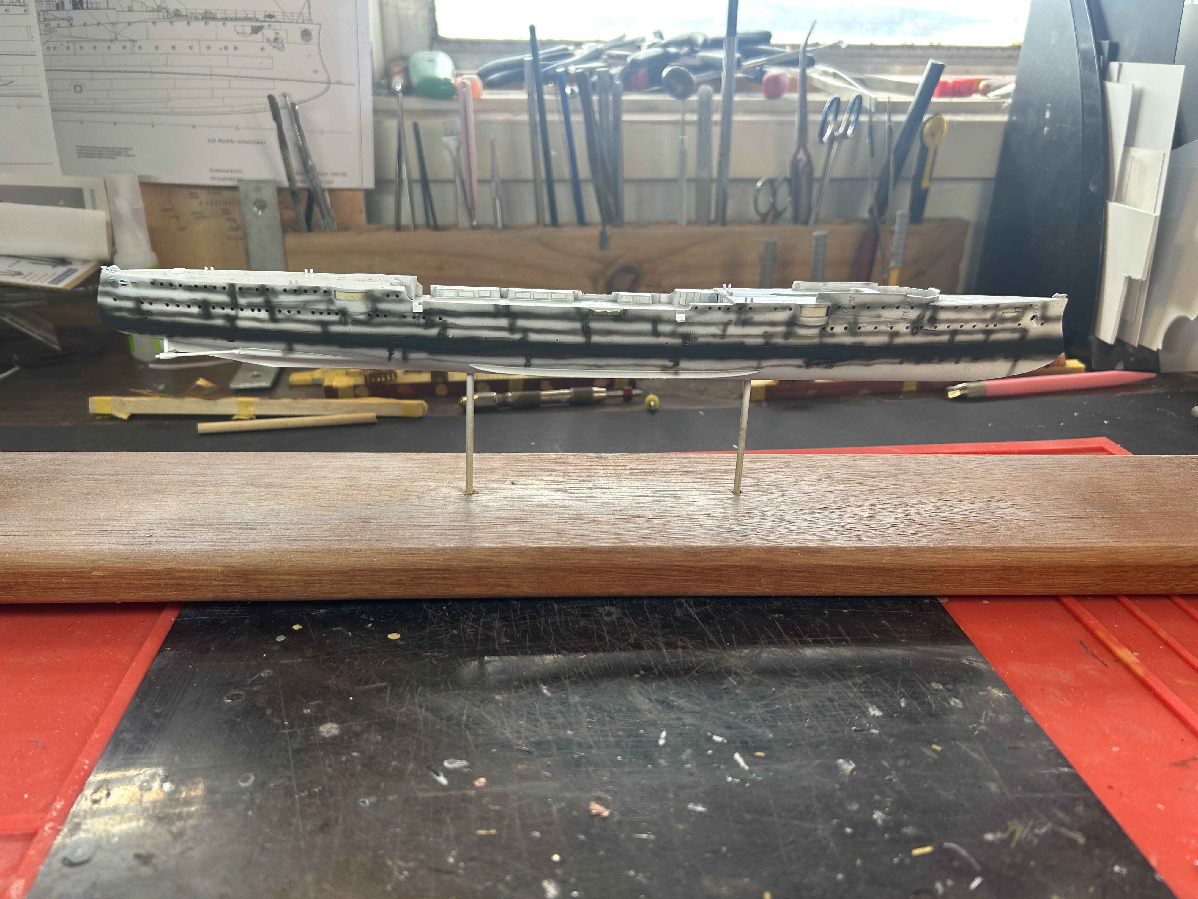

Starting in the lower hull, dark brown base, red overspray then pink fade. Next will be alge to a) cover up the sins and b) to make it look like a ship that travelled around the tropical South Pacific without frequent scrapes

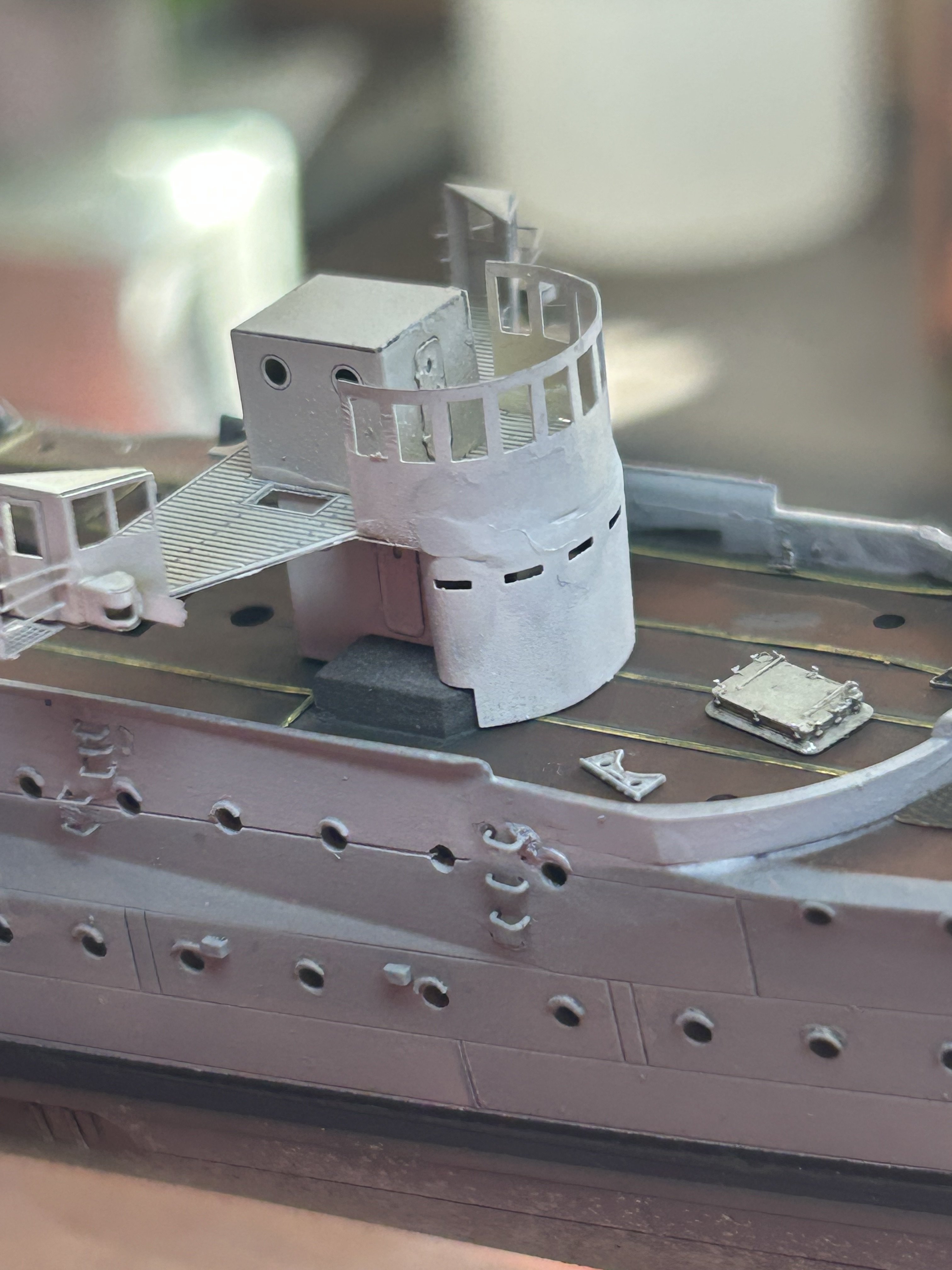

Continuing to work in the grunge, when upon close inspection I can see seam lines and putty. More sanding to do the patch work repairs and I’ll redo the boot strap and I want to make it a little more defined .

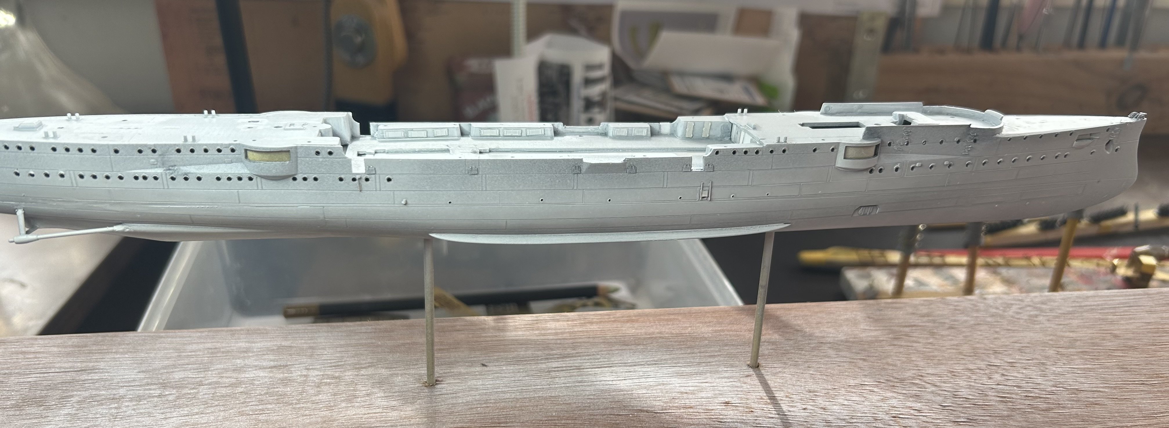

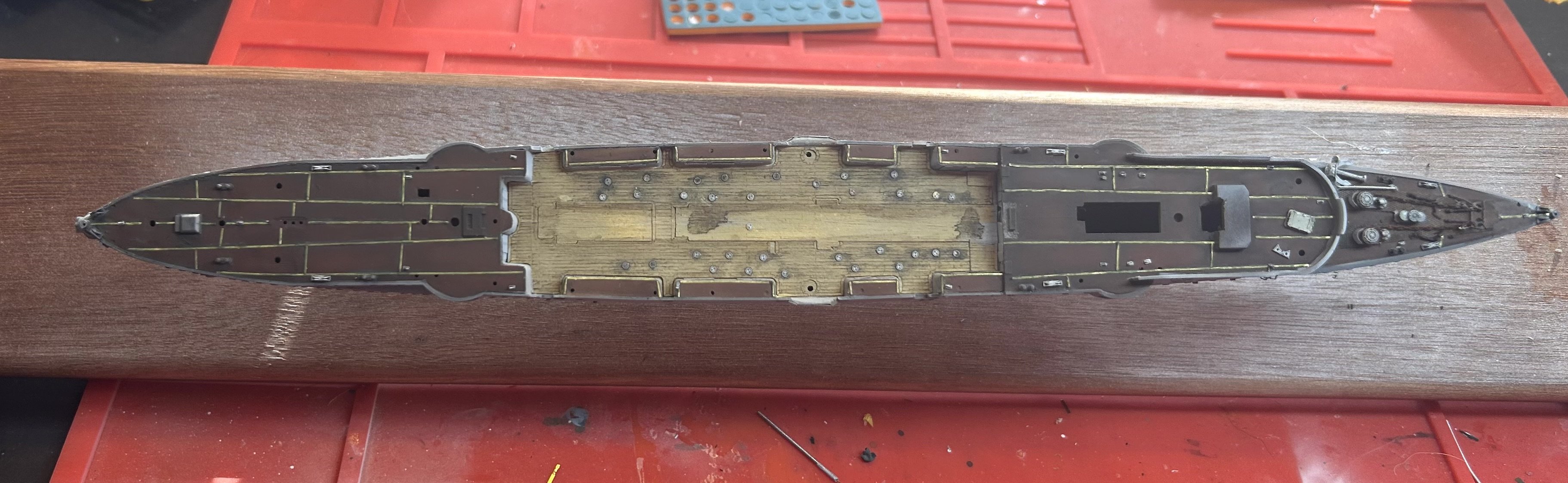

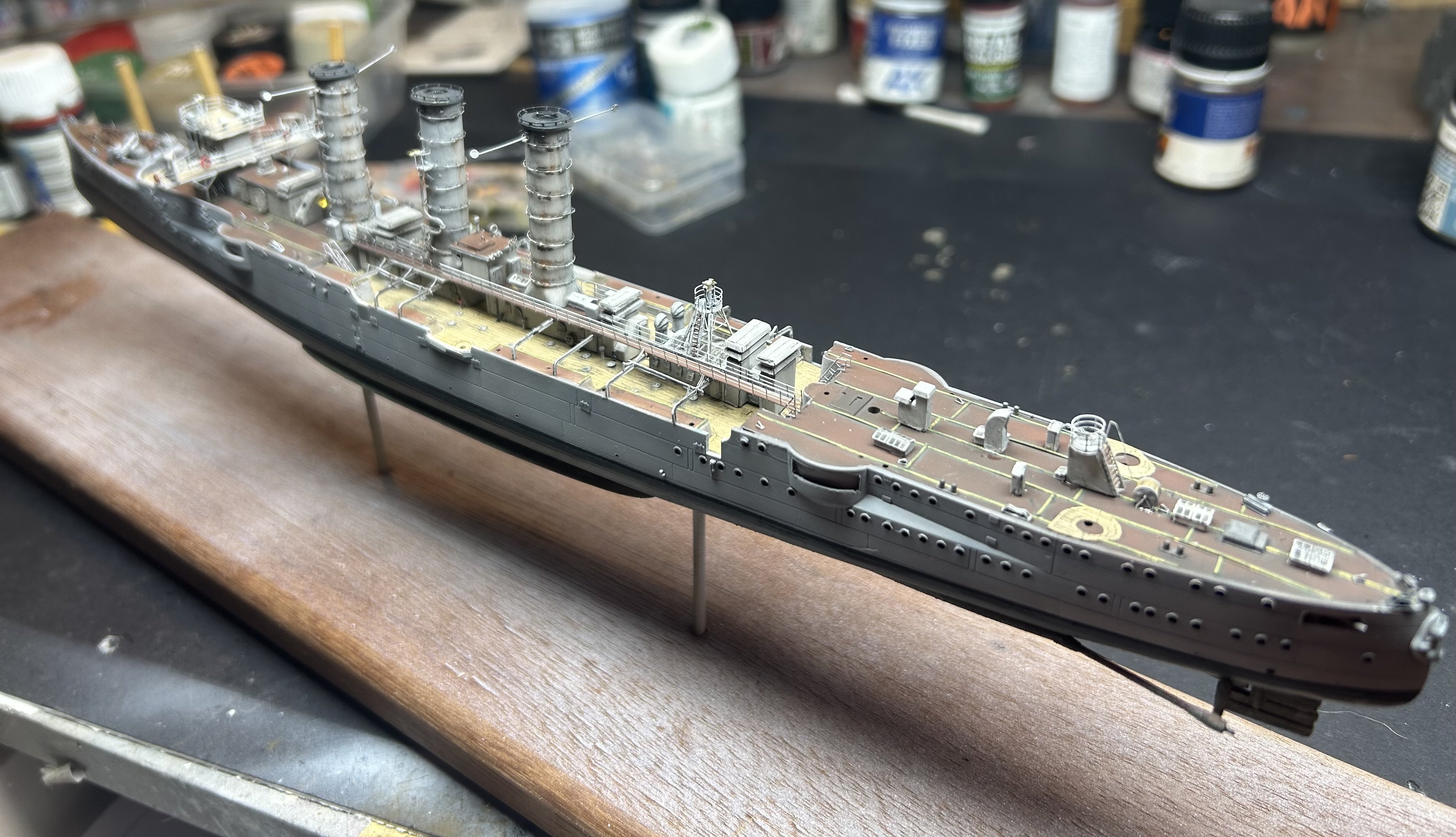

Emdens deck, two shades of brown; this was linoleum and I imagine it would get a bit of fade in the tropics. It comes up black in the old photos but would have been burnt. I’ve given it a clear coat and will mask it when dry. Next is to paint the hull before I can remove the mask and add the brass hold down strips

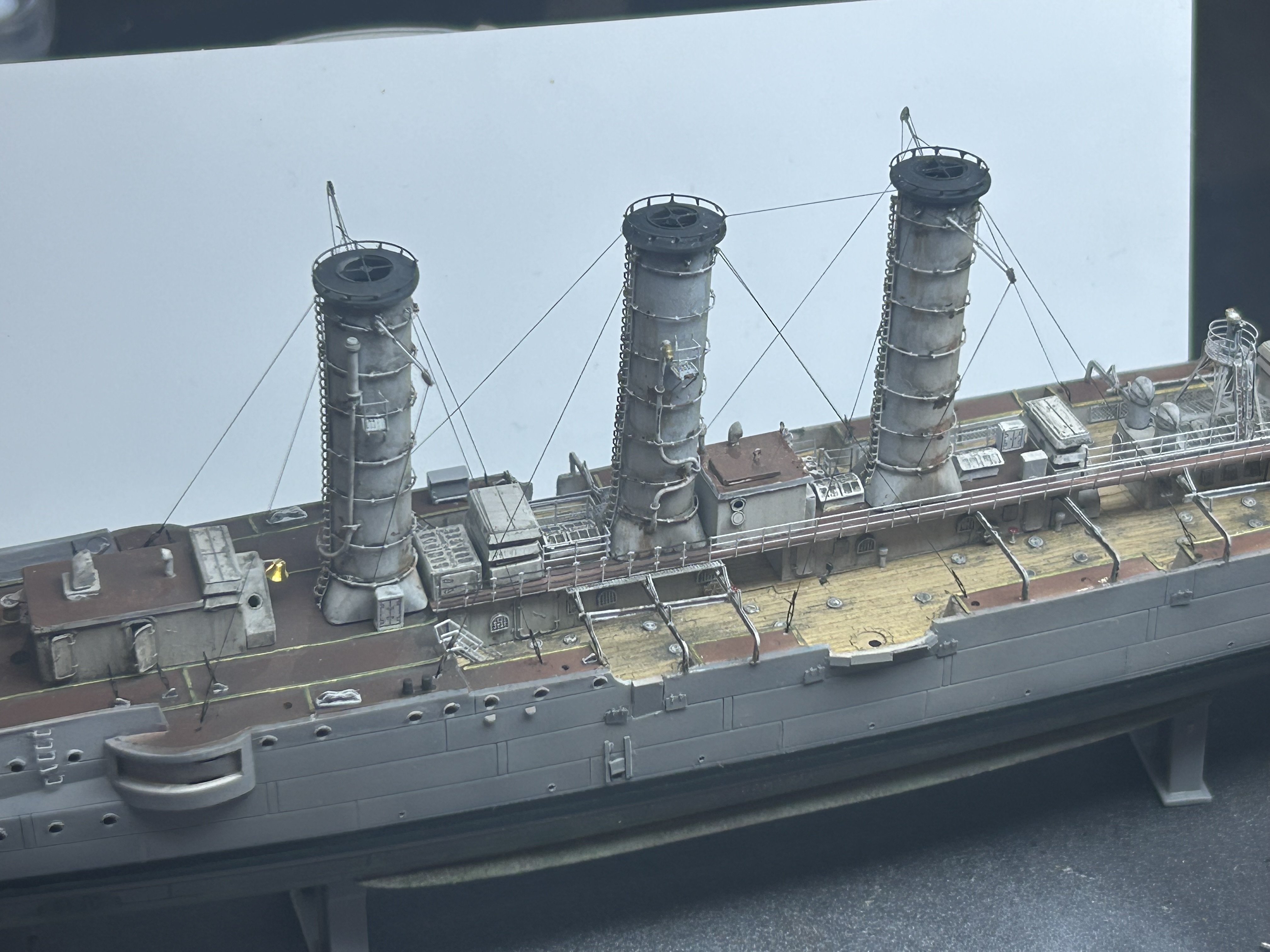

As you are aware, the brass is waaay to bright, so dulled down with some diluted green then a wash. Coaling scuttle’s added and a wash to dirty them up. By the time all the dockside dealings added this will just be background canvass.

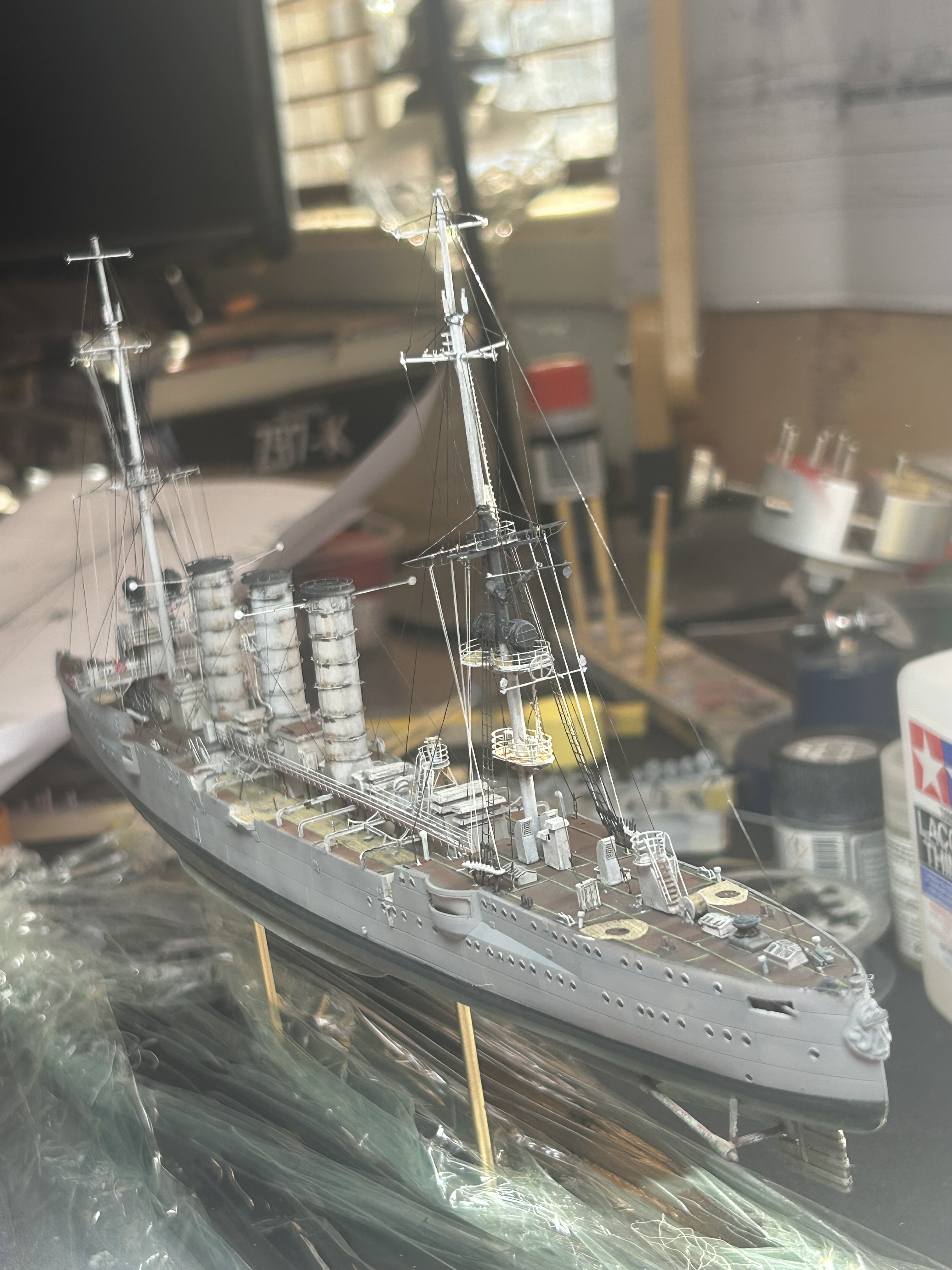

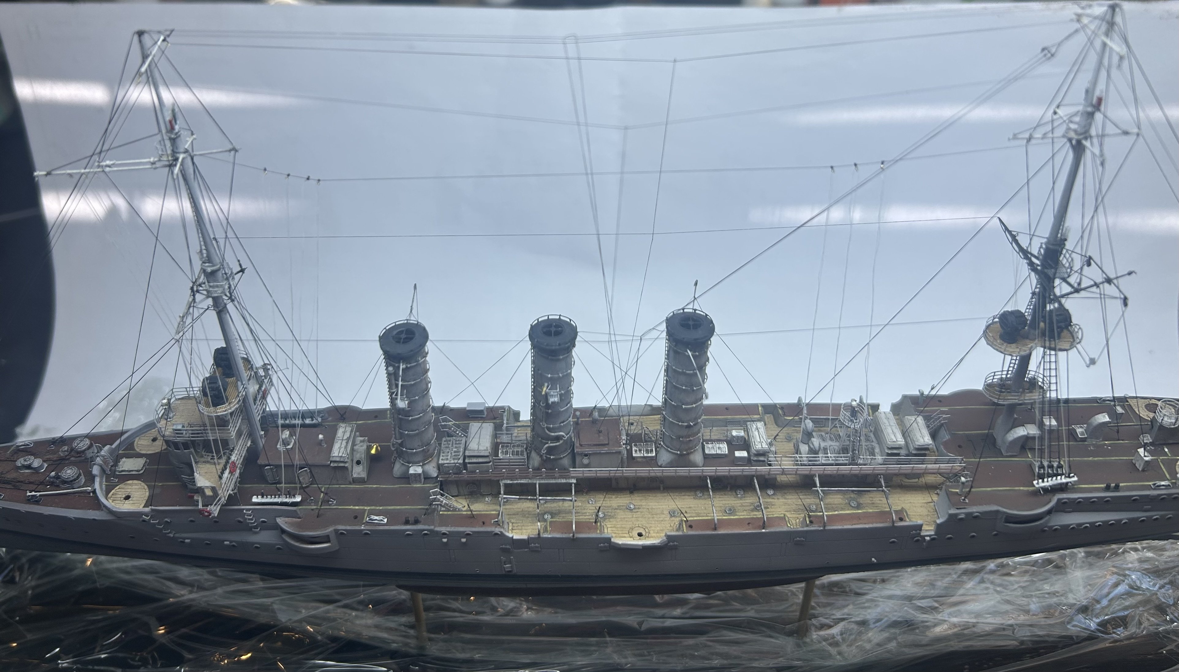

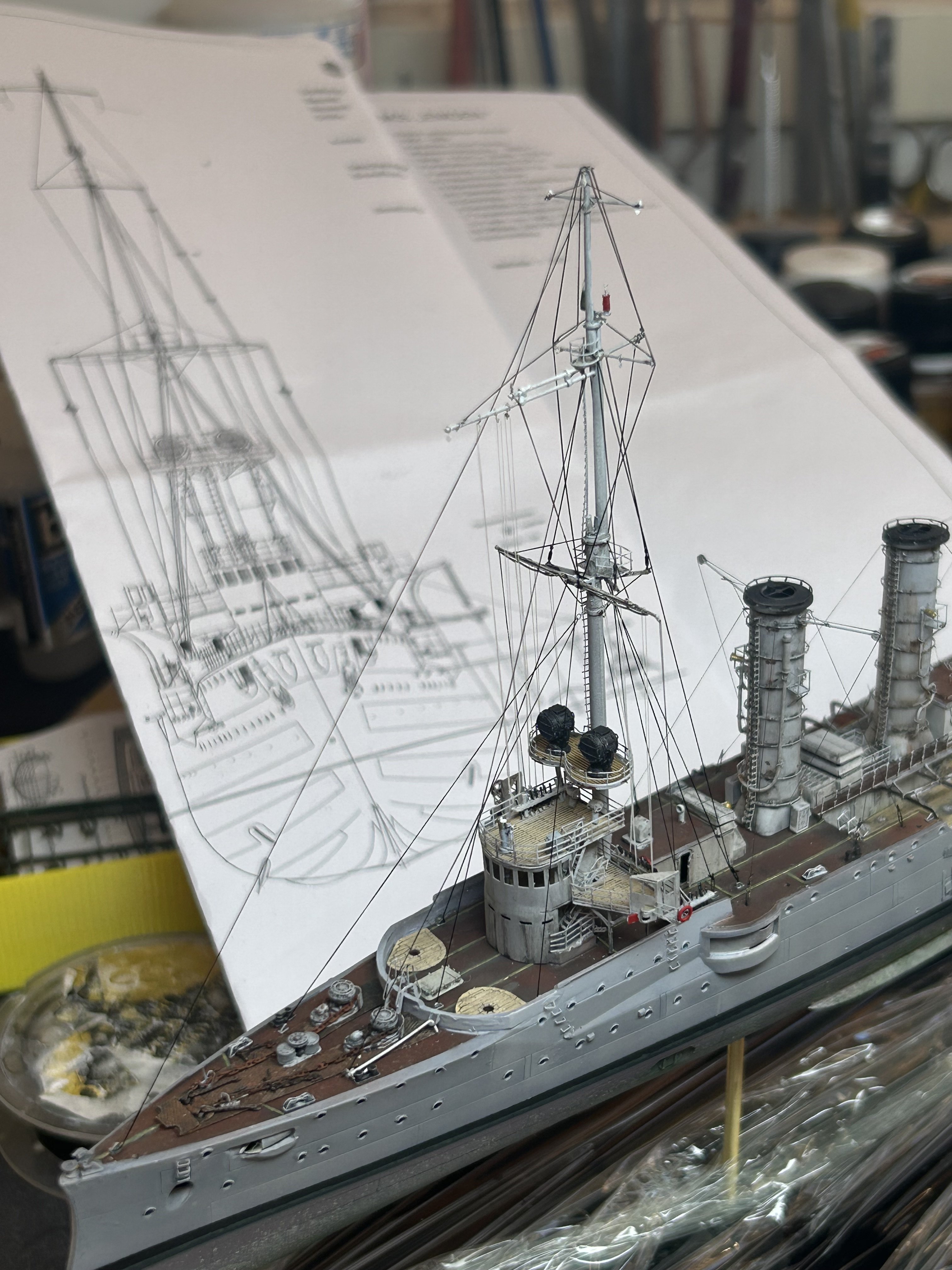

Denier line, I pre planned still the belaying points then use different thickness denier line m, stays are thicker than running, halyards are pale and thin, you have to use thin CA to attach denier line
