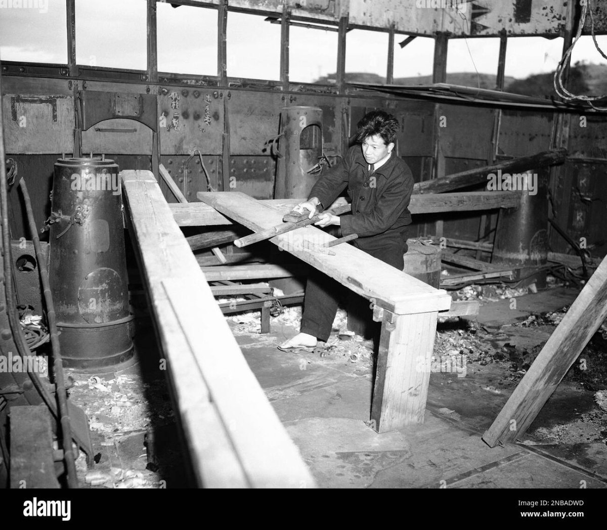

I have a question. I found a detail from a Japanese modeler — as shown in the photos below — namely anti-slip mats like those found on an aircraft deck, but placed on various platforms of the superstructure. I haven’t found anything like this in Anatomy of the Ship by Skulski, and I also don’t have photographic documentation that would confirm something similar.
So the question is: does this make sense?

In an attempt to get an answer to your question about anti-slip mats, my search of the internet came up empty.  However, if I may offer an opinion:  Japanese WWII battleships did not likely use modern-style rubber anti-slip mats as we understand them today in the superstructure. However, they probably employed various materials and methods to address the issue of footing.

Thanks a lot, guys. Looks like the issue's already been sorted out on another forum — I even got a photo showing part of the navigation bridge interior from the battleship IJN Ise, and you can clearly see the seams of the anti-slip mats in the foreground, so that pretty much confirms they were actually used.
