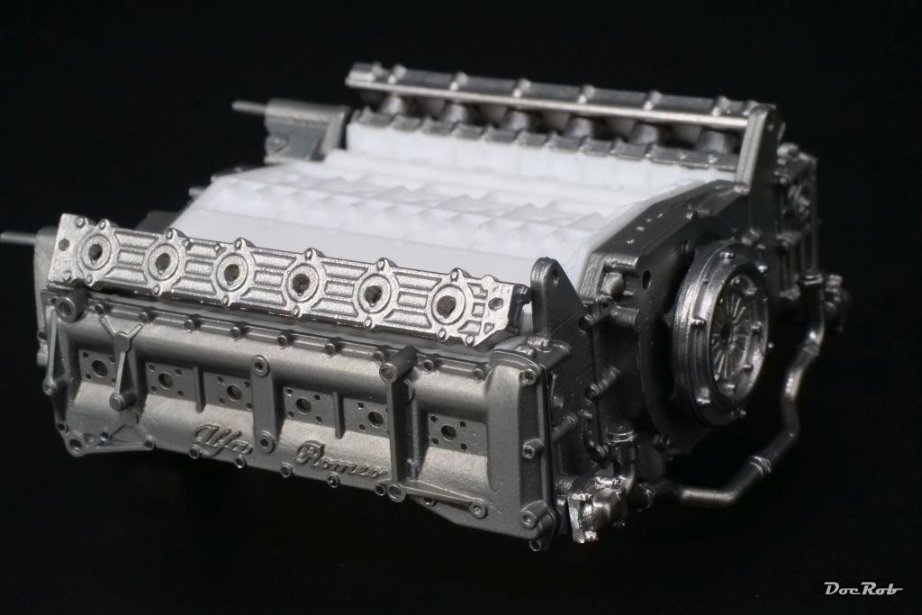

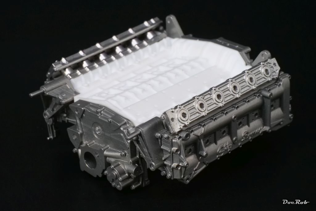

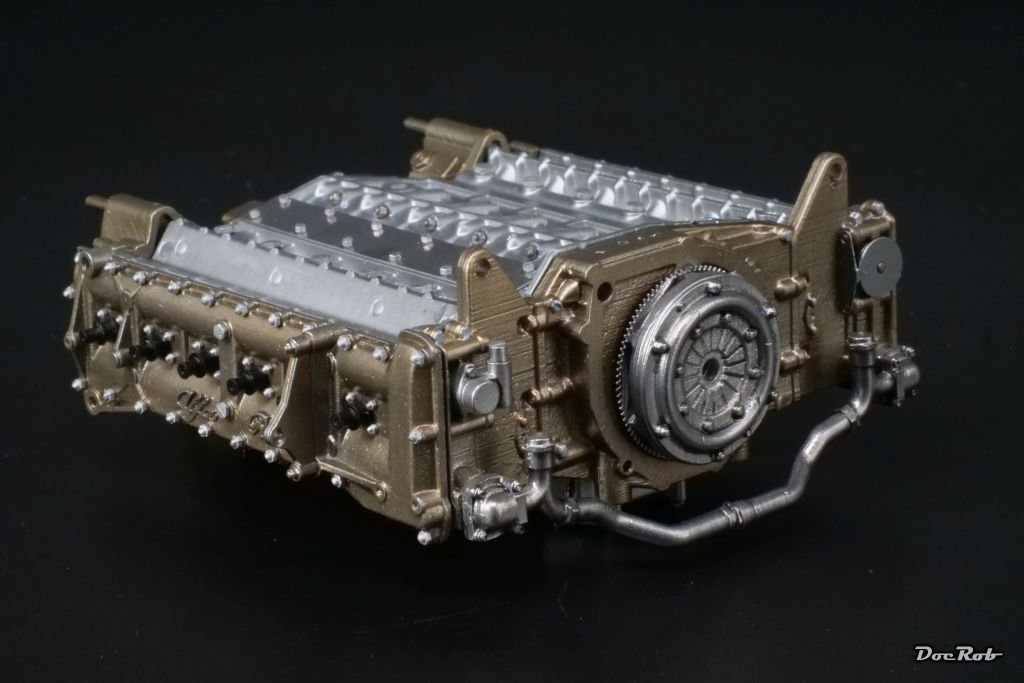

After about 150 or more holes drilled, most of the Alfa flat twelve engine is prepared for painting. Shown parts are only dry fitted, nothing is glued as of yet. There will be a ton of rivets been inserted into their holes after airbrushing.
Cheers Rob

One bank of cylinders is prepared, still six to go on the other side. You have to love to apply tiny white metal rivets with this kit, as there are hundreds. The engine was sprayed with AK Extreme Metals dark aluminum, the covers, front and rear, were a bit more complicated. The manual calls for a mix of copper and gold and my first try was with AK´s jet exhaust, which felt to dark and to bronze, followed by pale jet exhaust, which lacked the slightly reddish tone. Finally, I choose Ak´s pale brass, which looks good to my, compared with photos.
Afterwards, I painted all the casted nuts and boltheads silver and applied all the necessary rivets with fine tweezers into their pre drilled holes, always expecting the "ping" sound of a flying rivet.
Finally, I accentuated white metal with black panel liner and brass colored parts with brown panel liner.

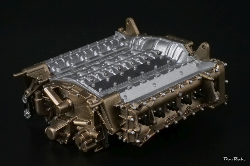

Cylinder bank number two is ready, again lots of riveting, always hoping that no rivets ping out of the tweezers. The rubber spark plug connectors got glued in and were drilled to accept the wiring.
This time, I used Tamiya metal primer for the first time, brushed onto the parts and it seems, that the metallic paint adheres well on the white metal.
BTW: Tamiya should use the MFH method for replicating belts. There are single cast belt wheels, the belt itself is made from self adhesive black tape.
One thing, I learned with MFH kits is the addition of springs. It´s always better to add the spring to the unmounted parts and glue these into place then.

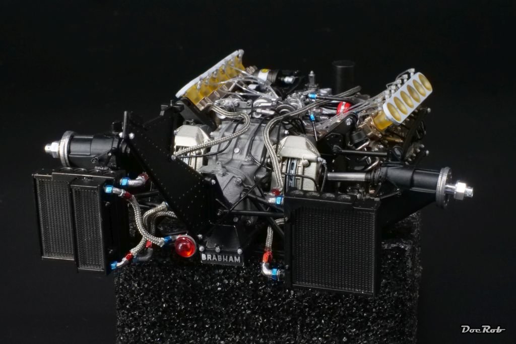

After checking all my MFH 1/12 kits about completeness, which was an exhausting task, I managed to continue with the Brabham. The clear yellow air funnels got installed, along with the clear fuel lines and accessories. This was a fiddly task, because it was difficult to determine the correct length of the fuel tubing.
I also installed the belts on the frontend, which were replicated by black self adhesive tape.
The white painted bracket parts on top of the funnels have angular PE parts glued on, to accept the fairings later. It was definitely a mistake to install them now, as figured in the manual, as I managed to break some.

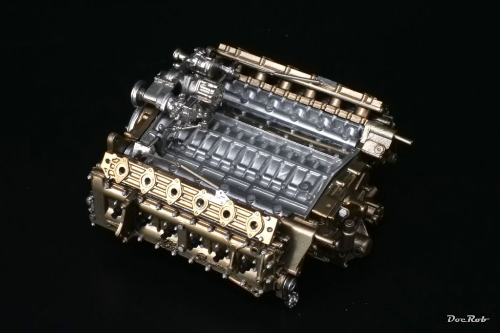

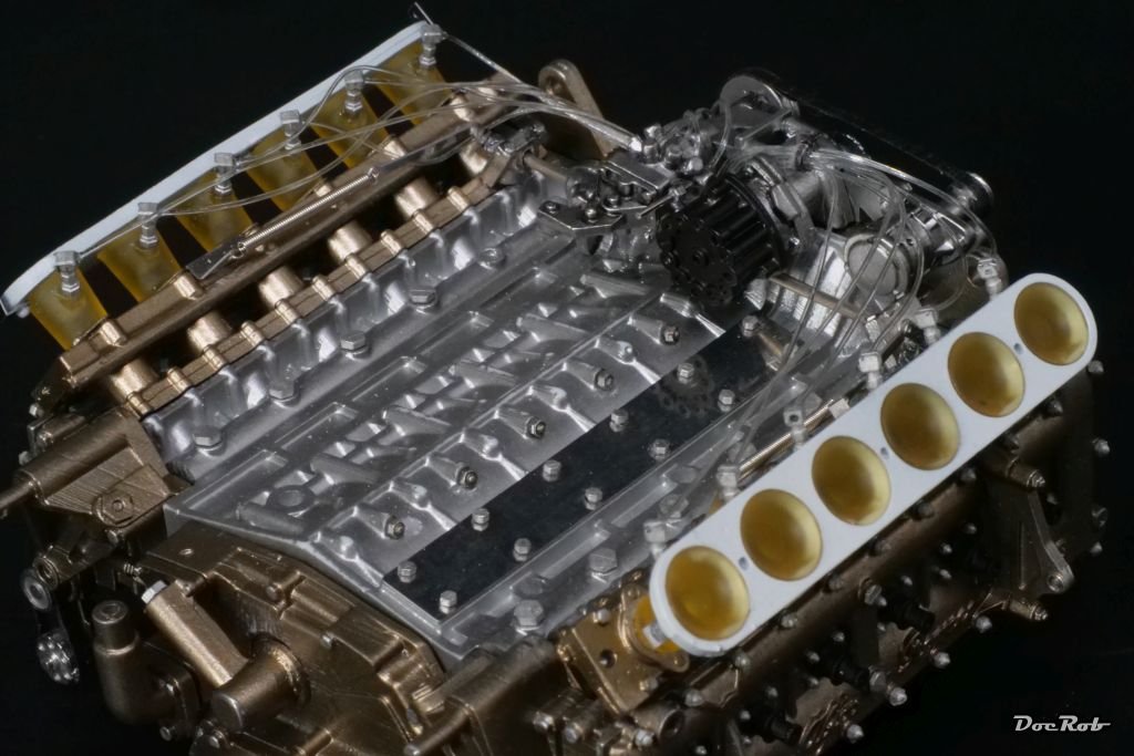

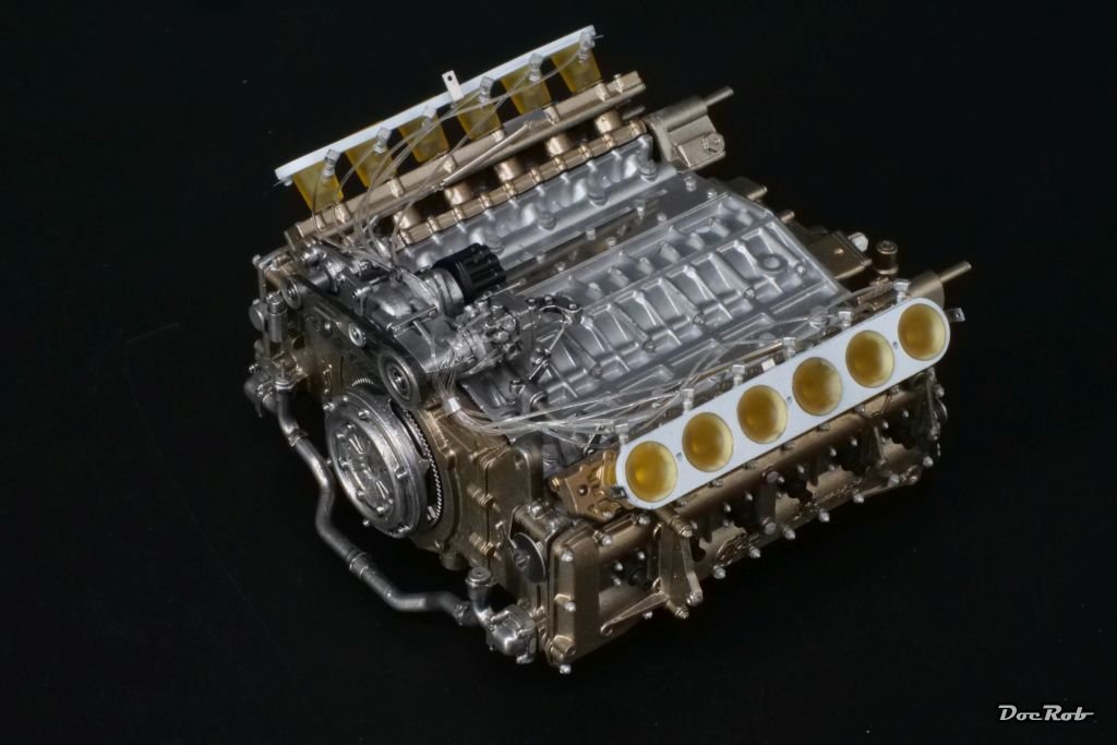

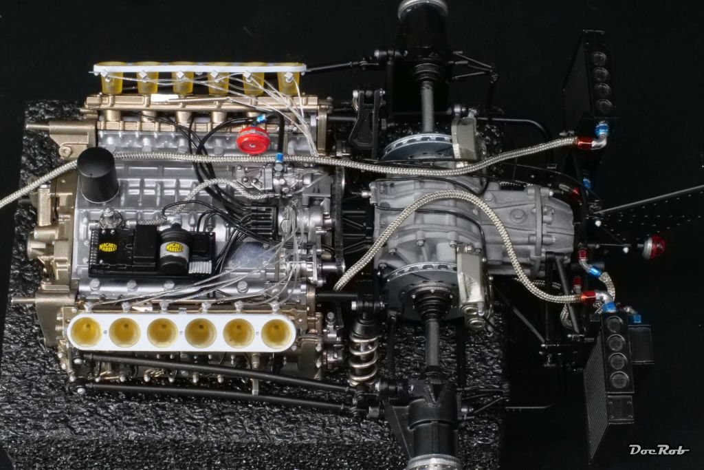

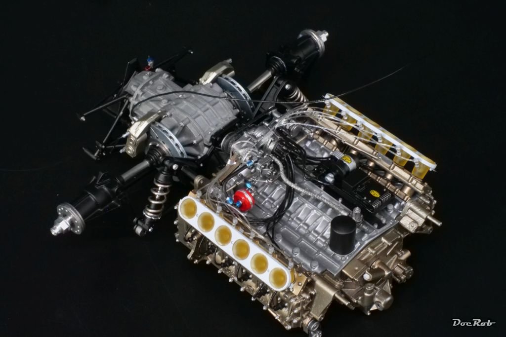

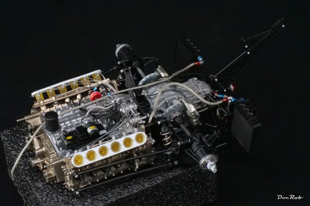

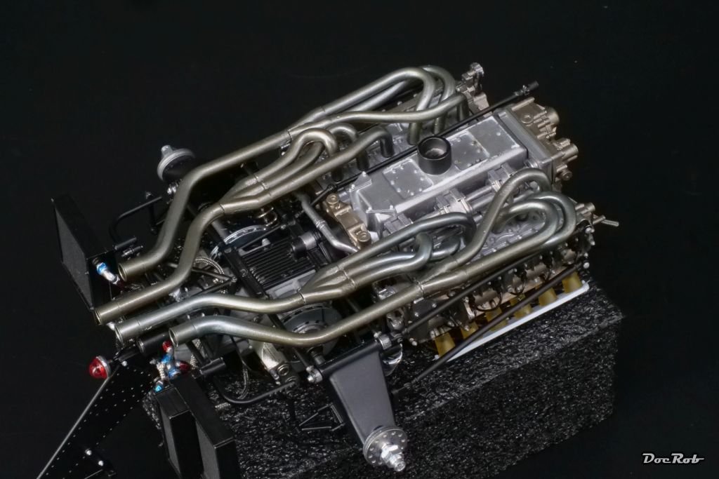

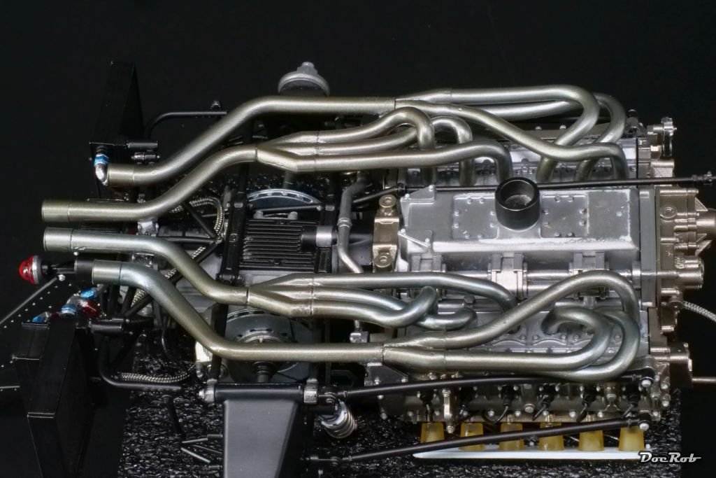

Today, I finished the engine so far. There will be some more wires and tubes added later, but this will happen after installing the gearbox and body.
In comparison with the transparent fuel lines, the addition of the wiring was relatively simple. Electronics and some other parts got added on top of the engine. For the first time, I used markers for detail painting, like screwheads and bolts, in this case a silver Playmarker from AK, which covered well, even over black paint.
I may add cable binders to the fuel lines and ignition wiring, but the ones, I tried failed miserably. They were 3D printed flexible decals from MFH and I managed to break four and got one installed and then gave up, so definitely no recommendation here. I think, I will use etched ones.
Another thing, I don´t like about the MFH manual is that there are no wiring length given and far worse, some wires or tubes lead to nowhere in the picture of the manual, which leaves you browsing through the pages and looking for the right connection, which probably isn´t there and the wire ends hidden somewhere in the body. A bit more clearness would be appreciated.

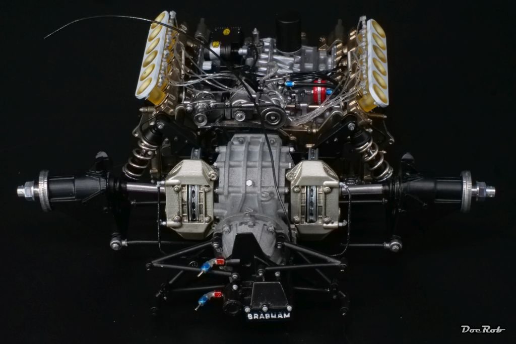

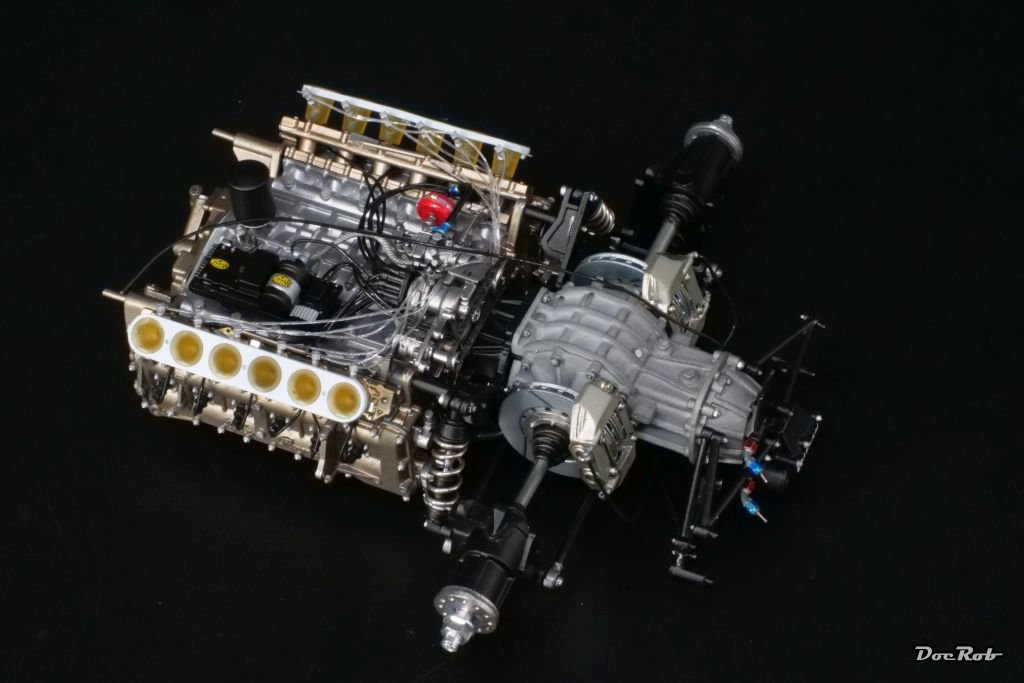

Next was the suspension, which is directly attached to the engine. The damper rods were painted with AK´s chrome marker and look really chromish, not like the to my experience really bad Molotow marker.
This was followed by prep work and drilling for the gearbox section, where a lot of bolts and screws are to be added. For painting the gearbox, I used Zero Paints Hewland Gearbox Texture paint for the first time, because it is a Hewland gearbox and have to say, I like the result, at least for a 1/12 kit.
I followed the recommendation of using a larger nozzle on my airbrush (0,4 mm) and raised the air pressure to almost 3 bar or 40 psi, to prevent clogging.
The brake disks were sprayed with Extreme Color stainless steel, therefore the slight bluish tint and the calipers were sprayed with duralumin.

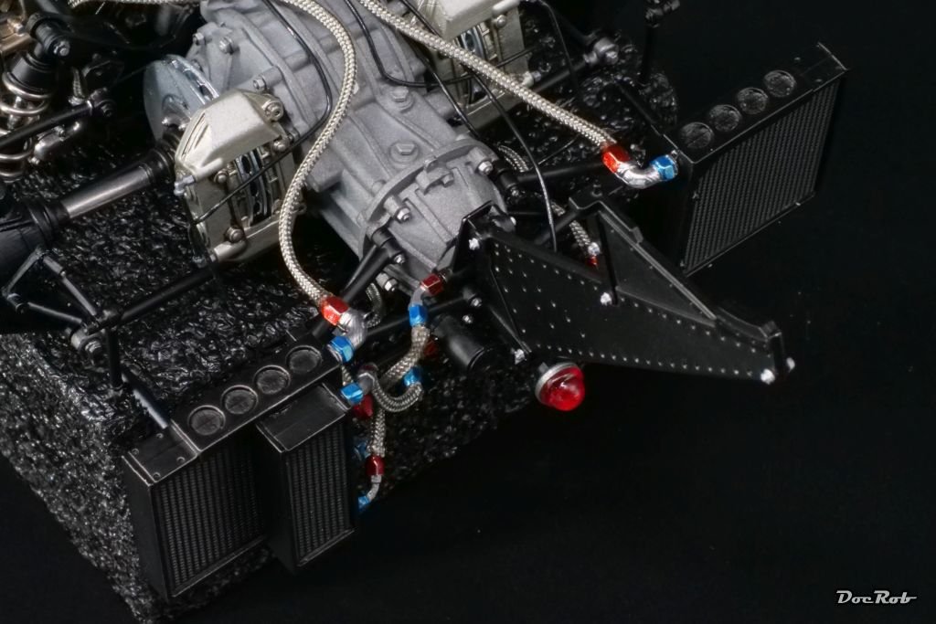

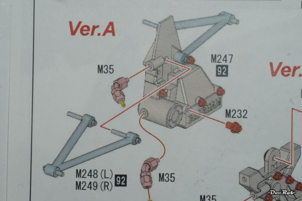

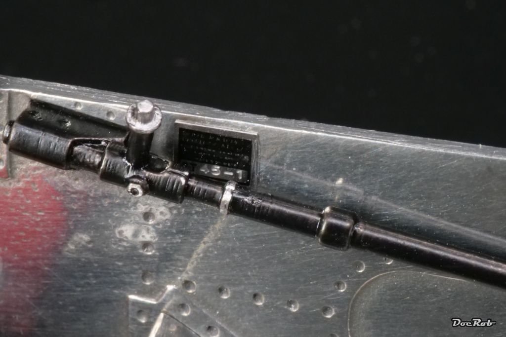

I finished the gearbox assembly step and started with the braking tubes. The fittings were badly casted by MFH, so I substituted them with resin ones. I stopped with the tubing and wiring for now, as I think, it´s easier to do it later, where it becomes more clear, which hose leads where.
If there is anybody out there building the same "Press Version" of the BT45 be aware, there is a mistake in the manual, which can only be discovered, when analyzing later steps. Part 248 (9) doesn´t go into the shown hole, but in the one to the left. It took me a while to figure out, how the supports for the coolers (248 (9)) will properly sit. The shown hole accepts the rear wing support later.

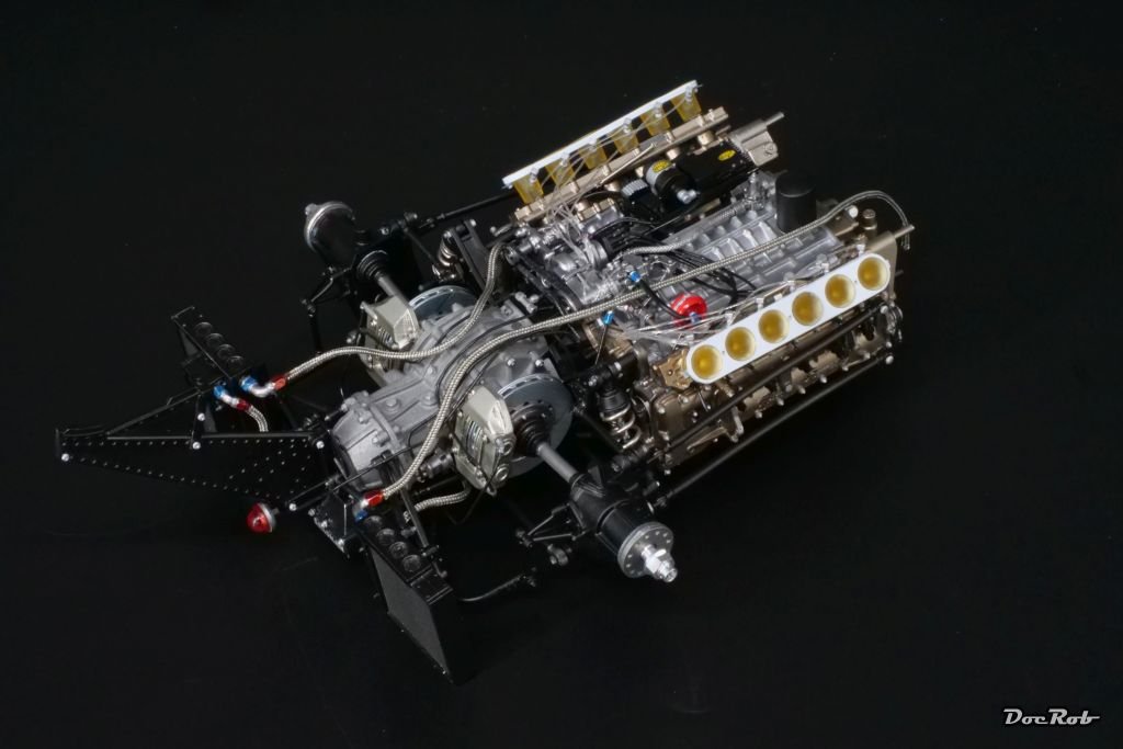

Chapter 9 of 20 in the manual is done and the rear section got finished sans the wing. Connecting the gearbox with the engine proved a little tricky due to numerous connection points, there is the suspension with adjustment bars, side rods and a shaft to connect all at the same time, trying to insert the screws for fixing everything. In the end it worked.
Another annoying part were the brake lines. The angled tube fittings provided by MFH were badly cast and I used resin ones from the spare box, but two of them broke and needed to be drilled out again.
I also substituted the white cast braided lines from MFH with braided textile hoses from Top Studio, which were far easier to work with. The cast ones need to be lengthened and bent, then drilled out with a 0,5 mm drill bit at the ends, to accept the fittings. Needless to say, that wiggling some of them in is nerve testing. The textile Top Studio stuff only needs to to be lengthened and then stuck on the 0,5 mm rods of the fittings with a drop of CA. Even my relatively liquid go to CA doesn´t soak and darken the braided hose.

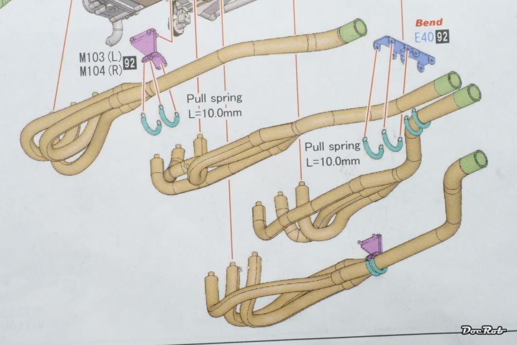

After a little pause, caused by one of my birthday presents, a week trip to the beautiful town of Valencia, I continue with the Brabham. I left the kit with the prep work for the exhausts just started and dreaded continuation, as F1 car exhausts can be a nightmare to build up. I cleaned all the parts and grouped them, followed by drilling all needed connecting holes. I then test fit the manifolds and glued the parts together with CA.

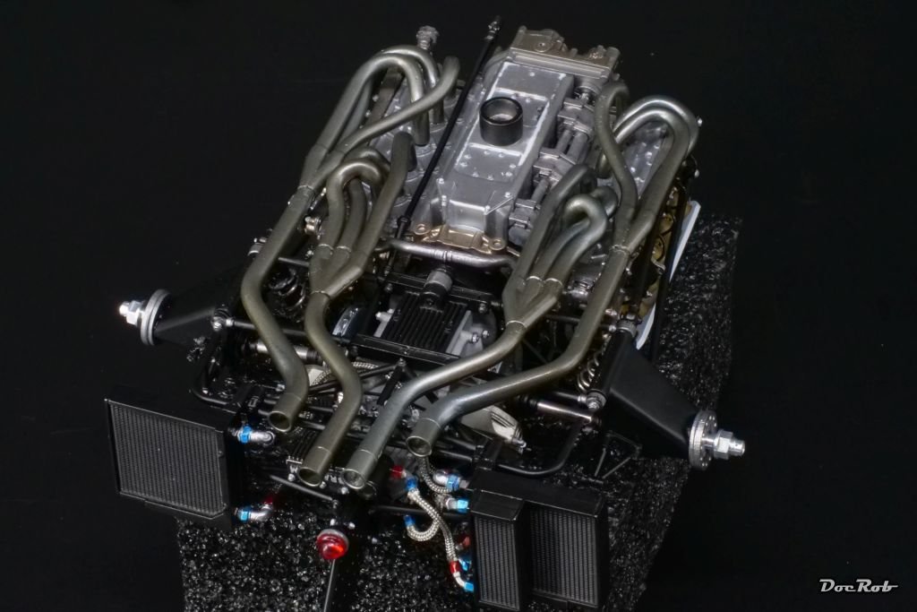

MFH claims silver for the exhausts, but what I saw on pictures led me to think of brownish stainless steel. I used metal etch primer, followed by AK´s exhaust manifold and accentuated it with metallic blue for heat staining.
While assembling, I tried to install the always dreaded coil springs before ore after inserting the exhaust, but failed. If I have a good idea, how to install these, I do it later or improvise somehow.

2 hours ago, yvesvidal said:
Just amazing. These exhaust pipes seem to come out of an Alien Movie.
You are right Yves, the exhausts look like Alien entrails and they are slippery as eels, when test fitting. It must be hard to design the exhausts with the idea of getting all twelve tubes at the same length.

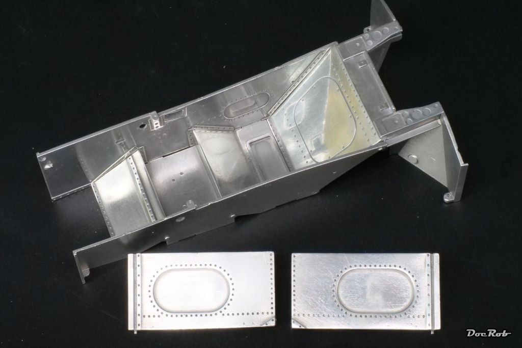

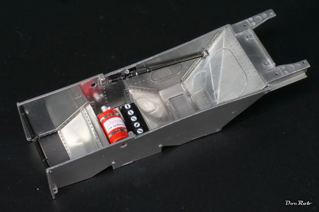

Yesterday was the day of mano negra, the black hand :D. Polishing white metal makes your fingers black with the metal residues, but despite the dirt, it is fun.
I used sanding sponges of 1200 to 6000 grit, to get rid off the cast imperfections, then it was about polishing with a cotton swab and Autosol metal polishing paste with works really well. I like the shiny look a lot and it could pass for polished aluminum to my eye.
Today, i test fitted for some hours, as now is the decisive  step, where the tub has to fit into the body, along all the mating parts.

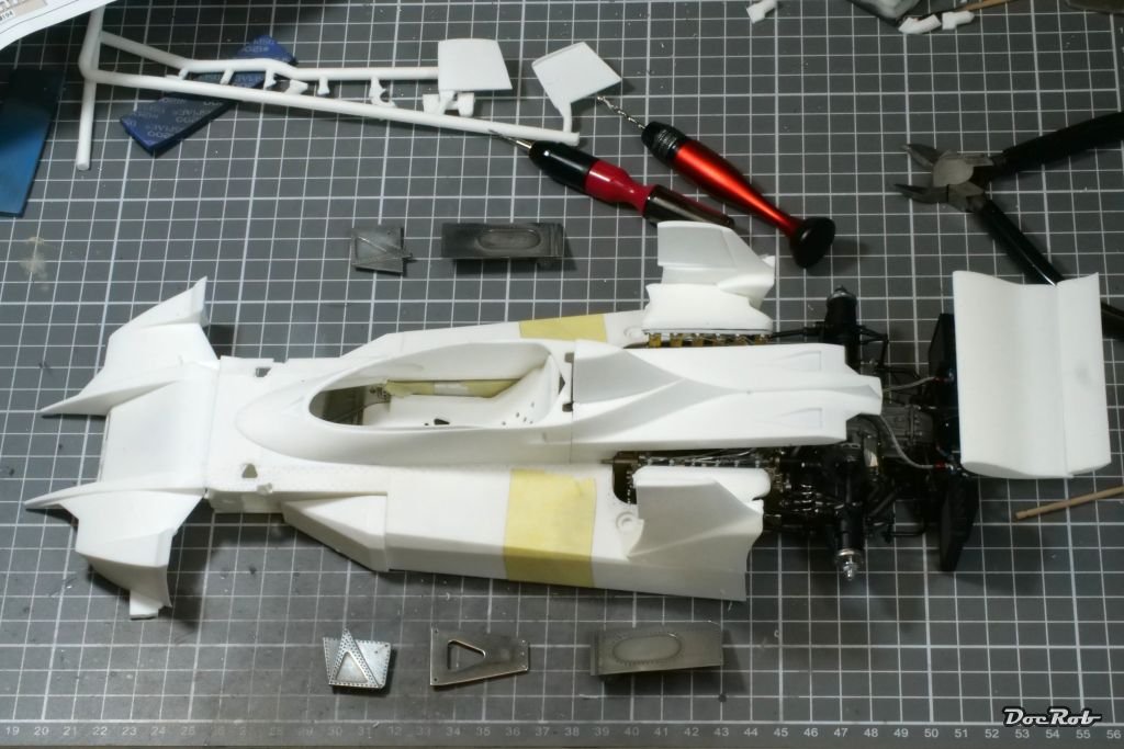

There is not too much to show at the moment, as I´m preparing all the resin parts and some of the metal parts for the next steps. Test fitting is time consuming, but helps to recognize, where everything fits and how.
During this test fitting period, I made a mock up workbench build up.
Cheers Rob

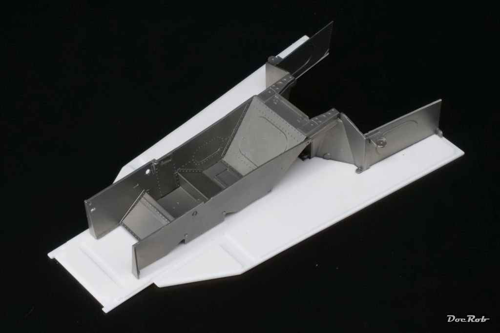

The preparation of the resin and metal parts for all body and the front suspension is quite time consuming, but the fit is overall very good. All body parts got cleaned up, surface sanded, washed in soap water, swiped with an alcohol soaked cotton rag and finally primed with Mr Surfacer 1500 whit primer, which laid down beautifully.
In the meanwhile, I glued together the polished cockpit tub and added some accessories. The battery and fire extinguisher will be hidden under the seat later.

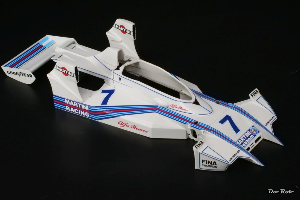

Finally some serious progress. I finished decaling the body parts, after a long period of prep work.
My usual method is read the manual, understand the manual, drill all needed holes, fill and sand where needed, sand all resin surfaces carefully with 4000 grit, clean all the parts first in soap water (helps to reduce the static, these resin parts possess, which makes them like dust magnets) and wipe it with alcohol. Next was Mr. Color 1500 white primer, which sprayed fantastic like always. After a day of drying time, I checked the surfaces again and then applied the body color, in this case Number Five´s Brabham BT44 white, which is a tiny bit off white.
I sprayed the first layer un thinned, let it cure for some minutes, followed with a mix of about 25 % leveling thinner and paint and let dry for some more minutes. The last layer was applied with about 50 % of thinner and the relatively short drying times helped, that the later layers "soaked" into the base layer.
There was extremely minimal orange peel, which completely vanished after half an hour of drying.
I have to say, these Number Five colors are fantastic to work with an give the best possible surface results. I used them for the Cobra Coupe as well.
I feared decaling a bit with the thin pinstripes and huge decal bands slung around the body. I didn´t need to worry, the decals were fantastic to work with and were applied using warm soapy water only. One word of warning though, MFH decals are covered with a very thin very transparent plastic sheet which slightly adheres. Take care, you remove it before applying the decal, because it sticks to the foil much better than to the backing paper after soaking and you have to carefully peel the decal off the foil with a scalpel blade, which is really no fun. I only missed to remove the foil with two decals, but man, was I sweating.
