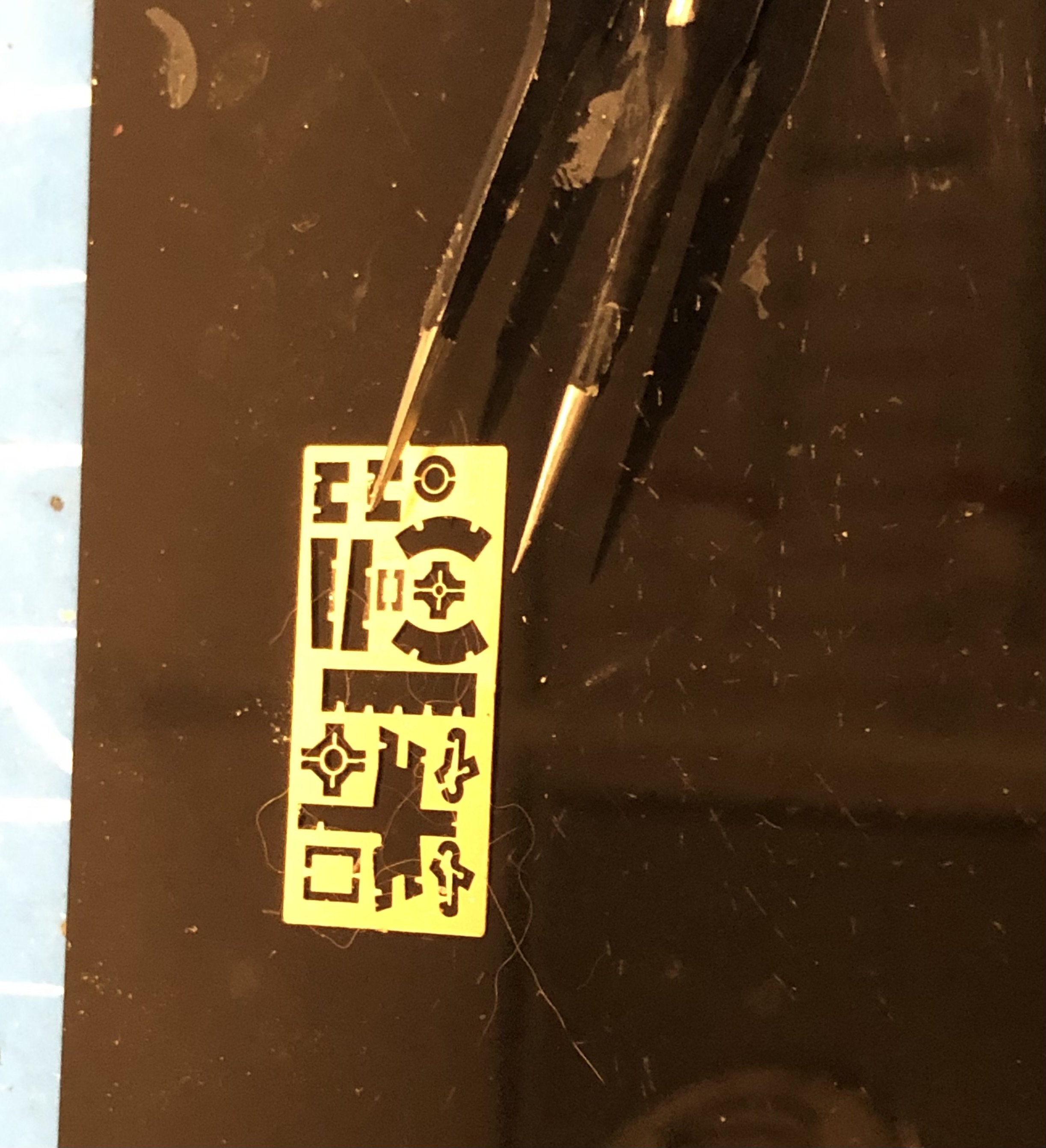

The photo etch is very soft and easy to cut and bend but very small.

 last two bits of PE were a puzzle.
The instructions show P4 as mounted on the turret but not where.
The helpful photos provided by Patrick once again came in very handy and confirmed that there is nothing similar on the real machine.
Again P9 is supposed to be situated in front of the driver’s hatch but the photos show nothing there so these pieces have been omitted.

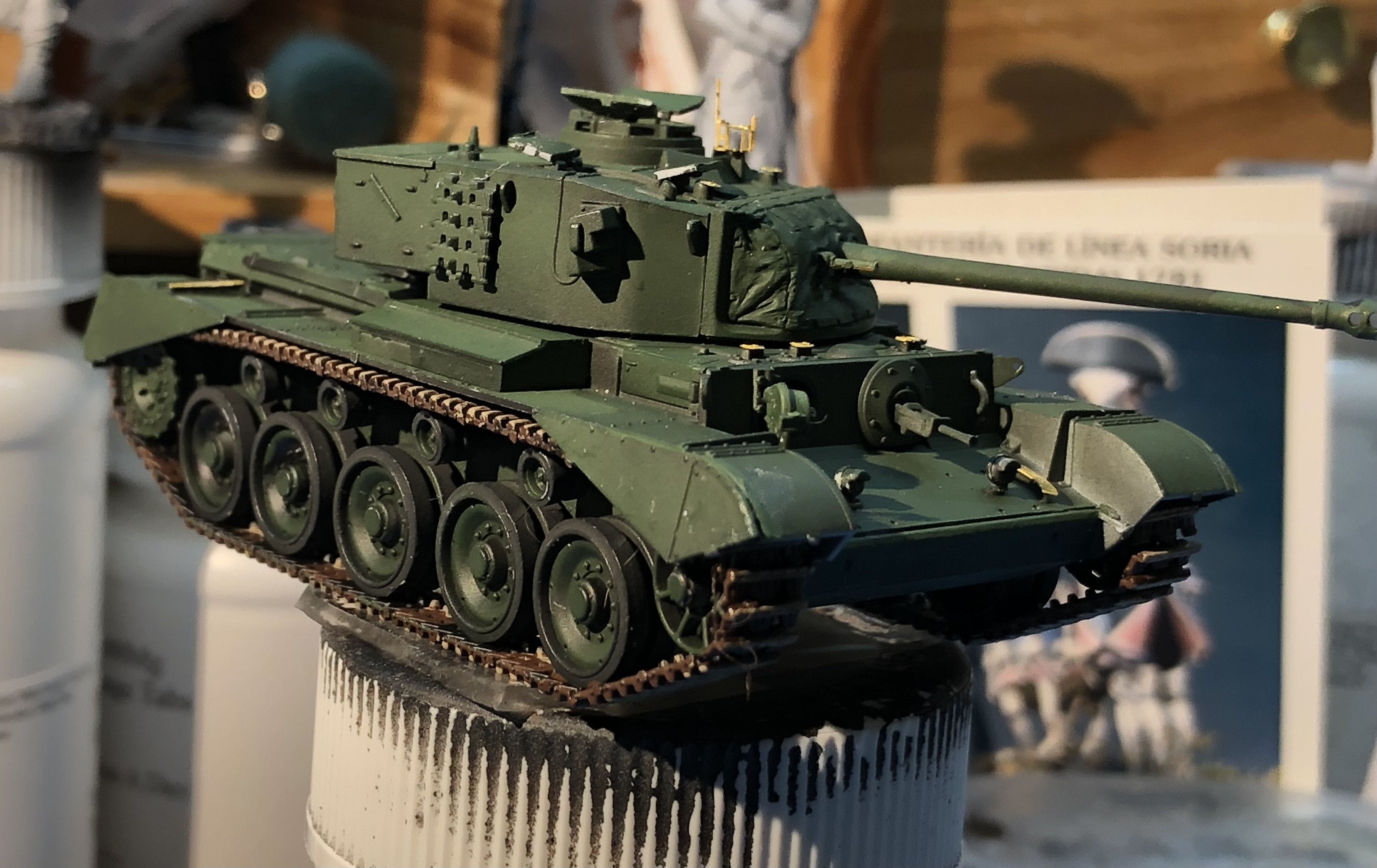

That done the tank was ready for paint touch up and a gloss coat ready for the decals. The decals came off the backing paper nicely and laid down smoothly.

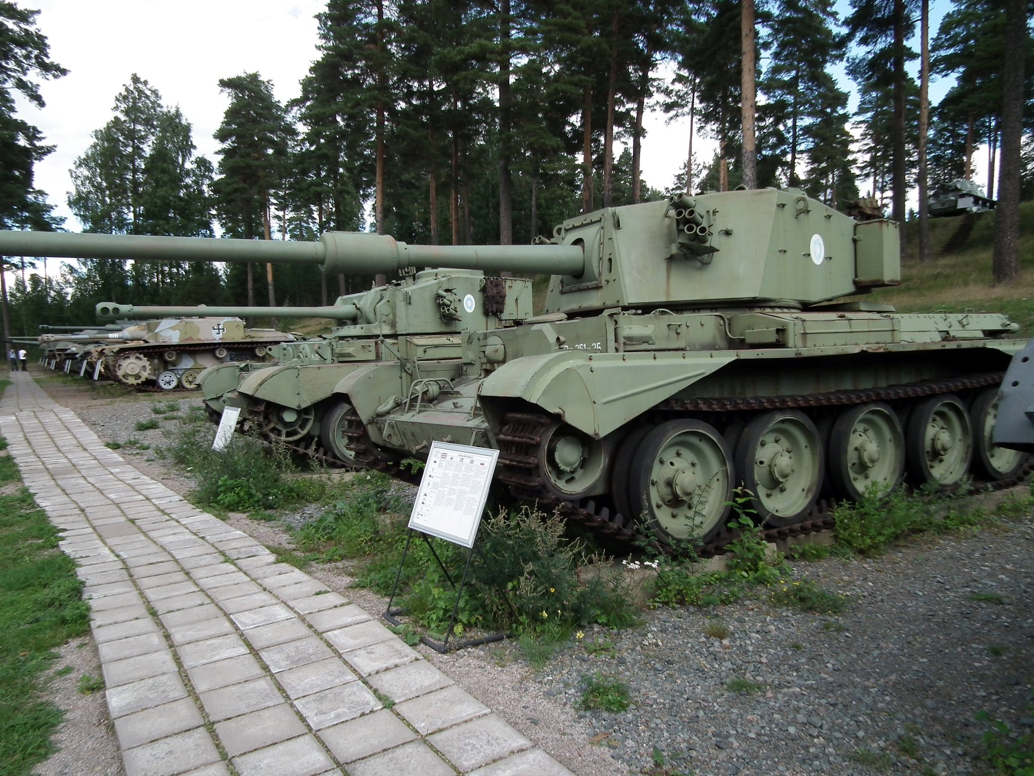

 spade was added and the towing cable. The kit supplies a length of braided wire for this but no indication of placement or length. Once again those photos …… Many thanks again @Baker
The wire looked under scale and too springy to use easily so I substituted a piece of rigging cord painted light grey (galvanized I assume) and added the kit supplied eyes to each end. This was added to the front deck and suddenly it was obvious what some of the PE bits were for.
ive used some diluted buff acrylic paint to simulate a light coat of road dust. I can’t imagine that peacetime tanks were encouraged to be scruffy.
IMG_2004.thumb.jpeg.2e4c715bba5dac75af626930d1cb995c.jpegIMG_2003.thumb.jpeg.5565281928004b70ebd72c271f7956ed.jpegIMG_2002.thumb.jpeg.b32743ae42c1c1715650b460bb41123d.jpegIMG_2001.thumb.jpeg.13297b658b5bf1e3c2dea022776db30c.jpegIMG_1999.thumb.jpeg.0c316938e173f6c39a24bd0b39a94faf.jpegIMG_1998.thumb.jpeg.0ec9852b6b350d6eda4c424c387bb6d8.jpegIMG_1996.thumb.jpeg.b6b4108b1029c03c43b16be77f44722e.jpegIMG_1995.thumb.jpeg.ce8ec26abc2684ce6ad88b9d284f8043.jpegIMG_1994.thumb.jpeg.2dd3946ade5c5cf8a38e5b5ca03861fb.jpeg
I enjoyed building this kit and actually found it to be easier but still well detailed compared to the Flyhawk kits. I’m very tempted to try another Vespid kit but I’m trying to hold to a moratorium on buying anything else until the pile is reduced.
