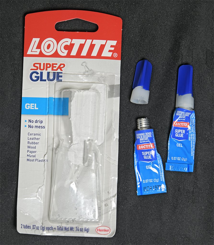

Superglue.jpg.db32e0eea52eb7443bfc66d8013cced2.jpgThen I bought these two tubes a couple of days ago. The instructions said to screw the end/cap pair onto the tube to puncture the thin metal diaphragm on the top of the tube. Try as I may it didn't work with the tube on the left. So I tried to puncture the diaphragm with a sharp metal point - it wouldn't puncture! The entire brand new tube was rock hard!
The second tube was still pliable so the glue inside was still liquid. I tried to open the second tube and the cap would not screw on straight and puncture the diaphragm. I punctured the diaphragm with a metal point and used the end/cap from the first tube.
So far I have gotten three small drops of glue from this second tube.
So out of six tubes of superglue I have purchased only one gave me at least half a tube of glue before it hardened. Two were hardened before I opened them. Two more solidified shortly after I opened them.
Considering the relatively high cost of this stuff, it has cost me two to three dollars per drop. That is extremely expensive!
Apparently other people have had better luck and have actually been able to use super glue regularly. Does anyone ever get to use an entire tube before it hardens? What's the secret?

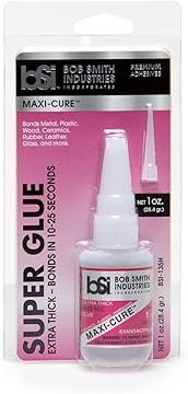

I have used C/A glue by Bob Smith Industries (BSI) for over 20 years with complete satisfaction.  Many places sell BSI glues under the stores name.  Same design of the label except for a silver label with the store's name on it across the top.  This is a very high quality glue and if properly stored will last a very long time.  Recap when done for the day and keep it away from excess humidity.  Dole out a few drops and recap using a C/A applicator until the drops dry up or run out.  I buy several bottles at a time and keep the sealed up glue in my shop freezer for a couple of years sometimes.  Open it and it works perfectly.
The only problem I have ever had have been because of forgetting to recap the bottle for an extended time or keeping an open bottle in close proximity to C/A accelerator for an extended time.  I try to keep the accelerator far away from the C/A being used - at least 2 feet.
I keep several types of the BSI C/A glues as they have very different by very repeatable and predictable setting times.  I mostly use the Super Thin and Gap Filling Medium glues in 1oz bottles.

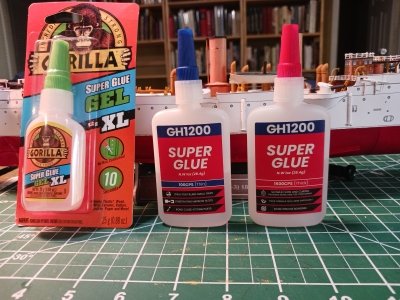

Yeah, I've never had a good experience with the little tubes of CA. It wasn't until I acquired a bottle of Gorilla Glue that I found CA to be a reliable option. I also found that the Gorilla smelled less than other brands. I acquired the two bottles of 'GH1200' glue over a year ago because they were much cheaper than Gorilla and they're still going strong. I also discovered that the thin glue had a much stronger odor than the thick. When using the gel I typically put a glob on a piece of aluminum foil and use a toothpick to apply it. For the thin, I do use one of the thin micro nozzles that can be slipped over the bottle's tip. That also cuts down on the odor. Nevertheless, the older the glue, the longer the drying time.

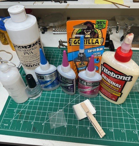

Here's my "everything glue" picture.  Previously, whenever I needed to use CA, I grabbed the Gorilla Super Glue with the Micro-precision nozzle.  But, for the past few years, I have been using the Bob Smith Industries cyanoacrylate products, and have the extra thick, the gap filling medium and the super thin.  To be honest, the super thin is really hard for me to control, so don't use it as much, but need to keep using it.  They are great CA solutions, when needed.  To apply, I grab a small wax paper square out of my stock (held with the clothes pin) and place a dab or so on the wax paper and use a thin toothpick.
For my diluted glue supply, I have a bottle of PH Neutral PVA that I keep diluted in a small squeeze bottle with a needle applicator.  That works really well, and I always have a Q-tip handy to soak up any excess (if needed) .
In my current rigging of the Santa Maria, I have begun using the Sally Hansen Hard As Nails polish, which has come in super handy and convenient for the rigging knots.  The built-in applicator brush makes it super easy to place a small drop on the rigging where needed, and it has a decent dry time to keep the job moving.
And, of course, finally, the Titebond Original for all my wood gluing.  I'm liking the Original better than the Premium.
Anyways, back to Phil's original query, I am not familiar with the Locktite product but have seen it in the store.  I had no issues with the Gorilla drying up, and have had no issues with the BSI products (although I do recap continuously when using.

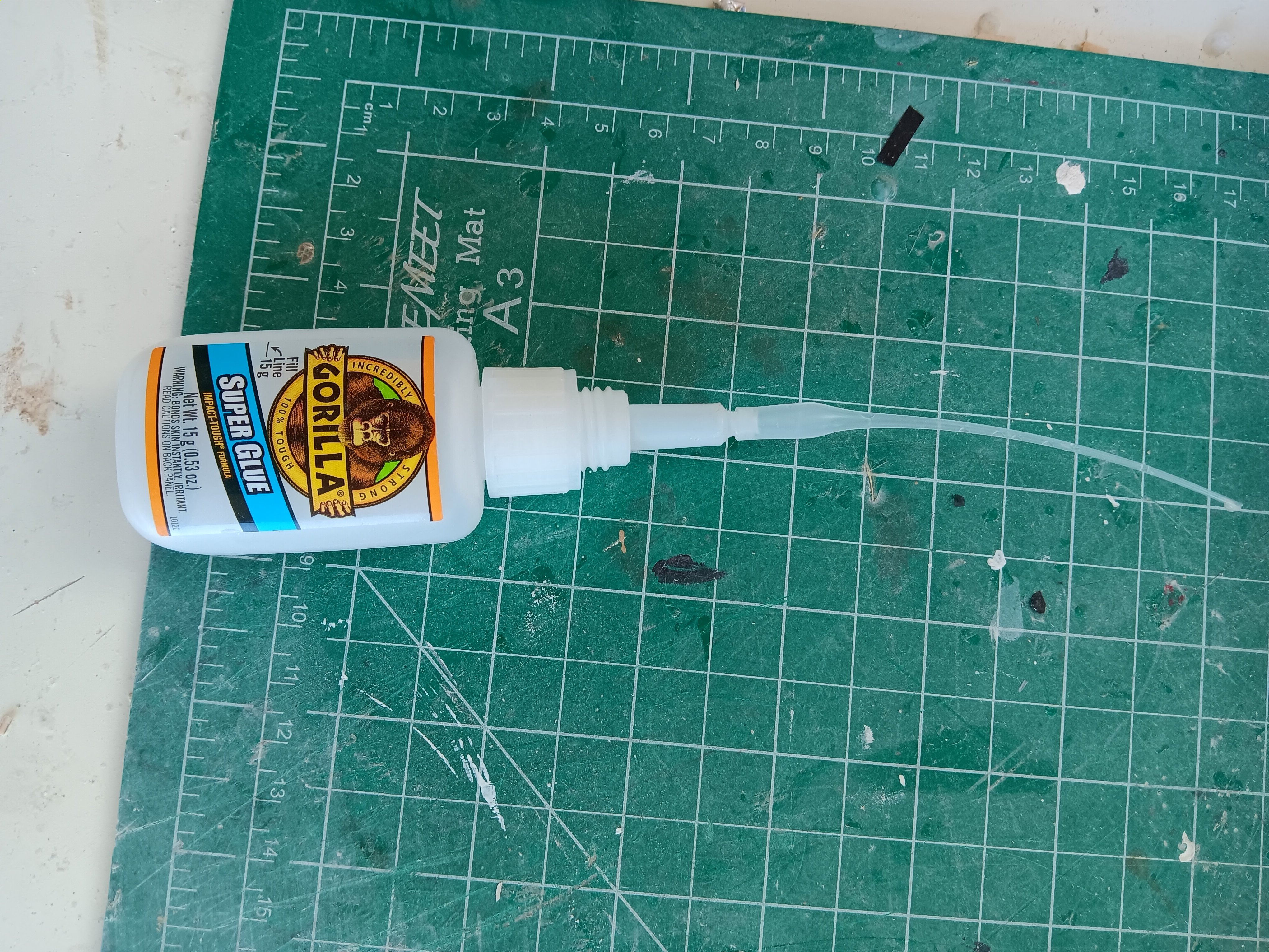

Key for me is using the very fine tips I bought on Amazon.  A ton of them for very little money. I get rid of the cap and just use a nozzle. I leave it on between uses. Even over night. If it clogs I just cut a tiny bit of the tip and it's ready to go.
Bill
This is exactly what I do. Of course I pretty much have zero humidity in the air.

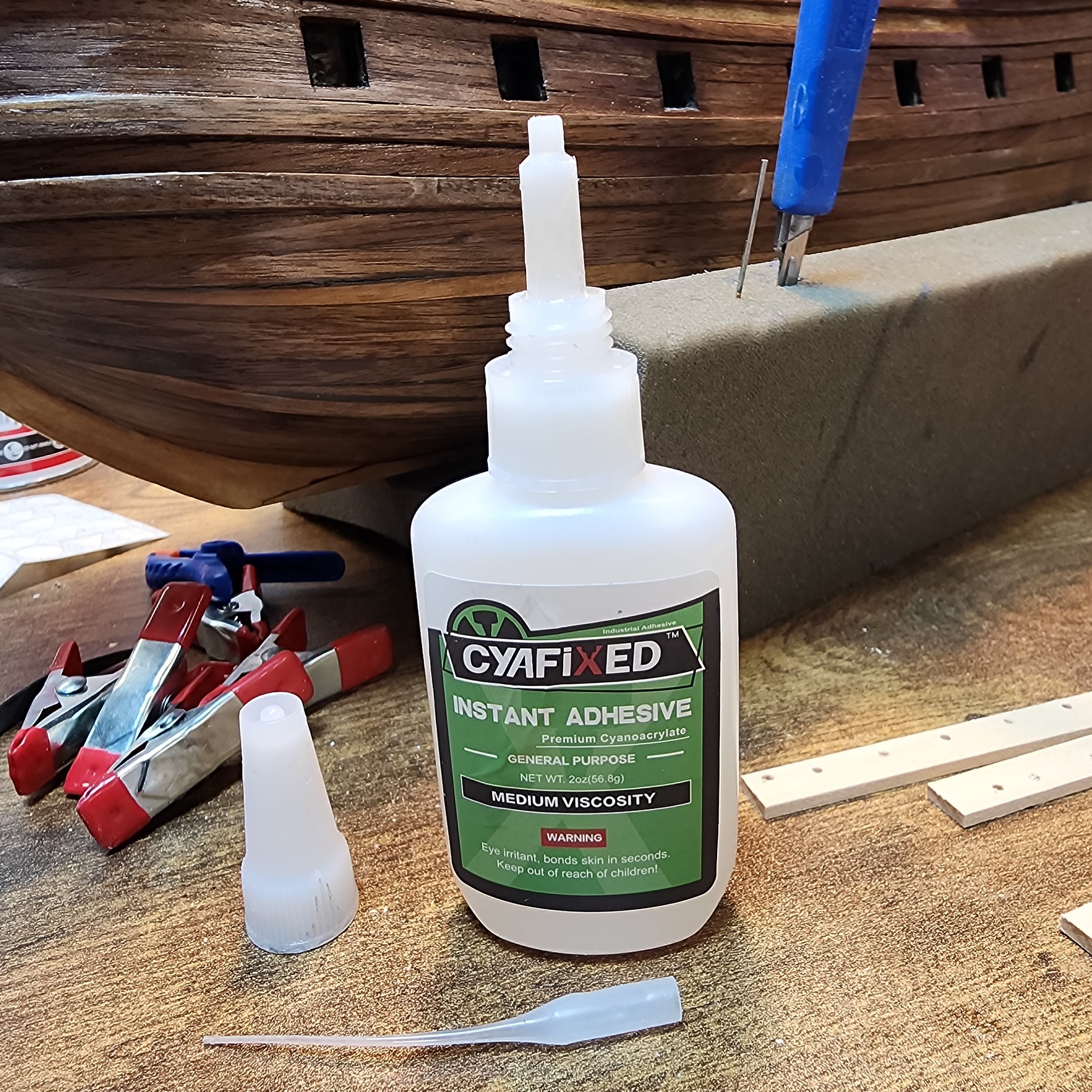

I agree with "W".
I have had so much frustration with super glue I gave up a couple of times
but finely hit on the same as "W".
The tip is key but also the screw on cap. You can leave the tip on or unscrew and cap
and the screw on cap seems to seal better than push on caps and does not get stuck on the bottle.
I imagine Gorilla glue is good.
I accidently ordered from Amazon and got this industrial glue produced in China
but it is good stuff too and seems to last unchanged in viscosity and dry time and it is 2 oz.
