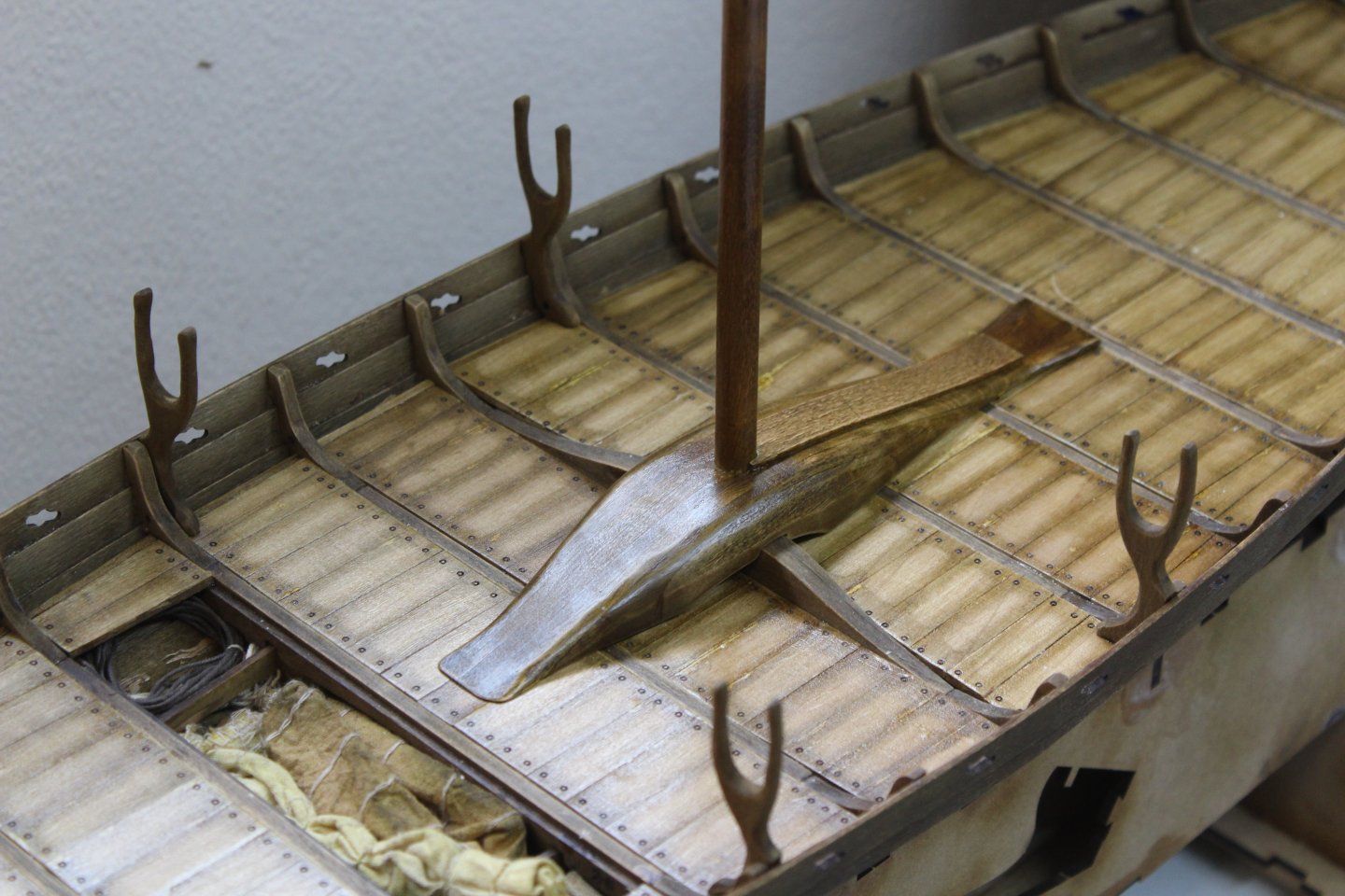

1:25 Drakkar ‘Oseberg’ V3
History
It is believed that the word “drakkar” originates from the Old Norse words “dreki” and “kar,” which mean “dragon” and “ship,” respectively. The warship acquired this name because the head of a dragon or another mythical creature (like Jormungandr) usually adorned the ship’s bow. The shape of the ship was also long and narrow, resembling a sea serpent. The Vikings constructed drakkars out of pine, oak, or ash wood. They used a special technique for splitting trees along the grain. They then watered the planks and held them above a fire to make them more flexible. The shipbuilders put the parts of the ship together with iron rivets and nails and bound them with cords and ropes. After that, they tarred the whole structure and caulked it by plugging holes and gaps and making the seams watertight. The sail was rectangular or square. It was made of sheep’s wool and covered with grease so that it didn’t get drenched. If there wasn’t a fair wind, the Vikings used oars – 20 to 35 pairs of them.
In the Viking age, few ships could compete with a drakkar in terms of sheer speed, but drakkars were also very nimble. Thanks to the drakkar’s shallow draft, the Northmen could easily sail along rivers and fjords. They could land in places that were very difficult to access and attack their enemies unexpectedly. These warships were also barely visible between the waves because of their low sides. This helped the Vikings catch their enemies unawares, even in the open sea. Drakkars were created for more than just war, however. They were solid and capacious, so the Vikings sometimes used them for trade and to transport goods, but more often these ships were used for sailing long distances. How far did the Vikings travel? They reached the shores of Iceland, Greenland, and North America, to name but a few destinations.
copied from the kit review by @James H
the full review can be found here
 1:25 Drakkar ‘Oseberg’ V3 - Ships of Pavel Nikitin - REVIEWS: Model kits - Model Ship World™

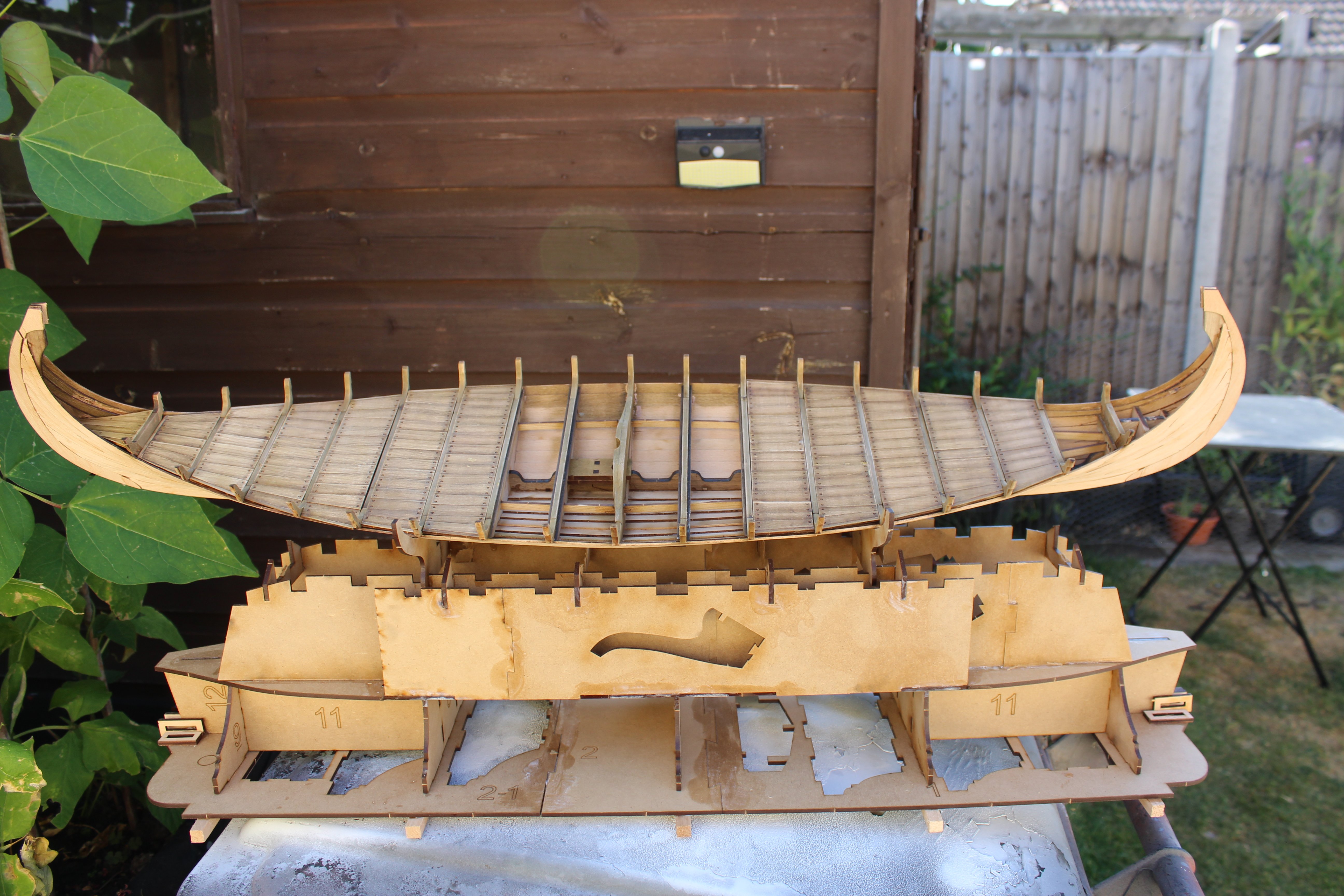

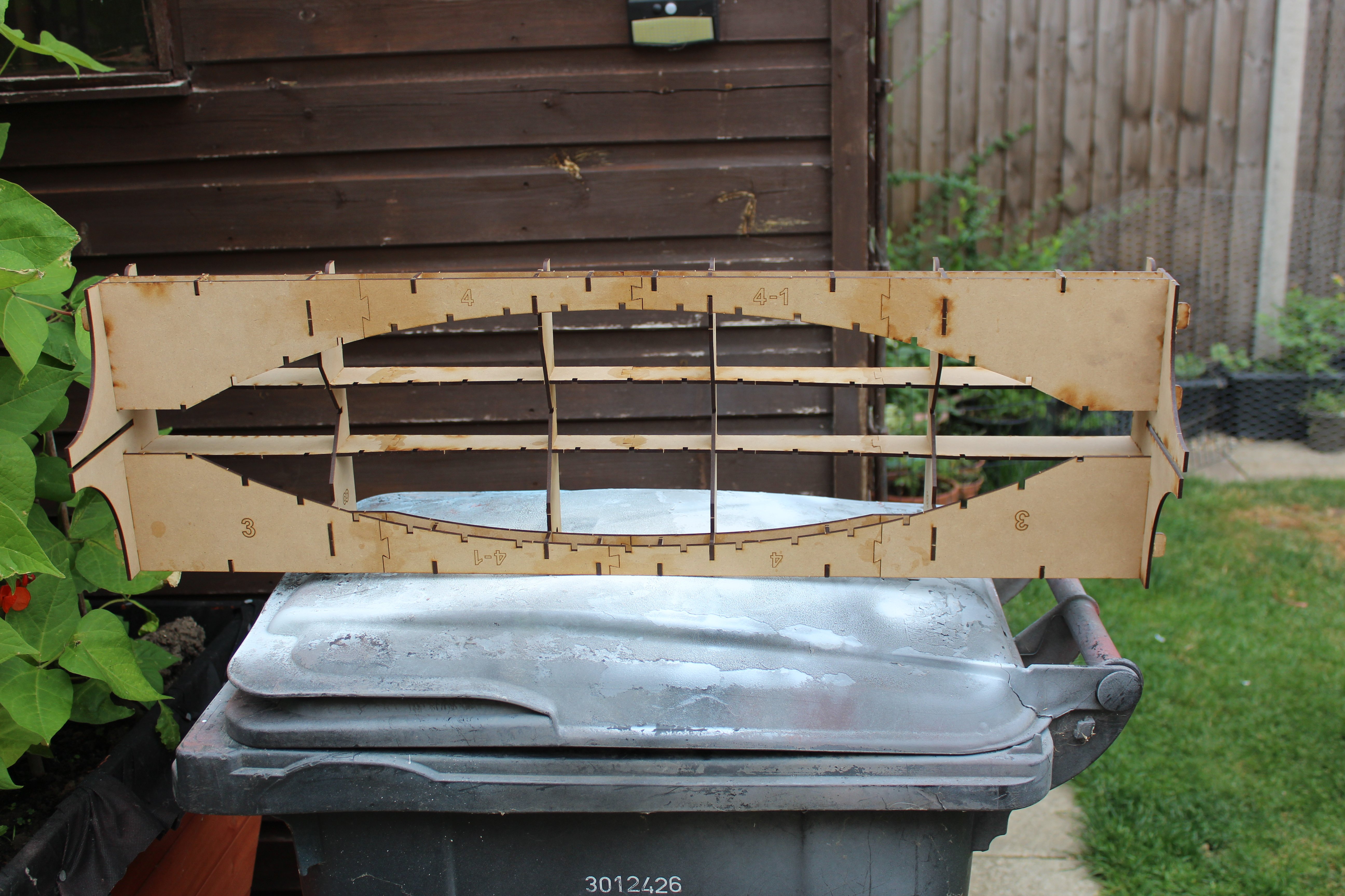

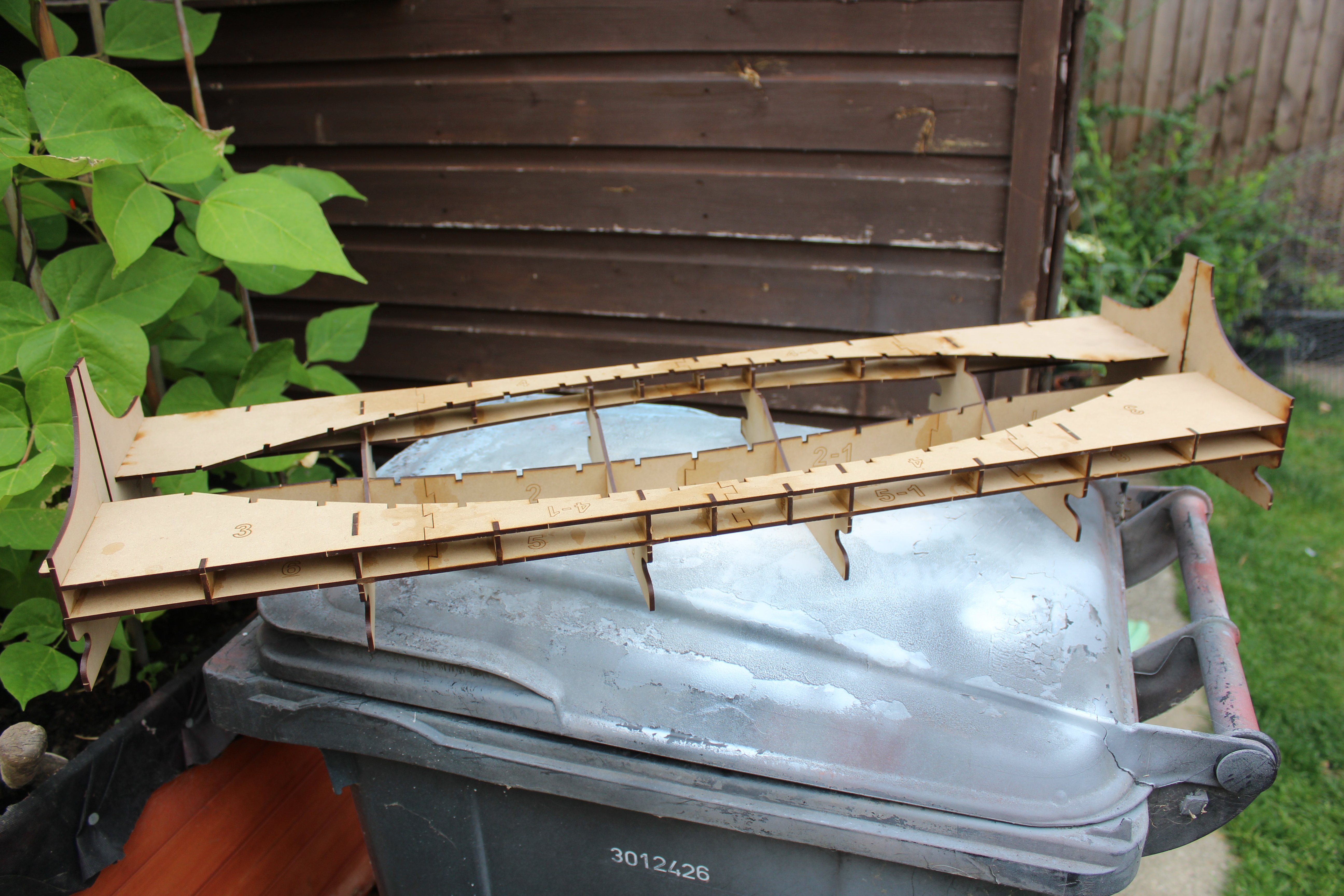

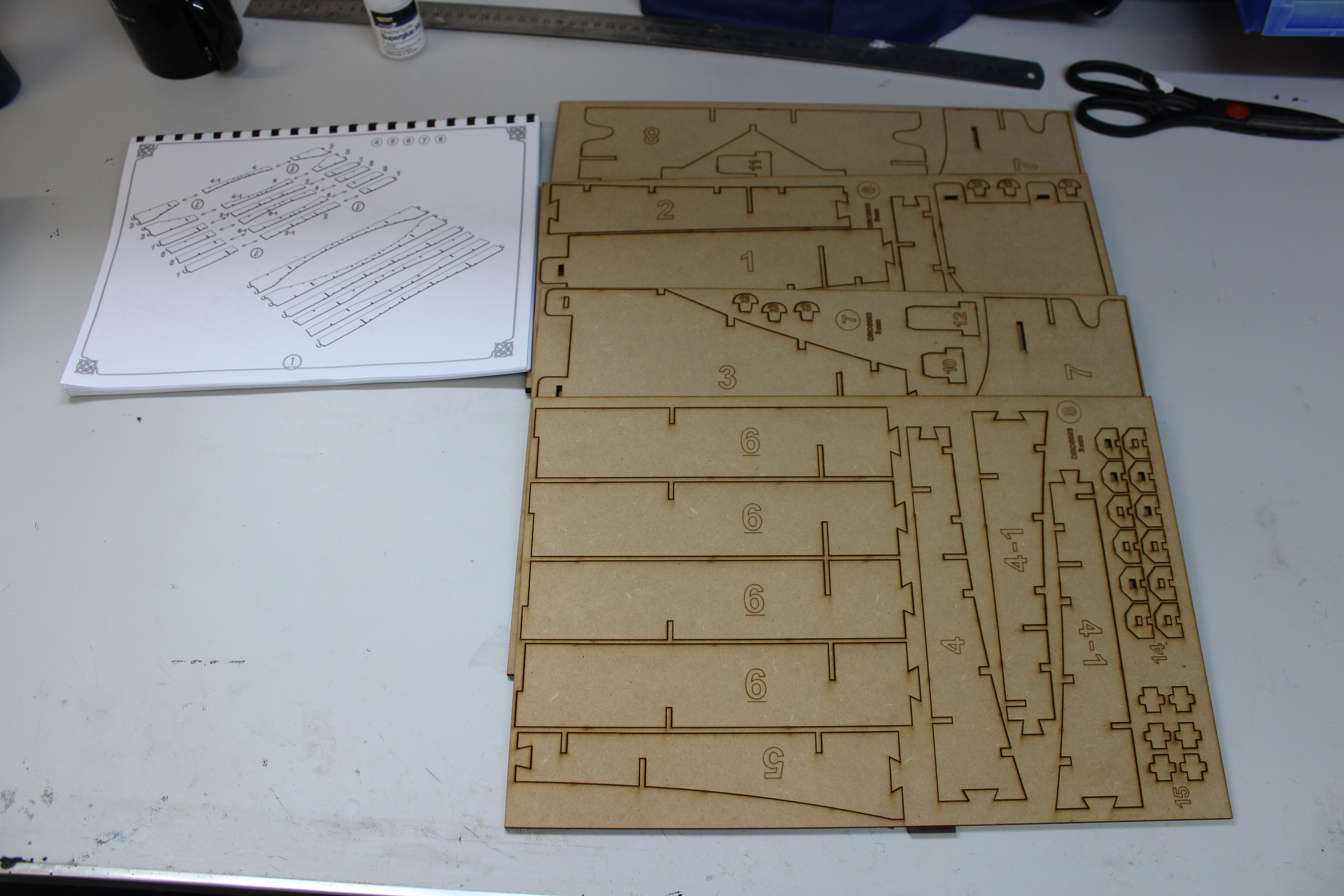

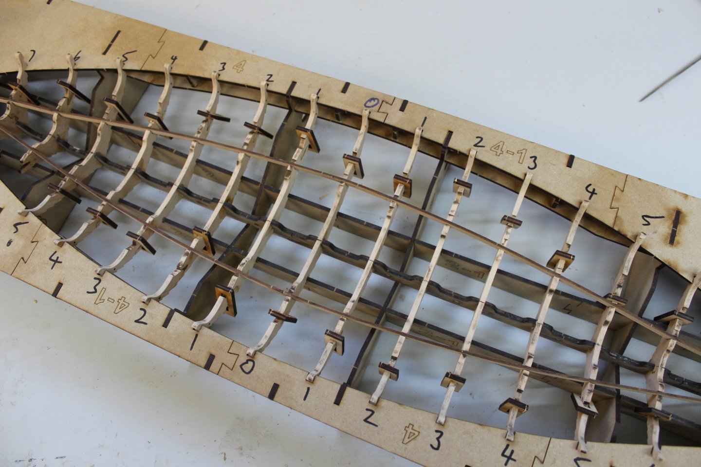

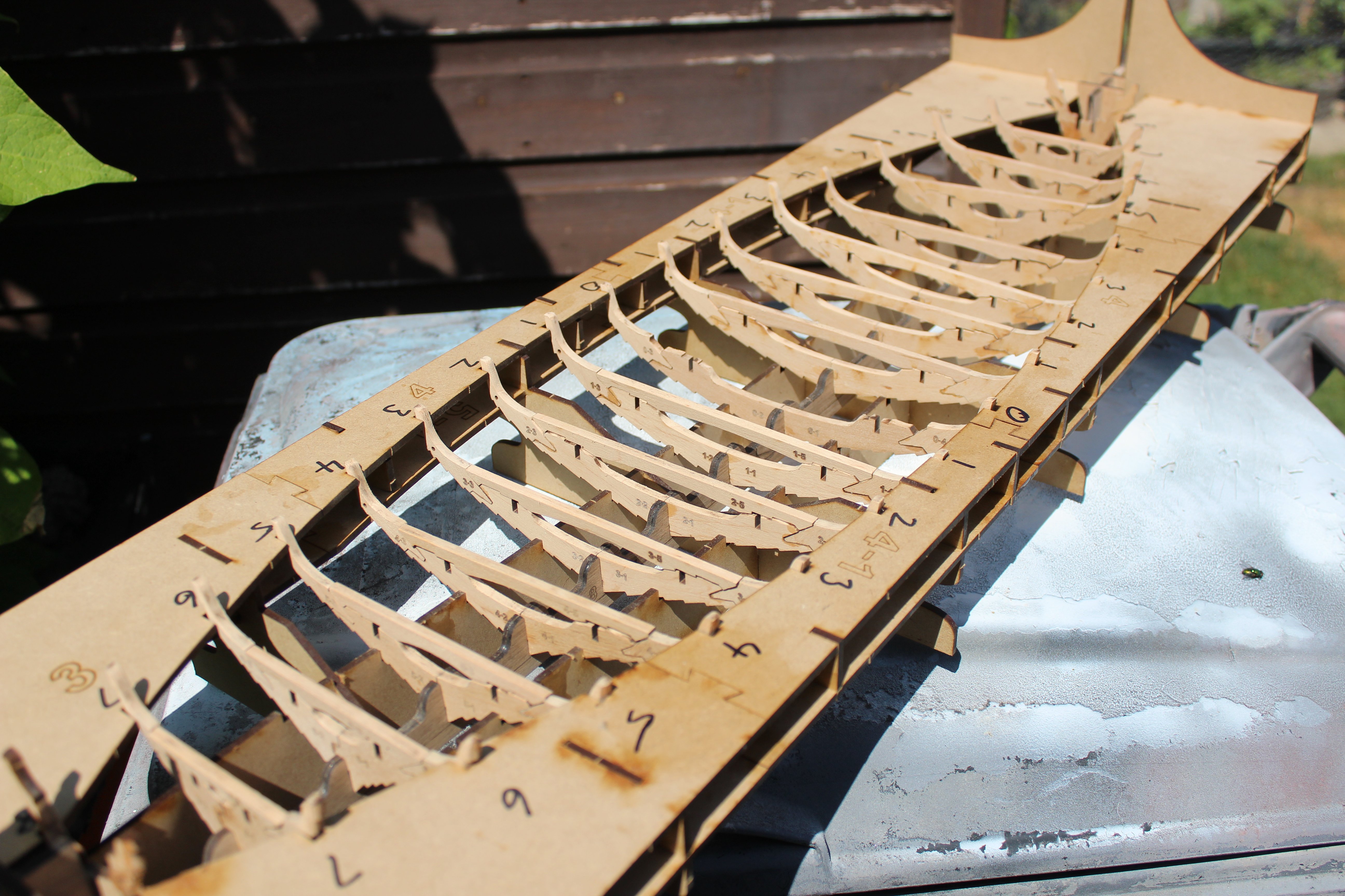

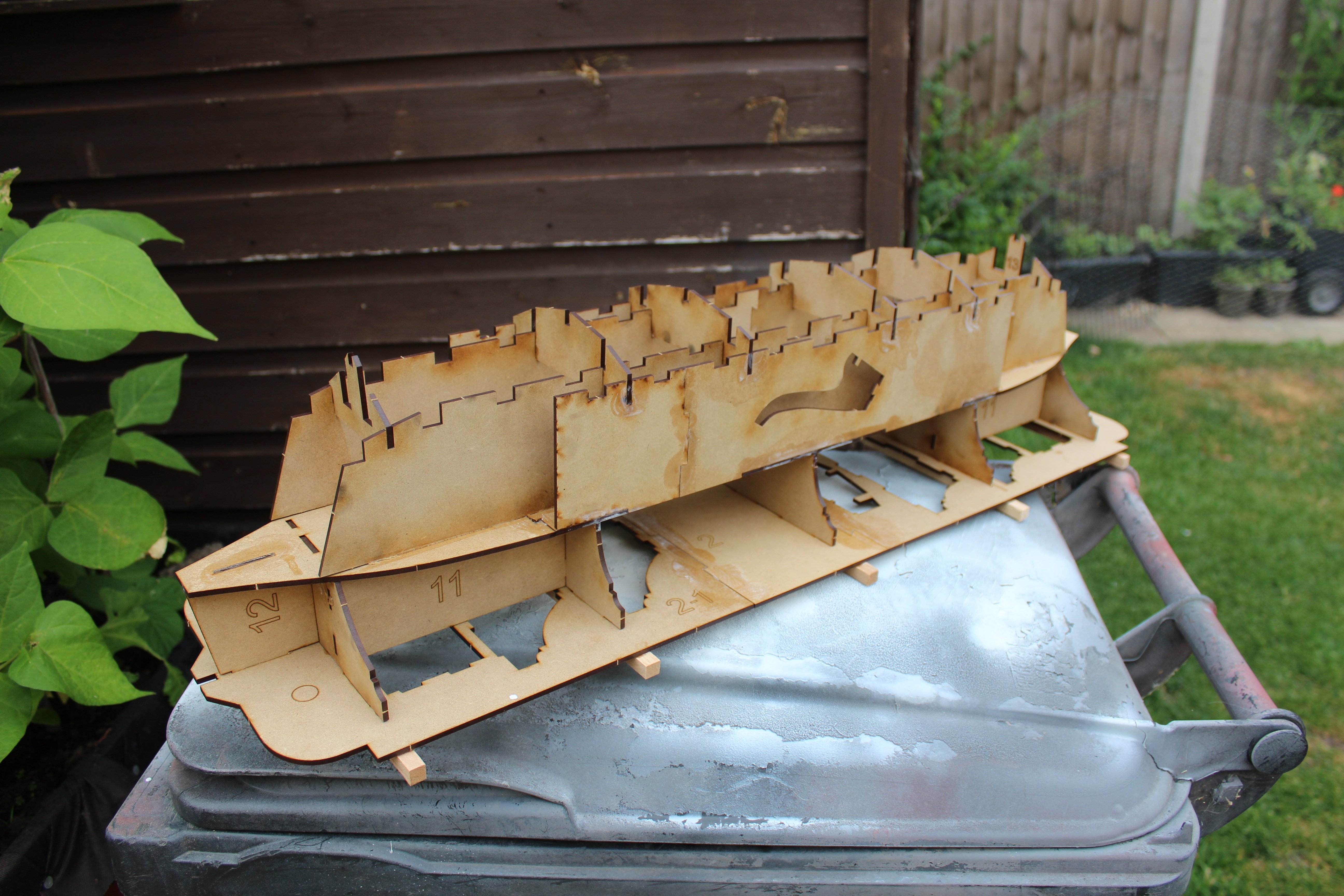

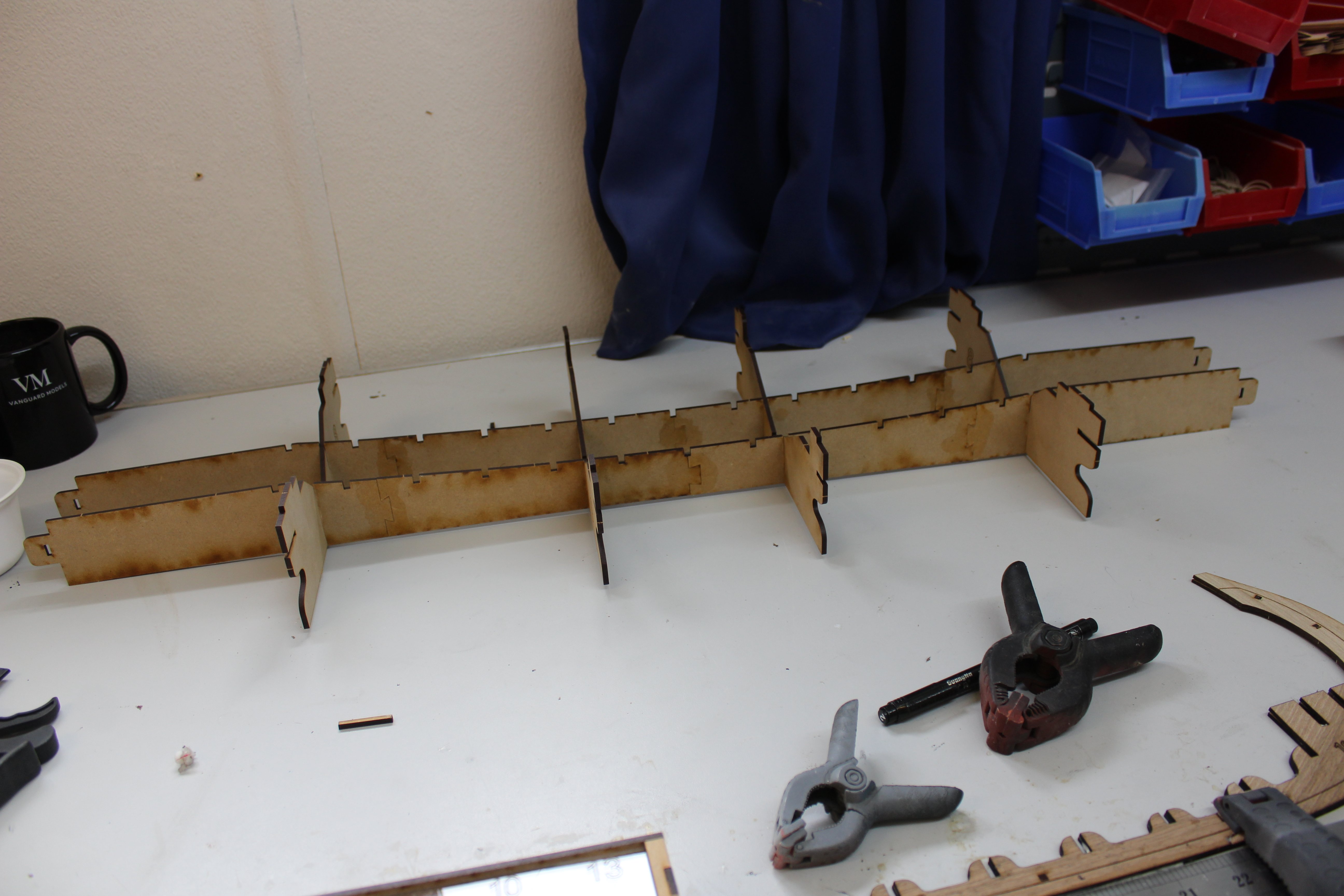

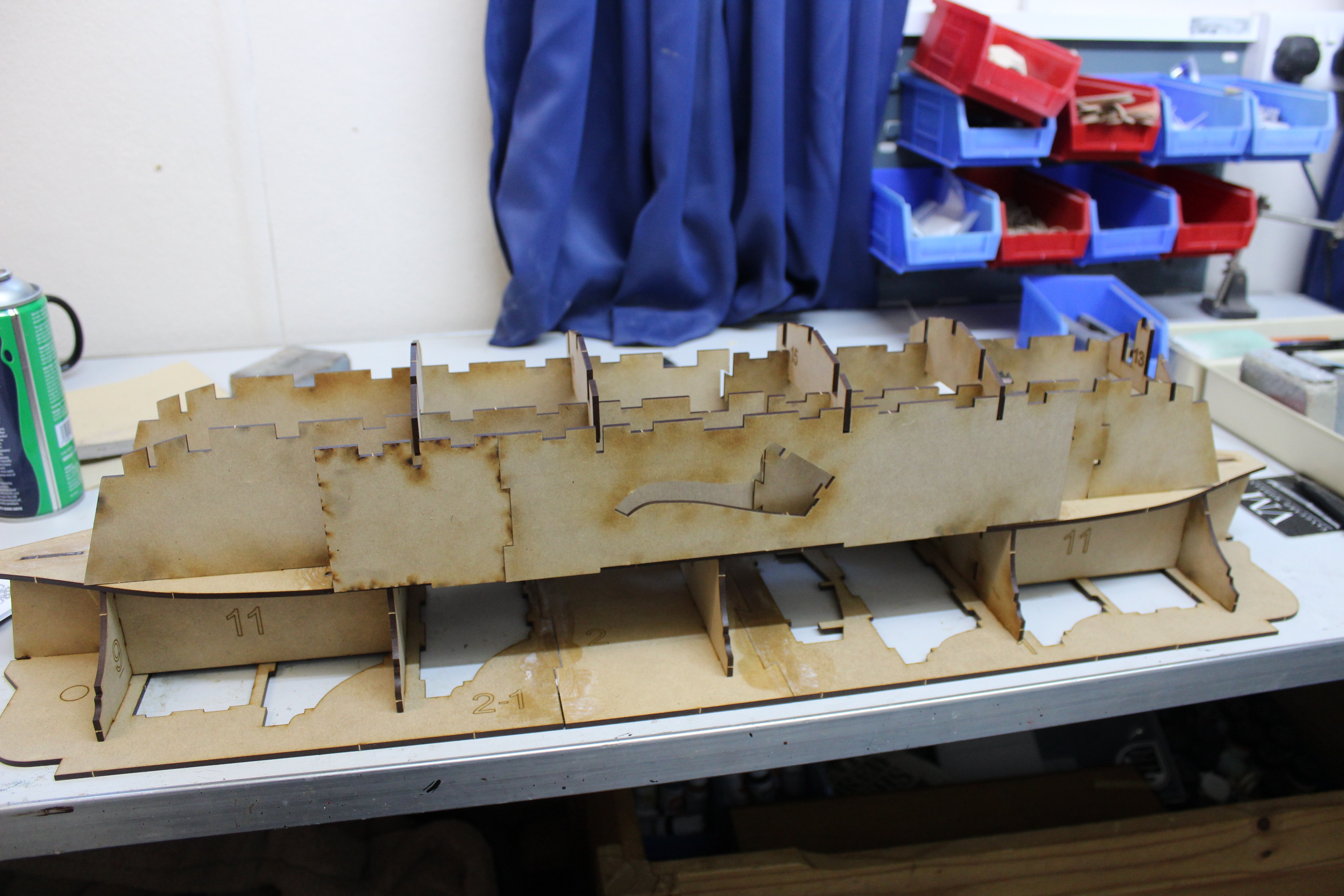

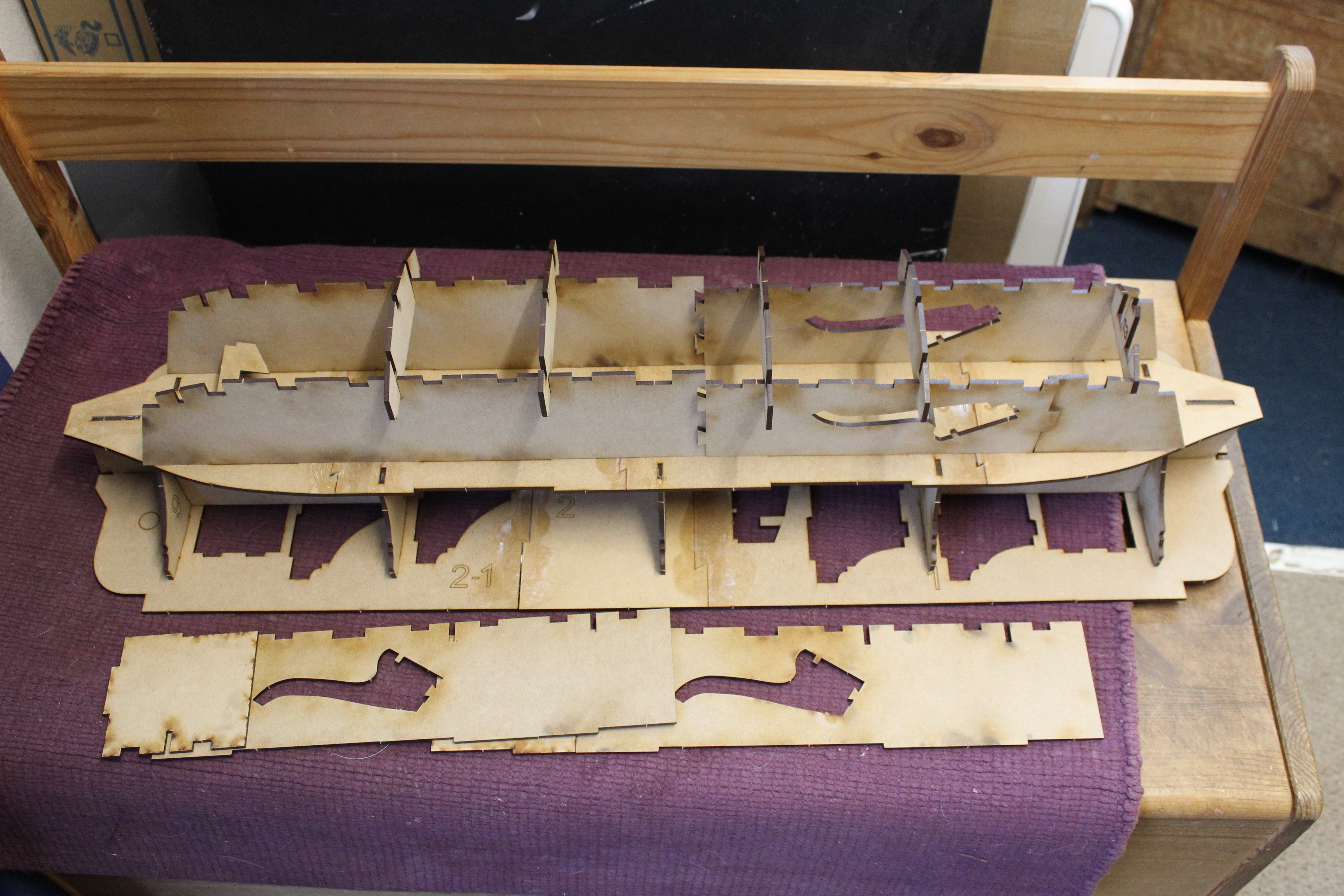

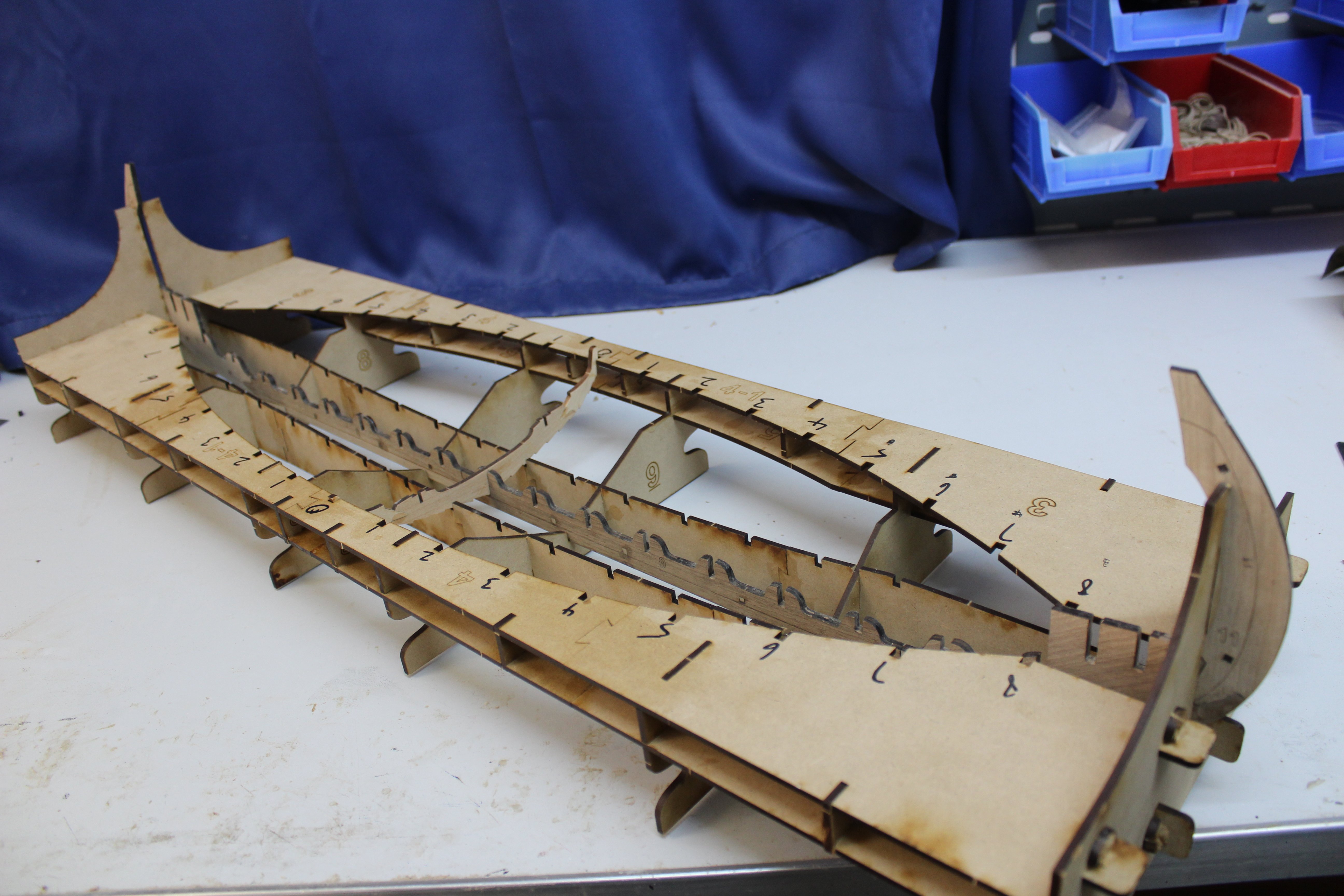

Day 1 building jigs

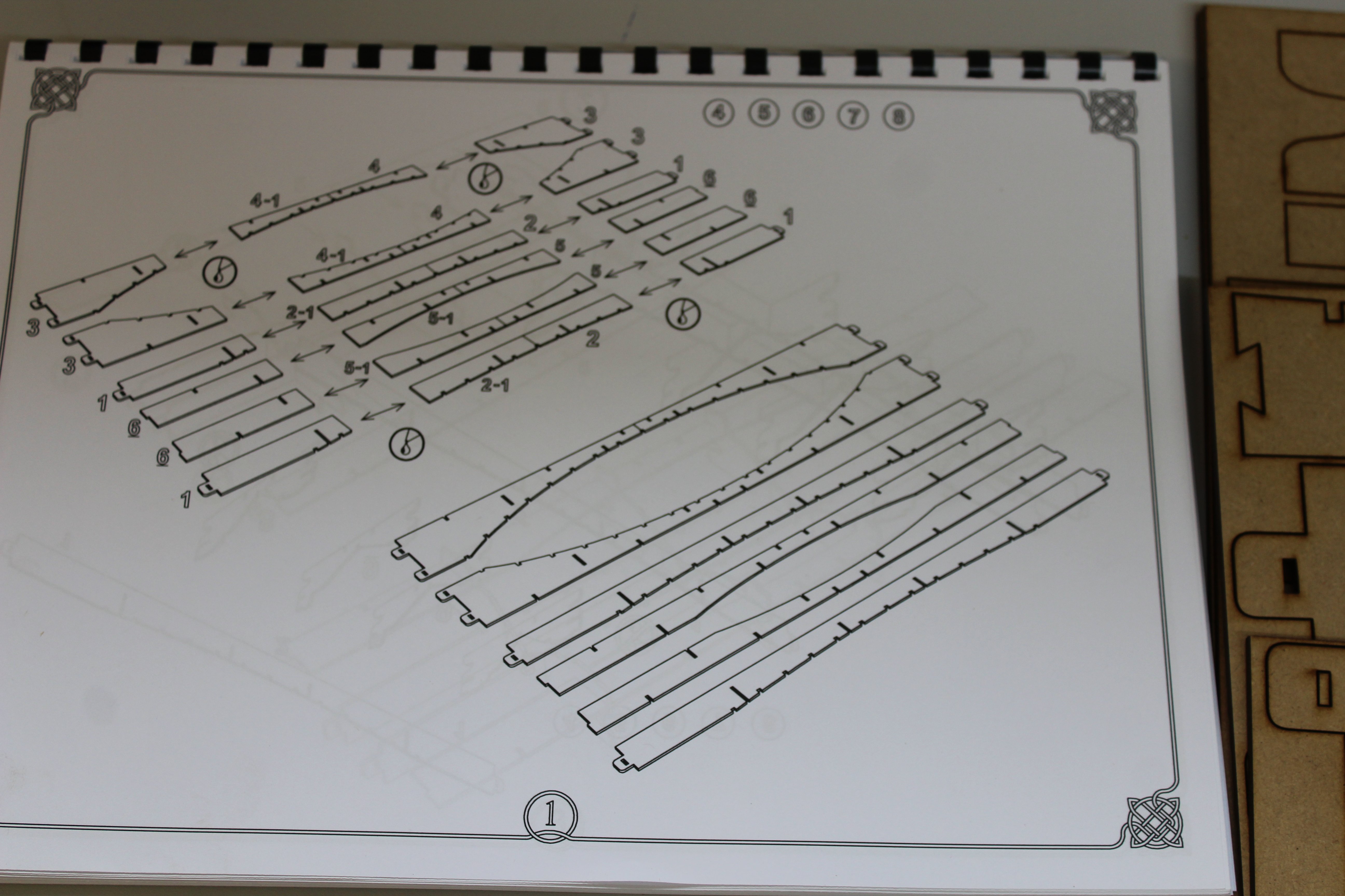

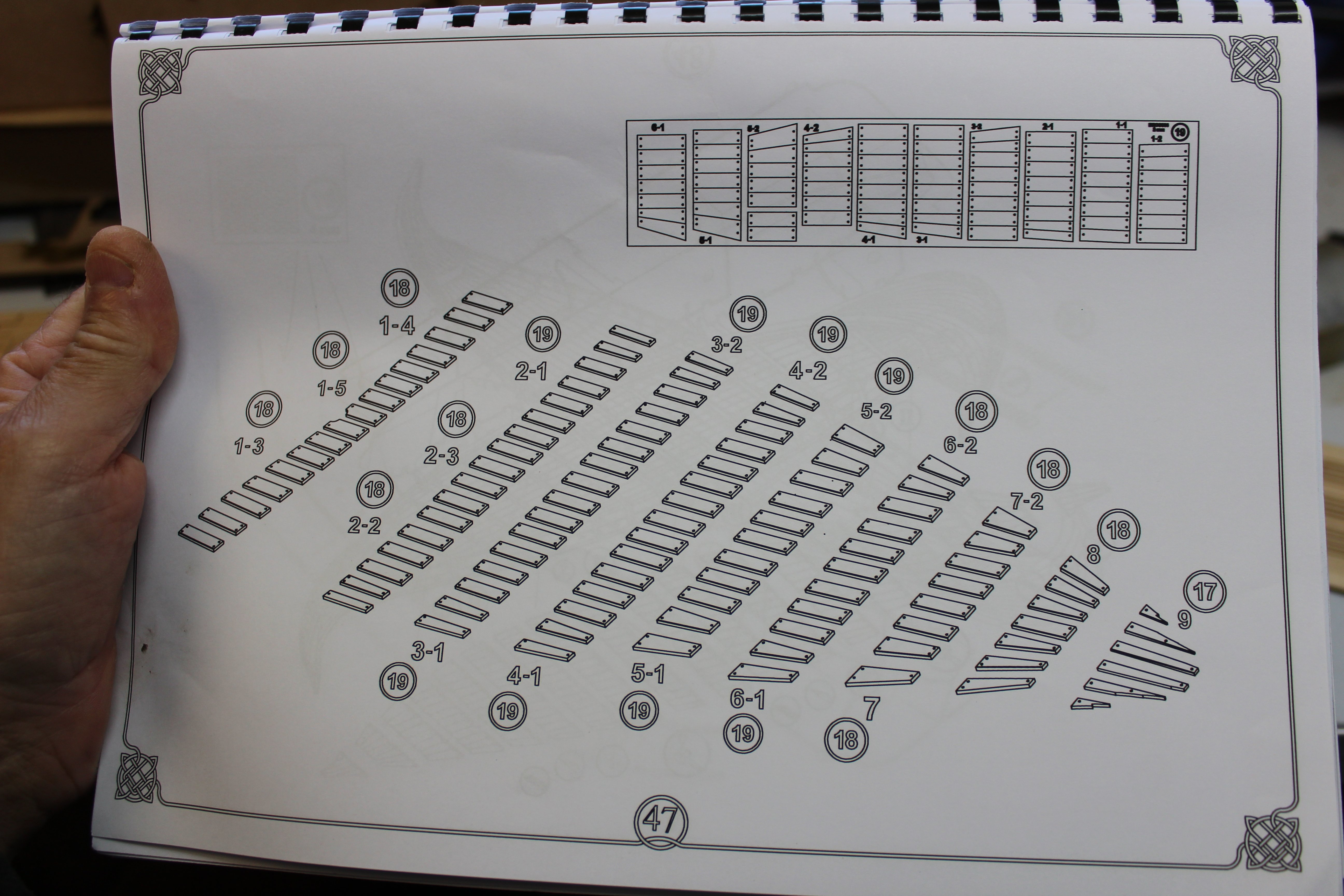

made from mdf, the instructions are easy to follow, but, not all steps are covered, and some of the parts are different shapes to that shown, ideally, the best bet is to work alongside the excellent online video
IMG_3890.thumb.JPG.8cfd07f7a79052085a5d8d19012ca5a2.JPGIMG_3889.thumb.JPG.1909265a0309bed7c6f05ad42f558a42.JPGIMG_3891.thumb.JPG.b9ee50f9a5c031622d14ed4acb9581b5.JPGIMG_3894.thumb.JPG.f61338a14c84f8407e8e8a08fa0f5644.JPGIMG_3896.thumb.JPG.11589643759c1be28d1130338fcb2a95.JPGIMG_3905.thumb.JPG.347484176d1cf801f03c7ec44089b33d.JPGIMG_3906.thumb.JPG.3de9952f50dfef8a17adb72f11464cd0.JPGIMG_3907.thumb.JPG.76bdbcbec857135ddadf5ae9159e8668.JPG
Jig 2 is used after the keel and frames have been removed from jig 1 the hull is turned upside-down placed on top to allow hull planking
IMG_3901.thumb.JPG.6a18809c7622d0d2f6308f2f7efd9877.JPGIMG_3902.thumb.JPG.33b15741a0267ab3a5518bf47fda203f.JPGIMG_3903.thumb.JPG.989f0ac495190c430b139e43c7512fe7.JPGimage.thumb.jpeg.b1313fa990f8b374efcdcb49d19d1ac2.jpeg

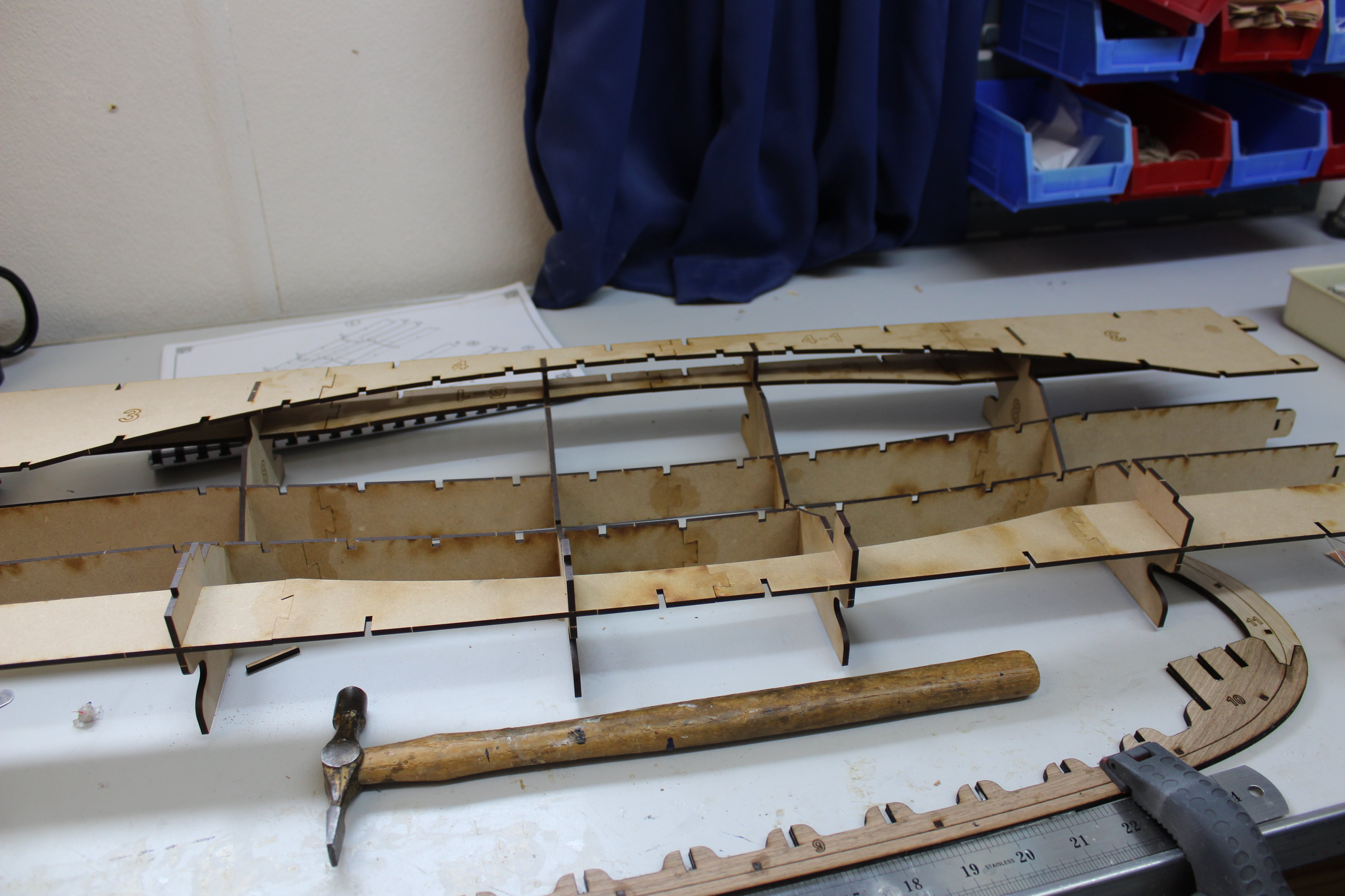

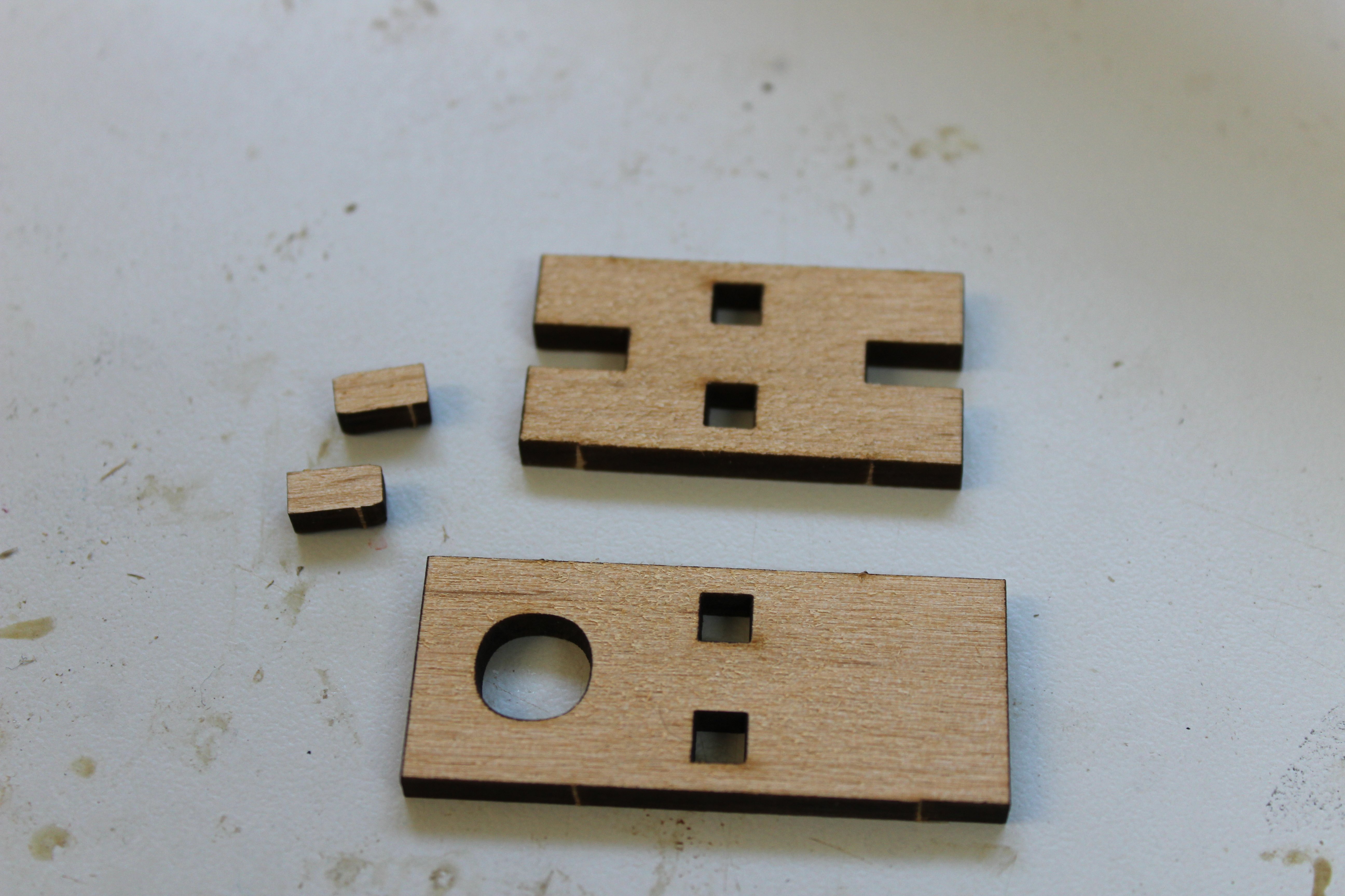

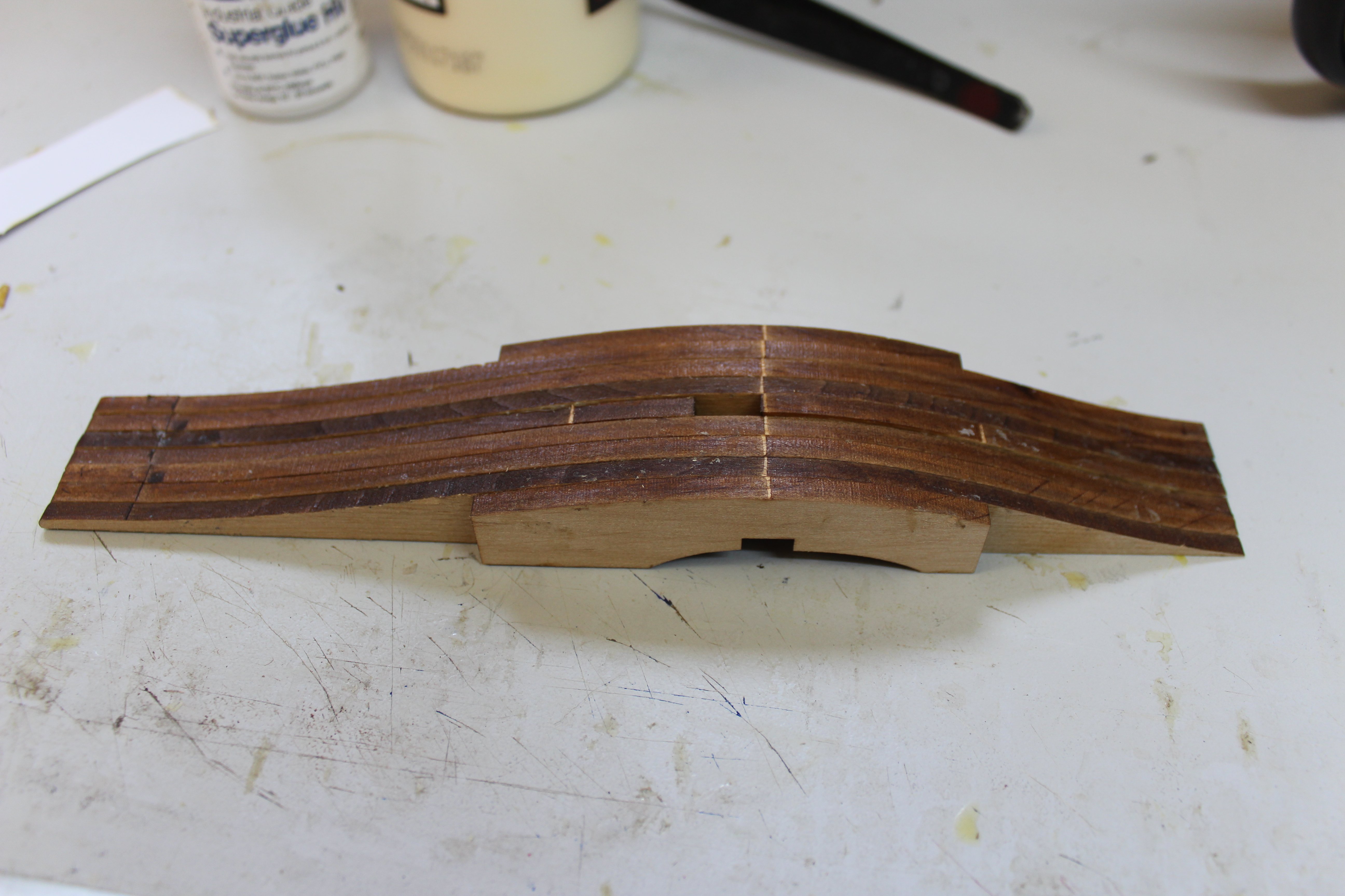

keel
no issues with making the 2 keel/centre pieces, these are offset sections to avoid weak sports, are glued together, allowed to set and then joined together, being held in the right place by 3mm inserts
IMG_3892.thumb.JPG.1c3c4bd2b38f82663745b52215bf42ff.JPGIMG_3893.thumb.JPG.fd1d4cb8da48d1f1cd596c5b734c9e82.JPGIMG_3899.thumb.JPG.66f6dd04bc748ab0067af9f56eed2d82.JPG

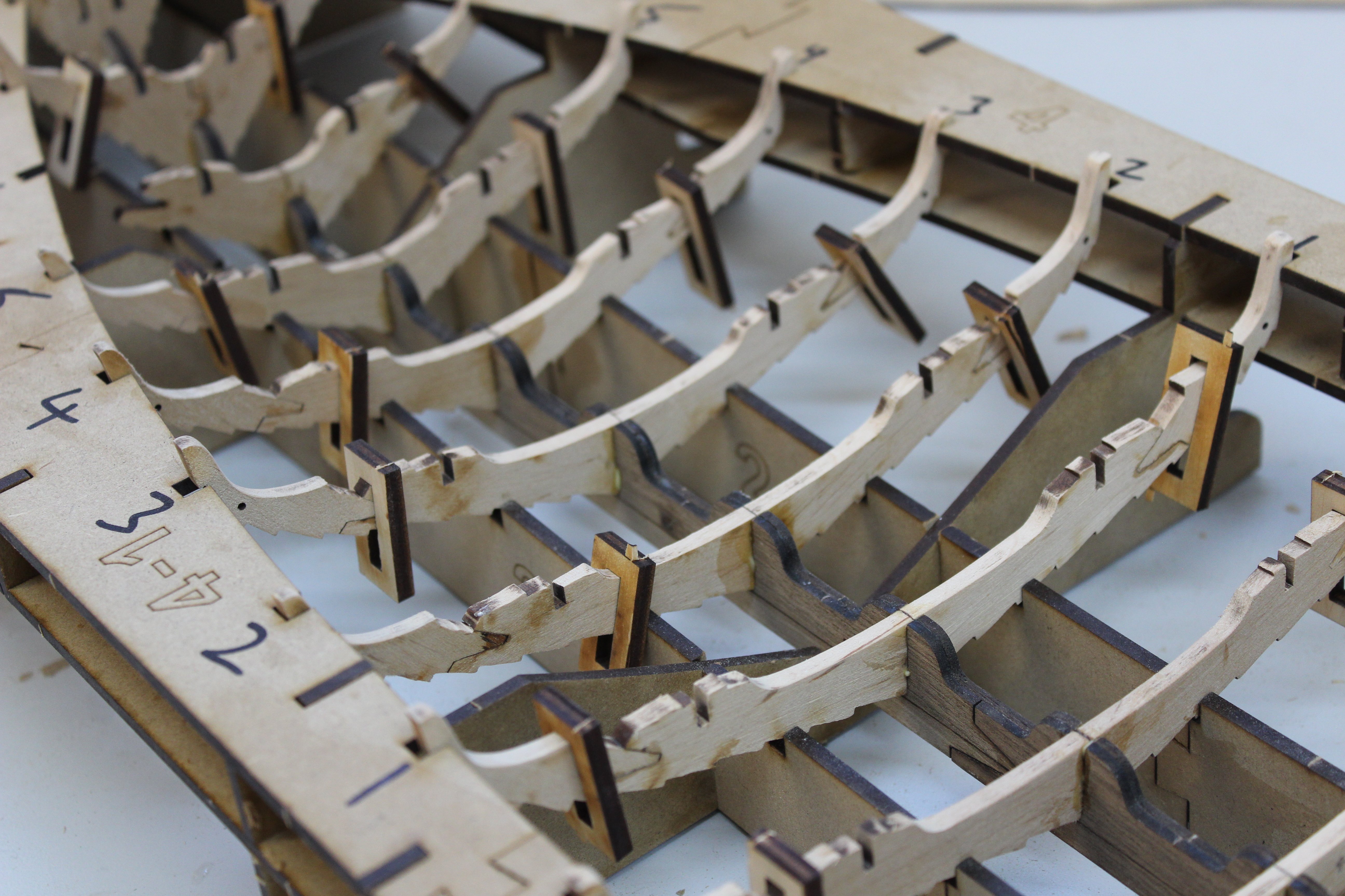

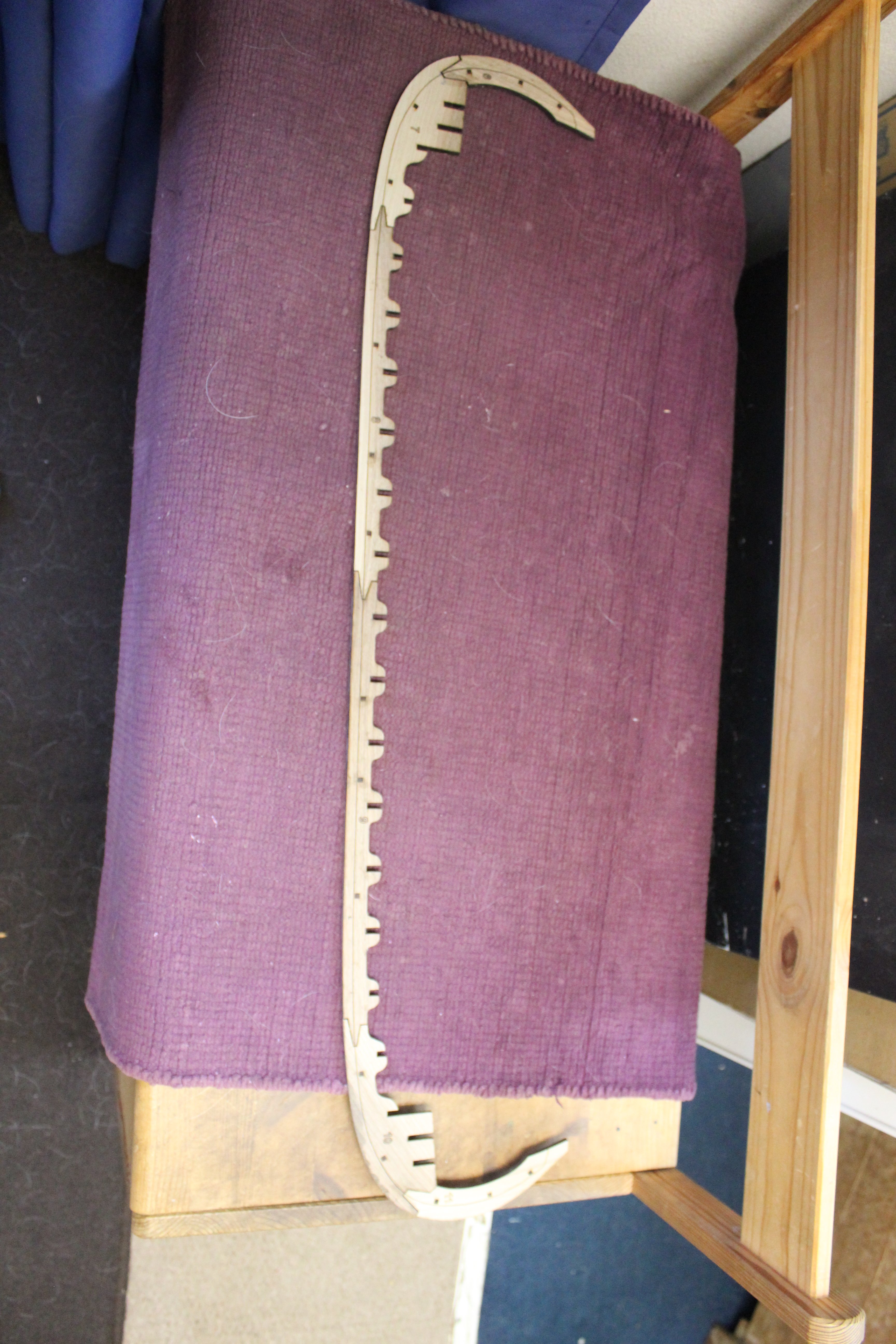

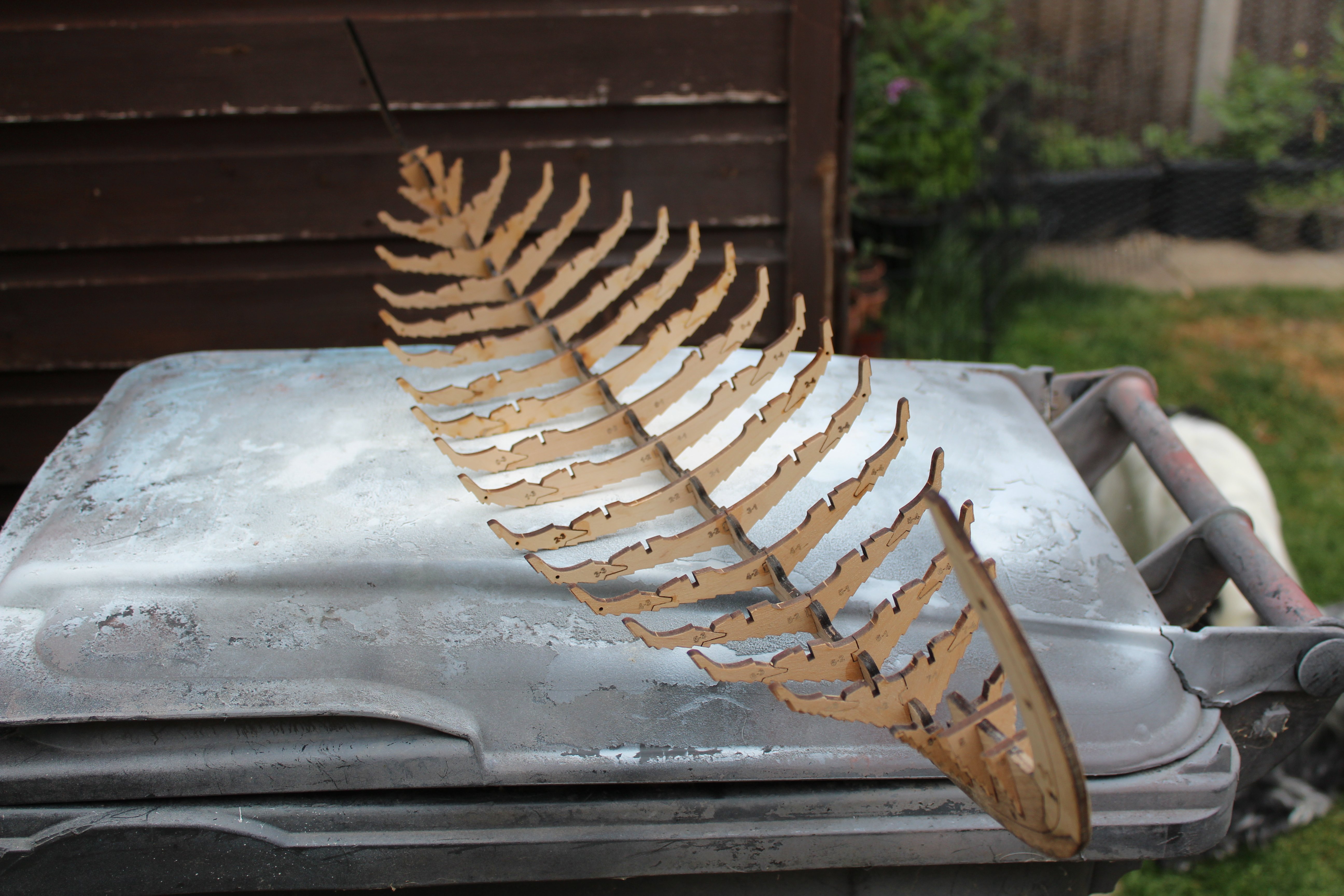

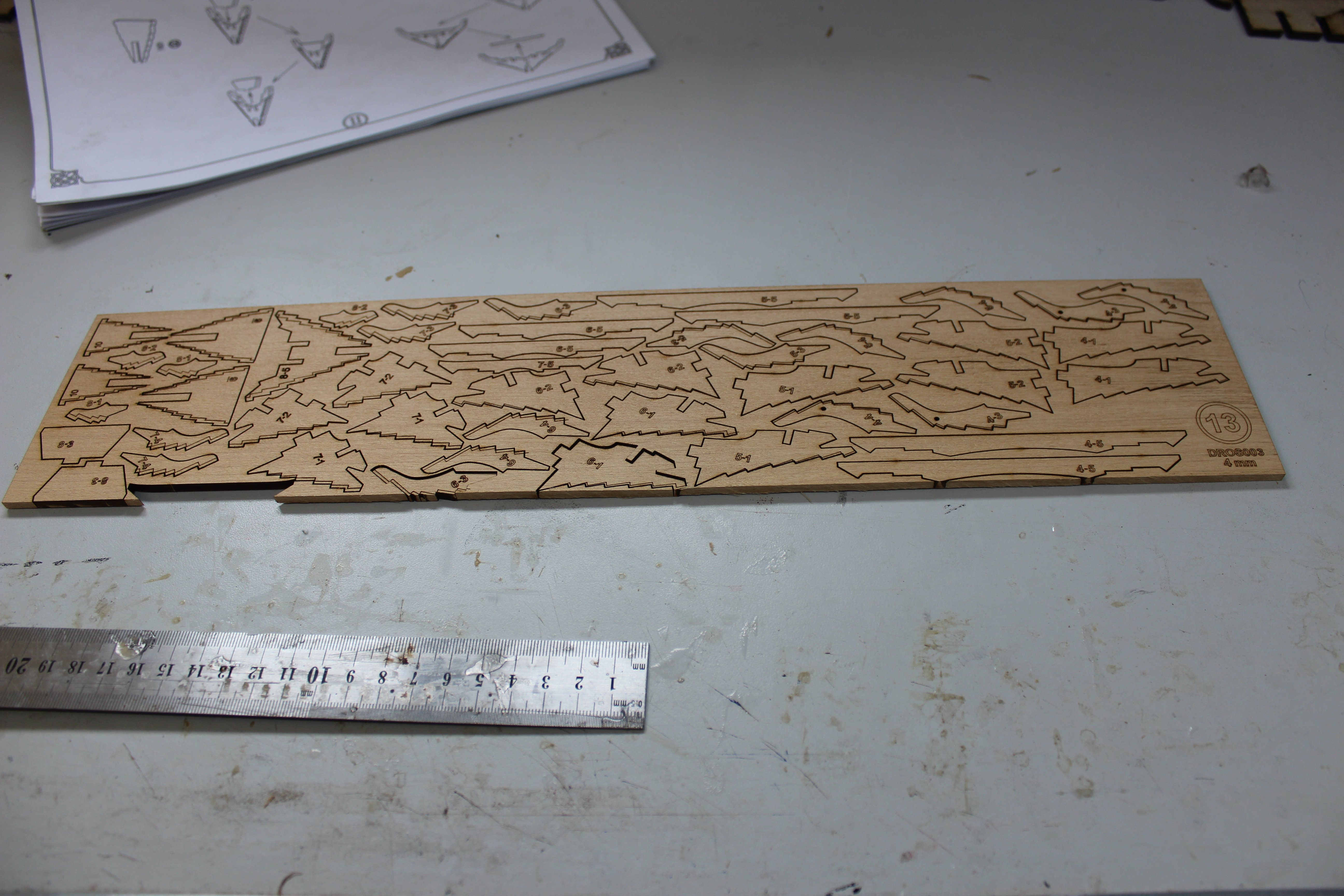

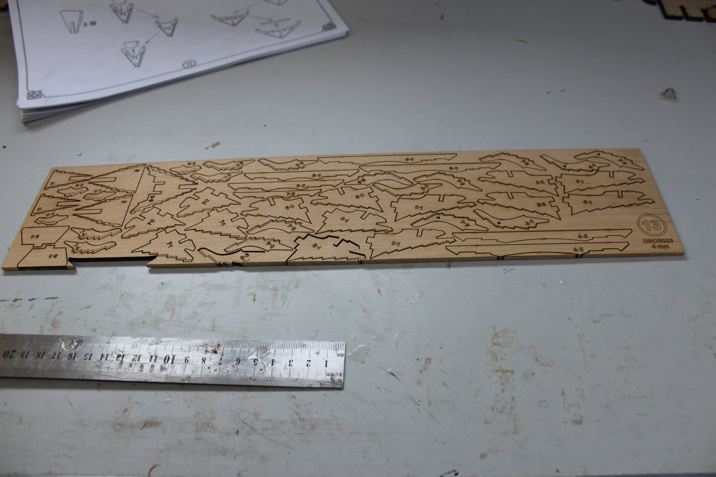

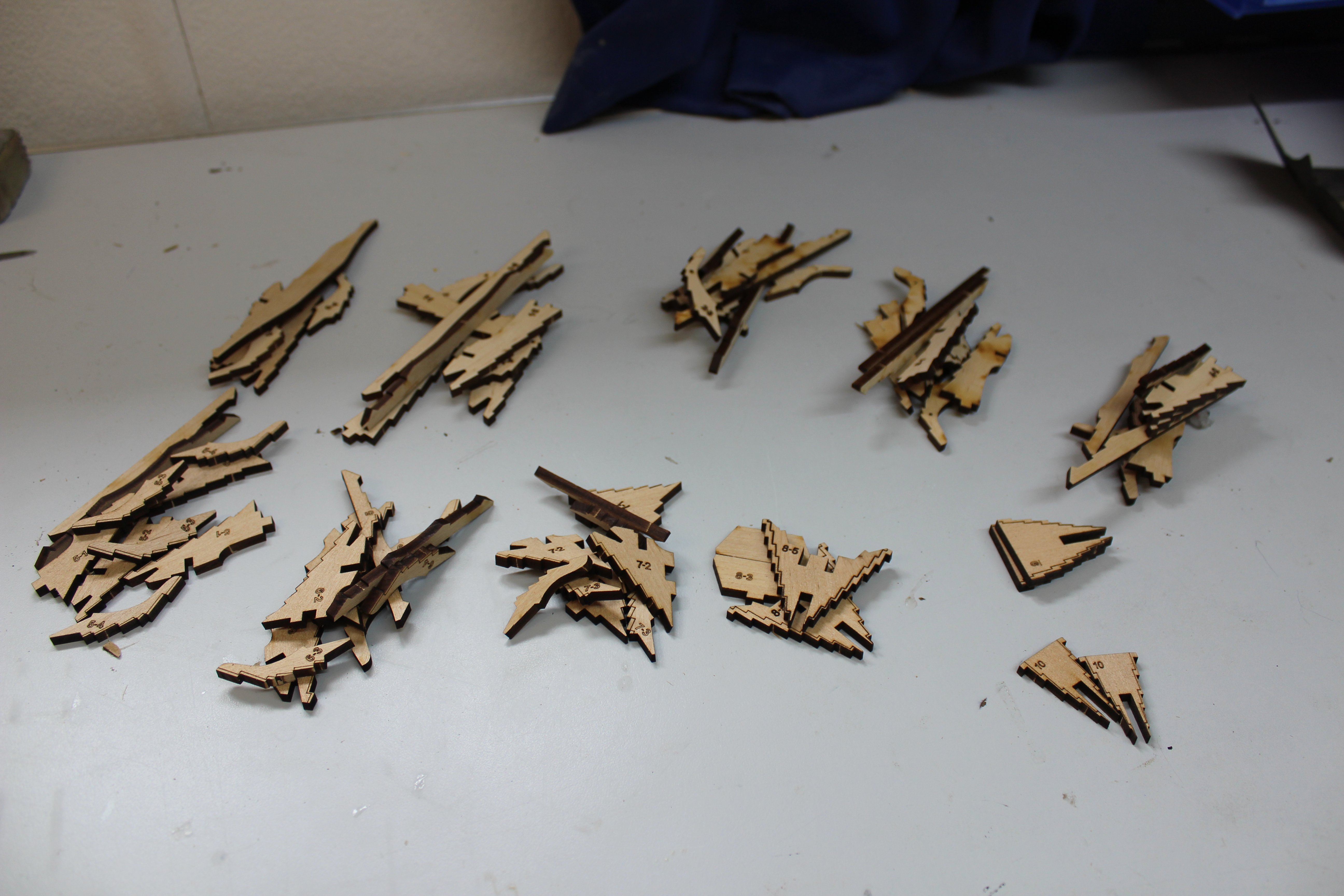

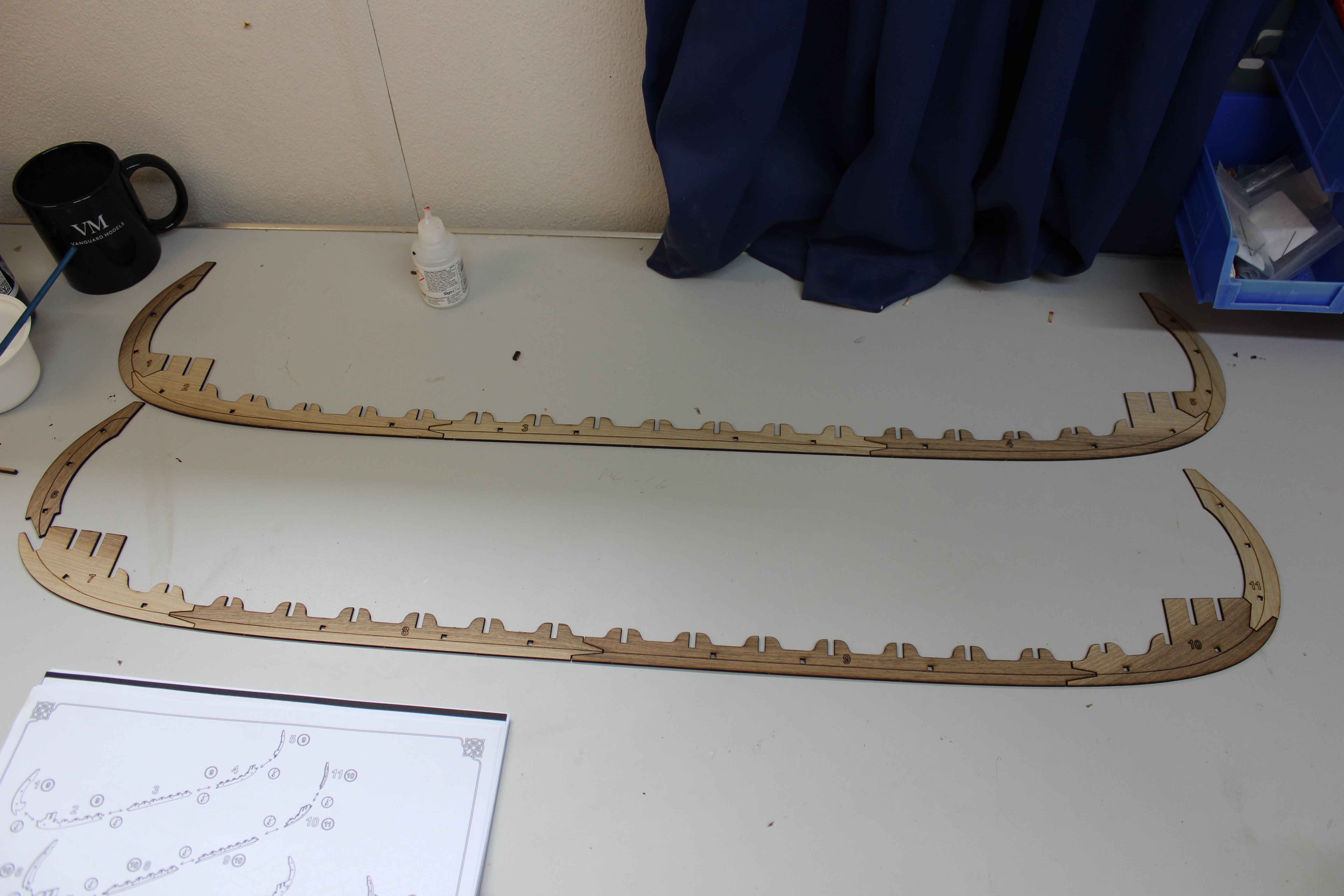

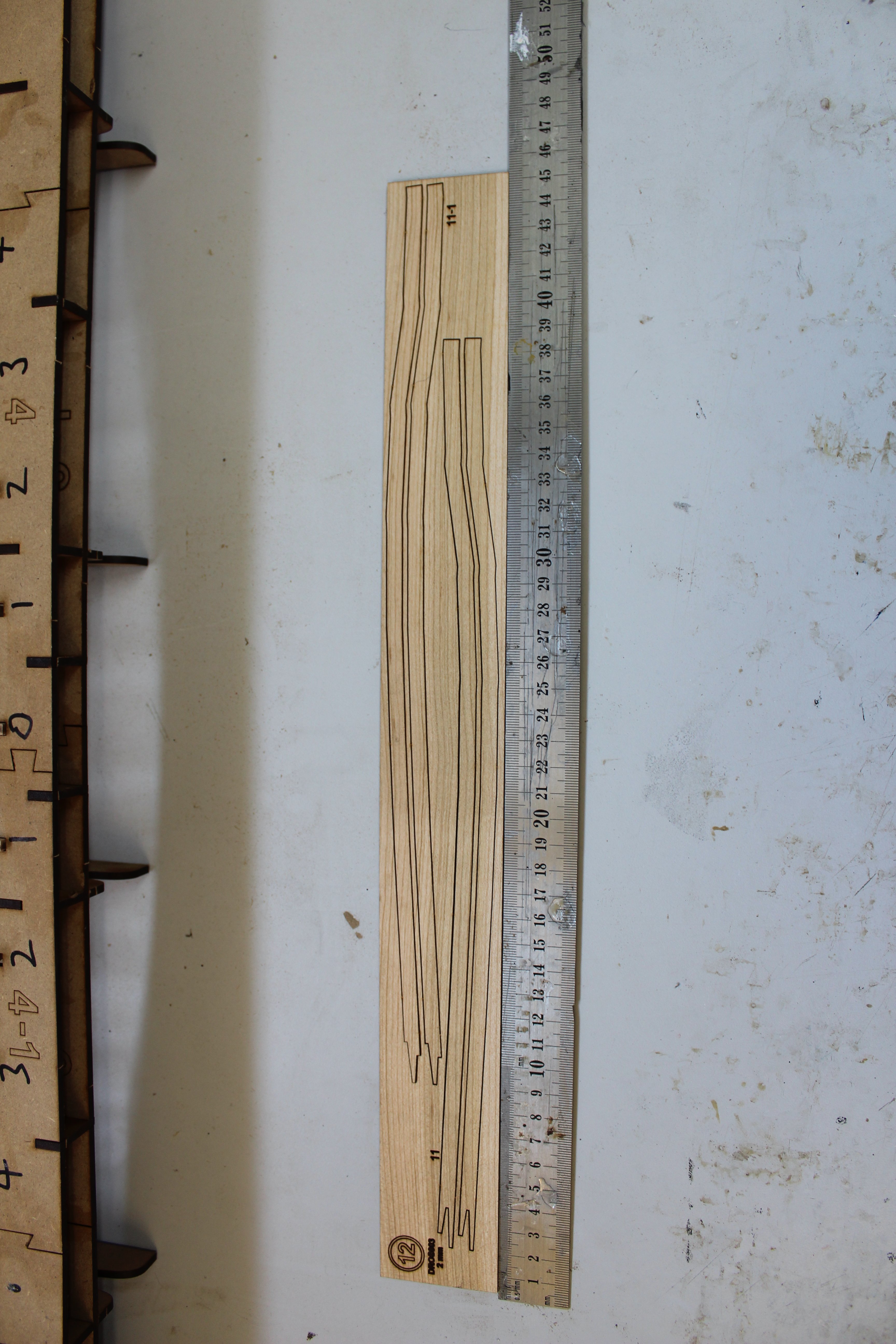

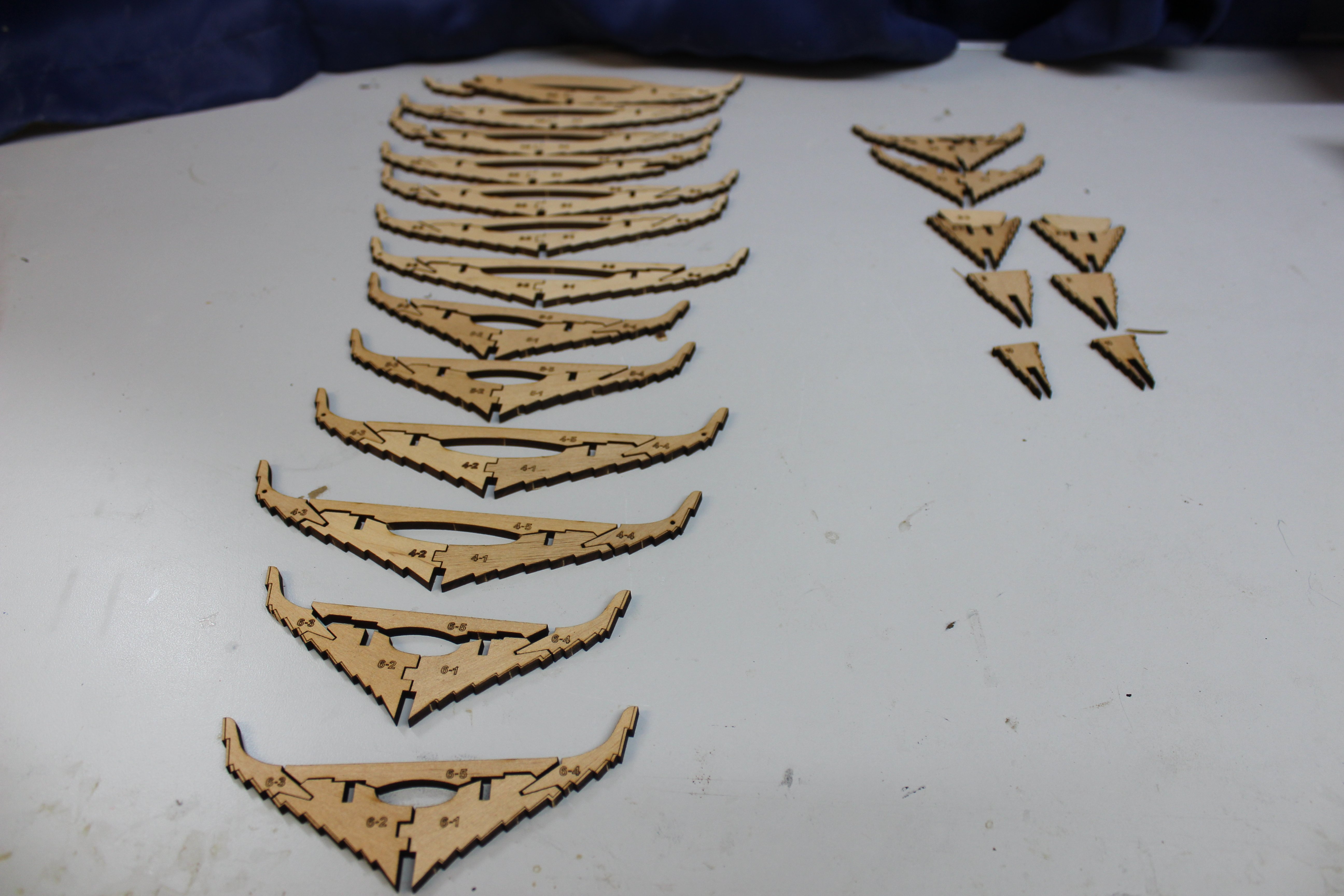

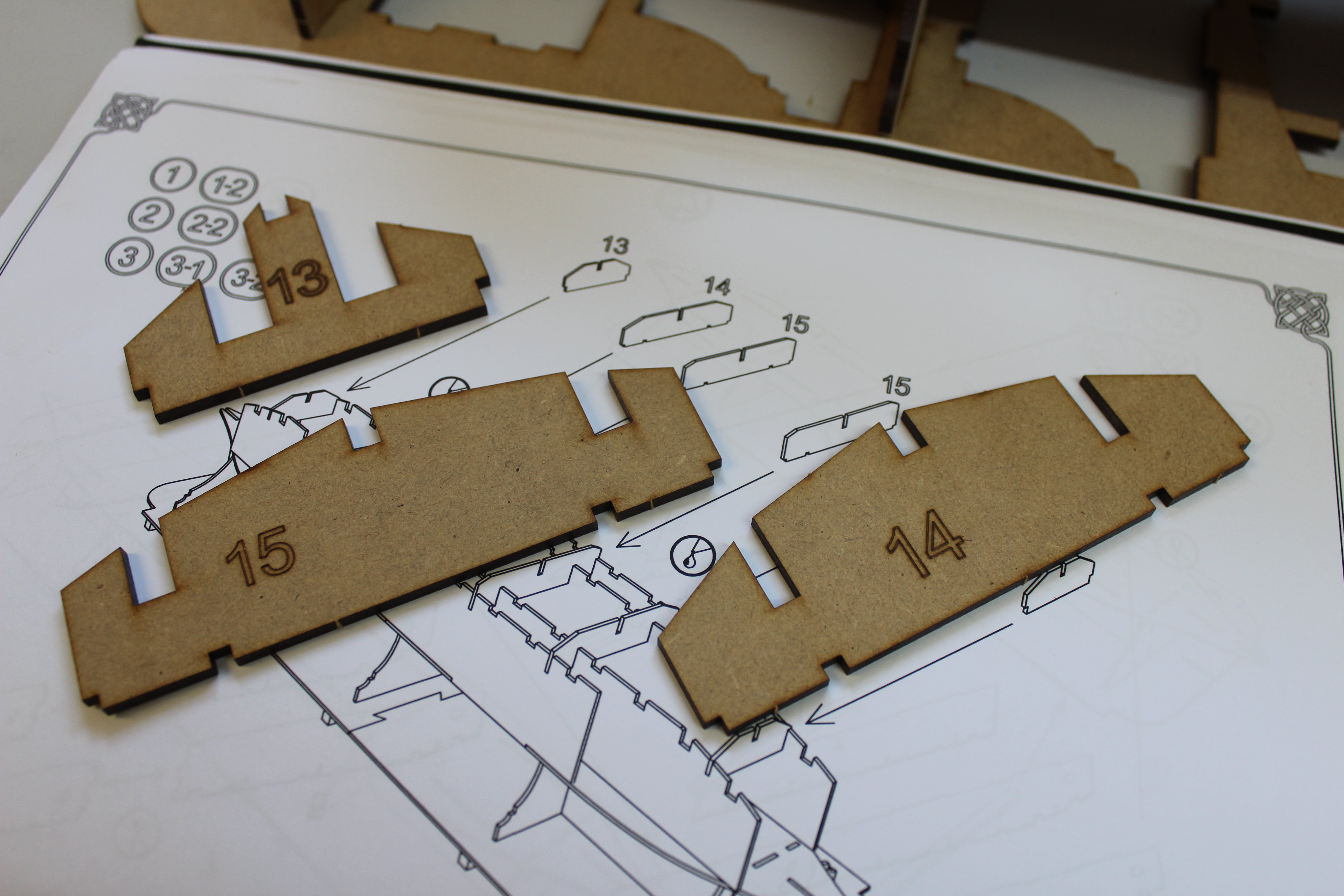

Frames

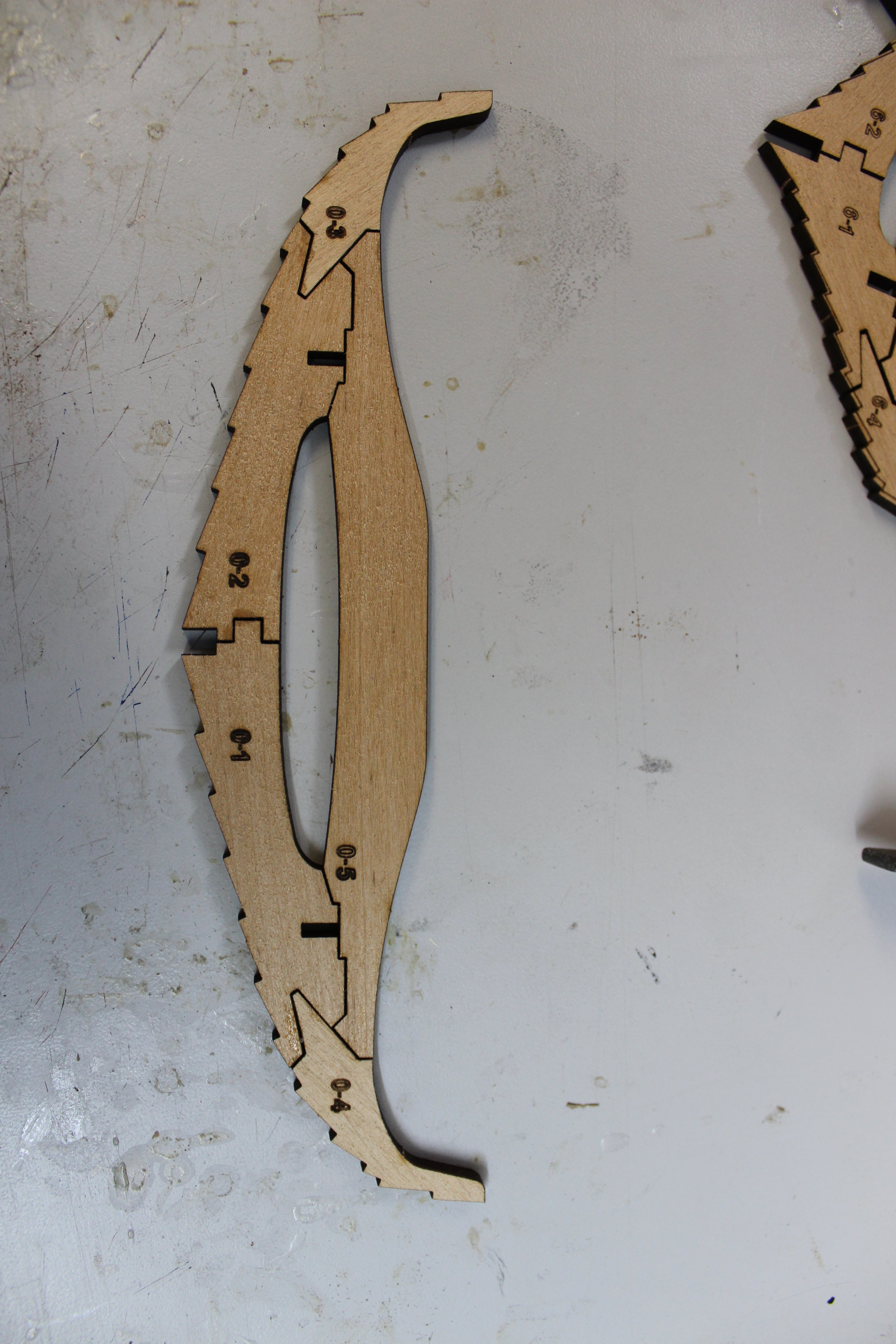

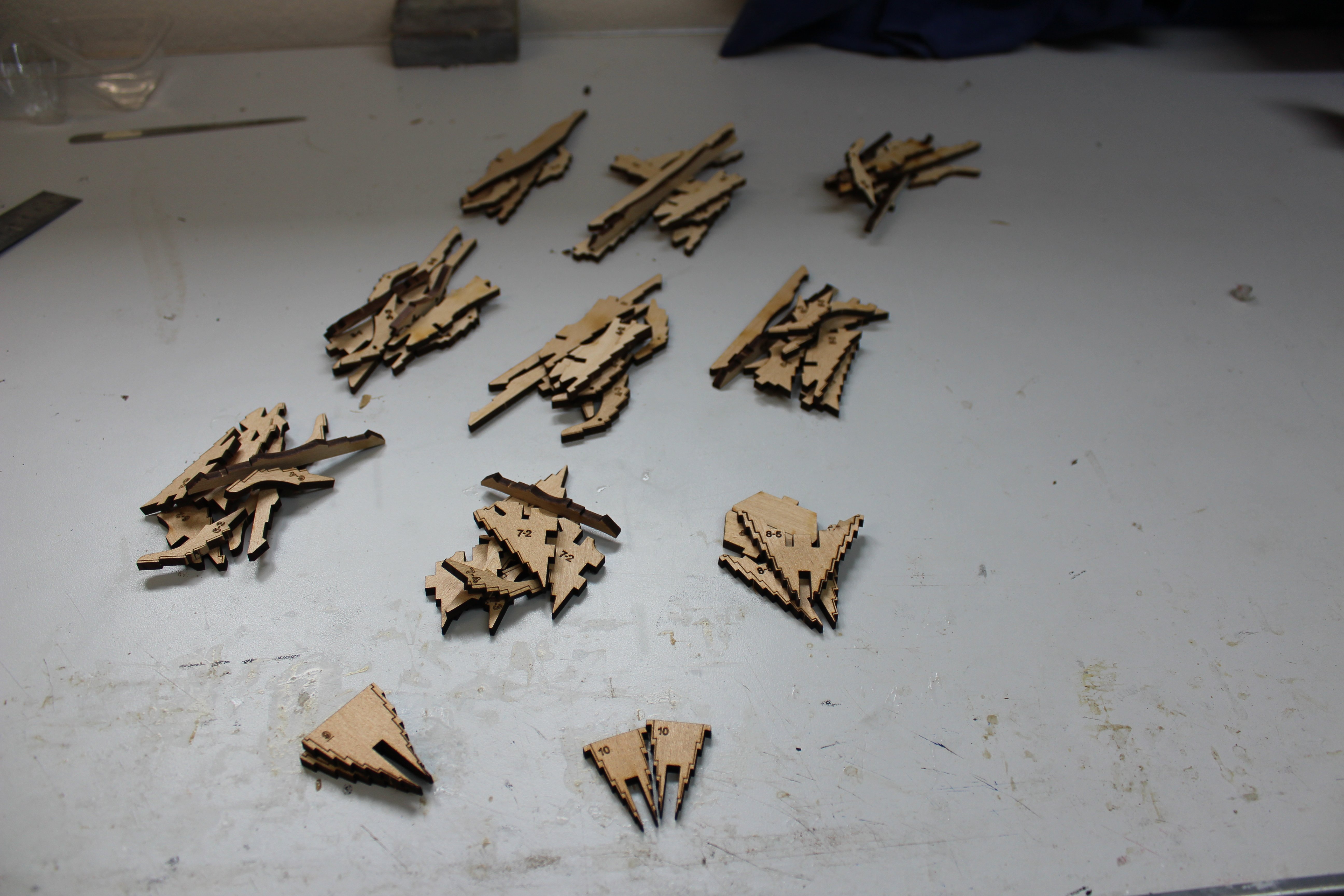

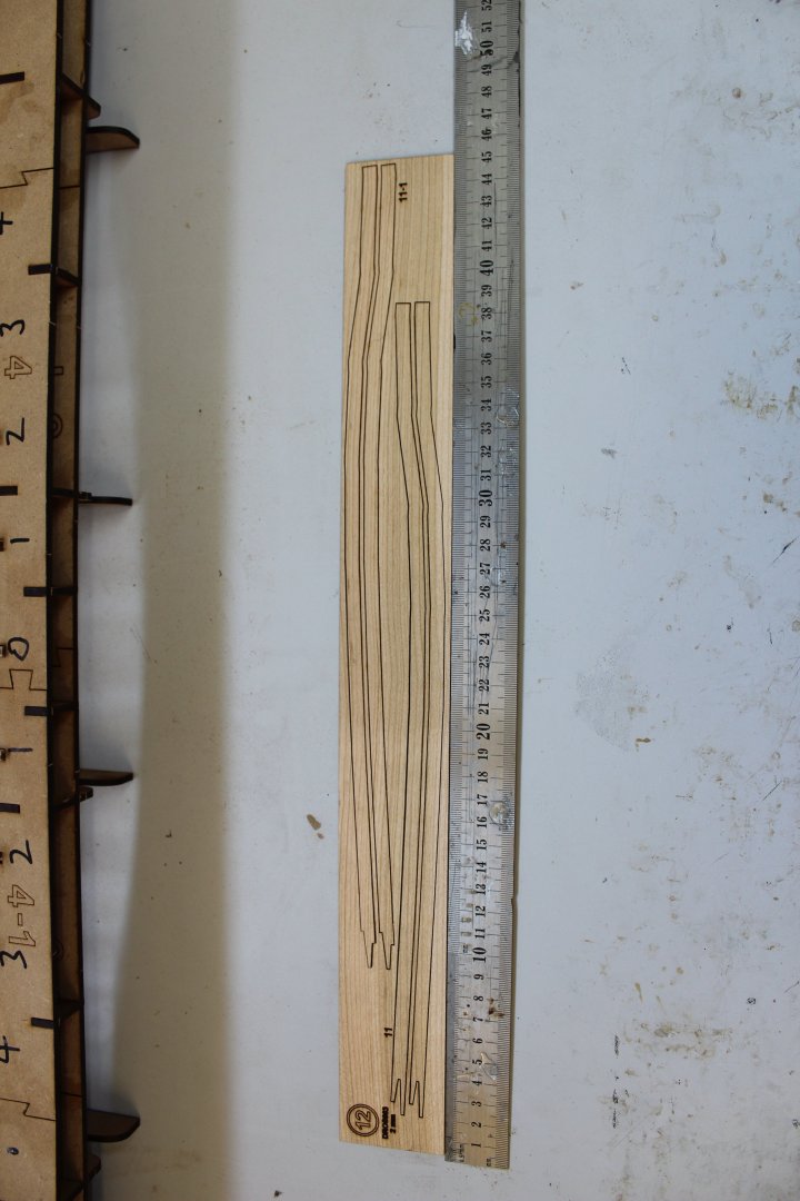

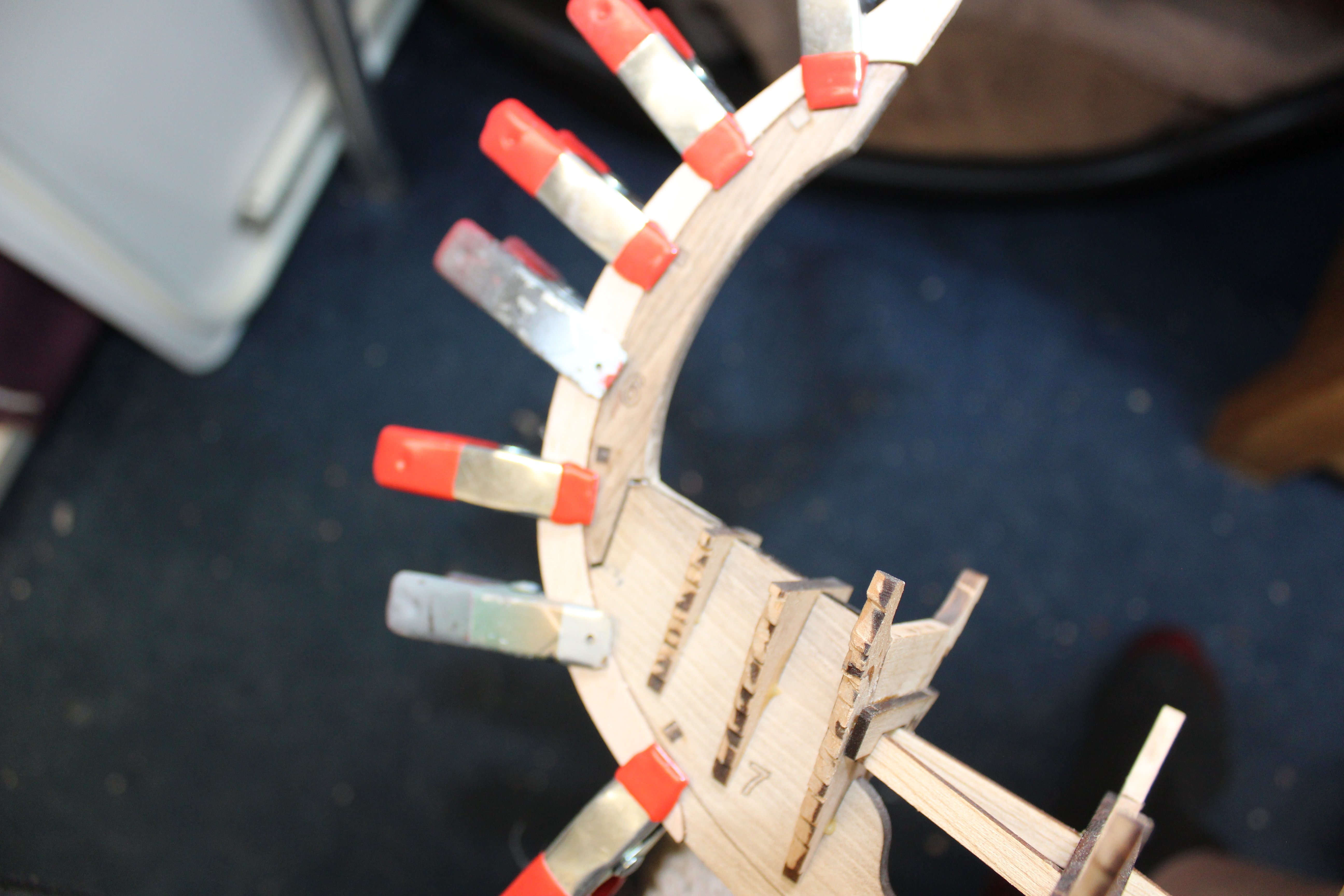

21 frames numbered from the middle - zero, up to number ten fwd and aft, most of these frames 0 to 7 are made up off 4 pieces, a 5 part is added later in the build when the frames are placed in the jig, frame zero has 2 extra parts to be added later, as this forms part of the mast support.
lasered markings denote the tapering areas, which does not take long to do, apart from frame 8 which was a pain to sort out, i dont have a photo at present, but as the planking is clinkered and a lot of tapering i found getting the filing quite awkward
Edited by Kevin
  This is amazing puzzle, with pre-fairing noted on frame pieces by a second lasered line within the perimeter.  The building jigs are also engineered cleverly.  I saw another build somewhere (but can't find it again just now) that goes meticulously through each step - with some useful tips/caveats.  Other related builds of Billings Oseberg or Vikingskibbe have troubled themselves with installing riviets, yet Siggi's Gokstad recent build used a scribed line near the plank edge and pencil dots to simulate rivets effectively.

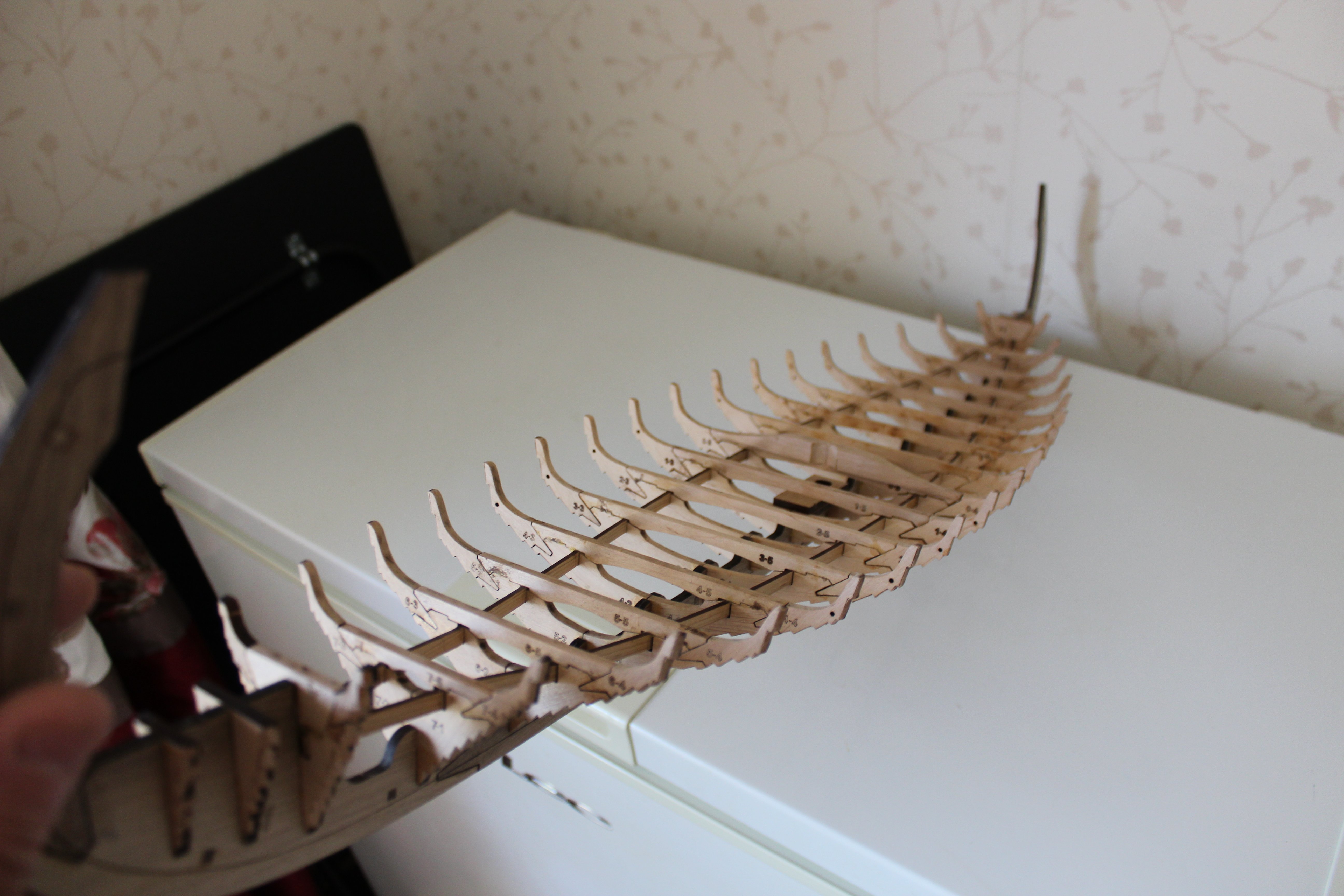

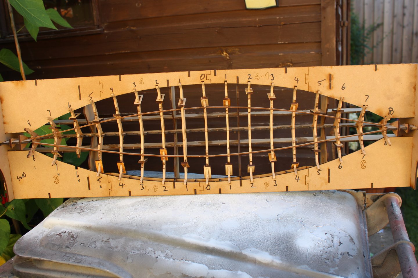

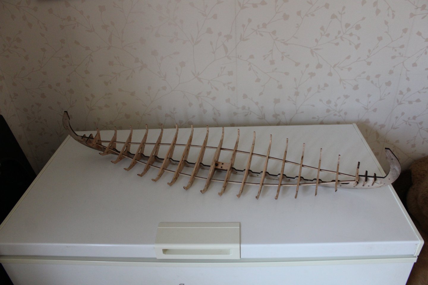

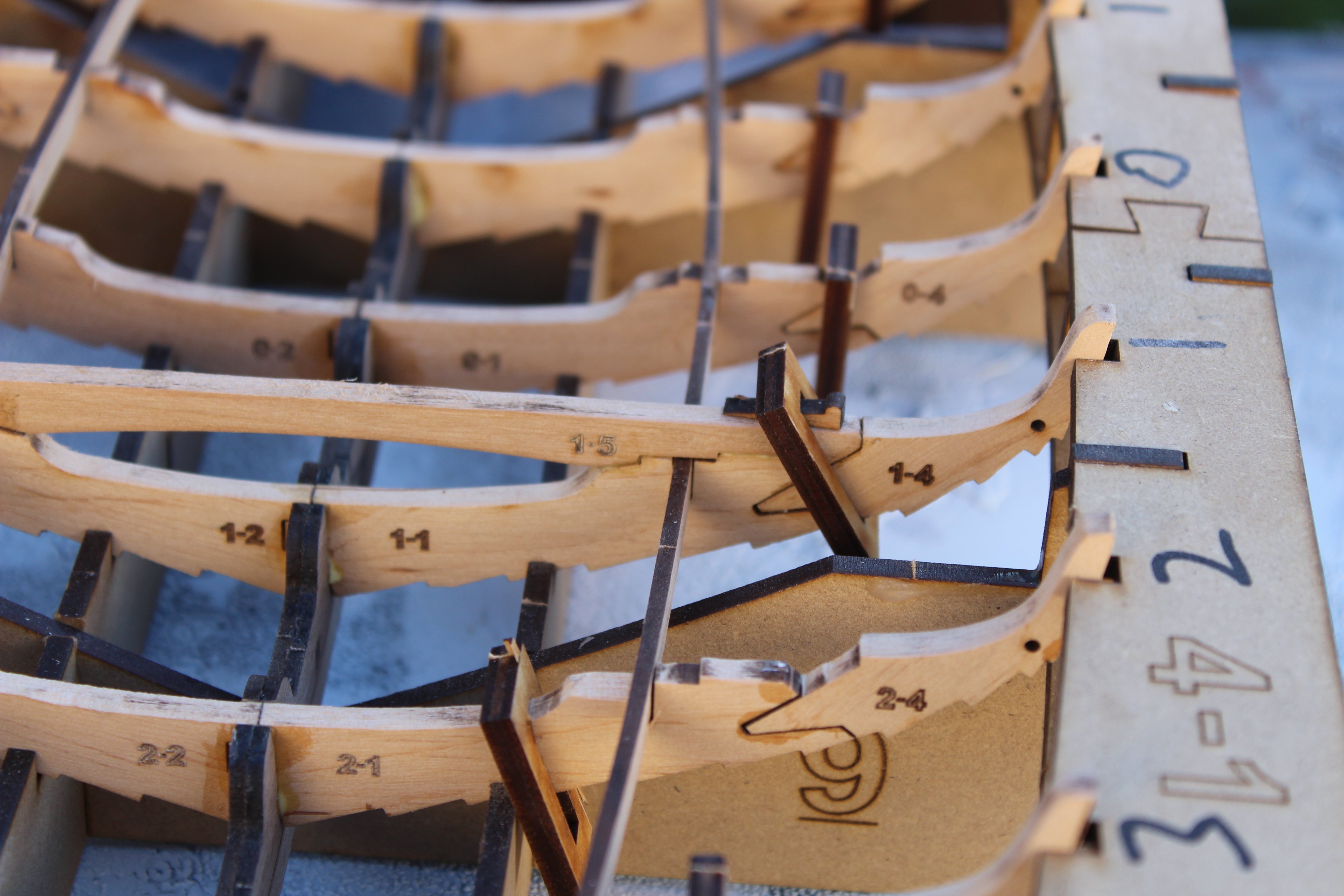

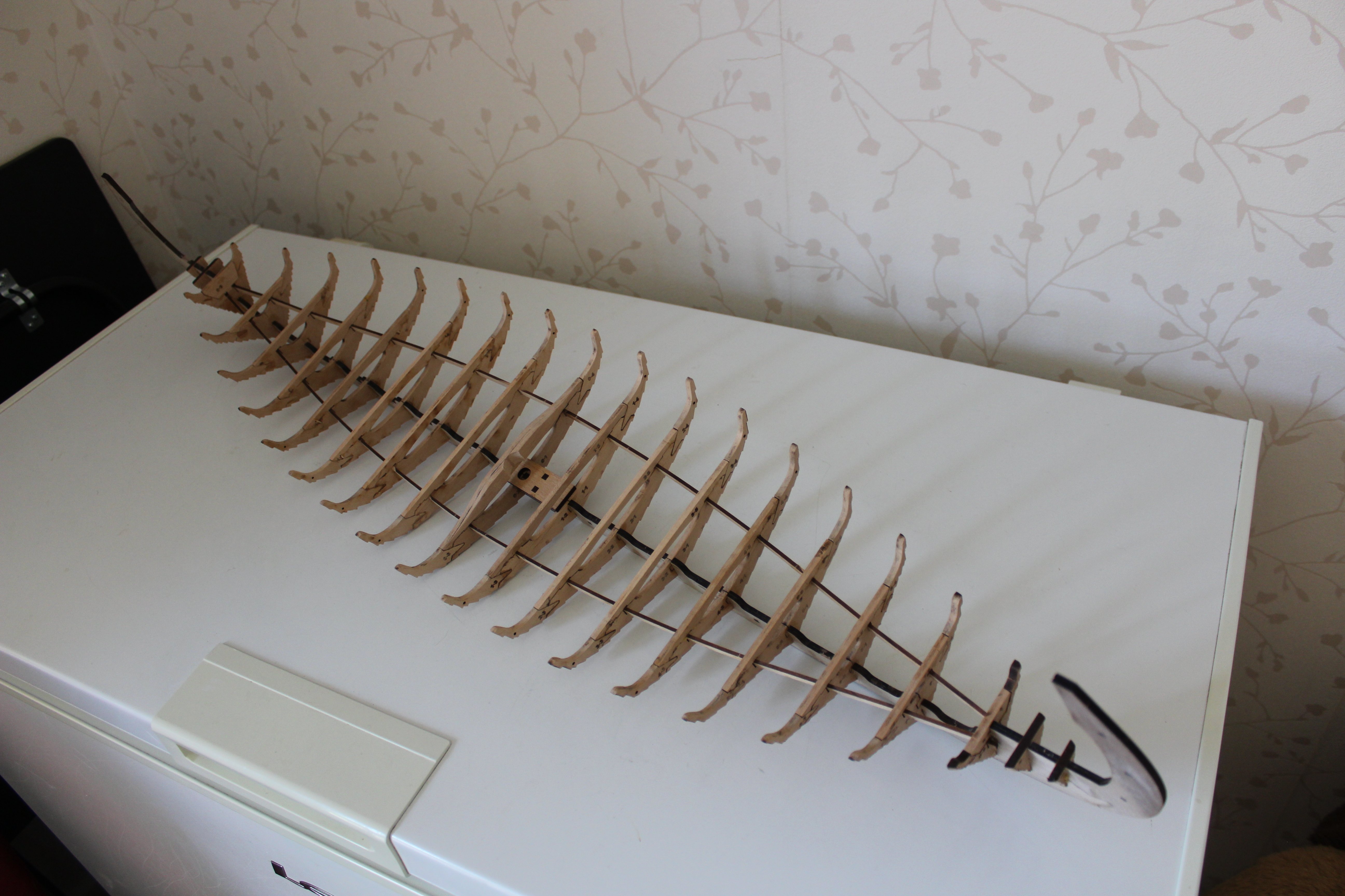

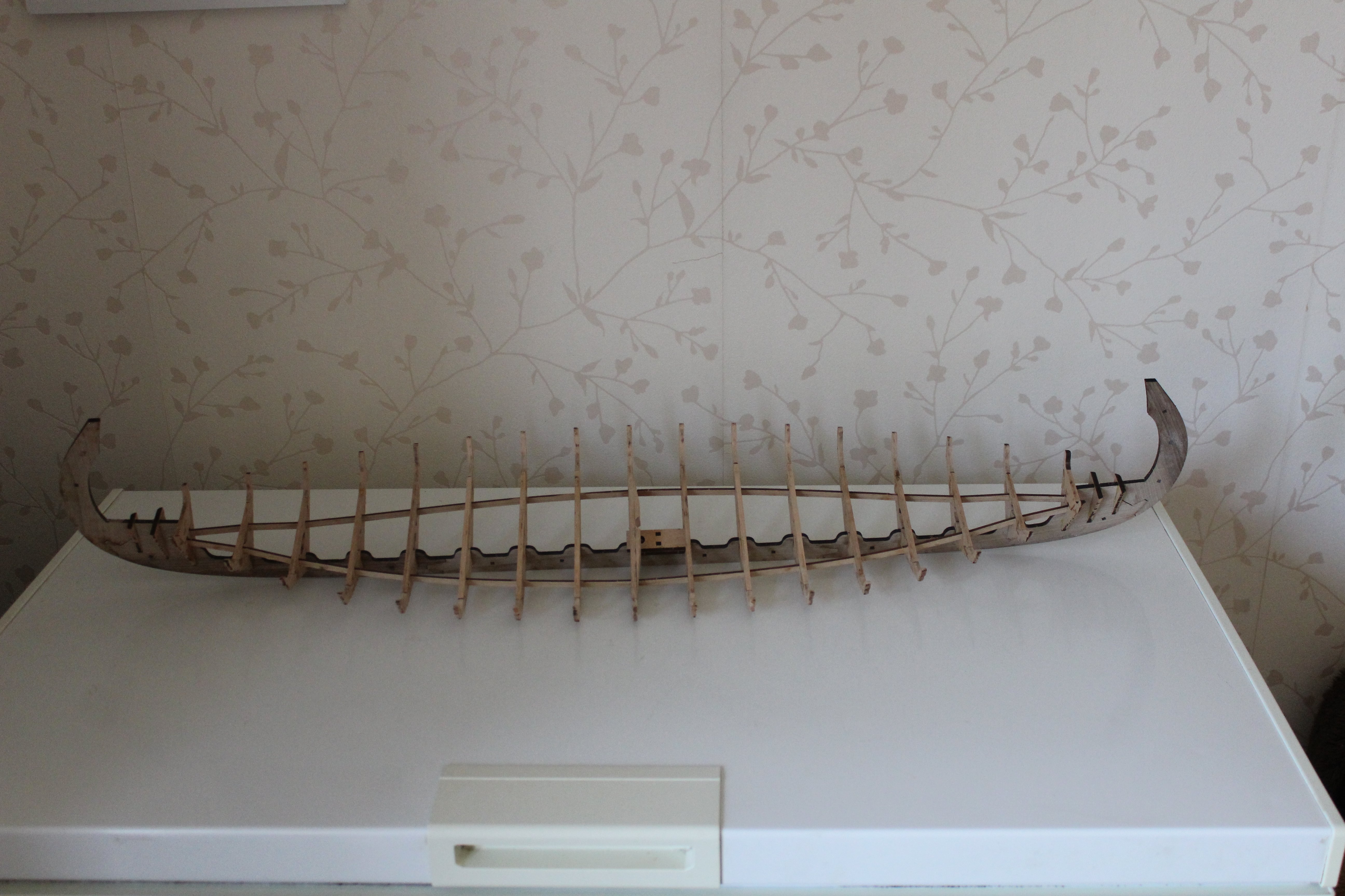

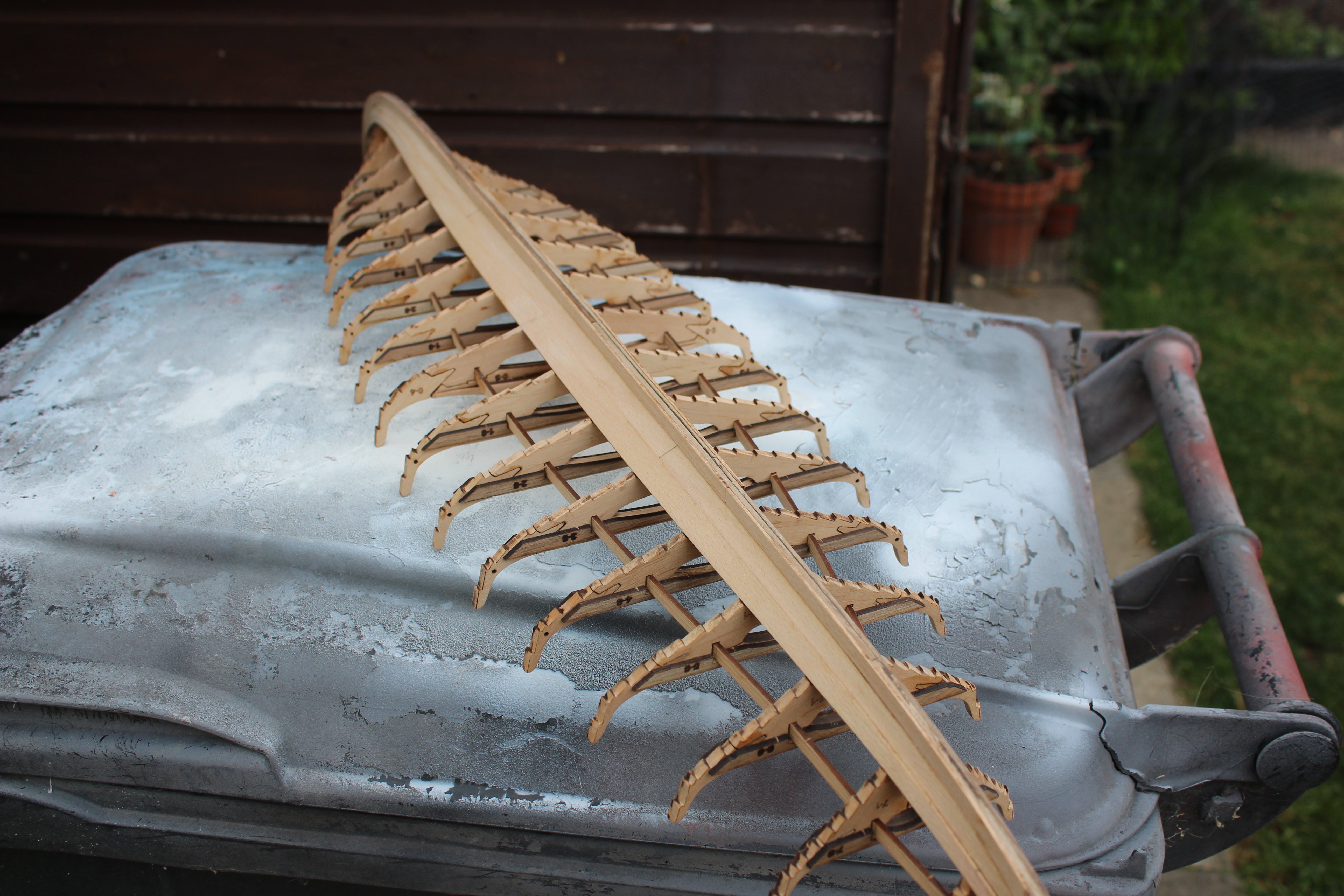

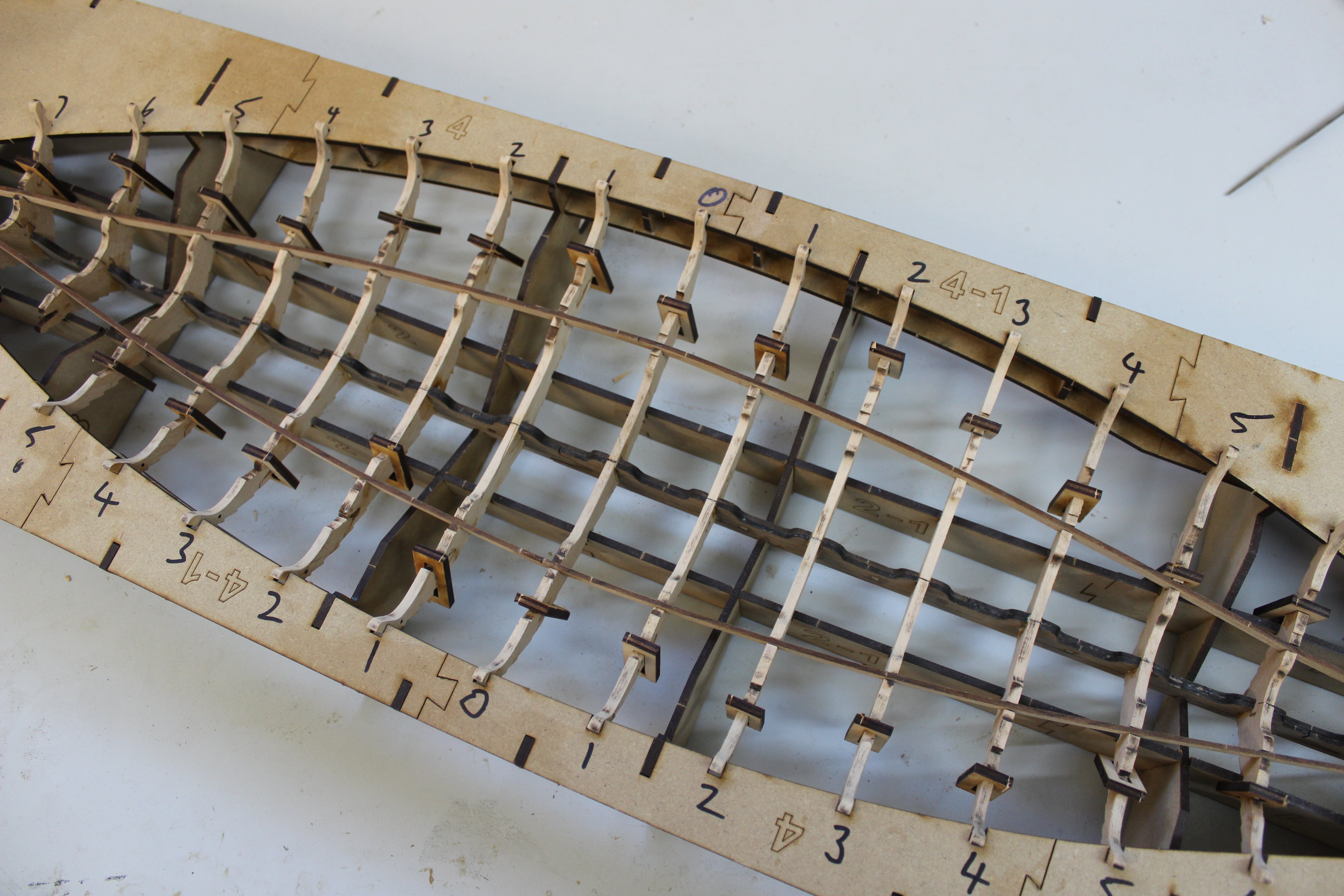

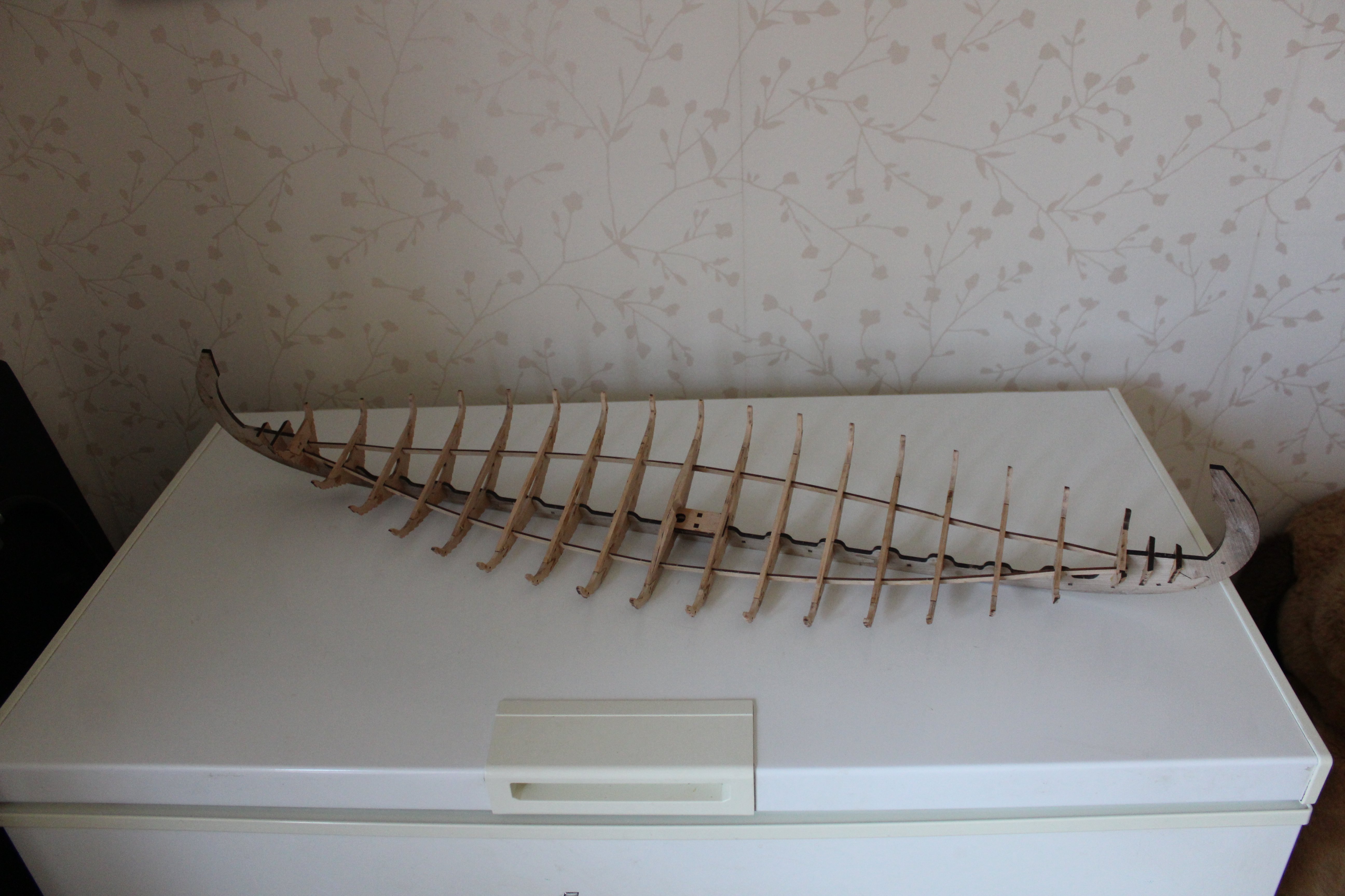

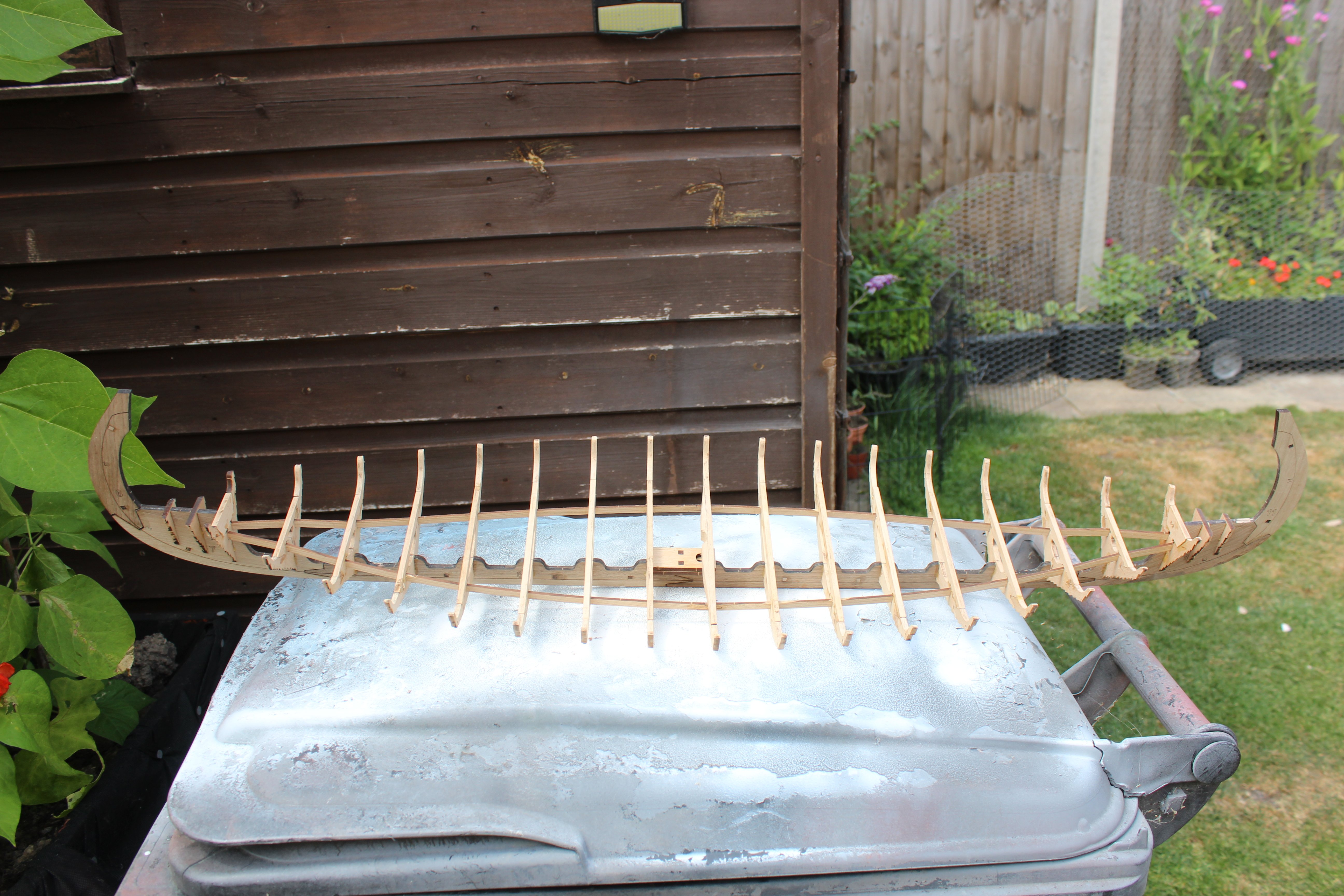

frames dry fitted

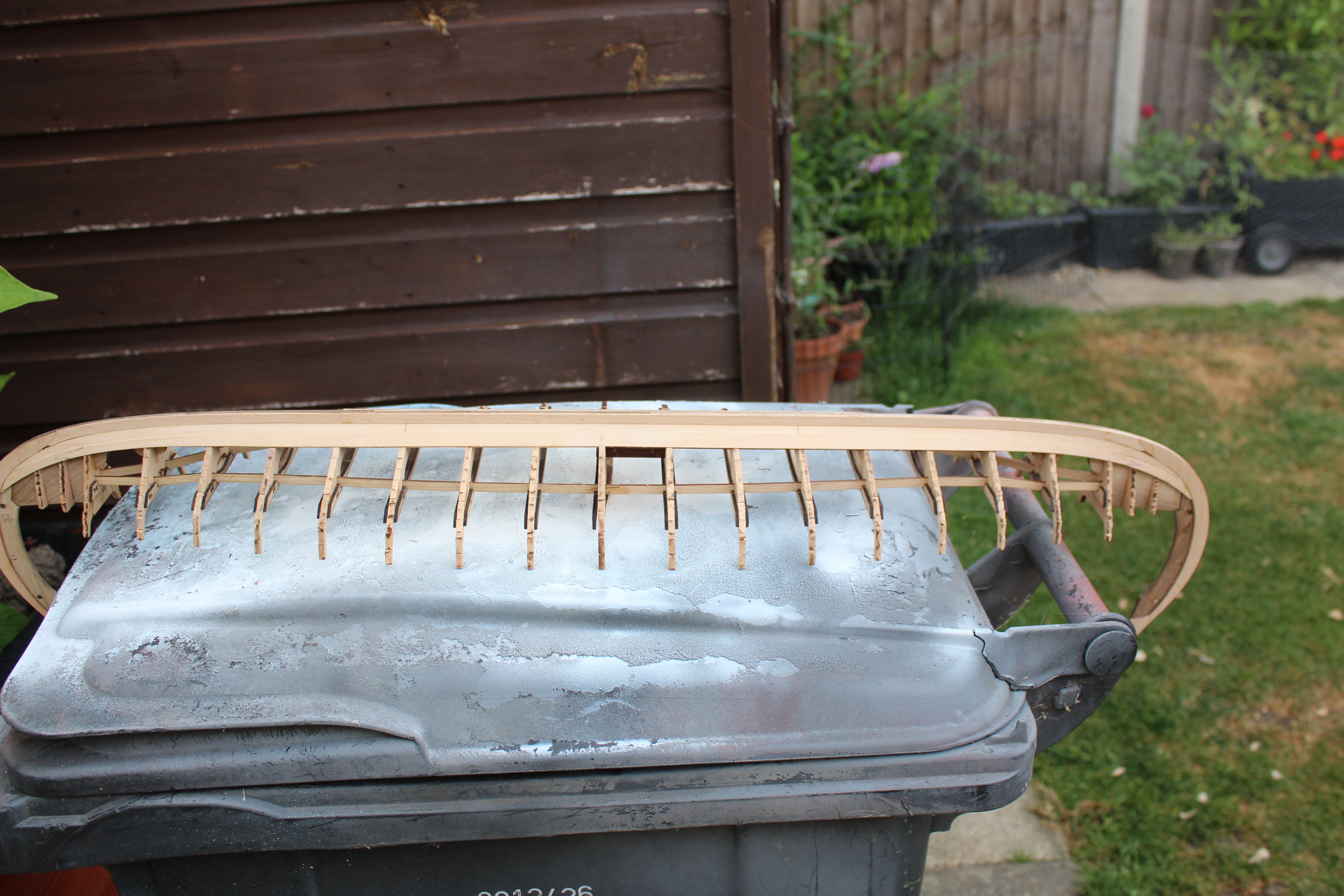

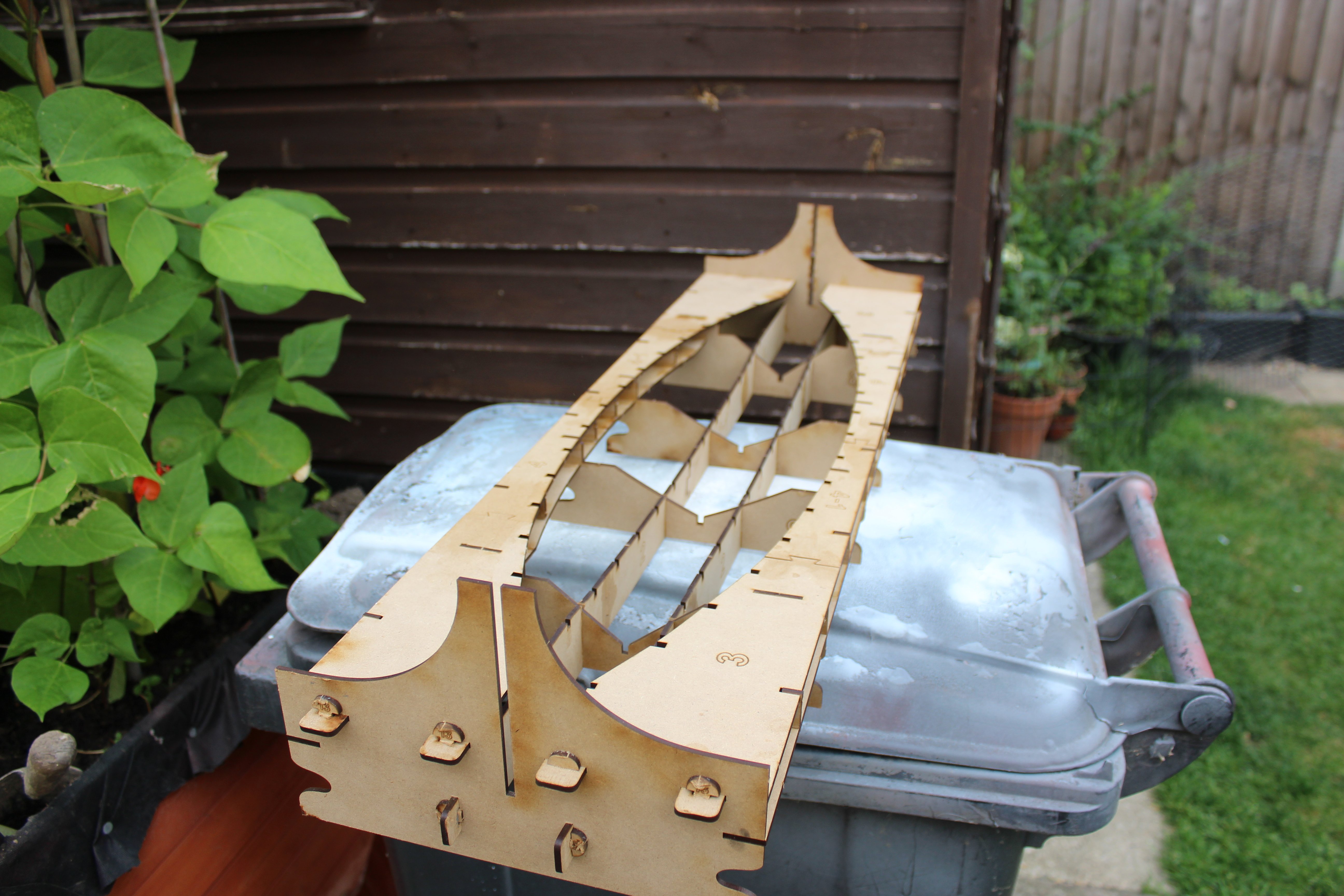

the keel was placed into the jig, although at this time there are is right or wrong way of doing this, i marked the jig with frame numbers and decided to write fwd on one end,
frames are cleaned up again, and glued onto the keel, the cross member 2-5 is not fixed at this time until the stringers are in place
some time later
day 4

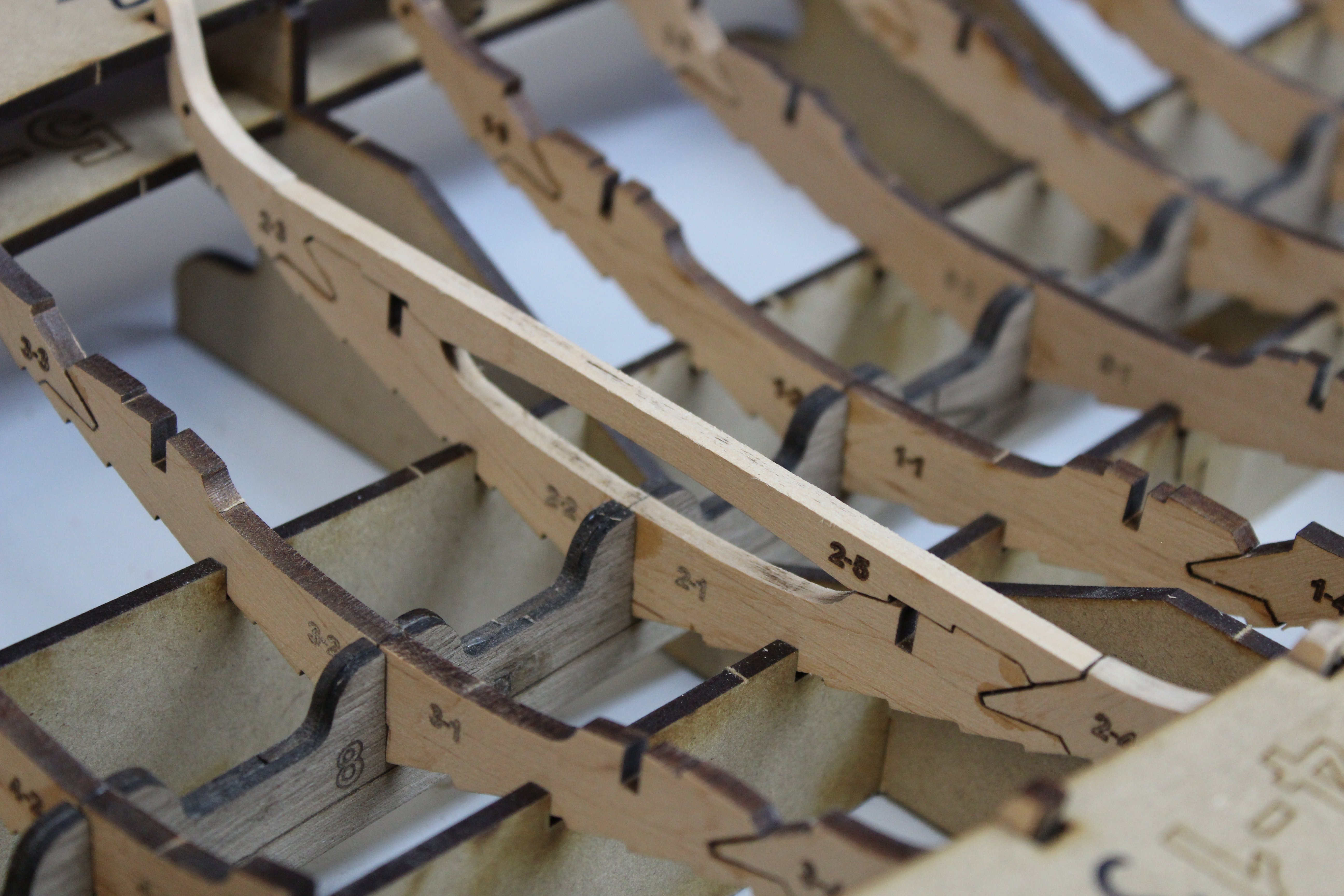

having been left overnight to set the keel and fitted frames are removed from the jig, only to be put back in with the cross member clamps

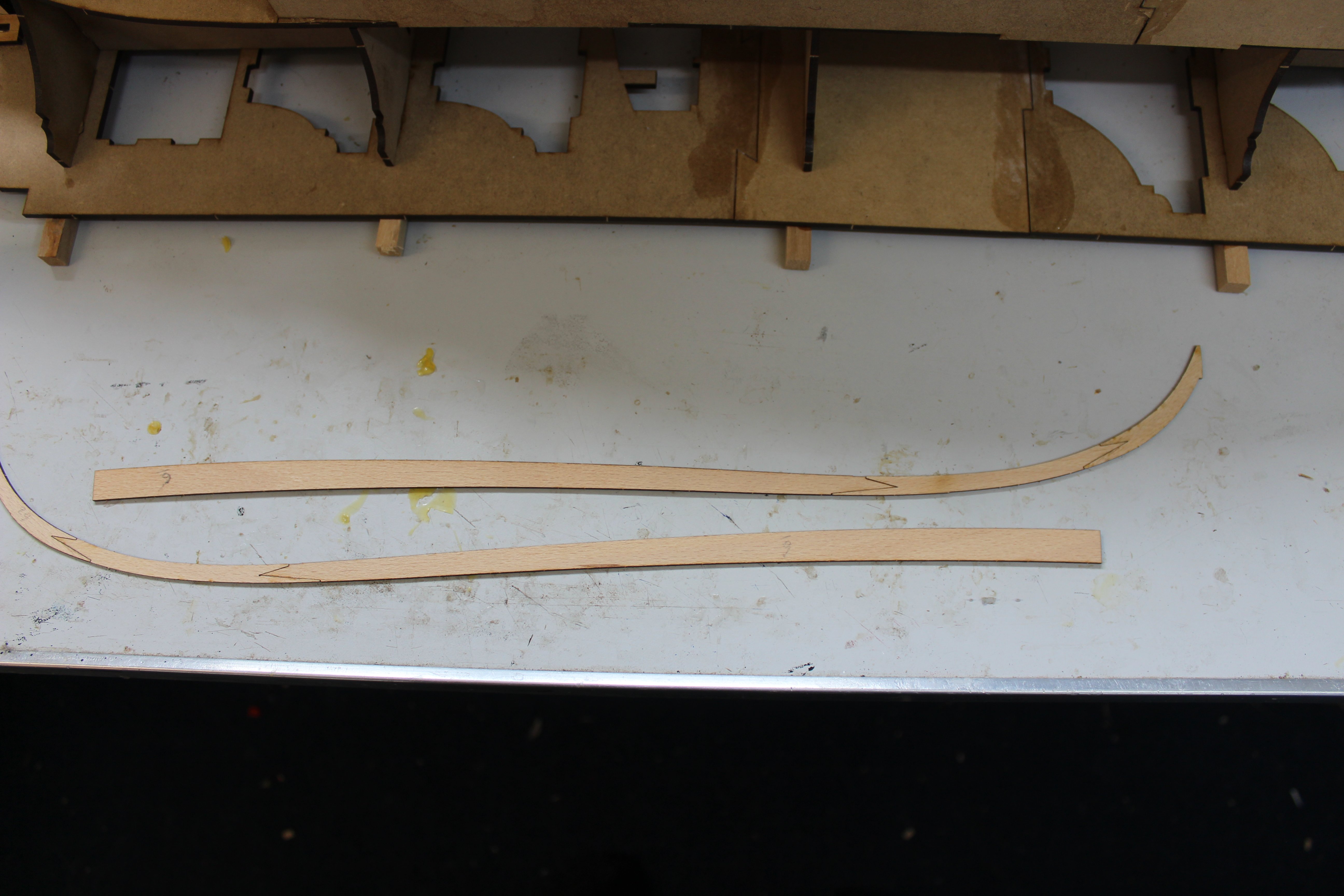

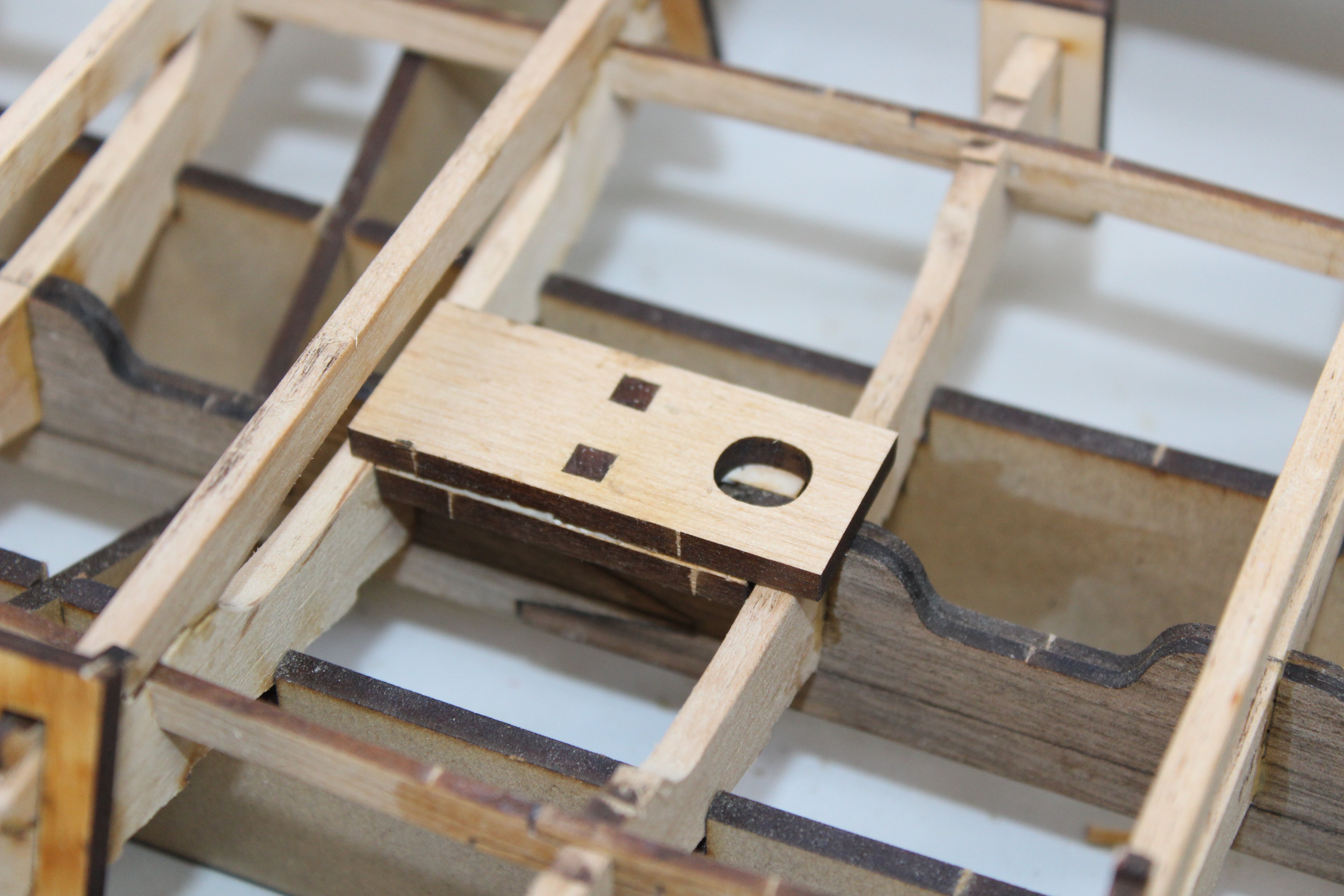

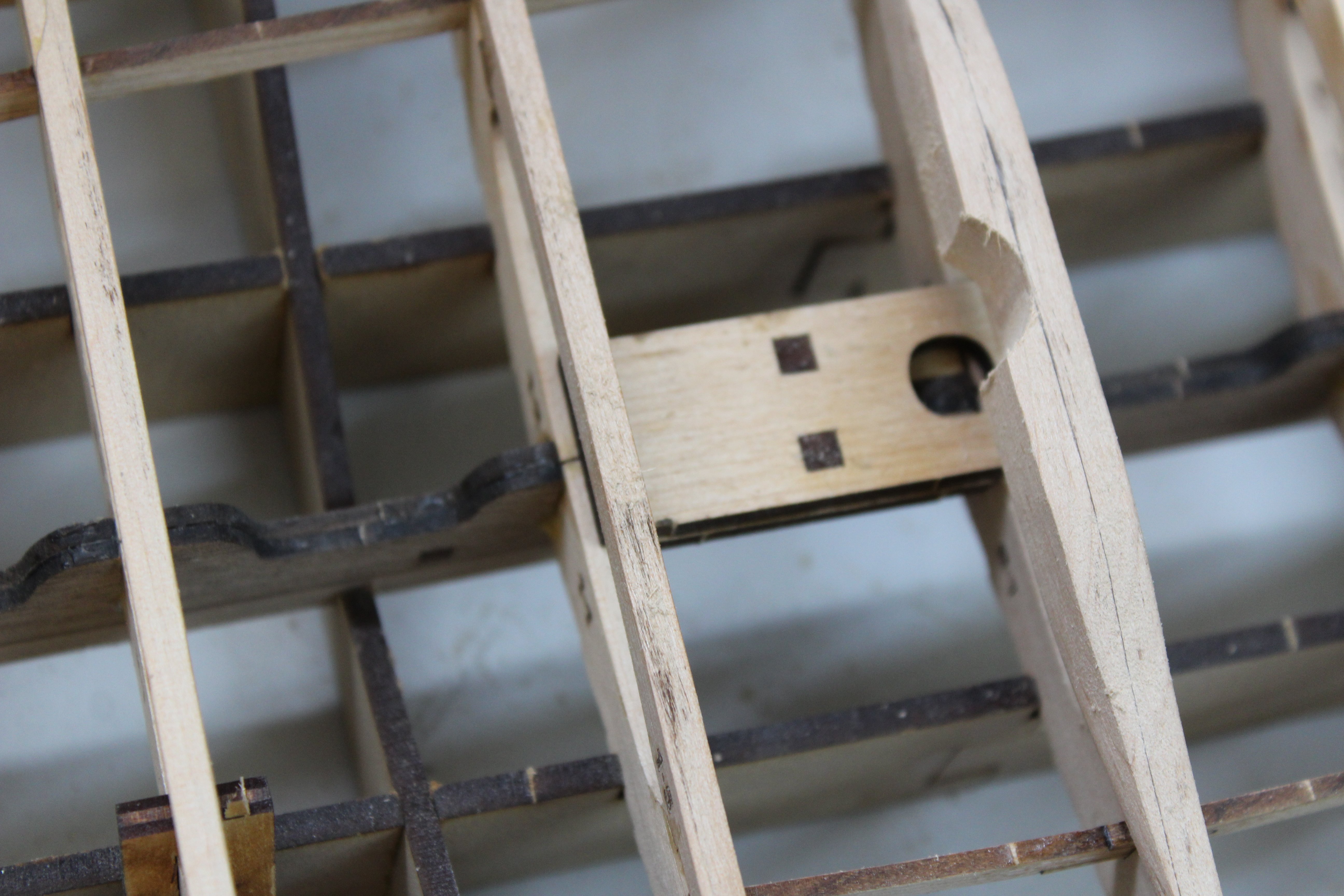

shaped stringers
in place
simple yet clever way of holding down the cross members whilst the glue sets

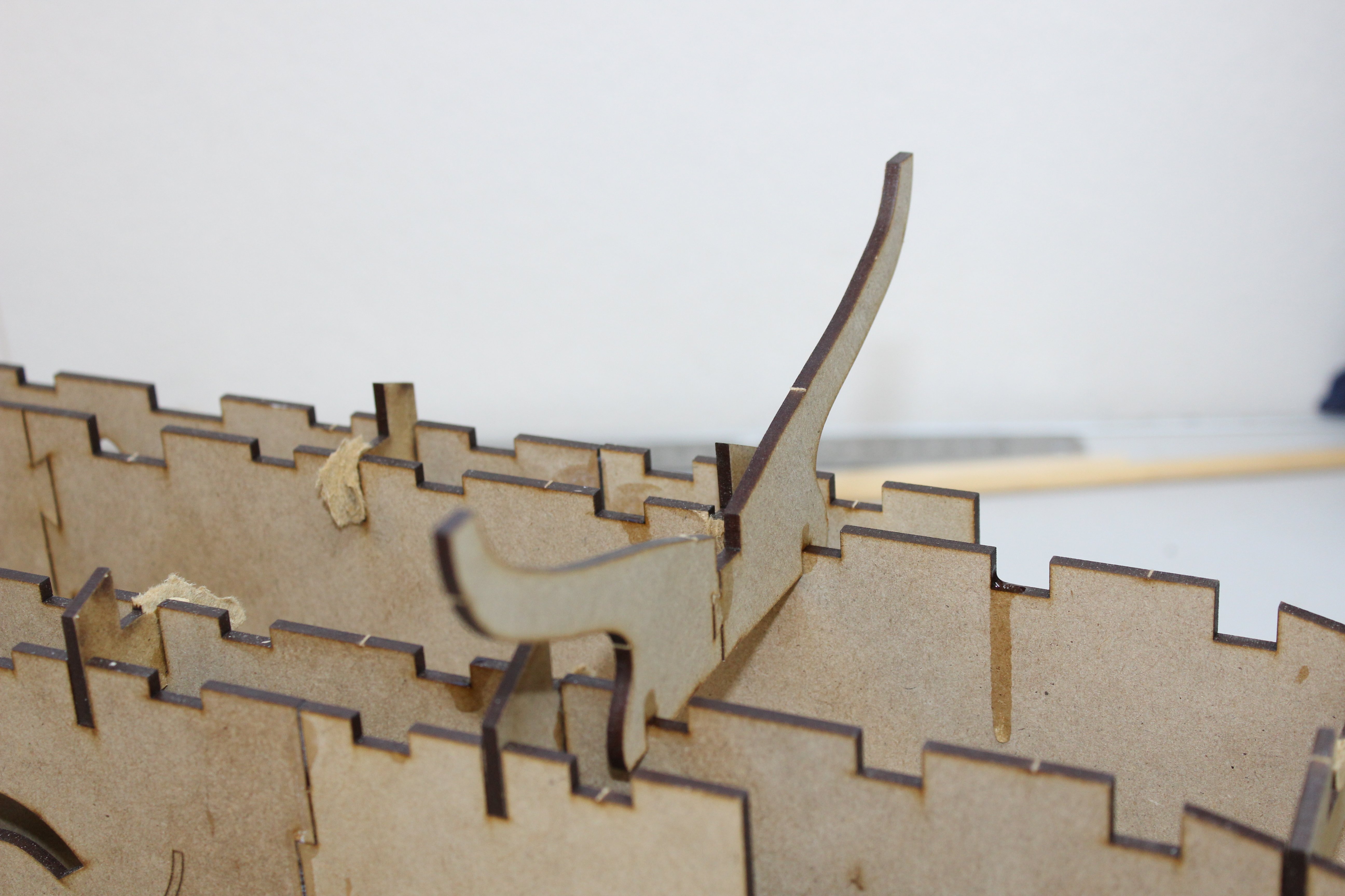

as i mentioned yesterday the way frame zero goes in dictated fwd at aft of the build, now is the time

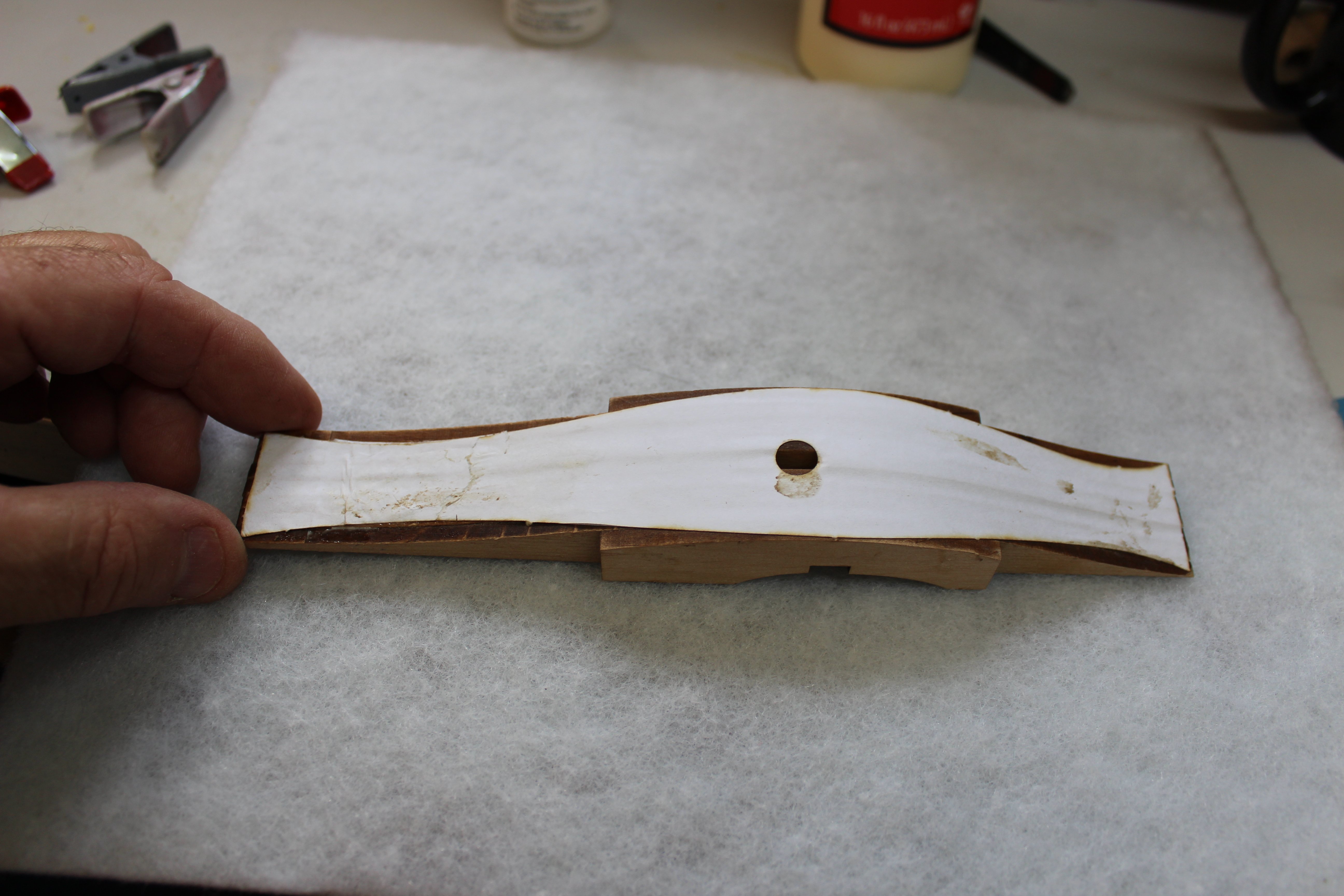

Mast step
image.thumb.jpeg.f205ecebf4dd4f5279765ef94c4cdfc6.jpegimage.thumb.jpeg.88456018aeb8269a43009a0c8544c90e.jpeg
out for the day

and the whole assy removed from the jig

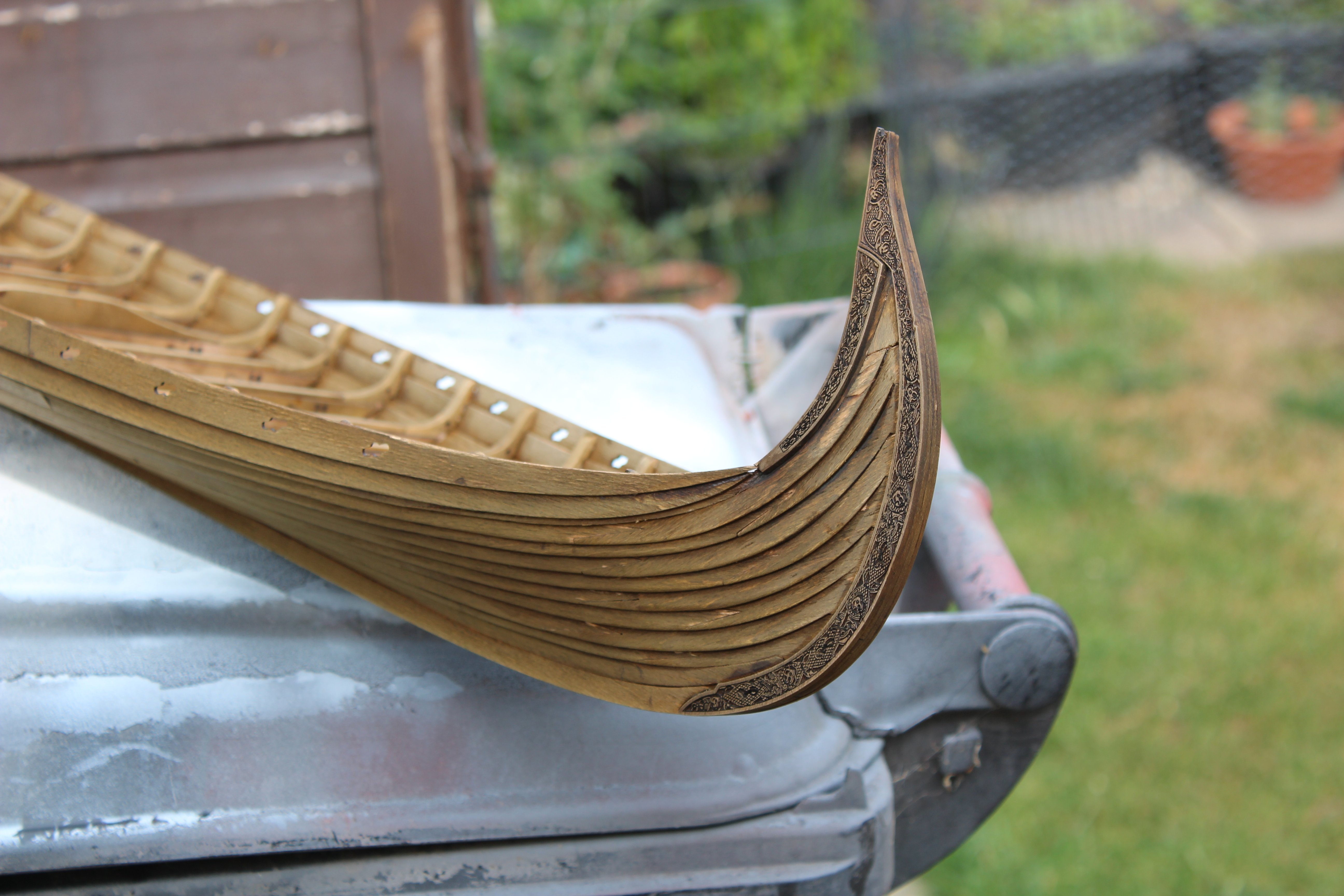

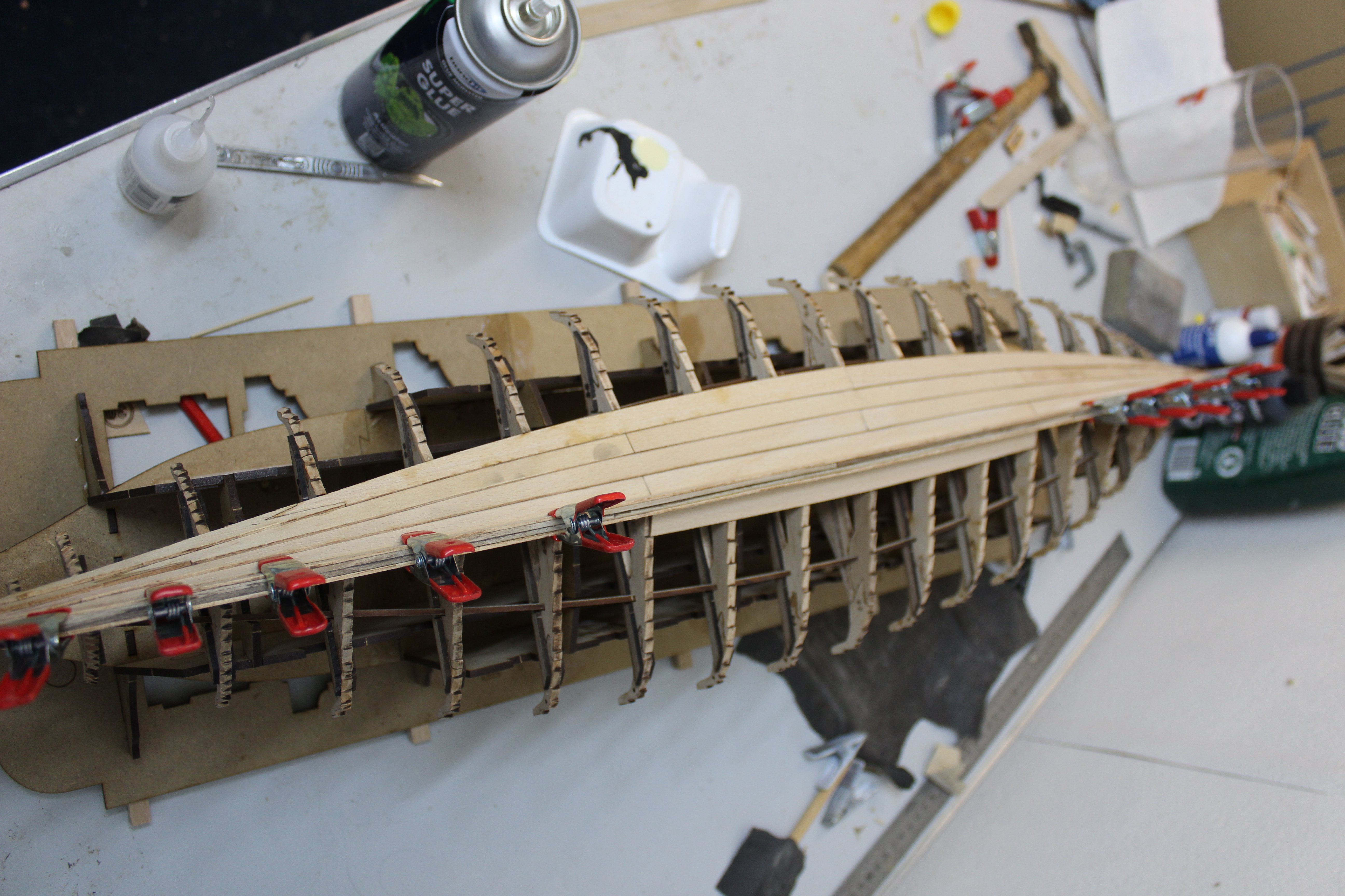

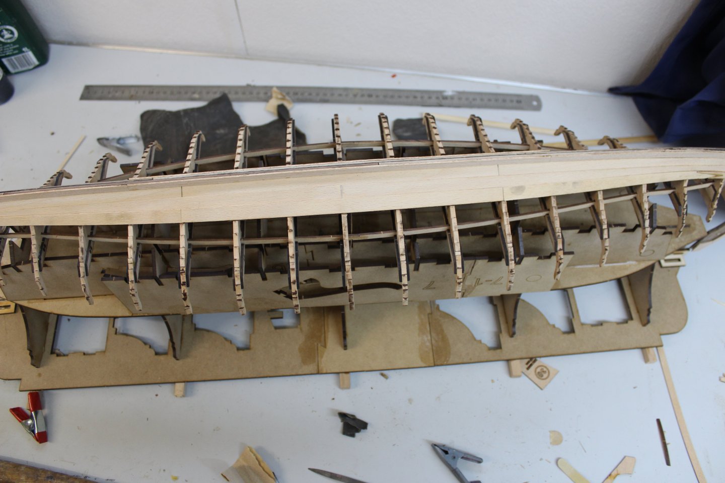

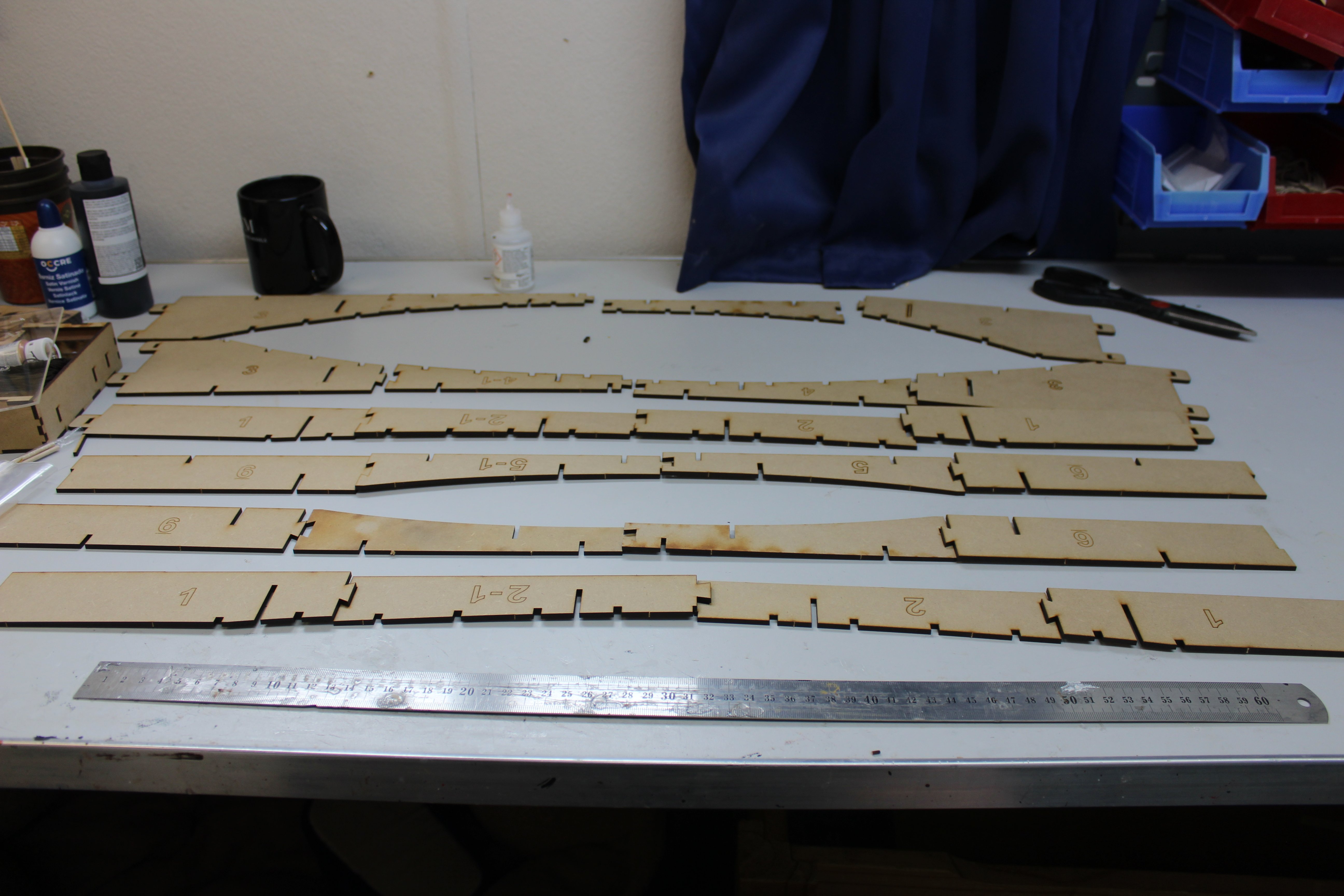

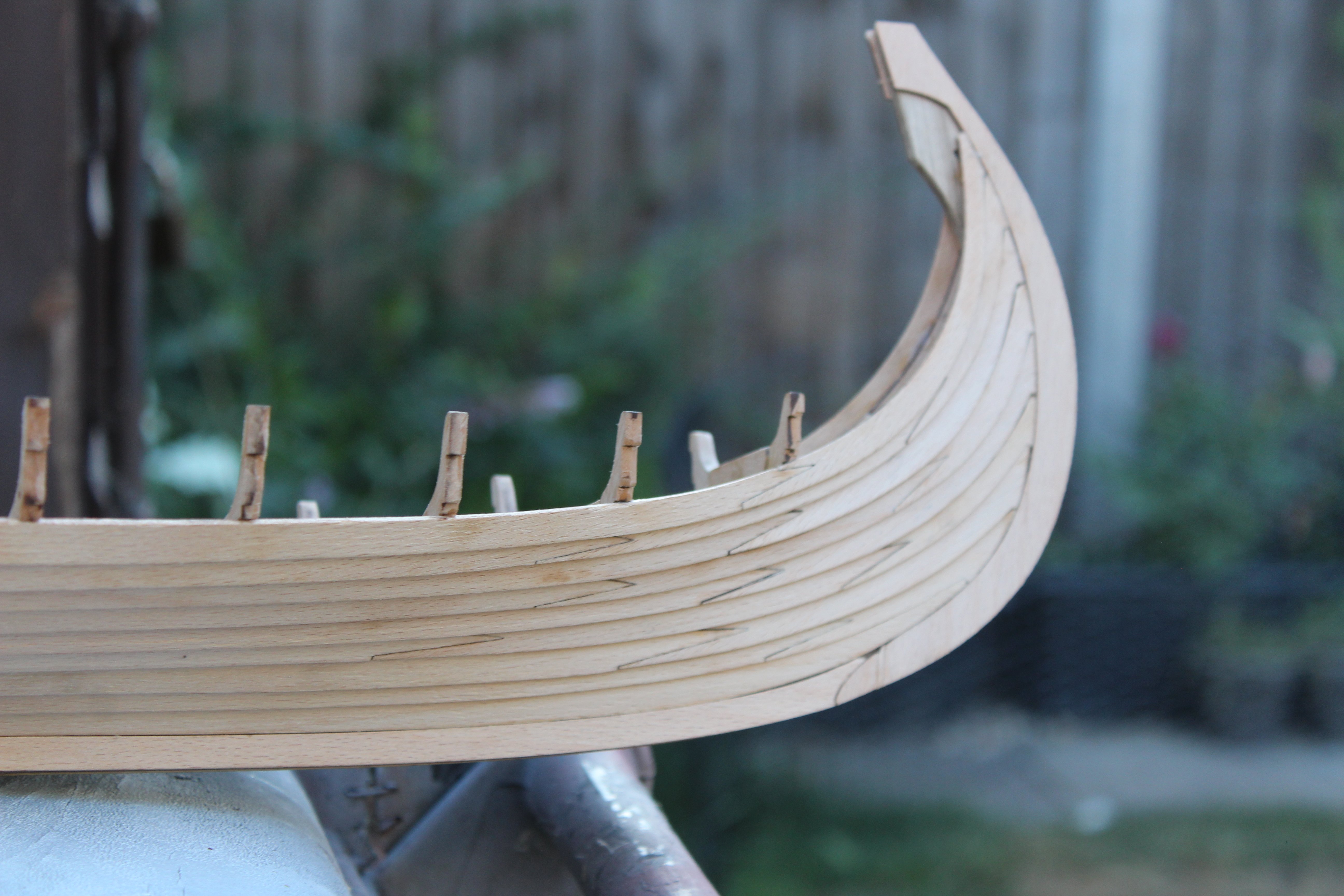

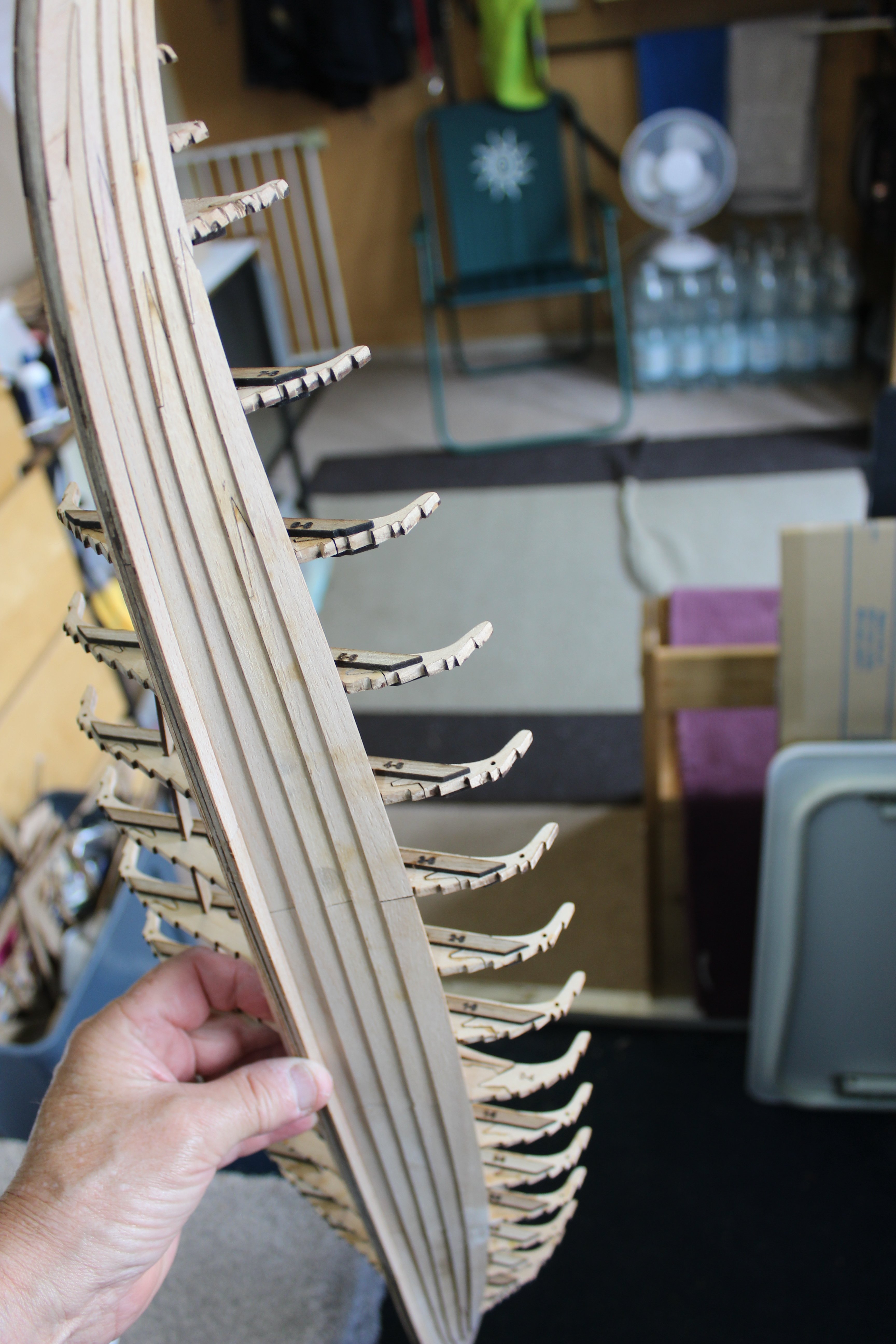

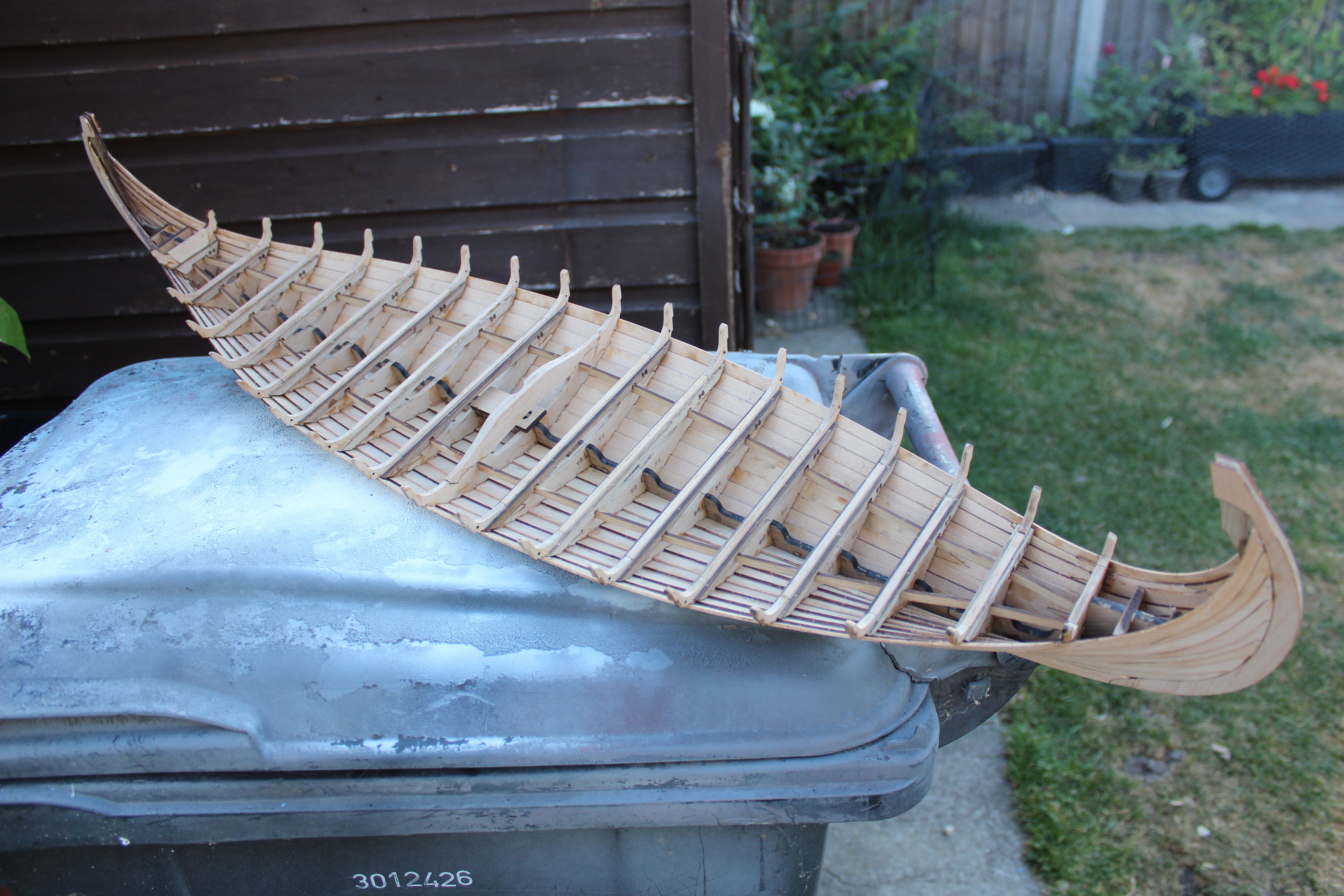

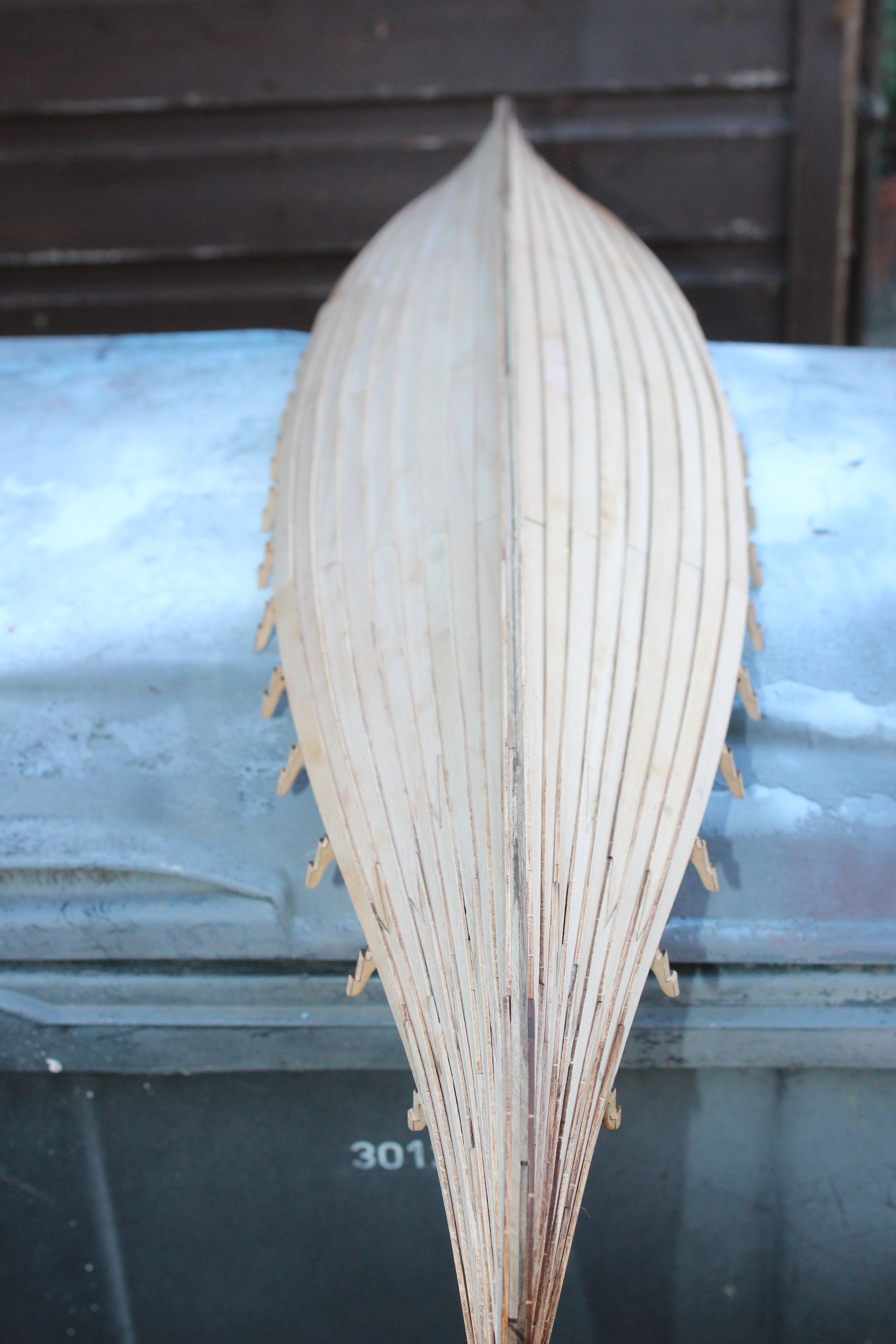

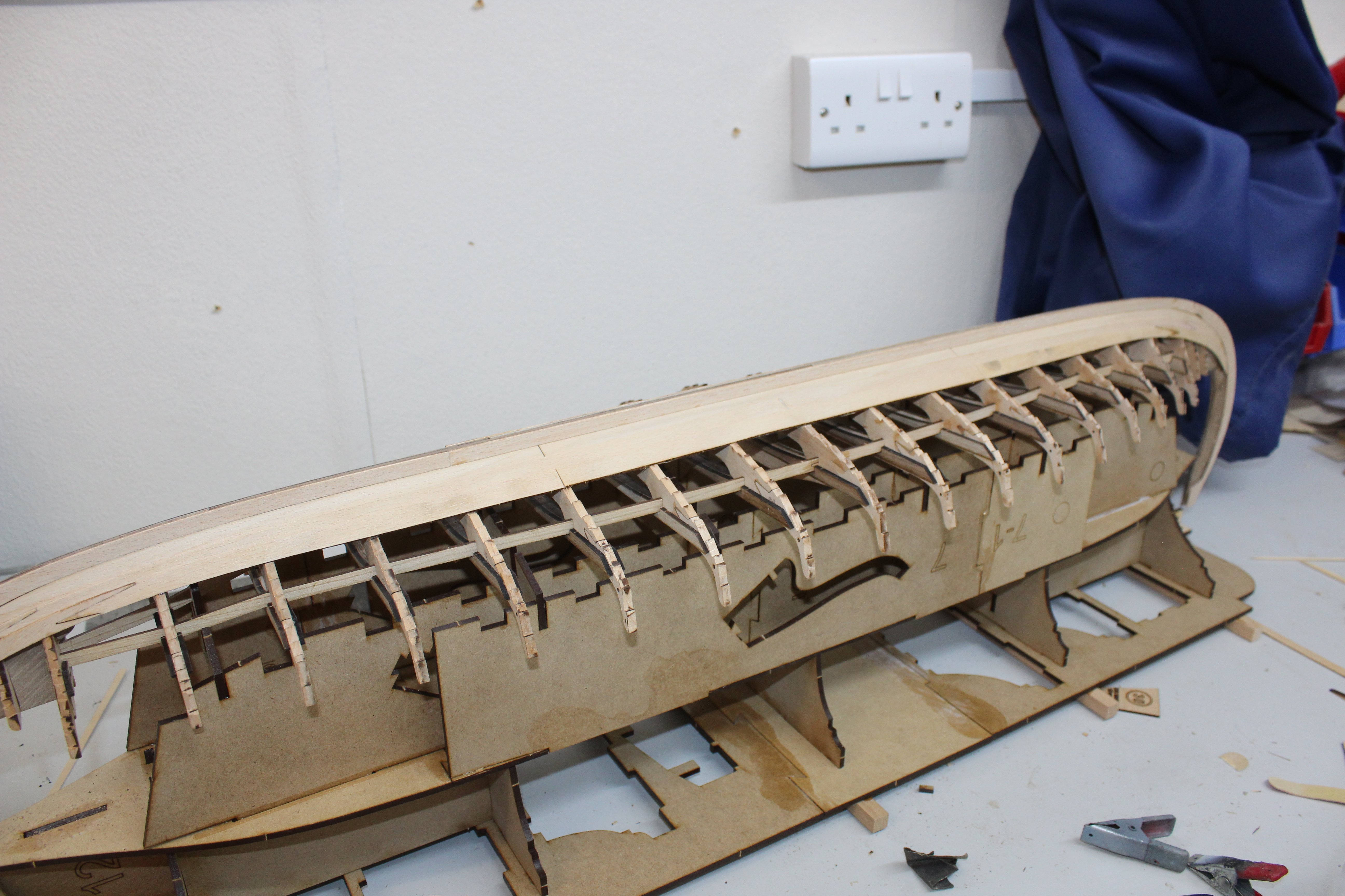

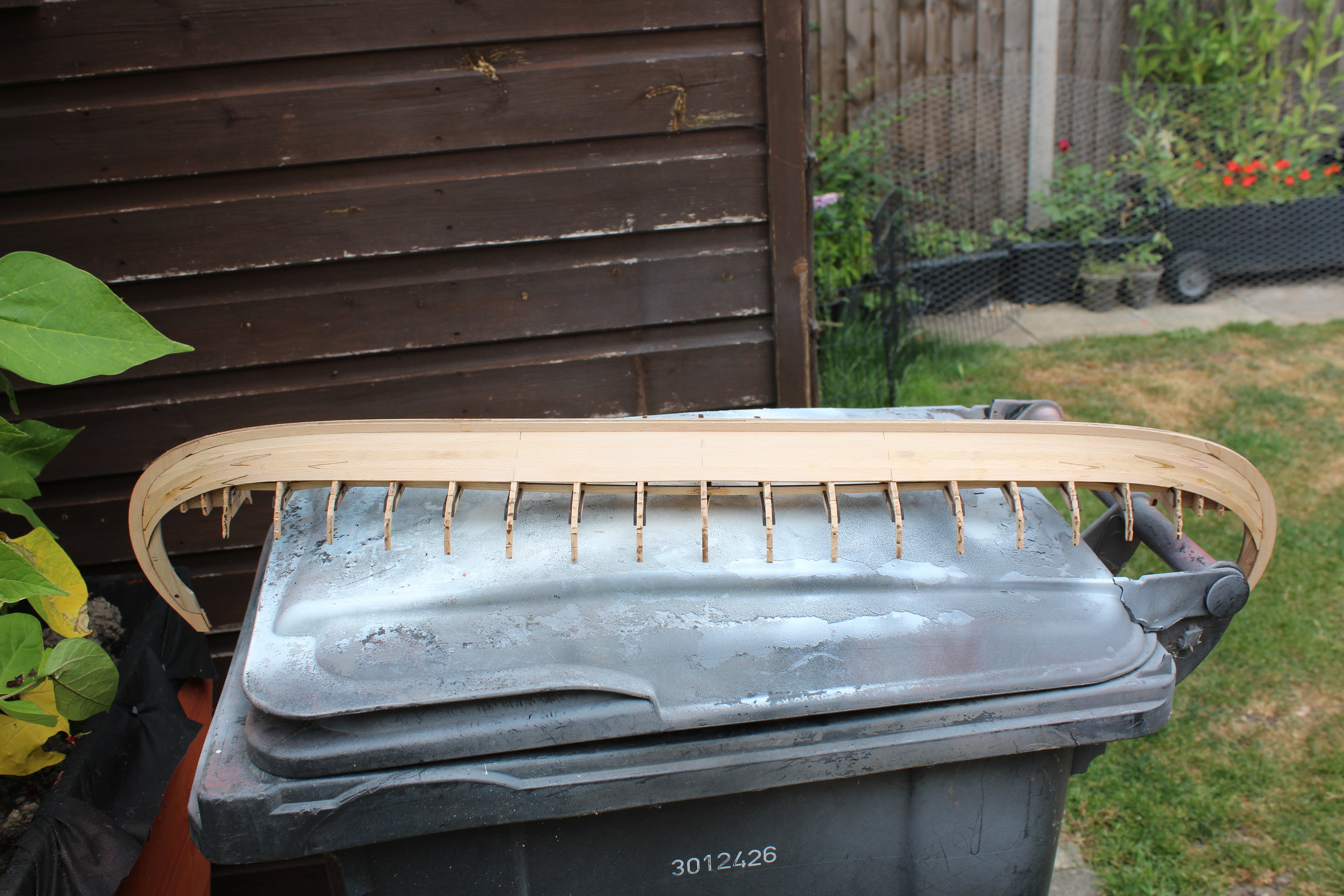

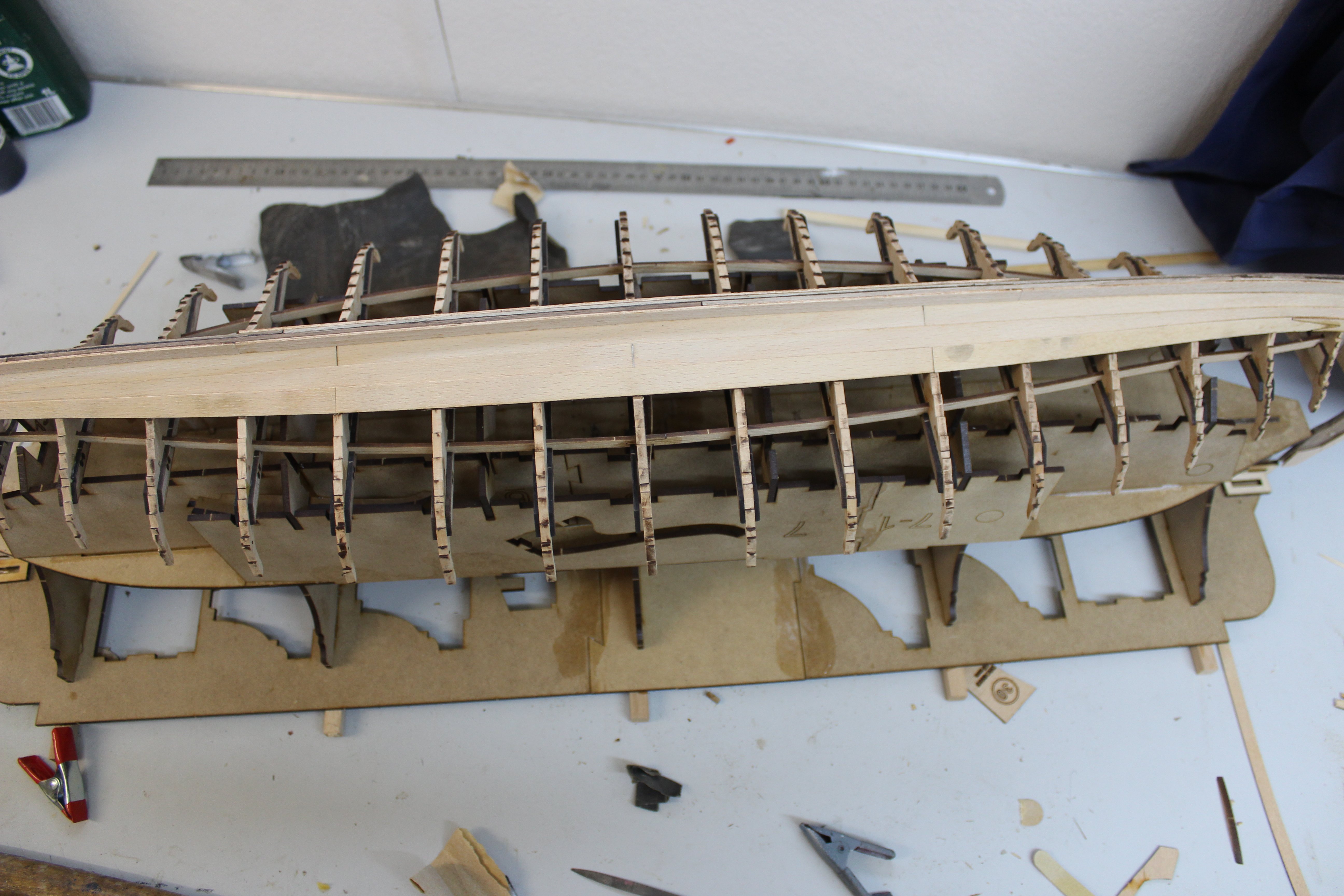

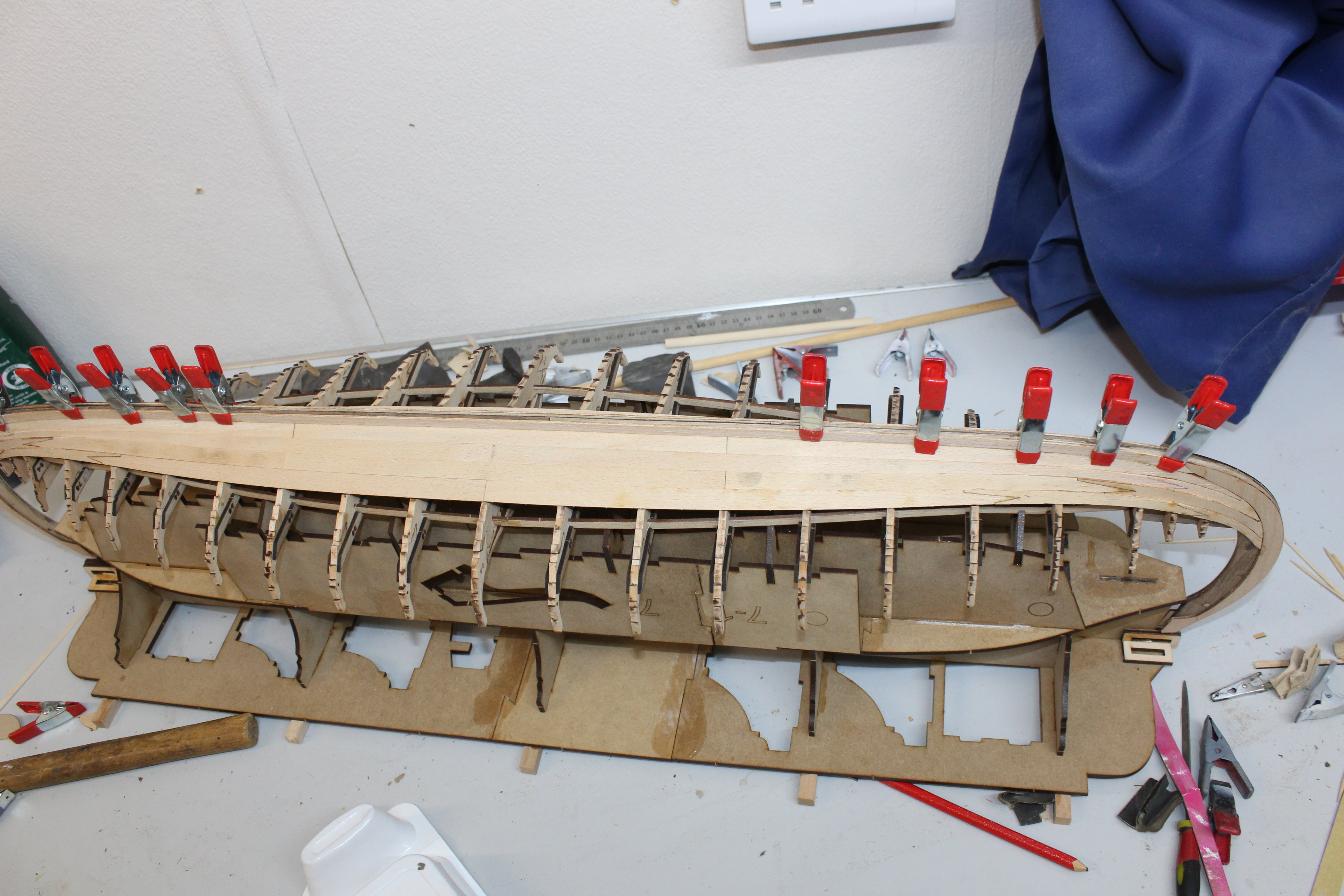

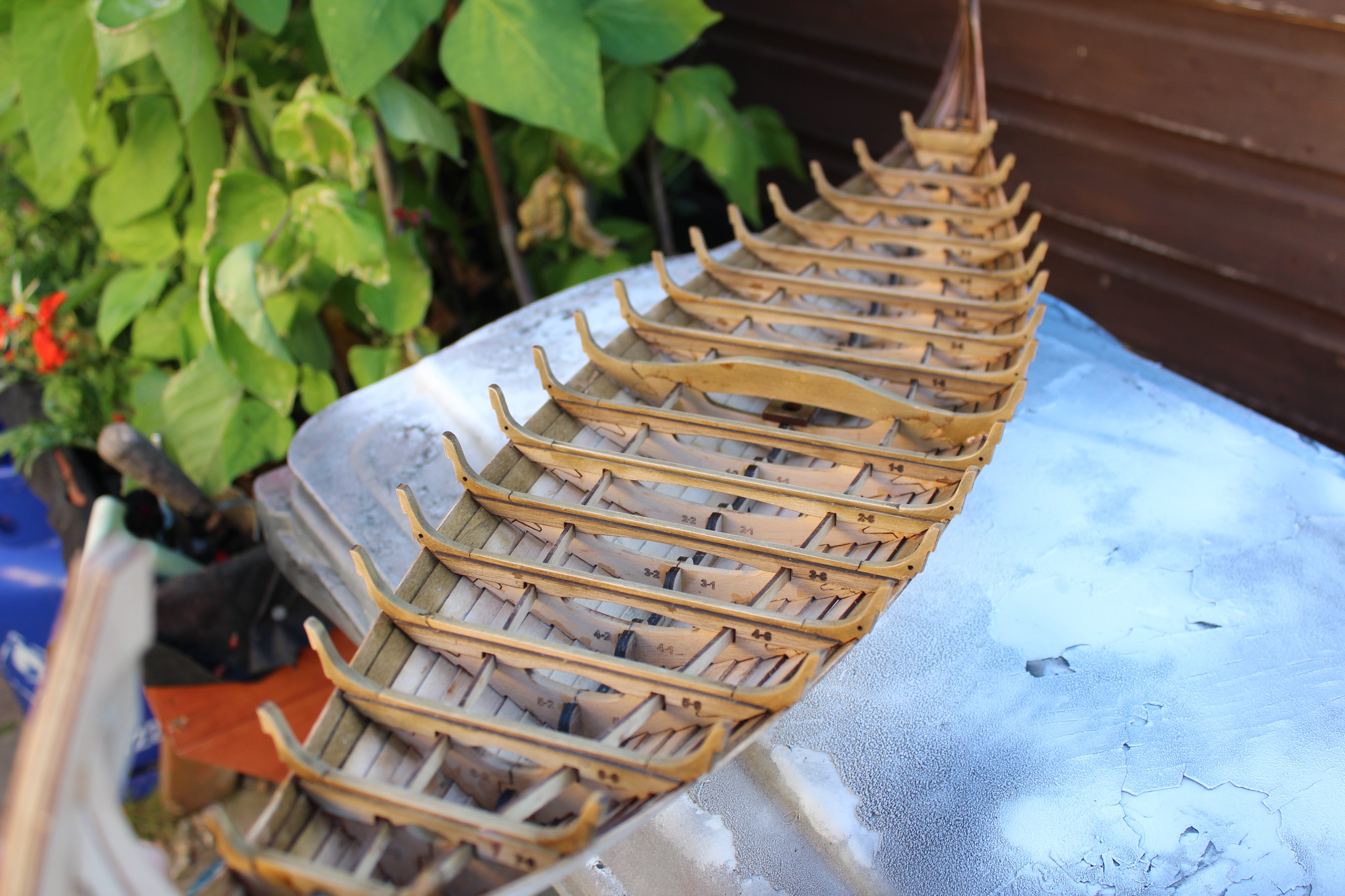

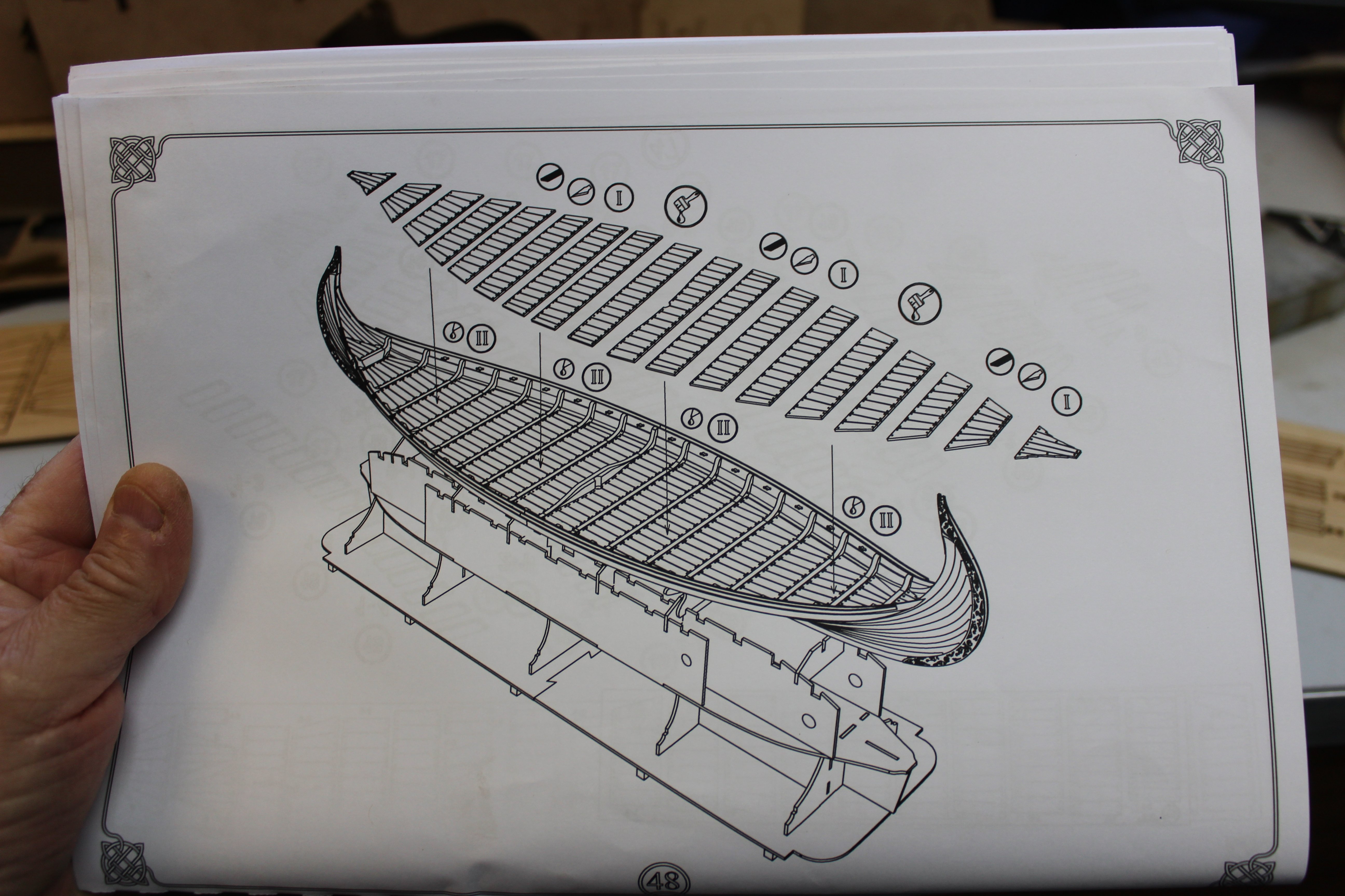

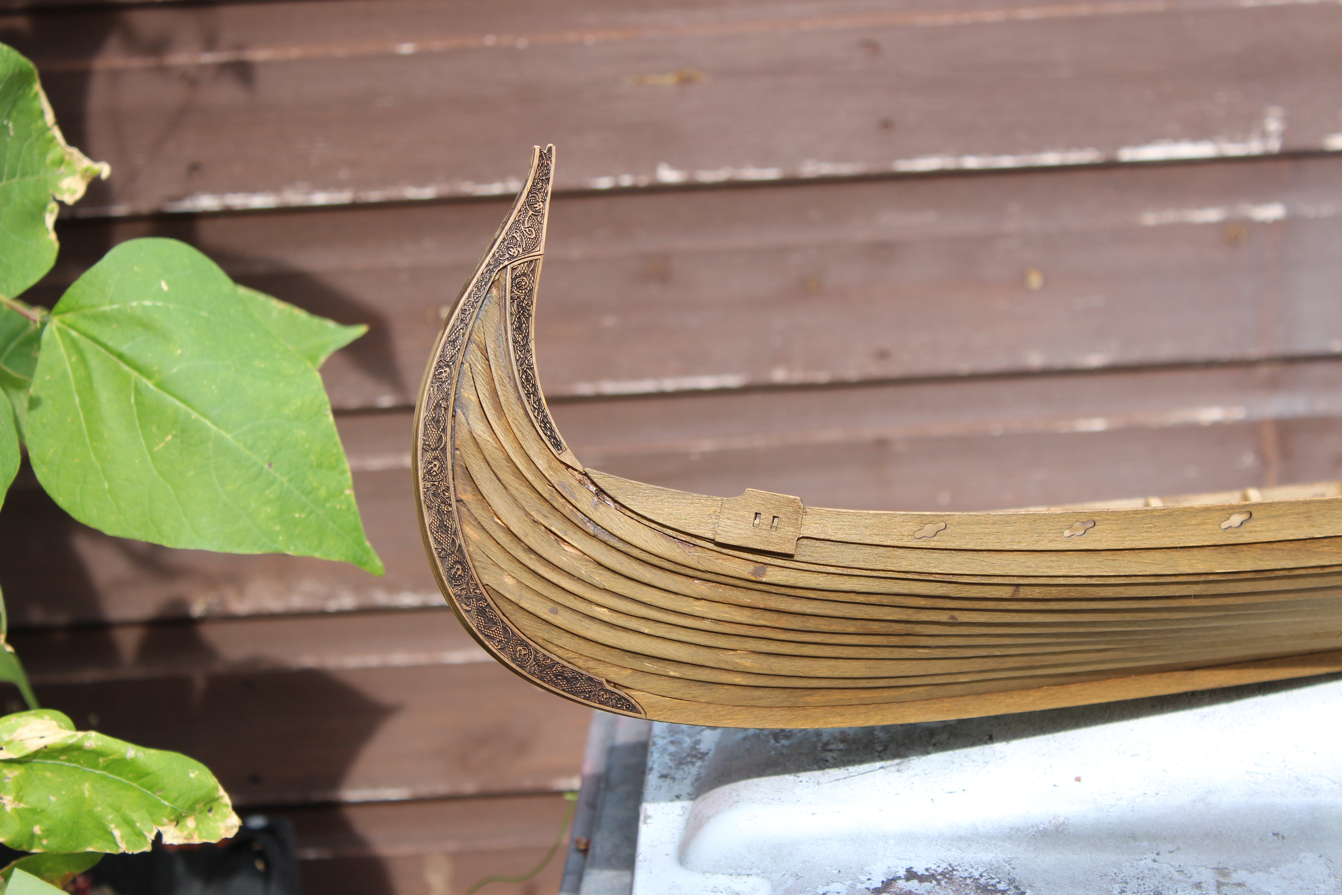

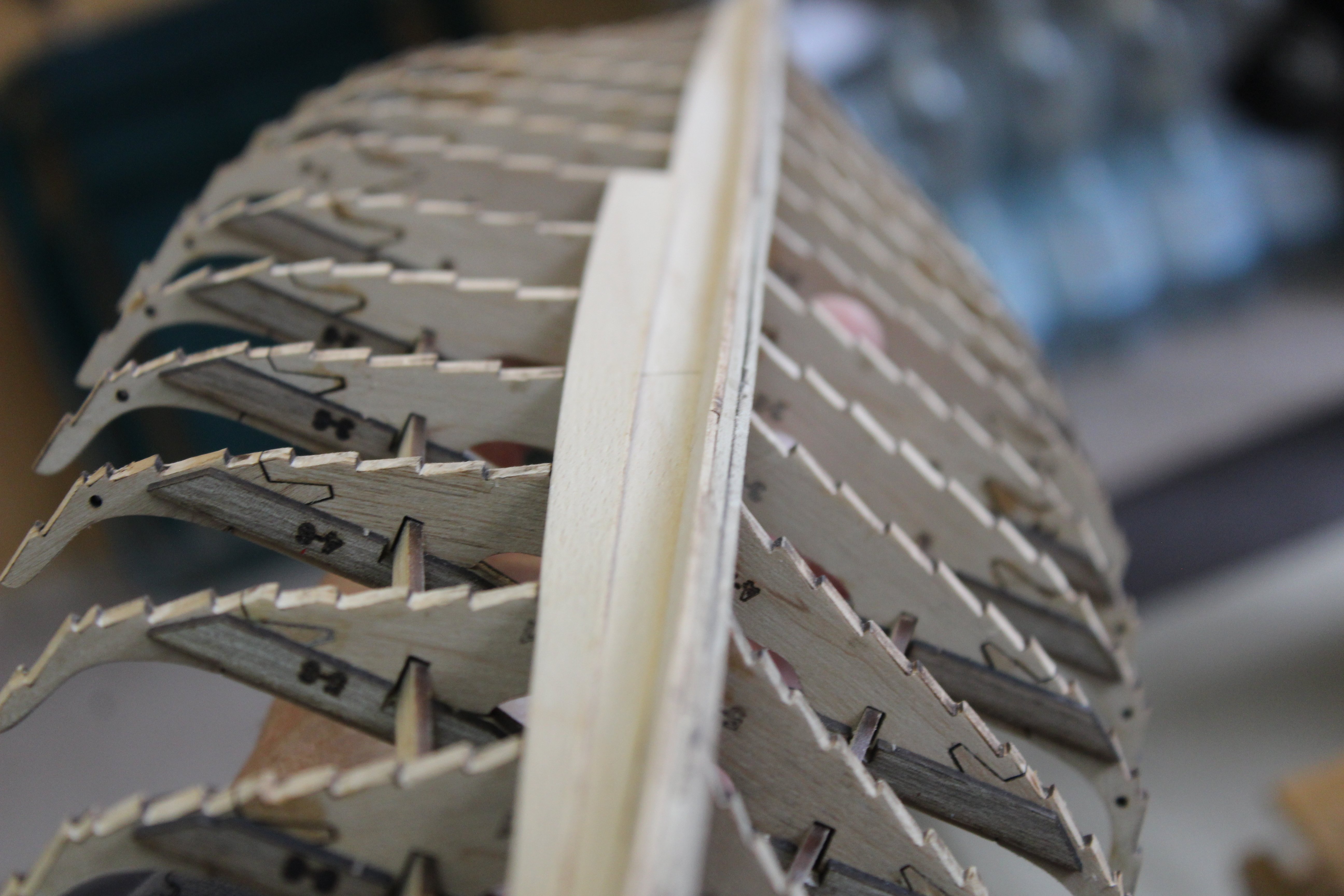

Day 8 Planking

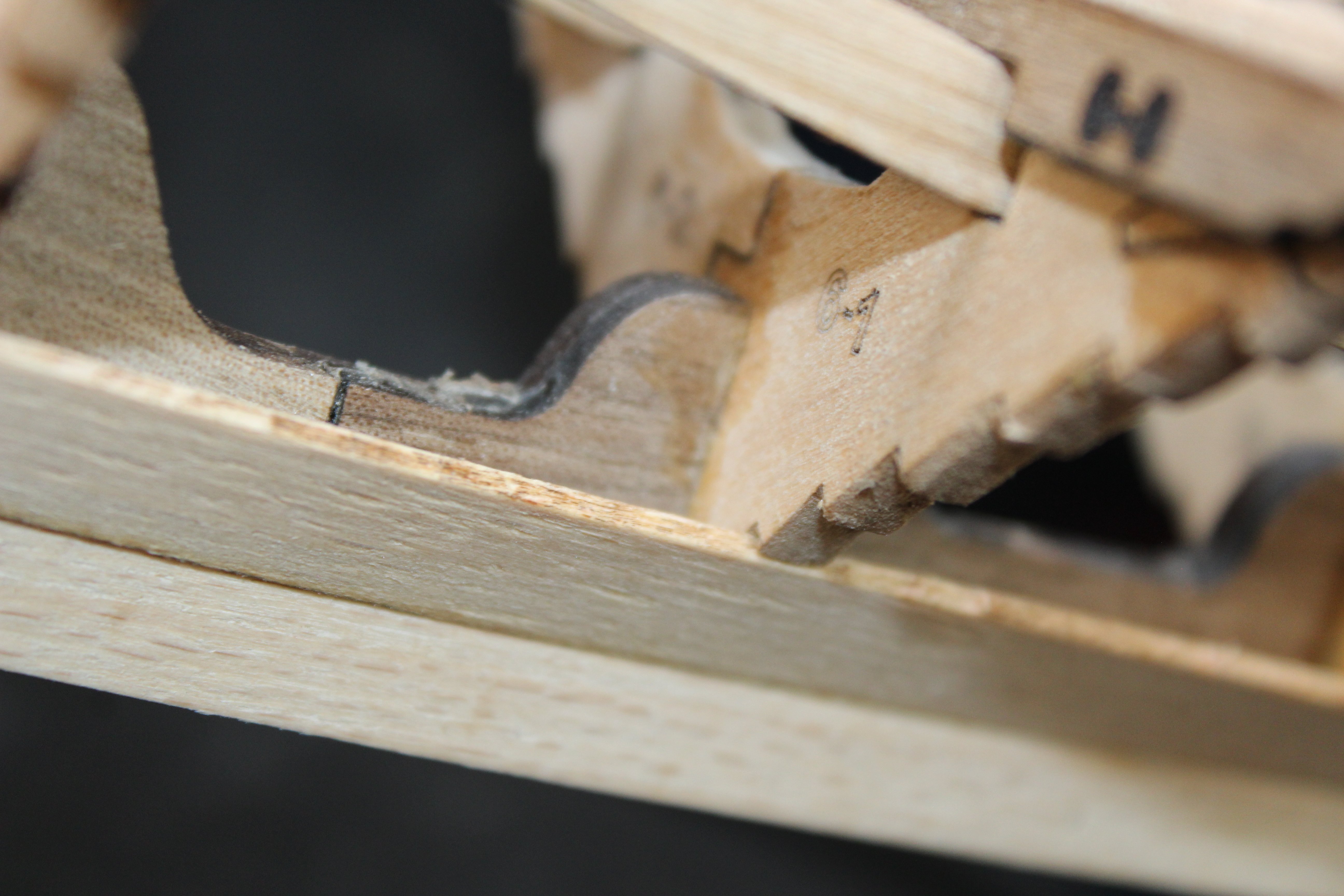

Having never done a clinker build, i was expecting it to be far more difficult than it actually is.
The boards are made up in two halves, sanded then lined up against the rebates on the frames, frame 8 (bow and stern) is not a problem, but does need adjusting each time a run goes in, numbers 9 and ten, don't do much other than force the wood in the right direction
Before starting a temp piece is put in, and removed at a later date, all the boards then butt up against this, it also extends along the keel
board row number 1
row 2, and so on
i am finding the boards very dry and brittle at times, especially around the kerf joints, the whole assu will be stained so will experiment on best way to fill, and ensure the stain will take to those repaired areas
Edited by Kevin

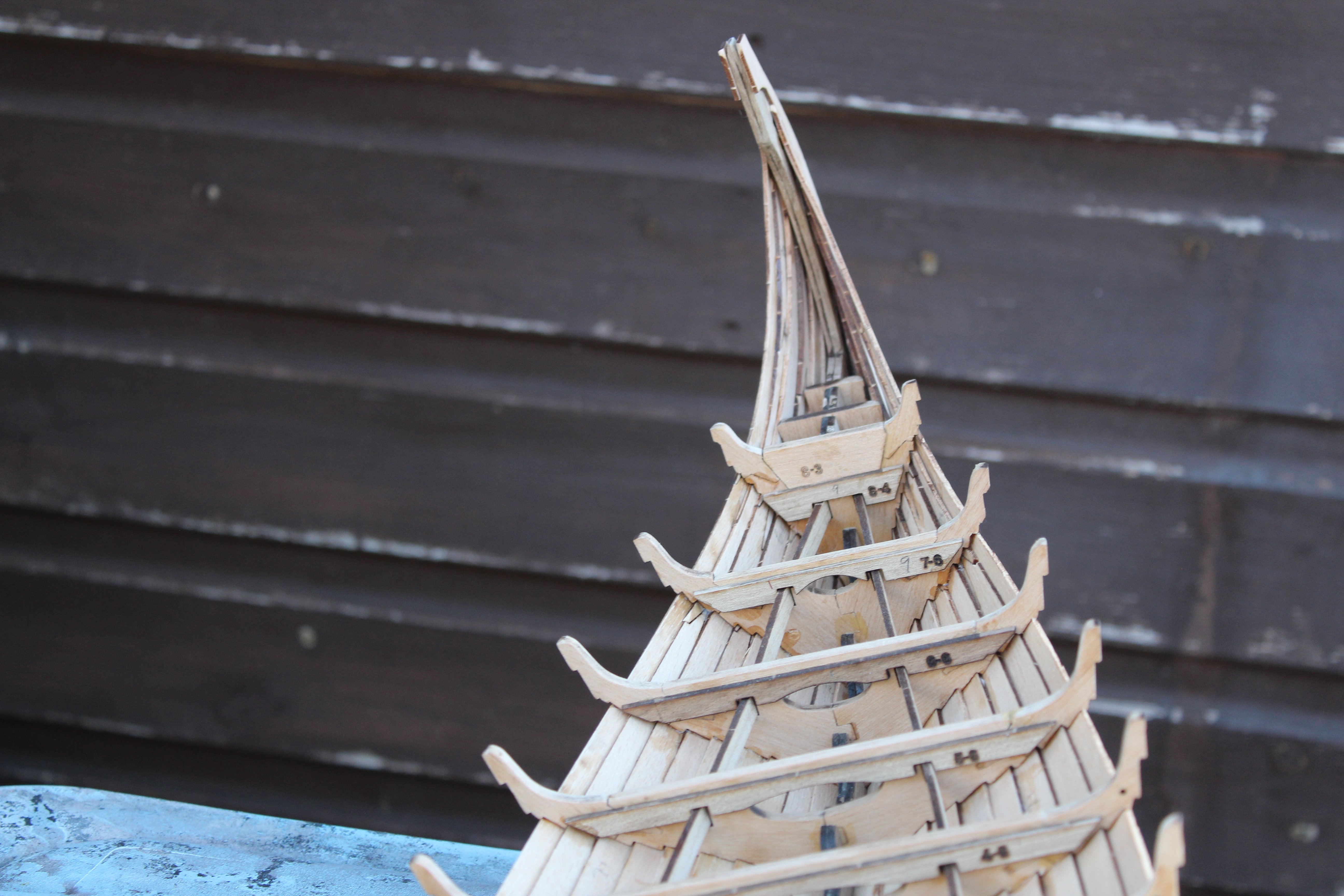

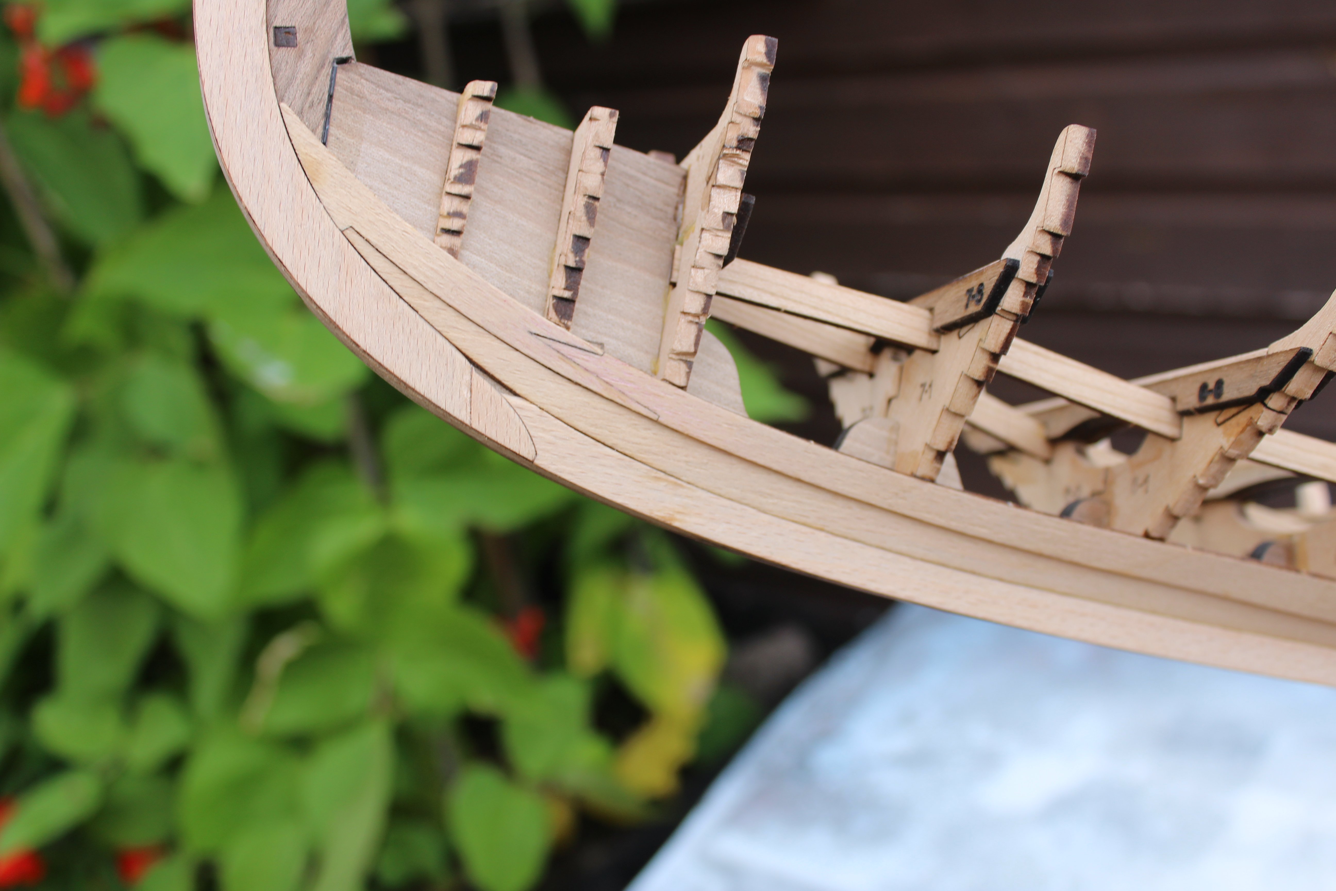

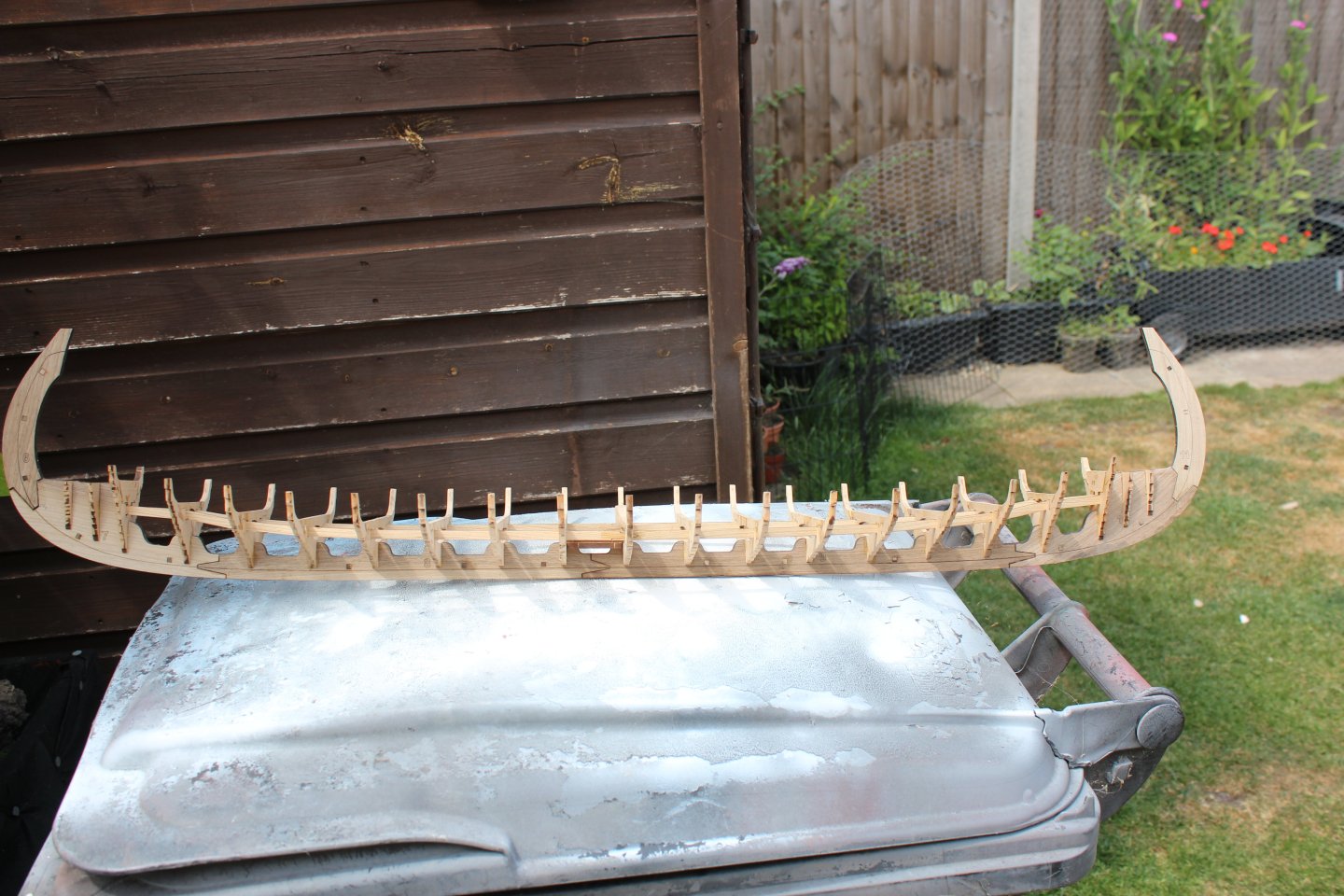

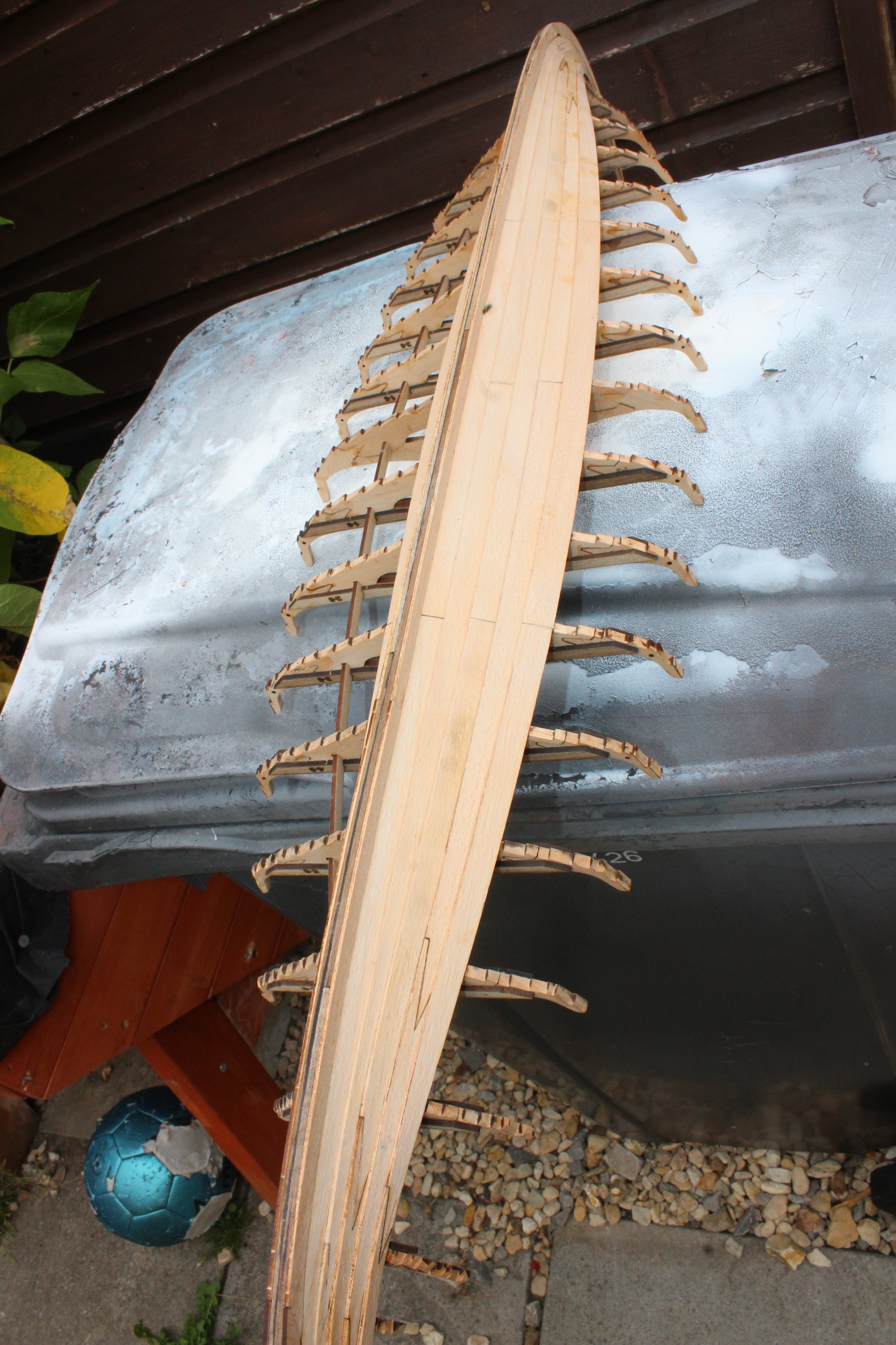

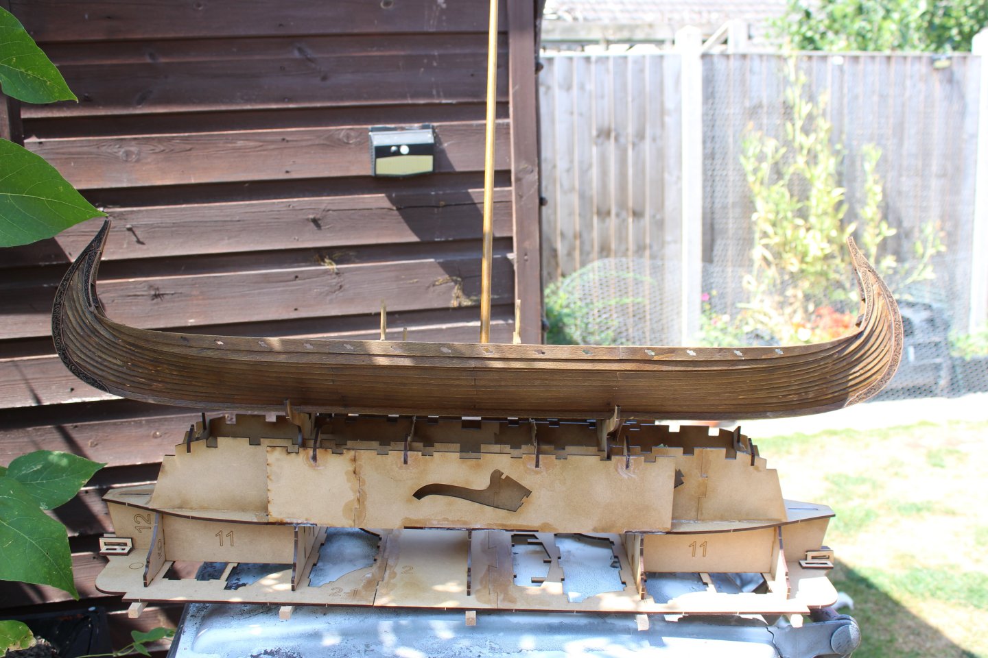

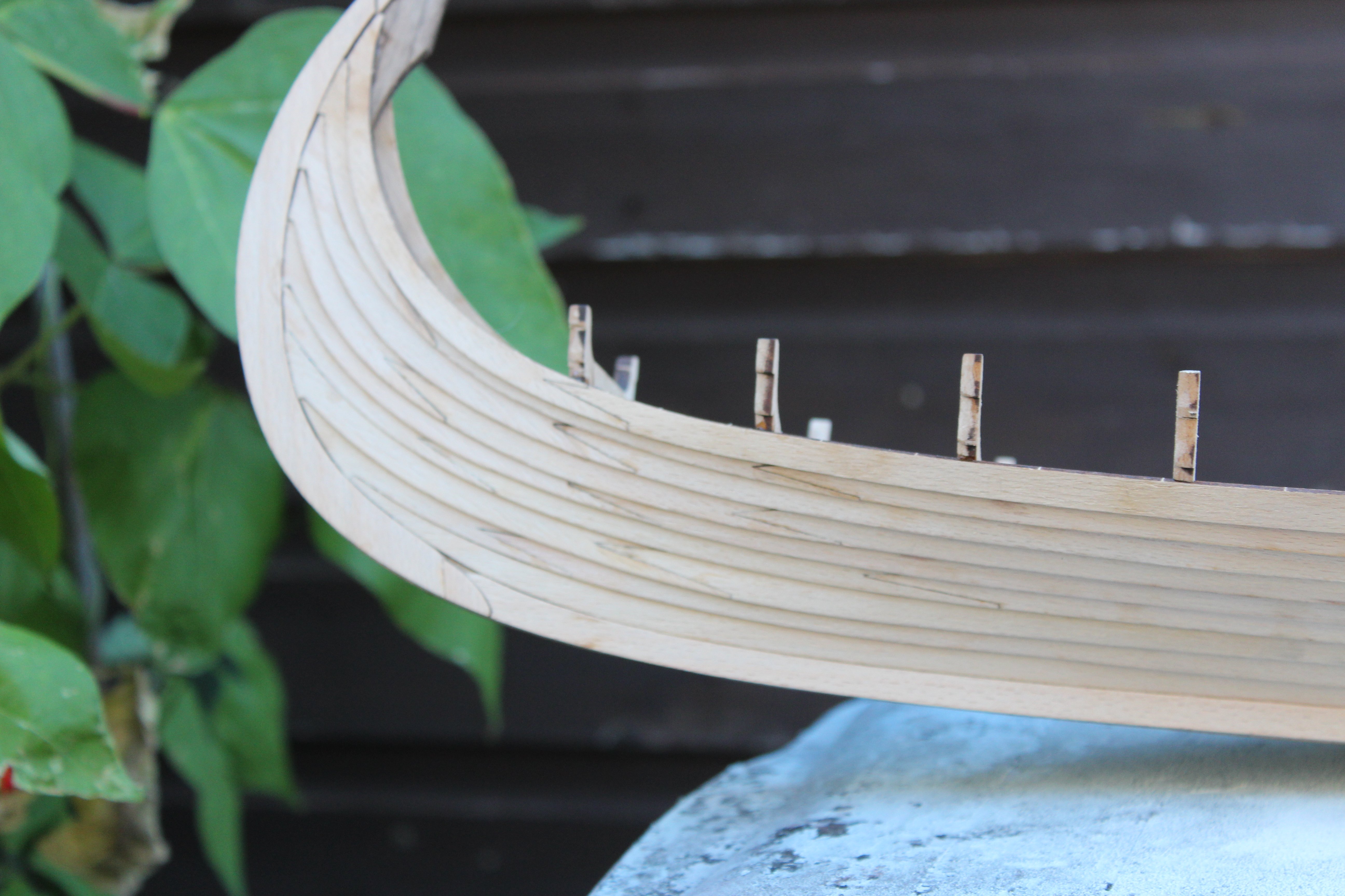

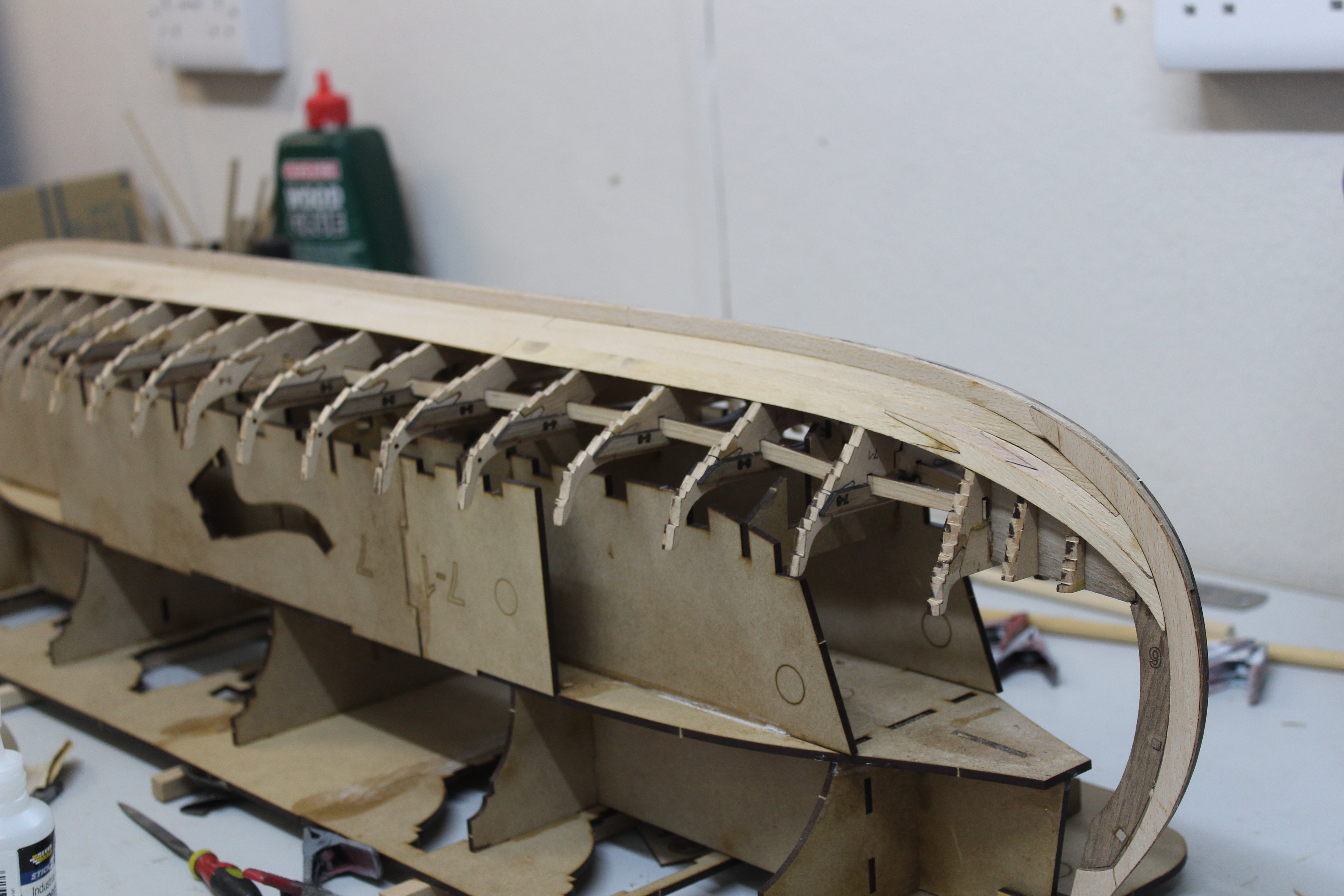

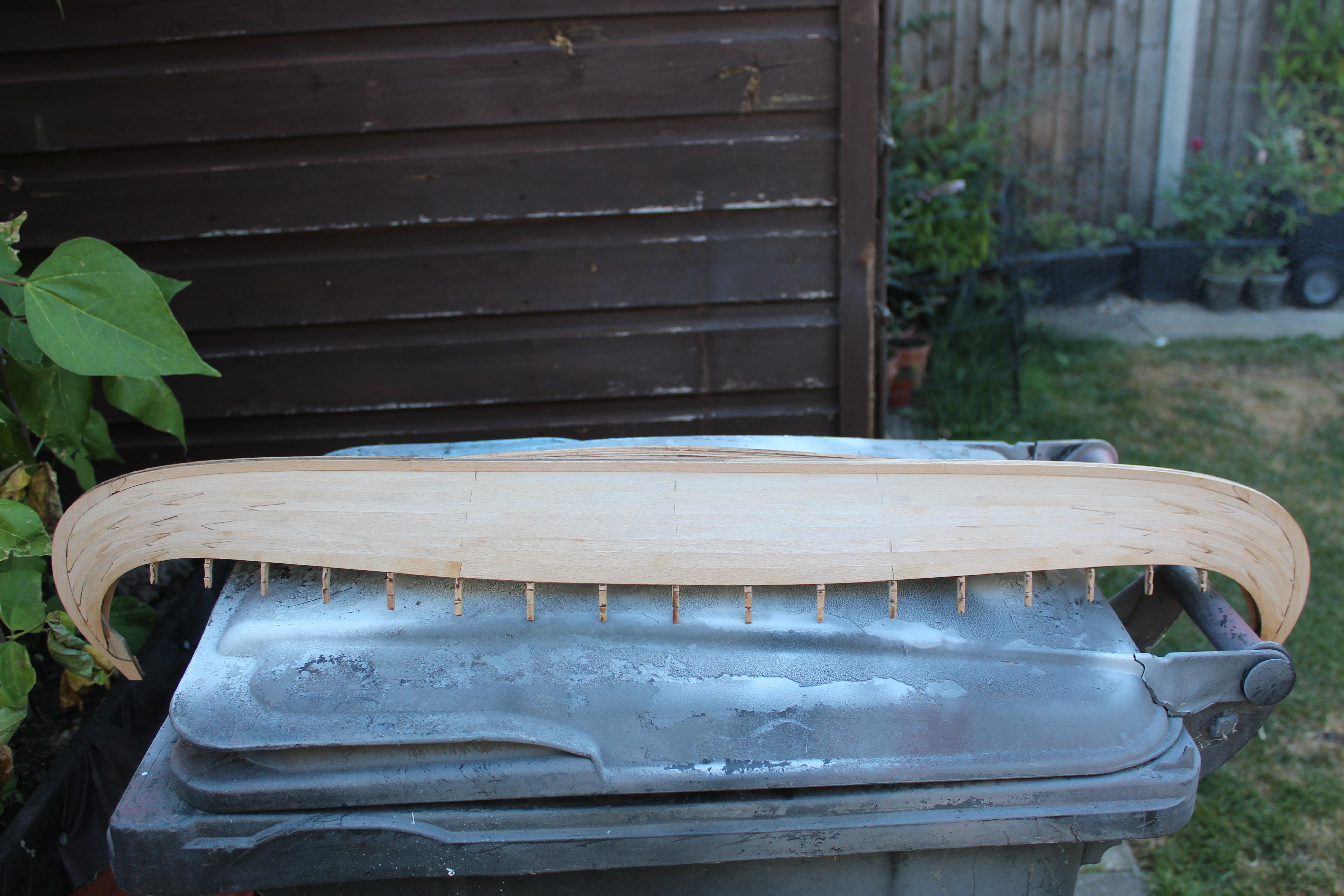

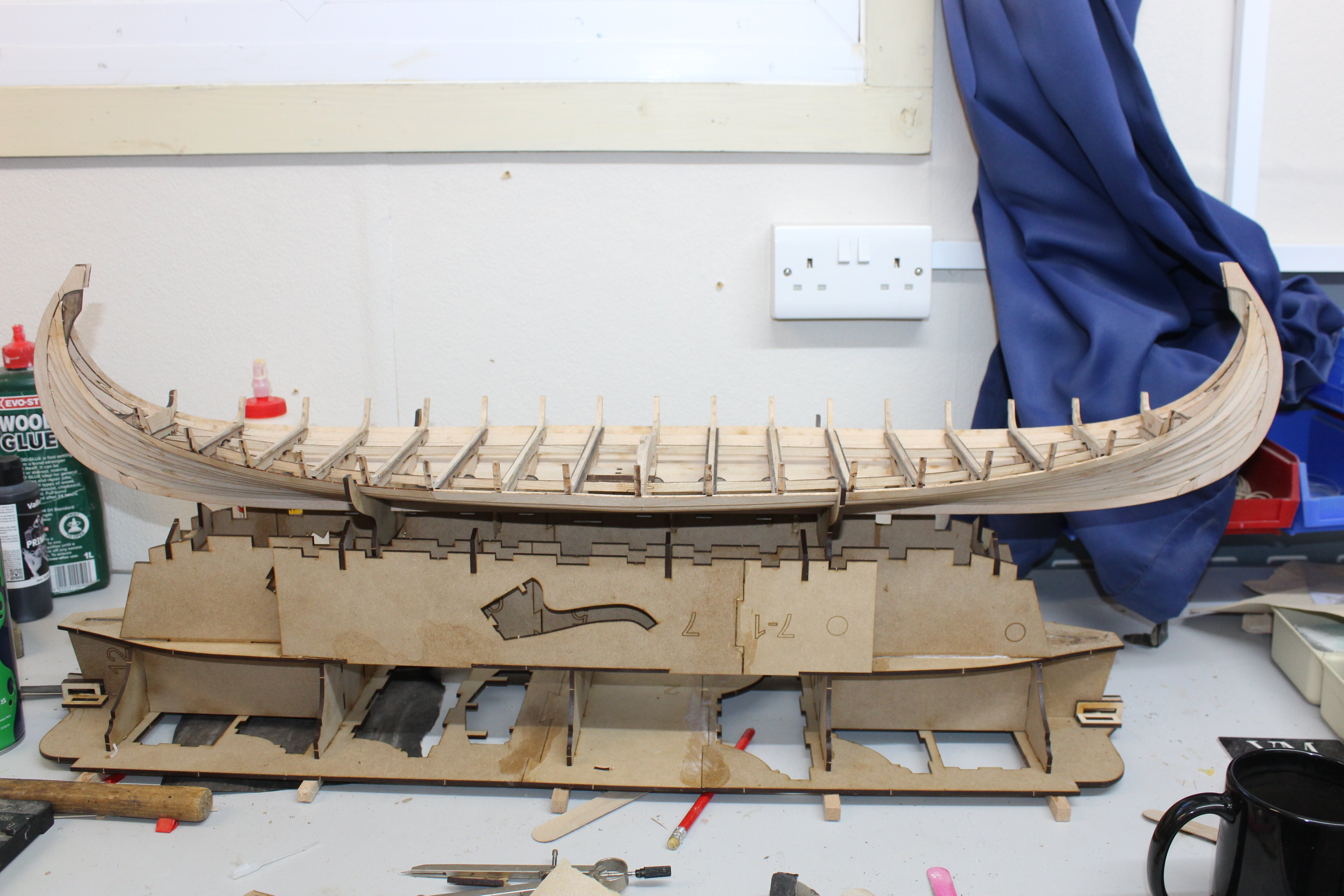

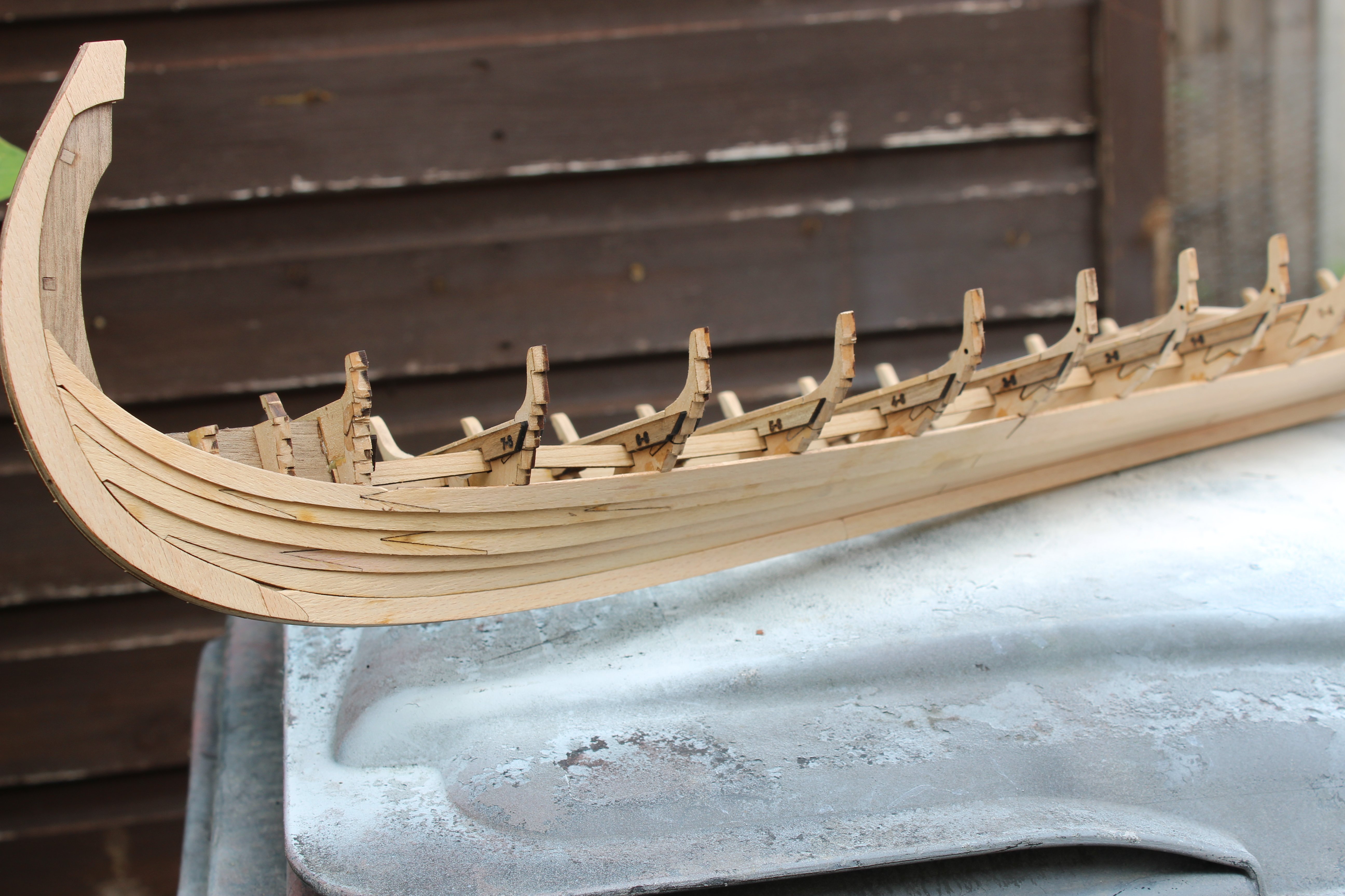

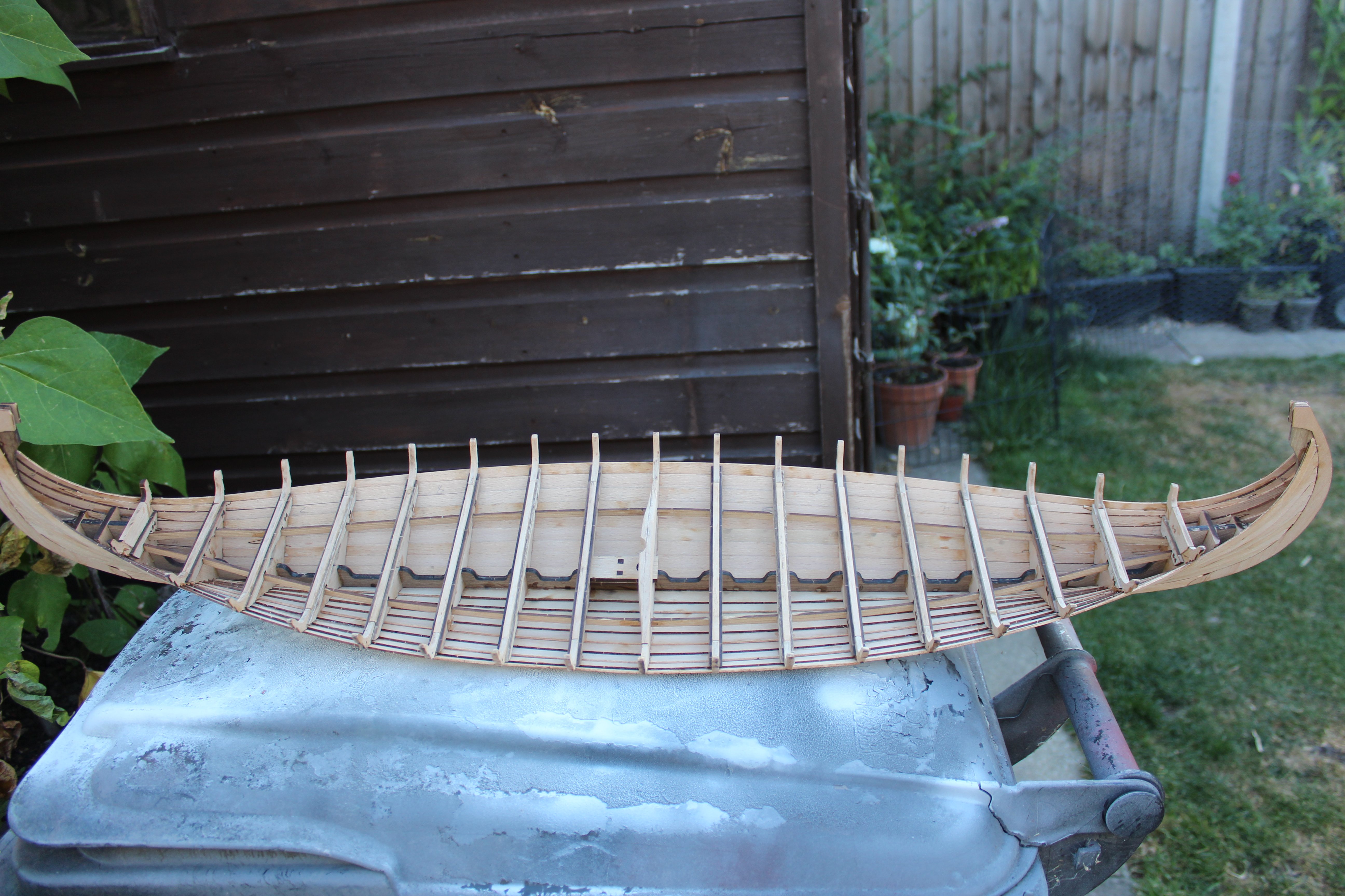

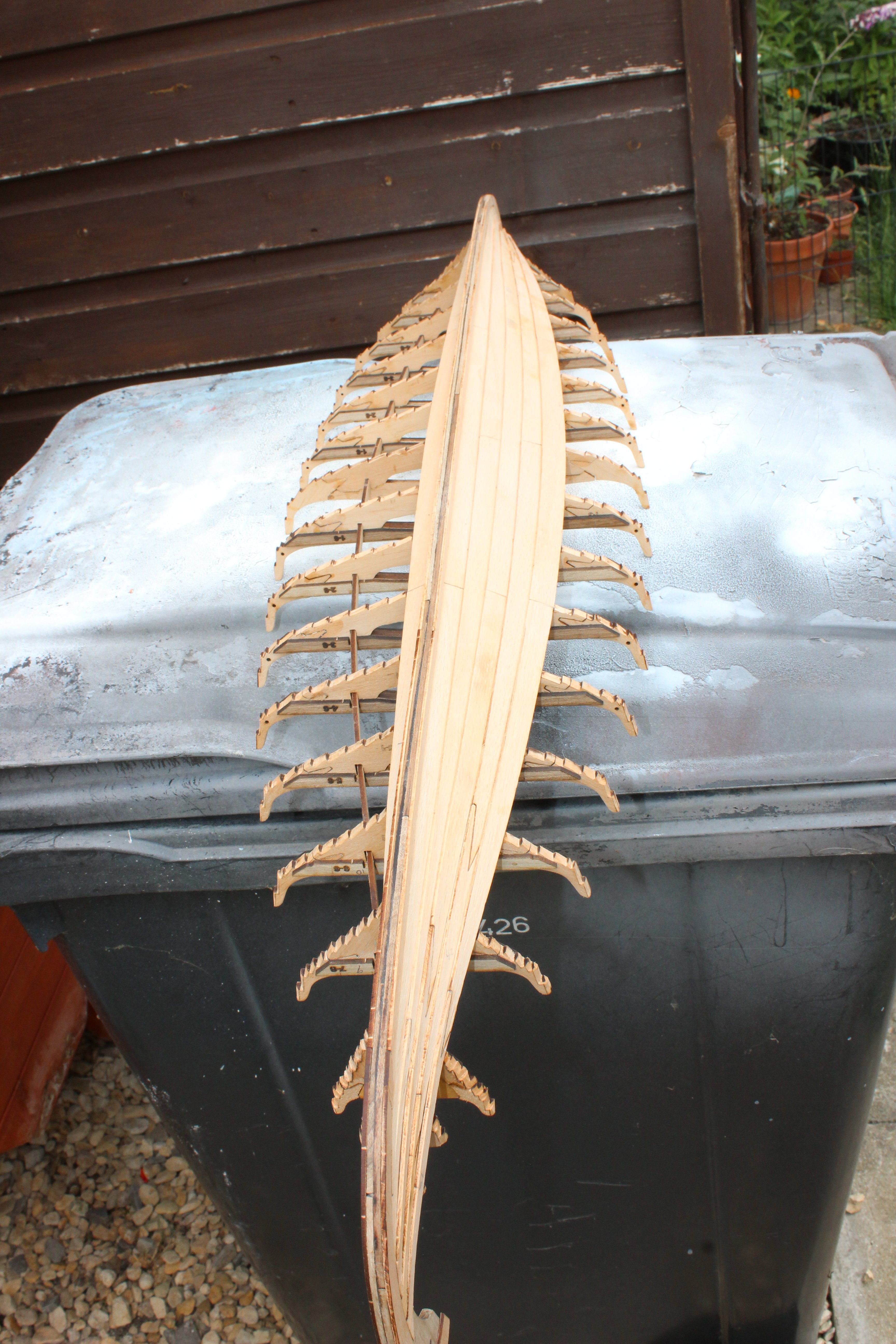

good morning everyone

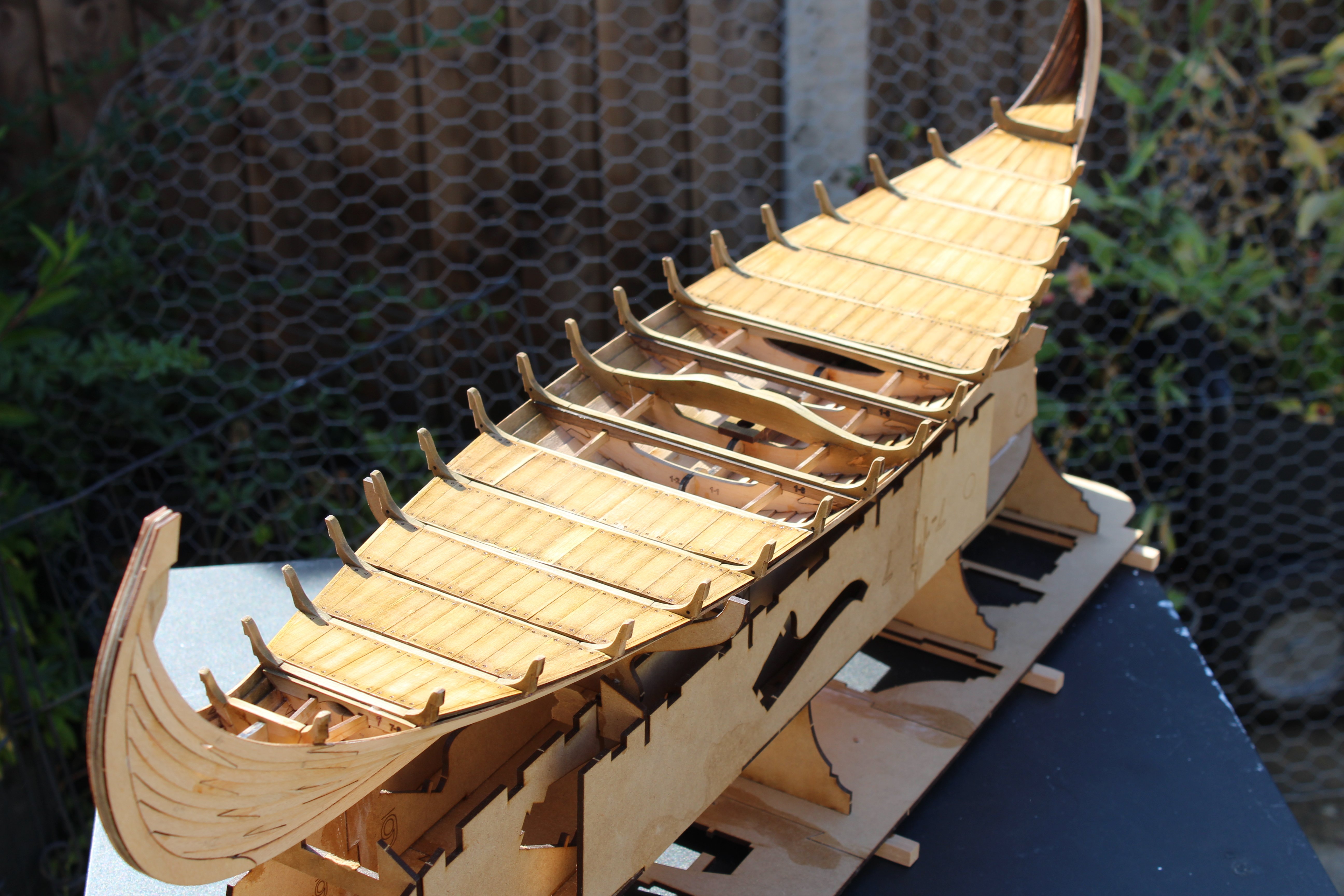

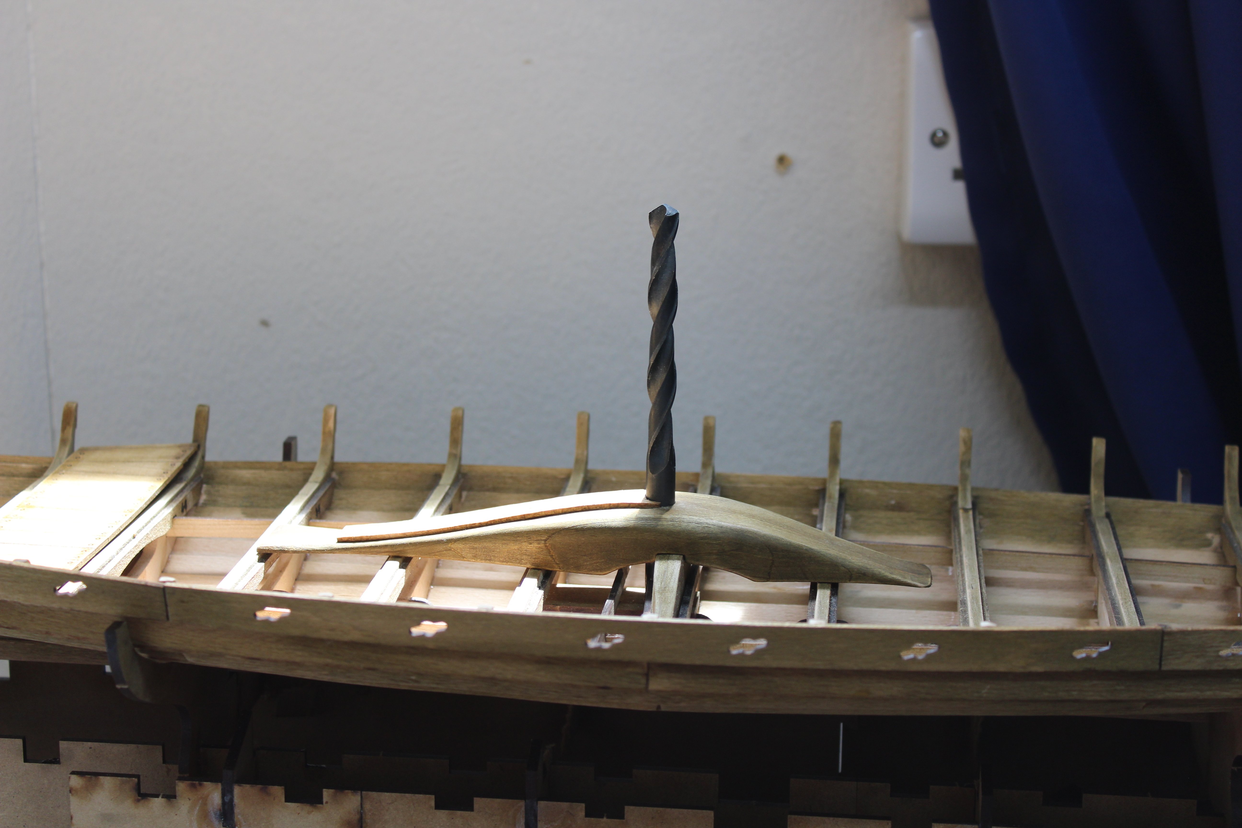

took the build upto deck level, which is the height of plank 9
IMG_4037.thumb.JPG.8299dec057e4c4ab75b0ff6b5ff66cbe.JPGIMG_4038.thumb.JPG.b6afb9dfaea4ba7aaf6b4c333e3528d3.JPGIMG_4039.thumb.JPG.8c679a0940ef874798ddc7f18963f94b.JPGIMG_4040.thumb.JPG.c9eb75b8c49b4e729b032b99364f06e4.JPGIMG_4042.thumb.JPG.2f7d073df831088e65b99e4f626a22bd.JPGIMG_4043.thumb.JPG.3f0f872d9345cea15b8f87dd7c87f7c7.JPGIMG_4044.thumb.JPG.1741f9a9a0b1bb249b80cd4364037376.JPG
the frame is adapted again to fit the new keel width.
IMG_4046.thumb.JPG.4932a24ec5c236ffdb6a025aeb6a0a8a.JPGIMG_4048.thumb.JPG.0a7439a70e69e1738d3678bf0b8c1338.JPG

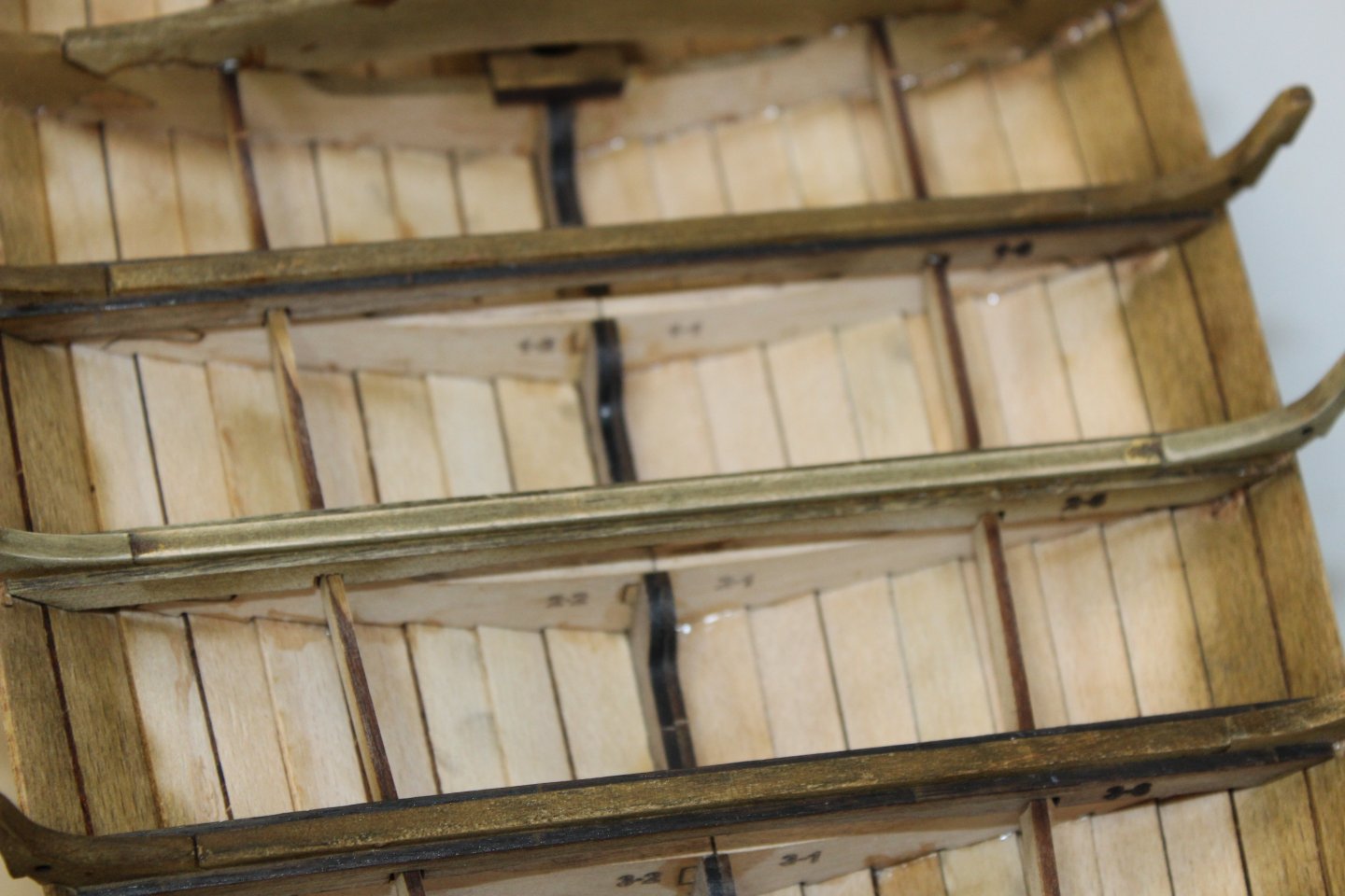

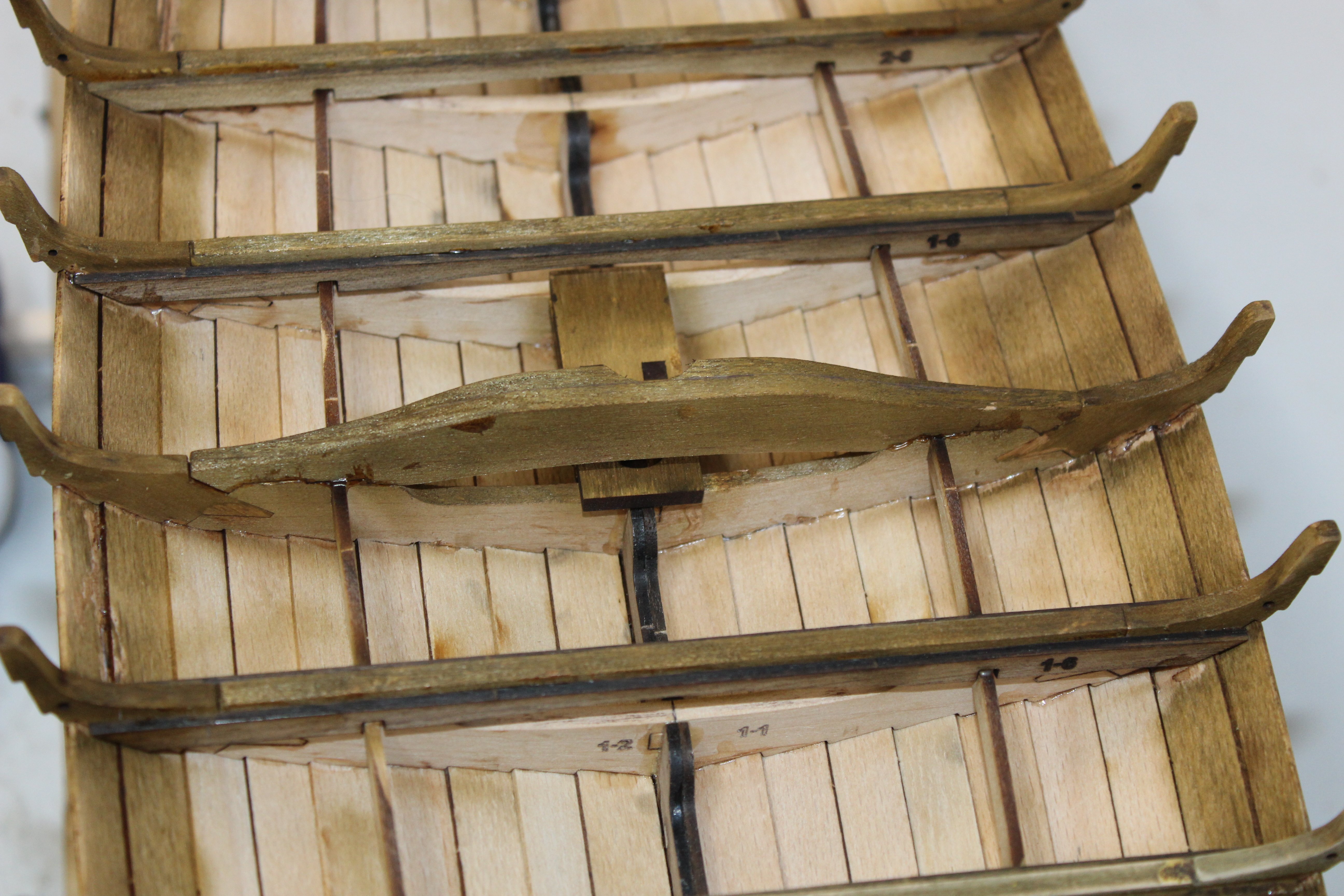

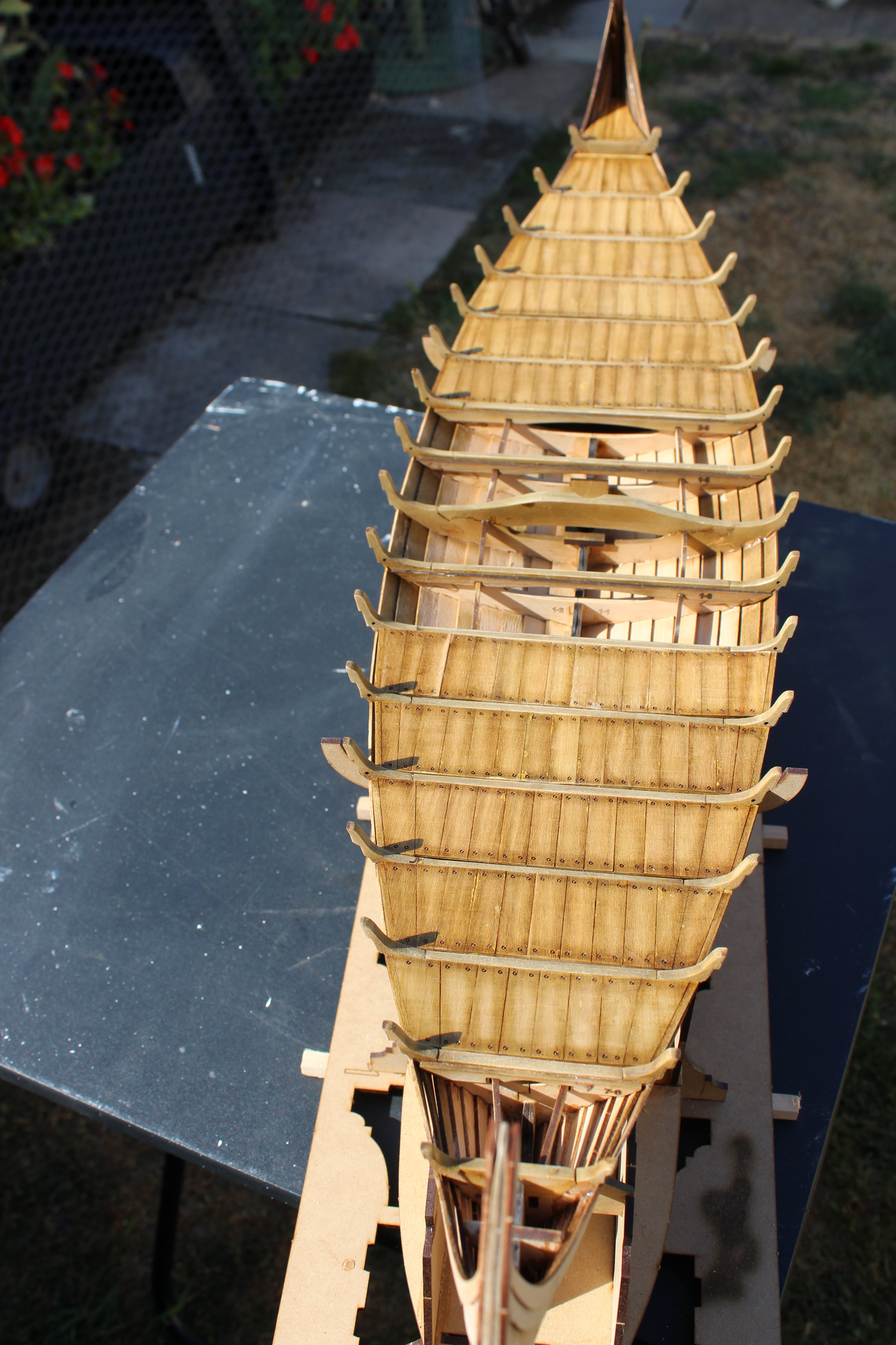

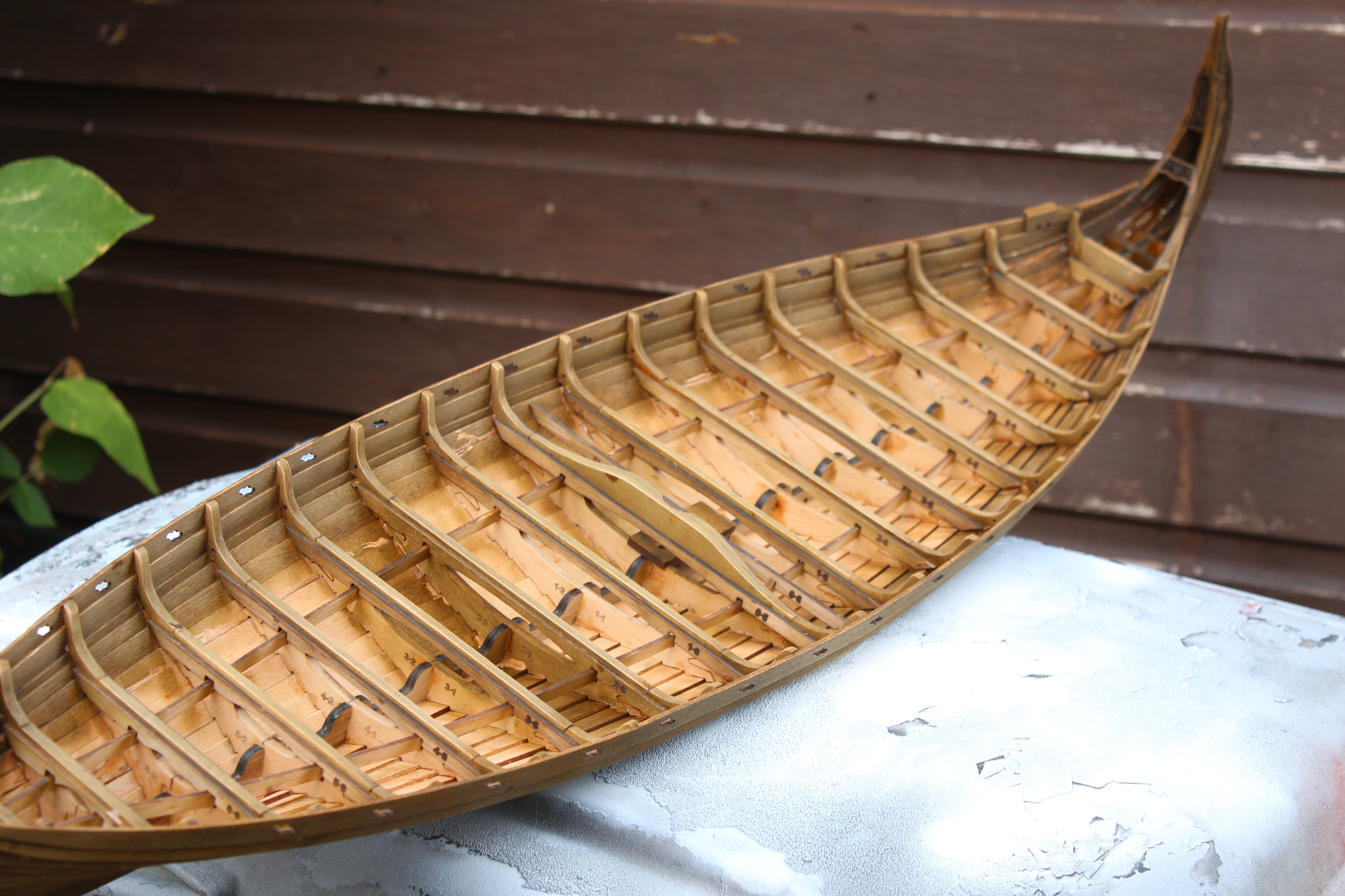

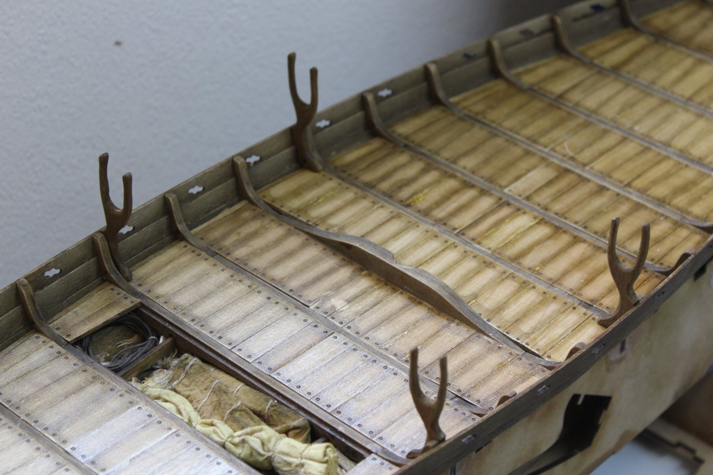

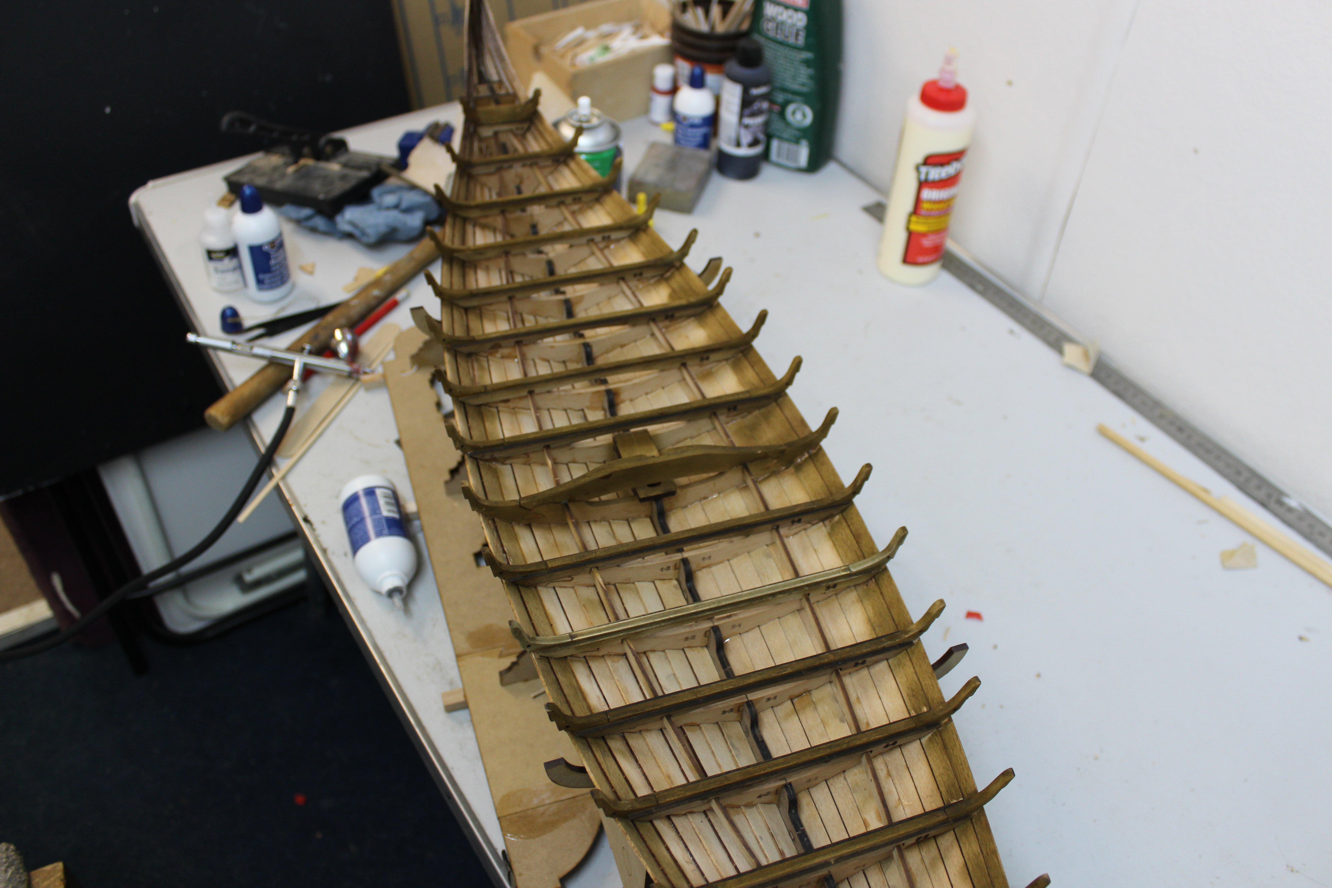

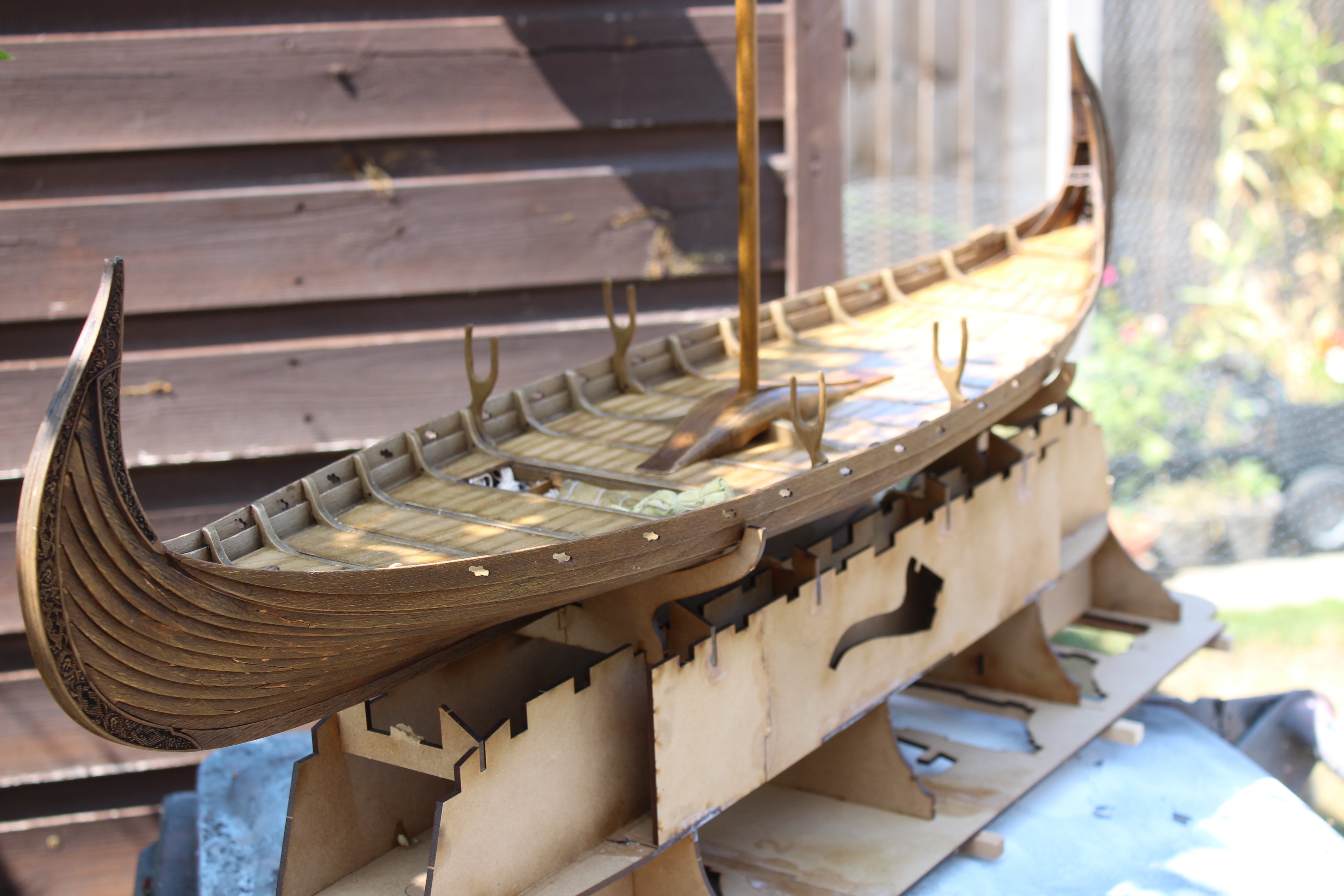

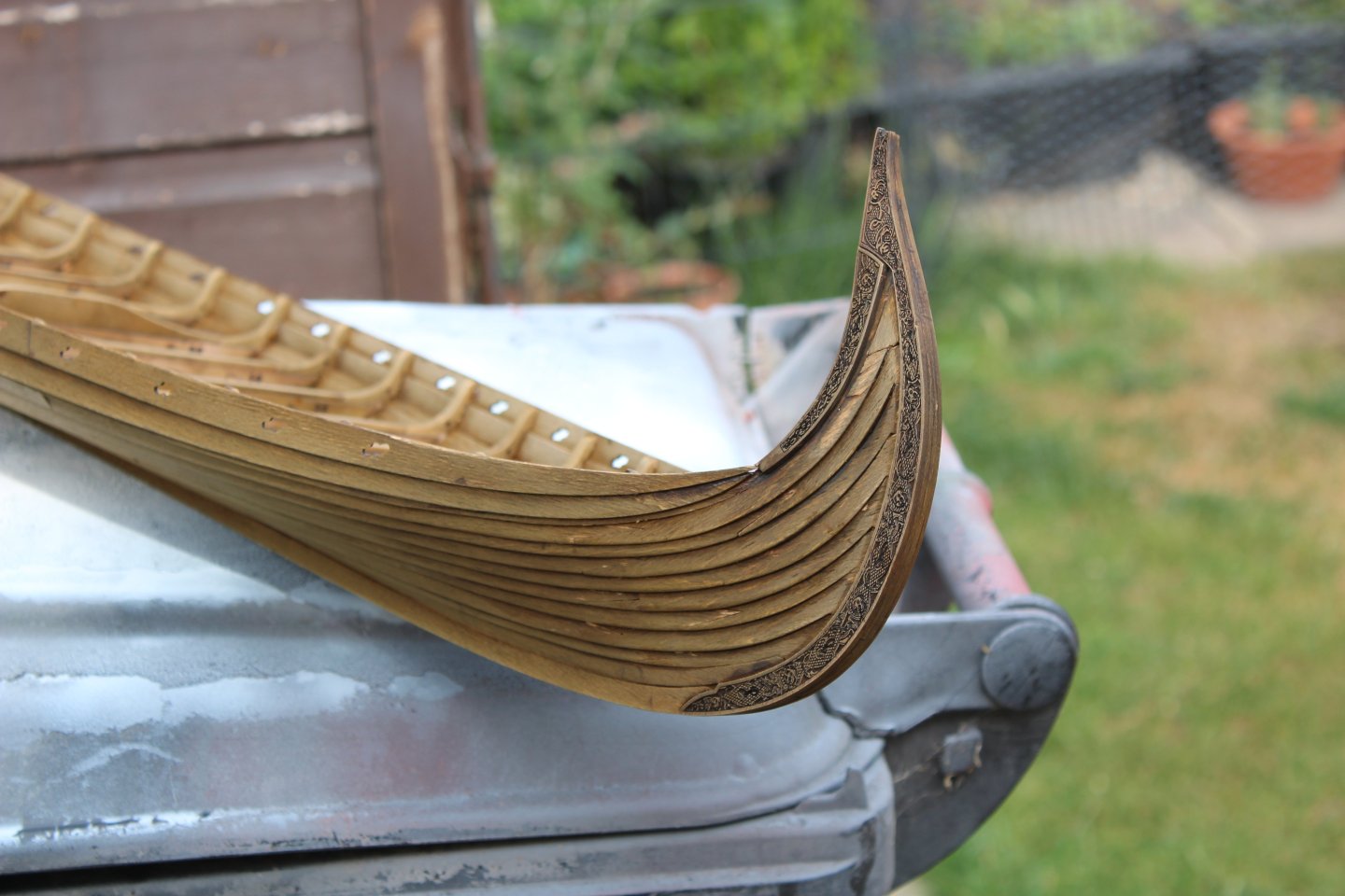

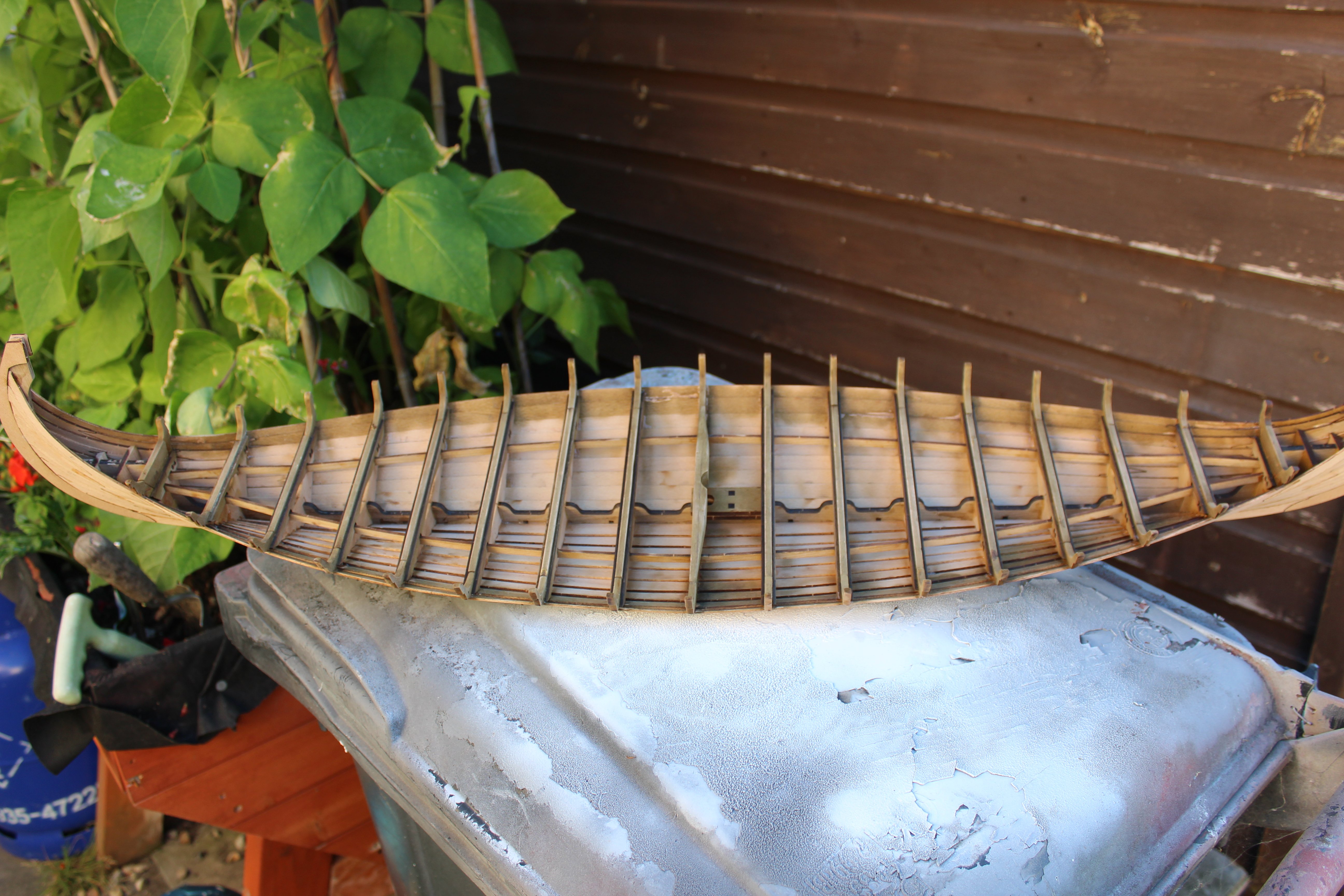

Deck beams - Airbrushing
i would love to have bought the wood dye the Pavel Nikitin uses, but would cost a fortune to order and shipping (about £60), a set is available on one of the market sites, but at the same price, so i purchased a set of OCcre wood dyes, Walnut and Oak
IMG_4052.thumb.JPG.4b69f5bf454c5d71d7246cb0dd122e1b.JPGIMG_4053.thumb.JPG.54237aaa6237bd77d86547f89569084c.JPGIMG_4054.thumb.JPG.0f0f846201c6369f5de4be662e9821a9.JPGIMG_4055.thumb.JPG.0eab1bd4e60bfc17b5ec1c6e01cd7380.JPGIMG_4056.thumb.JPG.ce92f80e5afccc41c0842650181d1ea1.JPG
IMG_4058.thumb.JPG.caa54951bc0189724ff563bedf504d25.JPGIMG_4059.thumb.JPG.680c054d8184e7c1b98c8b38e2356cdd.JPG
Edited by Kevin

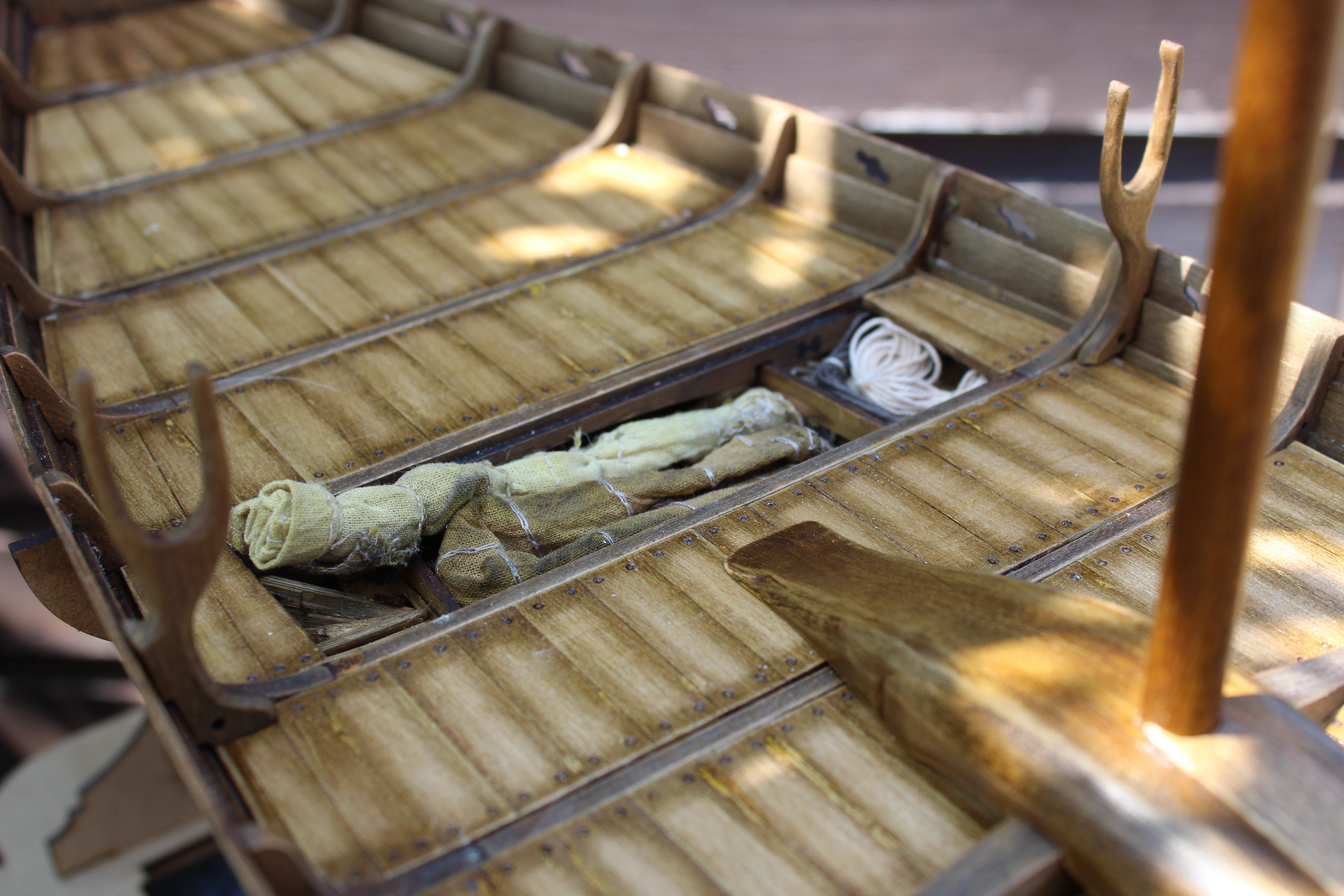

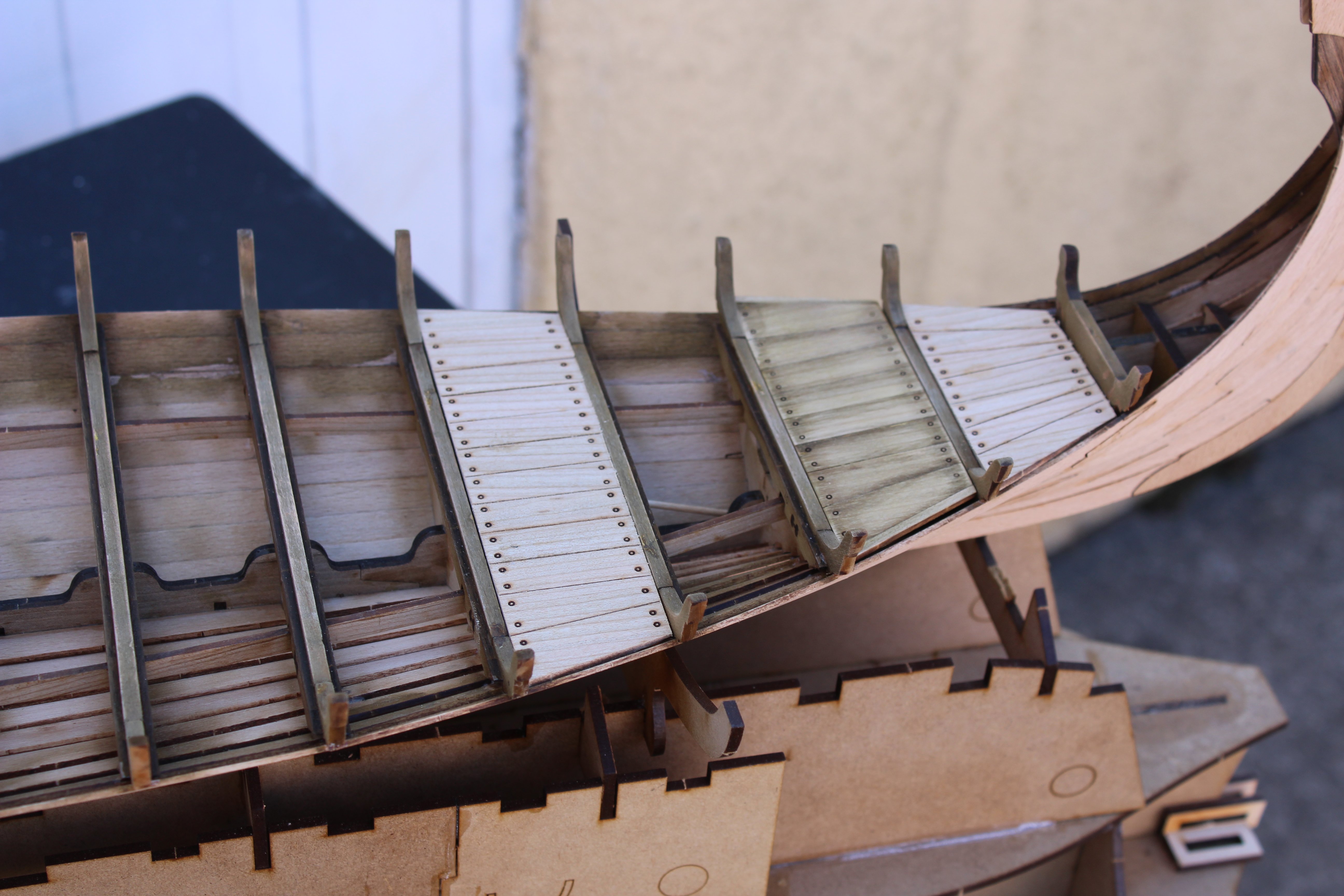

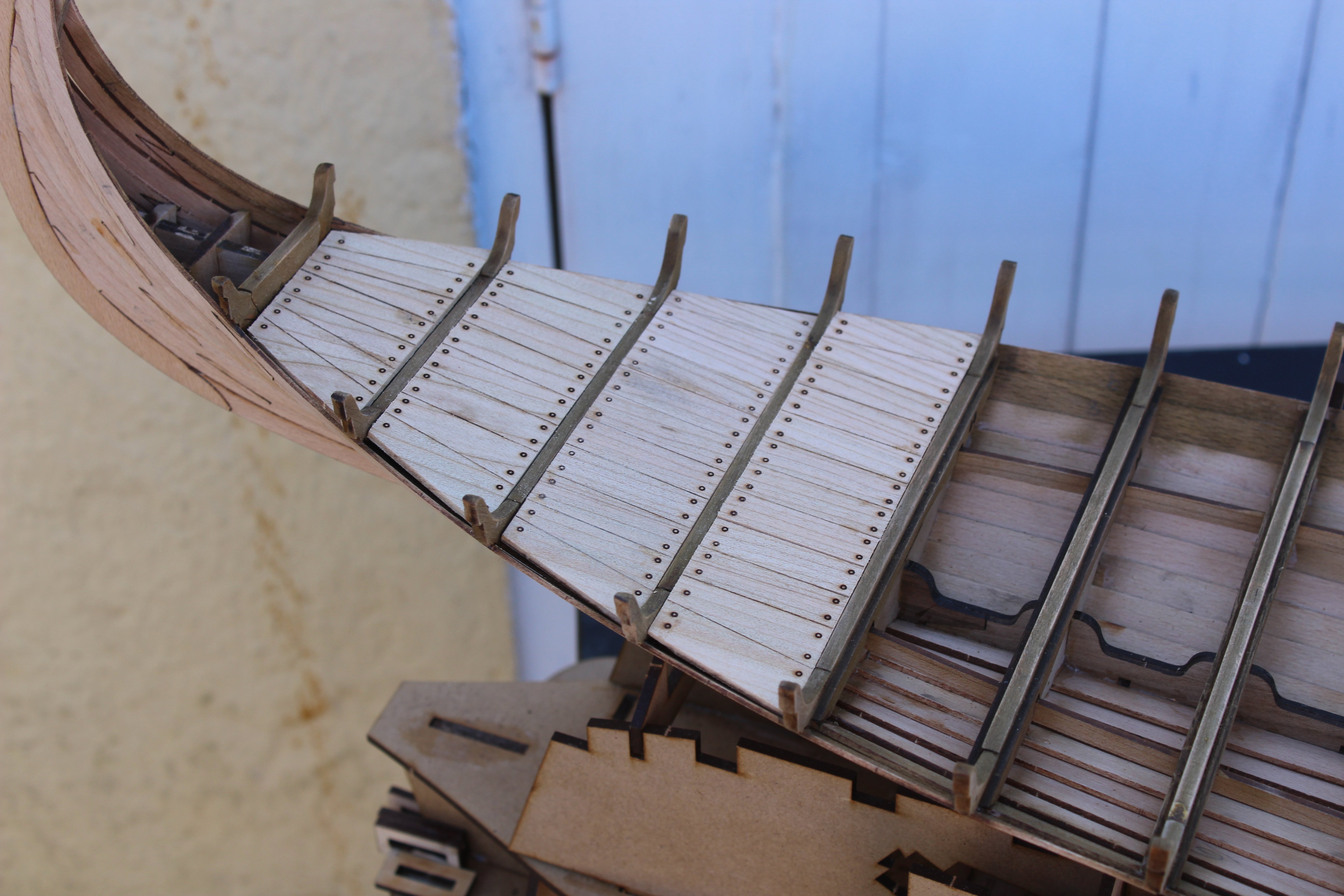

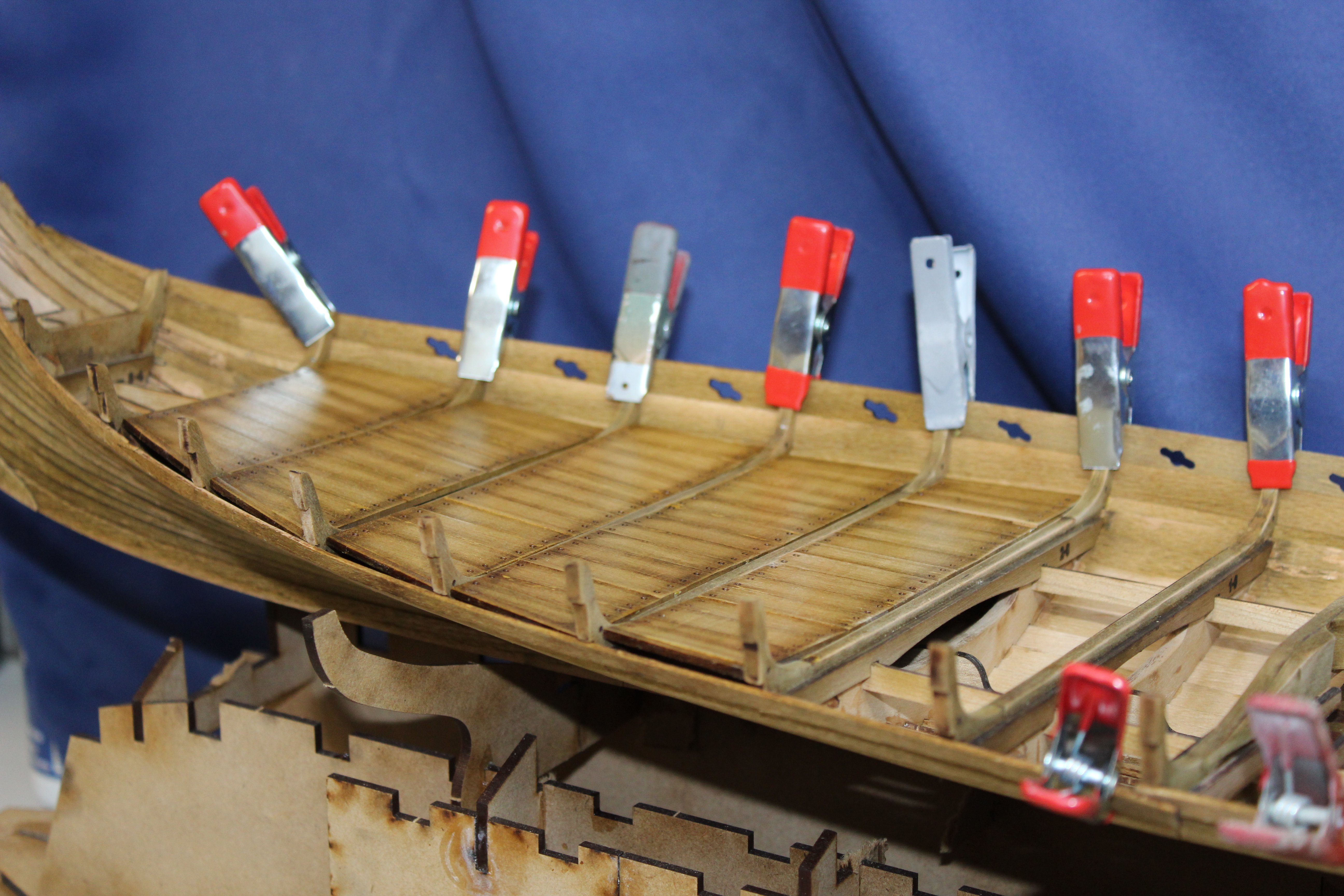

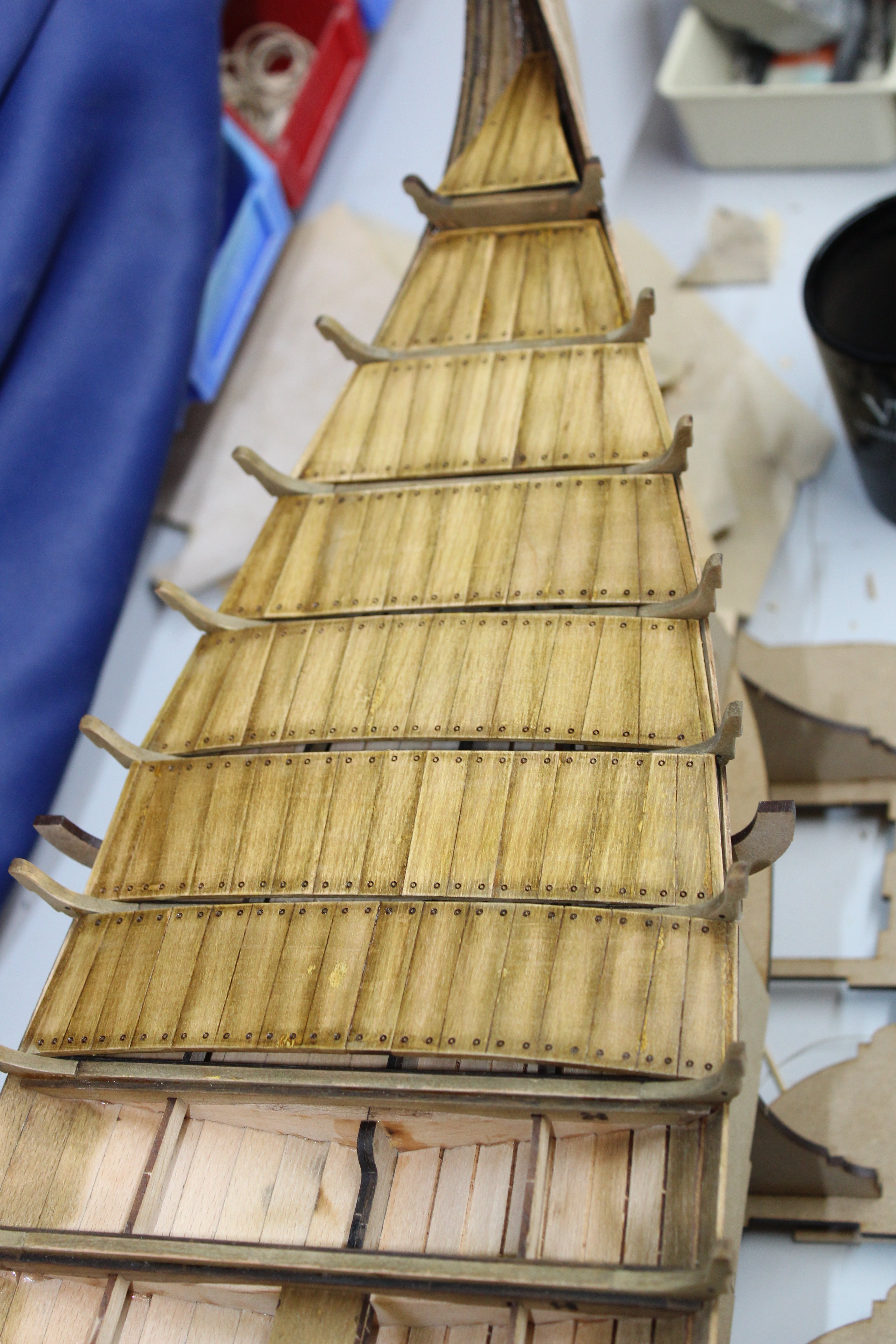

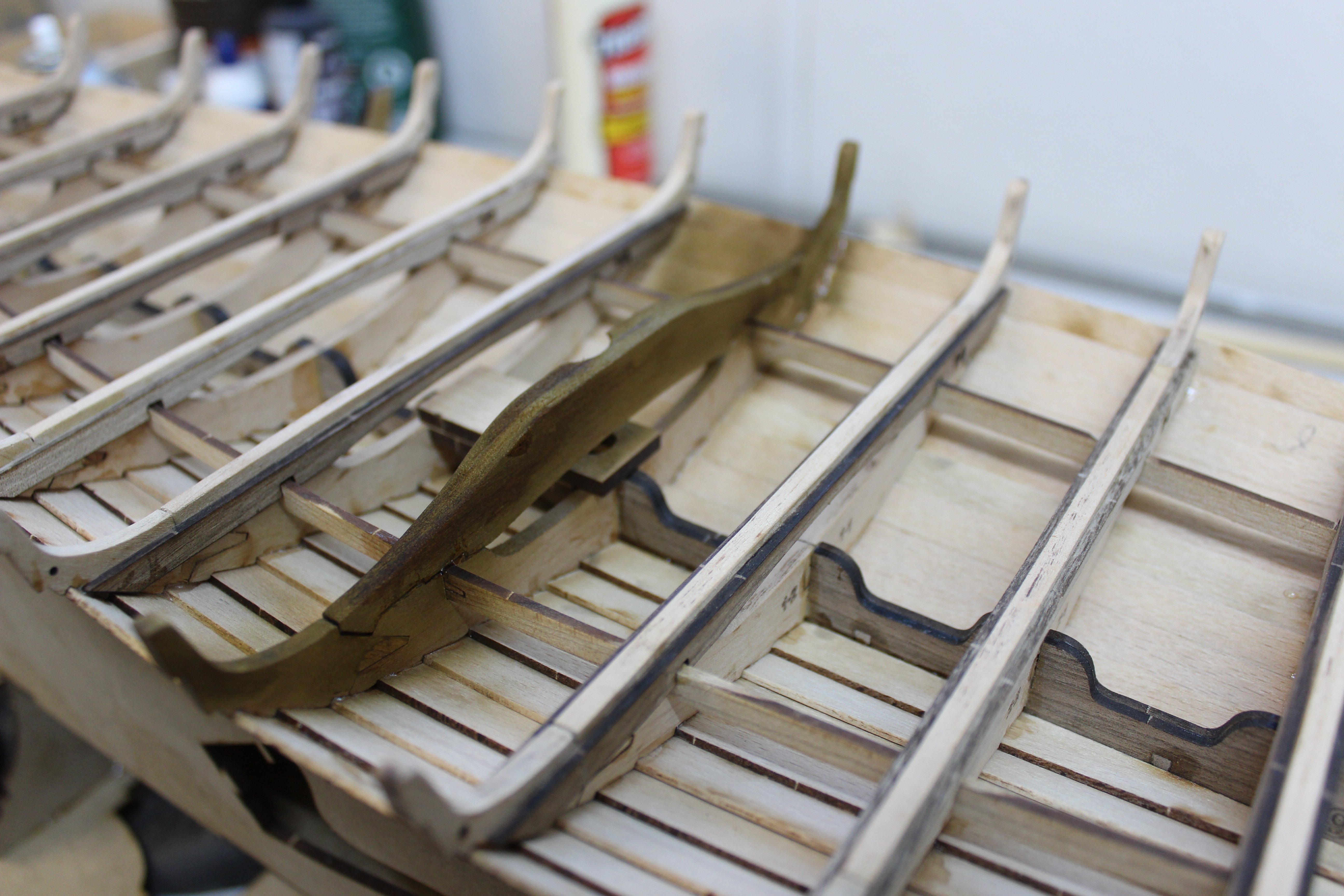

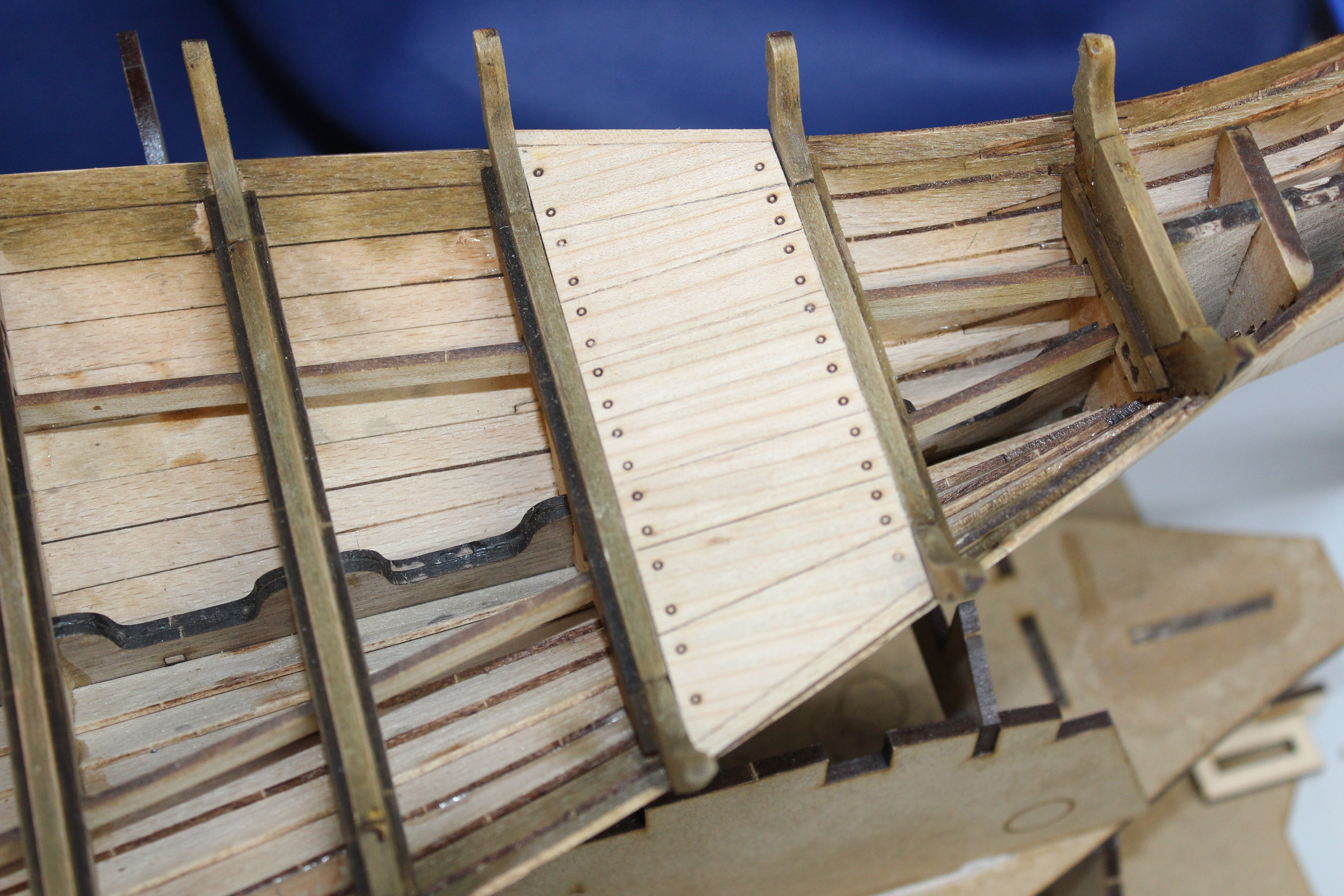

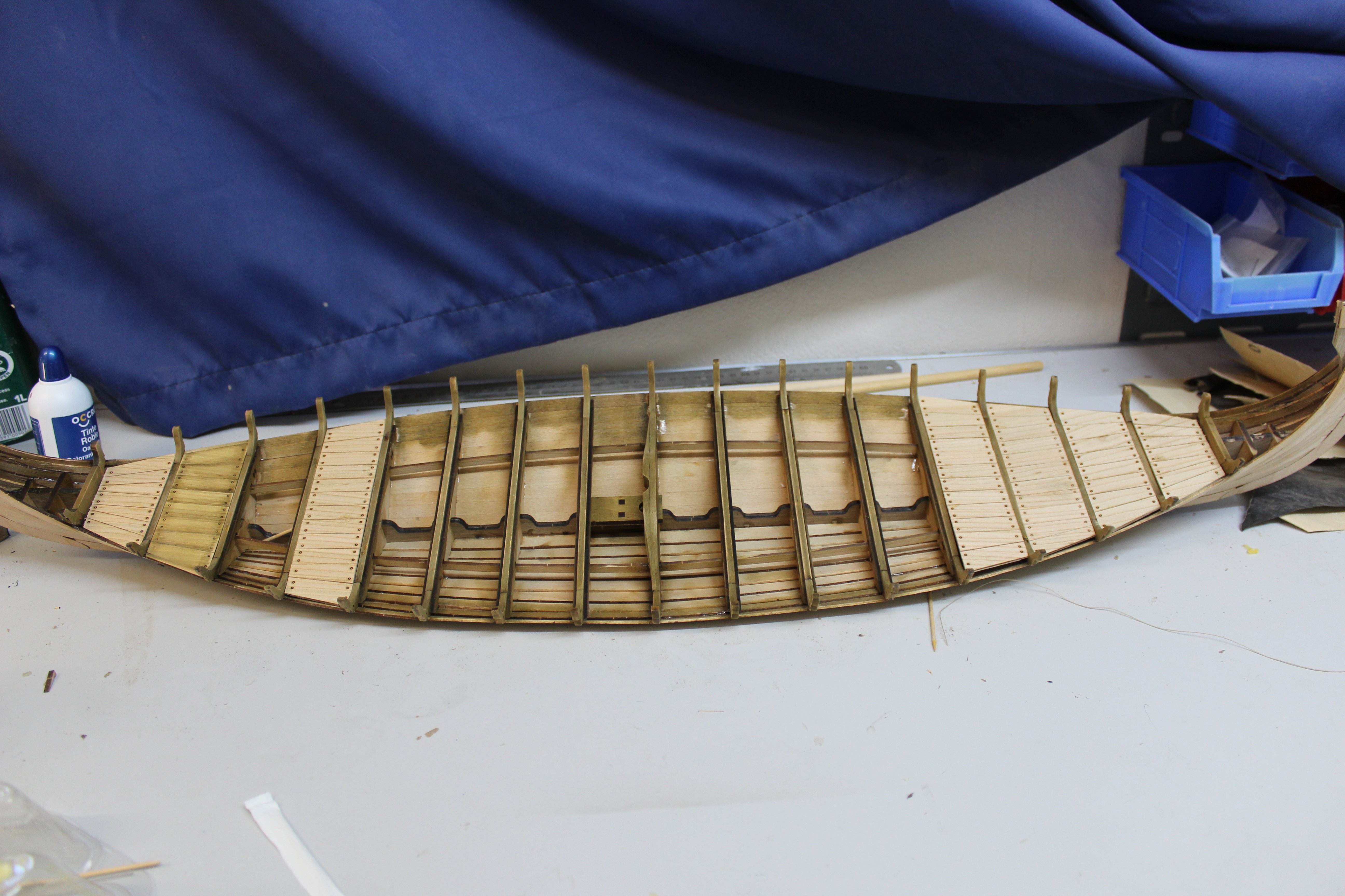

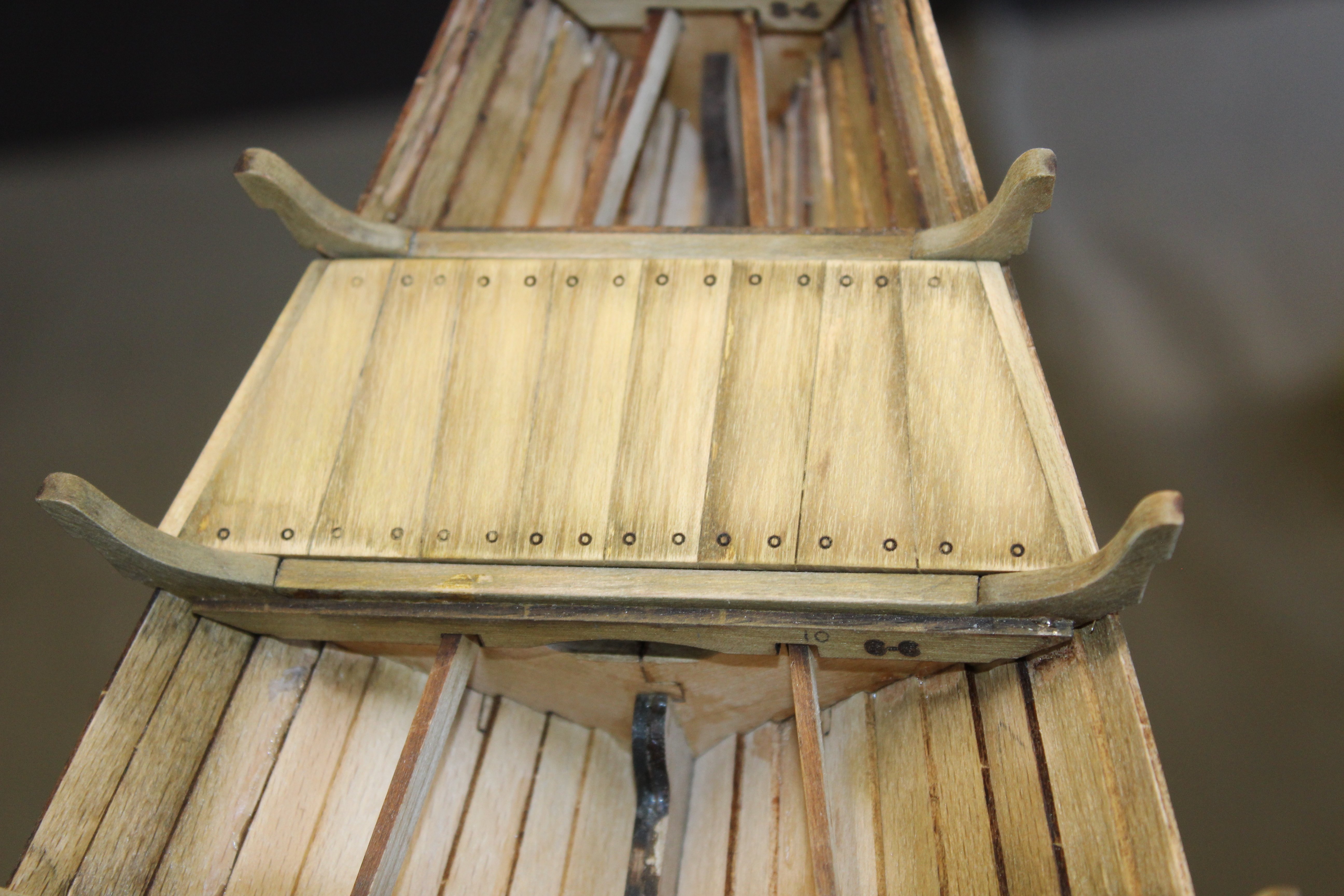

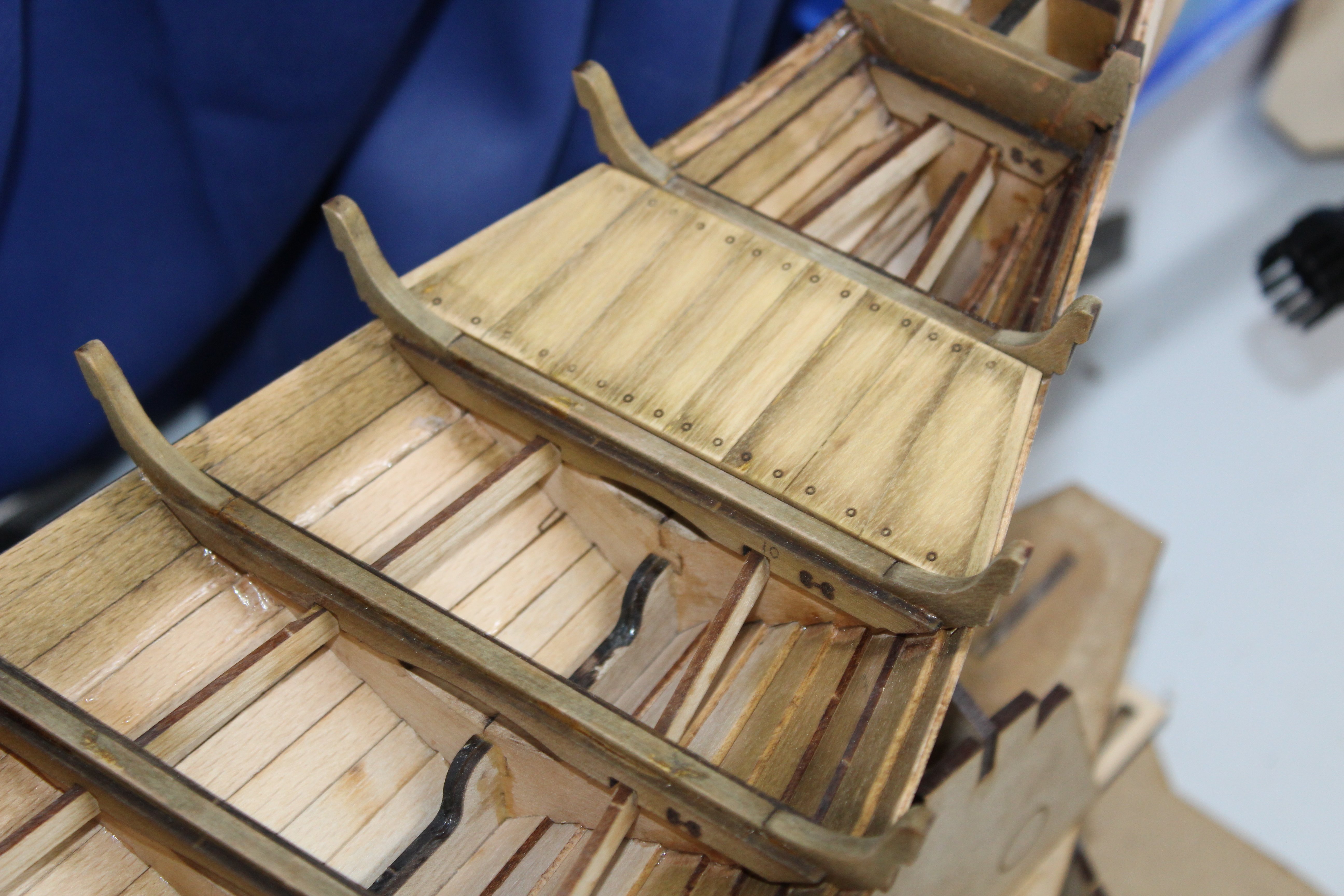

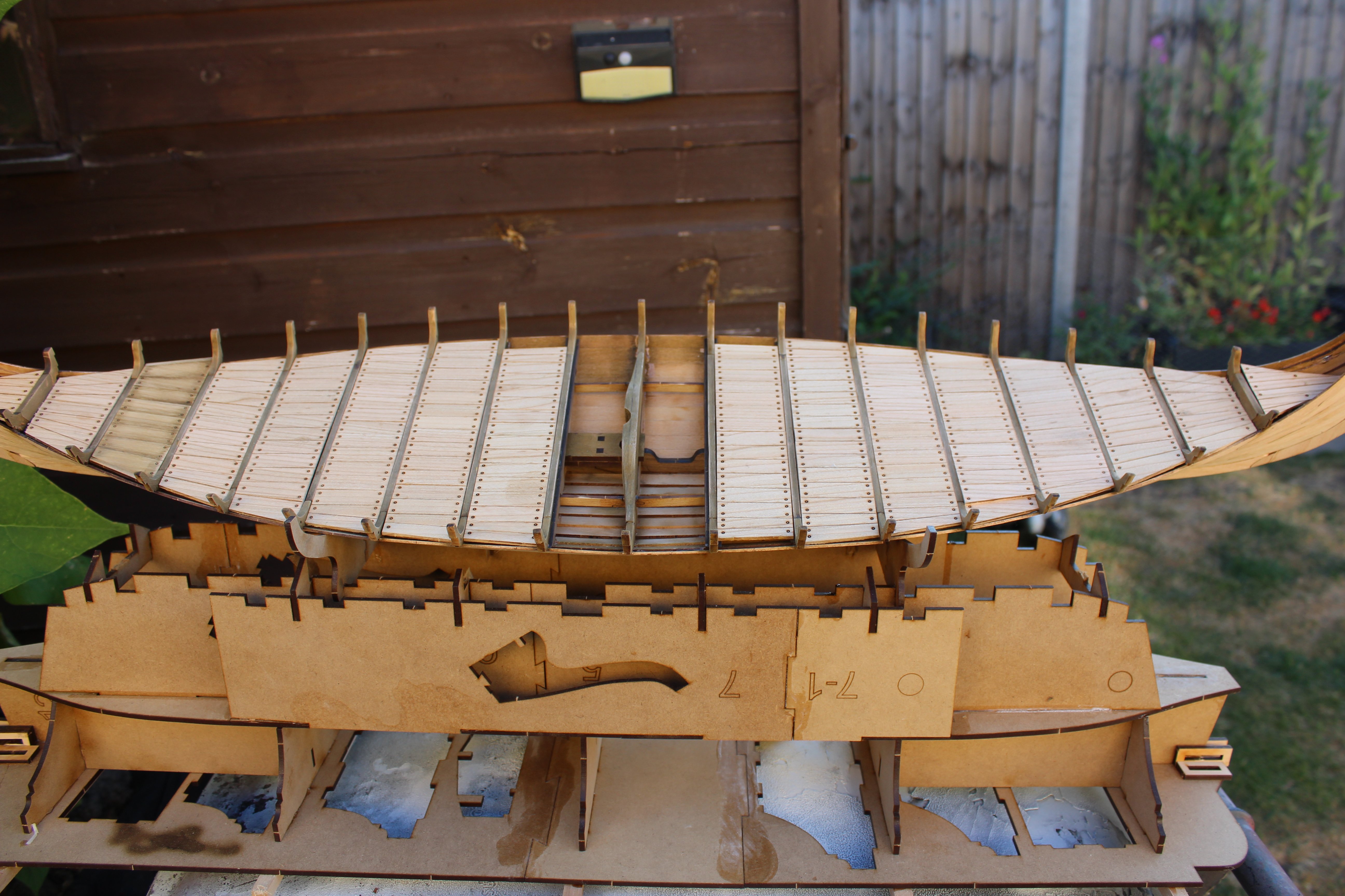

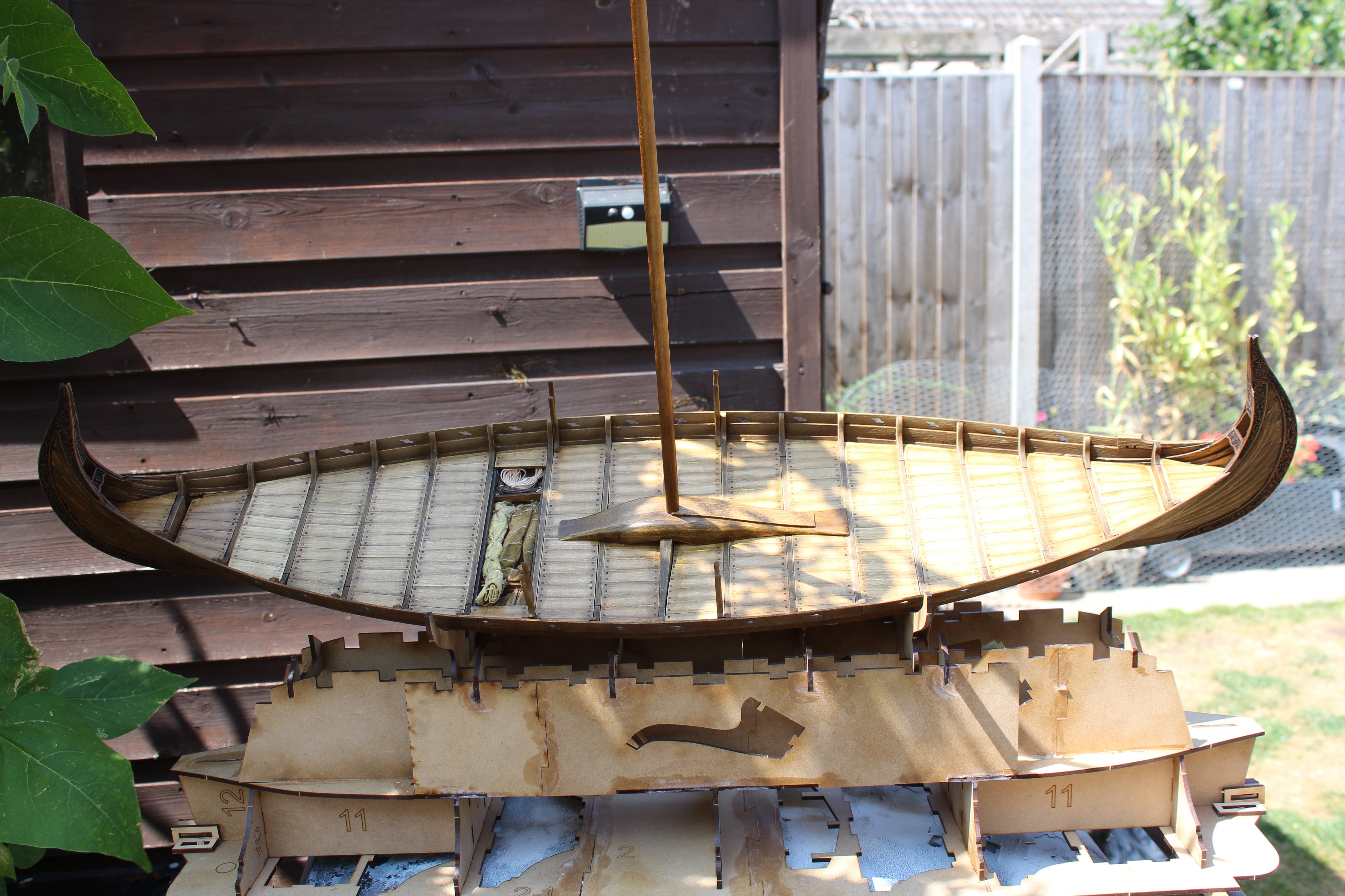

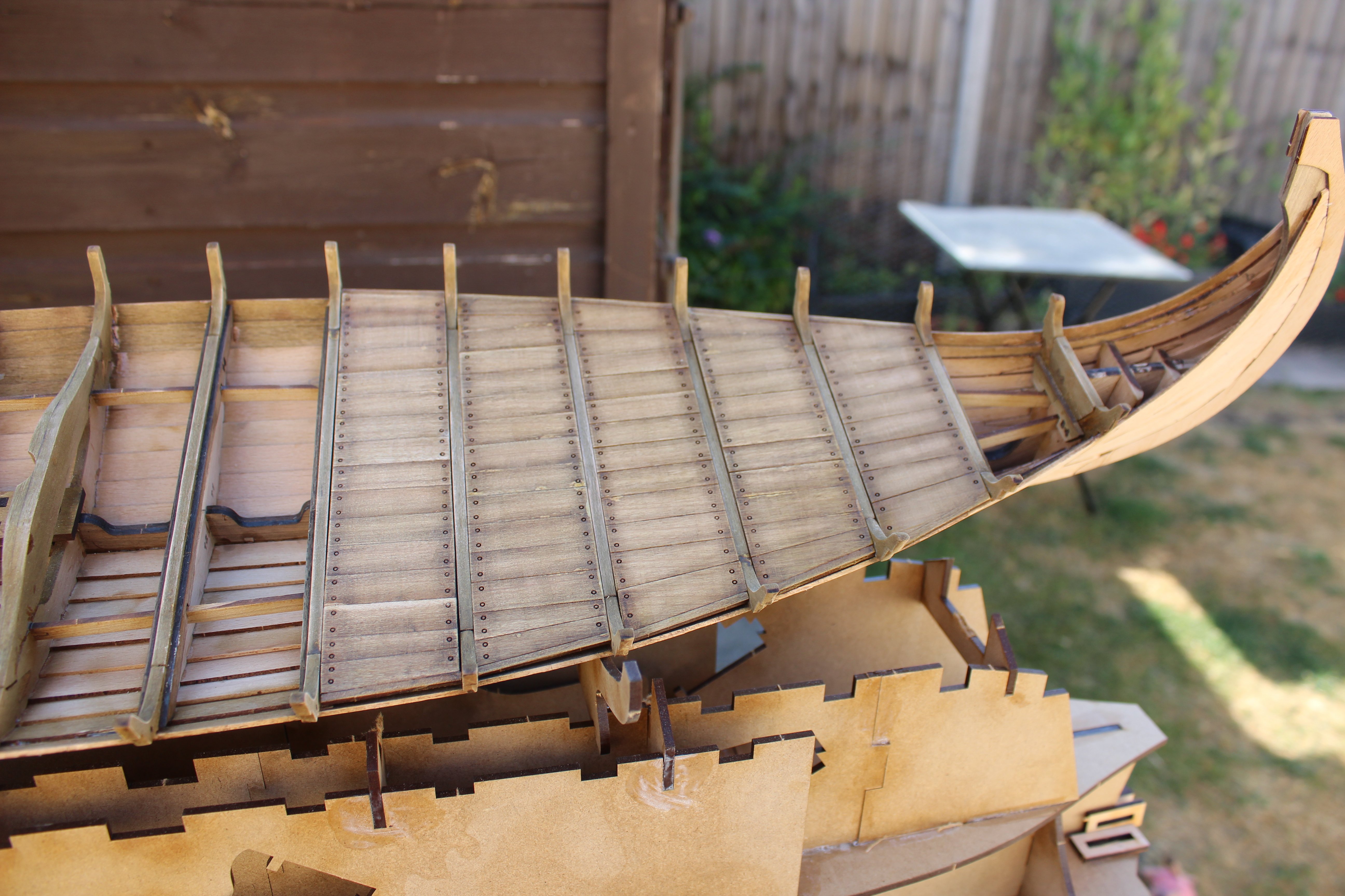

Good evening everyone, thank you for comments and likes

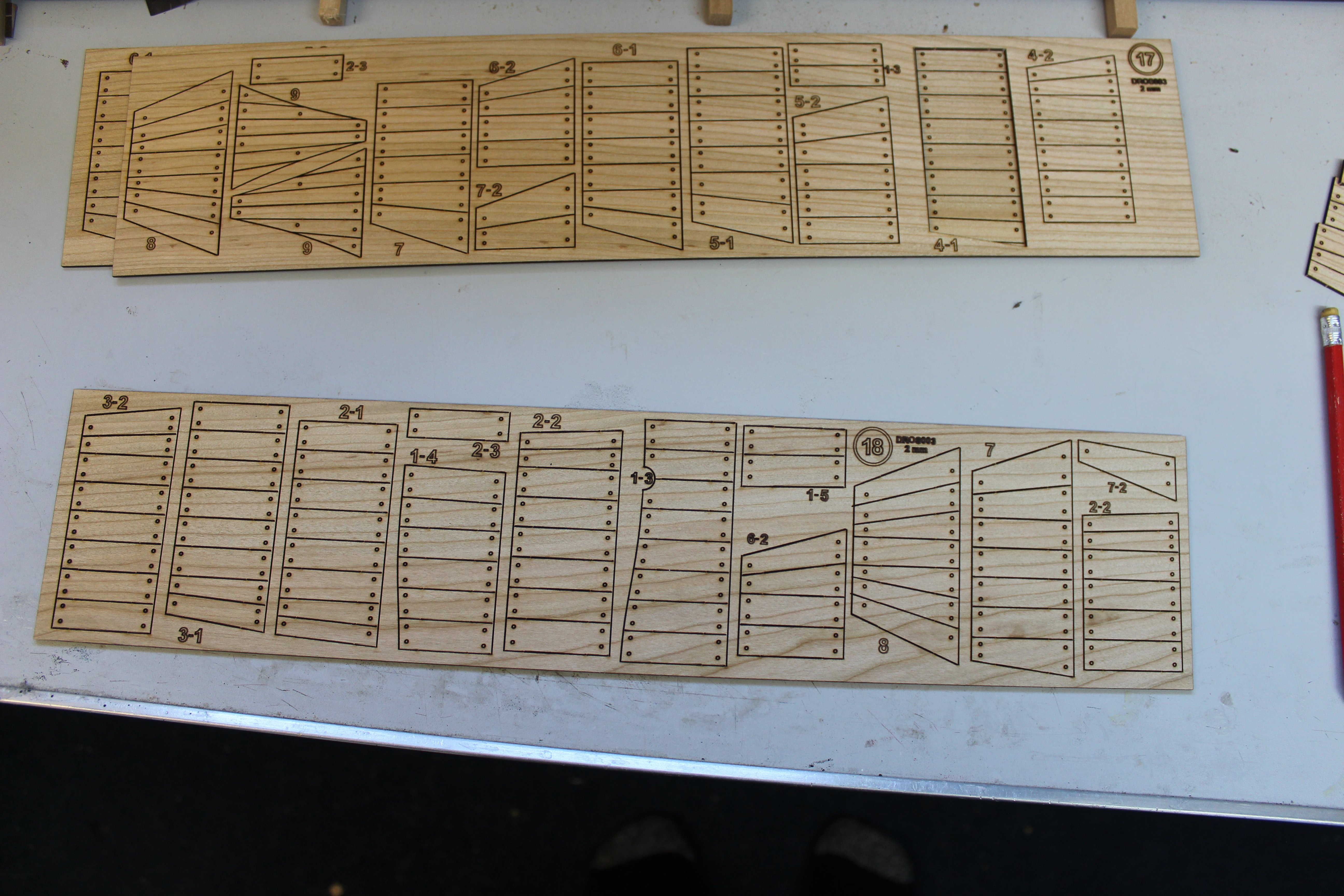

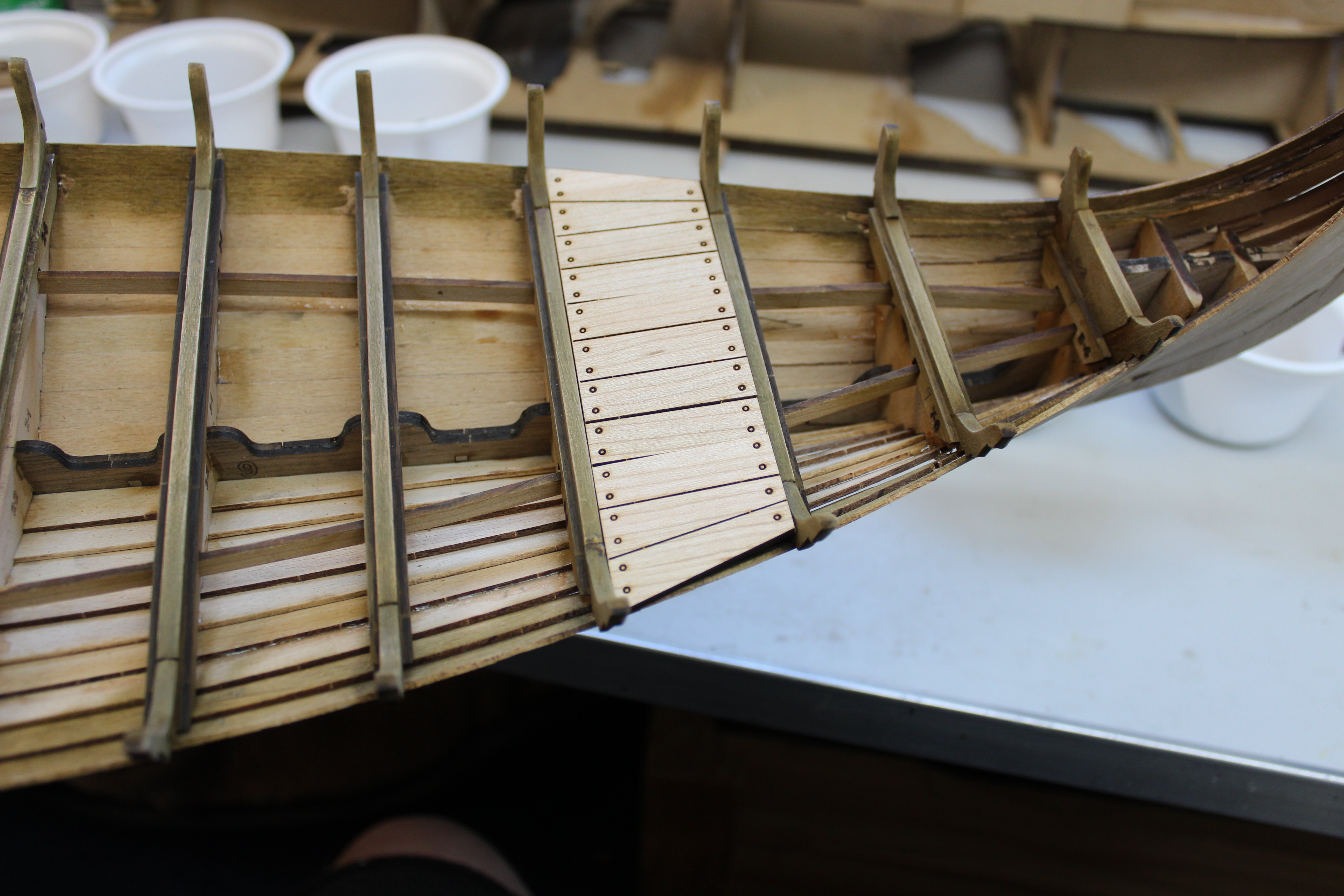

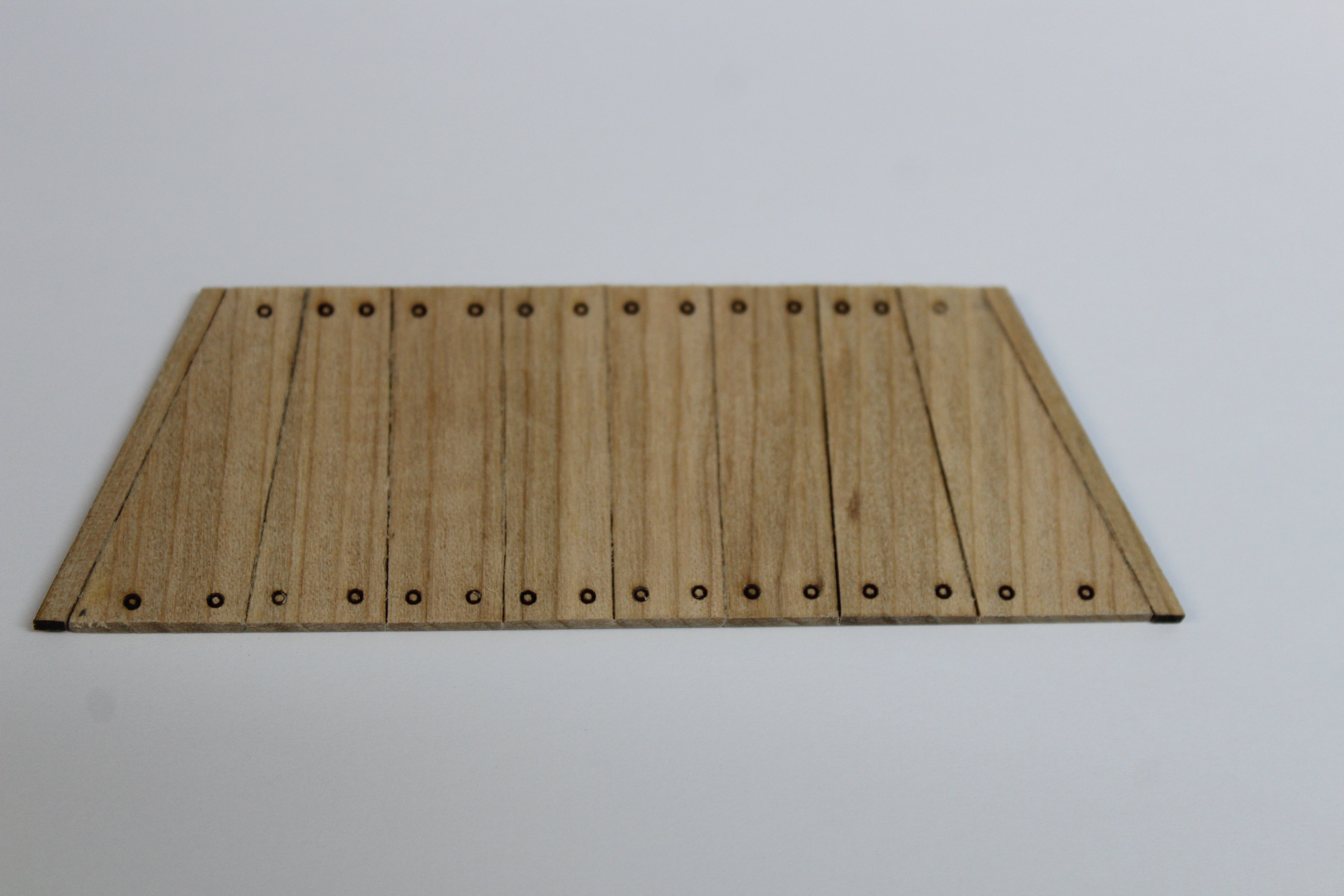

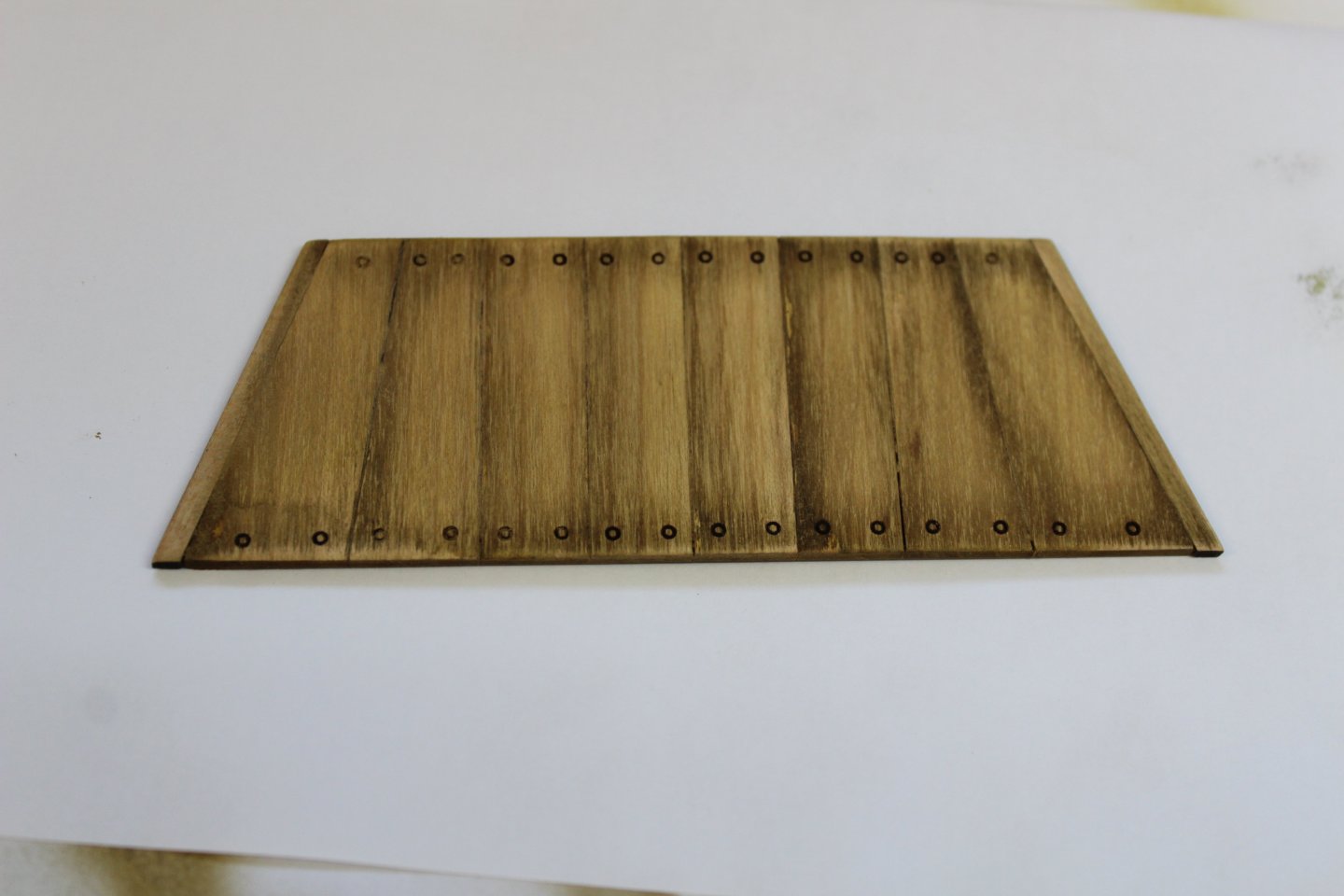

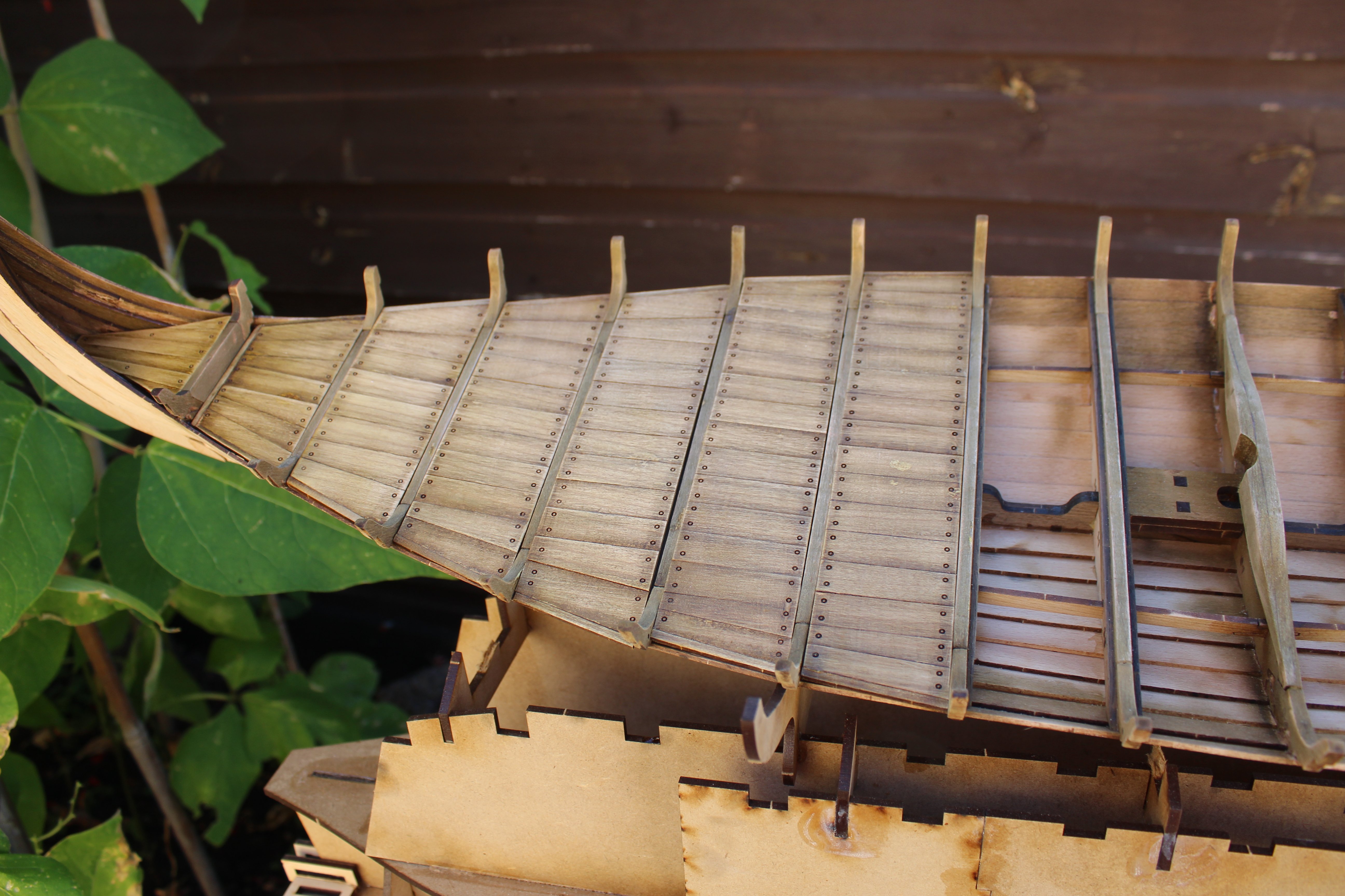

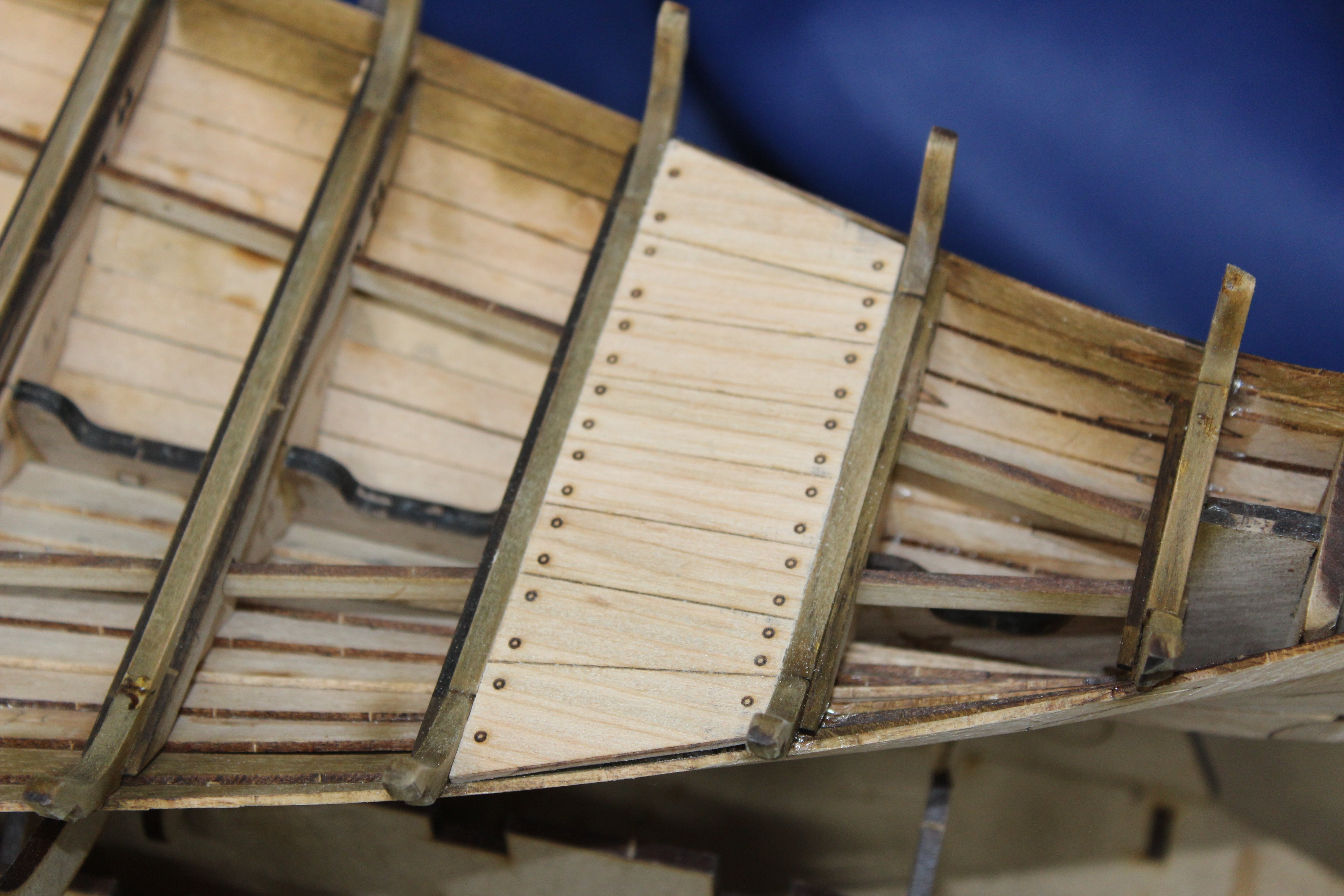

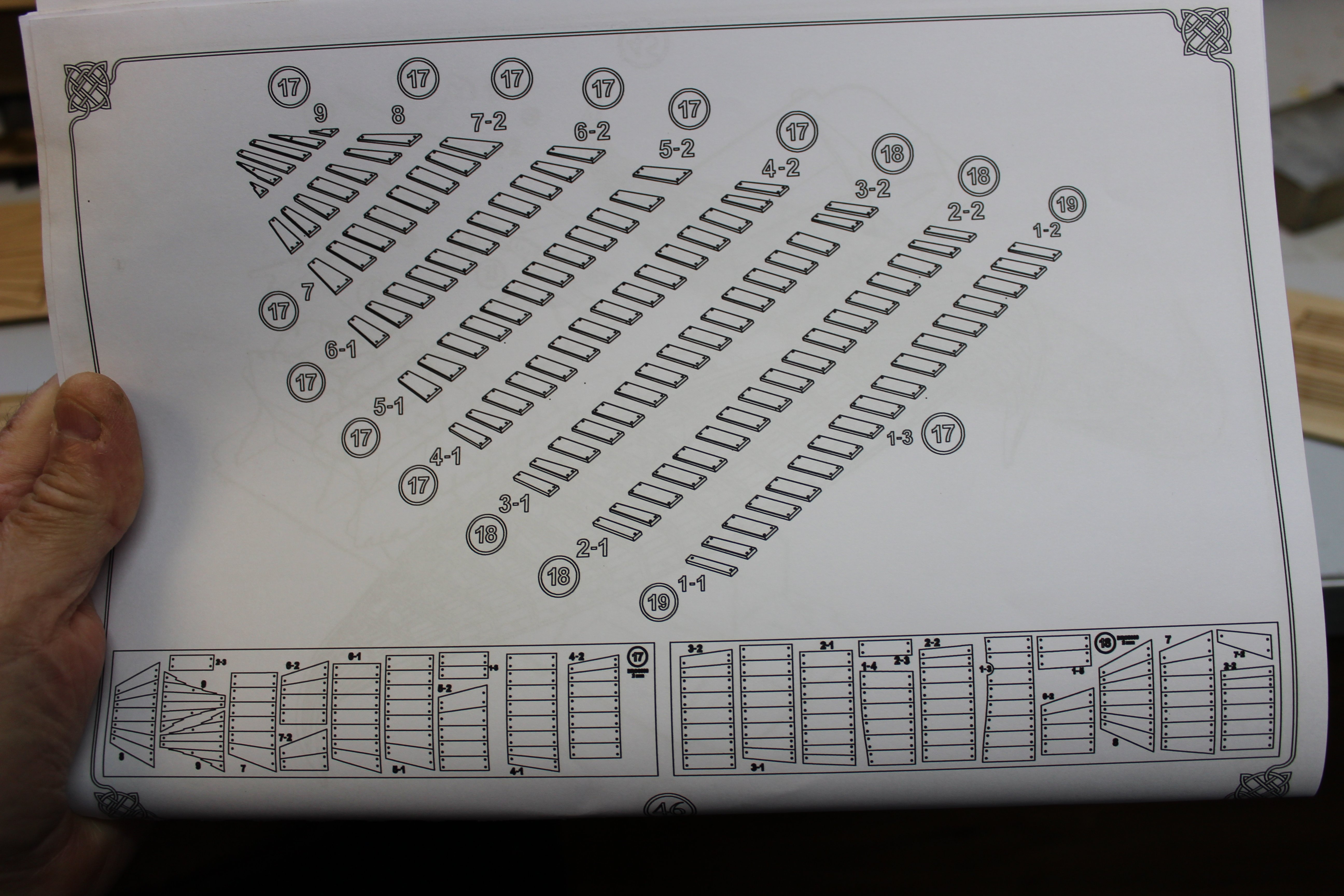

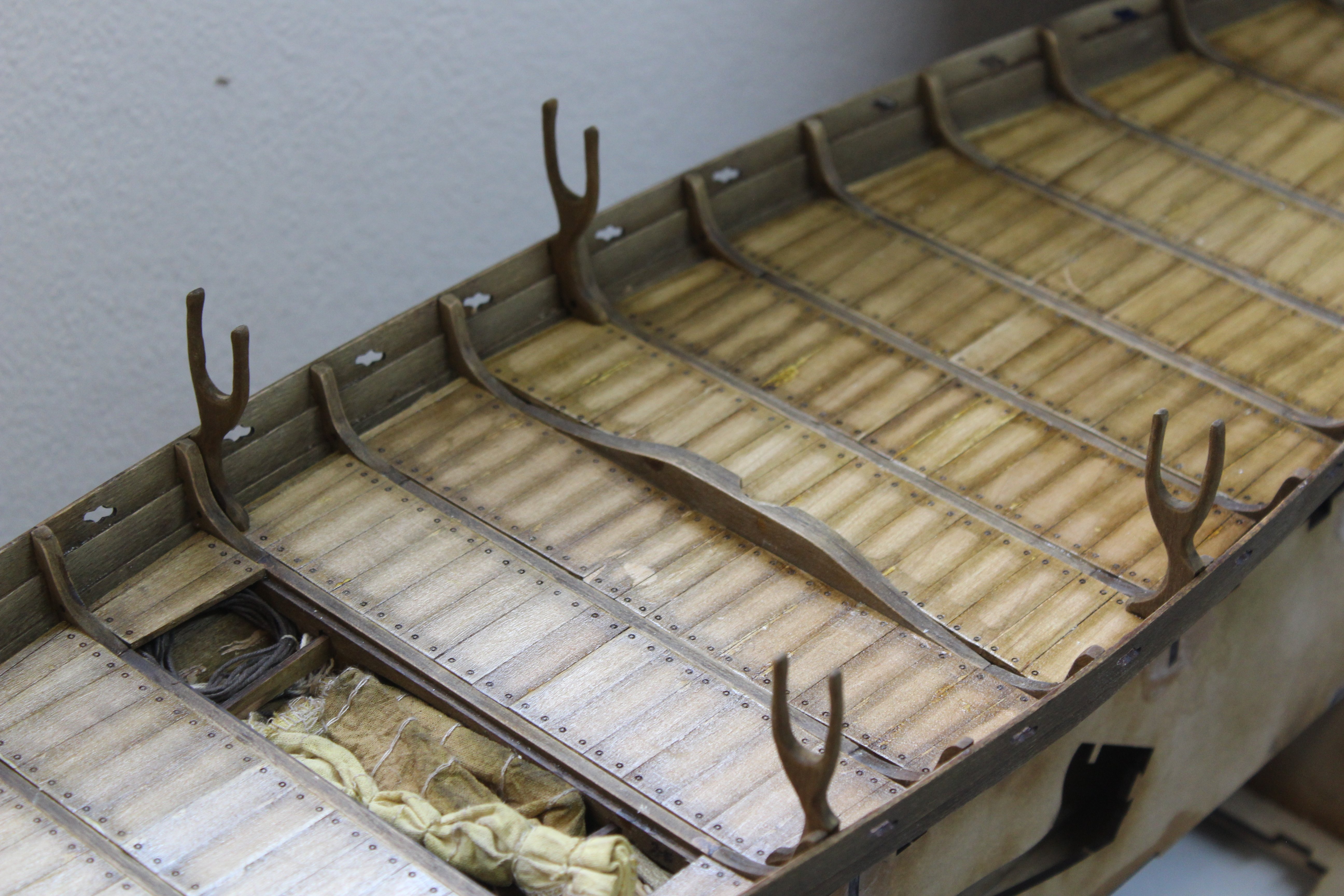

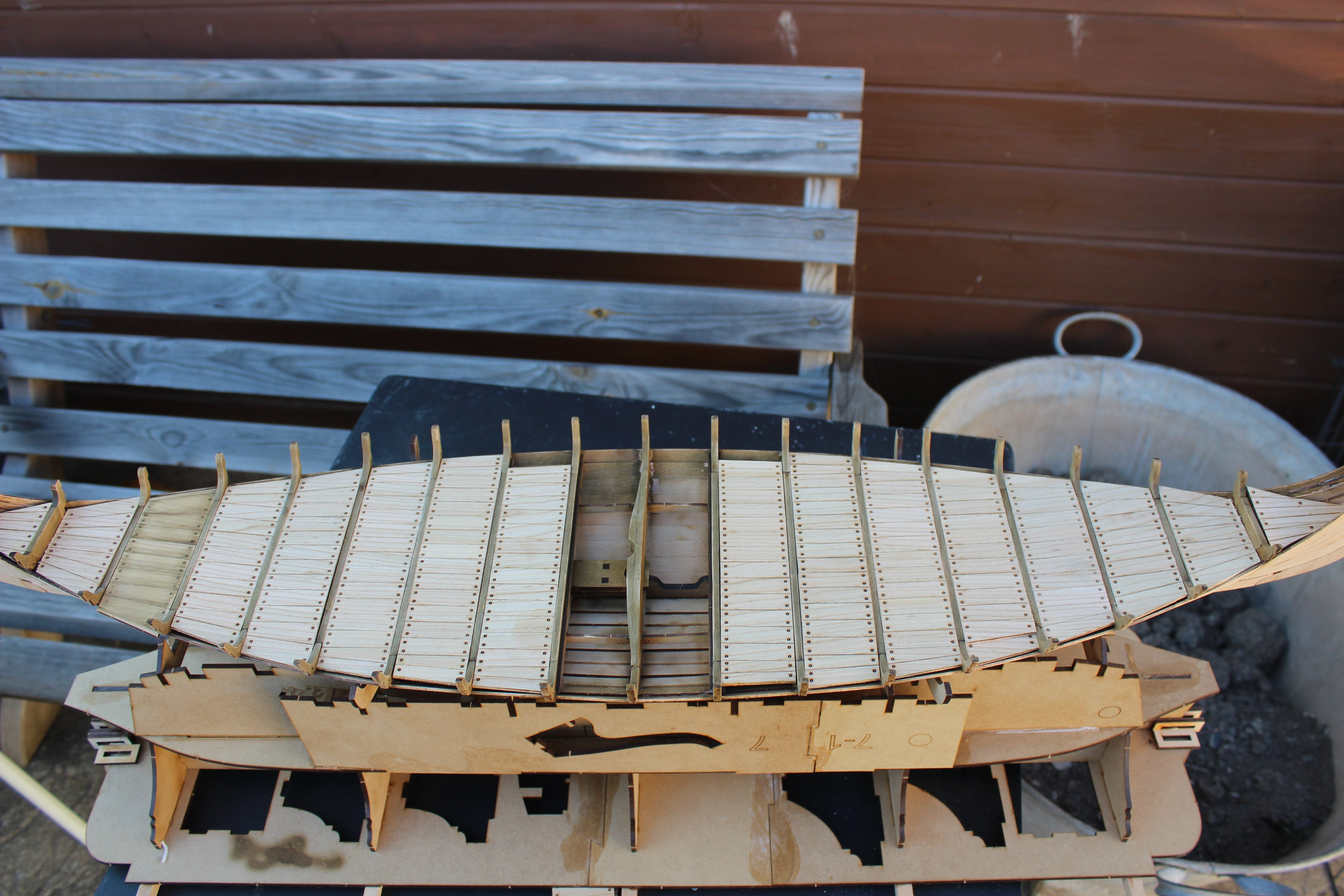

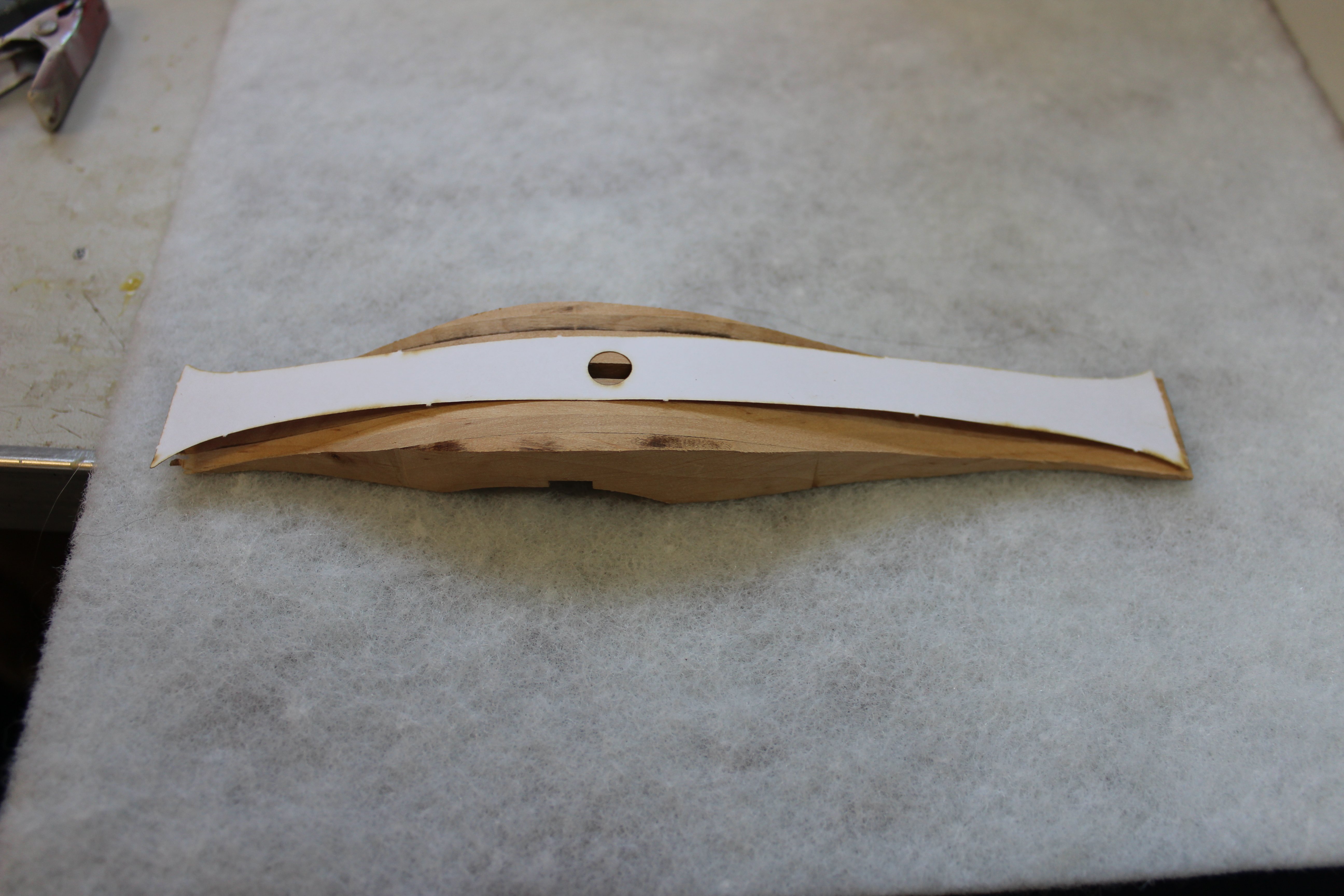

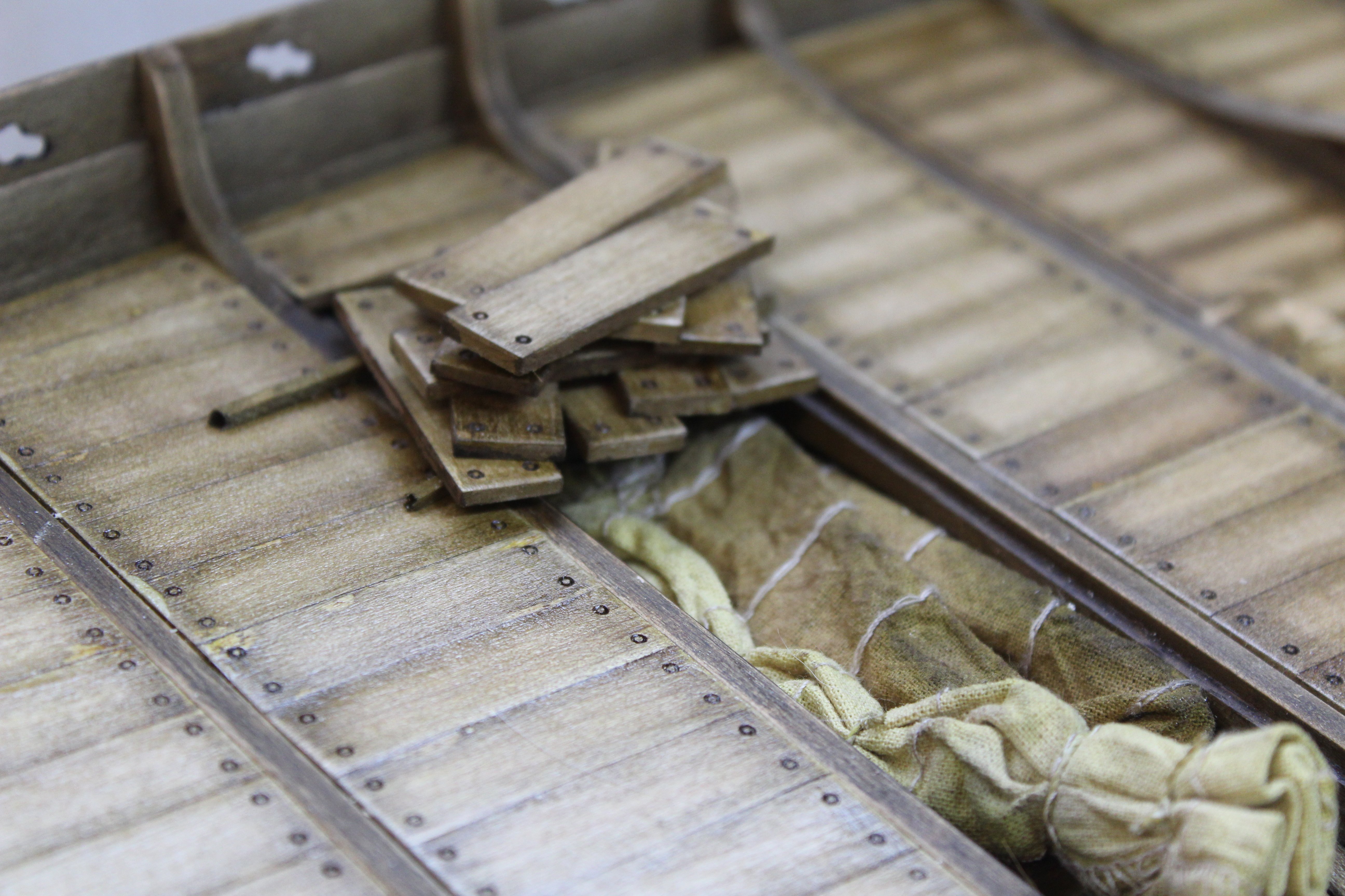

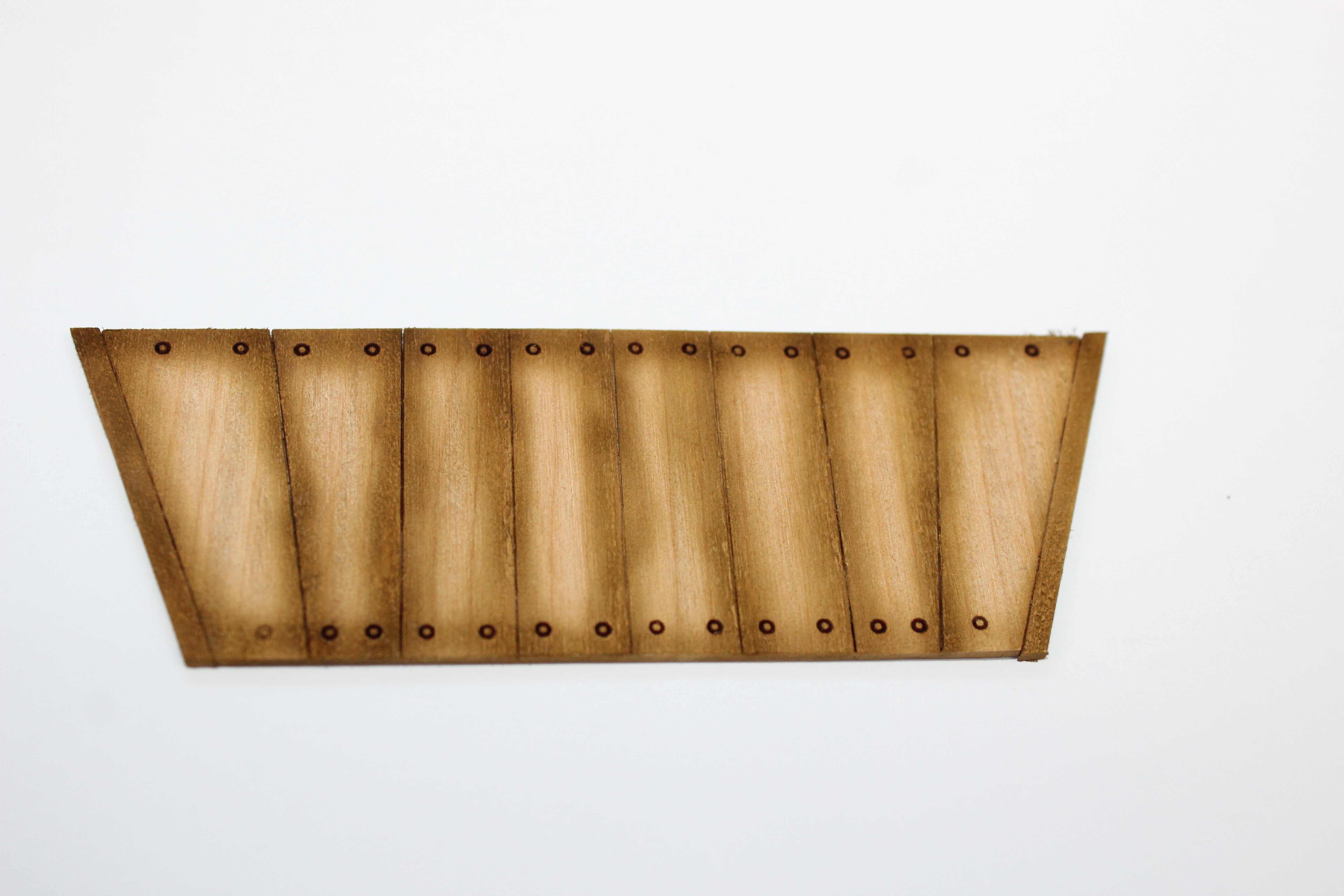

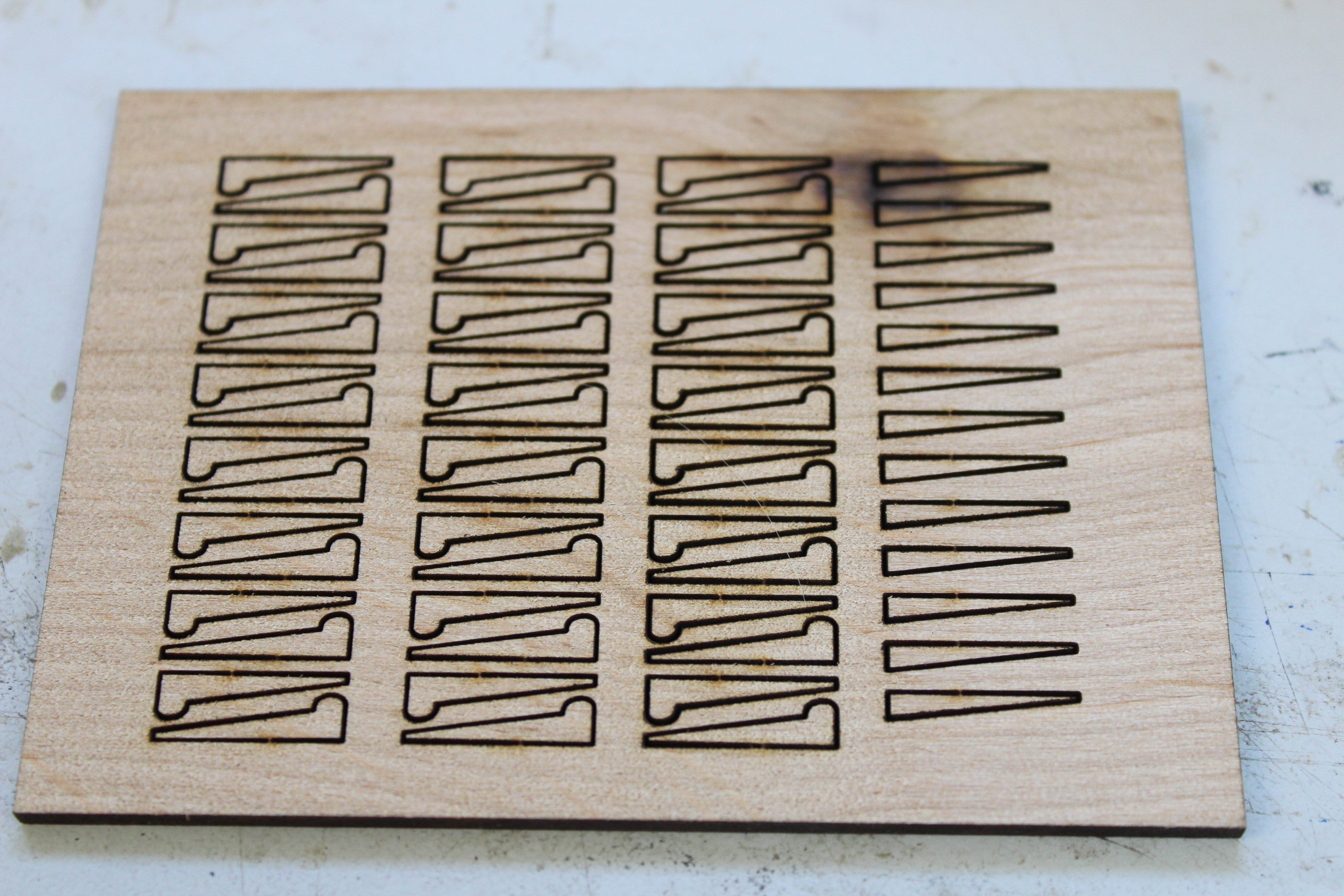

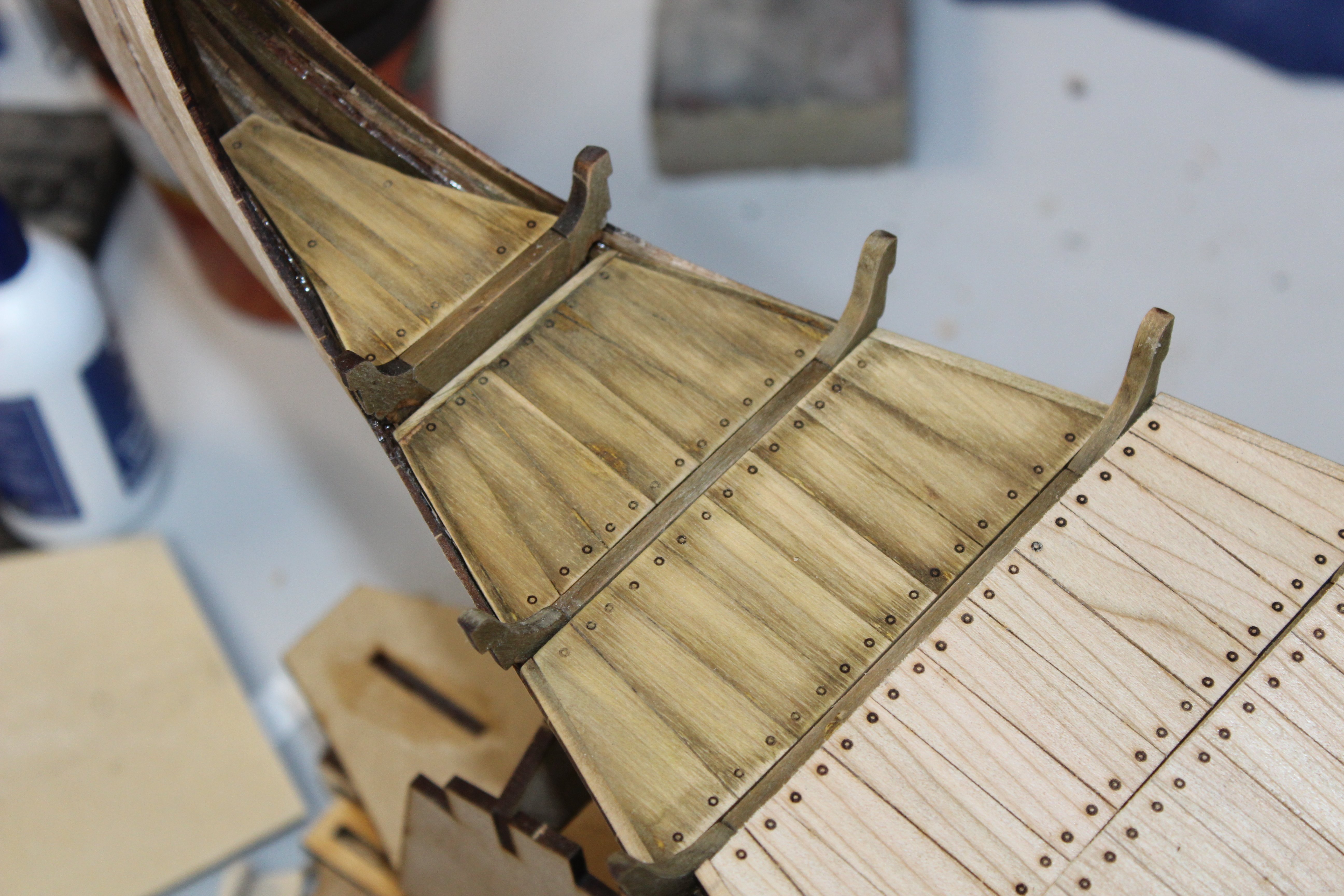

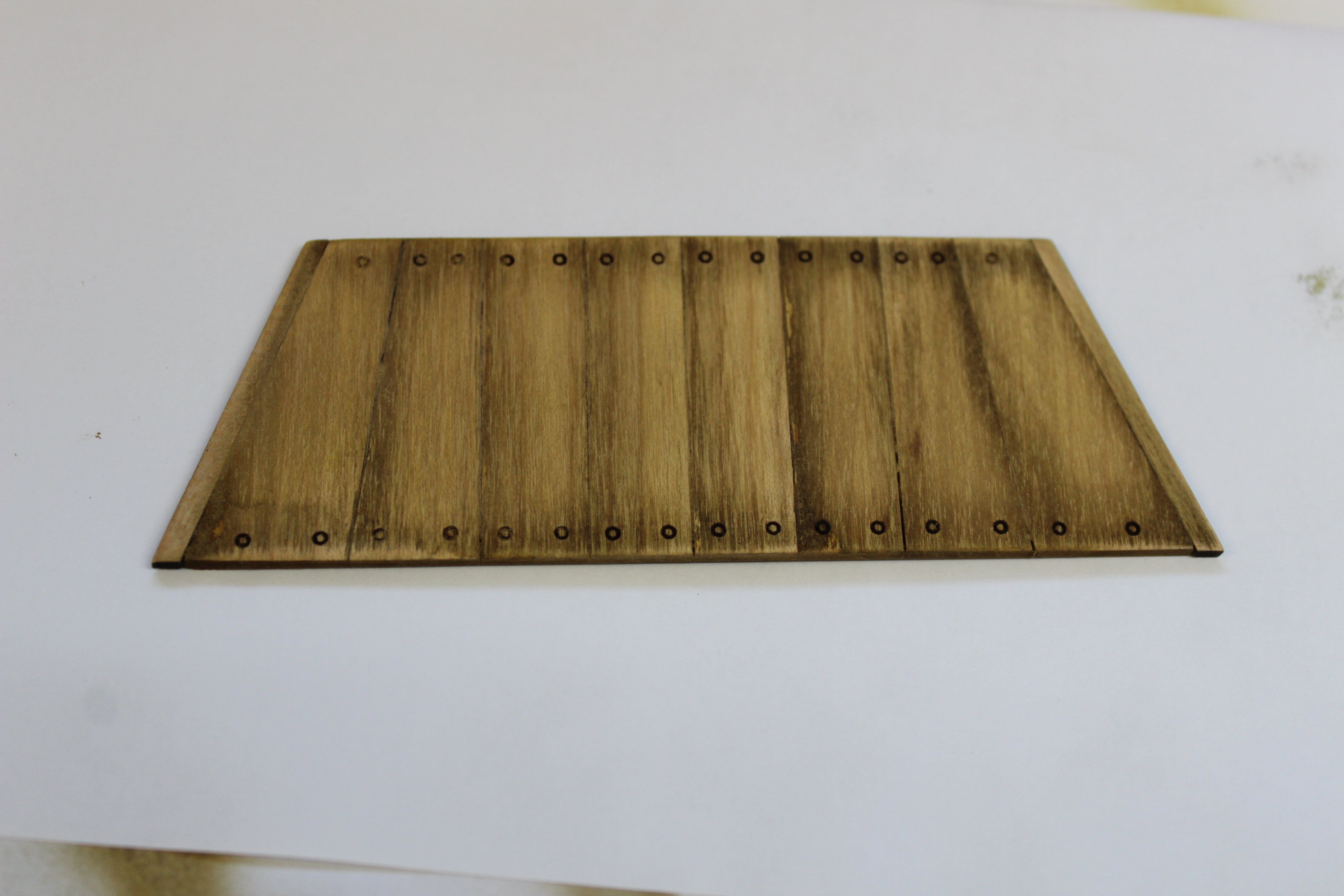

deck plates- not finished yet

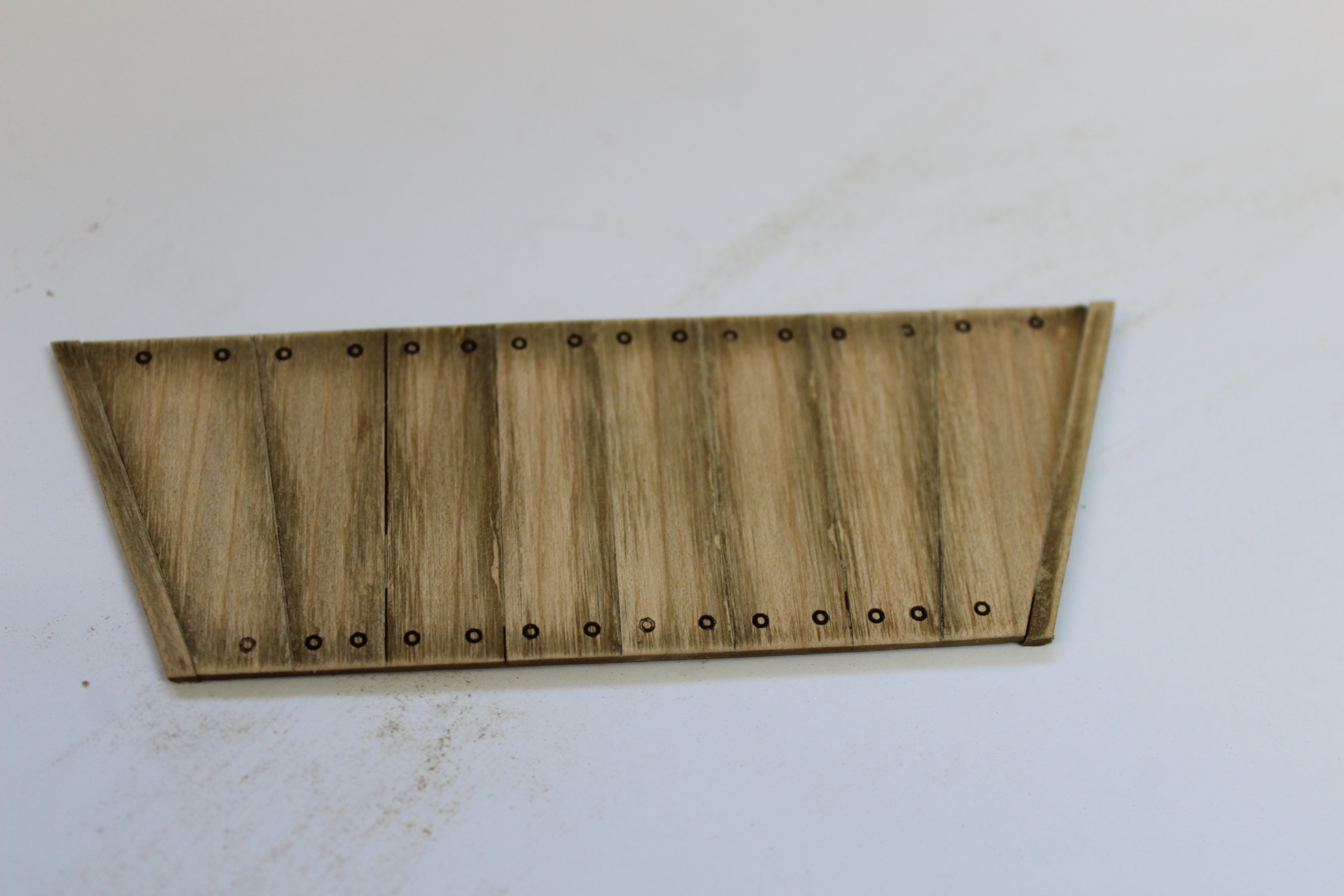

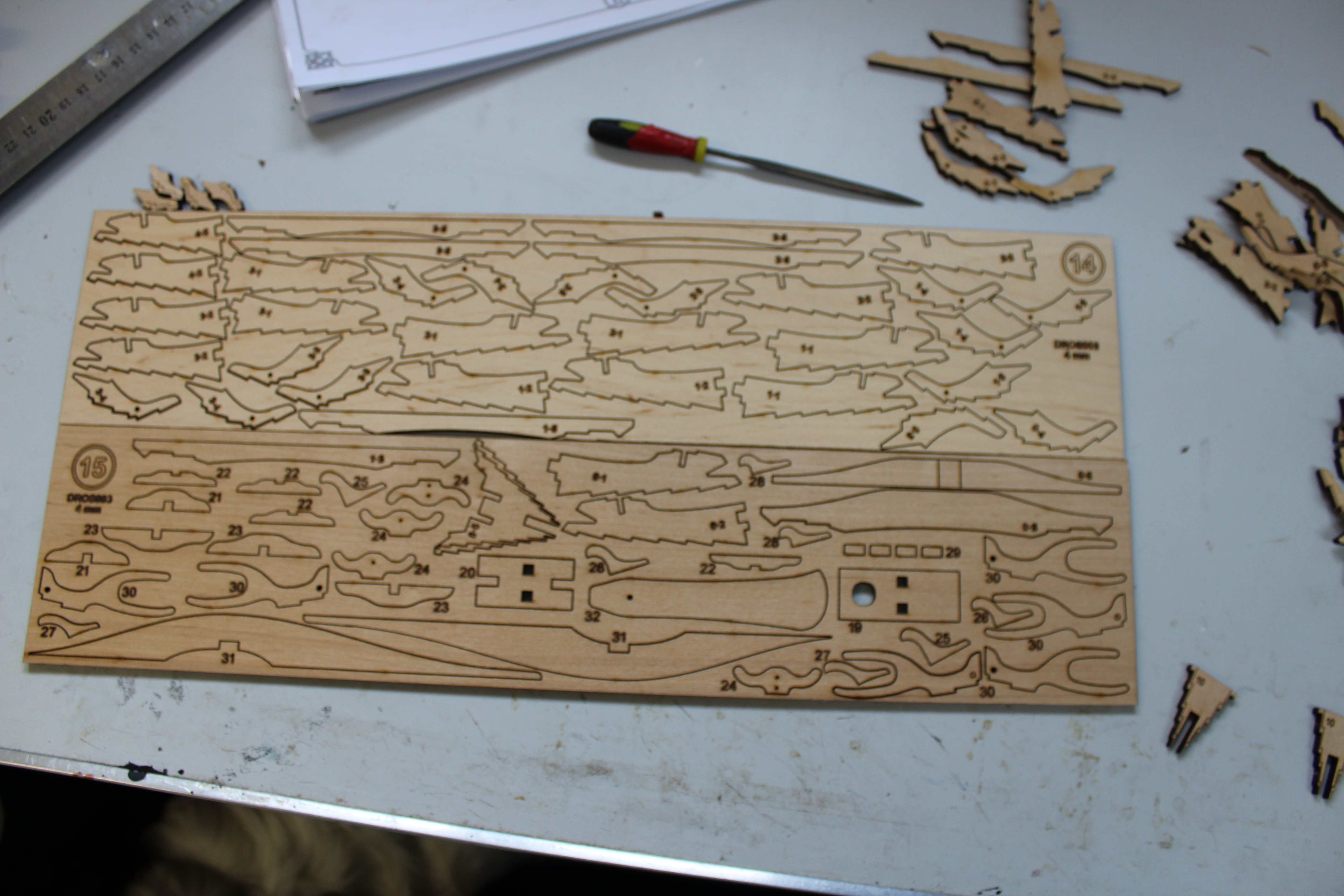

two sheets of plates have to be removed, separated and sanded,
IMG_4057.thumb.JPG.4359a7305e9bd18dcfceaa130219a21d.JPG i numbered each piece of mine prior to removal, as i was bound to mix them, the instruction don't show much, other than where they go, but great online tutorial
IMG_4061.thumb.JPG.51e51eed8f76e8aa27ccdb2b30d22243.JPGIMG_4062.thumb.JPG.65d669f55cd1bf1608d41b95466f3558.JPGIMG_4063.thumb.JPG.7a1f567e00a57708f1cc37b50ce9b381.JPG
then sprayed all the edges with walnut, sanded them with 3500 grit pad, repeated, then sprayed over with Oak and sanded again
Been 34 deg in the mancave, too warm for me, so im slightly behind, where i would like to be, not a race, im pleased with the way it is turning out, But wood glue, is a real bug bare, even with just using a cocktail stick to apply. So before she is completed, i will remove some of the worst offenders and open them to reveal the hold
no plates are glued down at this stage
Edited by Kevin
Looking good, Kevin.
Good thinking to number everything first. I'm an expert at, "It'll be OK, I'll just be careful where I put them", and then spending hours trying to sort thing out! 😀
