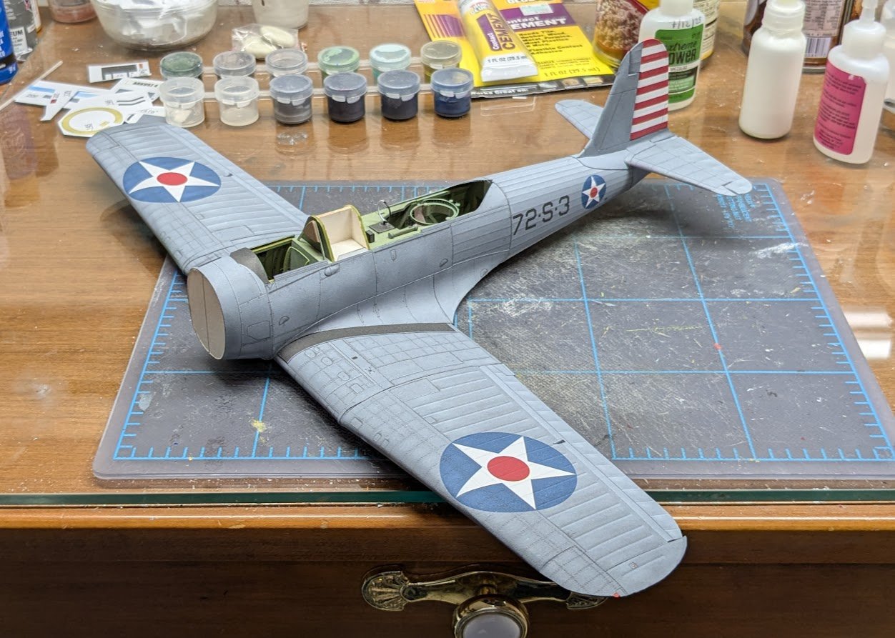

Horizontal stabilizer added. The framing went together lickety-split, followed by some thin CA to stiffen the structure and a little sanding to get the outboard taper correct.

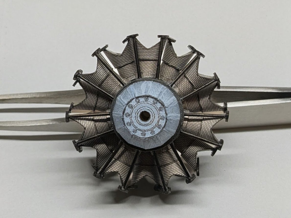

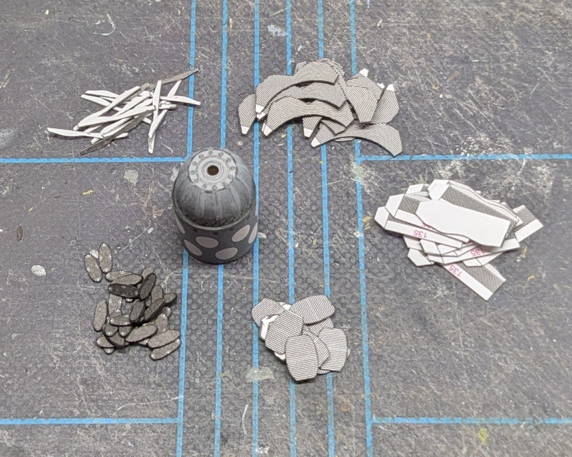

I got the engine block built and all of the paper parts for the cylinders cut out -- fourteen cylinders at six parts each = eighty-four parts to cut out. After that I started rolling cylinders, but I only got two done before my brain died. 🥴

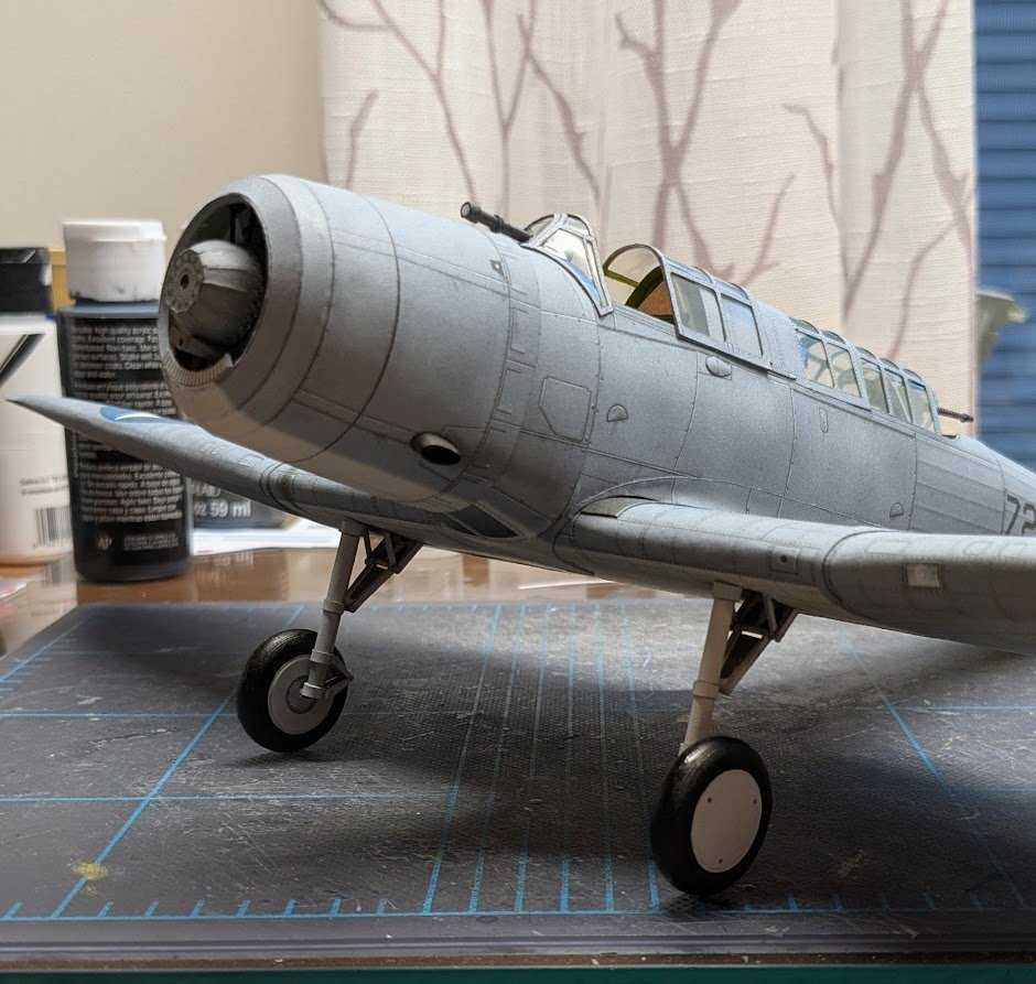

Made quite a lot of progress since the last update. First, I got the engine mated to its bulkhead and the forward fuselage ring done. You can see some of the cowl rings in the background.
Next, all of the cowl rings were shaped and closed. At this point they still need a little final shaping.
Here the cowl rings have been added. I had a problem with the last ring because I didn't realize that it was supposed to angle back into the cowl opening instead of forward. I made a few cosmetic boo-boos in getting it repositioned.  I also overlooked that there is a printed interior cowl piece. Fortunately, as this photo suggests, the interior is difficult to see, so the interior piece's absence shouldn't stand out.
A couple of exhaust stubs and an air scoop later and the forward fuselage was ready to mate to the rest of the model.
Finally, the .30 cal mount was completed. It's just loose-fitted for this shot -- I will remove it while I work on the canopy. I had originally planned to display the gun in the stowed position and have the aft canopy closed, but the diagrams were unclear on how to configure the mounting to make that possible, and I could find no helpful images online. Displaying the gun deployed means that the rearmost canopy section will need to be separated from the rest of the canopy in order to display it in the open position.

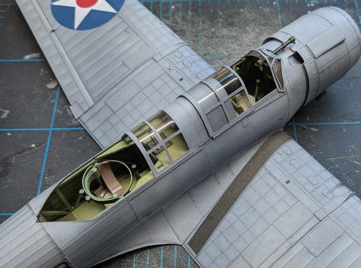

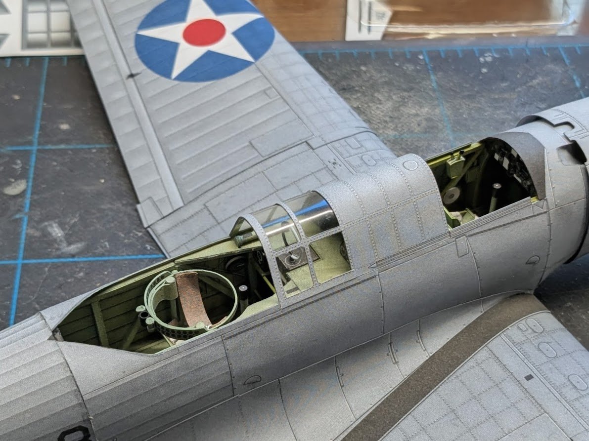

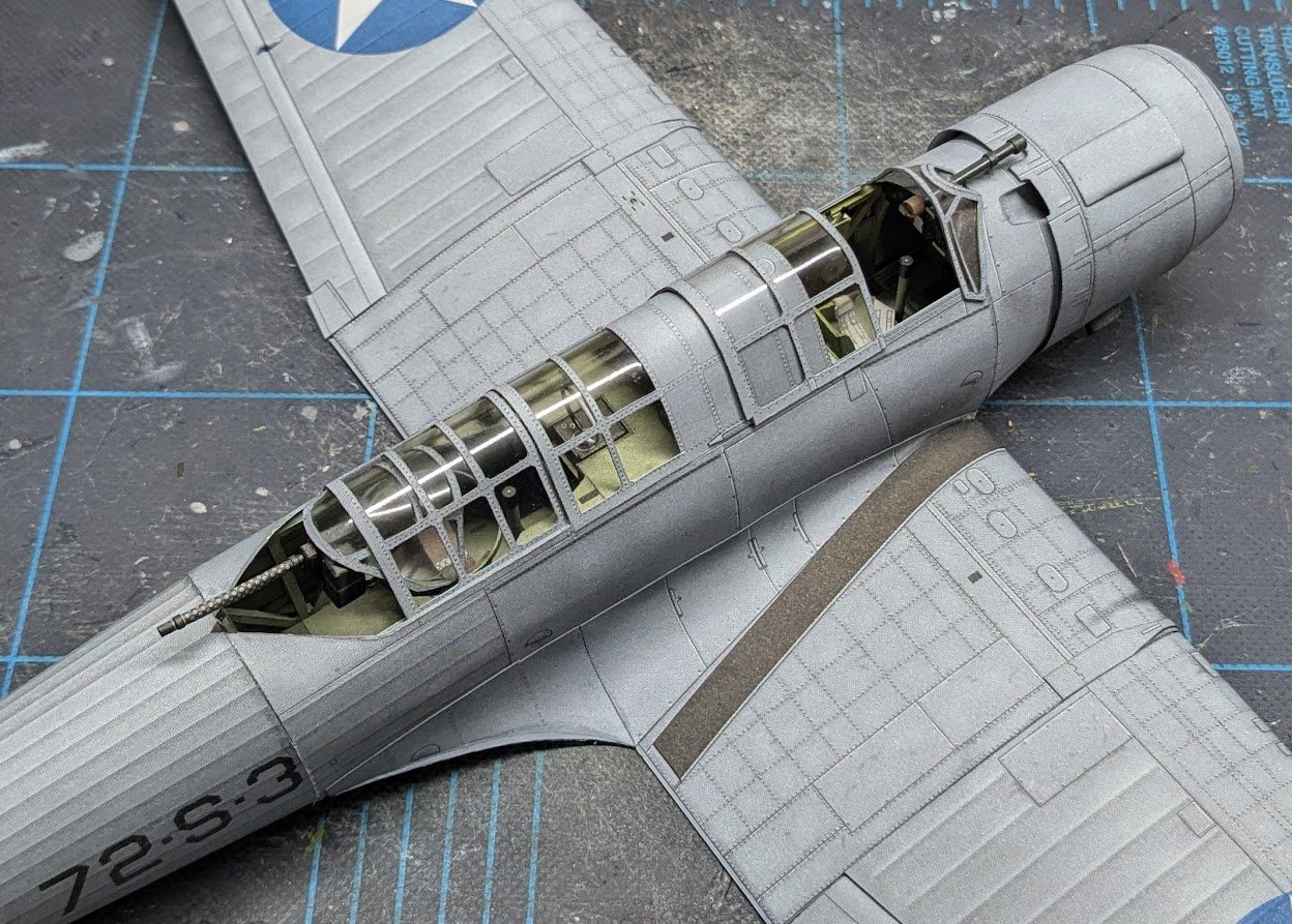

Windscreen and cockpit canopy done. Building and installing the bomb sight was a booger -- the paper part wound up being too large, so I had to replace it with a piece of styrene rod wrapped with several paper bands.
The only thing I got done today was the last two canopy pieces. The first one was not too much trouble -- until I realized it was riding too high because it is supposed to sit inside the fuselage rails, not on them. So, I had to cut it free from the fuselage, clean up the glued edges, and glue it down again.
Then came the last piece. It was an absolute nightmare. I had to take a best guess at how far back the framing went on the molded canopy, because the forward part wouldn't sit right if the frame was too far back, and the aft part wouldn't sit right if the frame was too far forward. Ultimately, I must have guessed wrong, because the resulting piece absolutely would not fit where it was supposed to go, and no amount of cajoling had any positive effect. I also discovered that the machine gun was going to have to go in before installing the last piece, because it would not fit in after the piece was installed. I finally had to resort to cutting off some of the aft portion of the last canopy piece. The resulting shape is now wrong, but at least I was able to finally install it after many, many attempts. This process literally took hours to complete. 😑

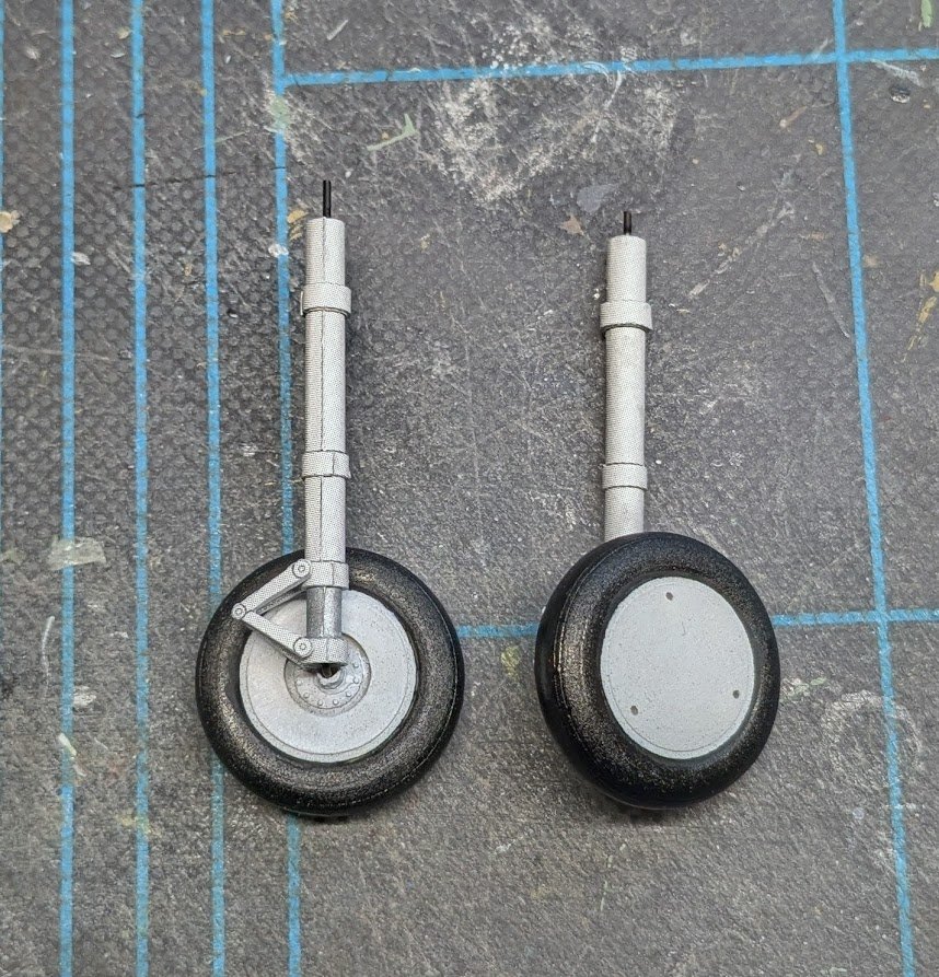

Next up: landing gear.
