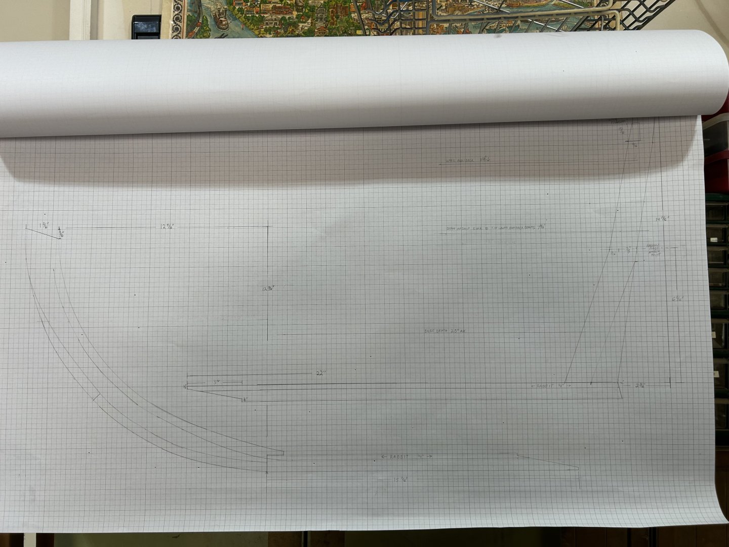

With the ship selected, scale came next. I wanted it to be as large as possible, but still able to pass through the overhead door. This restricted me to 7'-2" of clearance. 1:24 is the largest scale that I can use to allow for the ship's masts to be fully rigged as the top of the flagstaff on the mainmast will be right at 7'. (I may make this part removable to give myself a little extra room for the day I have to move it.) Finished, the model will be about 9' in length, 7' in height, and a little over 2' in width.
My next challenge was drawing up plans for the main components, keel, frames, transom, etc. Using several sources, including the Vasa museum, books by Fred Hocker, and a brilliant dissertation on Vasa's architecture by Kelby James Rose at Texas A&M, I was able to get accurate dimensions, angles and curves on the main components, as well as pictures and explanations on what the internal structure looks like, details on construction joints, and functions of many elements that are not always shown on typical models. One of the major issues that I've run into is that Vasa was not built along the typical guidelines of the later 17th century. Many deviations in the Dutch building practice along with changes that both builders, first Henrik Hybertsson then after his death, Hein Jakobsson, made to the structure mean that some of my usual resources that I use for 17th century ships, will have to be dismissed as they are not applicable. Fortunately, while I strive for accuracy, this project is most importantly about fun!
I used large graphing paper to draw up 1:24 sale drawings. This is allowing me to test fit elements and see how they interact before cutting them on wood. I can then trace out the individual pieces that I need onto parchment paper to use as a stencil to transfer the shape onto wood. This is especially helpful on the curved parts. It also allows me to try to make my mistakes on cheap paper rather than expensive wood.
I started this project technically in May with the drawings, then I cut my first pieces of lumber on September 7th. This is likely to be a very long build, but I really don't know of any other kind! :) I hope you all enjoy this as much as I do. There are still lots of things I've yet to figure out such as how I will make the cannons and all the carvings, plus how much of the interior I plan to show. I have a rough plan, so we shall see. In any event, it should be entertaining.

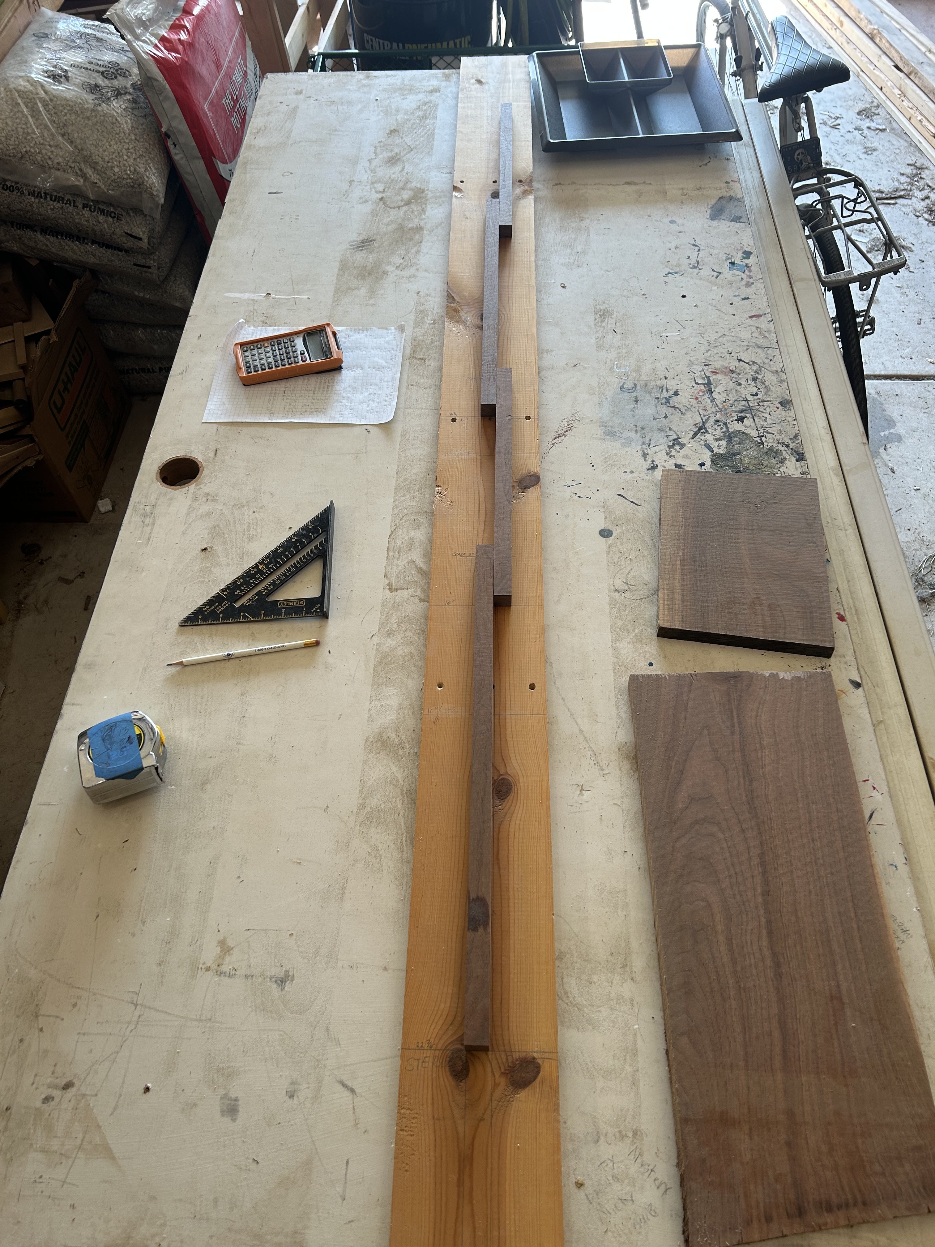

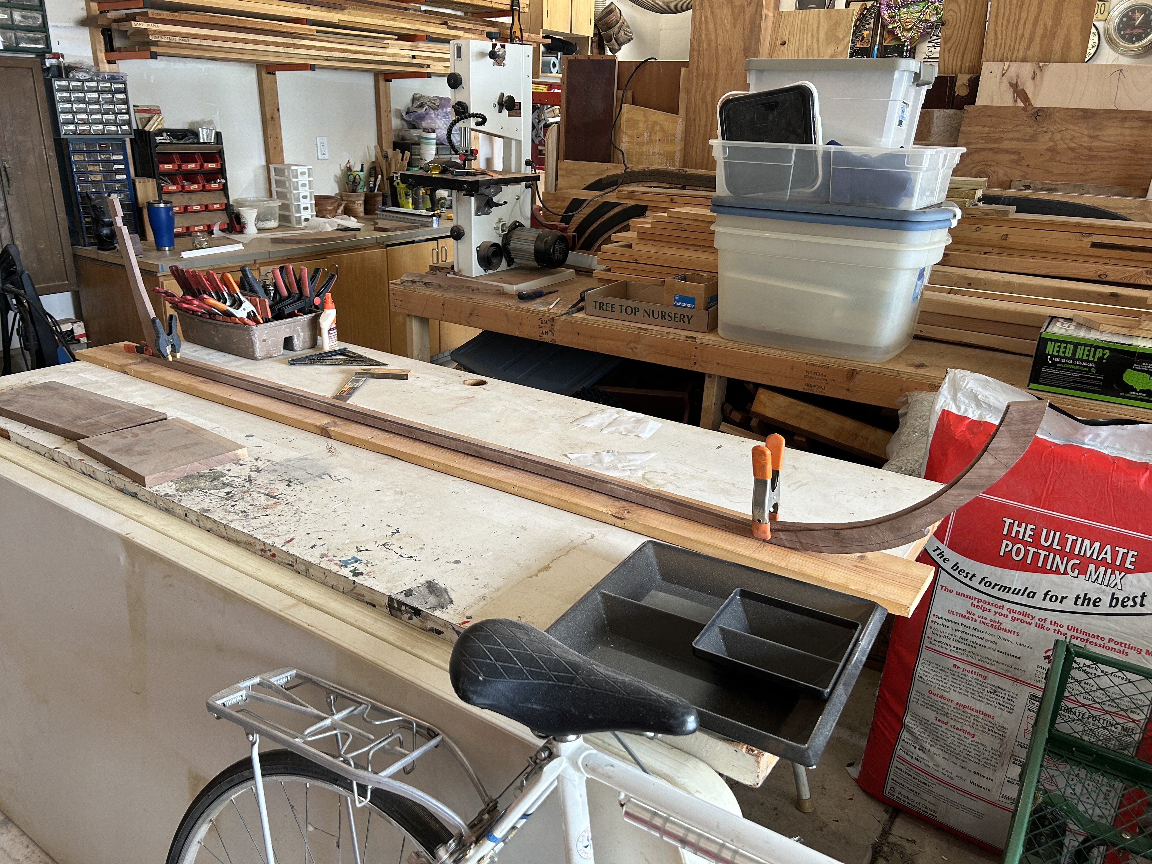

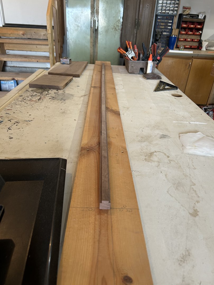

Construction started with laying out a build board with marks for the keel sections. This gives me something to map the build to as well as provide support while building. I chose to model the keel in four separate pieces as the actual one is. Each piece is a different length and here we run into of the first major deviance from generally accepted practice. The main mast is stepped above a scarf joint at section 2 & 3. Typical keels of the time would have been made in three sections to avoid this by stepping the mainmast in the middle of the 2nd section. The accepted reason for this deviance is the Dutch shipbuilding practice that attempted to have minimal waste by using as much of the available wood as possible. Therefore it is believed that at the time of sourcing the wood for the ship, along with the other ships under contract at the time, this was the best they could do with minimal waste. We do not know if this would have truly mattered or not, as the ship was never able to truly put any strain on the joint.

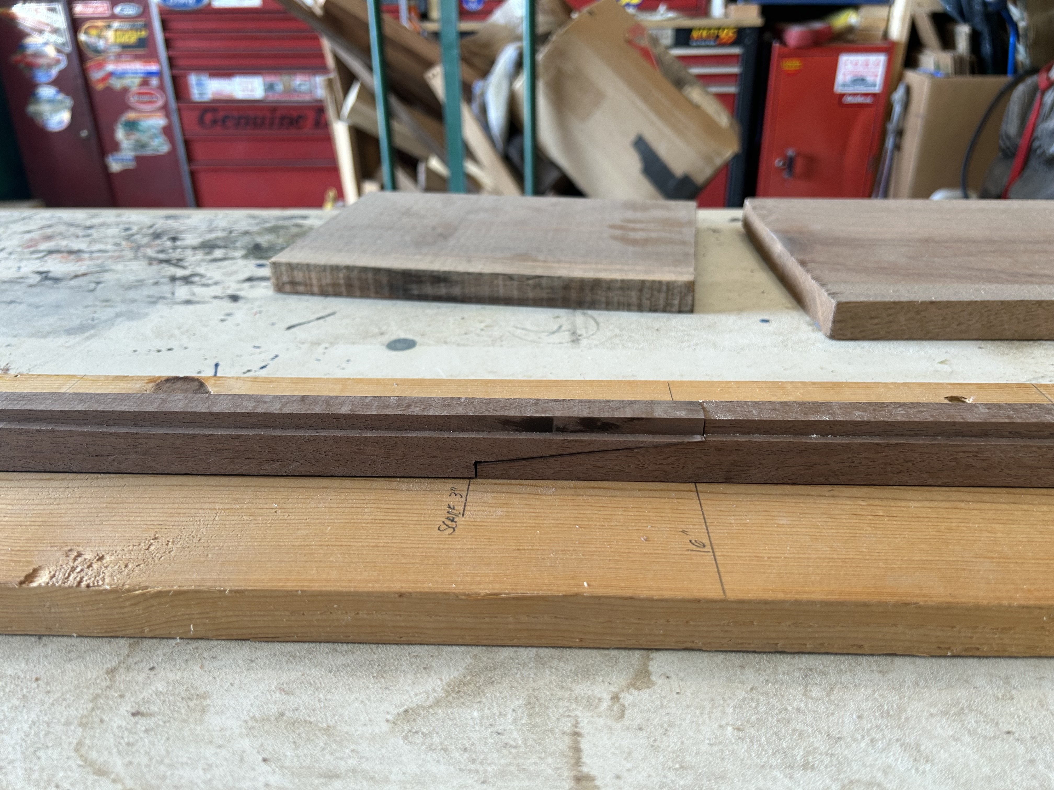

Once the sections were cut to length, the scarfs were cut out and the rabbet was grooved onto the sides. The pieces were glued together and left to dry.
The overall length of the keel alone is 5'-4". Next up will be stem and stern posts.

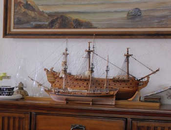

My own observation: the forum had Clayton's model as main focal point. As soon as he finished his model, the remaining log's were mainly the 'standard' build logs of kit-versions of Vasa. Fred stopped being a regular visitor, because we were for the main part just lurkers, drooling at Clayton's beautiful model. And than it lost momentum as a community of Vasa-enthousiasts. But it still is a wealth of info, although it is sometimes difficult to find the info, as it was quite often just in casual remarks somewhere in a post....
Jan
15 hours ago, Dziadeczek said:
Make sure though that you have enough room in your house to display the model!
  I like the warship directly under the wall painting on the right, where just the first mast sections are shown as if the ship is still under construction or otherwise in dry dock for a period of time.  I'm probably going that way with my 1:100 Vasa due to the problems and compromises made in the old Billing kit (ca.1970) - and besides making the hull the focal point, I can wrap up the long-delayed project much sooner and get on with something else.
I had actually considered modeling it without the topmasts as it is displayed in the museum. That would have allowed me to build at 1:10 scale even, but, having read through Hocker's Vasa II book which goes into considerable detail on the rigging, and from personal experience with complete rigging and sails on previous projects, I want to try for full rig. I have ambition of going so far as to make the rig semi operable for changing position of the sails, but that may be a dream. Either way, its a long ways out.

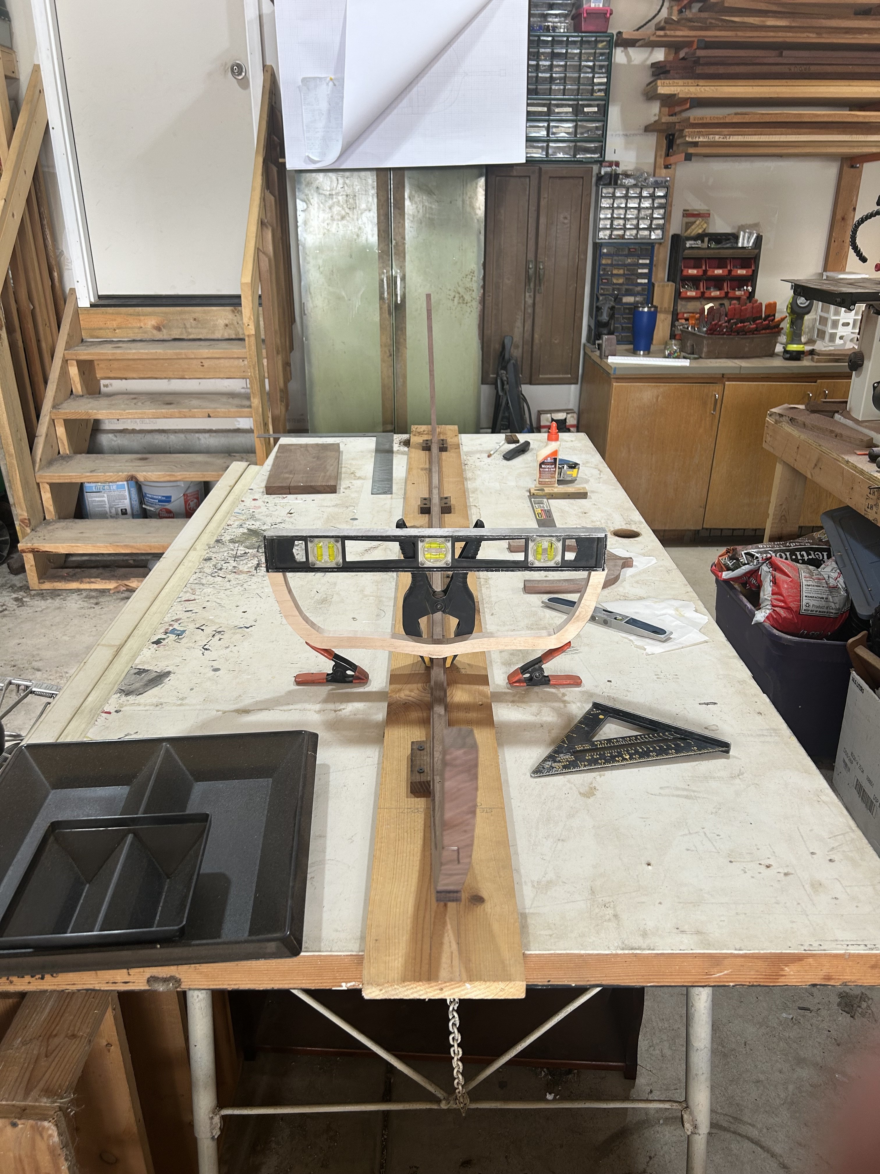

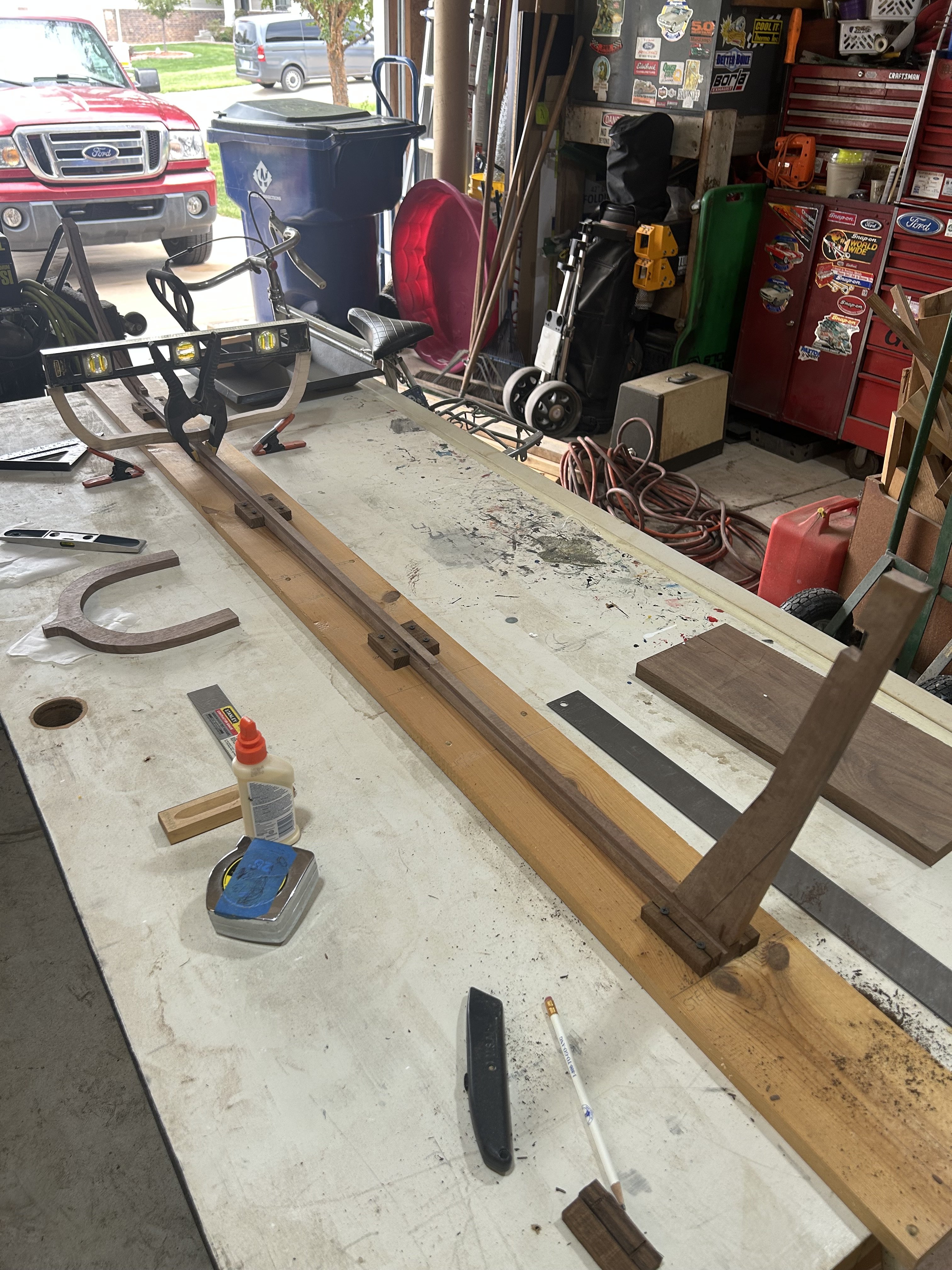

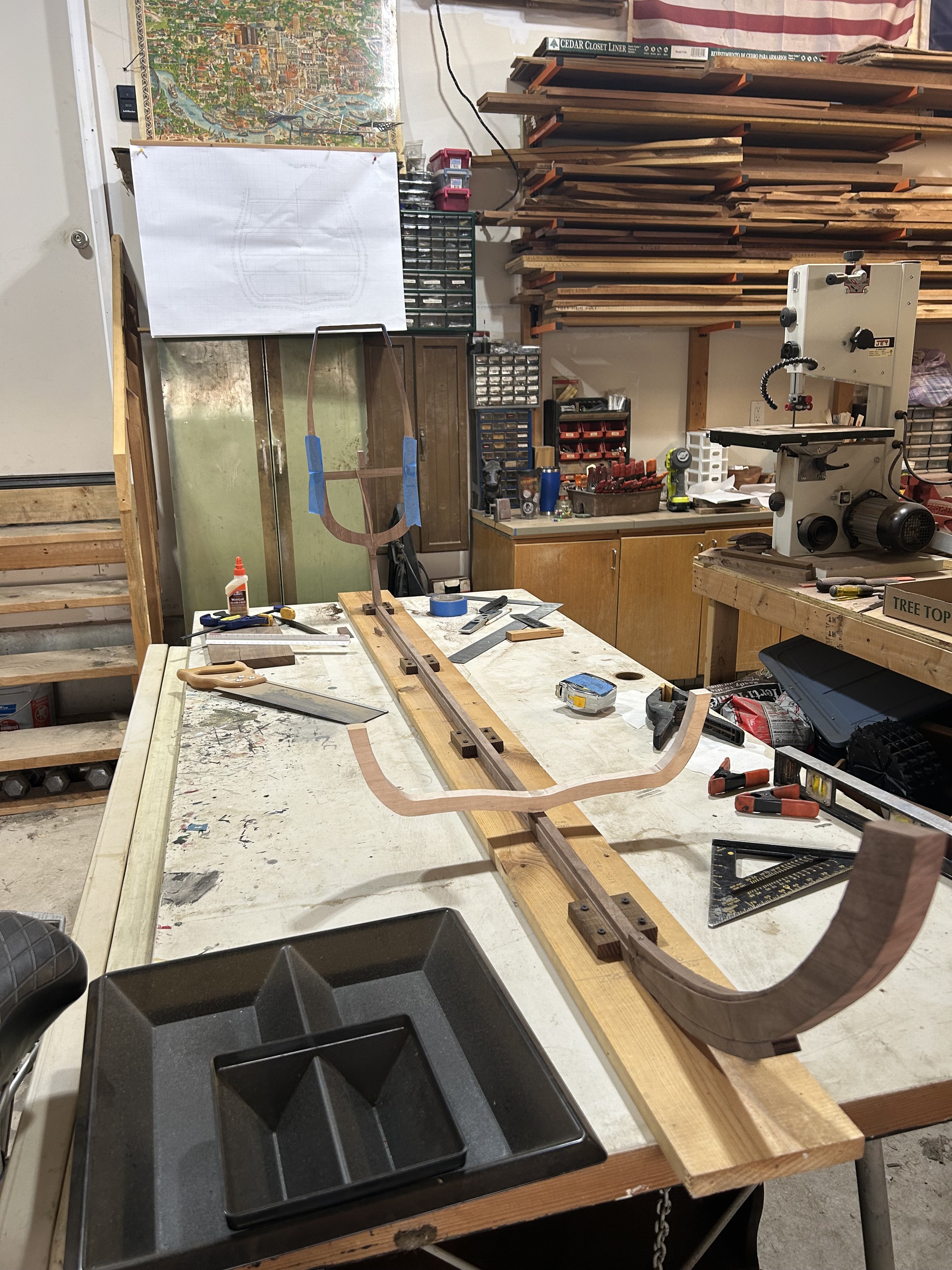

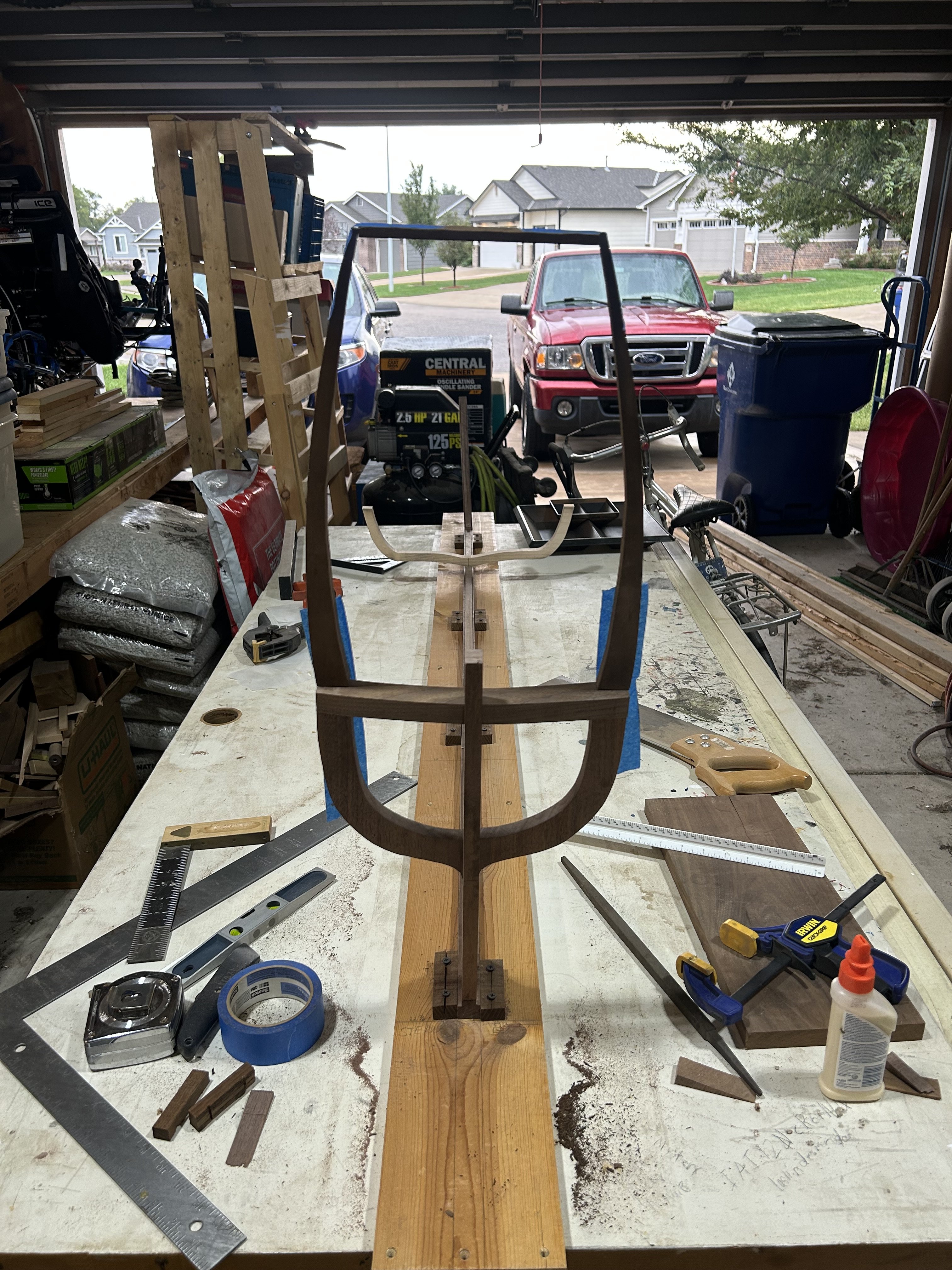

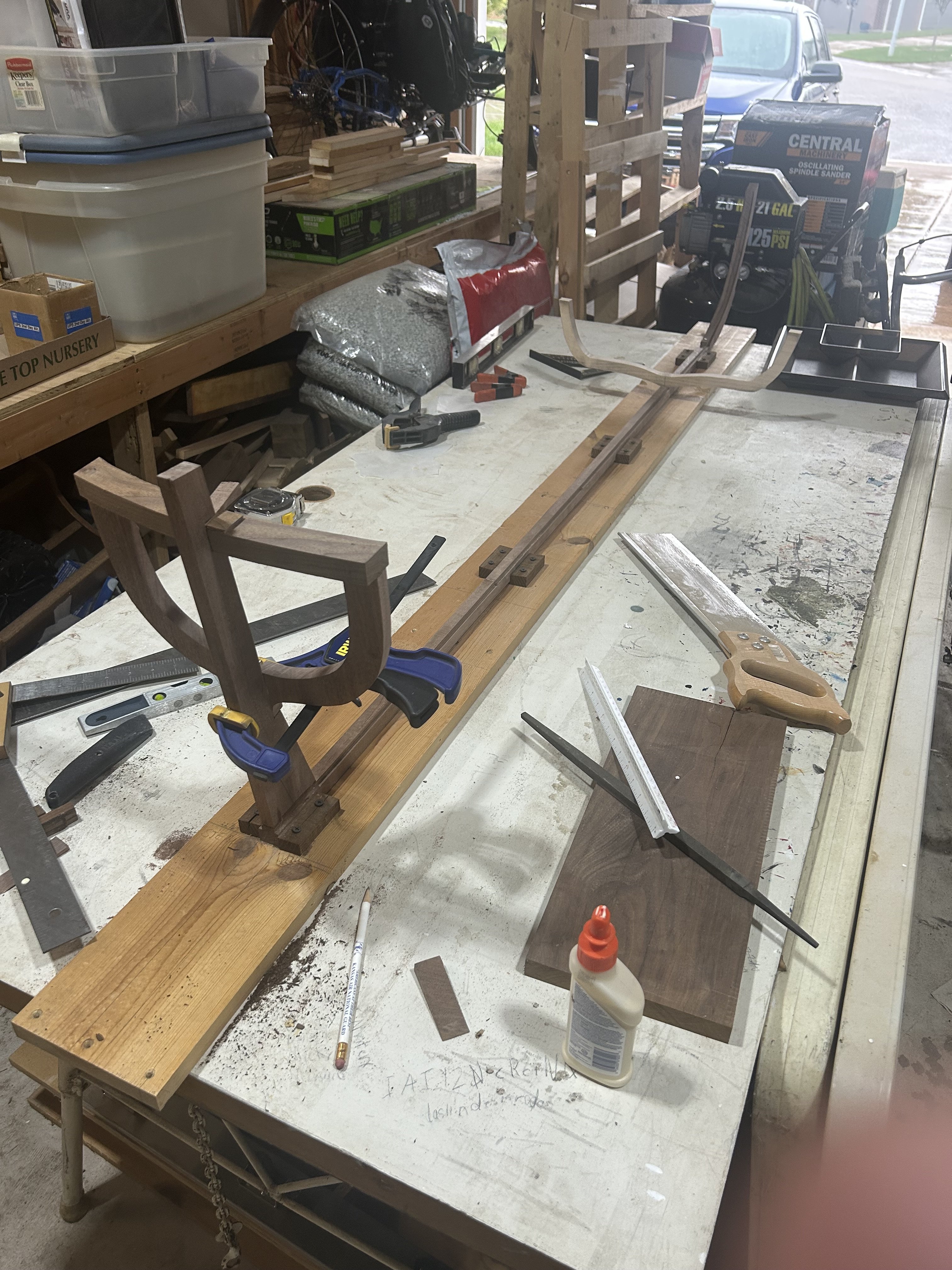

A few new photos to update a little progress. I built the stem and stern posts and attached them to the keel. The keel, stem and stern are made of walnut as will be the wing transom and fashion pieces. I chose this wood for a couple of reasons. The first and main reason is that I wanted these parts to stick out from the framing and planking. Part of this build is educational and so I want to highlight certain areas and one of the ways to do that is to simply change color. These are major structural components that defined the ship's overall size and shape and as such, they hold particular importance over other components. The second was I already had walnut wood in plenty in the required thickness. 😁
While these parts were drying, I worked on the first frame I would add. This frame is located at the widest part of the ship and once placed would give me a clear picture of the size of the model. At its widest point, the frame is nearly 19 inches. As I am not working with a given set of plans or stencils as many kits provide, I have to make my own. As such, I am making my own drawings for several key frames along the length of the ship. These are mainly where data points taken from the actual ship have been recorded and shared during research and preservation. From there, I can make a series of frames to fill in the spaces. After the frames are installed, fairing can be honed in to smooth out the profile.
Next up will be the wing transom and fashion pieces to start building up the stern.

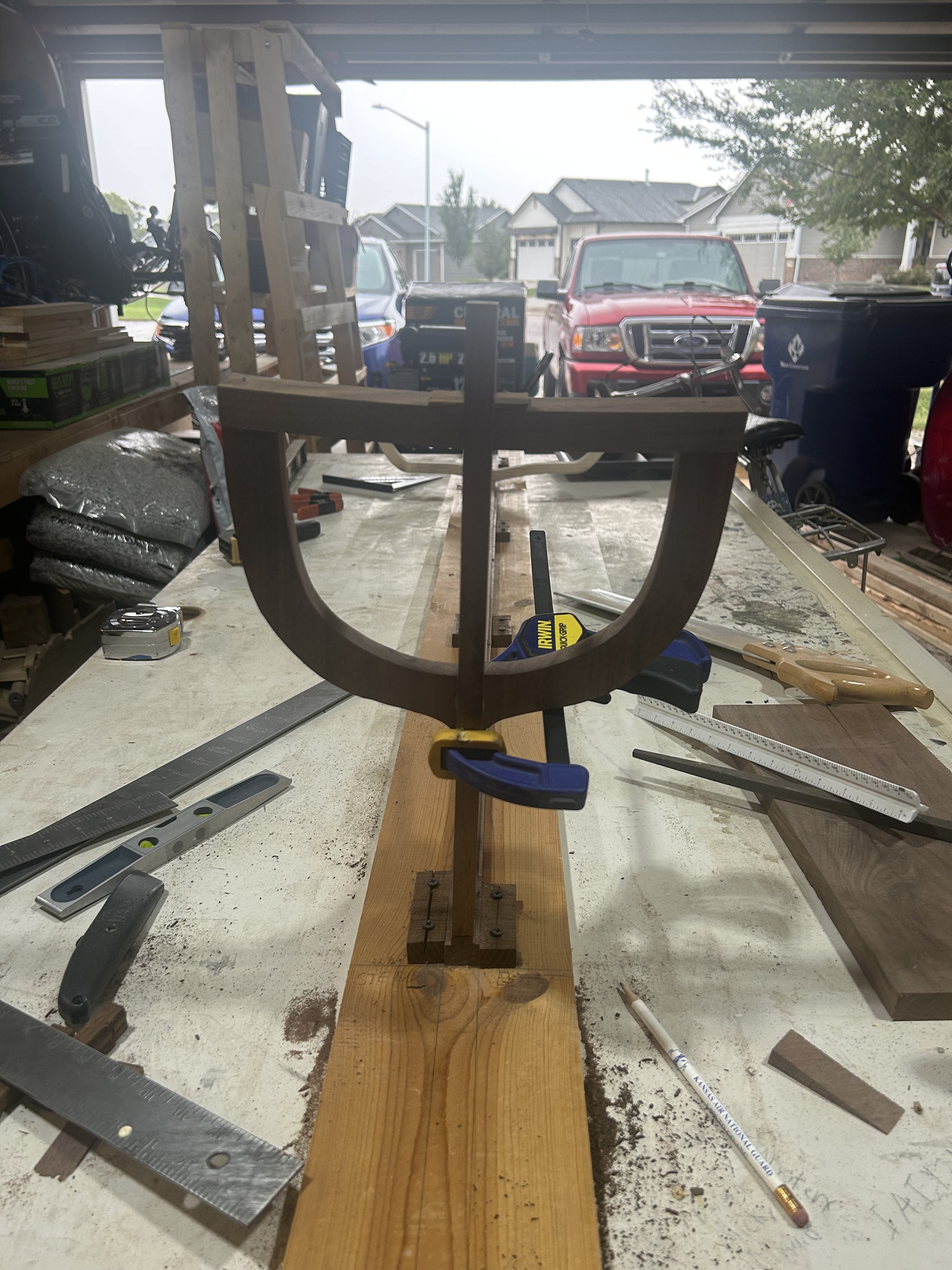

The transom is taking shape with the wing transom and fashion pieces secured in place. I also temporarily set the stern timbers with tape to give a visual of the height of the hull at the poop deck. With these components in place, a general idea of the final size and shape can be seen. On an interesting note, the Vasa is believed to have been constructed with just these components, keel, stem post, stern post, and transom in place and then the framing set with no frames in place. The planks were clamped in place to each other and then frames were added once the shell was formed. I will place my frames first, but it is an interesting and somewhat intimidating method of construction for a ship this size.

Over that span, EJ, I have some concern that your keel plinth and mounting board aren’t up to the long-term task of keeping your keel straight, as the hull takes shape.
Your right and this board is only temporary. This one is mainly just for the setting of the keel and frames. Once the frames are set and I can lock them in with temporary battens, the hull is going to be removed from this board and flipped over onto another temporary mount so I can plank the bottom of the hull to the bilge depth. Then the ship will be flipped back over and set into a more secure cradle that should allow me to continue working with stronger support. A final move to the display cradle will take place sometime during the rigging process when I will have to lower the ship from the current table to the floor in order to accommodate the mast height. Likely when I set the topmasts.
I'm still working on the final display design as I am not sure just how top heavy she is going to be just yet. Another part of the challenge is that I intend to have a lot of the hull opened on the starboard side to allow interior views. This presents a challenge on where any cradle arms rise so they do not block openings. Fortunately, I have time to figure it out and can make tests and adjustments on the construction cradle.

Well, that’s just the thing - if you continue setting frames on this current base, and then lock them in with your battens, then whatever distortion all of that frame weight introduces to your keel will also be locked-in.  I think you will be safer and far less aggravated, in the future, to start from a truly flat and solid base.  This ship will be heavy.
Ah, yes, I understand what you are saying. I thought you were talking side to side, rather than downward with the weight. I was cautious about making sure the board was both solid and flat to not have any humps in it. I think what may be concerning is in a couple of the early pictures it appears that there is a gap under the keel, and in fact there was! The scarf joints caused the keel to rise slightly due to not being cut as perfect mates. This caused the keel to bow upward slightly in the middle. I had to reset the joint, (wood glue truly is strong stuff) and the keel lays flat now.
None the less, the concern is genuine, though I admit, I have been focused more on the side to side alignment of the frames and ensuring that they are level across the top more so than deviations at the keel. I have had a few ships with one side slightly higher than the other before, and even once when it looked like the stem and stern had been twisted opposite each other. Typically these were small deviance's and easy to hide, but on a large scale like this, I will not have that luxury as small defects will be magnified.
I will take another look at the build board and possibly upgrade it and/or the securing blocks. I admit, I'm a bit more concerned about it now...

I wanted to share some of the “behind the scenes” work that I’ve had to do. Here are a couple of the drawings that I created to help in design and build. These are made in 1:24 scale on 2’x3’, 1/4” graph paper. I am making one each for many of the key locations on the ship. This allows me to add or change details on paper before committing to wood.
Using these drawings I trace out individual elements, such as the frames, onto parchment paper. The parchment paper is then cut into stencils that are laid on the wood to transfer the shape. The stencils are saved incase I need to remake a piece and for creating the additional frames between the key ones.
This is a slow process as each drawing takes me anywhere from a couple of hours to days depending upon the level of detail in each one. The two here are of the stem and stern along with the first and last sections of the keel, and the frame that corresponds to the widest part of the ship.

Incredible build! Black walnut make it look very similar to the real one :)
