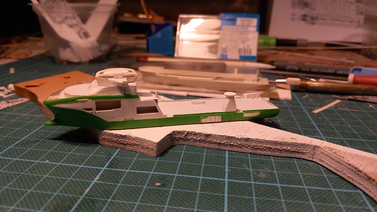

Well here we go.
I got my first commission (sort of) for 2 small 1/1250 ships. Sort of, because I was planning to build those vessels in the future after all. I'm sort of lucky that the client requested a specific scale and simple waterline lay-out. Determining those is something that takes a lot of thinking and time in my case.
1 vessel is a slightly larger version (but a much older vessel) of Scheldt River, so nothing special there. So I won't make a build log for that one.
The other one however is the Viking Neptun. A state-of-the-art Subsea Construction Vessel. She has (in my opinion) very sleek handsome lines, yet a strong purposeful appearance.
Ya'll have to thank @Glen McGuire, for it, since he convinced me to start a build log. I believe it will be a challenge worthy of a log due its accomodation that is largely integrated into its hull/bow.
It has proven to be a head ache during planning already.
As is typical for these vessels, she has a Dynamic Positioning class 3 system. This means she  can hold her position within certain weather boundaries with any defect. For class 3 that means that either an engine, thrusters or even electrical cabling can be disabled without her losing position.
She started her life as a true SCV for the Norwegian Eidesvik company, installing manifolds in oilfields on the bottom of the sea/ocean. Additionally she is equipped with a cable carousel and an optional cable lay system for cable laying ops. She did those as well.
About 1 year ago she was sold to marine dredging and infrastructure company DEME, to be used as a pure cable layer next to the DEME vessel Living Stone.
She received an additional carousel on deck and a dual lane cable lay system, very much like the one from Living Stone.
This cable lay system was built in smaller modules, so I assume it will be easy to remove in case subsea construction activities would be planned.
For me the livery is quite difficult. I like the race-car red and yellow more than the yellow green-white livery.
However, the client decided to go for the DEME version with full option, which means both the carousel and cable lay system on deck.

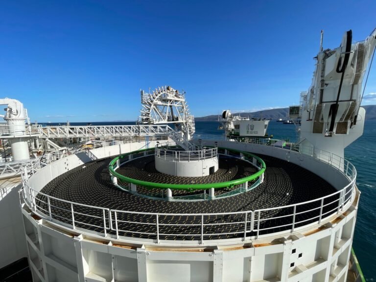

You can put a lot of cable in there... She  also still has her original carousel below deck, for a total of around 12000t of cable.

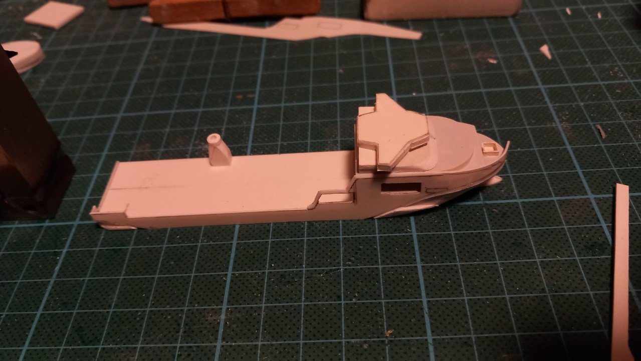

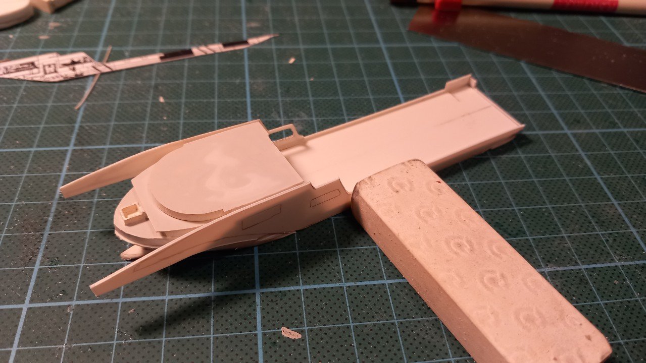

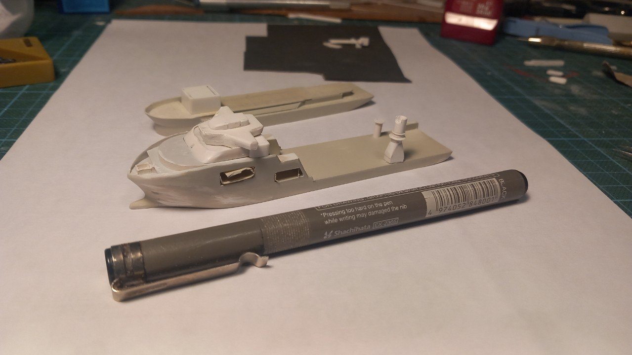

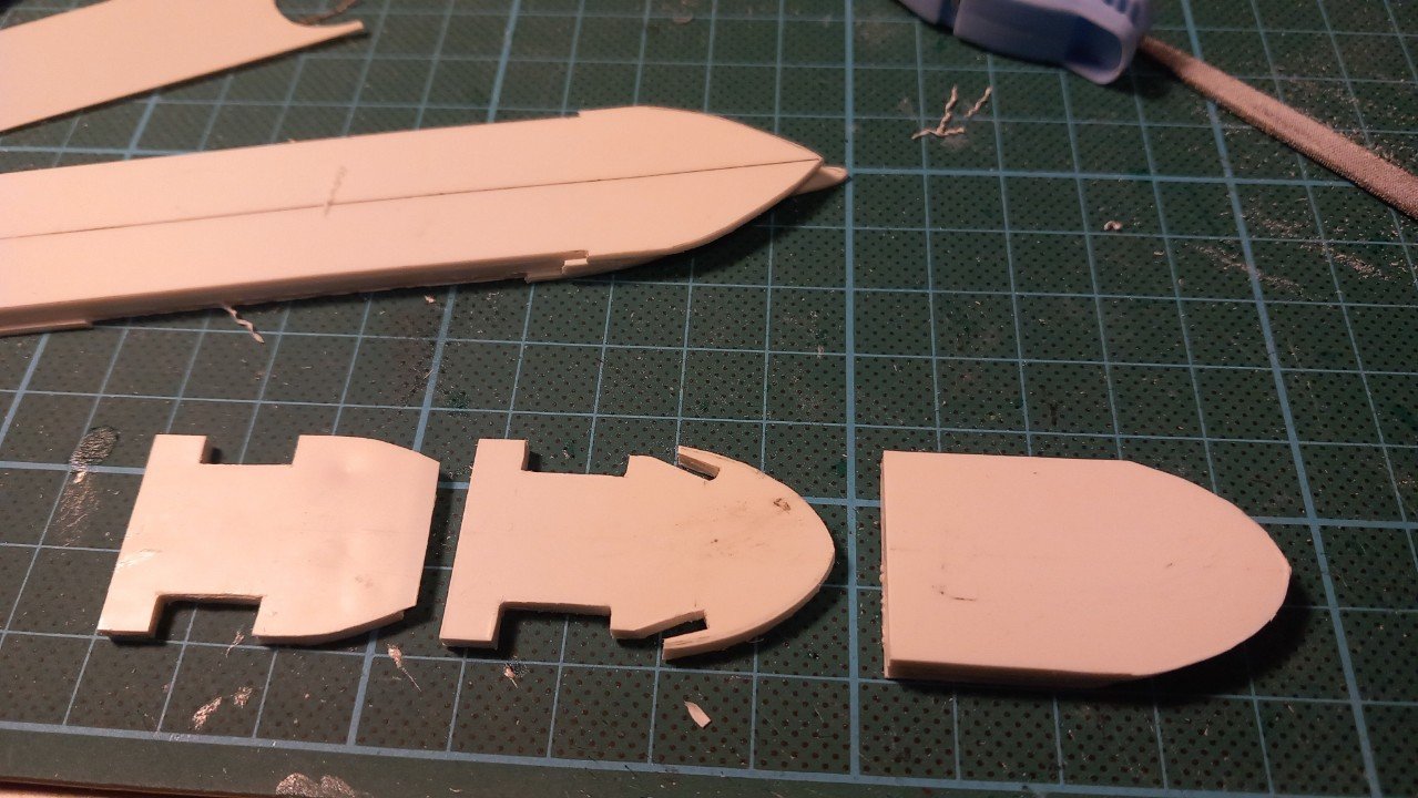

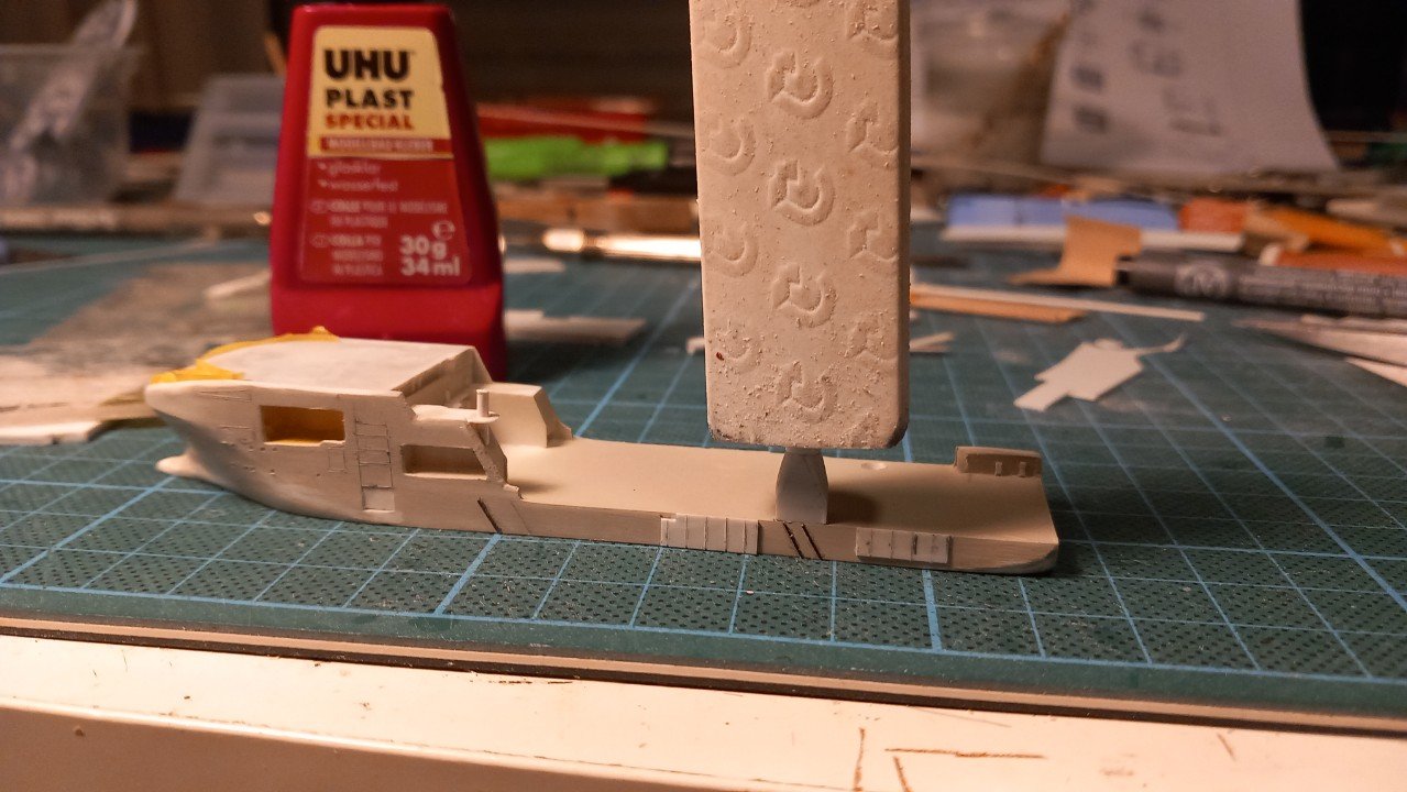

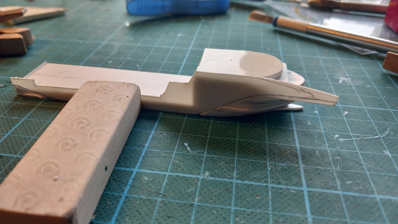

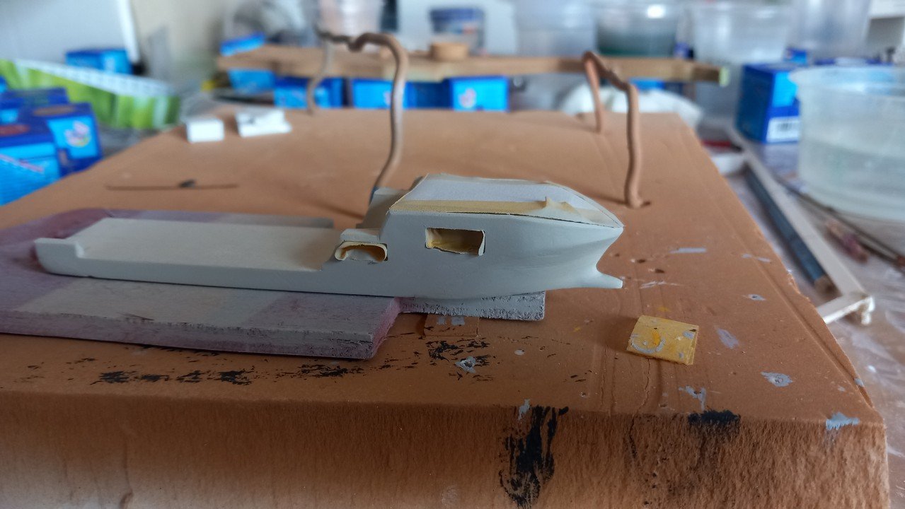

In the meanwhile I've been building. I have also started building the second vessel (named Lange Wapper), since I want to do a few actions, like applying putty, building lifeboats etc. in 1 go rather than sequential.
So , construction will be a sandwich of different thicknesses. First a combination for each level, then a combination of different levels in blocks.
Eventually I will wrap the whole thing in a 0.5mm outer shell, where all openings and portholes will be cut/drilled.
The complexity of this build lays of course in determining where the openings will be and which part of the inner blocks will be visible through the outer hull holes.
Blocks going together.
For the largest openings, where the lifeboats will be located I opted for walls, to hide any seams in the stack.
Those are then cut and filed flush with the surrounding surfaces. As you can see I have also mounted the aft bulkhead of the superstructure. This is only glued to the lower 2 levels. The upper levels are still dry fitted, since I need to detail those before the outer shell is placed.
And a test version of the outer shell to show the concept.
The sides of the stack are uneven and rough, those will of course be sanded flush before that outer shell goes on.
Roel

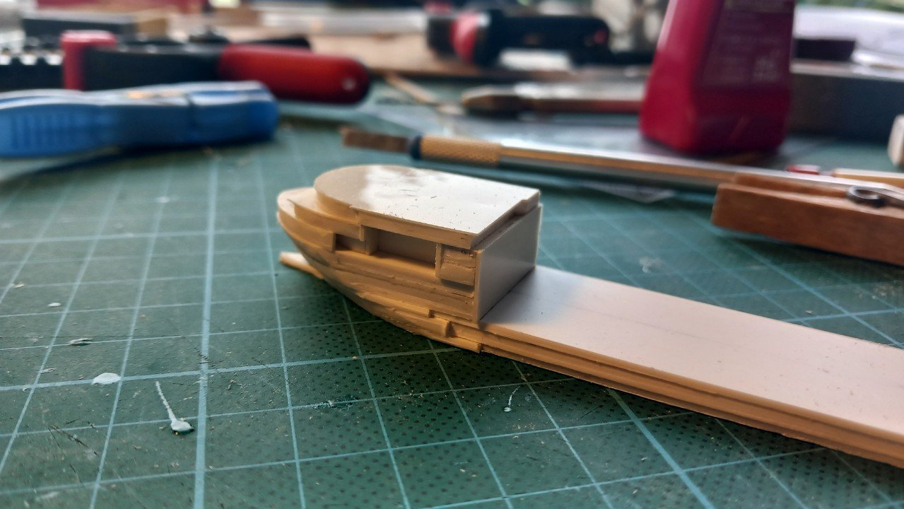

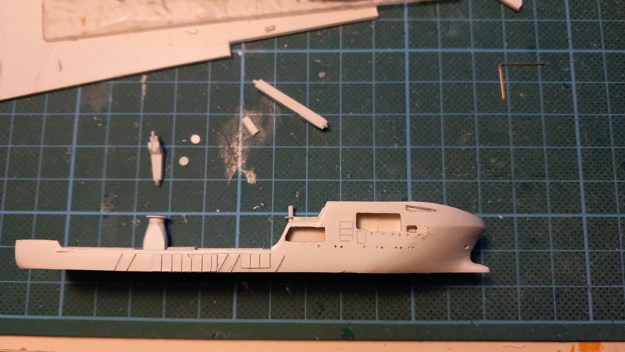

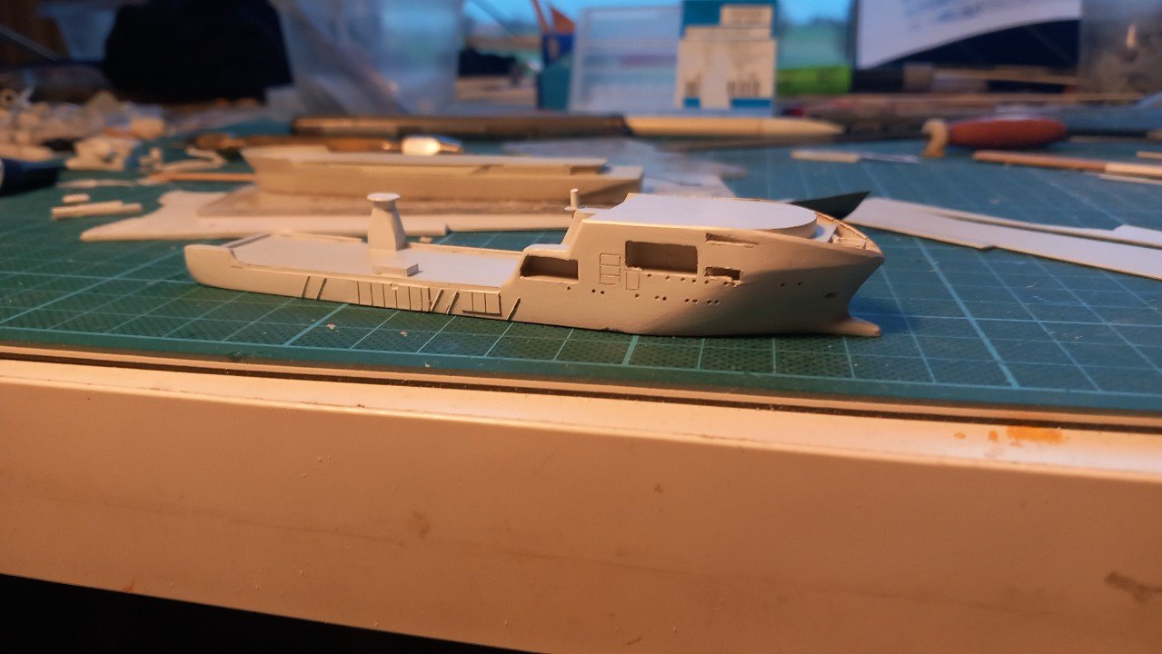

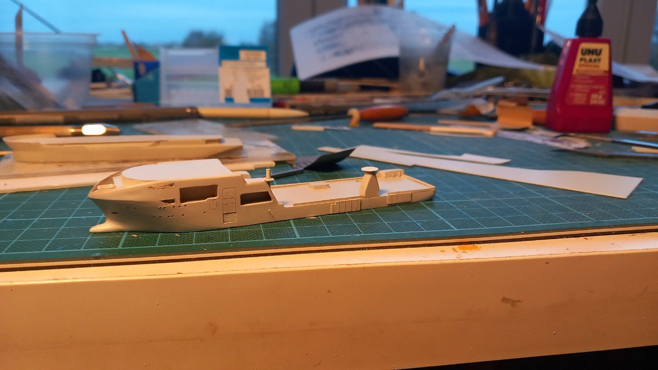

And you're off and running, is the outer shell card?
Plasticard 😄, so no, not really. It's styrene sheet. I do normally make paper and cardboard templates before shifting to styrene. In this case, due to its small size, I opted to go directly to styrene.
I have 0.3mm available, which would give me sharper edges, but there are 2 issues with that.
First one is that it melts excessively with the glue when used as a cover surface, this leaves bumps and pits in the surface. 0.5mm sheet retains its flatness.
Second is more related to this build and that is simply the angled upper edge of the forward area.
Some may not have noticed this, but the edge along the whole accommodation and along the aft edge down to the main deck is angled. The 0.5mm thickness allows me to recreate that angle by carving and filling along that edge.

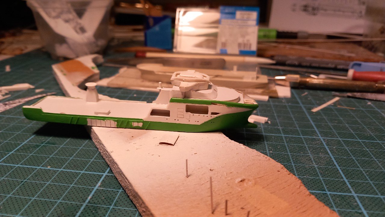

I currently started adding details and painting the some parts before  I can place the sides. I'm also refining those sides, starting to cut the openings for lifeboat and rescue boat and carves that angled upper edge on the SB side.
The fore deck has a swimming pool, which I built from 0.3mm styrene.
All of that will mostly be covered by the helicopter deck though.
What I love about this scale is that you can always continue building something. Even when you have a failure, due to its small size, it's easy to rebuild.

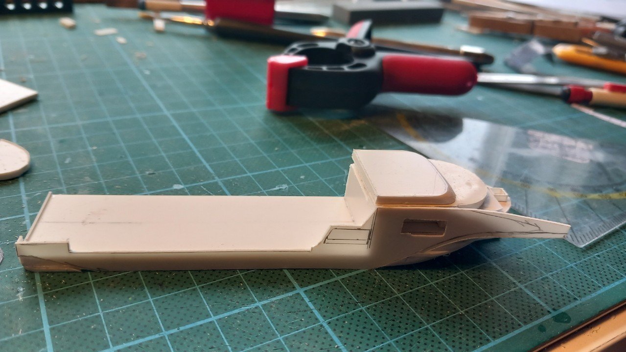

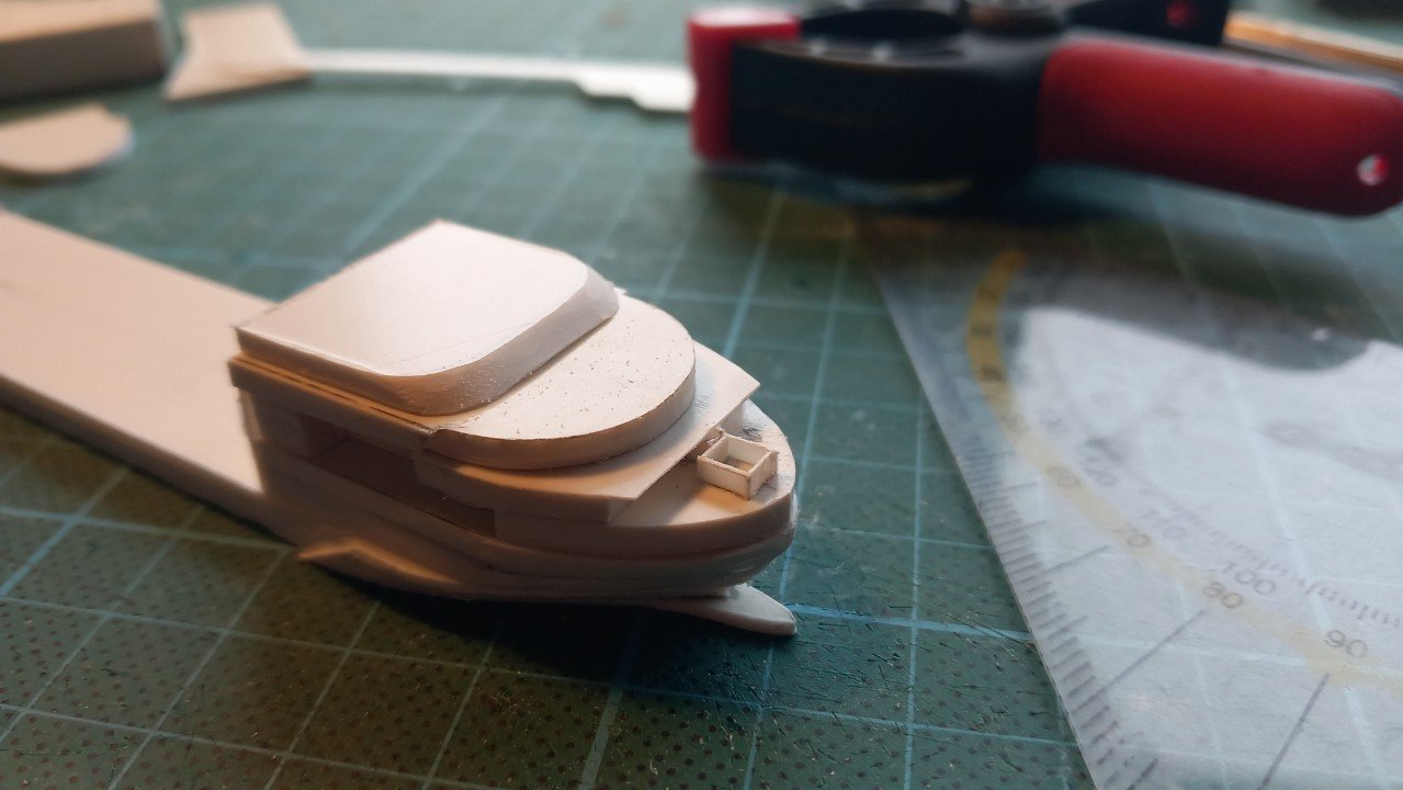

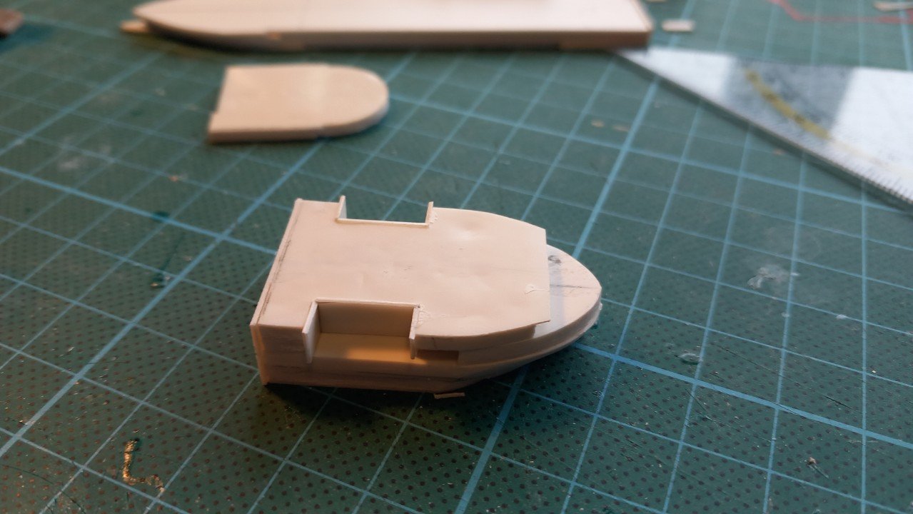

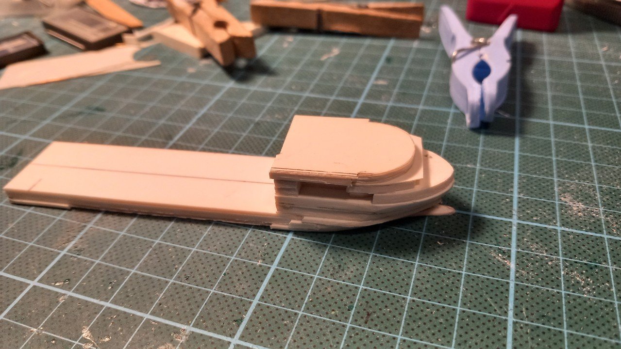

In the meantime I have also built the first part of the bridge and large angled level below it.
These parts really look like a starship and are a lot more complicated than expected. Every part seems interconnected rather than stacked and that bridge hardly has any straight surfaces.
Edited by Javelin
Roel

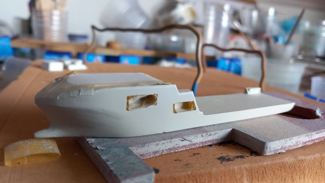

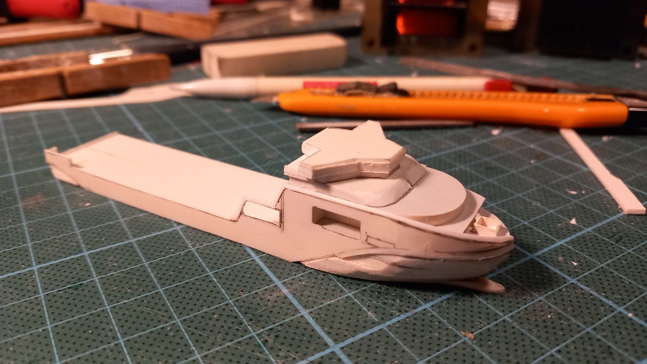

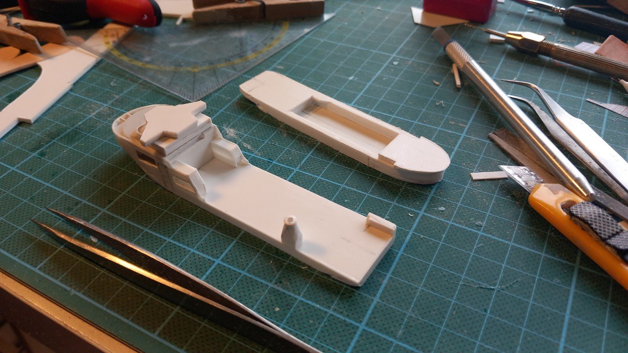

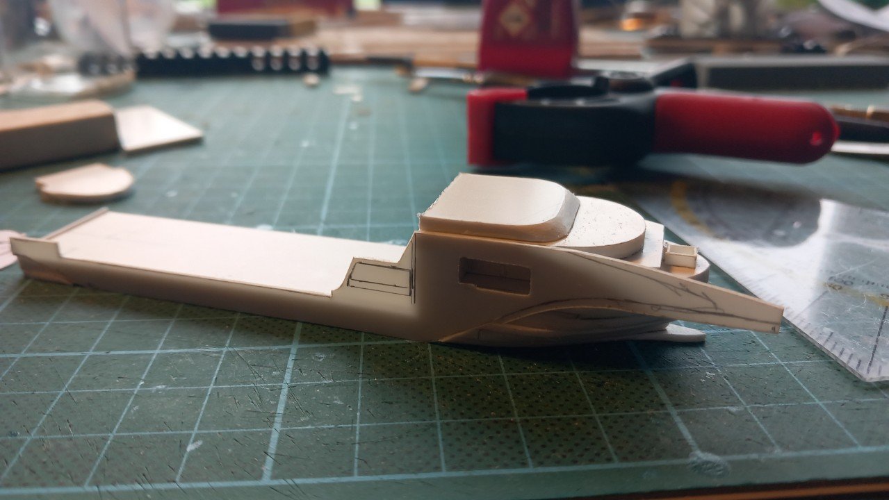

And today's progress.
Continued adding some meat to the bridge level and mounted the first side shell.
Decided to only put the large openings before mounting the shell to the hull.
The small openings should be ok to cut afterwards, but would probably prove troublesome to cover for painting if I had cut them before.
Also made a start on the crane pedestal. These are nice side projects when the glue is drying on hull or bridge parts.
Edited by Javelin
Roel

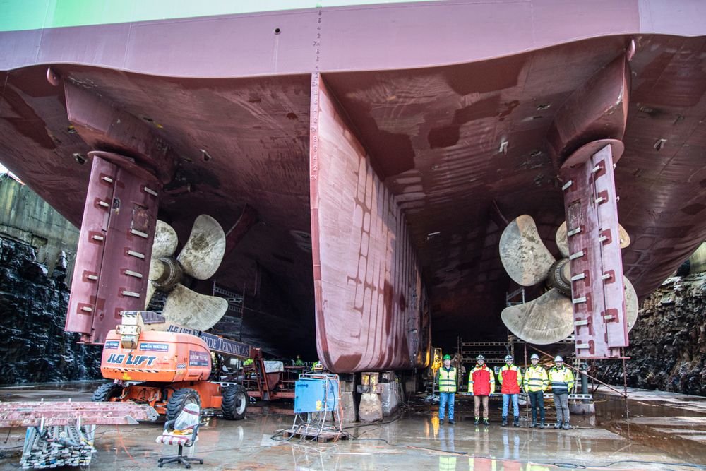

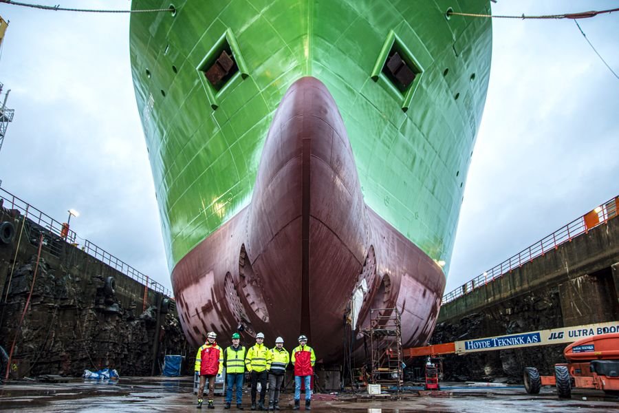

A litte more about that real ship. This is not relevant for this build, since this is a waterline model. (perhaps for a future racecar red version?).
What makes her somewhat special for a modern offshore DYnamic Positioning vessel is her rather conventional propulsion. Where most vessels in these classes are relying purely on azipods/twin pods etc. Basically propellors that can be turned 360°, Viking Neptun has a conventional twin propellor-twin rudder propulsion.
In addition, she has 2 regular bow thrusters, 3 stern thrusters and just behind the bow thrusters, 2 retractable azipod thrusters.
That's a lot of power and thrusters to hold position and heading. You don't want to tangle lines 2km below the waterline...
As mentioned, a lot of them are simply redundant, so that in case of failure of one thruster, or a complete power production unit, she can still maintain that position and heading.
As a disadvantage, this means all engines and thrusters need to run during DP operation, which means the engines are continuously running at very low power, which they really don't like.
In above picture you can see the  rudders are of the Becker type, which means there is an additional piece that hinges in the same direction as the rudder, this doubles the effect of the rudder, so a 10° rudder angle on this type of rudder equals a 20° angle on a normal rudder. They can also often be used at greater angles, creating a nearly 90° deflection.
The propellers are variable pitch propellors, the blades can rotate hydraulically, to change the thrust  while keeping the same rpm. This means they are less efficient (compared to fixed pitch) for pure sailing, but makes the vessel much easier to manoeuvre.

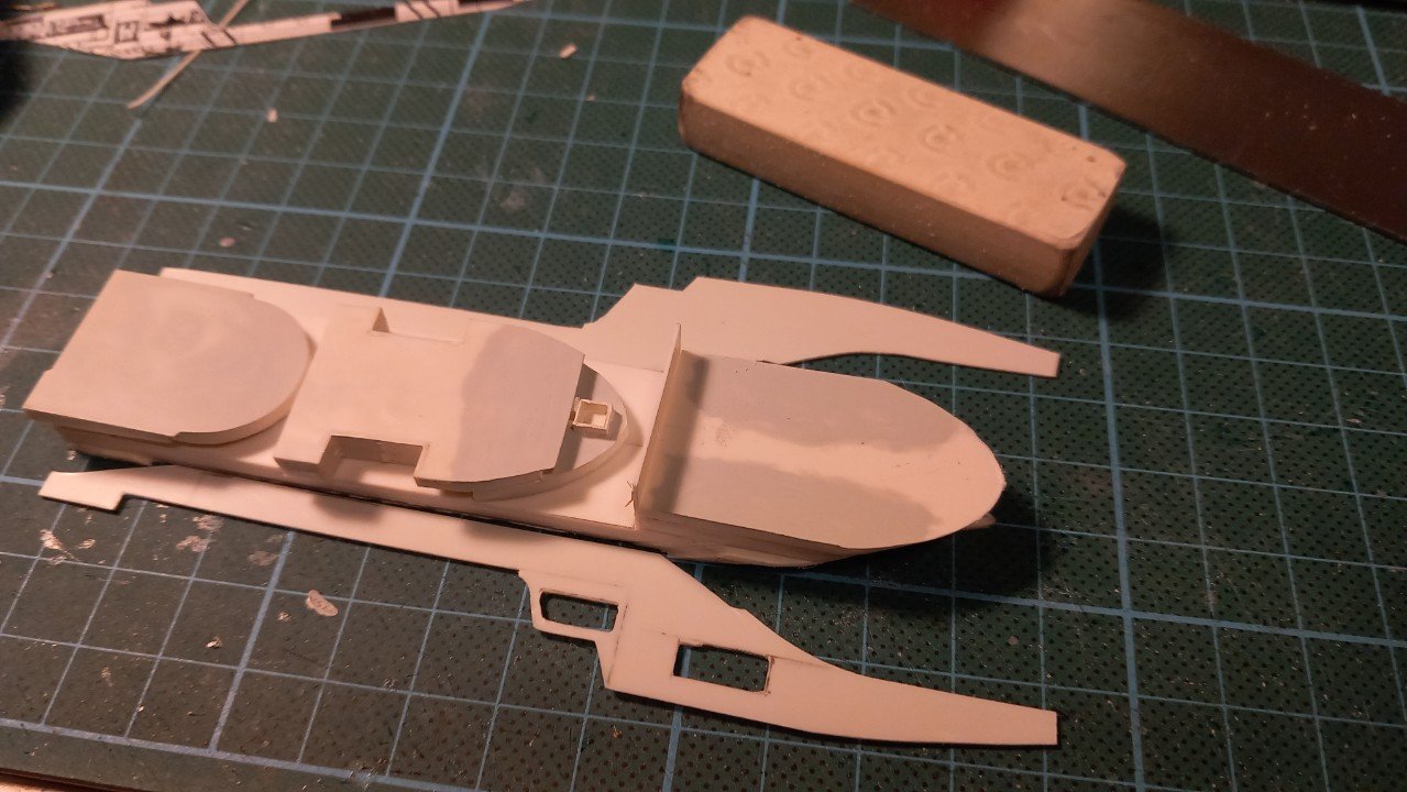

As for the model, this may be the last post for a while as I've come at the point where I have to smoothen the hull with Milliput epoxy filler (followed by a coat of spray filler).
However, before I do that, I need to bring the second hull to a similar state, so I can apply the filler on both hulls at the same time. Looking at it today, I noticed I underestimated the complexity of the second hull, meaning I will need to progress it much further than expected.
I also closed the side galleries for the rescue boats on Viking Neptun.
The pedestal is only dry fitted, it'll be in the way for filler application and sanding afterwards.
The bridge and level below are also only roughly shaped. They'll have to wait until the hulls are ready.
Edited by Javelin
Roel

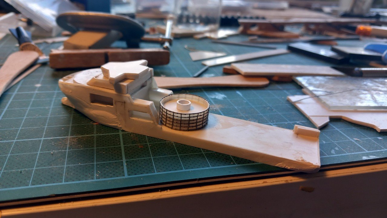

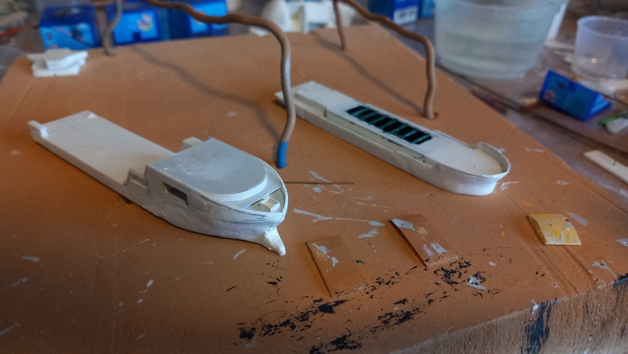

So, finally got to the stage of putting epoxy putty on them. Now on to some hours of sanding and probably filling some smaller pits.

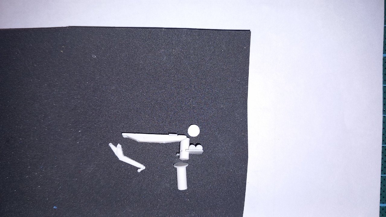

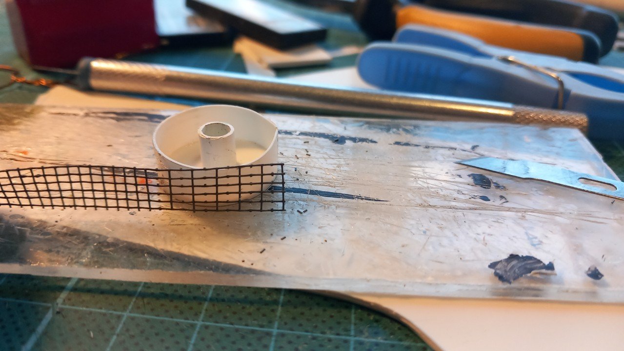

In the meanwhile I started work on the carousel. First tried to get the proper dimension by turning a piece of PVC pipe I had laying around, but the dimensions were still just too large and thick, so I eventually built it up from a disc with 0.3mm side shell.
As you can see, it's not perfectly round (slightly pointy on the right),  so I decided to make it look as if it is partially filled with cable.
Put some filler bars on the bottom and then forced in another disc, somewhere midway. By gluing the shell to that disc, it did become nice and cylindrical.
I then tried to put copper wires to get the horizontal stiffeners. However, the amount of vertical stiffeners was goint to cost a lot of time...
So, since laziness is the mother of invention, I went to check some fly screen netting. It seemed quite right, thickness not too much, vertical spacing perfect. All I needed to do was cut out every other vertical stanchion.
It's not perfect, but better than a bland looking wall. It'll all be painted white after all.
Both vessels will now be sanded and continued until I can apply some spray filler/primer. Then their paths will diverge again.

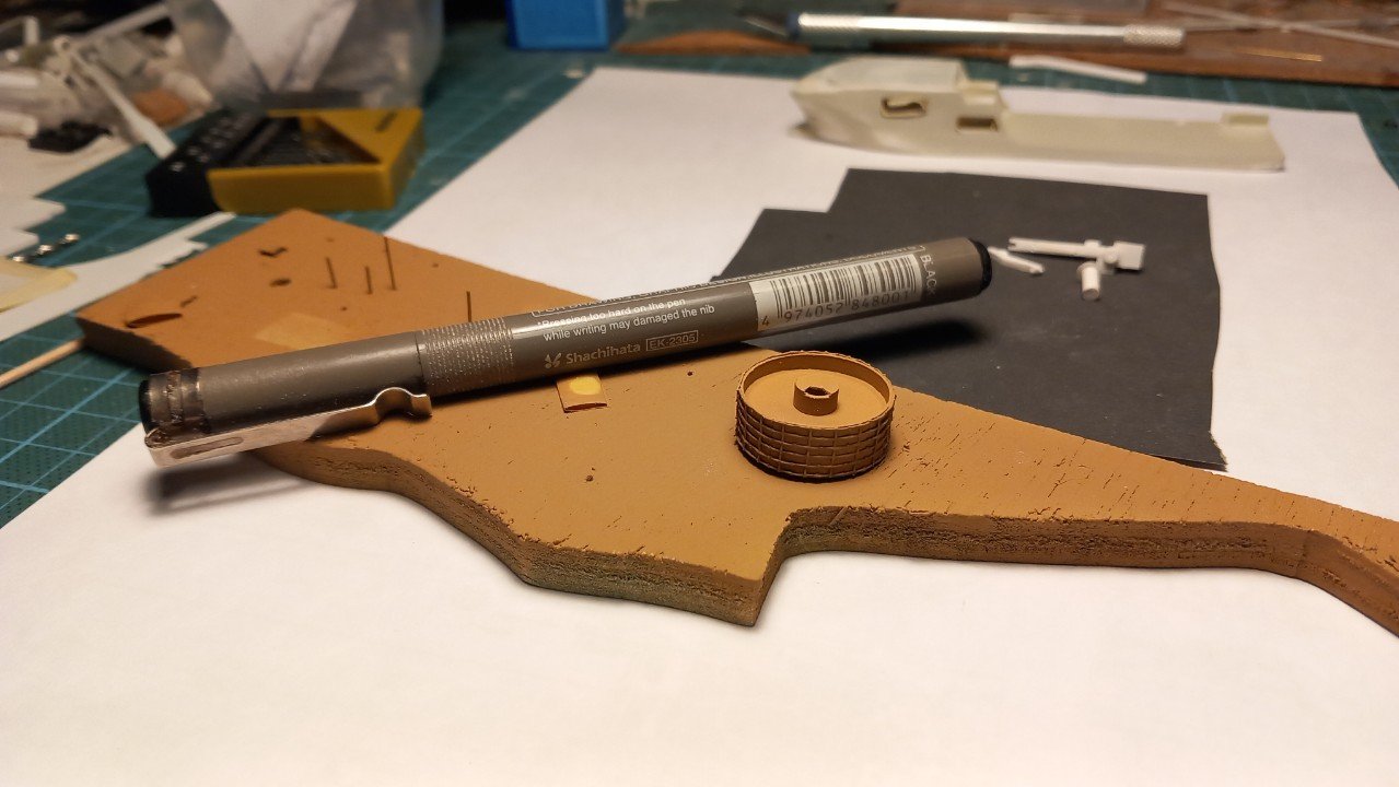

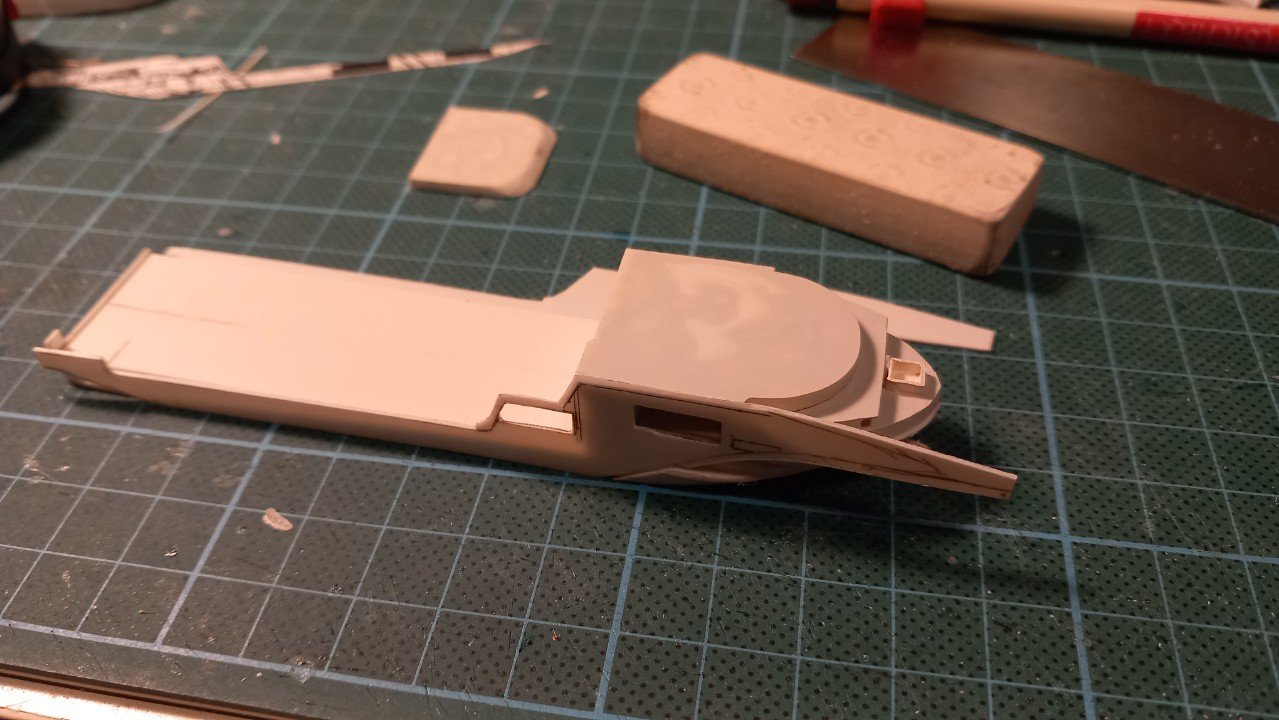

On to the model.
The carousel got its primer.
The vessels had additional putty and spray putty applied.
On Viking Neptun, I now sanded her with fine grit sanding paper, cut out the recesses for the anchors and started drilling portholes.
Will probably continue detailing the sides, scribing lines etc. before continuing to primer, then white and finally the yellow-green.
Haven't determined yet if I'll add the wooden landing areas and rubber bar fenders on the side of the vessel before spraying the primer or after...
During drying of both vessels, I also proceeded on the auxiliary crane. I believe her main hoist is 100T SWL, also with a wire length of 3000m. It also has a lighter auxiliary hoist. The main hoist does have its wire on a big drum on the back of the crane itself.
In different pictures of the real vessel you will see the crane jib rests and even the auxiliary crane itself, are being moved around on deck. This is done during preparation of projects (called mobilisations) and adds to the cost of such offshore projects.
Edited by Javelin
layout - picture position
Roel
Even in this early stage she's really starting to look the part, Roel.

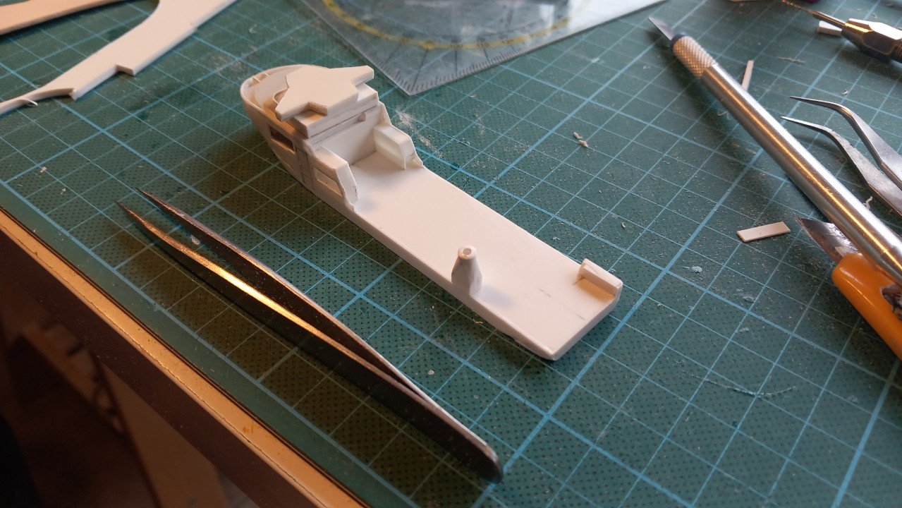

Short update this time.

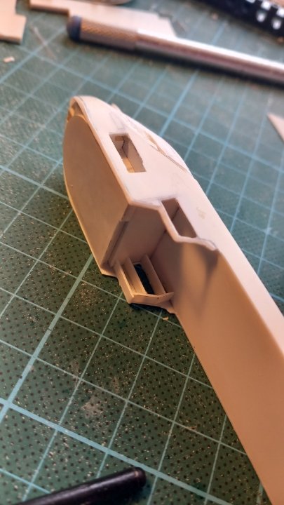

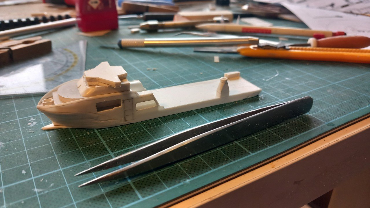

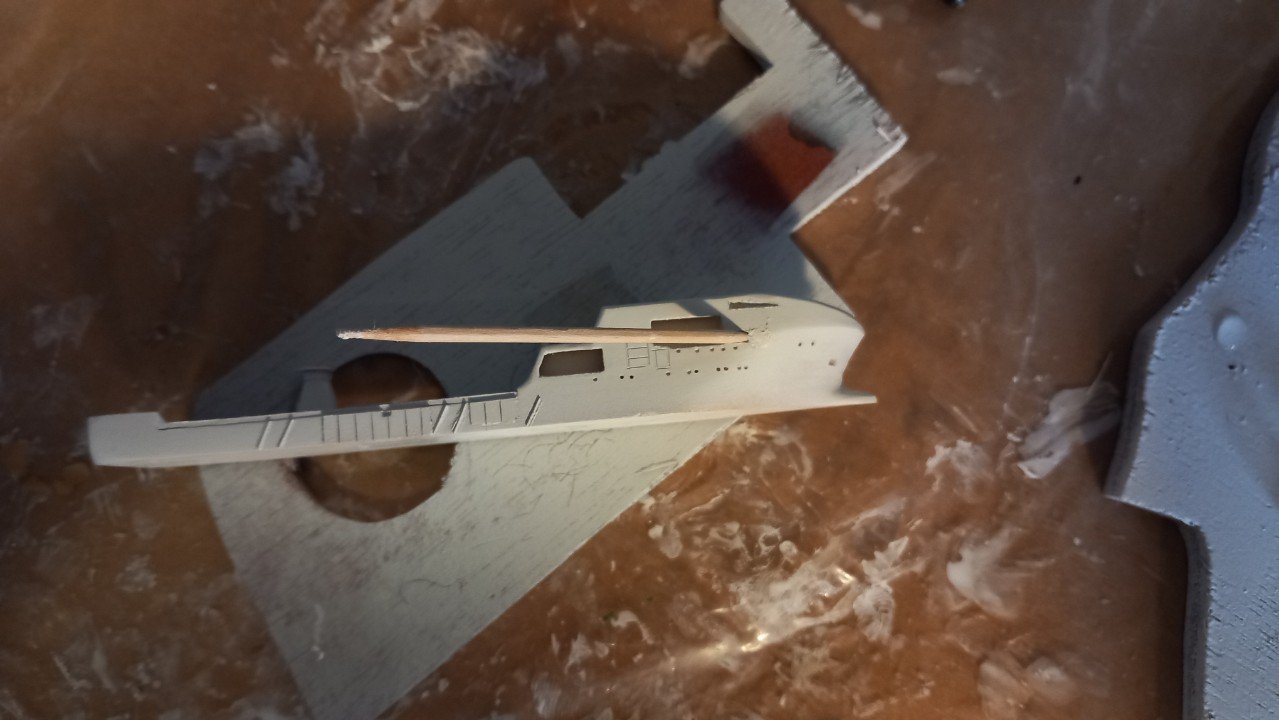

Tricky detail on the portside is a partly recessed piece, where the panel of the ROV slides down when the A frame is deployed.
I had foreseen this, but didn't want to cut it out before mounting the sides in case it wouldn't be perfectly in the right spot.
So I decided to carve it out now, removing a piece of 0.5mm, and replacing a small 0.3mm panel inside the hole. This way I got a 0.2mm recess, which is about right at this scale.

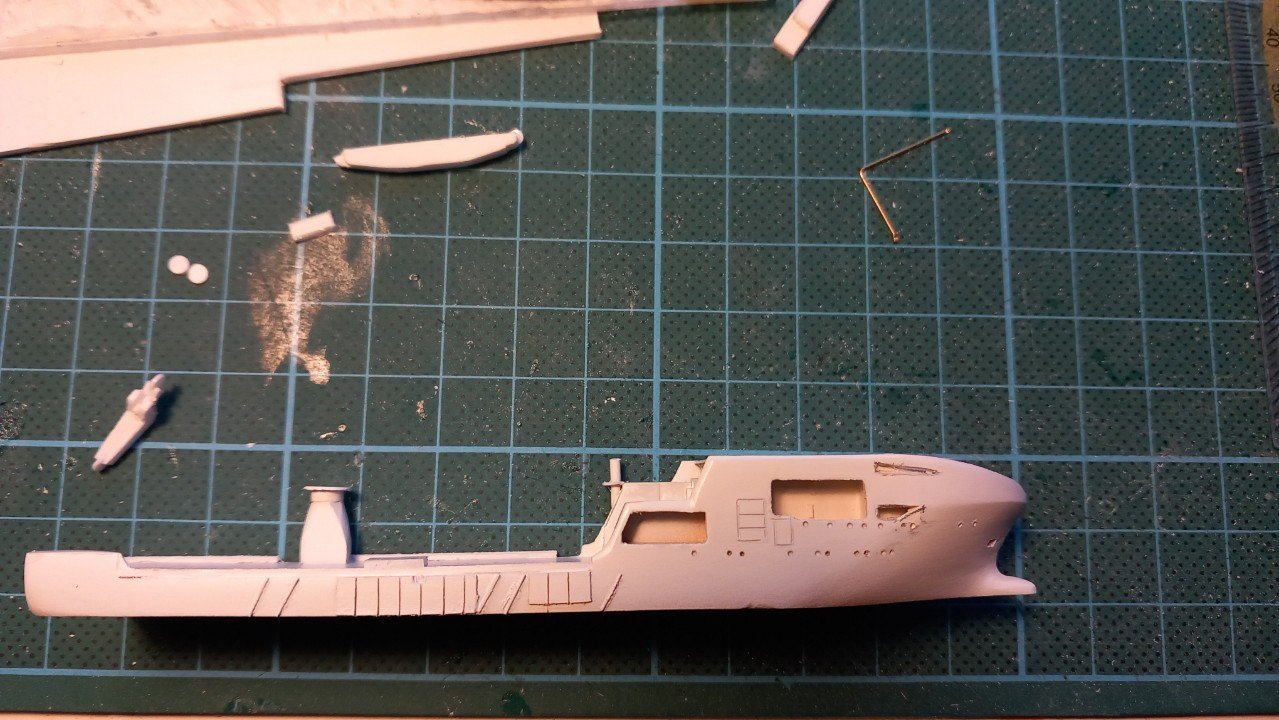

I also scribed some panel lines and the areas that are to be removed after the white paint is applied.
Decided to add more detail, including those fenders, wooden landing areas and bulwarks on the aft. Crane pedestal is fused into the bulwarks, so that one is being placed before primer as well.
I'll put this one in primer and prepare the Lange Wapper for primer while VN dries.

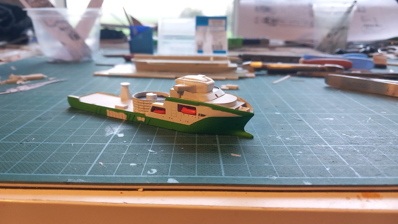

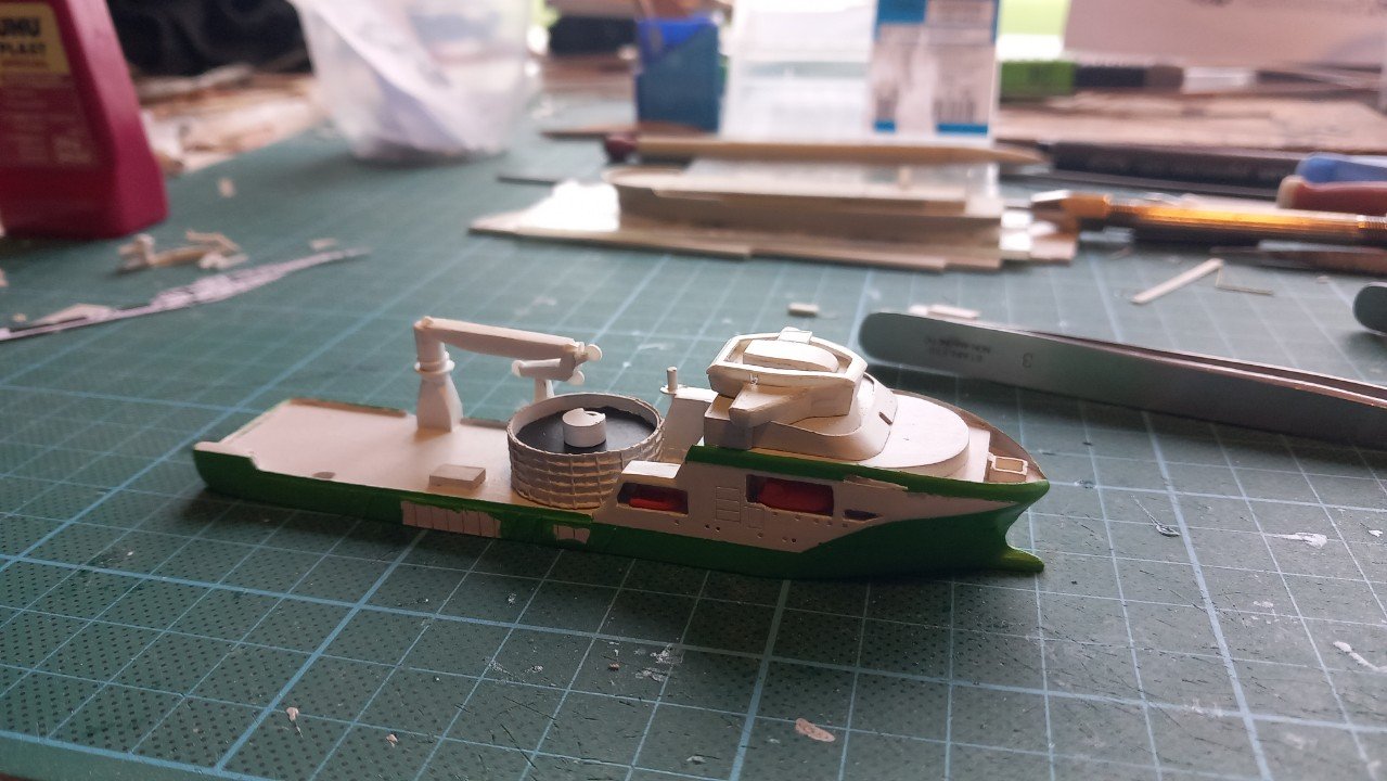

Today a rather big step forward. She, along with some parts, received her coat of primer and final coat of white, for the white parts that is.
I'll let it dry thoroughly before masking the white and putting the yellow-green.

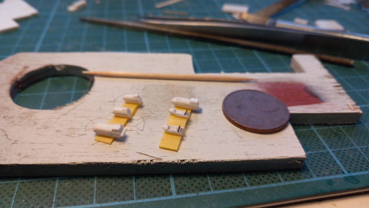

Additionally, I finished the lifeboats, but I'm waiting to paint them until I finish the ones from Lange Wapper and the 2 rescue boats from VN.
As you can see, I've also continued on that complicated and fancy looking bridge top.
Roel
 Her finished shape is starting to emerge and is looking great, Roel. 👍

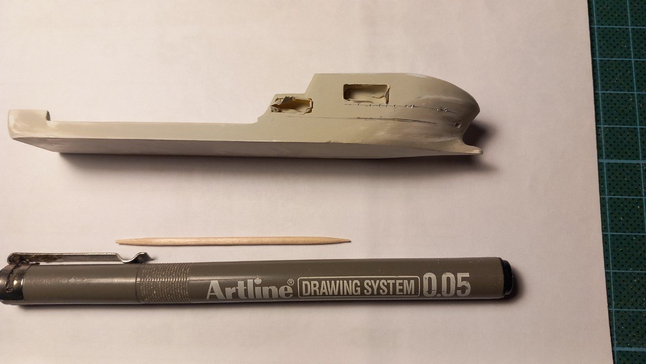

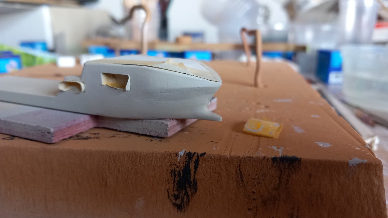

It looked quite ok to cut the small openings in the hull, but I guess lack of patience got the better of me...
The parts where I needed to cut were unsupported 0.5mm styrene and noticed small cracks in the paint when I started putting some force on the knife.
I also drilled the corners, as usually, as this prevents propagation of a cut and allows an angle on the knife.
The cracks in the paint were acceptable, but on one hole, disaster struck... I assume the styrene may have been weakened by the sanding, and my knife wasn't the sharpest in the pile. In any case, the forward edge gave way and a piece broke out.
The other side was acceptable.
Time for a repair. It's not very elegant, but least I learned a couple of lessons again. Difficult to put in the filler as there was nothing to support it.
Luckily I thought about removing that tooth pick in time because it was almost stuck to that filler.
Time to redrill the portholes and sand the repair smooth.
And then careful cutting with a sharpened knife.
In the meanwhile I also continued the main crane and prepared the lifeboats and rescue boats for VN and Lange Wapper. Notice the difference in VN's lifeboats and Lange Wapper's. Offshore vessels often have a crew (and many visitors, representatives etc.) of 70 to 100 people, while dredging vessels are often limited to 15-30 people.
I believe I will have to give the vessel another coat of white to fix the tiny cracks and cover the repair (although most of it would actually end up yellow-green).

As for VN, this where we were yesterday. It still needs some fixes, but overall it's quite ok. Of course I also still need to paint the black tube fenders and wooden (grey-ish) landing areas.
Roel
Oh, wow, that little bit of paint made a huge difference, Roel.
