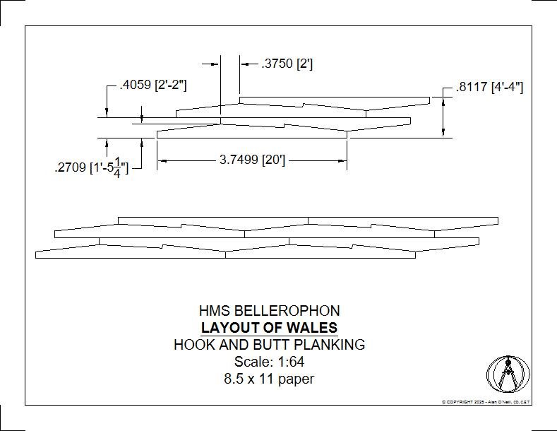

I drew some 20 foot long hook and butt planks at 1:64 scale using DraftSight to make a straight plank template.
(The pattern drawing that was here has been removed. You can find the updated drawing posted  on 6 Sept 2025)

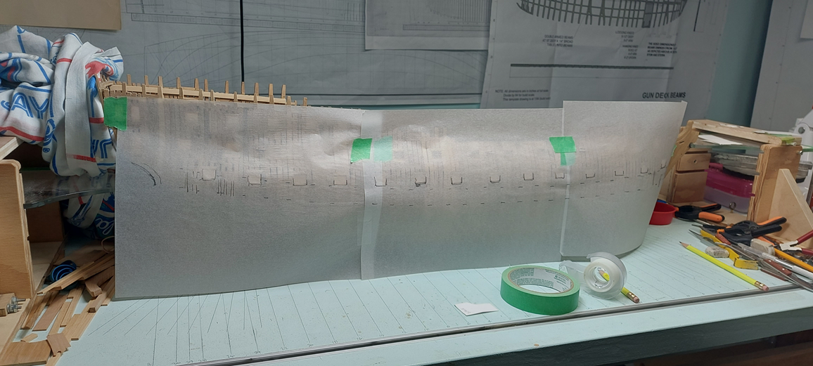

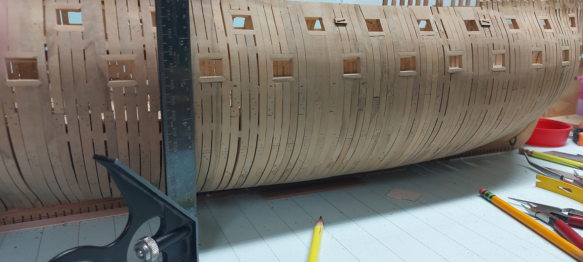

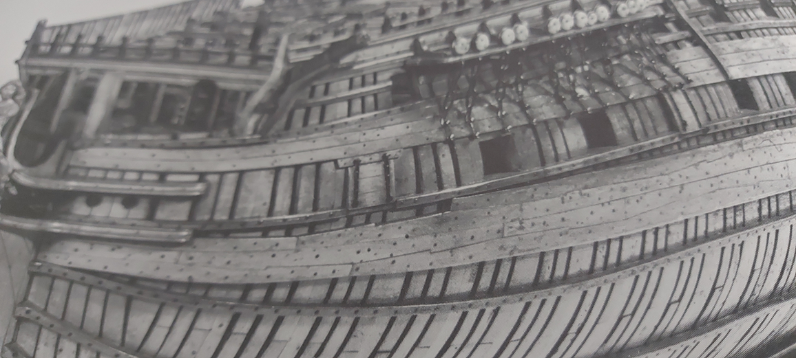

I measure off the NMM plan and converted the measurements from 1:48 to 1:64 scale. These were transferred to my timbers.

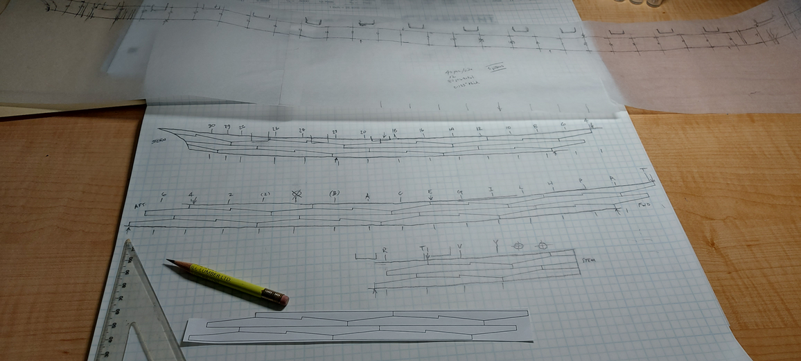

I then attached sheets of tracing paper to the model and transferred these marks to it along with some other details (gun port openings, hawse pipes holes, butt to stem post and end at the aft).
This curvature was then transposed to transparent graph paper. The printed straight plank template was cut out and slipped below and my curved templates were traced onto the graph paper.
I will be using black walnut for the wales. This stock will be cut and sanded to thickness and then two sheets rubber cemented together to allow me to cut both individual identical port and starboard planks at one time. I cannot use my black carbon paper to trace these shapes as it will be difficult to see the outline on black walnut so I’ve ordered a package of white carbon paper for the job!

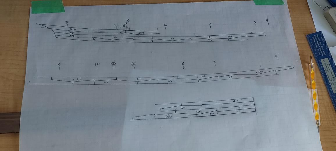

I cut all the jigsaw pieces and then fitted them together on top of the plan I made. It required considerable fiddley adjustments to all pieces... sort of akin to chasing your own tail.

After a longer stare at photos and getting some priceless advice from David, I've reworked my layout of the main wales to have long straight runs at the stem post and stern.
The hook on all my two lower runs was backwards so they need to be remade.
I've separated the "good" from the "bad" and am re-tracing the "need to remake" pieces now.
I'm going to need more wood prepared for this.

Here is the new pattern. The earlier version has been removed so no one else needs to follow that path of horrors.
(***All: I had images here but deleted them as I will be laying it all out all over again per post 1771)
Edited by AON
Alan O'Neill
Well, that looks more plausible, but are the lengths 24' 0" ? They look a bit short. The other little item to observe is the lowest plank aft in the lower strake. It is a short piece (if you've arranged everything else correctly) as it was cut to shape and fitted rather than bent. The piece curls as well as curves around to the outer end of the wing transom.
Check the RMG web site and search 'planking expansion' for examples.
