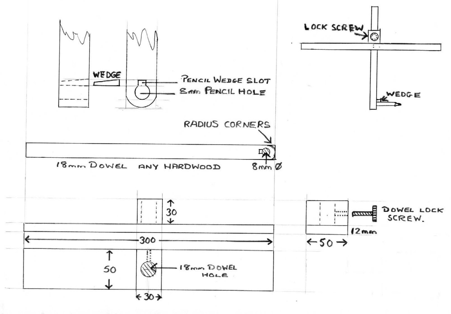

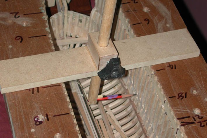

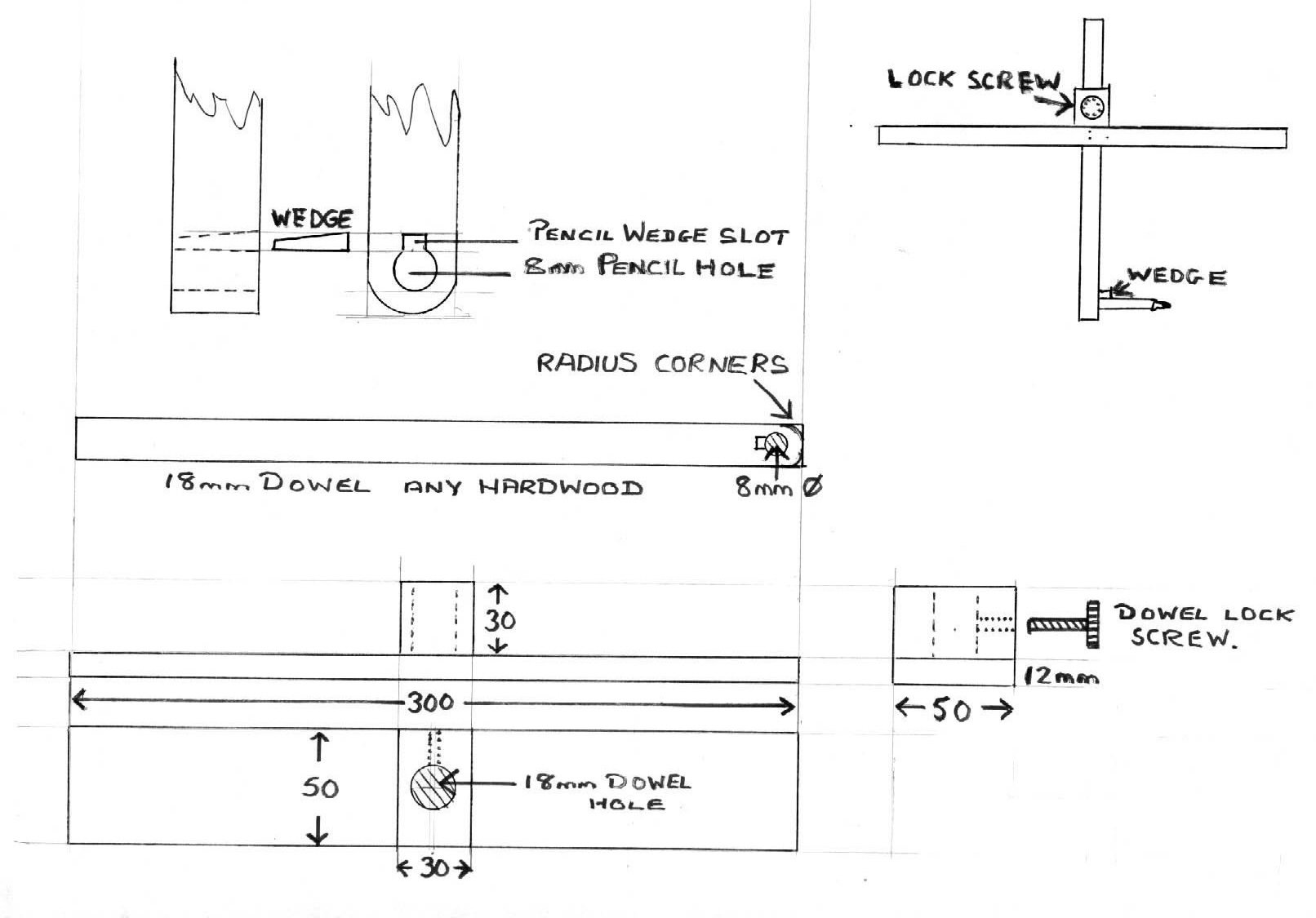

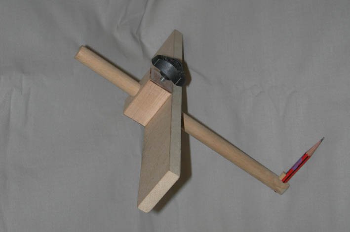

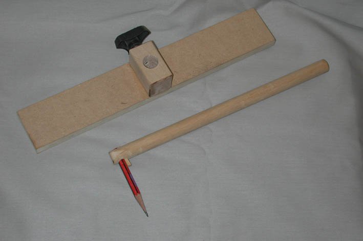

I found this somewhere in the abyss of my external drive. (Unfortunately, I don't remember who the author is and where it was originally posted...) Hope this helps, Thomas -
