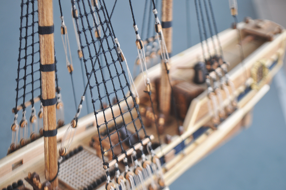

well, I've entered the most boring part of ship modelling... rigging the Ratlines @.@
This is my first attempt, gone terribly wrong...
very obvious hourglass shape.. so, I removed them all and reworked on them..
After few more hours of reworkings.. here's the result!
hmm.. Although look much better, but the hourglass still slightly visible.. :(
add a red line to make sure..
Ya, it's still an hourglass.. :( maybe I made a mistake here, I should have put on my futtock stave first before I started on the ratlines..
I'm thinking of reworking them, AGAIN! But it won't be in recent time, will seriously need to cool down myself on this..

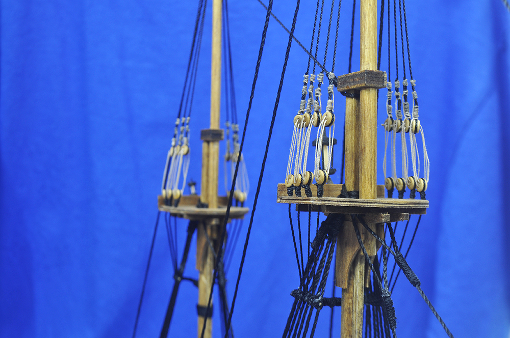

It has been a while after the trip, and a coming church festival kept me busy preparing it since I'm one of the crews... Anyway, here's some updates of my ship.
I removed my ratlines which I think the result is still not satisfying, and decided to put on futtock staves first before I redo them. Thanks for the suggestion! :)
Ratlines Removed

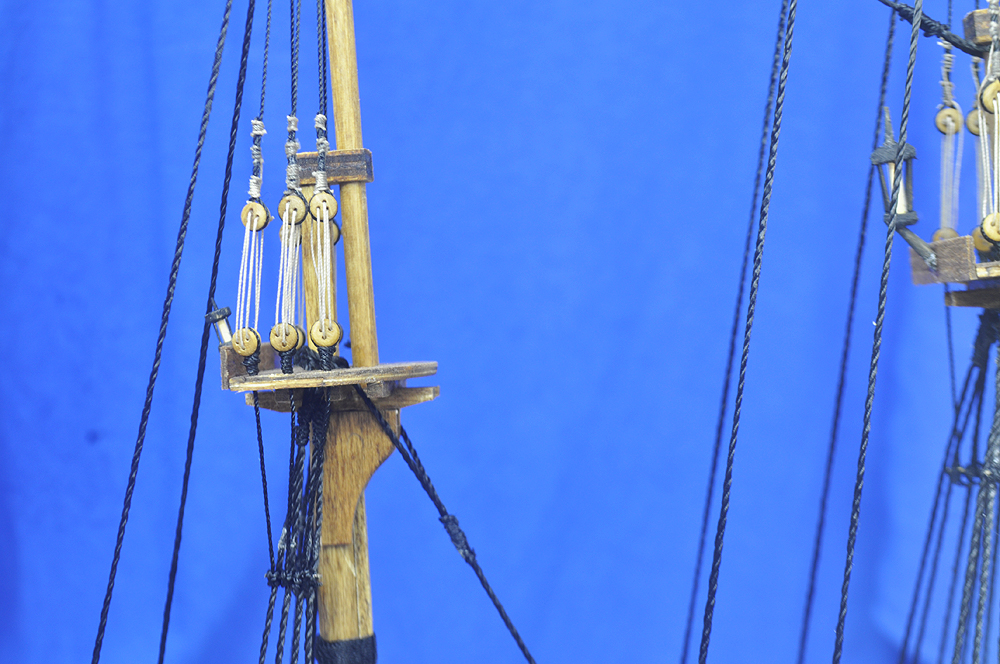

Added deadeyes first before starting the futtocks.
Deadeyes on Crow Nests

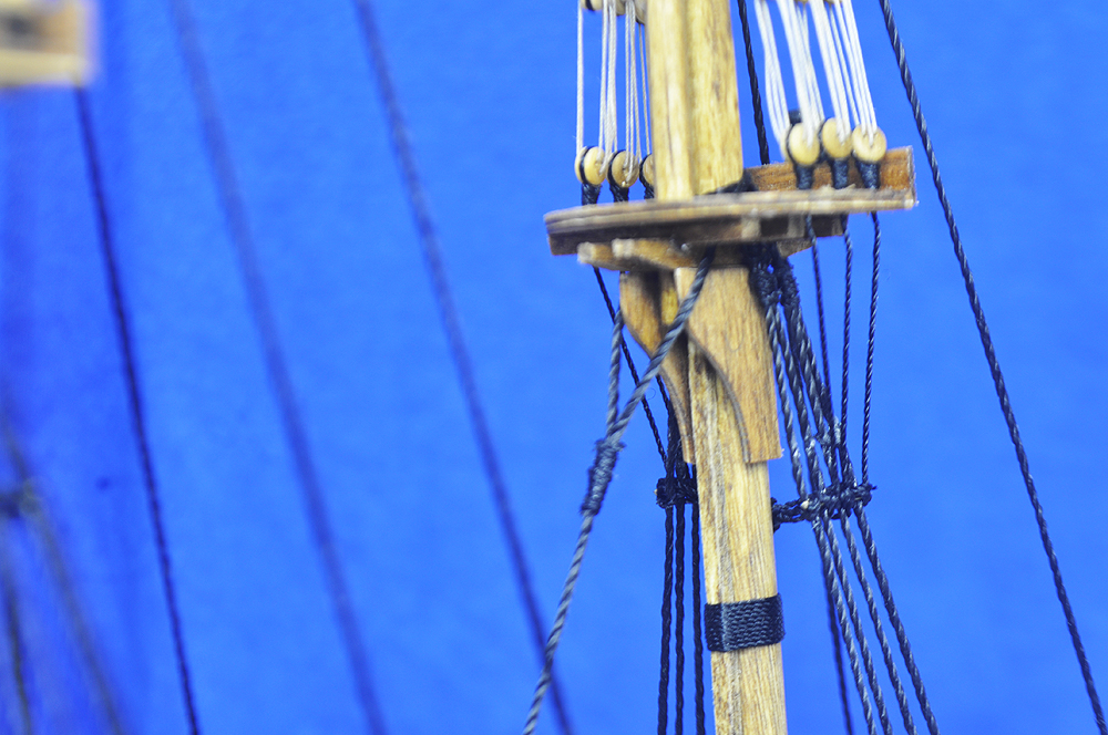

Then, I started on the futtock staves. It's done by rigging a blacken copper nail to the shrouds.
Main Mast Futtock Stave
Mizzen Mast Futtock Stave

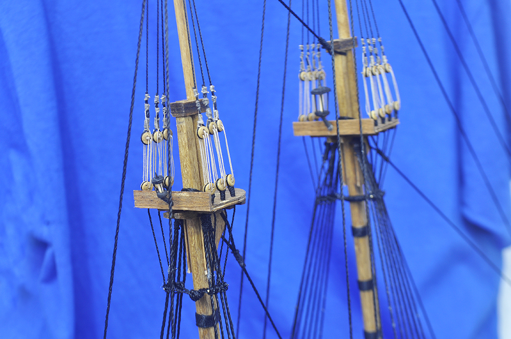

However, I did not continue on the ratlines. Instead, I skipped to finish all the stays and topmast shrouds first. :)
I will continue on the ratlines before I put my yards on.
Topmast Shrouds
Main Topmast Shrouds
Main topmast shrouds with main stay and main staysail, if I'm not mistaken.
Mizzen Topmast Shrouds
Mizzen topmast shrouds with mizzen stay.

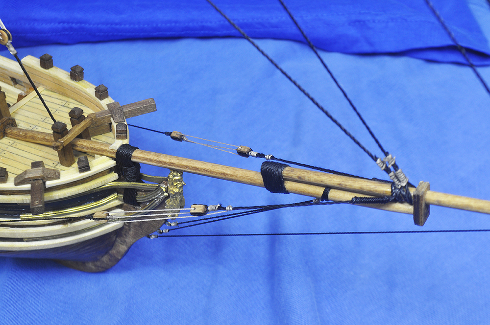

Bowsprit Shrouds
Back Stays

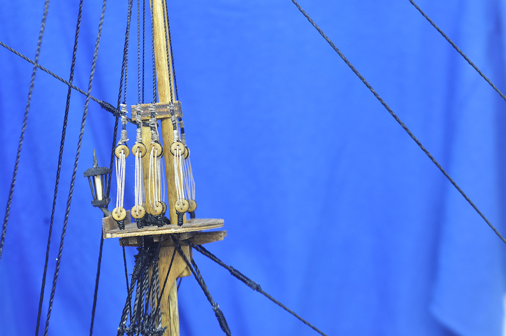

Lamps on Crow Nests
Stays As Viewed from Crow Nest

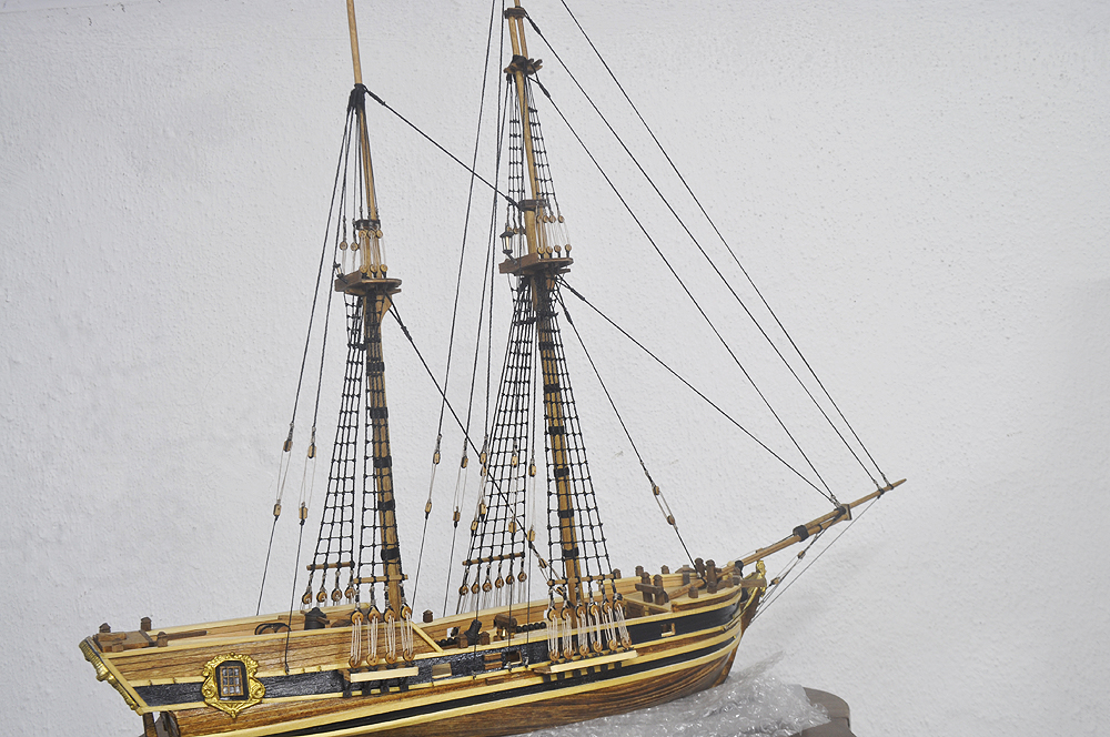

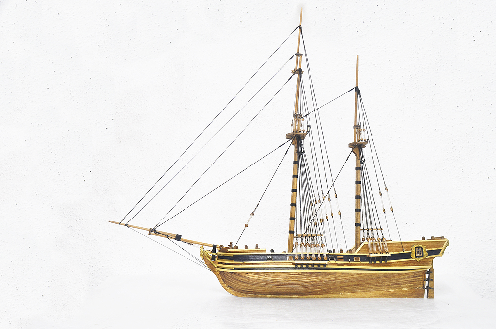

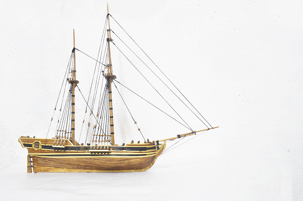

Up till now, basically all the stays and shrouds are done. Next, I will need to put the gaffs on, then only continue back working my ratlines. :)
Starboard
Port
Current Look
C&C are most welcomed! :D

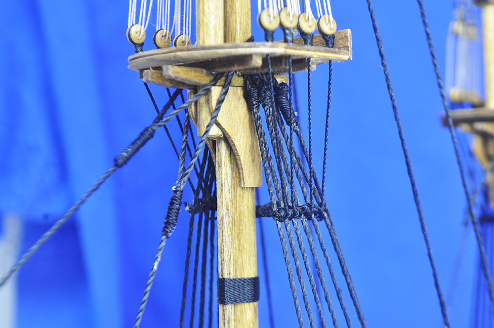

OK, it's time for redoing works.. The Ratlines! Thanks for sharing the methods, the result turned out great! :)
Method Used
Also, I used cow hitches instead of clove hitches at the first and last shrouds.
Cow Hitches Are Used at First and Last Shrouds
Total of 392 knots... :D
The feeling doing the last knot of the last ratlines was really good! XD
Ratlines Completed

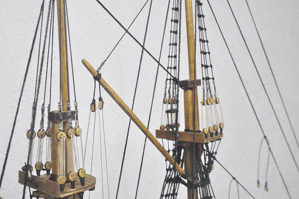

Then, I continued to the gaffs..
Main Gaff In Position
Stacked up the threads in a circle at the end..
Mizzen Gaff Running Rig
Current Look
The 2 pairs of hanging blocks will be braces for the spritsails. Next move is to put the yardarms on, and my ship is really upon completion :)
