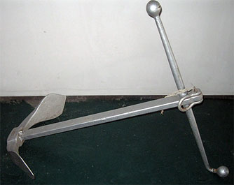

I realize that the anchors are those provided by the kit manufacturer, but, although I am quite familiar with many boats of this relatively modern boat's era, I've never seen a wooden stocked anchor with the stock passing through a square hole or band through the shank as these Model Shipways anchors do. (Not to mention that wooden stocks on anchors of any size were long obsolete by the time Glad Tidings was built.) That isn't to say there never was such a thing, but this is the first I've ever seen of one in more years than I'd like to admit at this point in my life. It would seem that the manufacturing of such an anchor would be a lot of trouble for not much, if any, benefit and add unnecessary weight. Generally, a late 1930's boat of this size would, contemporary with her launching, carry a standard folding "fisherman" anchor with a metal stock that slid through the shank such that the stock could be positioned to lay alongside the shank when the anchor was stowed flat on the deck, rather than slung on the rail. This was a big improvement over fixed stock anchors and became near universally employed when they became available. In my experience, wooden stocks, when employed, were fitted in pieces over the shank of the anchor and never through the shank.
I want to stress that this is no criticism of the model, which is beautifully done. Just a question about a note of historical accuracy. If anybody knows of this unusual stock design, I'd be interested in hearing more about it. Howard I. Chapelle designed Glad Tidings as his own personal yacht and he knew what he was doing. Perhaps he wanted anchors that looked "old fashioned," but that's just a guess, and, if so, why didn't just make them to fit around the shank as usual?
Standard galvanized folding stock "fisherman" anchor as assembled for use:
Folding stock "fisherman" anchor folded:

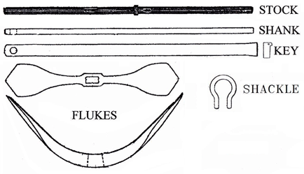

Herreshoff three-piece patent anchor parts disassembled:
Note flared lower end of the shank against which the flukes fetch up. One distinctive advantage of the Herreshoff patent anchors was that because they could be broken down into their component parts, the design was particularly well suited for use as heavy, and (hopefully) infrequently used storm anchors which could be stored, disassembled, in the bilges, keeping the weight low in the vessel and being more easily capable of getting from the bilge to the deck in parts before assembly. In this fashion, a 150 pound storm anchor could pretty easily be brought on deck in fifty pound increments that were easily moved about below, unlike a 150 pound anchor with fixed flukes, shank, and stock.
Three-piece stock anchor drawing.
Chapelle was an accomplished yachtsman and at the time he designed and had Glad Tidings built, it would have been quite possible he equipped her with Herreshoff patent anchors as they were, for their time, the most efficient and reliable anchors available, pound for pound, due to their scientific engineering.  Here's an extensive article on the Herreshoff patent anchors, if anyone wishes more information on them:  https://www.woodenboat.com/herreshoff-three-piece-stock-anchor
