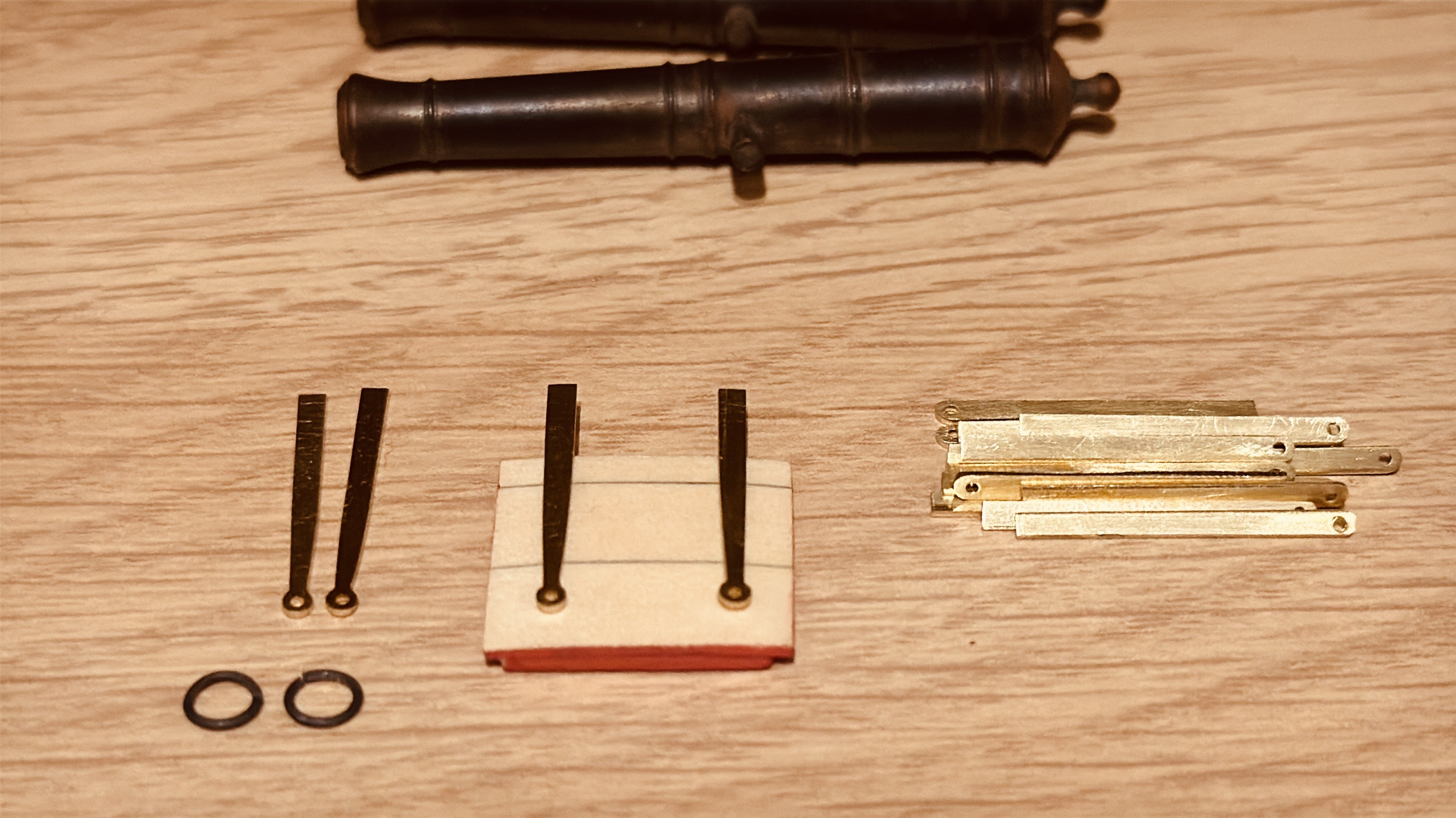

I need help. I have two questions:
1: It's not explained how to make the eyebolts that are drilled into the lid through the lid hinges' hole.
    Is there a tutorial how to make these and how big should they be made with the 28 gauge wire?
   Is it just a ring that let's the 24 gauge wire split ring go through with a little pin on it to be glued in the drilled hole in the port lid?
2: Where can I buy this  Japanese saw like the one Chuck uses to saw his split rings that go on the cannon port lids?

Use a #47 drill bit....
Check here for an explanation on how to make those.   They are the same as the ones made for on the deck of the Speedwell.

You can go a little smaller on the rings for 1/4" scale....maybe try a #50 bit you will know after you make your first one.  Use 28 gauge wire.

I made the lid rings and eyebolts the same way as the ones on the deck but with 28 gauge

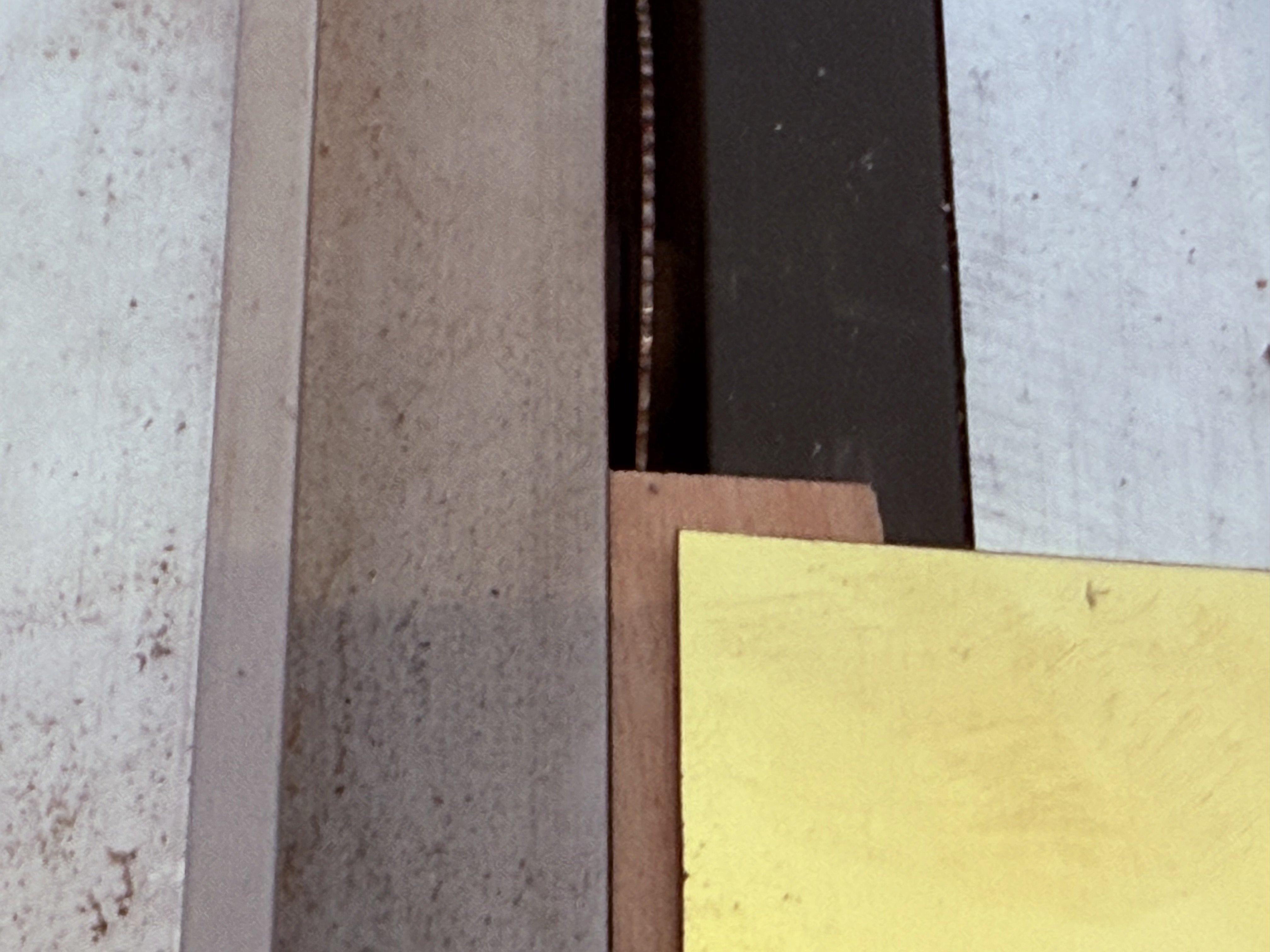

Today I made a start with the hinges for the gun hatches.
With a strip of wood under a 20x40cm 0.4mm thick piece of brass it can be cut in strips of 1.6mm wide. Without the wood the brass slams hard under the saw and bends in an ugly way…the scratch piece of wood underneath it prevents that. After that cut the strips in the length of the hinges as found on the plans and reserve 4mm for the curled hinge piece.
More tomorrow…
Frank.
