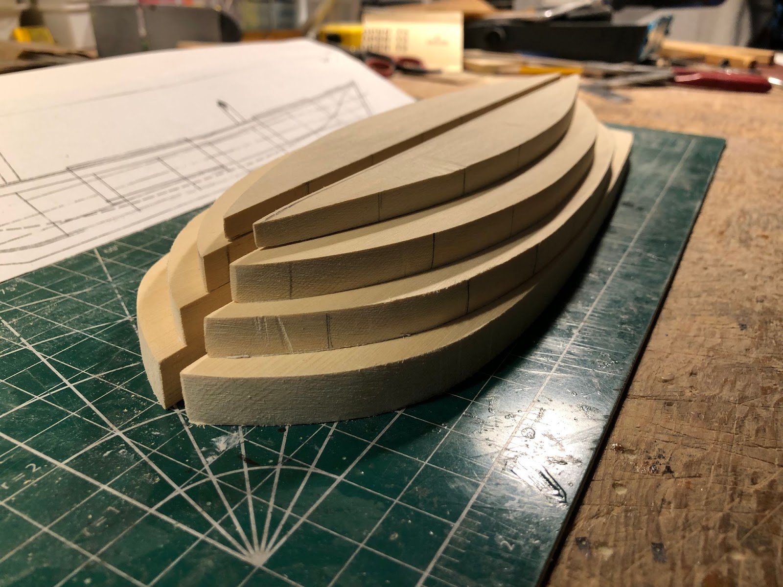

So I patched together some plans from the PILOTS book.  I feel that this is necessary to come up with proper hull lines.  I adjusted the plans so the model, at 1:48, translates to a boat with a length of 48 feet.  The beam is 16 feet, and the draft is around 6 feet.  I’m not sure exactly where the water line is at this point.  I’m going to use the ‘lift method’, sometimes called the bread-and-butter method.
I’ve made two halves of the first ‘lift’ (or the first slice of bread).  It takes me a lot longer because I don’t have power tools.  But I like making saw dust, plane dust and sand paper dust.  The lifts are made from Alaskan Yellow Cedar.  This bottom lift is just under a half inch on the stern end and a little over a quarter inch at the bow.  That took awhile to make that smooth and have both halves match.

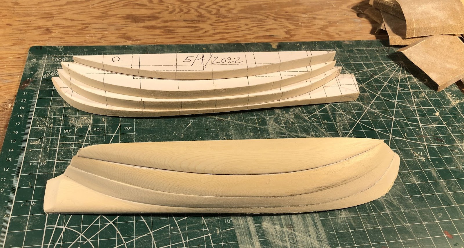

Making the lifts has begun.  The four lifts are cut out, but more sanding is needed.  Each piece must be as close to the plans as possible.  That is the only way to insure that further sanding
results in a properly shaped of the hull.

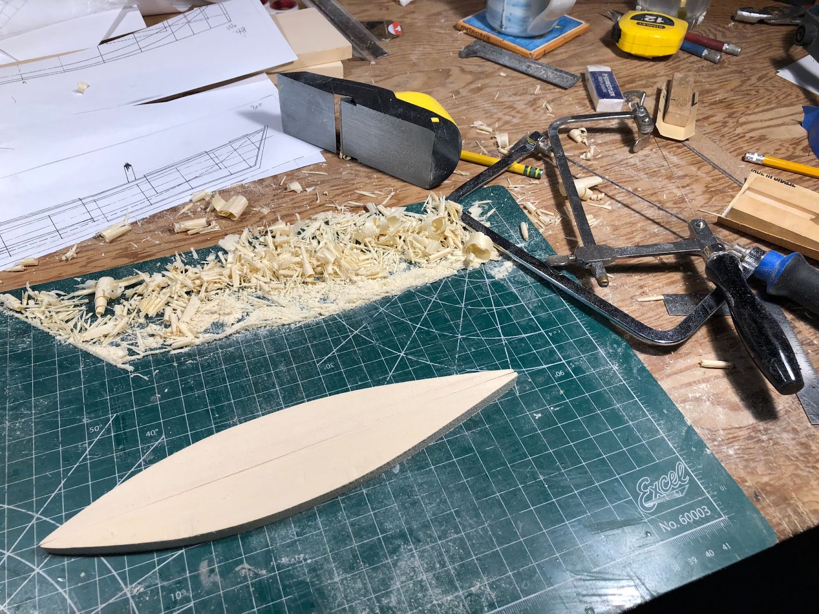

I’ve done a rough sanding of the port side lifts.  The stern area gave me some trouble, but once I was able to ‘read’ the various views on the plans, everything seemed to make sense.  The lifts  need more sanding, but I want to wait until I have the other side done.  The two sides have to match.  Then the final sanding will be done after the lifts are glued together.  I also have to decide on how to cut the deck hatches.  And, based on my research, whether or not I want to make a small stove in the forward hatch. Advise is always welcome.

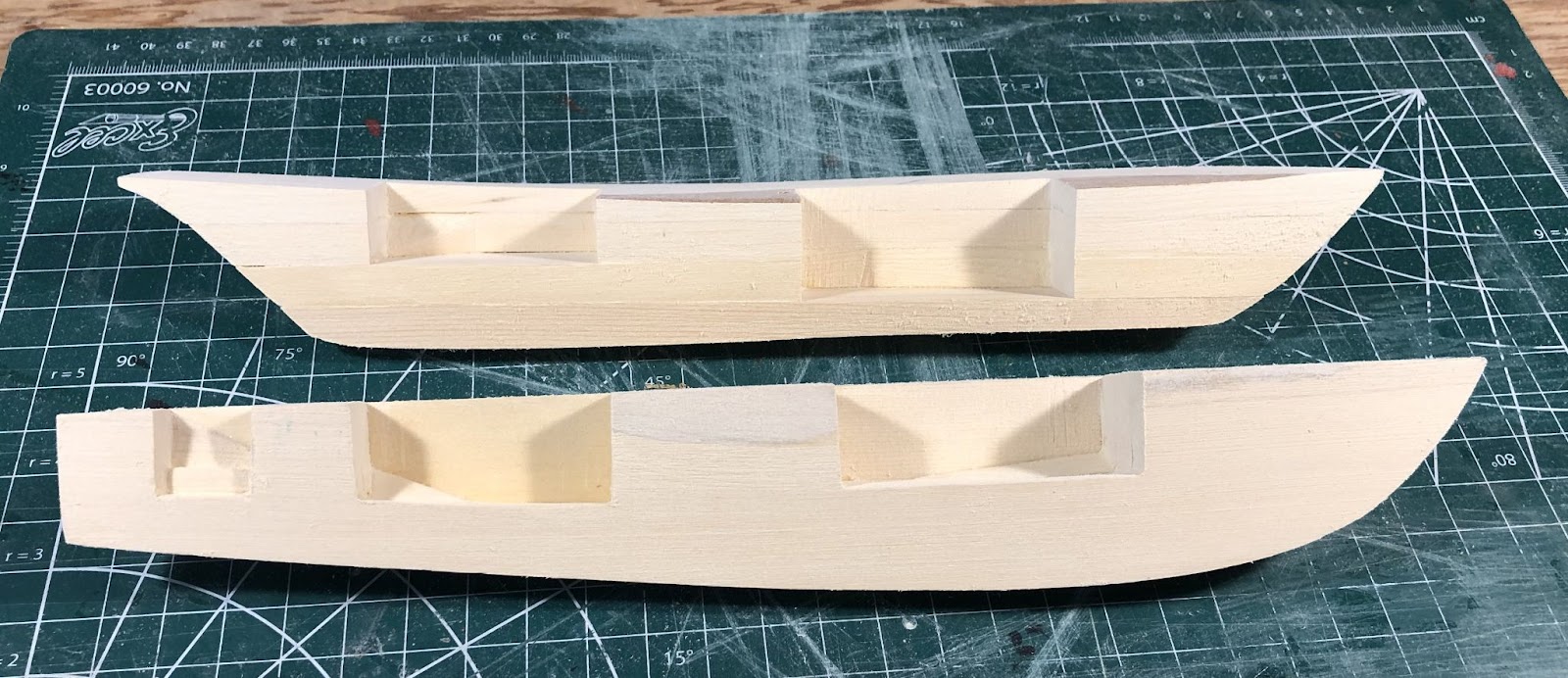

A lot of progress to report.  The four lifts of each half of the hull have had their preliminary sanding and are glued together.  Both halves have also been sanded, although much more sanding is needed.  The hull looks like a boat.  Photos are attached.  I am going to use some plastic wood or Gesso to fill in the cracks between the lifts.  And I plan to have a sheet of 3/32 cedar down the middle that will form the stem and stern posts and the keel.

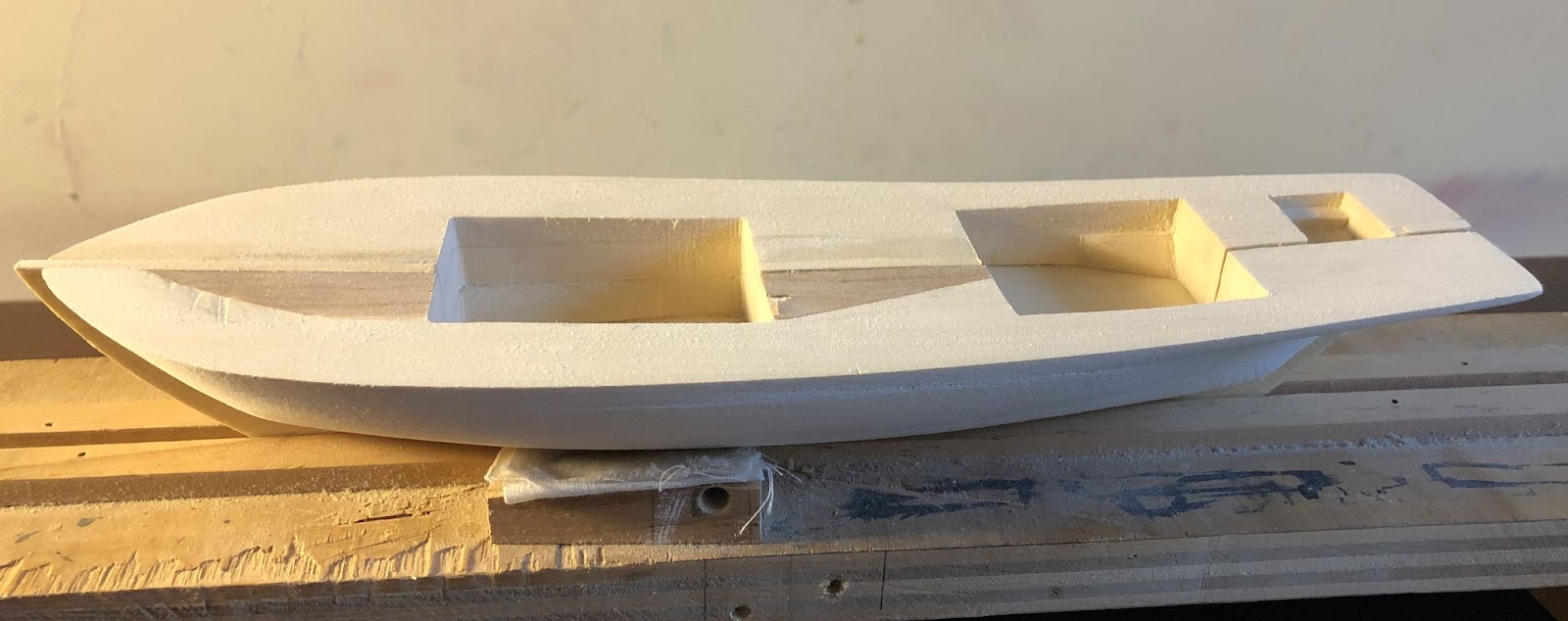

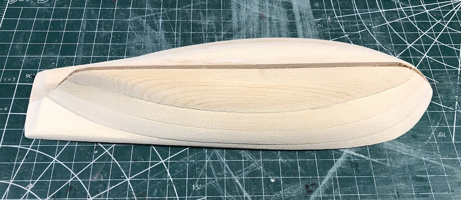

Just a quick update - I glued the two halves together including the sheet in the middle.  No real problems except that I need to do more sanding.  When I look at the shape of the hull, it looks fine; but when I hold it a certain way under a light, I see a slight ridge near the keel.  That ridge must be removed.  I know that when I plank the hull, it will become obvious.  It’s best to solve the problem now.

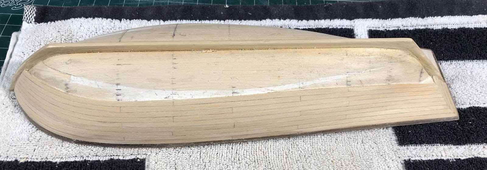

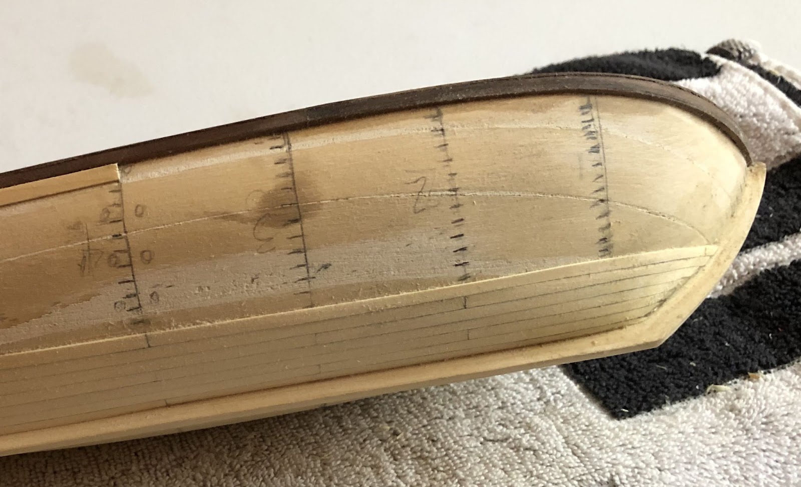

I’ve spent a lot of time trying to plank the hull.  (Three attempts have been removed and replaced.) I’ve now got 7 strakes installed on the starboard side and I see problems with the overall look of the bow.  The planks look OK (1st photo), but they are rising way too fast (second photo).  I’ll need to use at least two drop planks in order to finish.  The real solution is to use edge bent planks.  However, I can't get the 1/32 inch thick, ⅛ inch wide cedar planks to bend enough; and the planks don’t hold to whatever bend I do achieve.  I think my only solution is to order some sheets and cut strips out in the shape I need.
If anyone has any advice, I’d appreciate it.

Well, I made my decision.  I pulled the planks off the hull and will replace them with 1/16 thick strips.  As I was advised, the thicker strips will bend, without breaking, to the extent I need.  So far, I’ve installed 9 strakes and the results look much better.  I’m going to start from the keel for the next strakes and, looking at the planking so far, it will be interesting when the two sets of strakes meet.

Hi Ken. You may of already did this but what about  breaking your hull up in to belt's. Am building Chuck's Winchelsea and he breaks up the hull below the wale in to 4 belt's of planking. Once you find the belts just take and using very fine tape, mark off the placement of that belt. Am using 1/64 that I got off of amazon and the belts are really making it so much easier planking the hull. Once you have your belt's located you can break each belt down to the number of plank's that will cover that belt, using  a propotional divider or tick strip. Just look down the hull on that belt line and you will see where it needs to be adjusted. Take a tick strip and mark out the width of the belt, then using a planking fan you can find the number of planks in that belt. I like using a propotional divider because for me it's more accurate then using a tic strip because some times  I make my tick mark's a little on the thick side. That really makes the plank a little on the wide side. Hope this is of some help to you good sir. Gary
Thanks Gary.  I am still having trouble with the planks starting at the keel going "up" or down since the boat is upside-downside.
Your belts may be just what I need.
Cheers.
Ken

Ken usually the garboard strake next to the keel is a little on the finicky side. It widen's at the stern post and decreases at the stem. You don't want it getting to far up the stem and usually doesn't go to far past  the joint between the stem and the keel, maybe 6 inches. but each boat and ship are different here.  Once you get that one to your liking the rest of them should be a lot easier. If I get a chance I will take a photo of the one am doing on my Winchelsea which may be of some help to you. Gary
Edited by garyshipwright
I'd like to see your photo.
Someone told me this would be an interesting planking exercise, and he was right on.
The stem is giving me the most problems; although I can't wait to see how it all looks when the two rows come together.
Cheers.
Ken
FjDGKoK81-iPogKpjqc3bmbZuQJWNHkivpjK2tltqwIumT-O309jWemdPr_pOtG_T5OQvcD9ALdg3qod2yrJlYhPIBzsRY3wxsc5T8Usvi5-q9Ks0XNRTwjq6AiakjPWgW-f3VKSjDNhf0ep4PF_T8AojkbJkGabBmCUzgE1rgWMskQw-V_AJAxf5Q
I admire perfection attempts because I can't. Good Job!!
Thanks for the photos Gary.  They will be a help.
The problem with my boat is that the bow has this "bowl" shape.  But I like the idea of planking in sections.
Hope your modeling is going well.
Cheers.
Ken

9 hours ago, druxey said:
Do read the planking tutorials on MSW
In addition to the tutorial by David Antscherl, if you have not already done so, check out the You Tube video series on planking by Chuck Passaro.
Allan
PLEASE take 30 SECONDS and sign up for the epic Nelson/Trafalgar project if you would like to see it made into a TV series.   Click on http://trafalgar.tv   There is no cost other than the 30 seconds of your time.  THANK YOU
Thanks David, Gary and Allan.
As a member of the Ship Model Society of NJ, I've read and printed all the tutorials by Chuck.
I should return to his monthly workshops.  (I hear he has started them up again.)
Every time I take some planks off and replace them, I see an improvement.
