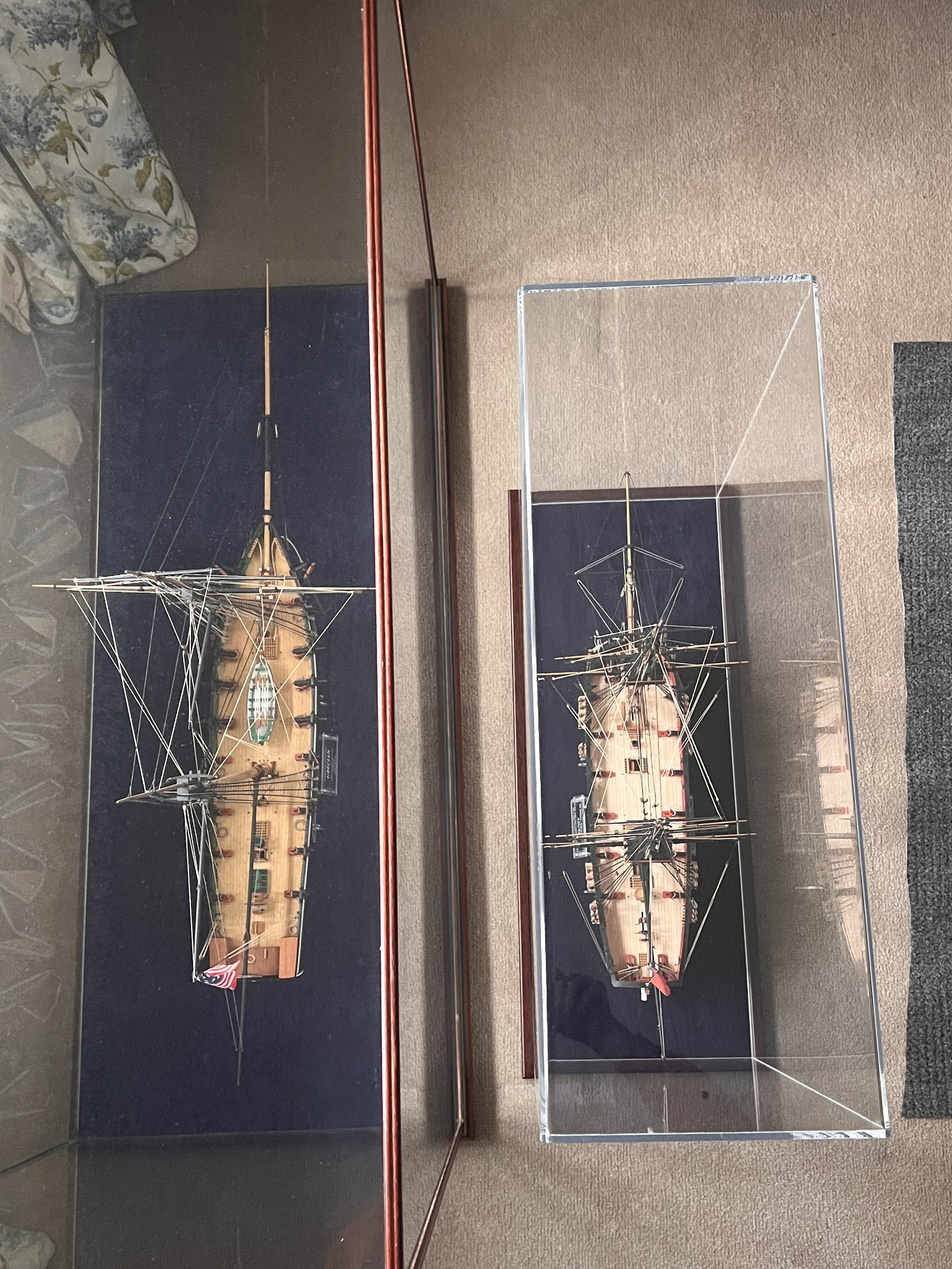

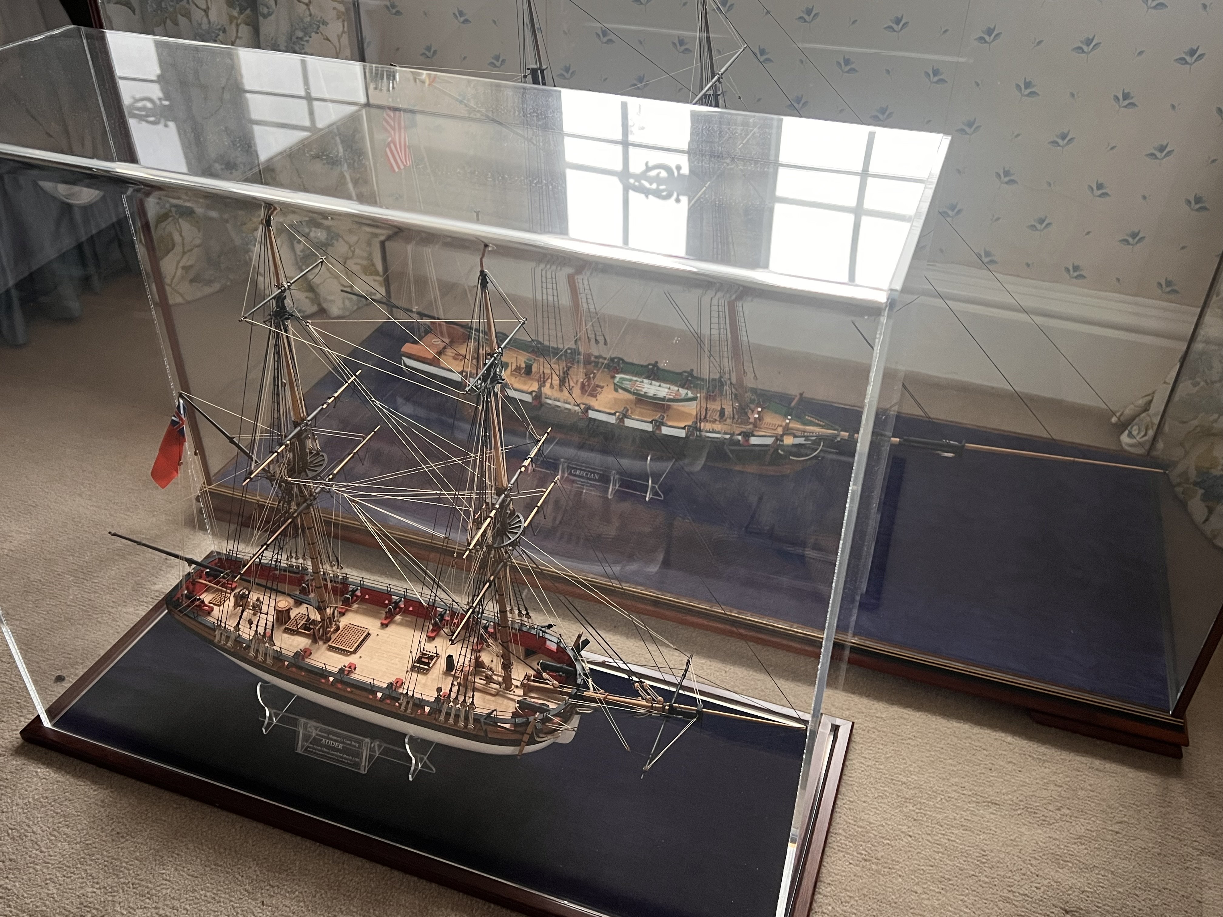

Grecian is finished and in her display case. Rope coils fitted. A few final pics.
1FC9B527-509D-460B-BEDB-B2C4D4DC15C4.thumb.jpeg.f80106baac95d7303d2ff41a228449f2.jpeg99752A68-CC8E-4F78-9628-DB9F3F0CF87A.thumb.jpeg.e59a8348499304eb44342e6f8545c952.jpeg6B70068B-9B6D-4681-9FA4-768BEC0CB396.thumb.jpeg.ece1cdcfede8ff29c0bc8a0e55419b51.jpeg06A7E5F6-1B7E-4F59-BD6D-F5B63981CC96.thumb.jpeg.3bbc4e29d4c54c02e639f376d1012a4f.jpeg7F69164D-95D6-448A-ACE0-9061B47FD78B.thumb.jpeg.24340000ee1ab1ecb44d40bc2ec4811e.jpeg0E9565C0-2719-4A08-84E5-7882F770EC22.thumb.jpeg.a9a05cc44eb2e692271eb739705d0e67.jpeg
The case is from DSC Showcases who if you’re in the UK I highly recommend. I have one of their cases for Alert. Despite being handmade from wood and glass they’re much cheaper than the acrylic alternatives.
DSC usually make the cases bespoke, but in this case they had this one already made and offered it at a big discount so I bought it. It’s the perfect length, but with hindsight a bit too wide and a bit too tall. Grecian looks a little lost in it, partly due to that huge bowsprit. I suspect that when I eventually build Sphinx I’ll eventually put her in it, her overall dimensions are similar but she’d fill the case better.
I’ll probably need some anti-UV film on the case or window to protect against fading.
Thanks again for all the advice, encouragement and support on this log, it’s been invaluable! Thanks to Vanguard for yet another wonderful, extremely high quality kit.
