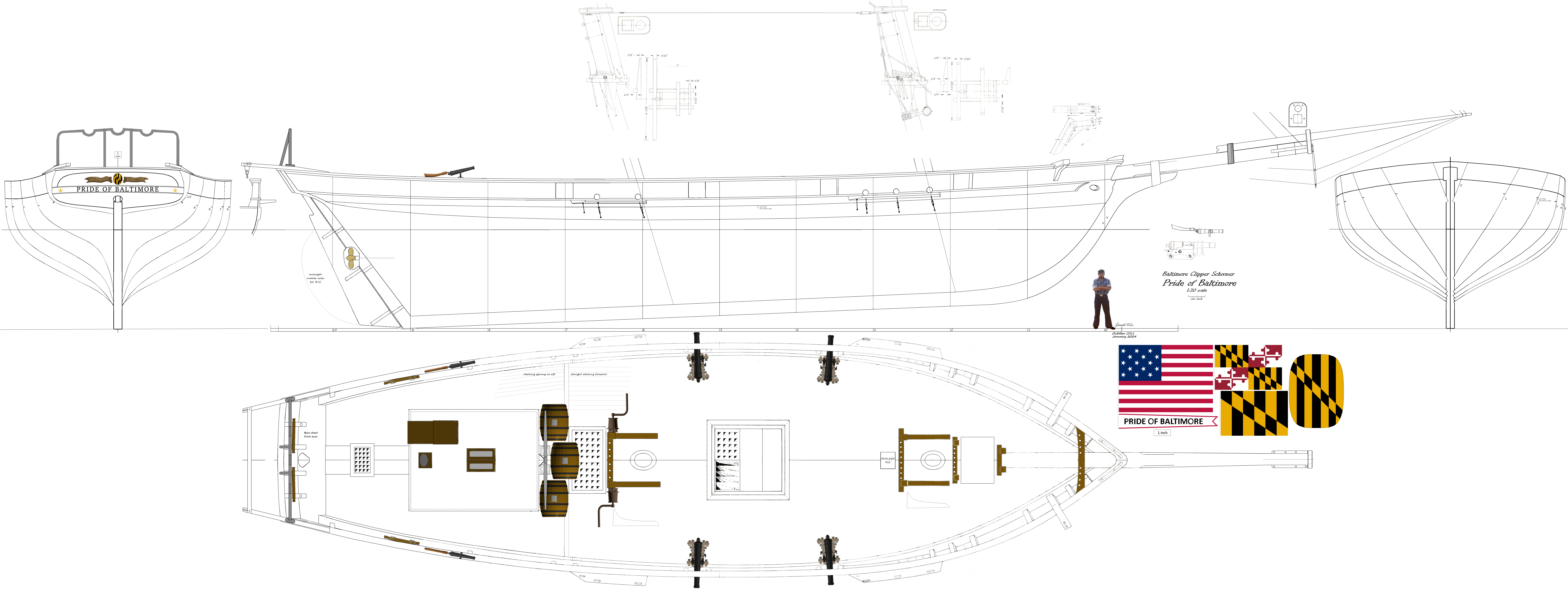

In 1982 I acquired a copy of her plans from Thomas Gilmer with the intent to build a sailing model, but I was young, moved around a lot and it just never happened.
In November of 2011 I got to seriously thinking about actually building a model of Pride and figuring out what size to make her.  The upper limit was as large, overall, as Constellation, but there was a lower limit also.  I tried scaling her the same as Constellation (1:36), but looking at what she would need in terms of batteries, winches, servos, etc; I didn't see how I could fit the equipment needed to control so complicated a rig.  I decided to make her 1:20 scale, as large as I could and still stuff her into a van or SUV.
With her lines scanned and scaled up I printed her stations on paper.  There were glued to 3/8" CDX plywood, cut out, sanded, etc, and stood up on the old building board Constellation was built on.
A work in progress: every item I draw in scale gets added to this plan.

So, in another thread the subject of signal flags came up, renewing my hunt to figure out a signal in a painting of Constellation.  I never got an answer, but I did find a resolution and I drew up all the flags I've be using on the model in scale.  Well, what I do there I obviously must do here, so...
Here, in 1:20 scale are the flags that will go on the Pride of Baltimore
The image may have been resized by the forum, but there it is just the same.
BTW: if you look back in the thread a bit you'll see that hideous black and yellow ovally thing is the Lord Baltimore badge Pride had pasted on her t'gallant.  I wouldn't have put it there, but it was there when I sailed on her, so the model get one too.  Scaled down to 1:20 didn't help it any.
