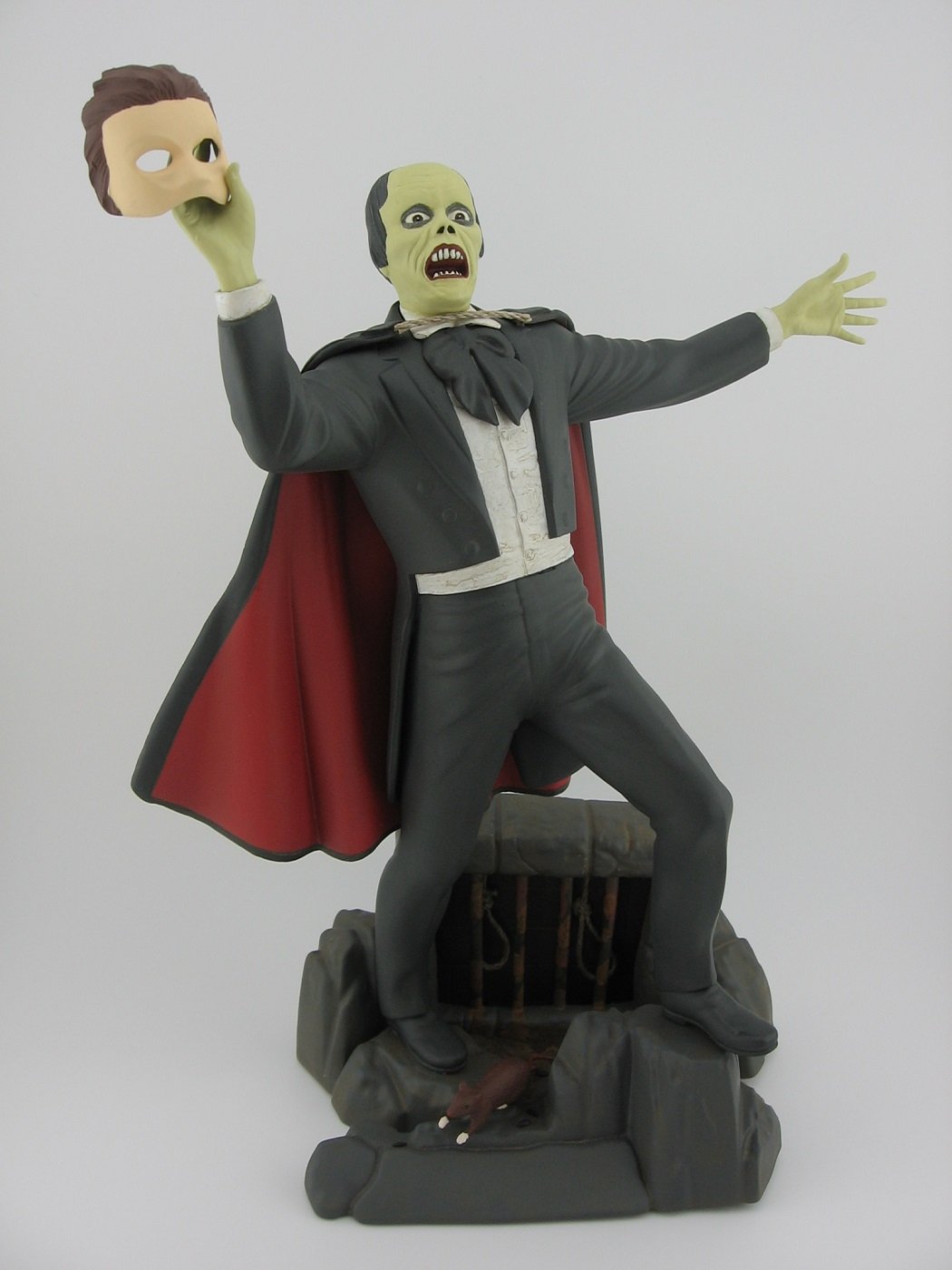

Well, with reluctance, I’ve decided to post a build log on this basic kit. For me, the operative word being basic. I purchased this model on impulse two years ago on an opportunistic basis for one reason. Nostalgia. I had it, and a few of the other Aurora Monster Models, 50+ years ago. But since purchasing it, and recently building my Academy 1/400 RMS Titanic, it has taken on a new purpose. That being to help learn entry level scale modeling skills, which will, no doubt, be necessary to improve on for my Trumpeter 1/200 RMS Titanic build.
I looked at starting a build log for this kit on another community board, but that board was somewhat frustrating in that the engine that drove it seemed slow and clunky, annoying pop-up ads, 3rd party photo hosting, and it was unclear on exactly what a build thread on that site is.
For me, posting a build log is not showing off. I’m fully aware, in the short time I’ve been here, that the talent on this board is immense. How could I possibly be showing off to that talent with such a basic kit? Contrary, this log is about receiving feedback on how I could, and can, do things better. Critique and suggestions are welcome.
My wife and I watched the original Lon Chaney silent film a few nights ago, for reference and inspiration. Loved it. I’d seen “The Phantom of the Opera” many many years ago, but that must have been the Claude Rains version, as I know for sure it was not the Chaney film. First time I’ve watched that one.
A couple of inaccuracies to point out: The Phantom (Erik) did not have long silver hair, as depicted in the box art. And, if there was any “prisoner”, it was not a guy behind bars. It was Christine, an opera understudy whom the Phantom was obsessed with.
And so it begins…..
