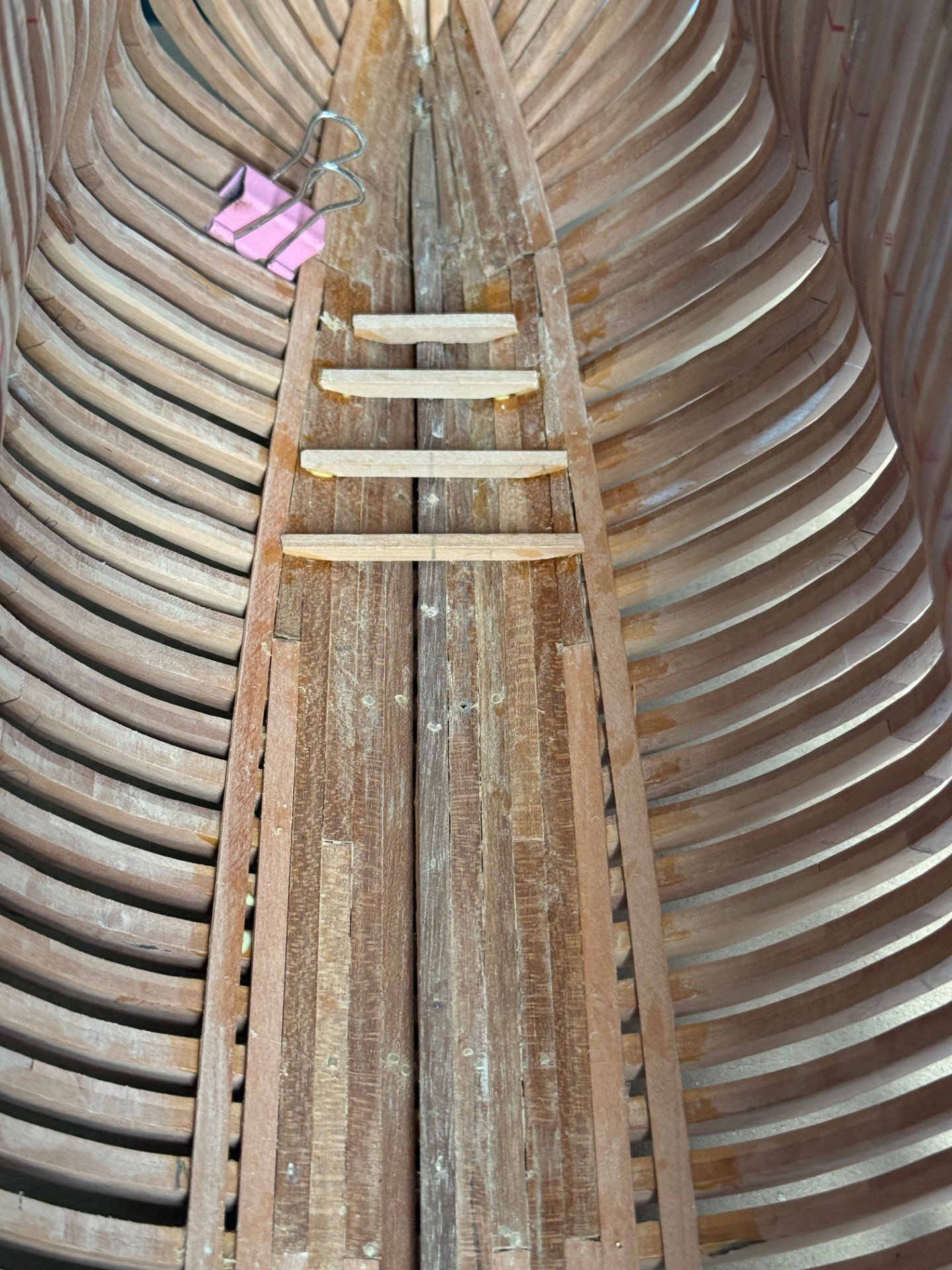

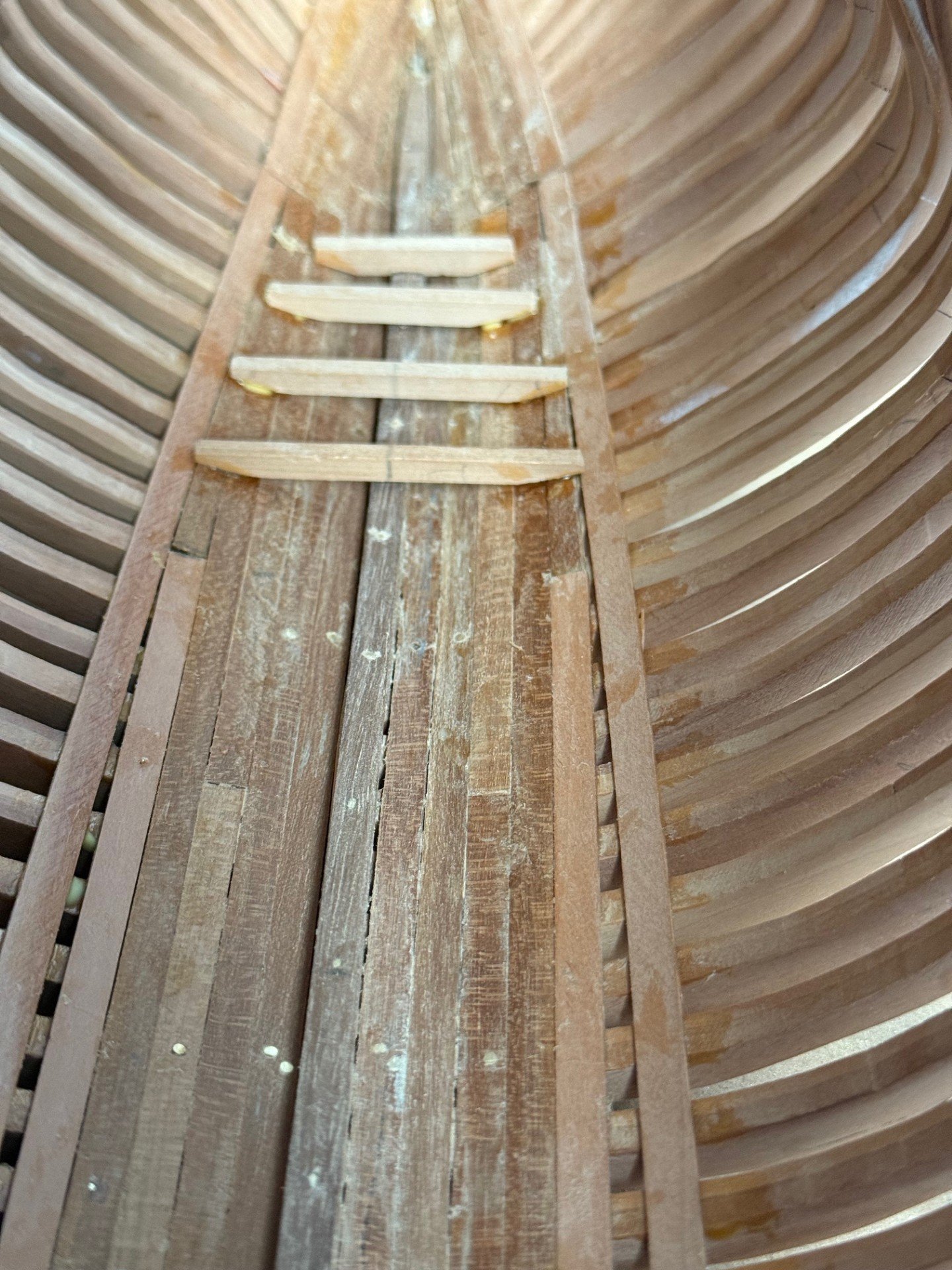

I did some progress in framing and I found out that my previous drawing were wrong , due my less skill to set the printer, so the more framing I was assembly the more mistakes I found out.
then I finally got the right blueprint of the project in the proper ratio and I decided to start over.
stay tuned ,  you'll  see the progress soon

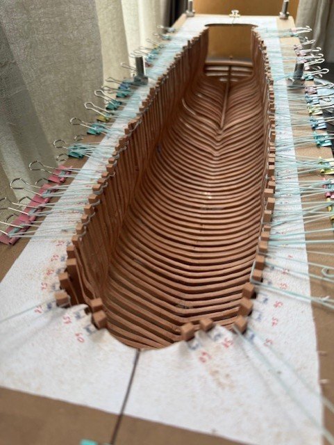

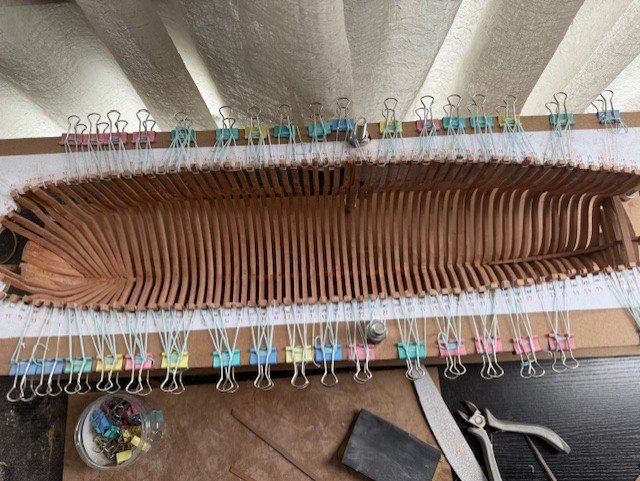

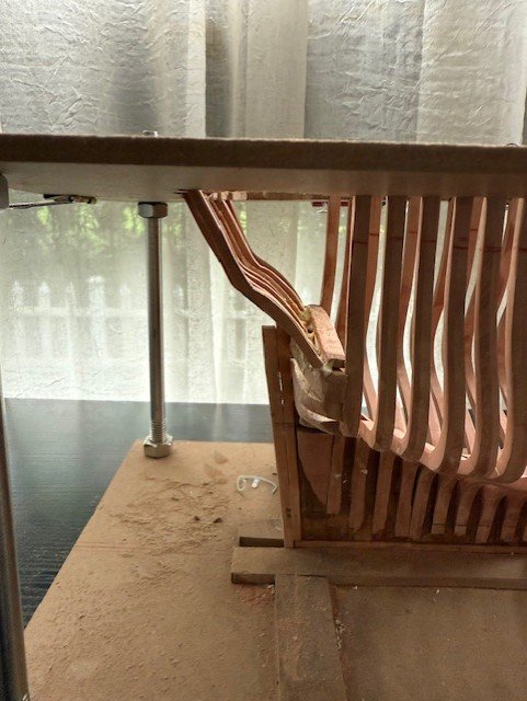

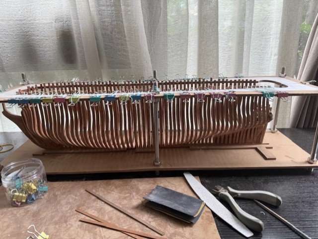

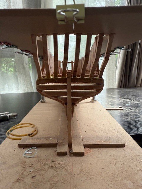

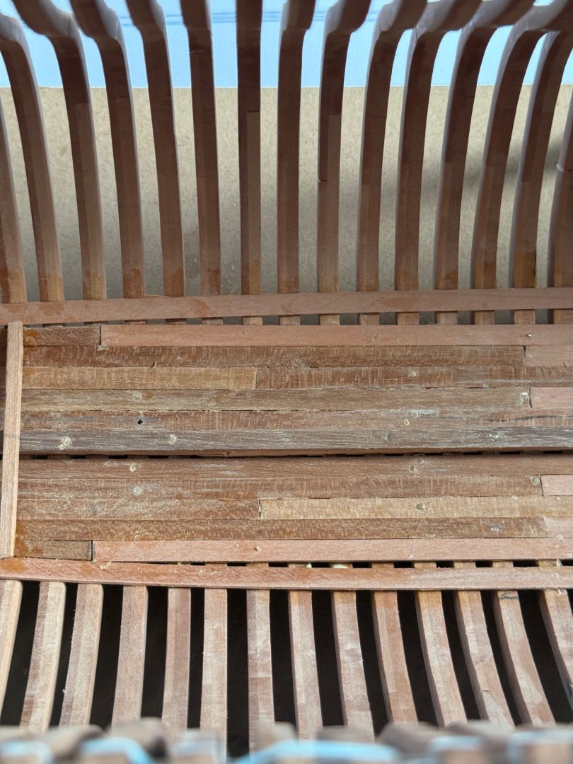

hi! here we go again,
I made some progress I build the jig frames and I started to assembly  the keel and Bow  which I tried to make  it look bit more real than the Plan which it seems  assemble only in 2 huge wooden pieces, I try to use black paper too for caulking , then I have to work a lot o sanding to get better effect, but for the very beginning it seems not so ugly
stay tuned  Cheers
thumbnail_IMG_0115.jpg.5fec3dcaee476c14152b4deba814724a.jpgthumbnail_IMG_0118.jpg.bd844785979e52b4af97e010790c89e4.jpgthumbnail_IMG_0123.jpg.6479be4d2ab4f06f9351348a0f2eed17.jpgthumbnail_IMG_0122.jpg.34f9a0f3e041b38ee44ba39809864473.jpg
Good call on redoing the frames! The first version was painting yourself into a corner with very little meat on the frames, would be very hard to fair (especially with the simulated bolts). And keep in mind that with Hahn method the alignment of top parts of the frames is also important.
Looks so much better now, well done! :)
Looking excellent from here.   I noticed to that the Hahn plans are a bit sparse, shall we say, in place like the bow.   He admits in his books that developed "shortcuts" to work better for him.  Some, are wasteful in wood, others not.   Still makes for beautiful models though which is a good thing.
Past Builds:
Tricky bow area, looks to be nicely done!
Wonder how it would look after fairing 😊
A few areas look suspicious, but hard to tell from the photos. Just hope you are verifying the ”flow” of frames as you go (with some wood strip) to avoid obvious dips and misalignments.
Rooting for you! 👍
Rooting for you! 👍
Hi Mike, yes you are right there are a couple of frames which seem misaligned, it mainly due by some slot in the jig frames which need to be adjusted in the time and it seems the flow of frames are coming along quite nicely... thanks for supporting ,
Hi Max looks like a very nice build you are doing there and some of the frames especially the cant frames will be very tricky.  I have never built cant frames like you are trying to achieve but I have learnt that each frame should flow into the ones next to it. I just look at what I've made and if I can see the flow of the frames its usually about right - great start; good luck and I'm following :)
Thank,  your comments give me strong motivation to make it better and I really appreciate it
