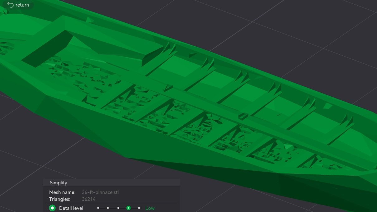

Bambu Studio does indeed have a simplify function, but it appears to default to "Very High" detail level which is what the screen shot above depicts, believe it or not. When I lower the detail level not only does the hull exterior get even worse, but the interior details (floor gratings etc) start to disintegrate too.
Here's a screen capture of "Low" detail level. Now that's an ugly hull!!
Ian, in that case I’d guess that whoever uploaded the model had to simplify because of file size limits. Is there any way of tracing back to the designer and getting the original?

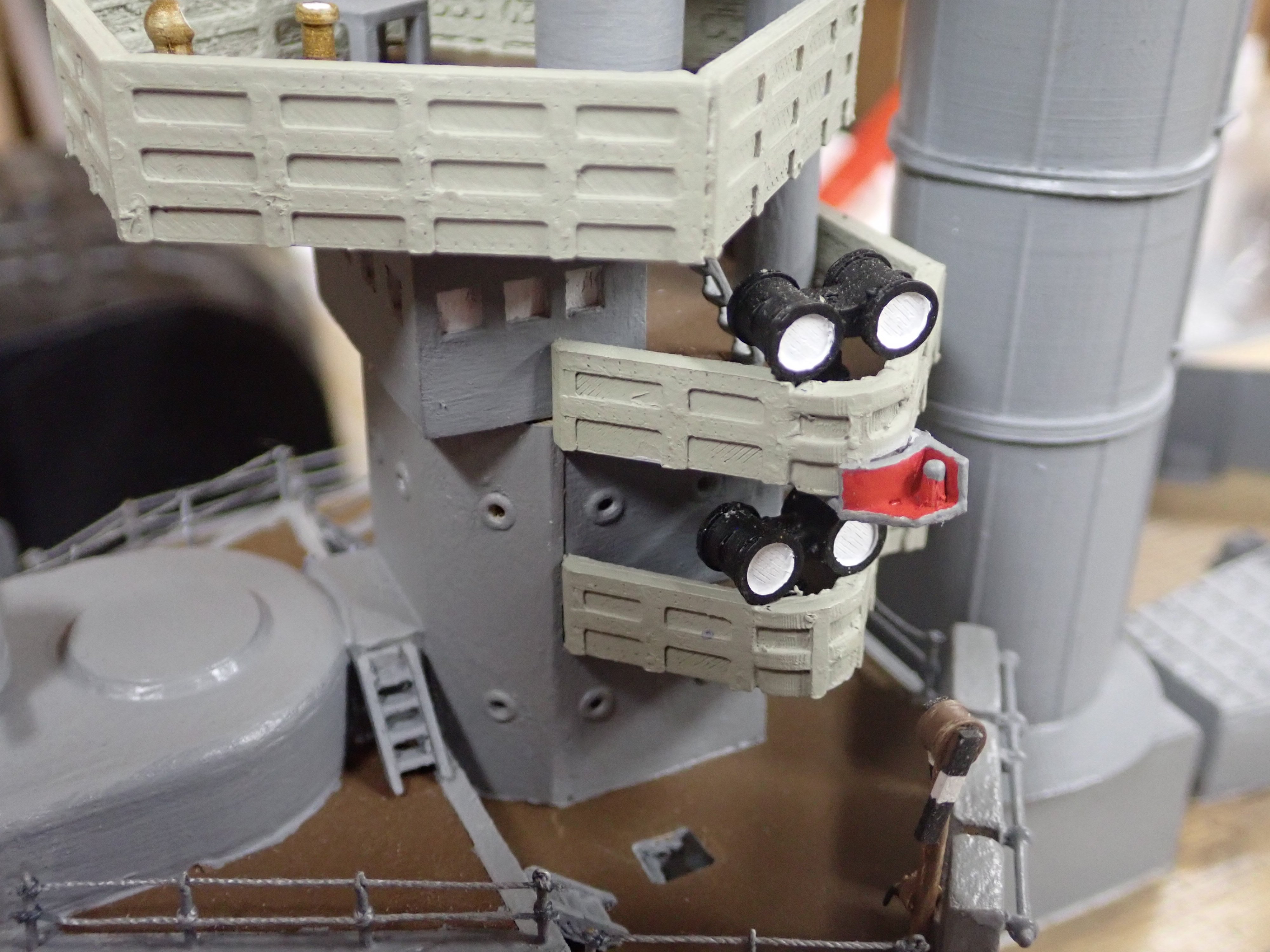

I added the port and starboard navigation lights, at the level of the charthouse deck. Still need to make white ones for the foremast/mainmast.

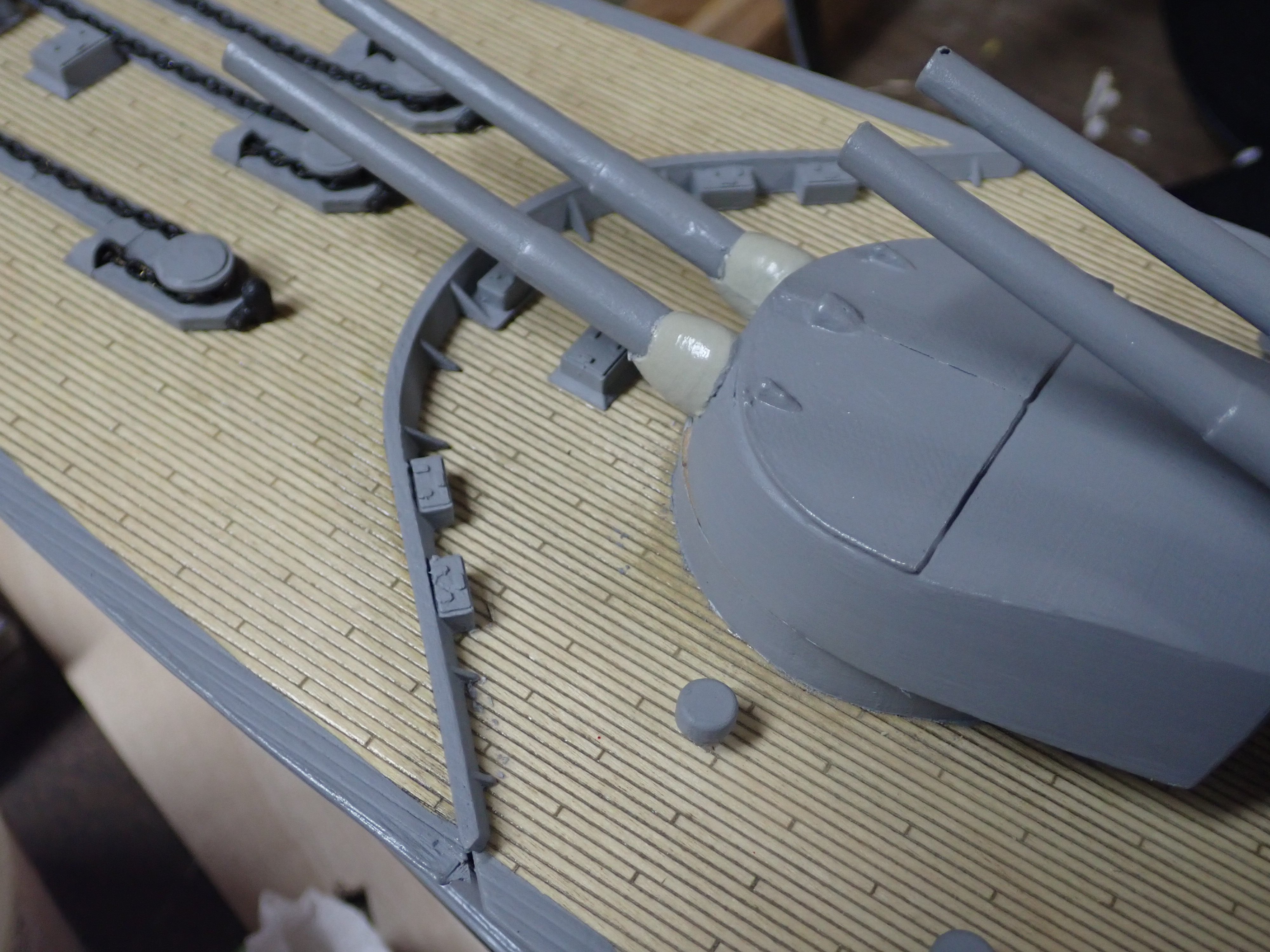

Last, I finally glued on the forecastle breakwater which also has been sitting around painted and ready for weeks.

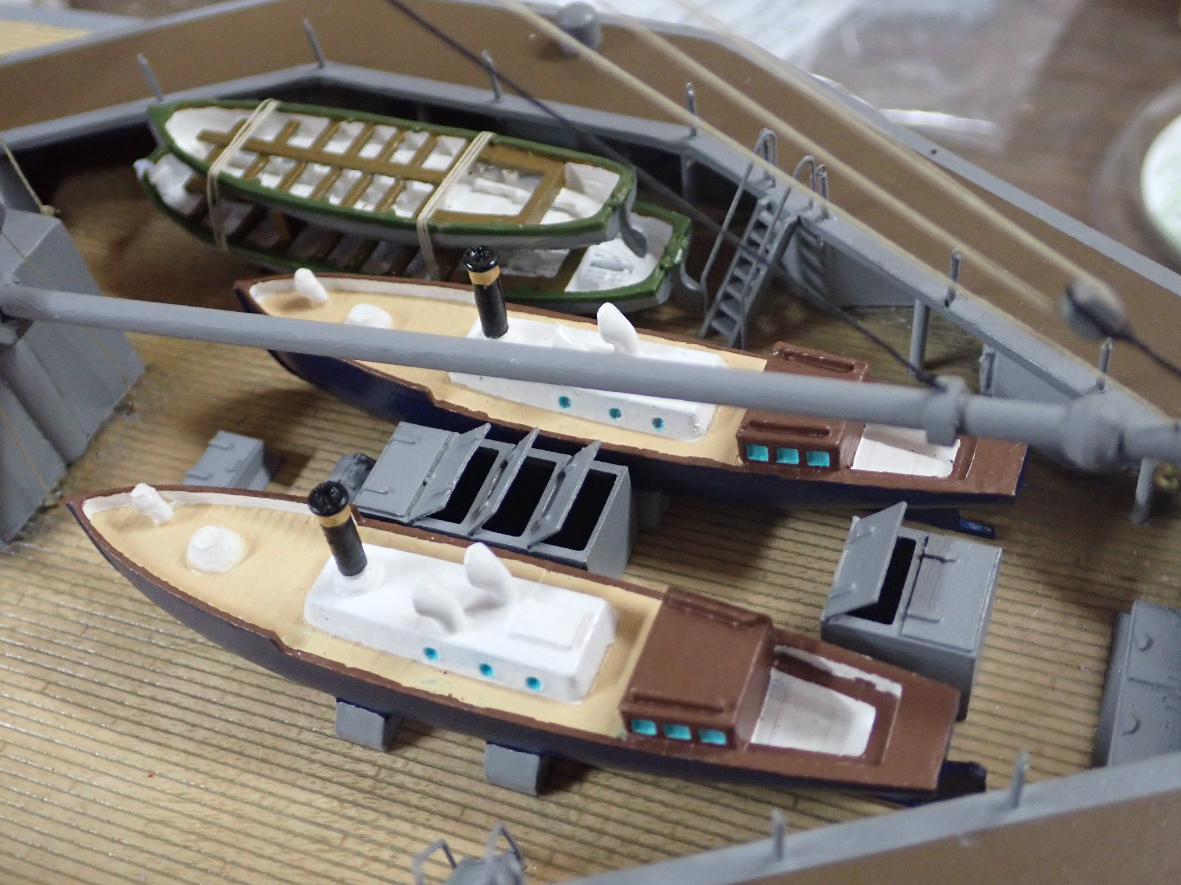

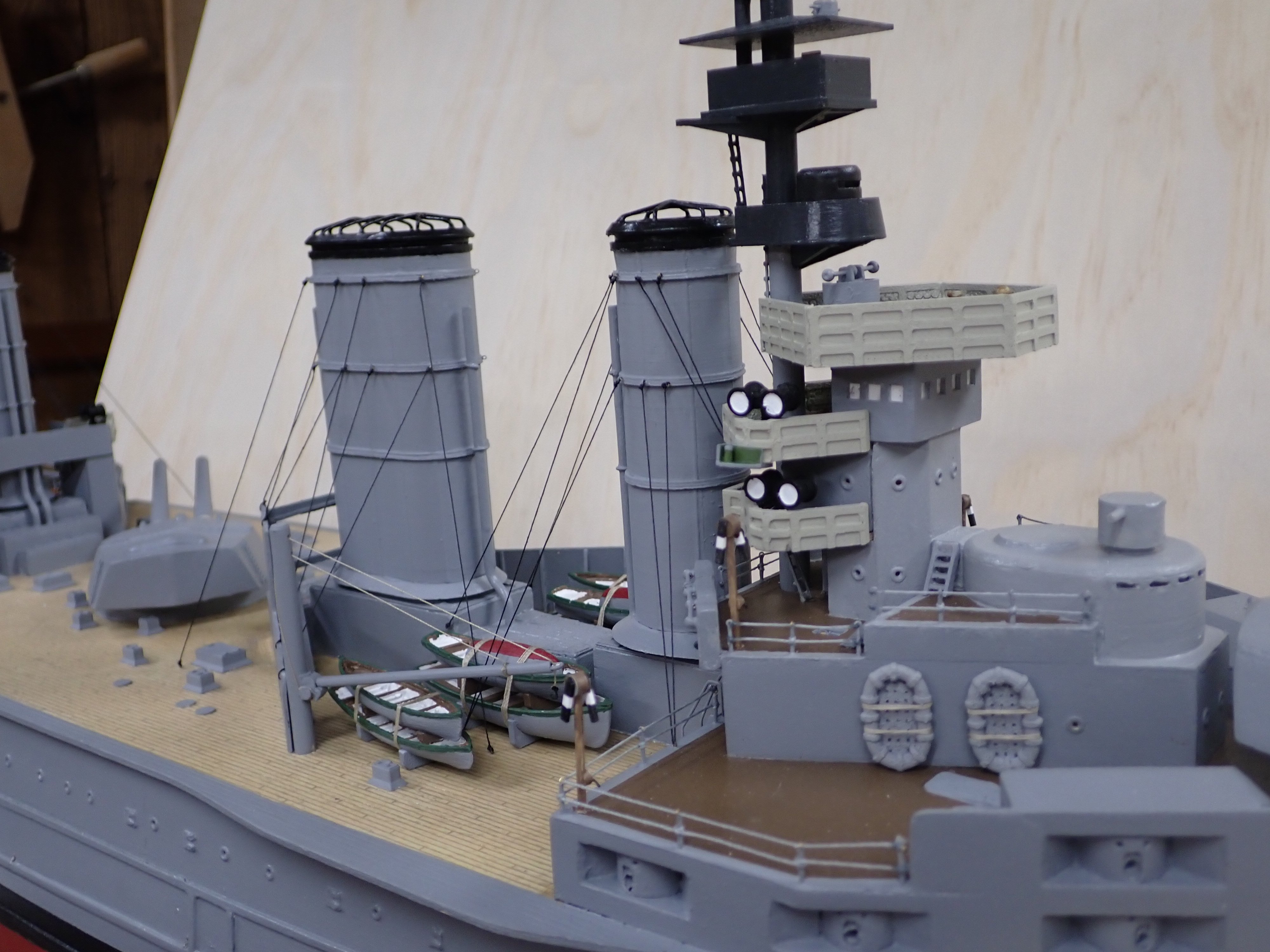

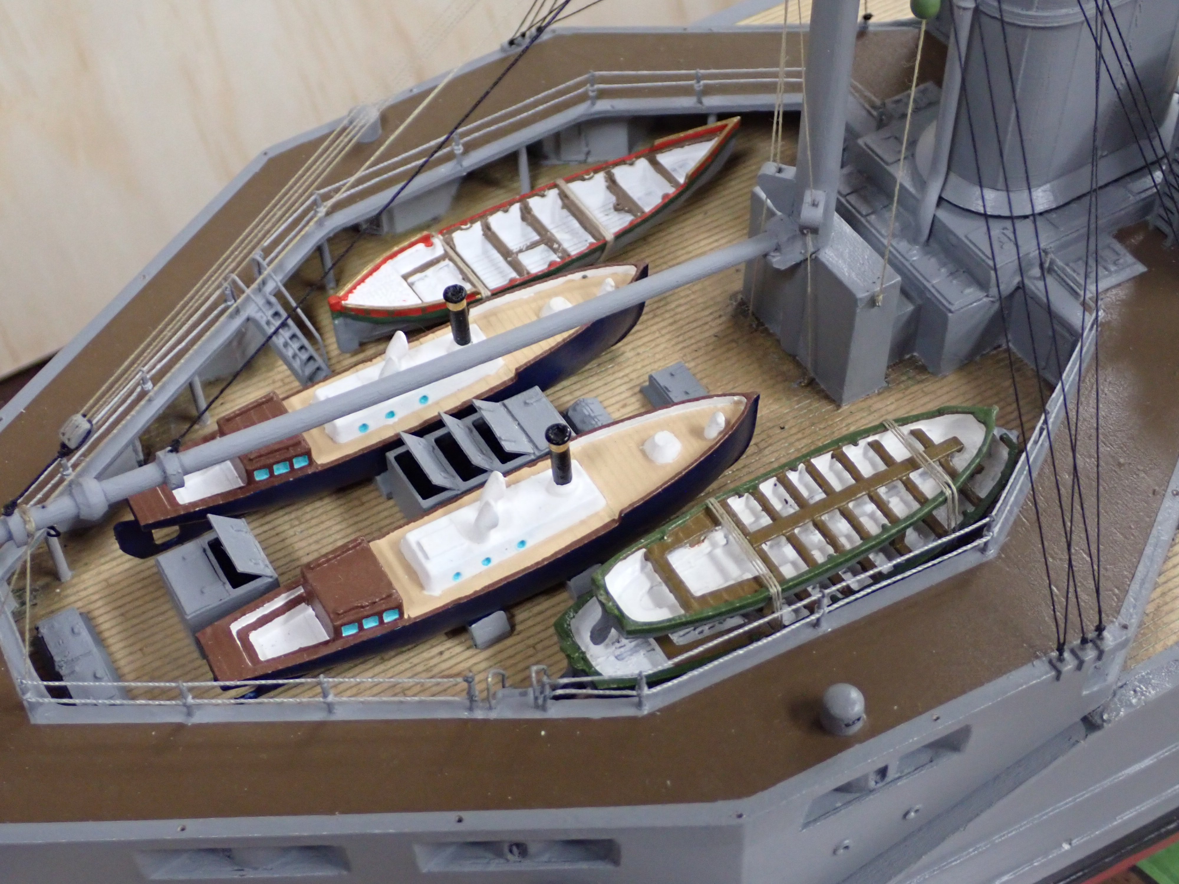

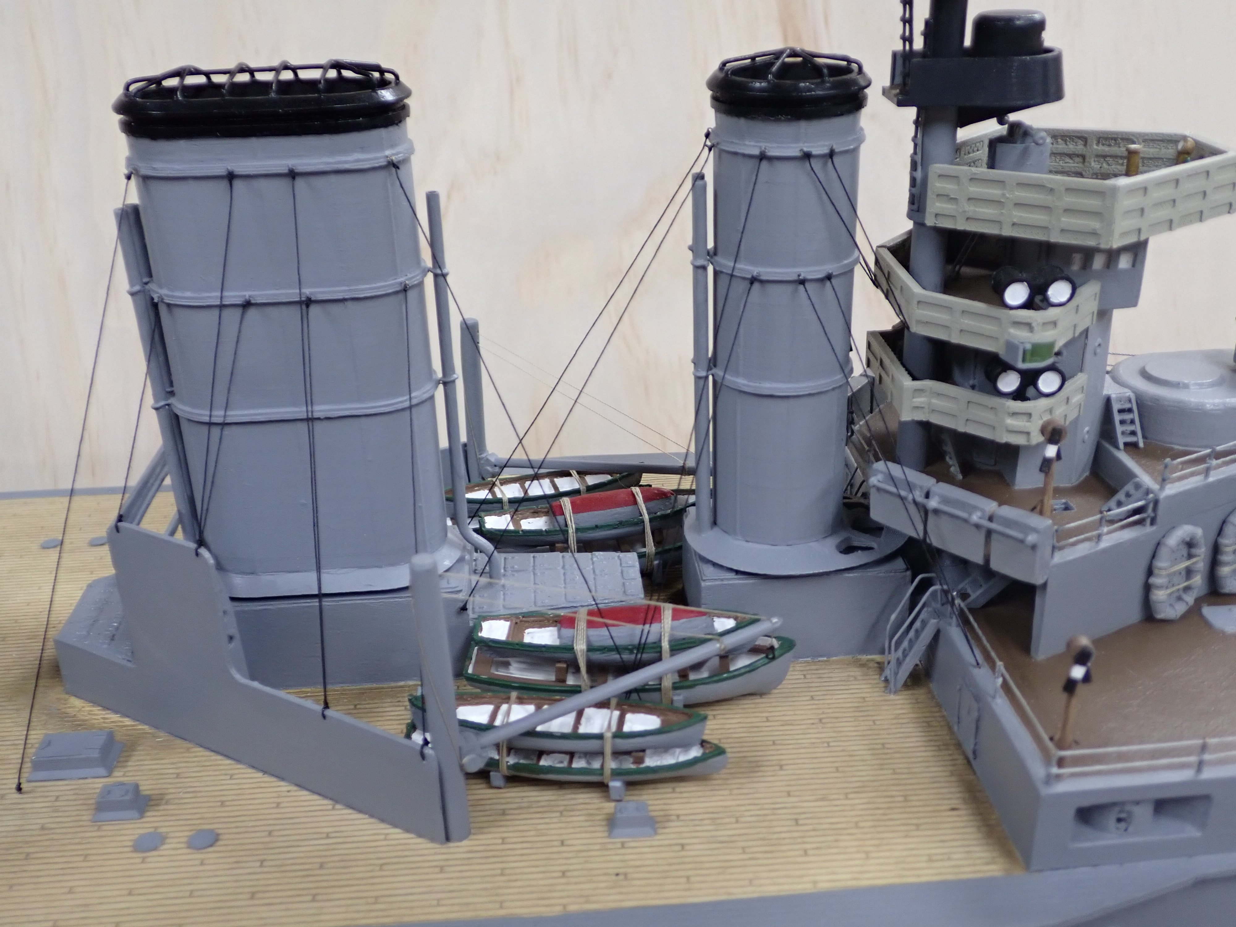

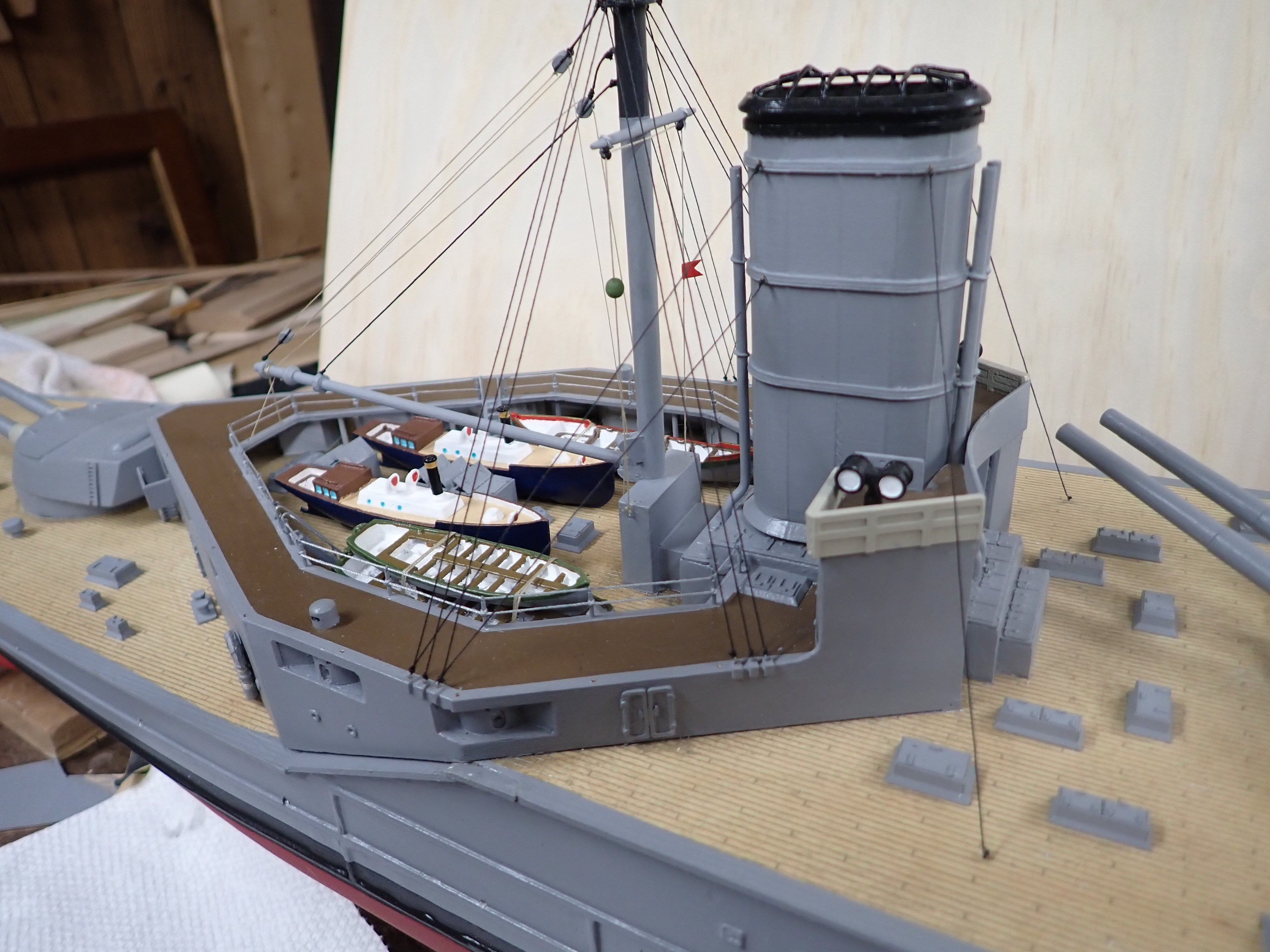

Worked on the rest of the ship's boats; ten of them in two stacks of three and two stacks of two. It took me days and days to find suitable printable hulls, break off the print supports under seats etc, and paint them. They printed with very nice floor boards etc but many of them were ripped up in the process of removing the supports. Fortunately you can't see inside the lower boats in the stacks. For the stacks of two, I needed a hull with two pointy ends for the upper boats; I used a "Titanic Lifeboat" file for the them because they printed cleanly. For the stacks of three, I inverted the 16ft dinghies on top because the tiny interior details were too delicate to clean up neatly. These dinghies are 1.1" long.
Also added the admiral's barge (albeit as a whaler because that printed better) all painted up fancy. Don't know if they kept it fancy in wartime but anyway..............
Boats in the aft well deck. Still need to rig the outer railing on the shelter deck. Barge has red/gold trim.

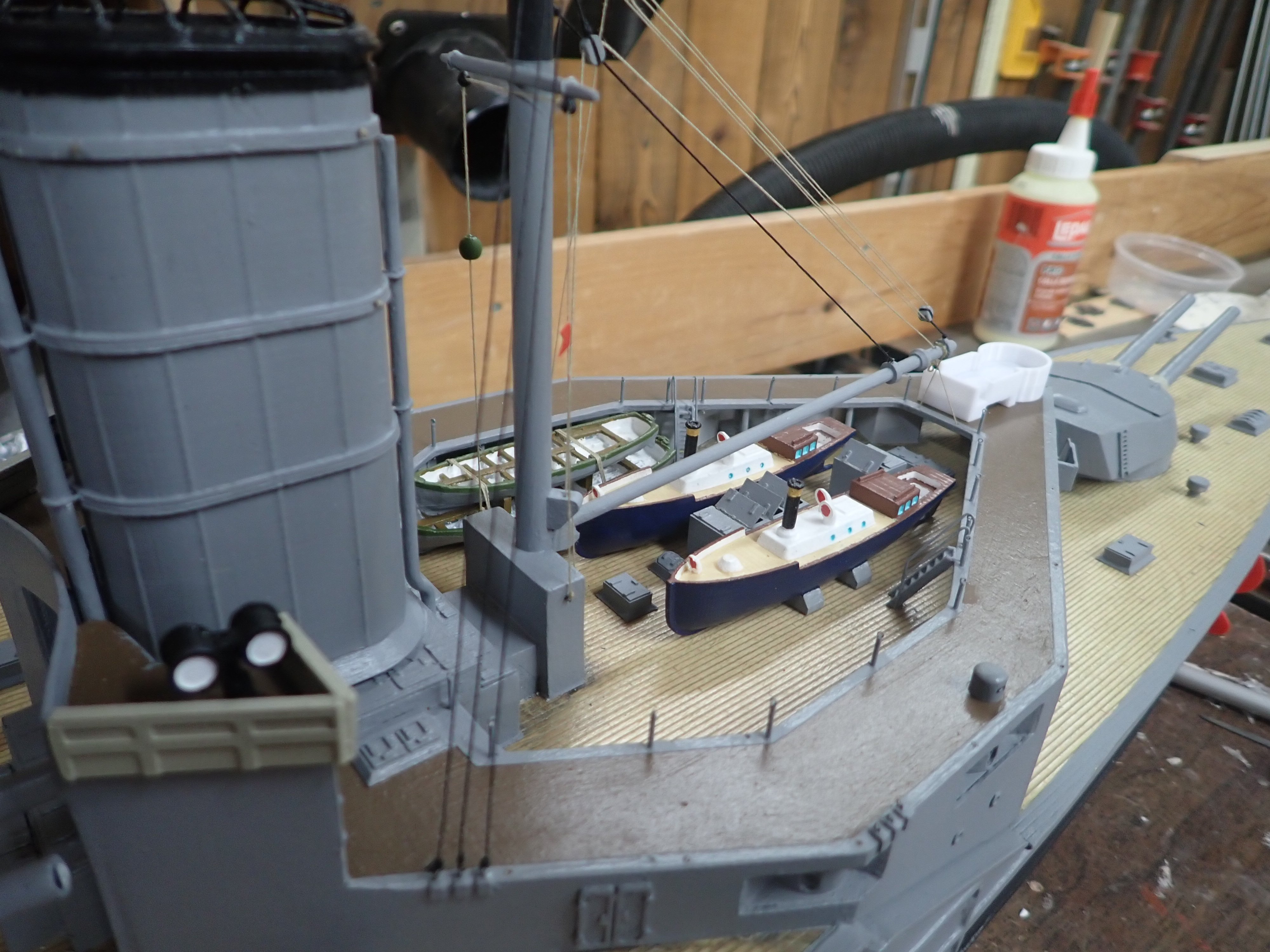

Rigging on the aft superstructure.
Boats at the forward superstructure. Tiny dinghies are painted red on bottom. Fore and main funnel bracing wires complete on the starboard side; not started on port side. Boat cranes not fixed in position yet. You can just see a couple of the Carley rafts I drew and printed. By the way, why were bracing wires needed for funnels on these ships but not on later ships? Welding instead of riveting?
View of forward superstructure.
Next up? Let's see.....foremast stays and many signal halyards; radio "aerials"; two tiny sounding machines and booms for the fwd shelter deck; two hotchkiss guns aft; main deck railings (🤔); brailed torpedo net and booms.

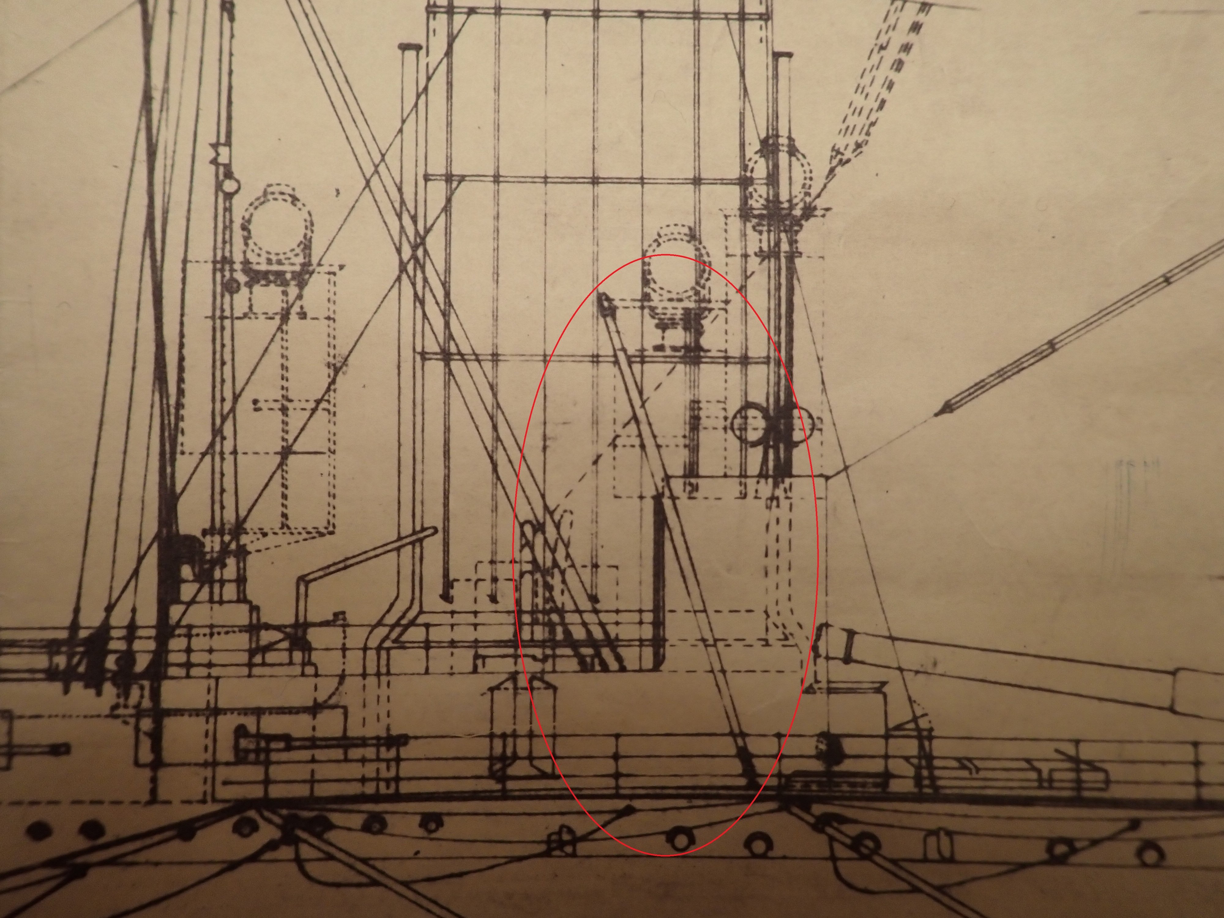

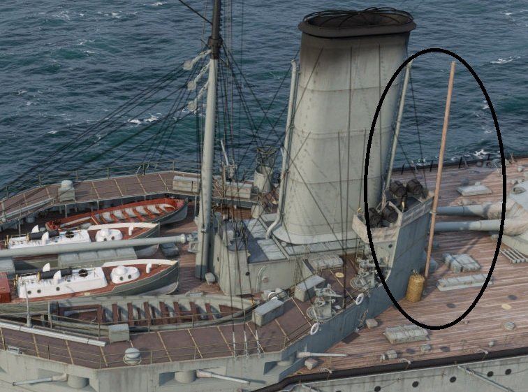

Does anyone here recognize the purpose of this spar, and apparently associated large wood cask, circled in the pic:
The 3D rendering (which I already know has errors in it; it's not infallible) shows a pair like this, port and starboard, and a similar pair at the forward superstructure.
My Ough drawing shows the following: yes there is a spar, albeit stowed at a different position, but no cask.
He doesn't seem to show any at the forward superstructure
Also, I'm puzzled by how the free ends are being held in position.
If anyone can shed light on this for me I'd be grateful. Thanks!
look at the bottom of the search light in that circle & you'll see 2 dotted lines to that spar. whether those lines go to the top of the spar or not i do not know. is that "wooden" cask actually wood, painted metal or some other material? what time period does it show the spars & casks & is it same time period as your model?

The searchlight towers were added after 1916 and are shown dotted in this Norman Ough drawing which shows an earlier appearance. I believe the dotted lines you mention run to the edge of the platform and just happen to be behind the tip of the spar. I do not know if the cask is really wood; I've only ever seen it in the 3D rendering, which is from the "HMS Lion" entry at navalencyclopedia.com.
 Ian, wild guess here.......were those spars used to hold the torpedo nets (removed after the Battle of Jutland in 1916) and the barrels (which have domed tops) were used to store the netting when not deployed?
Edited by Keith Black
Boat boom?
We used long poles and buoys to mark locations - for mine fields, channels, etc. The spar passed through a hole in the buoy. On the lower end of the spar a cable and weight were attached to anchor the buoy. At the upper end of the spar was a flag (and a radar reflector after radar was invented).

Keith, thanks but afraid not. The torpedo nets were massive - they were rolled up and lashed down on shelves running most of the length of the ship outside the main deck railings. In the 3D rendering image above, the net is the long black thing. There were "brailing davits" spaced at short intervals along the sides too, probably about 80 of them in all; I had already sort of decided to omit them since I already have to make about the same number of stanchions. 🙄
I have some brailed cord to dye black to represent the nets.
Thank you Dr PR!! That seems likely given it's circa WWI. I have noticed that the "boom" seems to be simply clipped to the top of the blast shield without any rigging at its tip. Now that I have a story in case anyone asks, I will install a pair or two.

Given their position in relation to the boats's position, I'd also say they are the booms to moor and embark the boats. They also seem to be long enough to serve that purpose.
Regarding rigging to deploy and stow them, no idea. Perhaps connected near the upper stowage support?

Good guess, but the long boom on the main mast seen in the rendering going off photo to the left is a large crane to handle the well deck boats.
There are two smaller cranes for the forward boats.
Not talking about booms for lowering the boats, but booms for entering them.
