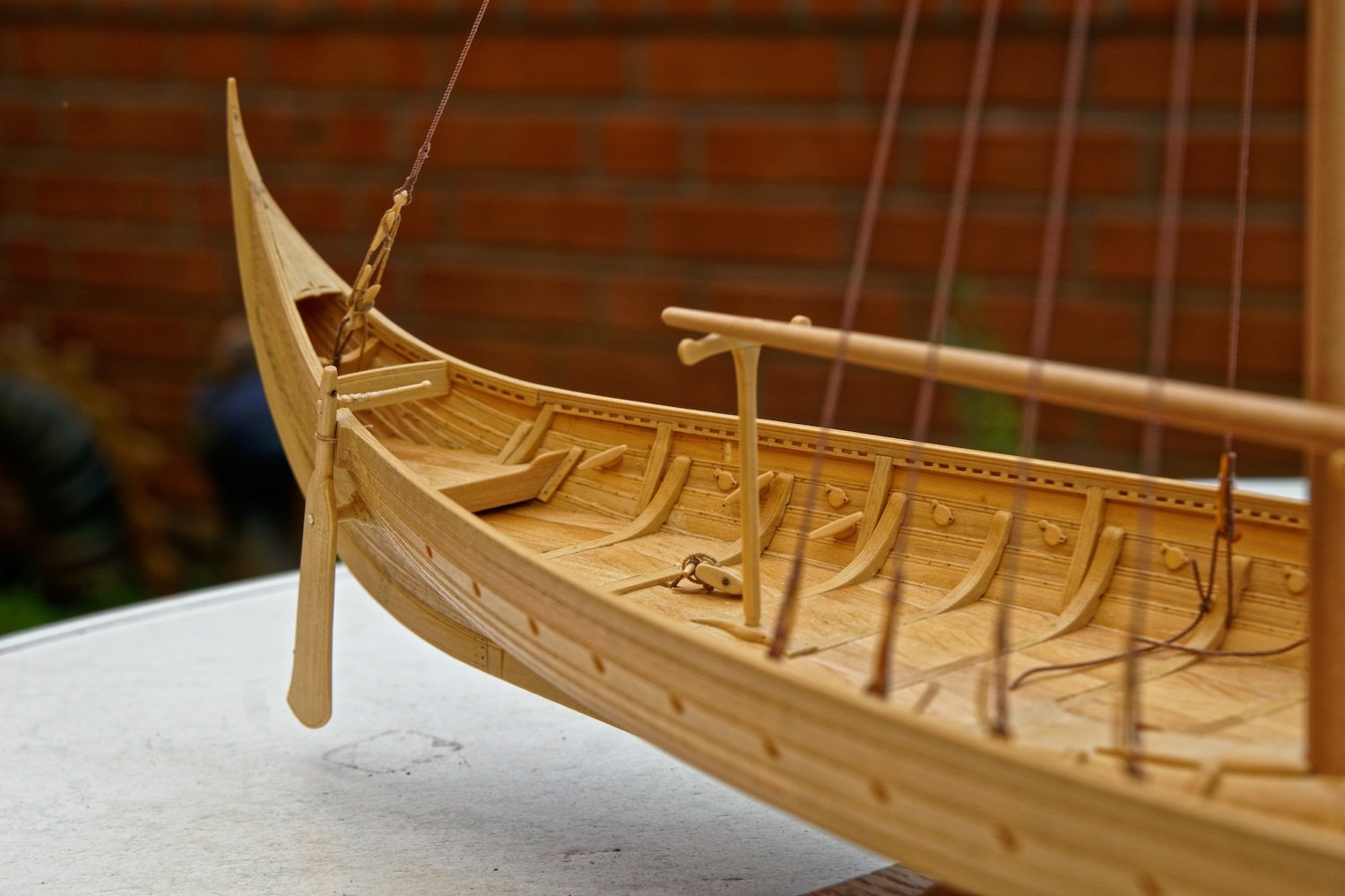

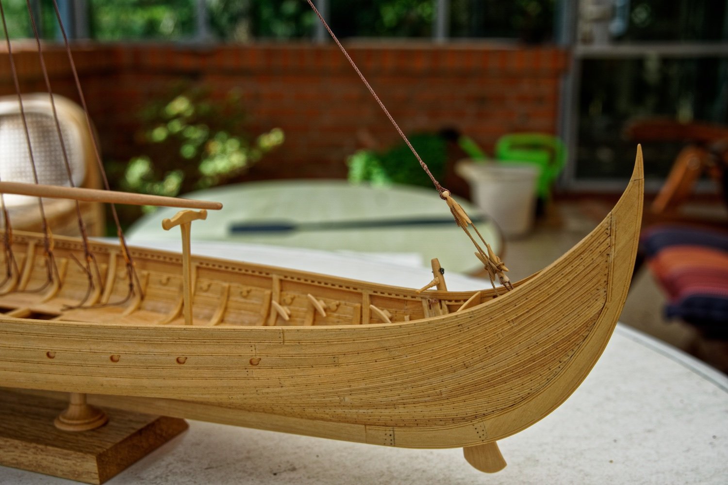

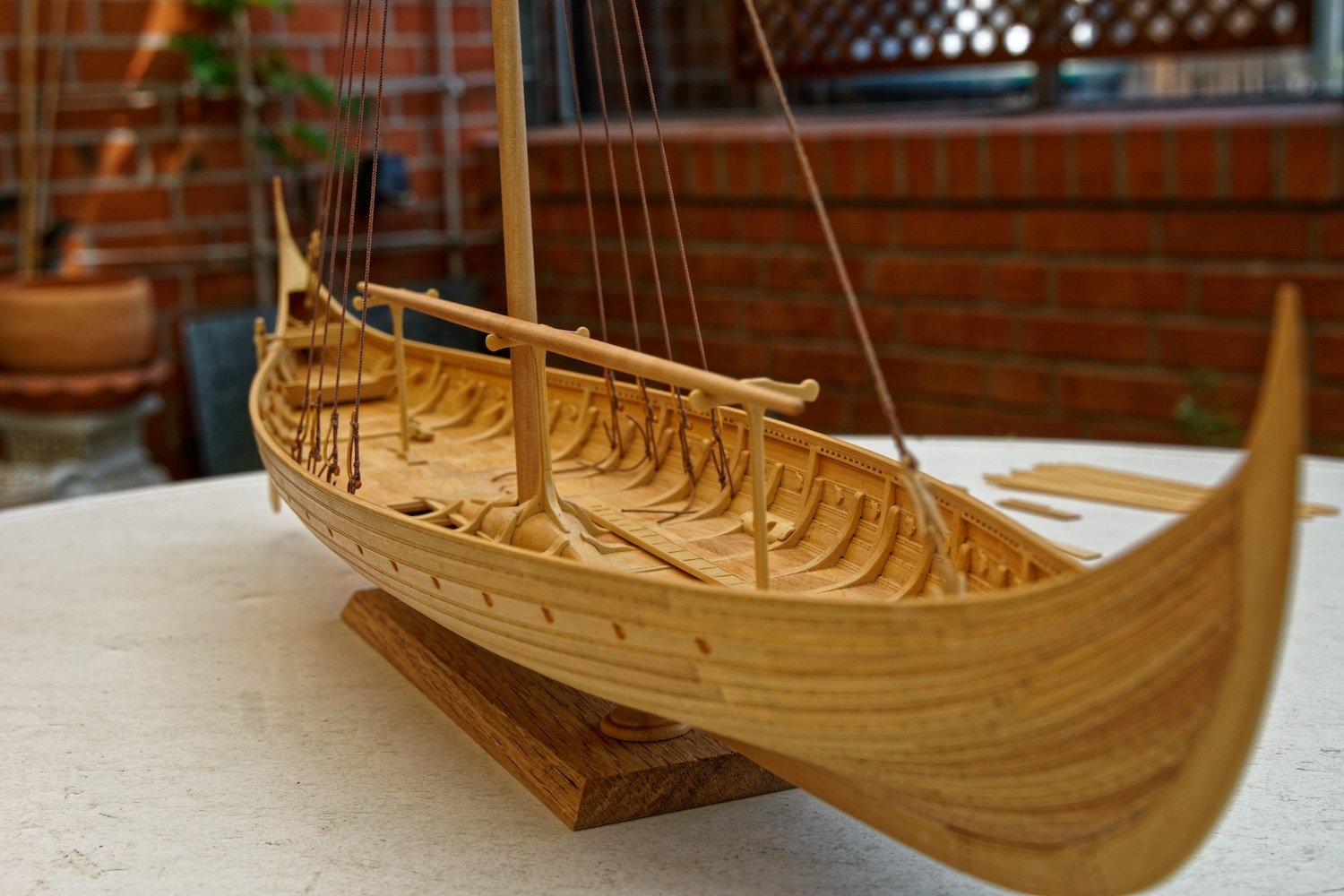

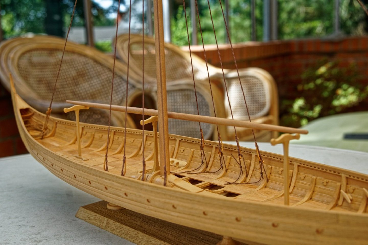

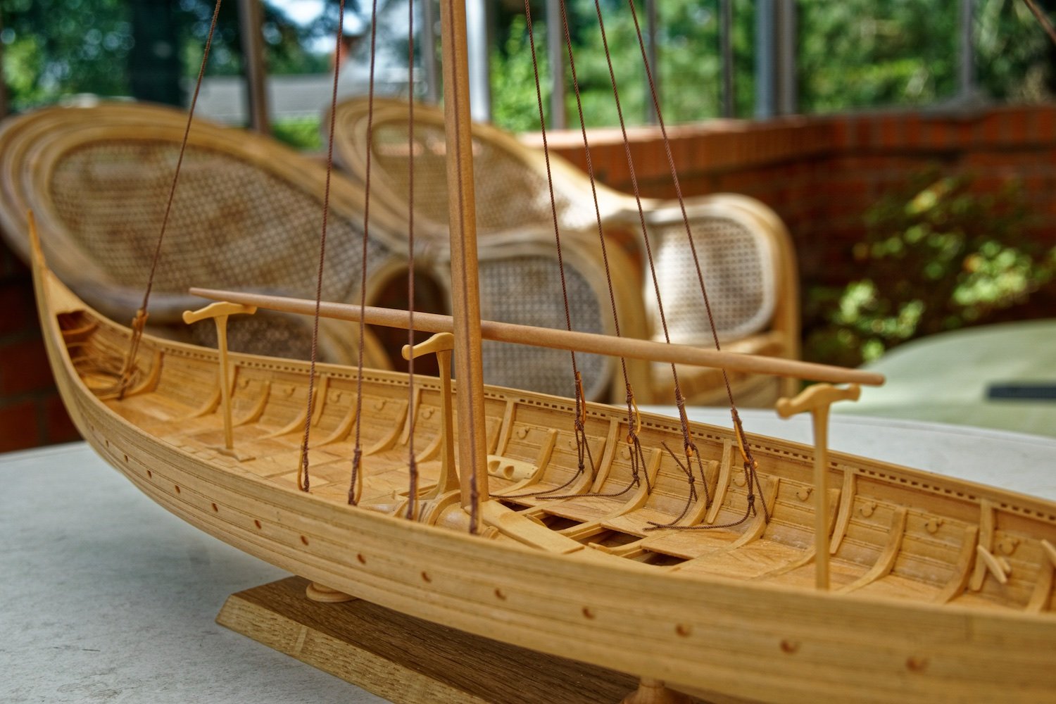

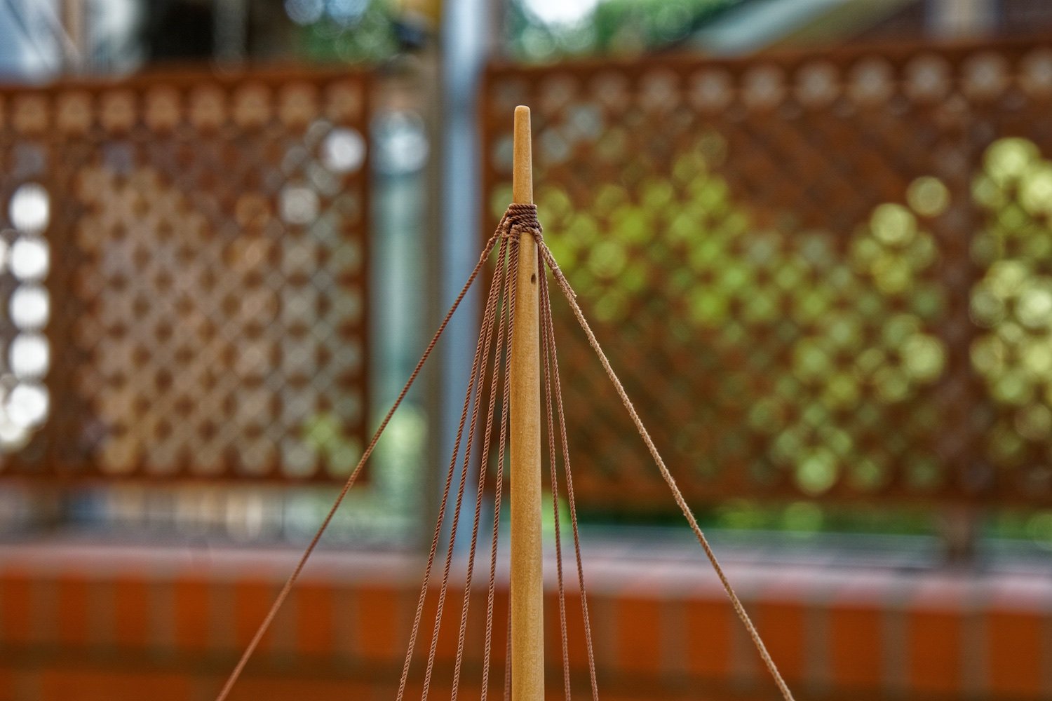

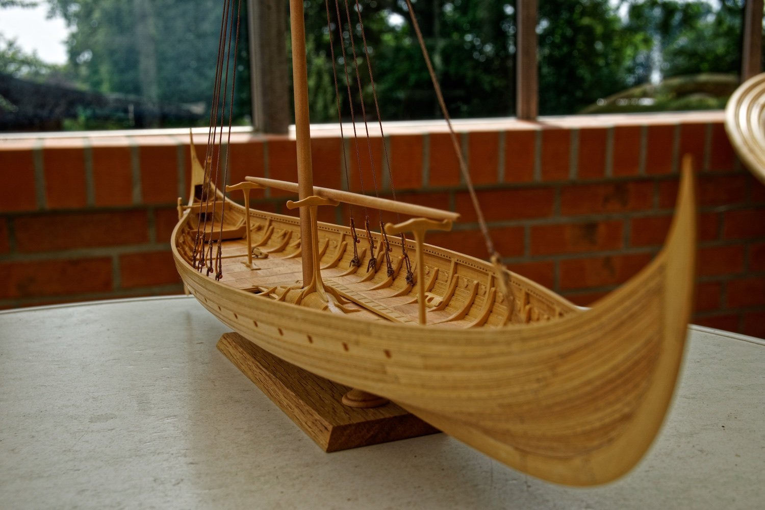

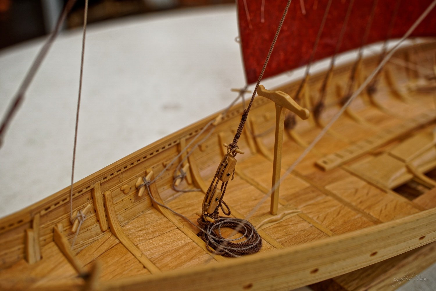

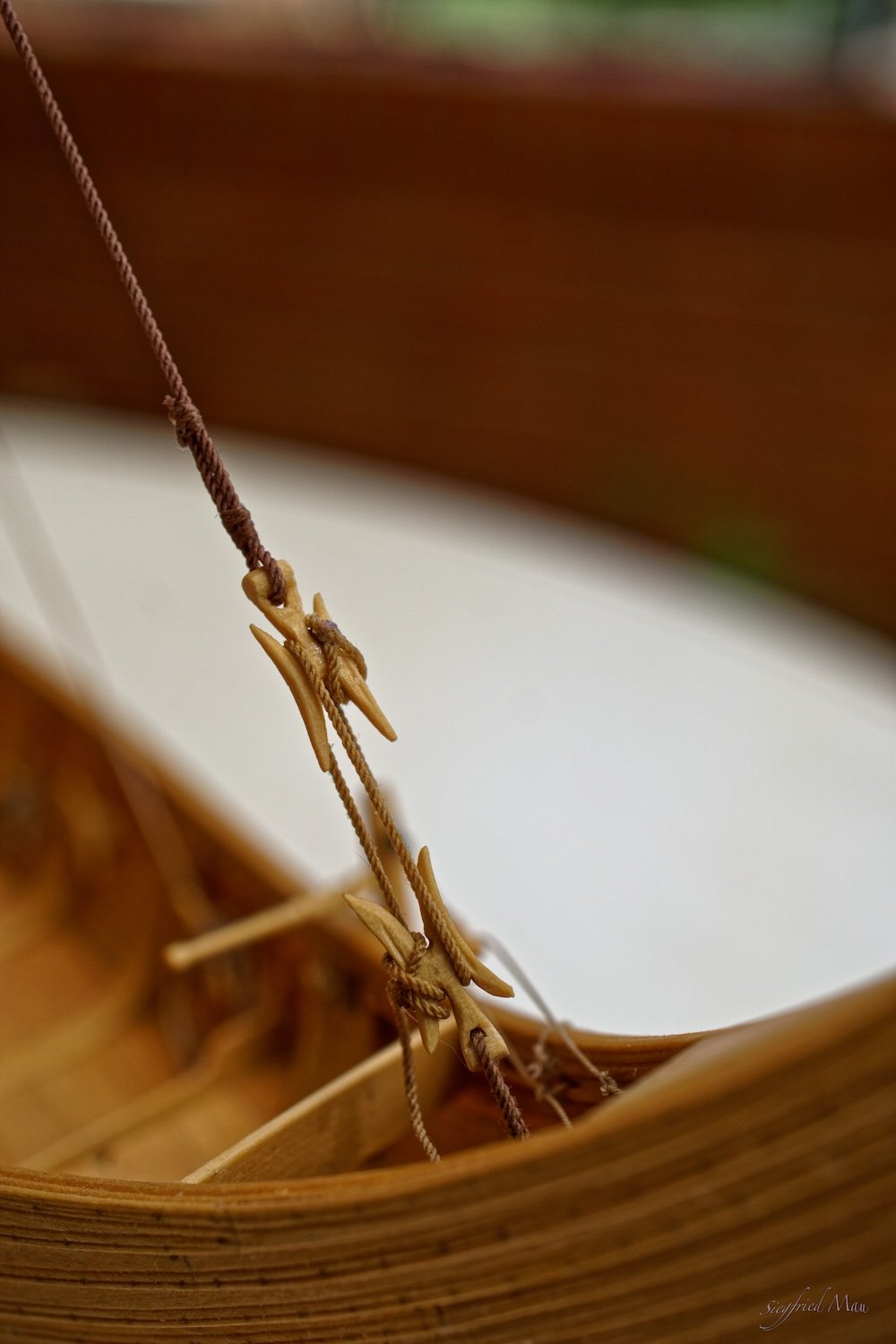

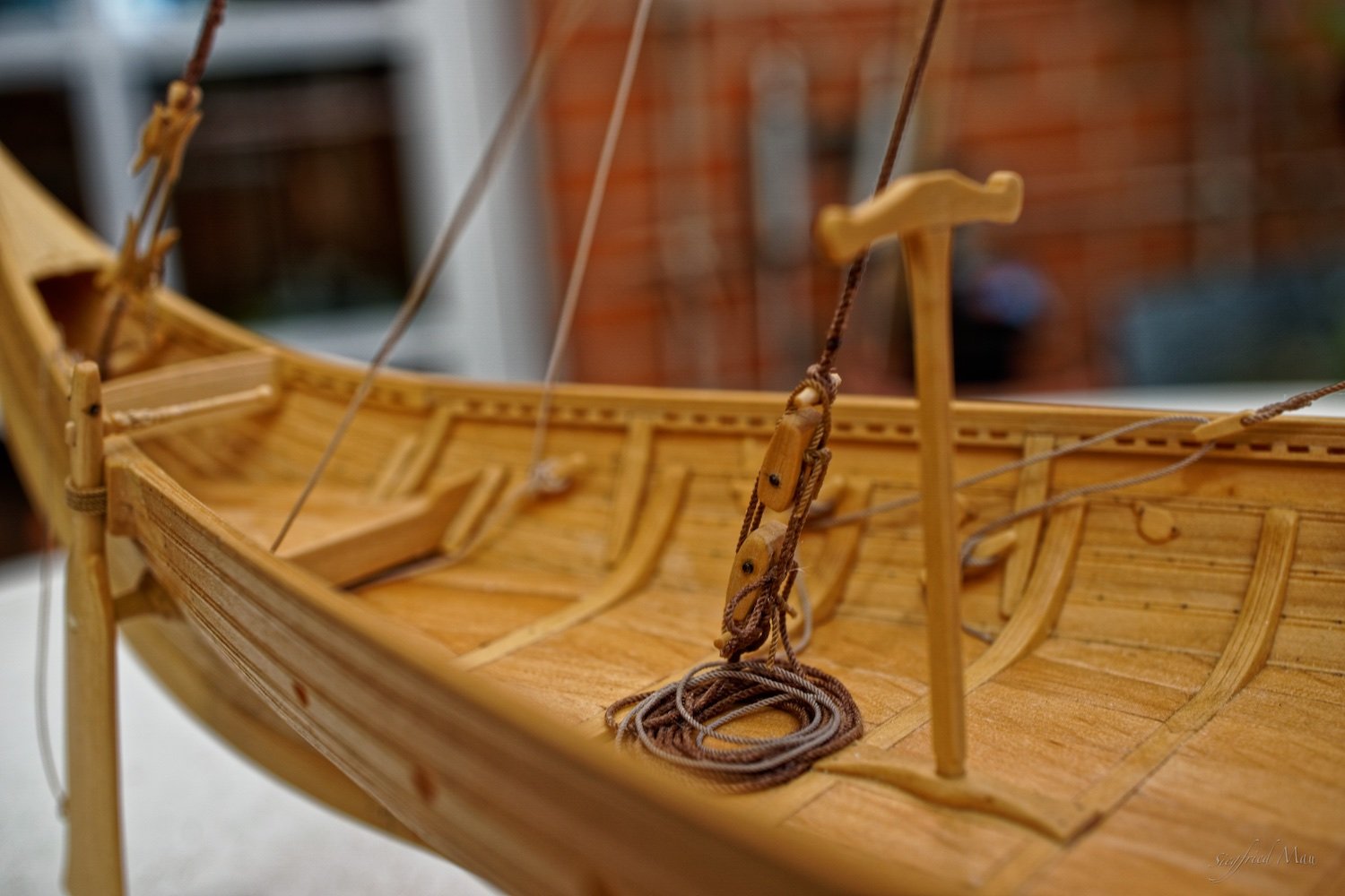

Today I finished the standing rigg. And I know now exactly, why I don't like rigging. These stuborne and nasty twines, who go always the directin you don't want ☹️ It was realy loud yesterday in the basement!
But the result is great, I think. Now the ship looks fuller, more compact. Enjoy the pictures. The strongest rope is the forestay with 0,7 mm Ø, the shrouts and forestay have 6,5 mm Ø

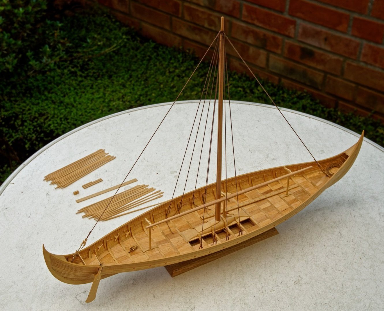

Today I cleared the deck from rope ends, at least from the shrouts. The next thing to build is the sail. I ordered Silkspan, and it should arrive here someone next week.

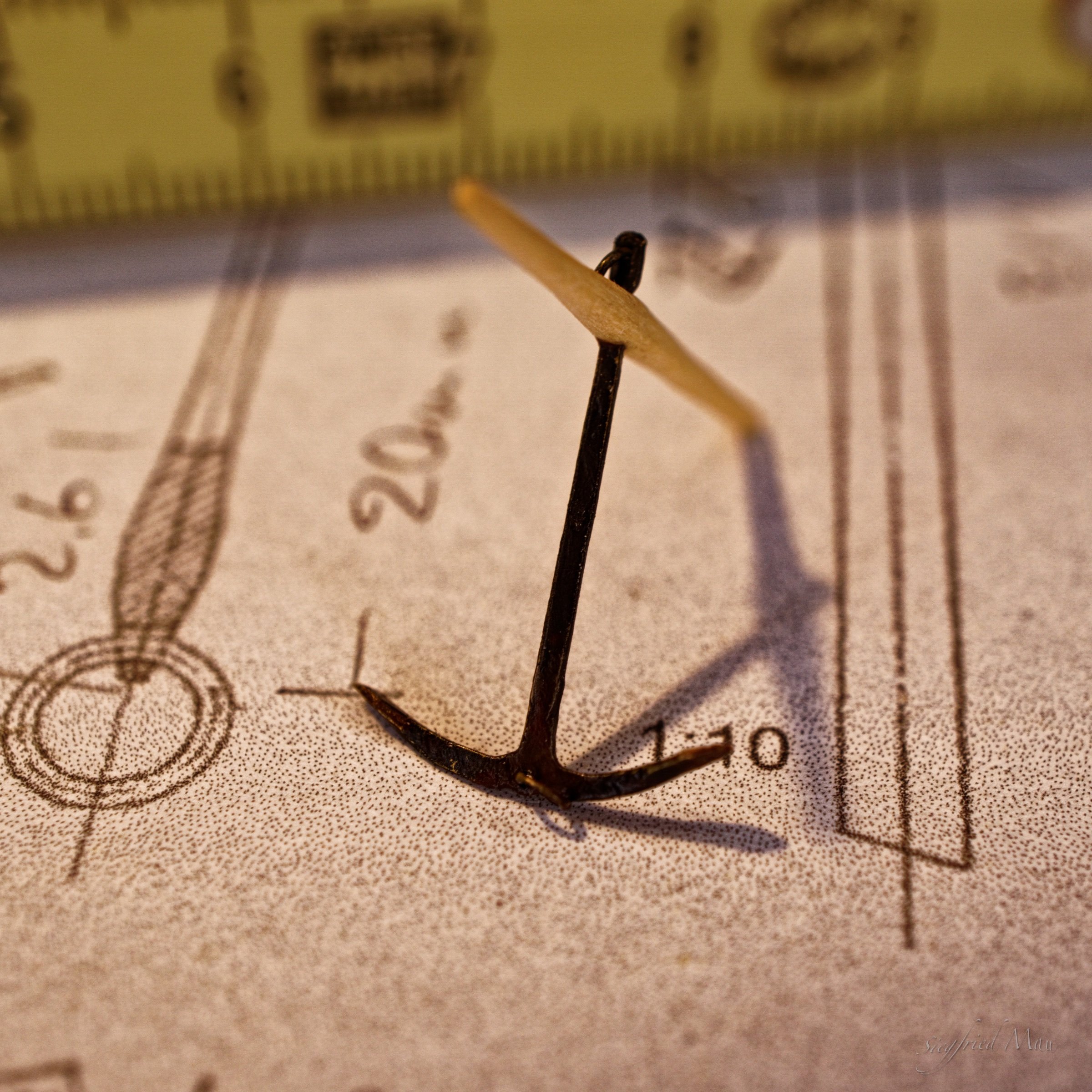

Hello,

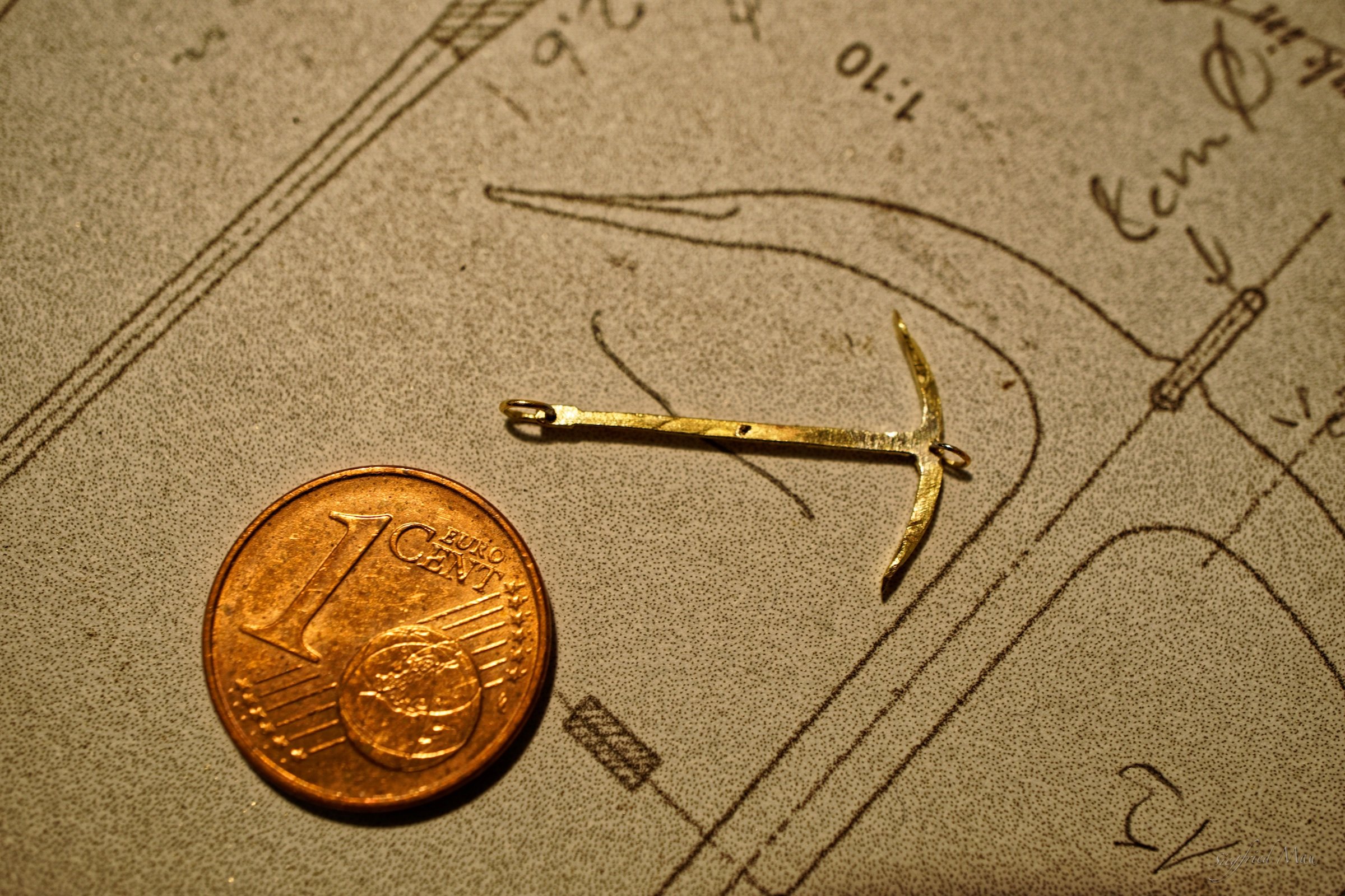

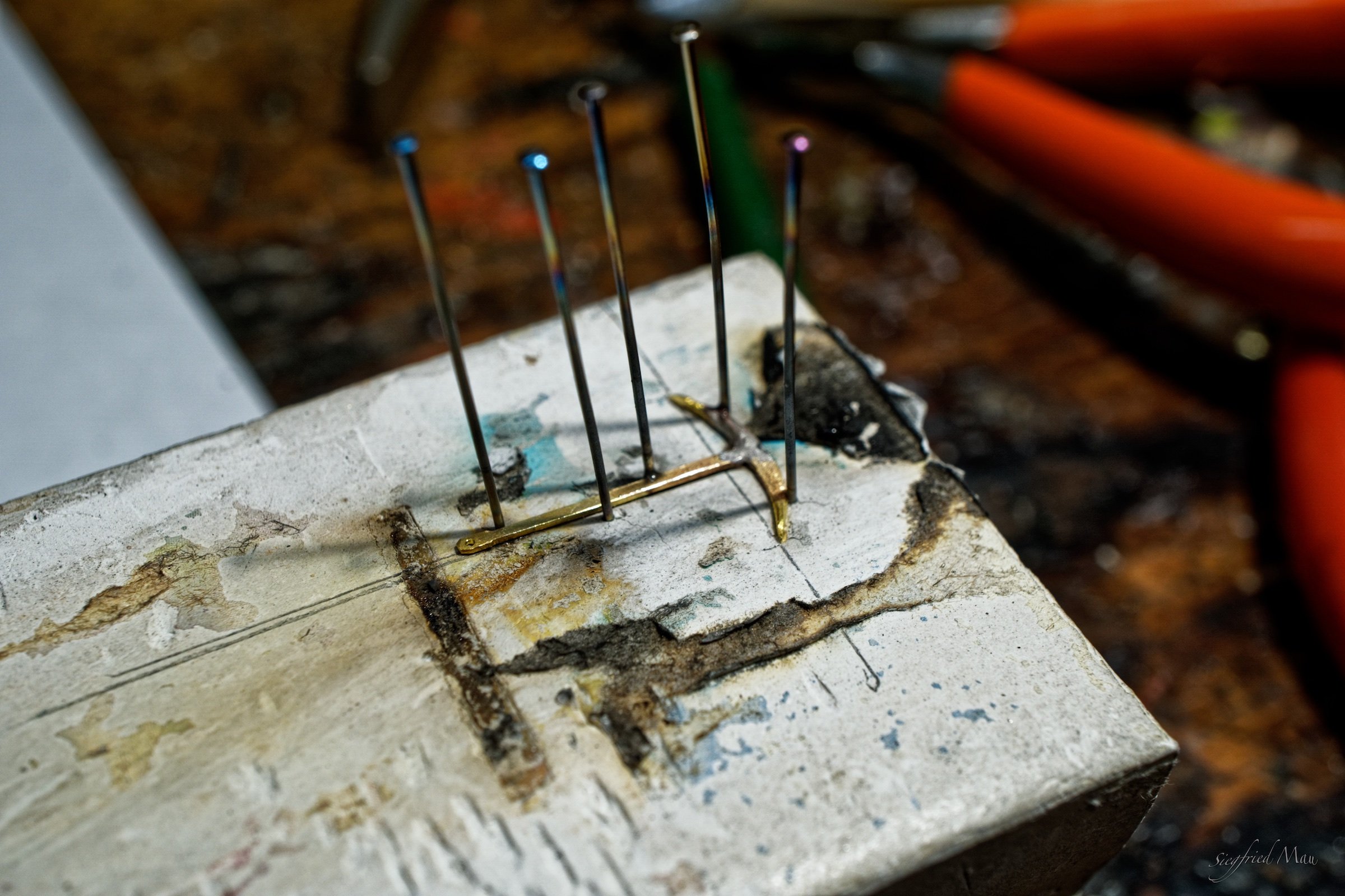

today I finished the anchor. At the Gokstad ship they found only a rust trace of an anchor from 1,1 m length, and an anchor stock of 2.75 m length. At the Oseberg ship they found an anchor of 1 m length, and two anchor stocks. One of 1,5 m and the other of 2,7 m length. The anchor fits to the smaler stock. May be, they though that the dead in heaven did't need the large anchor.
So I build the smaler typ of anchor. Material are pieces brass wire of 0,8 and 1 mm, hammered flat and to form and for the rings 0,4 and 0,5 mm wire.

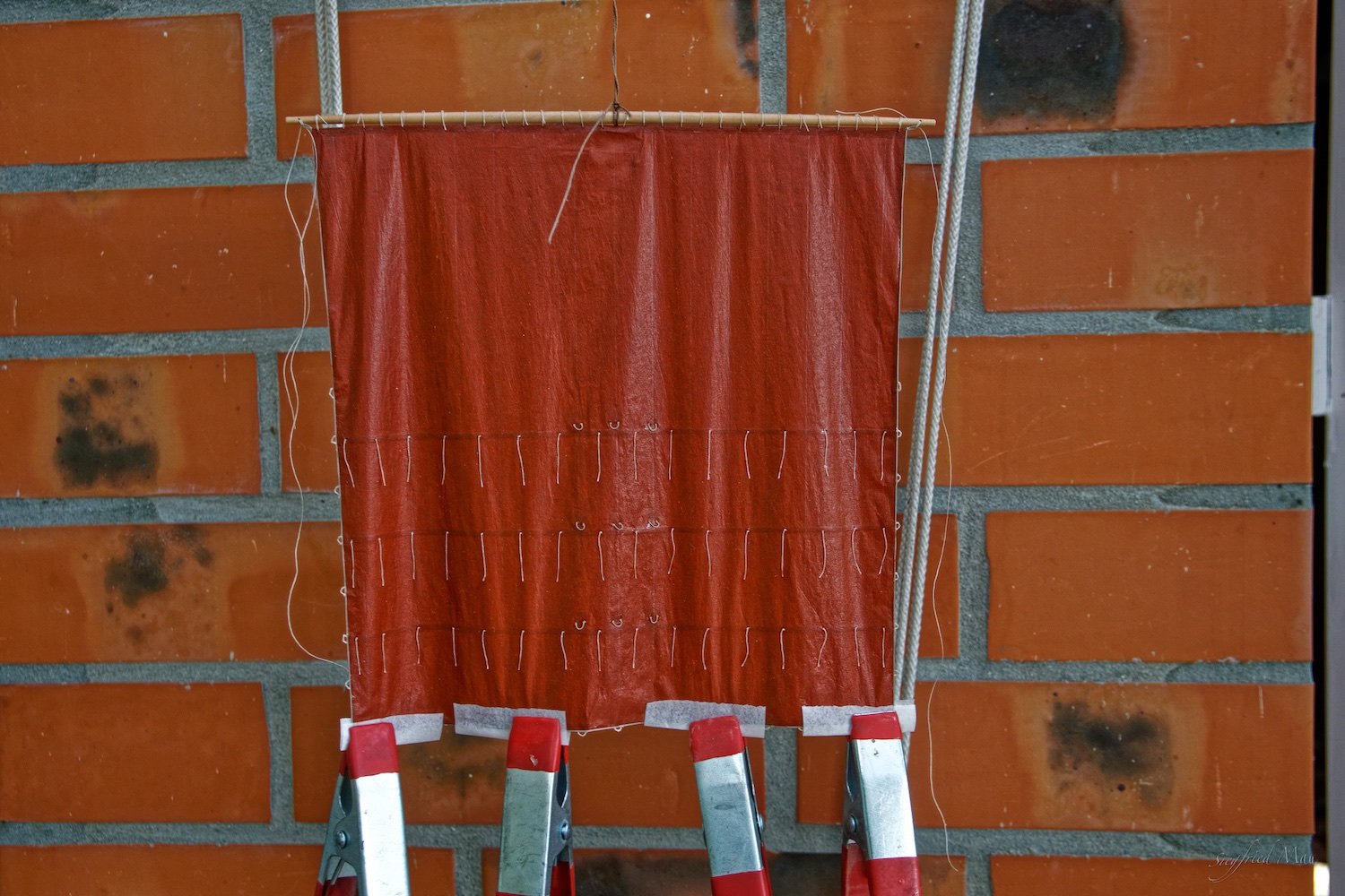

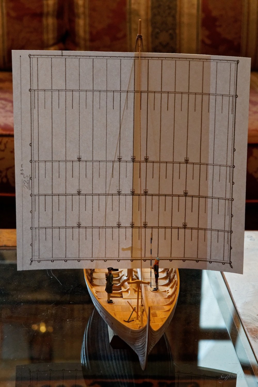

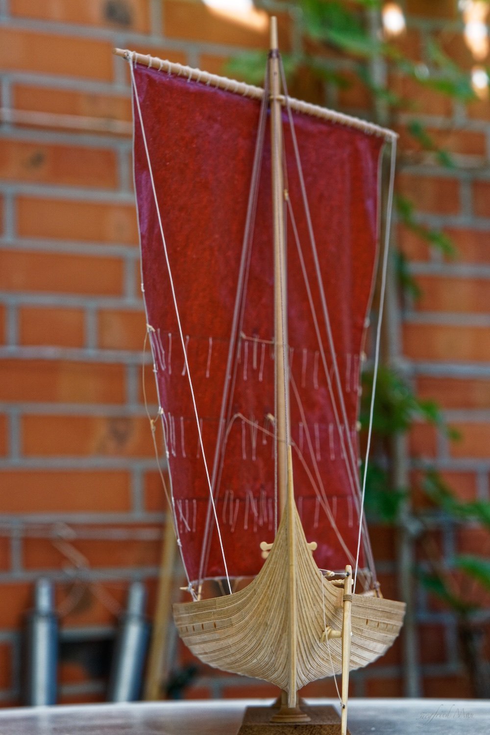

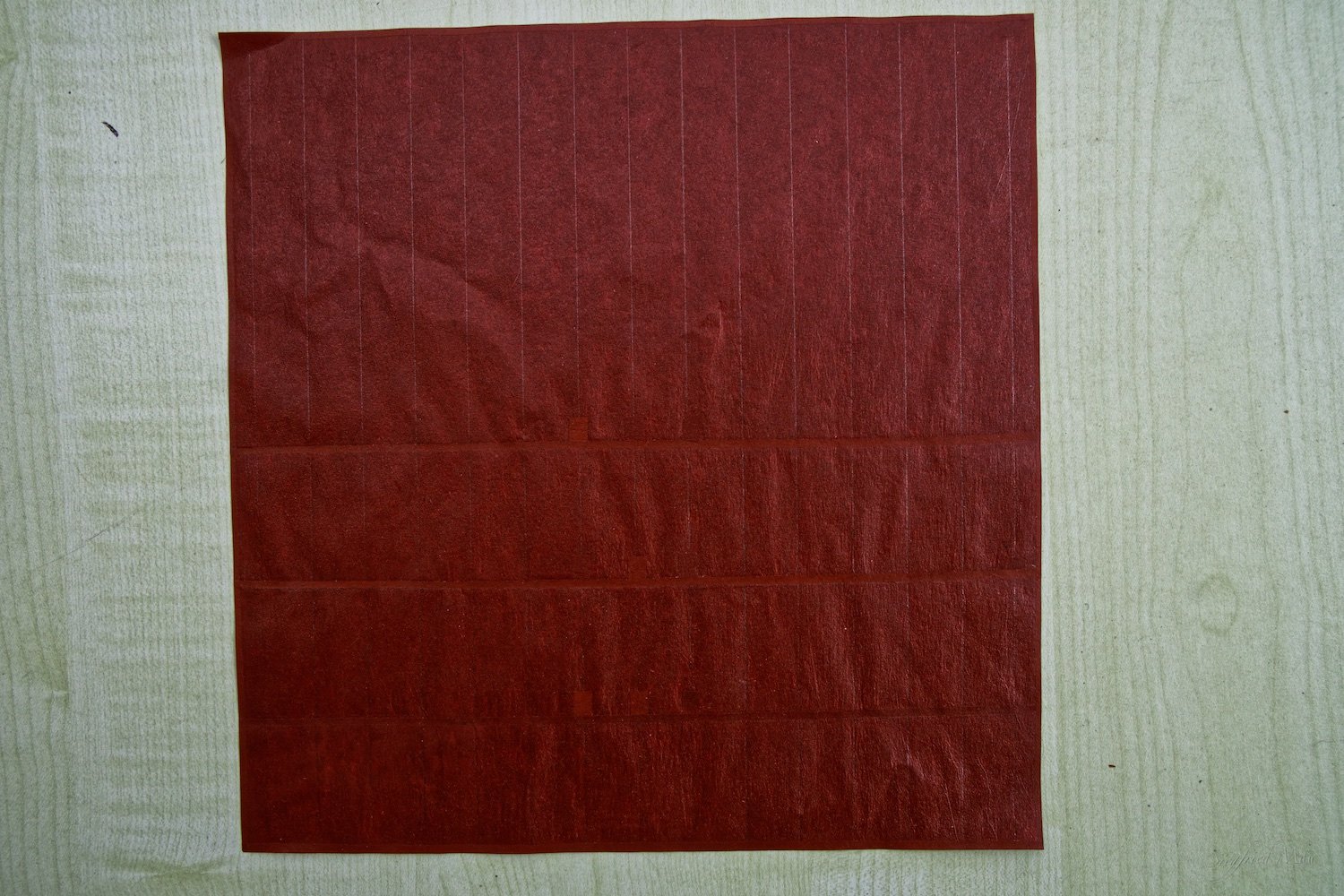

just a short sign of life, but no great progress. I'm bussy with the sail. My first try with silkspan did't work for me. The bolt rope tears out when I tried to sew it on. So for tomorrow plan B, linnen.
So should it look
And that is the the first try. Did't look bad, but did't work 😐 At least the color is't so red, it's more a red-brown

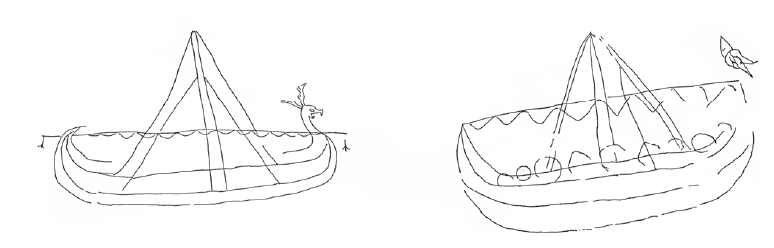

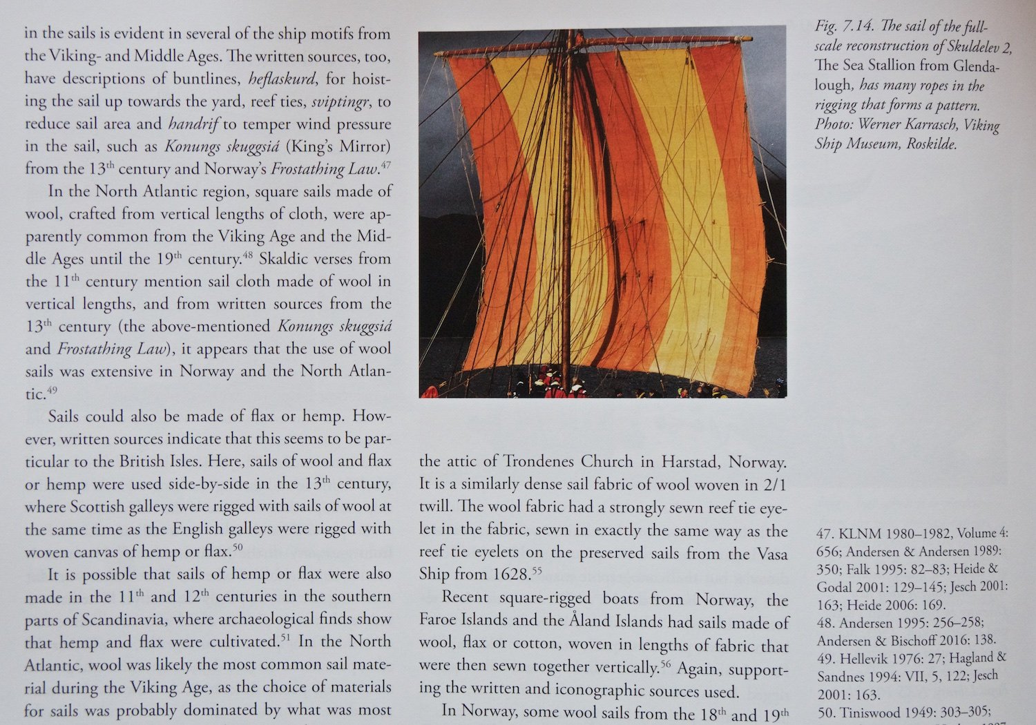

On 8/1/2025 at 4:21 PM, Siggi52 said:
I'm using what Vibeke Bischoff has reserched with her experimental archaelogy.
It is a very controversial area to dive into. But the results of "experimental archaeology" do not seem to mesh with the iconography so far found dating to the viking period. The sail that ms. Bischoff depicts in her plans seems to be most like those used in 19th century norwegian coasters as seen in this drawing by R C Leslie:
The iconographic evidence from the viking period comes down to only a few sources: rock carvings, coins, rune stones  and graffiti.
The Gotland stones aconsistently show a low slung sail which is as wide as the ship is long and with a diagonal pattern on it beneath which are a series of lines attached to the foot of the sail
The carvings on rune stones demonstrate very wide rectangular sails
Coins from the same era show again a wide low slung sail with evidence of the sail being brailed up in a number of places but only one coin (the third one) could possibly represent a reefed sail but I doubt it.
The graffiti scratched on rocks in Trondheim show a longship and a ?knarr with lowered yards and the sail furled.
The modern reconstructions of sail and rig are more in keeping with the well tested and effective 19th century sail of the coaster which is high and narrow rather than the meagre evidence from the viking period of a wide and low slung sail. We dont have enough evidence to be dogmatic about this and, at the end of the day, Siggi you have built a beautiful model of a modern reconstruction of the Gokstad ship and it is perfectly fine to attach a reconstructed sail on it. The above is not meant as any criticism of your lovely build.

Hello Dick,
one sourse you did't mention, the sagas. And Ms Bishoff worked up all the sources you mention and came to the result I have showed. After Ian wrote his coment, I re-read the chapter about the sail.
Did you have her Book? It is very interesting to read and she used every source available. ISBN 0901-778X and 978-87-85180-77-3. I got my copy through Amazon from California.
I'm sorry, but my english is't so good to make here scientific discoursions and I'm not an expert for Viking ships. You may be right that the sails they build today look more like modern sails, but she also has arguments for the shape of the sails she build and why the sails were not as wide as the ship is long at the picture stones and coins.

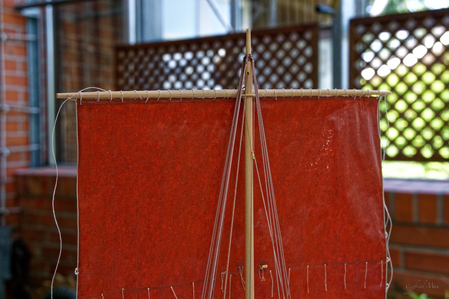

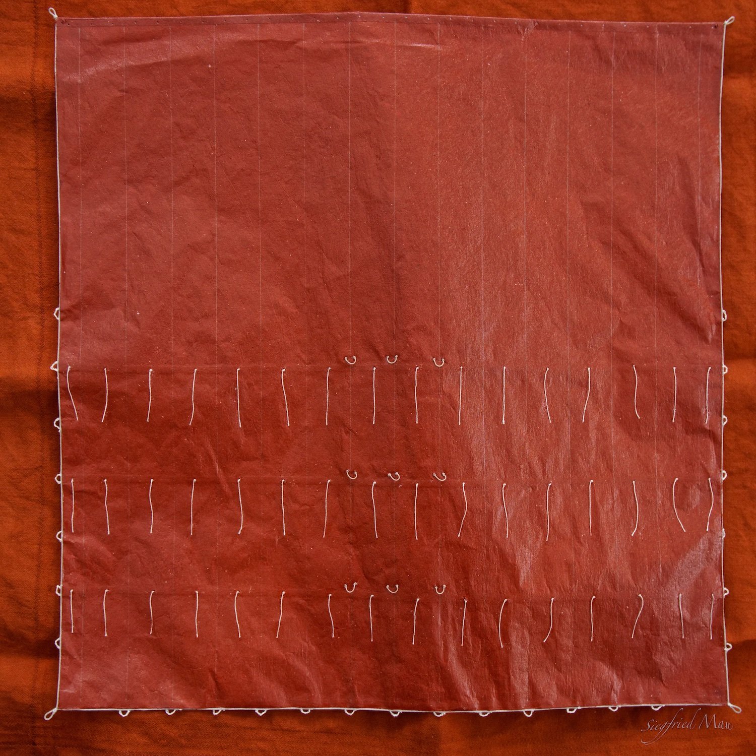

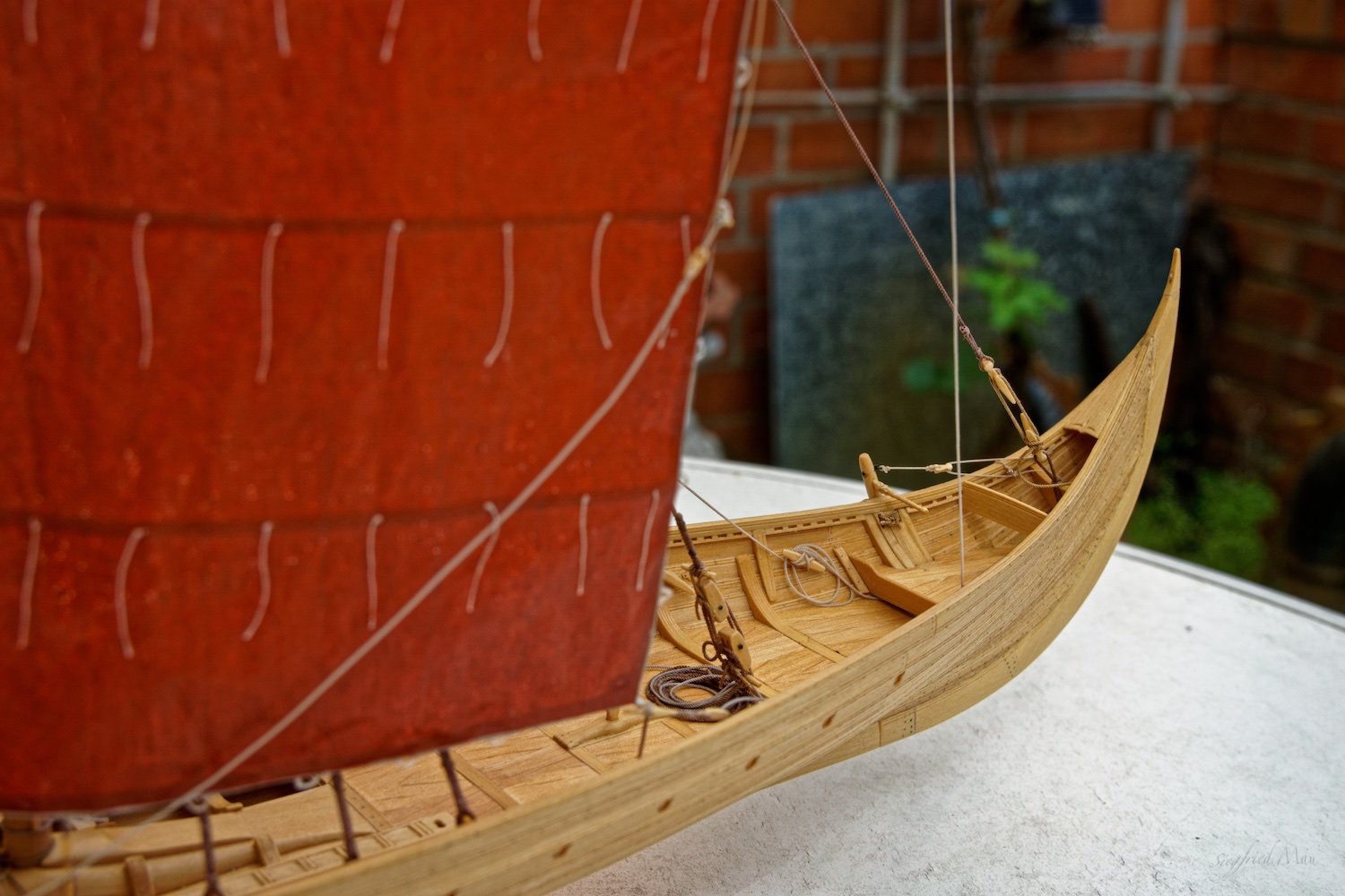

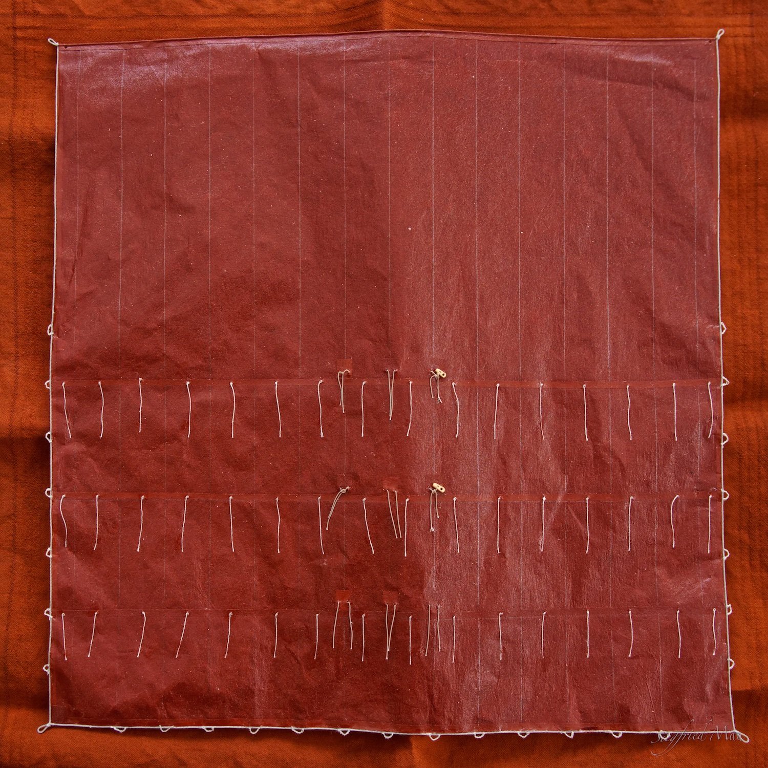

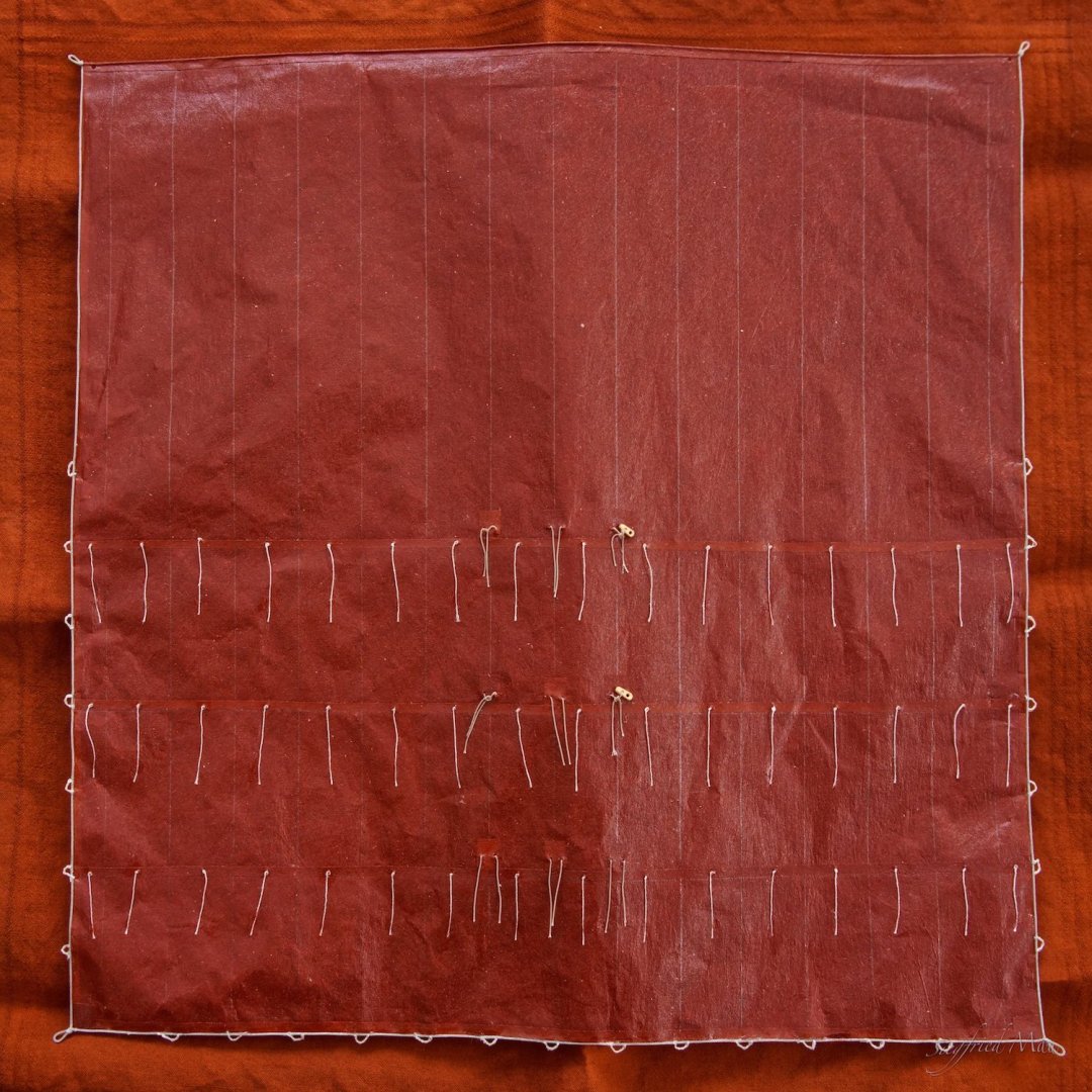

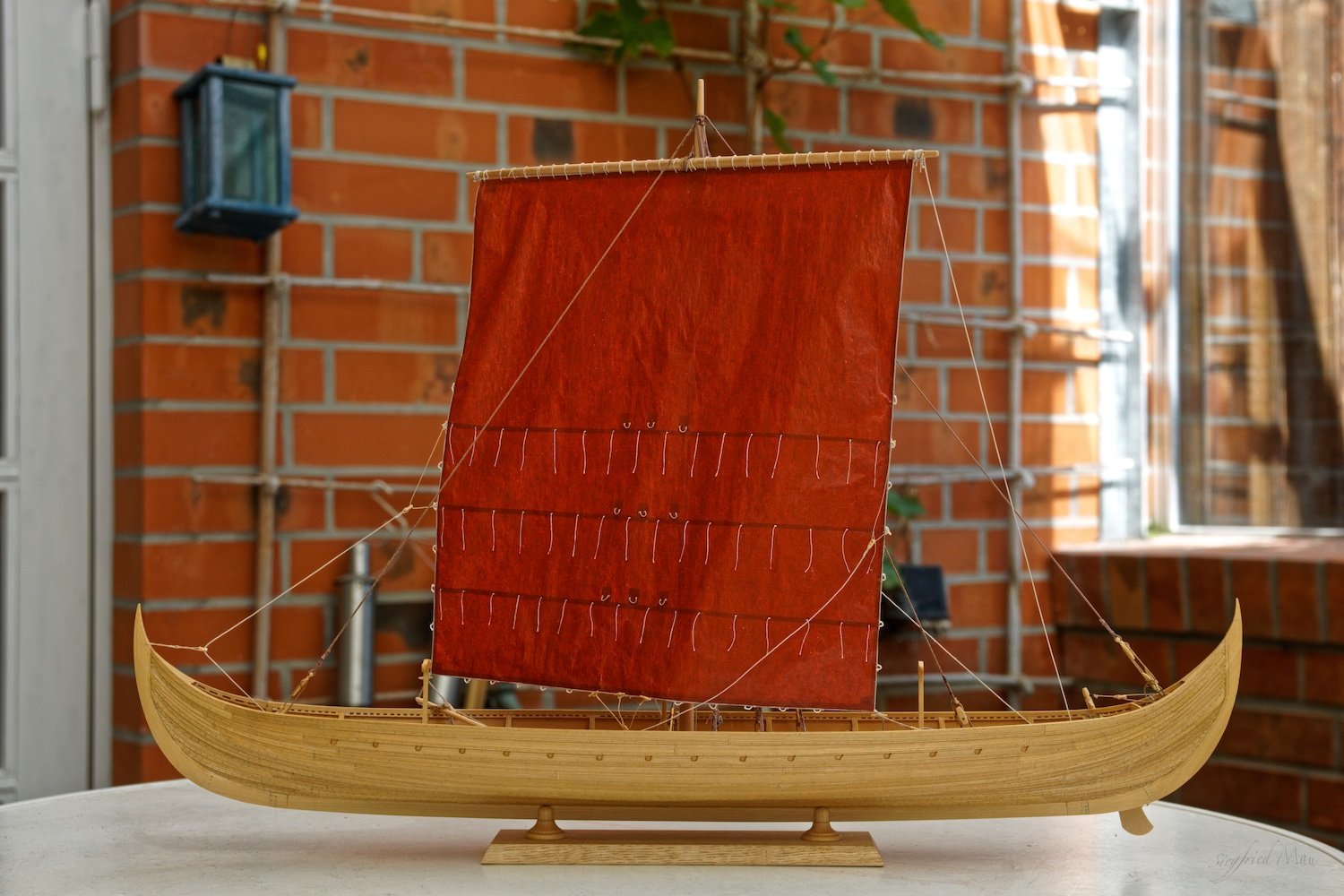

Hello,
the summer is back 😀 We will see how long it last and we have here 19°C again.
Today I finished the sail and the next days I hope it will be at the ship.
The front side
and the back side

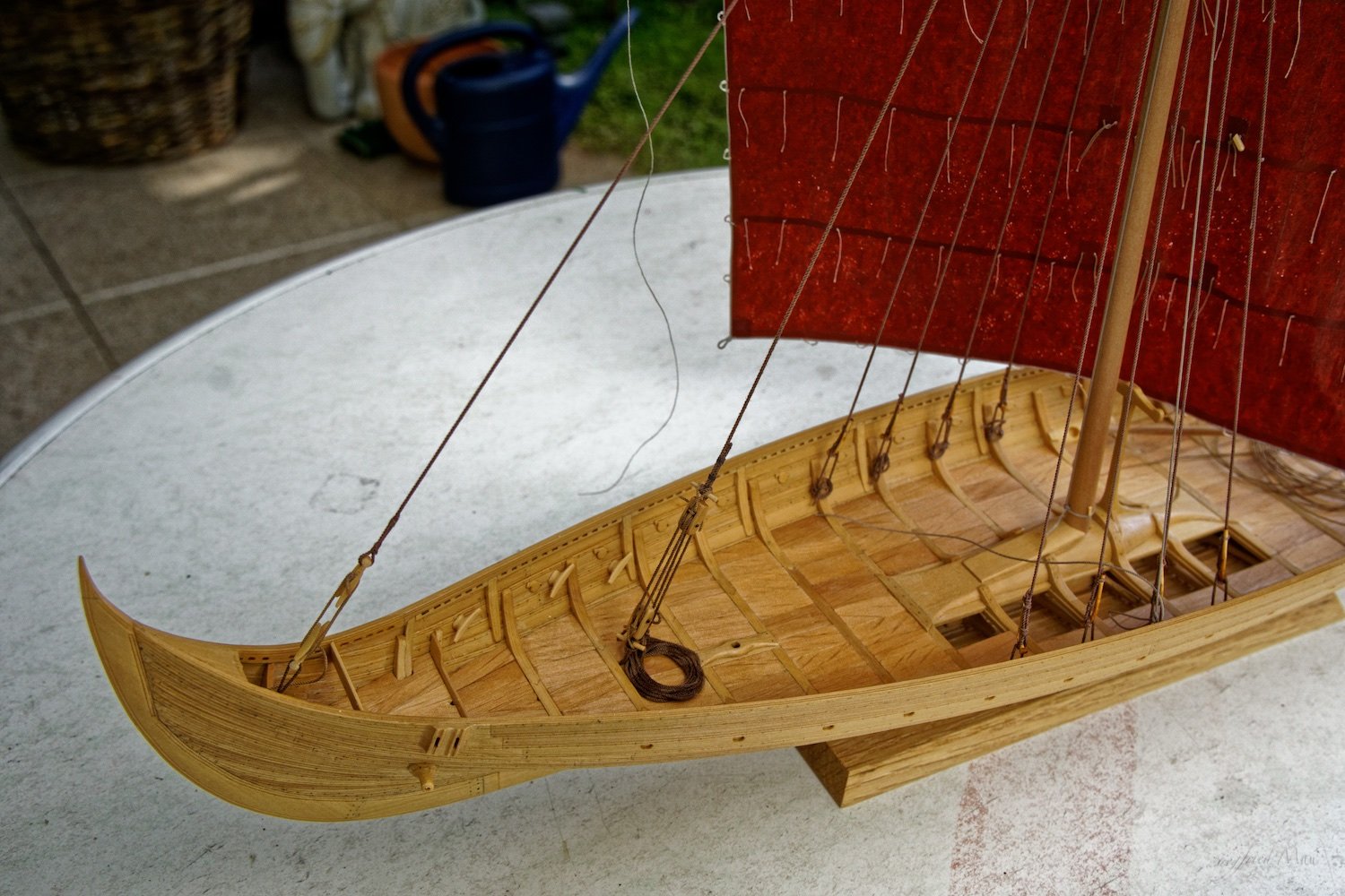

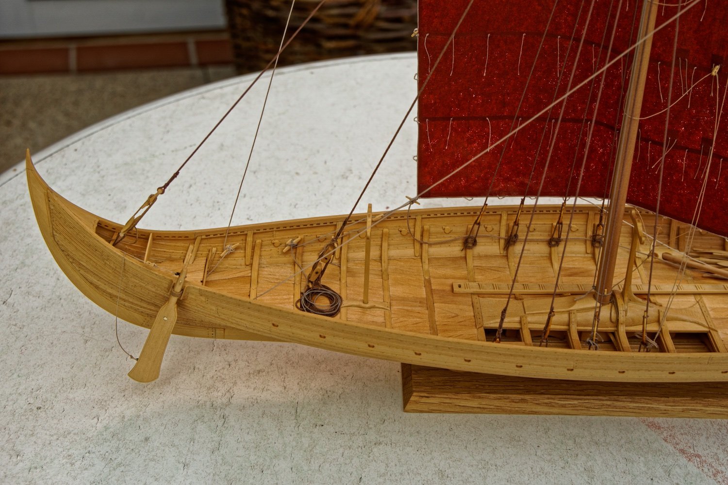

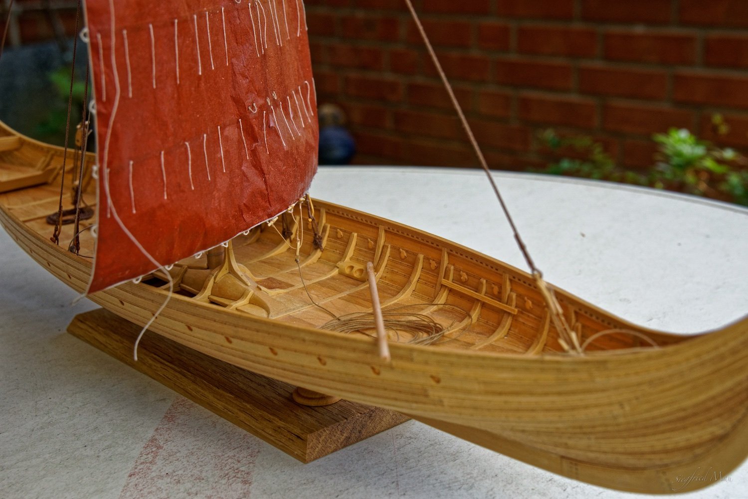

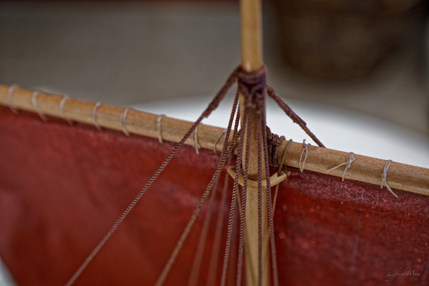

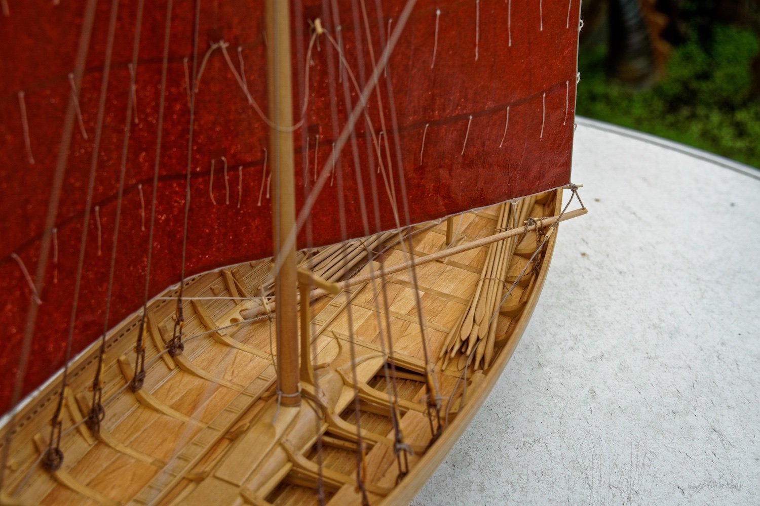

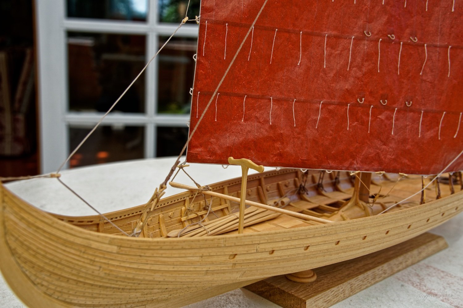

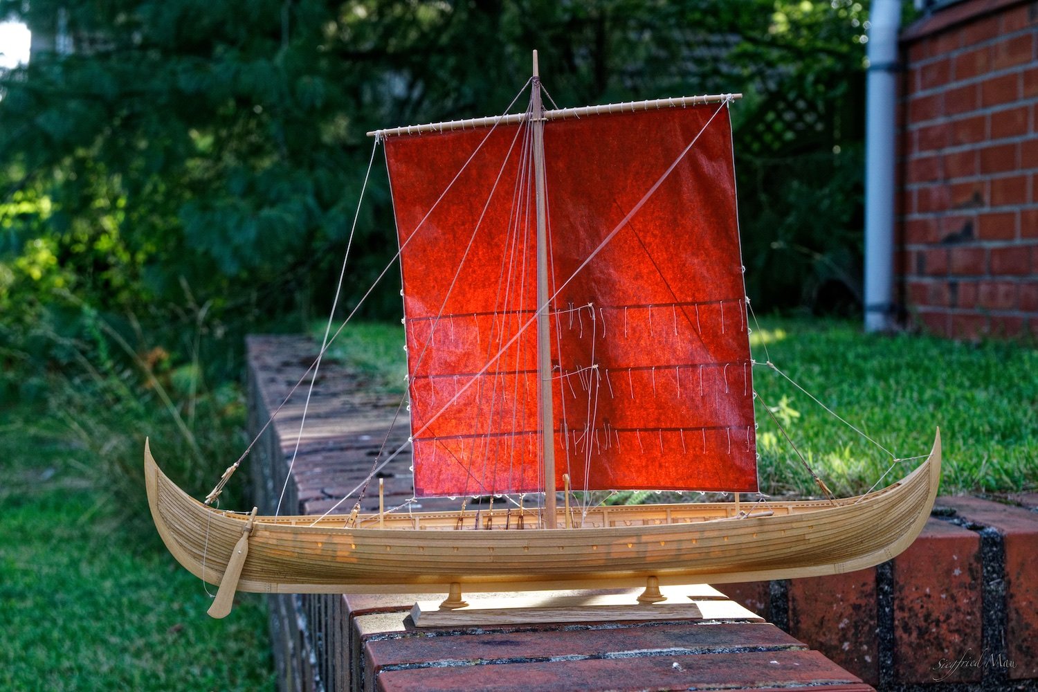

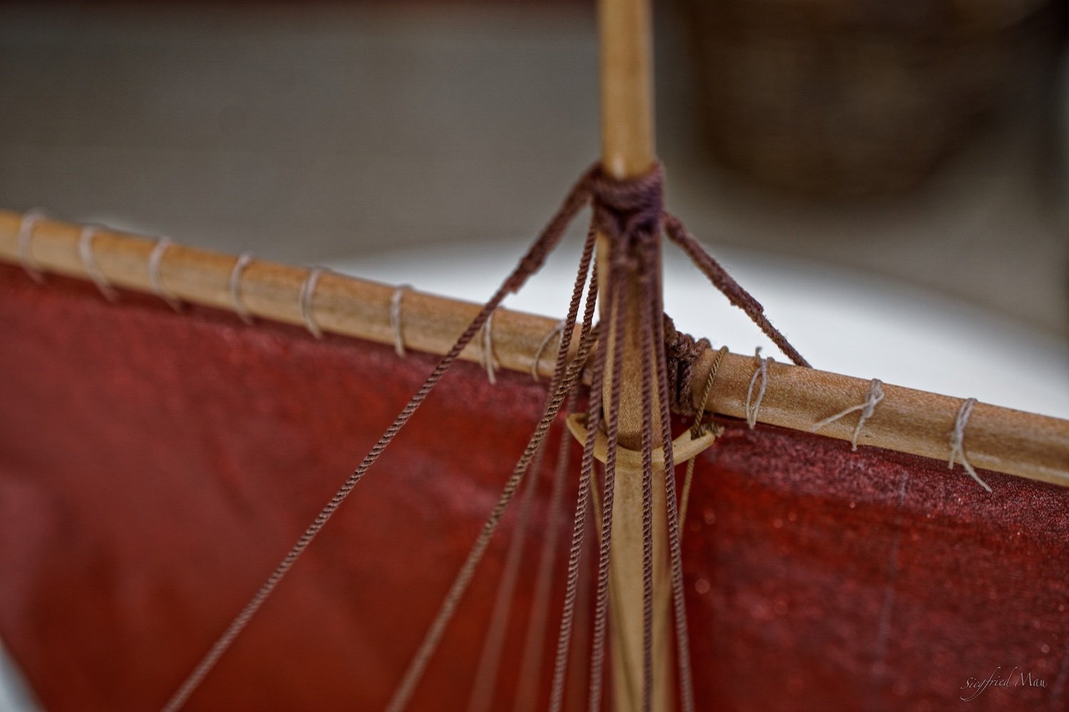

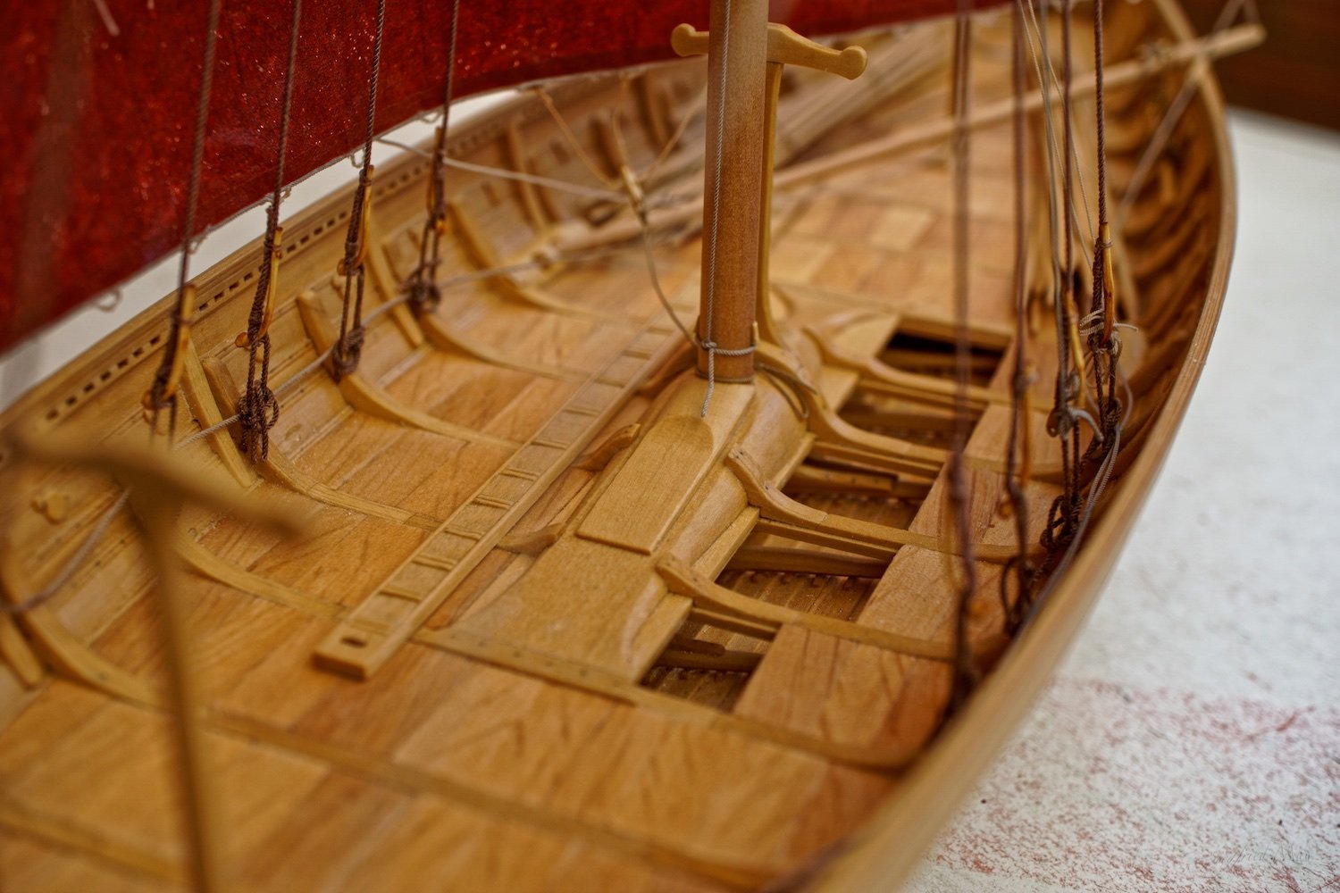

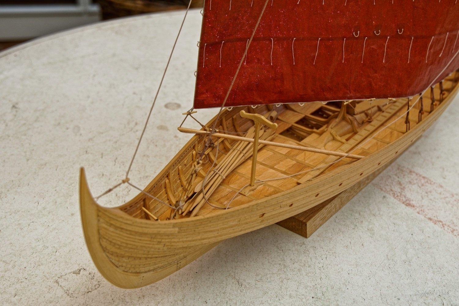

Hello,
the sail is set. But at least not completly rigged.
The upper parrel rope, I think, I must also make in 0,4 mm Ø rope like the lower rope. But that is something for tommorow.

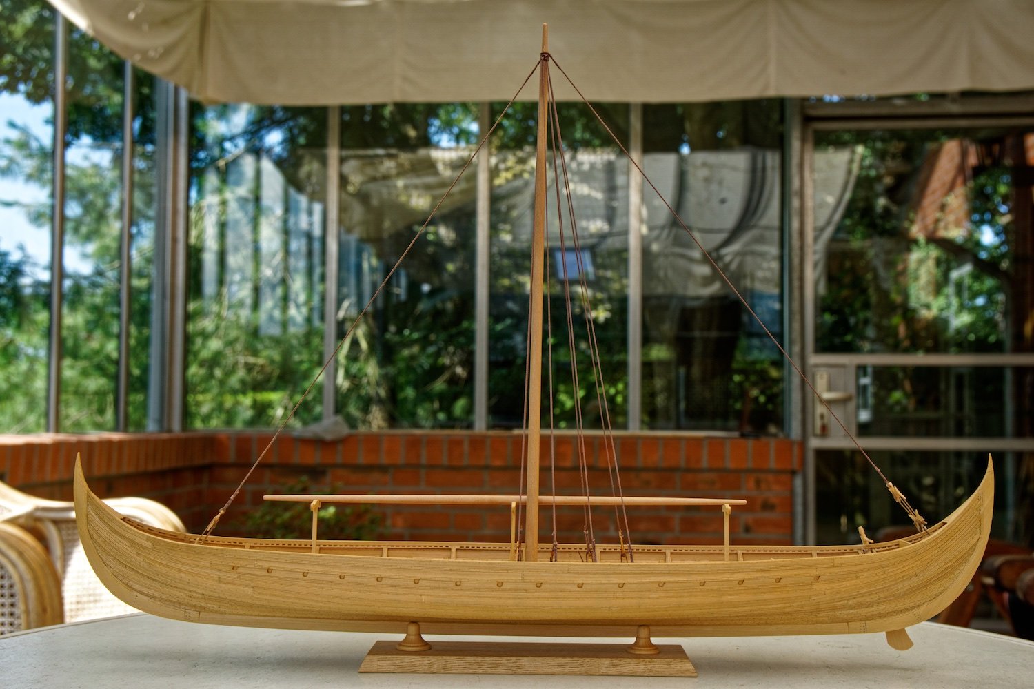

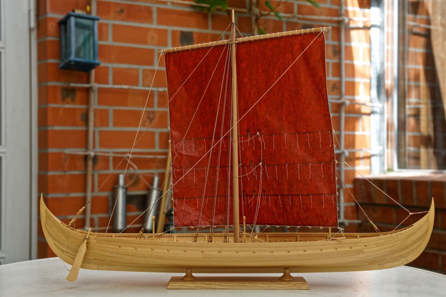

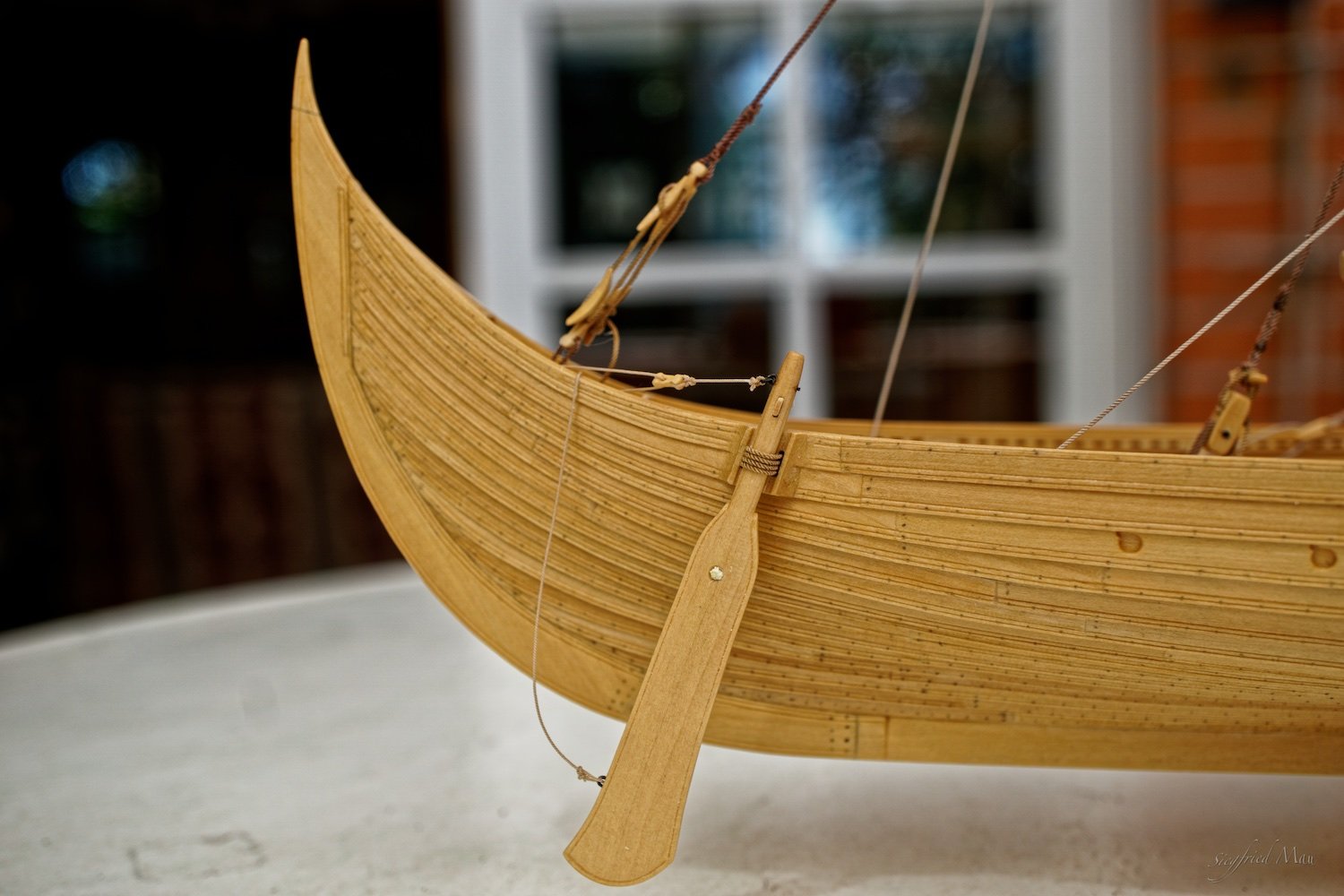

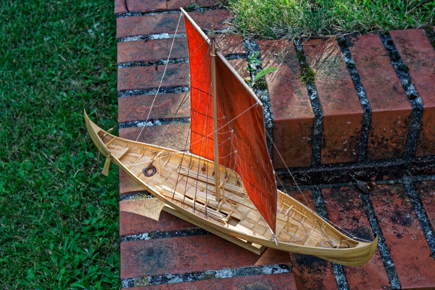

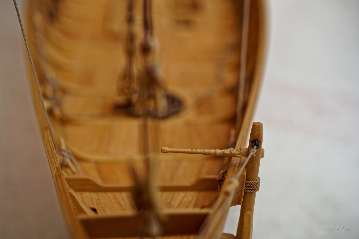

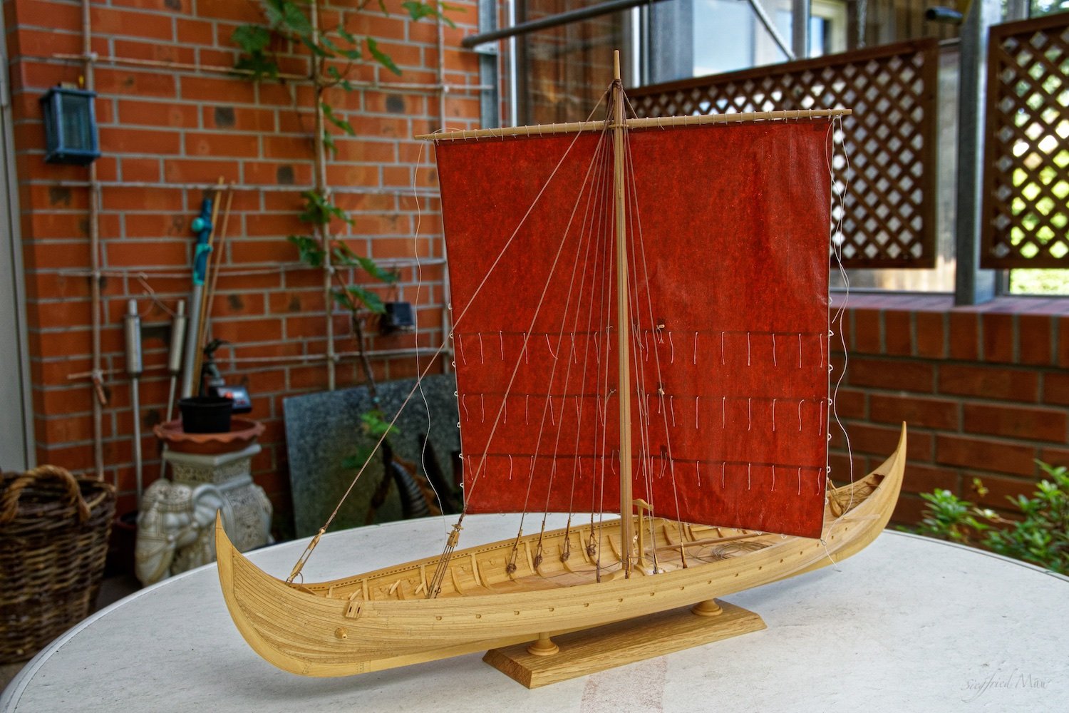

Hello and thank you for all the likes,

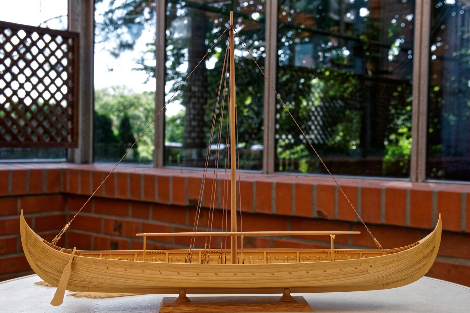

today I finished the ship mostly. The rigging is complet and only the oars and some smaler things must be fastened. Some pictures with the last sun for today. More tomorrow

 Congratulations, Siggi. She is beautifully built displaying your extraordinary skills. 👍
 What a beautiful gem. Siggi, thank you for sharing and letting us be part of the journey.
