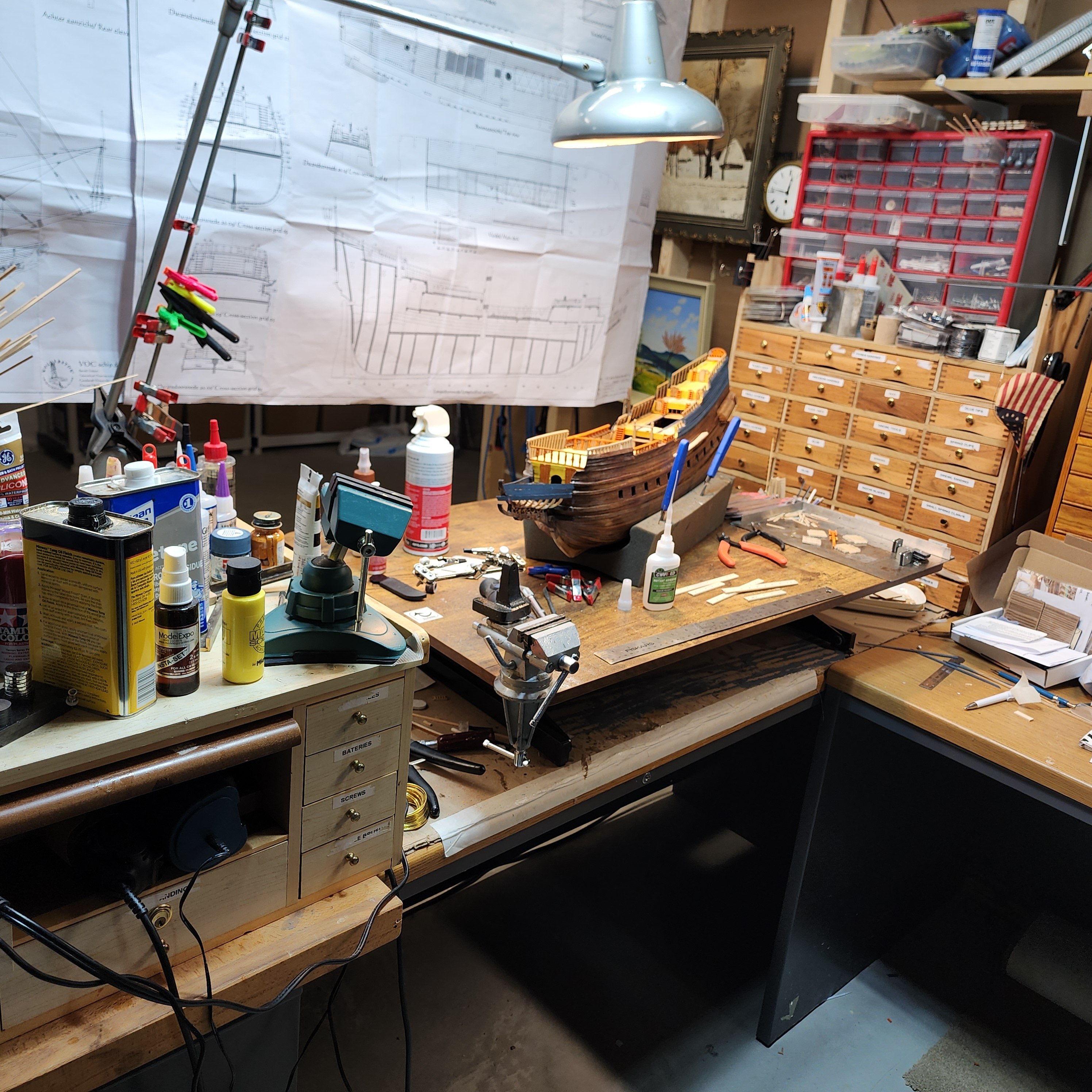

Hi Chris, I have three work tables. One for drawings, one for the build board and one for fabricating. I always stand while working so the tables are all 42” high which is about elbow height for me. The build board and fabricating tables sit in the middle of the room so that all sides are accessible. If I get tired of standing I have a roll around drafting chair with the seat sitting 30” off the floor. I find that this works for me because I don’t like having to climb out of a chair if I have to go get something which is quite often. I never put anything in cupboards because once the door is closed I can’t remember where it is or if I even have such a thing. Each table has an led shop light hanging over it and an articulating magnifying light clamped to it. And lastly I invested in a good shop vac that doesn’t scream when you turn it on. Good luck with your new shipyard 👍
Best Regards……..Paul

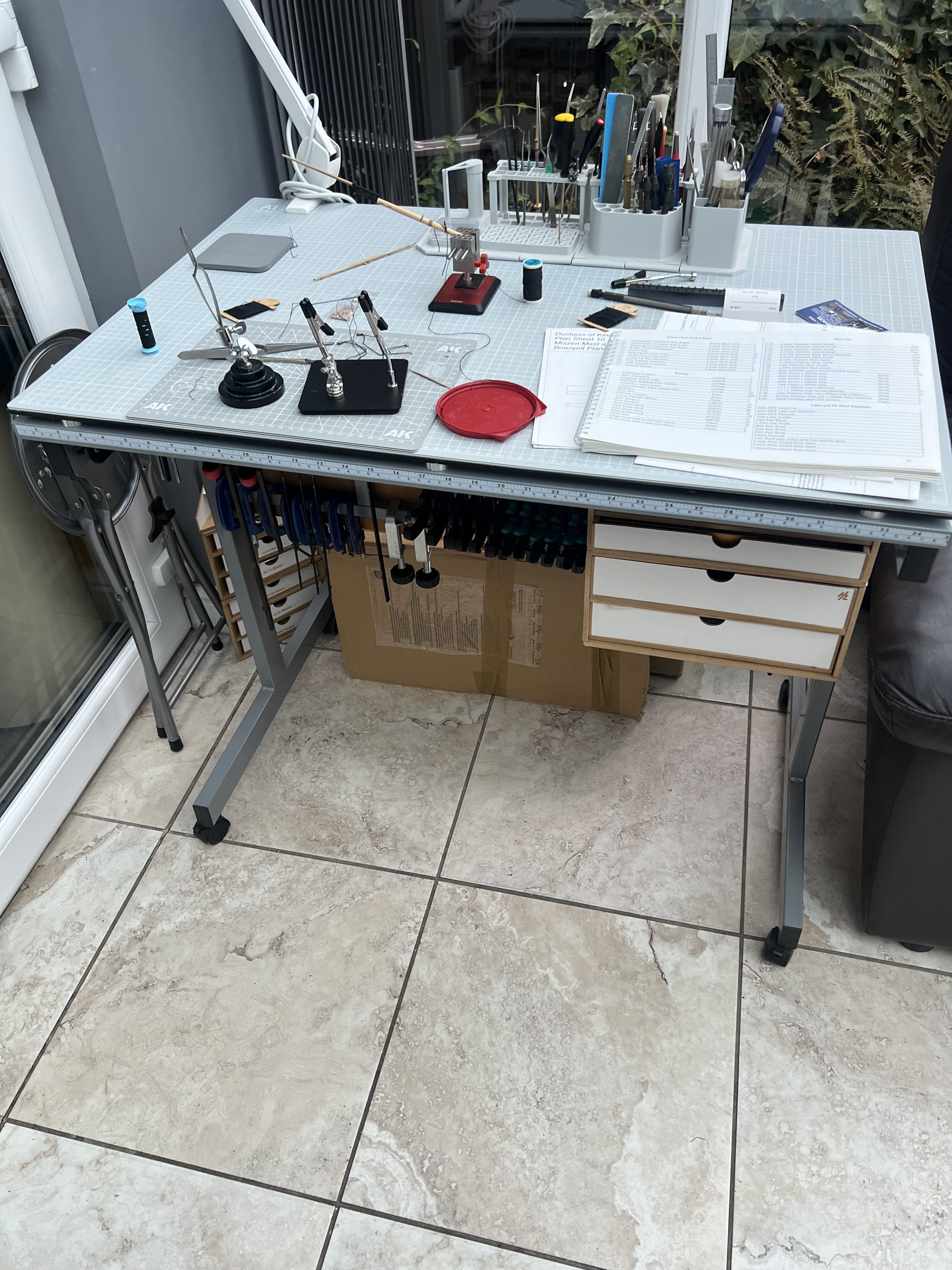

As always strongly recommend to buy an electrical lifting table, they are quite affordable nowadays with many companies on the market (including IKEA that sells frames separately). Replace a flimsy office tabletop with a sturdy solid wooden one - and you will end up with a fantastic build table that allows you to find a perfect height for any operation. I added an inset vise and peg holes into mine, the possibilities are endless.
It is a relatively new "accessory" that is often overlooked, well worth the cost.
I would avoid hammering mortise joint with a chisel on such a table, so it is not a full replacement for a workbench if you do a normal woodworking. But more than sturdy for all the modelling needs.
Some examples of my setup (IKEA table frame, solid top cut to size of the working area, Veritas inset vise), very easy to customize it for your space.

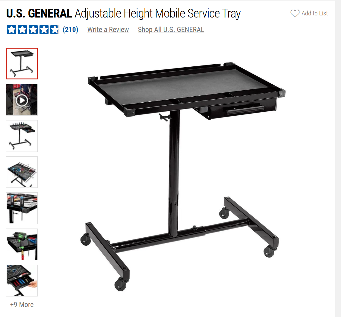

I purchased an Adjustable height mobile service cart from Harbor Freight.  It has wheels and I placed a homemade build slip using 3/4 plywood and universal T track from Rockler. Built some slides to support the work. The table rolls and I move it to the position I need it to work. If I need to push it out of the way I do. The 12 x 12 tool tray stores the tools I need for the work I'm doing. Works great for me. image.png.ad94afaf082b60e3703d3c1c50ab2c78.png

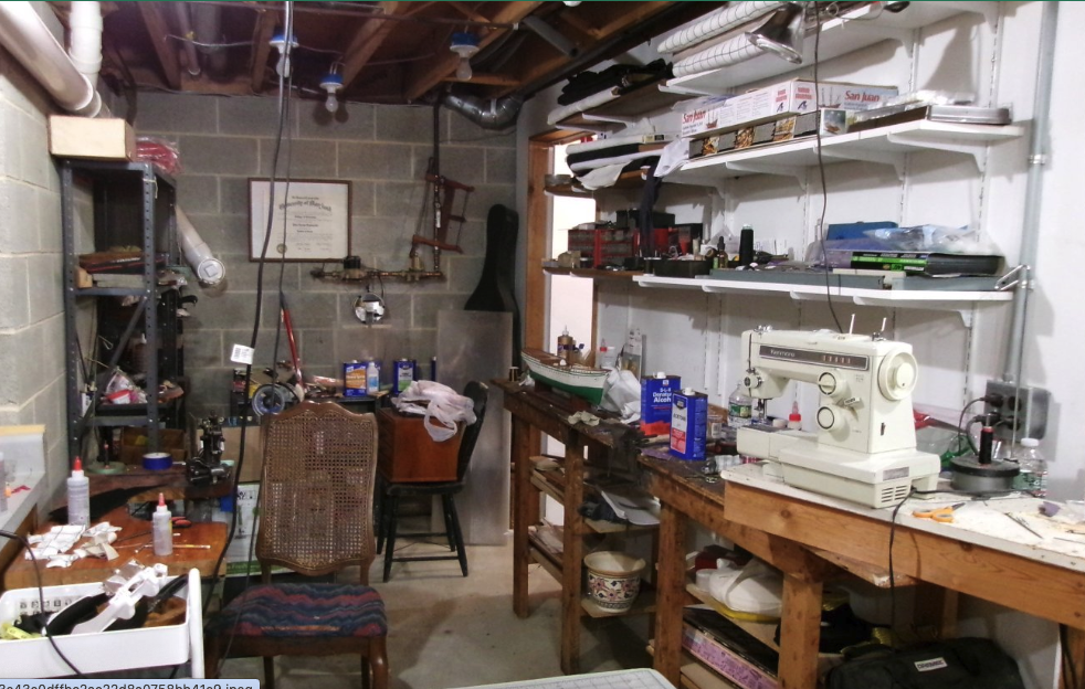

  You can consider adjustable shelving as seen in a tight end of my workshop.  Found at most 'big box' home stores, the vertical rails attach to a wall (preferable screwed where there is an underlying stud), then metal arms (several lengths are available) clip into the verticals at the levels you choose (and they can be easily changed) - then the shelving made for the arm length chosen simply lies on top of the arms (don't space the verticals too far apart).
  You can put stash kits, supplies or whatever on the shelves ... and this idea can be used for finished models in any room, where acrylic sheeting is hung from the shelf above (drill holes along the top of the acrylic to fit over hooks screwed into the edge of the upper shelf) and the bottom of the clear sheet rests against the lower shelf.  That, plus small sheets on any free shelf end, will keep out most of the dust - yet permits easy access to the model.
  Below my shelves is a home-made tall bench (plywood top and 2x4 legs & under frame) where I can work standing.  Many find sitting for too long can cause back strain, so at least half the work I do is standing - also efficient in a tight space.

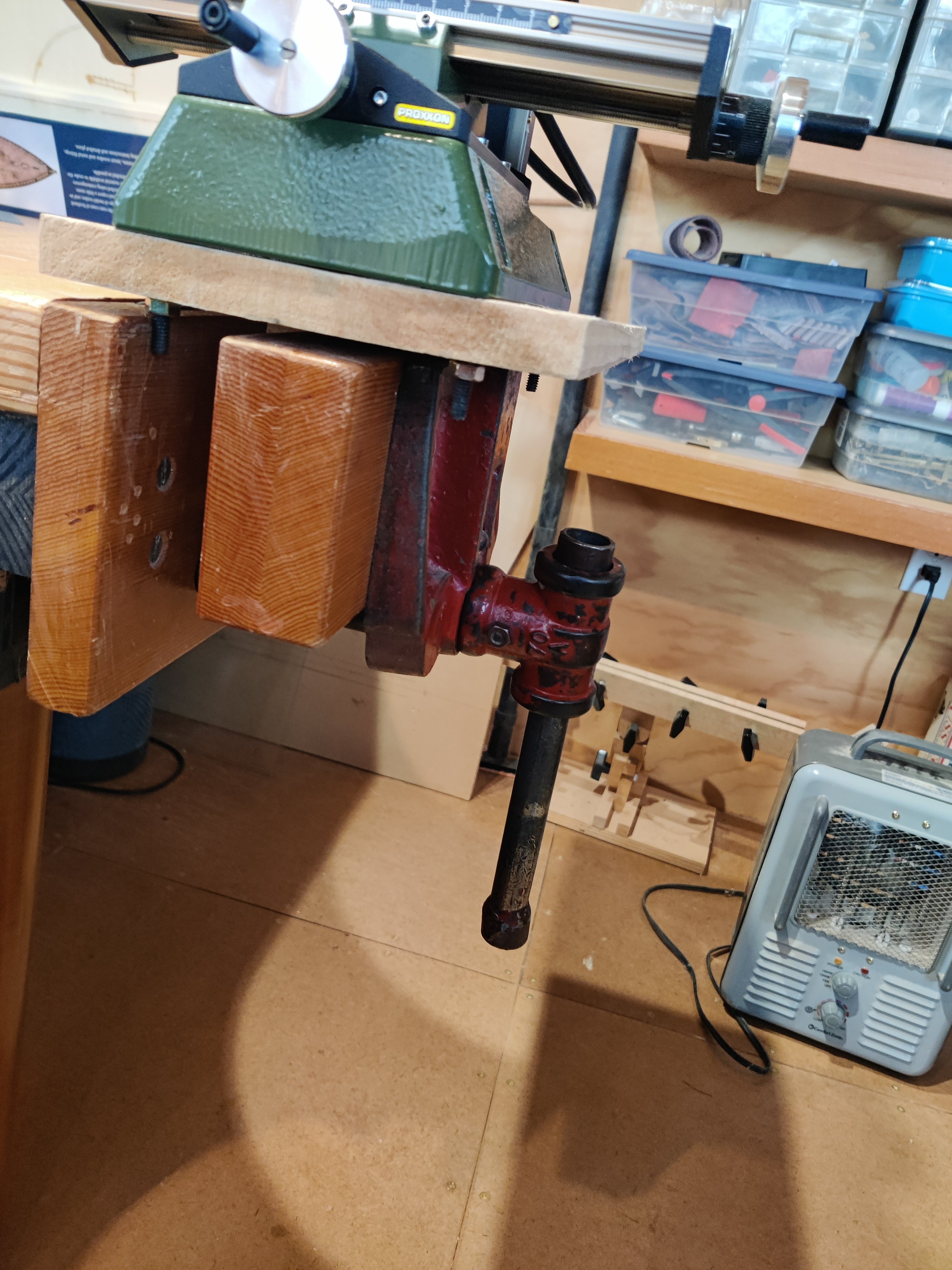

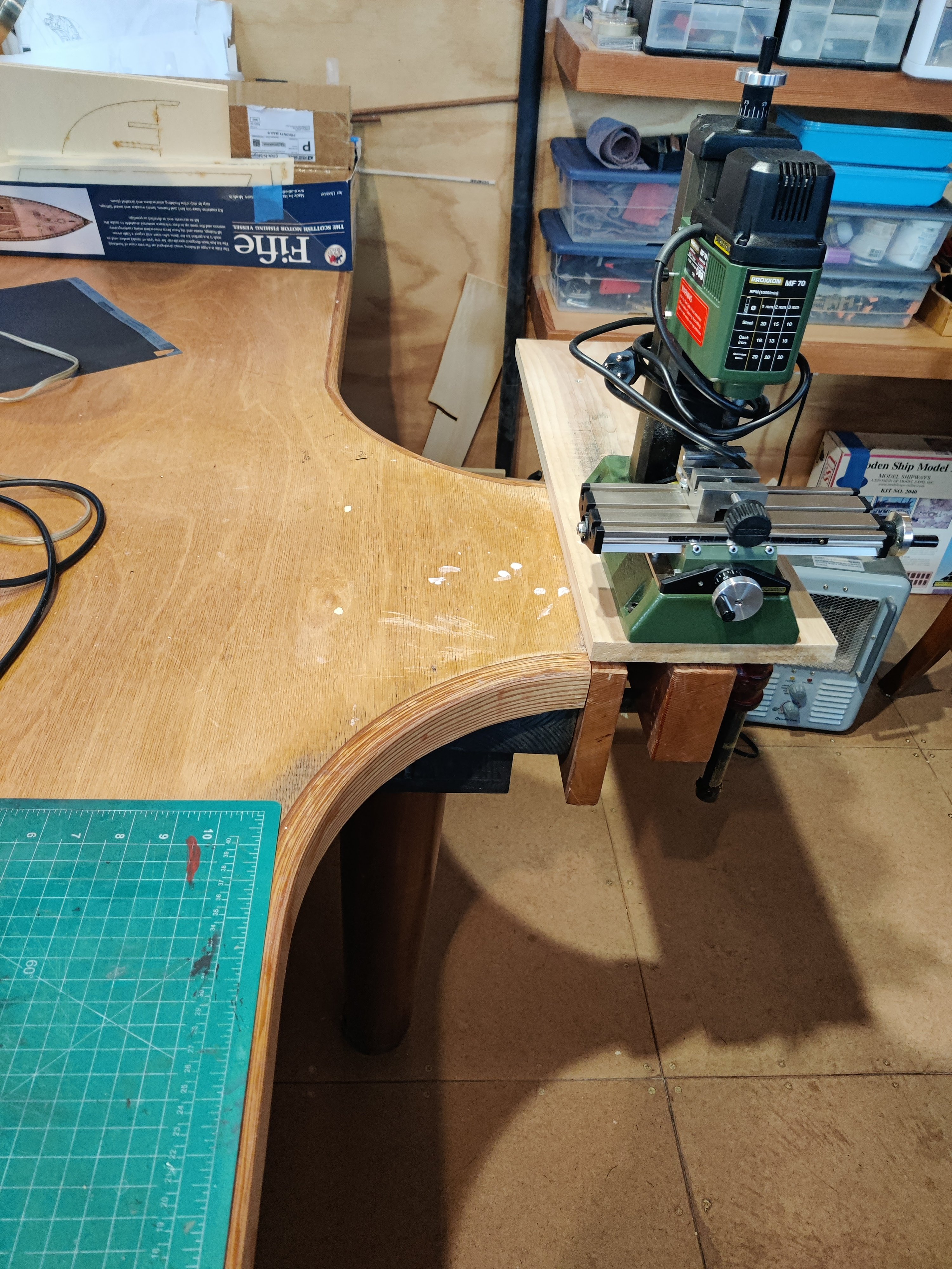

10 hours ago, Sundt said:
The kitchen will be integrated in a L shaped workable.
I would recommend that your worktable have an extension at a 90 degree angle to your worktable top for a vice. That is accessible from both sides.This is important because it provides enough room to use a hand saw for items in vice. I also have used it to hold my Proxxon mill , to hold the keel on a boat etc.. Be sure to put a leg under the extension to support the stress on the extension.
