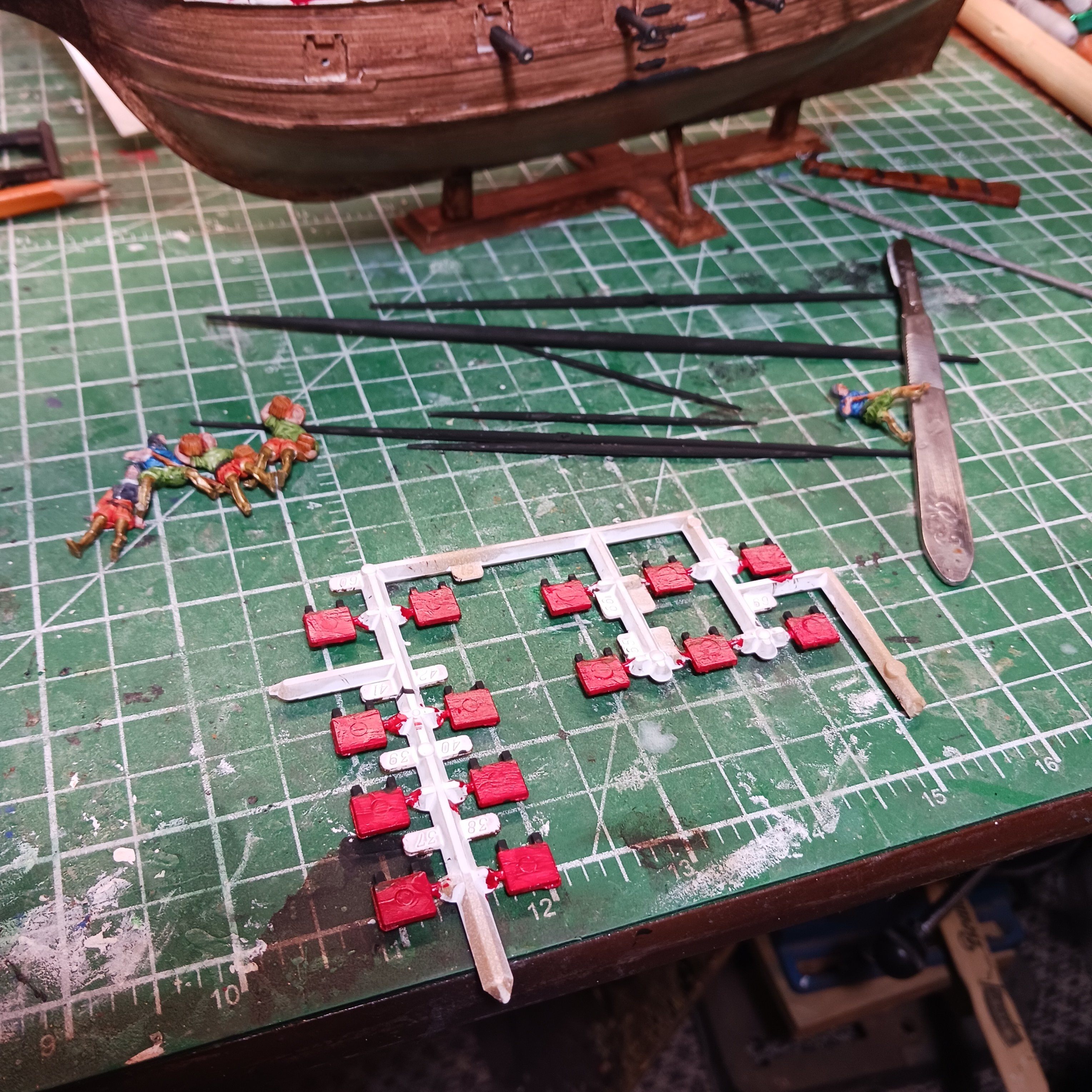

Only four cannons to rig, the rest are dummy barrels. Today I painted gun port lids, pretty easy with speed paint,
Now it just a matter of cutting them off the rack glue them on and just a small thouch up will be required.

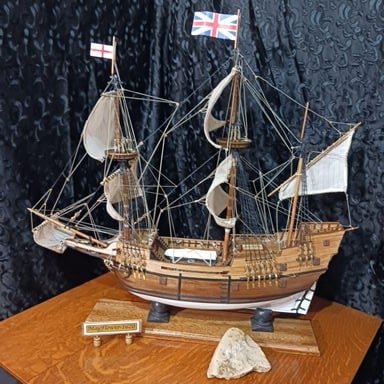

Thought i would drop of mine on, built over 20 years ago now and still on display. Reason put on though is that you like rigging. This was rigged using he Noel C L Hacney book for the Airfix Mayflower. Well worth a look on ebay for

@Thunder nice looking ship,  did you use the kit supplied sails?

Yes, they are the kit sails with a bolt rope superglued round the edge and the cringles on each corner. The Mayflower Airfix guide does take you through all of that.

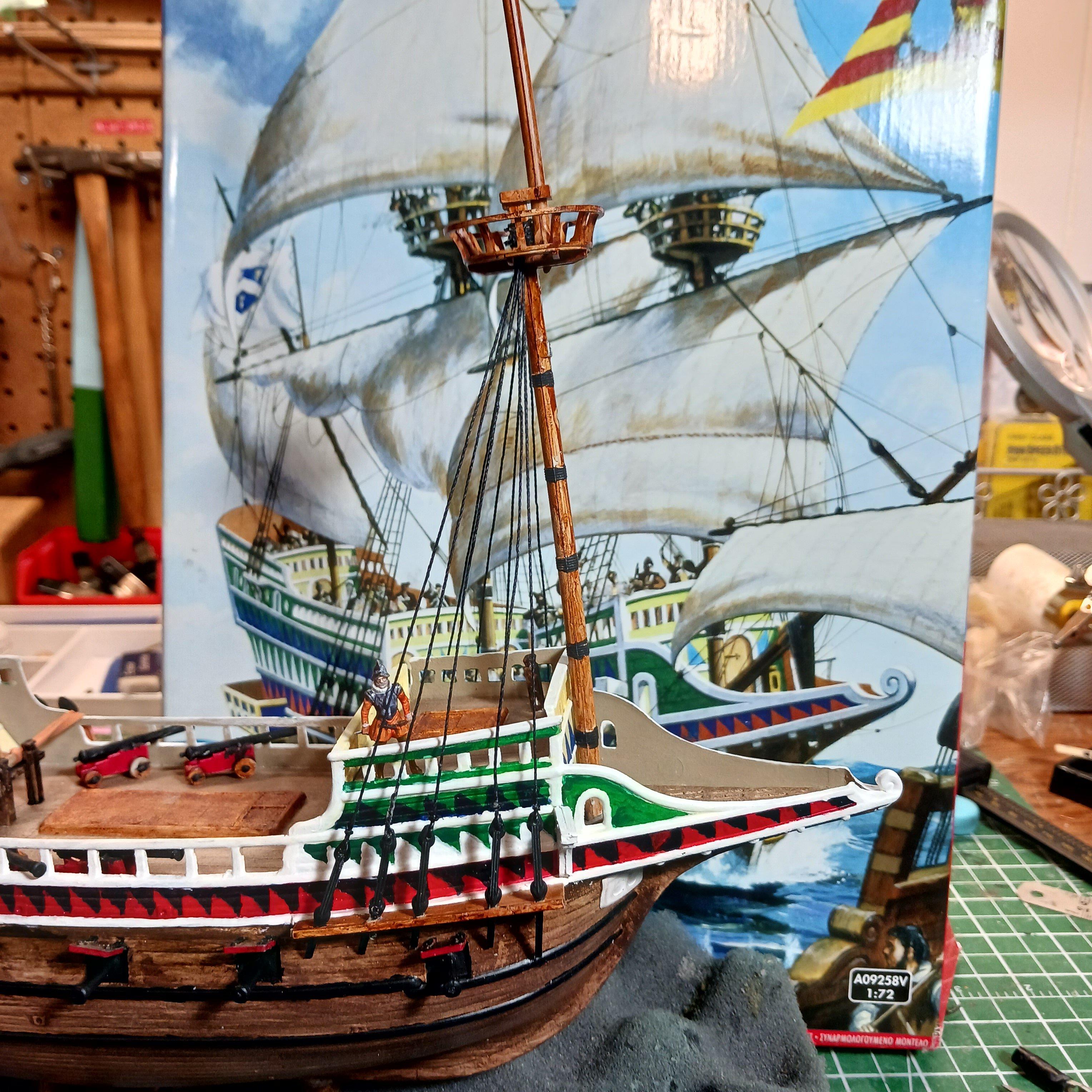

More painting, plus more touch ups :D. This seems to be the biggest part of the build, painting the model . Only the ropes are not painted,  and I am to shakey to paint straight lines anymore.
A little more green then a little more white followed by touch ups.  The red strip is done  lol.  Add the blue curtain next then it's on to the cannons.  Real life yard work and the love of my life knows her wish is my comand, has more green house things that need attention 😞  No playing till Monday , but then we are going for the big guns. All four of them. :cheers:
Thanks for looking in and yes @Keith Black I broke up the Bowsprit yard off , for the first time  lol.

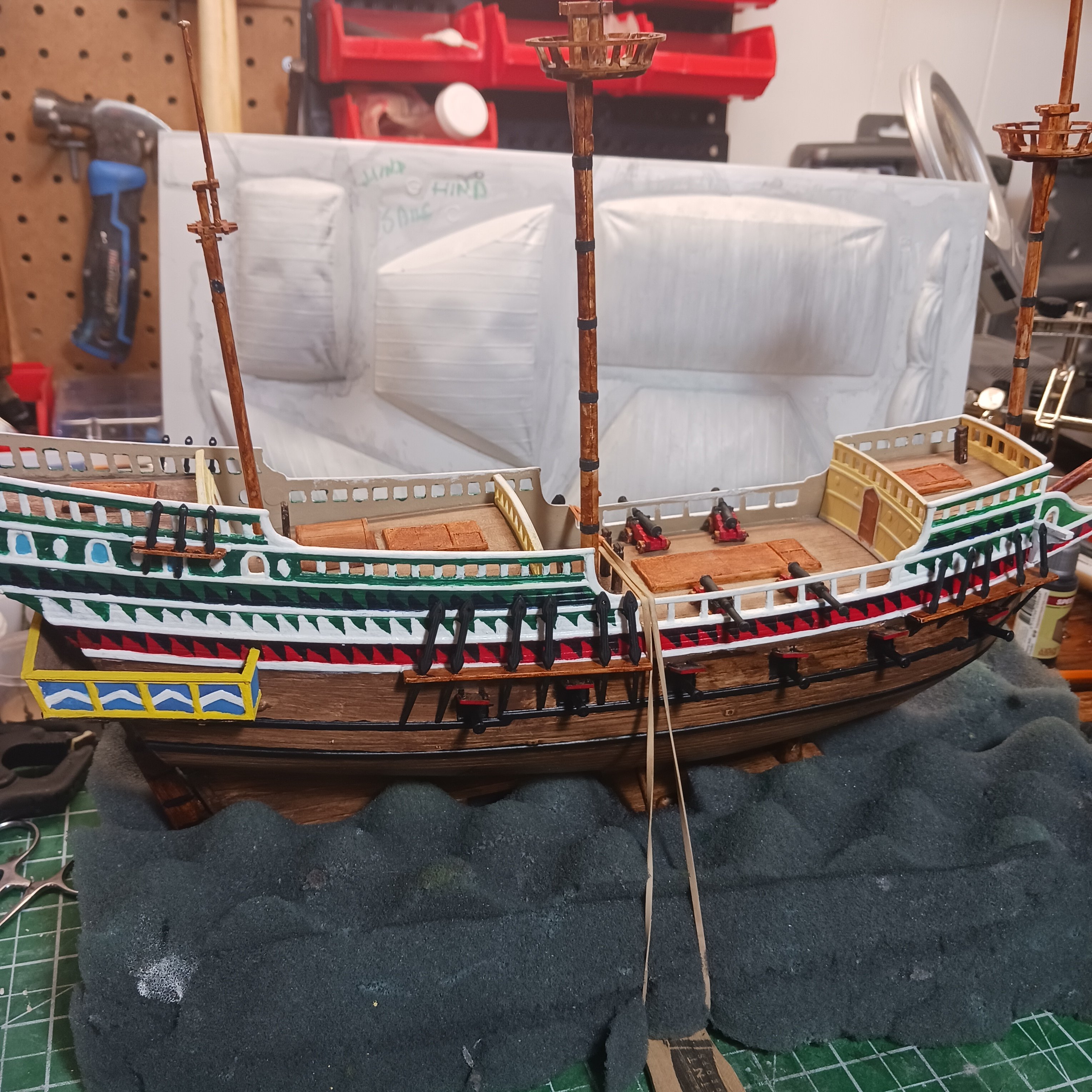

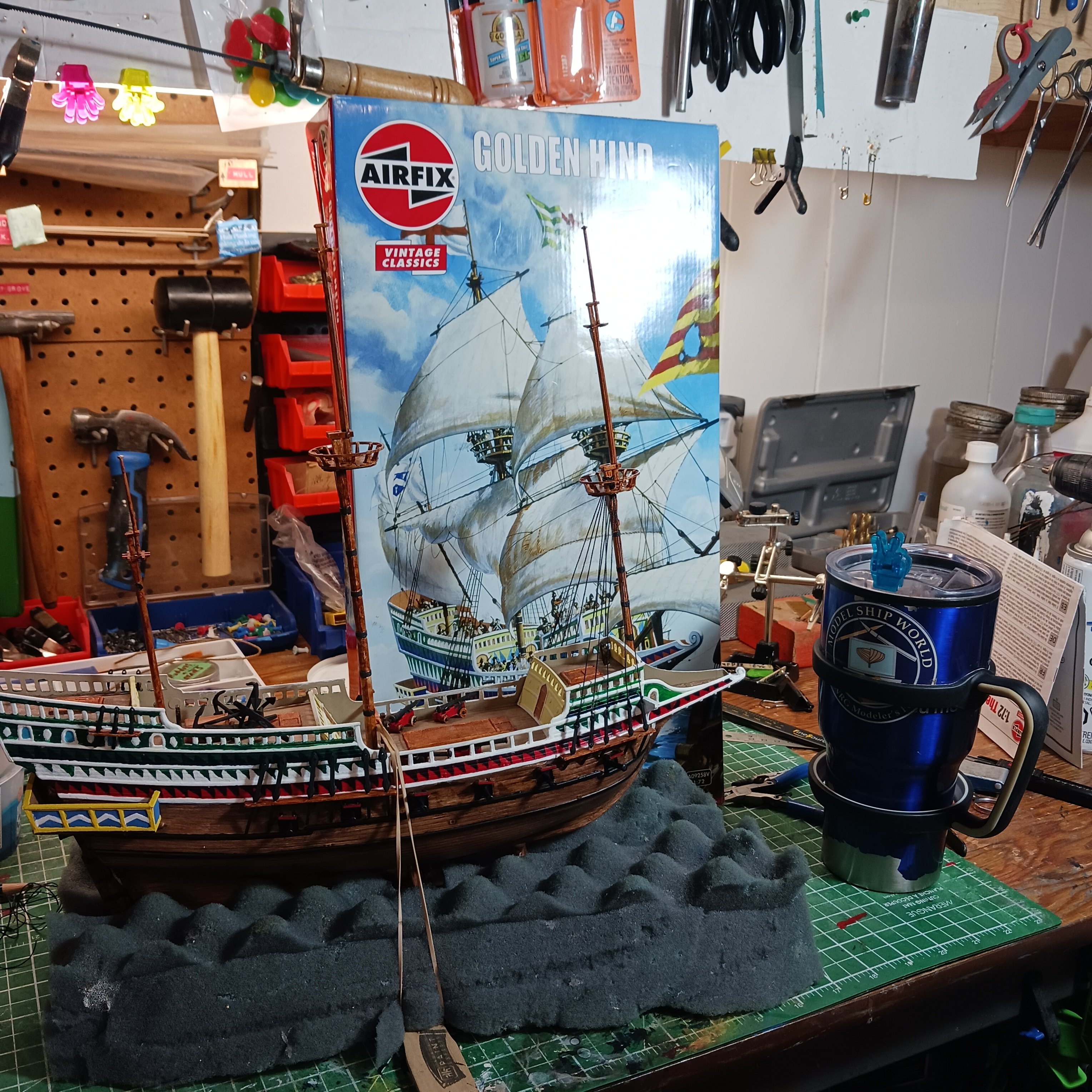

I am going to call the painting of the hull on my Golden Hind finished.20250428_140658.thumb.jpg.3abd304860a9fd092f9b59fb2eaaa67d.jpg
Time to  build the anchors, four of them.
The sign was a bit of a challenge, but it is not bad.
Channels and deadeyes next , this is the portside main channale. I will paint the rest tomorrow.
I should be able to run a few shrouds and ratlines by the end of the week, research on the sails, I am going to paint the kit sails, and apply a bolt rope to one and see if it is worth cutting the rest  or making some paper sails. We wil l see.  :cheers:
That's my ship for the day, thanks for looking in.

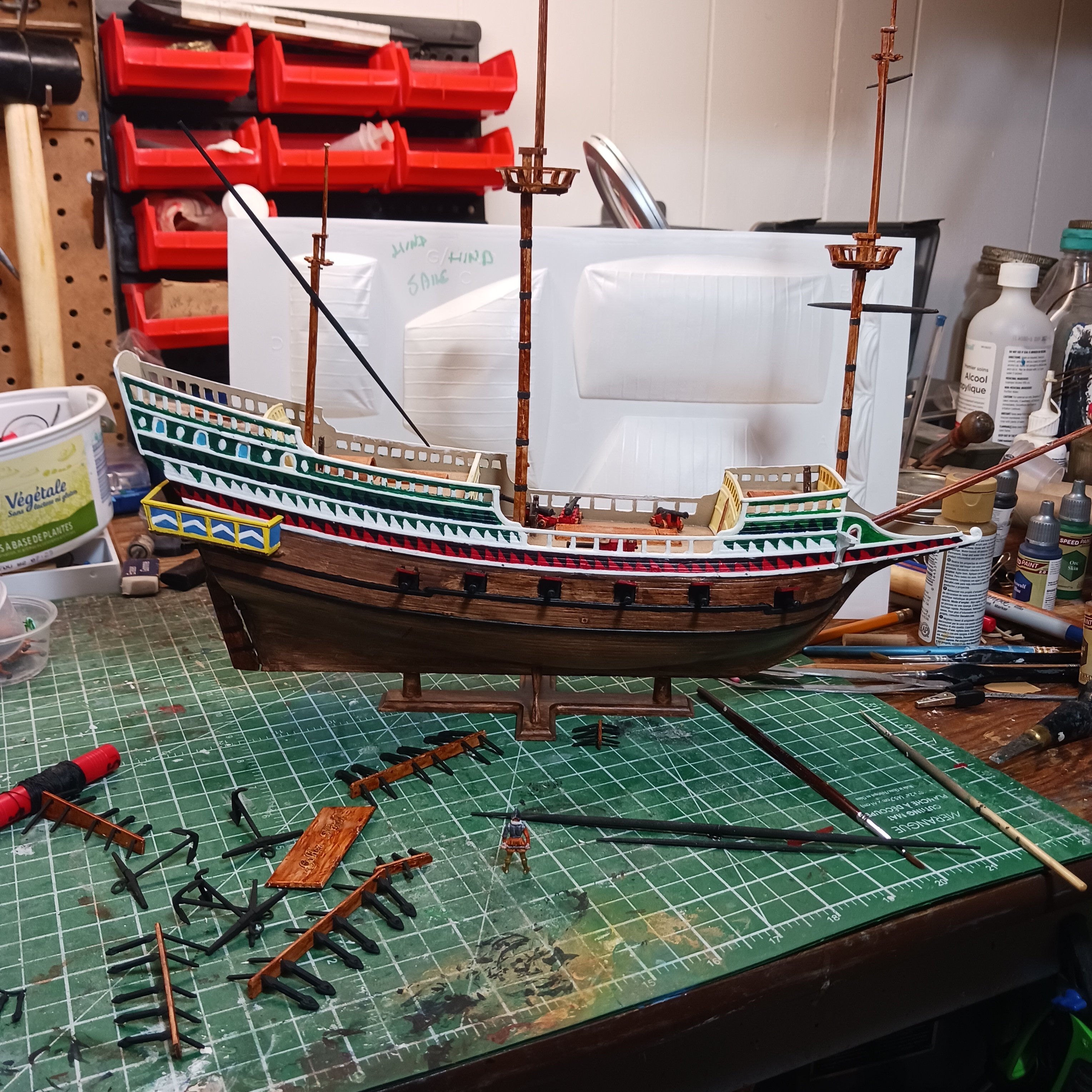

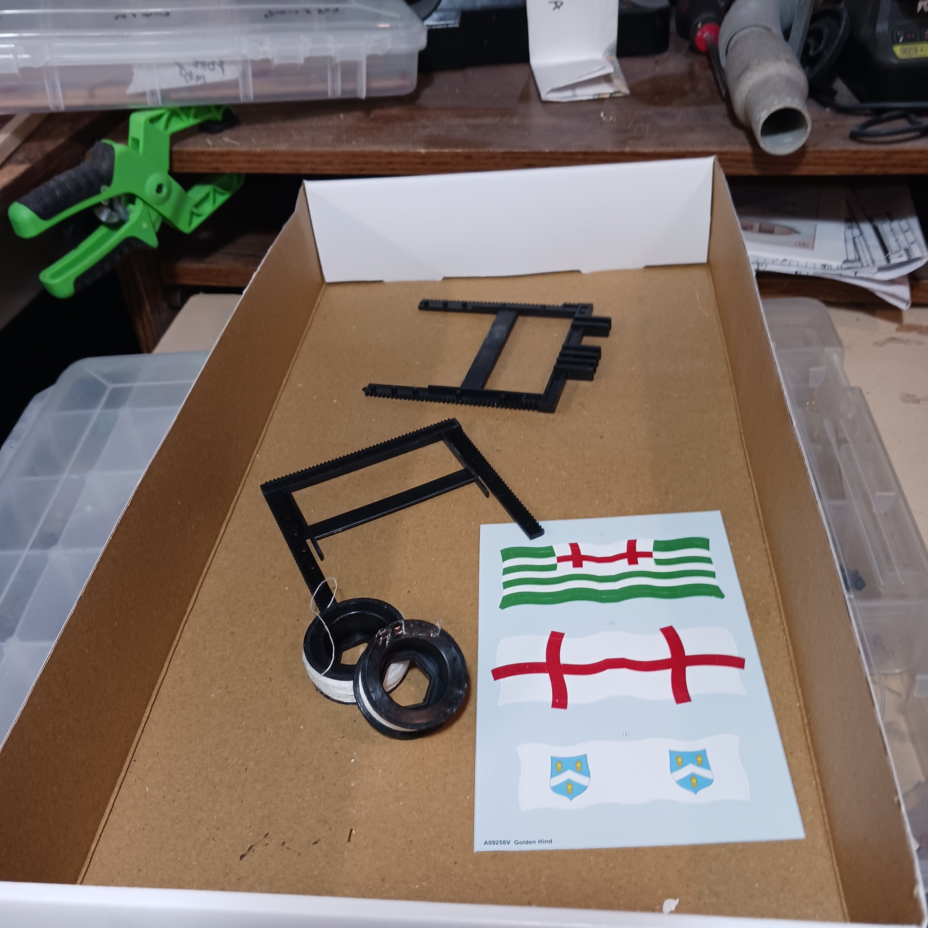

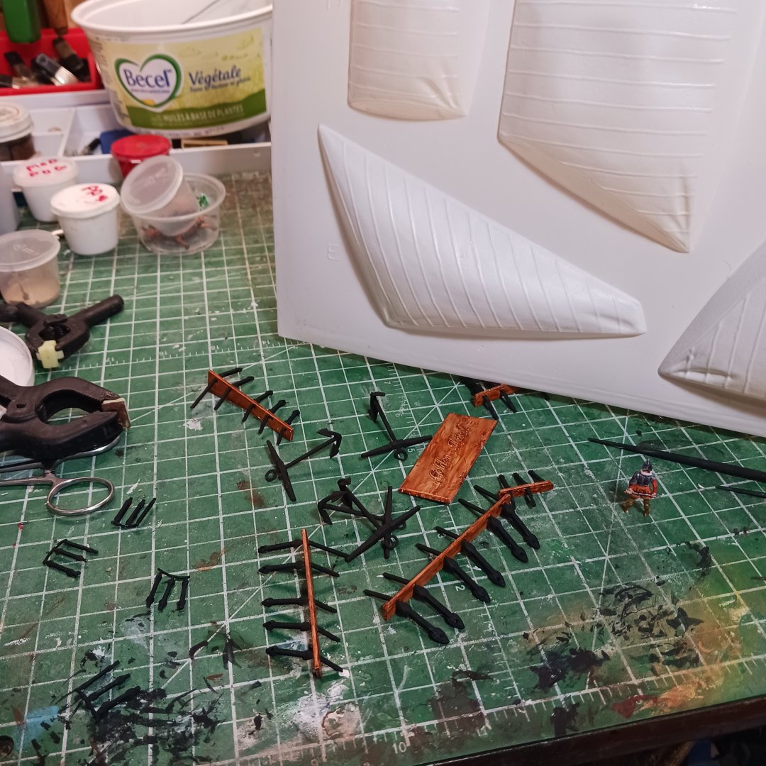

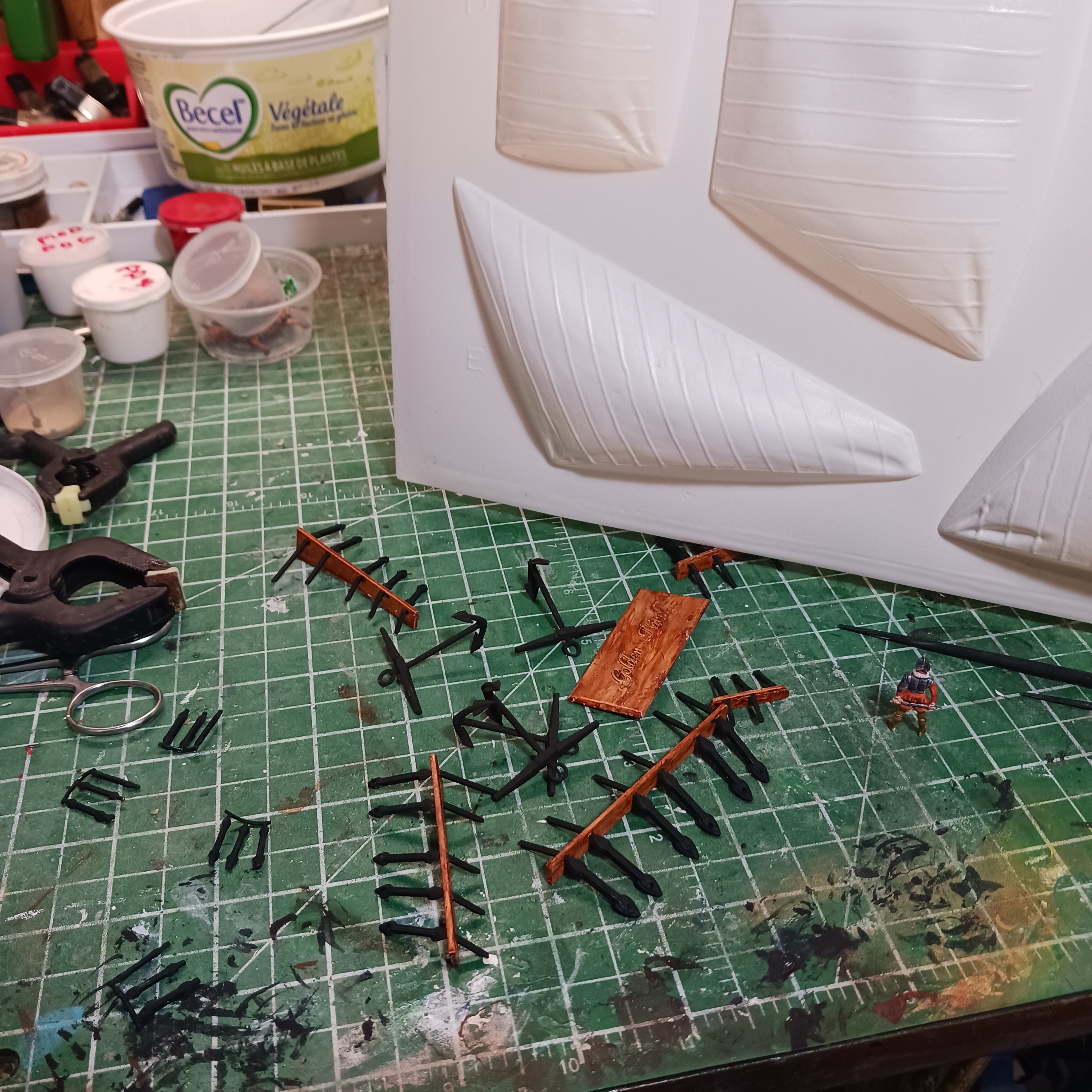

The box is almost empty,  just some kind of jig to tie shrouds I think. Plus the flags and two rolls of white thread, the same size.
Sir Drake gives the kit sails the look over. Let's see what we can do.
All the peices, have been painted  The yellow on the stren need another  coat but tomorrow.
  Hopefully I can get all the pieces glued on , easiest  deadeyes and lanyards I ever made lol.20250429_205043.thumb.jpg.dd6b0bd59a9d51790c67cf1cb80092aa.jpg
Ratlines are on the horizon :D.  Thanks for looking in.

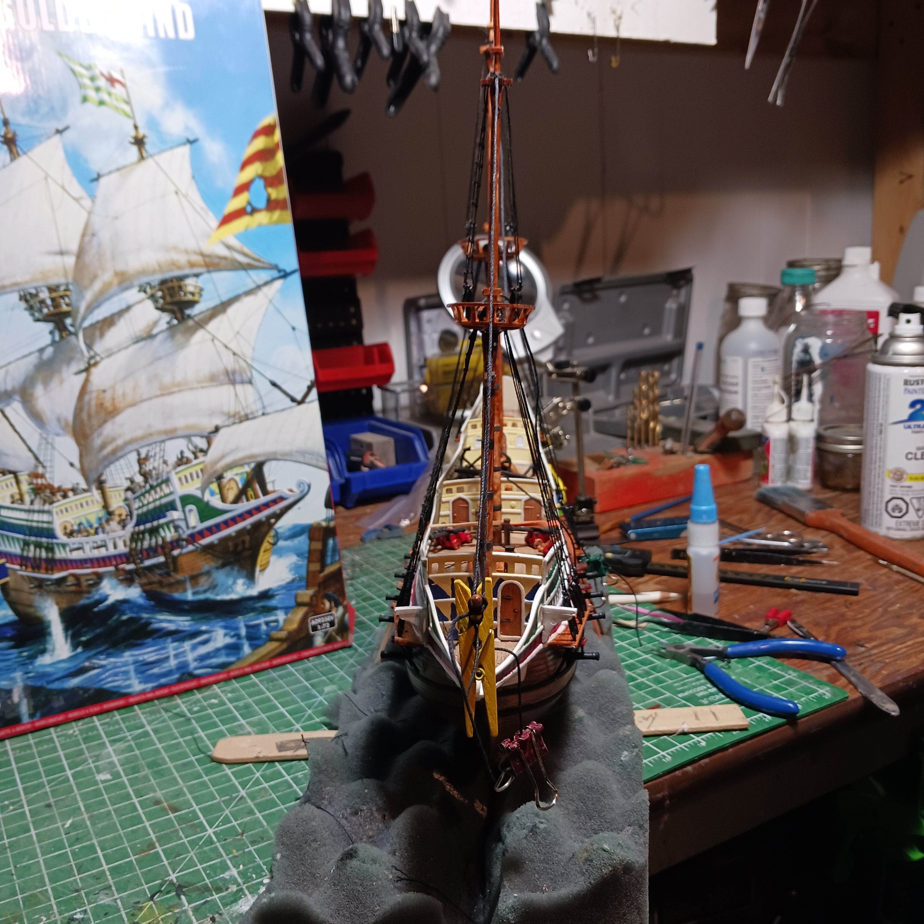

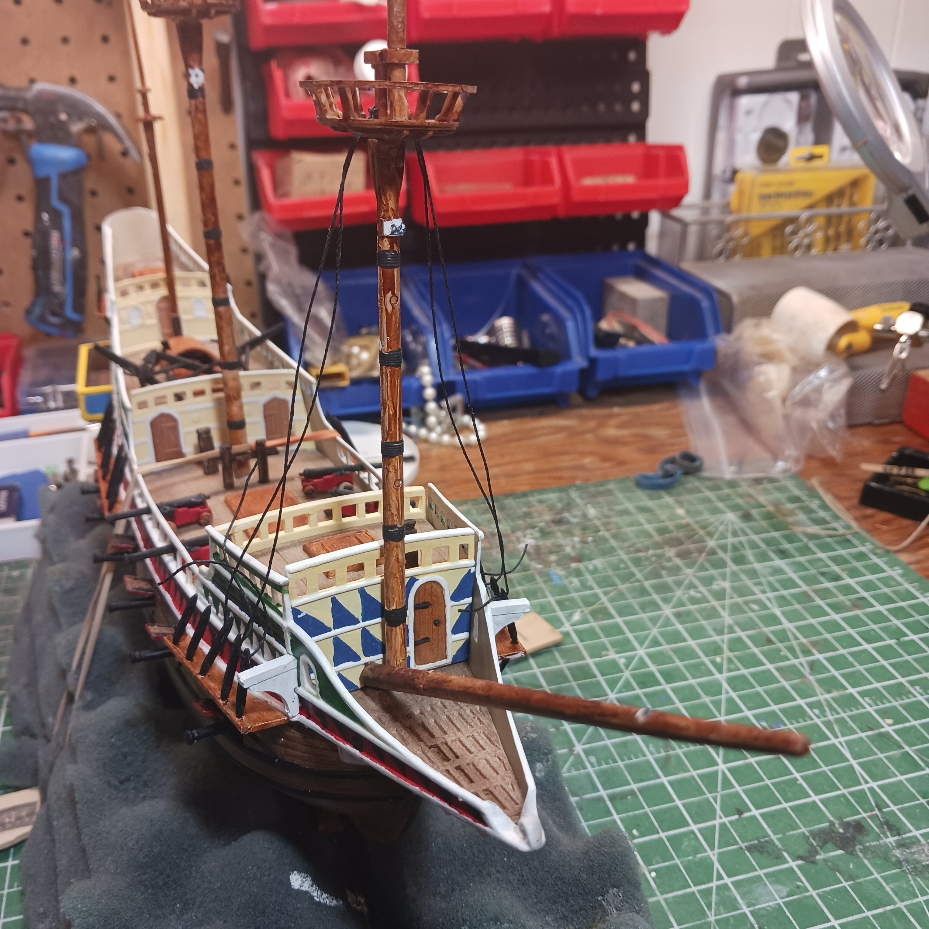

All the channels are installed, with deadeyes and lanyards finished. Lol20250430_114913.thumb.jpg.174ef3ce6f1031d6ea09c71853ea6f41.jpg
@GrandpaPhil the First Mate says try painting the kit supplied sails. If they don't turn out ok she will sew me some new ones. So this is the sails with the first wash coat. I will glue on a bolt rope add some highlights  should be good.
     But now it is TIME to start rigging.

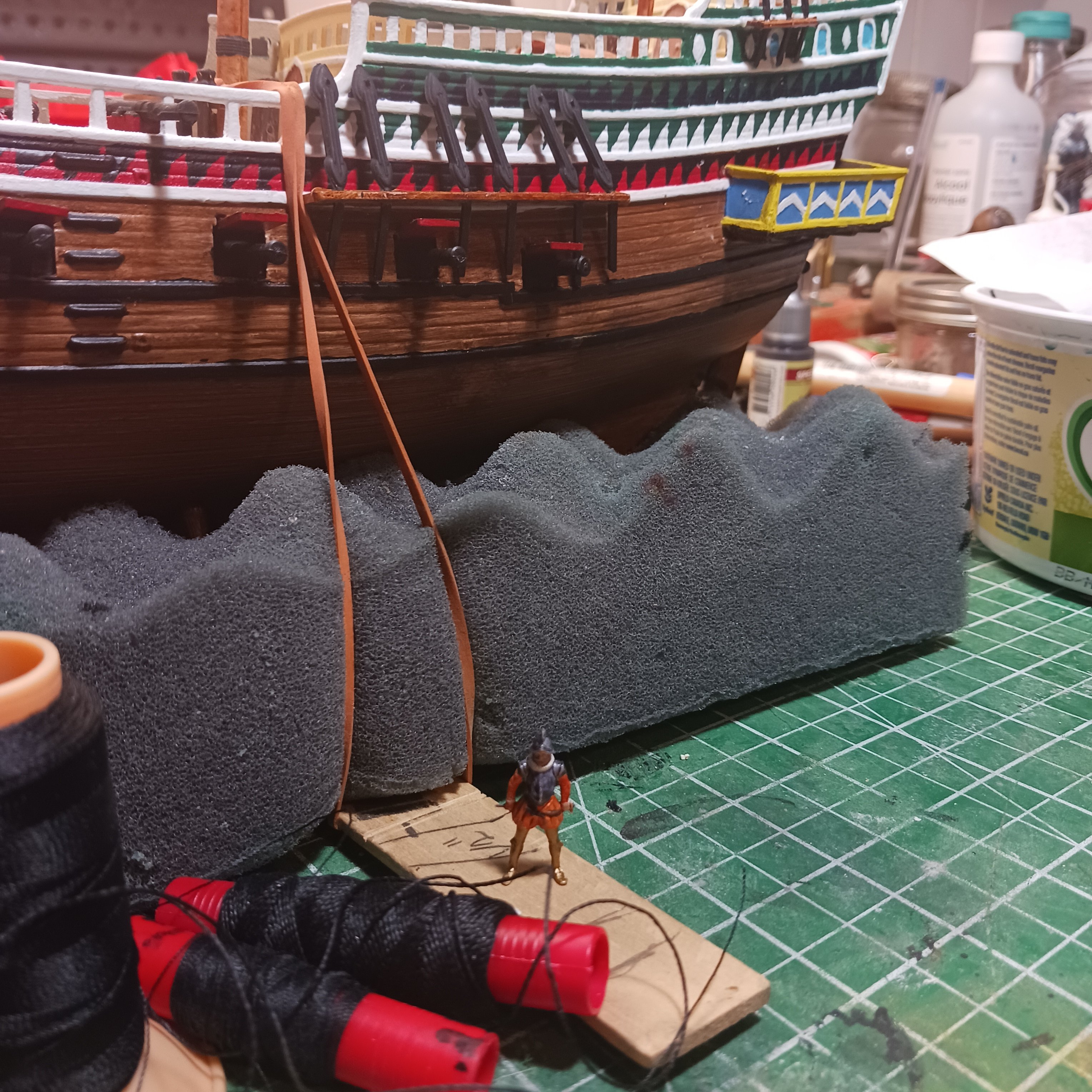

Sir Drake says we are short about six feet of .5mm black thread for the upper deadeyes,  plan is to use tan .5 mmm then tar it black(paint).

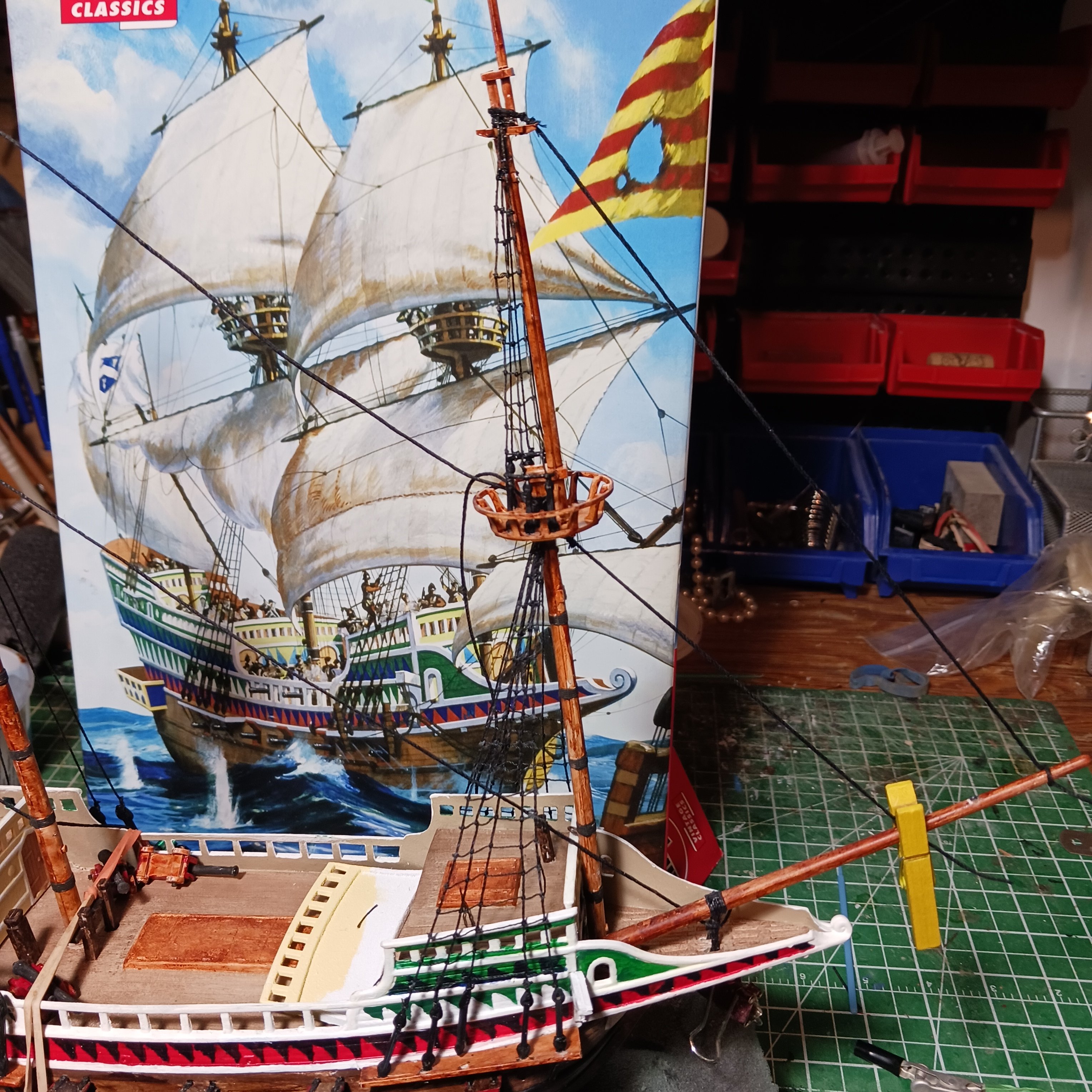

    The first set of shrouds are installed and seizeing is not all that bad. I can smell ratlines  in the air.
I still have the three walls to paint, bow, mid ship and stren , but I am in my happy place with ratlines so close lol.
  I have several ways to rig this ship, I have not decided yet on how far I plan on rigging.   Apparently  she is rigged  pretty much the  same way The Mayflower is rigged, so looking at my Amati Mayflower for inspiration  lol.

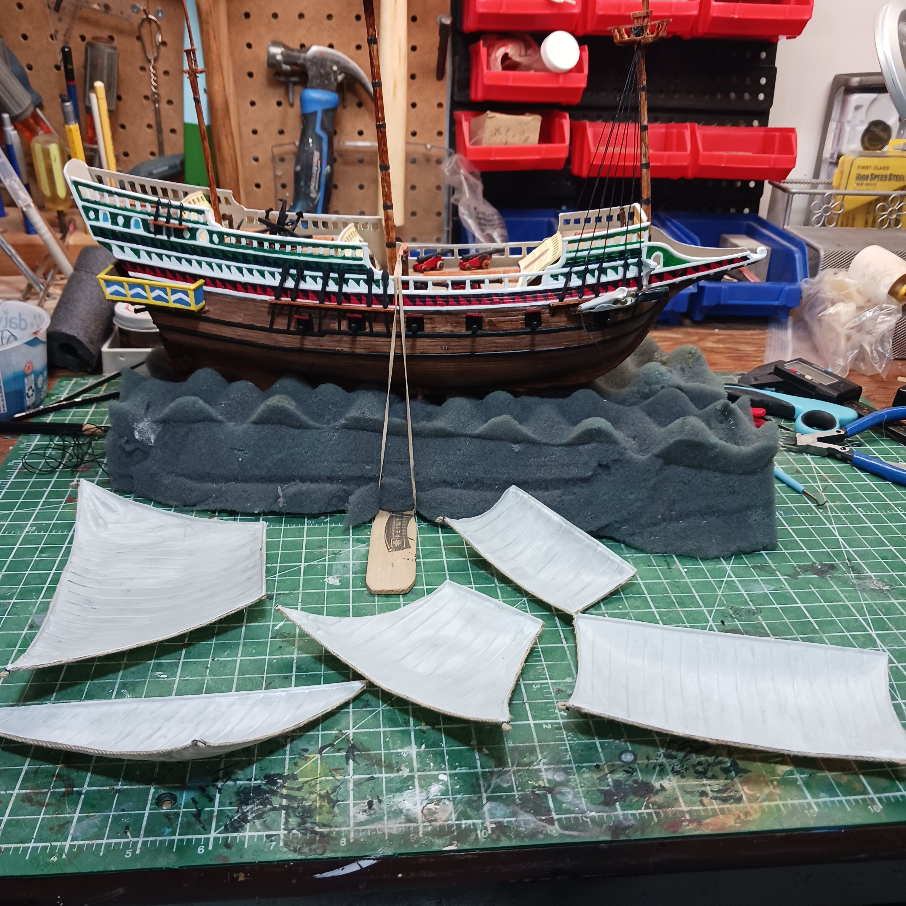

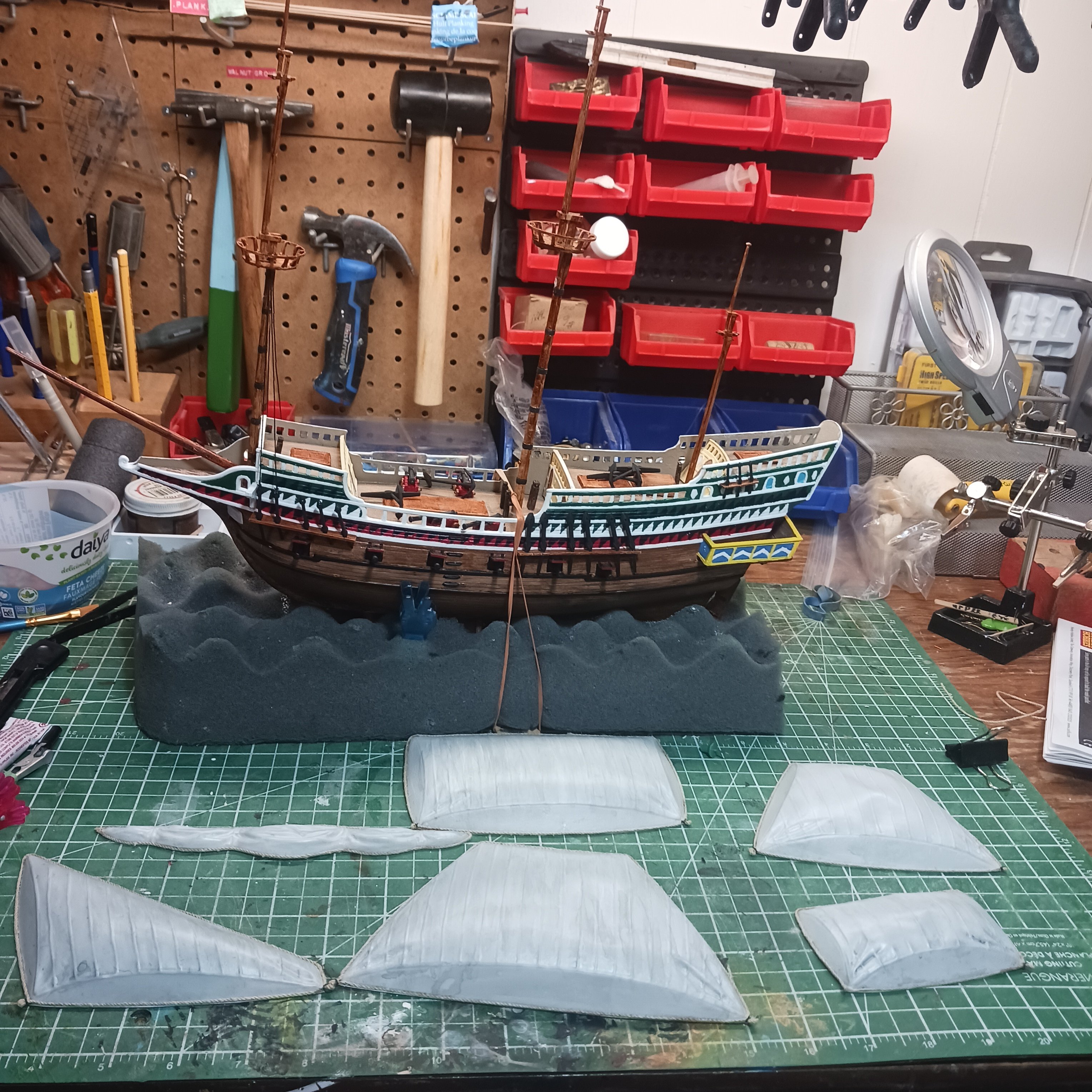

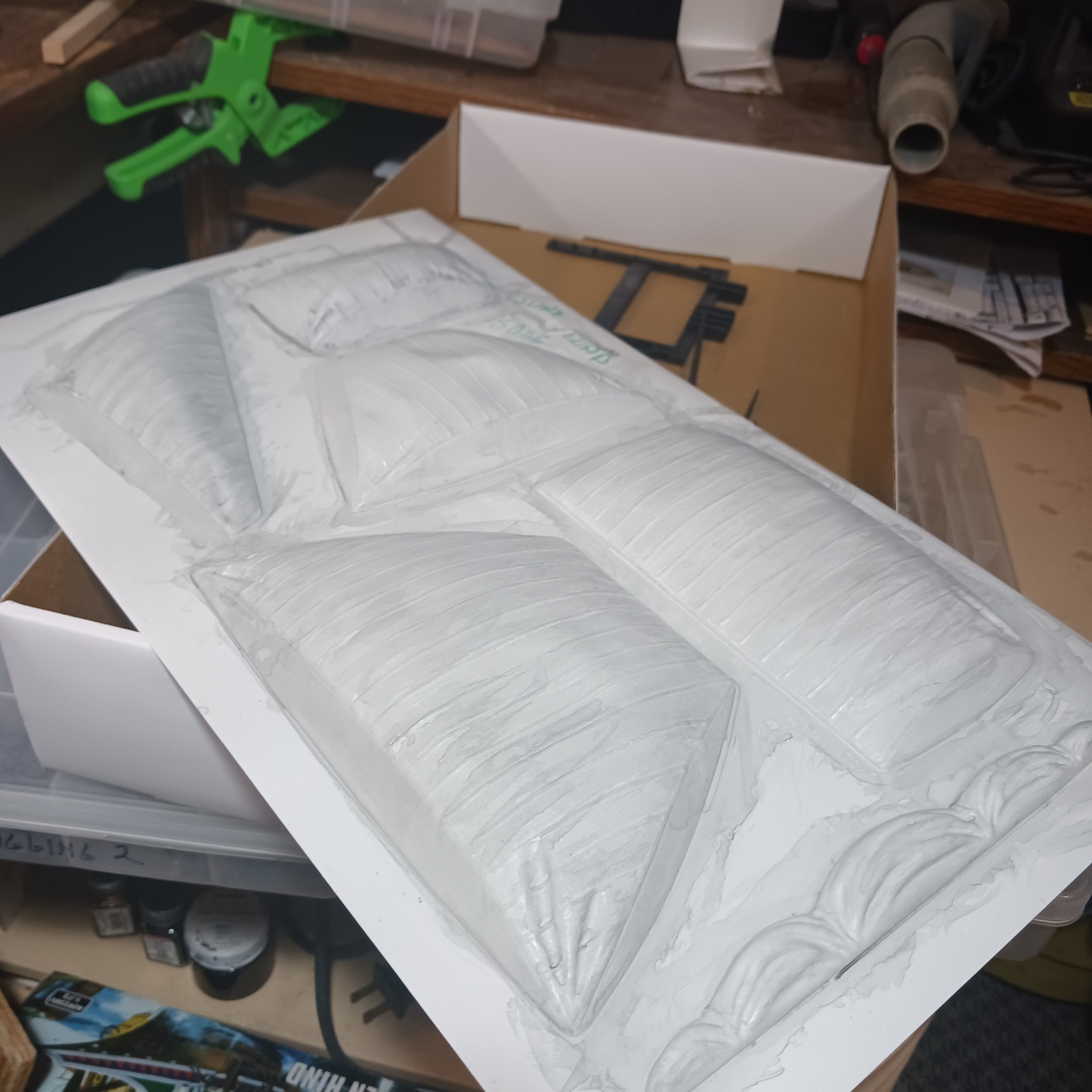

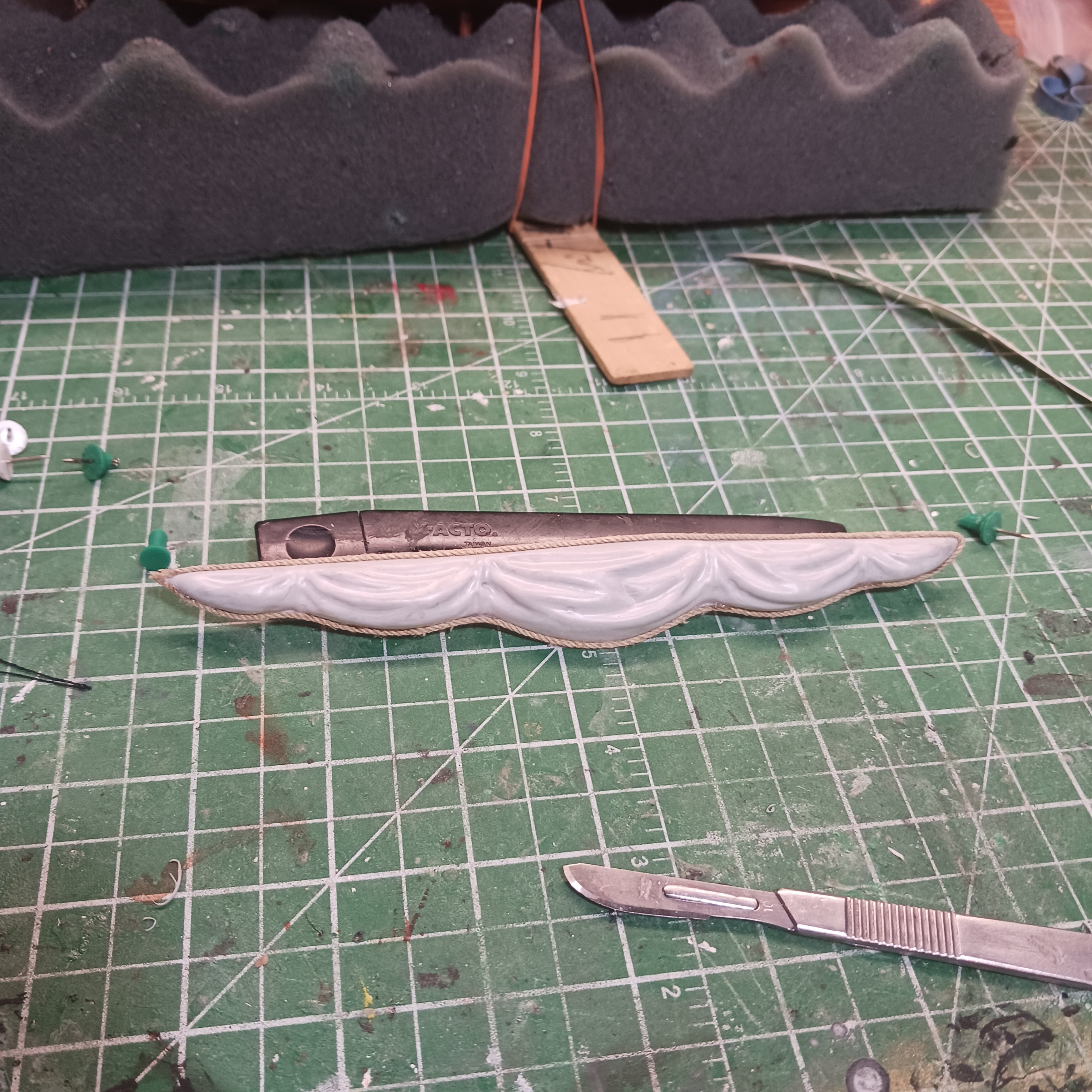

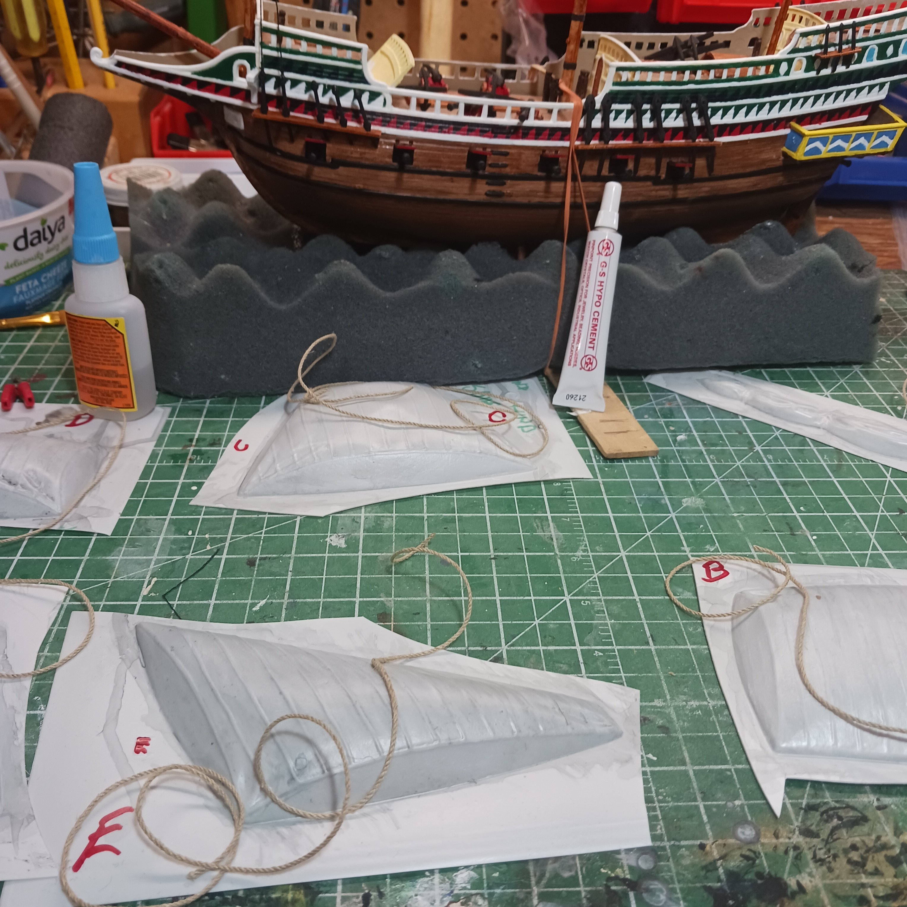

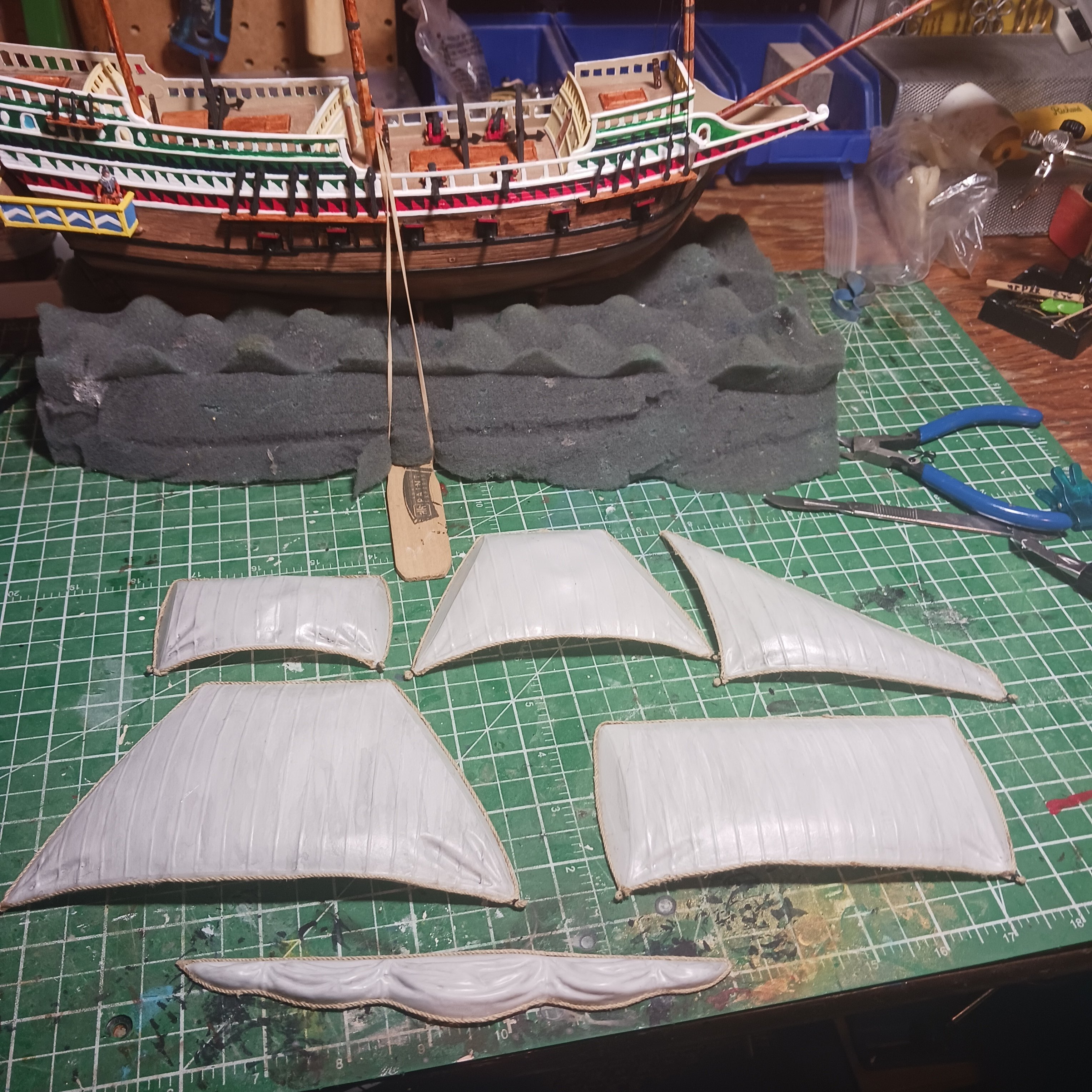

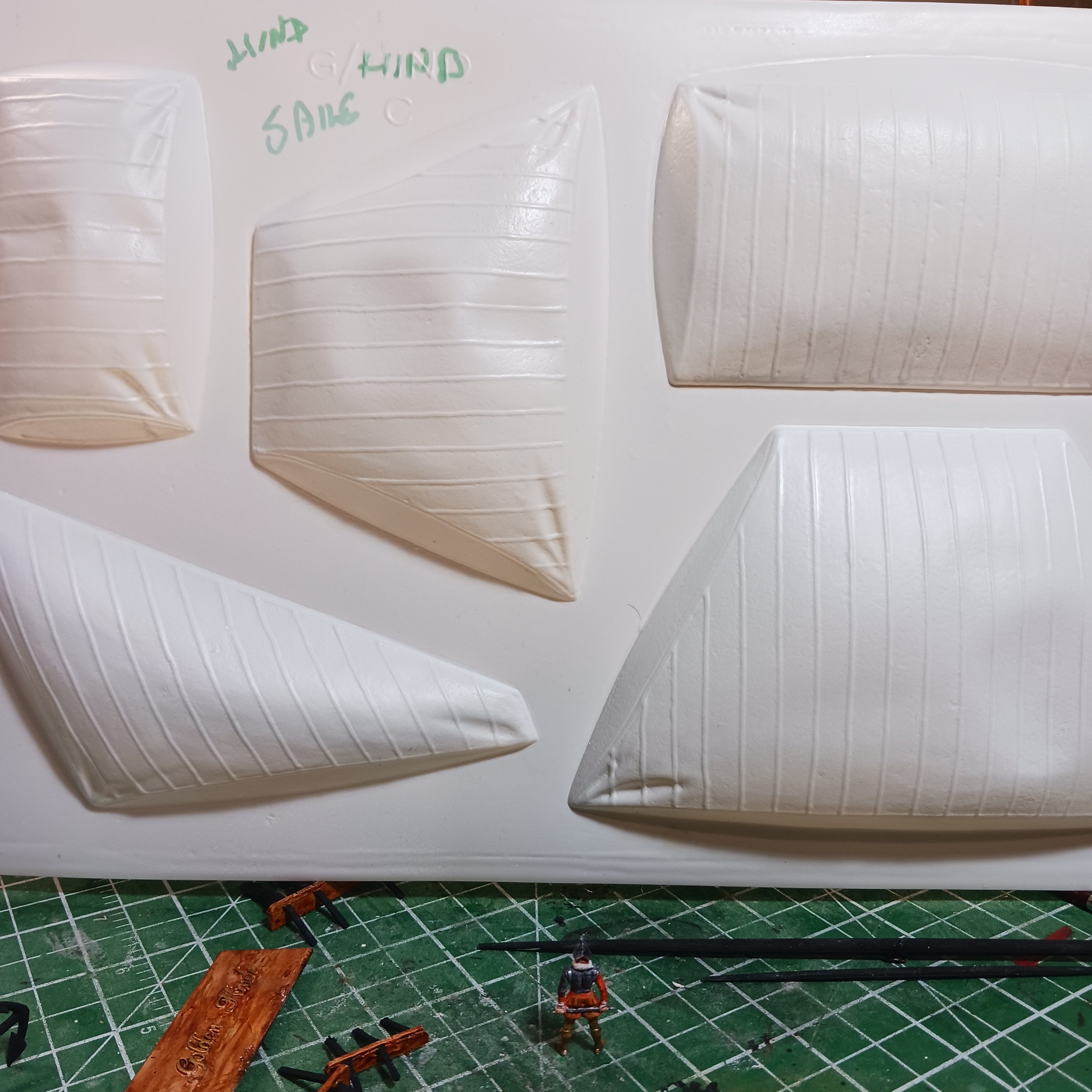

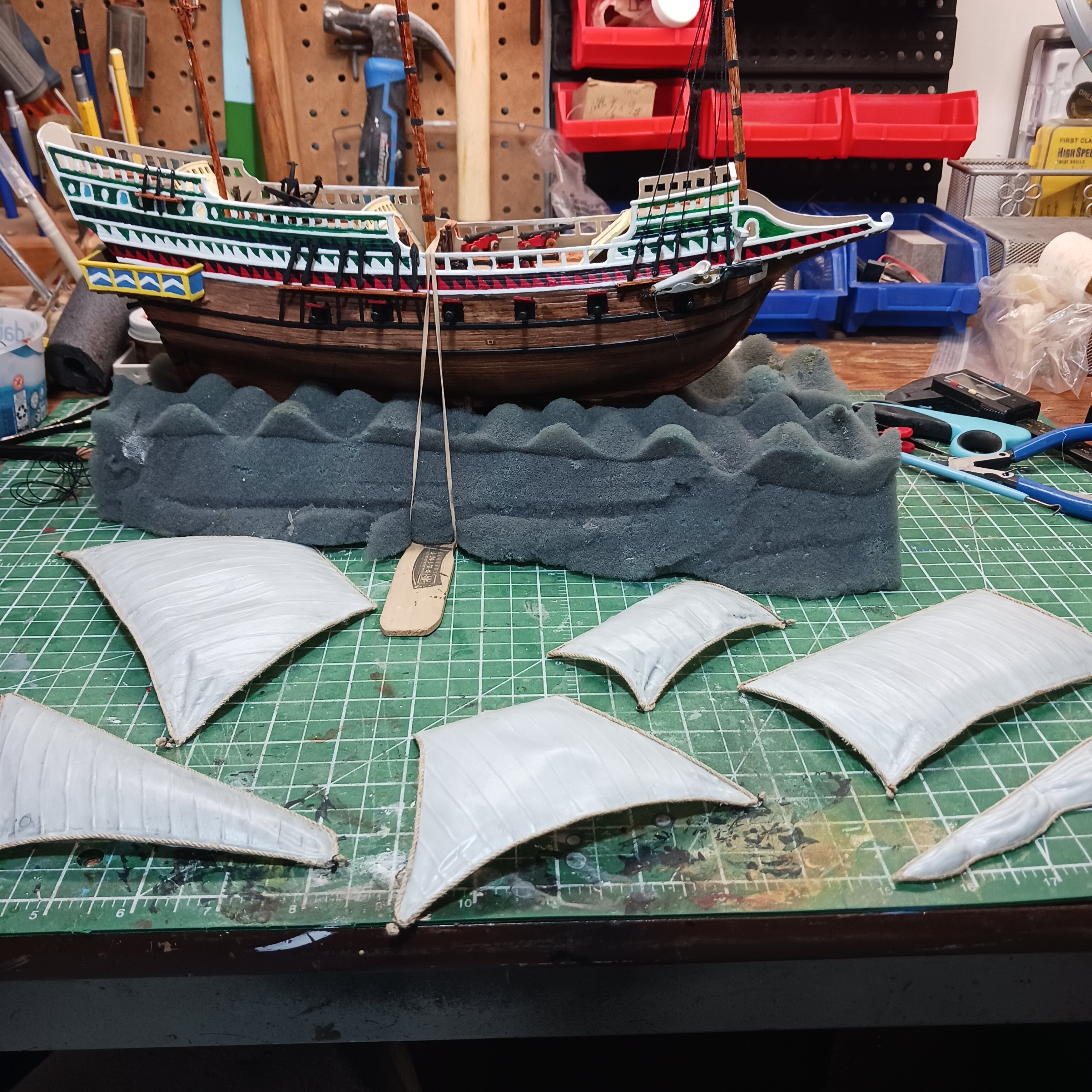

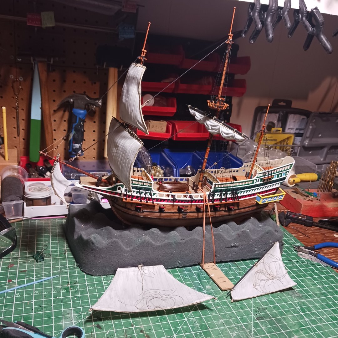

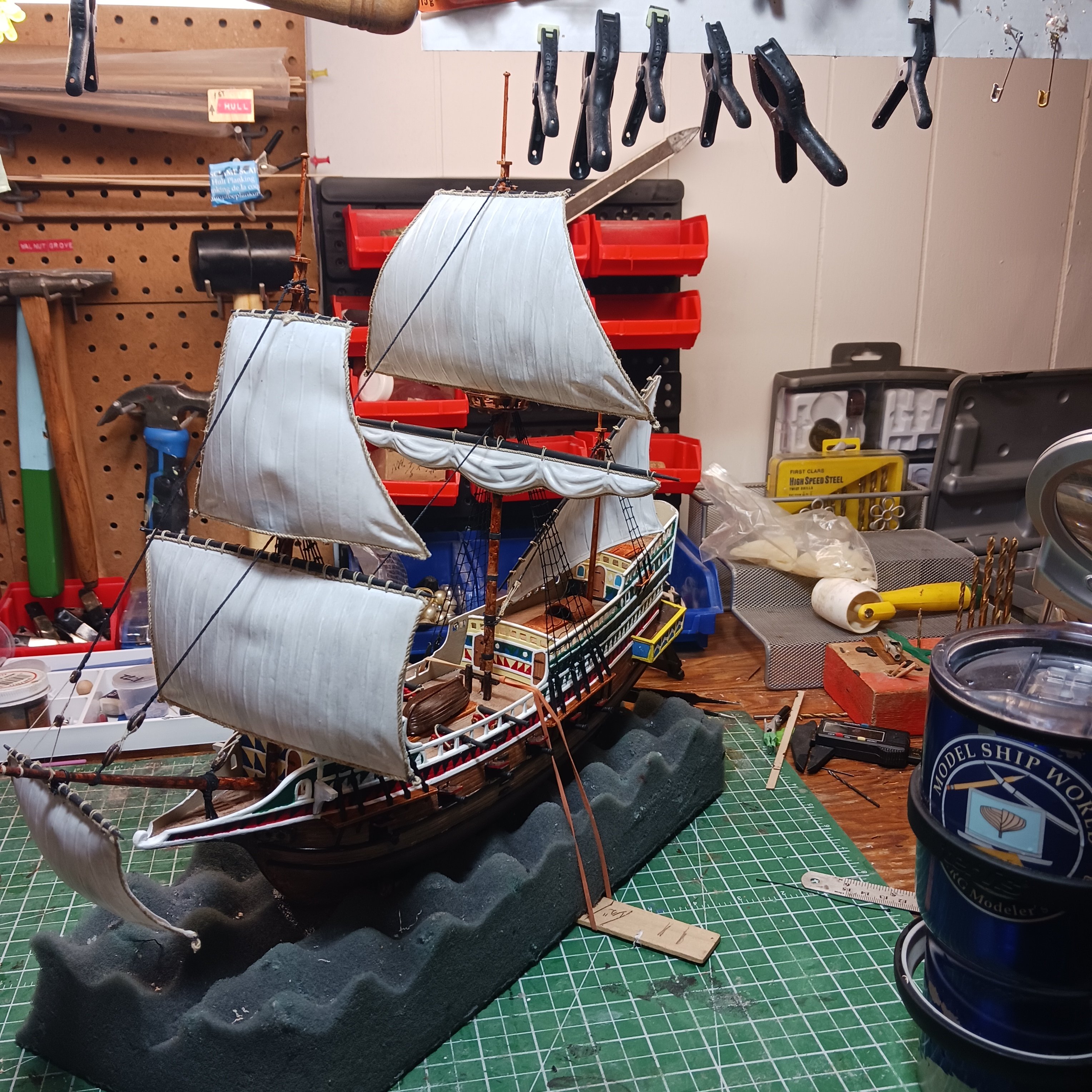

The making of the sails. This morning I thought I take a break from rigging and see what I was going to do with the sails. Yesterday I brushed on a coat of Holy white speed paint  thined with water about 40% . A quick coat and leave it, after it dryed I clear coated it.20250430_114930.thumb.jpg.96765082691f455f316445d03a6a659a.jpg
Today I came up with a plan, lol. Rodney,  my late friend , told me about G-S HYOP cement, said it was great for rigging,,but I never really tryed it. Anyway  I cut the sails in pieces,
Then I used a 1.3 mm rope for a bolt rope. Glued it on , seized the ends  and found using the black x-acto to cut them out was the best.
Soo ,, then I had to see what they looked like.20250501_131314.thumb.jpg.f5dbe00506806bef2459193039e41579.jpg
And here are my sails, I going to airbrush some highlights latter,  but I think they will be fine. The Frist Mate said they are Beautiful  ,oh my they look fantastic. Lol I think she doesn't want to make  cloth sails  lol 😆 😂
  Well sails are done, back to rigging,  I really  thought the sails would be a problem,  but some how it all came together nicely.

Thank you so much @Snug Harbor Johnny, they look a lot better this way,
Thanks for looking out for me , the benefits of membership 😉
Knocklouder
                   WASA
                   USRC Harriet Lane

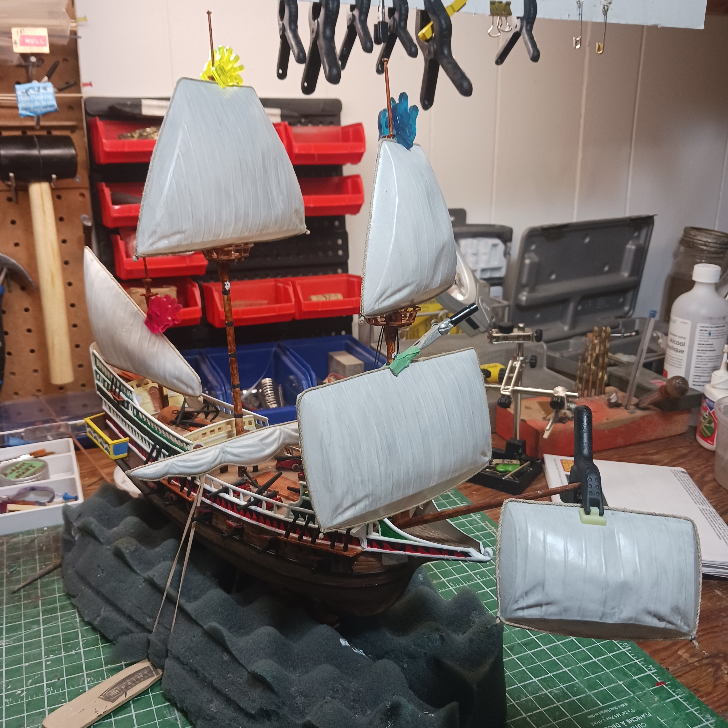

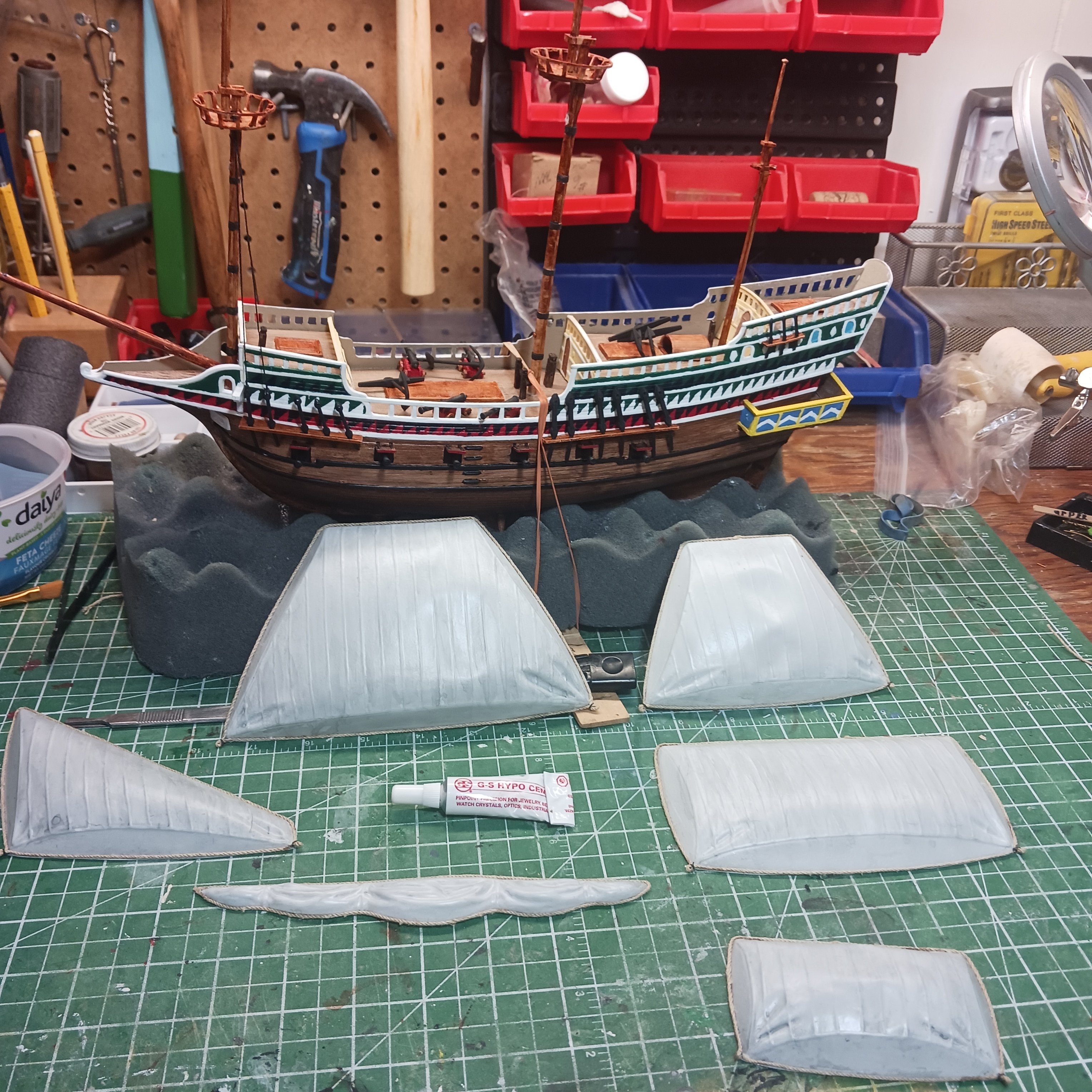

A special thanks to @Snug Harbor Johnnyfor his suggestion that I look over the bolt rope on my sails, sure enough I glued them on wrong.
yes they look better thus way, there are a couple of little dents in the sail that I am hoping a heat gun can fix that we will see.
And of course,  I had to see what they will look like lol. Except  for the four yards and the bowsprit mast that are all back in the box things a running smoothly.

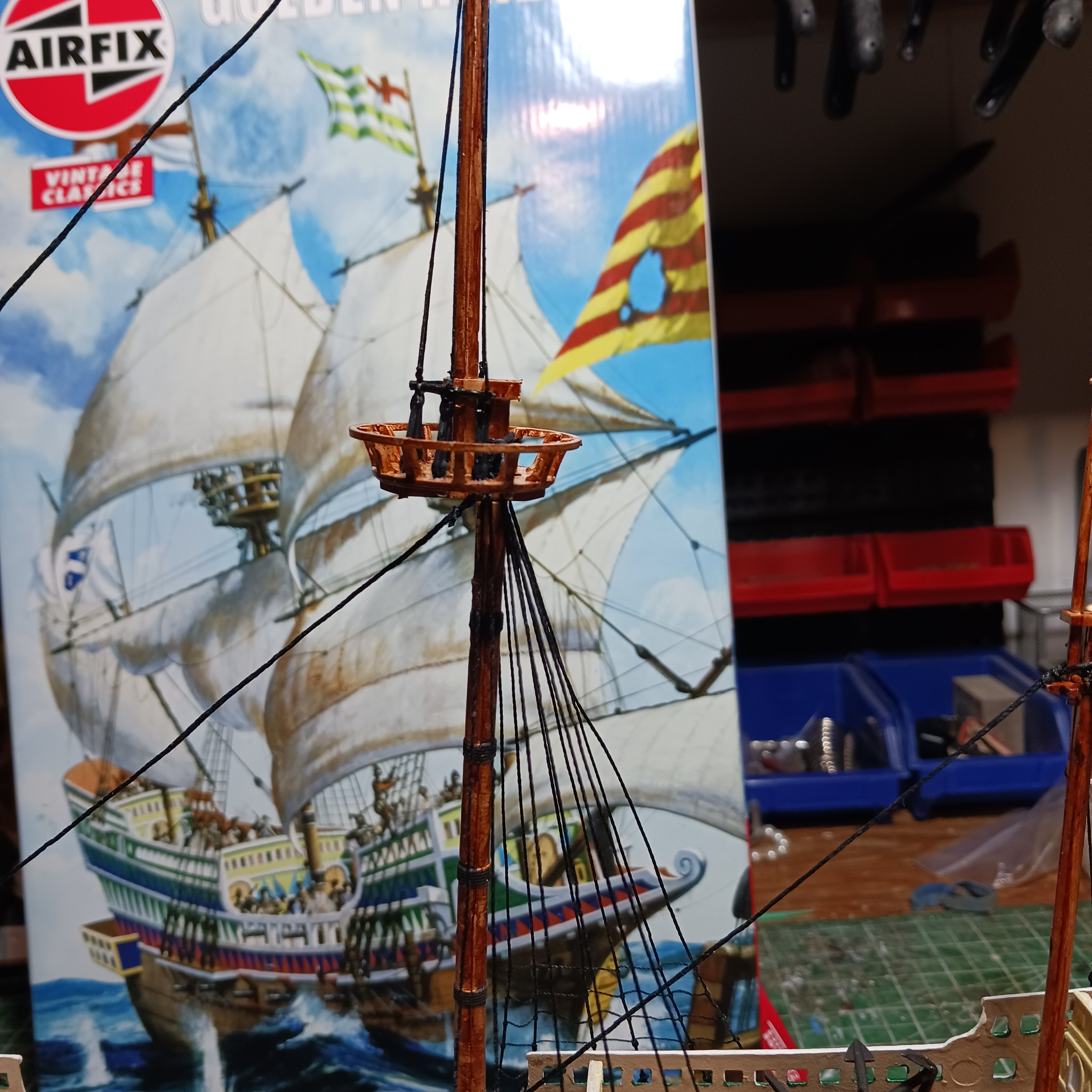

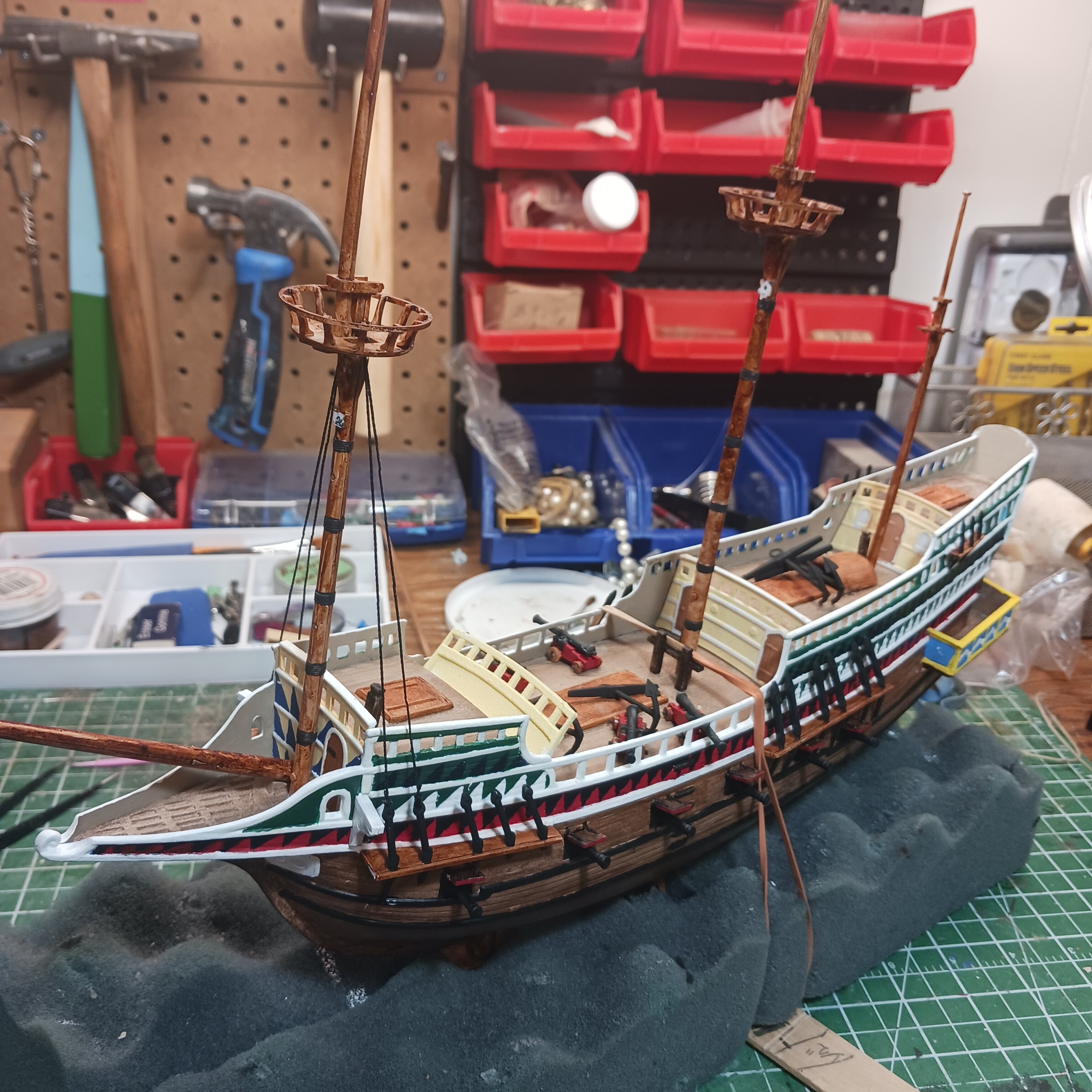

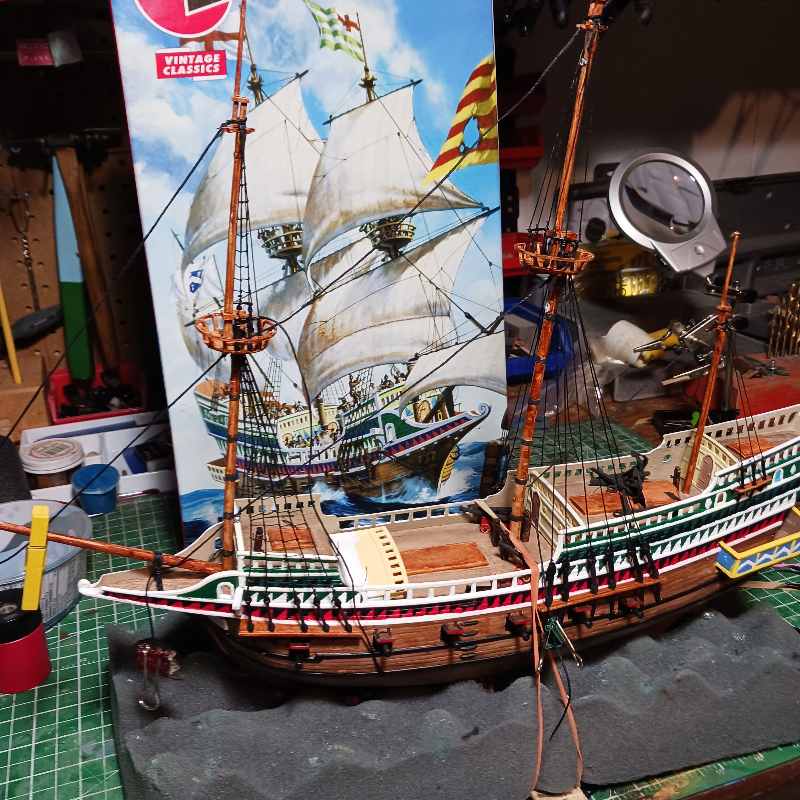

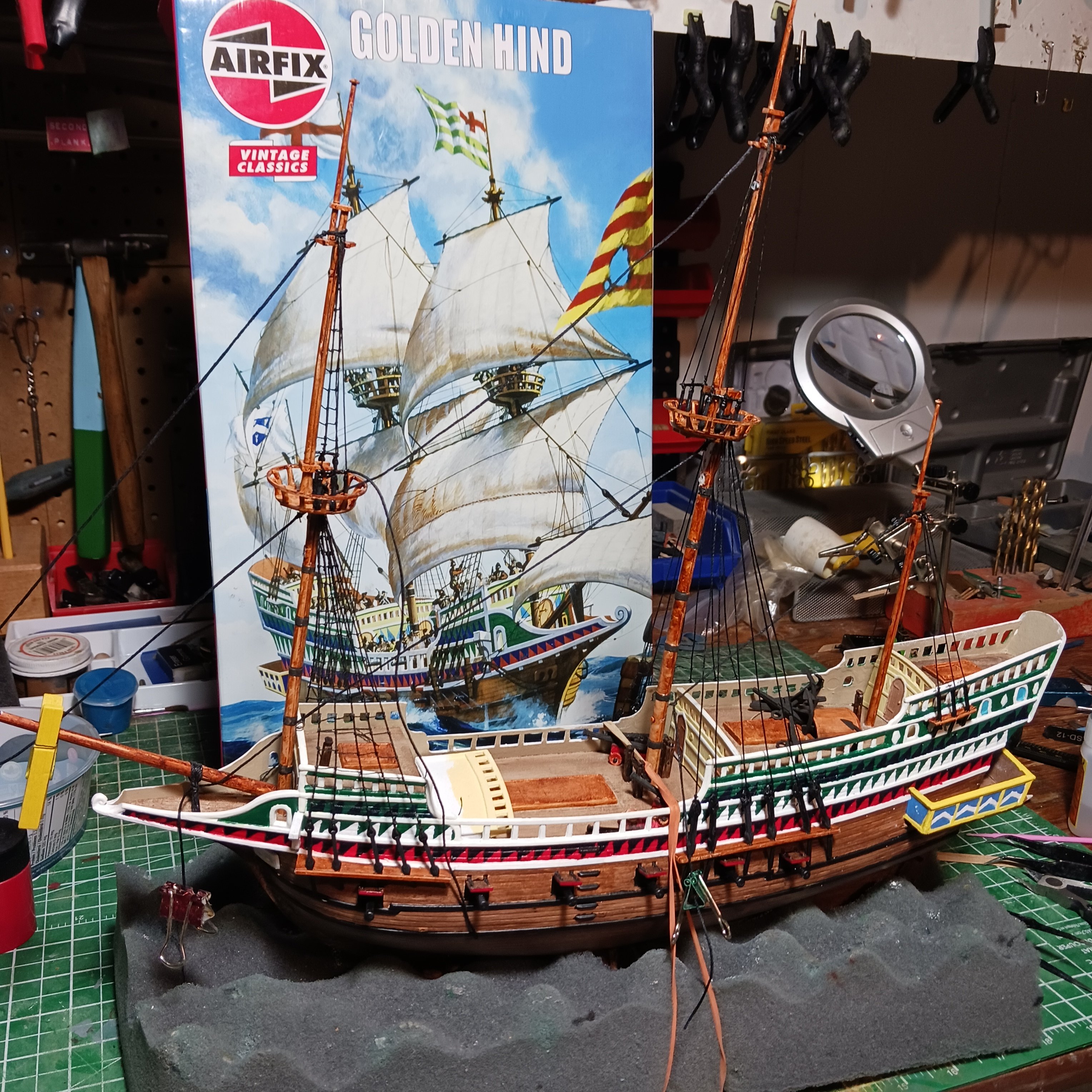

Starting to look a lot like the box , and the lower shrouds for the foremast are installed,  on to the main mast tomorrow,  yes there is a white out in Winnipeg  right now so have to shut her down for the night. Back at h'r tomorrow,    :cheers:

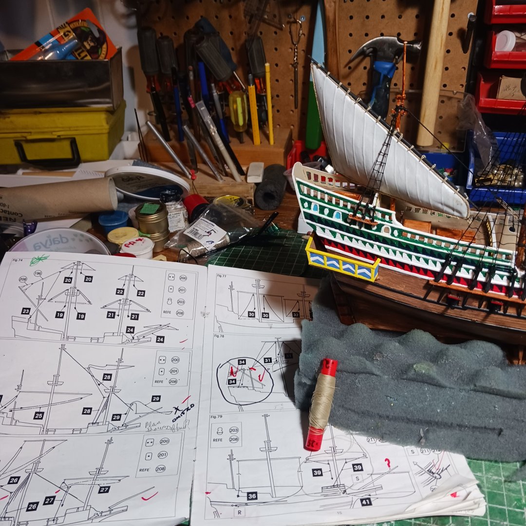

Some good news and some not so good news too.

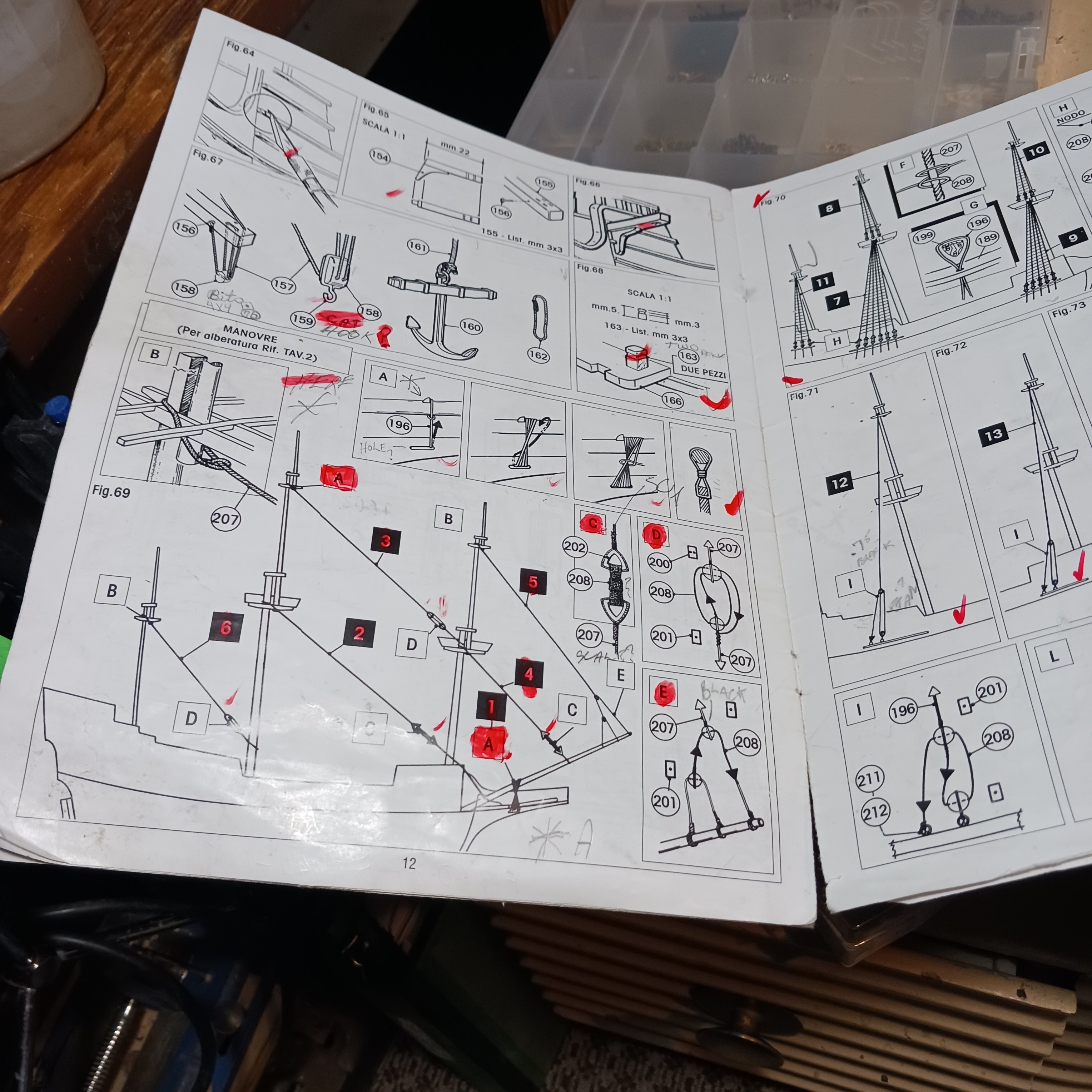

 Frist the good news, digging  into how to rig the Golden Hind,  the kit instructions are useless, but a member told me that it is rigged pretty close to the Mayflower,  and I have done one from Amati that had good information on how to tie, what blocks  and where things go, so I dug out my Mayflower info and boom there it all was , and if I get stuck I can run upstairs and look at my finished Mayflower. Lol 20250508_141944.thumb.jpg.9ae7df331194e63bd315e8981679246b.jpg
Messenger_creation_D453C450-B78E-4CB2-A4B7-F38A8DB59AEB.jpeg.430c30104dc918521e45d0ab54eab2f8.jpeg
And the bad news is I just noticed that they mainmast platforms is glued on backwards.  Darn, to much work for me to redo to fix this  soo....   marking it down as next  ship I 'll do better lol.
 Plus that big plastic sail on the upper main mast will hid it lol.  😆😅
So I am in my happy  place , ratlines. 😁 . Plus the not knowing what to do about the rigging , is a big load to get rid of, just a matter of neatness and getting the the time to do any modeling.
Between hockey season,  planting season, stuff I got to do season, I am sure these ratlines will take awhile.  On thing about plastic is if you wiggle it back an forth for awhile it breaks. I  had to stop yesterday  because I was shaking so much that the deadeyes were breaking off. Of the 20 sets of deadeyes  I have shook off four so far, and they are a pain to fix that's for sure.
Armed with new information about rigging,  time to geth'r  done .!!

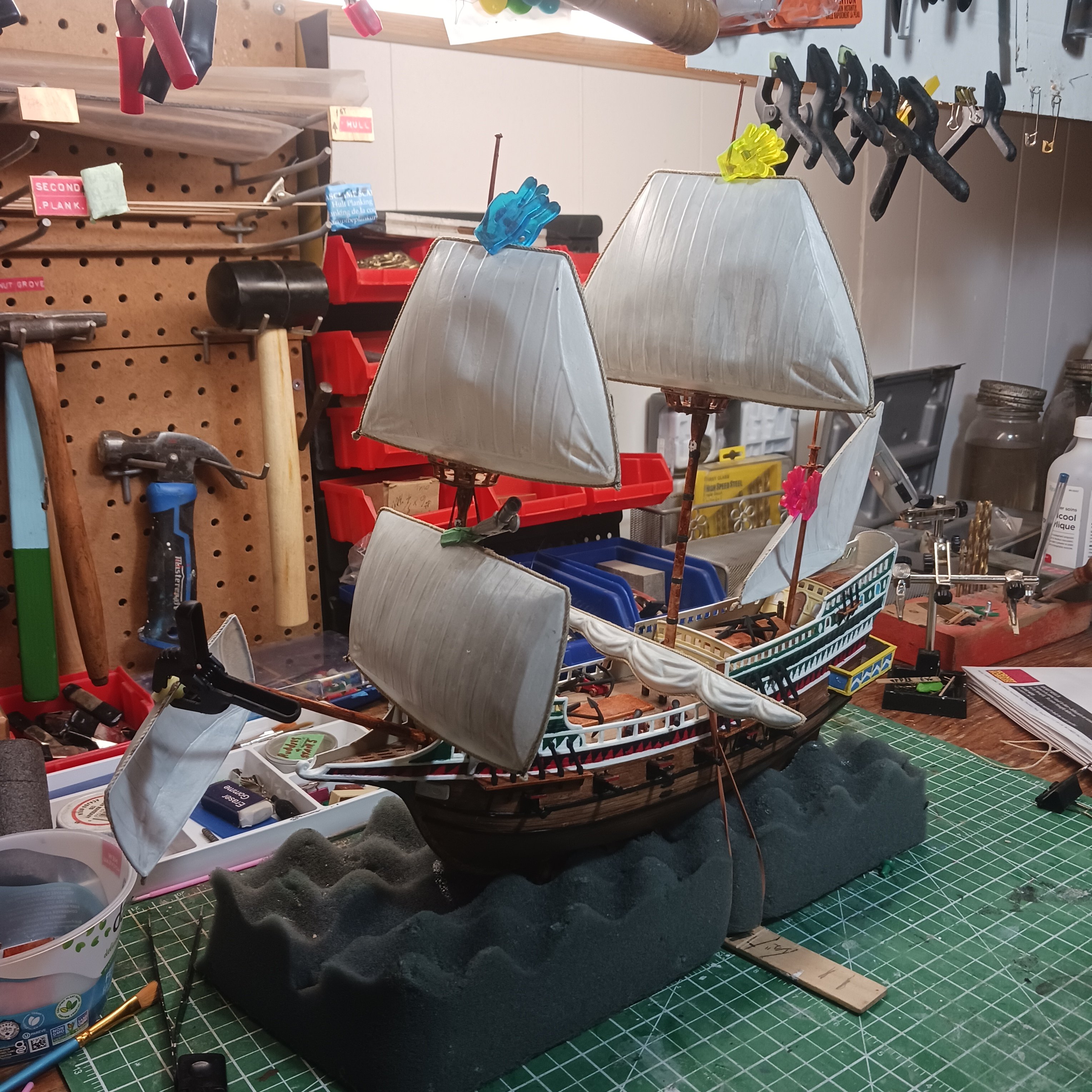

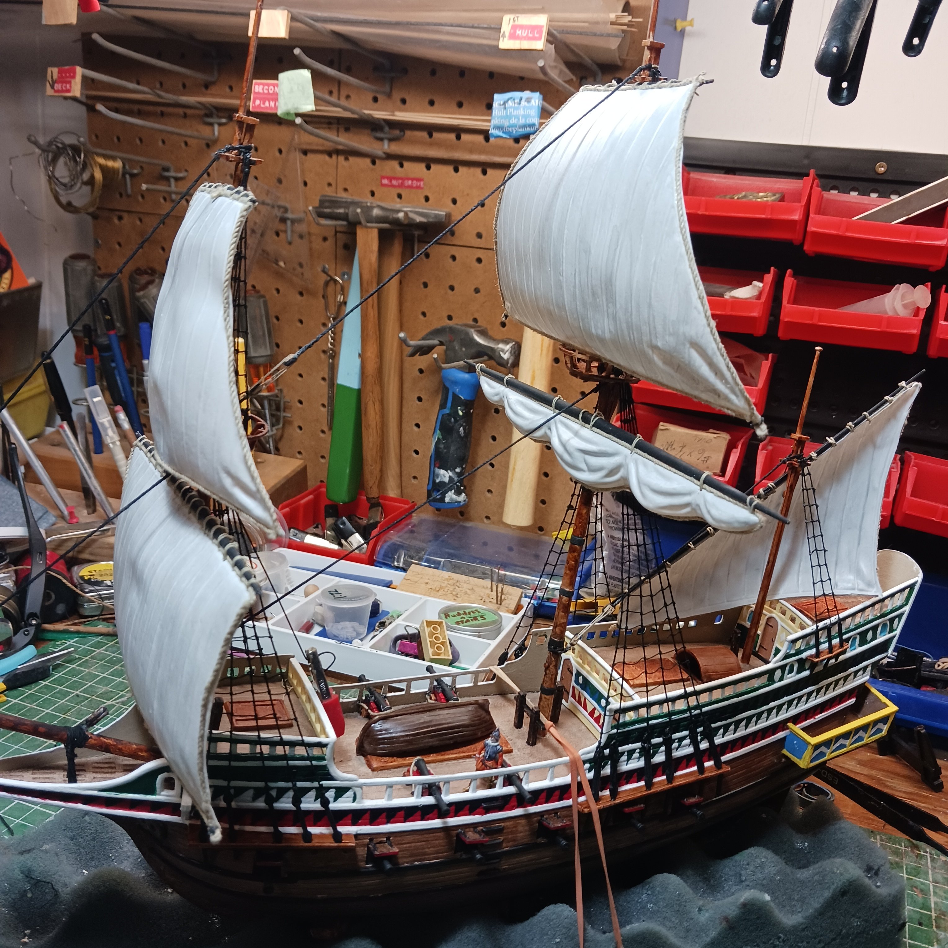

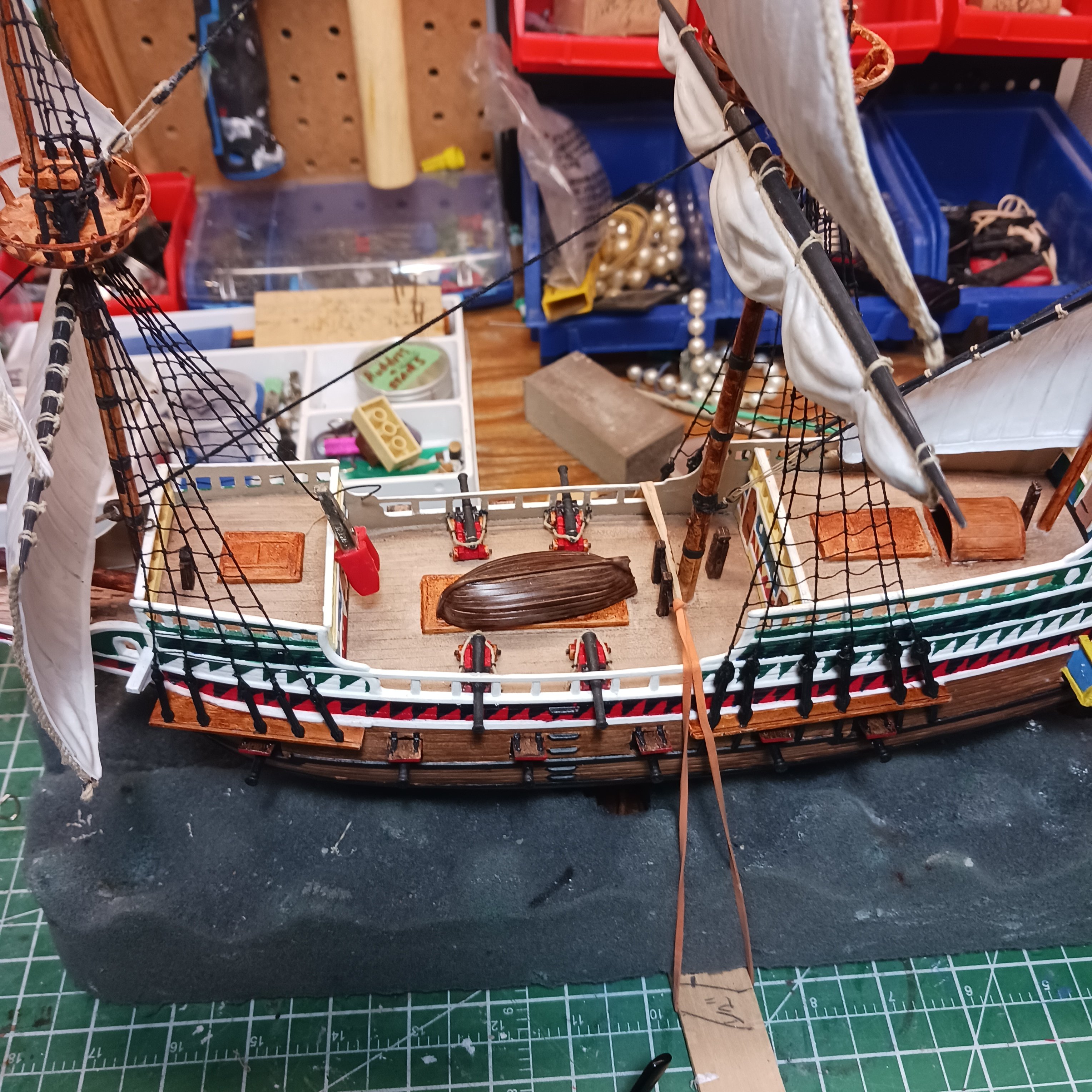

Time heals all wounds, things are starting to get beck to normal.  The arm still gets a little sore but much better.

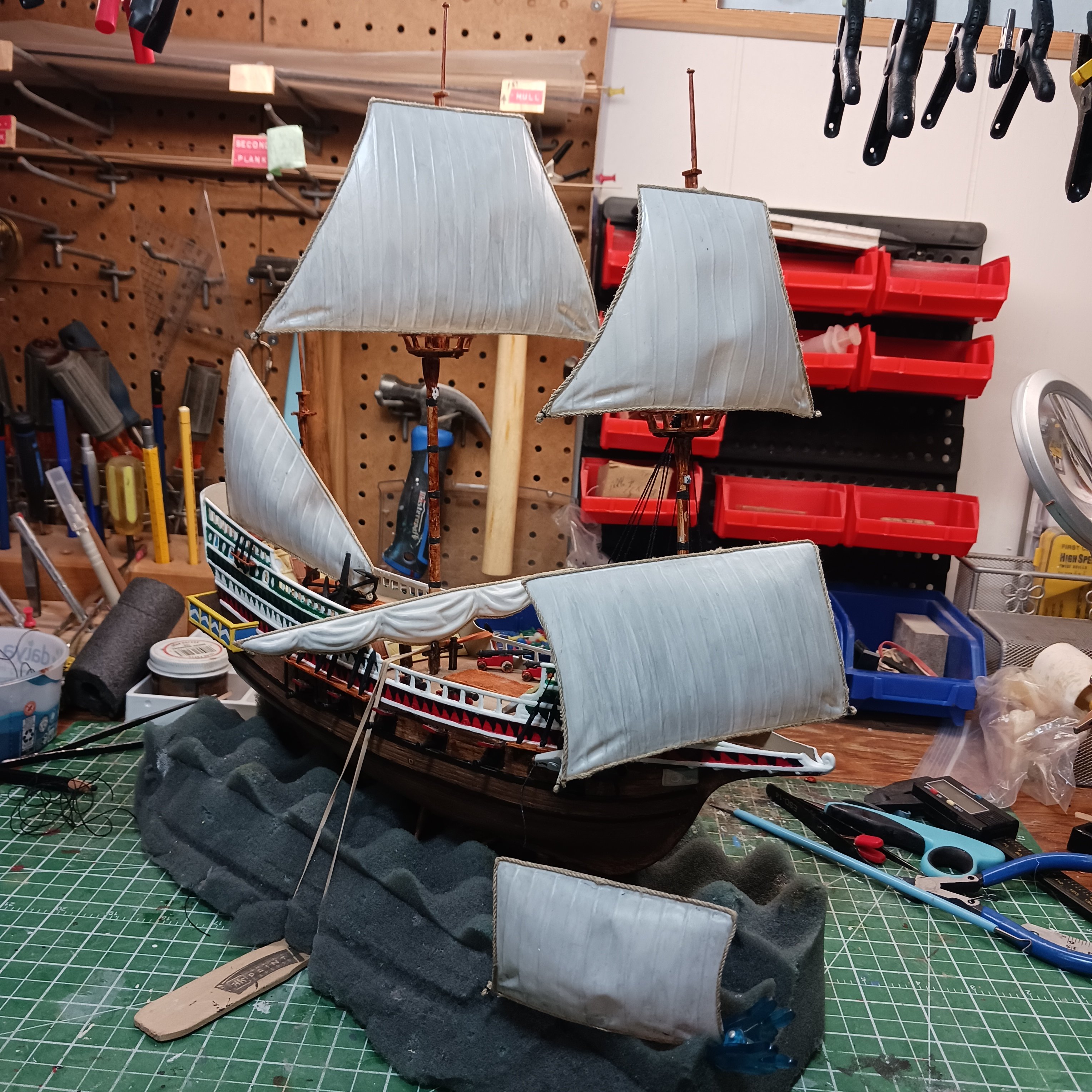

 The sails are hung, all the holes for the rigging are made it just a matter of glueing them on and tieing things up.
I tied the yards on, with the help of just a thouch of CA to keep the yard in place then tied them on.
I added a breach rope only for the four upper cannons ,and painted the ship's boat, I will make a stand for it later.
Just a few lines to run, some knots to tie and I am going to call it finished for now.
Will be sliding this ship right next to the Duchess in Kingston in the display case.
  So with just a few lines to run and some last minute changes this should be finished soon, but something might come up to delay the process for awhile lol.

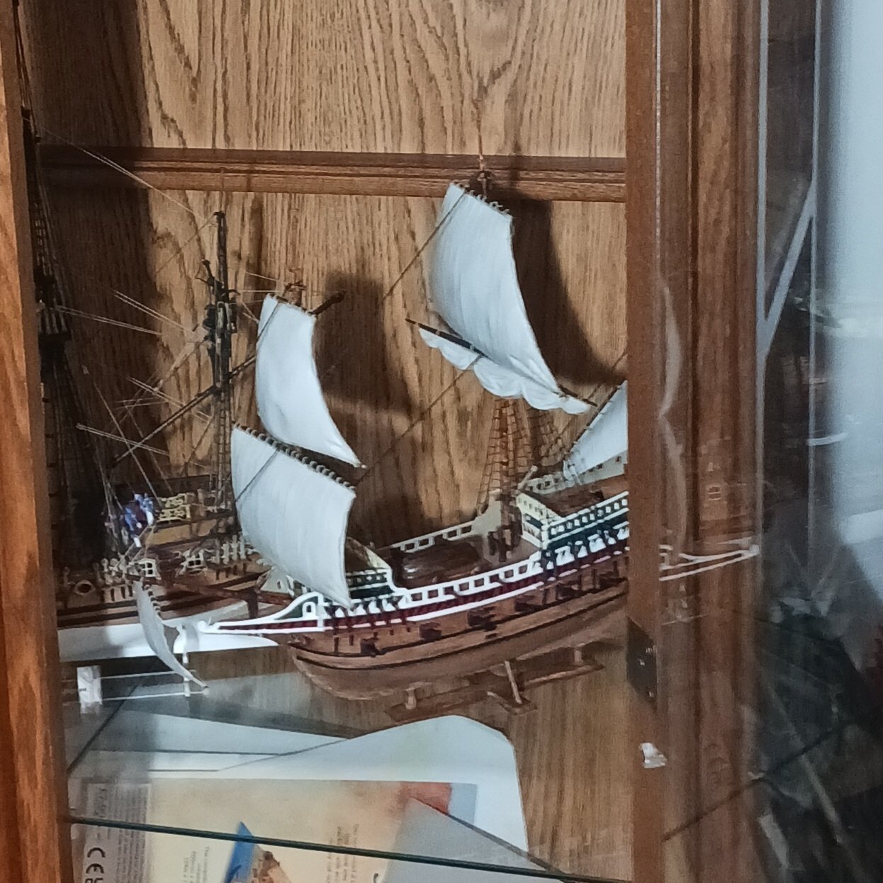

   Time to start thinking of my next build, well waiting for my next Surprise build to be released  I will attempt to build two Bluenose  ships, one is a Billings model and one is a 1962 vintage Scientific
 So  the Hind is in the display  case but needs more work. The first Mate is going home for a visit  with her sisters , and will be gone a week, so lots of time for the shipyard follies  lol for a week anyway.:cheers:

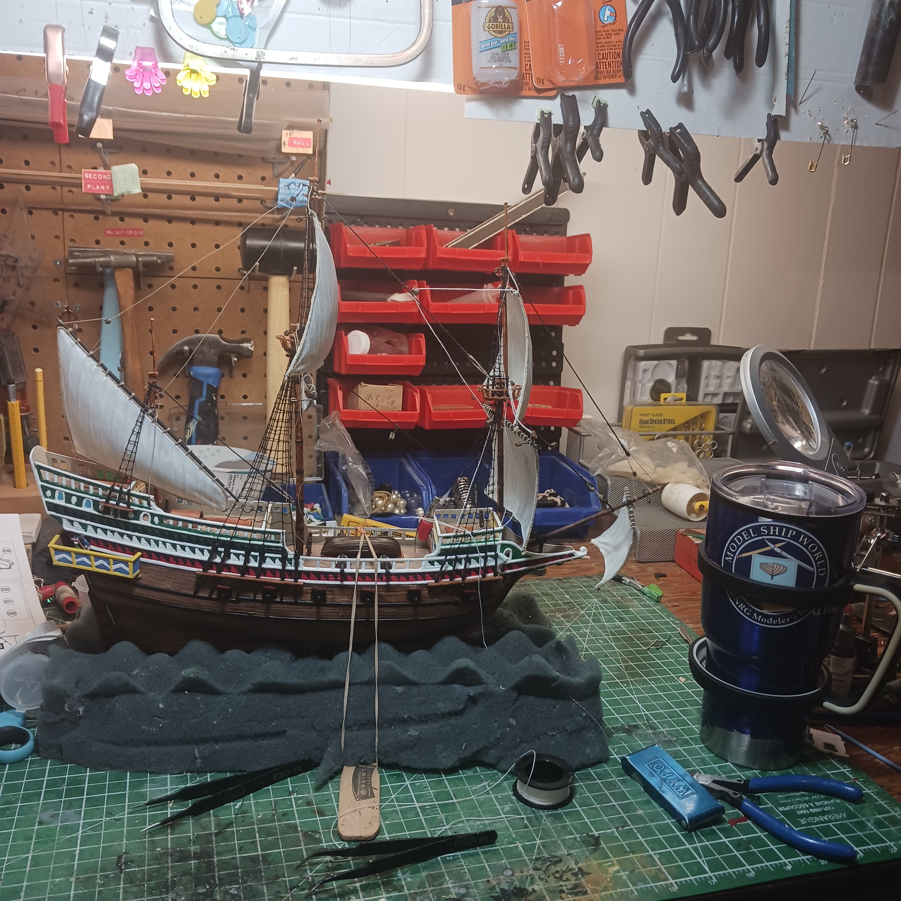

I have taken the Hind out of the display case and have her back on the bench . I have had a few set backs nothing serious,  I fell awhile ago separated my shoulder,  that's getting  better, now I blew a knee, got a 850.00 brace for my knee that only further my pain in my wallet 🙃
I recived my order for rigging lines so now I can continue on.my journey.
plan in hand, time to get all the blocks and line install, lash down the ships boat anchors and flag done. Lol
 Coming up to four years that I have been modeling,  time flys when your having fun. And being here is the most fun one could ever  have. Thanks so much for showing me how. Talk soon my shipmates.:cheers:.

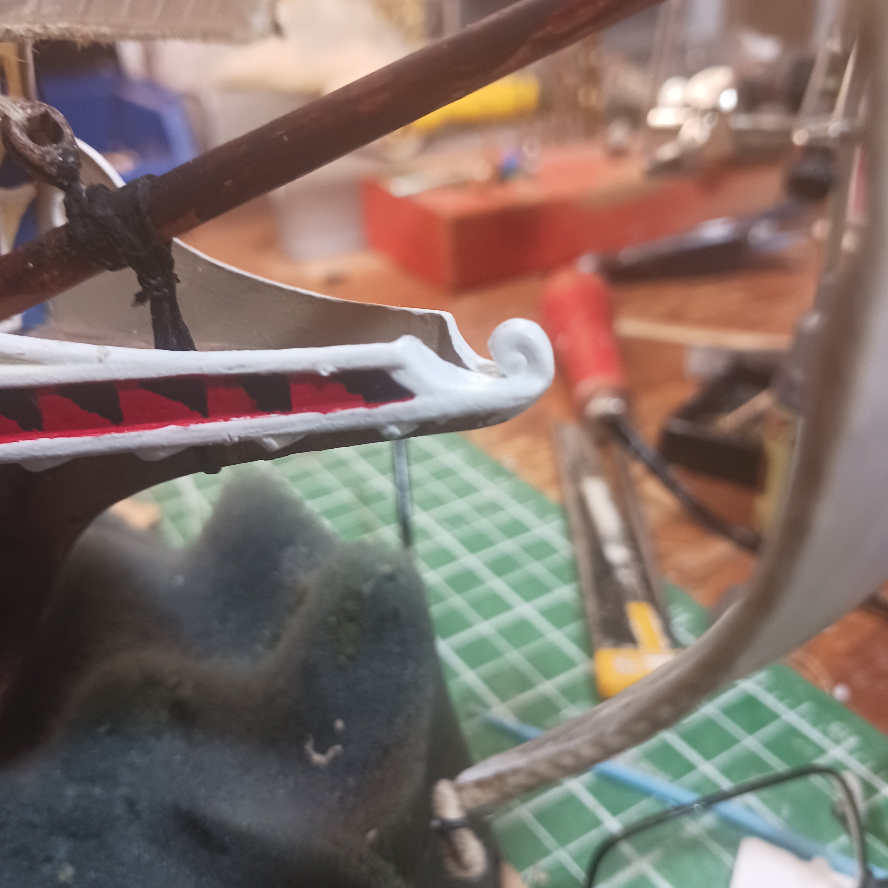

 I have been looking into the figurehead,  the kit come with no blocks, no figurehead
no ships boat, no thimble blocks , no heart blocks. I thank my God for my friend who is a wizard at printing things. I have to be careful what I say around  him because when he hears that I need something  he will print it lol. Here is the figurehead  he is working on. It wont be exactly like this and will be attached a bit different . I don't know where I got this picture but it is from a Golden Hind  build someway. I am only using the idea not exactly as shown. Messenger_creation_D5472E1F-9DDF-426F-9EC3-E0DC61FFA402.thumb.jpeg.a603671301b99bba406117bfba53258d.jpeg
 plan is to file the bow flat, about half way through about. Once flat the figurehead will be pinned to it. Should work.

 I got to spend a few hours today in the shipyard,  the weekend looks great for time in the yard, so a push to get'er done by Sunday night, we will see. There not much to do now that the 5th season is over lol. So I should get lots done. Talk to you Sunday.my friends :cheers: :cheers:.
Knocklouder.
Bob,
  That looks like the figurehead on the Golden Hinde replica in London.
Your Golden Hinde is looking great!
Also, I’m glad to hear that your arm is feeling better!
