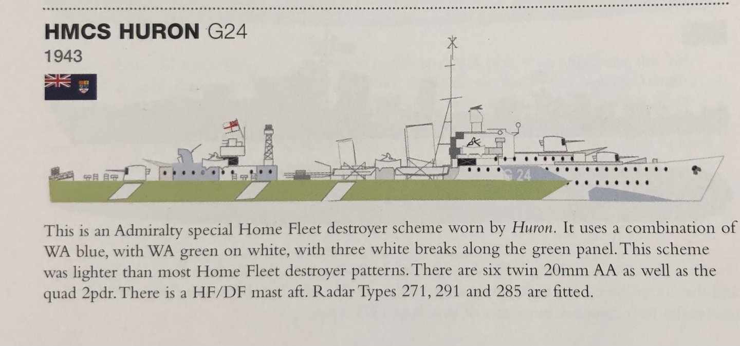

The camouflage scheme on the box art drew me to this one, curiously the painting guide has something different
Ive also seen a Sovereign Hobbies illustration showing a four grey shade scheme.  My book British and Commonwealth Warship Camouflage offers another variation based mostly on Western Approaches green. This one is quite unusual and might be the final pick.

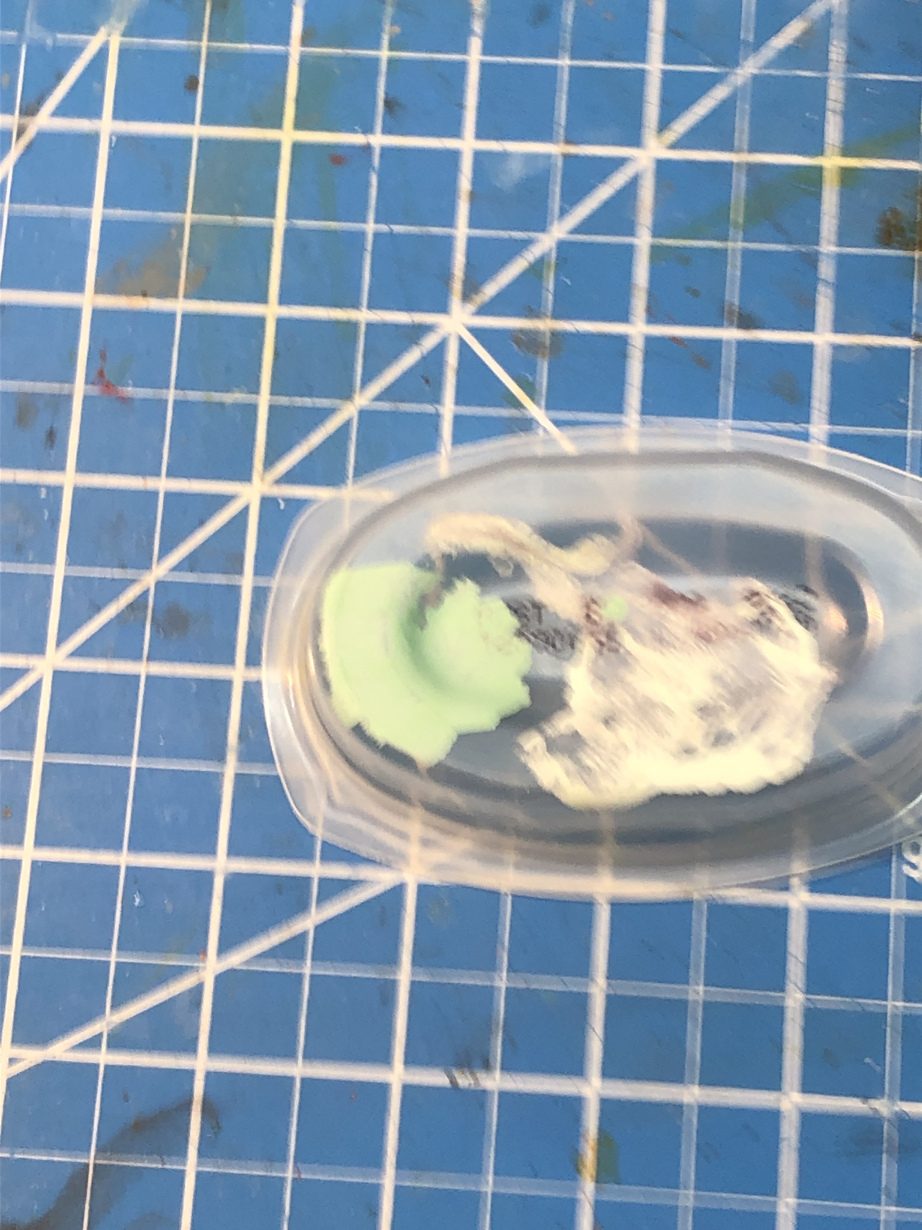

After deciding on the paint scheme I needed to sort out the paint. I have the AK Royal Navy set which includes Western Approaches Blue and Western Approaches Green. I was not totally happy with this set when I used it before but I thought I would try it again. I tested the WA blue and green.
Although it looks a bit bright the green does resemble the color seen in a WW2 photo of HMS Comet wearing a similar scheme. The blue is another story, it’s almost white. I’m going to use Tamiya Light Blue which looks better.

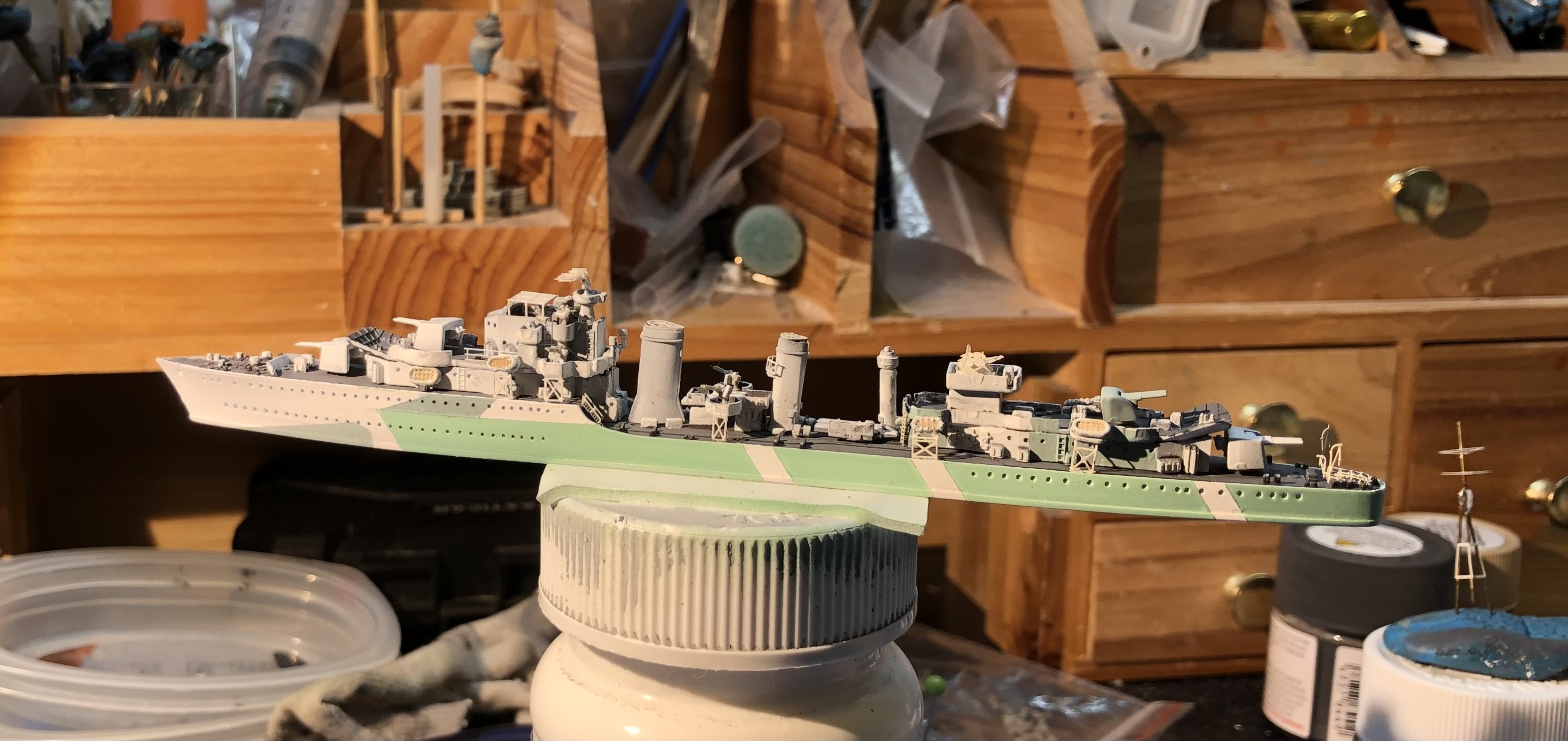

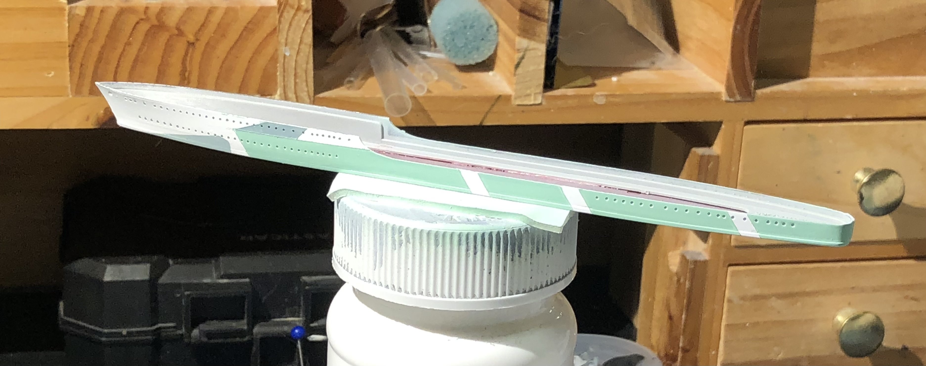

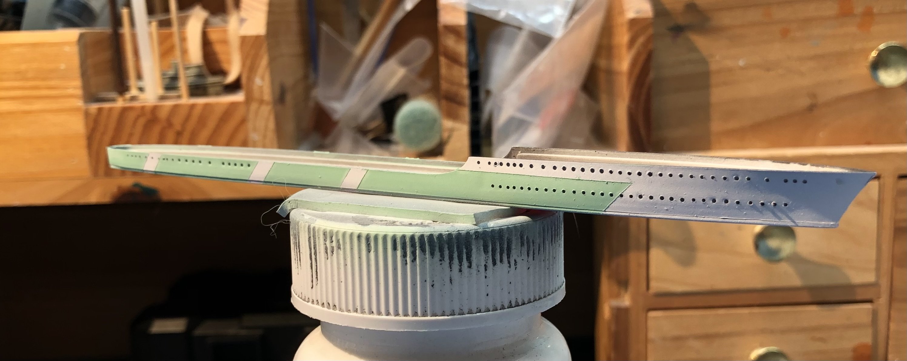

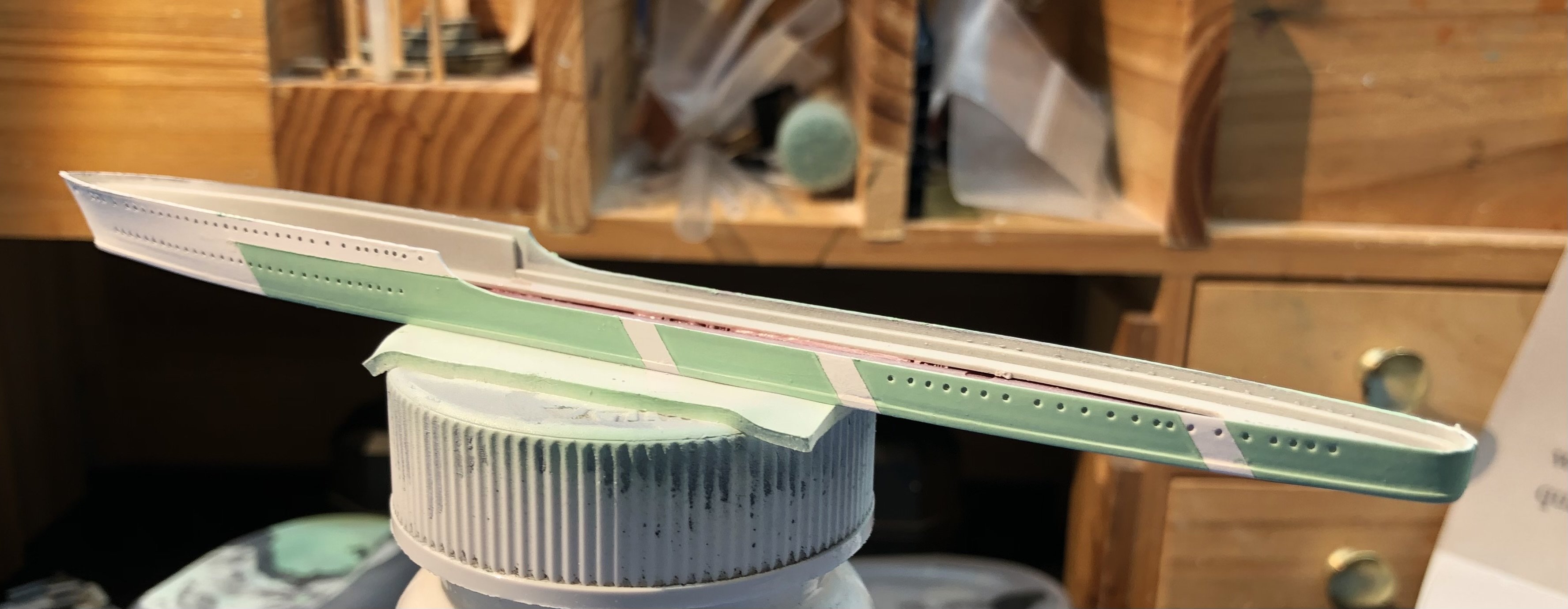

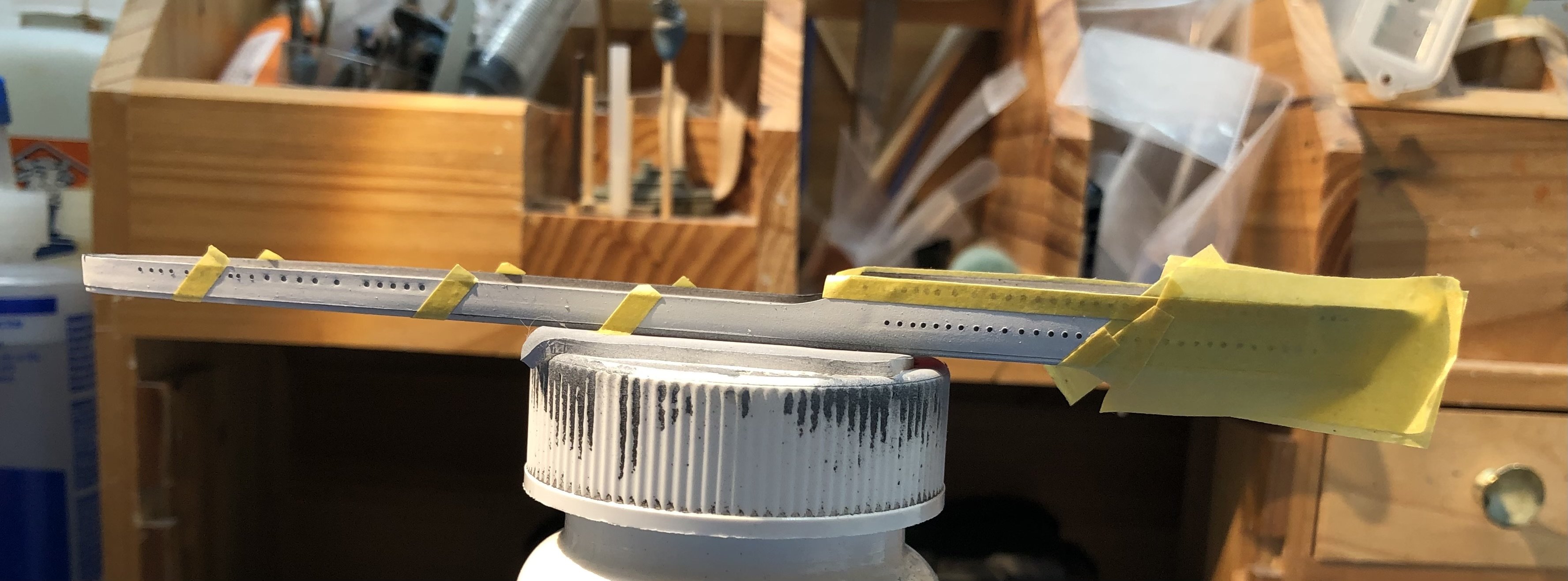

After painting everything except the decks with flat white I masked up the hull ready for the green part.
I remembered the AK acrylics and water based and using.Tamiya or Vallejo thinner causes the paint to curdle. I have some AK acrylic thinner and that worked quite well. The green was sprayed on and the masks removed.
I think the color is where I wanted and the masking worked well. Unfortunately the port side was not so nice. The green paint appears to have run down the white leaving the green areas mostly white with green streaks. Maybe I thinned the paint too much or used too heavy a coat. I did notice that the paint took a long time to dry even in my 85F garage. The coverage looked good at first but seemed to run during drying.
I sanded the green back and then painted the hull all white again, a second coat was needed today and tomorrow should see us masked and trying the green again.
At least the masking will go a bit quicker next time.

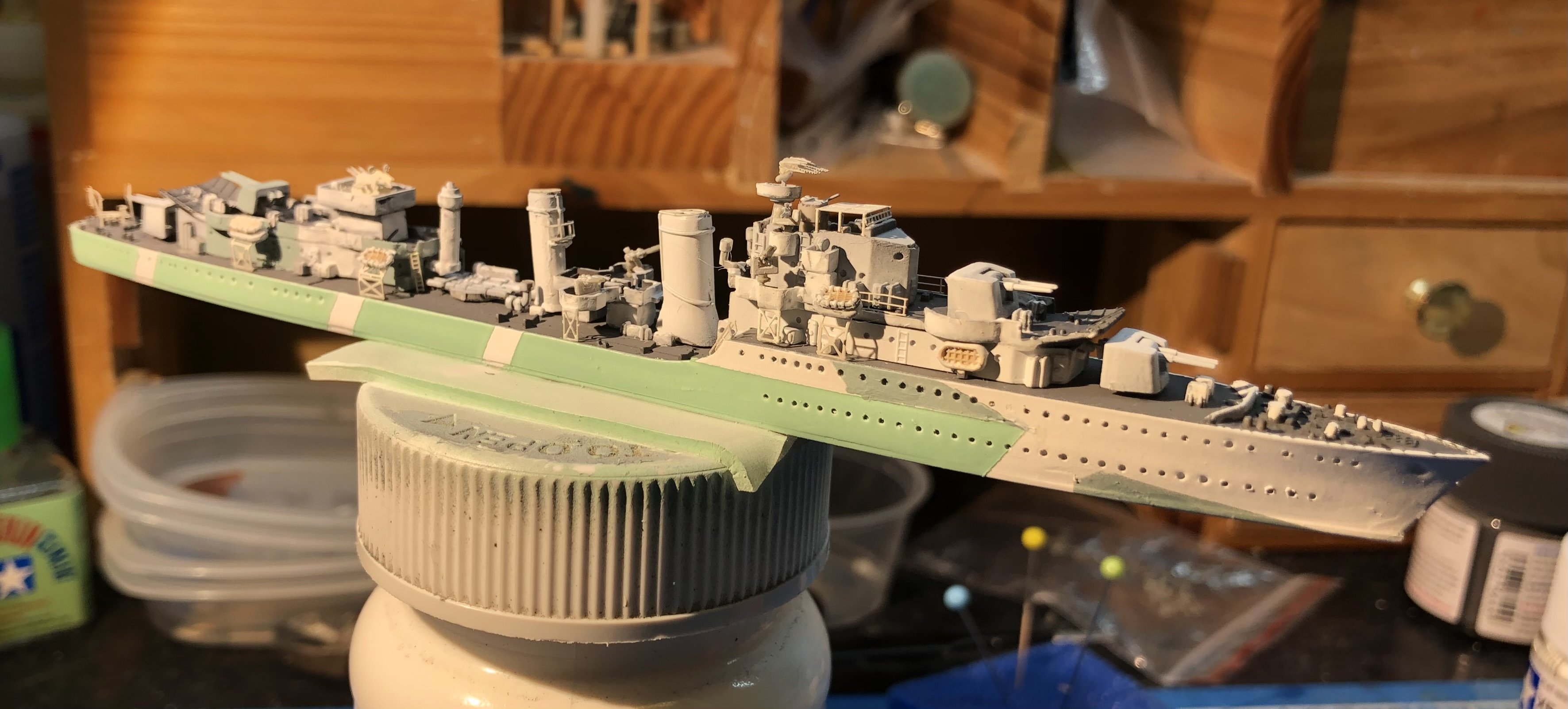

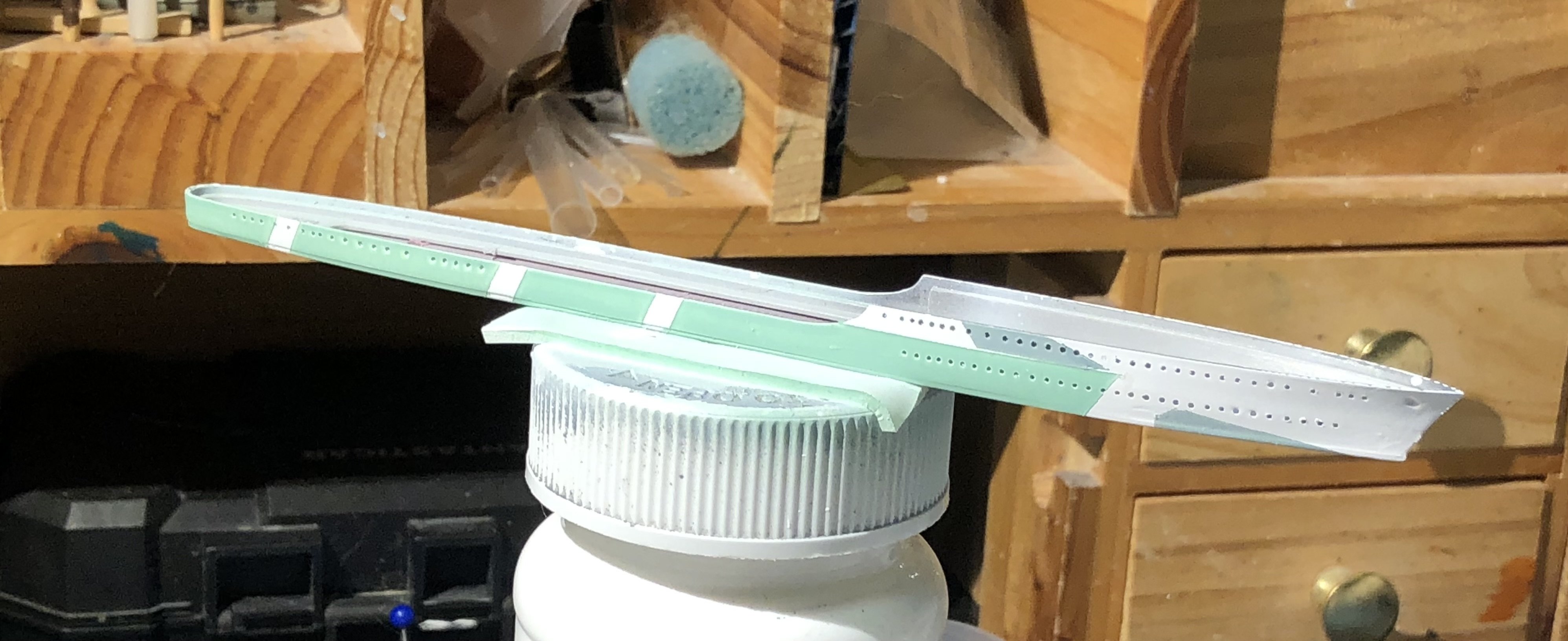

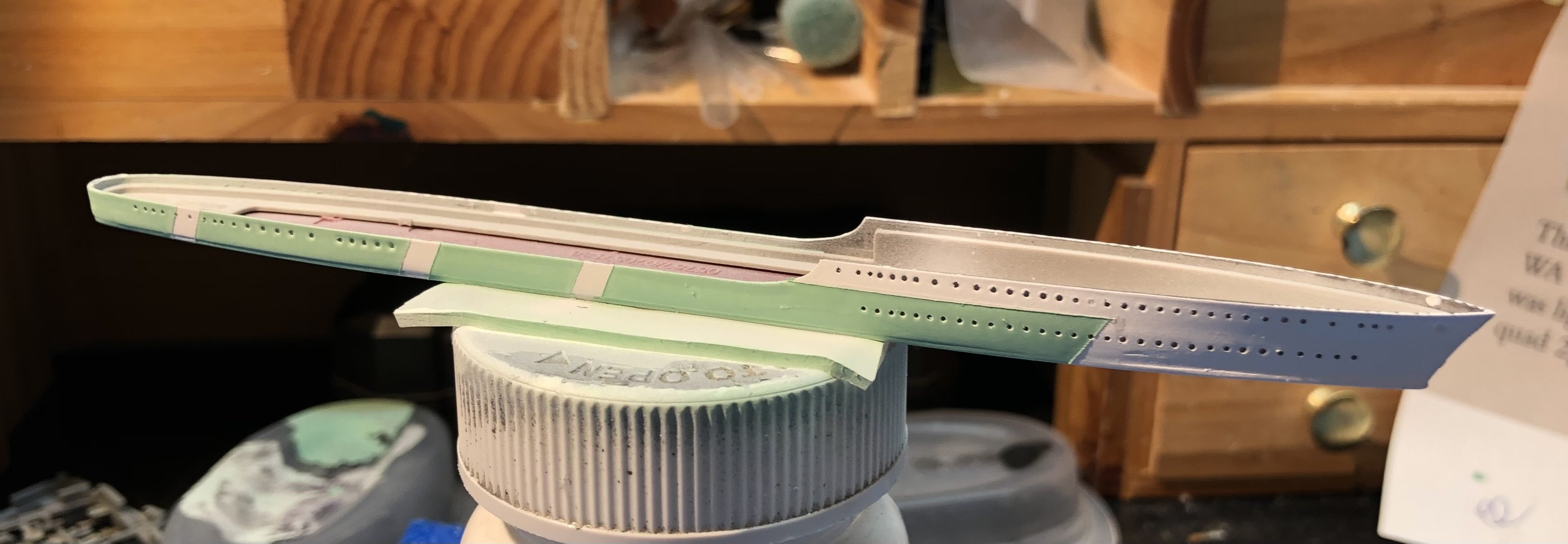

I sprayed the am Western Approaches Green and it seemed to be better behaved today. I used less thinner this time. My working theory is that the longer drying time allows the paint to flow down surfaces and can cause streaks. It also means the paint is very prone to penetrating the masking. This time I got a good result in terms of color and masking.
IMG_2178.thumb.jpeg.19e398e73c54a27e6a83be5f8a75bc57.jpegIMG_2177.thumb.jpeg.2c73f8bc2cb4c10825ba9fa5e5baa668.jpeg
I’ll let the paint harden overnight and hopefully mask and spray the WA Blue tomorrow. The masking is going to be a bit intricate but the paint is Tamiya acrylic light blue so should be less of a problem.

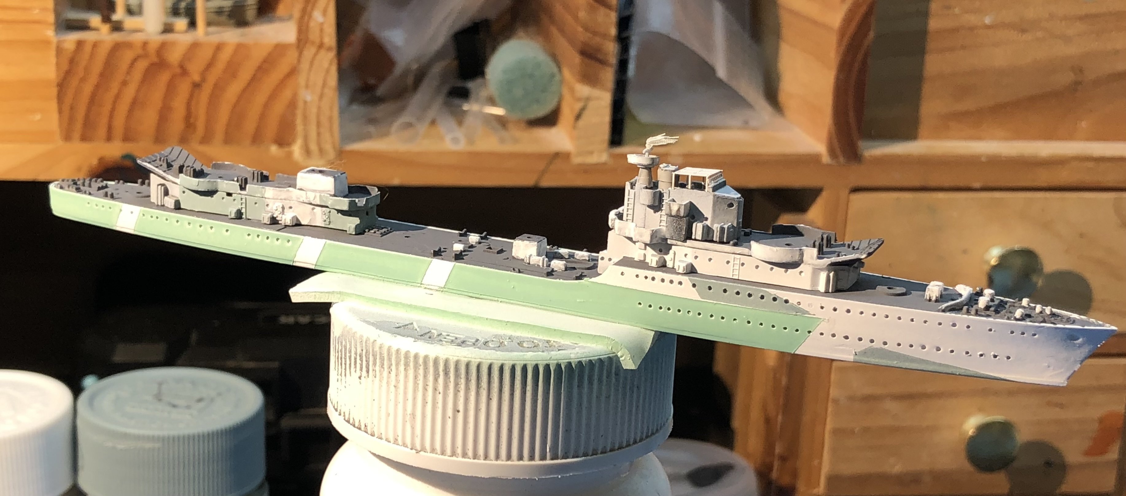

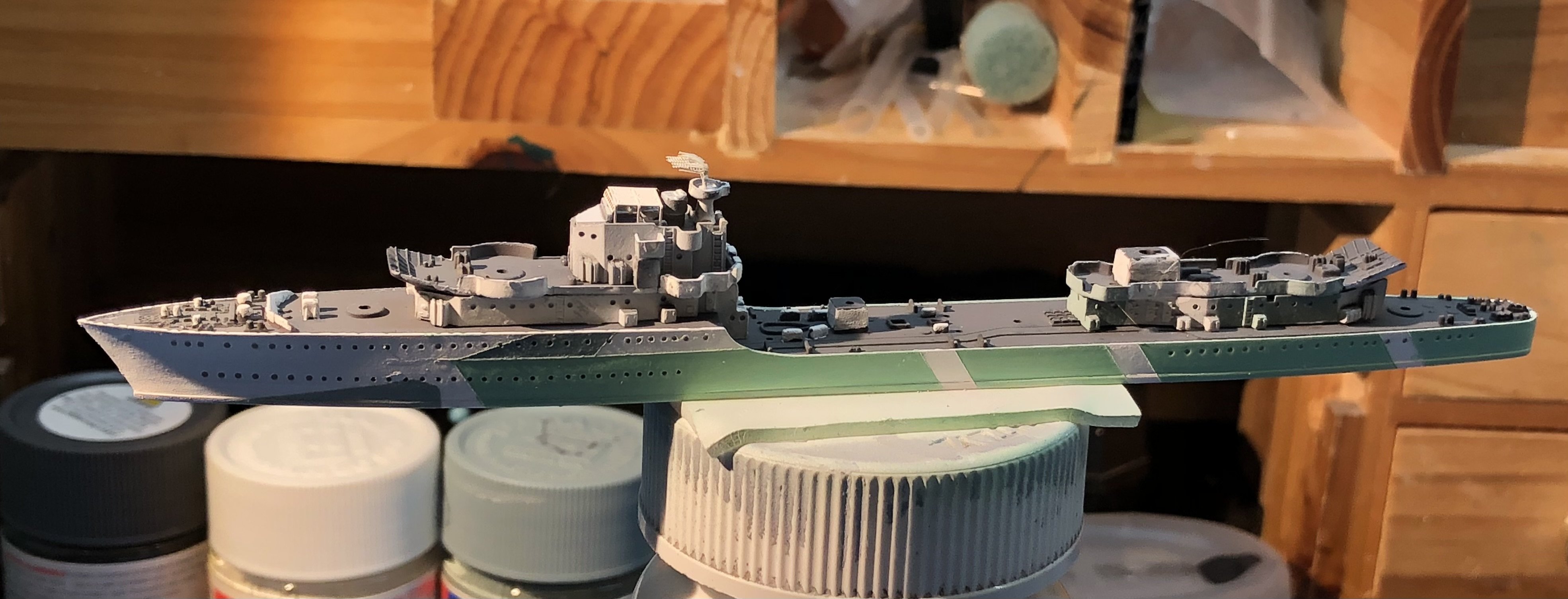

Another day, another masking session, for the blue this time. Fiddly thankfully there are only two blue sections per side.
 The masking remained watertight and the Tamiya paint dried quickly so the result was quite clean.
The WW2 color photo of HMS Comet has similar colours so I think we’ll call that good.
The deck has had a coat of dark grey. The superstructure is white with a little blue so I think I can start sticking bits together and thinking about the PE. Tribals seem to be a bit like Flower corvettes, they all a bit different so some of the PE is not going to be used but at least there are railings and ladders.

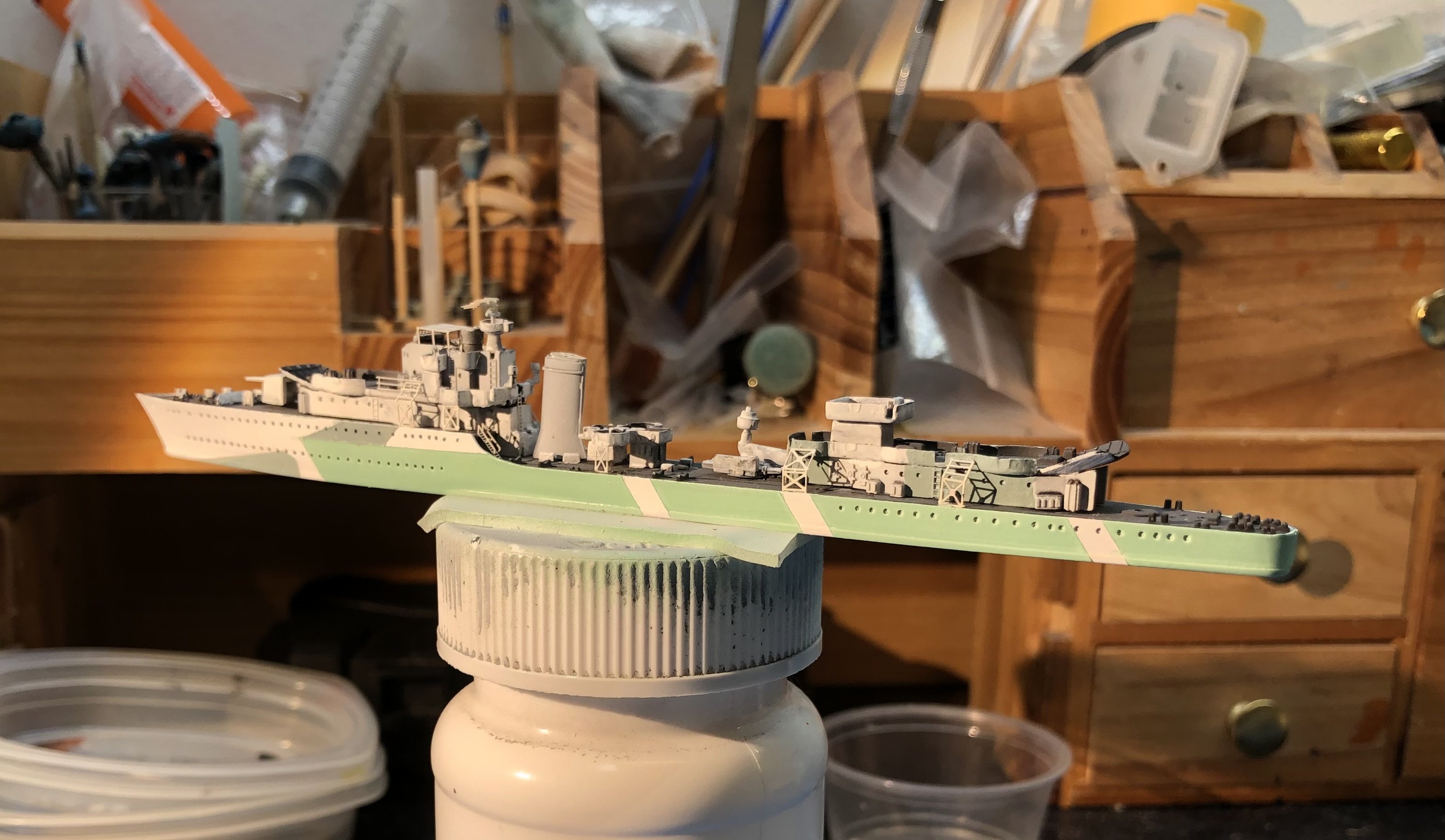

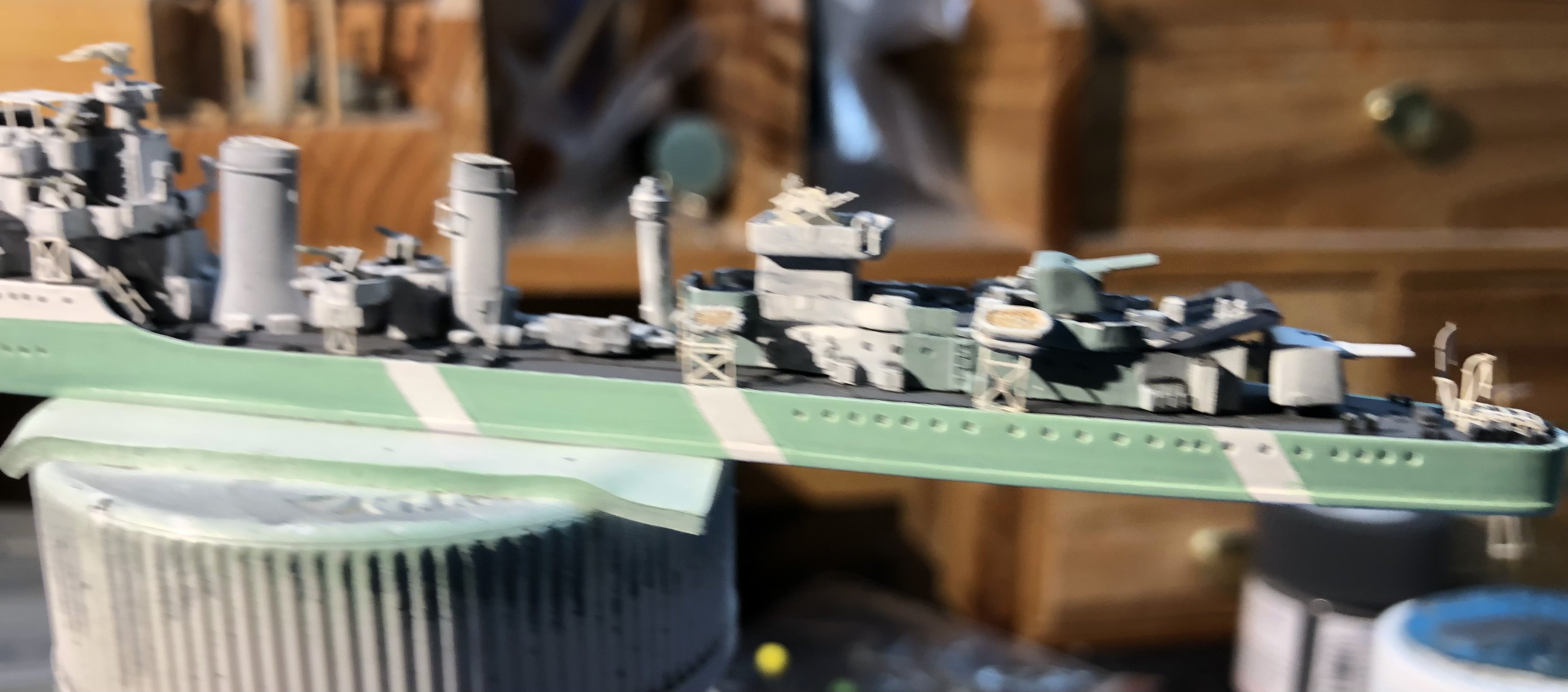

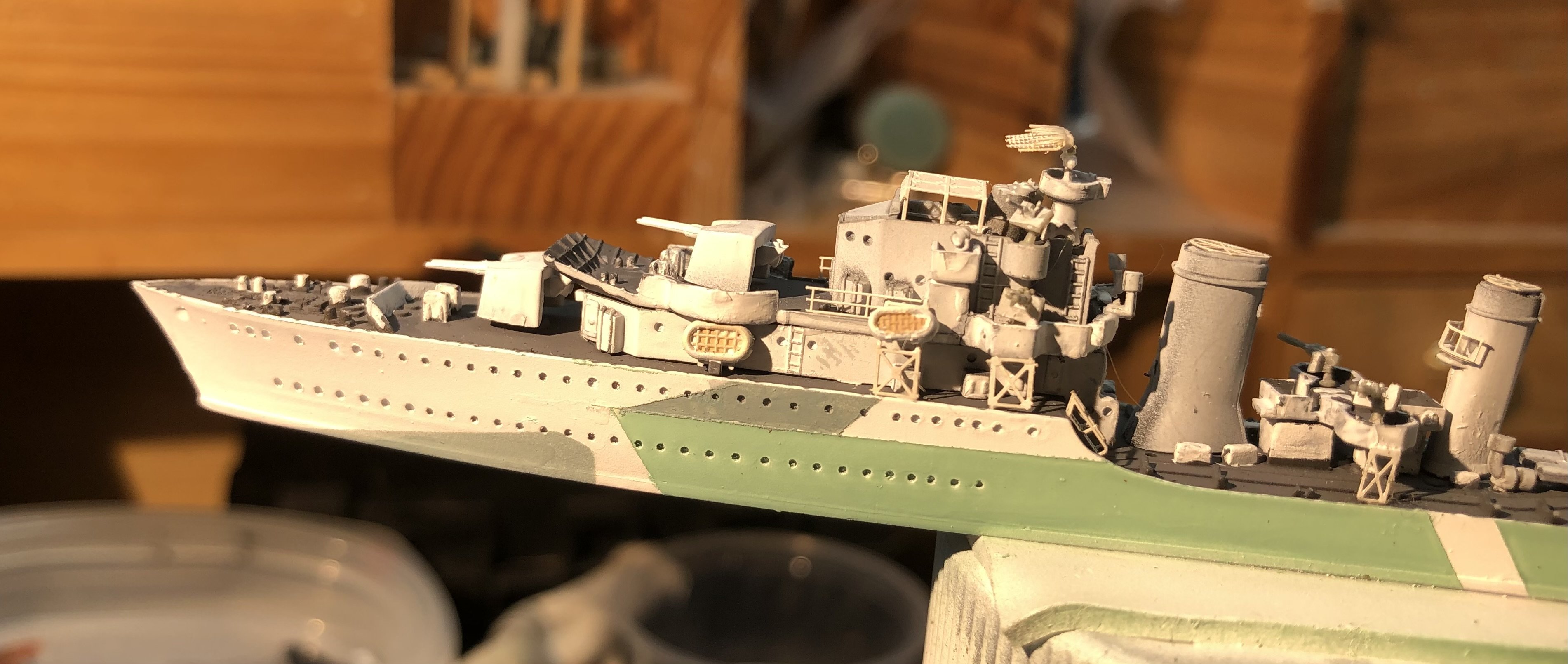

I’m spending a lot of time working through the various configurations of Huron through the war years. Trumpeter say that the kit reflects the ship in 1944 but the box art and the kit bits show a tripod mast ( early war years) whereas the WE PE provides a lattice mast which is the later configuration. Luckily I found this photo.
This shows my chosen camouflage pattern and also a tripod mast in (I think) 1943.

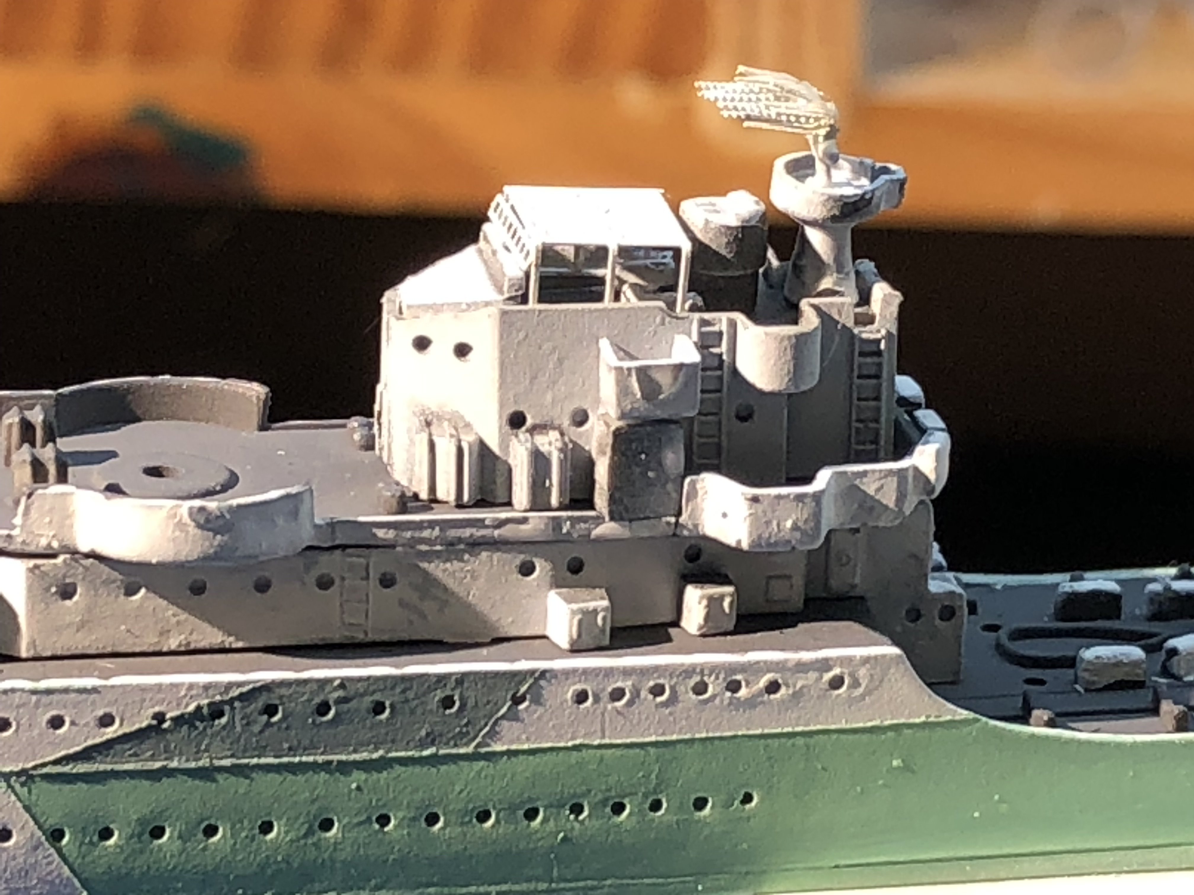

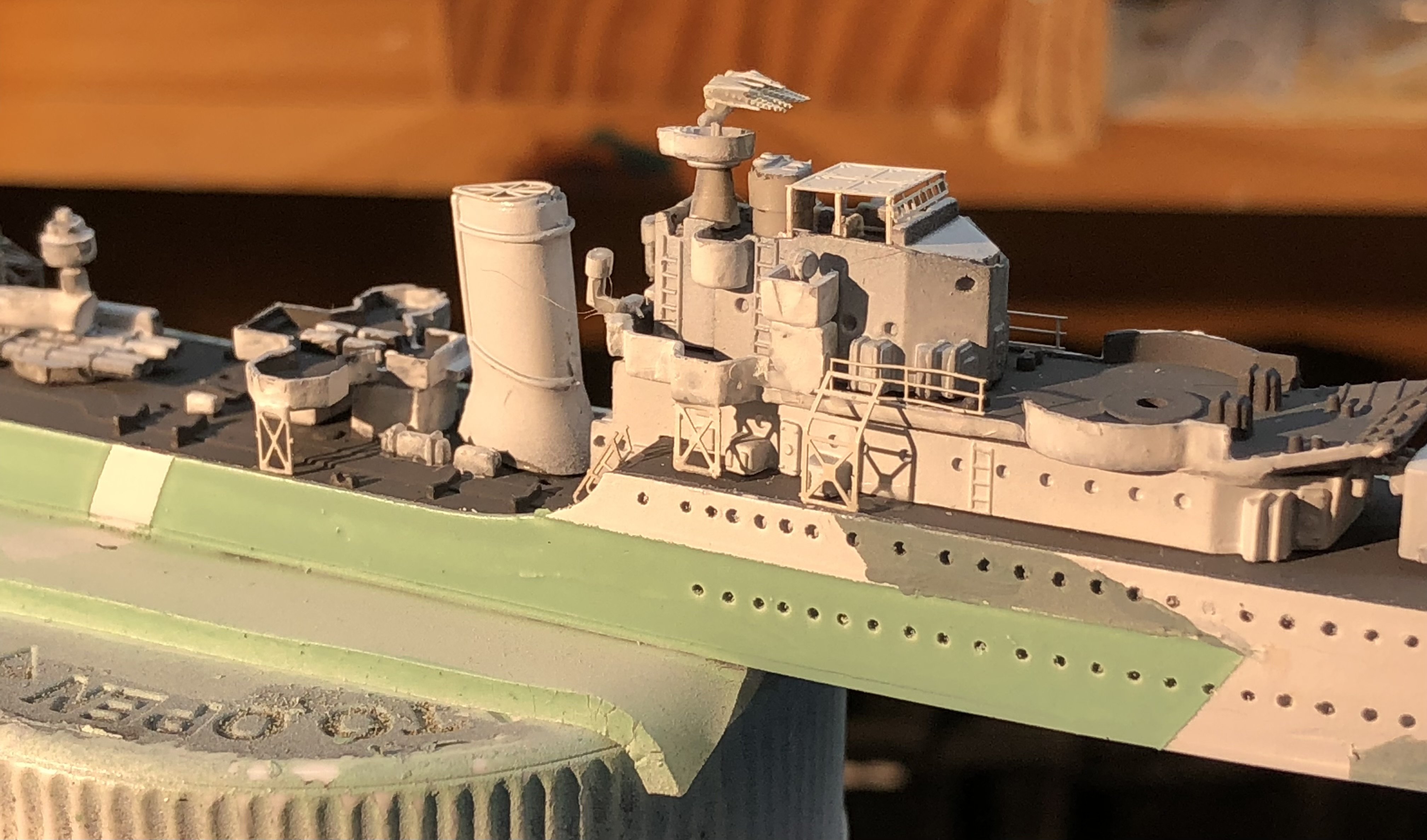

So with the hull camouflage complete I started building up the superstructures and edged into the PE to detail the bridge. I added the bridge windows and the canvas cover, then made up the Type 285 gun control radar which was very fiddly. Some of the WE PE is very small and probably beyond me. The quad pompoms are just too tiny and intricate.

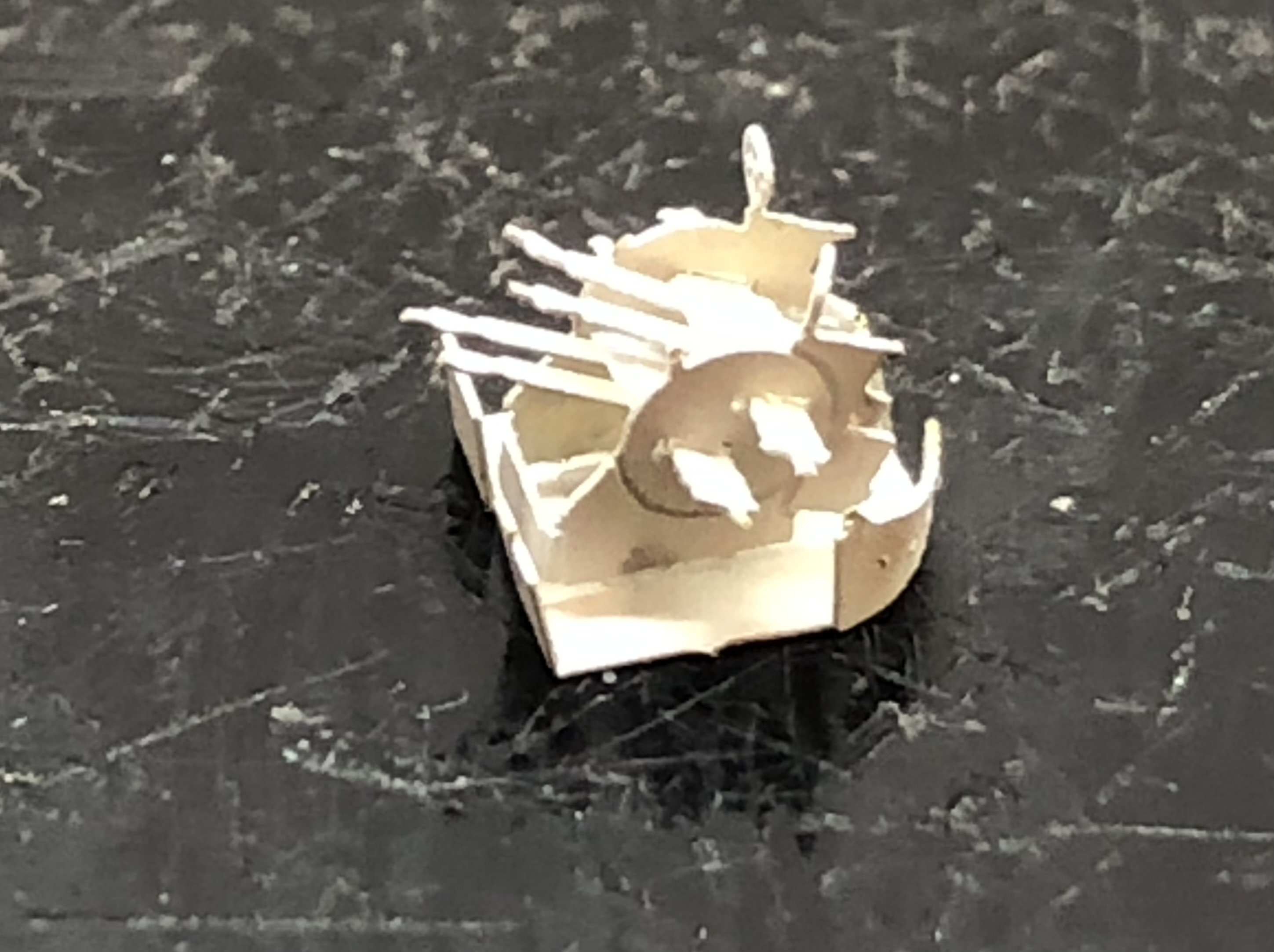

Guns at 1/700 in PE are a real pain, especially the twin, triple and quad guns.  Part of the problem too with them is that the barrels are usually flat, rather than round, so you get more of a 2D look if one should happen to look very closely.  I decided to replace the guns at 1/700 scale (and even at 1/350 scale) with pre-made guns that look better than the kit blobs.  Adds to the cost of the kit, but saves a lot of aggravation and improves the look.  You can find some really nice injection molded sets (at least I think they are) from Fine Molds.  And more and more you're seeing 3D printed items from outfits like Bunker Studios, Five Star, and Black Cat.  I recently found my holy grail kit - the 1/700 Loose Cannon USS Langley CV-1 for a good deal on eBay.  I was excited when it arrived, but disappointed at some of the detail pieces so I ended up getting replacement guns, small boats, rafts, etc.  I ended up also getting some of those items for a 1/700 Trumpeter Hornet and 1/700 Tamiya Bogue that I plan to model.  You can find these from places like Squadron Hobbies as well as on eBay (usually from Chinese sellers).
Thanks for the useful resources for replacing the secondary guns. I’m with you, the kit guns are usually horrible and the PE looks flat and is fiddle and fragile. I think I need to invest in some resin replacements, I found a fair selection on the Squadron / Black Cat category.

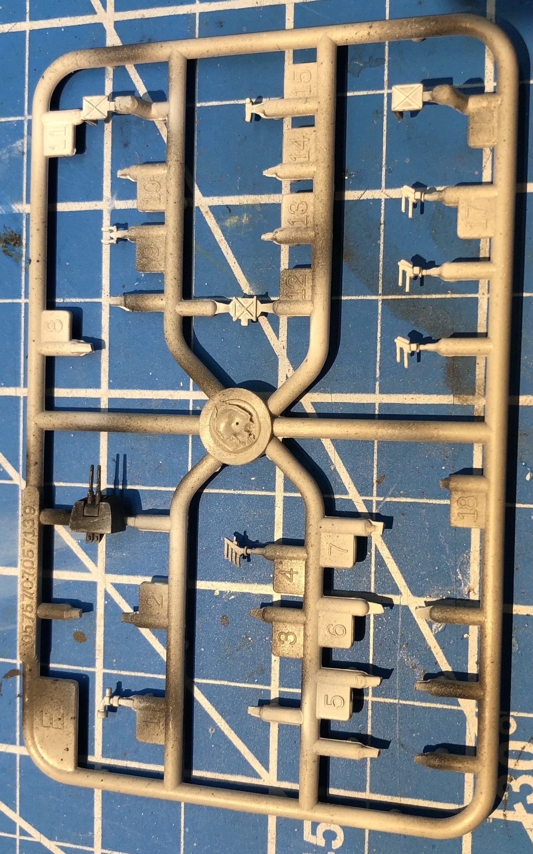

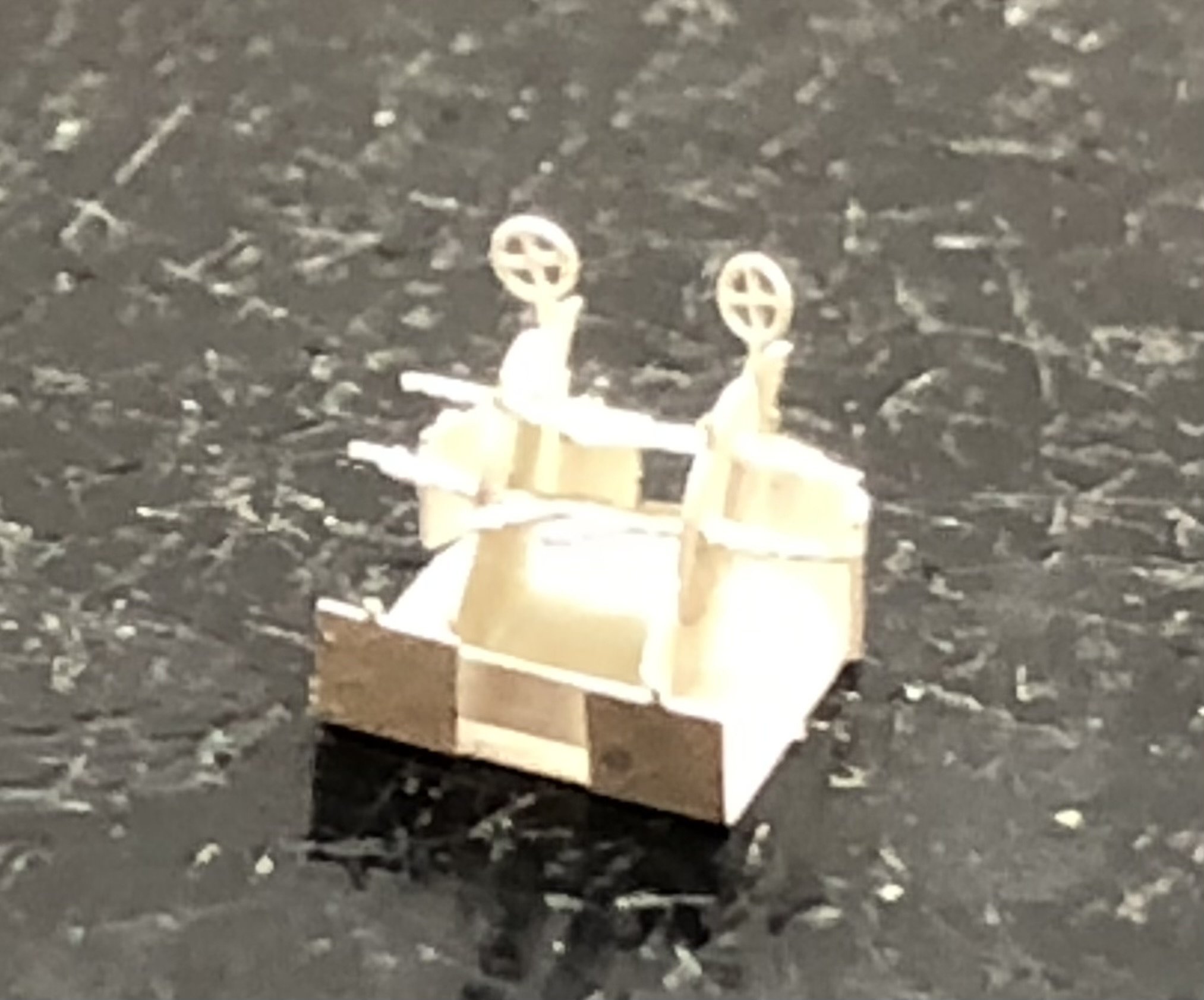

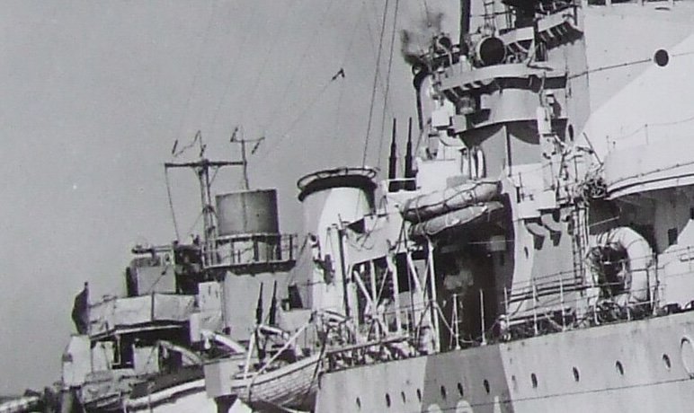

Ive made some progress in the last few days but it’s slow going. Next source of confusion was the number of Carley rafts on board. The kit says six but and inspection of the 1942 photo shows twelve. Luckily I found some spare Flyhawk rafts of about the right size and the WE PE has the support structures for all locations. Fairly easy but then I moved onto the secondary guns. I spent an indecent amount of time on Sunday making the quad Pom Pom and the quad 20mm guns which were a real eye stretching exercise. Compared to the kit parts I think they are better even if flatter.
IMG_2209.thumb.jpeg.9c531c31e6b9a4b96395b8ca6e57756a.jpegIMG_2210.thumb.jpeg.6af494717199428dc545339bc7303f2a.jpeg
However according to my research Huron had no quad 20 mm guns but just six singles which the kit doesn’t acknowledge.  I may have some Flyhawk singles that are not too bad but then I’m looking at the 1942 photo which seems to show a number of twin Oerlikons.
Maybe the twins were fitted before 1942. Squadron have Black Cat twin mount 20 mm so maybe I’ll go shopping after searching the spares box.
So in amongst all this prevarication I got a bit done, some railings, life raft supports, and fitted a few more bits of the structure.
IMG_2215.thumb.jpeg.217ac5c4c6f50bca6739588c75da8c29.jpegIMG_2218.thumb.jpeg.ed80ab32aafdf758ac07fa390f578275.jpeg
Thanks for looking in, the likes and comments.
Alan

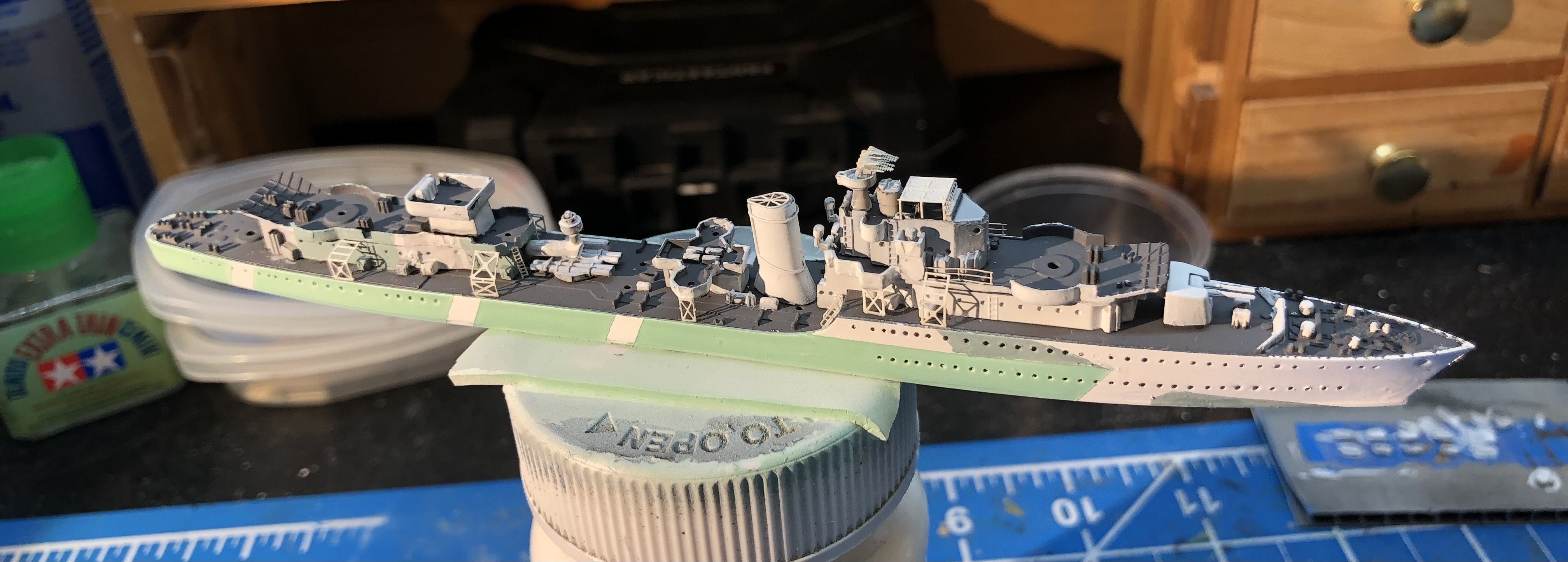

I sorted through my spares box and found some 1/700 twin Oerlikons with shield and some Flyhawk single 20 mm without. After cutting the stand off the singles and adding them to the shield they looked quite good. So my eventual solution to the 20mm gear was to put two twins in the waist gun deck and the lower positions on the bridge superstructure. I added two singles to the bridge wings. When I was researching the Flower corvettes I read that individual captains would take advantage of any spare armament to enhance their defenses. So this configuration echoes the photo and is close to the initial specification.
Similarly the Carley rafts were often configured by individual captains. I’ve followed the photo again with three raft racks on each side, two carrying a pair of rafts.
Other small details have been added, a depth charge rail at the stern and the second funnel
IMG_2220.thumb.jpeg.aeefef0714c2bac9332cbee824b55c39.jpegIMG_2221.thumb.jpeg.f4dd795968ec4480b5bf0a6d76b19fdc.jpegIMG_2222.thumb.jpeg.7c76a5d3871c2f1082c814c8a9cc5c97.jpegIMG_2223.thumb.jpeg.21c2063a41e0da1554973b7ac54169c2.jpegIMG_2224.thumb.jpeg.ed2258d820660e3c7ddbe2a40c5f4d44.jpeg

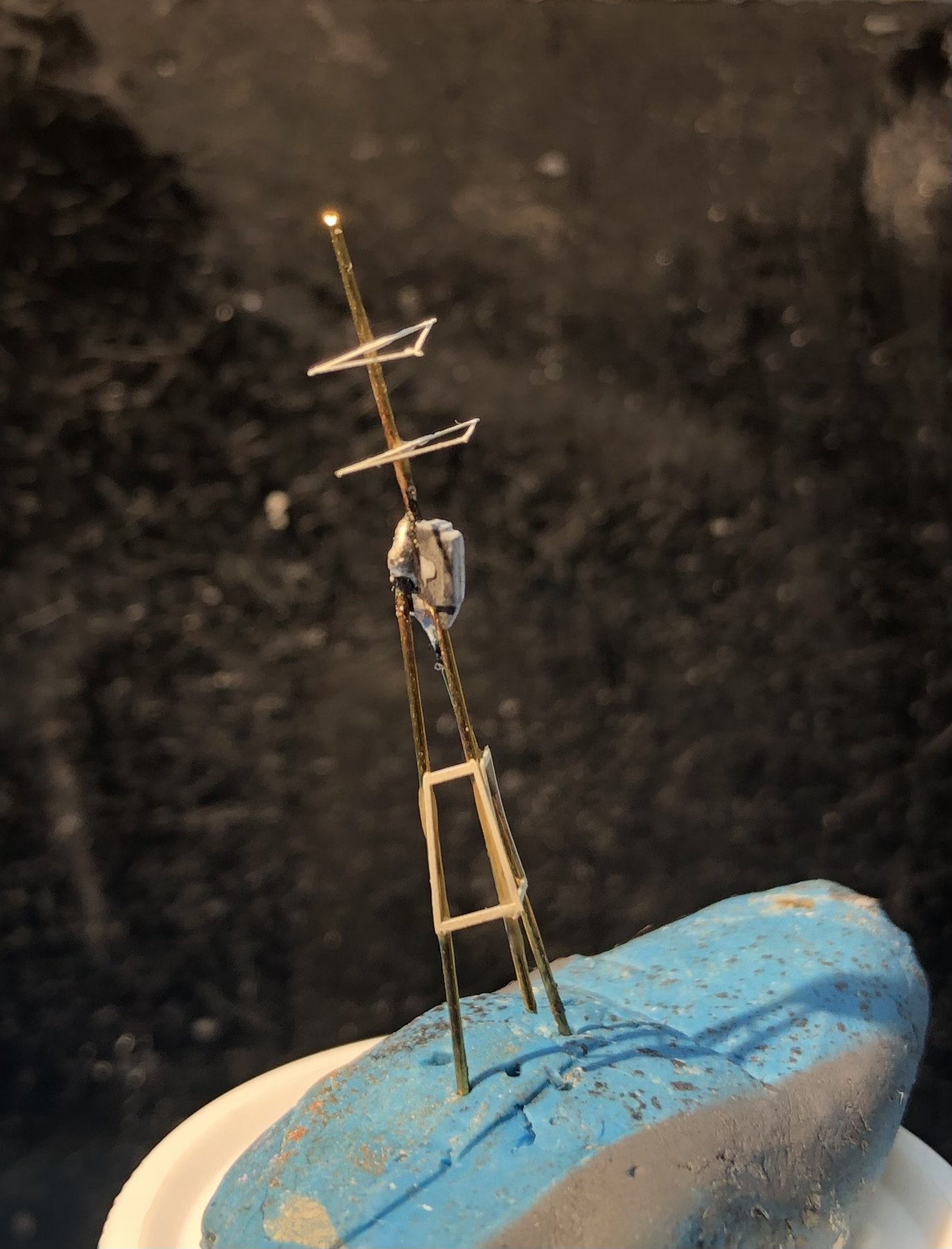

I didn’t like the kit foremast, it’s a bit bent and it’s wrong too so I made up a tripod mast from brass rod and added the PE yardarms. So far so good.
I think the mainmast is worse so that will be something to tackle tomorrow along with the ships boats. Trumpeter has the stowage wrong, the boats were swung from davits, not stored on chocks. That might be awkward to change but I will try and see how it goes.

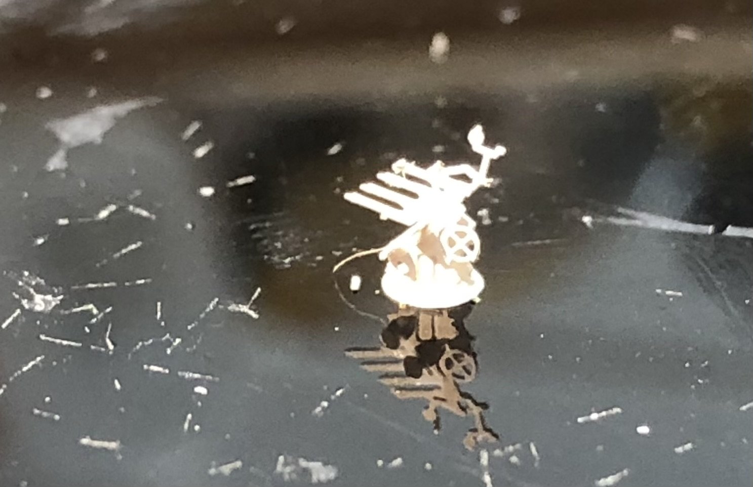

Nice stuff Alan but 1/700 :huh: is beyond me ship those pompoms to Mike he can do anything!!:D

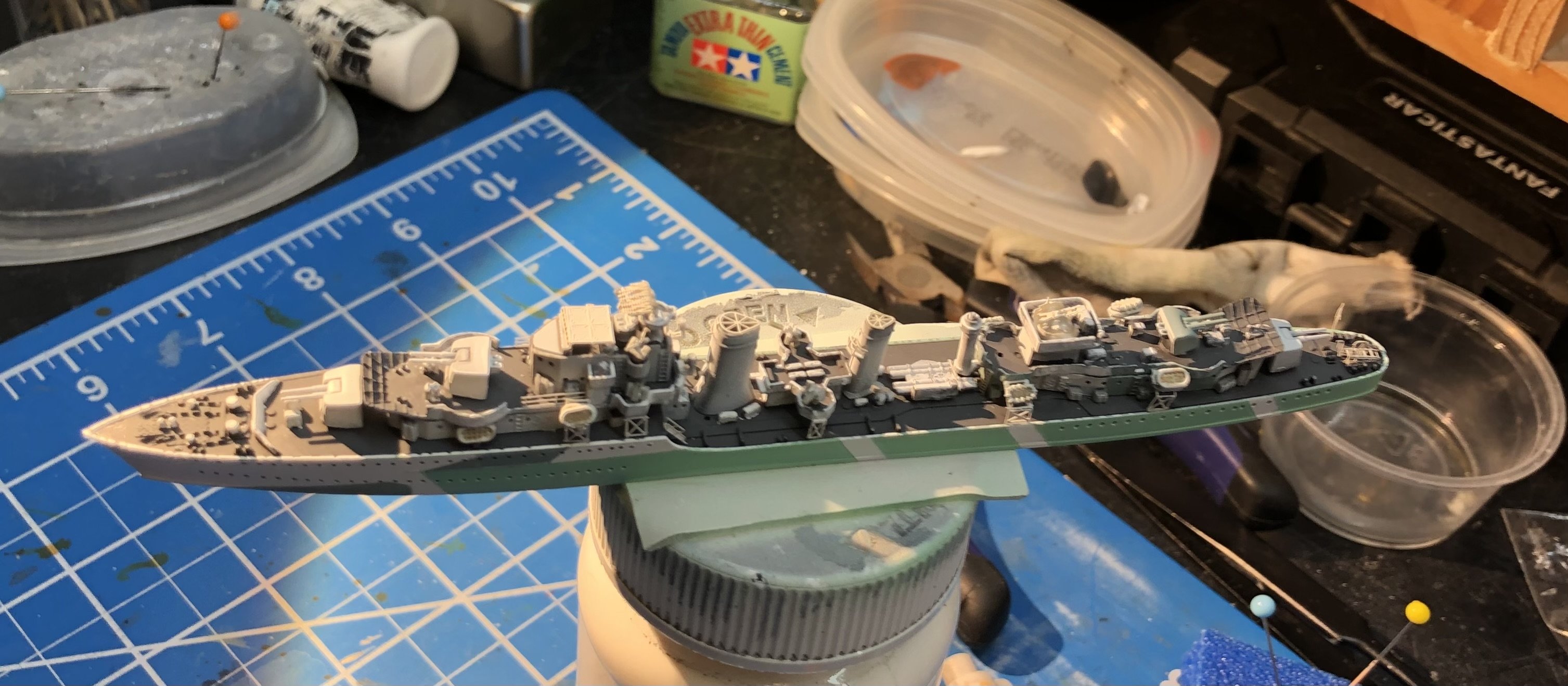

I’ve been adding little bits around the ship. I decided that putting the ships boats on davits has to be done now that I know that’s how they were really stowed. I think it’s going to make installing the deck railings tricky.
Curiously, in spite of the ships having four boats WE only gives you three sets of davits.
A root through the spare PE box has come up with some similar ones.
The brass masts have been added and the forecastle railings are almost done.
 last significant items will be the main deck railings and the mast head radar HF/DF
Some weathering and touch up. I’m not going to try to rig the masts, at 1/700 it’s beyond my eyesight.
