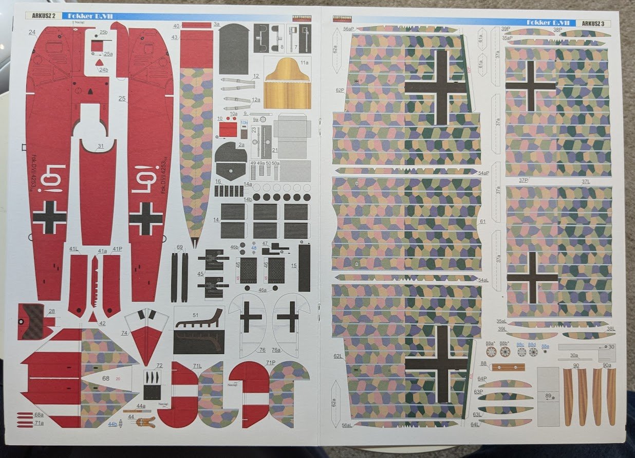

Some of the parts pages. Pawel's skills as a graphic artist have improved quite a bit since 2007.

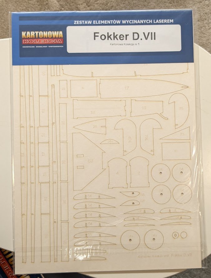

And the frames set.
No rigging to speak of on this one, and no canopy either, so I don't anticipate it will take terribly long. Look for first cuts soon!

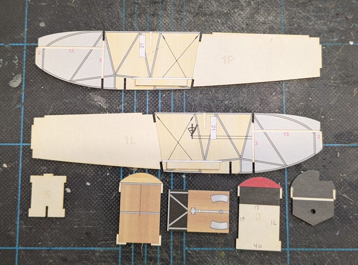

First cuts on this kit consists of a lot of prepping of structural elements. If you've followed any of my other KK builds, you may recall that the fit between panels tends to be overly snug. To alleviate this, I remove all of the locator marks on these elements, and sometimes a bit of the underlying pulp board as well.
The cockpit elements are a bit rudimentary. Once those are added, the fuselage panels will go together very quickly.

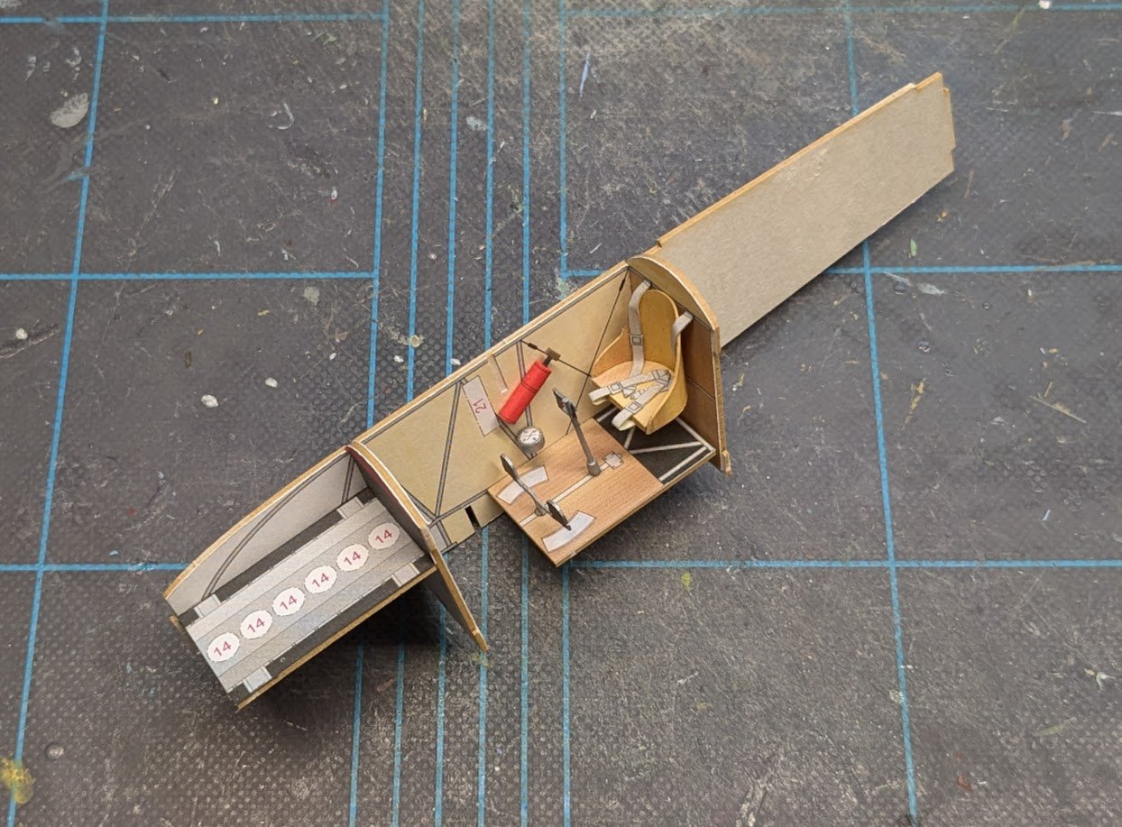

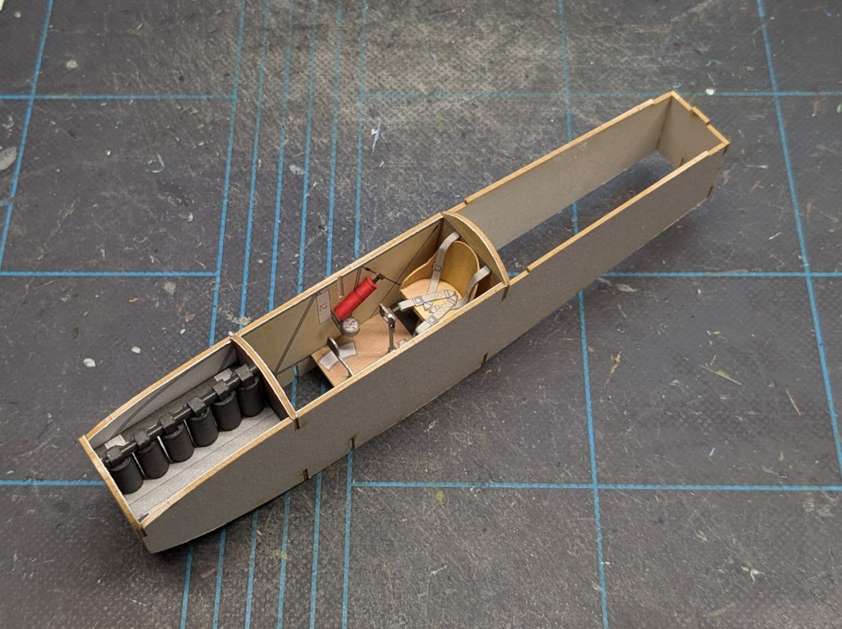

Fuselage assembly continues. First we have the traditional "take a good like now while you still can" photo before the cockpit gets zipped up. The control stick and rudder pedals are supplied as 2D parts. The pedals will be the less visible of the two on the finished model, so I left them alone, but I felt compelled to replace the stick with a scratch-built replacement made from styrene rod.

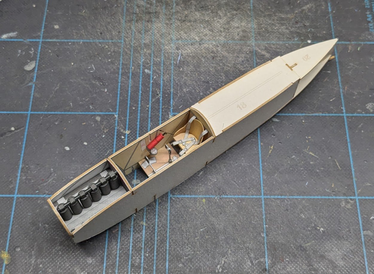

Fuselage sides added, along with the rudimentary engine cylinders.

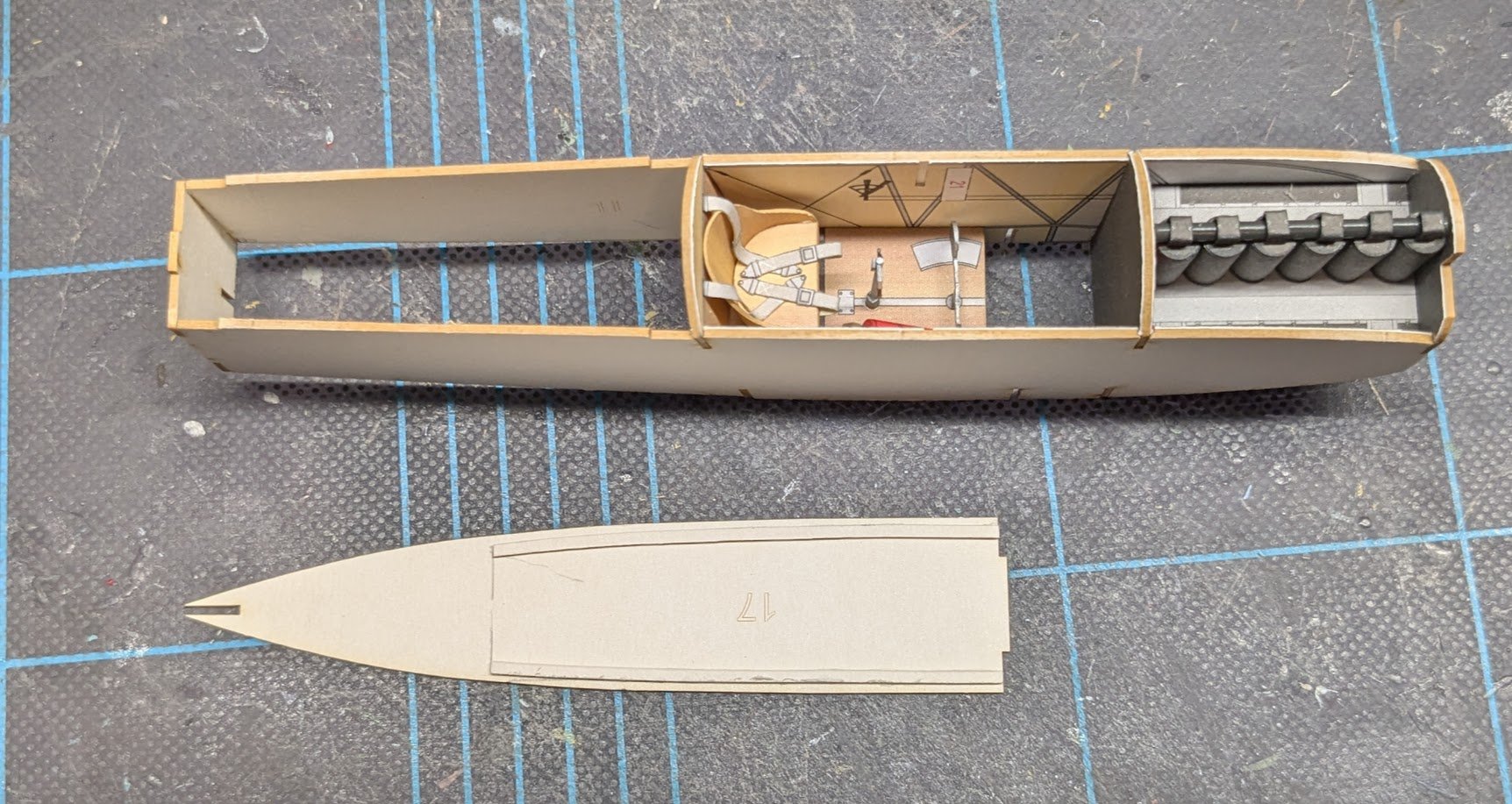

The fuselage bottom is rounded and makes no provision for proper fitting to the straight fuselage sides. I added locator strips made from scrap card.

Great job!! I remember doing this also. One of my favorite designers

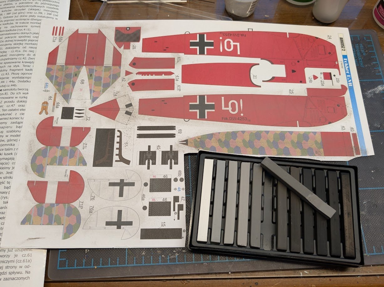

After adding a few last cockpit bits (fuel tank, instruments), work commenced on prepping the fuselage skins. The kit has no weathering, so the colors look a bit bright for the Western Front c. summer of 1918, so I decided to try grunging them up with some weathering chalk -- just enough to take the 'freshly minted' look off of them. This entire sheet as had chalk applied, except for the topmost fuselage skin, just so you can see the before-and-after.

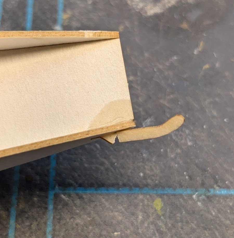

The tail skid is part of one of the aft fuselage frames. It's a part that just dangles out in space and begs to be broken off repeatedly, so I soaked it in thin CA to stiffen it. It made no difference. 😑
I'll let you imagine which "special word" involuntarily escaped my lips when this happened. It was either:

That looks quite sturdy  with that thickness  of card.

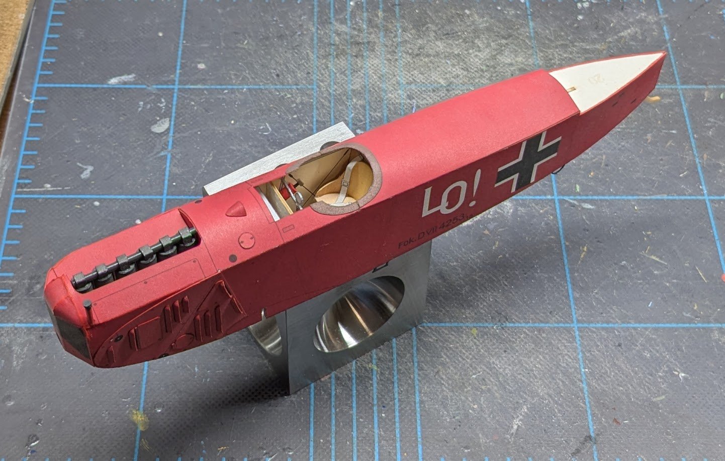

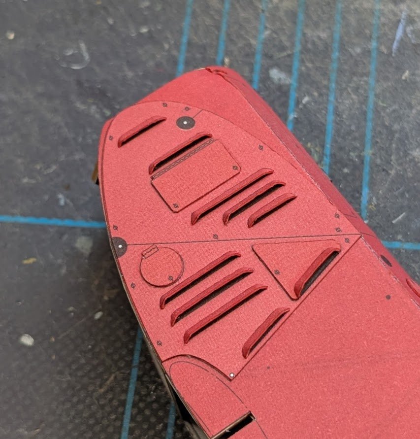

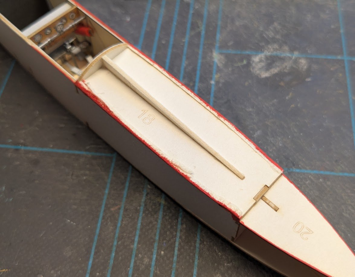

Skinning the Fuselage
The top deck of the fuselage behind the cockpit is a separate skin. To better position it, I added some joiner strips along the edges of the fuselage framing.

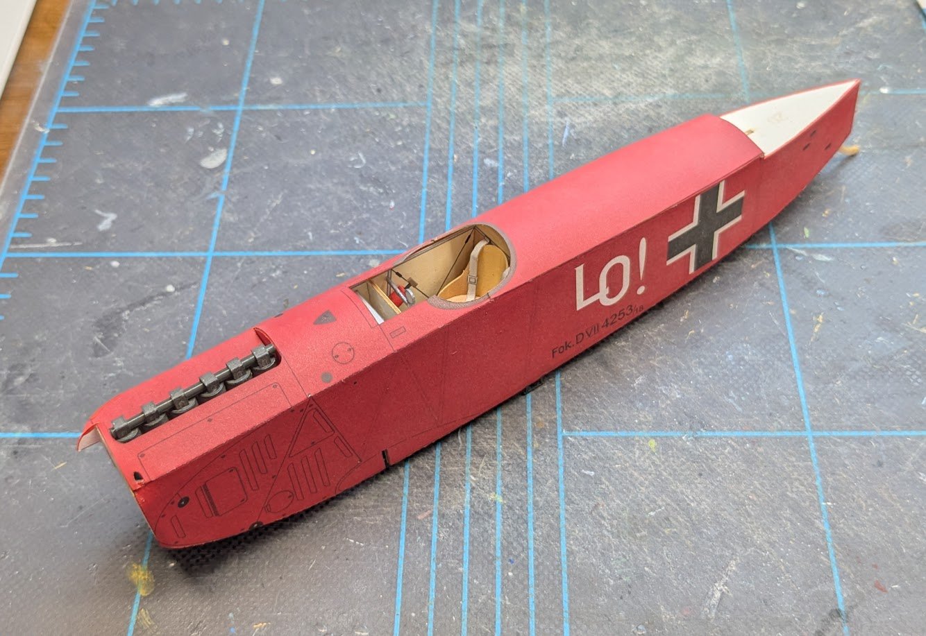

The sides and top went on without too much difficulty.
There are alternate parts for doubling the engine compartment sides -- those will be next, along with the louvered vents.

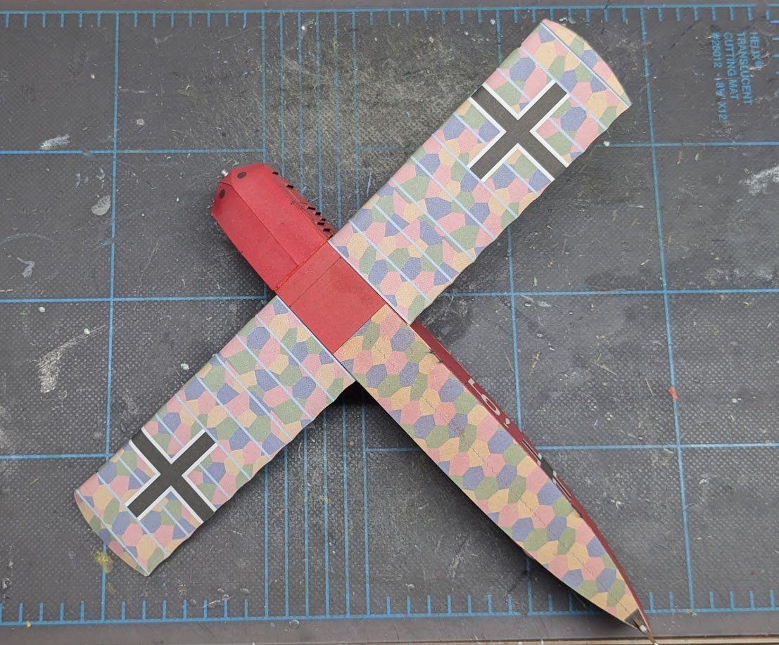

Wow, I got an entire wing built today!
Of course, there's a whole 'nother wing to build, so let's not get too excited.
BTW, the wing framing for this kit is significantly less rugged than in Pawel's later designs.

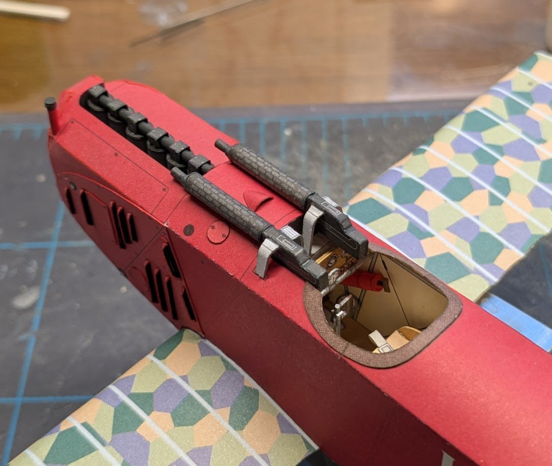

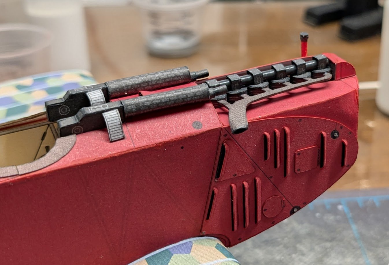

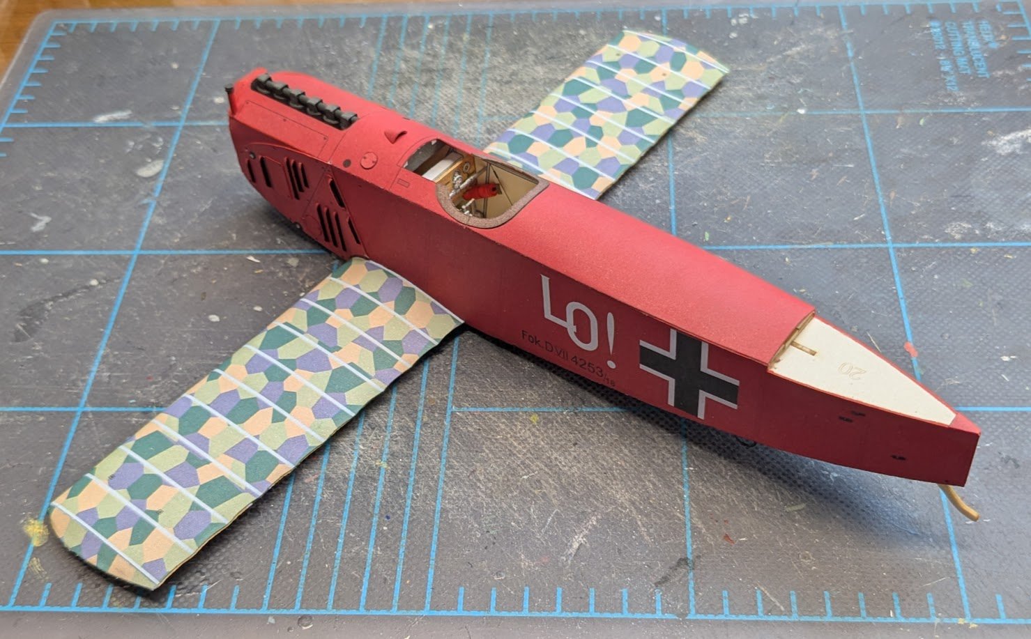

The Fokker is armed! I left off the gun sights for now -- they are delicate, so they'll be added toward the end.
I also added the exhaust pipe. The stock part is a flat piece, but with some careful shaping I managed to add some flare to the end of it.

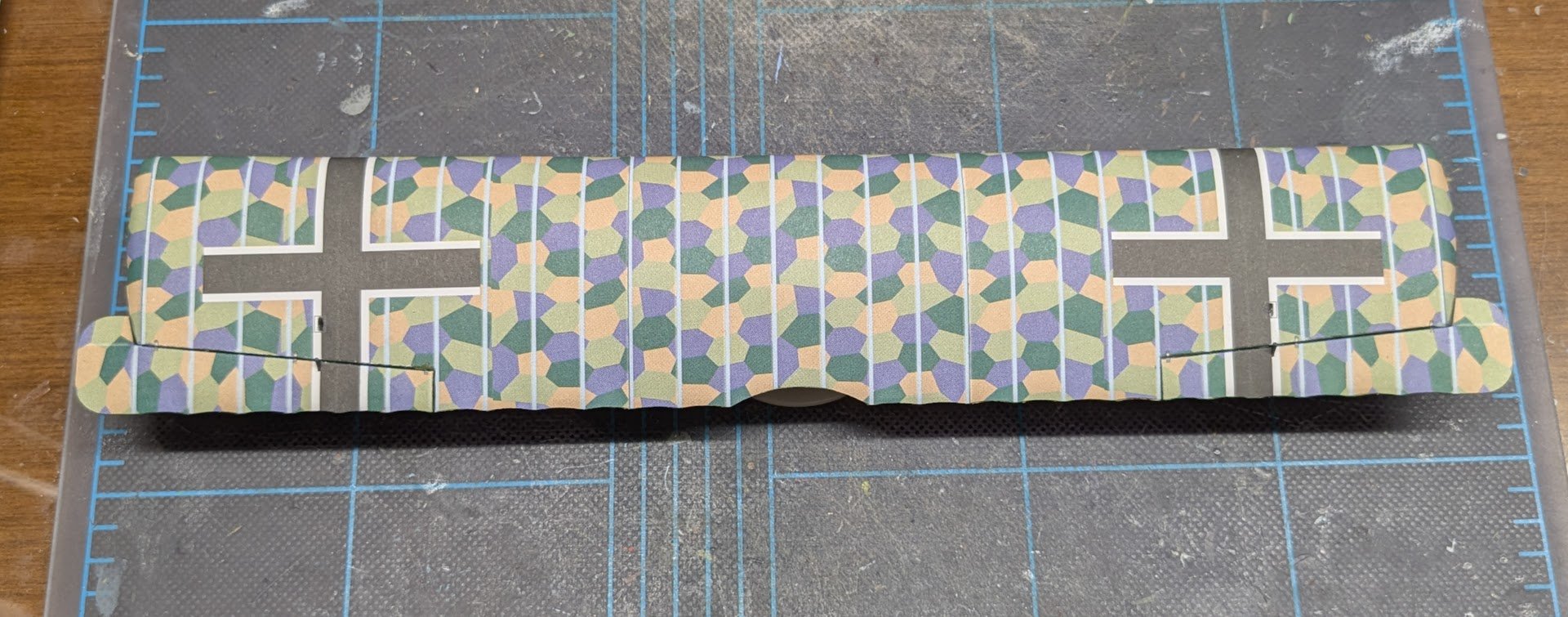

The top wing took several days. You won't believe what happened! I was cutting out the skins one evening when suddenly . . .
. . . I got bored. 😮

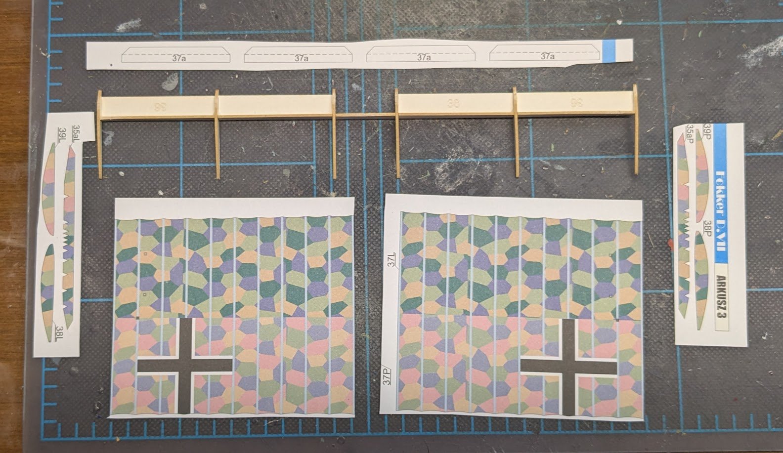

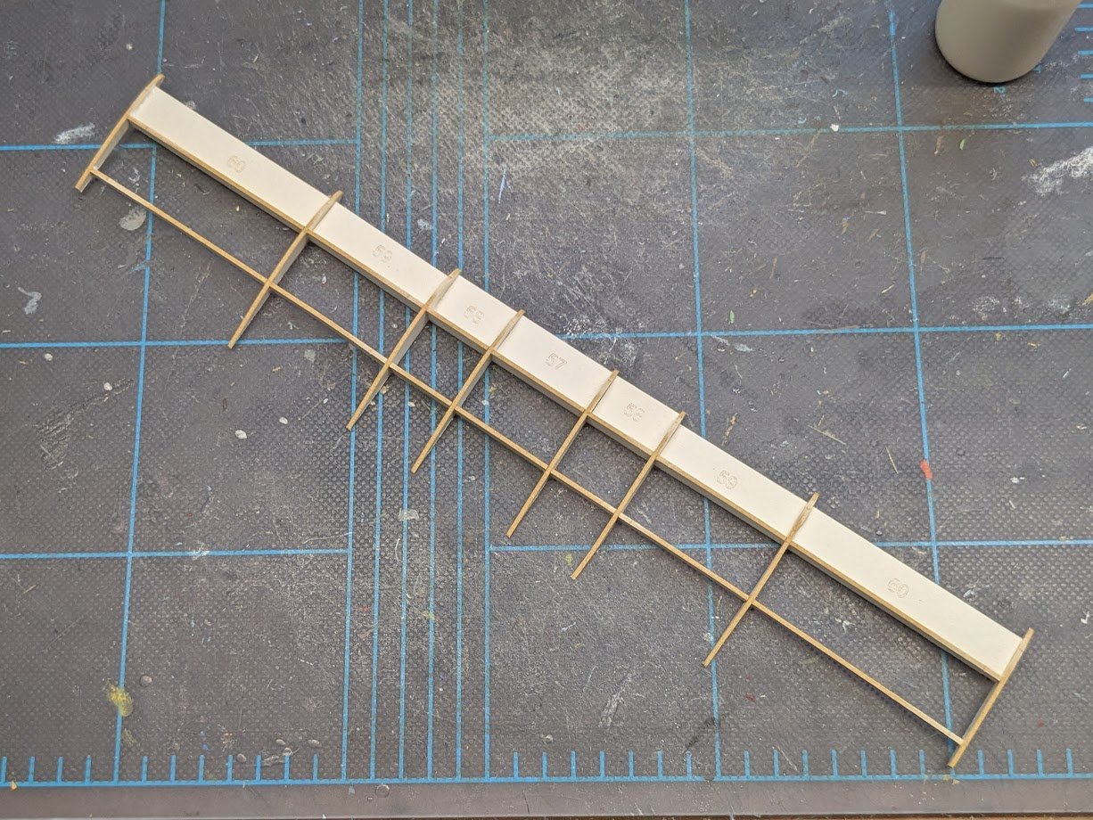

Yeah, weird, right? So that was it for that particular night, but the task is finished now. First a shot of the framing:
This is pretty substandard framing by Kartonowa Kolekcja standards, so I added a strip of scrap card atop the two spars to stiffen everything properly. The main skins were not difficult, and lozenge camouflage does a fantastic job of um, well -- camouflaging any tiny mistakes. The biggest issue was with the wingtip pieces -- these ended up being too small to pinch together neatly. I tried filling the gaps with pieces cut from the kit's spare color swatch, but I didn't like the look of the repair, so instead, I filled the gaps with layers of glue and later painted them with AK colors. You can't really see anything in this shot, but I think the repairs turned out okay.

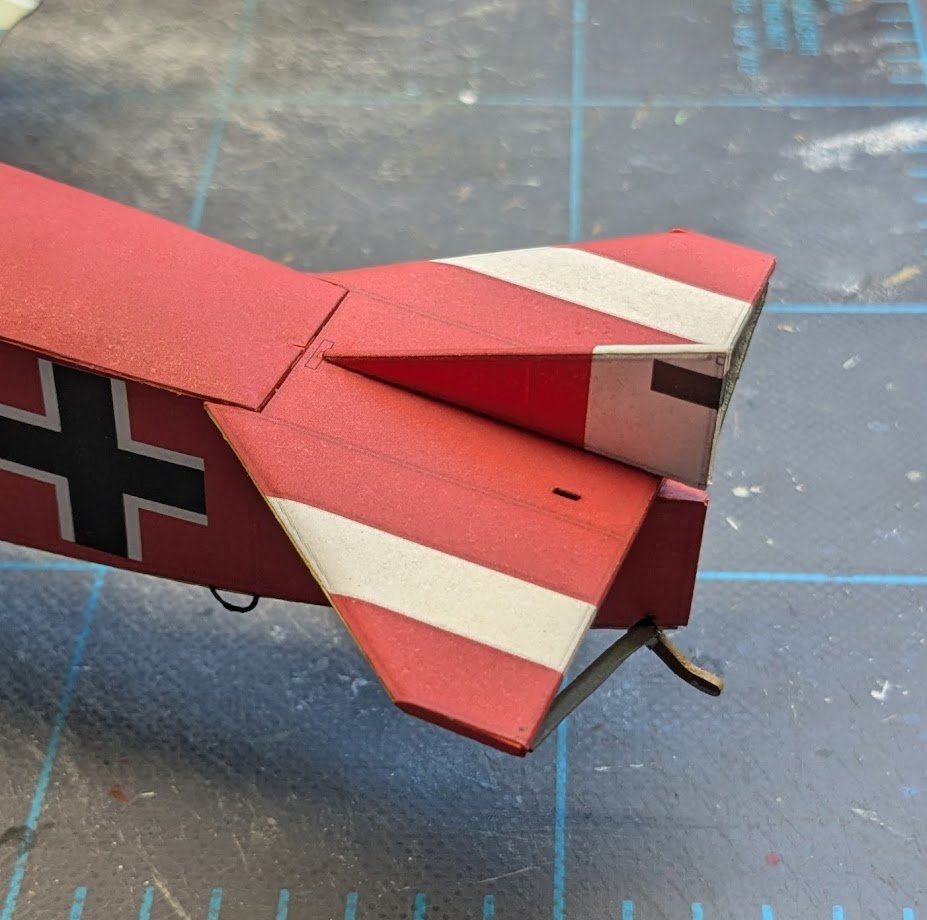

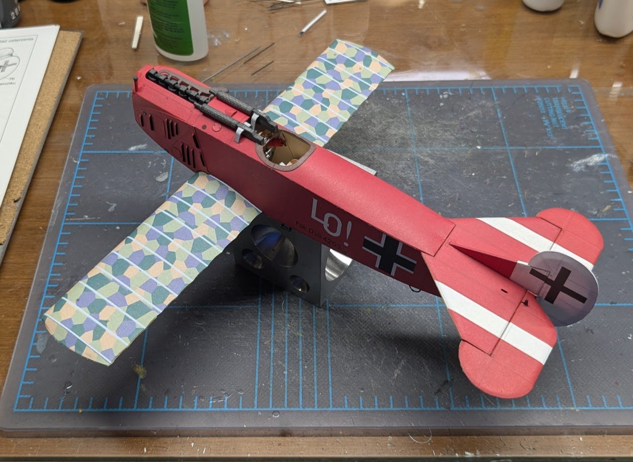

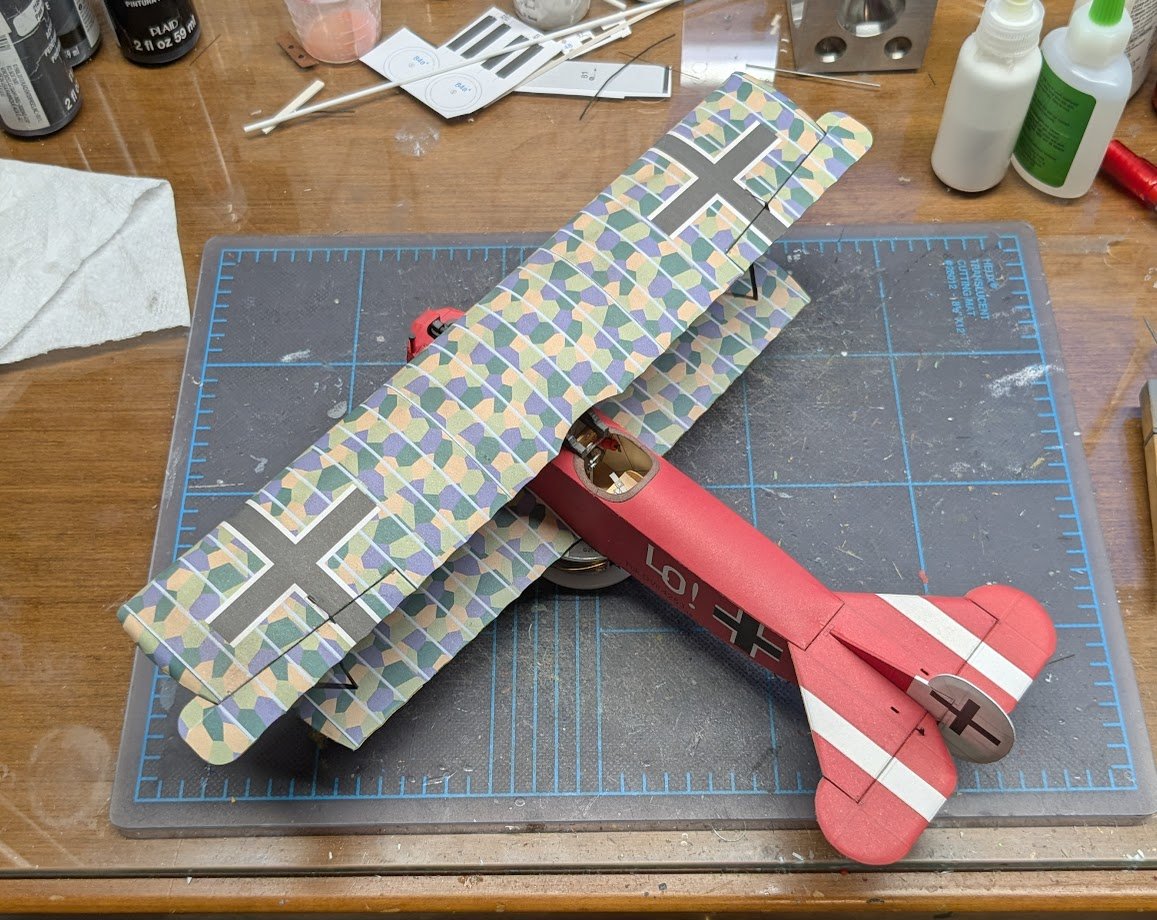

Things are moving right along now. The vertical and horizontal stabilizers have been added, along with the struts for the latter.

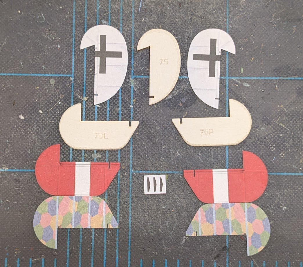

All of the parts for the rudder and elevators have been cut out and prepped.
