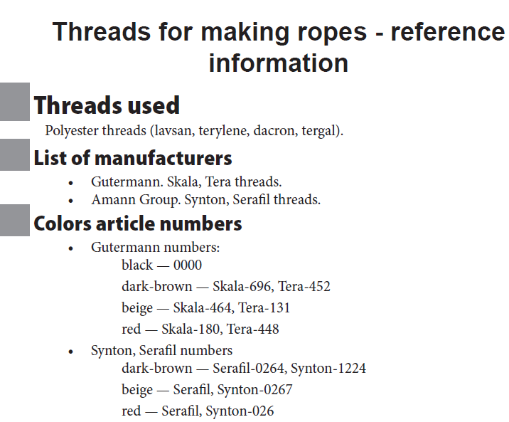

Mara thread - what colors do you use for fabricating ropes
Go to solution Solved by Y.T.,
Newby question...!!
I'm looking forward to having a go at making scale ropes with my incoming rope walk....
I had a look at the available colors for Mara thread - I thought there may be a few similar but different hues but the range is expansive!
What colors (numbers) do you use for standing and running rigging?
Thanks!
Dale

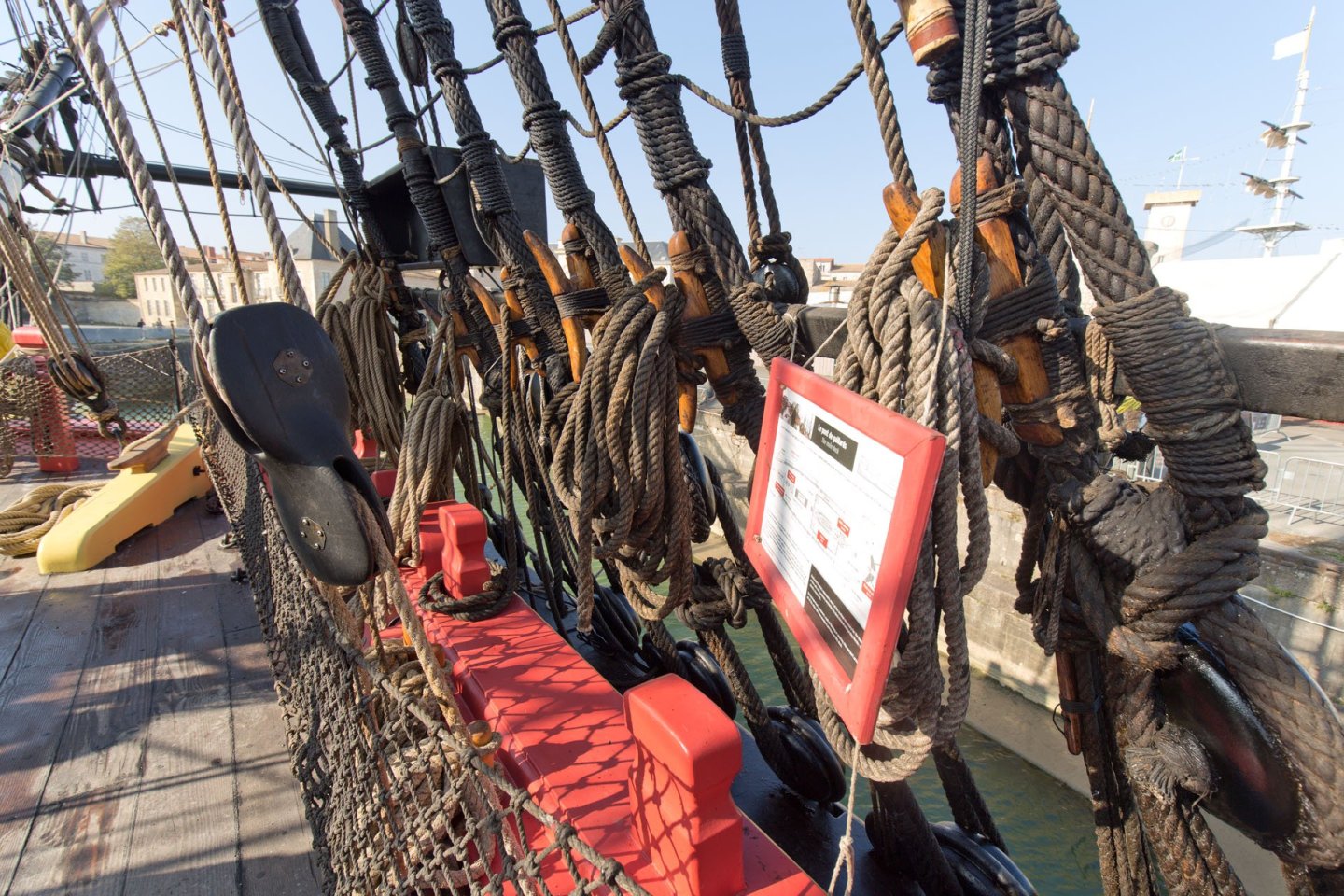

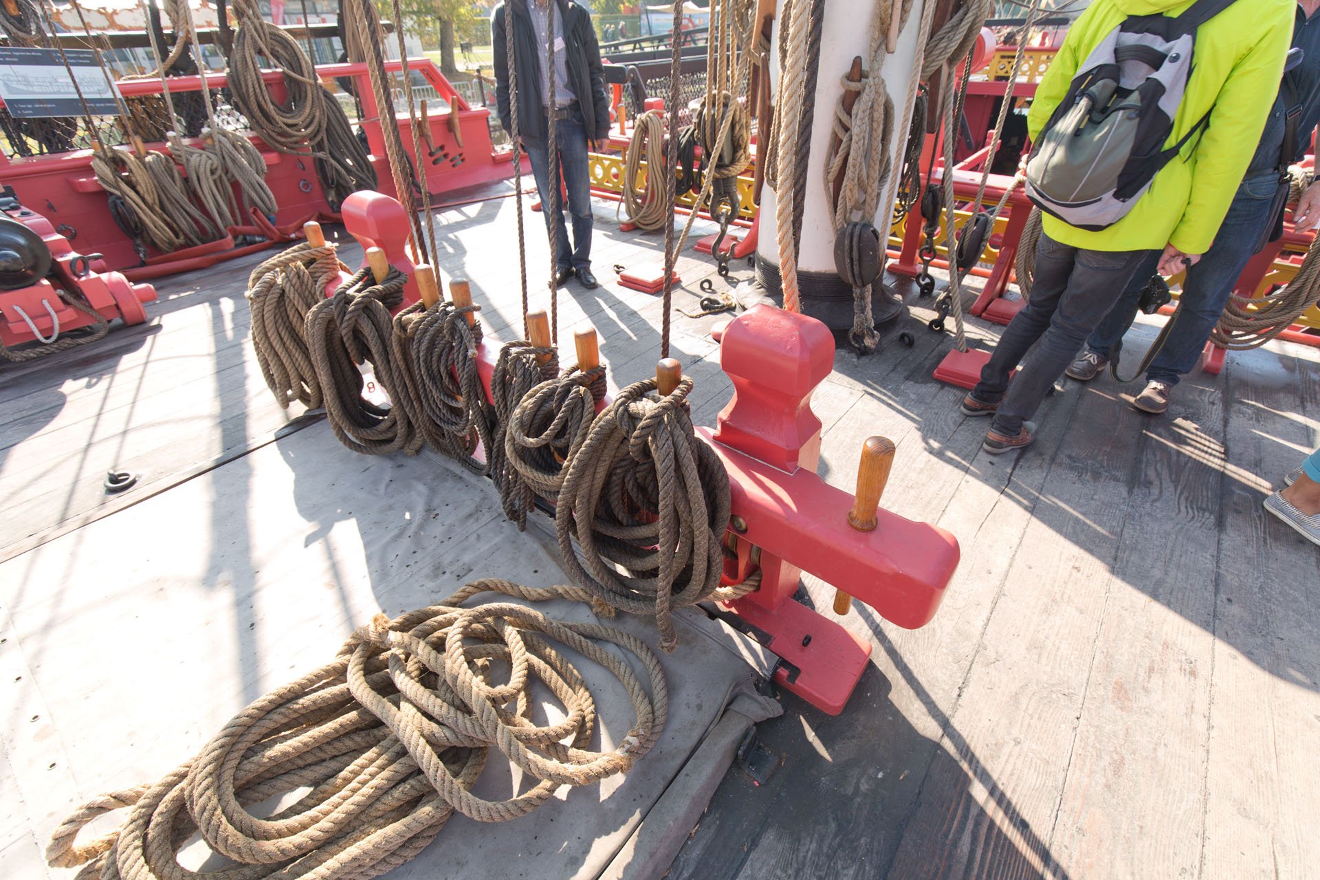

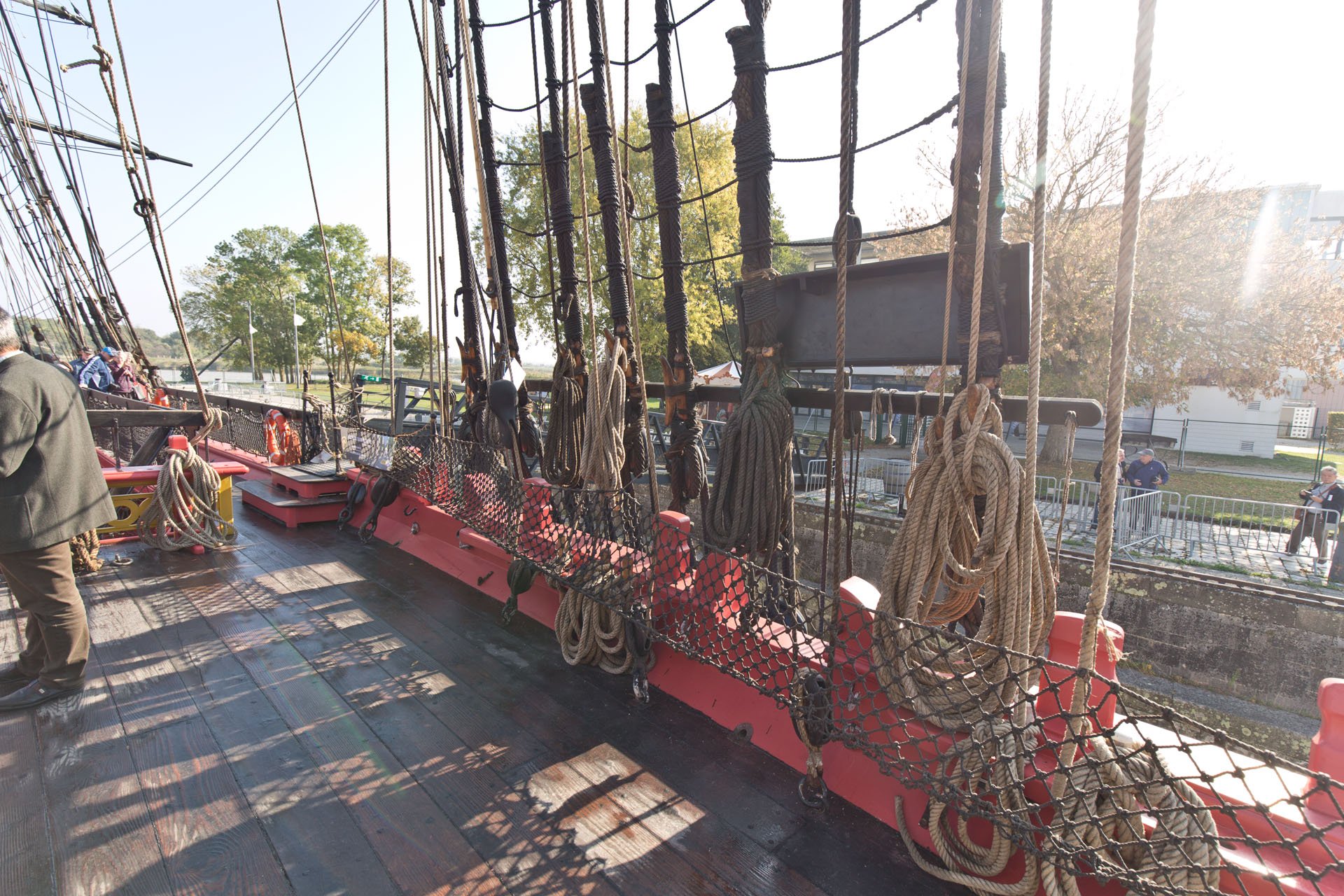

My 27 cents as for the color, as seen at Hermione:
50-thousend shades of brownish grey 🙂
No one is alike the other and even the shrouds are not completely black 😉
XXXDAn

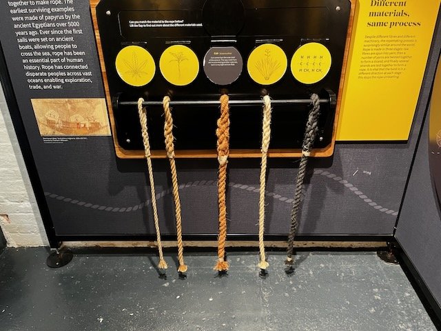

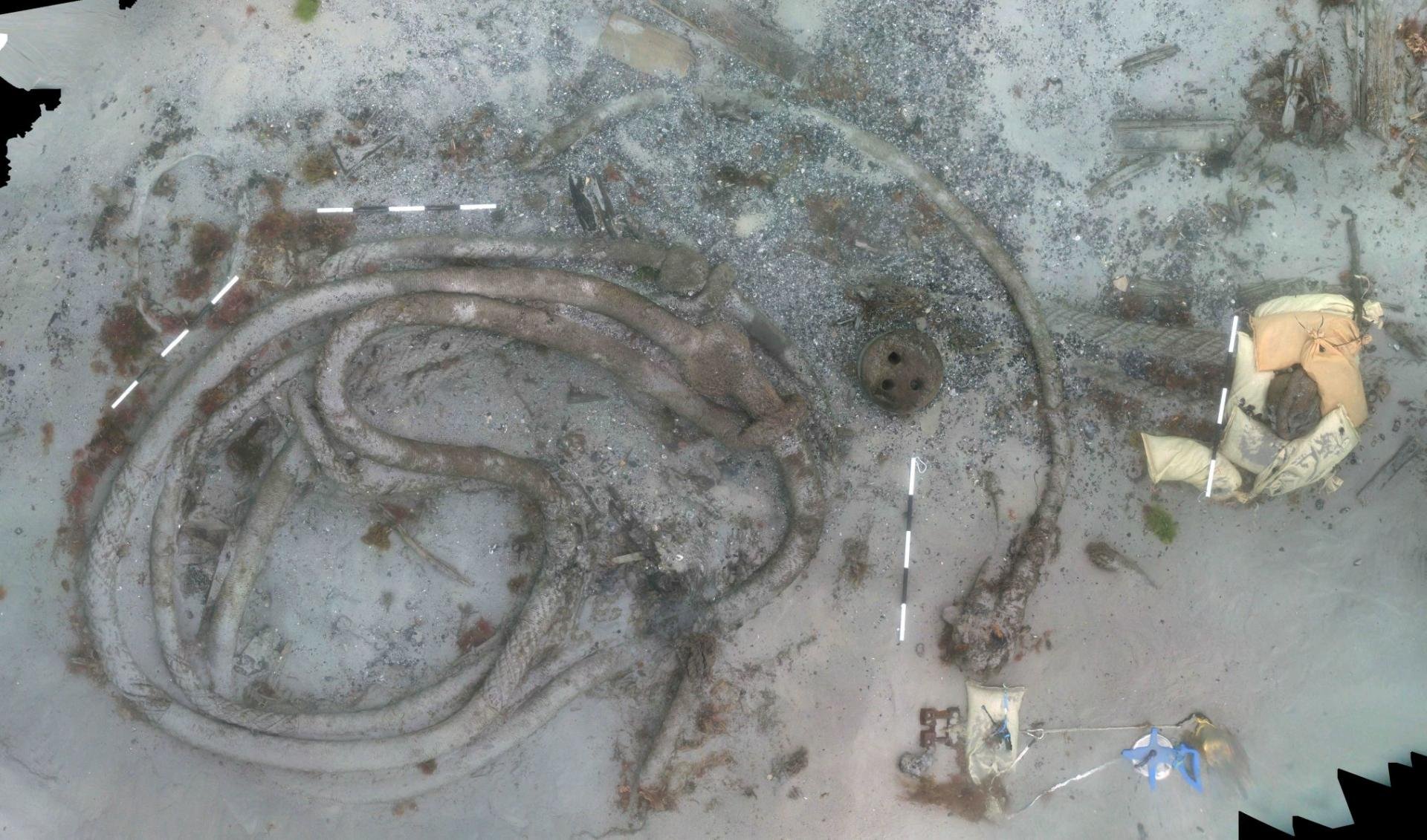

Below are a couple pictures of rope displays I have been lucky enough to come across.  The first is from the ropery at Chatham dockyard.  The second is from Mystic Seaport.  They show that even in new rope there is a pretty wide variety of colors that would change over time.  The ropes in the Chatham display are from left to right hemp, Manilla, coir, sisal, and synthetic.  The ropes from Mystic are labelled.  Some of the hemp ropes from Mystic are tarred as well.
If you are interested in rope making I would recommend doing a google search for the ropery at Chatham Historic Dockyard.  It is super interesting and there are lots of pictures of the process.  They continue to make and sell rope in the same facility used to make ropes for the Royal Navy in the age of sail.

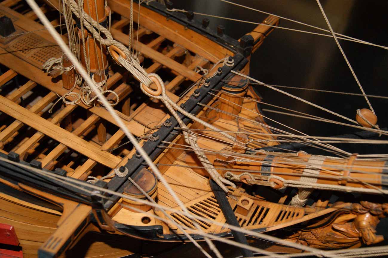

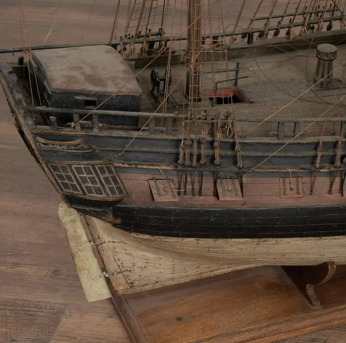

In French Navy Board ship models I've noted that approach as well Chuck. I actually like the way it looks. According to M. Delacroix, the noted French naval scholar:
"In the French Navy, all ropes are tarred, whether standing or running. This color is reddish-brown. The color then changes with use:
- The color of the standing rigging dont change and even tends to darken with the successive layers of tar it periodically receives, turning a dark brown close to black.
- The color of the running rigging does exactly the opposite; the ropes lighten as they pass through the blocks, as they rub against other elements in the mast, and of course at the mooring points. The color of these ropes then becomes slightly lighter, towards a light brown.
The vast majority of models in French museums were re-rigged by people with limited knowledge. It is therefore not surprising to find beige ropes in museums."

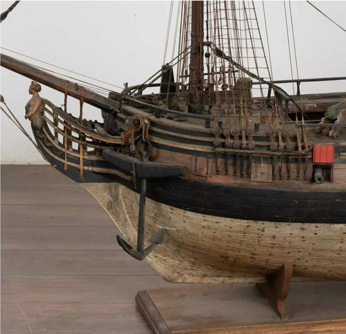

I agree with you...its just a model convention.   I like the way it look as well.  I do also like the look using historically correct colors too.   But again, its just an artists approach.  I do however think Henry Culvers knew what he was doing.  This seemed to be a very popular rigging style in the heyday of ship modeling from 1880 to 1930ish.
Check out the fine auctions currently being held.   A French model of Sirene made in France in 1880...It actually looks much older.  A steal at $14K.  Minor restoration and cleaning needed, LOL.  My wife would kill me.  Why in Gods name would someone ruin this patina by painting the port lids such a fresh bright red!!!!!  That makes me hurt a little inside.
https://www.chairish.com/product/21201899/large-ship-model-of-la-sirene-with-cannons-and-mermaid-masthead-france-circa-1880

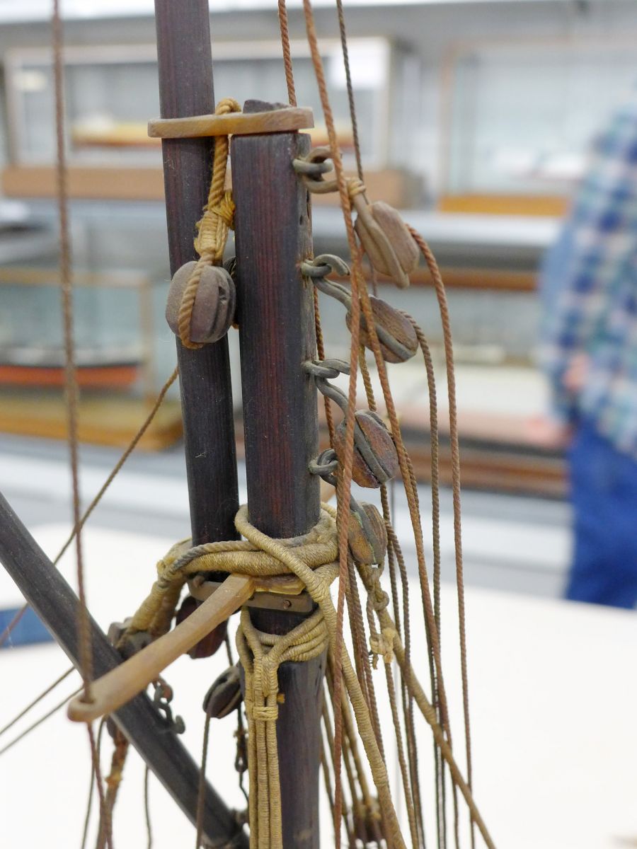

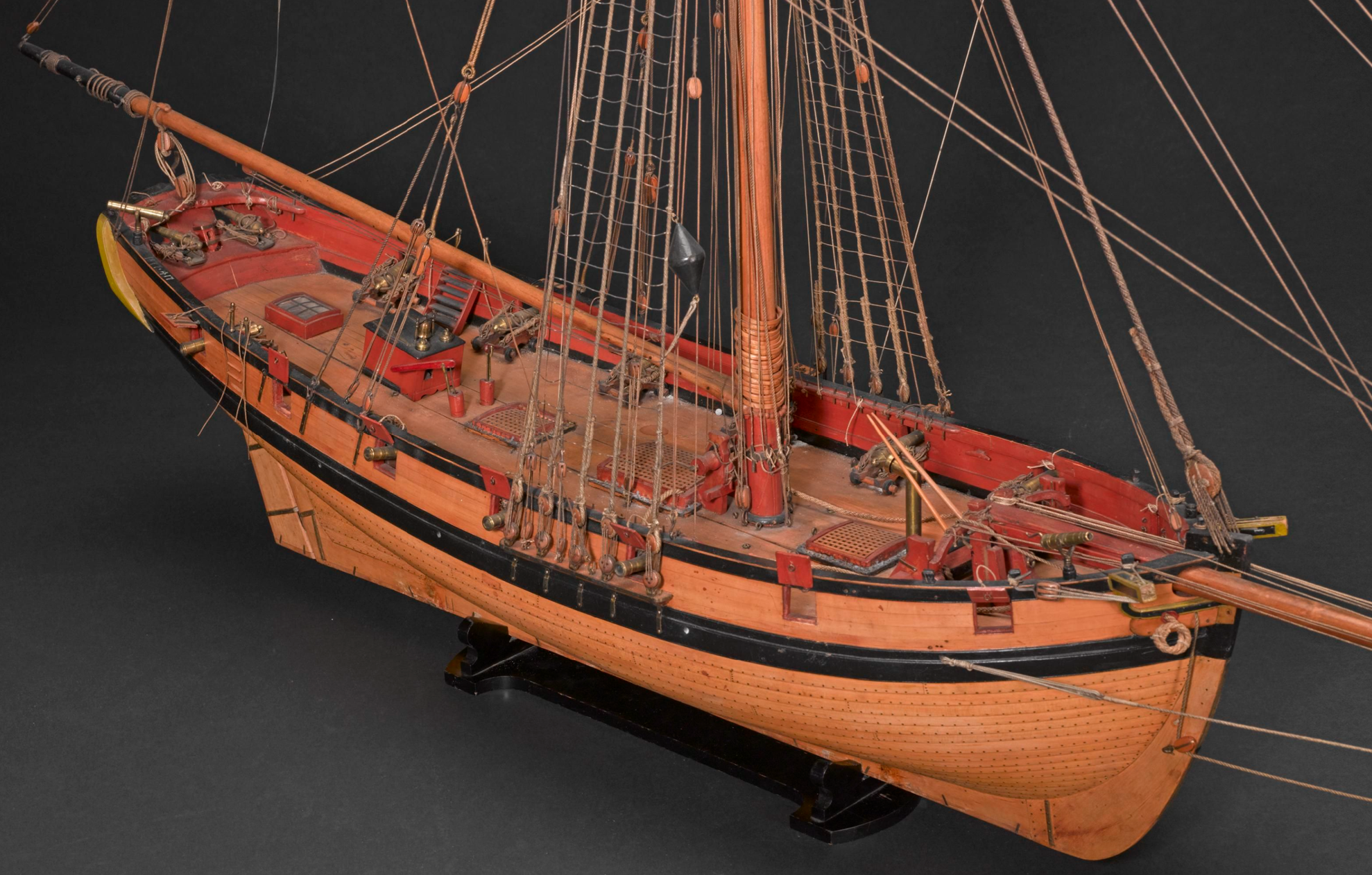

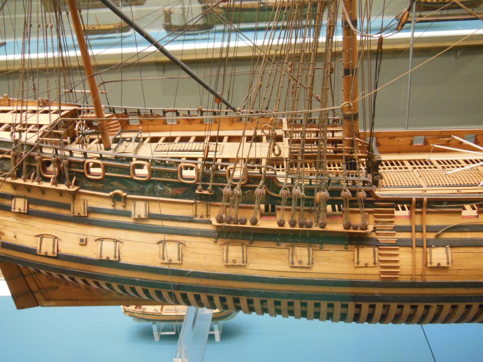

Just to add a bit more to what Chuck is saying.
Here is a model from the Science Museum.  It is the model referenced in Petersson's Rigging Fore & Aft craft.
I think the lighter rope throughout would be an interesting departure from most of what we see now.

Just to support Chuck´s and Greg´s observation: When I started to hit the french forums, I was surprised them not doing the "usual" diffentiation in color inbeteen the standing and running rigging. Even more they were surprised that we or better I did.
Eversince I orientate myself more on the style I saw on Hermione: different colors due to different level of tarring and also different bleaching by sun and salt.

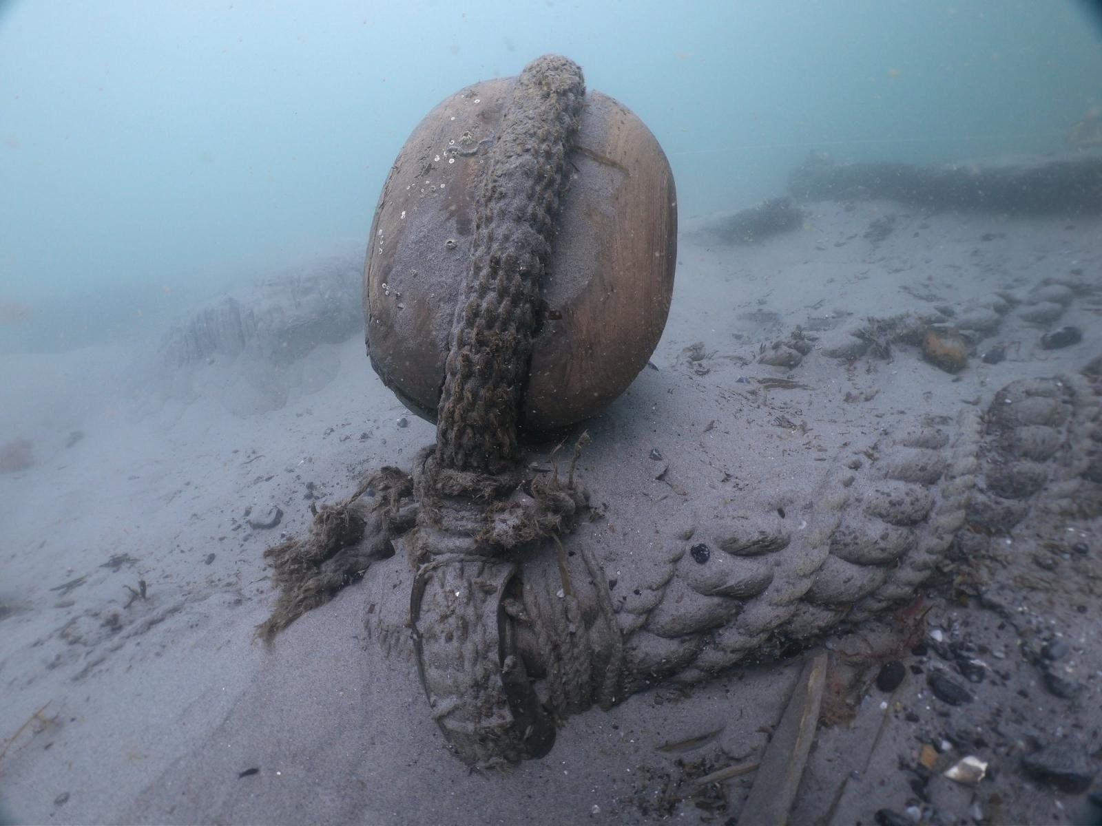

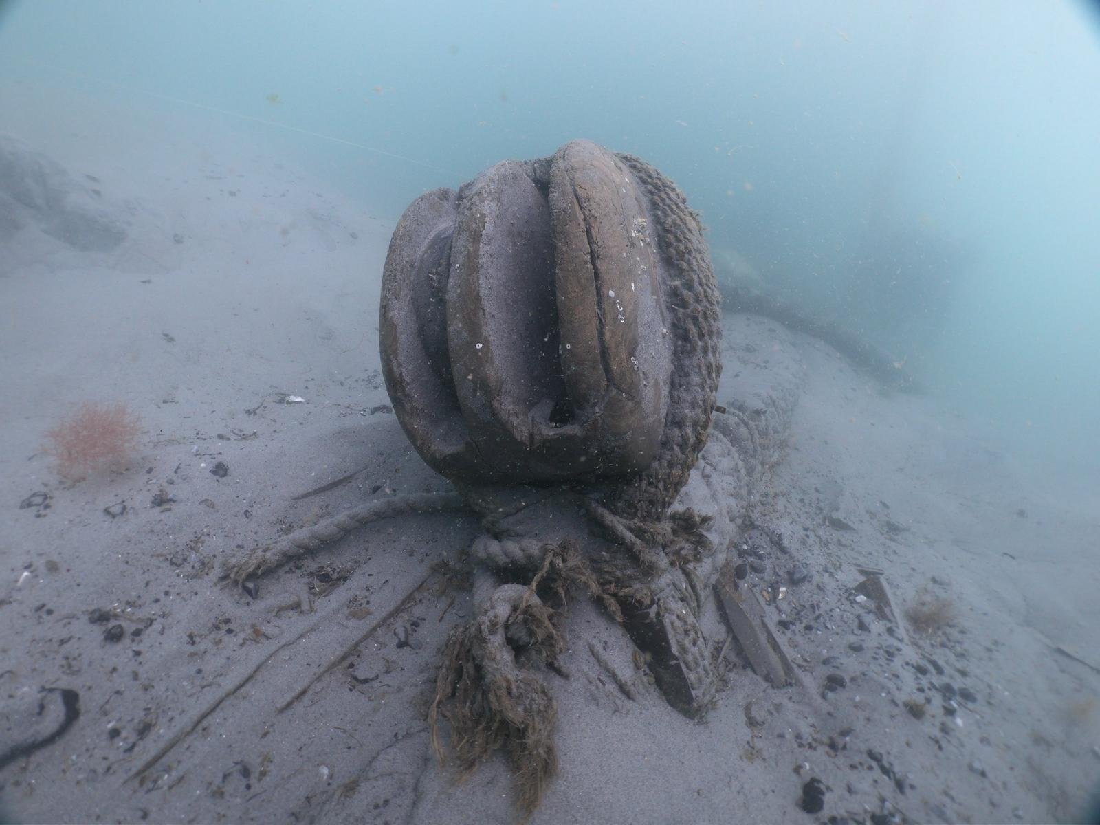

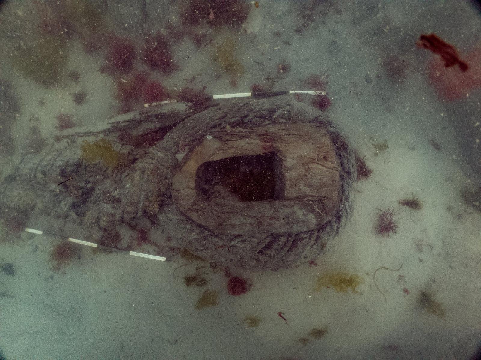

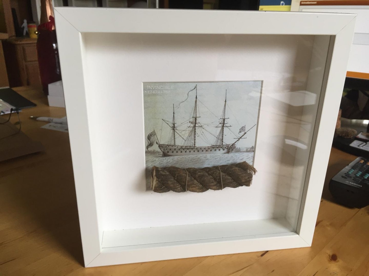

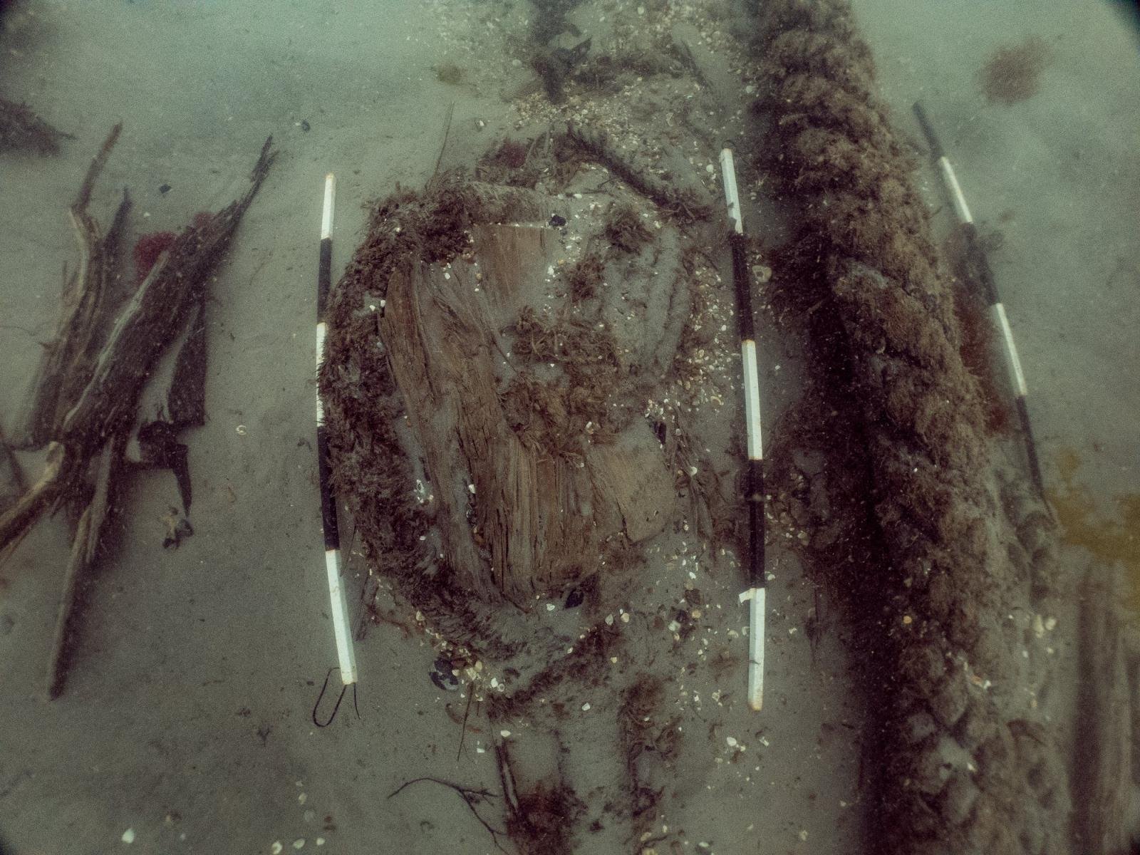

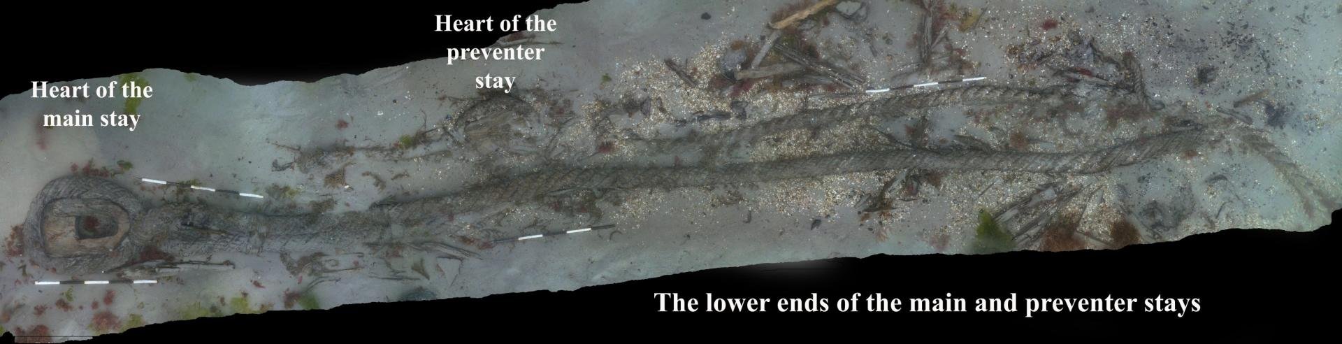

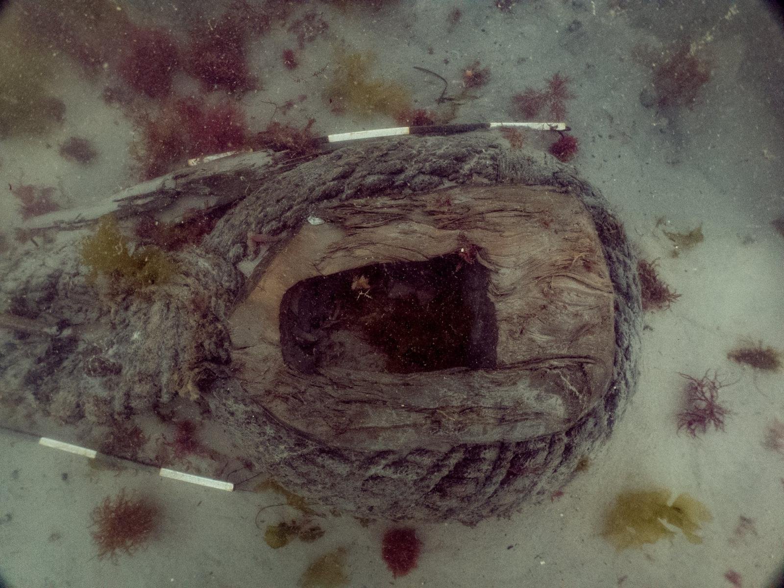

To the question if parts are wormed but not served I would like to show you the pictures of Invincible´s stays, nice to see the different worming, serving and the differences of stay and preventer stay 🙂
The mainstay wormed the whole length, served around the masthead up to the mouse, the preventer no worming along the length but wormed and served around the masthead. All pictures taken from the Facebook site of Invincible wreck.
Enjoy!
XXXDAn
Edited by dafi
Those are some very interesting pictures.
The thing that stands out to me is the 3rd picture where it appears the double block has the same woven material over its strap as the mouse. Also the woven texture appears to continue down further on the rope in picture 2 not just over the mouse. I have never seen this before.
Thanks for sharing them.
That is interesting.
I think it is pointing but maybe grafting (and please don't ask me to define the difference!). Ashley illustrated multiple alternatives as his #3550 to #3565, with others scattered about on nearby pages of his tome. But why go to the extra trouble n the eye of a stay, instead of just serving? Did it produce a thicker cover for the rope within? Was it more stable, if part was worn away, where long lengths of service can come loose?
Or maybe the ship's bo's'un was just showing off his skills and the pride in his ship!
Trevor
I still wonder if this block is a Stay Tackle Pendant / Fore hatch Tackle Pendant. Also it appears as it has an iron thimble around the stay. Often a sign that it should slide up and down. But there is a small seizing just beside that seems to block it - also what about the snaking in between the main and preventer stay. By the worming this block is attached at the main stay.

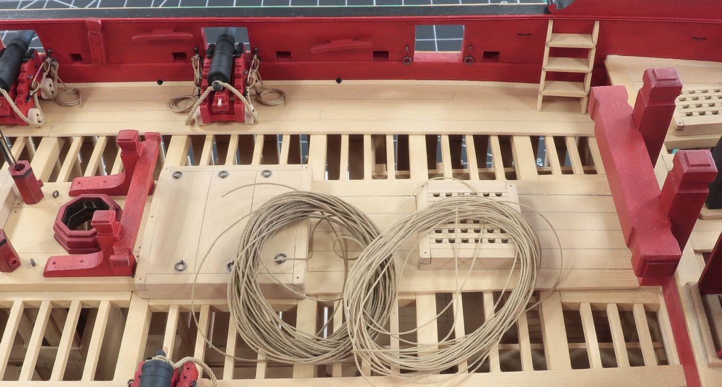

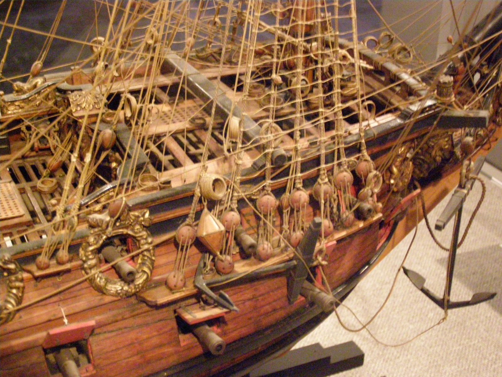

Choosing the right color…its a very personal choice.  Here are a couple of choices.  I am seriously considering NOT going dark brown for standing rigging on Speedwell as I mentioned earlier.
But rather than use the same Tan color I usually use for running rigging,  my thoughts were to go slightly darker with the tan.  Considering it will be used for both and after looking at so many models rigged in this style I am making some test rope and will choose one. Eventually.
Here is my normal tan alongside one that is a shade or two darker for this style of rigging.  Too dark?  Or is the light one ok?
You are correct to ask which color but in the end it is a very difficult choice.  Excuse all the dust on the model.  That happens so quickly.
I am selecting my test threads based on this model...I like the color used here very much and it isnt very light at all.
London 293
The Mara colors…
dark left and light right.  Note how similar they look below yet after laying up the rope they are quite different.   The 265 color appears much lighter after laying up the rope so this is why testing is needed which takes time and money unfortunately.  I am leaning towards the darker variety...
For dark brown I use # 682.

The darker color on your test rope looks to match the referenced model very well and would look great on a light coloured model (opinion from a novice!) .
Maybe a shade or two lighter than you normal "tarred" might just give a little variation if you aren't sold on all one colour...
