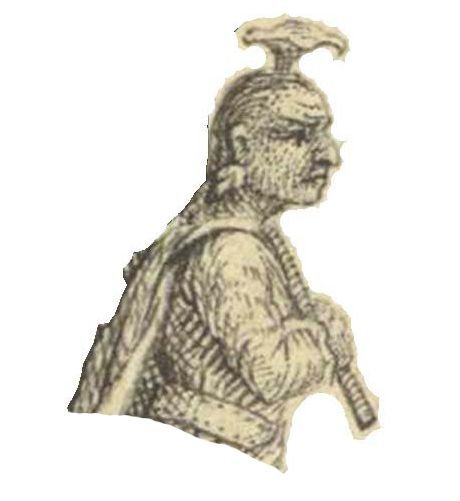

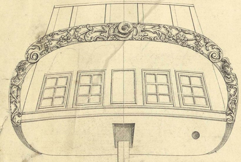

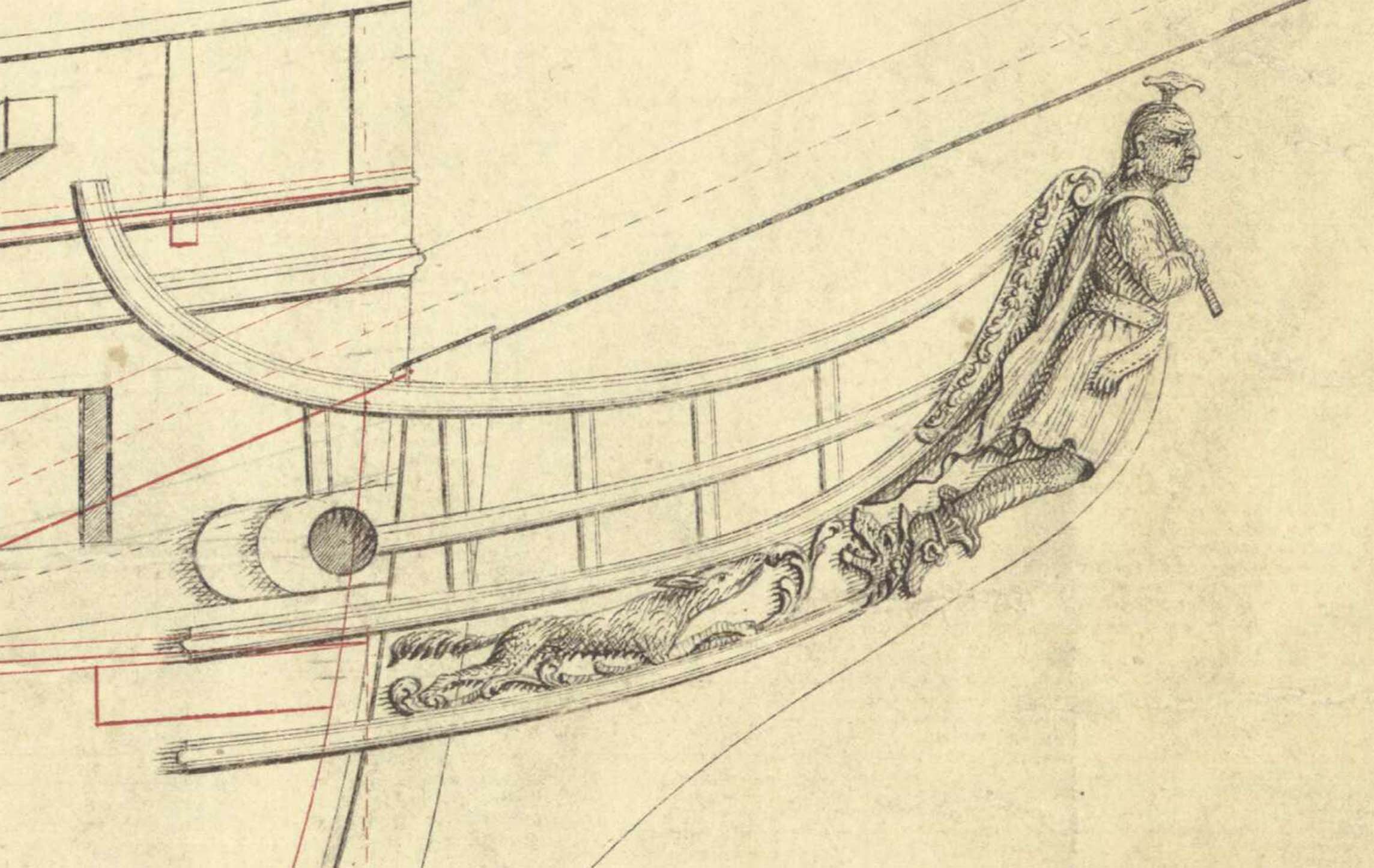

Here is my go at Meshy for a figurehead for Rattlesnake.
Here is the drawing from the lines at NMM

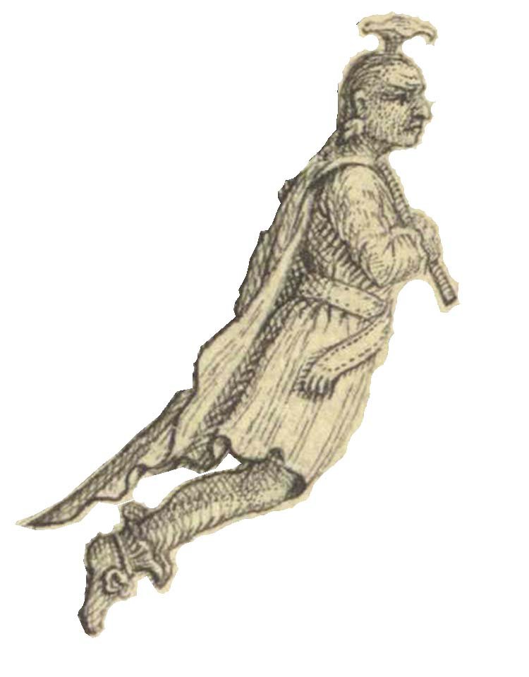

My trimmed up submission to Meshy.

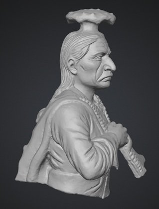

Here is the result from Meshy.   Amazing how easy it is.  ( Thanks Chuck! )   I can see how I can refine the original drawing to get some better results, like the end of the sash.
I only got one leg, but I see I left a "symmetry"  option on auto, so maybe switching it to full "ON " would have given me another leg.  But I also think this is something I can remedy in a CAD program.

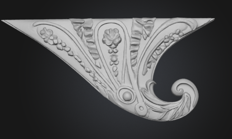

If anyone building Rattlesnake from Model Shipways or Mamoli would be interested in a refined version of this for 3D printing, let me know and I will give it a shot..  Or feel free to use my line drawing above to make your own.
The trail boards and transom carvings will be another project and that will involve creating a base relief such as Chuck discussed above.

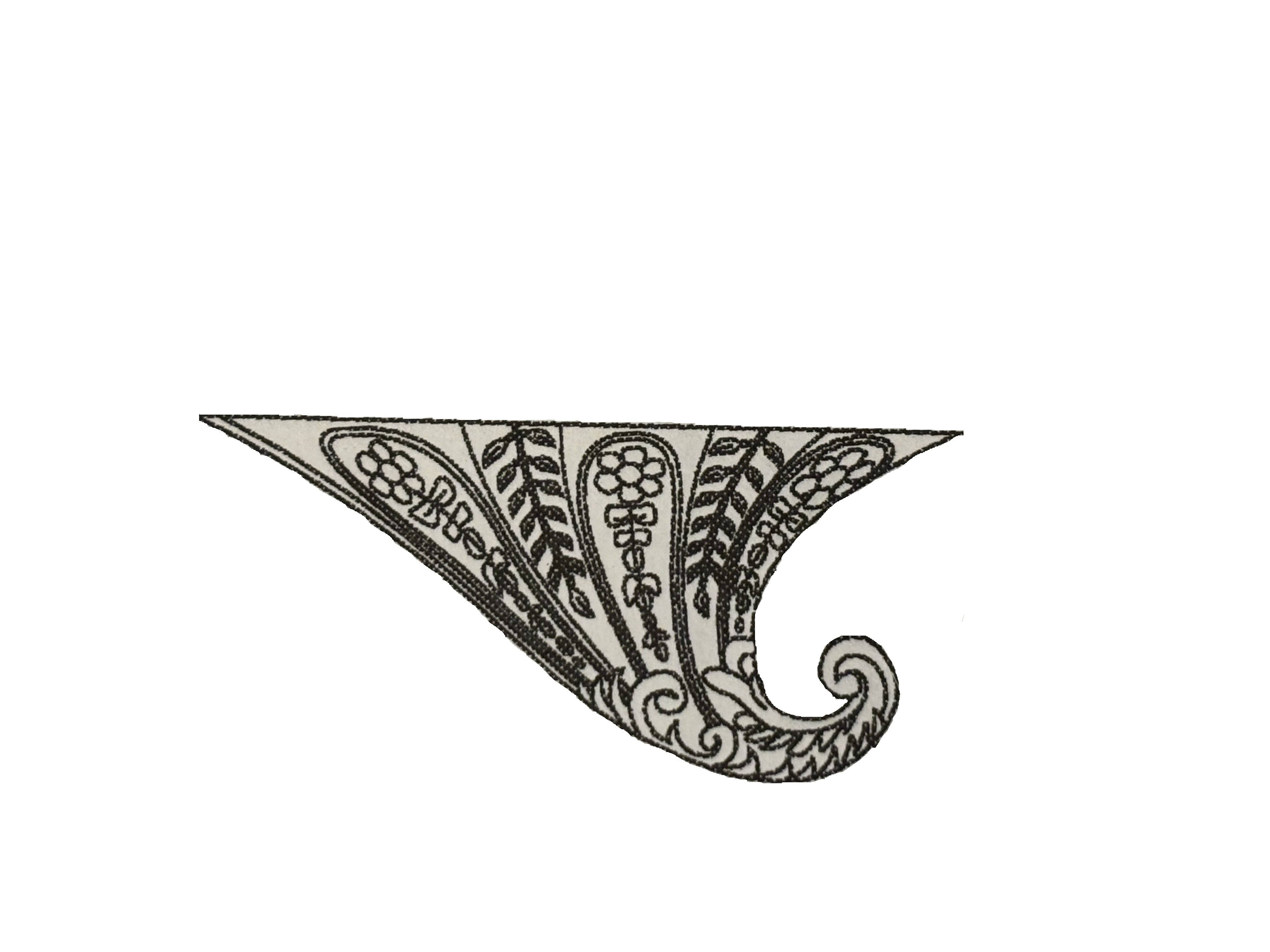

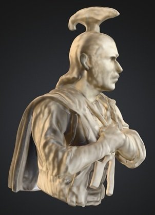

Here is my first attempt at using meshy.  I decided to start with the sash pieces that will go under the QGs.  I took a picture of them from the plans and cleaned it up.
Then inputted it into meshy and hit generate and this is what it came up with
Not bad, but also not quite like the drawing.  I need to figure out how to refine that.  I will play with it some more for sure.
Kenny
Kenny you picked one of the parts that is really tough for AI to do
properly.  I am afraid that wont work .  The drop is very complex and its shape can not replicated with meshy.  My guess is that you rendering is completely flat rather than shaped to fit the hull curvature.  Thicker and rounded at the top and narrower at the bottom in the other direction.

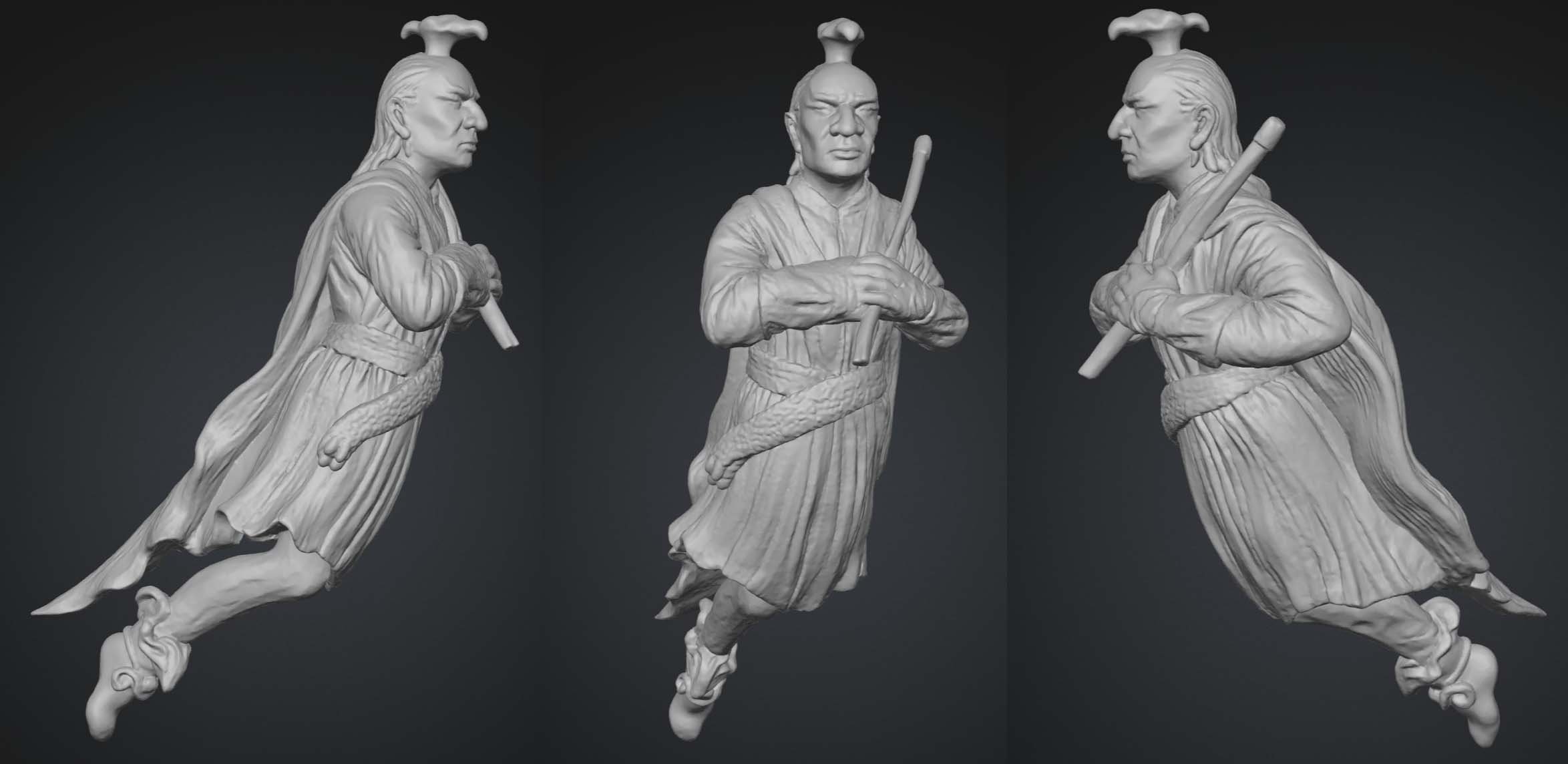

Now is this American Indian figurehead perfect....No.  But its pretty darned good.  This figurehead can be printed to the size you need.   Wash it and clean it good after it prints.  But then dont put it in the curing station yet.
All of the funky details the AI created can then be altered using some some sharp micro chisels.   You have most of the hard work done for you....the face is wonderful...the hands and some of the clothes features need some work.    So while the printed figurehead is still somewhat soft and not fully  cured, you can finish it up with your chisels.  This also helps the figurehead actually look like a carved piece rather than a "soft 3D printed" looking figurehead.   It really is the best way to utilize this technology and really slip in there a little bit of hand carving.   Once you finish your carved alterations, then you can stick it in the curing station to finish it off.
Does this make sense?   Please feel free to discuss this approach.   Its the approach I prefer especially since you are not mass producing these commercially and just looking for a way to create a fantastic and unique personal ship model project.

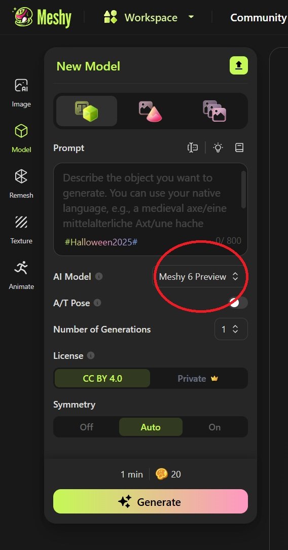

The problem with this free version of Meshy 6, I see, is that you can only upload your pic (photo or drawing) and convert it into a 3D sculpture, but you cannot further download this 3D sculpture elsewhere, to print it. To do that, you'd have to sign in for it and pay a minimum 8 dollars/month for a subscription (despite the statement from Meshy, that you can do it for a free trial - just to see how it goes (and if it satisfies you, then you can pay them and do your projects).
So, that is this limitation..., unless I missed something..   🤔
Lovely rendering.  Yes I Broke down and paid.  I thought they gave you a bunch of free downloads.  Maybe they changed that.
There are other sites that do this but Meshy 6 is the best out there.

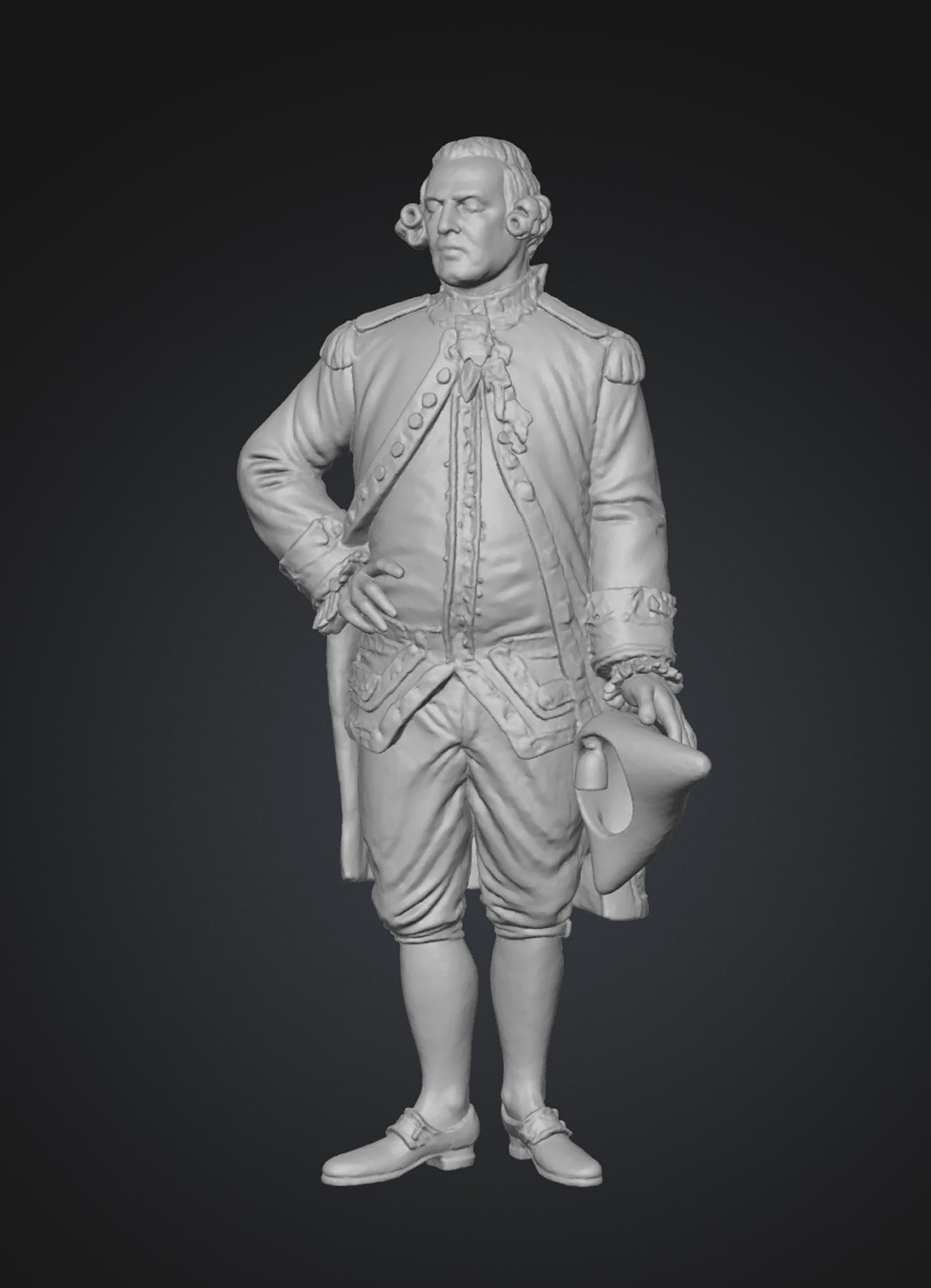

So lets say you want to make a 3d printed figure of a midshipmen for your model.
You can go up to any generic AI program like ChatGTP and ask them for it.  But you must be very descriptive.   For example I wrote this in ChatGPT.
Create a highly detailed image of standing figure of a typical sailor midshipman on frigate in the British Royal navy in the period of about the year 1800. Can you create 4 differnt views of this standing figure with no background.   Make each view separated by space so none of the views overlap.  Leave some space between each view.
I may have been able to make this request more detailed but I just wrote this on the fly.
The image it made for me is this.
Now is it correct to the period....I dont know, I would have to research that.   But anyway...
Next you take this into any photo program like photoshop and split it into 4 individual images.
Load it into Meshy or any other image to 3D program.  If I had time I would prob ask Chatgtp to redo this image without the hat and make him look a bit scruffier.   But I really only wanted to demonstrate another tip or method.   For those of you more experienced than me at this please feel free to post your tips here as well.
Also for us neophytes....If anyone knows how to easily do this...If someone could create a step by step for how to create the slot for a figurhead so it can be slipped onto a stem I would appreciate it.   Hopefully using free software.   Maybe Blender or freeCad.   I would like to give folks as many tools and tips for creating viable carvings and figureheads using this technology.   But my knowledge is limited.   So I am hoping those with the knowledge would be willing to share.
Scruffier with no hat...
And these are a few 3D conversions from meshy and hitem3D to show how very different the results are after using the same image from chatgtp.  The free retries were used in each program to make two figures from each platform.
The two center figures are from hitem3D.   A very different result and I will leave it up to you which one is better.   I know what my preference is.

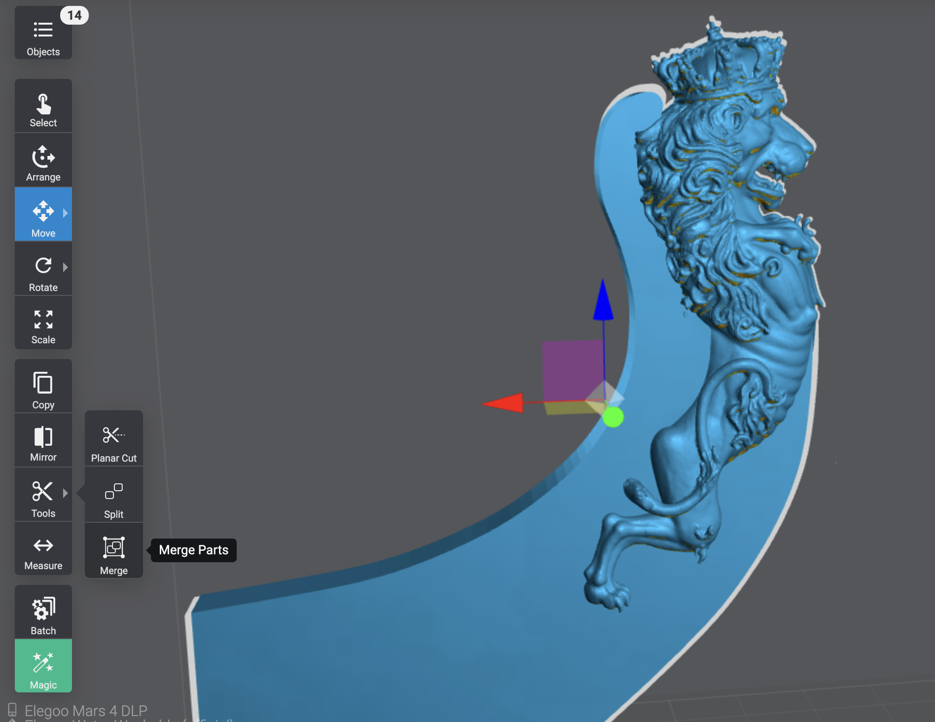

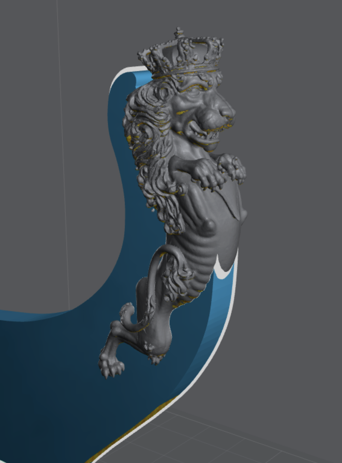

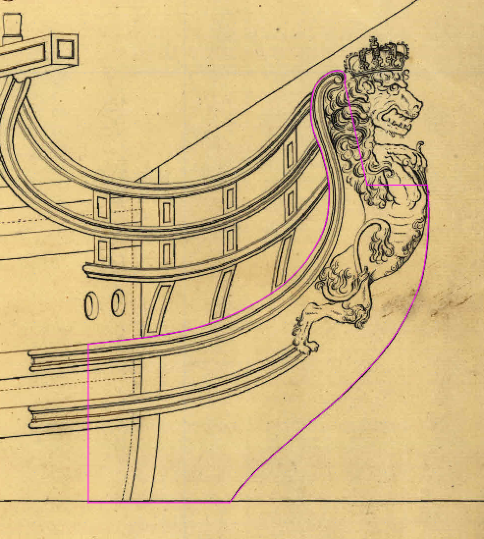

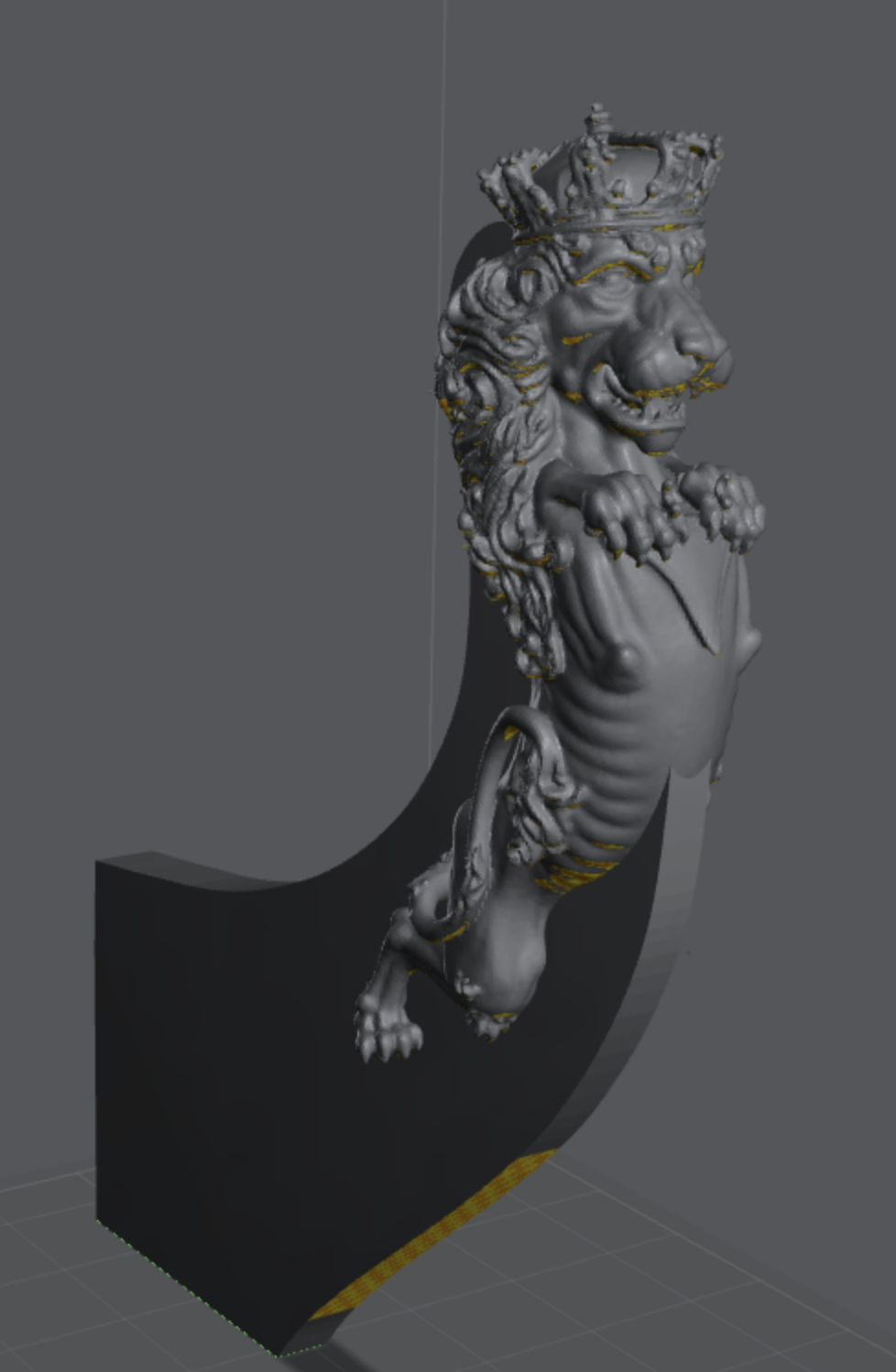

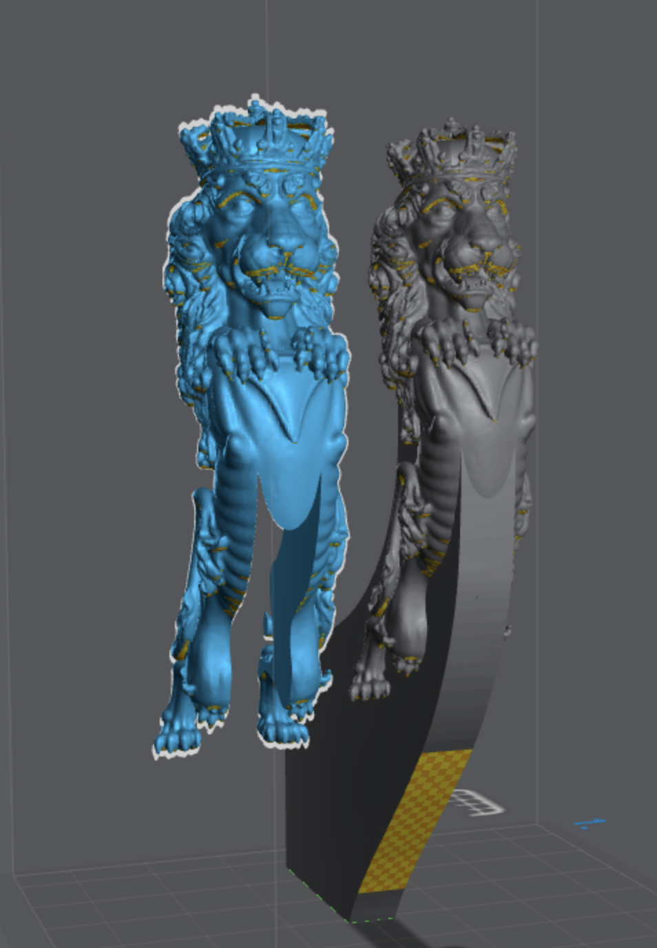

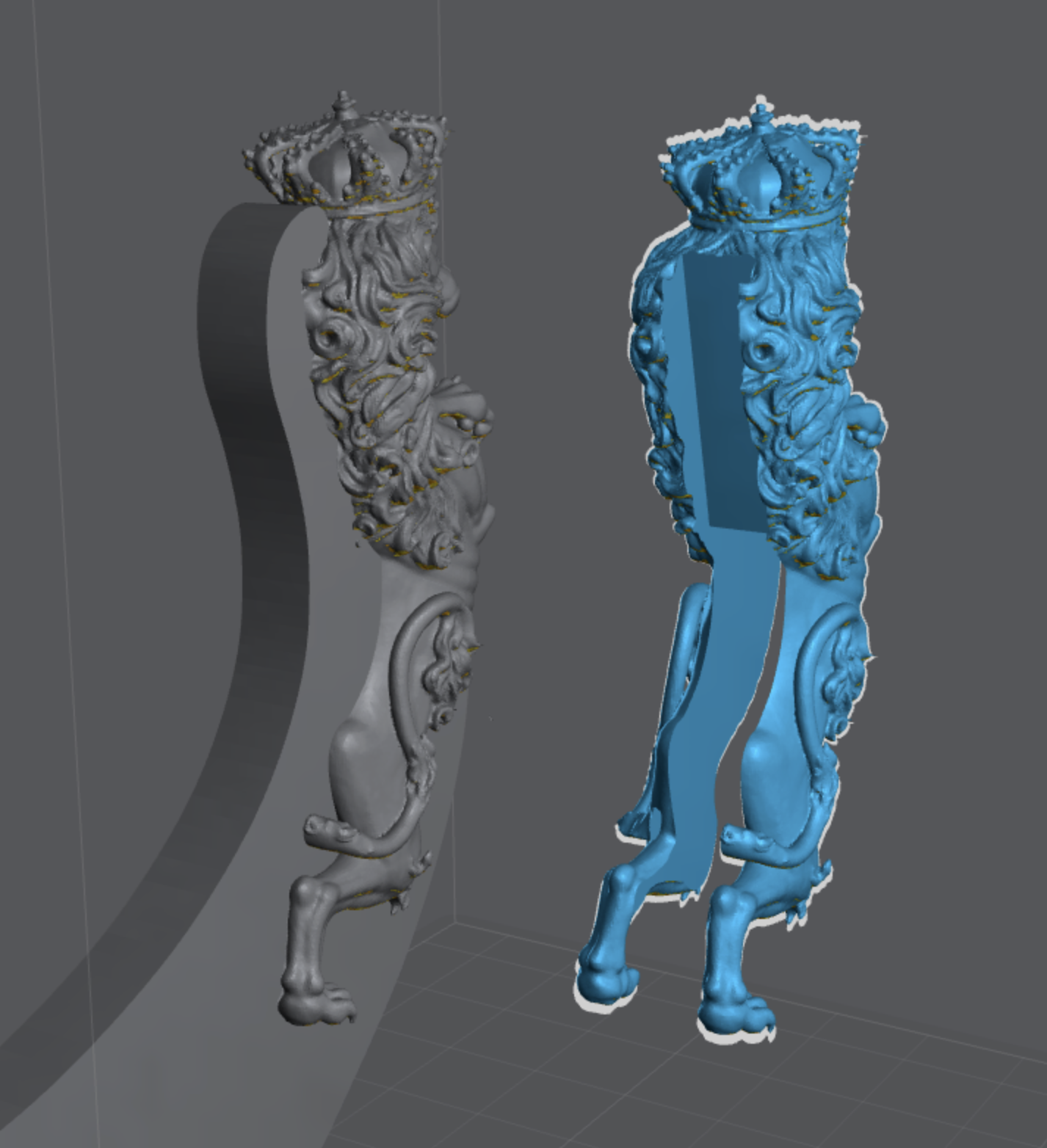

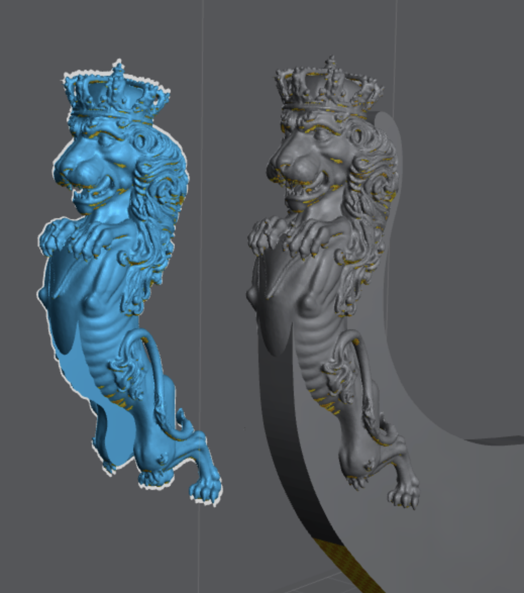

I also don't have any skills with the likes of Blender and Z-brush, but I have found a workaround that makes it easy to make the slot it the figurehead:
I draw the shape of the prow and extrude it to the correct depth:

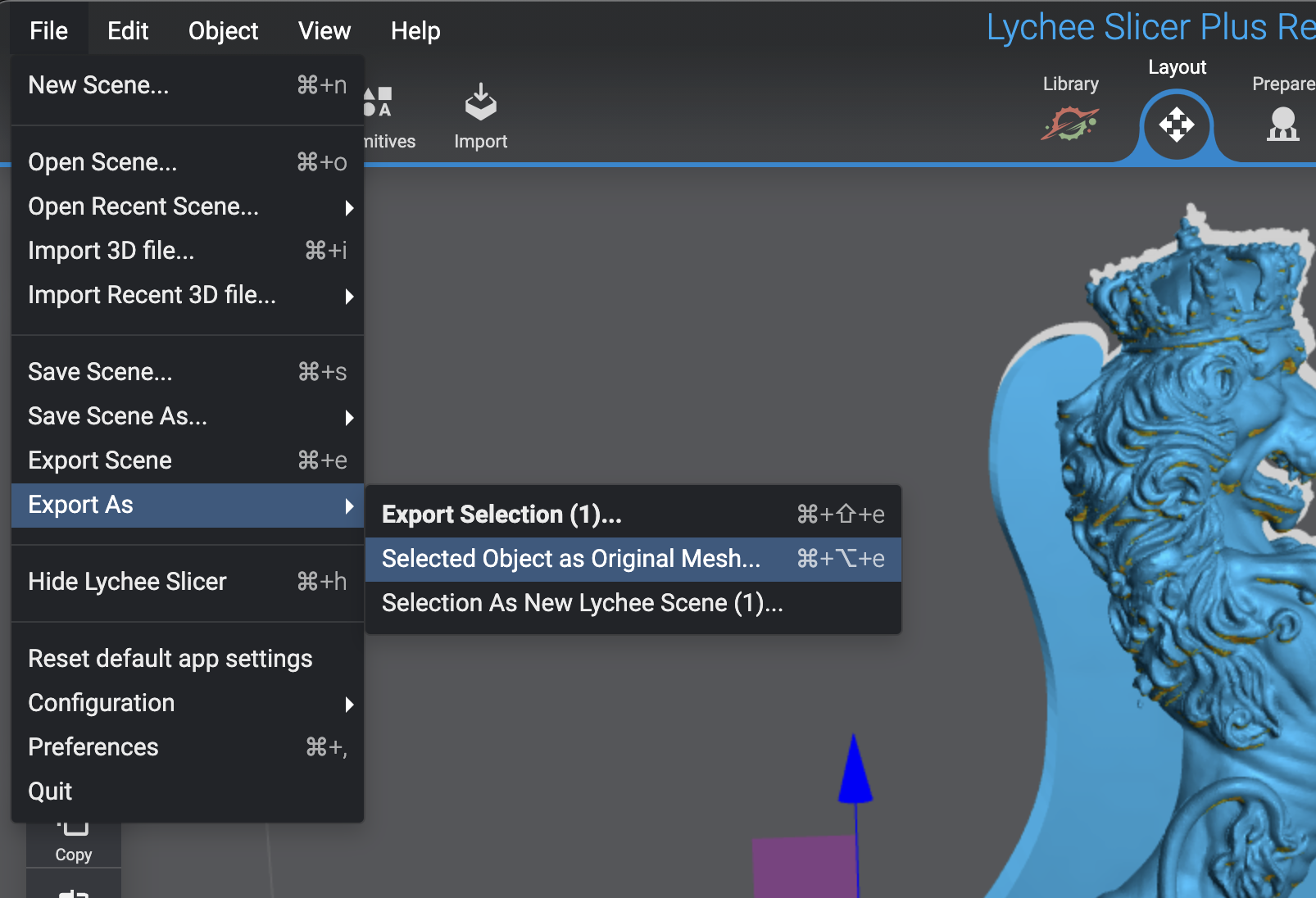

I then import it into my slicer (Lychee) along with the figurehead and position them. I find it is much easier to work in the slicer than in a 3D CAD progam when manipulating the part positions:
I then merge the parts and export a combined stl. The file actually still contain the seperate parts, which is detected by the next program, Onshape, a free online 3D CAD program. The prow is then subtracted from the figurehead with a boolean operation:
and the final slotted figurehead can then be exported and re-imported into the slicer for printing:
Screenshot2025-10-30at17_33_26.thumb.png.3ebdbe937318b9790f22e54d6cafd0bf.pngScreenshot2025-10-30at17_33_18.thumb.png.334e04c66844b5ef2c959e49adefddaf.pngScreenshot2025-10-30at17_33_07.thumb.png.5f94a8d316cfcf67cfab3e3f4e324541.png
This all takes 10 min total - except that the original file produced by meshy has topological errors. They are fixable to a sufficient extend in the slicer for the purpose of printing, but that is not good enough for the high tolerances of the Onshape program, so it is nessecary to repair and re-mesh the original figurehead file before this simple workflow can be completed. And that took me a bit of time to work out! I used a free Autodesk program called Meshmixer to repair and re-mesh the model here. So provided that you have 'water-tight' stl files, making the simple geometric subtraction to get a slotted figure is relatively simple, but it took some work to get there!
I have attached the slotted file here as well.
BR
TJM
Grønland figurehead cut.stl
Edited by TJM

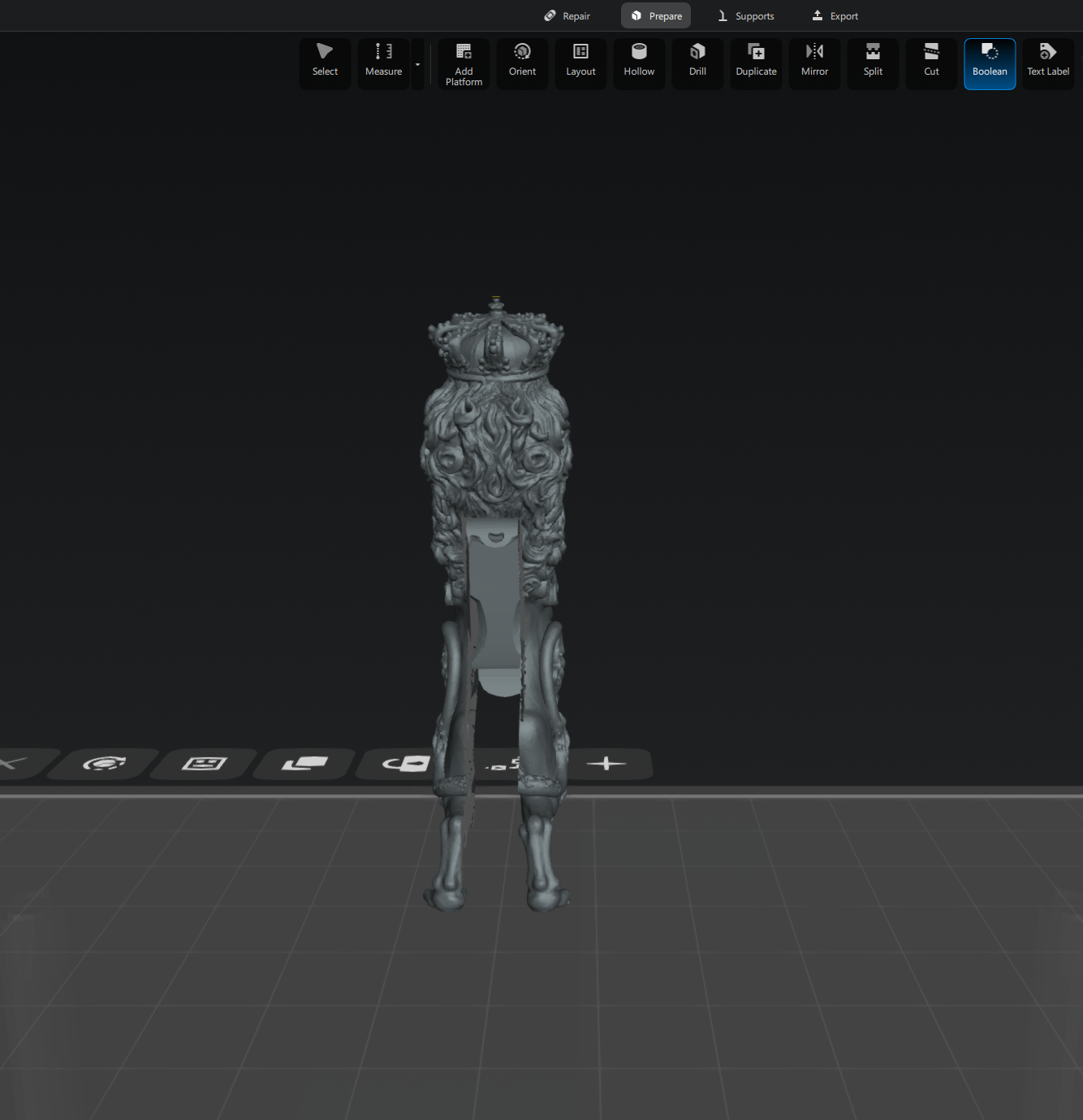

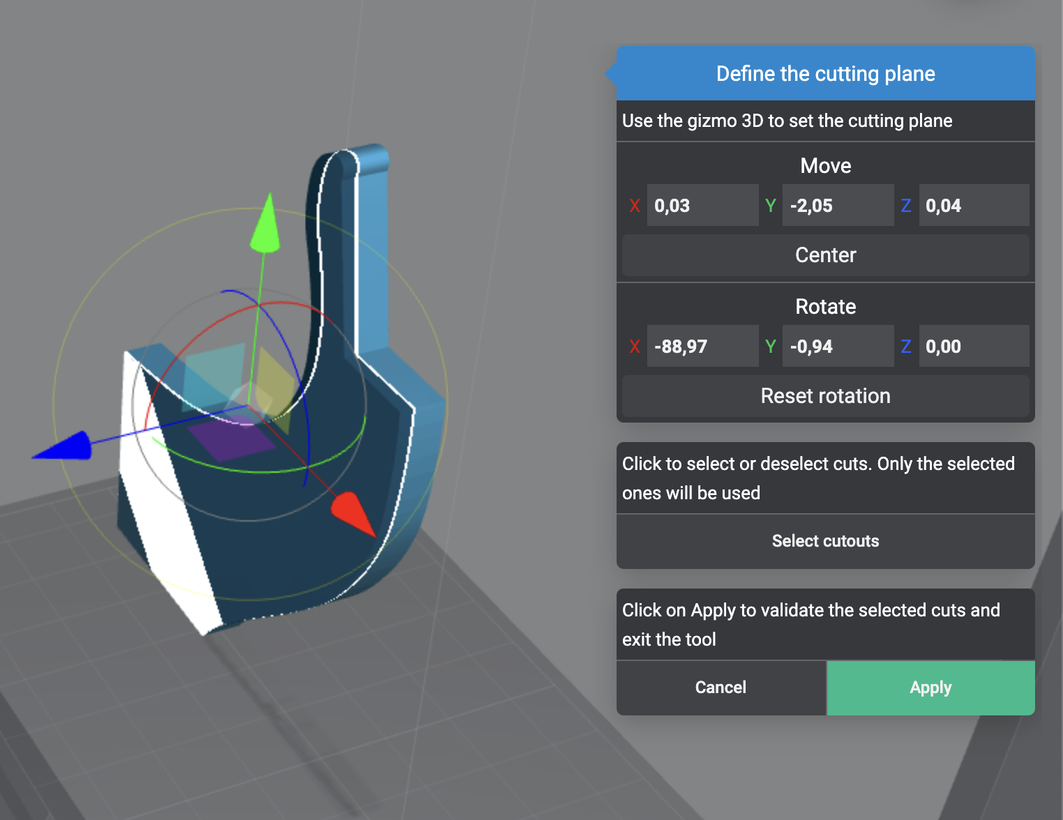

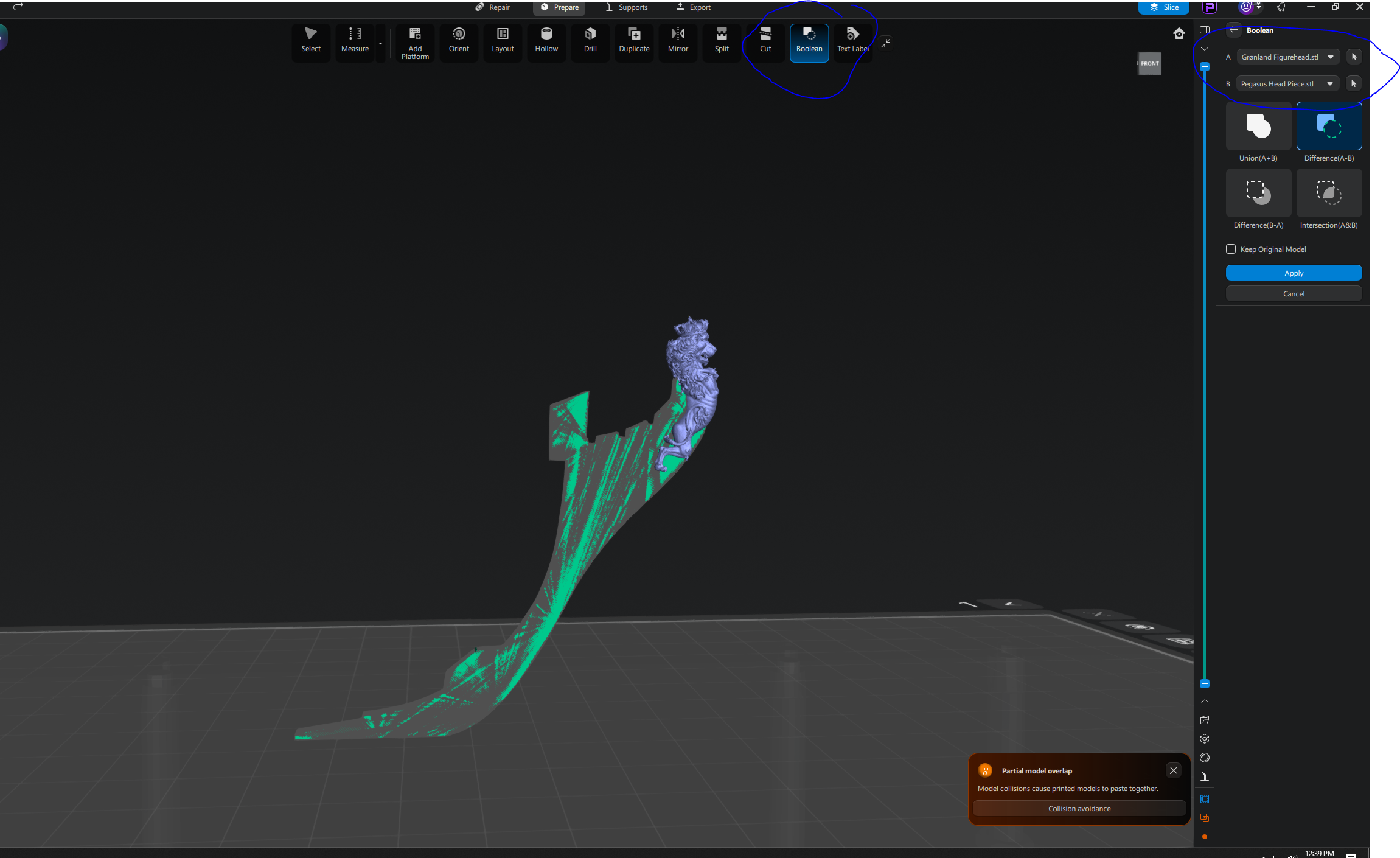

Chuck since I noticed you use Chitubox, that software has a boolean function built in as well.
-Import a stl of the figurehead, and a stl of the shape you want cut out. Im using the Pegasus head piece I used blender to trace.
-Align the pieces to how you want them to sit on the model
- Up top select the "Boolean" option and then select the configuration of which piece you want to cut.
-Hit apply and it will give you a new "Cut" piece.

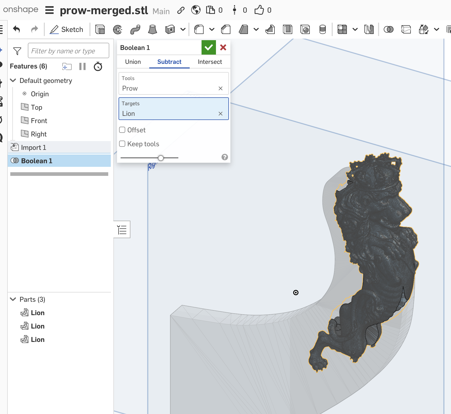

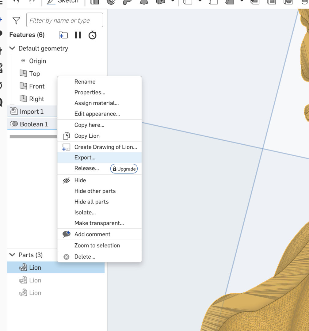

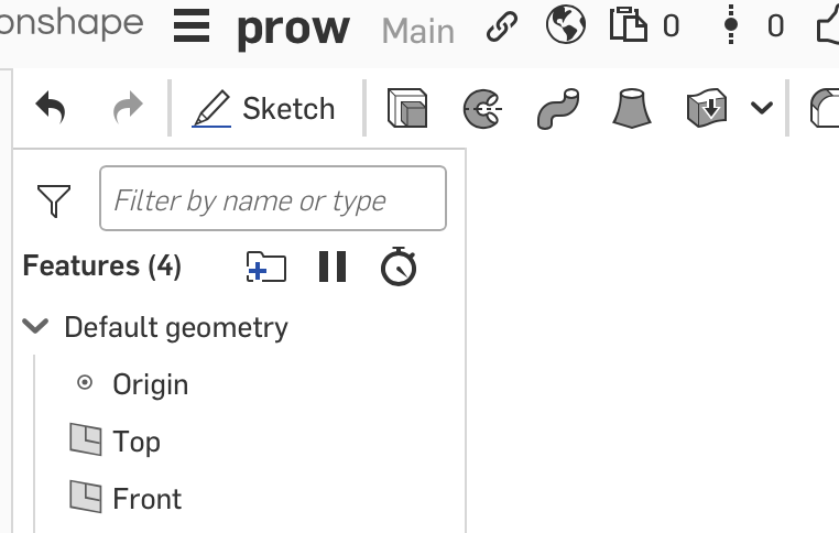

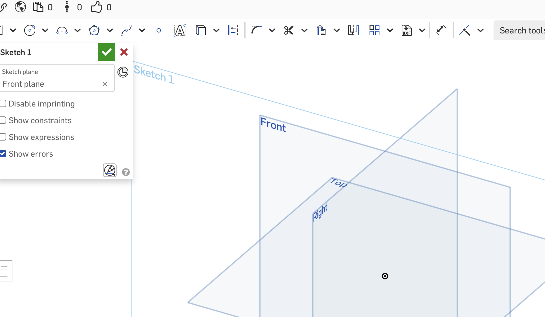

Alright, here's a detailed walkthrough of how to make the slot in the figure using Onshape:
1: make the prow template
I am sure there are many ways to do this, but this is how I do it.
I draw the shape in QCAD, using the scaled drawing as reference:
You can do this in any CAD program. Make sure all the endpoints touch - it needs to be a closed shape to enable the extrude operation.

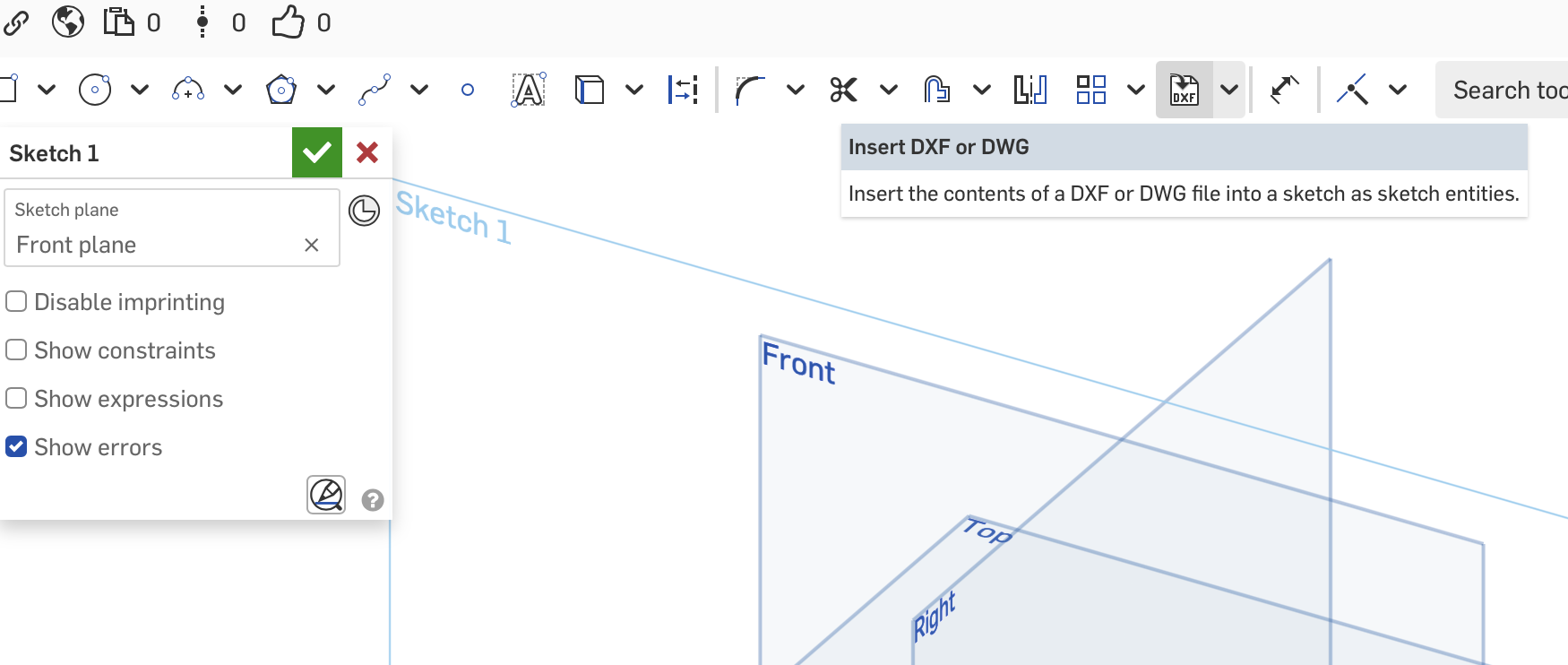

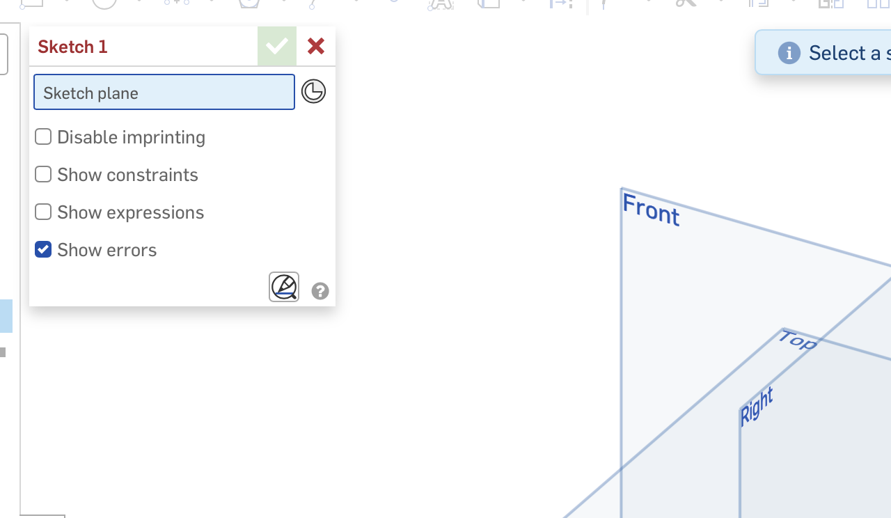

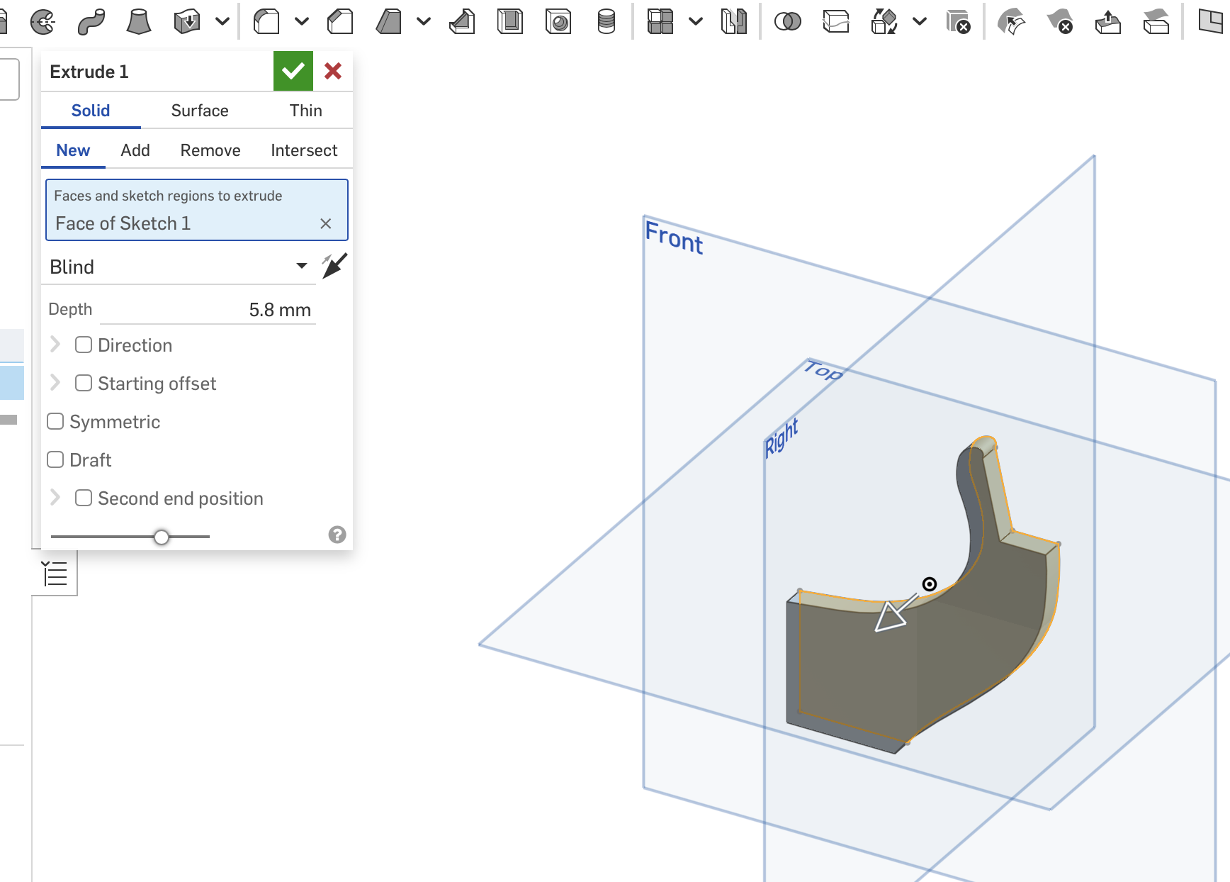

Then I make a new project en Onshape and create a 'Sketch':
You have to pick the plane to sketch on (I pick the front, it dosn't matter)Screenshot2025-10-30at18_34_57.png.3c1505436eeb36563c583dd36fbe7487.png

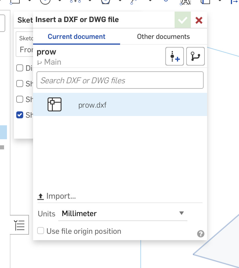

Then, before completing the sketch operation, click the DXF function at the top right:
Import your prow 2D CAD file:

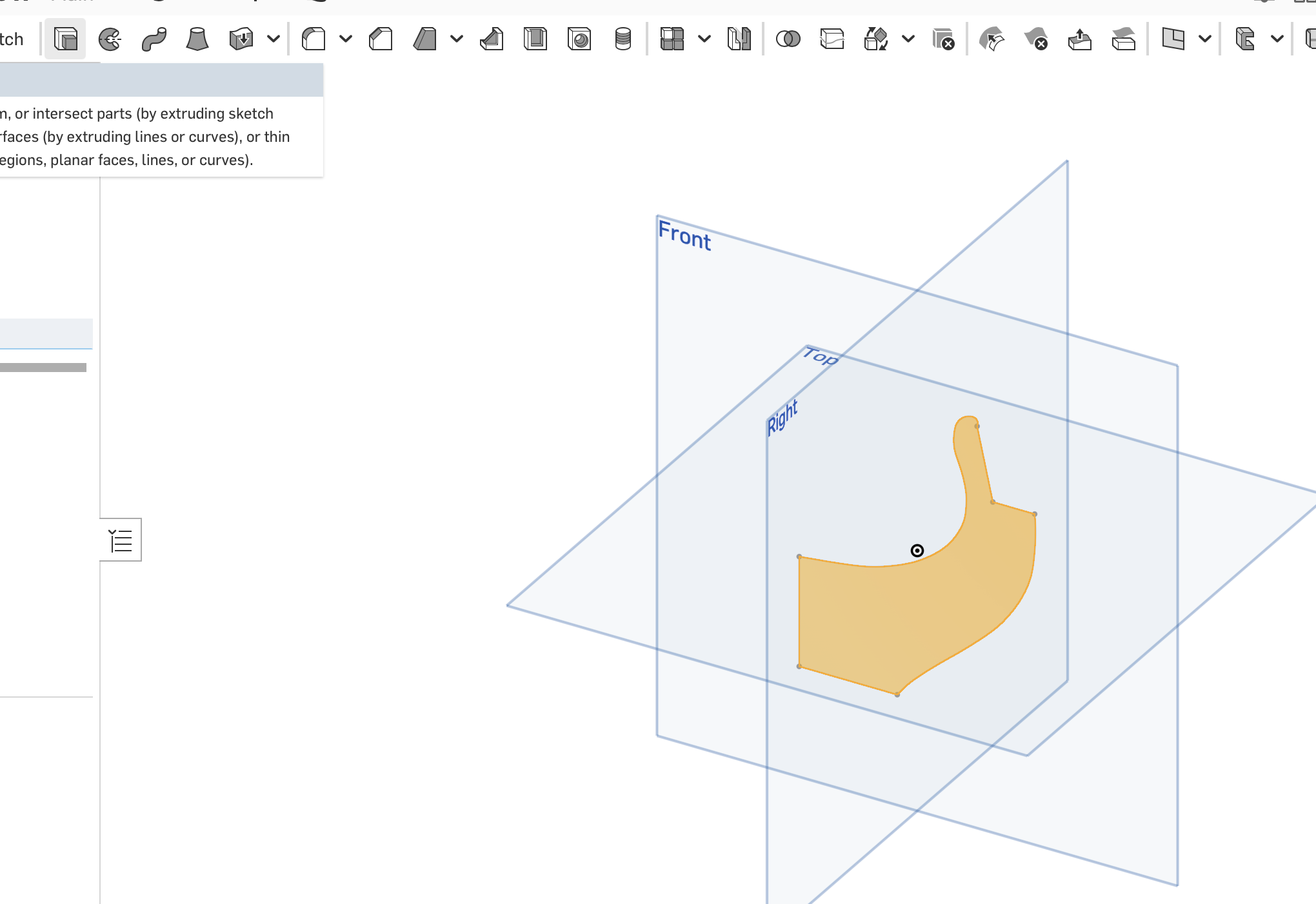

click the tick mark on the sketch function to complete this:

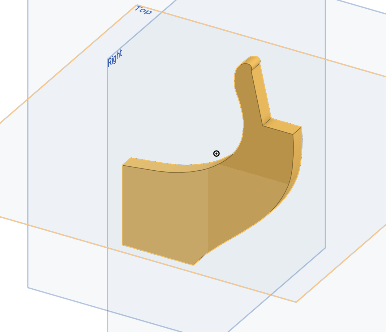

Choose the central shape (not the lines) and use the extrude function (top left):
Here you pick the depth to extrude, the thickness of your keel, but give it a bit extra, othewise bleeding of the pixels during 3D printing will likely make the cut to shallow to fit. You must experiment with the correct thickness.

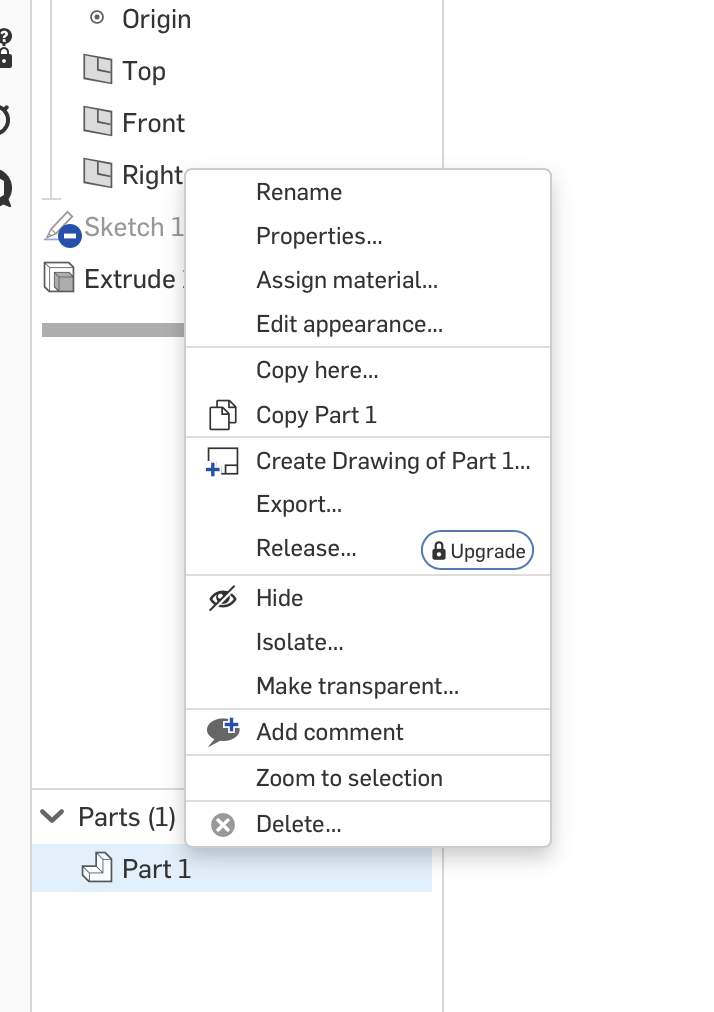

Then export this 3D keel shape as an stl:
Import this and your figure into the slicer (you can do it in onshape as well, but I am not good at moving things around in that program, so I prefer the slicer).
Adjust the position of the parts to fit and combine the parts (at least in Lychee, you have to do this to export both in the correct relative positions):
Export the object to an stl:

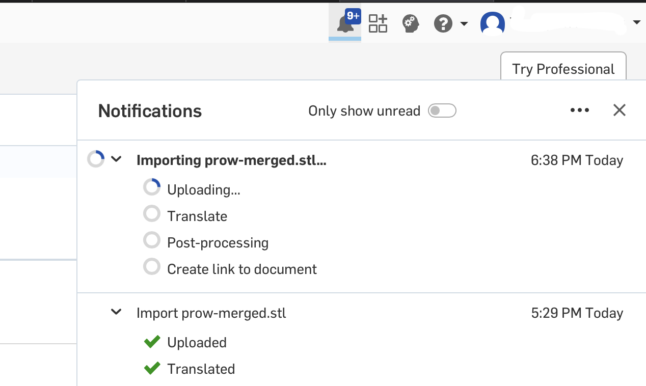

2: make the slot with the boolean function in Onshape

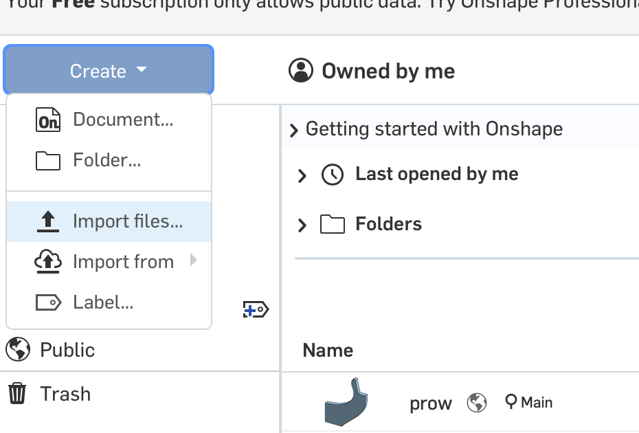

Now we need to import this model into Onshape. From the main menu, click the create>importScreenshot2025-10-30at18_36_49.png.245ba4db10b5e3dd7067171bb6220749.png

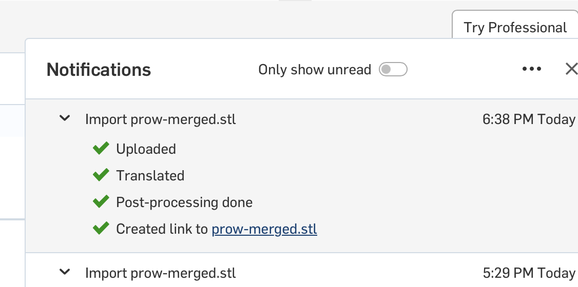

Import your stl - the progress will appear in the notifications tab (a bit counterintuitive):
When it is done, you get a link to your imported file:

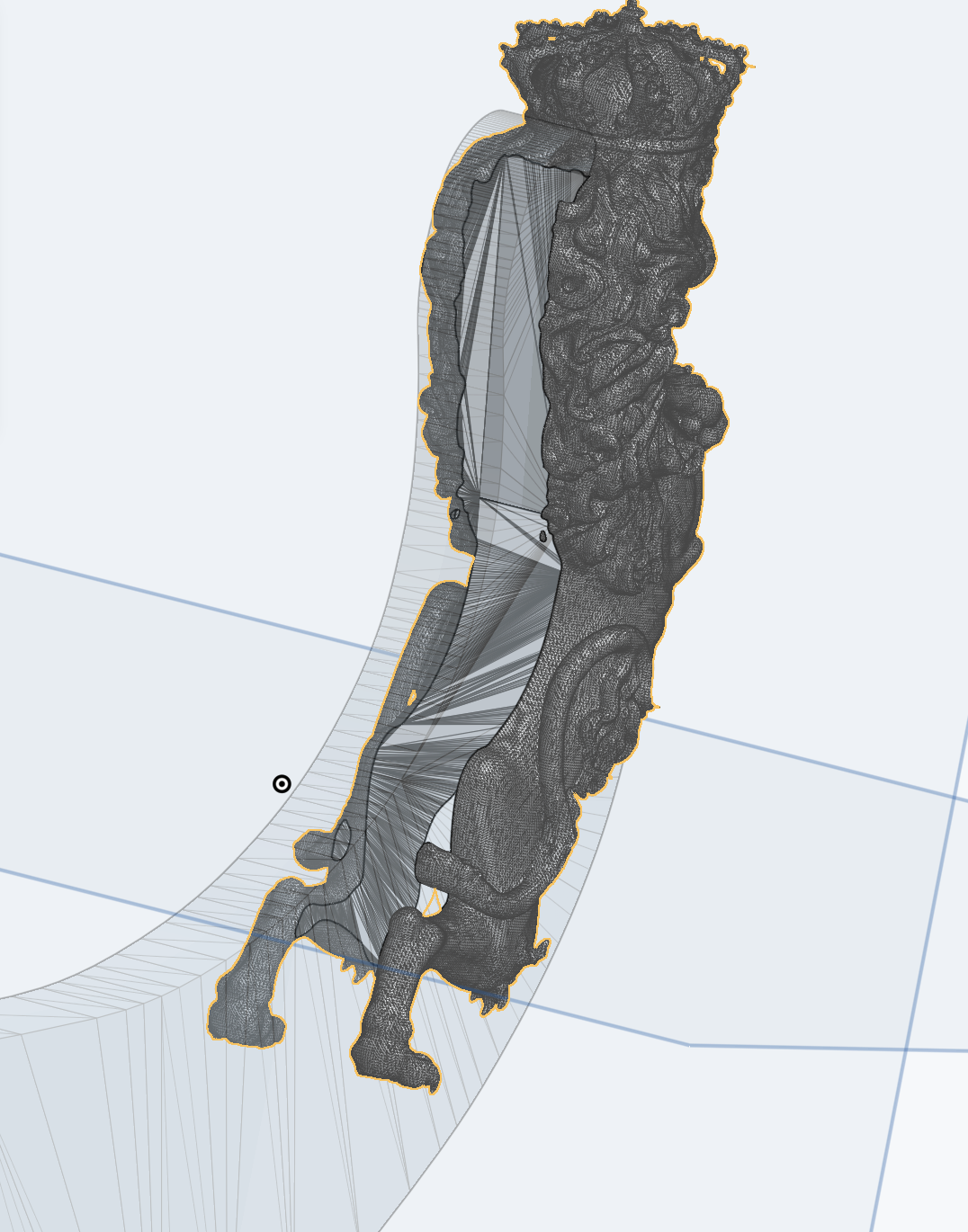

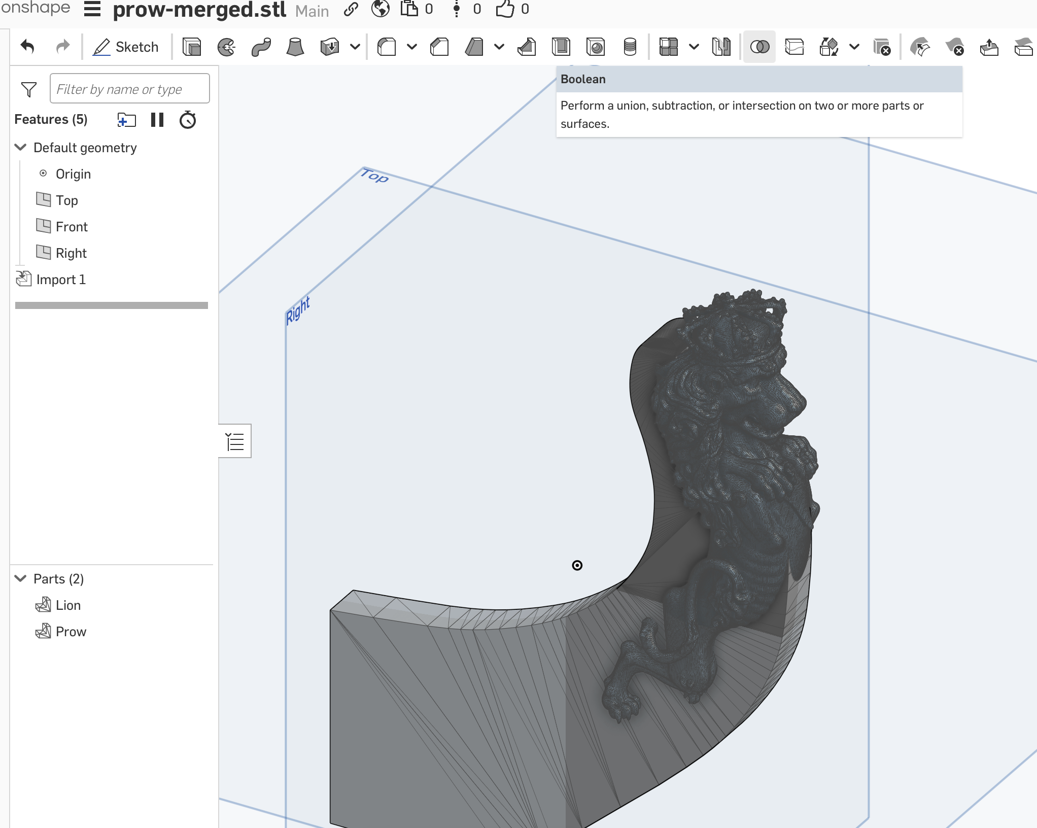

Now we are redy to do the boolean. It is at the top bar, two intersection circles icon:
As it says, you can do three types of boolean operations, union, subtraction and intersection - we need to subtract.
The prow is the 'tool' and the lion is the target. You can have several tools operating on several targets, if needed.

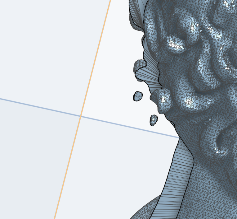

In my case, three lion parts appear - this is because I have two small, free floating bits of mane - normally you would just be left with one slotted figurehead part:
Then you just export the part(s):
I have seen instances where the boolean function fails - this happens if there are very extreme topologies as a result of the subtraction, but mostly, if you have so-called water-tight stl files, this just works like a charm.
Let me know if there are any points that need clarification!
BR
TJM
Edited by TJM
1 hour ago, druxey said:
So far, so good. But the knee also tapers in two directions. That also needs to be taken care of.
It is not a problem to make a taper like that, it is just two mirrored planar cuts to the 'tool' part. You can see an example from the slicer below and that there is around a 1 degree taper in two directions:
Then you can get something like this:
I am sure this is not completely accurate either, reality was likely more complicated. The accuracy will of course depend on how good your model knee is, but the procedure for the slot remains the same. I think it should be possible to make something that is good enough for a model with an aproximate 'tool' shape.

Just recently read through this post and have given Meshy a try. Really amazing. I created the image but when I try to download the STL file, it takes me to a page to upgrade my subscription. How do you download the file in the free subscription, or do you have to have the paid version to actually download files?
Frank
I too found it difficult to determine what you were getting and what it cost.
When you use Meshy 6, which is the highest quality you have to pay.
You can change the number to Meshy4 and get some free downloads, but you will see the quality is not as good.
Those who are into making this stuff can probably take the Meshy 4 stuff and improve it in another program.
This is the Meshy6 version.
This is the free Meshy4 version.  It does some texturizing that may be useful in other applications.  Depending on what you are making, you can probably get some useable stuff for free.
There is a limited amount of downloads.   10 Per month, I think.
I didn't find out what Meshy 5 does.  It may be cheaper than Meshy 6.
