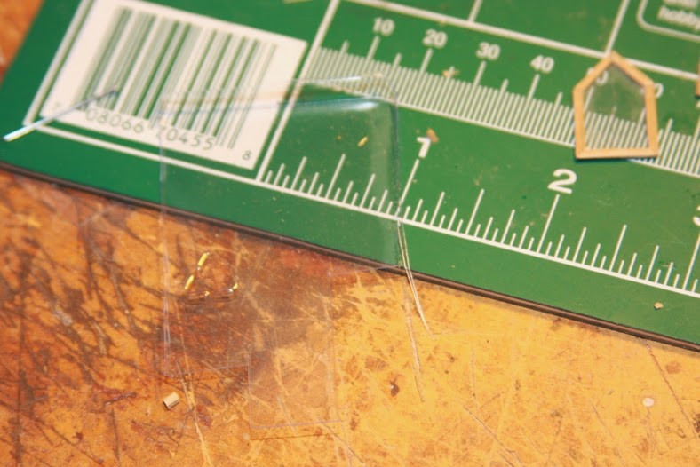

 I framed the windows with 2mm X 2mm strips cut and glued. Then I covered them with "glass" made from the plastic container that held some screws. I scored the glass carefully with an older, dull Xacto blade being careful not to pierce all the way through the glass.
I then stained and mounted the windows to the rear of the captain's cabin trying my best to match the coloring as closely as possible on the outside, while maintaining a mahogany color on the inside of the cabin, a location which would most likely have been more decorative.

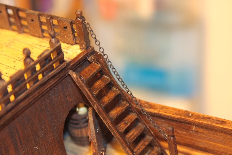

The ladders are created exactly how one would expect - each piece is cut then glued together. It takes a great deal of patience and persistence to glue the ladders with all of the "steps" even and secure.
To ensure the ladders are held in place adequately, each ladder is fitted with a pin in the base. A corresponding hole is then drilled in the ship. This extra step dramatically increases the stability when the ladder is mounted between decks.
Although some reference material shows only one set of steps from the poop deck, Xavier Pastor's reference shows two ladders. The final detail to the ladder is the chain guide running from the top stanchion to the bottom stanchion.

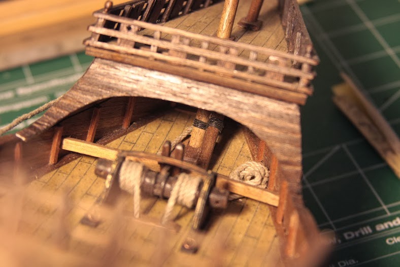

Once the Fo'c'sle has been constructed, the foredeck has been mounted to it, and the head beam is put in place, I was able to add both the bowsprit and foremast. Unlike later ships in which the bowsprit and foremast are mounted separately, the Santa Maria's bow masts are linked together. This made for a very tricky process.
The technique involved putting the two masts in place while the foredeck was unattached. I then bound the two masts together at the proper angle at their base. The patience then kicked in when it was time to mount the foredeck while matching up where the masts enter the main deck.
The final product with the head beam and windlass in place looked pretty good. It all makes me realize just how little space the sailors had to run around and actually sail the ship.

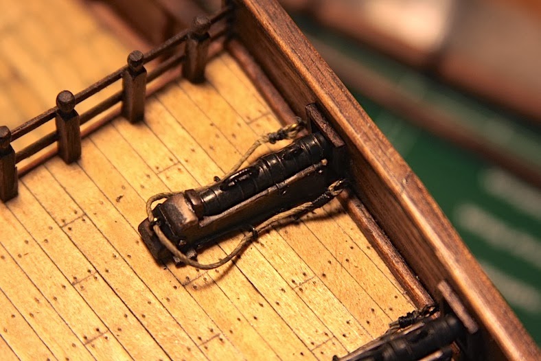

Like most kits, the cannons included in the AL Santa Maria fell very short of authentic. Although the die-cast brass cannons themselves were pretty close, the base on which they were to rest were woefully inadequate. So, once again, I turned to Pastor's reference material.
However, this was also an area where I didn't mind shifting slightly from authenticity. I also like the cannons created by Garik Grigoryan used in his rendition of the Santa Maria. Although much of his Santa Maria is a little too elaborate for my taste, I really enjoy his miniature deck fixtures.

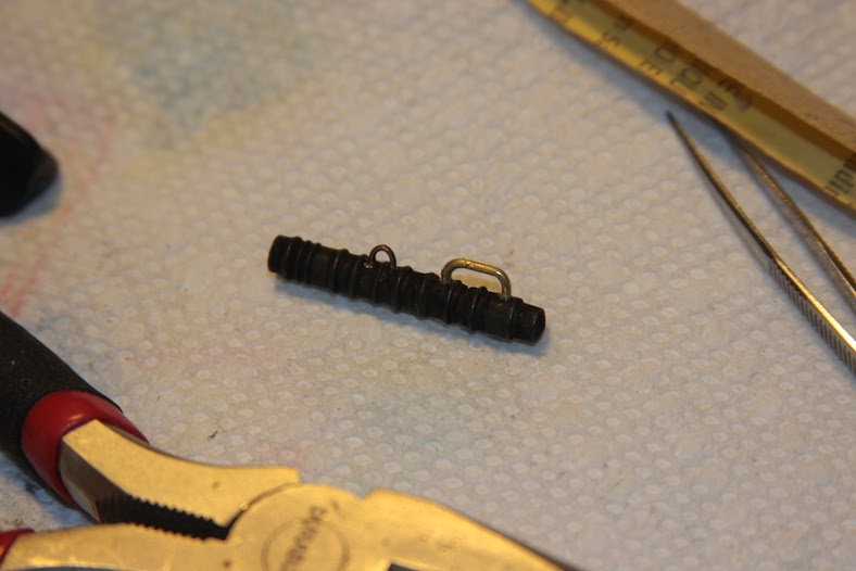

I started with my cannons by letting them soak to create a patina coating.  I then drilled out places to attached fixtures to the cannons.
The handles and loops are shaped brass wiring. I then re-soaked the entire fixture to build up the patina once again. Unfortunately the patina didn't build up as nicely as I would have liked, so I added some paint and other methods for aging as well - which I will get to.

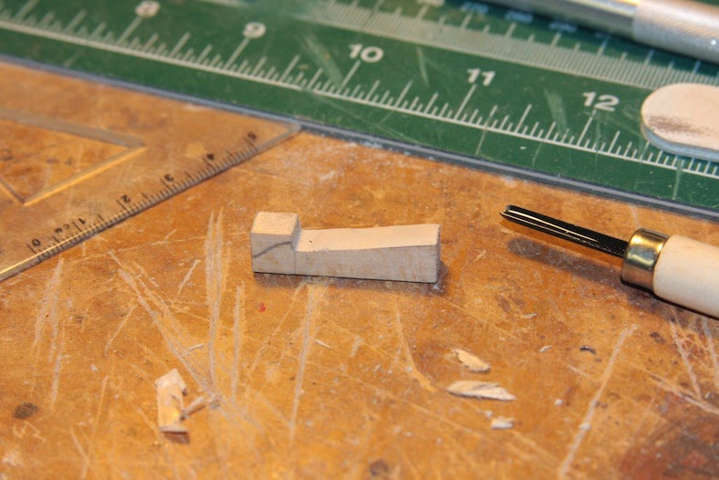

I carved the base pieces out of solid blocks of wood using both hand tools and a dremel. After the bases were carved out to hold the cannon barrels, the feet and backing are added, each is stained. The metal strips are cut and molded brass strips. The rivets are straight pins cut short and inserted into pre-drilled holes through both the brass strips and wood.
I then used this fantastic product I came across by Tamiya.
The trick is to add the fake soot and/or rust to a slightly damp product. In my case, I sprayed each piece with a thin coat of polyurethane then added the weathering product. Additionally, I painted the brass fittings that would not patina properly, then coated the entire fixture with the soot just before the paint dried entirely.
I was very pleased with the final product.

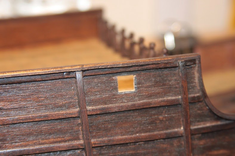

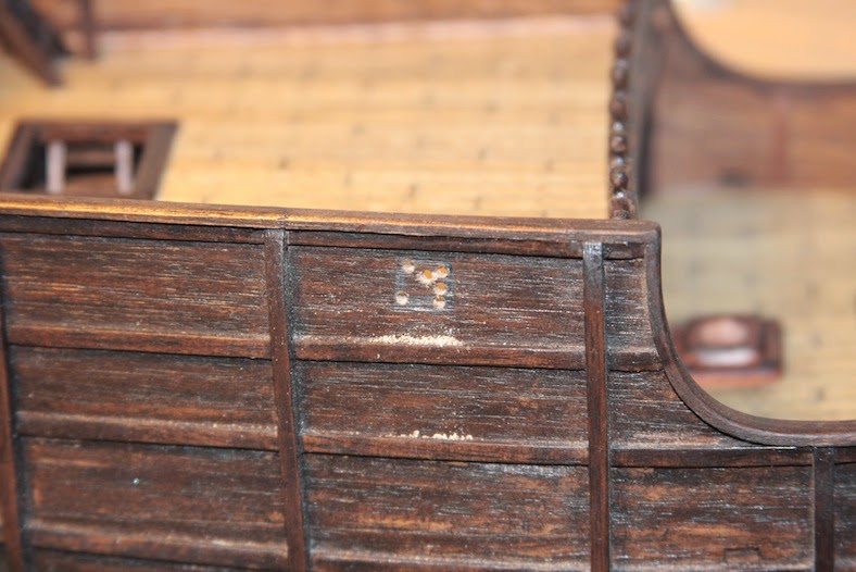

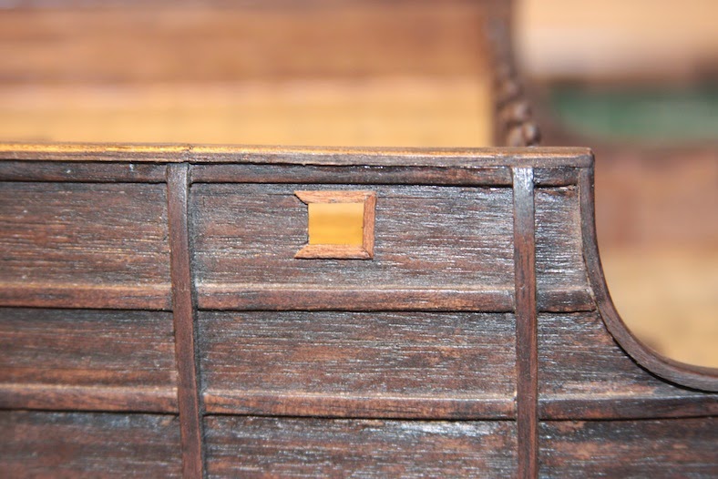

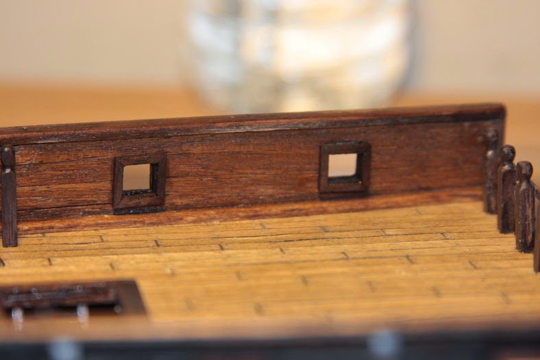

I then moved on to the gun ports in the side of the ship. It always makes me very nervous to cut into the ship. Obviously making any kind of error would be very difficult to correct. So I spend quit a bit of time planning before I actually cut into the ship.
After measuring where each gun port will be and drawing it in place, I started by drilling small holes to outline where the ports will be cut out.
 I then used a larger bored carving and etching dremel tool to get close to the sides of the gun port. The rest is done by hand using pin-files. It's a very slow sanding and filing process because it's very easy for the siding and planking to fray, crack, or break off.

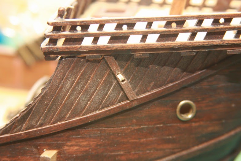

The outside of the gunports are framed with thin strips of mahogany that is mitre cut and mounted. In these cases I used "super" glue since the pieces are so delicate.
Since I always have difficulty creating frames this small, I used a technique similar to when I created the pieces for the captain's cabin. After pre-staining the wood, I cut and glued the 2mm x 2mm strips to a piece of paper. This makes it MUCH easier to eventually mount to the gunports.
After the glue dries, I use a fine X-acto knife with a new and very sharp blade to cut the paper from inside the frames. I then lightly sand the paper side until it is thin enough to not be noticeable on the final product. Each frame is then glued, sanded again, and stained.

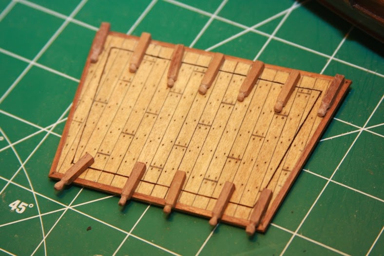

Like anything else with the Santa Maria there seems to be a variety of speculation regarding pinrails, cleats and the like.  I've had to scan the rigging over and over to try and figure out where these fixtures would have been.
I've also been trying to speculate whether or not the belaying pins are more traditional looking (as they are with more modern ships) or whether they may have been more primitive in nature like some of the cleats appear to be.
So, like the rest of the model I've looked at many of the builds and references that are our there and then pressed on with what I think works best while maintaining a credible level of accuracy.

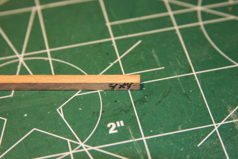

I used a 4mm x 4mm piece of walnut and bevelled the top edges. I've stayed away from much ornamentation on this build because I truly believe the Santa Maria had very little. However, I wanted to include a little bit of craftsmanship that I think every vessel would have likely had. So, I used one of my mini pin-files (which sounds redundant) to notch out the top of the posts.
I  used a 1mm thick 5mm wide piece of walnut and sanded it at a curve for the rail portion of the piece. I then notched out both the posts and rail to give them a nice tight fit. After staining the entire thing in "Kona" colored stain (to match the weathering I've done on the rest of the ship) I put them all together with the belaying pins.
Although it's not clearly seen here, I mounted the entire piece in the same method that I've done railings and stanchions - which is to drill and mount pins in the bottom of the posts, drill corresponding holes in the deck, then mount the piece with a touch of CVA glue.  It's always a challenge come rigging time to get these pieces to hold well once the running rigging is attached and pulled tight.
