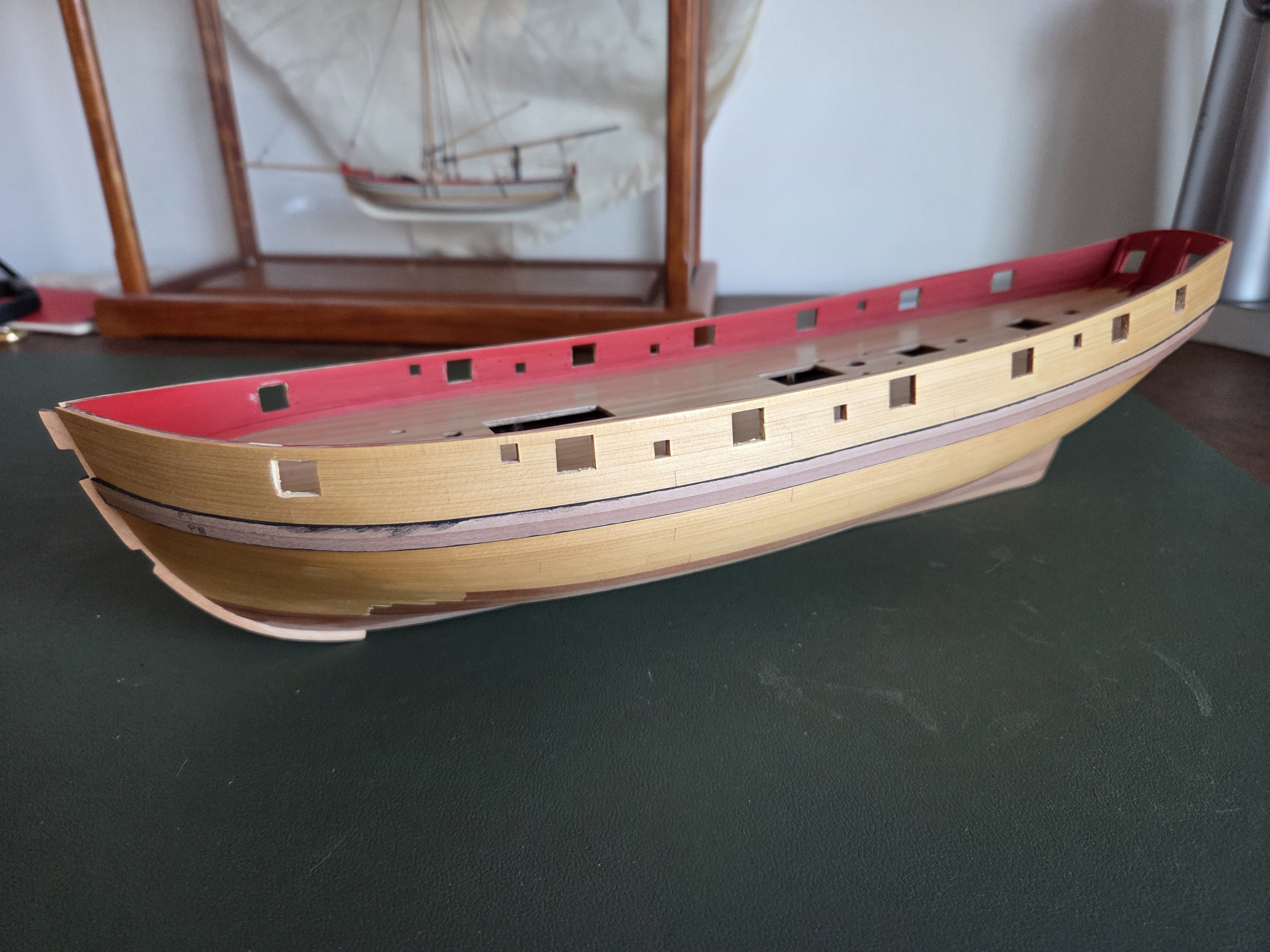

A very small update: I have just attached the wales on each side of the hull. I trimmed them short at the stern before gluing them in place, because I was dreading having to trim off the excess after they were attached - that was how I managed to nick the transom after installing the external bulwark planking. I painted the edges of the wales before attaching, so that I wouldn't have to mask anything. Now I will do some puttying and sanding and then paint the rest. I've also added some putty to the inside edges of the gun ports, and will be sanding that down to get some (hopefully) nice smooth surfaces before painting them. I'm going to be pretty excited to attach the stem and keel soon and sternpost soon! That will feel like a big visual step forward.
I think in part it can depend on how hard or soft the wood around the filler is. Using a very hard filler on a very soft wood can make sanding tricky, as the wood disappears faster than the filler. Bondo is very tough, and you have to mix it to the right ratio or you can get a slightly spongy texture. I've used Goodfilla in the past and been happy with it. It's a good balance of toughness and ease of sanding to me. It doesn't crumble and flake away too easily. When I am filling very small gaps in Alaskan yellow cedar I like to use the yellowish Elmer's wood filler, because it is very easy to work with, is fairly soft and sands easily, and the color goes well with the wood.
After all this time, this does indeed feel like a bit of a milestone for me on this build. Hull planking all installed, (the wales don't count, right?) and the gun ports and sweep ports cleaned up, and tung oil applied. I applied the oil to the planking below the wales so long ago that it has a slightly deeper, mellower color than the fresh part does, but hopefully that part too will mellow with a little age. I have a little repair work to do on the stern, having clumsily nicked one of the planks as I trimmed the ends of the side planking (I'll need to sand out the divot and reapply the finish) and then it is on to the wales. I am definitely going to be looking through all the Speedy logs I have already bookmarked on this site ahead of diving in to the coppering process, which is a little intimidating to me. Advice and warnings would definitely be appreciated.
