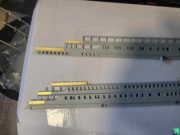

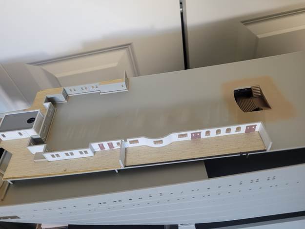

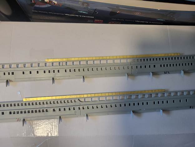

A Deck, deck veneers laid down, waterways and expansion joints laid down. I've been using white glue for all of it. It's flexible enough to allow for temperature differences, and seem to hold the PE better than CA glue...
https://i.imgur.com/R1P8tzd.jpeg
She's a big lady!
Still have to finish the hull plating at the stern, I will try with the metal plates again, but if that fails, I can add in the plastic plates from Midwest Model Shop.

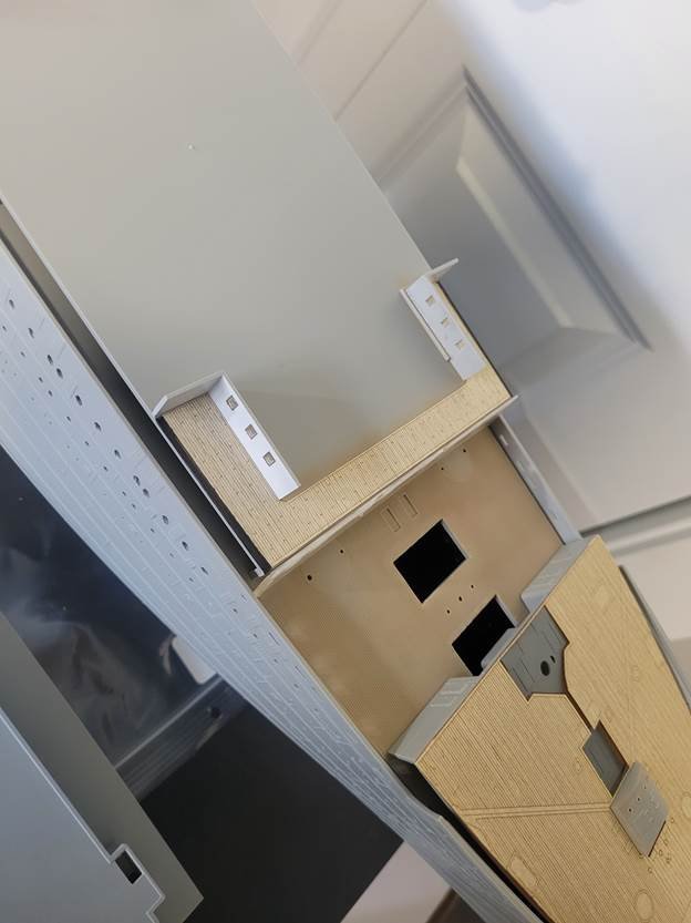

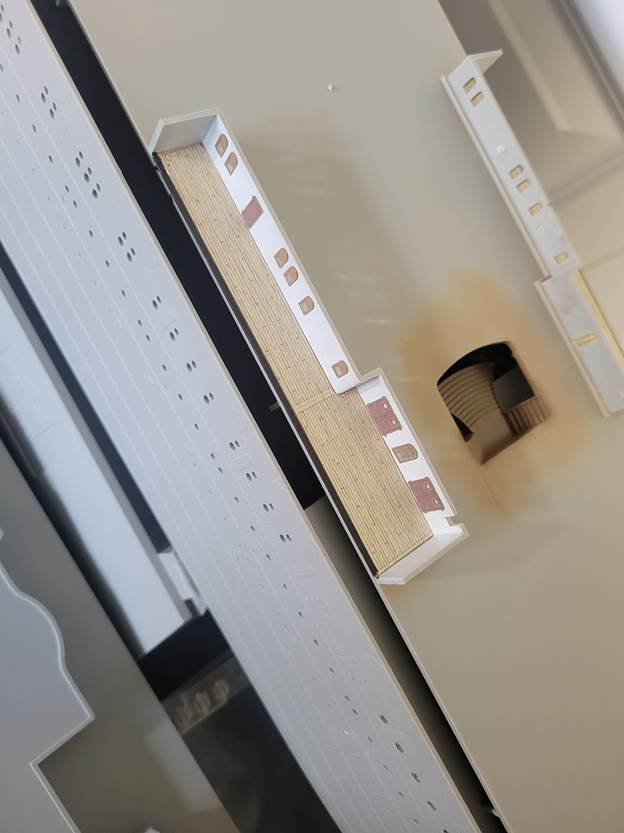

A deck structures:
One door missing, the handrails are a bitch to get/keep straight... Thankfully this will be behind a bullwark on A deck, 1 deck below the boat deck.
Some of these windows have the "stained glass" from the KA set... Micro cutting with very fine scissors on slippery plastic... NOT easy, but whatever! Looks really cool
The most time consuming part of any, is cutting the PE from the fret, cutting the nubs, then filing the nubs... There are 44 of the smallest windows on the longest structure shown... So there are TONS of windows. But, I  think this is an excellent primer to more advanced warships, because even though there is a dearth of PE parts, most are easy subassemblies requiring a single fold, if any. Or a gentle curve. So there are thousands of parts, but they're relatively easy to affix!
I'll probably eat those words later.

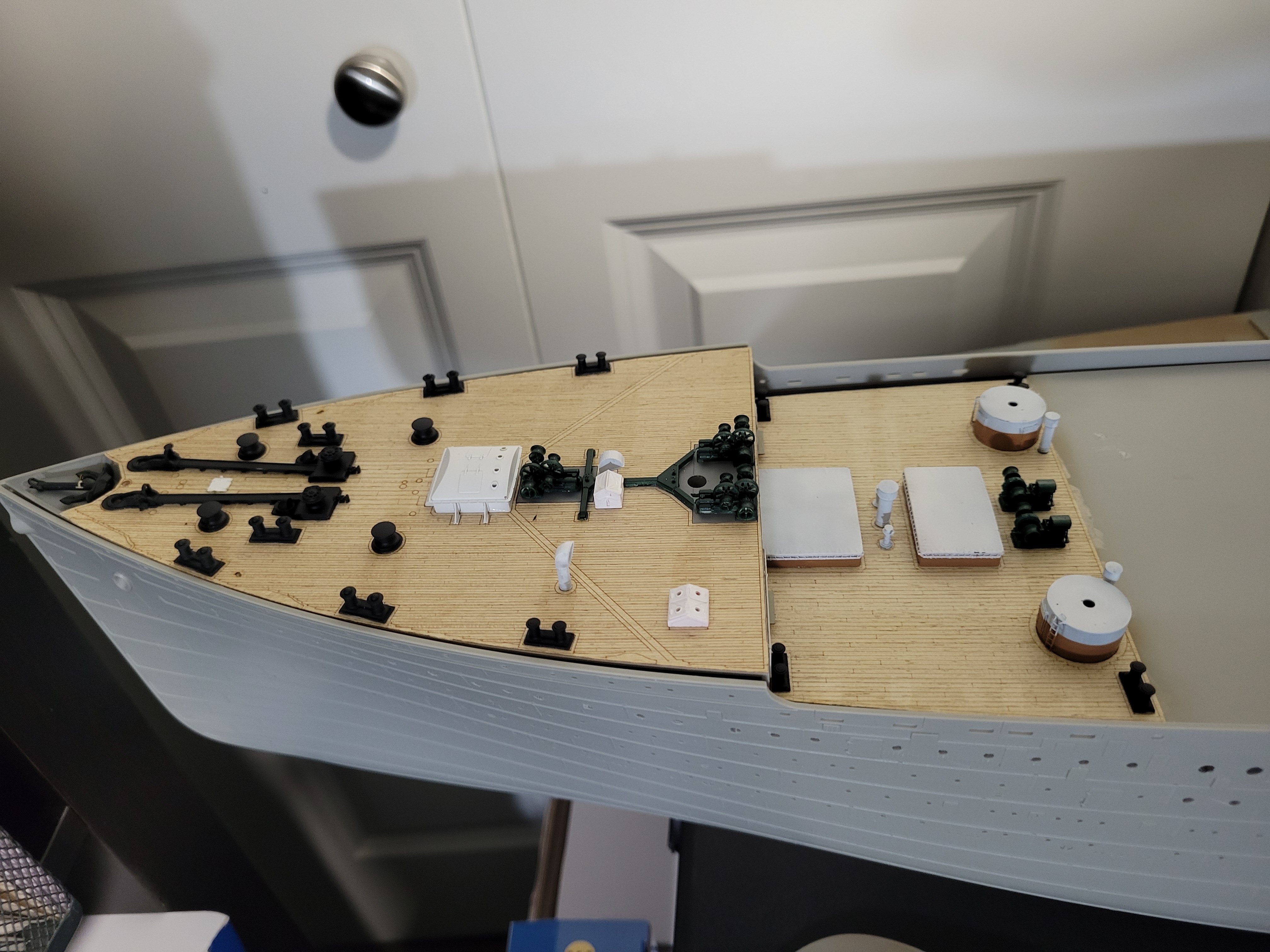

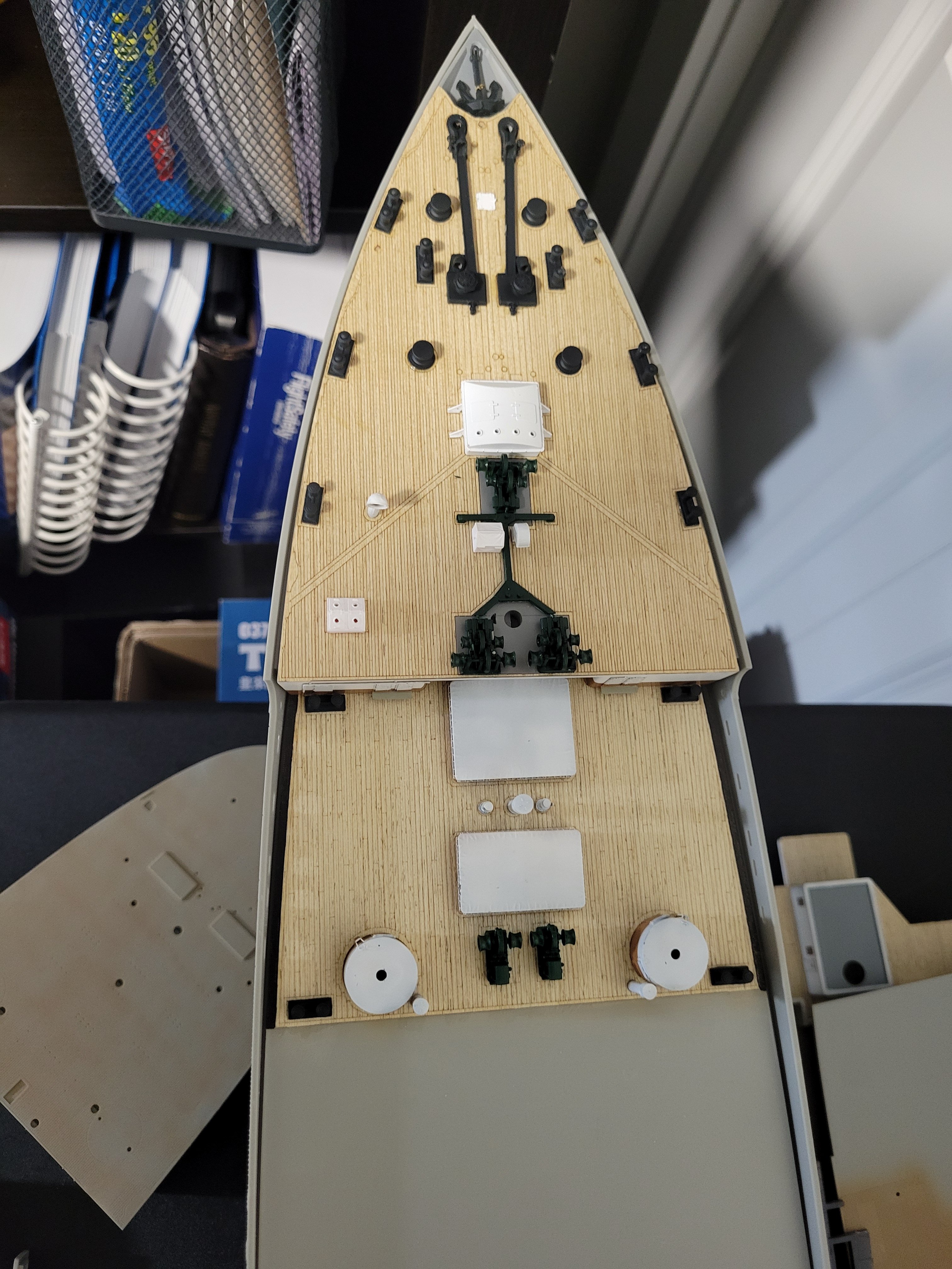

Minor progress... It's slow going, I did finally get the airbrush I need for the hull, now I just need to start on it, but it requires working in the garage... There's a ton of PE to attach, so I guess I may have to just bite the bullet and get at it... It's a little intimidating to say the least!!
Here is the Fo'c'sle and forward well deck, not 100% complete, but the stuff I can do without knocking bits off as I maneuver etc. good fun though, and it looks good! a chunk at a time is how we do it!!
