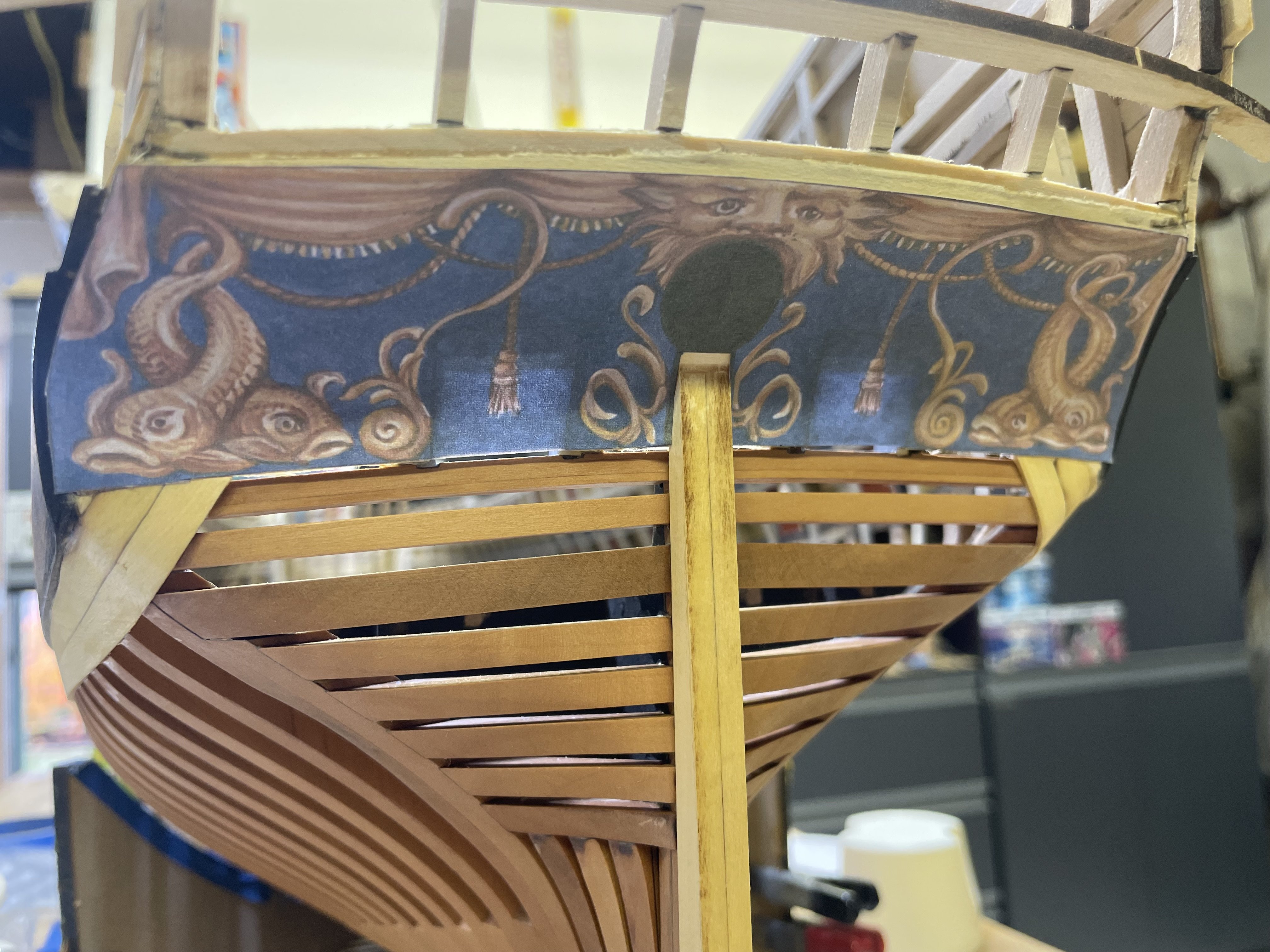

But I did have a success with the lower counter frieze and the boxwood molding. After some manipulation and multiple prints I think I have it where I want it and it fits pretty good. Some minor trimming required but nothing serious.

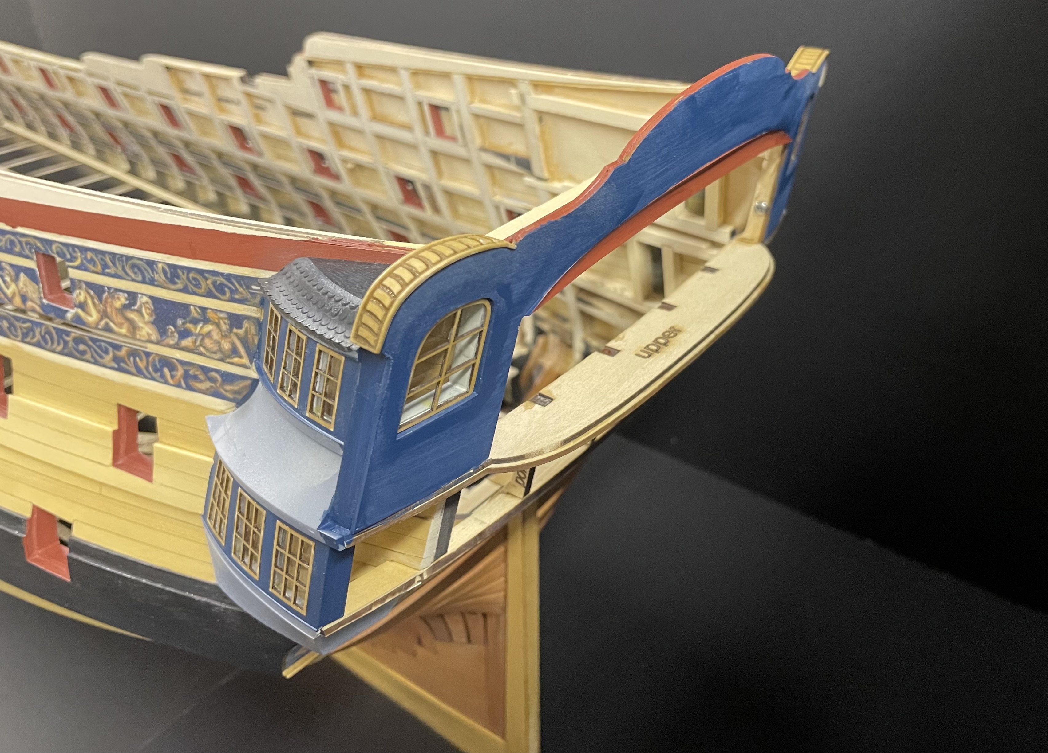

Some updates:

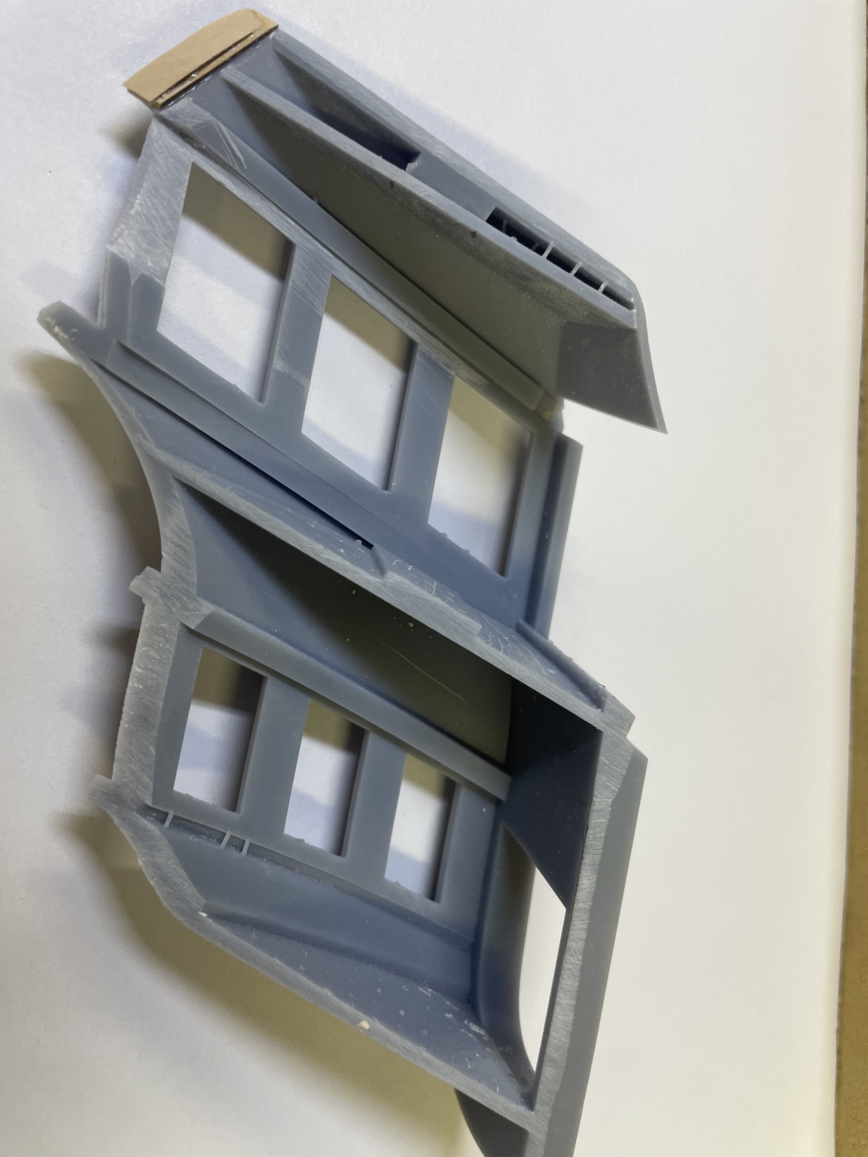

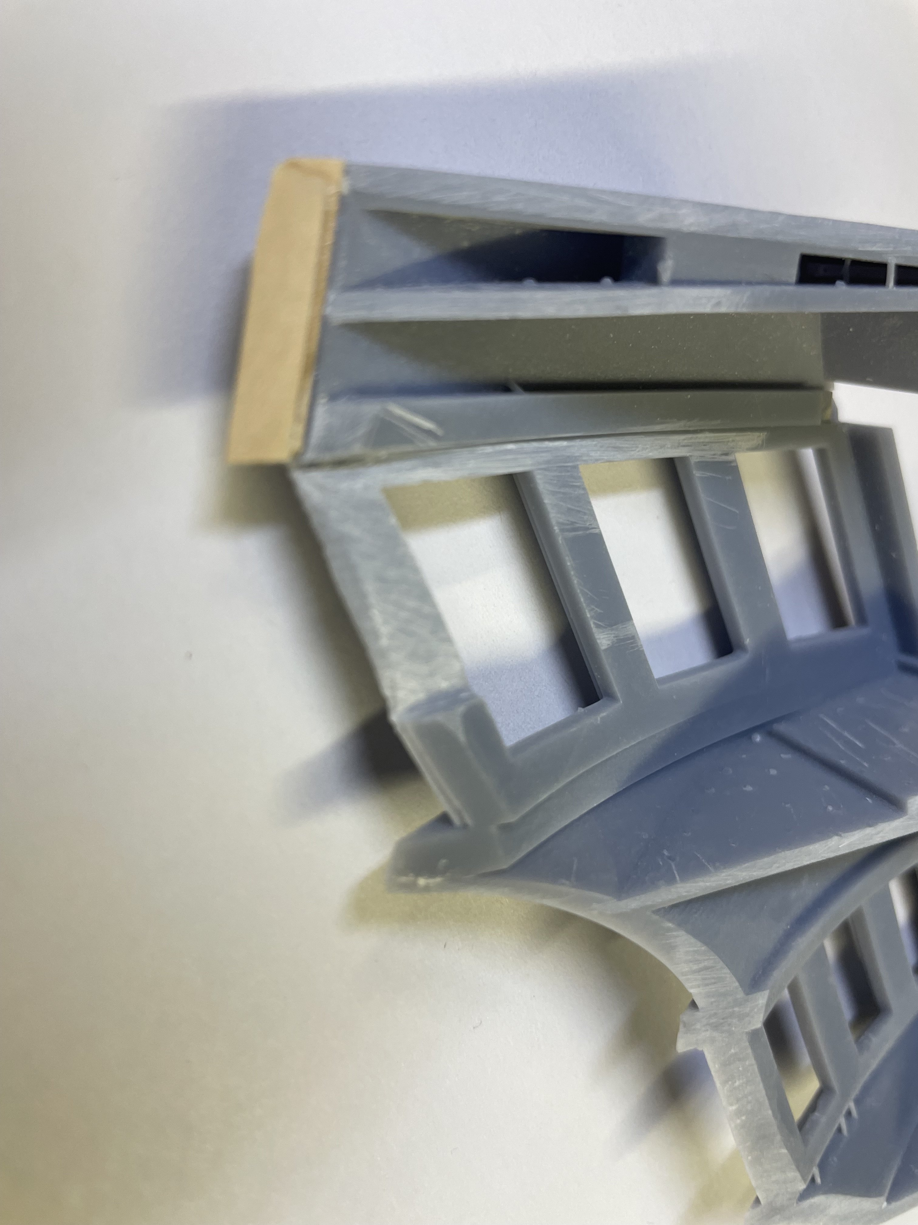

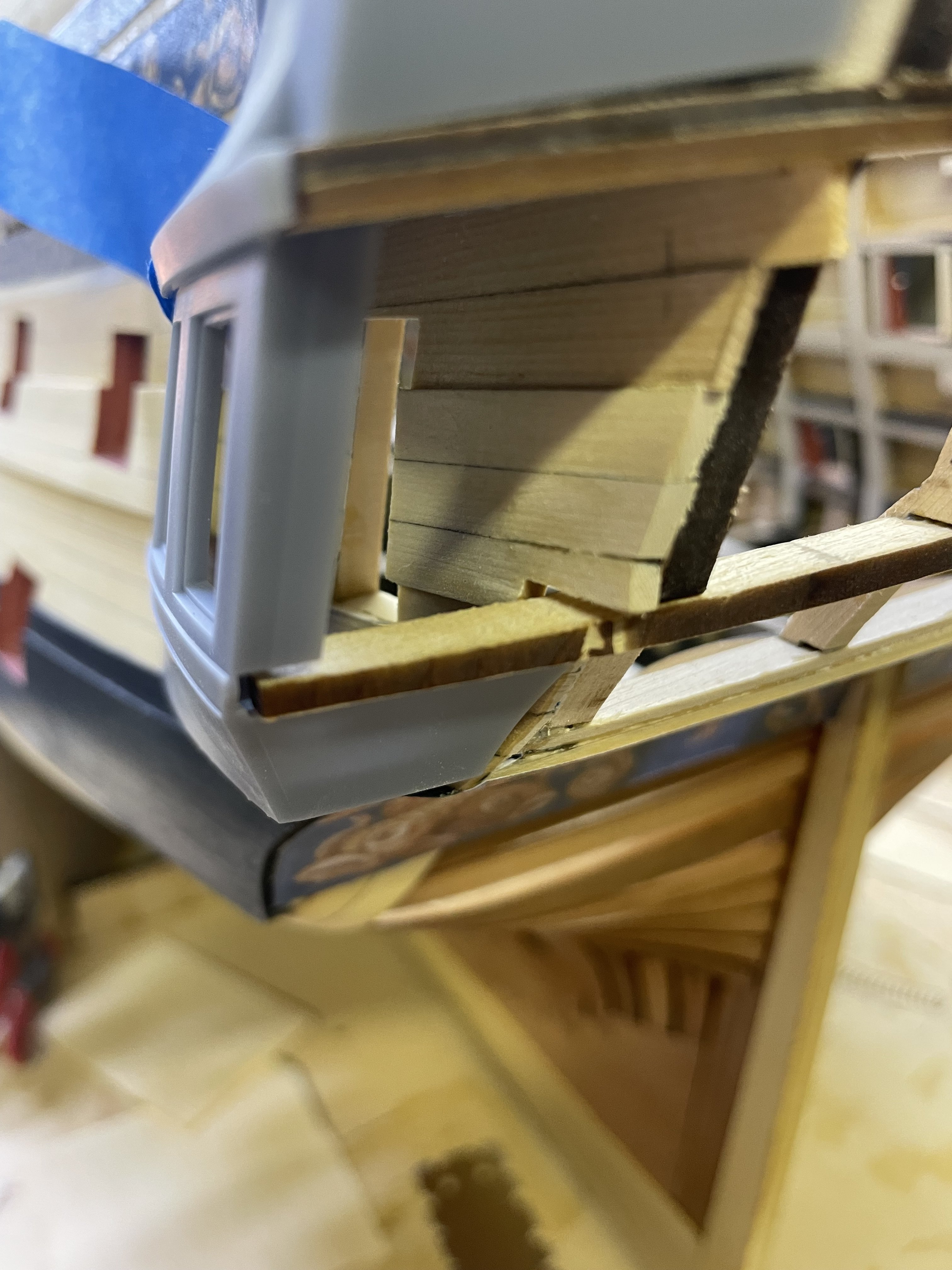

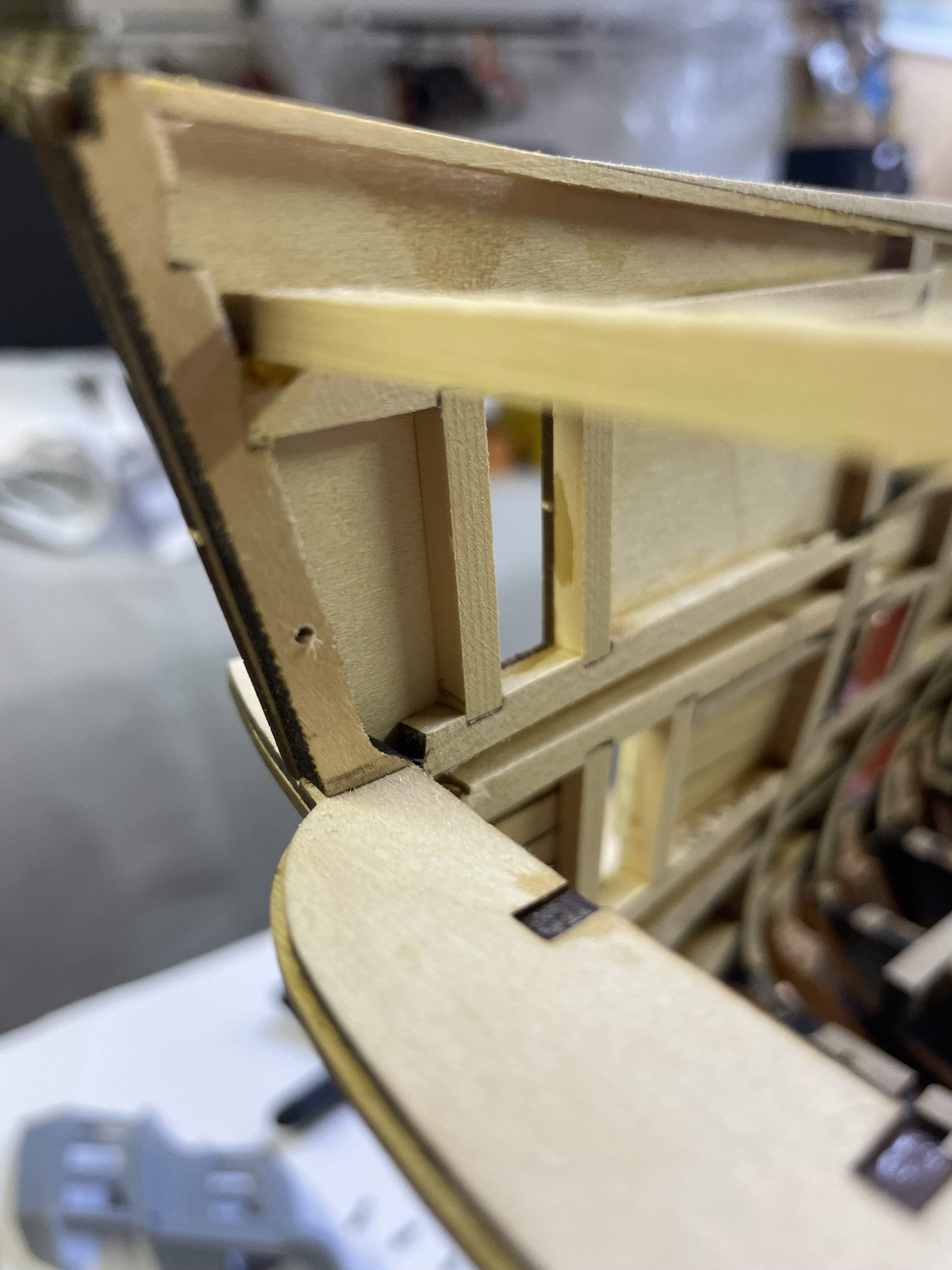

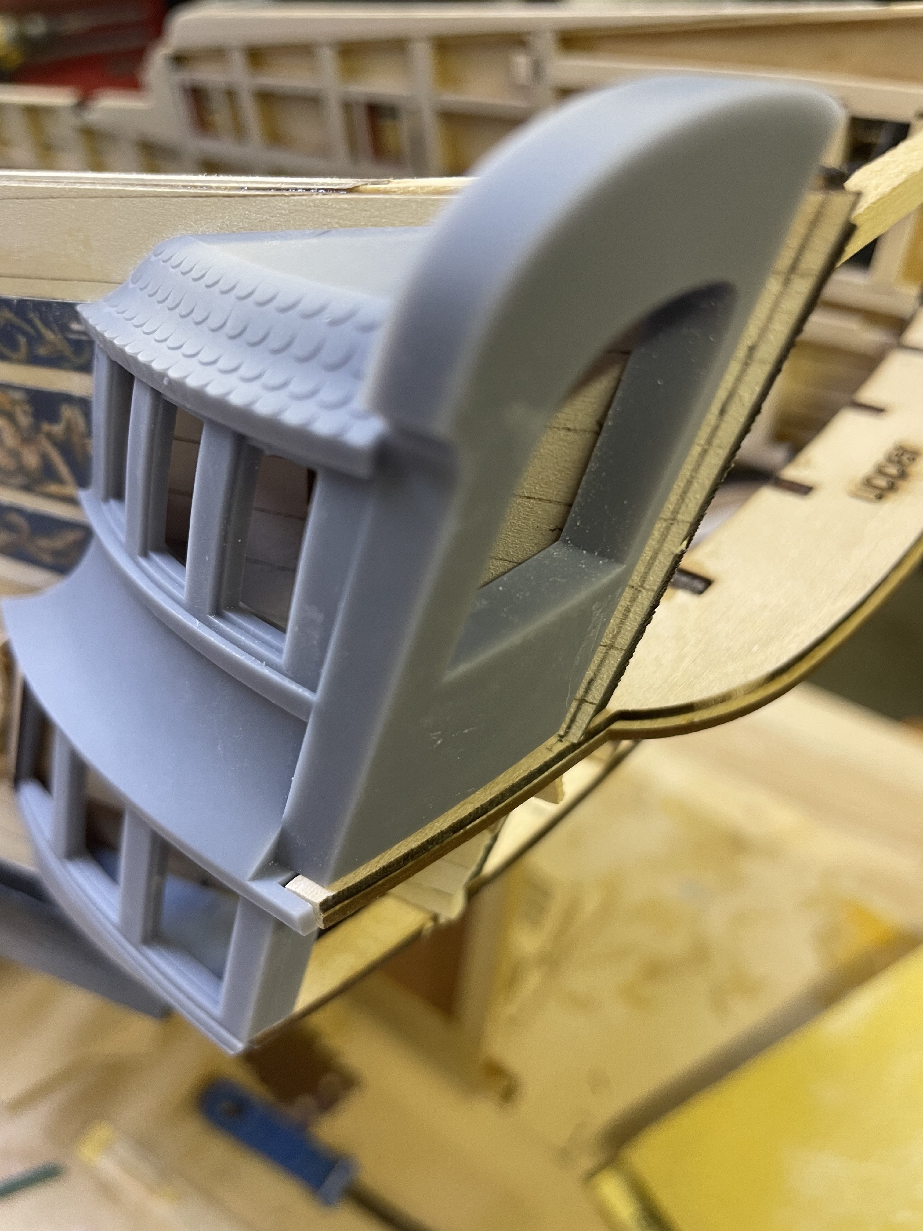

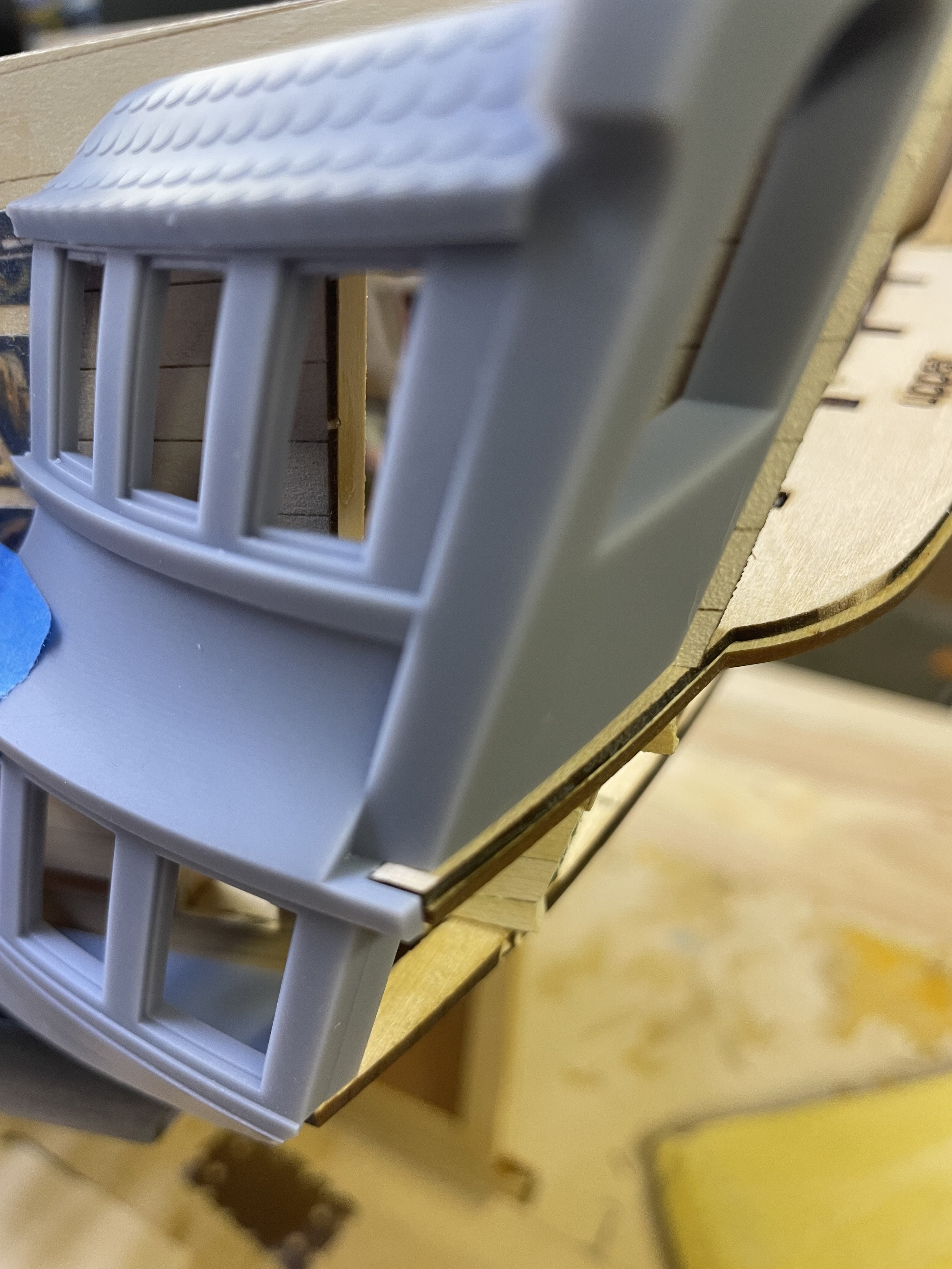

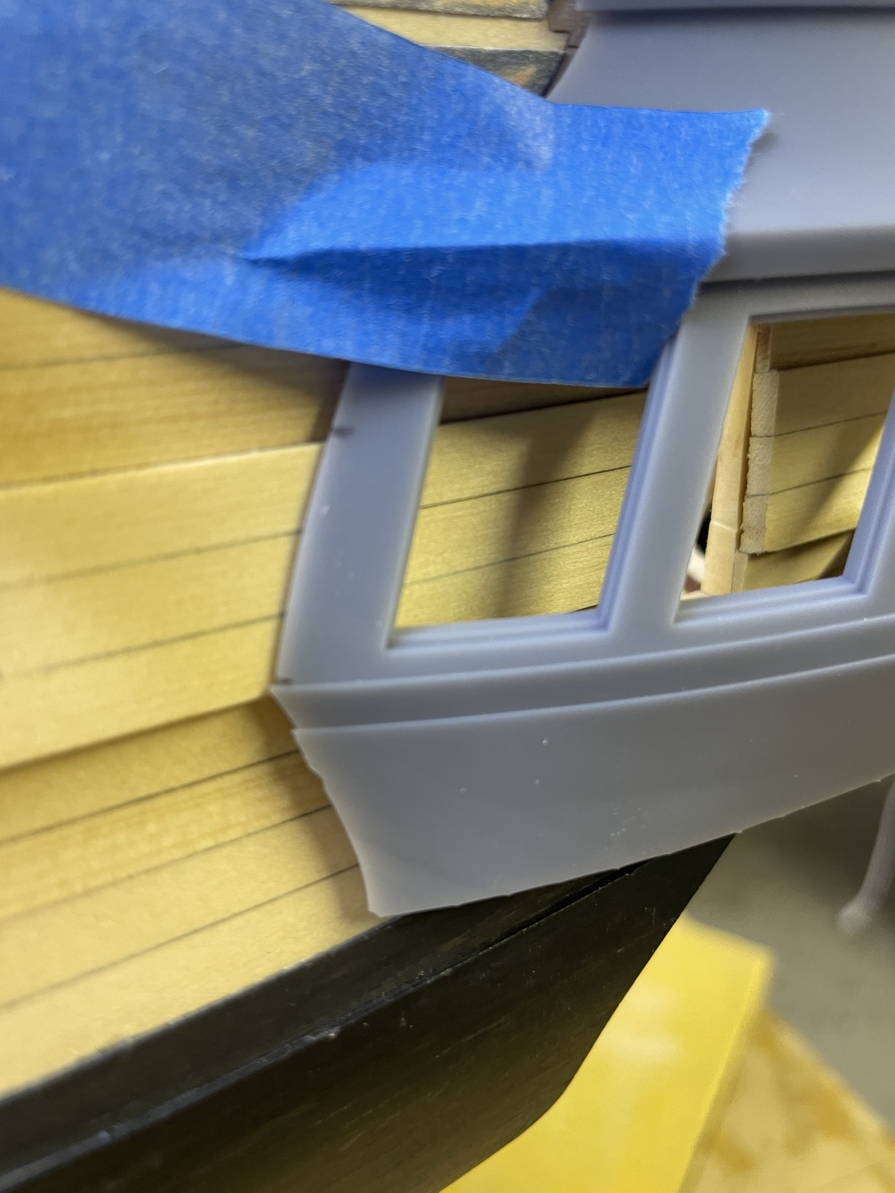

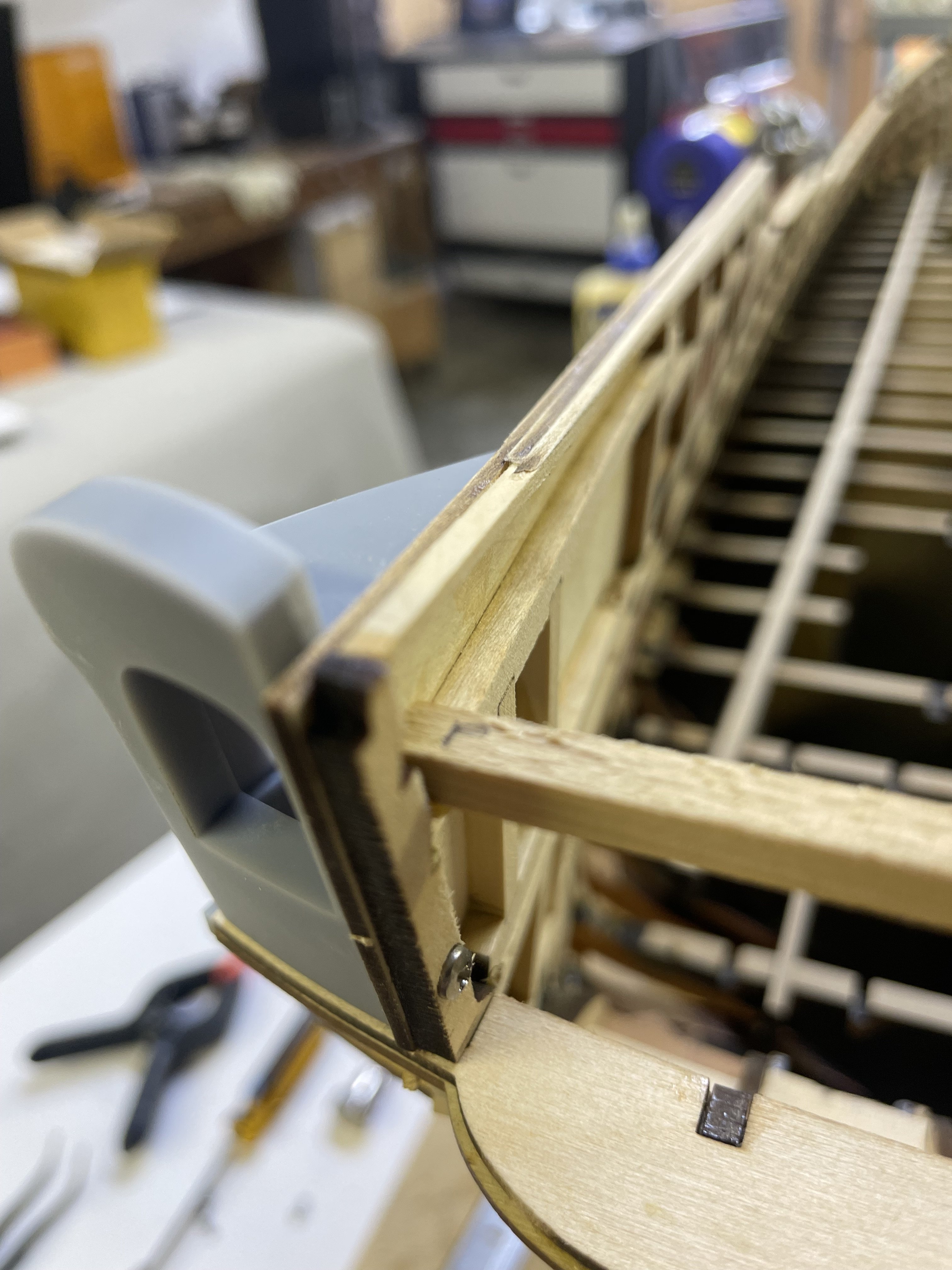

So I started assembling the Q galleries and attaching them to the model. This is a very tricky part of the model and requires a lot of patience and attention. It will be emphasized in the instructions!

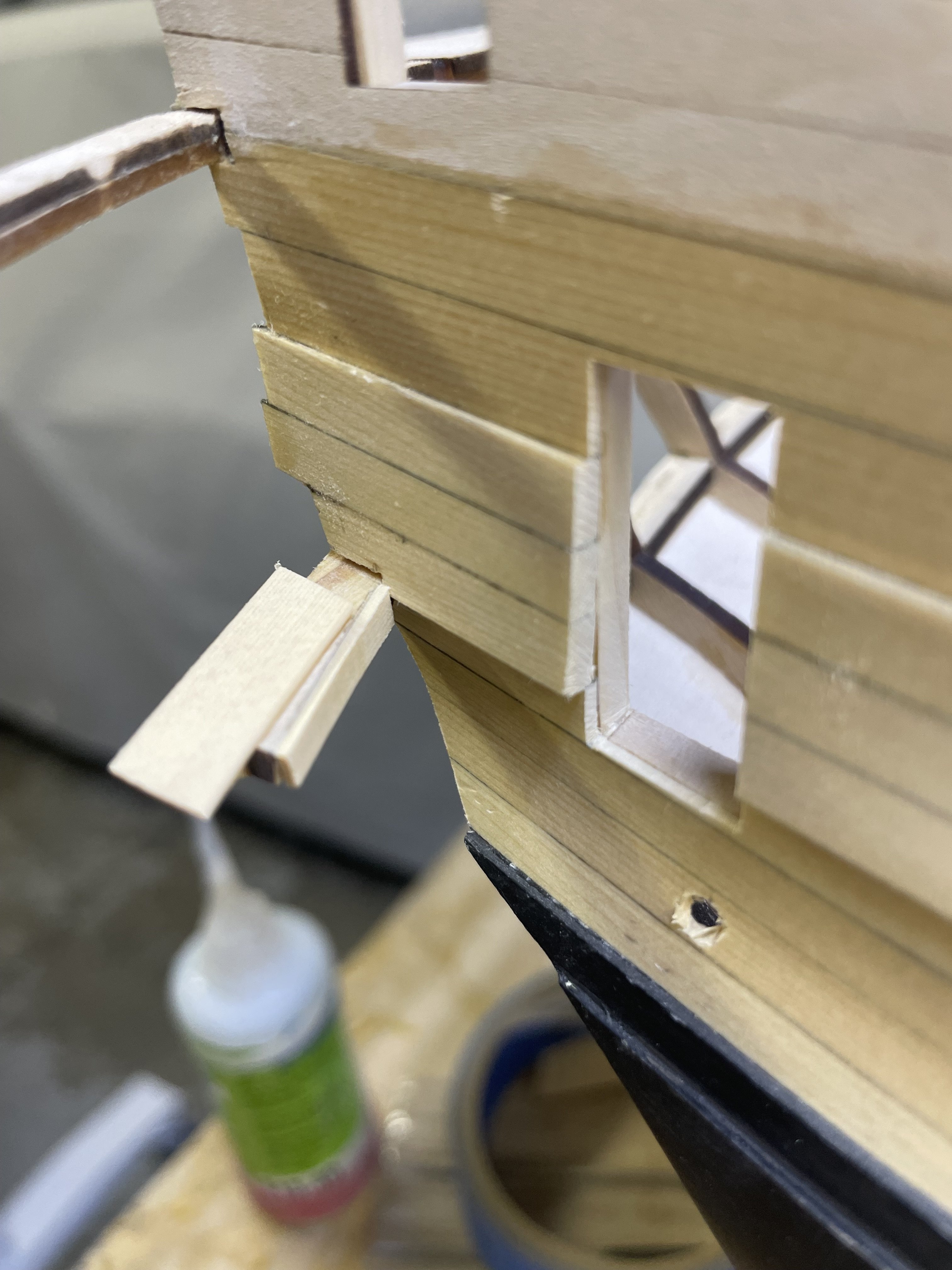

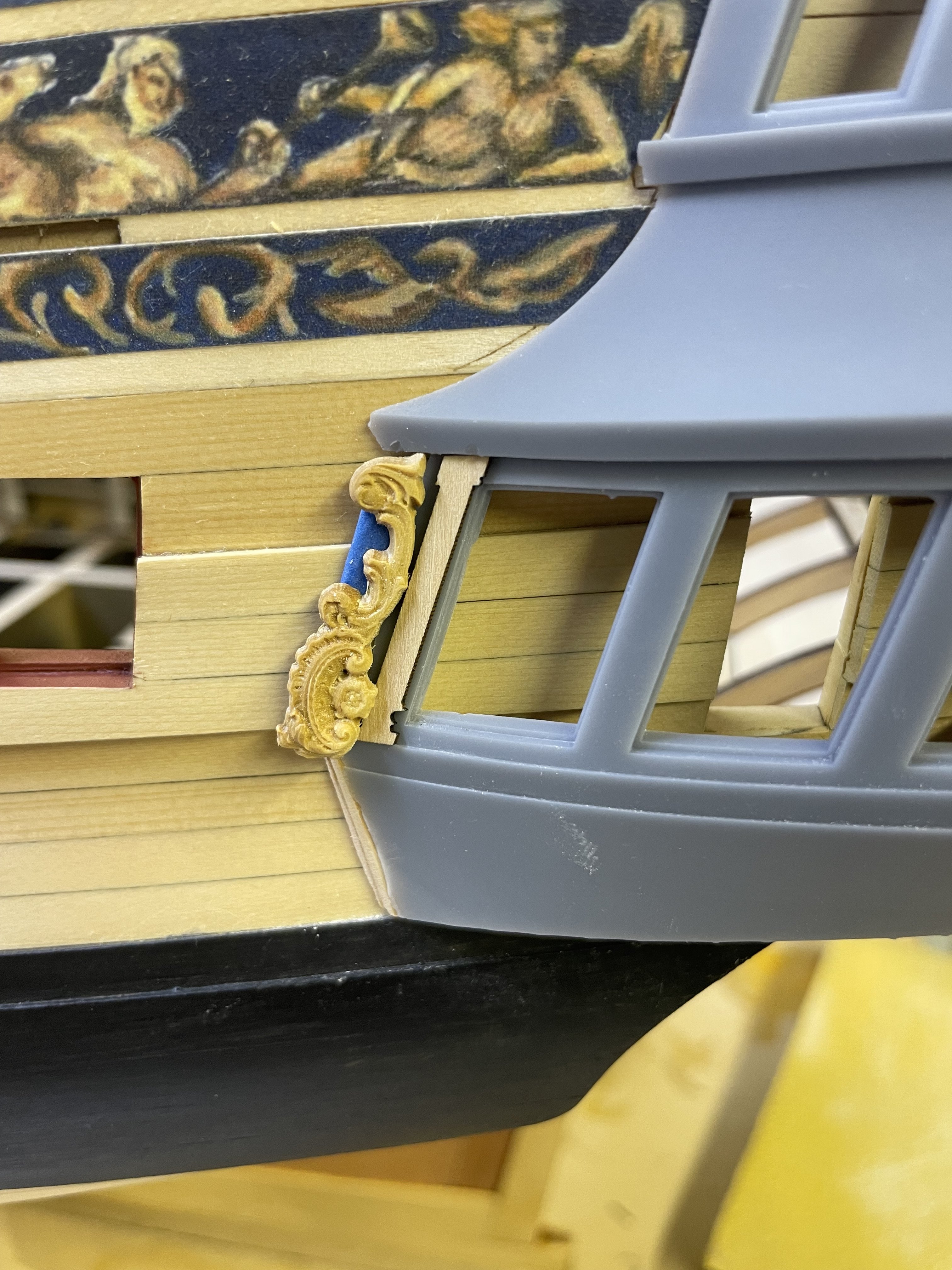

Begin with fitting the q galley on the model and marking where it needs to be filed to clear the channel wales,
go ahead and file and sand until the part fits pretty tight against the side of the hullIMG_0032.thumb.jpeg.af3beb55c28bac1c3b179e681e68705c.jpeg
i had to add a little bit of boxwood strips to the lower edge, my channel wales are probably running a little thick.
Test fit several times and make sure the q galley is sitting down correct on the beams as shown below as well as in the notch on the lower beam.
above You can see how the gallery fits up against the balcony beam. Make sure it’s just like this.
A lot of clearance is required for the channel wale so take Time to file it down right.

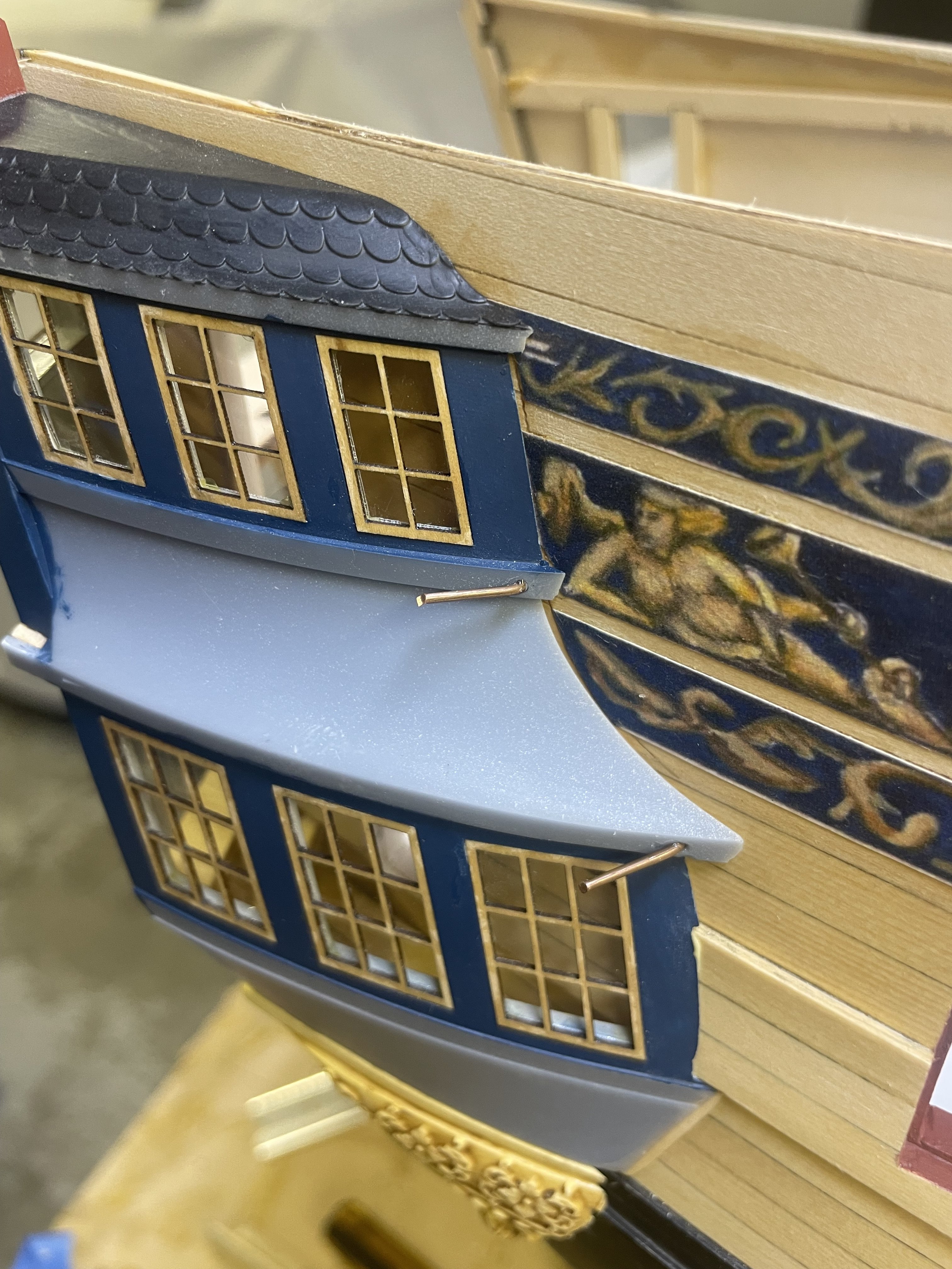

once everything looks good you can make sure that a column fits on the forward lower window as well as the carving, the carving covers up a lot of sins so if you chip and edge of the q gallery don’t stress too much.
below you can see the balcony beam hangs out about 1/32”, this is required for the transom panel to sit on, later after we get the galleries attached.

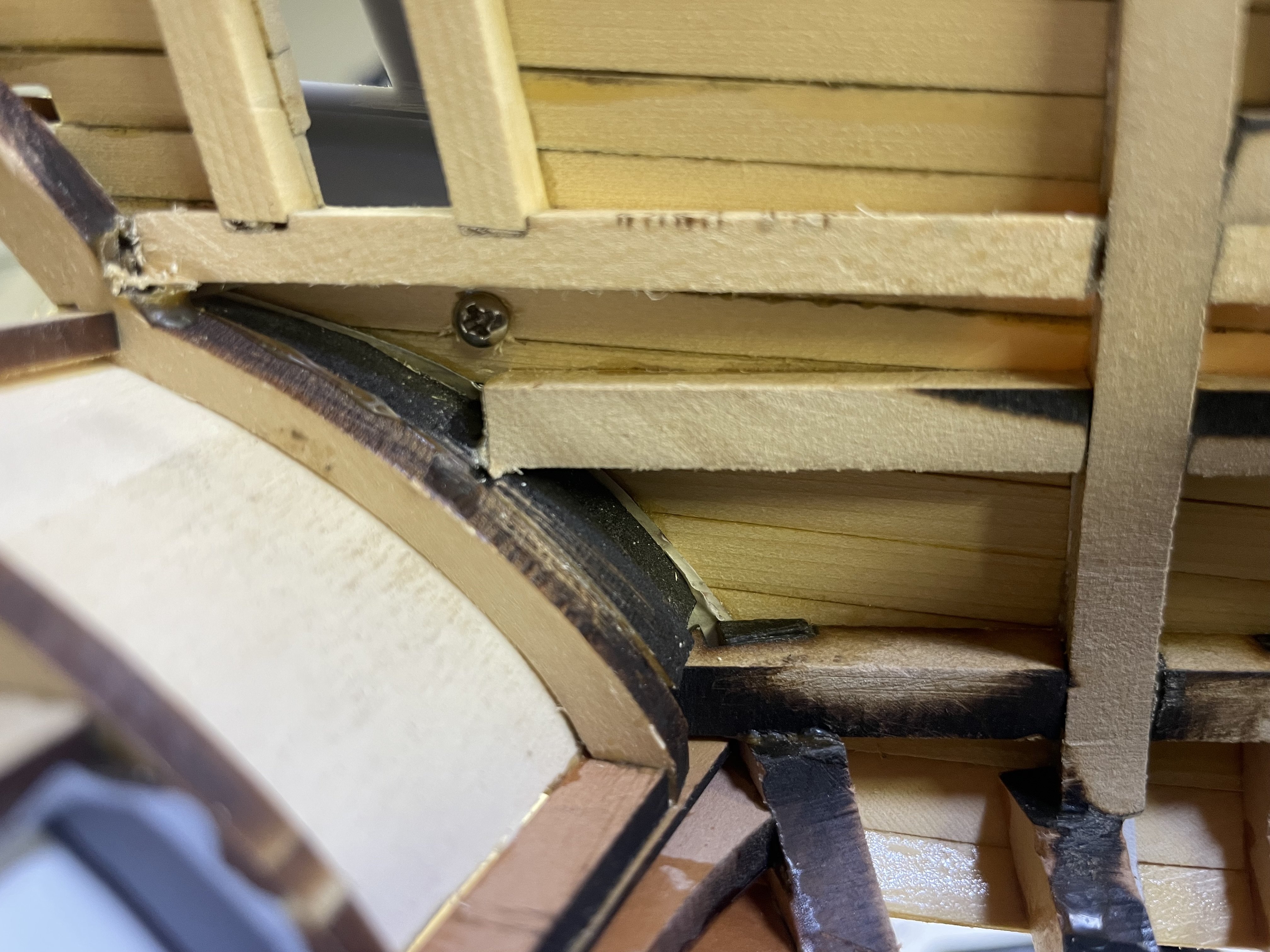

above, looking in the lower gallery you can see where the lower beam notch fits into the Q gallery, make sure you have that fit. It needs a little convincing to pop into place sometimes so take your time.

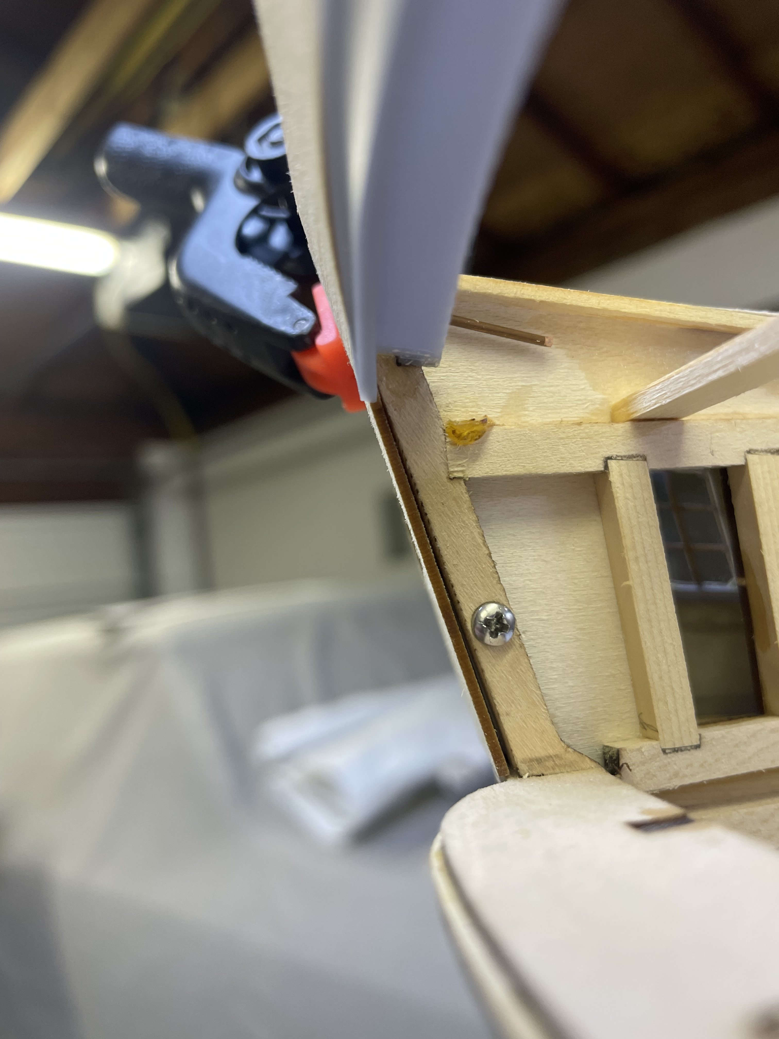

Below is where I drilled a hole to screw the upper part of the gallery down, I used tiny machine screws I found in the hardware store, anything will work as long as it’s small enough. I screwed them down in two places and this is helpful when taking them on and off frequently to test fit.
below is where I screwed the lower part, the q gallery has a solid block built into it for accepting a screw. Carefully mark out on the model where it’s located and drill the hole through, carefully mark on the part where to drill and then drill the hole when you take it off.

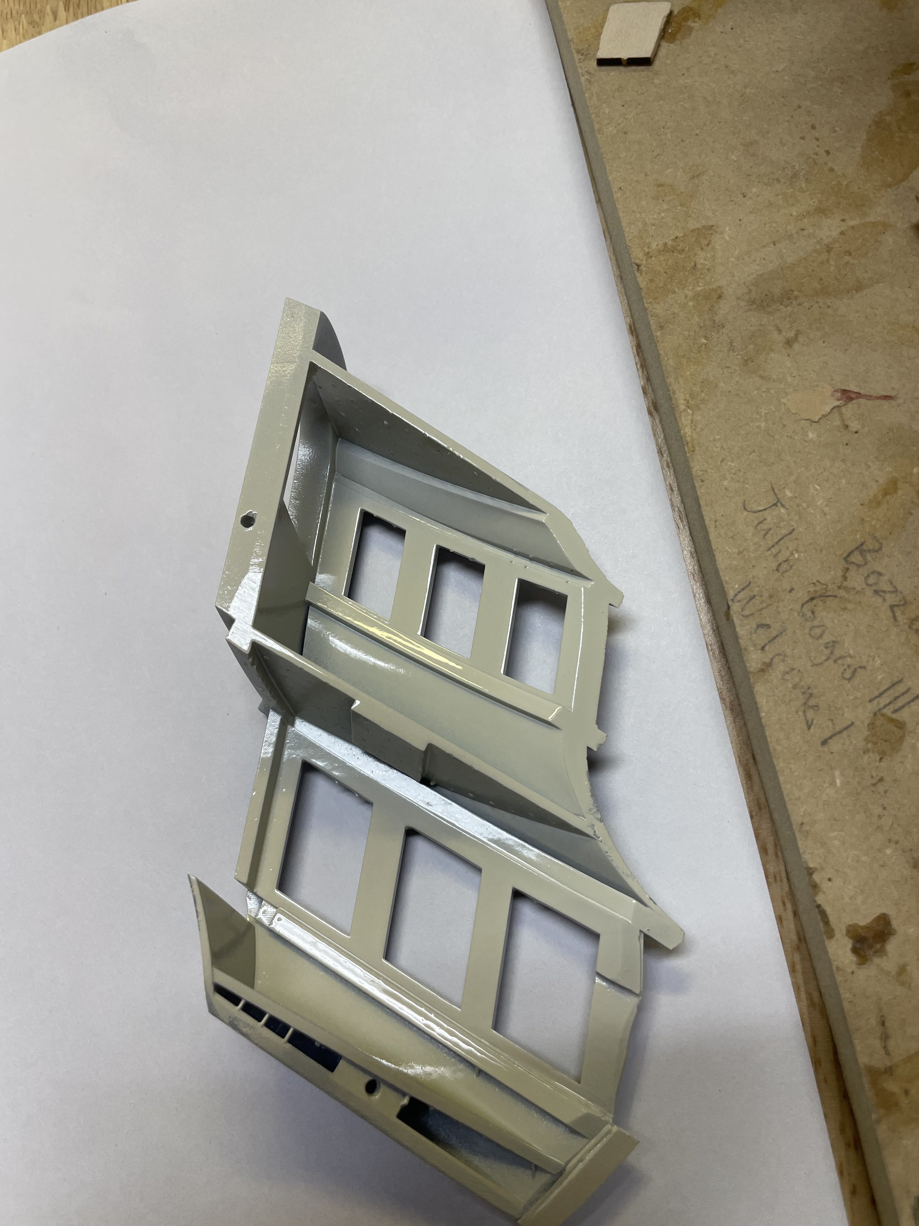

once the gallery fits well I went and painted the inside, I used an ivory white with some weathering compound to age it a little. Once it’s dry we can begin adding the interior parts.

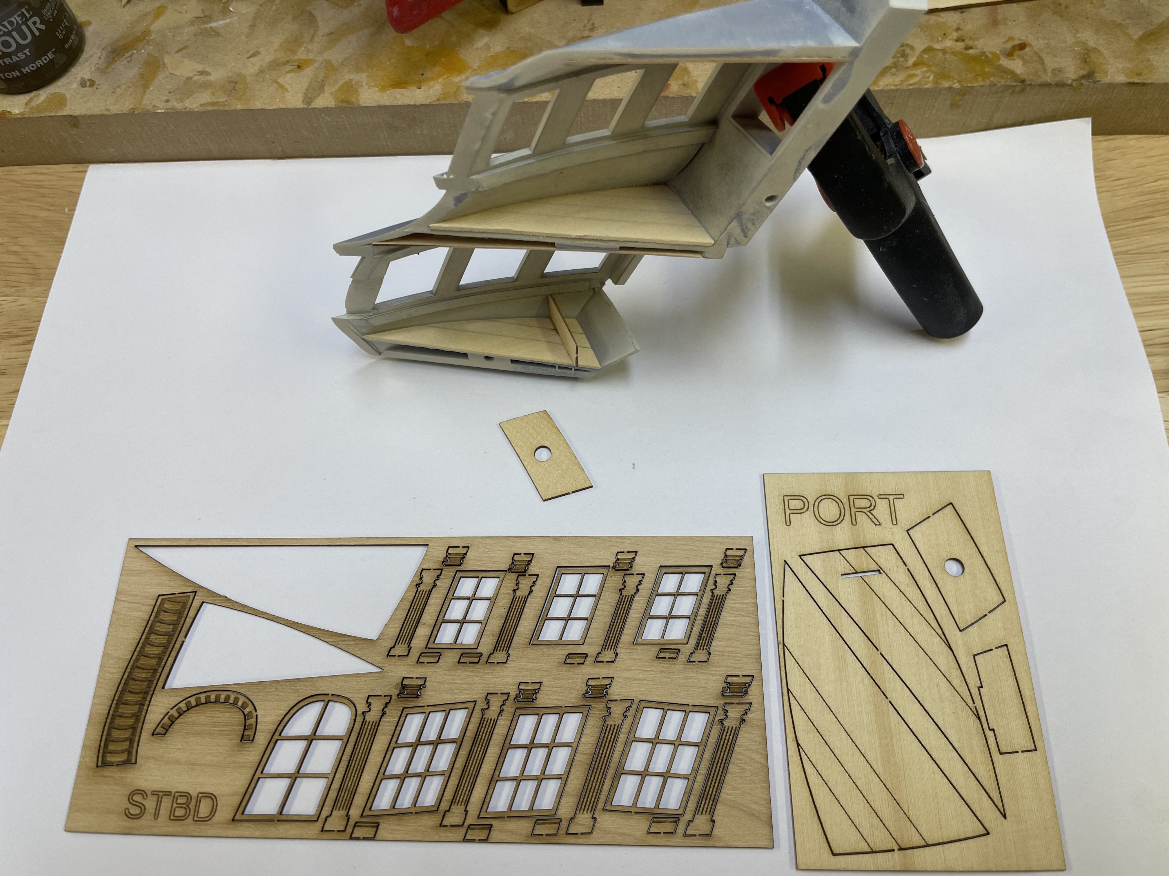

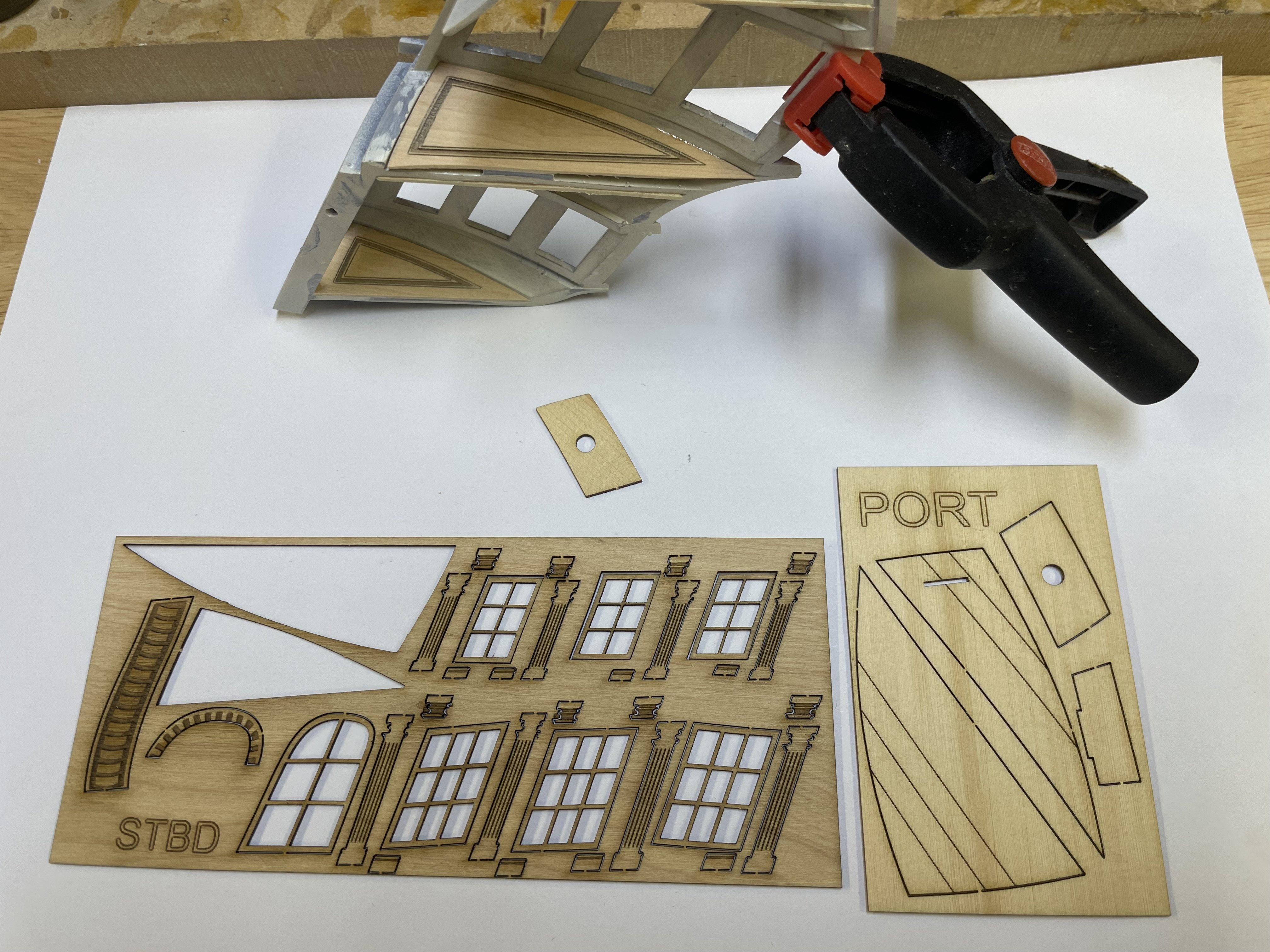

Outfitting the QG’s.

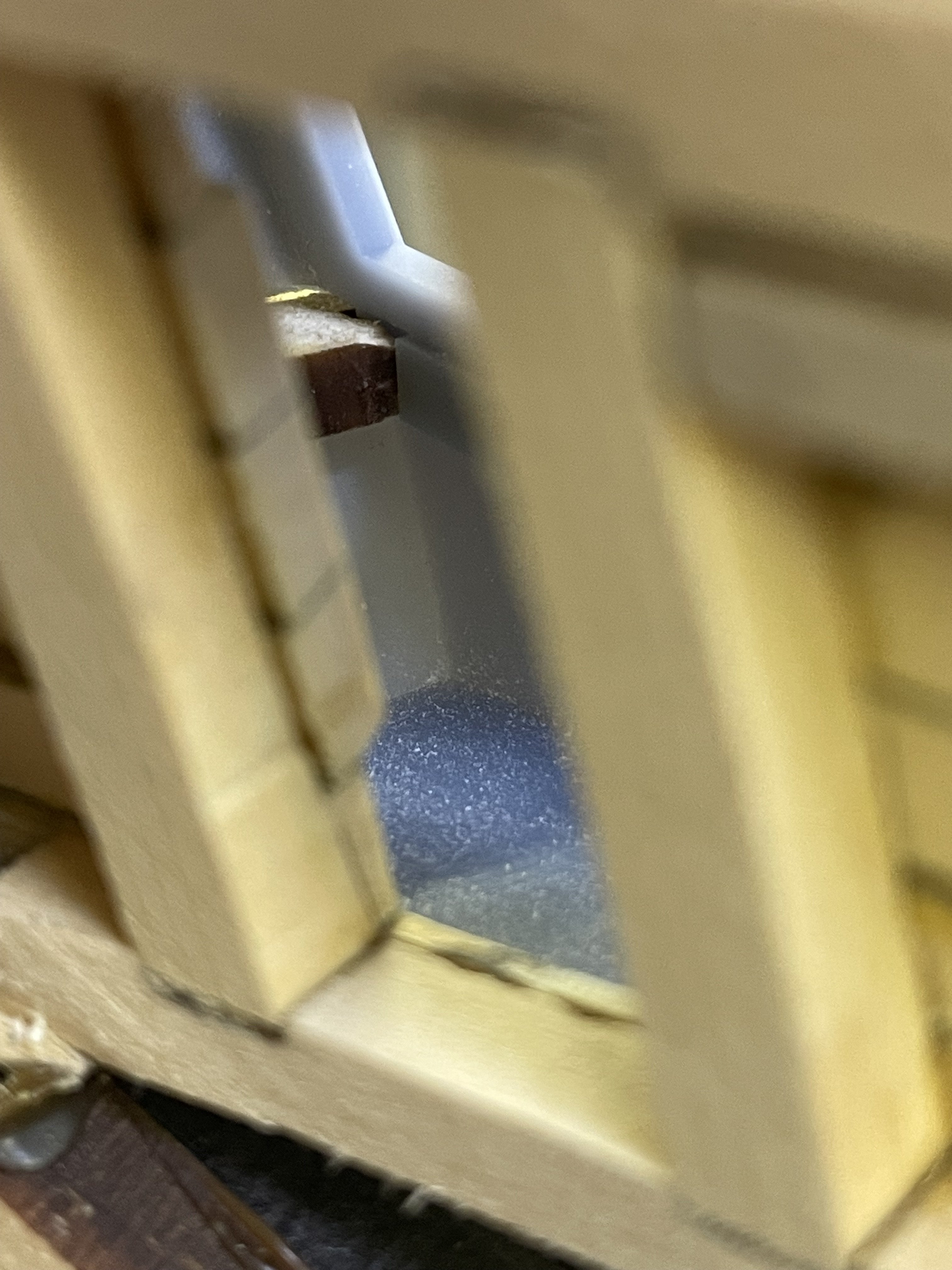

before I permanently attached the QG’s I painted them and fitted the interiors. You won’t see much but I added some panels and the head, I wanted to hide as much 3D print as possible.
below are the parts to outfit the QG, we have the window frames, the columns and the head. Also I have some etched flooring as well as ceiling panelsIMG_0073.thumb.jpeg.709655e77d2b589927415cb8796eeb64.jpeg
in the photos you can see the flooring and overheads going in, along with the toilet. I will cover this more in detail in the instructions.
below we have the lower beam, since it will be visible through the windows I doctored it up with some thin AYC leftover from planking, I added a little shelf that will go over the head.

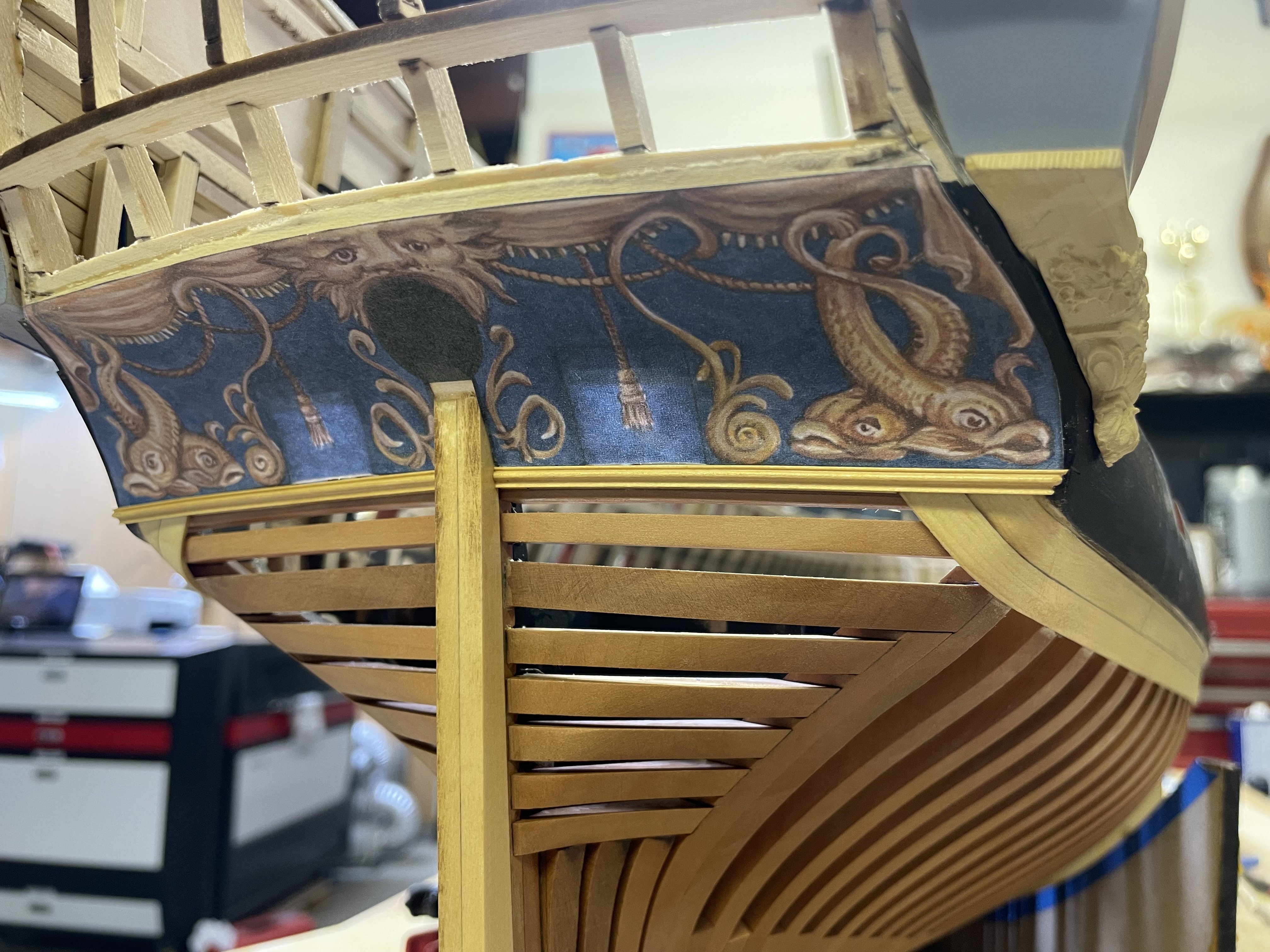

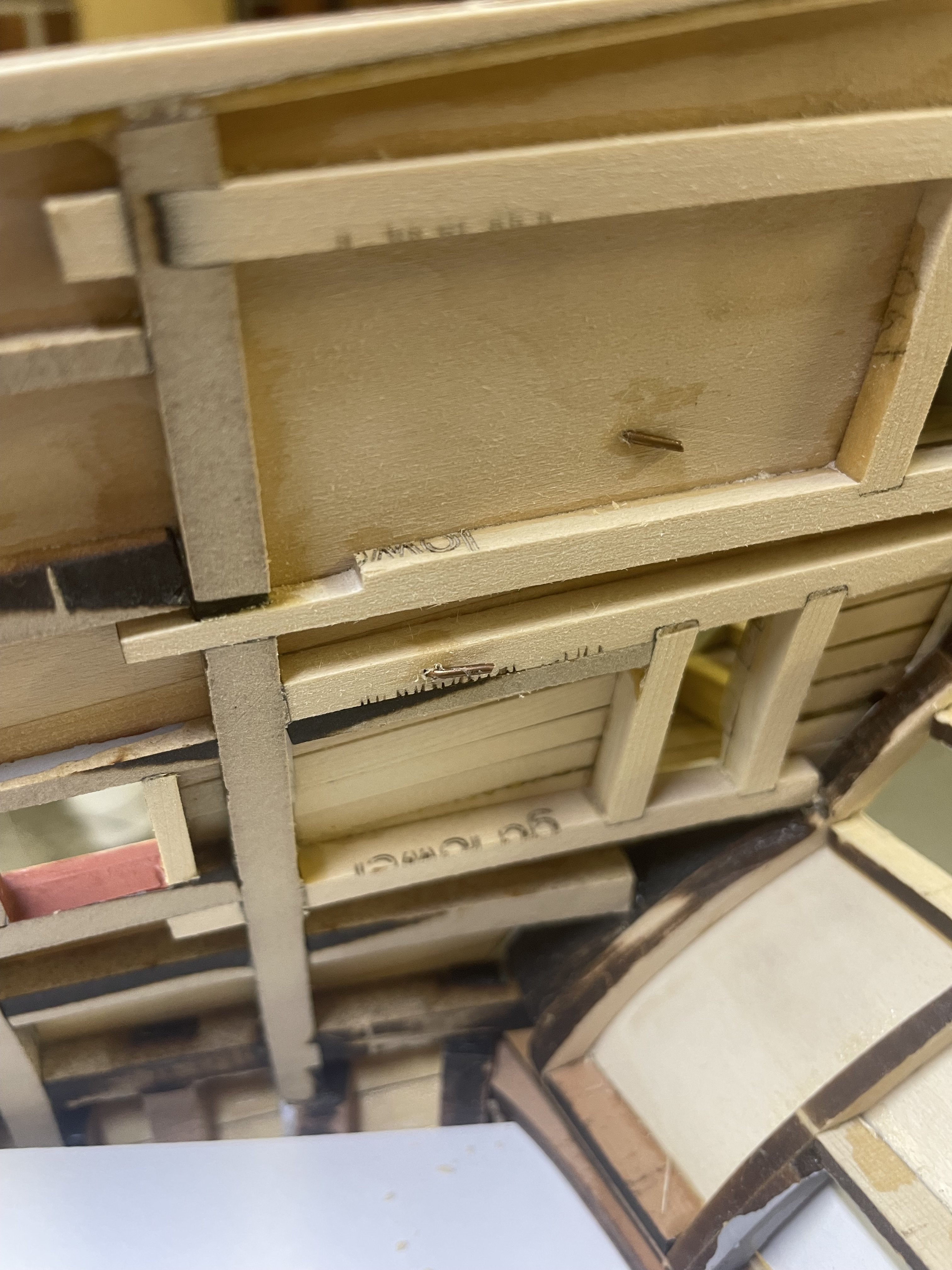

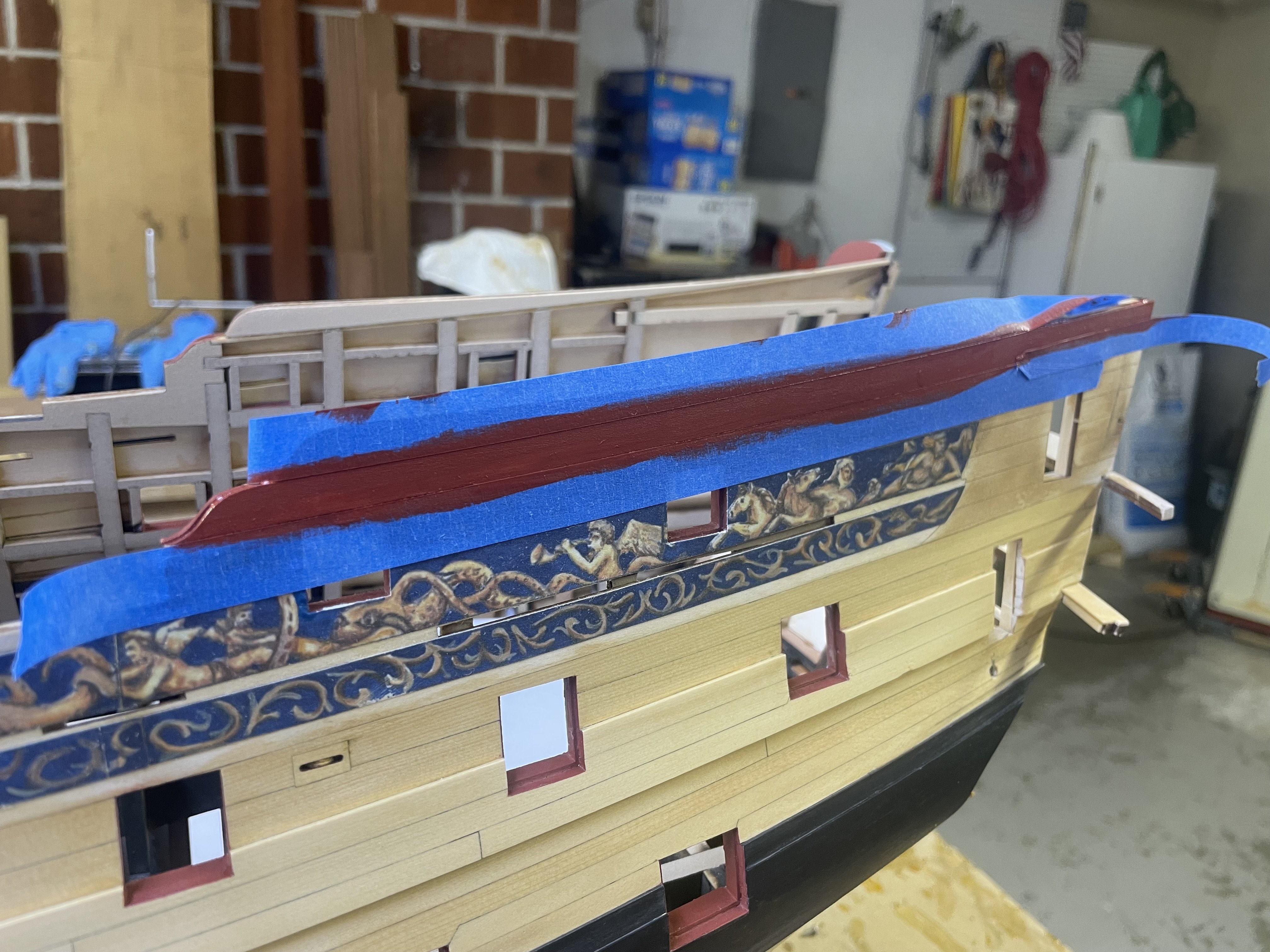

Before fully attaching the QG, I went ahead and taped off the frieze panel and painted in the red area, this way I don’t have to mask the QG.
after that was completed I went ahead and double checked The fit, made sure to sand down the added panels so they fit against the hull. Once that was completed I attached the QG, I screwed it down and then I pinned it with some copper rod (.040”) and CA.
once firmly attached I used flush cutters on the soft copper and carefully filed down the rest.
on the back side I just folded the pins over, except where there will
be interior paneling, once the ca cured I flush cut that end as well and filed it down flush.

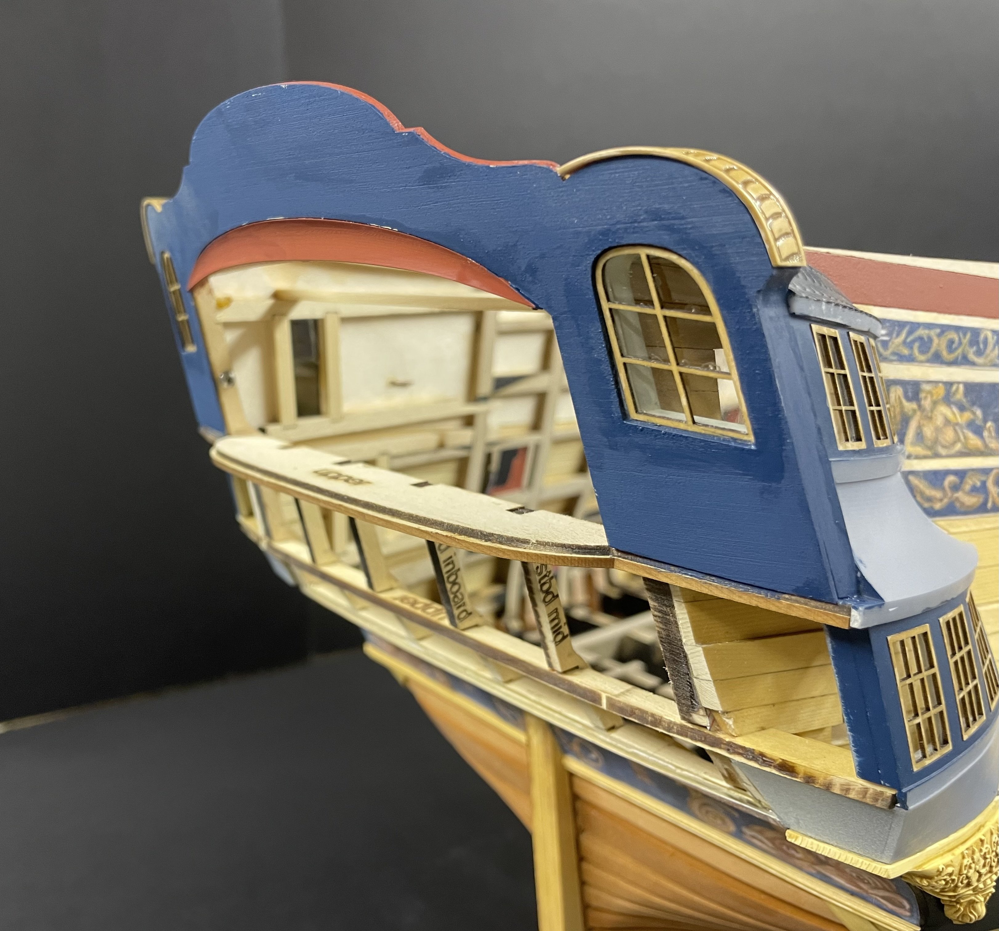

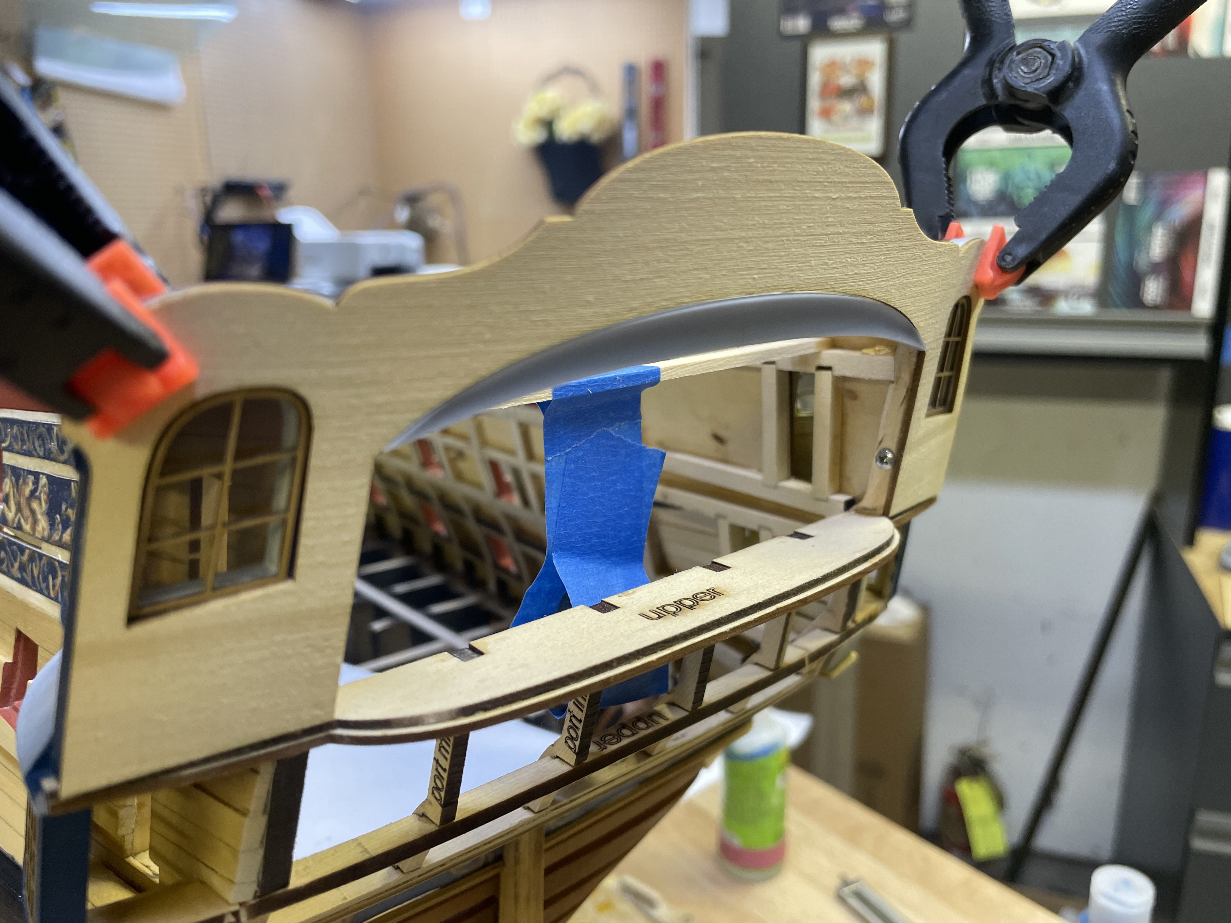

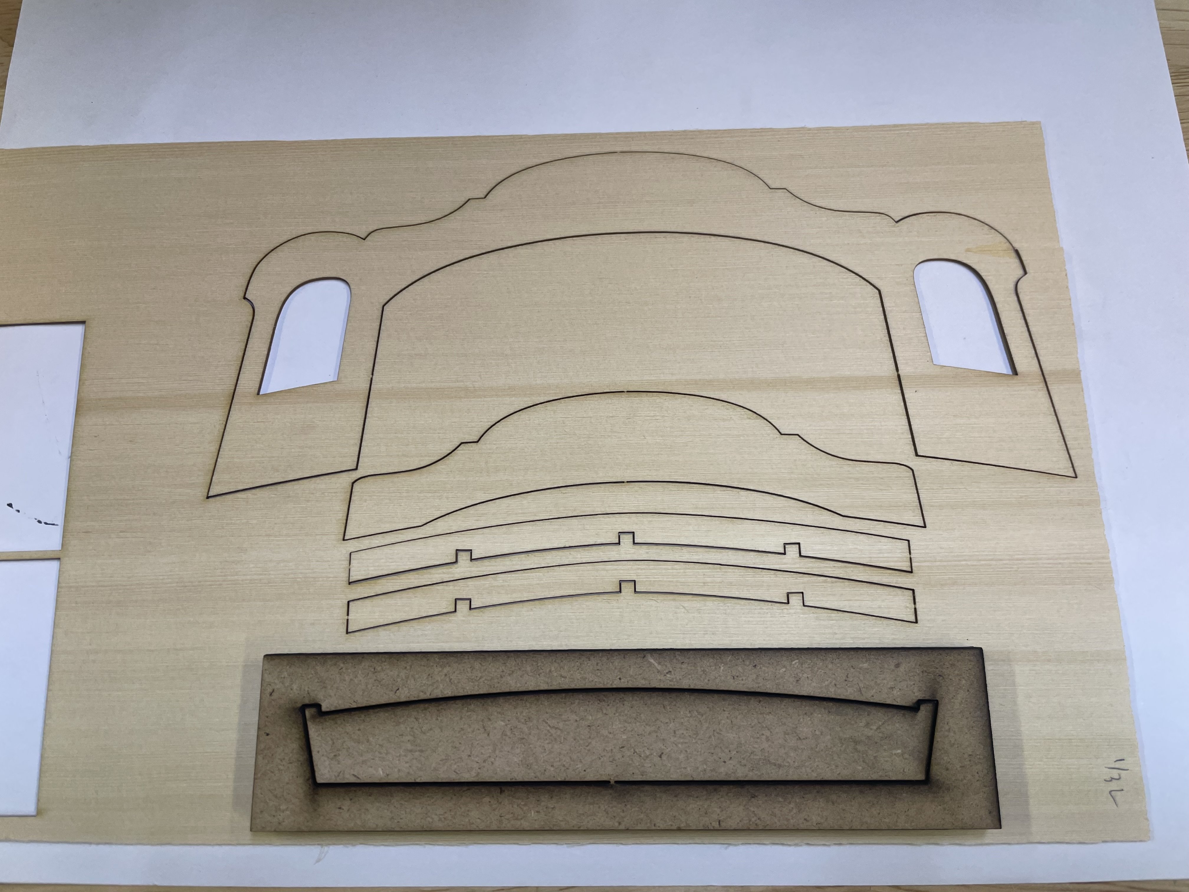

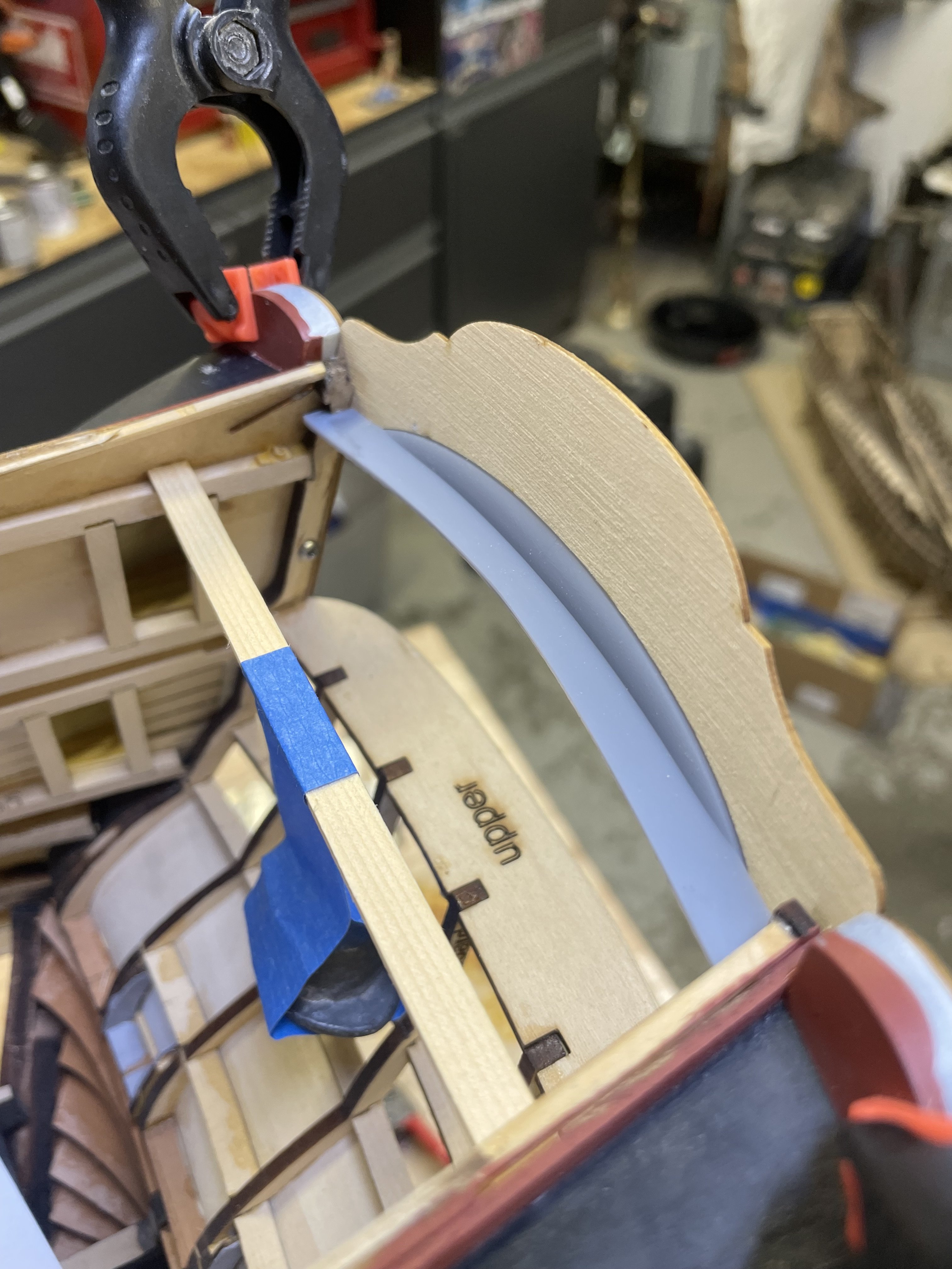

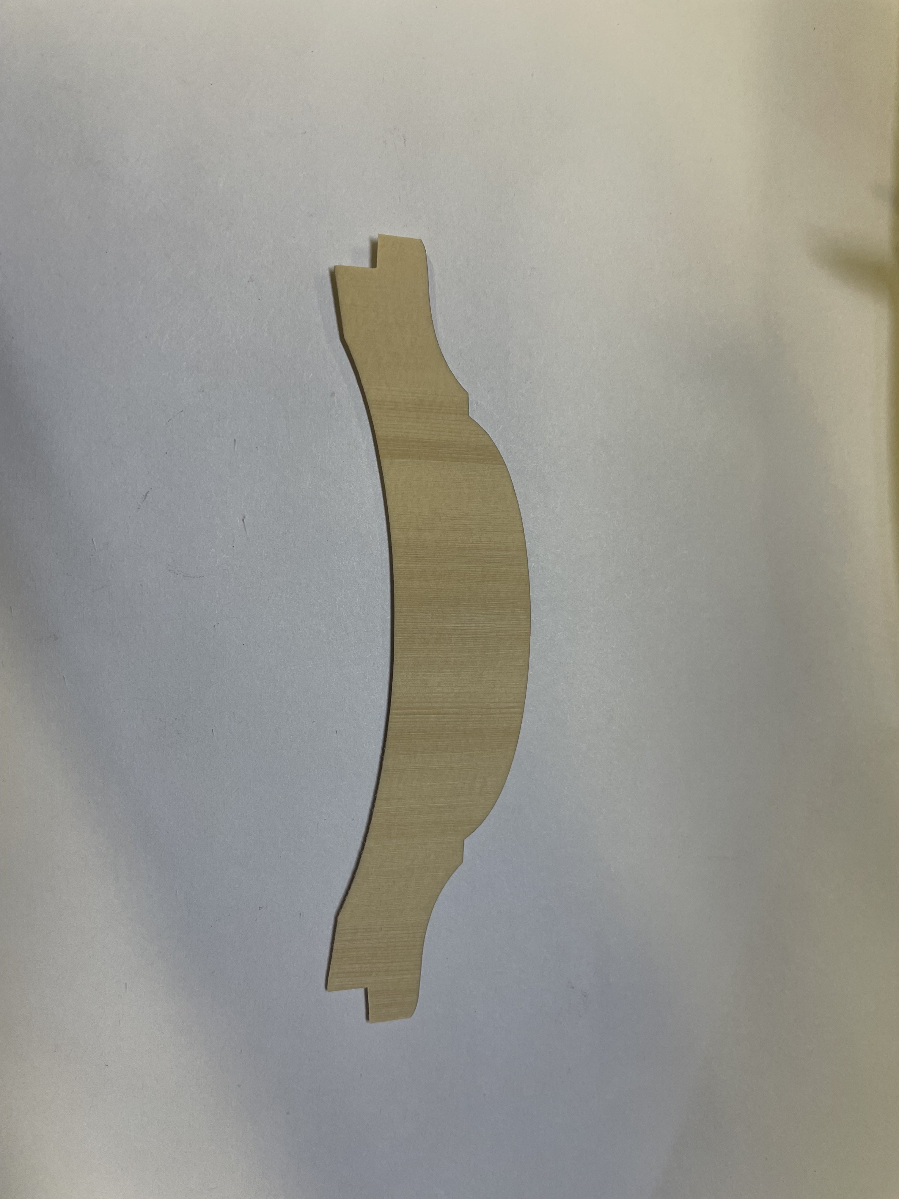

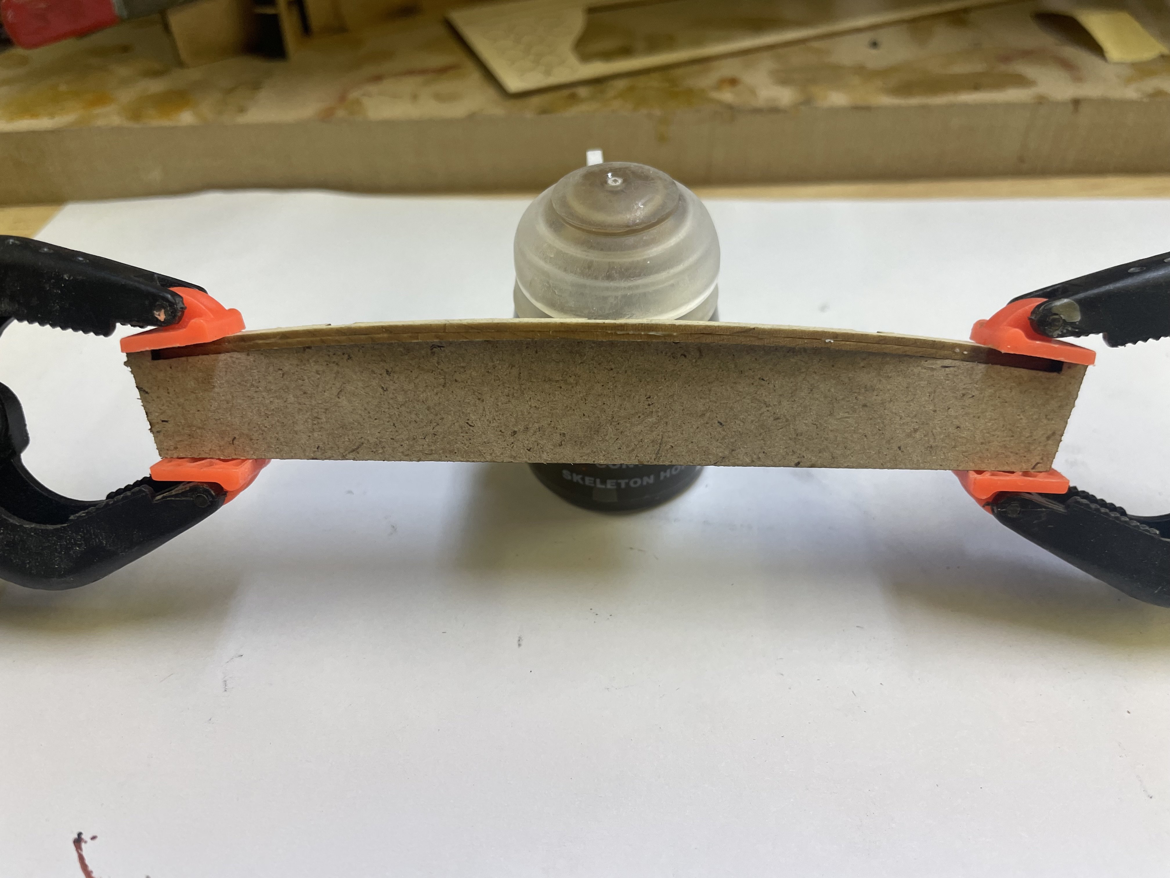

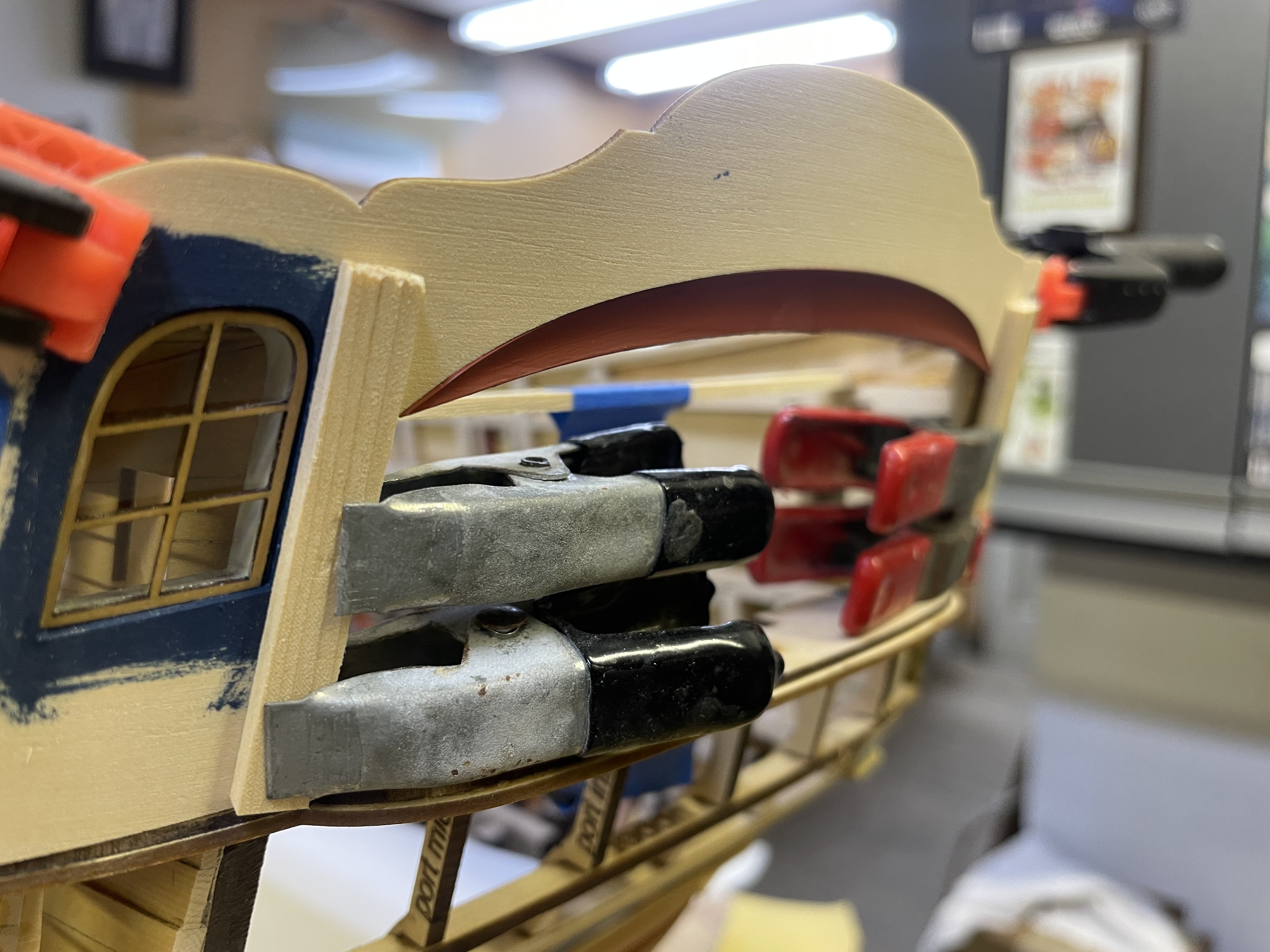

And finally it all comes together by Adding the upper balcony panel. This is a bit tricky and requires everything before it to go well.
The panel is 1/32 AYC and designed to fit over the QG’s and stern framing, it’s pretty delicate so be careful.
start by clamping the panel on one
side at a time, making sure it fits around the windows. It should have a snug fit right over them as they protrude out of the QG slightly. You may also need to do some minor trimming at the bottom so they fit on top of the balcony beam. That 1/32 ledge behind the QG is exactly for this purpose.

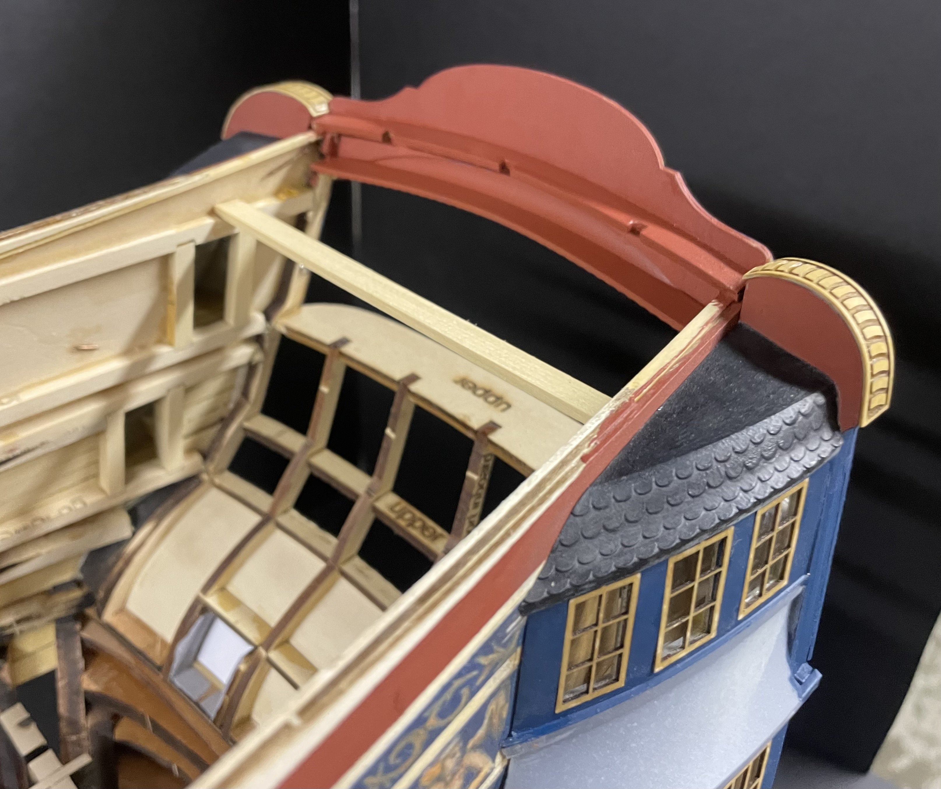

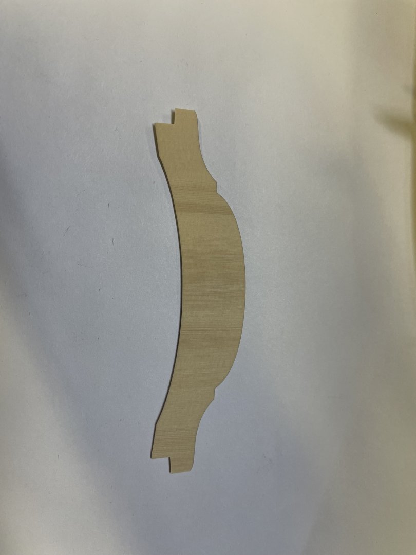

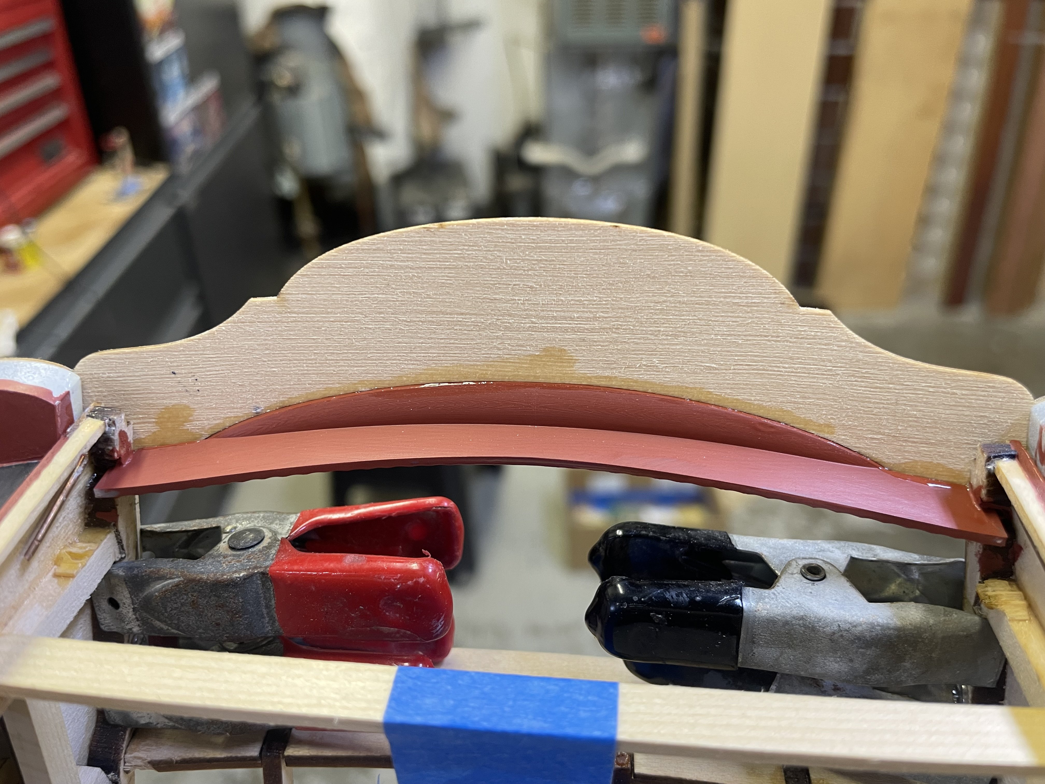

above you’ll also notice that I have the cove installed, I finally decided to print this along with the aft deck beam for the poop deck. This fits into some notches in the stern frames.

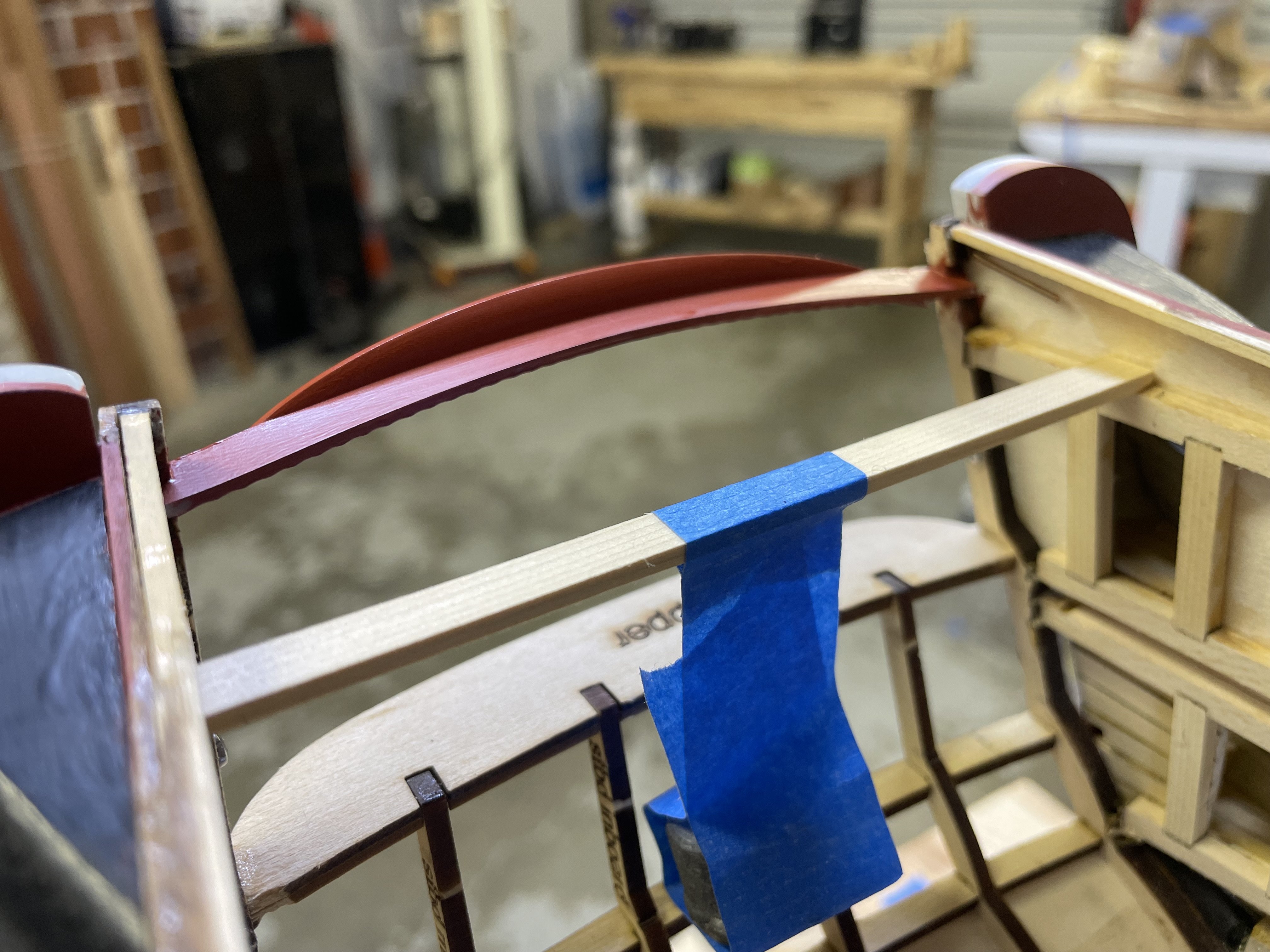

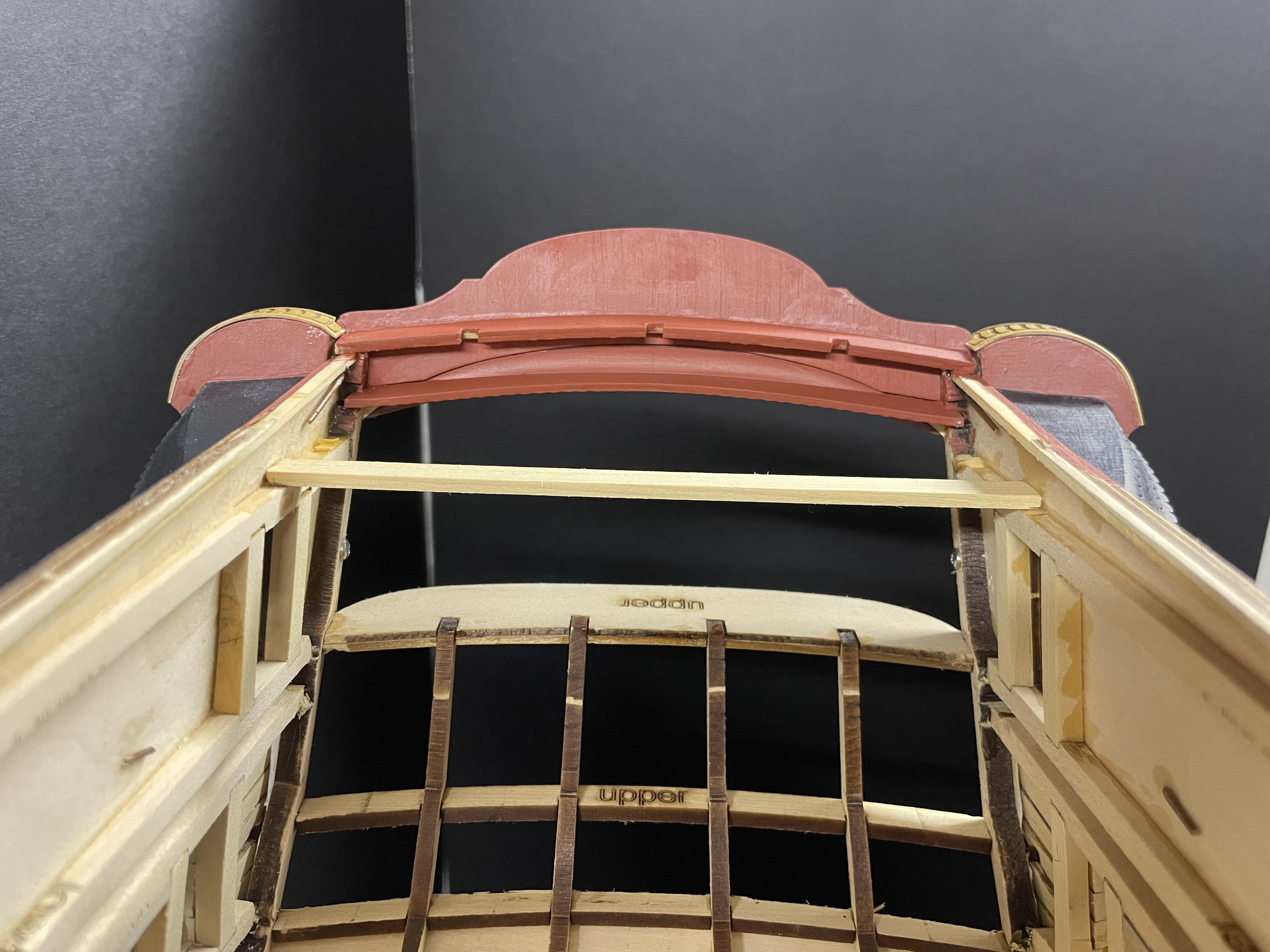

I installed a temporary beam
to maintain the measurement between the two stern frames where the printed cove/beam install, I should have done this before I installed the QG’s it would have made things much easier, thankfully it was only about 1mm out so I pushed the ends in and quickly glued down the piece of scrap.
above you can see where the printer beam fits into the notches. It should sit at its proper angle. CA works best when attaching printed parts.
once satisfied with the fit, I pulled the balcony panel off and painted the beam red, we will Be adding an AYC margin plank to the top of the beam shortly.
I also painted the margins of the window with the blue I’m using to match the friezes, I chose to go on the dark blue side, similar to the contemporary  Bristol model.

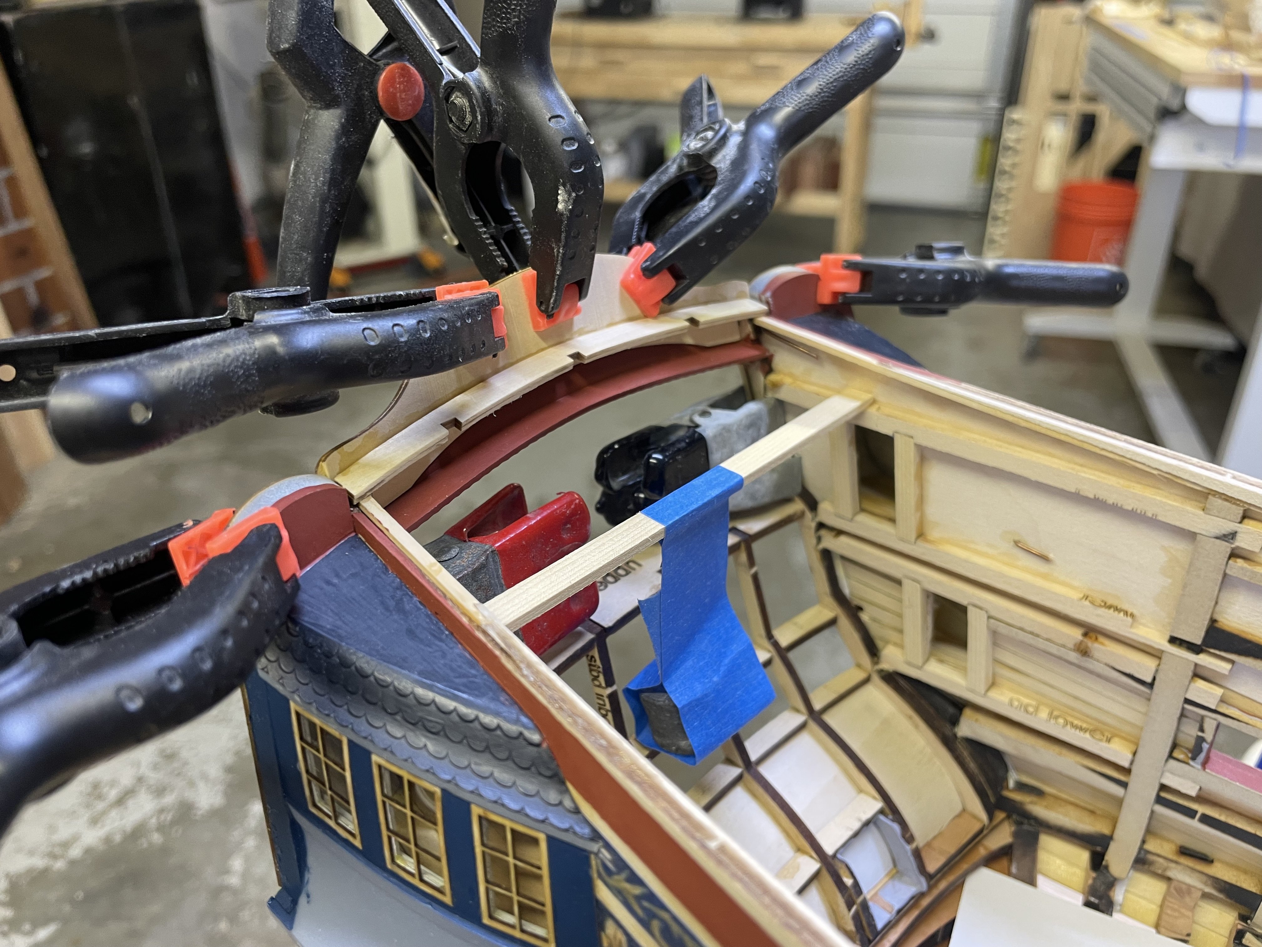

With all that completed I set the panel back on and strategized how to attach it. With the arrangement above it wants to lift off on the outboard ends. So I glued all the clamped spots with PVA so I had working time and then once everything was set and clamped I worked the outer edges with CA, I used similar thick pieces of scrap to carefully hold the edges down while the CA set.
Once the panel was secured and drying I attached the upper part of the cove to the panel, if everything went well then it should already be a tight joint, I just let CA flow into it and it set.
now is the inner laminate part of the panel, this just gets us closer to the tidiness we want and stiffens it up. I cut the piece so the grain runs the other way to help it conform. I had to do some very minor trimming to get this to fit. It should drop in nicely. I secured it with PVA and some CA on the edges.
Finally we add the upper beam, this spans the stern frames and will be responsible for holding some knees later on in the build. This is a laminated piece. Way above you can see it in the parts sheet along with the 1/4” MDF jig that will help with providing the correct camber
Once the beam it ready go ahead
and bevel the end that Fits against the panel until it fits nice. It can be secured with CA. And finally paint it all red.
as you can see once it all was finished I continued with painting the back side of the upper balcony panel blue, in fact the paint is still wet… it’s getting cold in the garage this time of year.

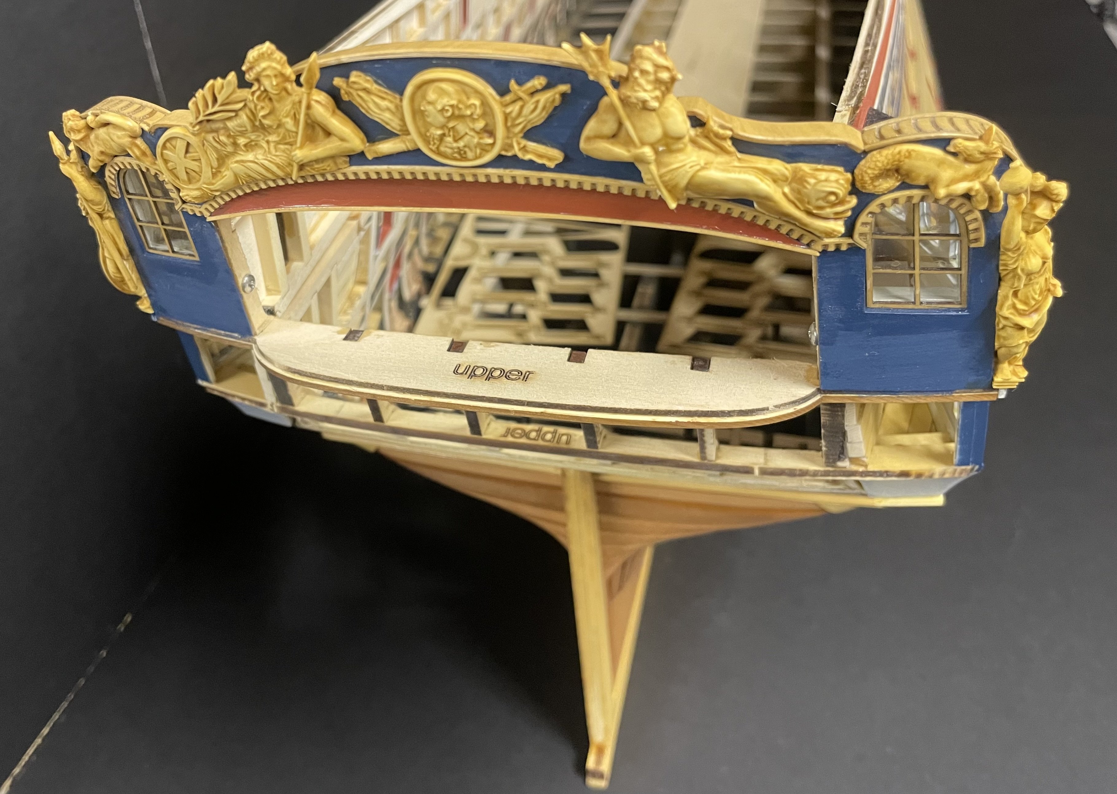

Today I will move onto finishing the upper stern with all the fun carved goodies, the reward for all the hard work.
JJ
JJ, the stern area with the QGs is progressing nicely.  She is looking very lovely.  It will be very hard to tell that there are 3d printed parts on this model when it is all said and done.
Kenny
On 10/27/2025 at 4:00 AM, Ronald-V said:
That's impressive! Nice flooring too :)
Thank you Ronald.
Thank you Kenny, that is my objective with the printed parts.

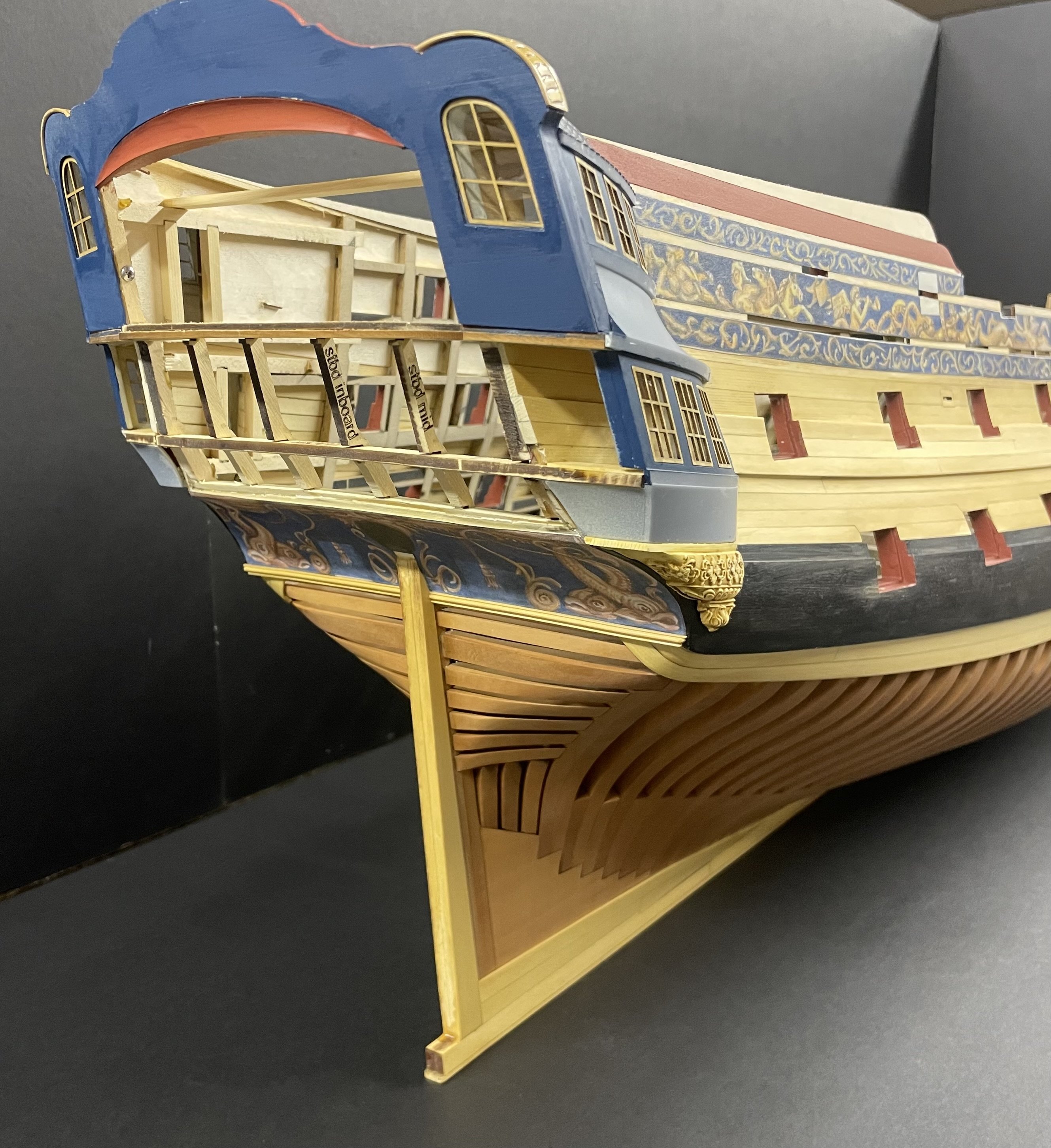

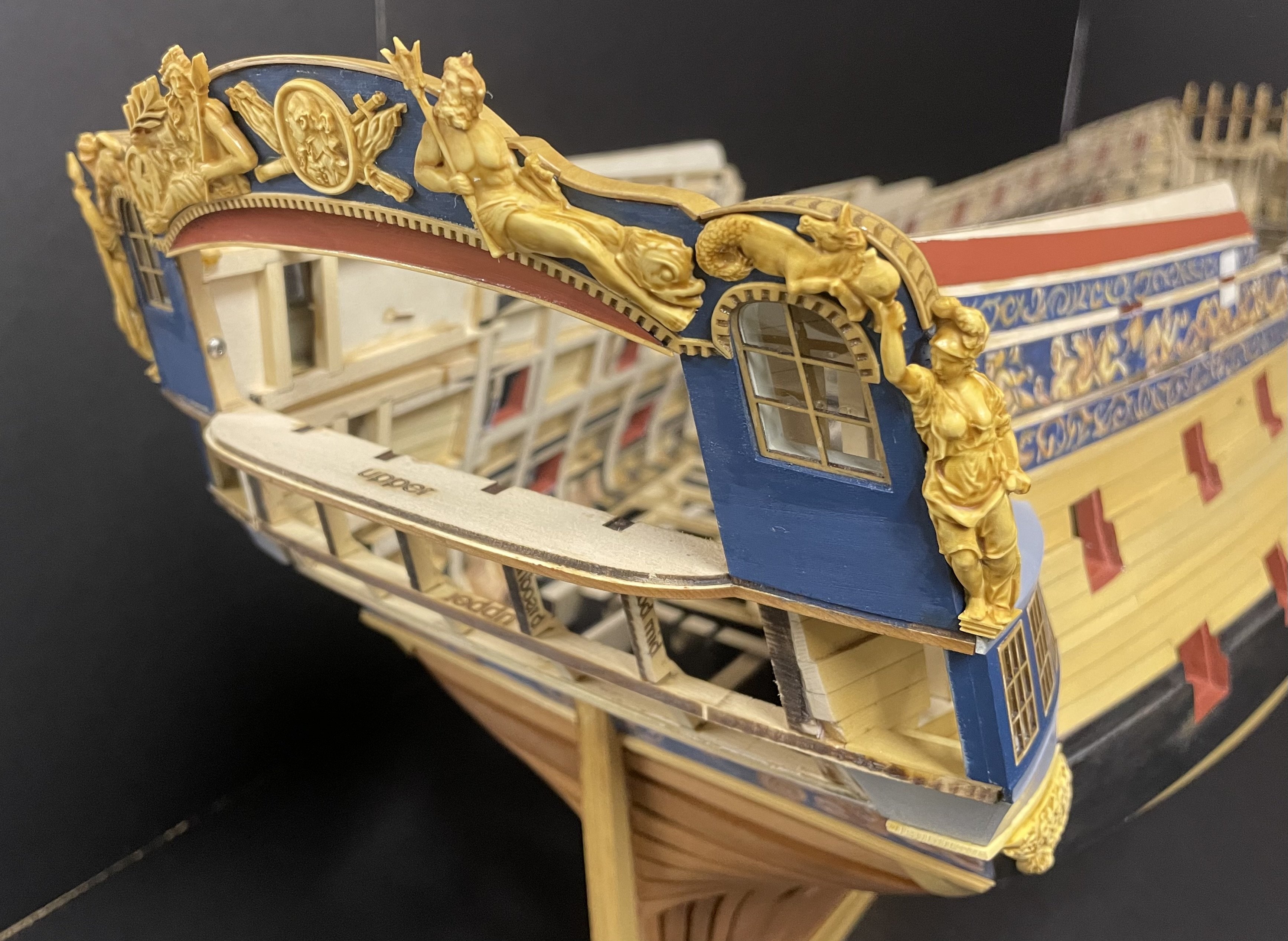

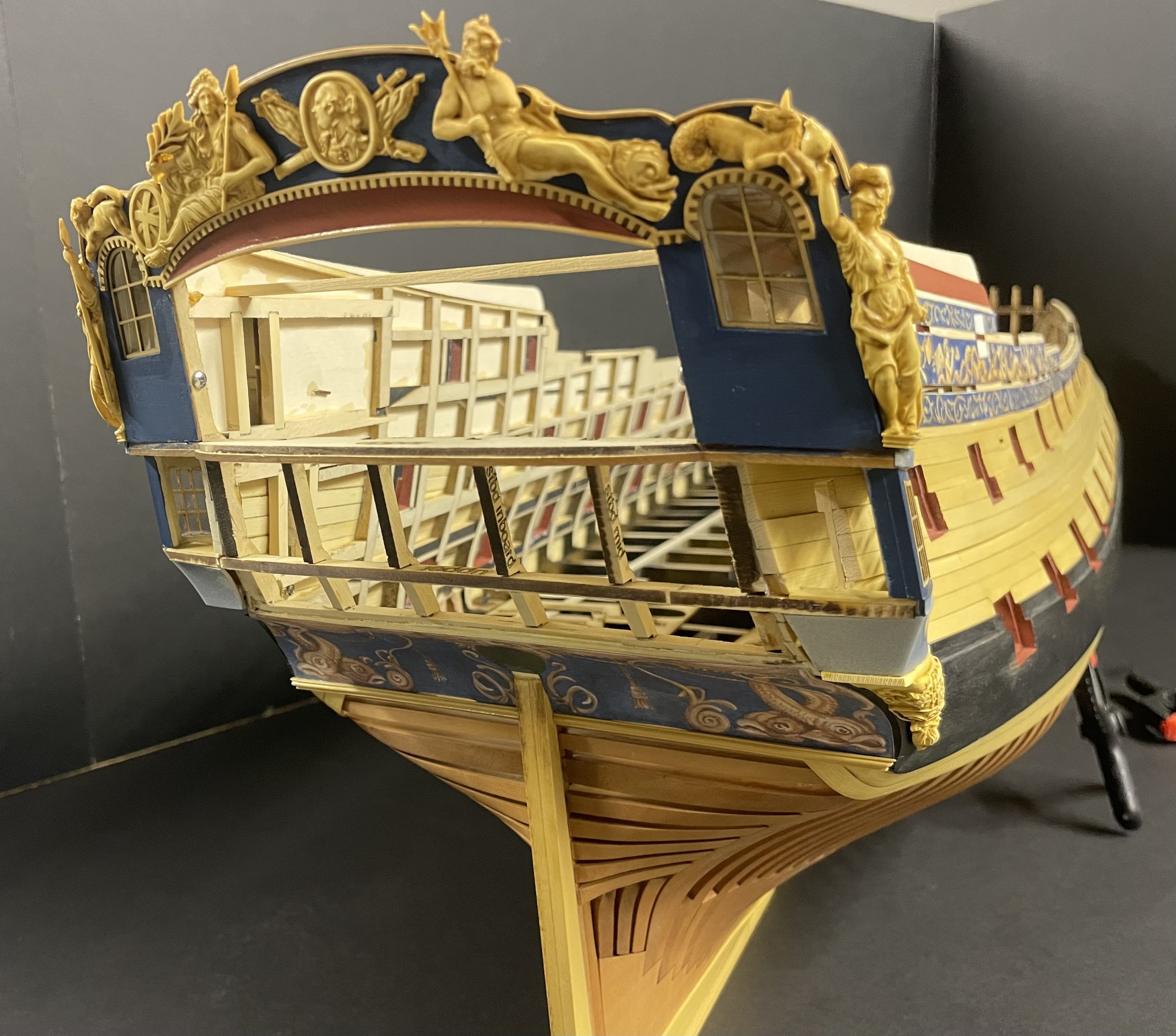

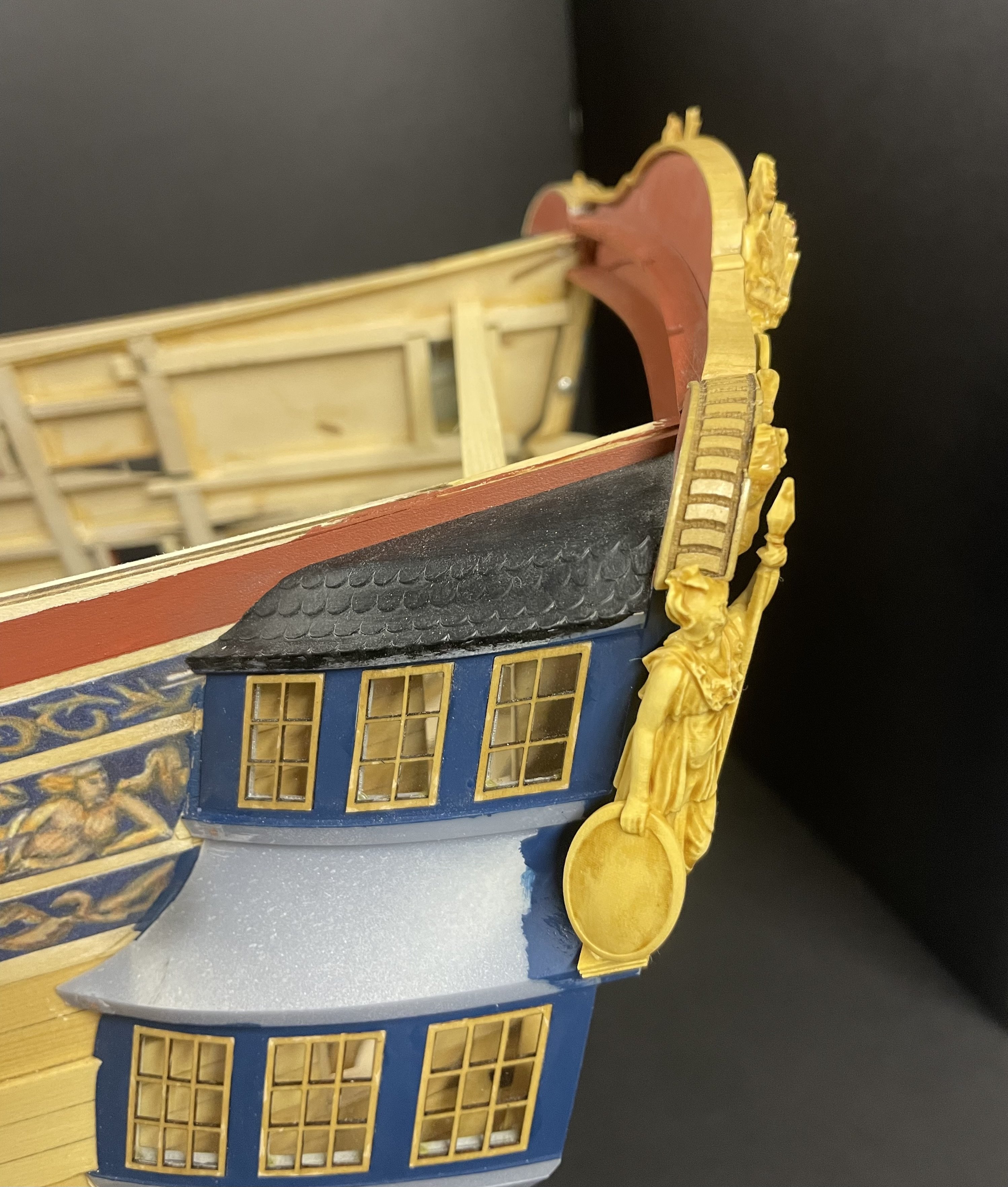

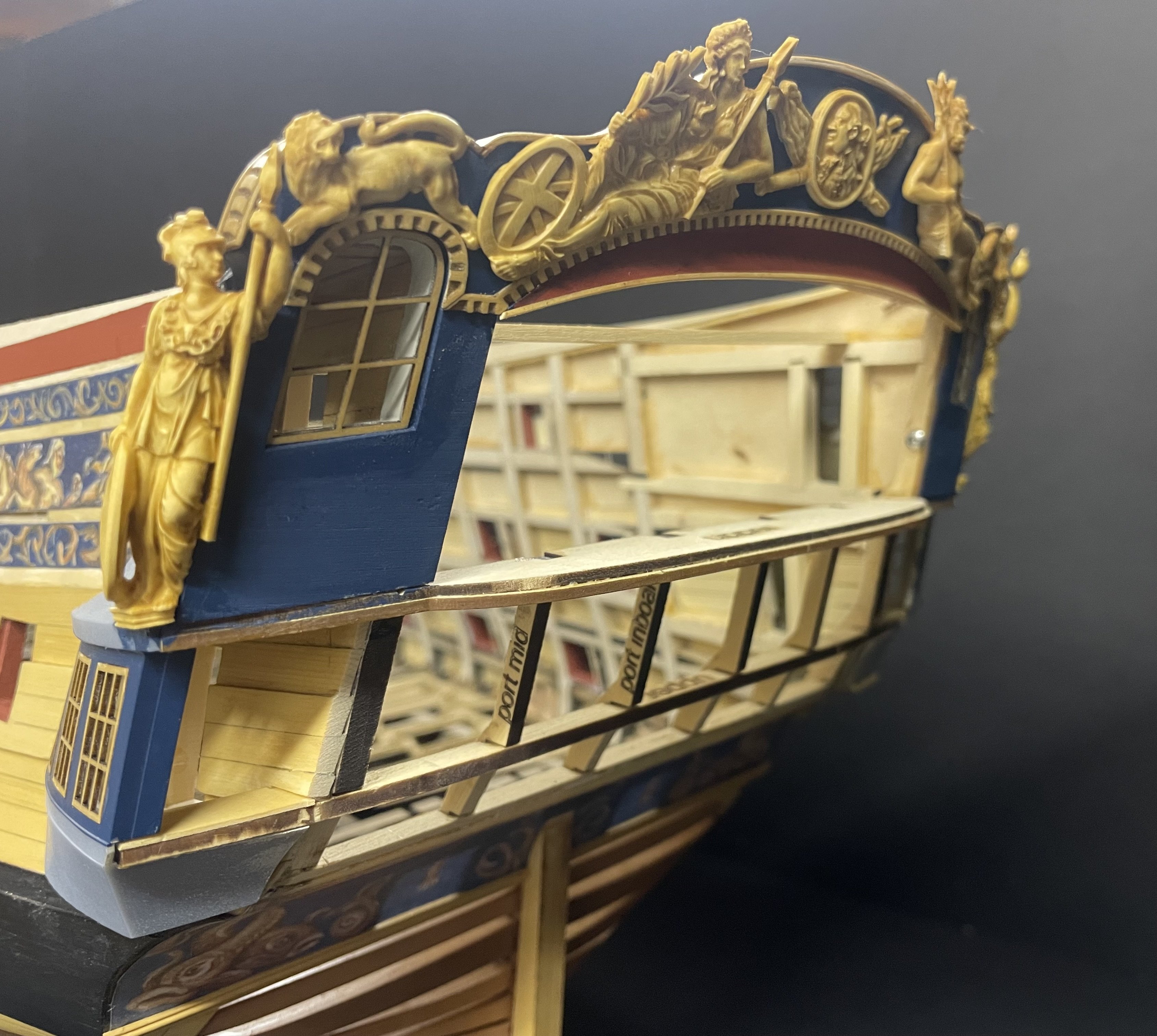

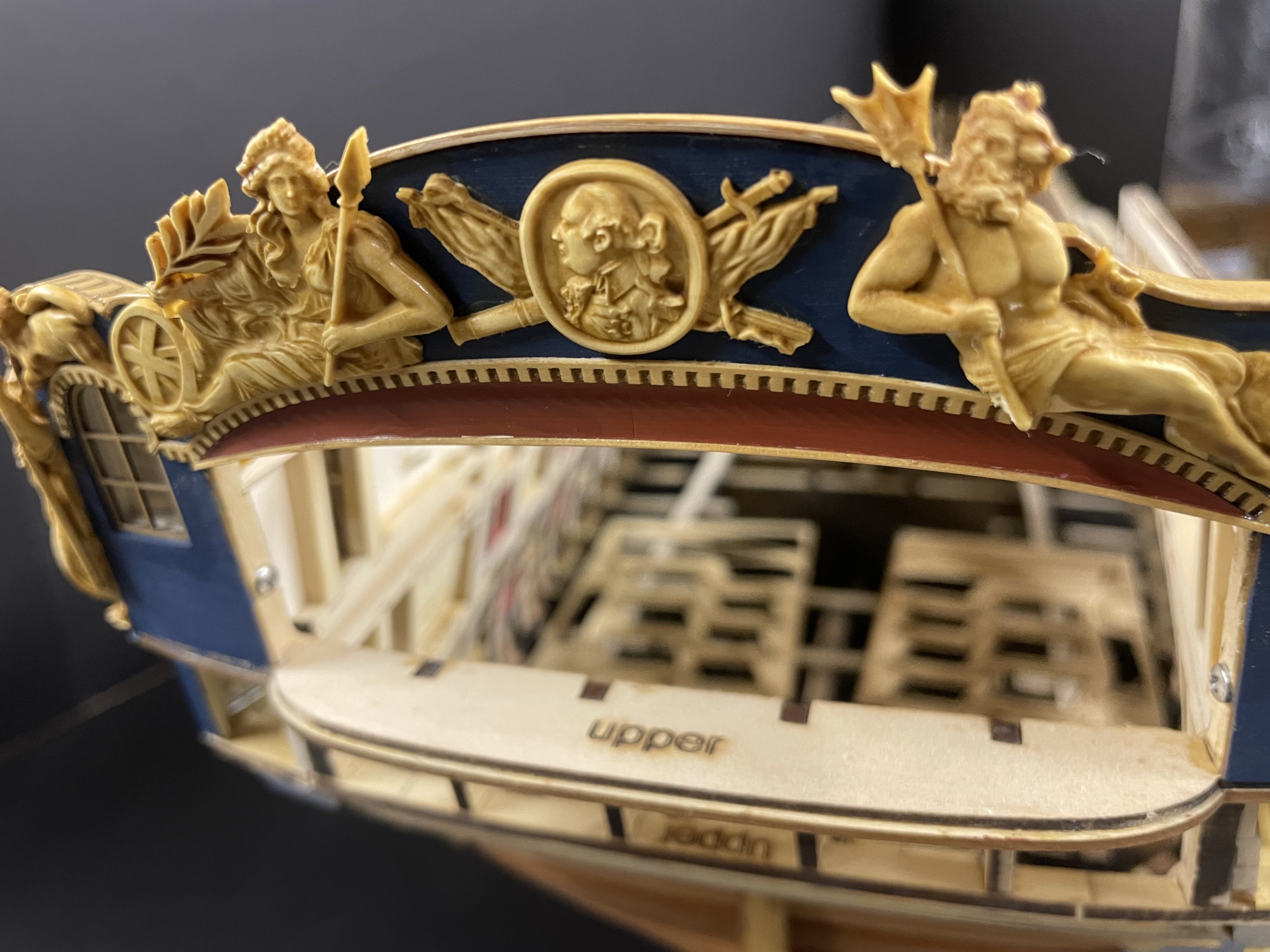

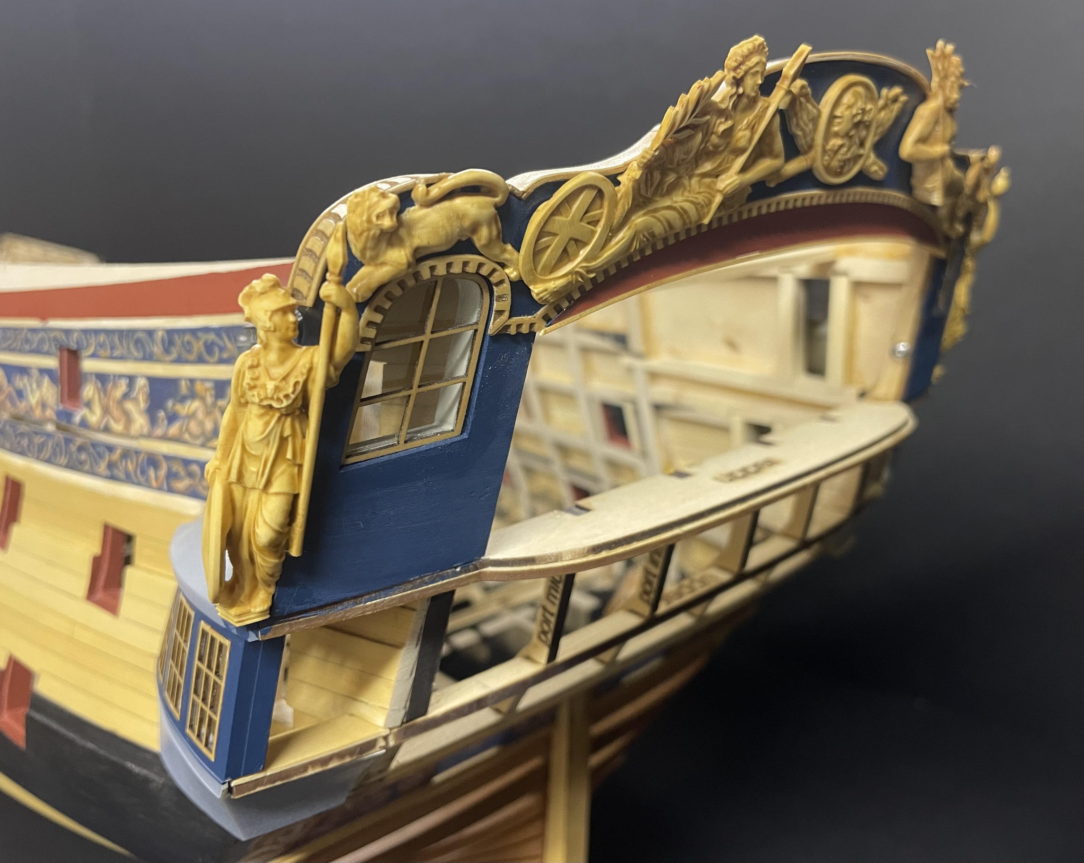

I was able to attach a lot of the upper
carvings yesterday as well as some trim. All the laser files are dialed in and ready to go. The Taffrail was a bit tricky, made up of two layers of very thin boxwood, it requires a lot of patience.
The carvings required some clearance work against the trim as expected, otherwise they fit absolutely perfect.
I have to return to work on Friday so this will probably be the last update on the model for 6 weeks. Will be finishing the stern and lower windows when I return and the rest of chapter 3. Then on to the gun deck!

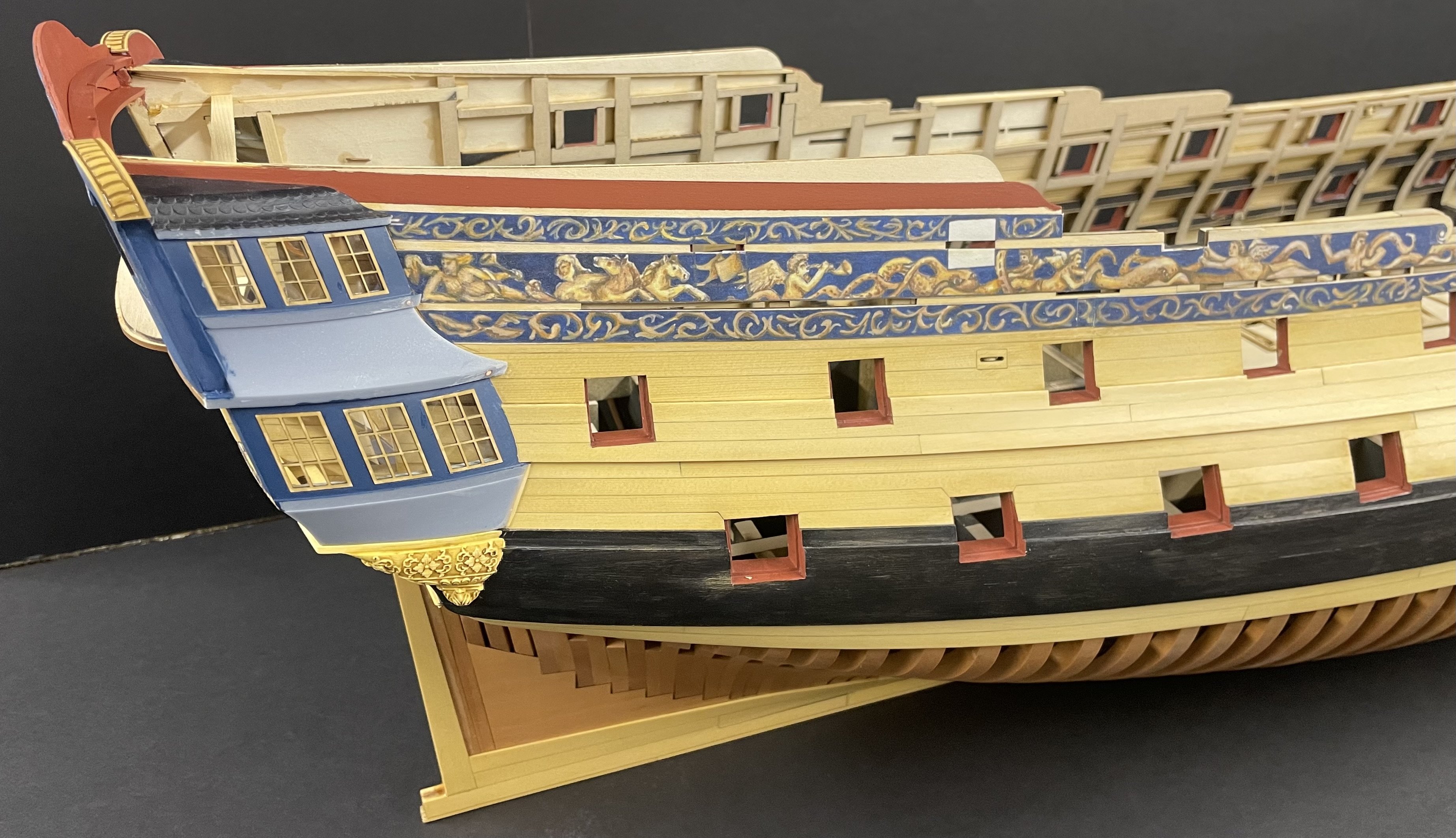

6 hours ago, wilma said:
Hi JJ,
The stern looks fantastic and your boxwood has a nice golden hue. Are these treated with bitumen wash?
Hi Wilma, thank you. They are coated in WOP first so nothing else can penetrate the wood, then I apply a wash of sorts. I’m just starting to use this so I’m experimenting with it still but I definitely like the results. I just brush it on then after it dries I go at it with a cloth soaked in some alcohol. Works quite well.
