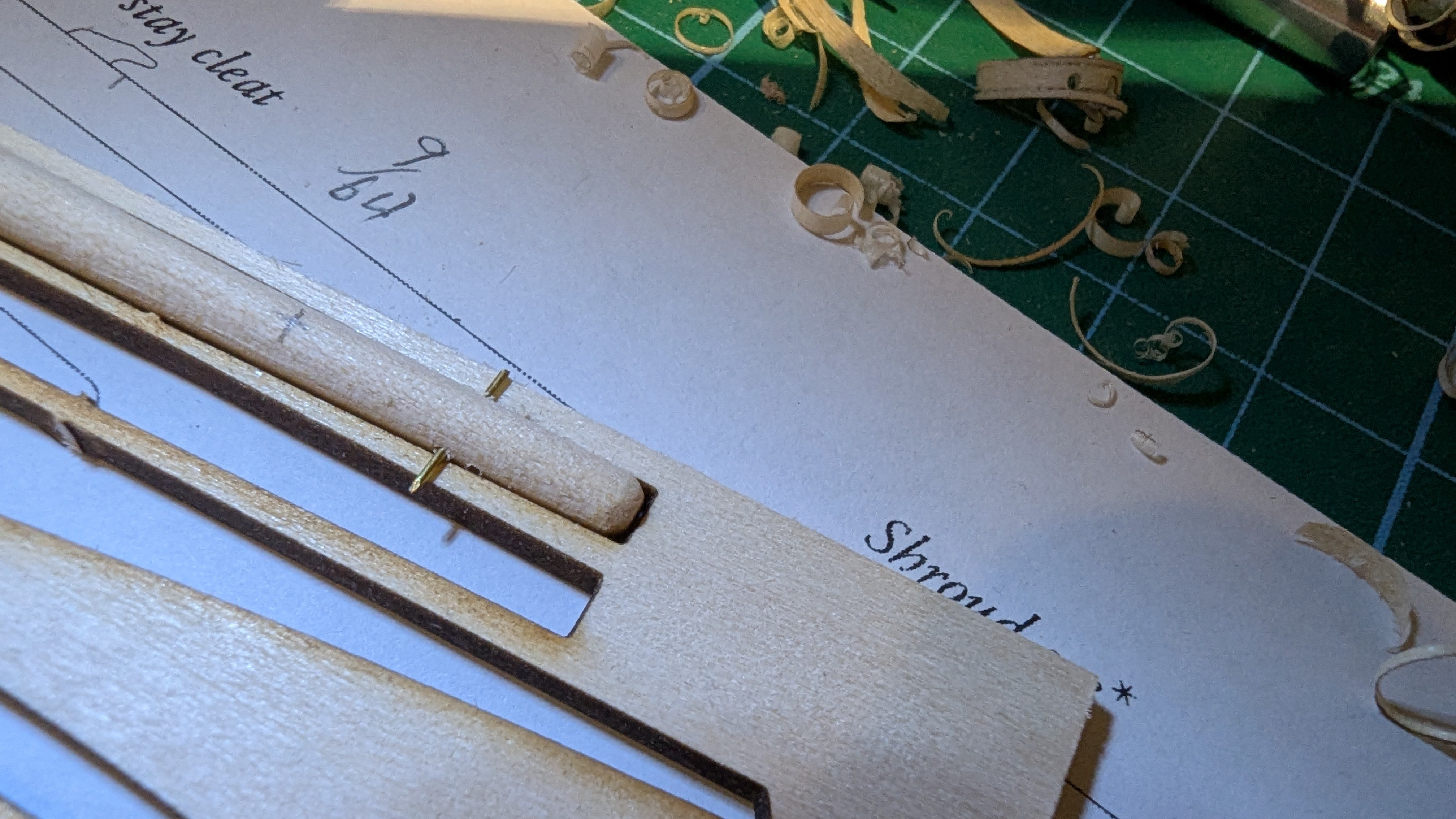

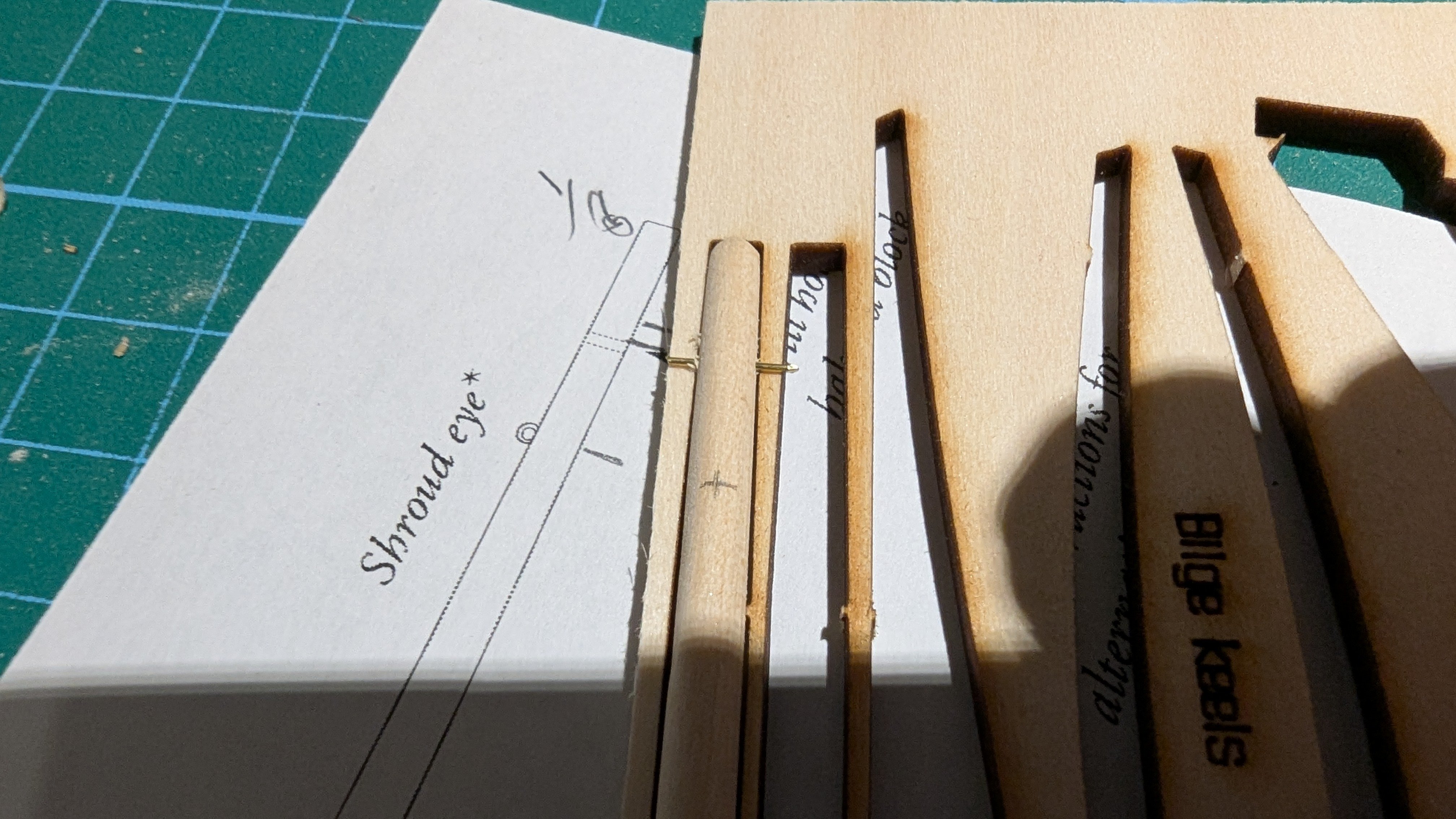

What the heck is everyone using for 'nails' to hold the stay plates
I bought a bag of suitable-size brass nails, 0.7mm I think. Model Shipways seem inconsistent in the size they supply with the kit (of the two sizes they sell). Some people have had their smaller nails, which should work well. Most of us get the large ones, which don't.
Trevor
Thanks Trevor. I found some Amati pins/nails that based on the diameter in the desc. should do the trick.
I've been jumping all over the place here, I get to the forestays, needs pins, get to the pintles, need a torch. So far I have the base and supports made up, a partly carved mast (which I just realized I cut an inch short at 9" instead of 10" B)). I'm still waiting on pins, but the gudgeons and pintles are done now - or maybe not? Seems there's a bit of an issue, the 'straps' are too short. I double checked all the other brass pieces, and it seems these are the right ones. Anyone else have the same or have an idea of the issue?
Funny, in the picture they look just long enough, but the top one is right on the edge. I feel like adding a nail will split the wood. Seems these should be far longer than they are, unless I've done something wrong.
Making them was interesting - I'm not sure how I feel about the metal work. It's satisfying, but a pain at the same time. I liked gluing everything together, on the contrary, cutting the tiny brass tube was horrible.
After I got a butane torch, I borrowed more of my wife's jewelry making supplies. I've also been getting some use out of the magnifying glass I bought a while back:
As best as I can figure, while the kit instructions call for the straps to wrap around the tube and pin (as you have made them), the kit-supplied straps are intended to bear their tubes+pins on their outsides, as the transom gudgeons carry their bits of tube.
Maybe its all part of Model Shipways' "apprenticeship" ... a step towards learning never to follow kit instructions blindly 😎
Trevor

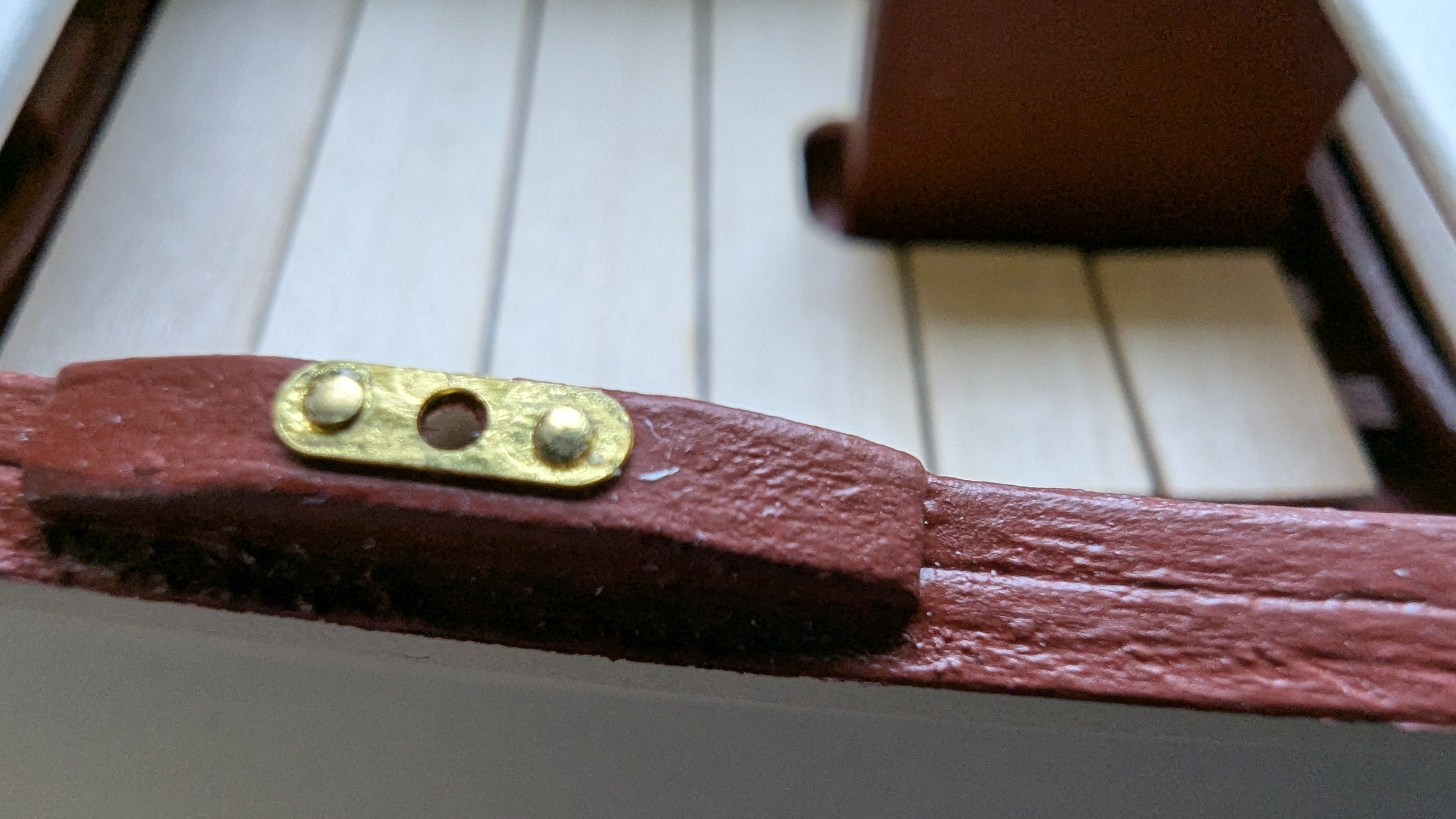

For the rudder, I looked back at the instructions and the notches that are originally put in the rudder way back on step 28 do say they are for the pintles. So maybe they're supposed to be inset in the rudder a bit. This makes sense, however the etched lines were way to small to fir them. I'm thinking I'll back up a bit here and increase the size of those notches. Since I need to do a bit of touchup on the daggerboard anyways, I can touchup the rudder too.
There's another issue where the rudder is 3/32" and the pintle is 1/16". So with the strap wrapped snuggly around the pintle, it's too tight of a slot to fit over the rudder. I was just messing with it and after widening the strap to fit around the rudder, the CA broke, the tube popped out of the strap. I may end up just fitting the pintle right on the rudder and then CA the strap over top of it. I'll fiddle around with this for a bit and see what I end up with... I am too particular for my own good sometimes. I hear good things about the fitment and quality of Vanguard, although I have some kit's ahead of me still, I'm really wanting to try them out.
Trevor
Trevor is correct that the tubes and pins should be on the outside of the straps.  See the 6:30 mak of this YouTube video:

I have some good news. The pins I ordered from the UK worked. They're Amati, I'll post a pic of the package for any future victims of Model Expo. I got the nails installed on the stays; finished and installed the rudder. I was able to hold true to the prototype and instructions by completing the pintles as described.
It was fun fitting the nails, but I can't say I had fun fiddling with the CA and getting it on my fingers every few seconds - the gobs that come out, even with my 'precision tip' are far too large. I'm thinking there are better options out there than the gorilla glue tips for such ultra fine detail. I found the idea of using pipettes, which I'll try. It also looks like BSI has some precision tips. Something to experiment with in the future - I'd love to hear comments from the wise ones here. Also, if there's a trick to keep away, reduce or clean up the white powder CA leaves behind.
I'm very happy that I managed to keep the rudder as a working, and removeable part. I didn't bother marking out the transom for the gudgeons as instructed. I simply glued both on at the same time while hinged to the rudder. The bottom one ended up slightly crooked but it worked well enough and ensured the rudder was installed straight.
Filed the rudder down a bit to seat the pintle closer. However I wouldn't advise doing this since there isn't a lot of room to work with and you could end up binding the hinges when fully assembled.

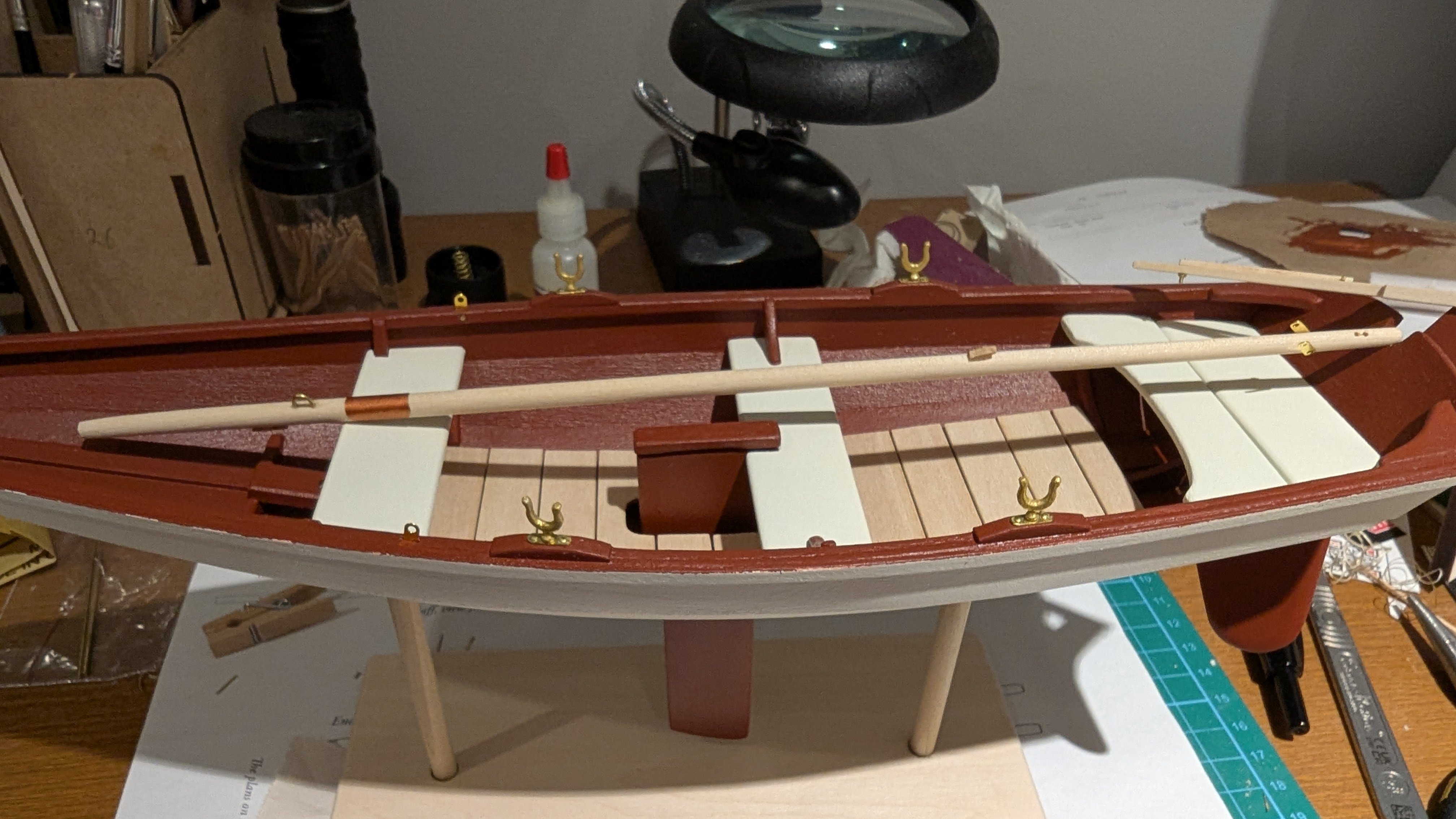

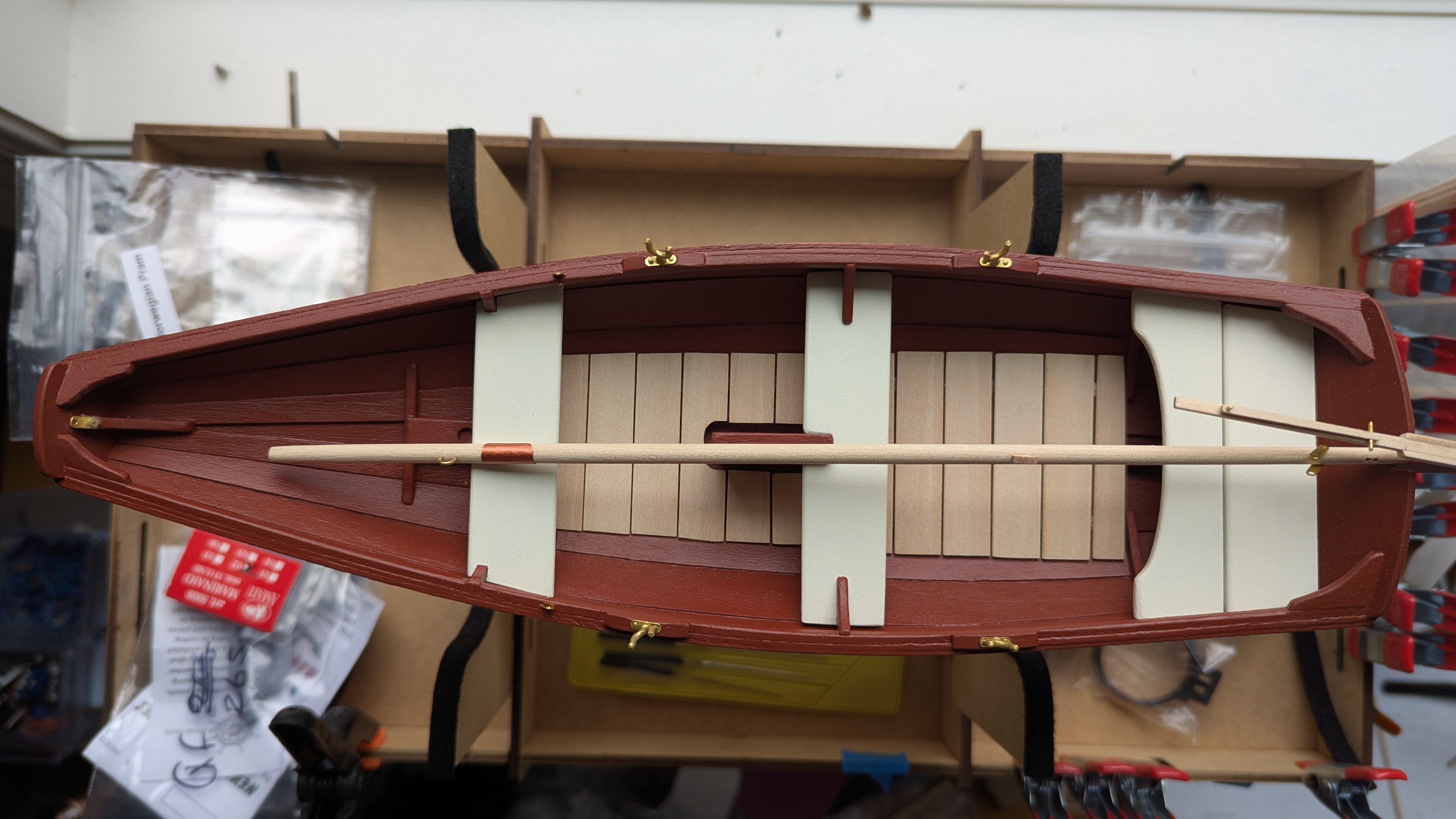

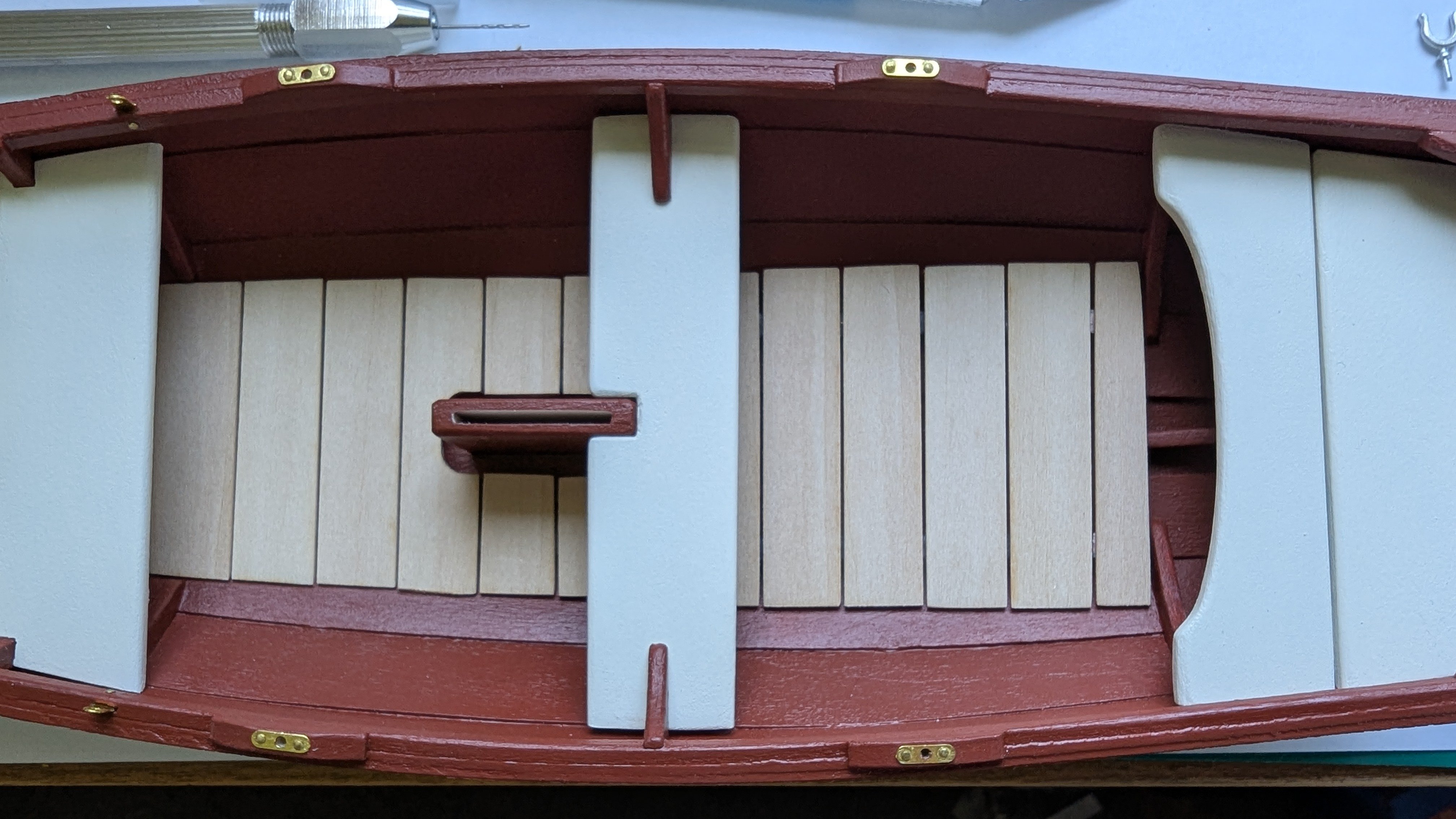

I haven't gotten much done over the past week, but I've released all the wooden parts, and figured I'd force myself to organize my pictures up to the current point. This one feels a little picture heavy for the amount that was accomplished.

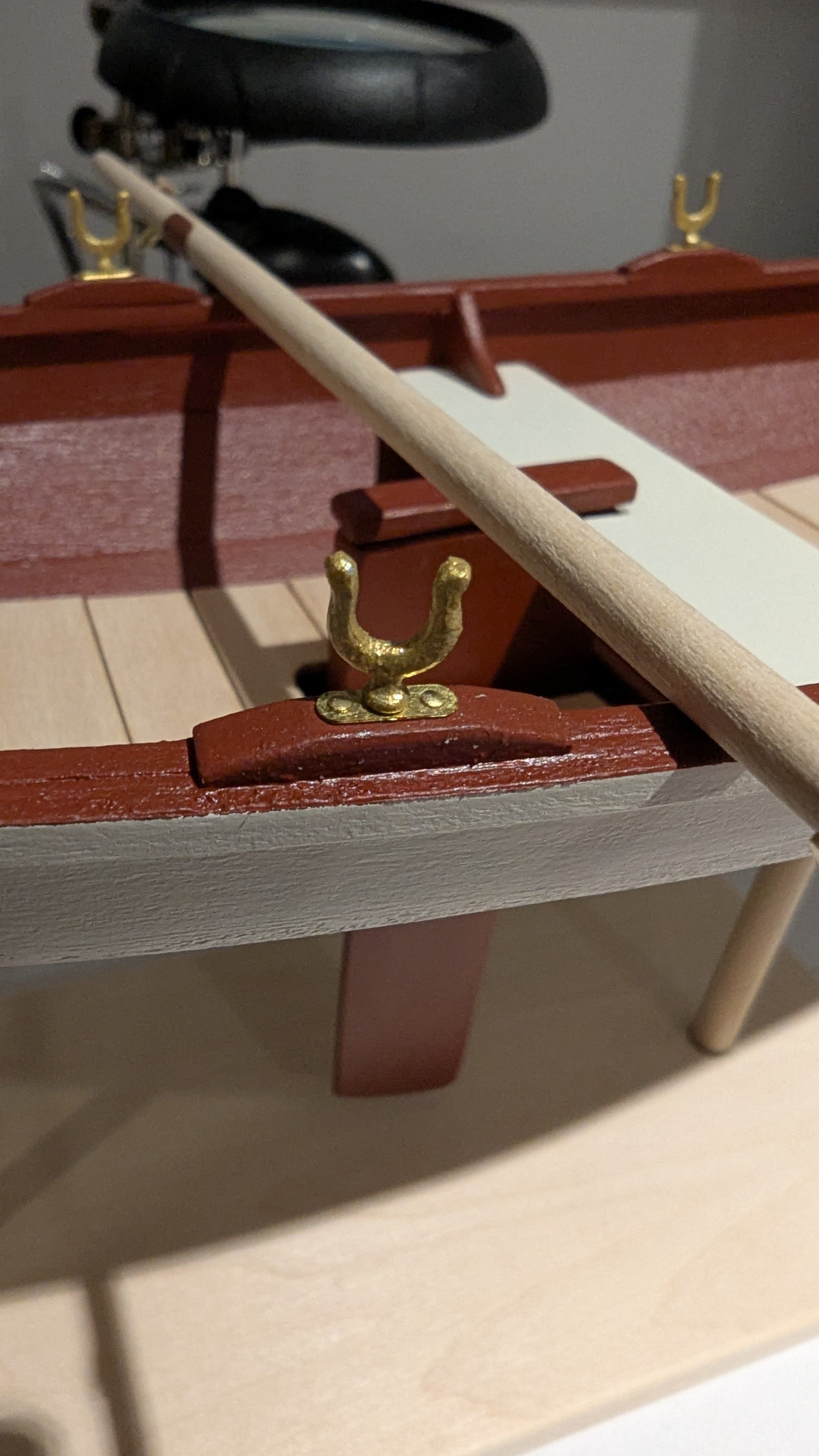

Log #15 - Oar pads & locks, mast

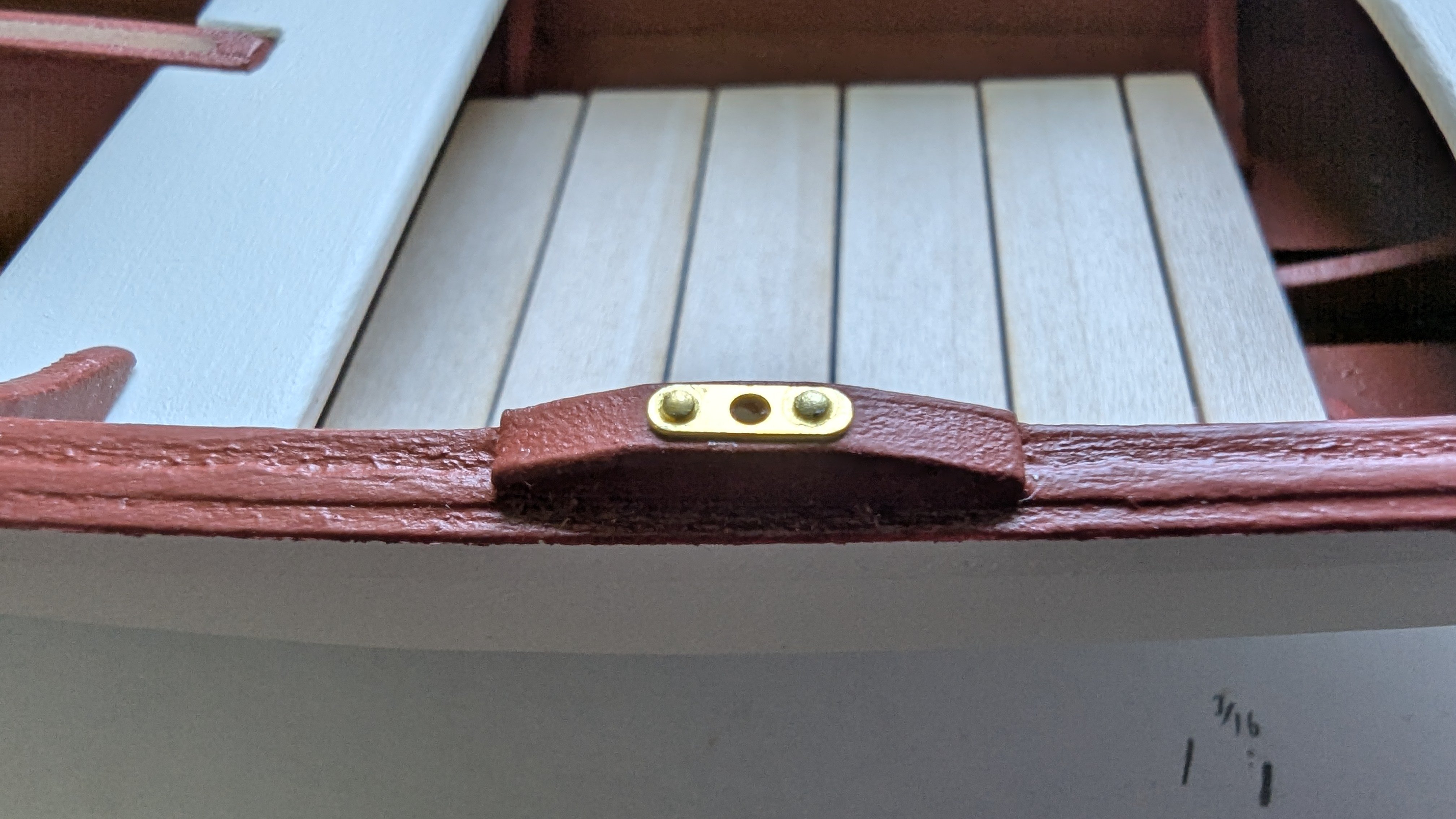

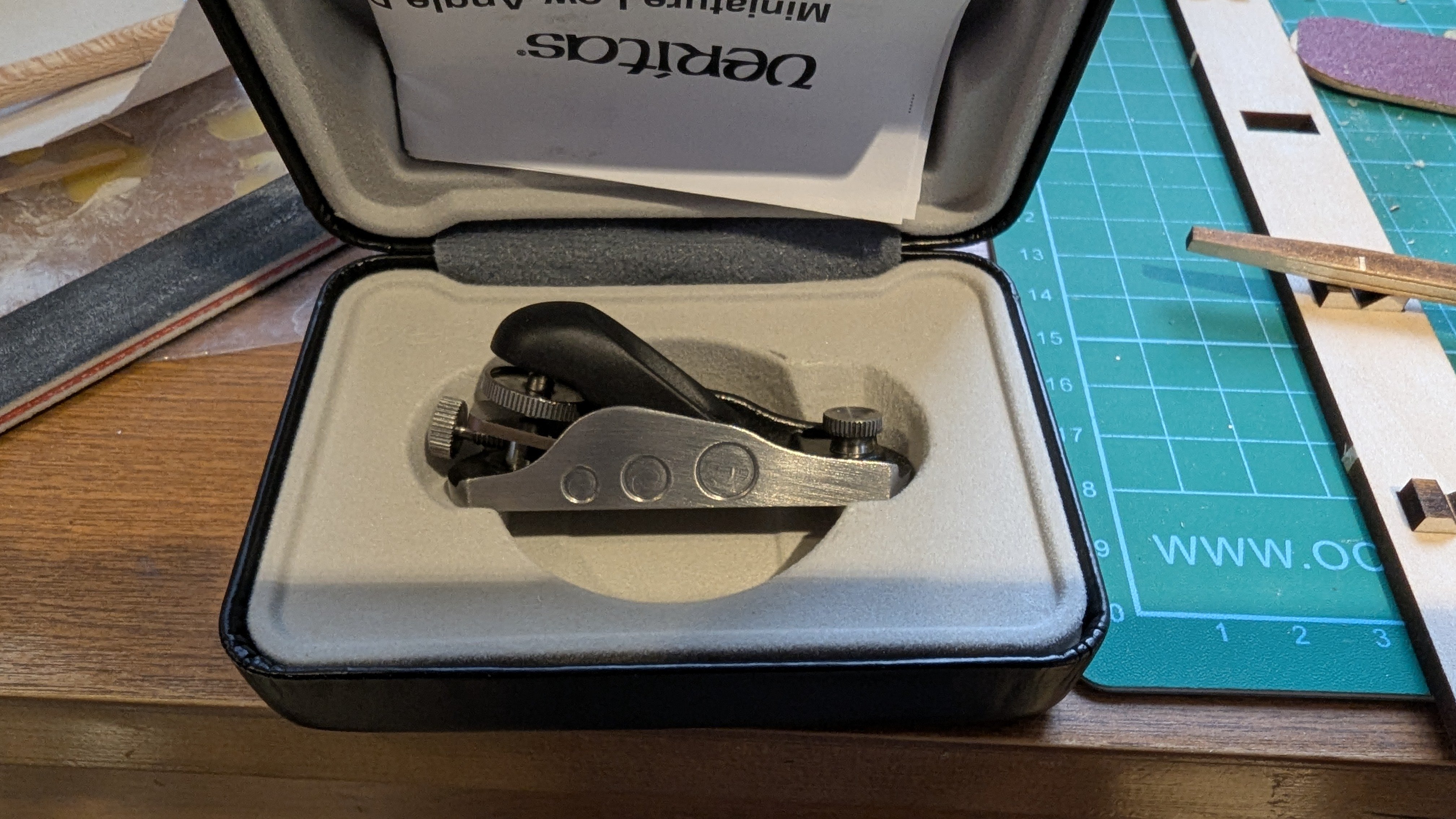

I picked up a few new tools, glue looper, Swann Morton scalpel, round nose pliers and some proper flush cutters (for wire/tube, I've been using the beginners kit ones from ME which I don't think are really appropriate for metal). First used was the glue looper which helped getting the oar lock pads in place. I applied each one differently, some techniques worked better than others. Using pins in the 'nail holes' to guide it into place with a small amount of CA on the pad help align it in the right spot. The looper helped apply just enough to make it stick, but not so much it spilled into the holes (there was so little glue, one or two of them actually came off).

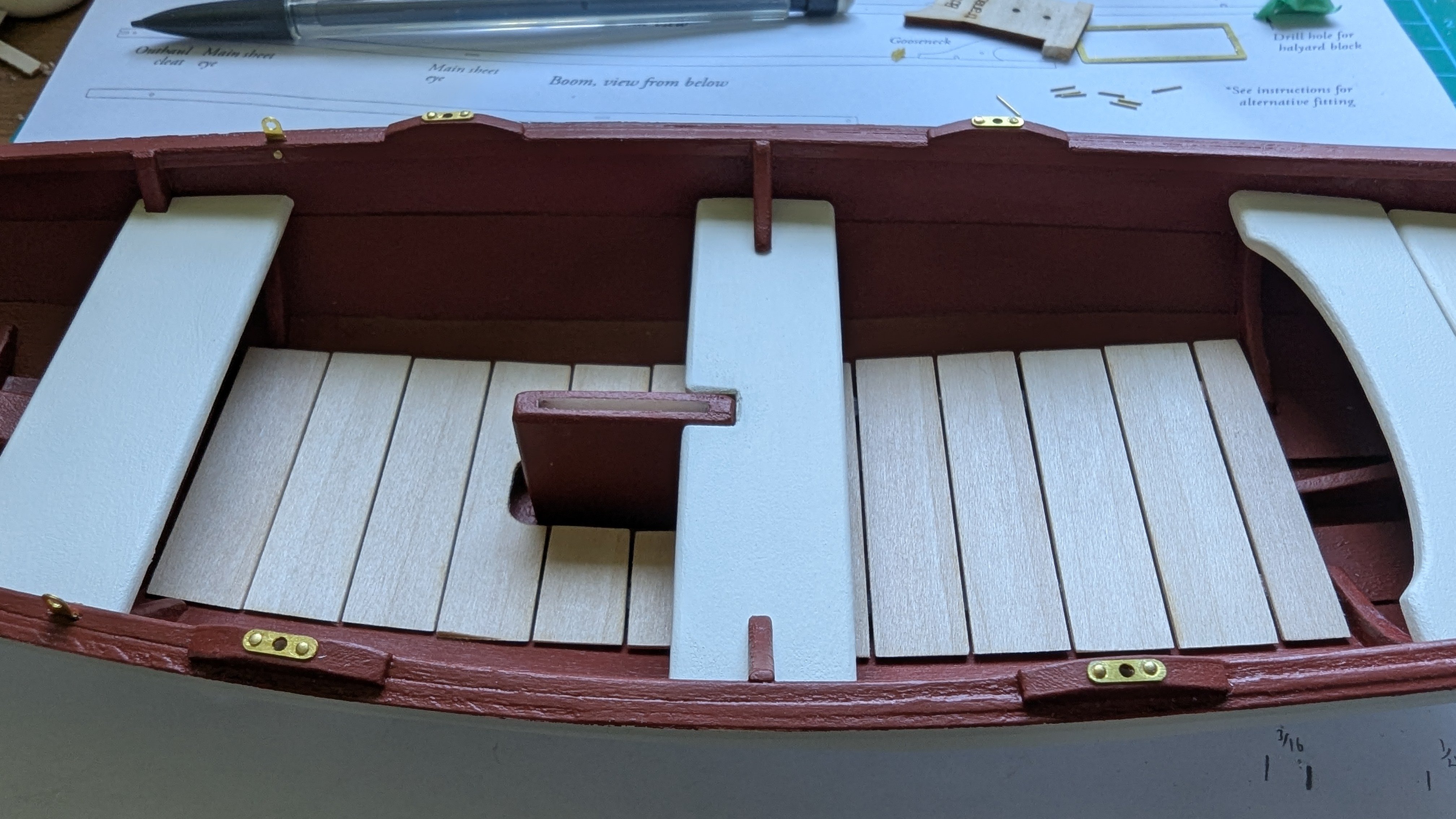

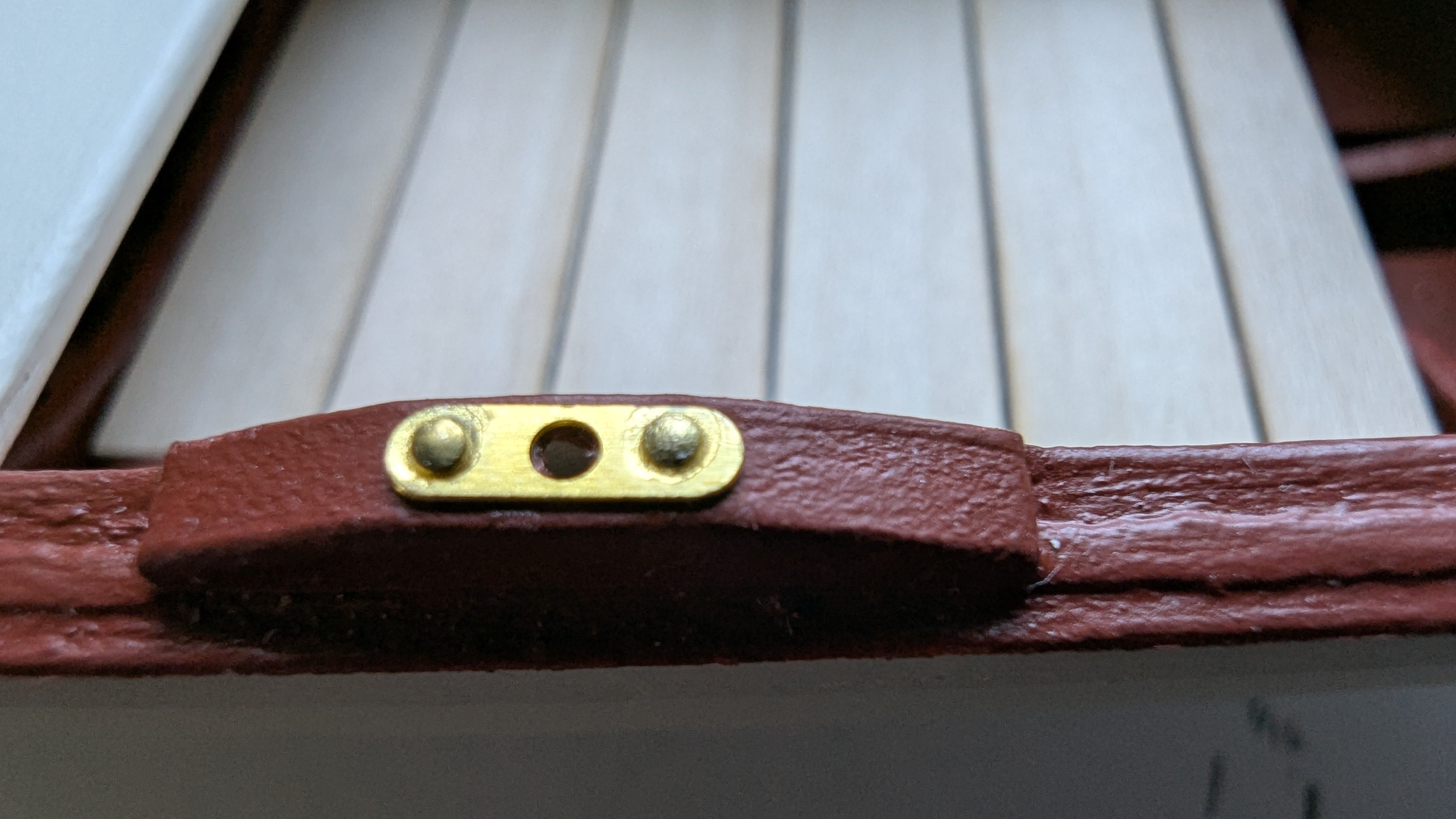

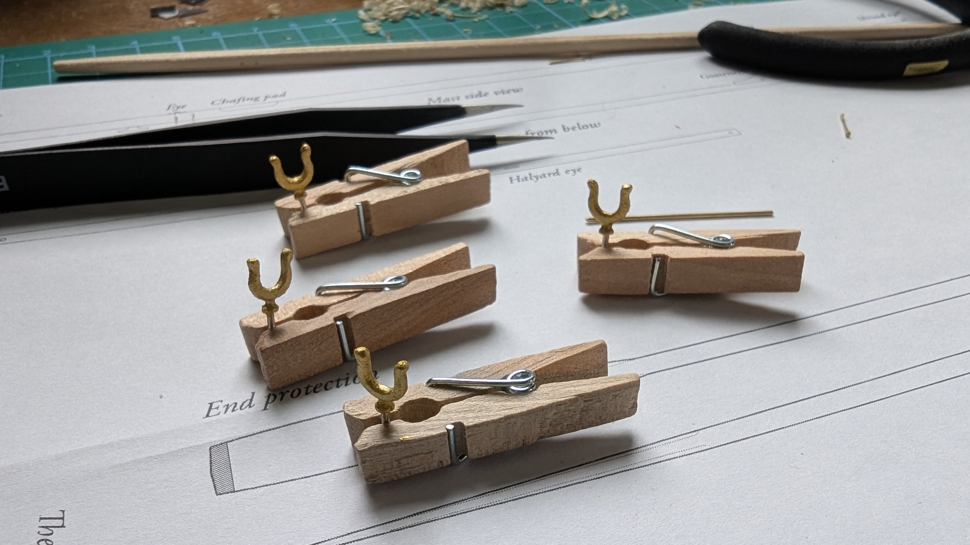

The loose pads were trickier to get nailed down, but I managed to drive the nails (applying a bit of CA to the tip to ensure they would do their job). I also had the nails slightly longer than the hole so they would bite into the wood and act as a nail should. 100% unnecessary, but I clearly have psychological problems. They all turned out quite well and fairly straight (and I just noticed a small amount of flaking CA on the paint in one of the pictures, now I'll have to go clean that up).
I was debating for a while about what to do with the oar locks as I didn't really want them to be 'steel'. I ended up painting them with some gold OcCre paint I picked at the ME clear out sale.

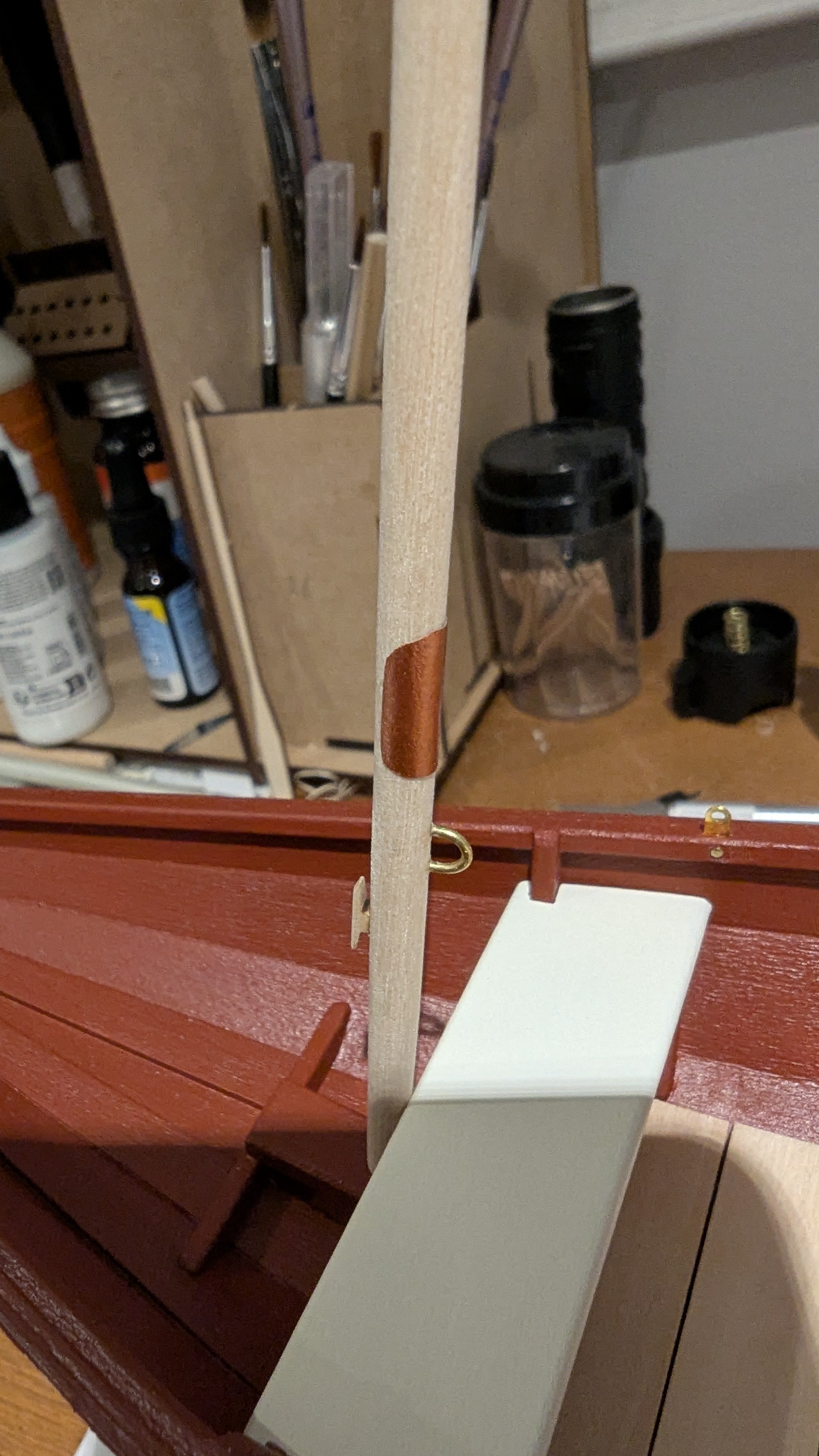

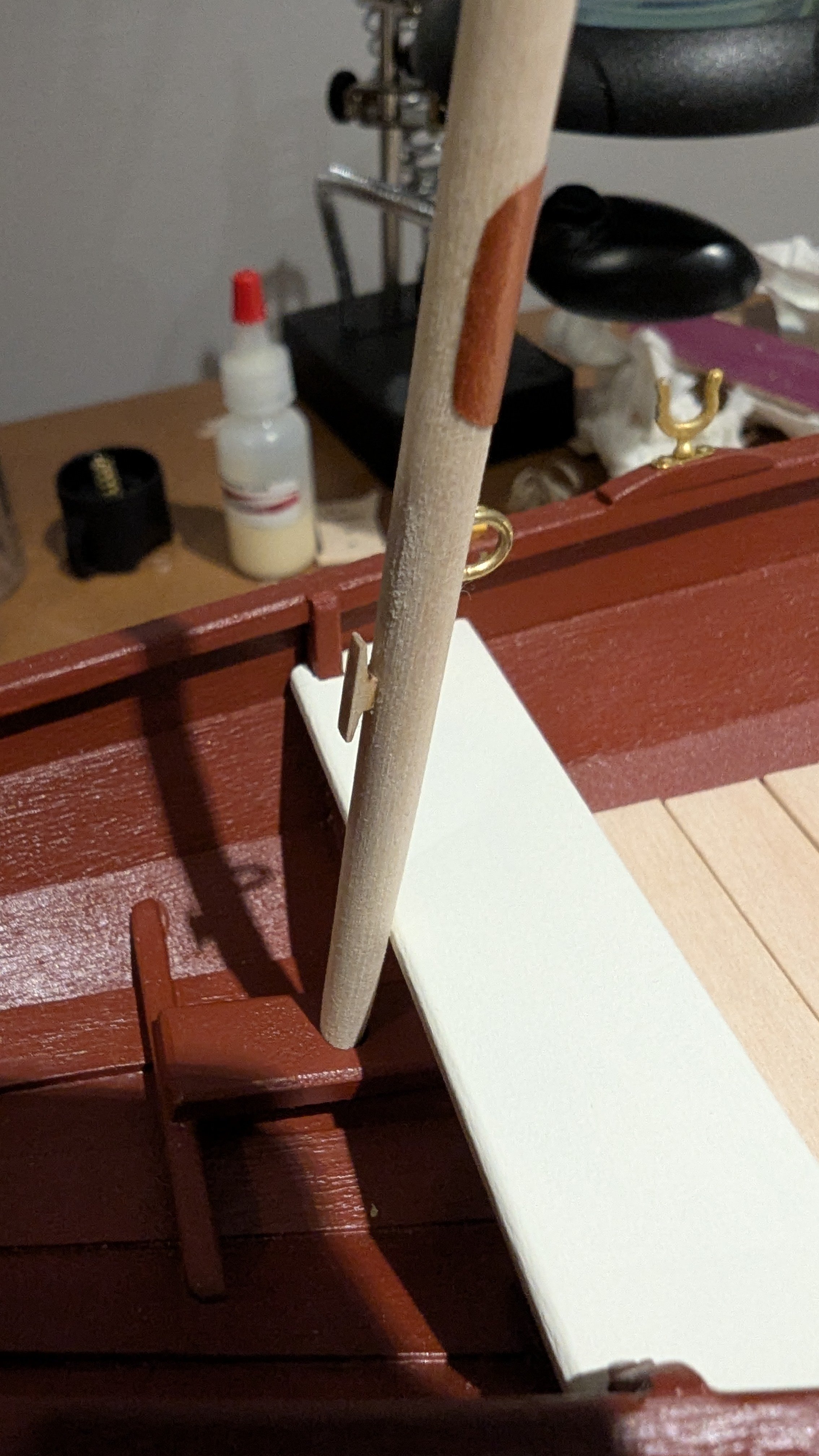

The Mast

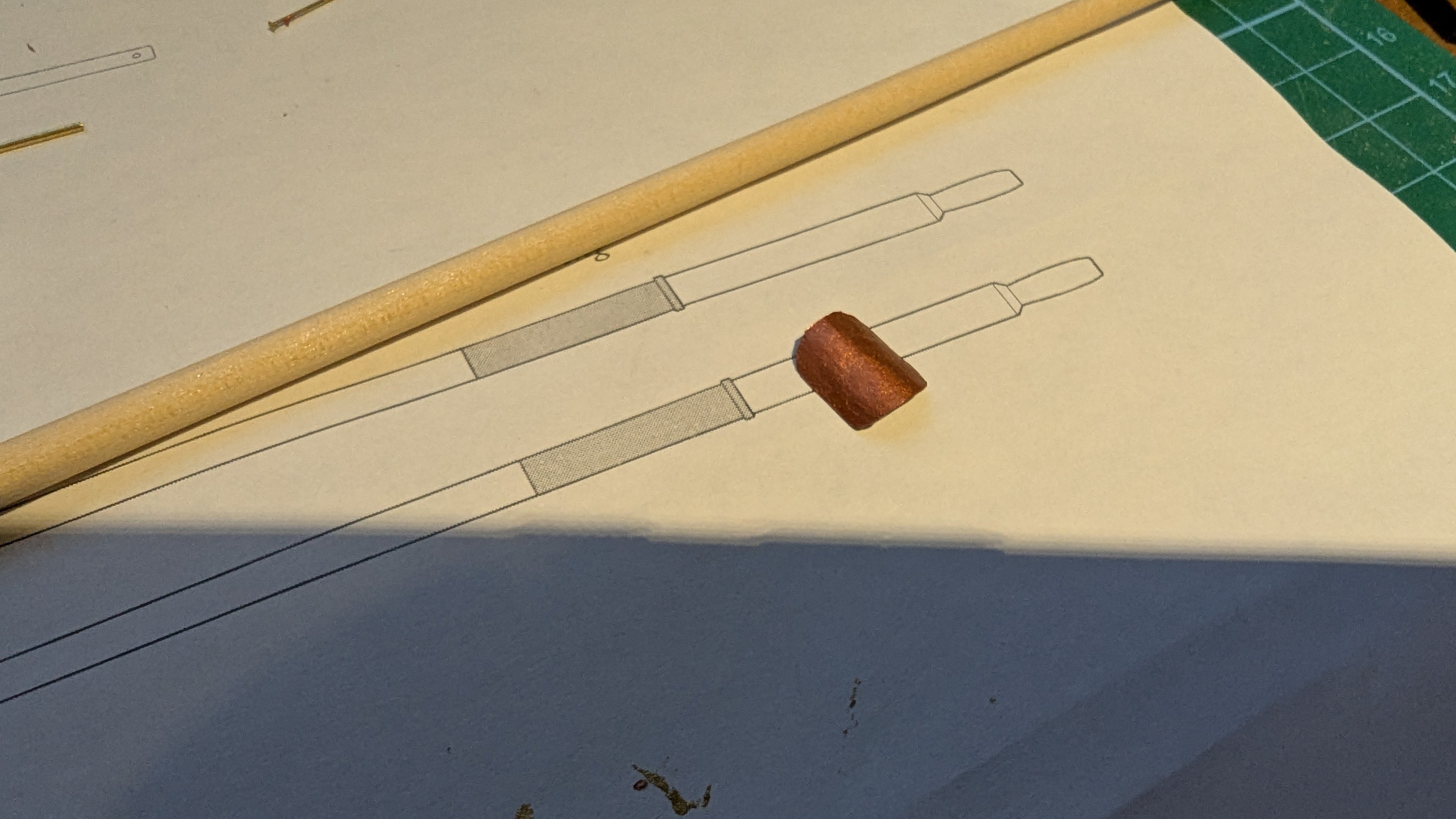

This took the majority of my time. I made both the laser cut glued pieces and the dowel versions. I ended up using the dowel because it's size and taper ended up near perfect. Although the process was interesting, I struggled with the glued pieces. Getting the char off reduced the size too much and discolored it. I found drilling such a small hole in the glue seem to be more awkward than drilling into the round dowel (I used some tricks for that). The bottom end that fits into the mast step ended up way too small and the overall profile was an ellipse - although I don't think that's an issue as many, if not most masts are oval.
However, I finally got to use my Christmas present:
Comparing both masts:
I wish I could remember who, so I could properly thank them, but one of the build logs had used a cordless drill to shape the dowel. I did the same and although it was far too dusty and time consuming for my liking, it worked perfectly. The process really sped up when I stopped using the same piece of sandpaper, and cut 5 or 6 strips to rotate as soon as they got 'clogged'. (Now I might need to put a mini lathe on my wishlist)

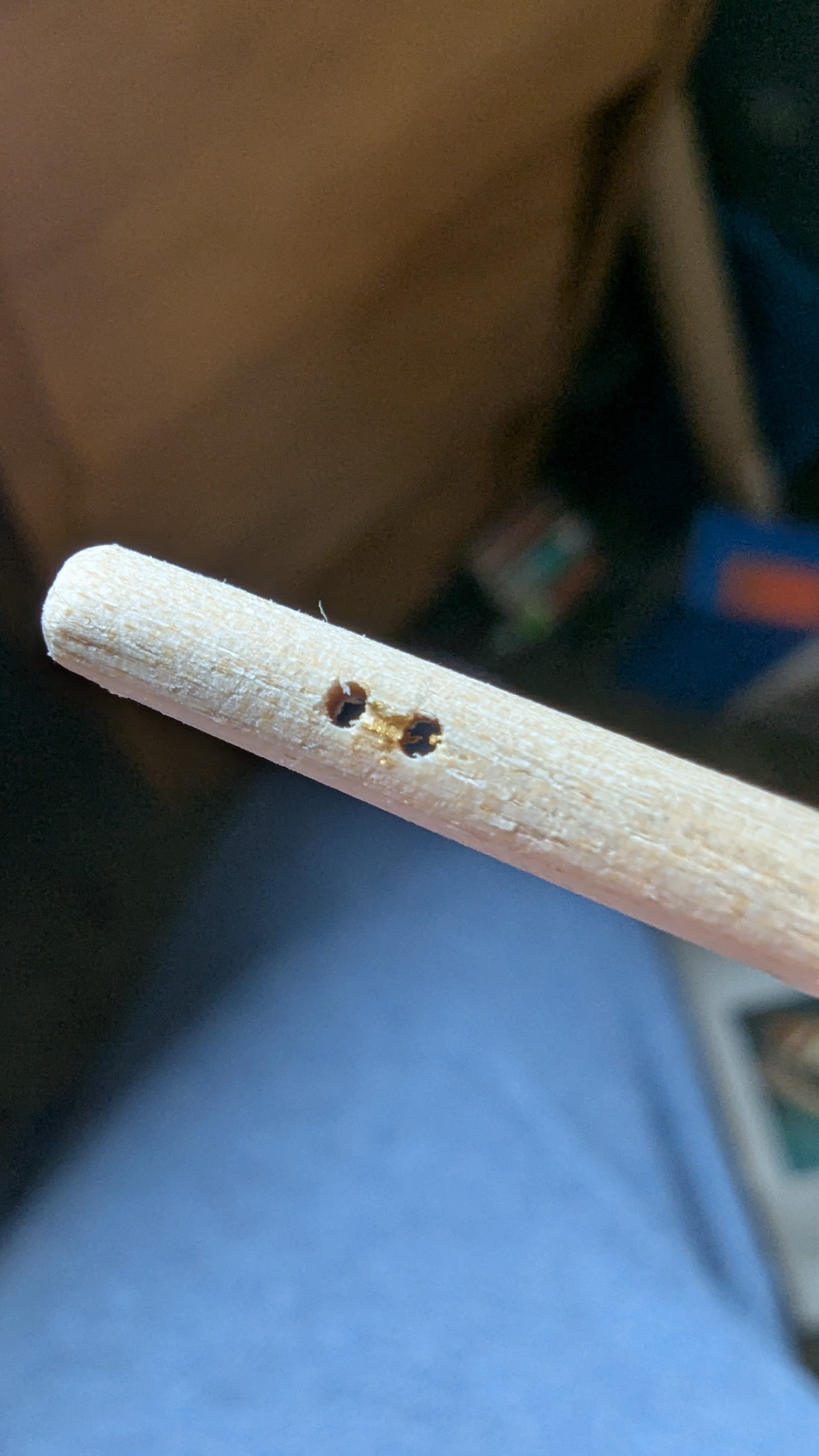

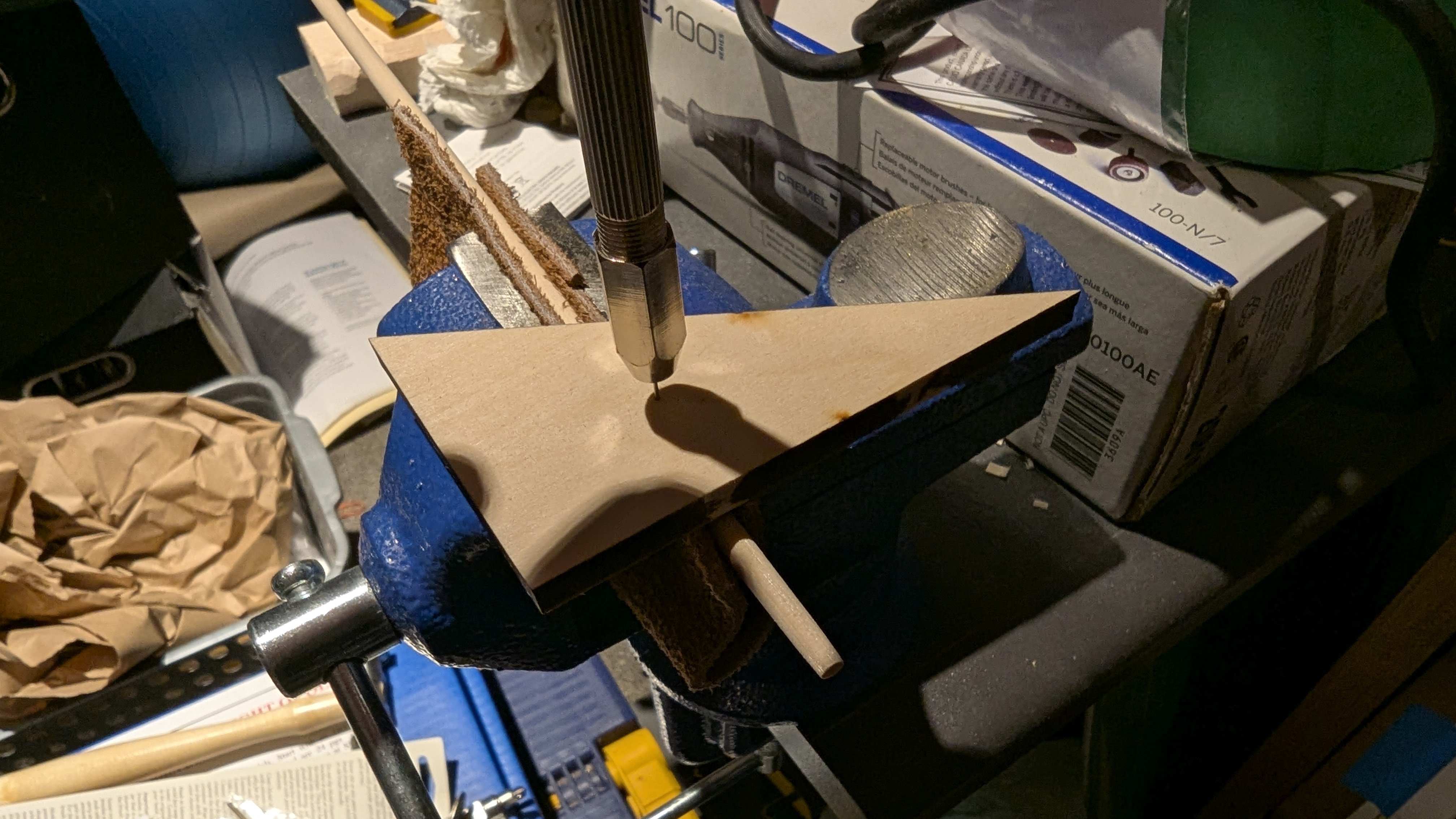

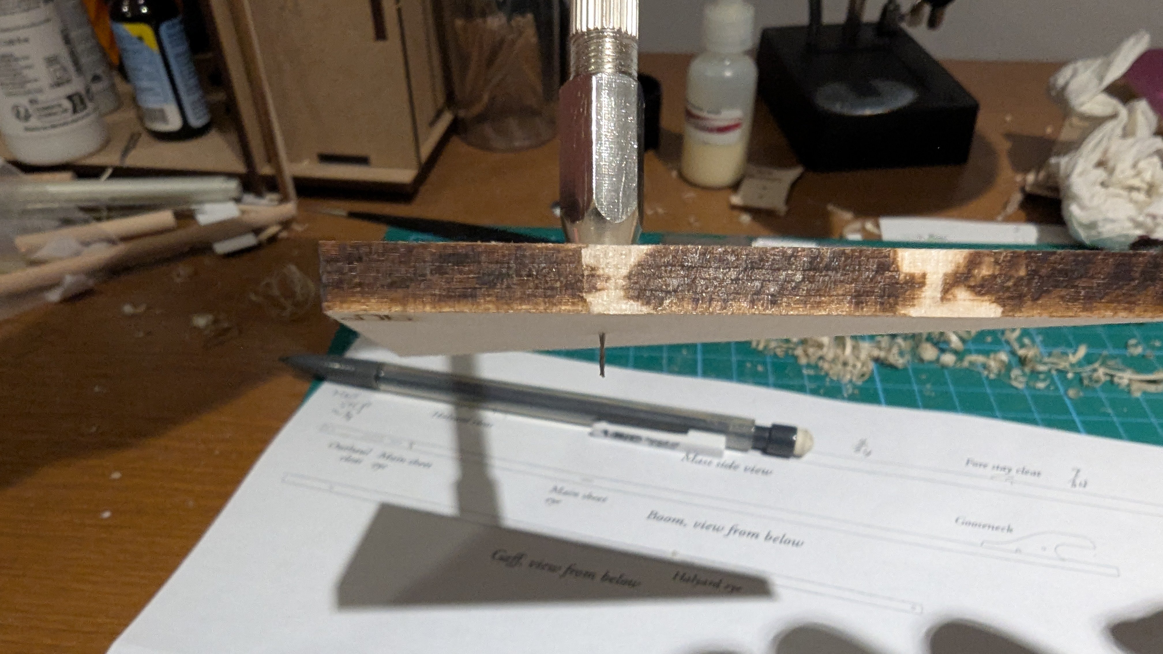

Drilling straight holes in the dowel took some ingenuity. With a press it would be much easier. I made a 'guide' out of a thicker piece of wood, placed the dowel in a vice and put the guide across the top to keep the drill straight. It would've worked even better had the top of my vice been perfectly level, but it worked well enough.
Making the guide:
Using the guide:
Next, to make the perpendicular hole, I drove a pin through the current one and used that to rest it it on so it would sit perfectly level and I could drill perpendicular:

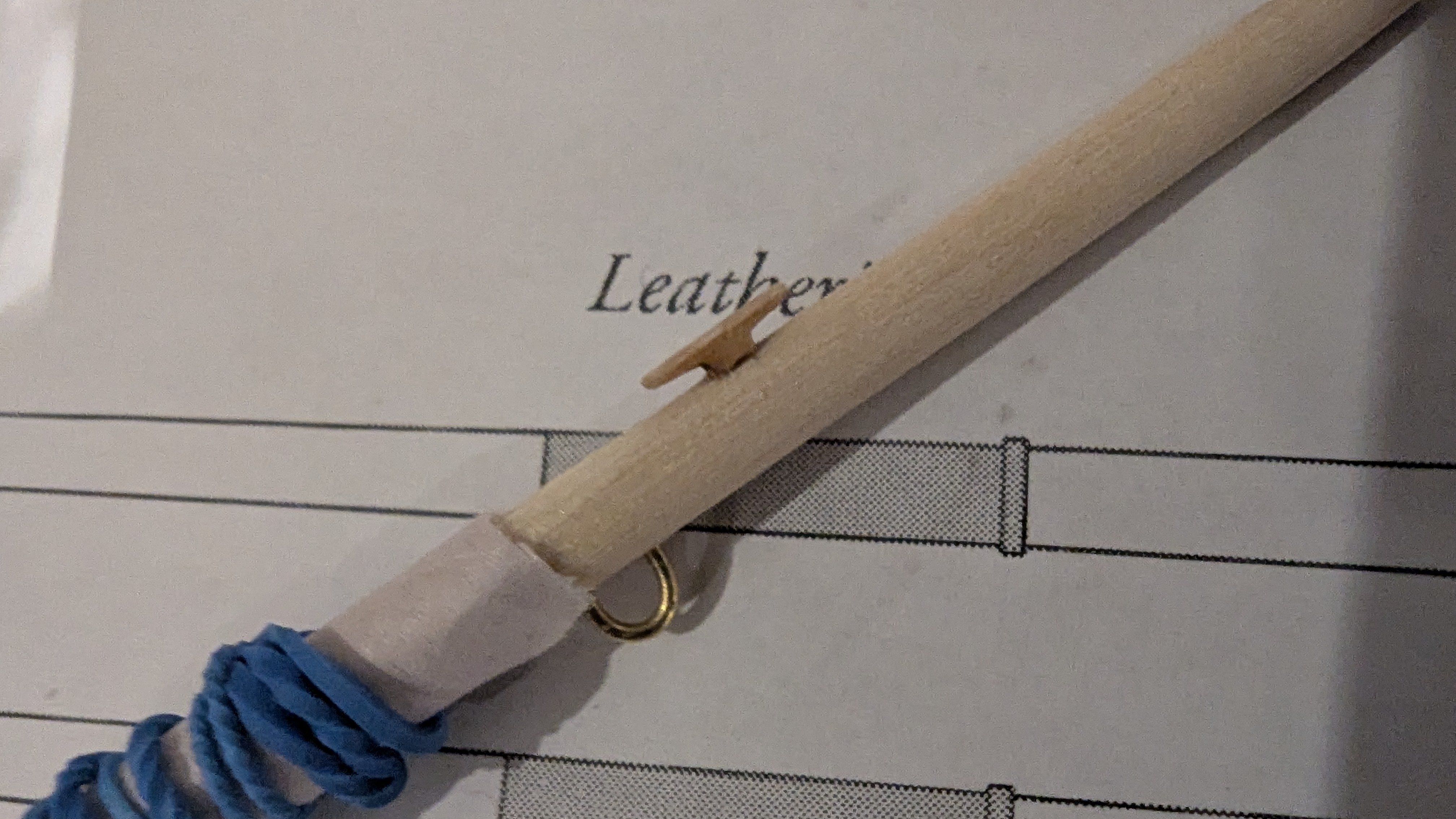

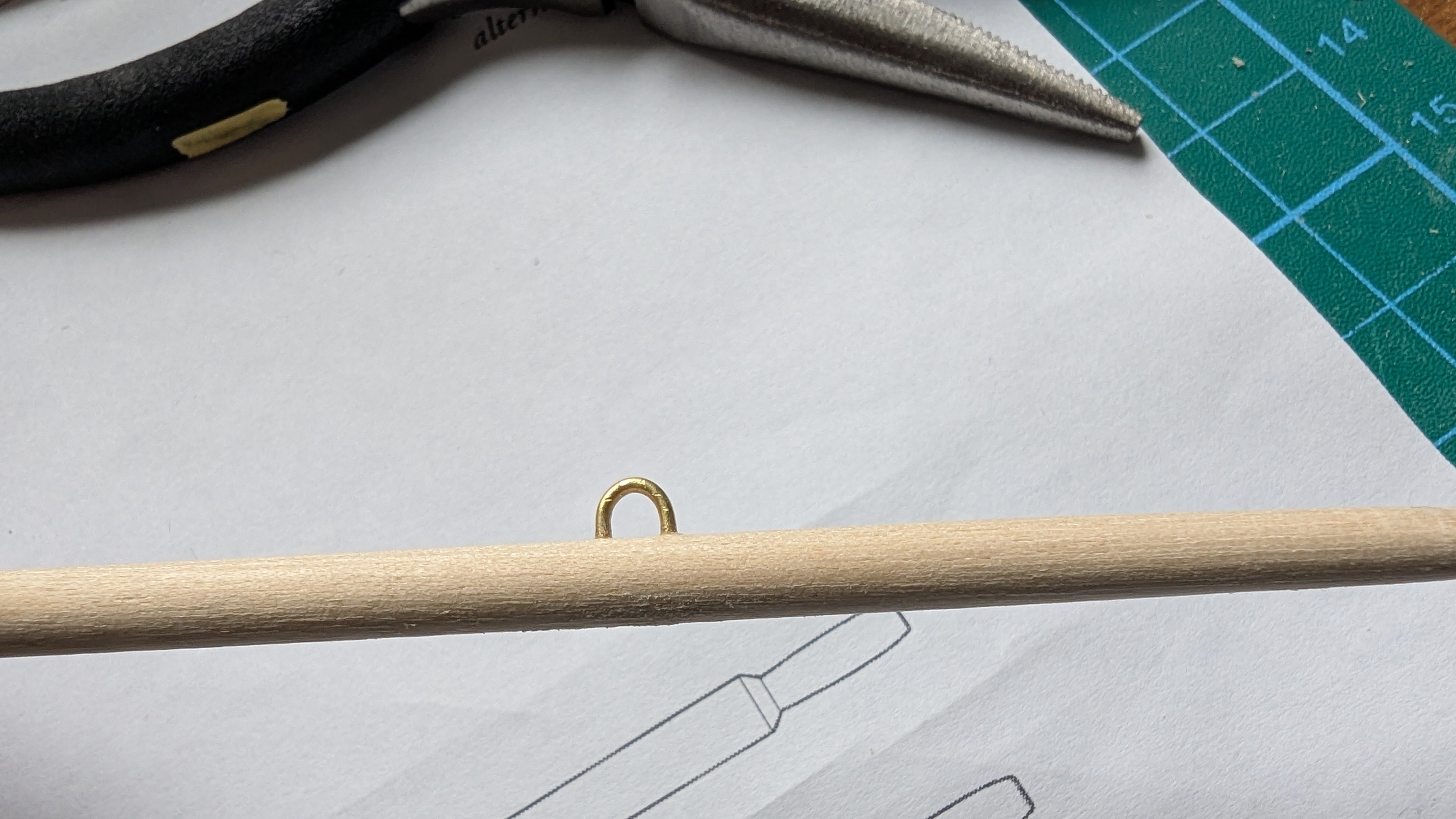

The round nose pliers came in handy for the eyelets. The eyelet itself was a U shape with one tip being longer than the other. That way, I was able to glue in one tip and then line up the other tip to push it all the way in. Applying the cleats has it's own miniscule and shaky hand challenges, but straightforward. Finally, to simulate the chafe pad (I went the 'copper' route instead of leather), I used some copper OcCre paint I had got for dirt cheap from... you guessed it.... the ME clear out sale.
First I simply used a toothpick to slather some paint on a piece of brown paper, wrapped the opposite side around a dowel to give it some memory while drying. Flipped it over, marked it out, cut with a brand new blade, PVA glue and voila.
I sent this to the wife with no context and she asked if my fake nail broke off :blink:
More gold paint, I cleaned it up after it dried, but didn't get a pic:

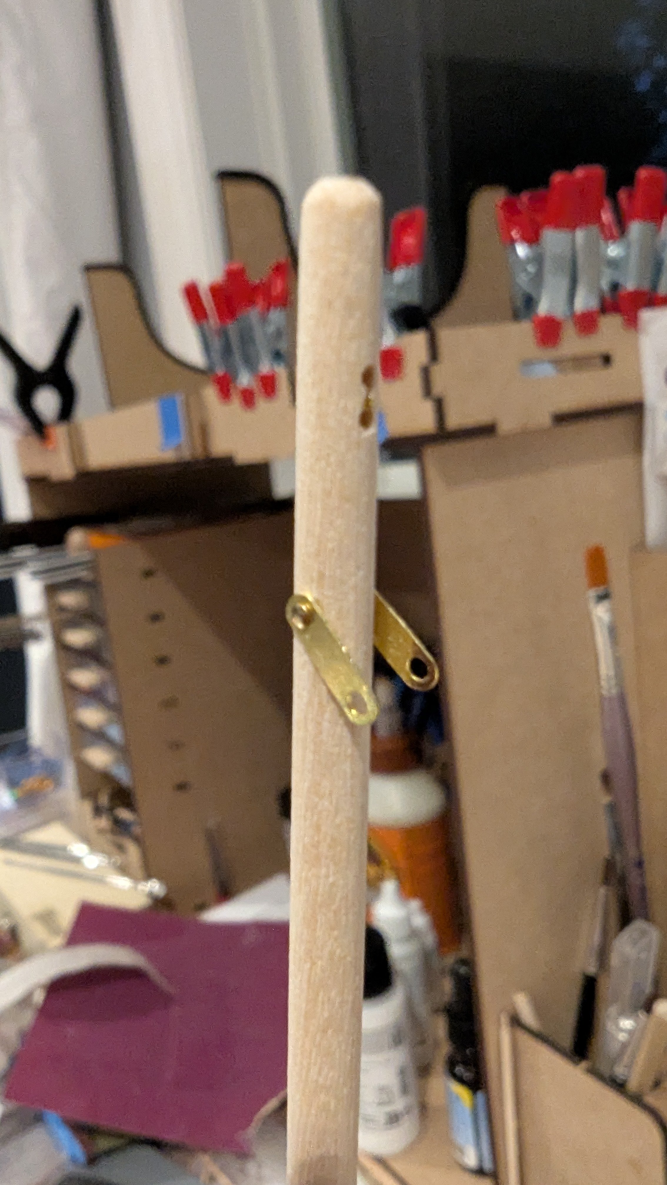

The stay plates swivel since I managed to get them on with only the nails being glued into the mast. Handy if I need to readjust them when rigging
The color matches nice enough; though I'm not sure how durable the gold paint will be. I've yet to glue them in. I was thinking of using a rubbery/flexible adhesive so they could be twisted slightly though the longevity of those adhesives probably don't make them the best choice.

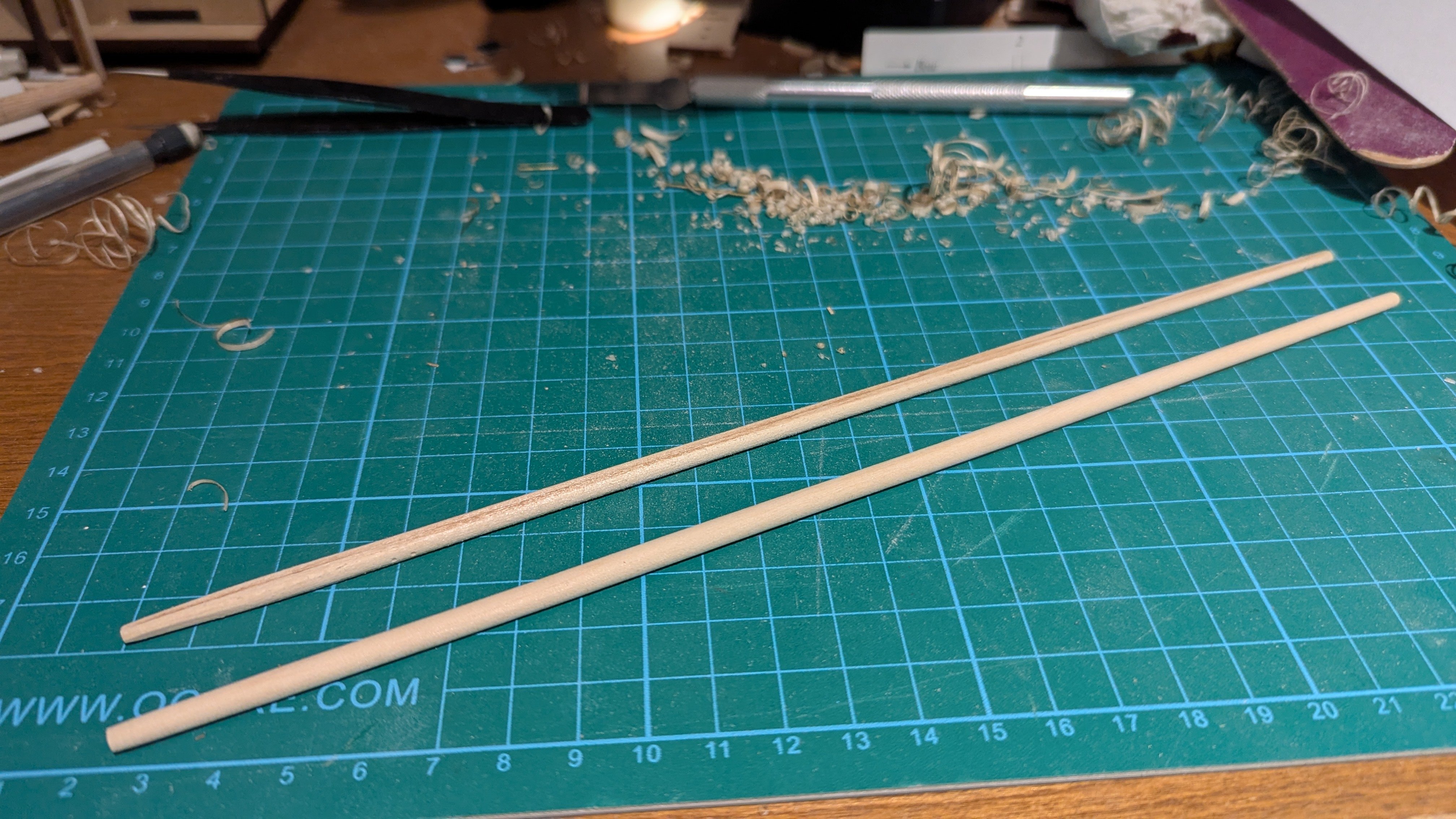

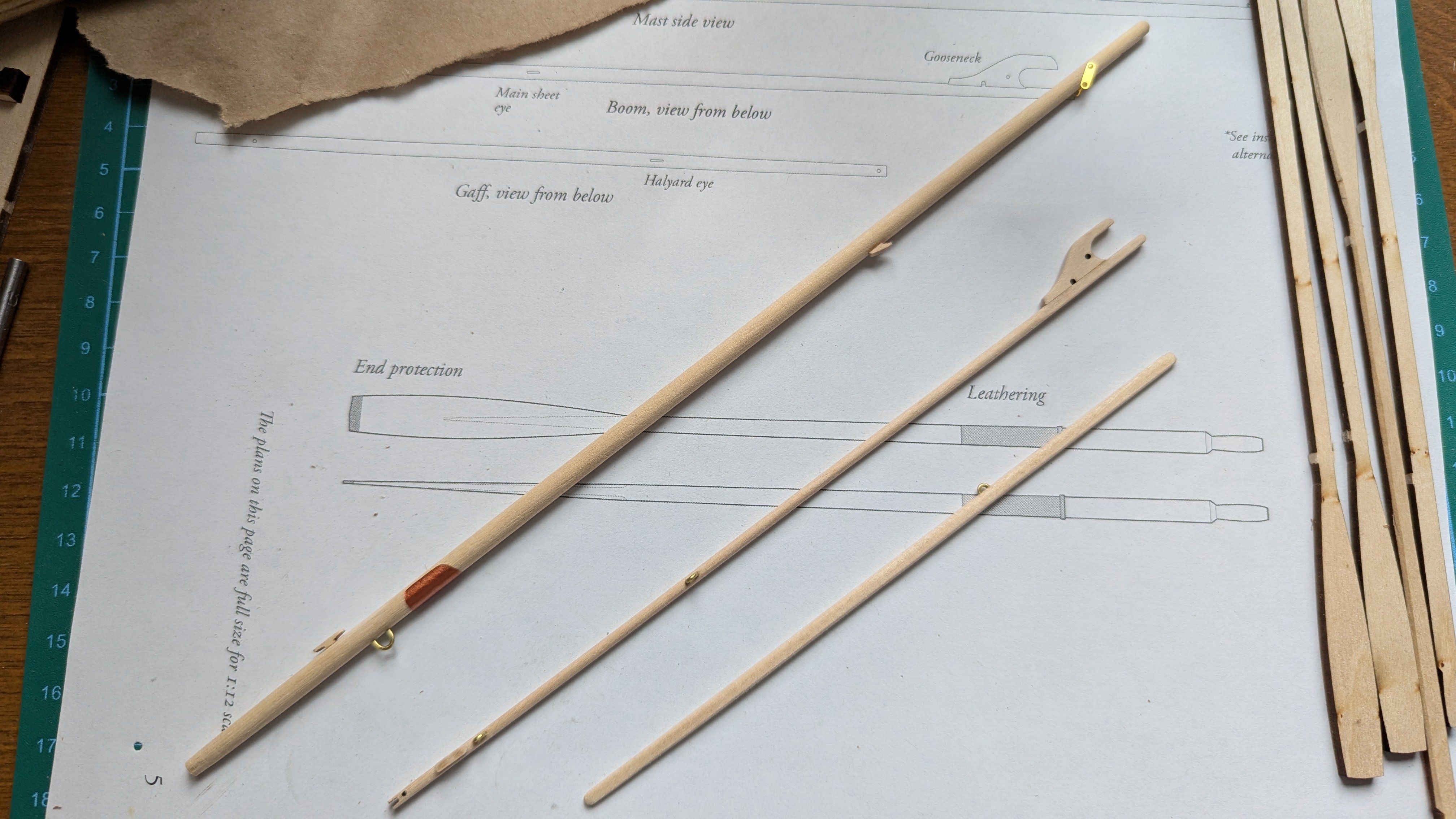

As of this week, I've shaped the boom; just need to finish gluing and drilling. Need to shape the top spar and oars, then onto making the sail and rigging.

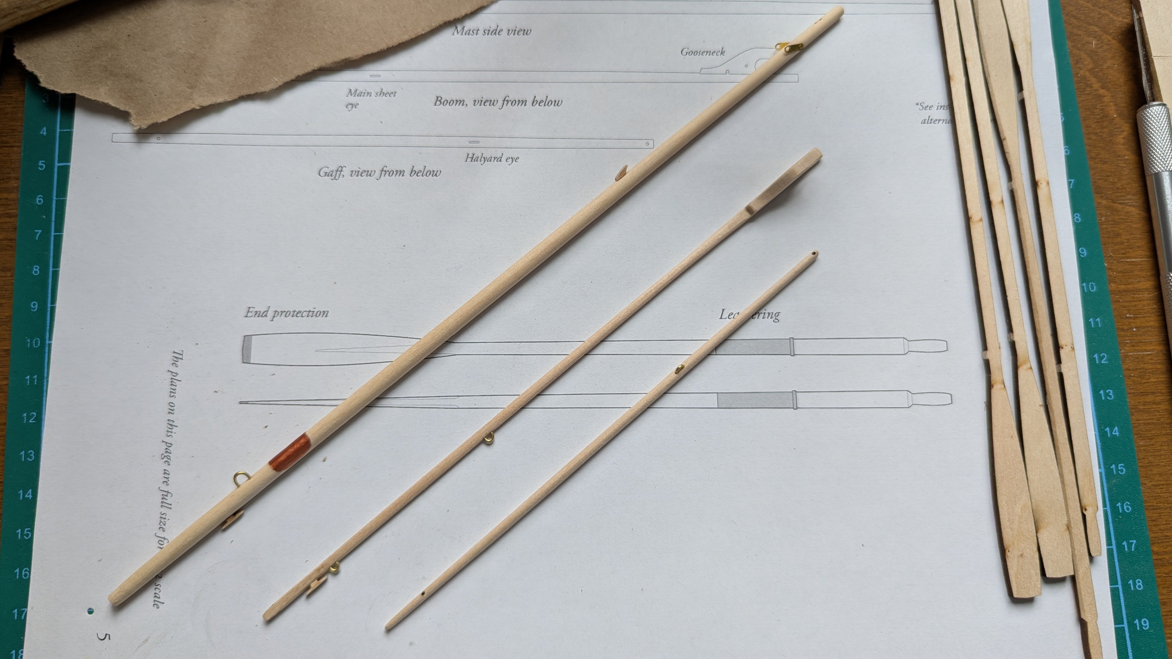

Alright, it's time to finish this up. It's been a busy summer, but I've also been procrastinating the oars due to the dust and the sail due to unknown territory. I needed a push and have been planning to join the NRG for a little while so I took advantage of the discounted offer and also joined the photo contest with the intent of submitting this pram. No, I don't intend to place anywhere on the board, but I figure it'll be a fun experience as well as a big motivation push because time is running out. The judges feedback may be helpful for the future as well.
Log #16 - Finished the spars & started the sail

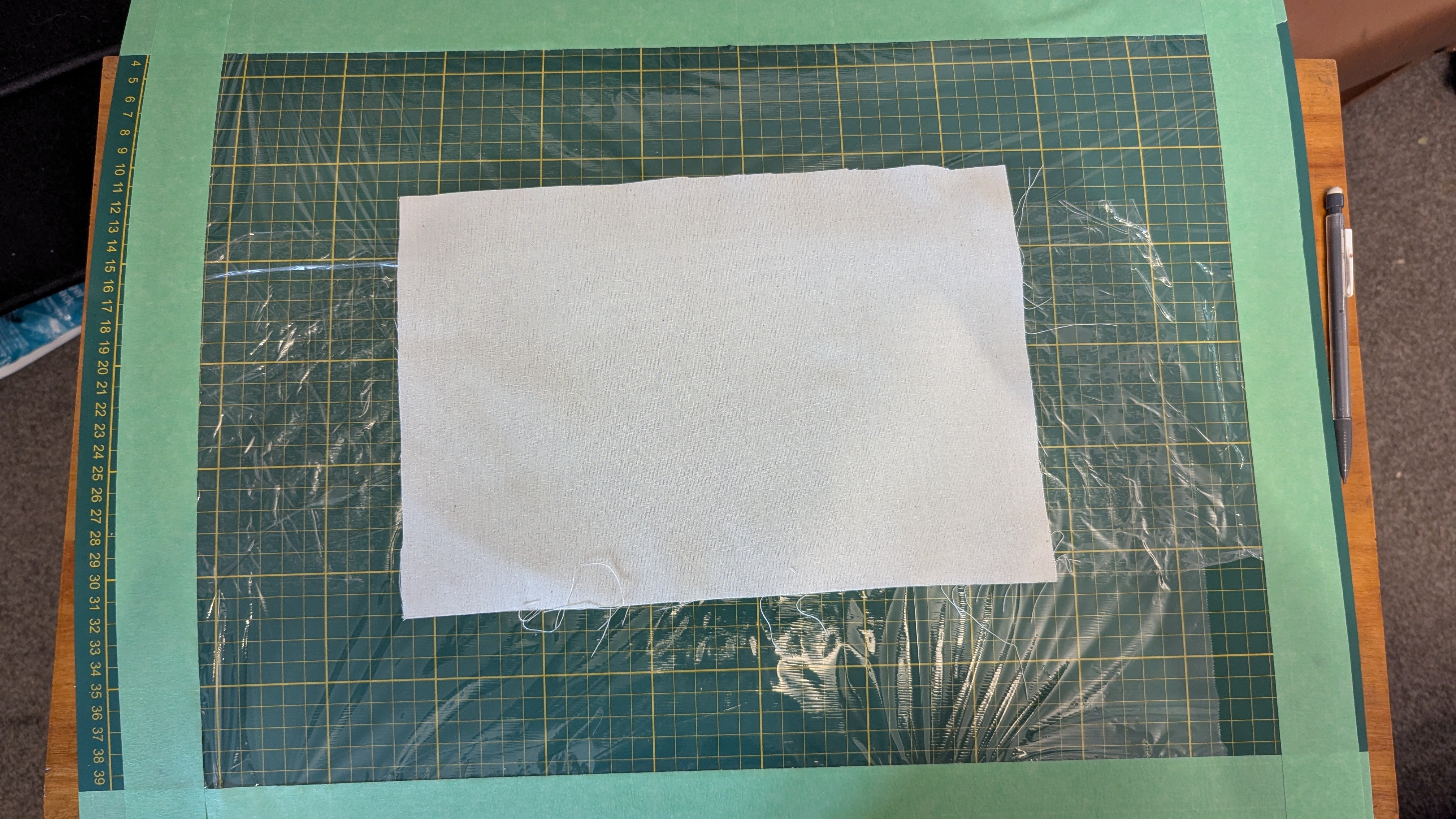

I'm skipping the oars for now and going right to the sail as that'll be the bulk of what's needed for a completed model. The oars aren't really a necessity and even if they aren't done by the end of the month I can still submit the pram with sails.
I finished the spars a while back, my only concern at the moment is how far I pushed the halyard eye in when gluing. The glue cured and stuck it, I tried pulling it back out a bit, but also had to be careful as I'd rather it be too deep than break the entire spar. If it ends up being too small, I'll just need to ream it out a little - not a huge deal.

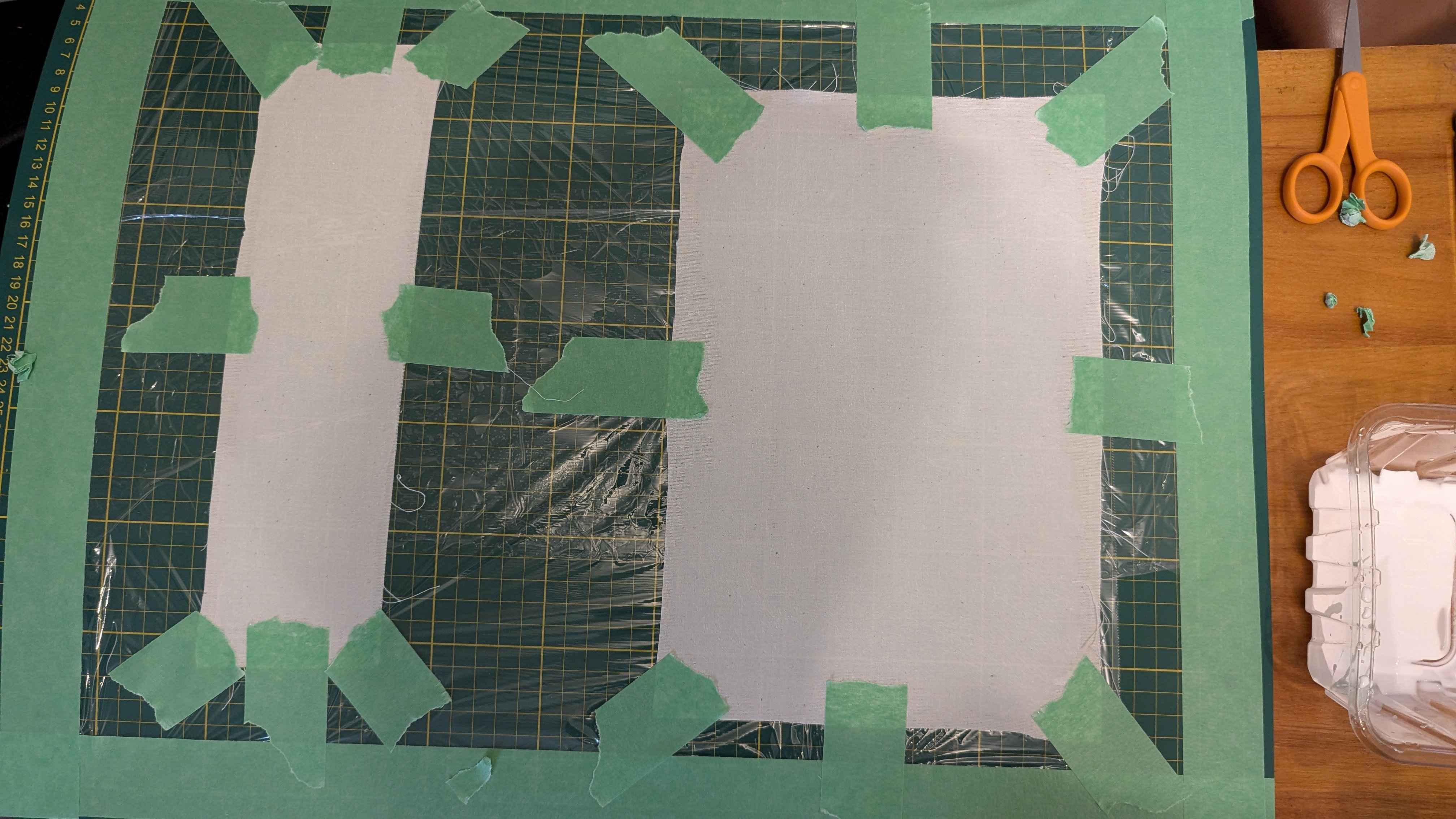

I've only just started on the sail. I laid some saran wrap down as others have.
Glued up and drying
The wife found those unopened scissors in a craft area. Fiskars and incredibly sharp, they did a great job cutting the fabric.
That's it, but I should have more updates coming soon. 11 days to complete, photograph and submit.

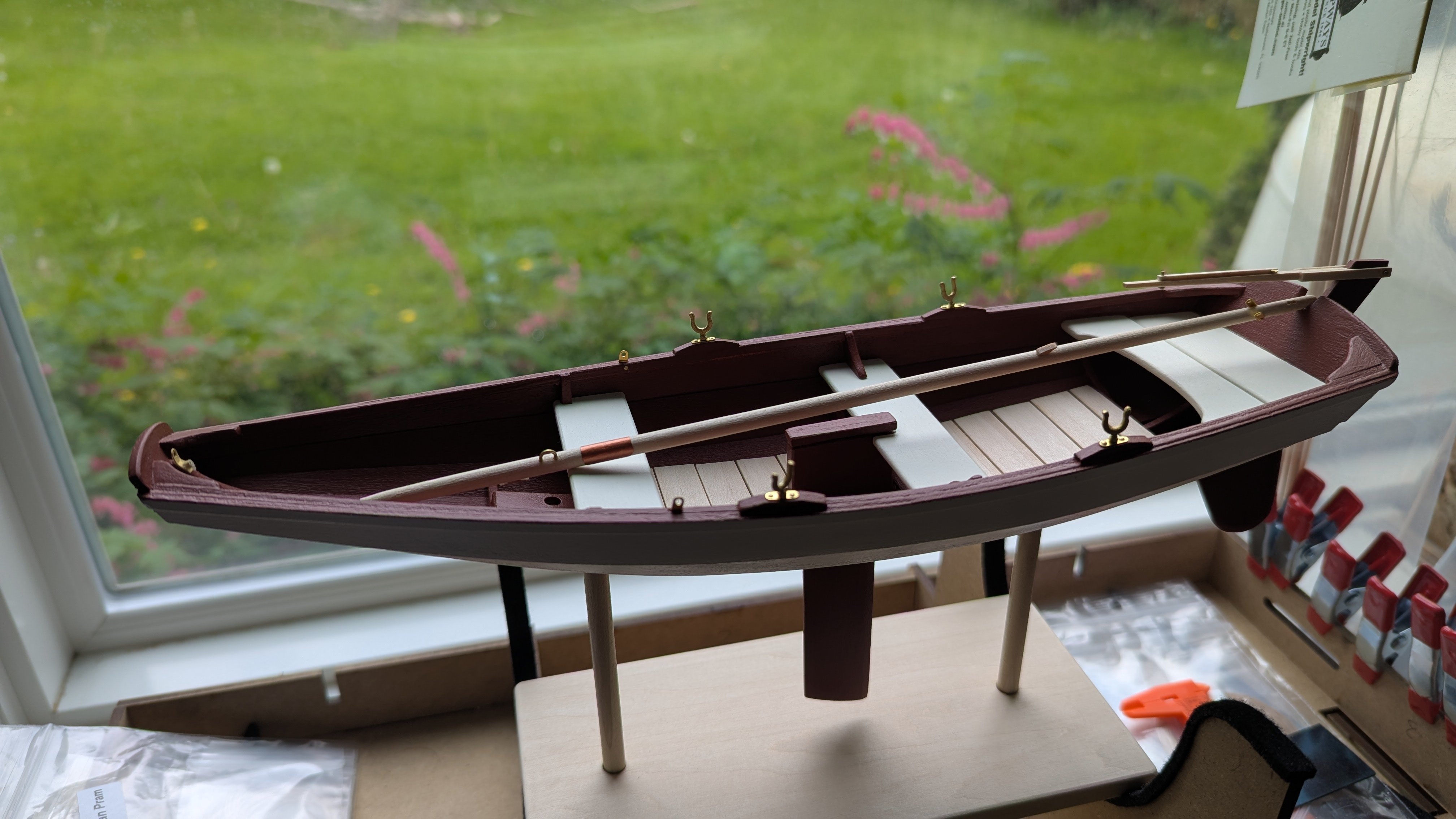

Log #18 - Finished
I completed the pram last weekend with a bit of a nerve wracking finish.
After I raised the sail, I noticed the aft end of the boom was hanging too low. I experimented a bit to see if I could adjust it enough and briefly considered finishing the mainsheet rigging and making it look as good as possible. But I knew I wouldn’t be perfectly happy with it unless it was improved.
The only real solution was to redo the standing rigging, as the mast was leaning slightly aft. The backstays were fairly tight, but the forestay had ended up on the loose side. I decided to remove the sail and carefully cut off and separated the glue from the forestay clip. Once it was free, I pulled the mast forward, clamped the line, re-glued it, and re-tied the knots. It was a success!
After that, I coiled up the loose lines and used various clothespins, a knife cap, and a metal punch to weigh down sections of the rigging while the glue dried simulating the natural weight and tension of working lines.
Letting the glue dry after attaching the back stays
Thinking the standing rigging was done
And after pulling apart and reattaching the forestay
I'll post a few more completed pics in a moment.
