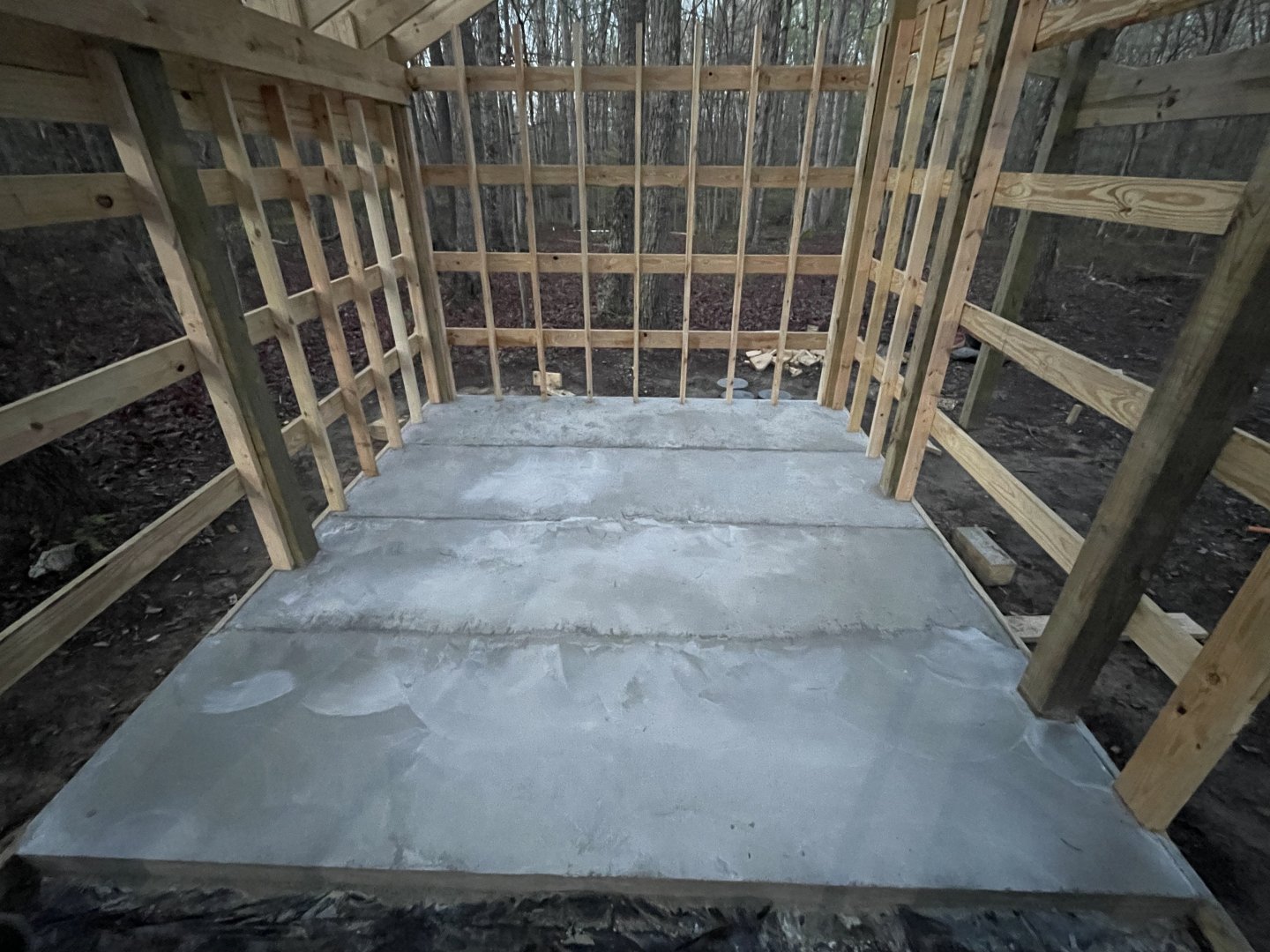

We’re all ready for the first of five concrete pours. I would like to get 3 in this week if possible.
The last 3 days have been very physical. We mixed 20, 80lb bags of concrete a day. The first day was a slow start. The main problem was figuring out the best way to get the concrete out of the mixer to the spot we needed it. My homemade shoot was not making it happen. We ended up moving the mixer out and using the wheelbarrow to get it there:-) Yesterday I was able to put studs on the inside, after that section had cured.
Todays progress.
Two more pours. Hopefully one tomorrow and one Saturday.
The Lord has given us another beautiful work day here in middle Tn:-)  We are ready for another pour soon as I finish breakfast.
The concrete was finely finished on Saturday. I was able to attach the interior studs as the concrete cured.

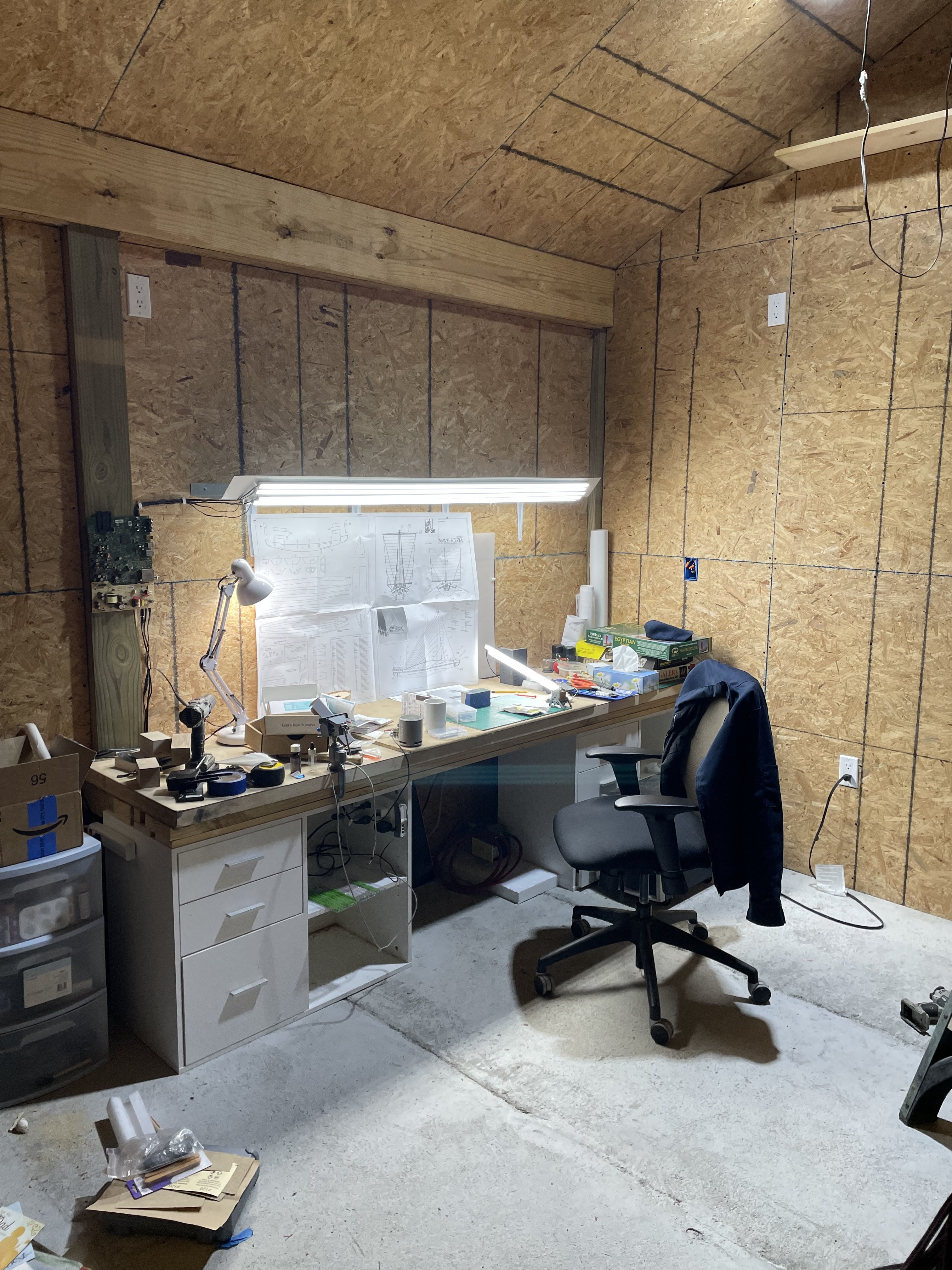

I’ve only been at this hobby for 2 years. That made it hard to design the work spaces. I’m sure I’ll need a plug or a light at another spot. On the north wall I put 2 outlets one 18” and 1 at 3’. I’m not for sure what will go here.
The east wall is where I’ll work. I made two stations will plugs above and below the future counter. Also above each station at the ceiling I put an outlet from the light circuit for some kind of under cabinet lighting.

plastic tarp between the dirt and the concrete.
Hey Yves, I’m no concrete man but it’s done by others around here, for a moisture barrier to keep it from migrating up through the slab. It maybe our fluctuating hot and cold most of the year.

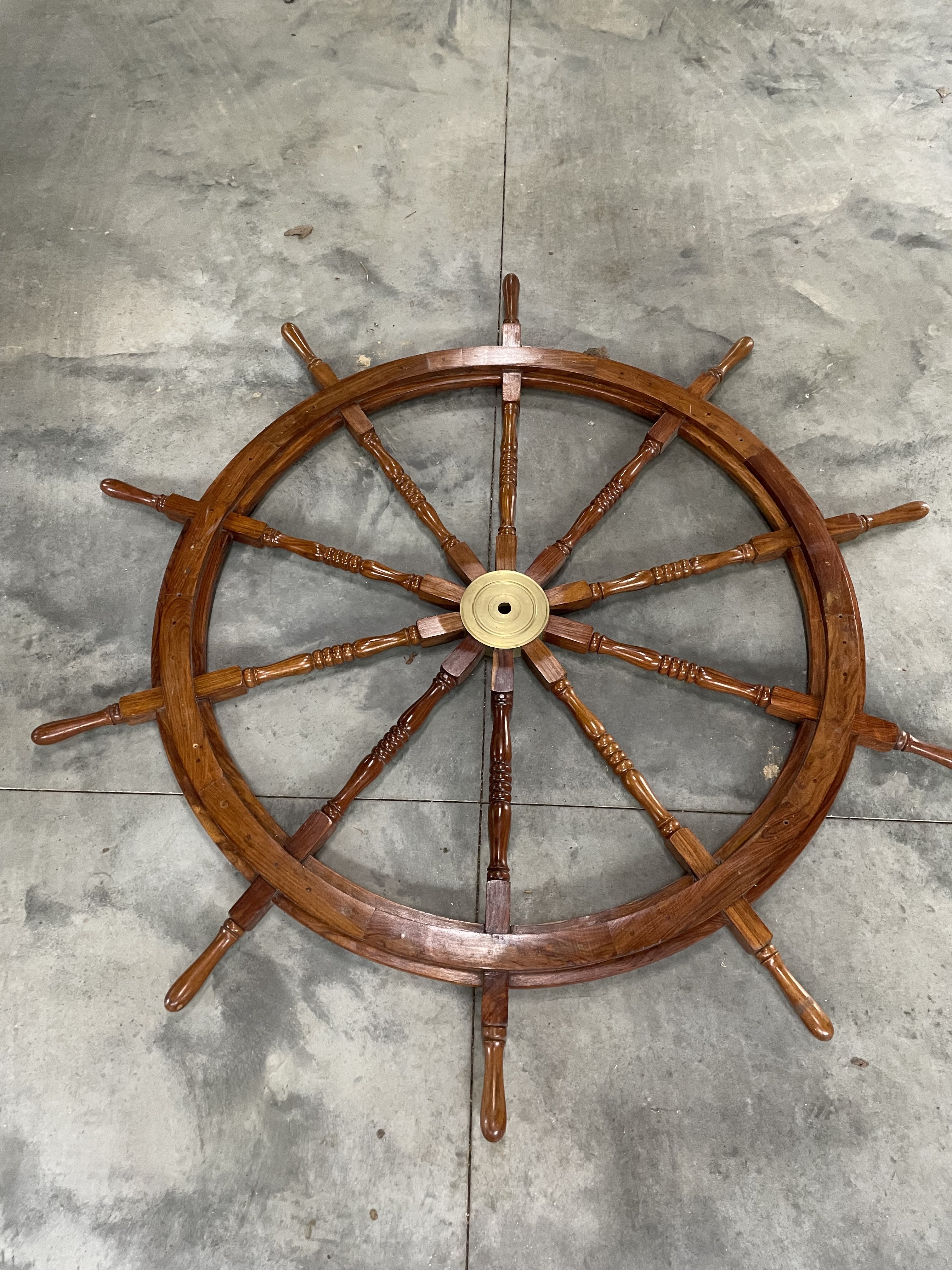

Standing back looking at the front of the shipyard, I thought it needed something on that blank wall. Would you believe in the hills of middle Tennessee I would find the perfect art that would identify my shipyard at first sight!
This wheel is 6’ diameter. We picked it up this morning on a short drive for less that the cost of a nice kit:-)
Now I have to decide what I need to use to weather proof it. It was decor not the real thing I believe. Then comes the “how to hang it on the wall” 🙂

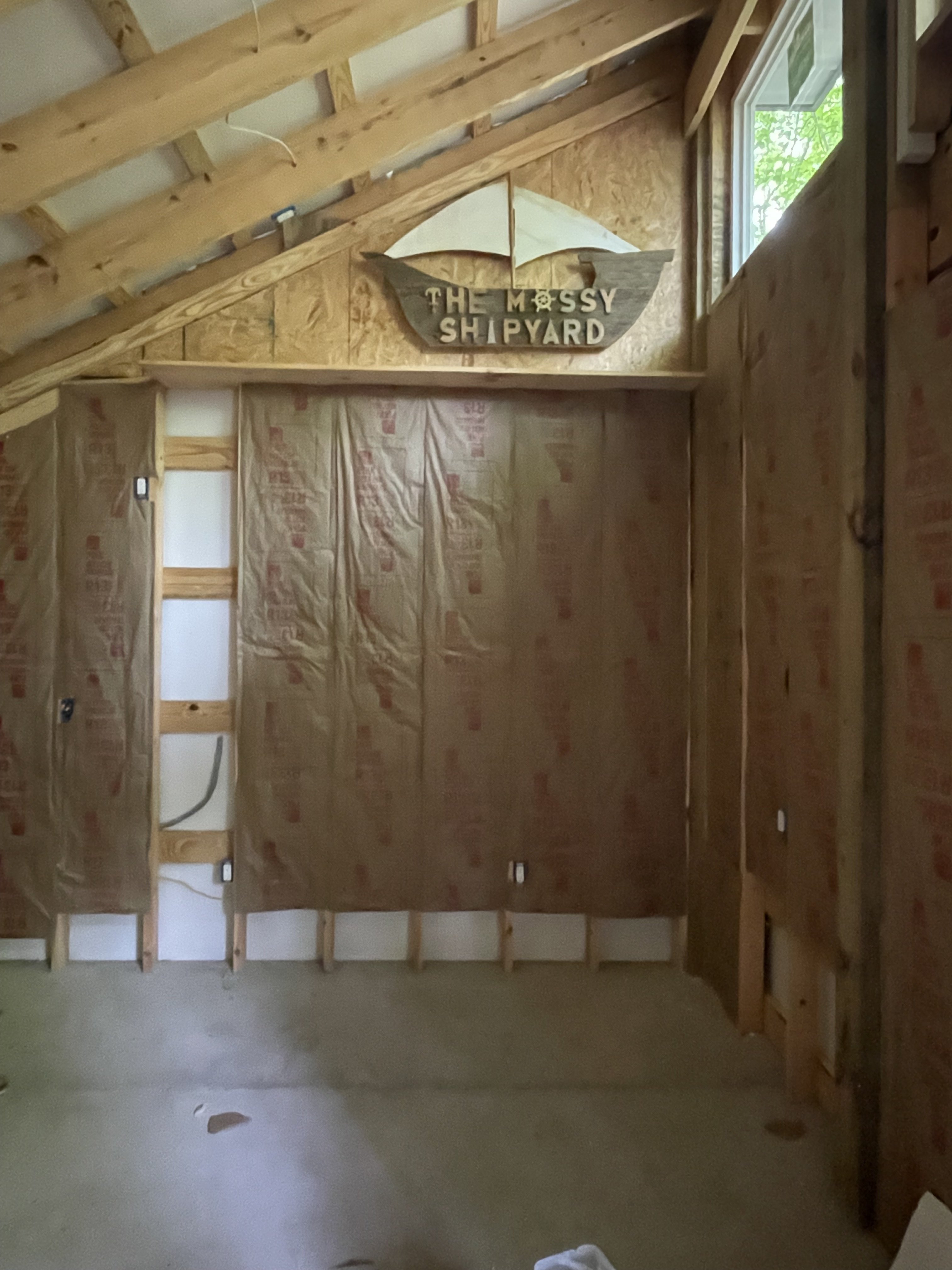

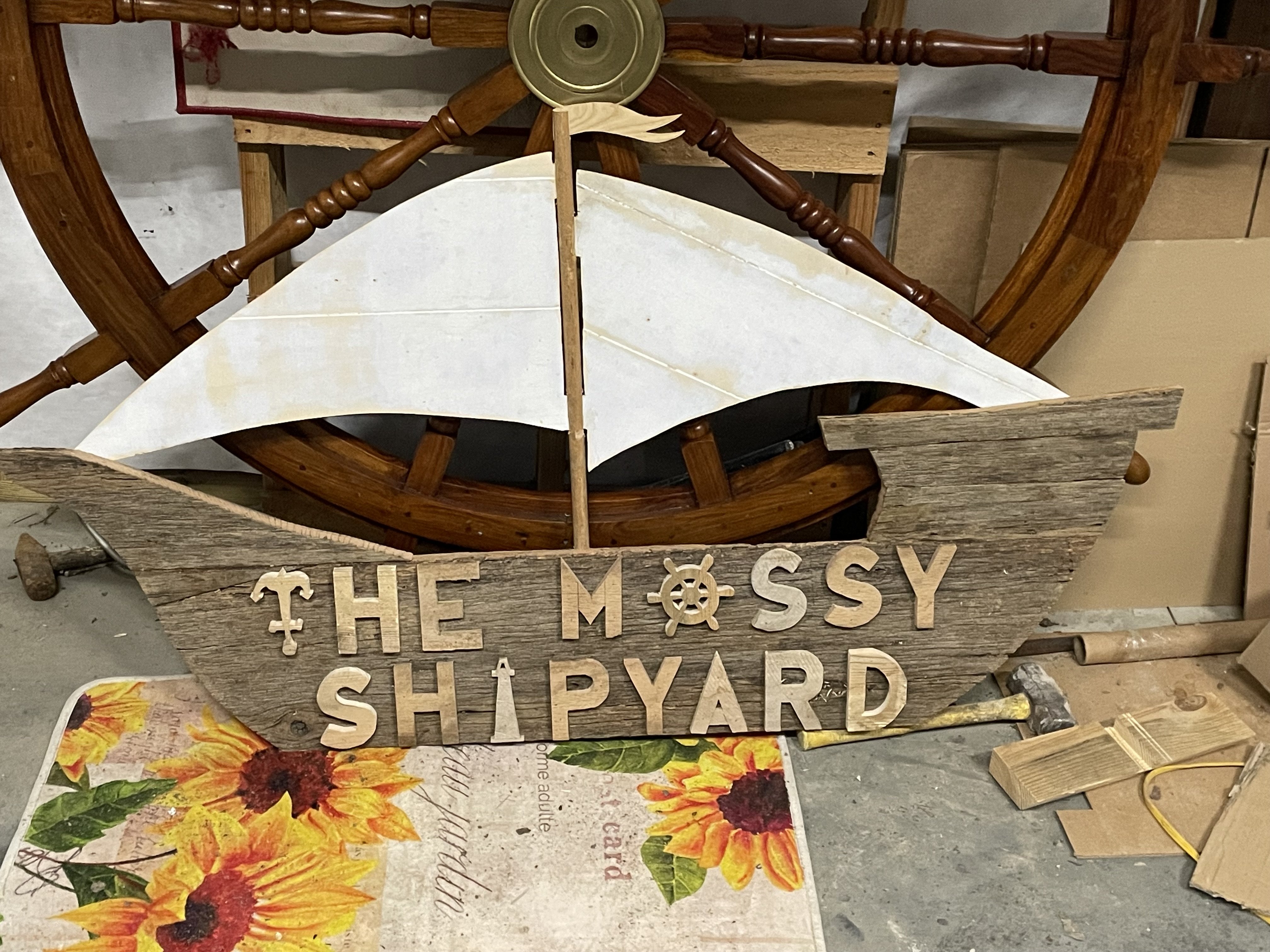

Yesterday, I had a visit from a friend that’s a retired teacher. He had made me a sign for my shipyard. He clams he has no knowledge of ships at all, but I think he did a great job. I know it took some time to cut out the letters.
I’ll hang this one on the inside wall at the height of the windows.
I’m still trying to finish the inside framing and a few electrical loose ends. Then we should be ready for insulation and OSB wall board. Thanks for stopping in:-)

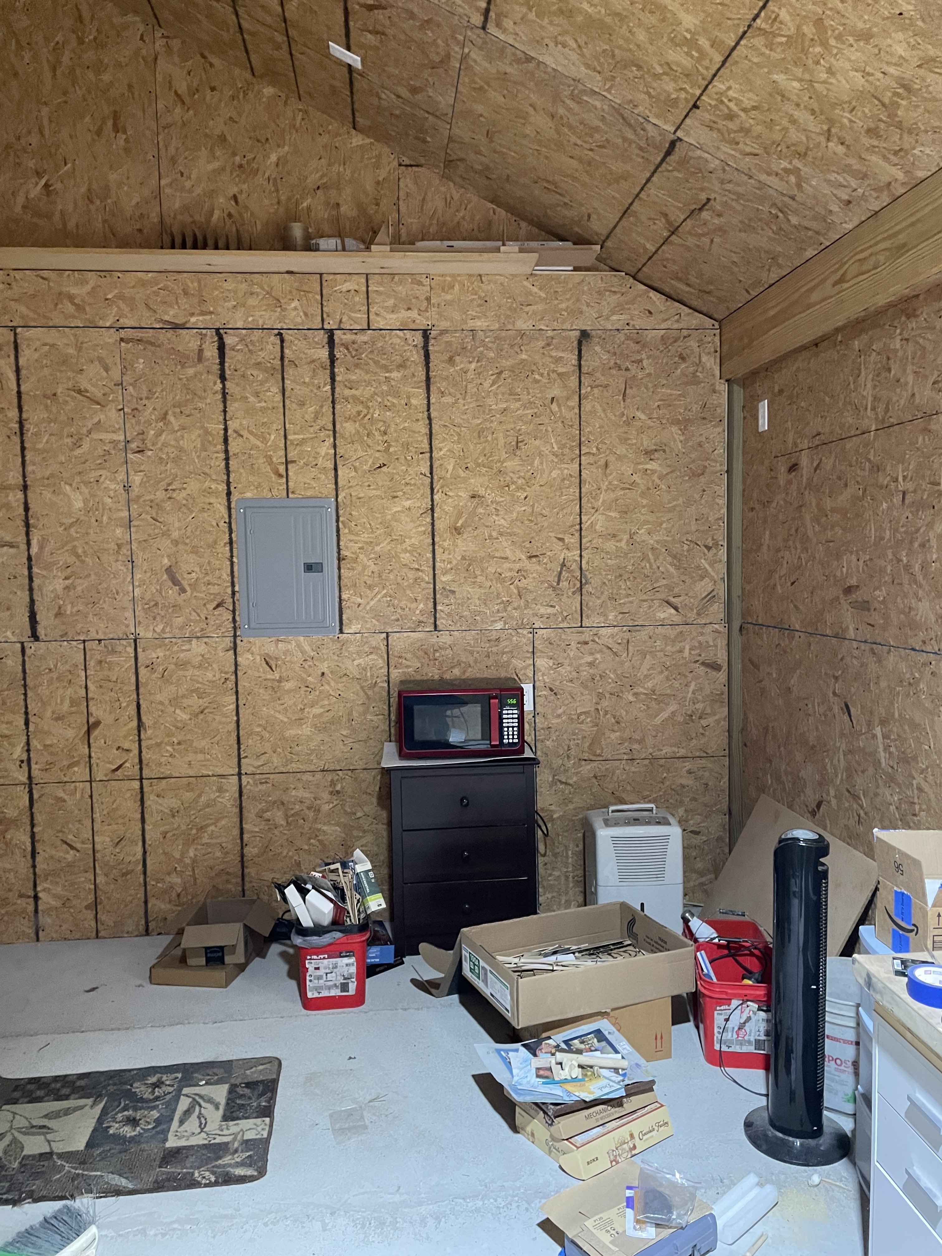

Work is slowly being done on insulating and wall board. I’m still waiting  to receive two electrical components that will be in the wall. We did get the first of the wall board up:-)

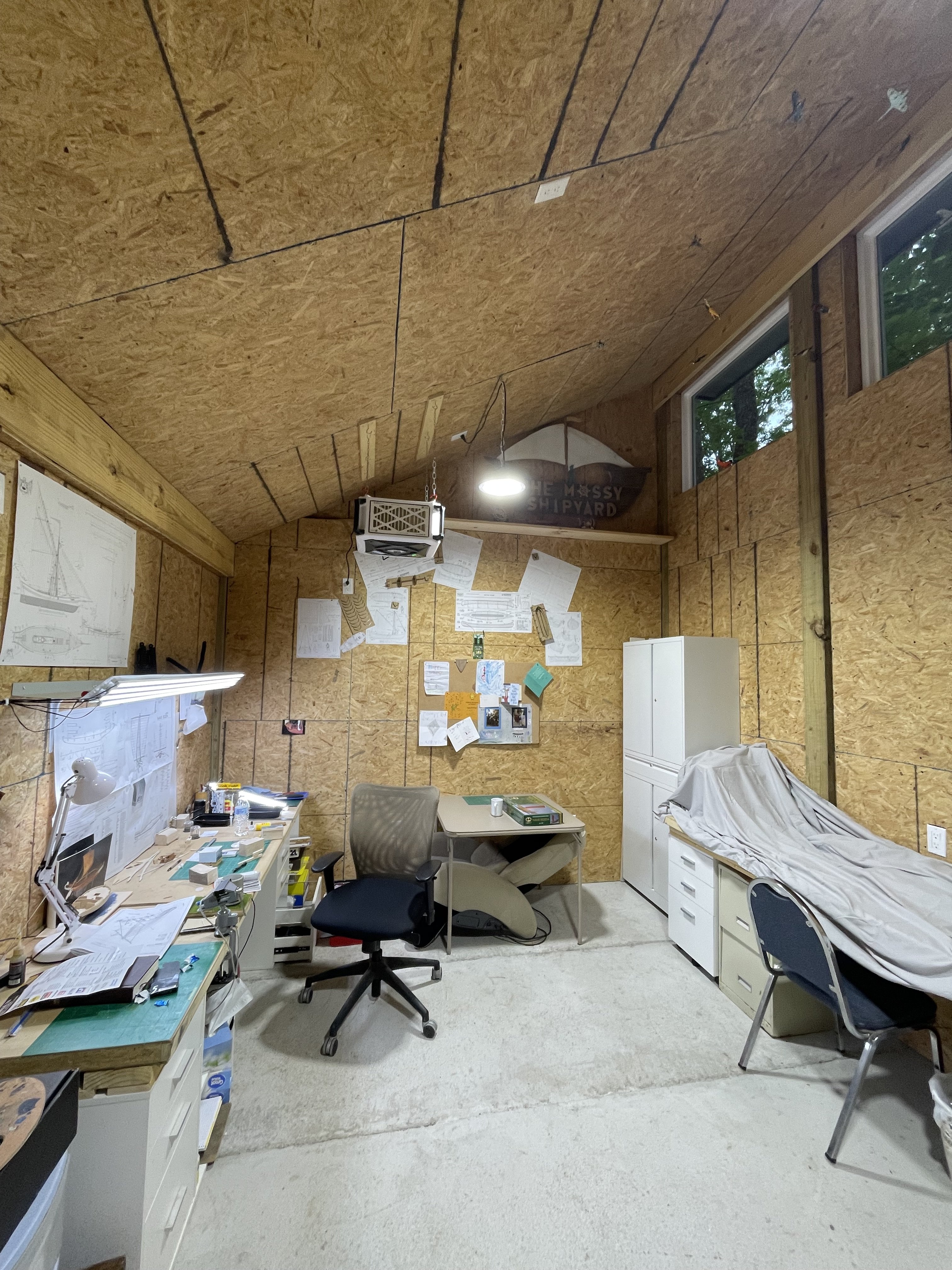

I made the move yesterday into the Mossy Shipyard. Junk everywhere! I pulled a new kit out just looking at the instructions for now. I need to get things cleared away before I start laying wood down or it may not ever reappear.
It’s going to take some time for me to figure out where things need to go and mostly things that need to be gone. I feel this build will never be finished.
Edited by Bryan Woods
I’ve spent the last few days cleaning up the old sight and moving some storage racks in, to give my wife more room for her decor.  I have found a little time to staple some prints and old memorabilia on the walls. I may wait till that’s further along, before I show it:-) The lights came in. Lots of lumens:-)
The Mossy Shipyard is gradually filling up. We got my wife moved in with all her scrapbook supplies. She covers her stuff up when she’s not working on it.

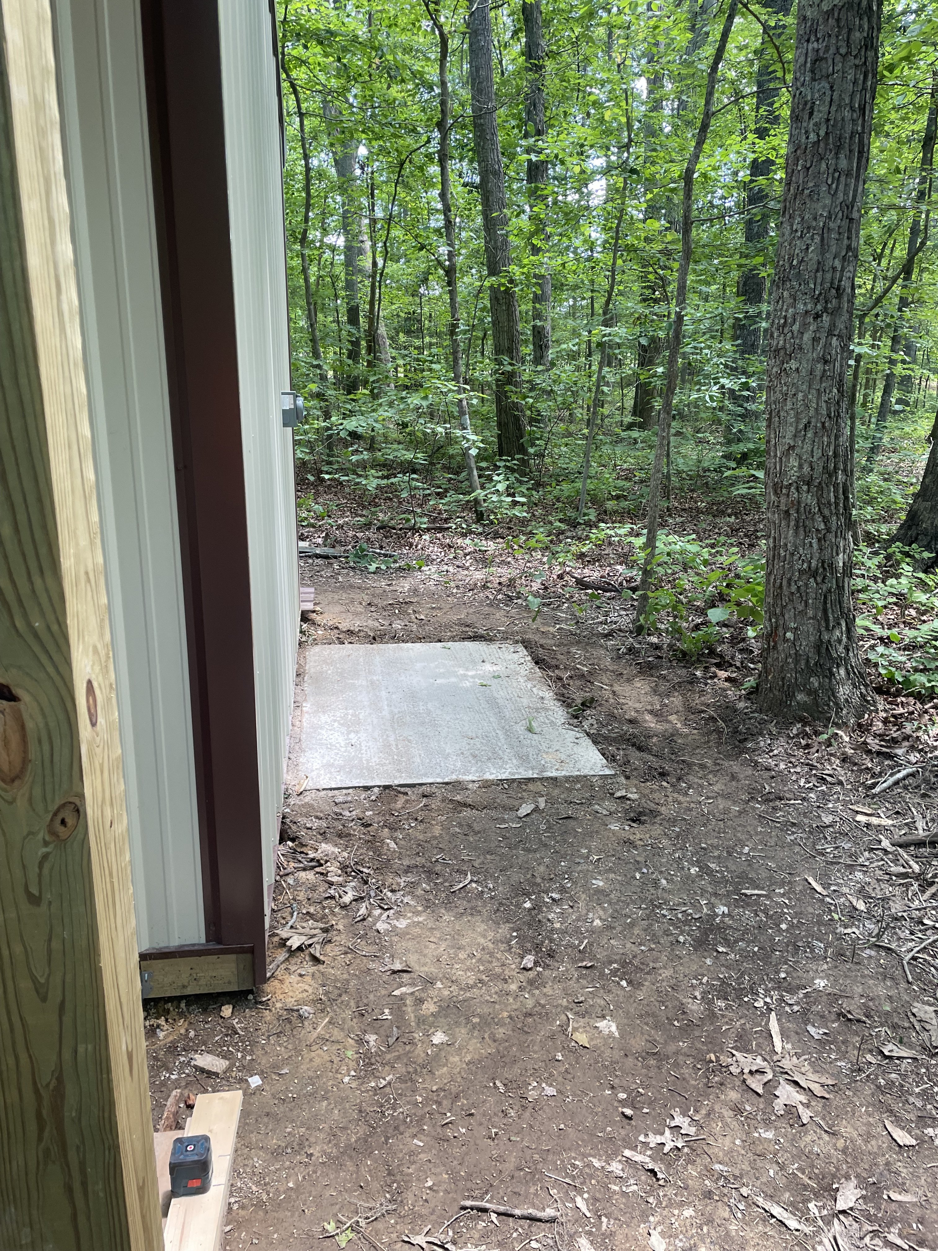

On the outside we used the last remaining bags of concrete to pour an equipment pad on the south end.

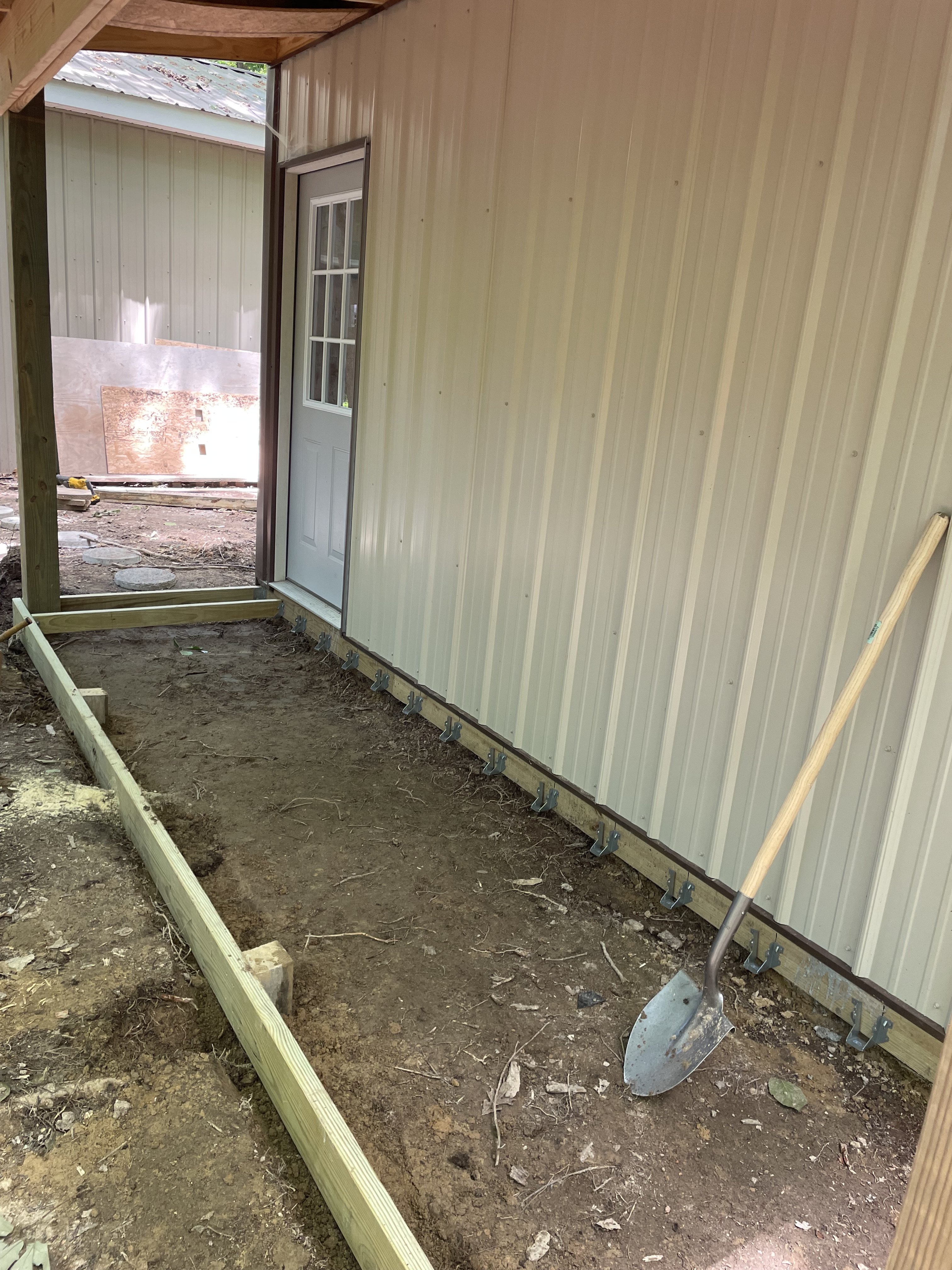

I’m still working on the porch. Hopefully get it finished this weekend.

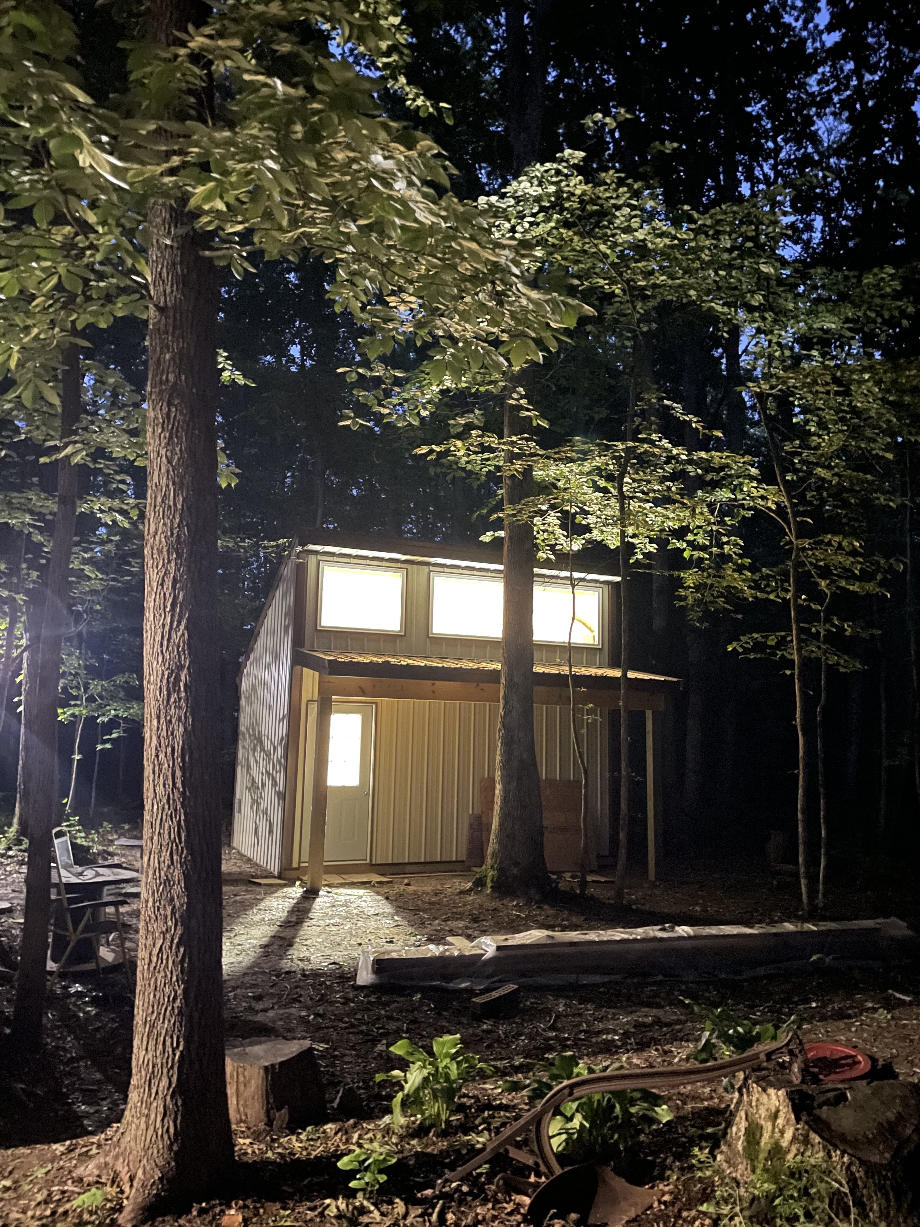

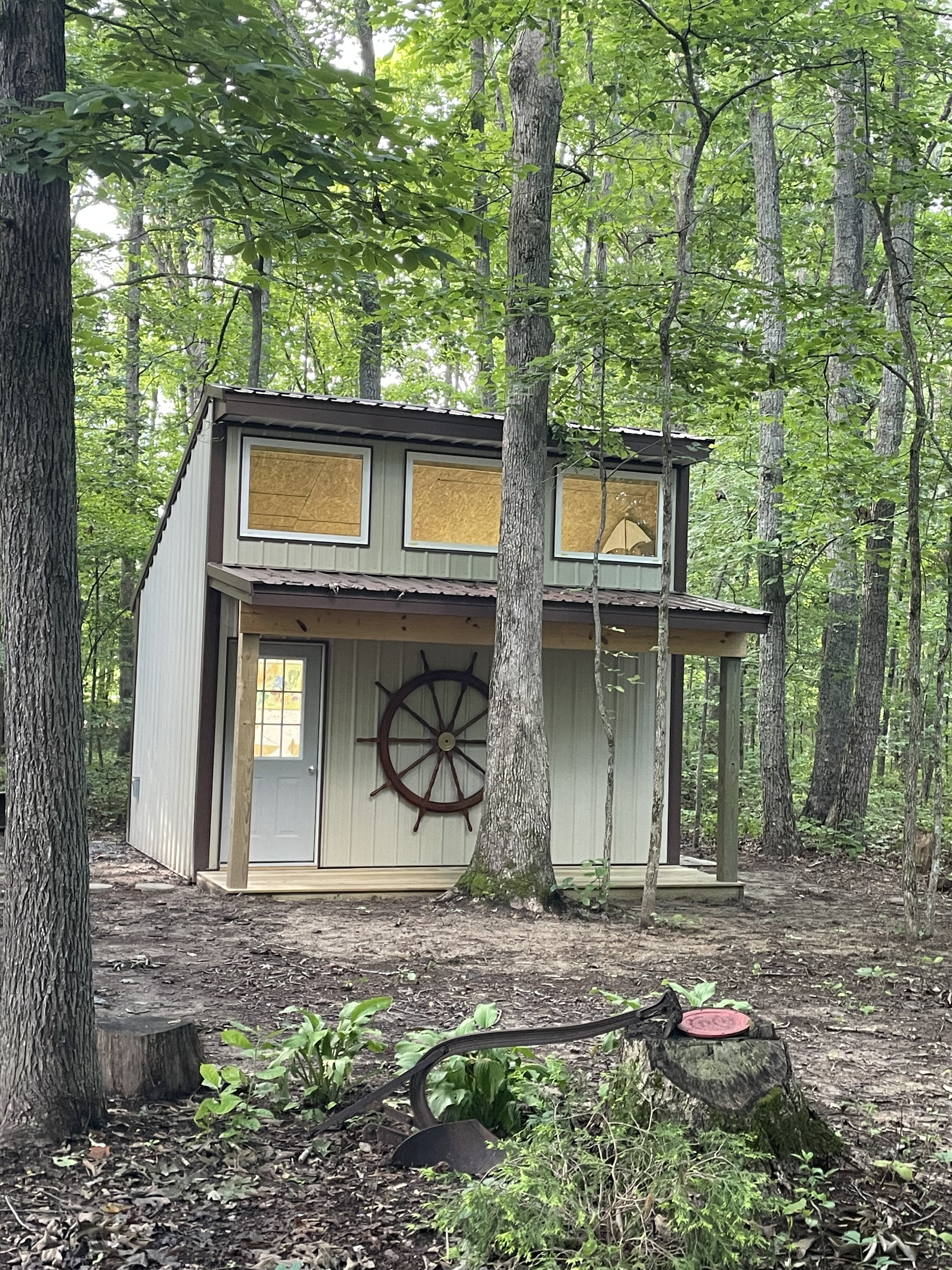

I finished the porch earlier this week and hung the ship’s wheel this morning:-) We will probably stain the porch, post and header later this summer. But for now it’s modeling time!

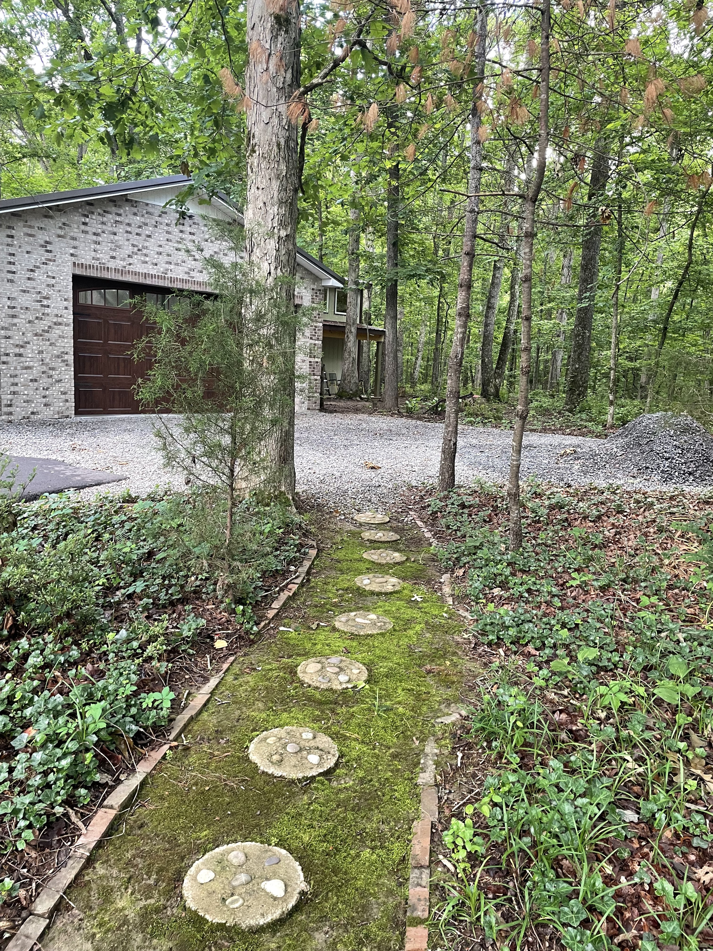

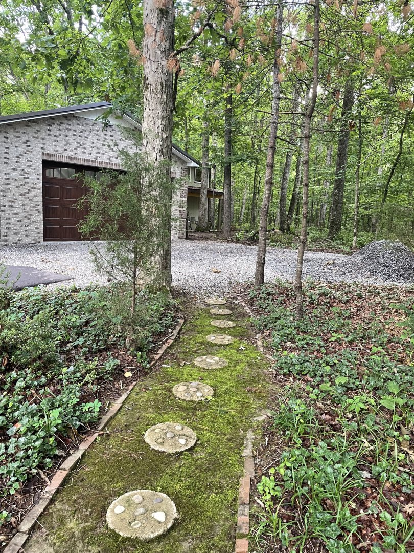

I’m hoping if I can keep to ground clear of aggressive vegetation, The Lord will bless me with his very own carpet. Here is a walk that’s took about 3 years.
And if you fail at that mission, He will give you an impenetrable Southern Woods mass of carpet, walls, and ceiling, but no doors!

Really looks great in that last photo, with the wheel on the front.  It has a bit of a “western saloon” look about it.  A gravel path from the front door to the house might help keep mud out when things get wet.
