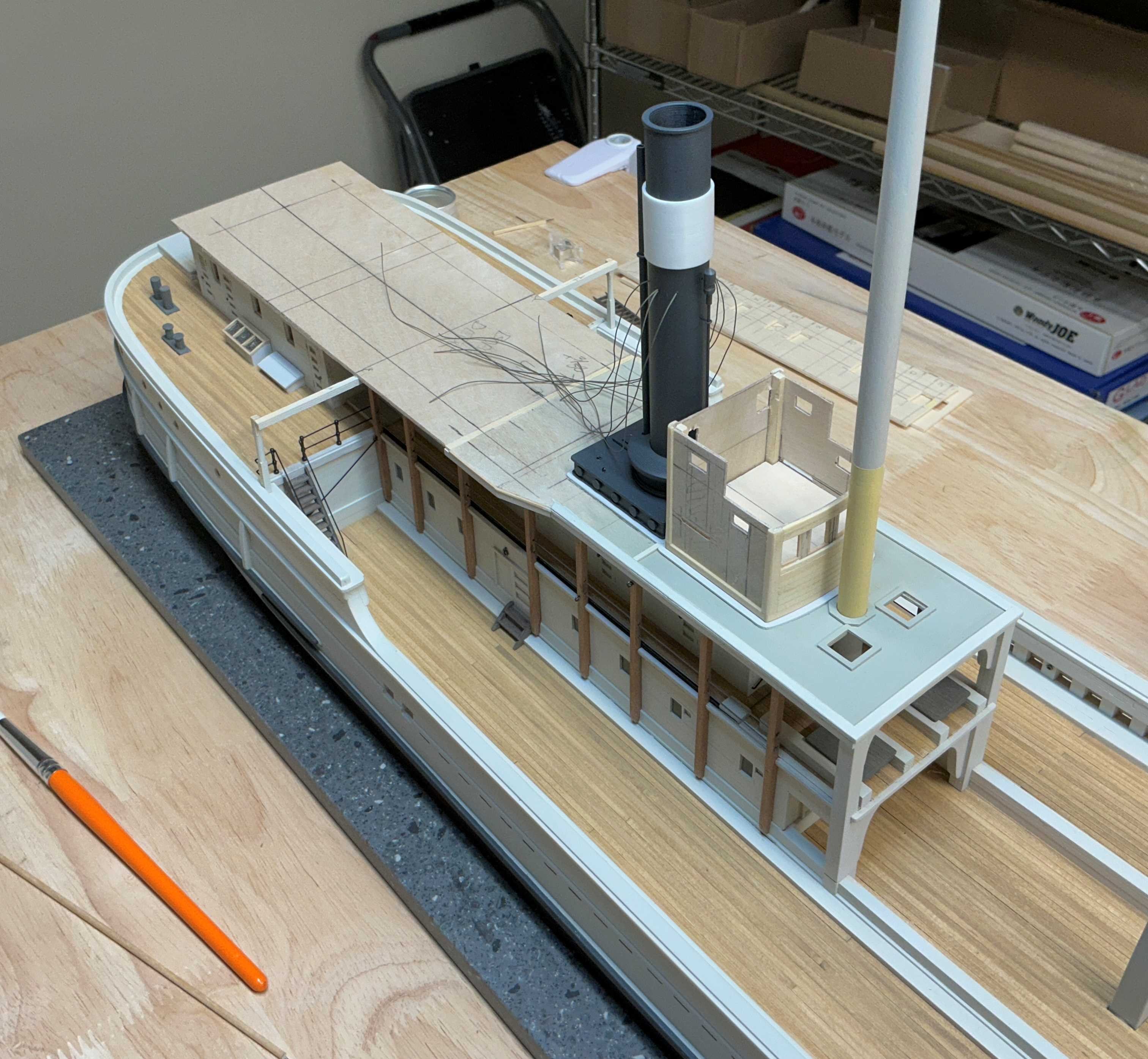

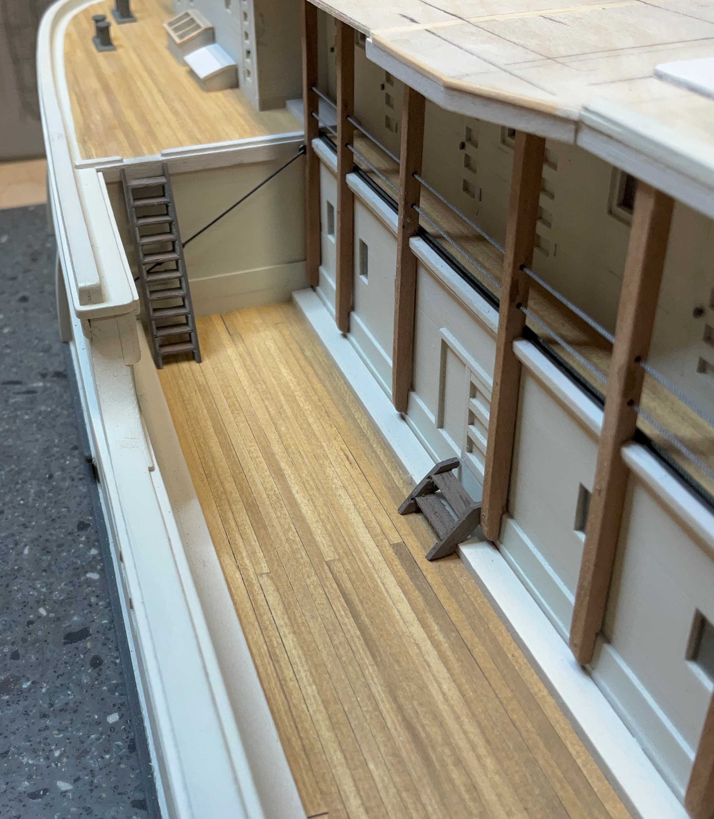

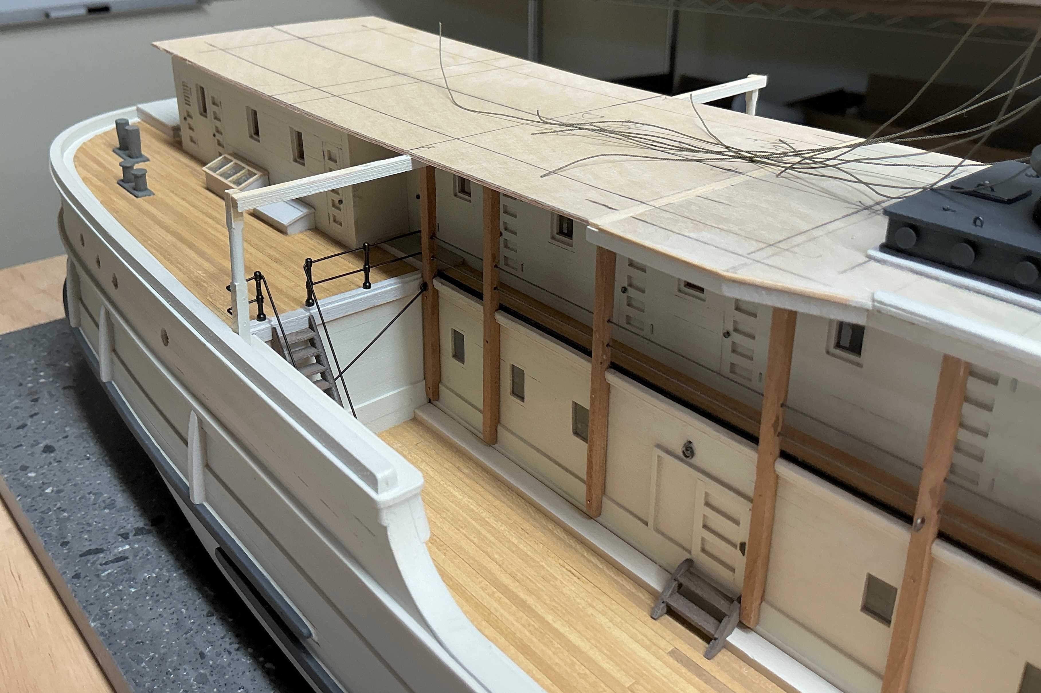

Hi Everyone, figured I would get one more update in before the end of the year. Thank you for all of your Comments and Likes. The covering boards were started probably in an attempt to delay working on the four ladders and three sets of steps. A  1/32" x 1/32"  strip of wood was glued to a 1/32" x 1/8" strip and painted before attaching.

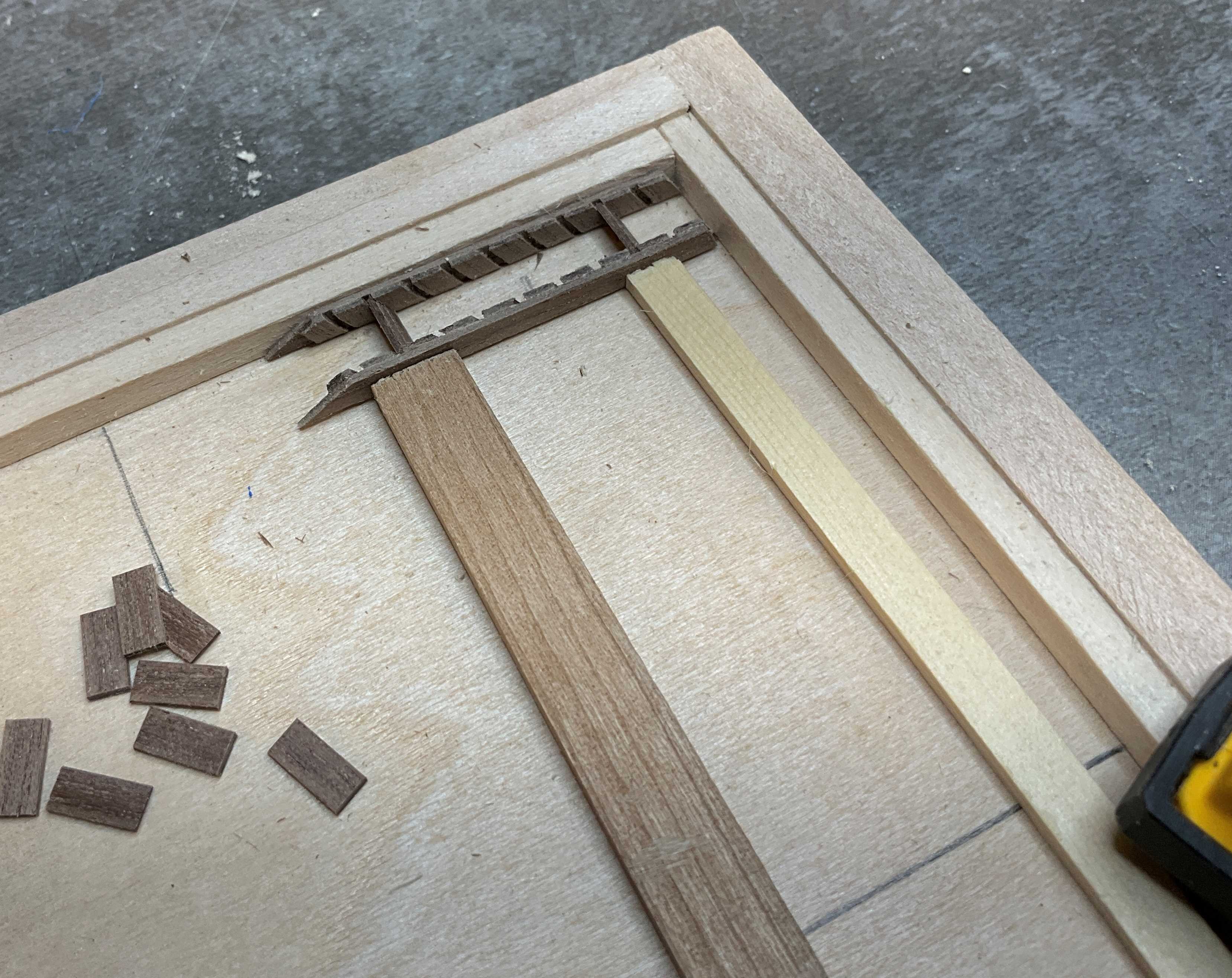

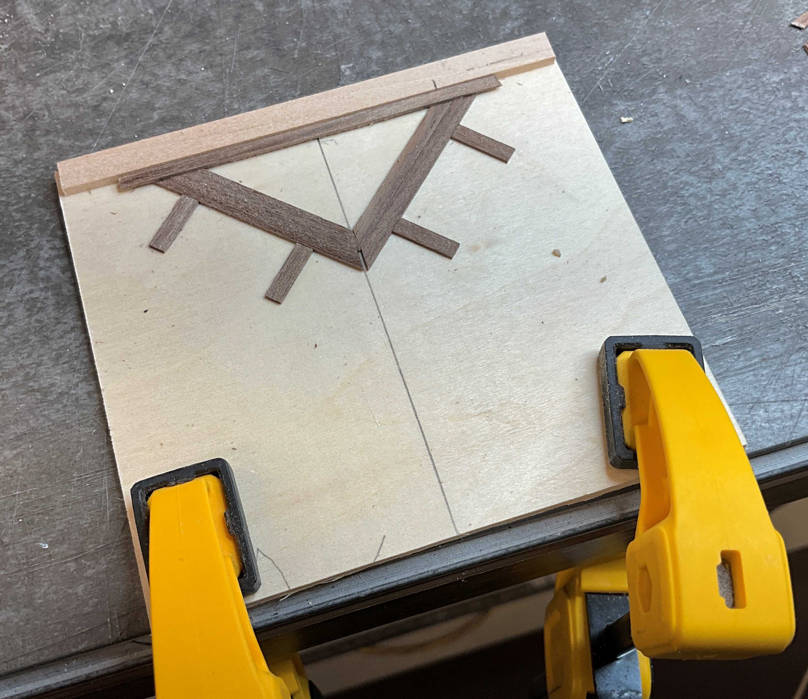

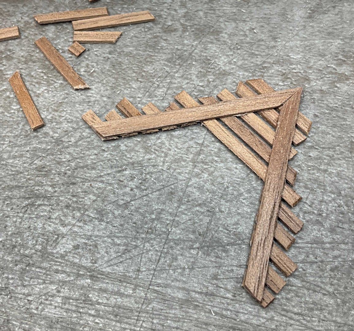

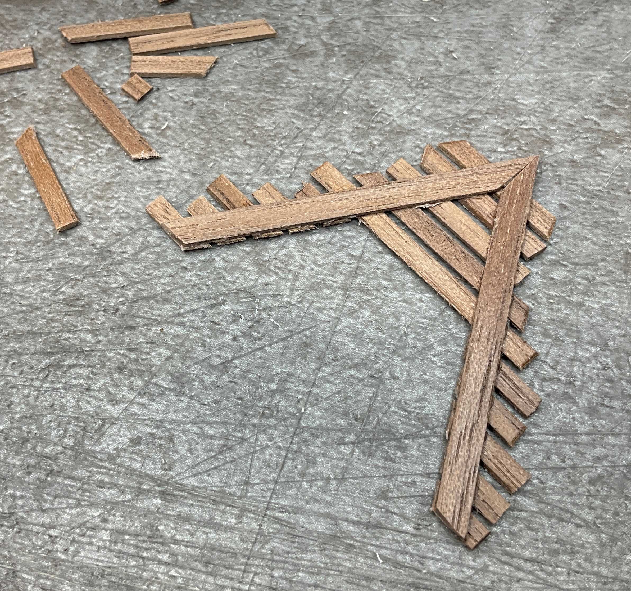

Once I had gone as far as possible with the covering boards I started on the ladders that are made from 1/32" x 1/8" walnut. A jig was made to hold the stringers and then the riser planks which were cut to around 3/32" wide were attached using a 1/32" strip as a spacer. After they were assembled they were given a dark grey wash.

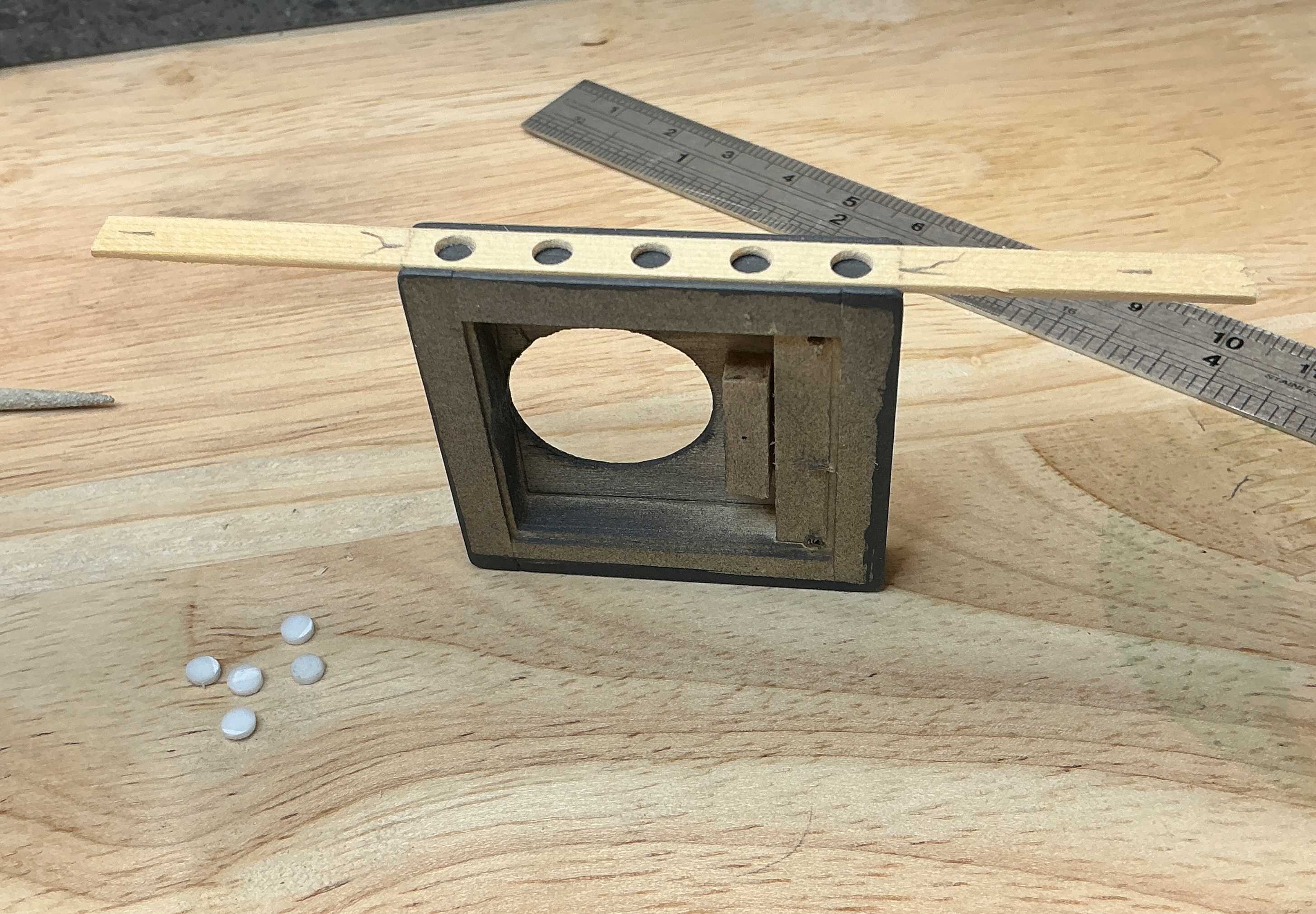

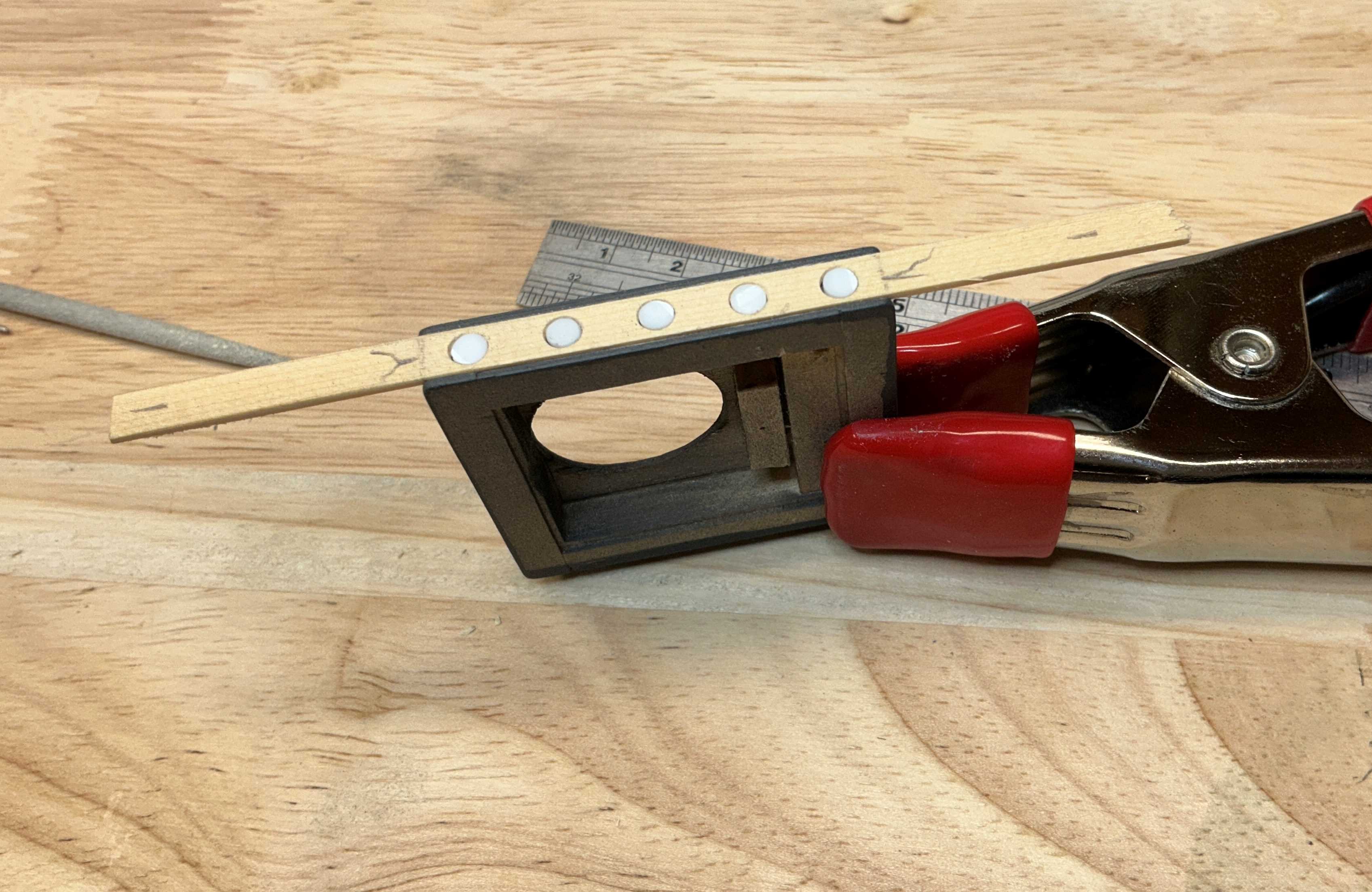

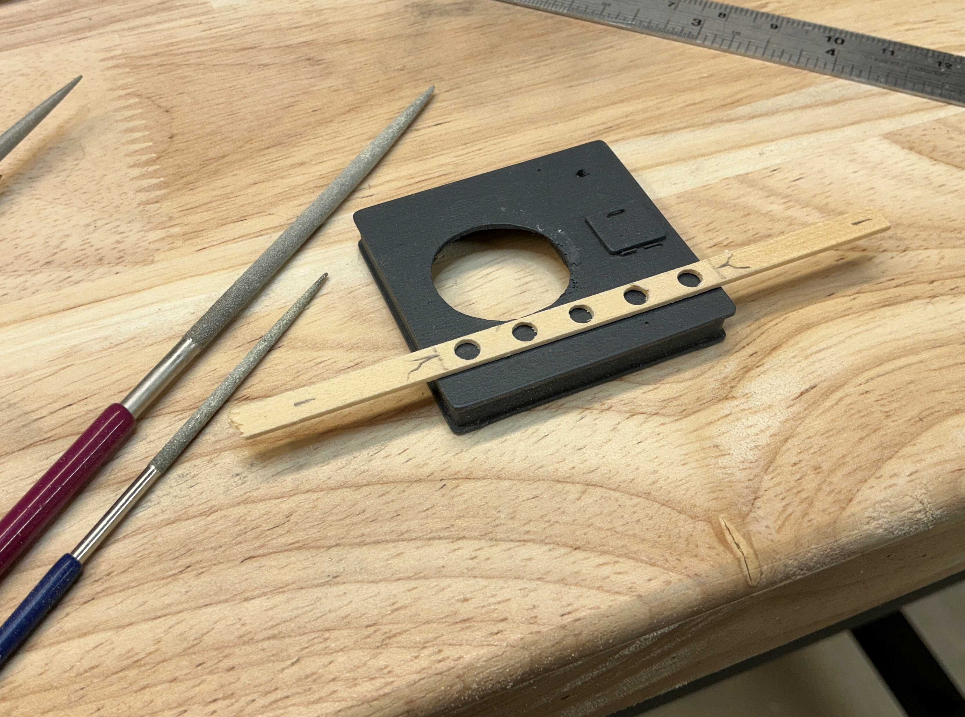

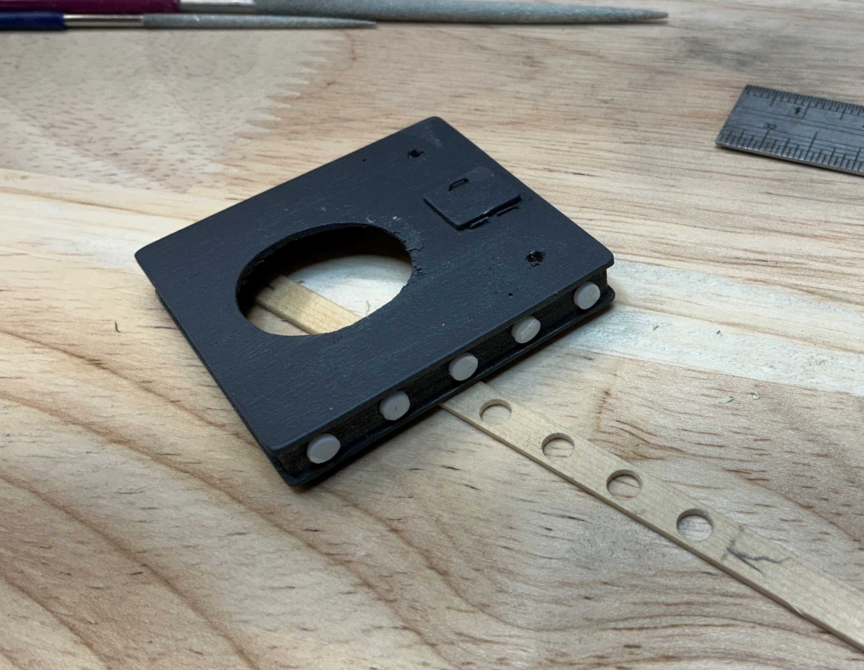

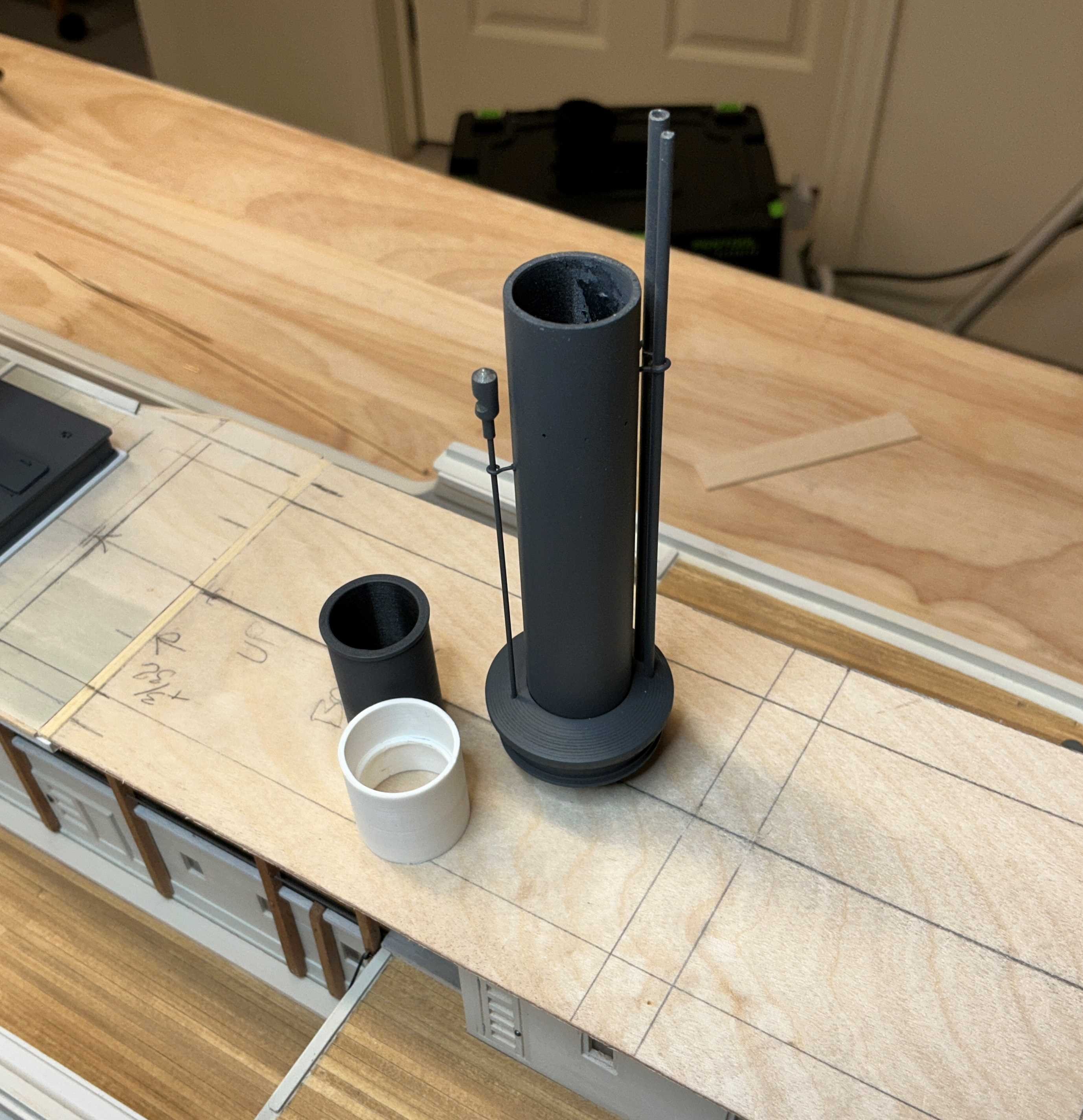

The iron casing for the stack was made and the deadlights were attached using a properly spaced template. The deadlights were cut from 1/8" styrene rod using the Slicer.
I was going to use brass tube for the stack but couldn't find anything to make the band. I decided to give Tinkercad a try. I found it to be a fun experience and ended up subbing out some STL files to a friend with a printer. I think they came out pretty good after some cleanup.

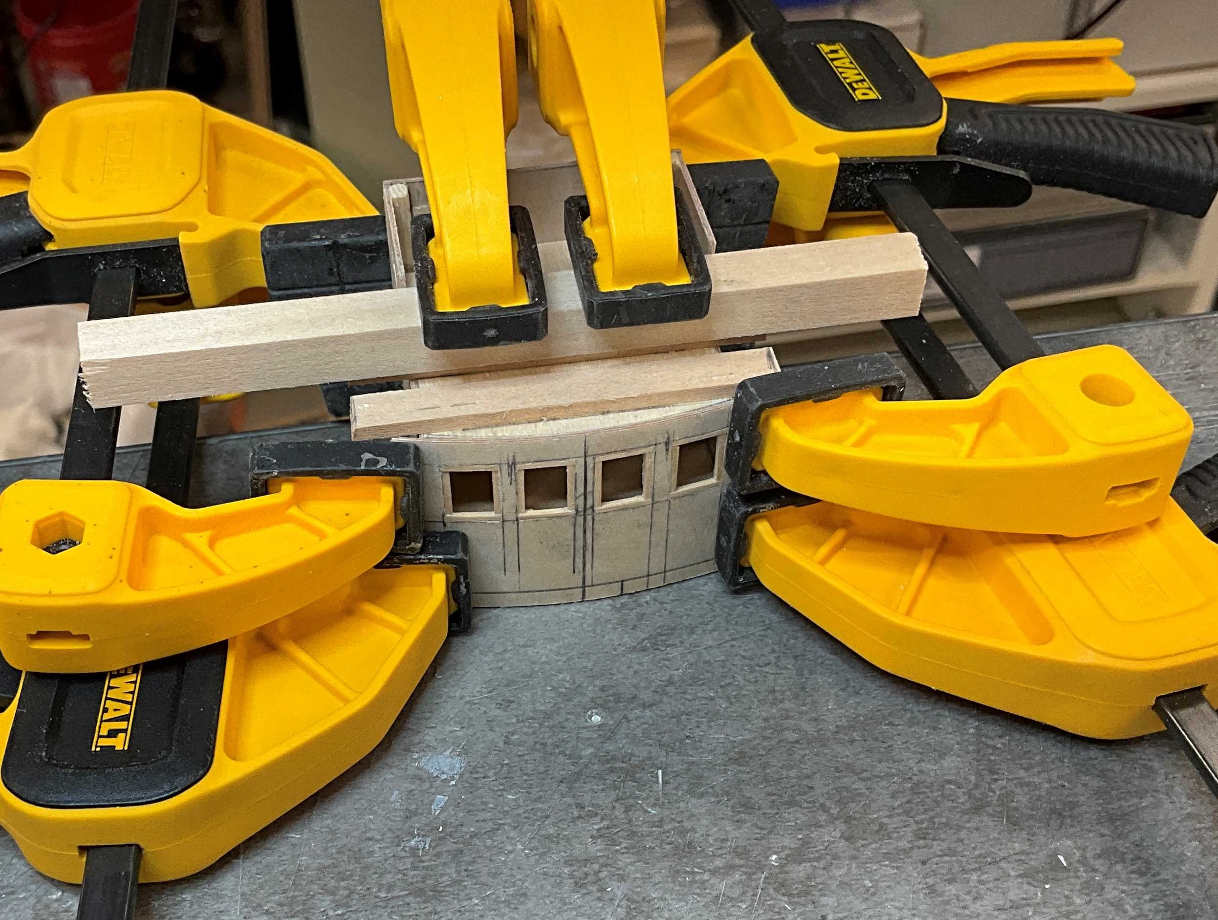

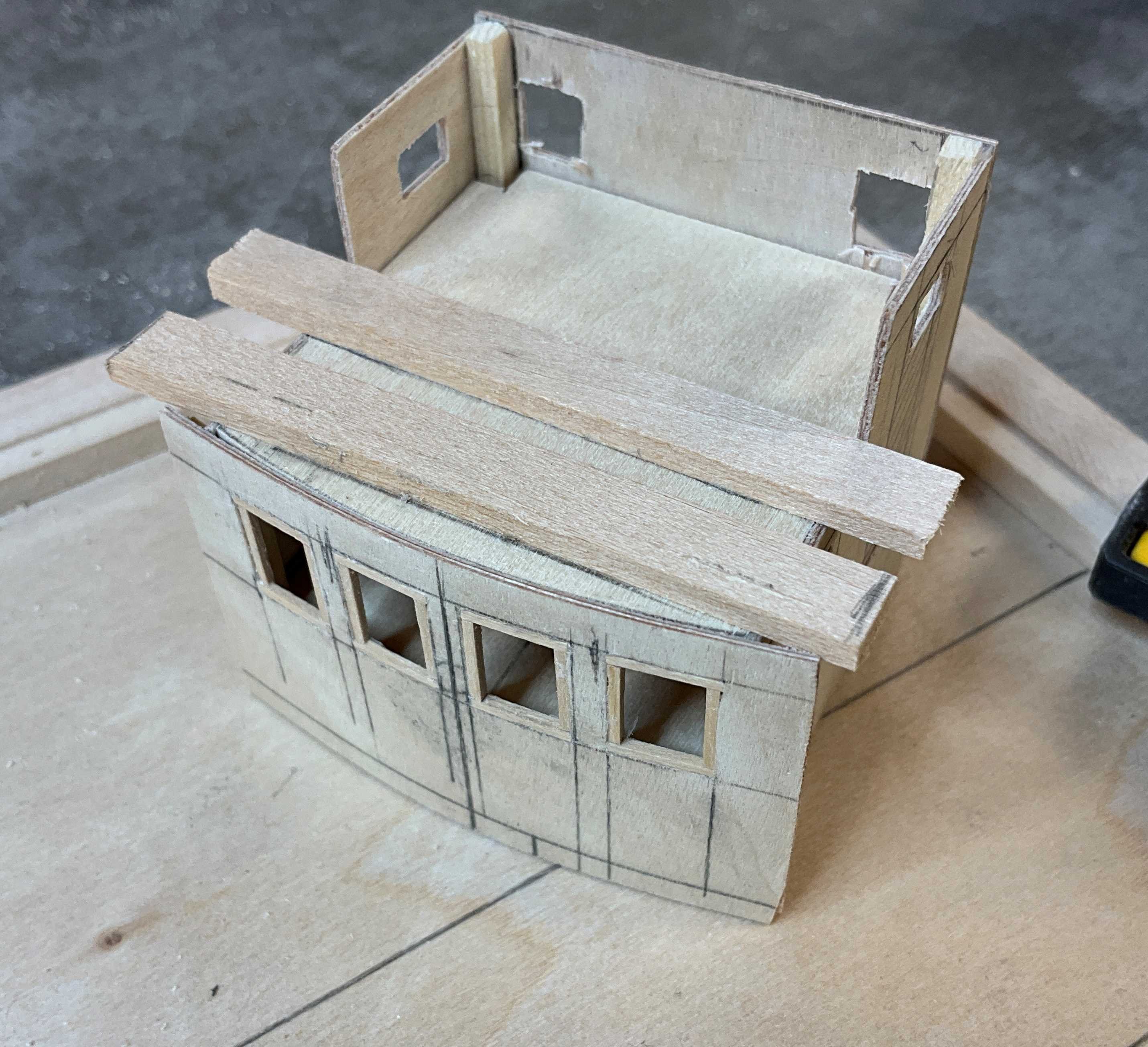

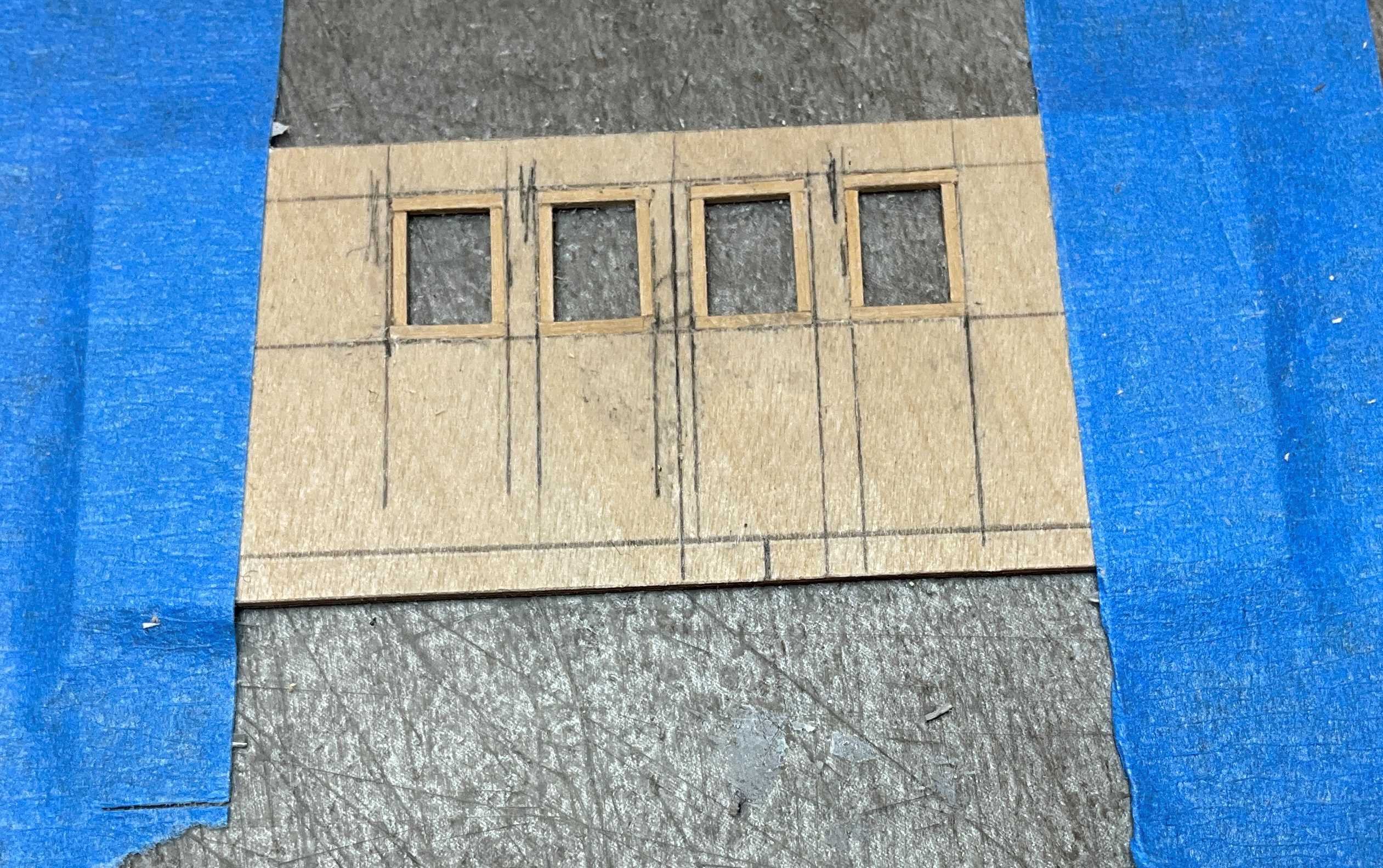

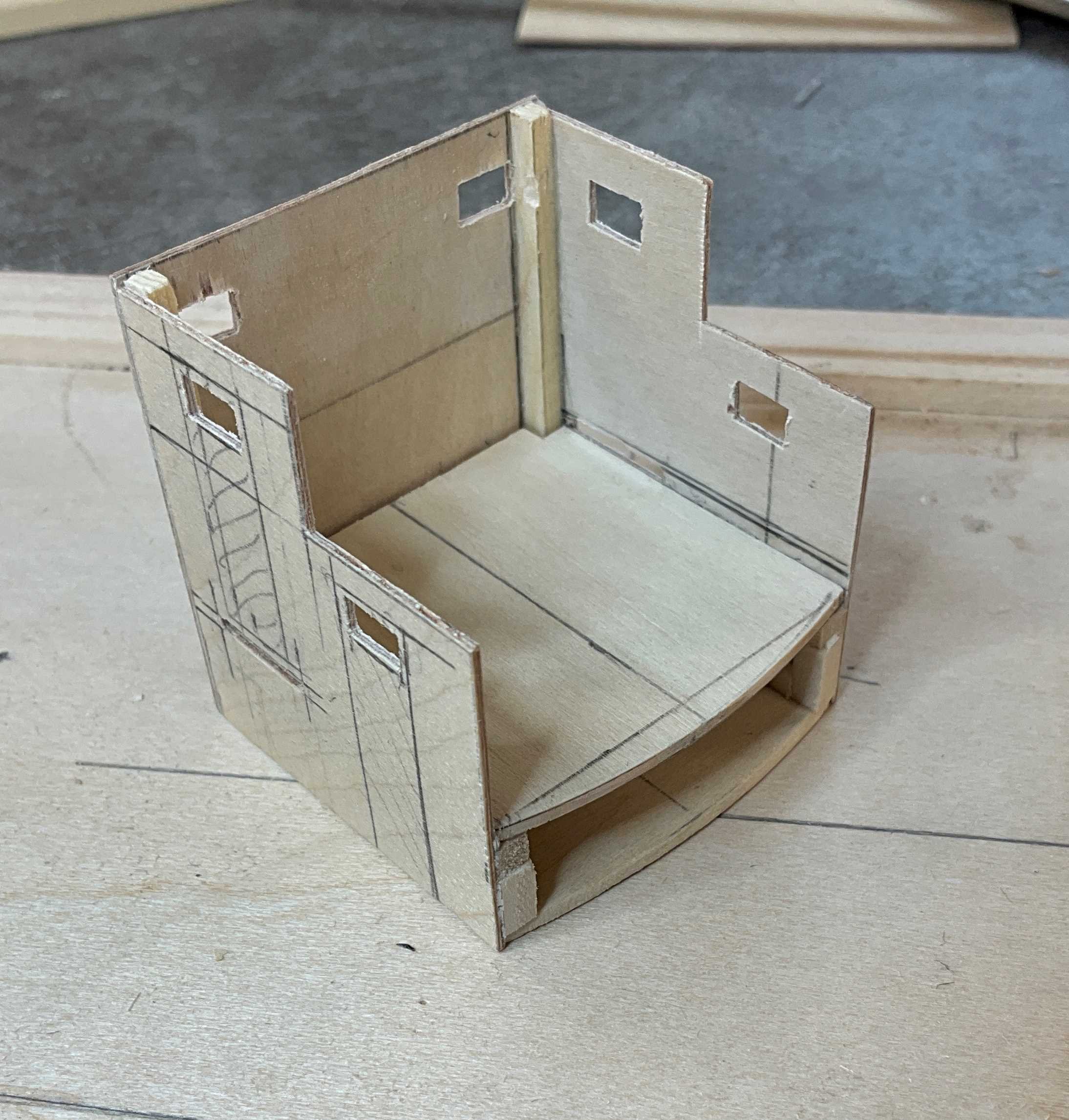

The wheelhouse was assembled using 1/32" plywood. The window openings are lined with 1/32" x 1/32" boxwood. Now the siding has begun.

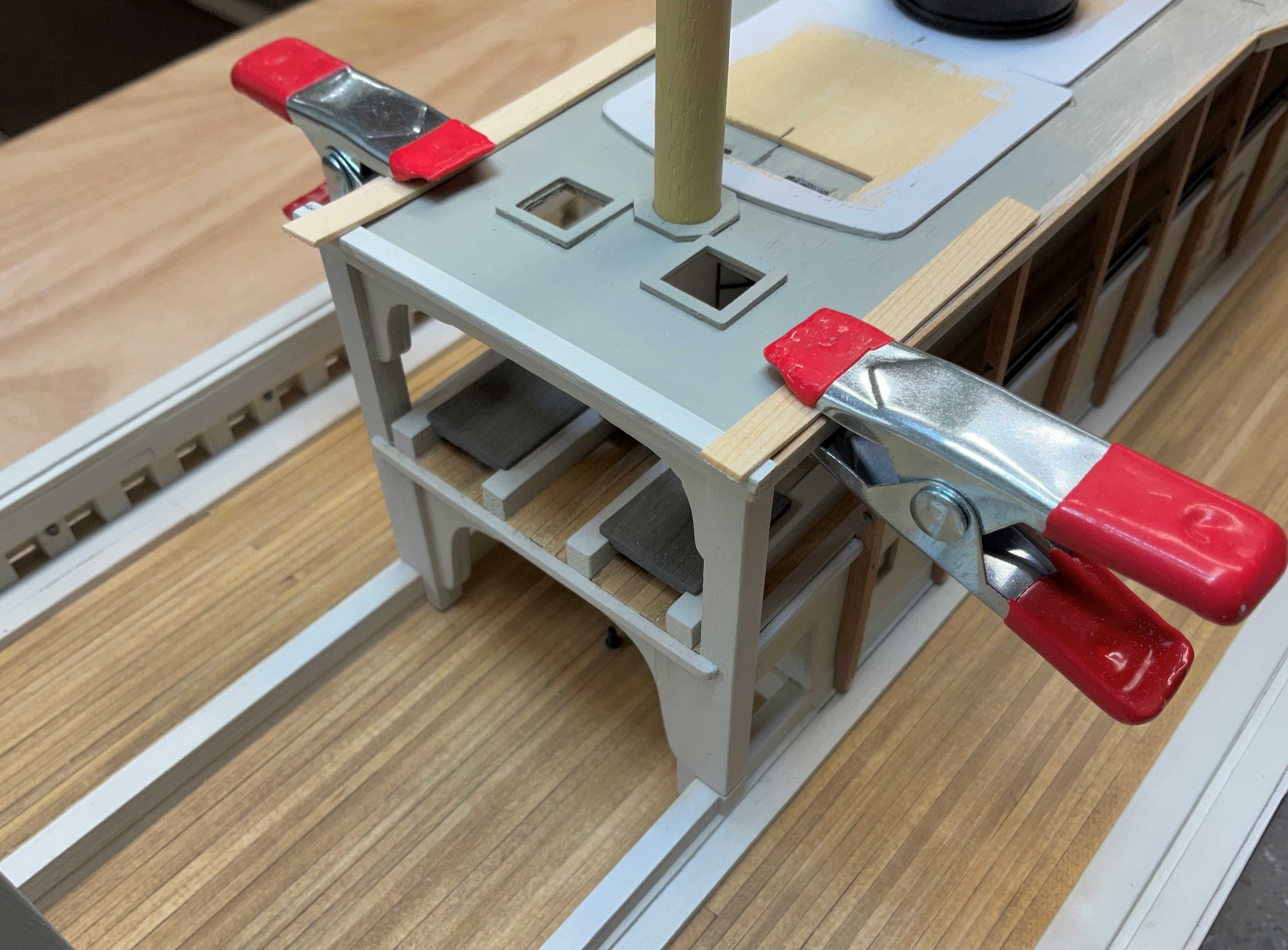

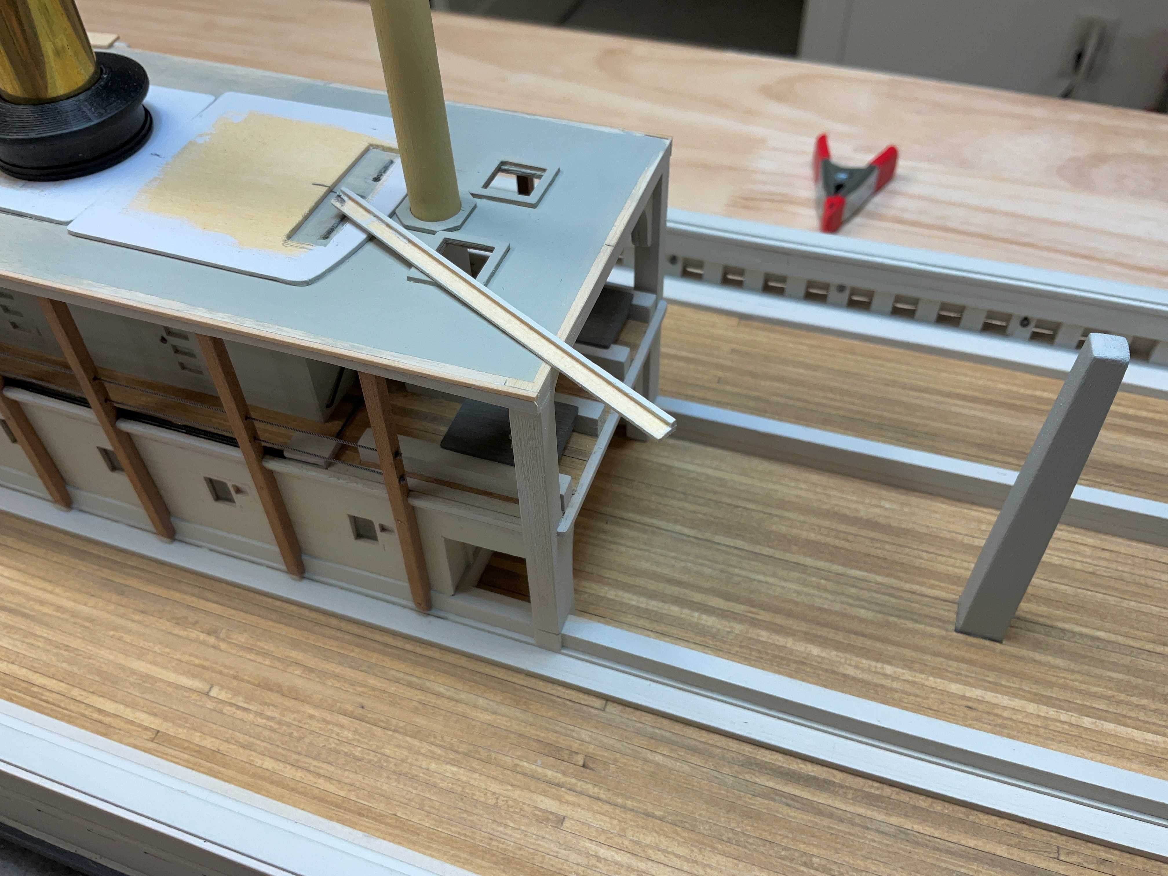

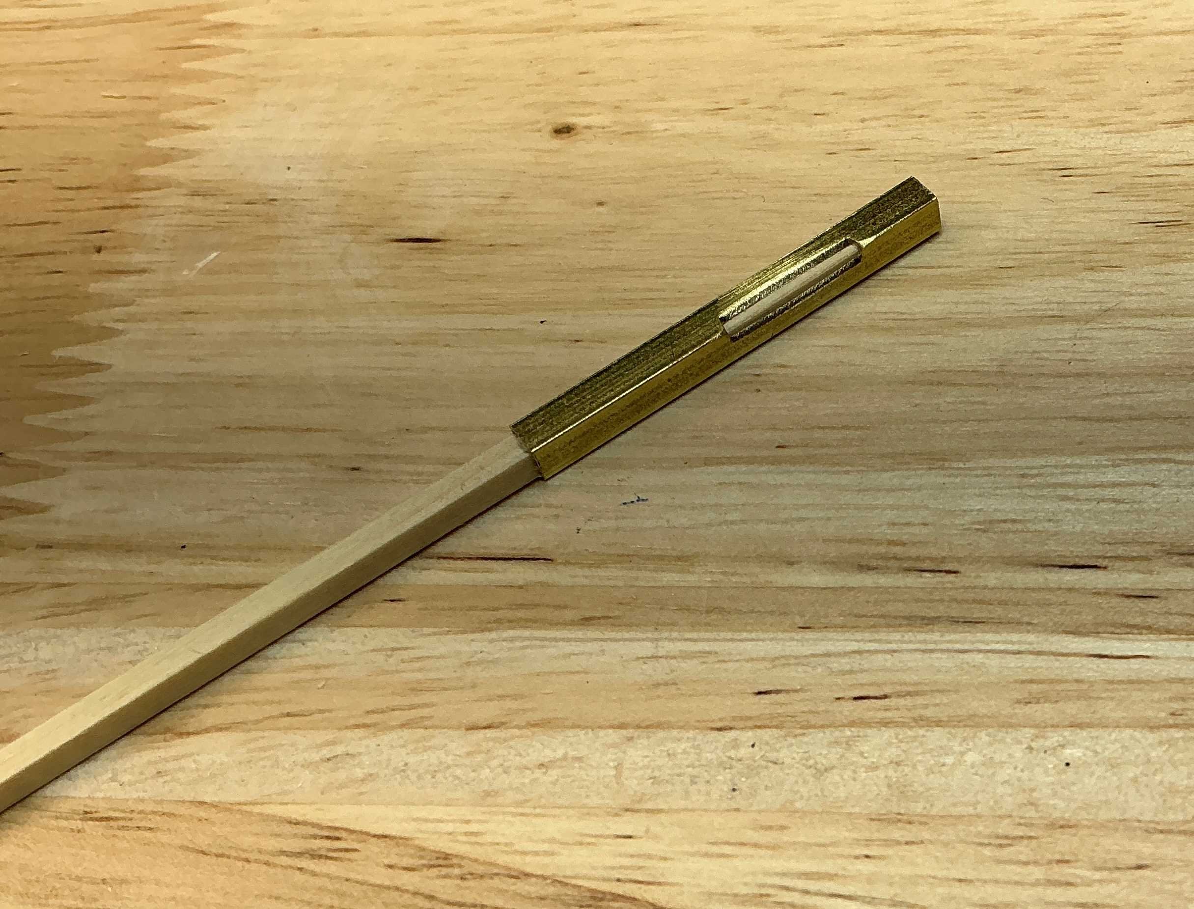

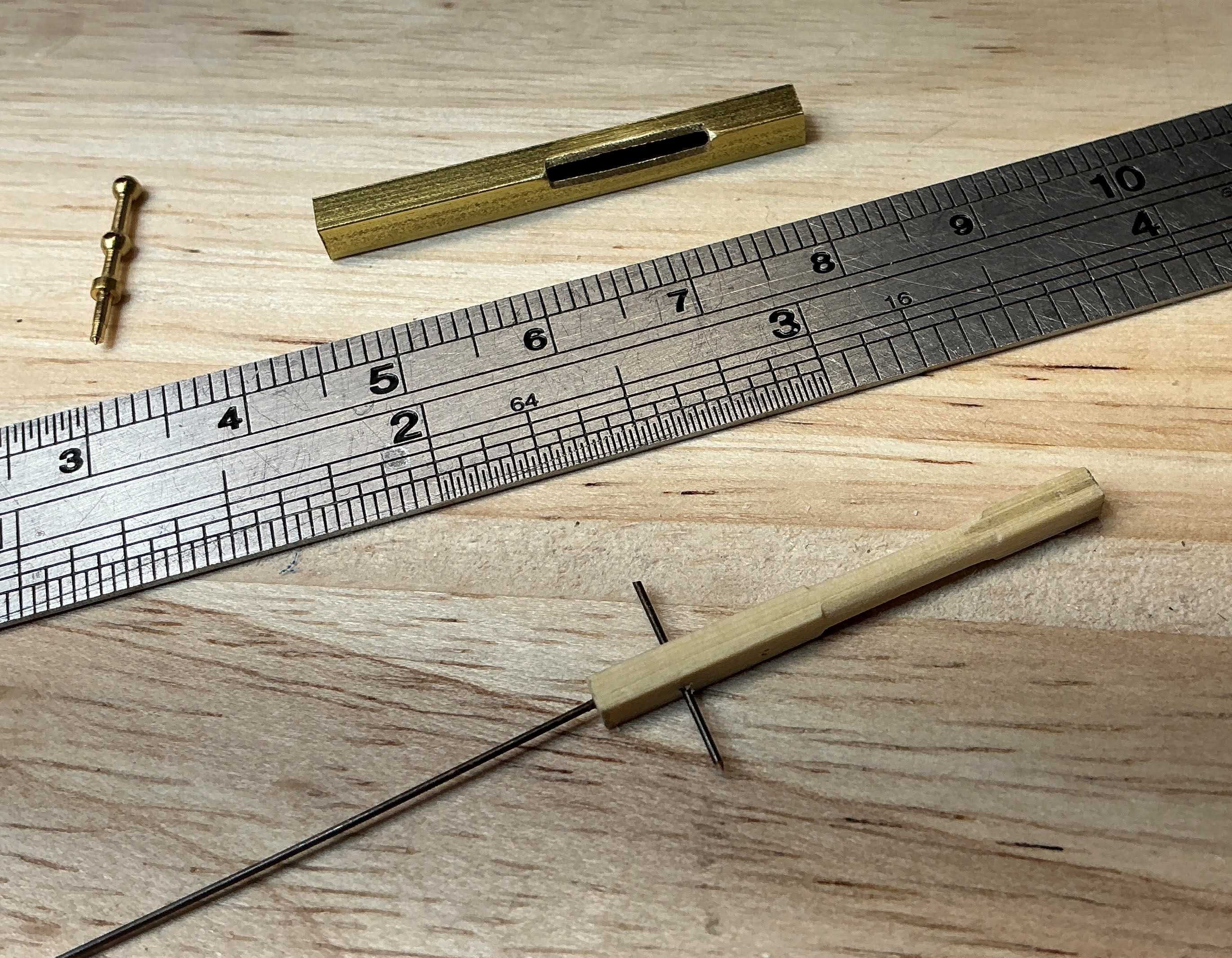

The hand rails for the ladders up to the cabin deck had to be done in combination with the stanchions that support the boat deck. The stanchions have a fancy turned section in the middle. Mine are not going to be that fancy. A "micro lathe" was made out of a piece of 1/8" square brass tube with a corner filed off the length of the turned section. A piece of 3/32" x 3/32" AYC is slid into the tube and the corner is sanded off at the slot. Then taken out and repeated until all four edges are sanded. They then need a bit of finish sanding.
Like other people have found, the store bought brass handrail stanchions needed to be sanded down quite a bit. The next ones will be sanded even more.
Now the rest of the boat deck can be framed. Hope to see you in The New Year!
