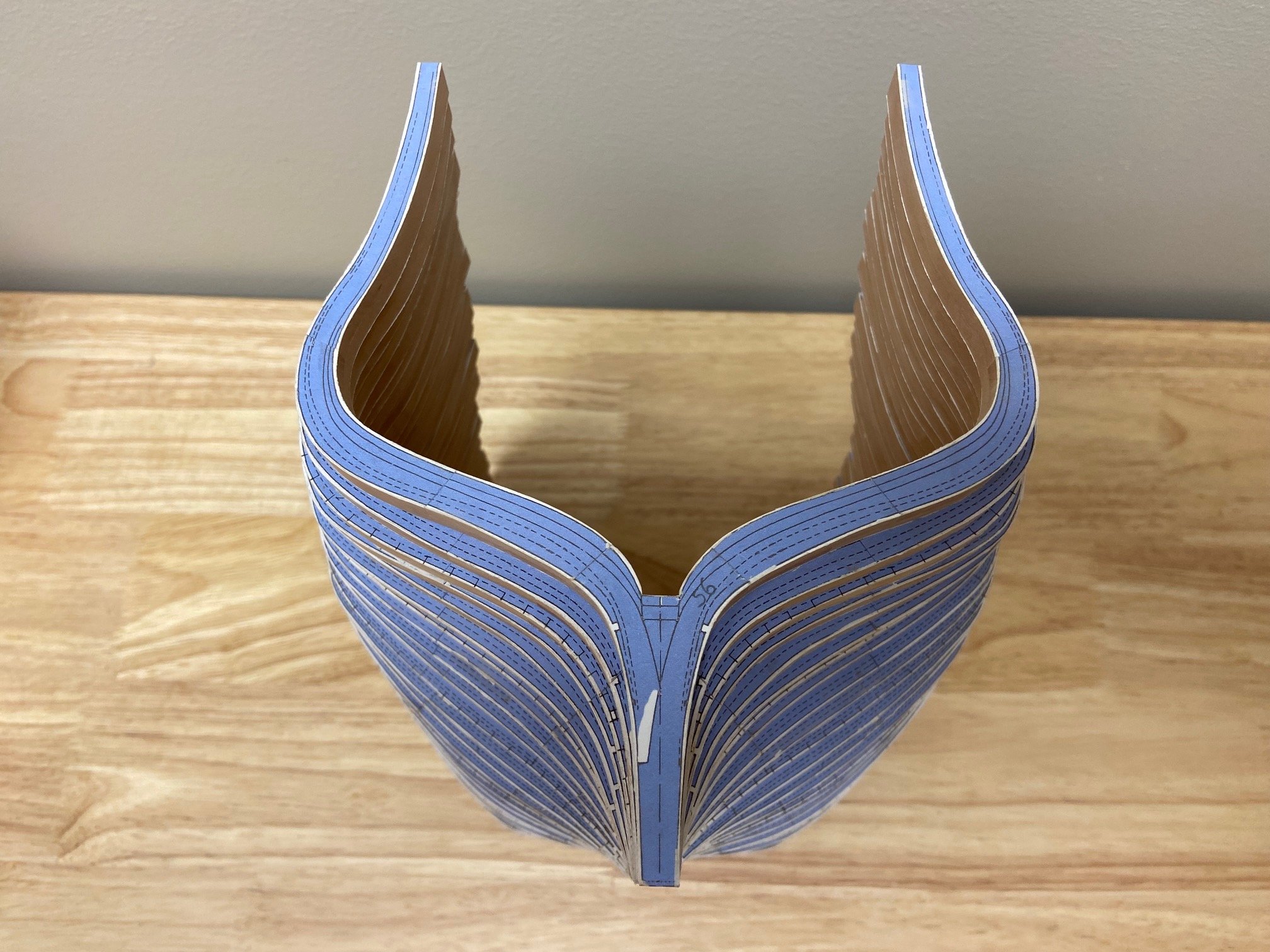

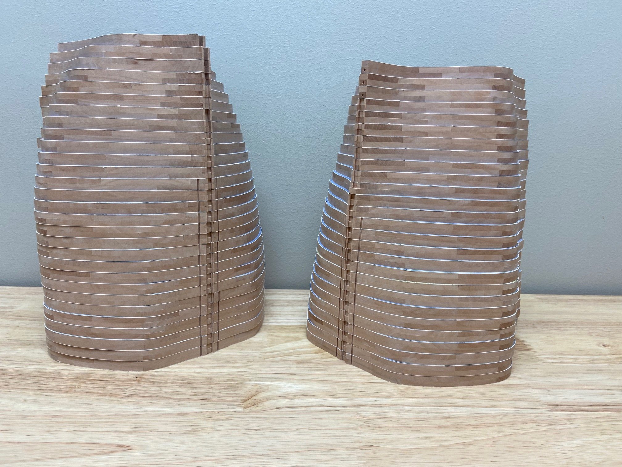

Thanks for your comments !  Tobias - I haven't received Vahur's delivery of Black Hornbeam - it should arrive any day.  I won't be using it for another month or so as I want to finish all the frames before beginning the keels parts where it will be needed.
Update - the first 29 frames of 58 total are assembled and roughly finished.  I will be installing bolts once they are faired and ready for final install into the jig.  I have seen either copper square wire or brass square wire as the material to simulate them, copper has the advantage of blackening it in situation without bleed into the surrounding wood. I am curious if using brass do most simply just install the brass square wire and let nature burnish it over time or blacken it.   My understanding is you will need to seal the wood first before attempting to blacken brass in situation to avoid the bleed.

I use a very thick black fishing monofilament for the bolts (designed to catch alligators and giant squids, I guess). No problems with any chemicals bleeding into the wood, etc. It is held inside the wood with CA glue and sands nicely to be flush.image.thumb.jpeg.7997b5fe68c7e7fd8c3d549037f92242.jpeg
Thanks for the tip Mike - your frames look great !  I know many use monofilament successfully.  I really want to simulate the square bolts that were used on French ships of the period - so square wire either copper or brass is my preference.

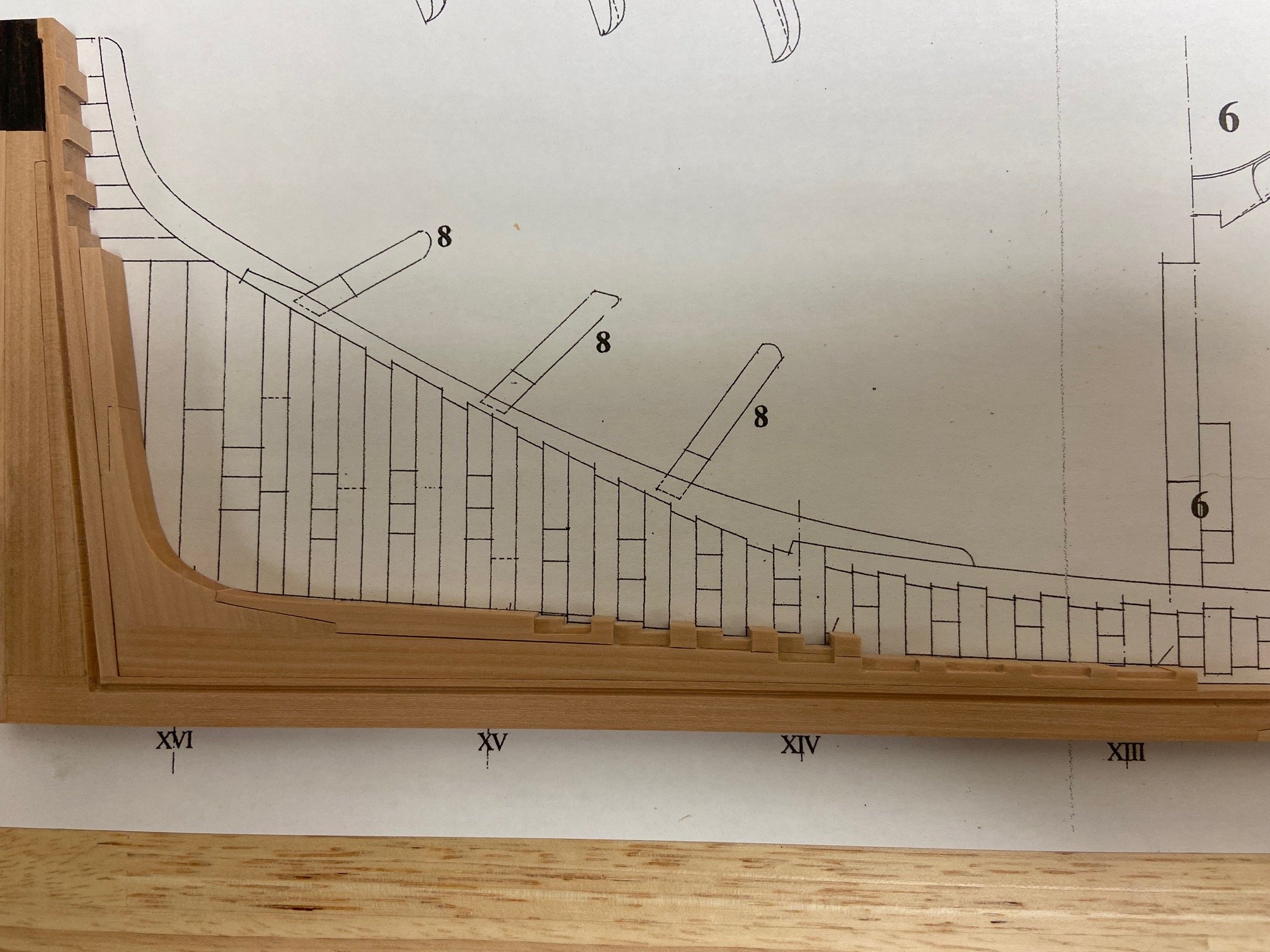

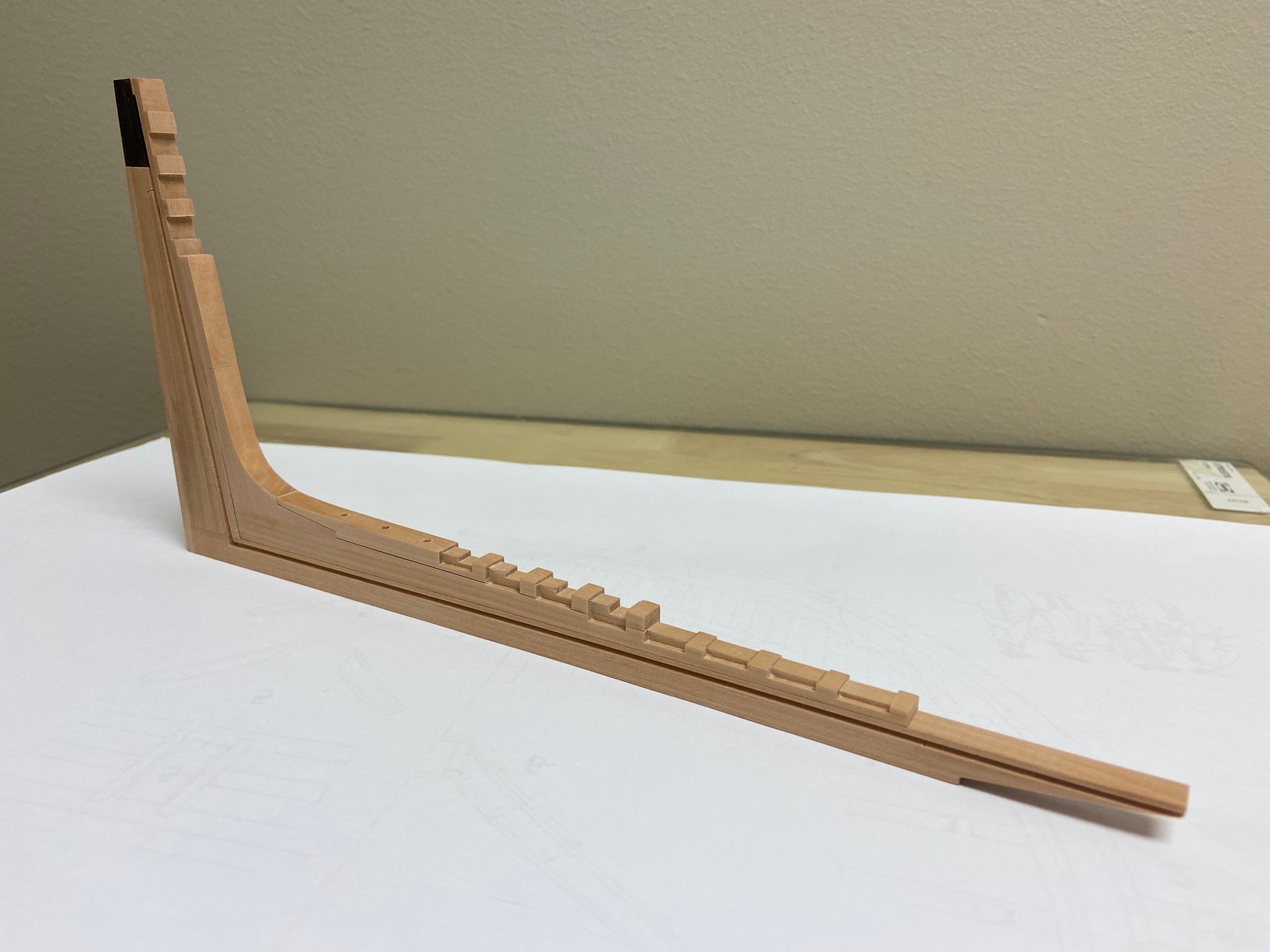

I've not come across black hornbeam for model-making. How fine is the grain and how well does it cut? And will it bend easily with heat? Certainly the photo makes it look really good. I bet it glues better than ebony!
Thanks guys - I like the Hornbeam a lot so far.  It cuts easily and glues well.  Also it carves nicely - harder edge to it than Pear or Box.    Many of the Eastern European modelers swear by it as a replacement for ebony.  As far as bending with heat - I will let you know once I get to the wales.  That's probably months away - so far I've broken down and rebuilt more assemblies than I care to admit !
That stem was probably version three.  My mill went astray this AM while cutting the rabbet.  So I took it apart with my friend Iso Alcohol and will reassemble it tomorrow with a new forefoot.  I am very happy the upper part of the stem consisting of black hornbeam was not yet glued to the lower half.
Thanks for your opinion on the hornbeam, Chris! Sorry about the milling 'oopsie'.
Nice clean result. Can't see any sign of the struggle!
