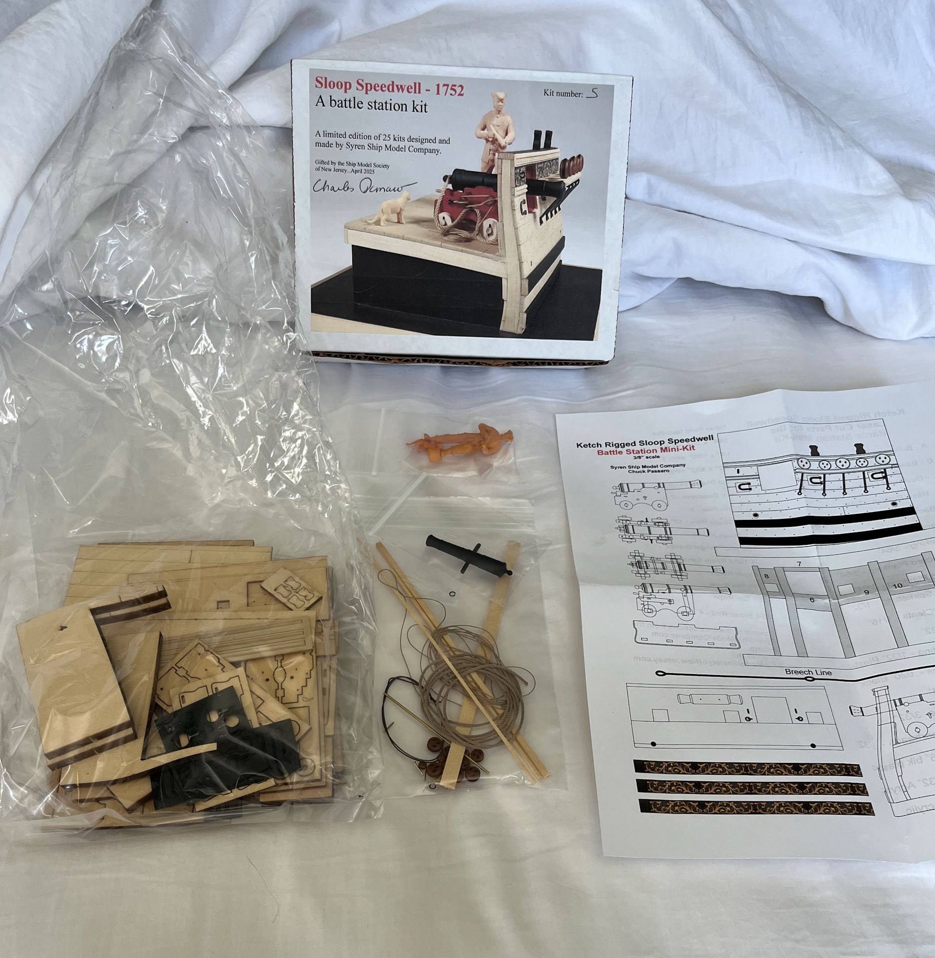

I won one of Chuck's Battle Station kits at the Joint Clubs Conference so I'm taking a short break from my Armed Virginia Sloop.  I justify taking on a second project with the excuse that this kit will be a great way to practice rigging a cannon, which I have never done.  The kit includes Syren rope and blocks, and at the Conference Chuck gave a presentation on how exactly he likes to seize his rope.  With this knowledge still fresh in my mind I felt I better use it before it was forgotten.  So here I go

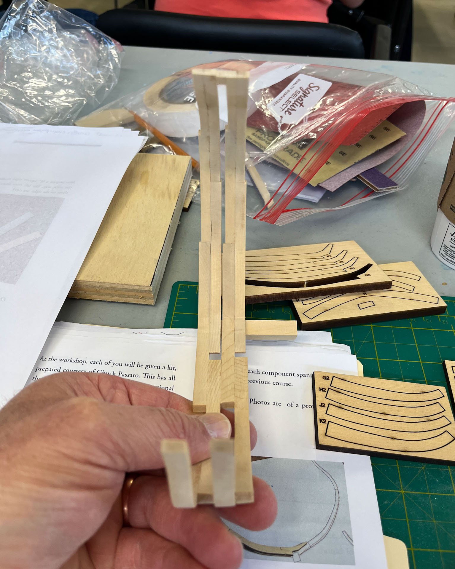

Here's the kit unwrapped on my bed; there's a lot of parts in the little box.  Directions are downloaded from Syren's website.

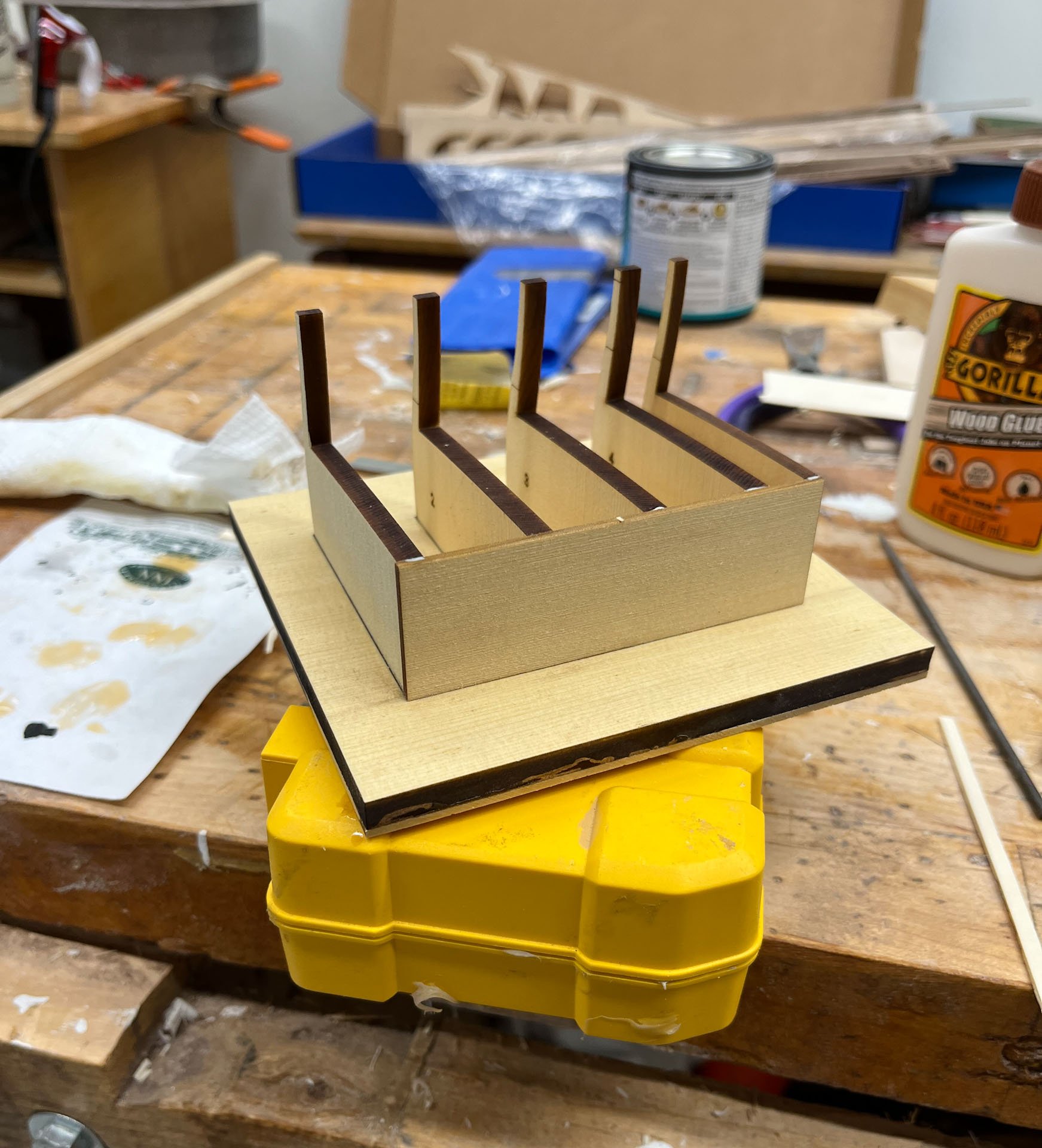

I read through the directions, unpacked all the parts, and re-read the directions.  The wood is all AYC I think, which I haven't worked with before, my previous experience is with basswood (blah) and holly.  AYC seems to be a good compromise wood; midway between basswood and holly in hardness, very minimal grain pattern, and it looks great under polyurethane.

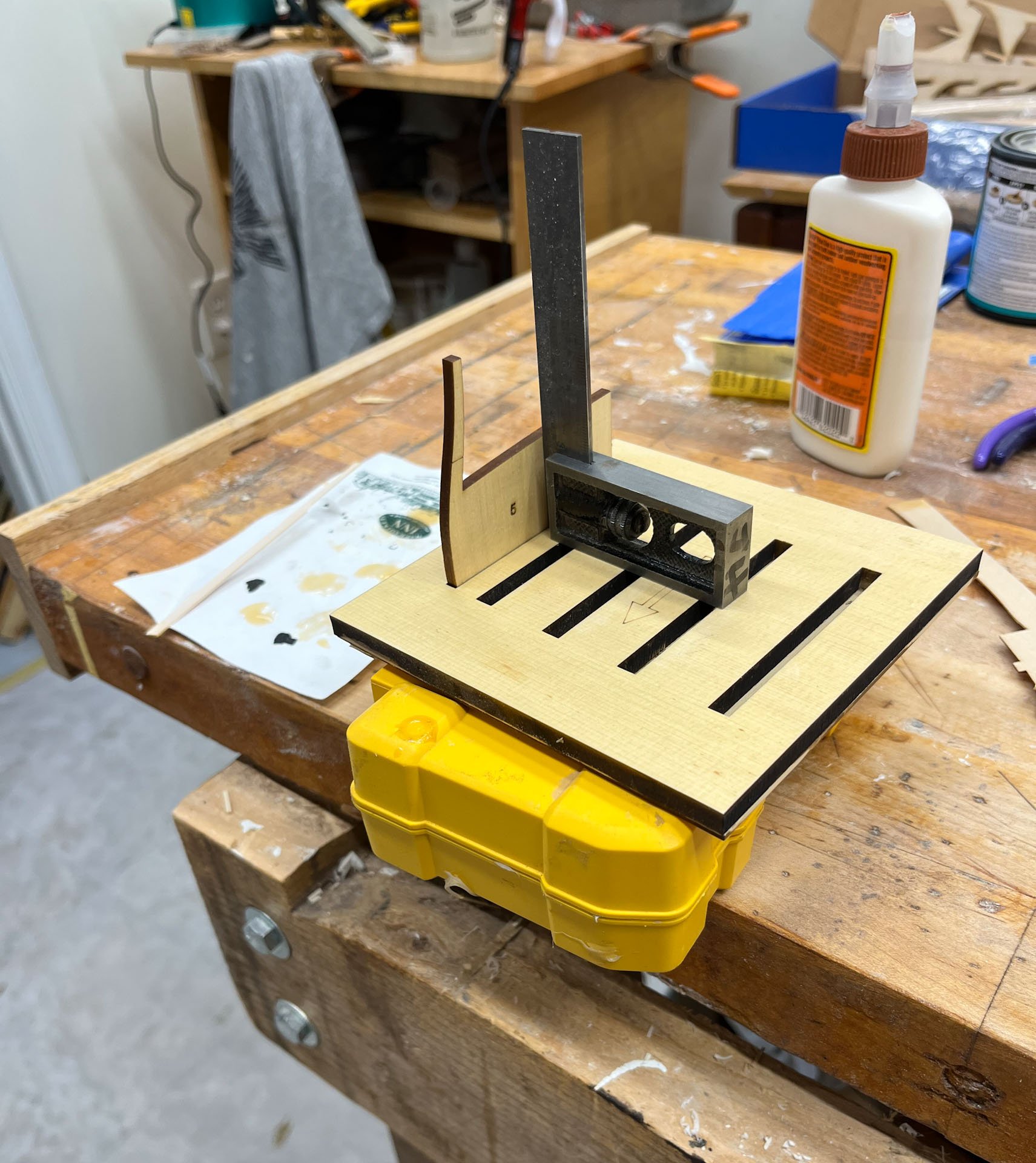

I glued the two base panels together at right angles, creating a 2-ply plywood of sorts.  The thicker piece had warped a little but I left them clamped under a block of wood overnight and it came out flat.  Then I used water-based polyurethane (because thats what I have for my AVS) on both sides of the panel.  I plan to paint the top black somewhere down the road and the urethane provides a good base.

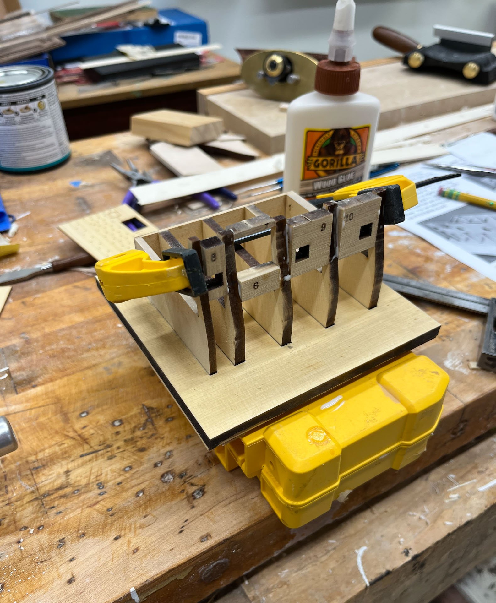

Next was gluing in the frames.  Mine fit fine without any sanding and I checked each piece for square as I went.  The slots are deep and the frames didn't require much adjustment and stayed put, and each frame is labeled.  Frame 5 (pictured below) is narrower and will only fit in 1 slot so its harder to screw up placement.
After gluing in the 5 frames I waited an hour then sanded the backside of the frames flat and added the back panel  Once it dried I sanded it flush with the frame edges.
And finally I added the blocking.  The Ultimation Hand Sander I got 2 Conferences ago worked great for removing small amounts of wood without rounding the edges.  I glued the blocking in place and clamped (gently) across the top.

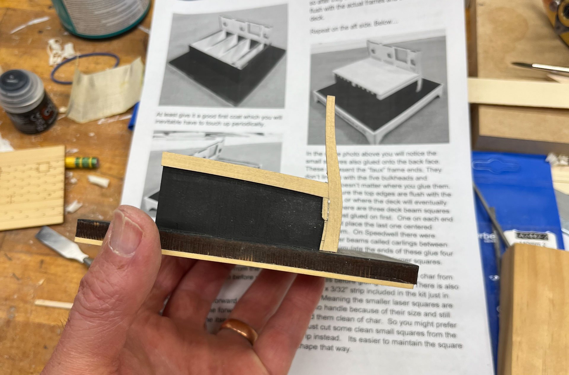

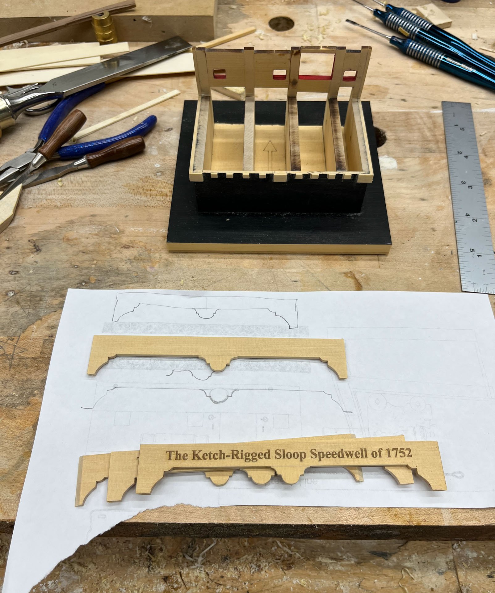

Good Wednesday evening MSW.  Progress on the Battle Station, finally.
As is typical I am making the kit much harder than it has to be.  After adding all the blocking I shaved them down to pretty close with chisels, then sanded them flush.  Two coats of water based polyurethane and 2, possibly 3, coats of black paint (Abbadon Black because I have 4 bottles).  Then I added the veneer end frames and deck beams.  I had a gap between the deck frame and the beam end it rests on so I chiseled out the beam and glued a slightly larger one in place; looks fine now.
Then I glued the end carlings and beam ends in place.  I made my own out of frame pieces; the kit supplied ones were fine but challenging to hold and sand (they are 1/8" square so jumped out of my fingers like fish).  I made mine a little oversize and trimmed them to fit once glued in place.  I will have to touch up the black paint later on.

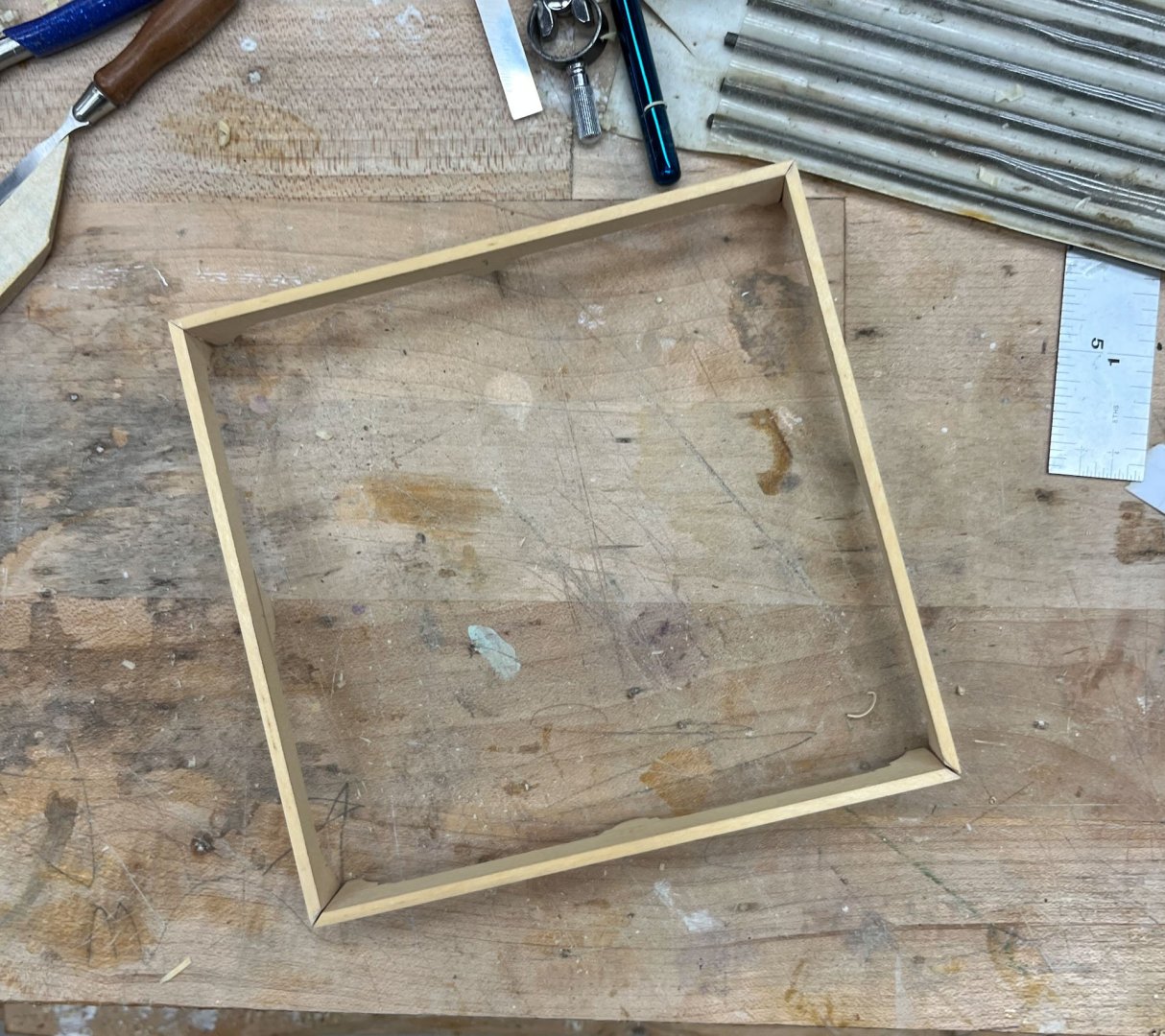

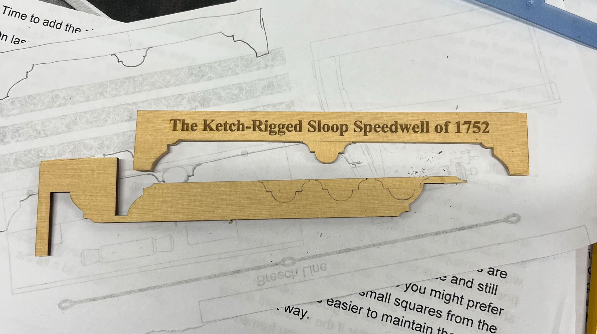

Next up was the frame the Station sits on, elegant feet on each corner with butt joints.  The edges are a relatively long horizontal run, compared to their height, and I thought some drops would help break up the space.  I have a Keepsake Box, below, which provided some inspiration.
I liked the cove molding along the top of the base frame too.  But I wasn't sure about replicating it at such a small scale.  Here's my initial try at a drop, which I thought looked acceptable.  Then I simply traced the original pattern onto some scrap AYC frame material and tried to make the other 3 similar.
Butt joints are simple, easy, look good, and idiot proof.  So I went with miters instead.  I had to shorten the Battle Station frame about 1/8" to make the frames fit (mitering has the effect of shortening the side frames).  I did the actual miters on my Ultimation sander.

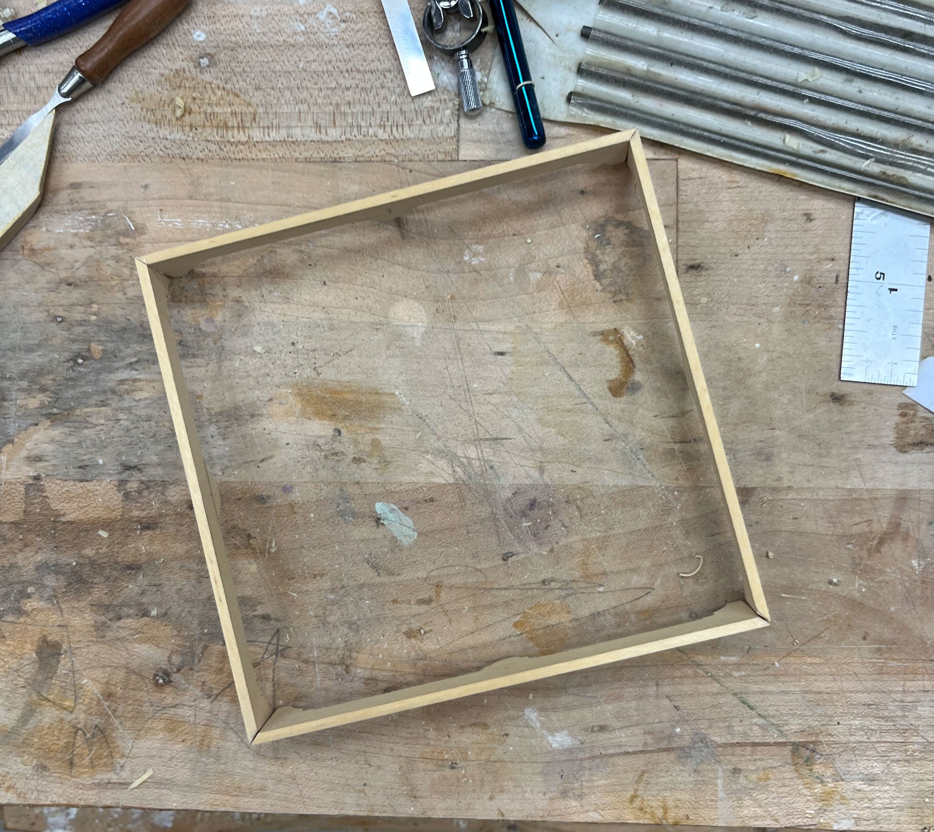

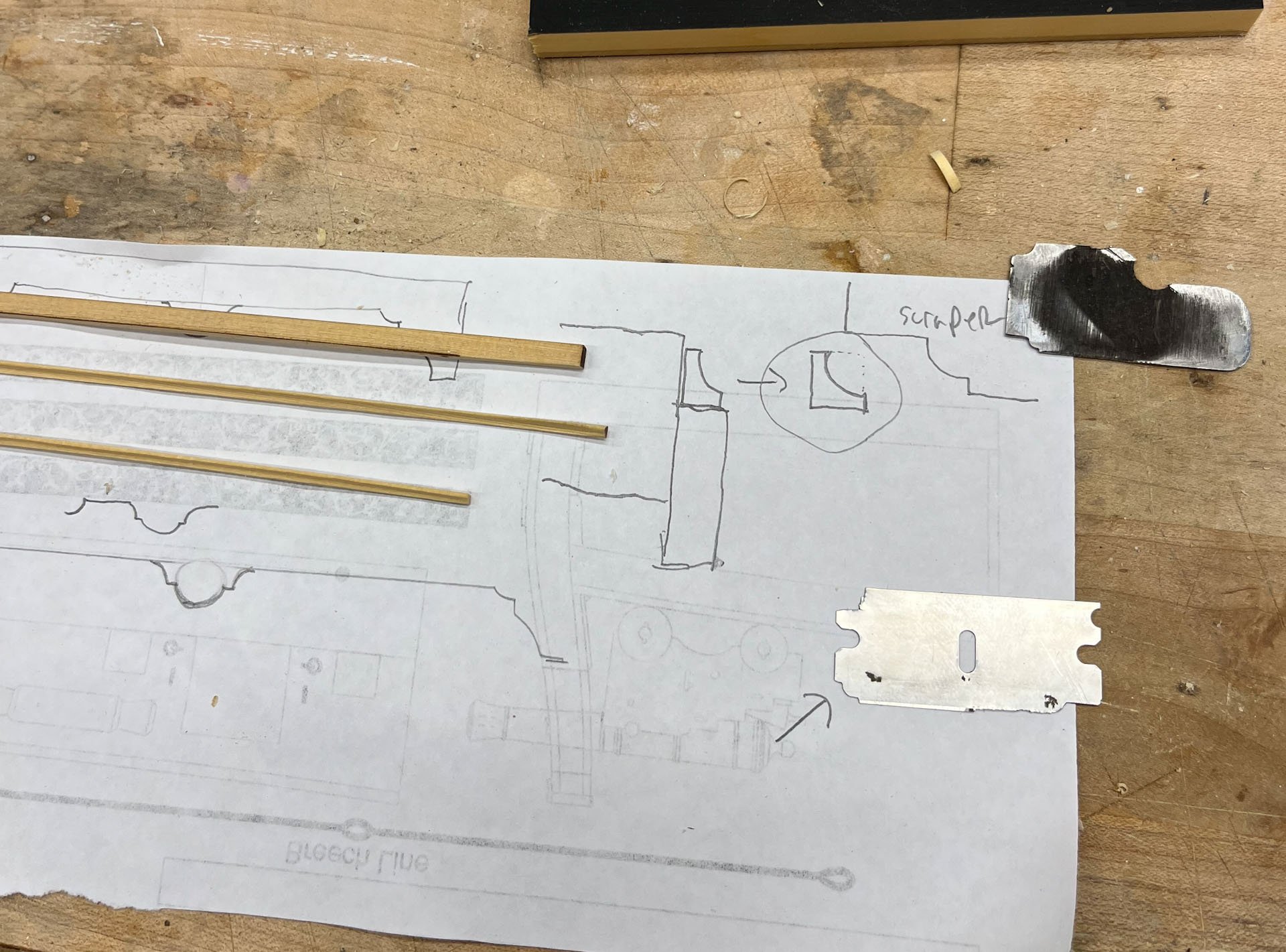

And finally the cove molding.  This was a challenge.  I figured a scraper was the way to go and I tried making one from a razor blade, shaping it with files.  It turned out to be way to bendy and flimsy but was good practice (lower right in below picture).  Then I made the profile in my usual scraping tool, a piece of old sawblade (upper right).  It has a wide flat area that registers on the wood top and worked pretty well.  I used again some scrap framing from the sprue that held the base pieces.  It was extra challenging as these pieces were 1/8" square if that and holding it all steady took some effort.  I found it helped to waste away most of the "point" with my veritas miniplane before scraping.
Here's a side profile of the molding.  The ends don't scrape well so the middle 3/4 of the strip are deeper but you get the idea.  AYC is a soft wood (harder woods are definitely easier to scrape) but I think its working out ok.  And the cove will match the frame.  I hope.

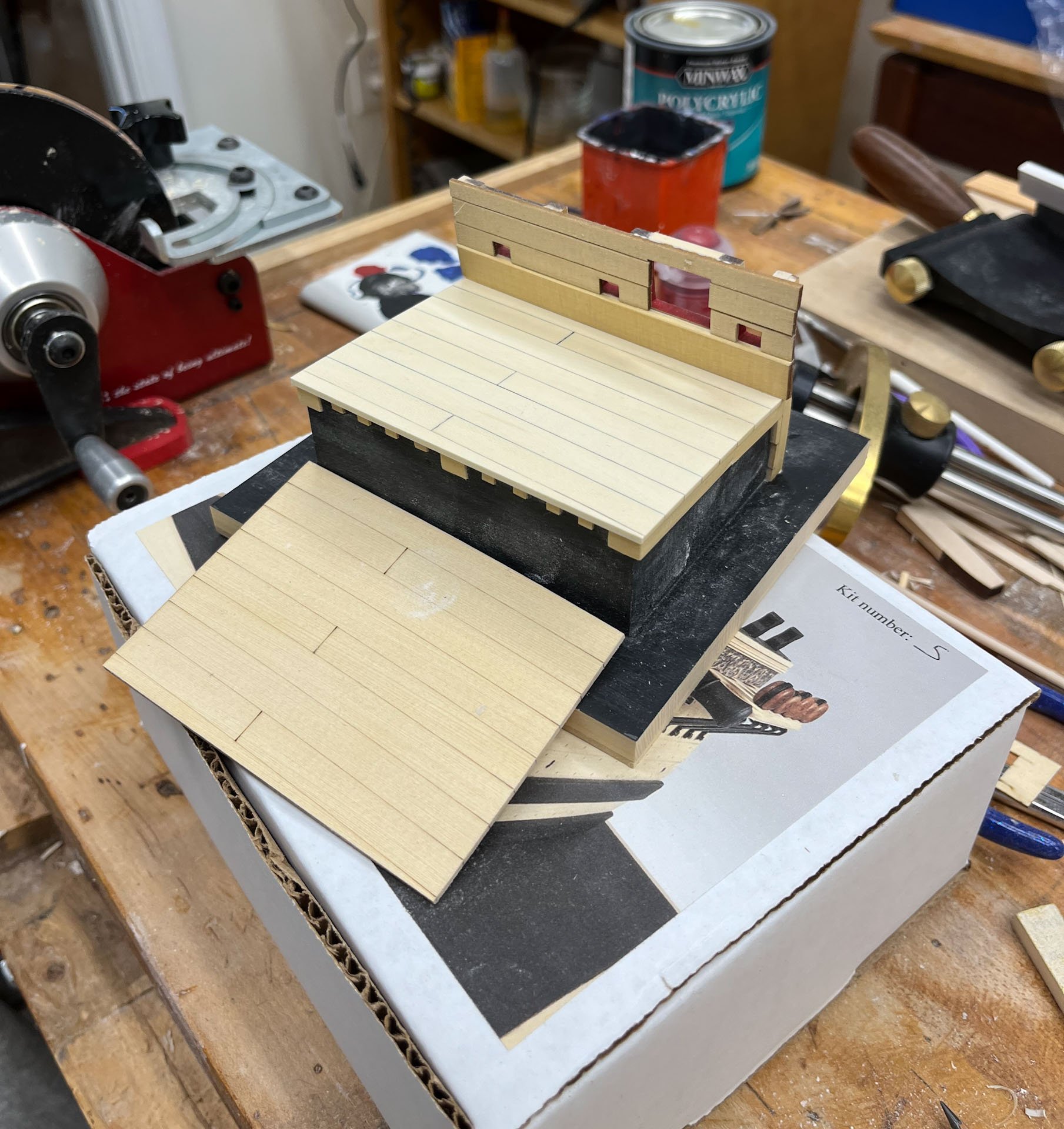

I decided there was no way I wouldn't break the stand if I glued it on now so decided to add it later.  I touched up the faux beam ends with black paint and moved onto the decking.

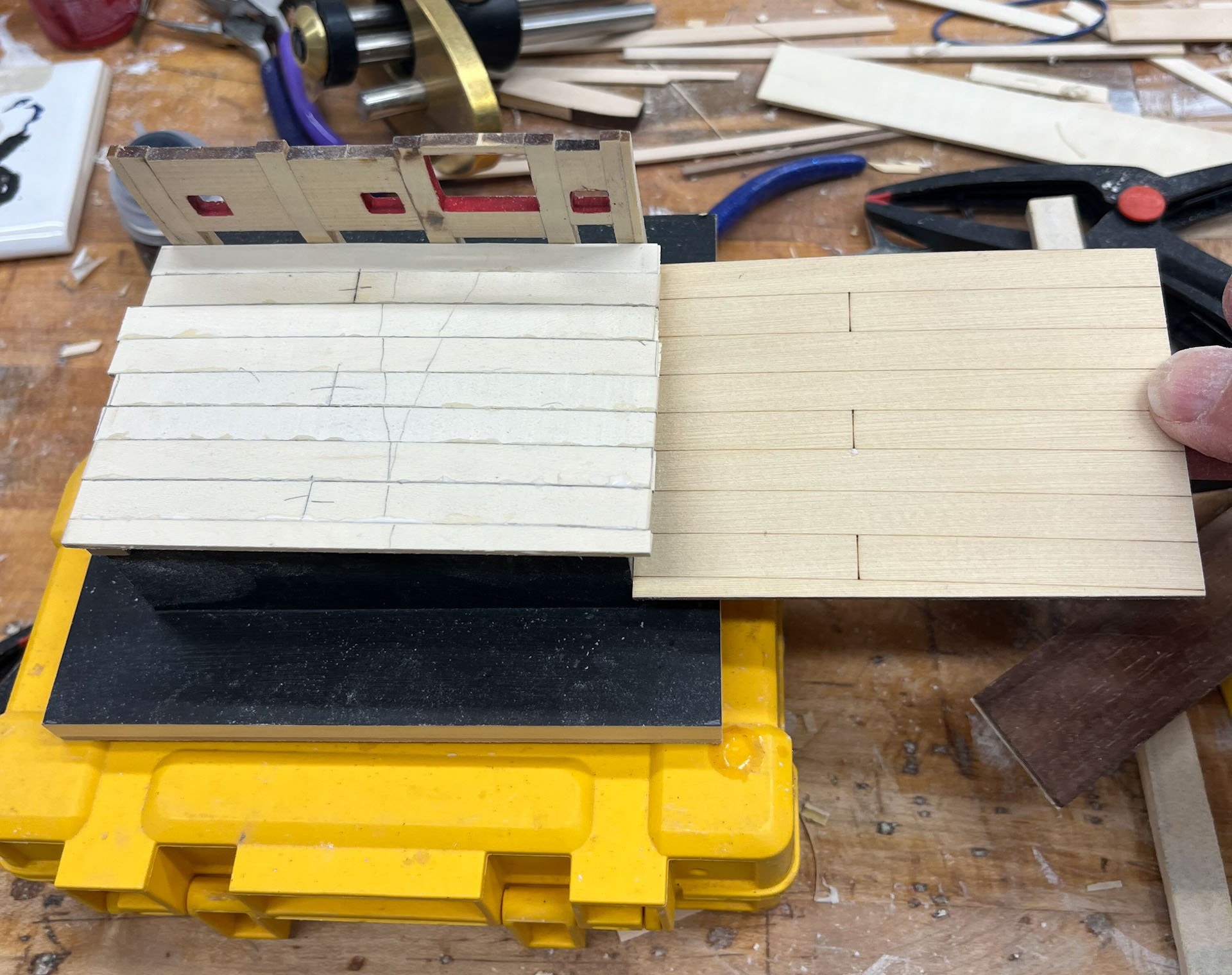

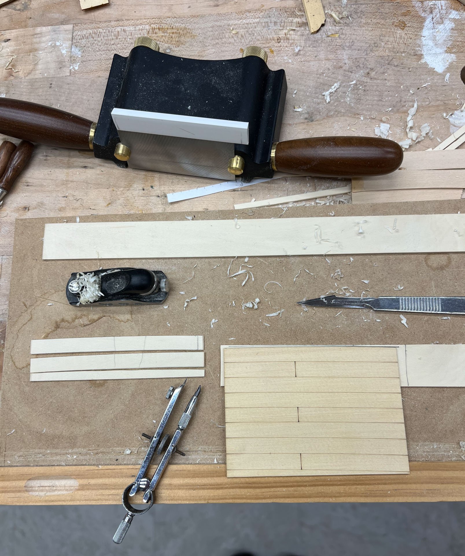

The kit comes with printed decking and exterior planking but that would be easy.  I did my usual plank preparation of cutting strips from my shrinking billet of holly and smoothed the rough side with my Veritas string thicknesser.  The decking is curved so the easiest way to replicate it was tracing the edge of the pre-printed decking onto my holly strip, smoothing to the traced line, and using my trusty compass to mark the width.  I cut the concave side with a scalpel, then smoothed with sanding sticks.  I like to mark my planks with a pencil triangle to keep track of order.  And when I inevitably drop one (or all of them) I can instantly recreate their order.
For anyone following this procedure be aware that the planks are not all exactly the same width - some of the middle ones are narrower than the others.  Not by much but if you want your decking to exactly match the printed version some fudging will be required.  I sanded each board as I went to match the curves as closely as possible, and used #2 pencil for caulking.  I also edge glued each board with yellow glue which has some gap-filling abilities.
Here is the deck after glue only.  I tried to match the spacing and width of the printed version as closely as possible. I know it looks rough.
After scraping the glue beads off I trimmed the edges back to almost flush (the Veritas mini plane is such an essential tool), sanded with sticks using 180, then 220 grit, then applied 2 coats of water based polyurethane.  Now it looks like below, which I'm happy with.

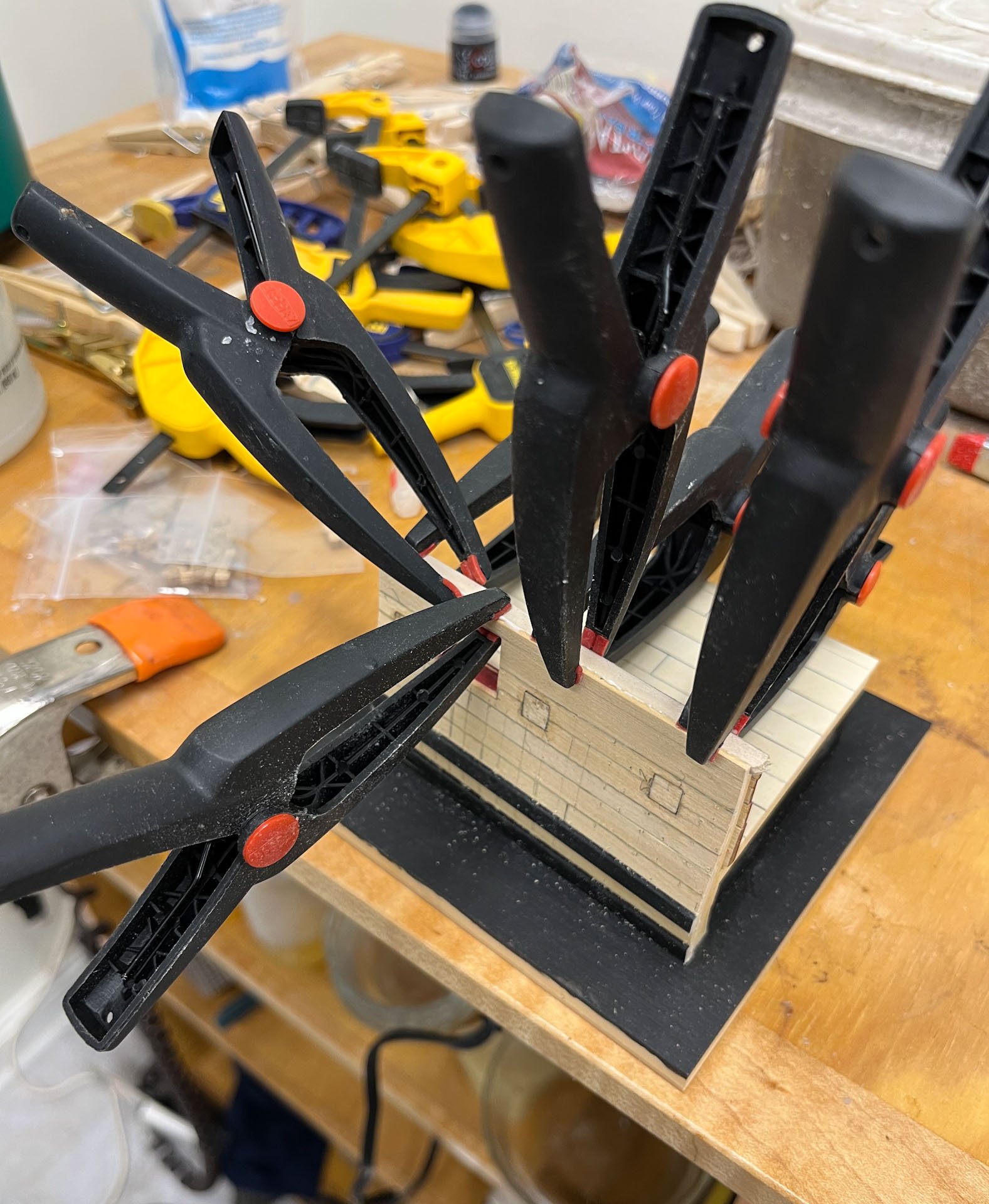

Also in the above pic I have added the interior planking.  The kit provides a single piece of AYC which could be glued in place; I choose to cut it into separate planks.  The bottom one I glued to the laser-cut spirkiting, making it thicker.  (Its a different colour in the above pic b/c its been polyurethaned while the planks above it haven't yet.)  On the top 3 planks I sanded the edges so they have a subtle bevel; I think the directions say to paint the inboard all red and I was worried the planking seams wouldn't show.
And at present its all drying.  Next up is enlarging the inner planking holes so they match the gunport and sweep port holes, then planking the outside.

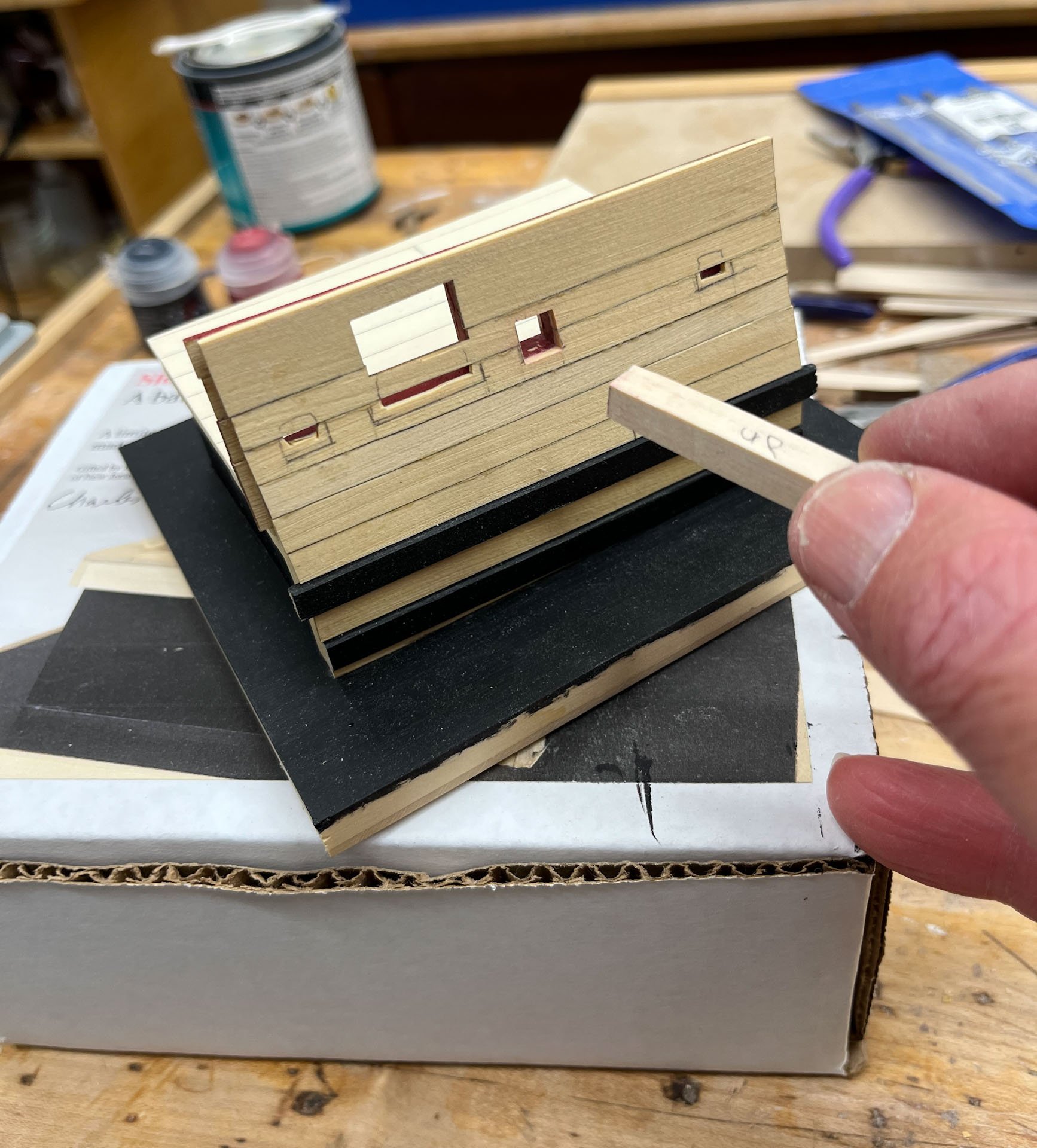

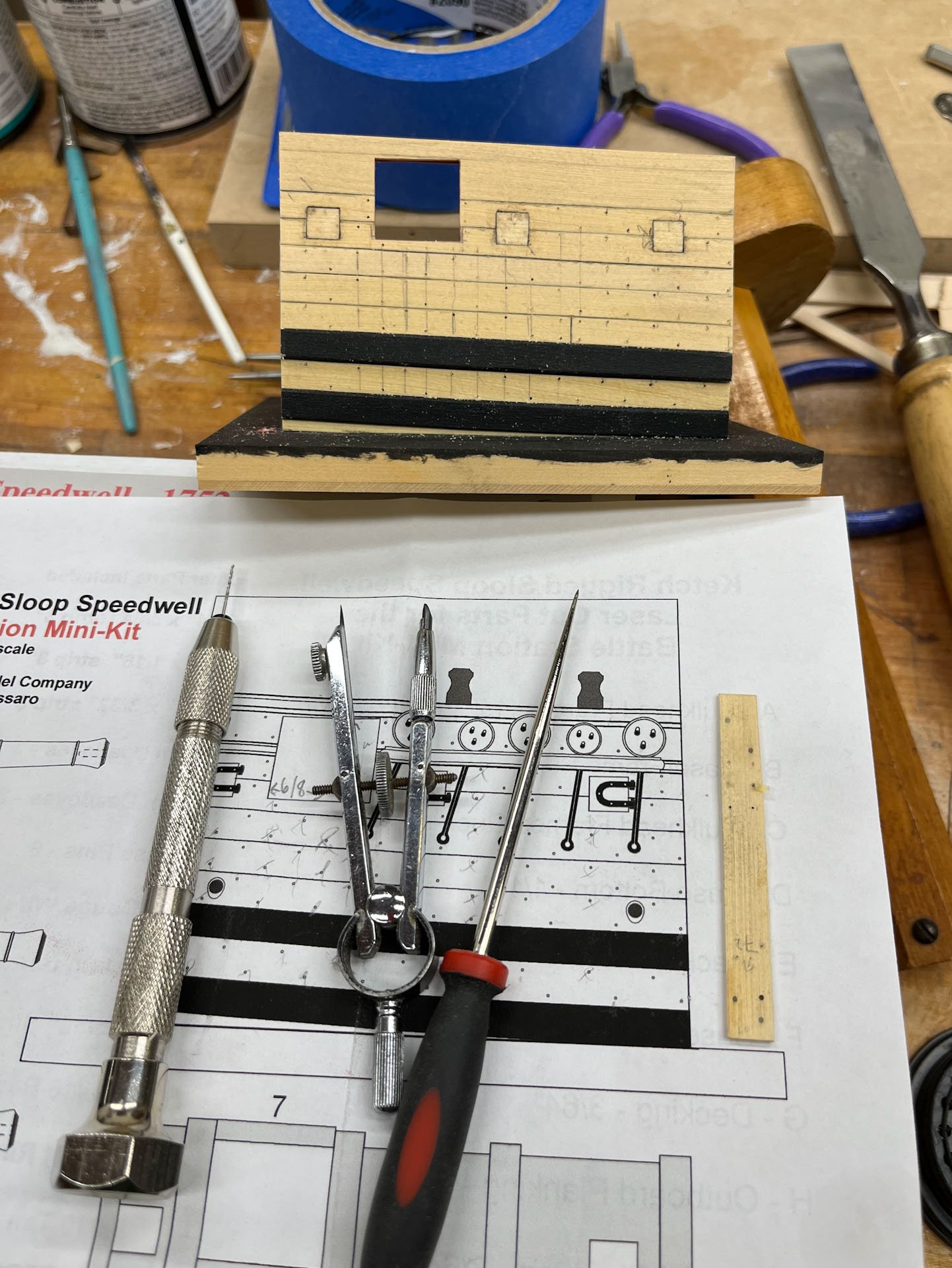

First up, I planked the front.  The kit includes a laser printed piece of AYC that could have been glued in place with some bending and minimal frustration but wheres the fun in that I like complicated.  I wanted this planking to be AYC so I cut my strips from the original printed piece and turned them over so the printed side was in.  The run of the grain wasn't perfectly even with the edges so I had to trim some and would have run out of material before I got to the top except I substituted some basswood strip for the wales which were painted black.  The planking is subtly curved which I also tried to preserve in my replacements.

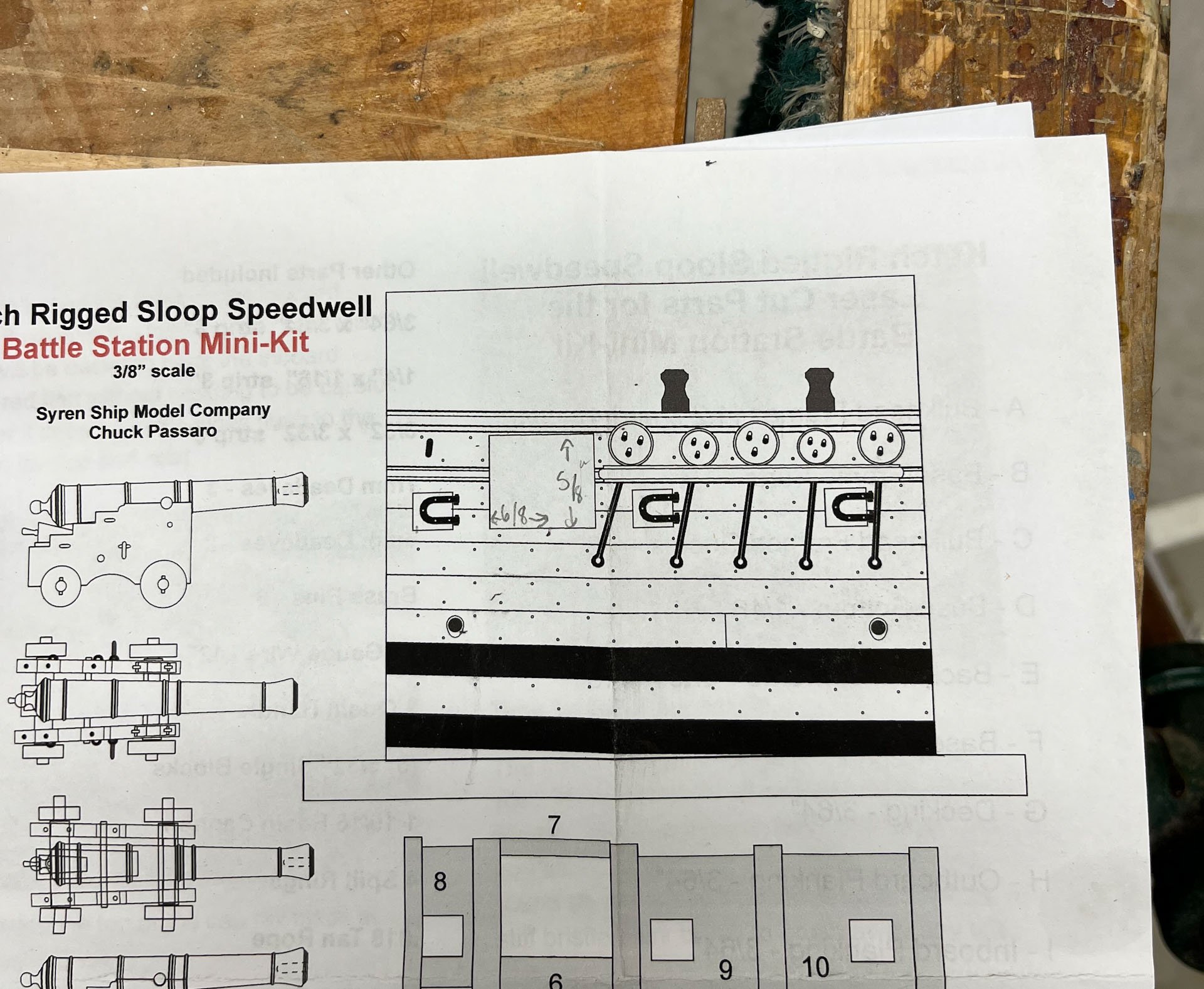

Next up was forming the oar and cannon ports.  I took a 1/4" (I think) square strip of basswood (make sure to measure yours if you do this, mine was extra strip from my AVS and while it looked square one side was 1/16"or so thicker than the other).  After squaring I trimmed the end so I could fit it into the hole and sneak up on the correct opening size.   It helped marking which side was up.

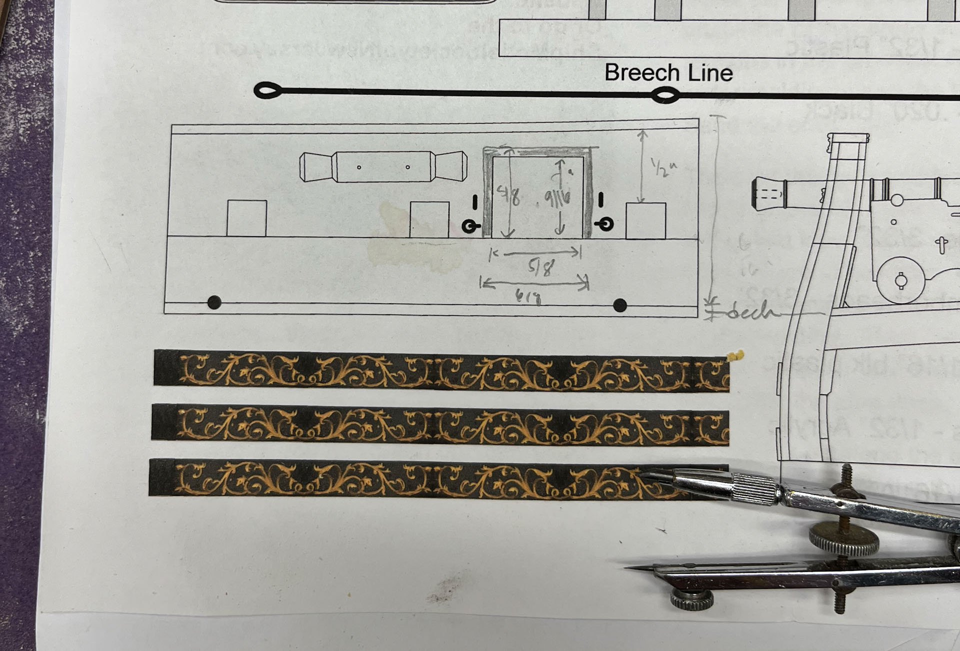

The oar ports were straightforward.  Then I got to the cannon port and got confused.  Somewhere I had messed up.  On the plans Chuck provides there are two "to scale" pictures of the bulwarks; one of the inside and one of the outside.  On the Exterior picture the cannon port measured 5/8" high and 6/8" wide.  There is a molding that fits tightly between the top of the cannon port and the bottom of the cap rail.  Ok fine.
On the picture of the inside planking the opening is smaller, 9/16" high and 5/8" wide.  I didn't realize this size difference at first and was going nutts figuring out how the distance from the top of the cannon port to the cap rail was somehow different front to back.  After some staring and measuring I eventually figured the inner picture is probably the rough opening in the prefab piece (which i don't have anymore as I cut it apart into planks).
Once that was sorted out and the openings finished I added the oar ports.  These were cut from a strip of AYC and sanded down very carefully until they fit and the edge reveals seemed even.  Here they are glued in place.  The strip I cut them from is infront.

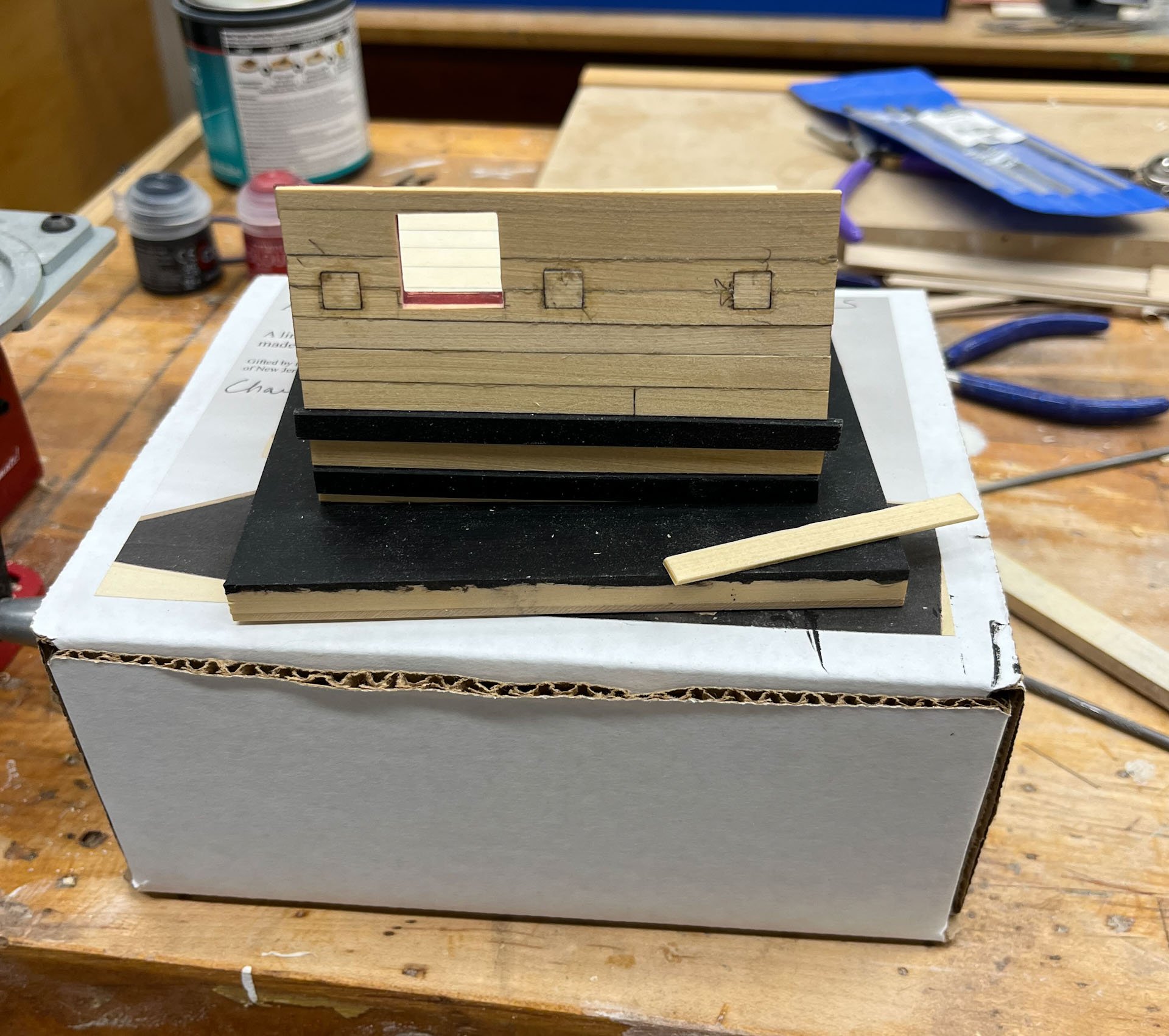

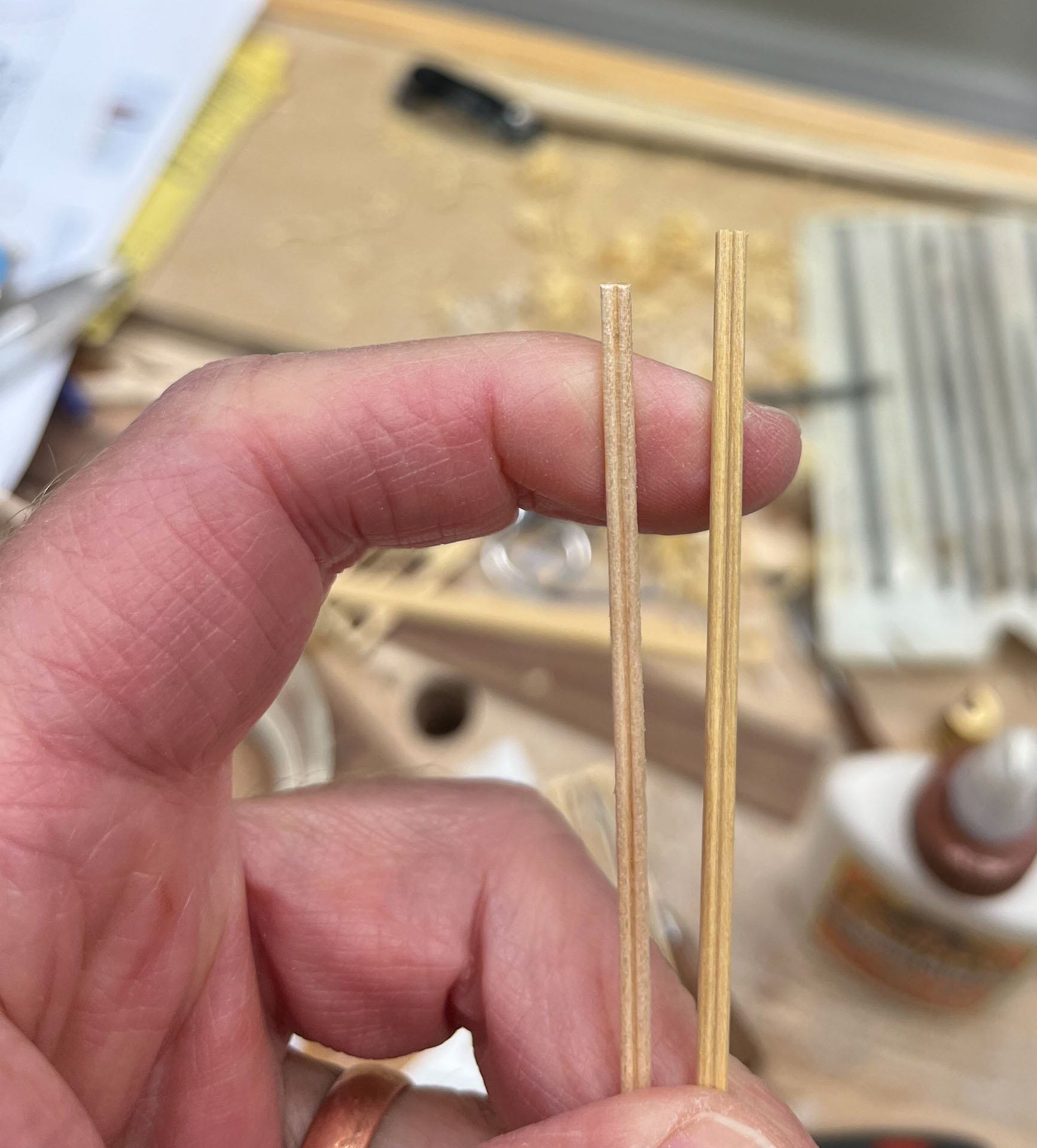

Next up was trenailing, trunelling, whatever.  I didn't attempt this on my AVS (the thought of ruining the planking after all the work that went into it was too much and I chickened out).  But here is the perfect place to practice.  I tried a bunch of different techniques on one of my rapidly diminishing stock of AVS spare planks.  The 10 lb black fishing line in drilled holes looked not right to me for this scale so no go.  Eventually I settled on Chuck's "drill a hole with a 72 bit, twirl a #2 pencil in the hole, and fill with a neutral coloured wood filler."  I first used some wood putty, which it turns out stays flexible (and therefore doesn't dry), and I suspect is solvent based so will probably stain the wood.  So now Elmers wood Filler is in the mail; for some reason neither the local Home Depot or Lowes carry it.
I had a lot of complicated methods in mind to mark out my trenails; tape strips, rulers, math.  Turned out it was easiest to use my compass held against the bulwark sides to trace vertical lines.  I poked an initial hole with my awl and drilled it out with the 72 bit.  KISS is still a good rule to live by.
And finally.  My inner bulwark planking ended up lower than the exterior so it needed to be extended a little.  Here I added a small strip of wood which should also give the cap rail a more secure glue surface.

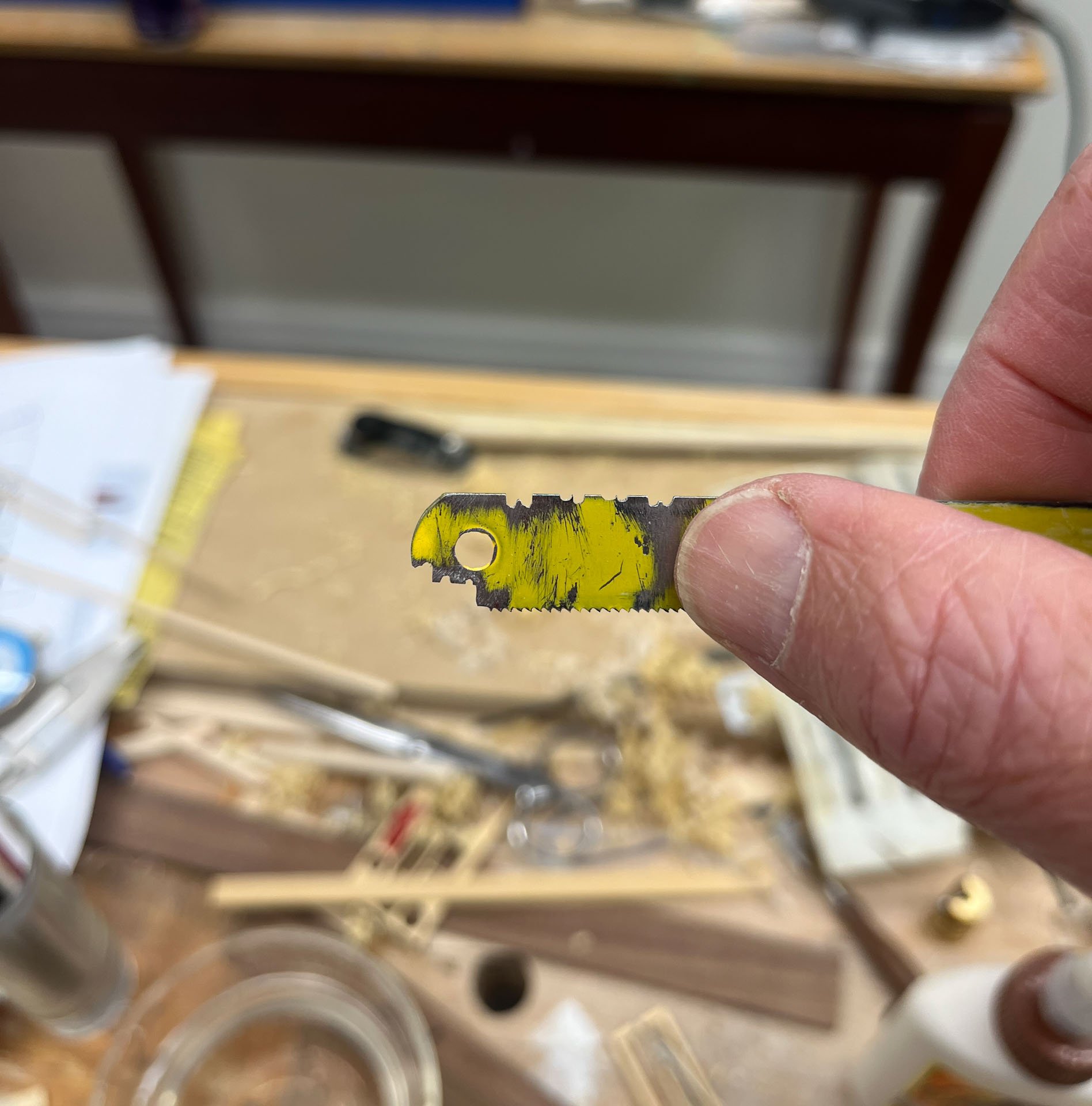

Next I made my scraper, going with a hacksaw blade this time.  It took a couple tries.  After clamping the hacksaw blade in a metal vise I used a cut-off disk in my dremel at low speed to make the initial grooves and refined with some small cheap files (not my nice Vallorbe's).  The pattern I used is the lowest.
And here I'm scraping the wood by running the blade gently tilted in both directions (it had a definite direction it scraped easier).

And finally the painted frieze.  The kit includes 3 strips and thats a good thing because I messed up all 3.  The first two by not cutting evenly and tearing the edges.  The third I sprayed on too much Krylon digital photo and paper protectant (Chuck had recommended this in his 18th century whaleboat kit that ModelShipways sells and it worked well for me).  But it was too easy to "spray 1 more time" and ridges of solidified spray formed along the edges of the strip.  Below you can barely see the ridges but they were there and bugging me.
The directions recommend using a glue stick - the one I could find was blue that is supposed to turn clear when it dries, but my son (who is 10 years old) remarked while walking by that the blue doesn't truly go away.  This seems to be his area of expertise so i practiced using one of my failed strips of frieze and some scrap wood with a very thin coat of white glue and it worked great.
After taking this picture I scraped the painted frieze off and printed a bunch more (6 just in case) and sprayed them with ONE coat of Krylon and resisted with all my might spraying more.  They look fine so I'll pick one and glue it on.

I was not fully satisfied with my previous attempts at making moldings.  The process was fine and good practice, but the wood I used (I think maple?) had a mottled pattern.  It looked ... ok.  After staring at it for a while I decided to hold off on making the upper molding until inspiration struck.

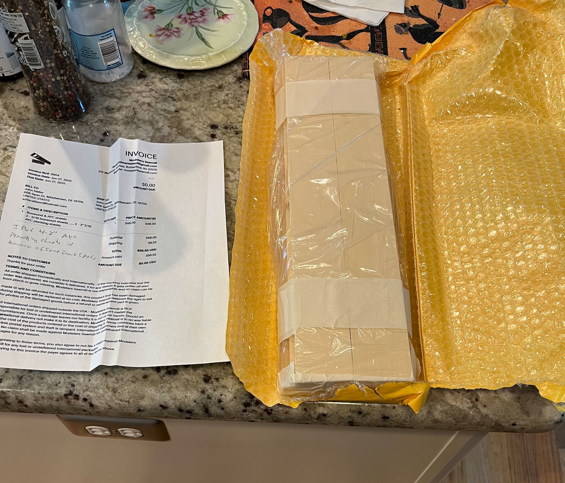

In every misfortune lurks opportunity; this was the perfect excuse to order some wood.  I'd heard good things about Modelers Sawmill in New Jersey so I gave it a try and ordered 2 billets of AYC and 2 of Boxwood (which I have never used before).  Joe, the owner, was excellent and provided good communication and suggestions.  The order took a few days to show up, was nicely wrapped on the outside, celophaned on the inside (to limit moisture exchange -> which leads to warping).  An excellent experience - highly recommended.  Joe even included 2 extra billets of AYC because of some discoloured areas.  I normally assume 25% wastage from imperfections so this was above and beyond.
Now that I had the wood I had to do it justice.  I cut a strip from the boxwood and used the same scraper as before to remake the lower molding.  Once it was scraped I trimmed it down to size.  It was definitely better.  Below the old molding is on the left.  You can see the mottling/spots it has.  The boxwood on the right is much cleaner.
The old lower molding popped off distressingly easily.  I changed from white glue to yellow in hopes the boxwood version would stick better.
Next I made the scraper for the upper molding.  My interpretation of the Battle Station plans indicated a double bead, the upper one bigger than the lower, with a small fillet at the bottom.  This scraper took a lot more time to construct versus the lower molding; every time I had it almost right I tended to over-file.  Here is the final result - the  profile I used is on the bottom left side.  The profile is cut pretty deep into the hacksaw because i had to redo it so many times.
Then the same process as before.  Scrape the boxwood, plane it down to the correct thickness, and yellow glue it in place.

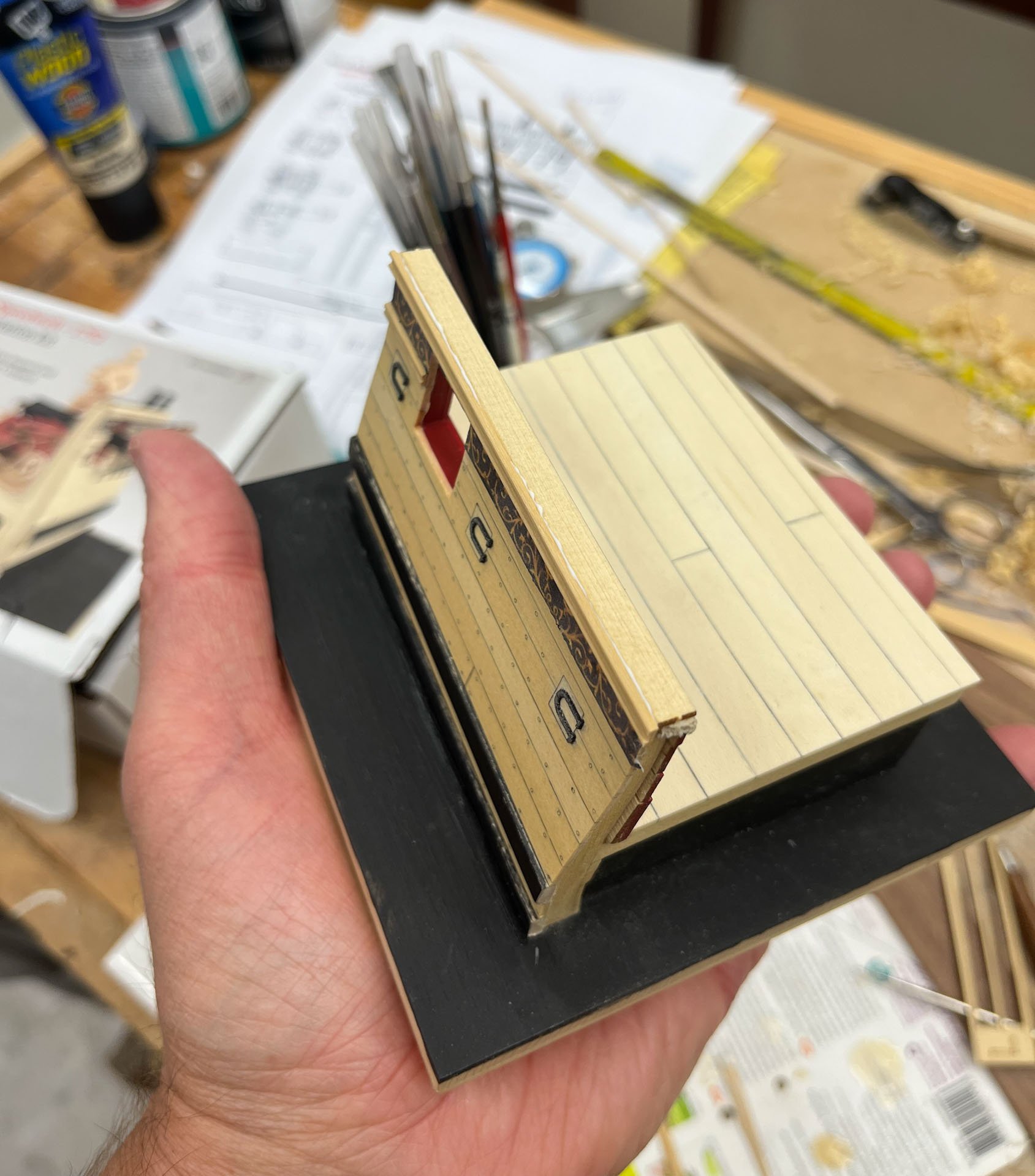

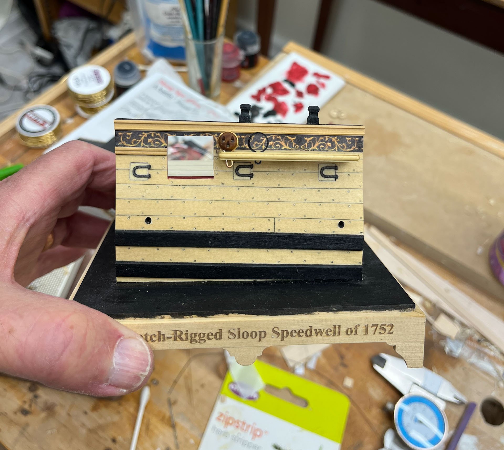

Good Thursday night MSW.  A brief update tonight, more fine tuning than impressive progress.
I finished the cap railing and moldings and sanded down the cross sections of the planking on the sides.  Then I added the channel, which had to be sanded down thinner to match the width of the molding.  I wasn't confident it would stay put with only glue so I pinned it as well.  I managed to drill all the way through the bulwarks with all 3 pinning holes so beware future builders.  I used epoxy and 20g brass wire which fit the holes loosely allowing me some wiggle room, and yellow glue.  It's pretty solid now.
After it was fully dry I realized I put the channel in upside down (the edge slots for the deadeye strops are not the same at each end, one is closer to the edge than the other) but I can't easily unattach the thing so its staying.
I noticed in the Speedwell book (Vol II, pg 47) Greg and Gave show the deadeyes all the same size.  They also chose to add a swivel mount directly over the channel, in between the 2 bolsters.  I don't think I'm doing the swivel but maybe my brain will betray me.  Again.  We'll see.  It might make the model a little too busy.
Then I made the bolsters, which were straight-forward sanding exercises and pinned them as well.  I used superglue for the pins.  Both feel secure.
And finally I manned up and attached the base pieces.  They were not perfectly square to each other so I have some sanding in my future before I add the curved molding to ease the transition to the base.
I also added the waterway piece, which in hindsight should have been holly so it matched the decking instead of the AYC i used but oh well.  I also drilled out the scuppers and used #2 pencil to darken them as per the directions.  They don't connect and you can't tell.

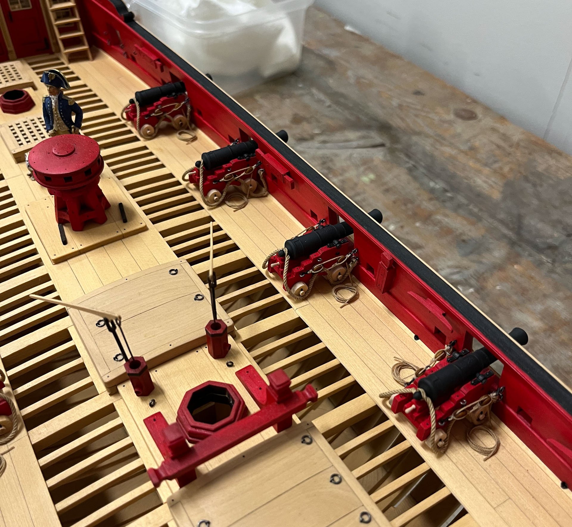

and now I started on the cannon carriage.

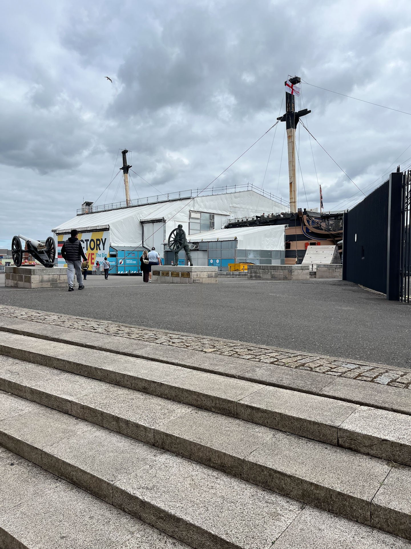

Well its been a bit.  The summer has been flying along!  We went on vacation to England earlier this month for 9 days and saw lots of touristy sights in the Southwestern parts; London, Stonehenge, Bath, Land's End, many others.  Then with 1 day to go before taking the train back to Heathrow I was let off-leash for the day in Portsmouth.  We all did our own thing (wife and kids went shopping); obviously I bee-lined for the Historic Dockyard.  So so cool.

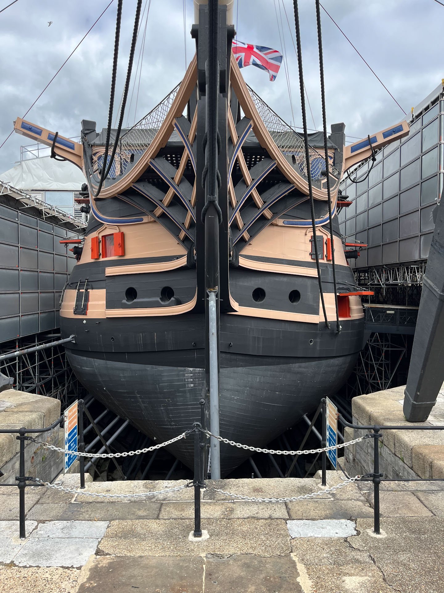

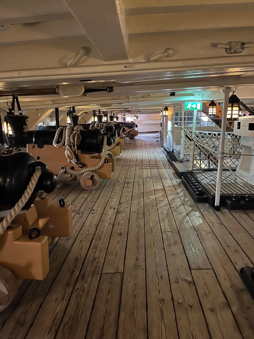

Here's Victory, who is under intense refurbishment.  My modeling buddy Jason was hoping for some rigging pictures but nope other than the fore and mizzen its all been taken down.
  Here she is from the front.  I noticed the bottom of the wales don't line up; not sure if thats purposeful.

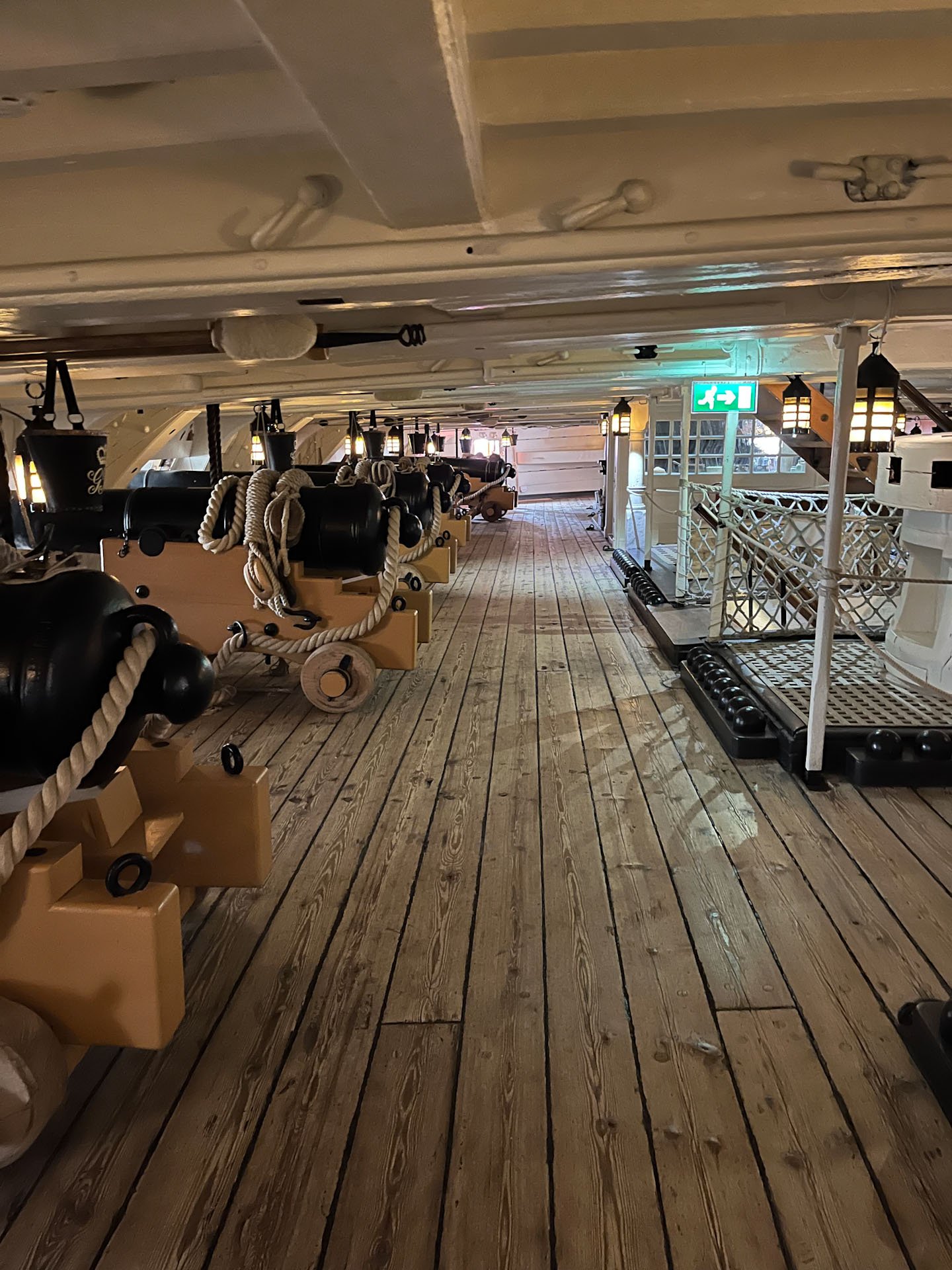

You can take a self-guided tour which I recommend; it was set to music and followed along the weeks before Trafalgar and helped set the mood.

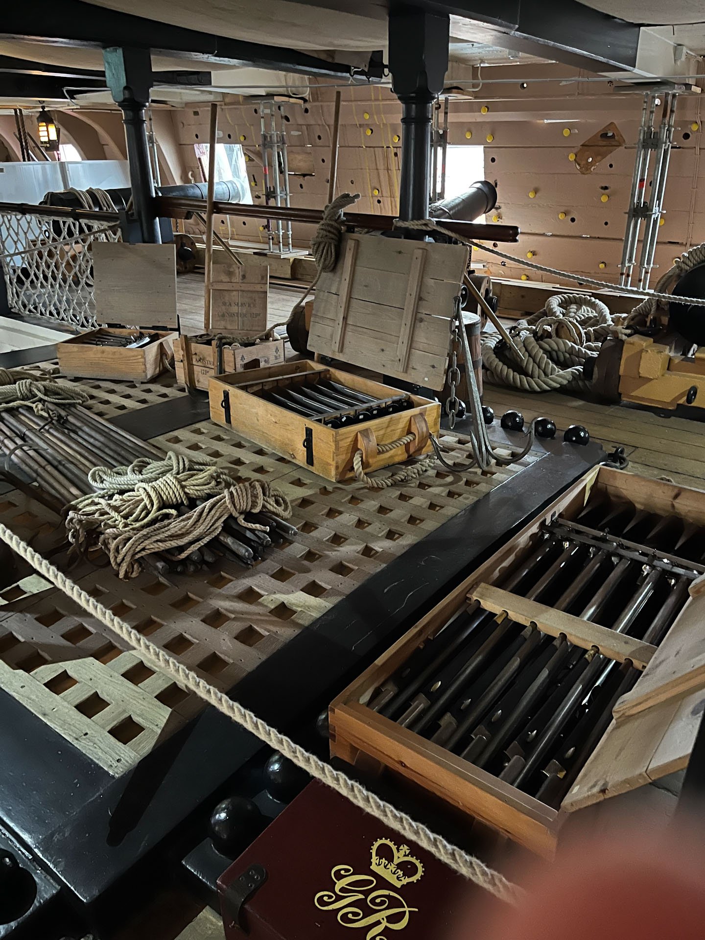

There were a lot of boxes of equipment on the inside decks that would be great details to add to a model.

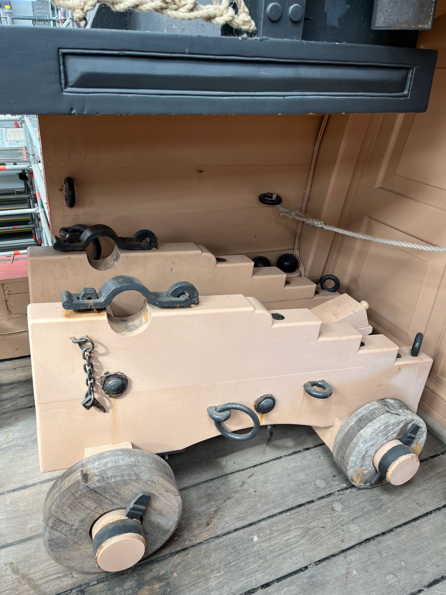

Since this log is about the Speedwell battle station and I have a cannon to model in my future I got a lot of carriage pics.  But I'm not sure how accurate the equipment is; the barrels were mostly wooden and I assume a lot is recreated.  I hope the pics will at least help me get the size of rings and bolts proportional.

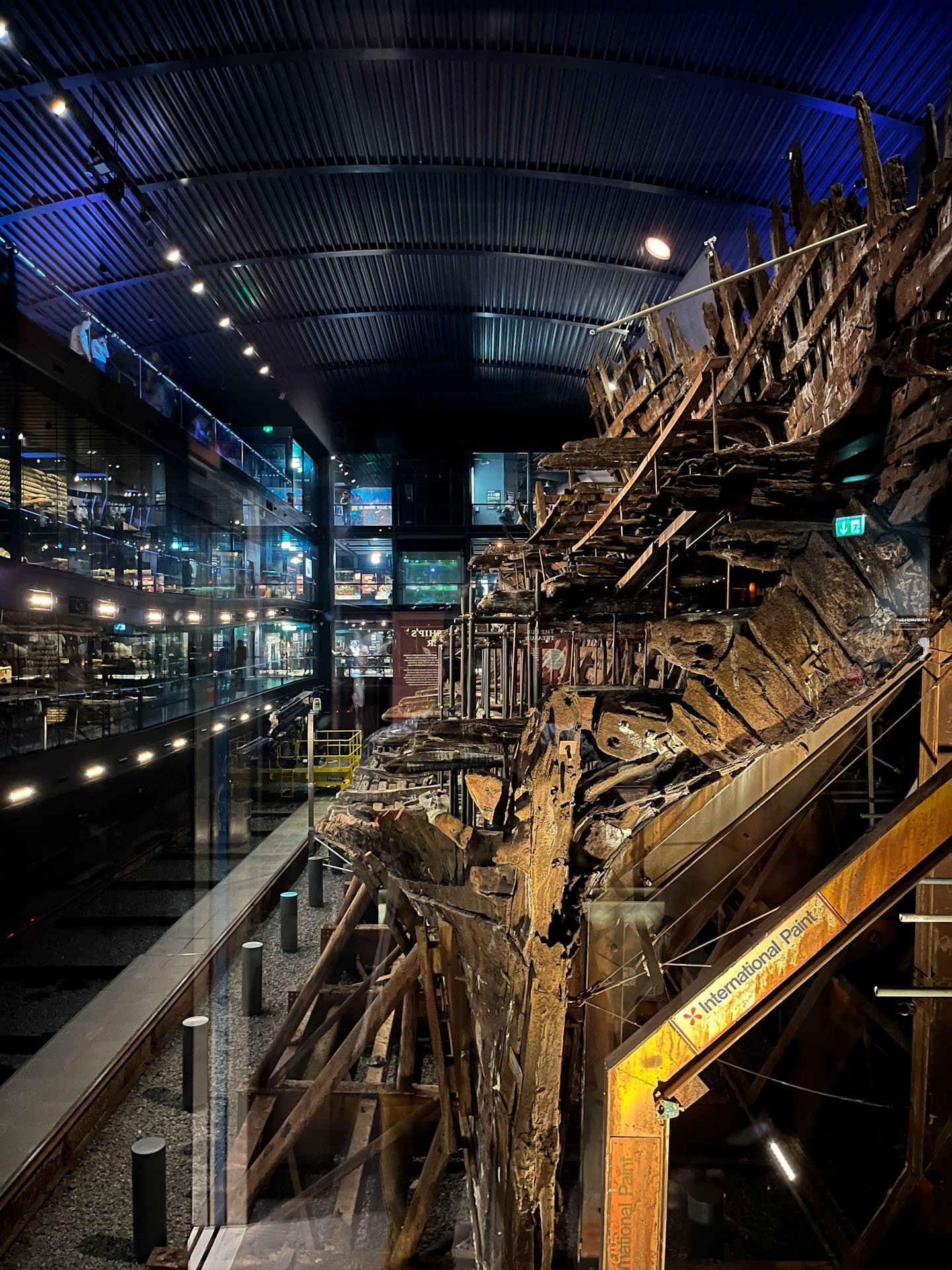

Next up was the Mary Rose museum, about 1 block away in the same area.  While I don't have as much interest in this era it was an amazing museum mostly due to all the personal effects found on the wreck that are very artfully displayed.  The ship apparently was overburdened (if one deck of cannons about the poop is good, 2 decks must be twice as good - it turns out no) and turtled in a gust during the Battle of the Solent 1545.  Many/most of the crew was trapped in place, and anything below the sand that wasn't prone to rusting was well preserved in the occupant's cabins - trunks full of clothes, personalized belongings, and many many bows and arrows.  Ironically the wreck itself wasn't as exciting as all the stuff in it.

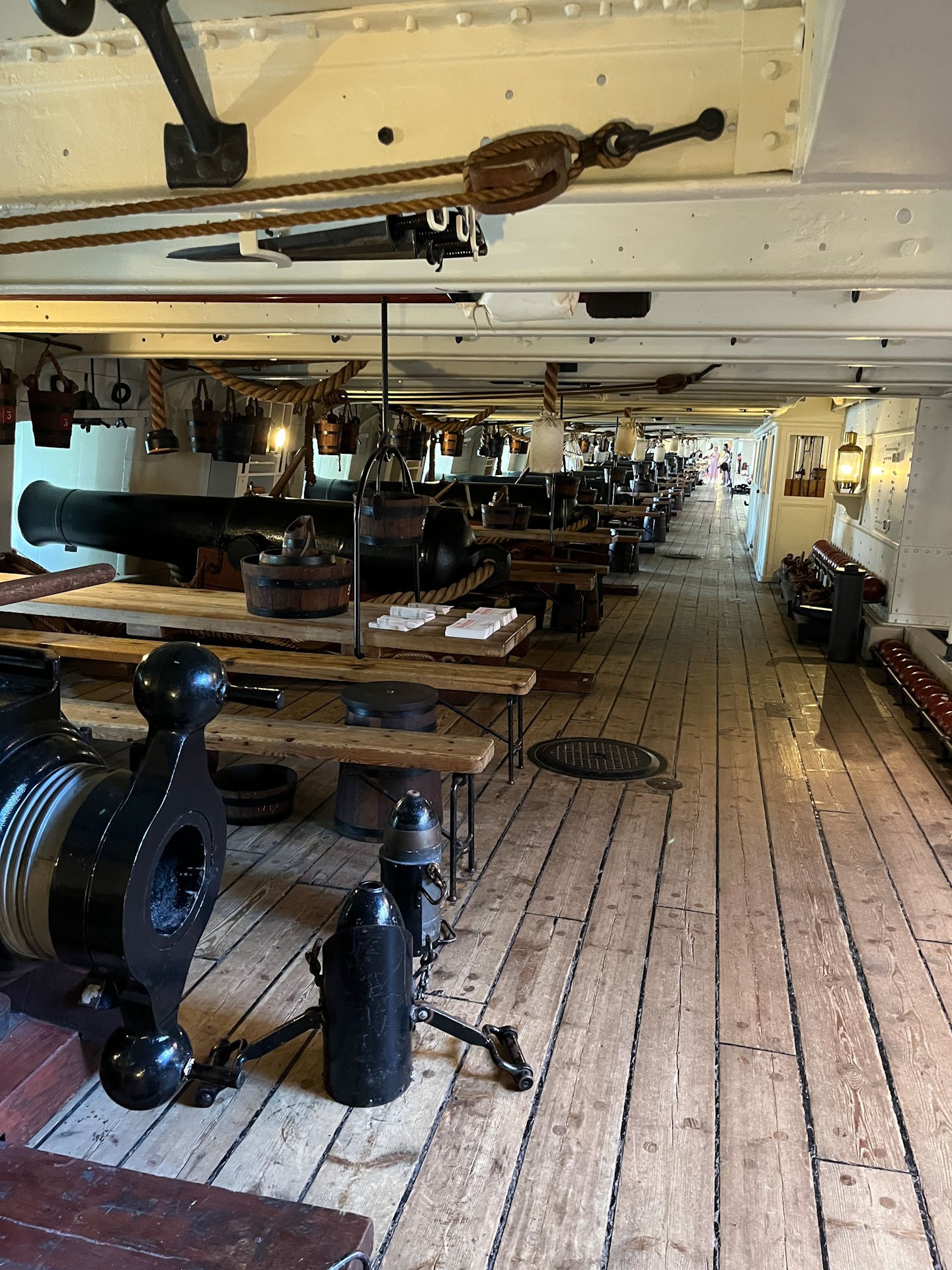

And finally, running out of steam haha, I toured the Warrior, a transition steam and sail powered iron hulled warship.  Its a bit past my era of interest so I didn't take many pics.  Interestingly it had the least number of tourists of anything I visited at the Dockyard.  Here's me looking tired and windswept.
The ship felt very steampunky.  Check out this row of cannons; very menacing.

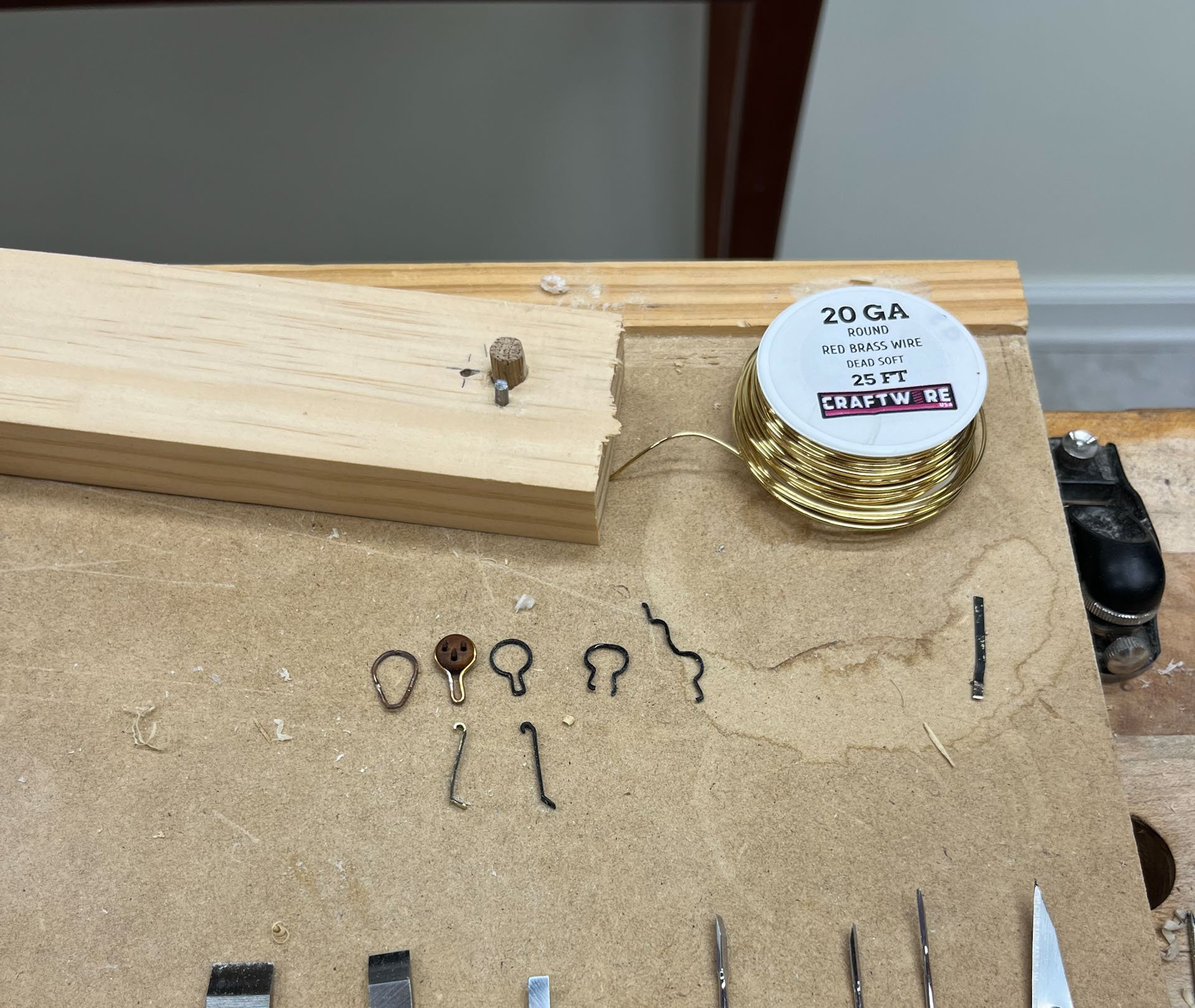

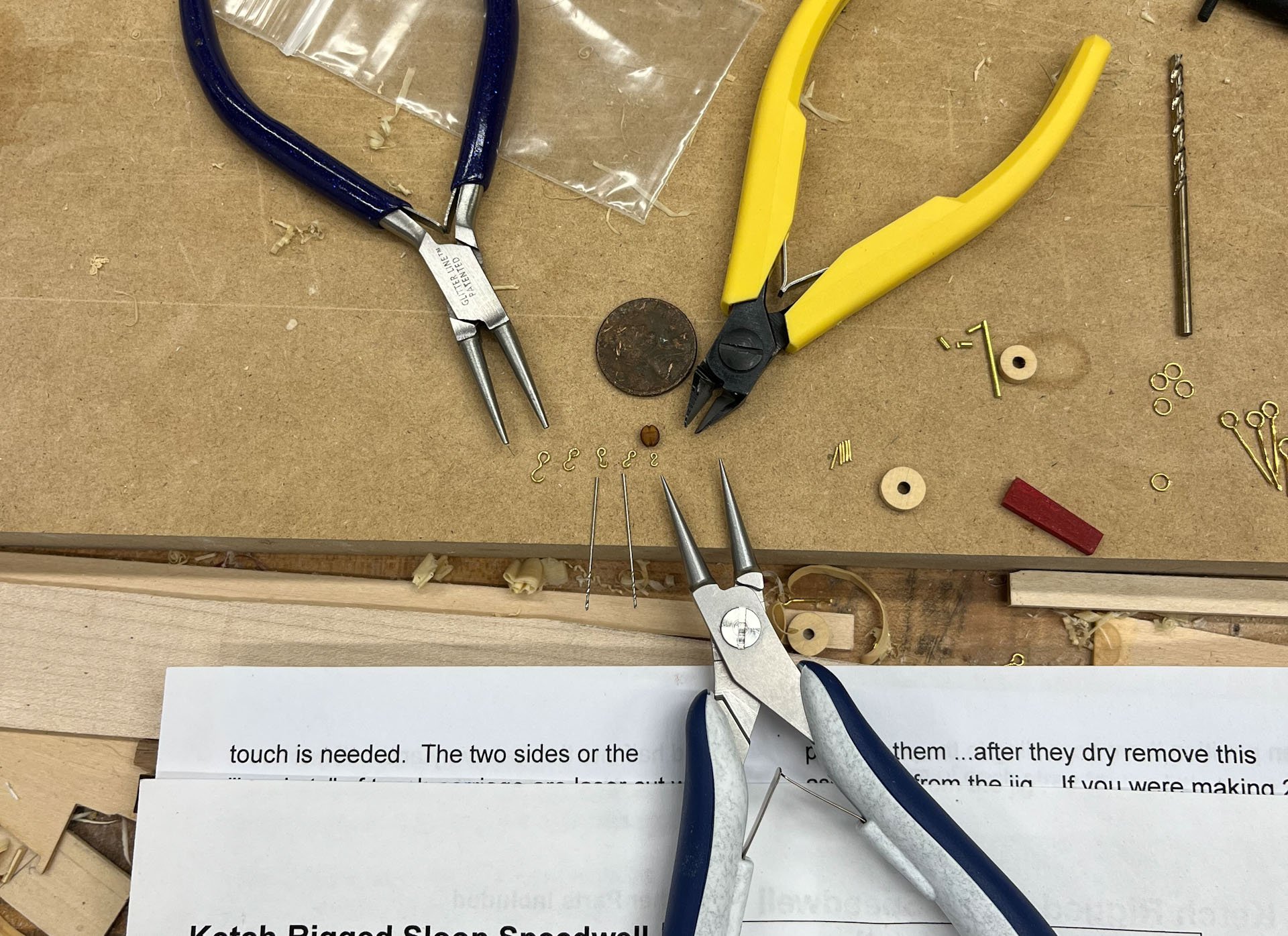

Chuck includes black plastic deadeye strops.  They look convincing and the deadeyes are easy to insert.  Obviously this would never do and I set out to further delay my completion date by making brass ones.
It took a bit to get the old brain running again and there were some false starts.  I think I recall most people make a jig of some sort to make the strops the same length.  I drilled a hole for a dowel and placed a nail next to it to construct an oval-shaped brass wire loop; on the left of the below pic are the first 2 versions that turned out to be too big.  On the right are 3 of the plastic kit strops  for comparison.  2 of them I tried to cut open and heat over a candle to bend them straight and measure their length.  They both immediately stretched and melted so no go.
Silver soldering went pretty well (for once) and on the second strop I moved the site of the joint more downwards toward the smaller loop so it would be hidden in the chainplate.  I made a brass deadeye strap (lower part of below pic on left) to test it out.  Works well and looks pretty much identical to the kit plastic one on the right.
Below, on the left, is Version 2 of my deadeye strop with deadeye in place.  You can see the lower loop sticks out too far compared to the plastic kit version in the next chainplate slot.  But getting there.

Nice work on the deadeye strops/ Probably the best place for the joint is along the side just under the deadeye. Less pressure on the joint and it is hidden in the channel.

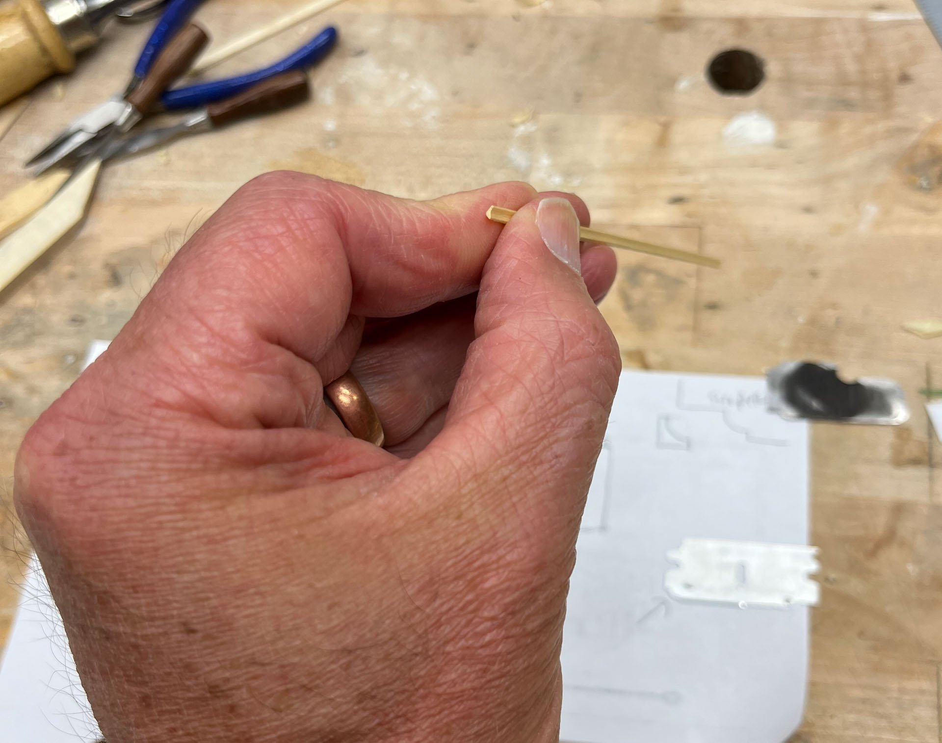

Happy Saturday afternoon.  I have met the challenge of making my own deadeye straps and strops headon, or possibly head first, and have emerged.  Call it a draw.
First off, the kit comes with perfectly serviceable laserboard? (a black plastiky looking material) strops and straps which look great and are easy.  So you don't have to go down the road I did.
The strops - I wrote about them in my last post.  The hardest part, by far, is making strops that are the same size.  I made at least 10 versions to get 5 that were close.  The below jig helped and you can see all the different versions I made.  The nail had to be adjusted 6 times.  Also keep in mind that because 2 of the deadeyes are smaller, 2 of the strops will be smaller as well.
At least silver soldering went fine.  Thanks Greg (dvm27; his advice is a recurring theme in this post) for your recommendations posted under Silver Solder.  I use Euro Tools inc silver solder paste SS 65 and it works great.
The straps were straightforward.  Hardest part was forming them; no one makes strips of brass in the size I needed.  I had a length left over from my AVS used to make the rudder hinges that was perfect, but it wasn't long enough.  Model Shipways doesn't sell the brass strips on their website that I could find.  So I cut my own strips a little wide and filed them to width.  Tedious but doable.
unsurprisingly it was hard to make the strips the same length.  And to drill the hole for the pin in the same place.
And then it was time for my Arch Nemesis.
Blackening.

I landed in Toronto which was fine, got my rental car, and headed to the Art Gallery of Ontario which is about 20 minutes away with no traffic, haha.  Parking was a struggle; eventually I used one of the kiosks on the side of the street and got the 3 hrs max which turned out to be plenty.  If I was towing my family and kids probably not though.
The floor I wanted was the Thomson Collection, a donated ship collection .  All the exhibits are in flowing glass display cases.
There are a lot of ships here, about half more modern metal ones, a quarter bone ships, and a quarter 17th-18th century.  I always feel its a worthwhile trip if one thing speaks to you; here I really really liked the 24 gun navy board style Nightingale, 1:48.  One i could see (someday far in the future) attempting to build.
The Surly was there, I believe a close cousin to Cheerful.
The rest of the museum is devoted to non-ship objects.  The first floor has an incredible section of carved ivory and 17-18th century carved miniature wooden objects that defy belief.  Many are carved on the inside; ie hollowed out balls with a level of detail and miniature-ism I would not have thought humanly possible.  So don't go to this museum if you are a carver; you will leave depressed.

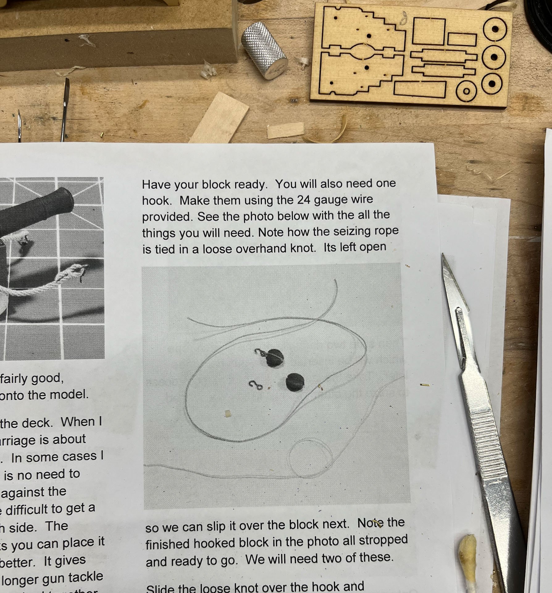

Here's what I wanted to do - make hooks that were proportional to the blocks Chuck supplied with the kit.  To me the hooks look smaller than the blocks; ludicrously tiny.
The pictures are deceptively magnified and I had spent some quality time before the workshop happily making giant-sized hooks.  Once I got my new tools things were better.  Purchases were:
1) teborg 46.9590 round nose pliers 5-1/2" long.  Tips are a hair bigger than 1/64" diameter.  My old set the tips were 3/64".
2) parallel jaw pliers, from Amazon.  Very helpful squeezing rings shut and making bent wire flat.  Generic made-in-pakistan.
3) Lindstrom flush cutting cutters #8147.  My old ones were not flush and left a "beak" on all the wires I cut
Below are my attempts to make hooks, left to right.  I had tried my original round nosed pliers; huge hooks, then wrapping the wire around progressively smaller drill shafts which was very awkward and still were too big.  With the new pliers I finally got a hook smaller than the block; Huzzay!  I also ordered some smaller brass wire, 28 and 30g, which Chuck said will make it easier to form small parts.
And thats where things stand tonight.  Now I need to re-make my giant eyebolts and rings to a proper smaller dimension and then finally on to rigging the cannon.
