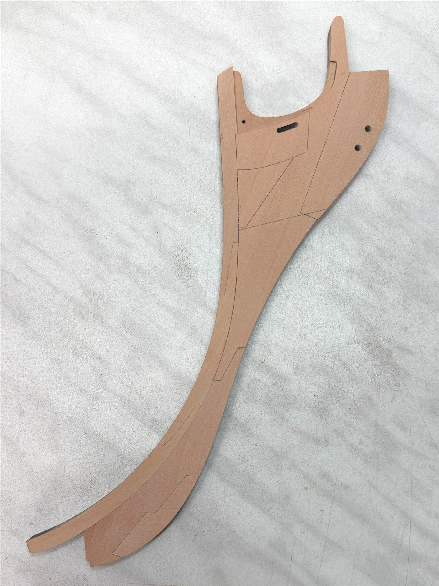

Many parts, such as the bulkhead former, bulkheads, jigs, and stands, other supporting parts are made of MDF of different thicknesses.
The frames, keel, and knee of the head are made of beautiful pear.
Here are some photos.

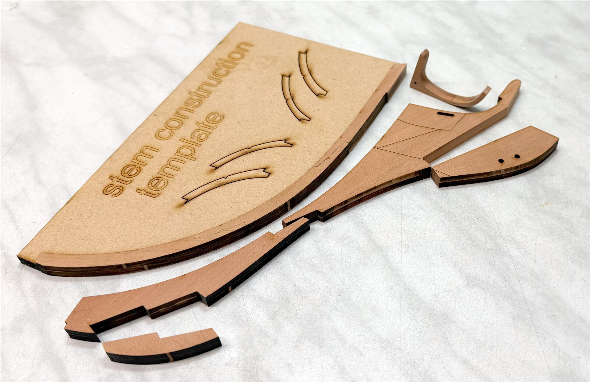

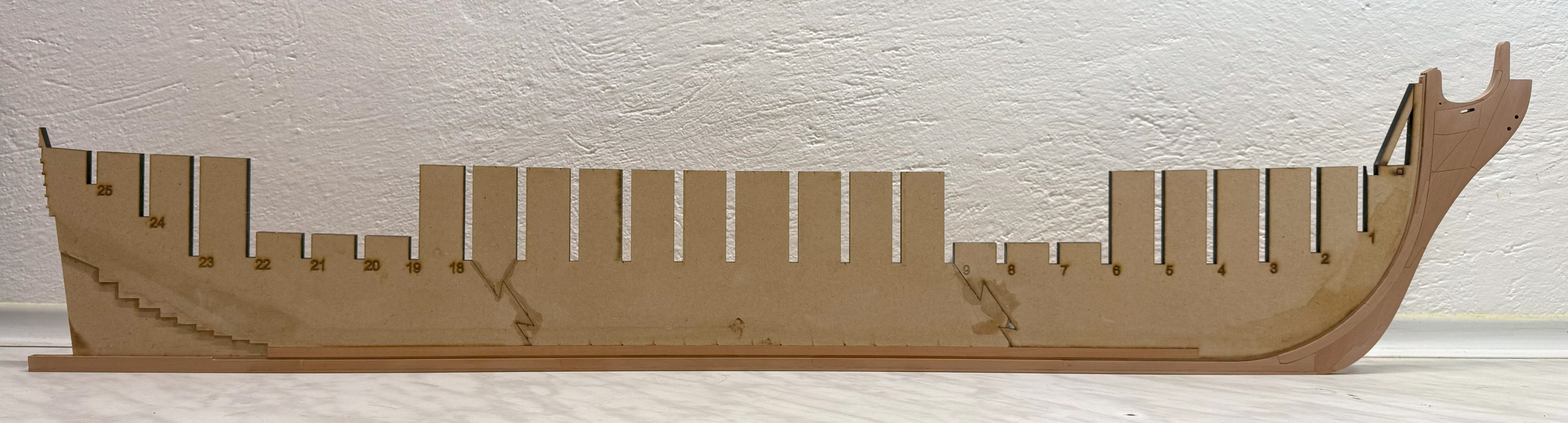

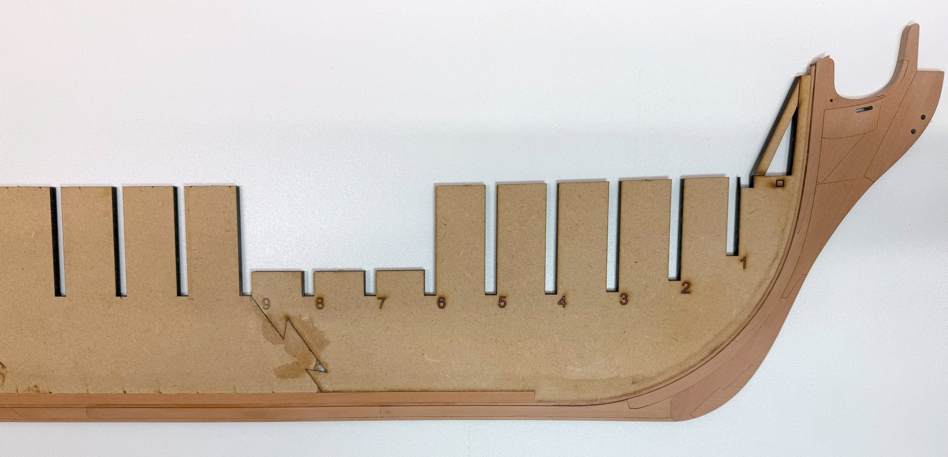

First steps of construction,

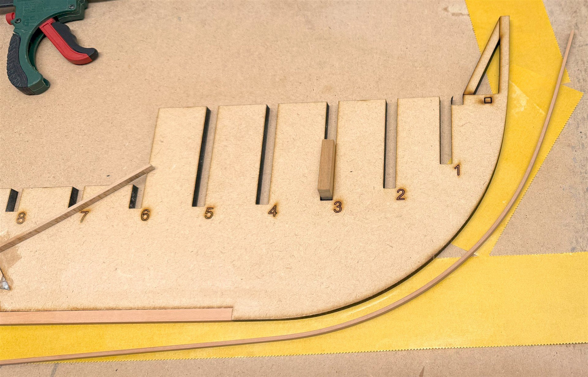

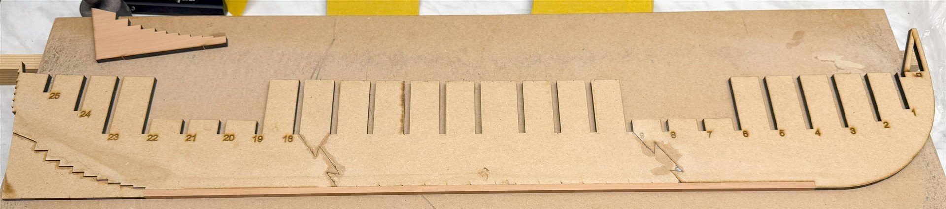

I glued the three pieces of MDF bulkhead former together on a flat board.
From the bottom, I attached an aluminum rail to keep all three parts flush.
I let it cure well overnight.
Then MDF deadwood - 3mm thick
so I used 1.5mm strips to centre it
Bulkhead former is 6mm thick.
I also glued the hull stands together.
I use a very thin CA glue to glue the MDF together, which I let flow into the joints

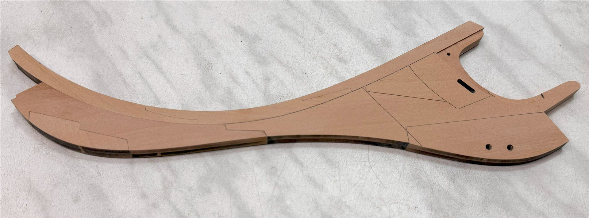

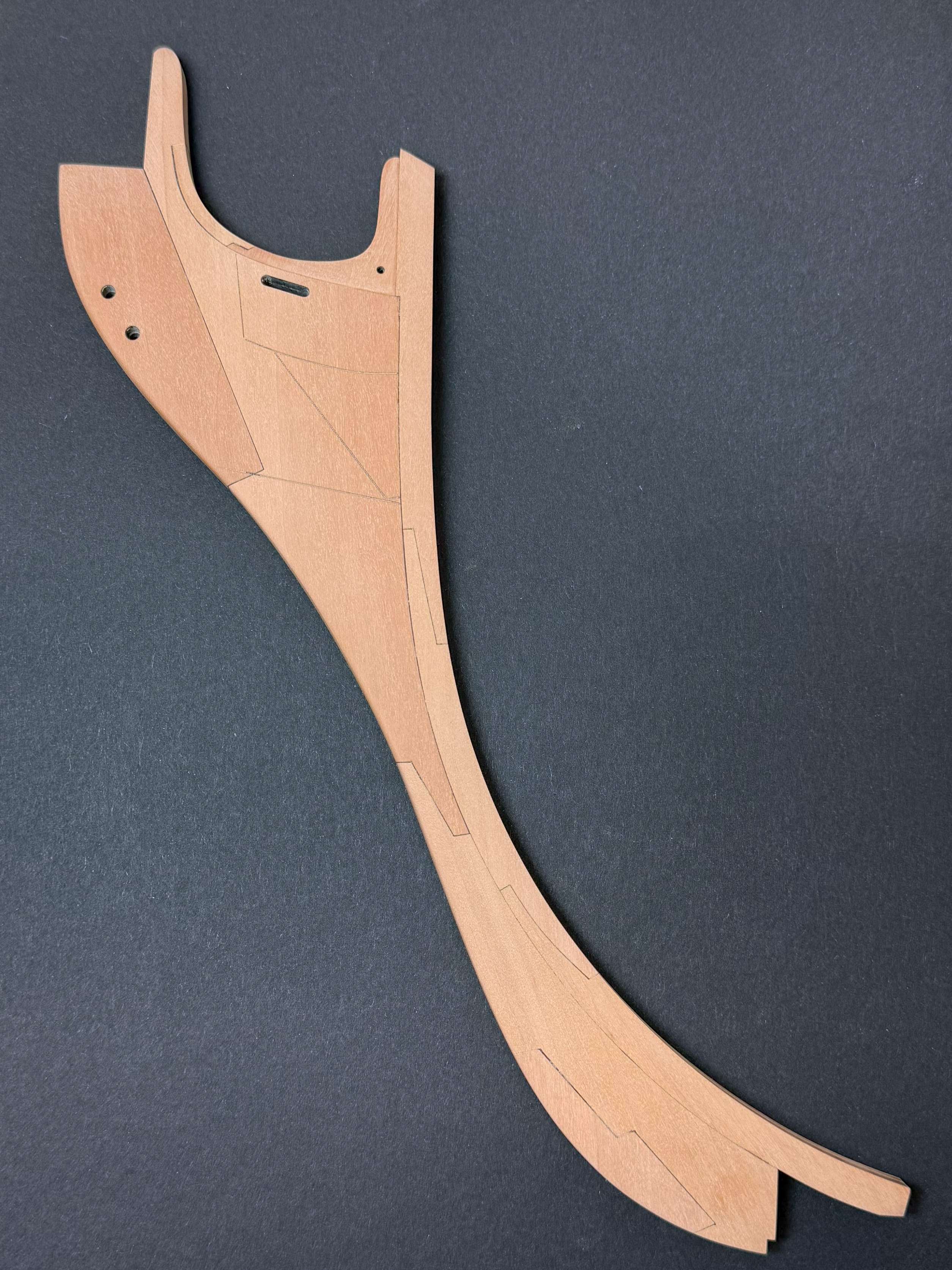

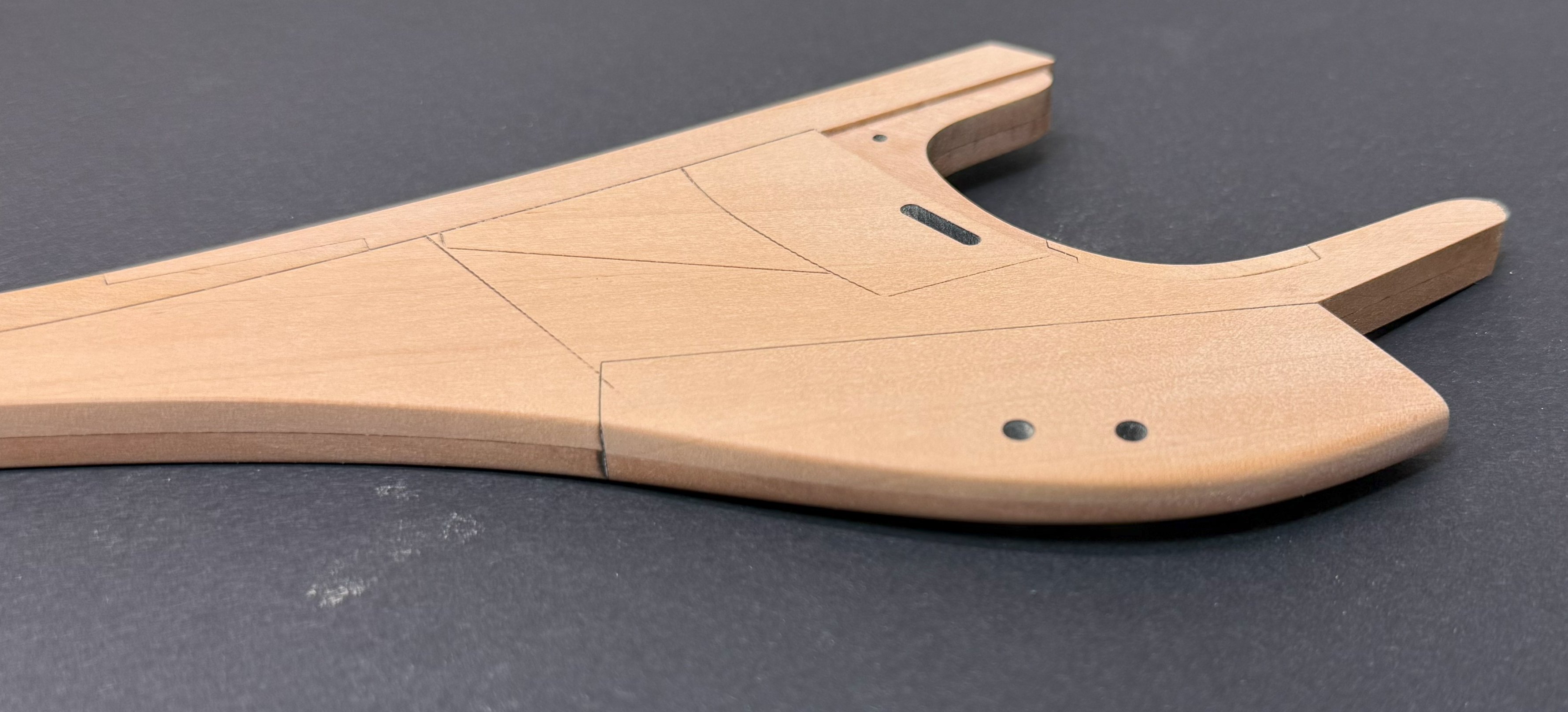

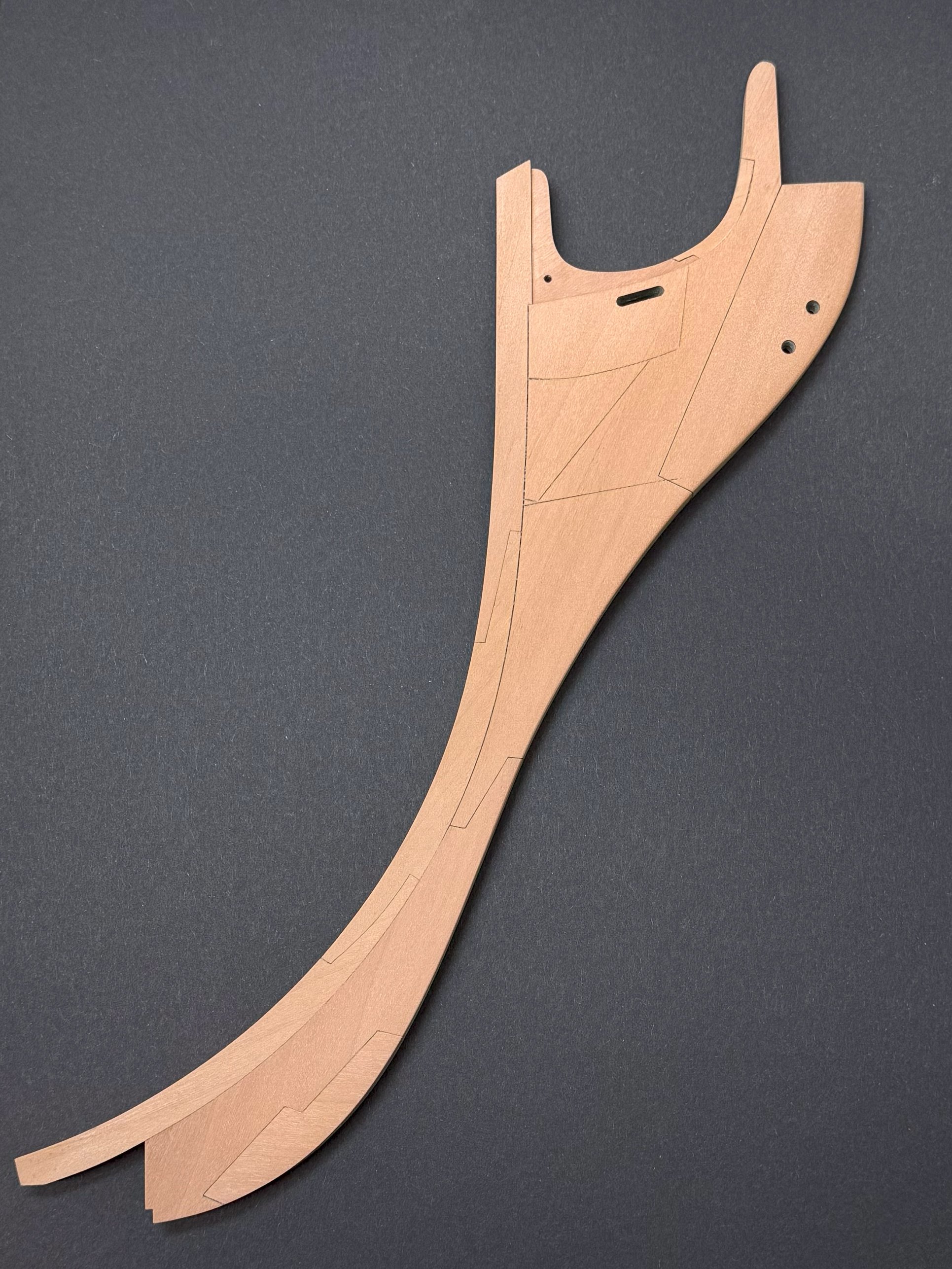

Next tuning The knee of the head parts so far dry

Today, I glued the fake rising wood to the bottom of the bulkhead former and bent the rabbet strip over with hot steam.
I've only clamped it for now to dry and shape it by tomorrow.
Alongside that, I'm slowly assembling the knee head parts...

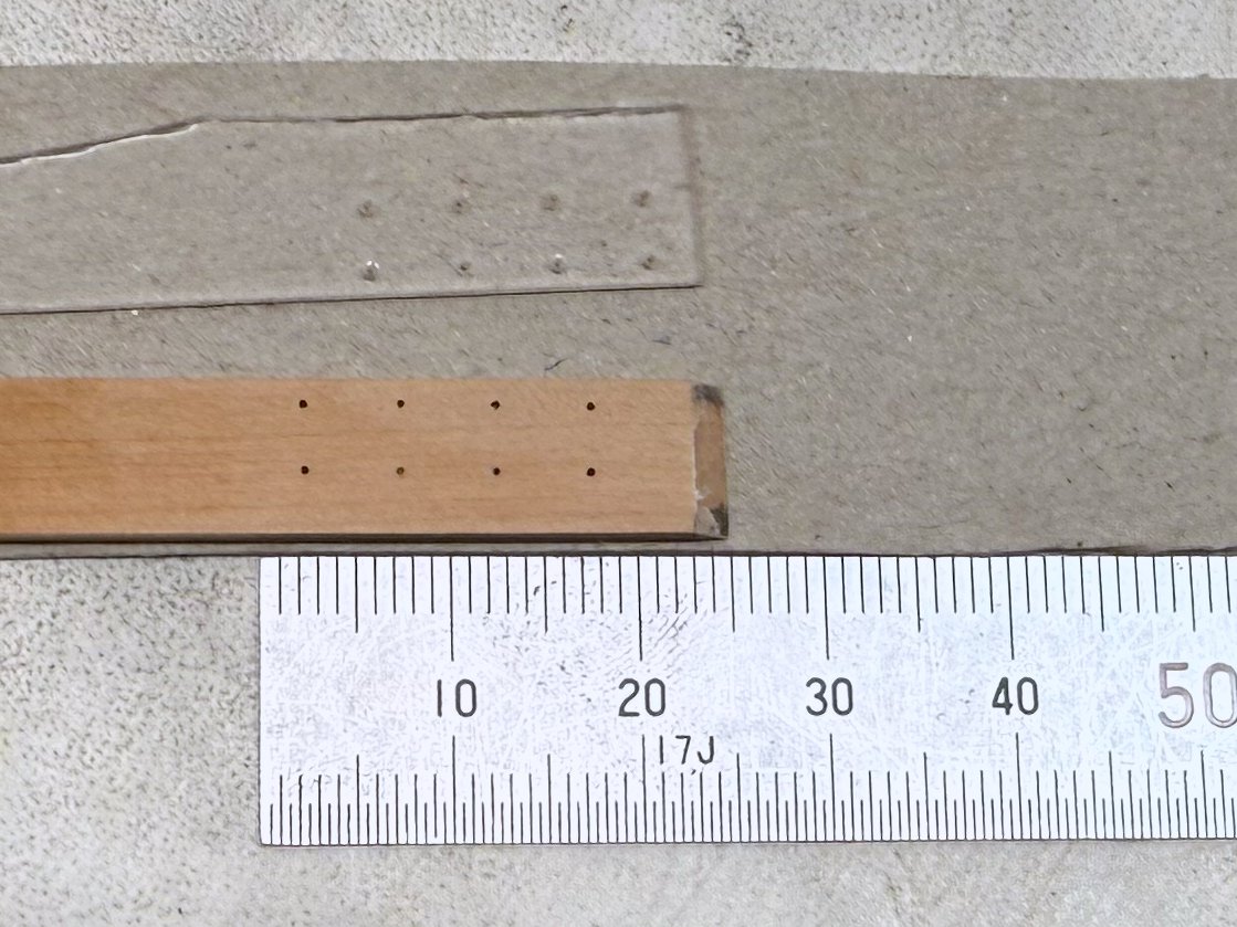

It looks like I've finished the keel.
But I'm still thinking of adding - simulating nails to the keel.
Here is a test with an 0,5 mm drill bit.
I don't see them much on the contemporary models but I have done them on Winnie and probably will do them now.
What do you think? Should I do it?

Thanks for the comments and likes guys.
Today, after much thinking about whether to do it or not,
I drilled and fitted the nails into the keel.

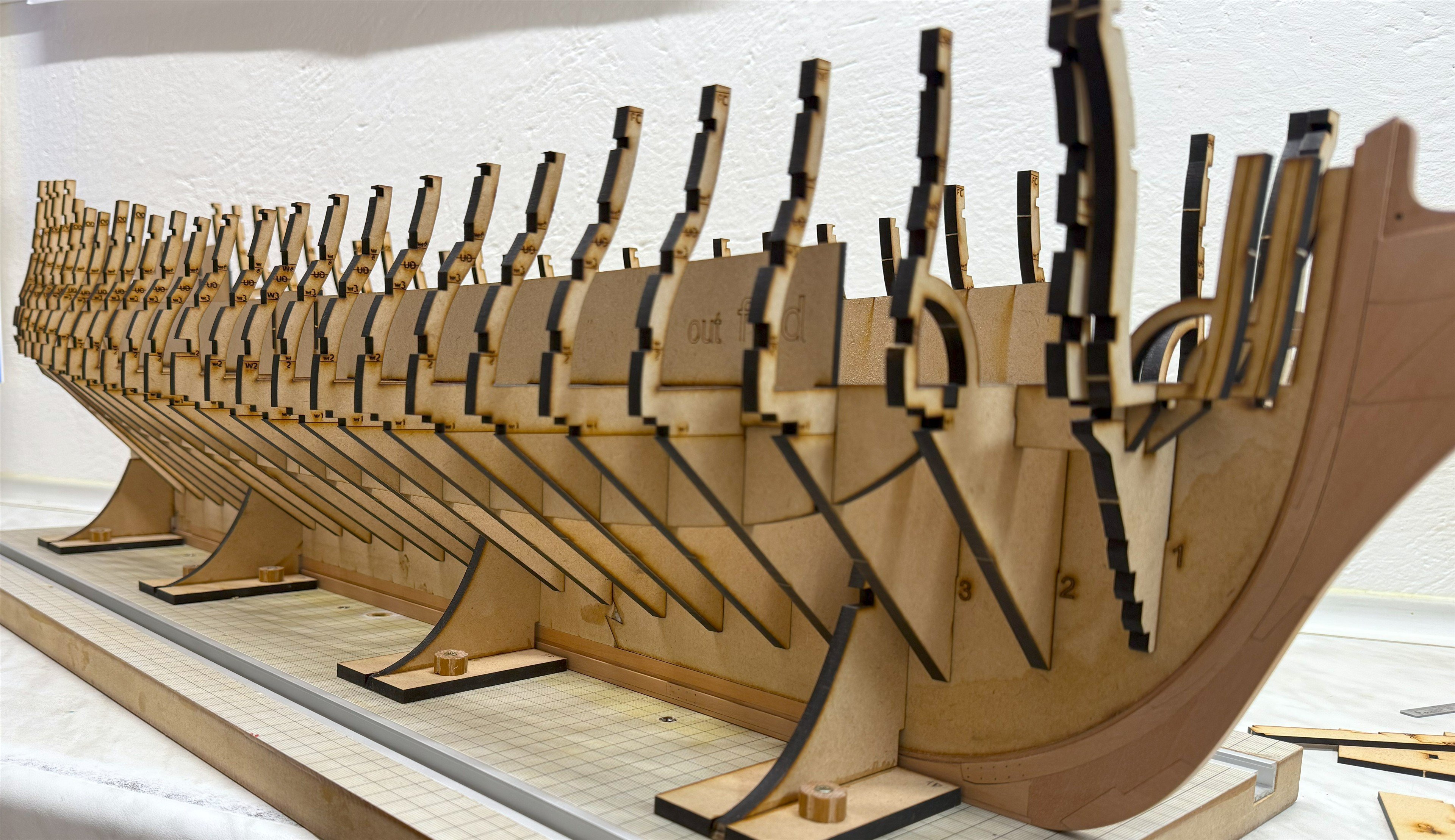

Thank you, JJ.
Today, just a small sample.

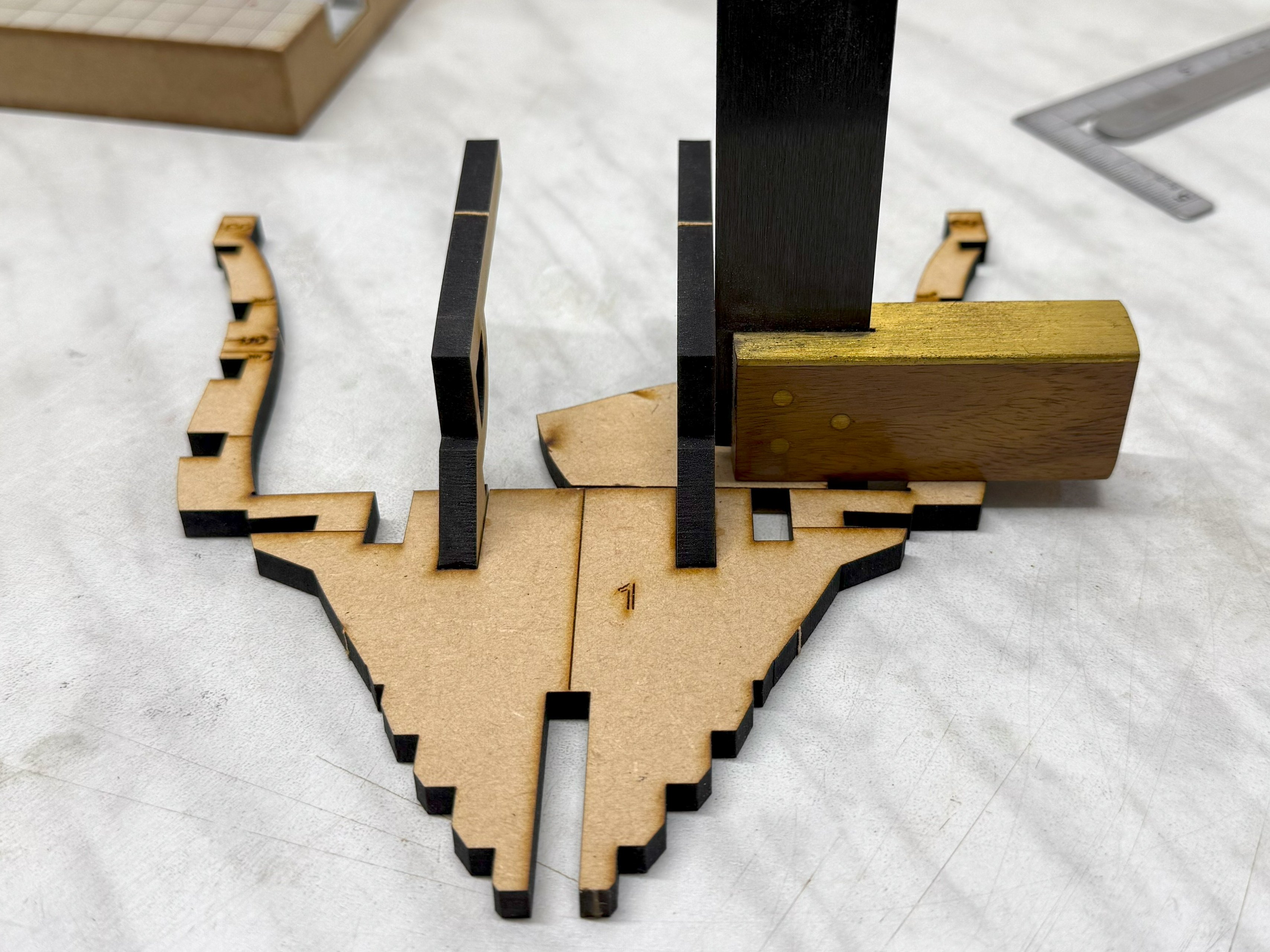

I installed the inner bow frames on bulkhead one.
I haven't started gluing the other bulkheads yet.
I dry-tested some of the other parts to check their fit and symmetry...

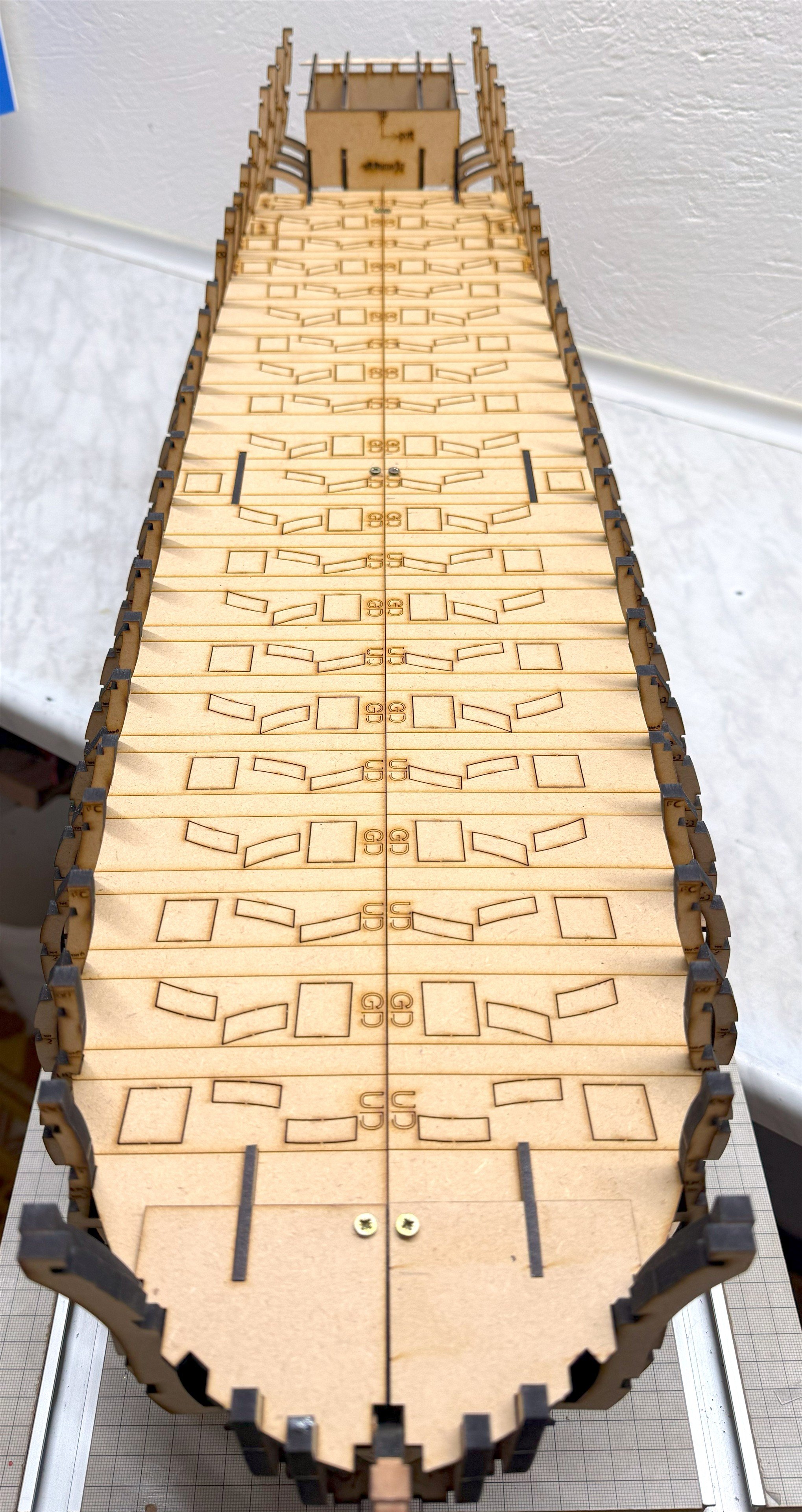

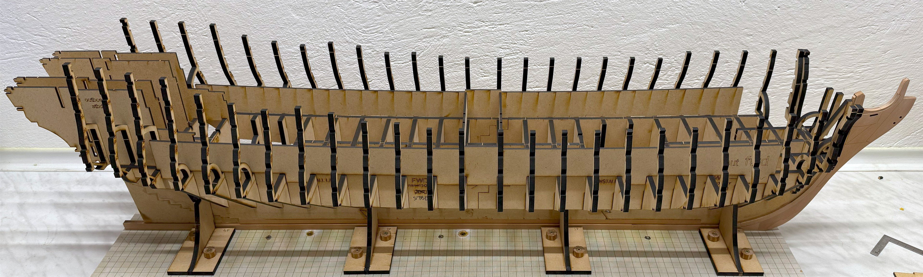

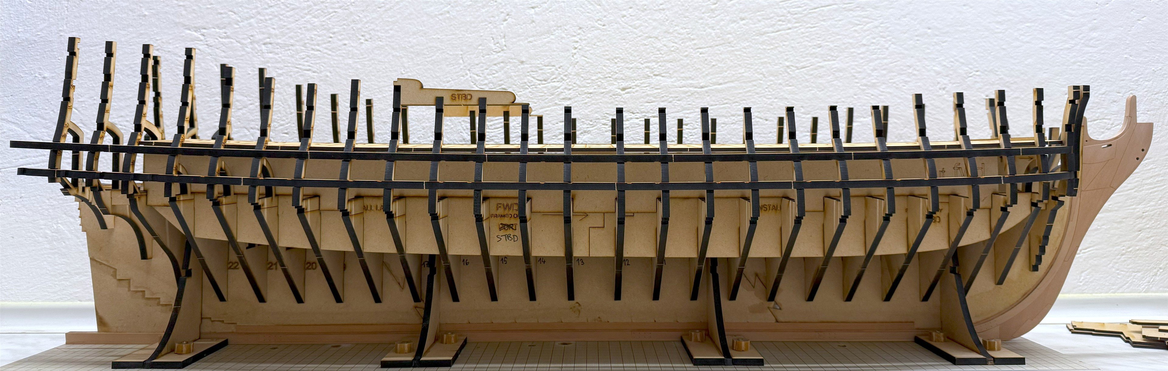

Hi guys,
so again a little update.
After checking if everything fits together I glued all the bulkheads permanently.
Also all the support jigs are done,
so I'm starting to install the frame brackets...

Thank you, JJ.
Yes, it looks good, and I'm happy with it.
However, I made some minor alignment errors, so hopefully that won't be a problem later.
Today, I just worked on the lower frame brackets.
And I started on the upper ones.
Hopefully, I'll be able to paint the internal structure over the week.

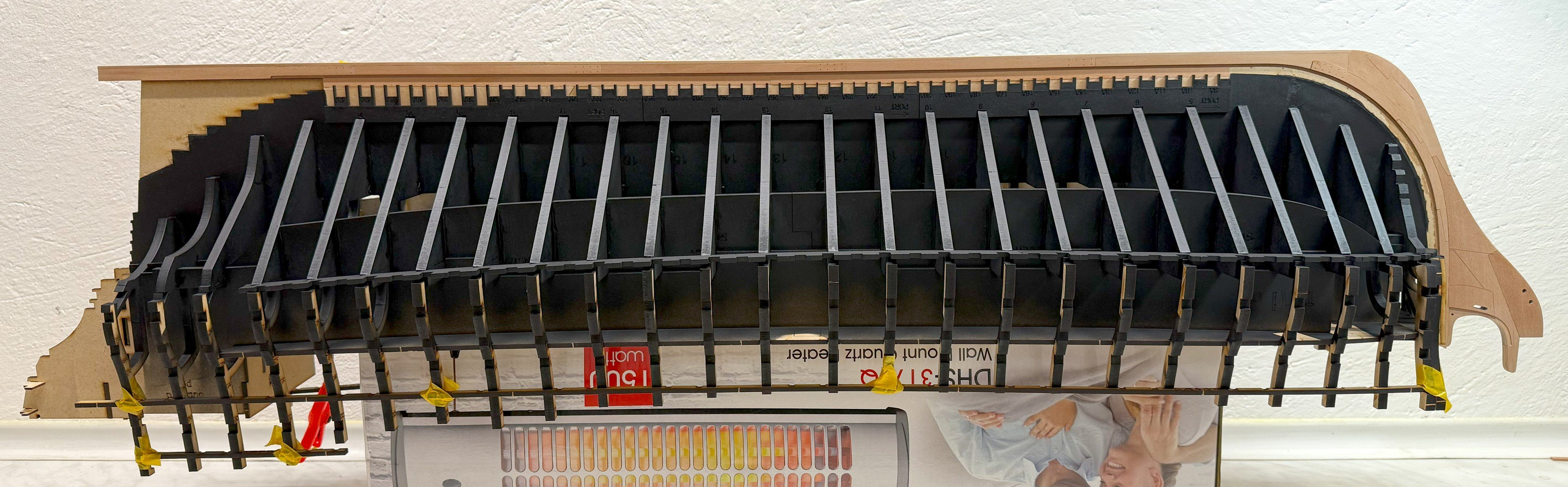

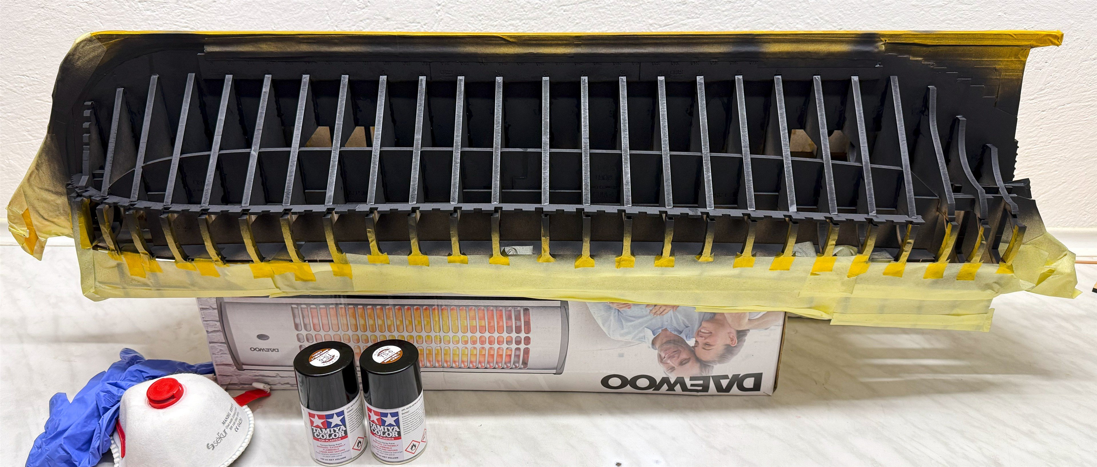

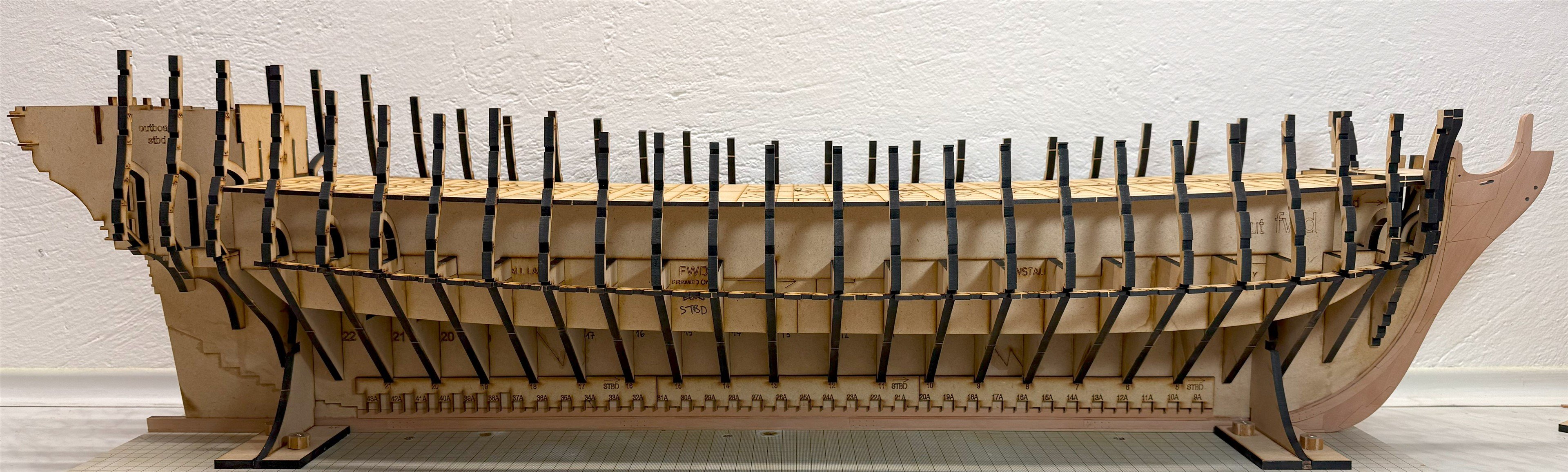

After installing the upper frame brackets,
followed by masking and spraying with black paint.
Unfortunately, I underestimated the amount of paint. I still had to order one more.
Because of its size, I opted for paint spray and sprayed it outside. However, a quarter or more of the paint was blown off by the wind. 🙄
