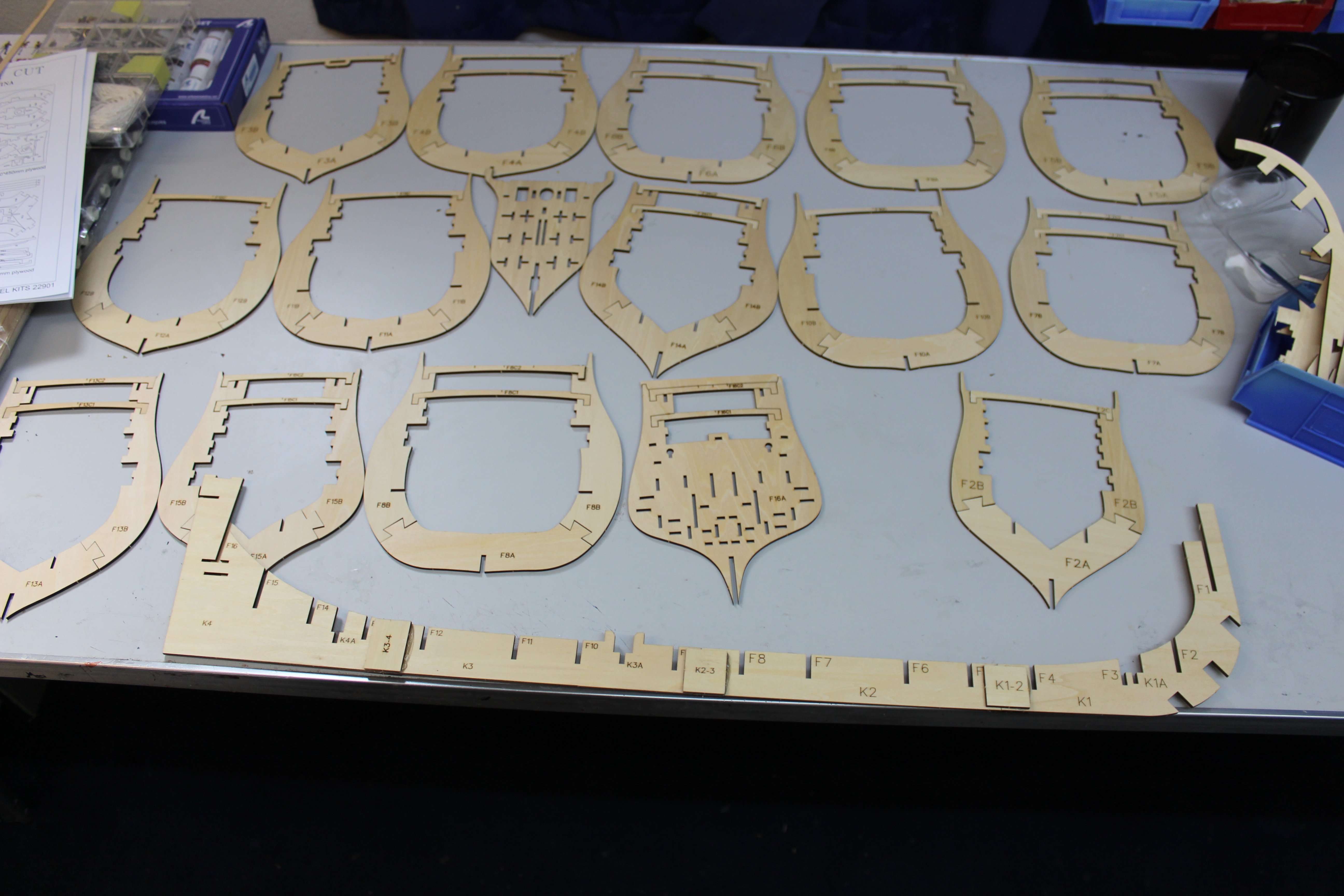

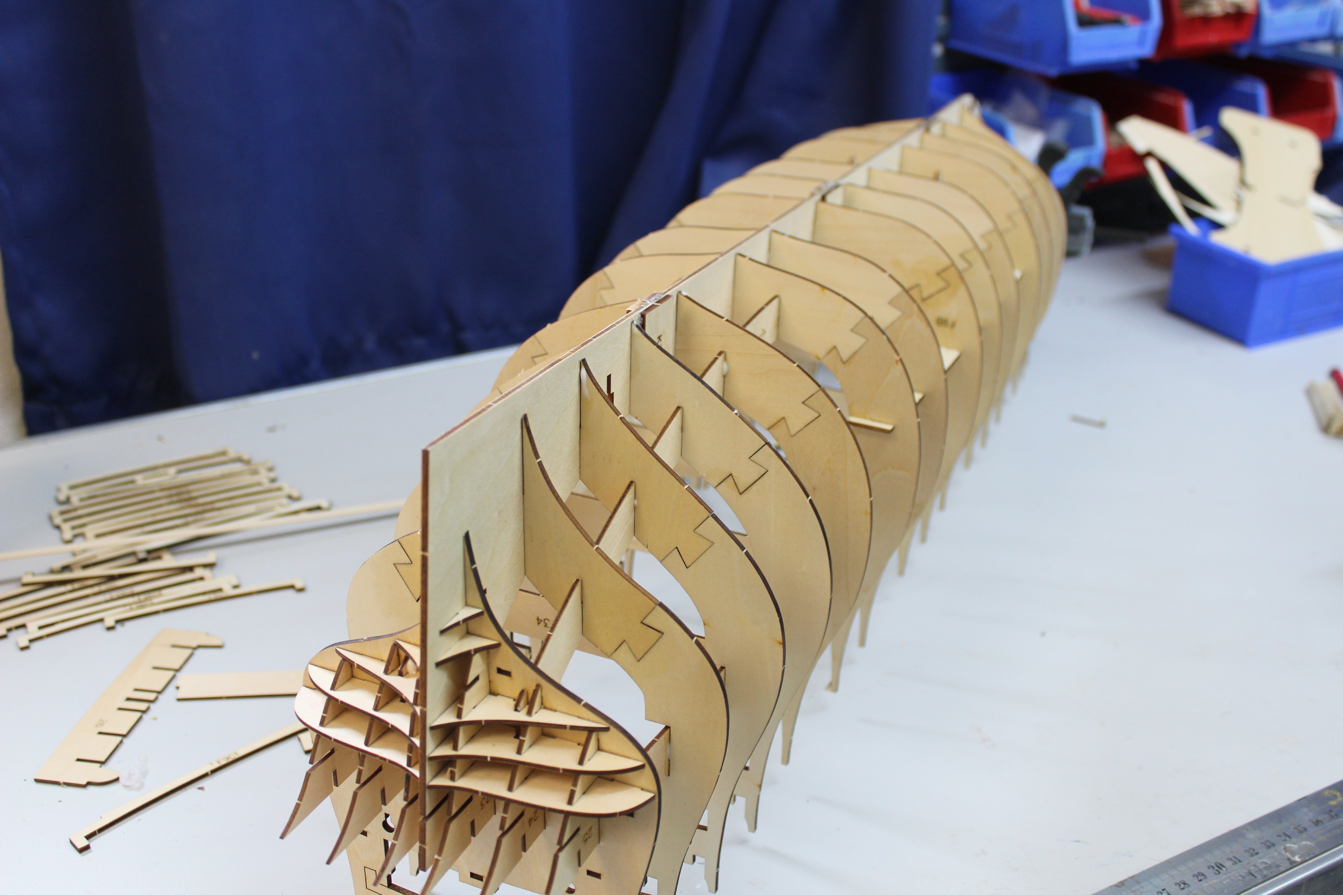

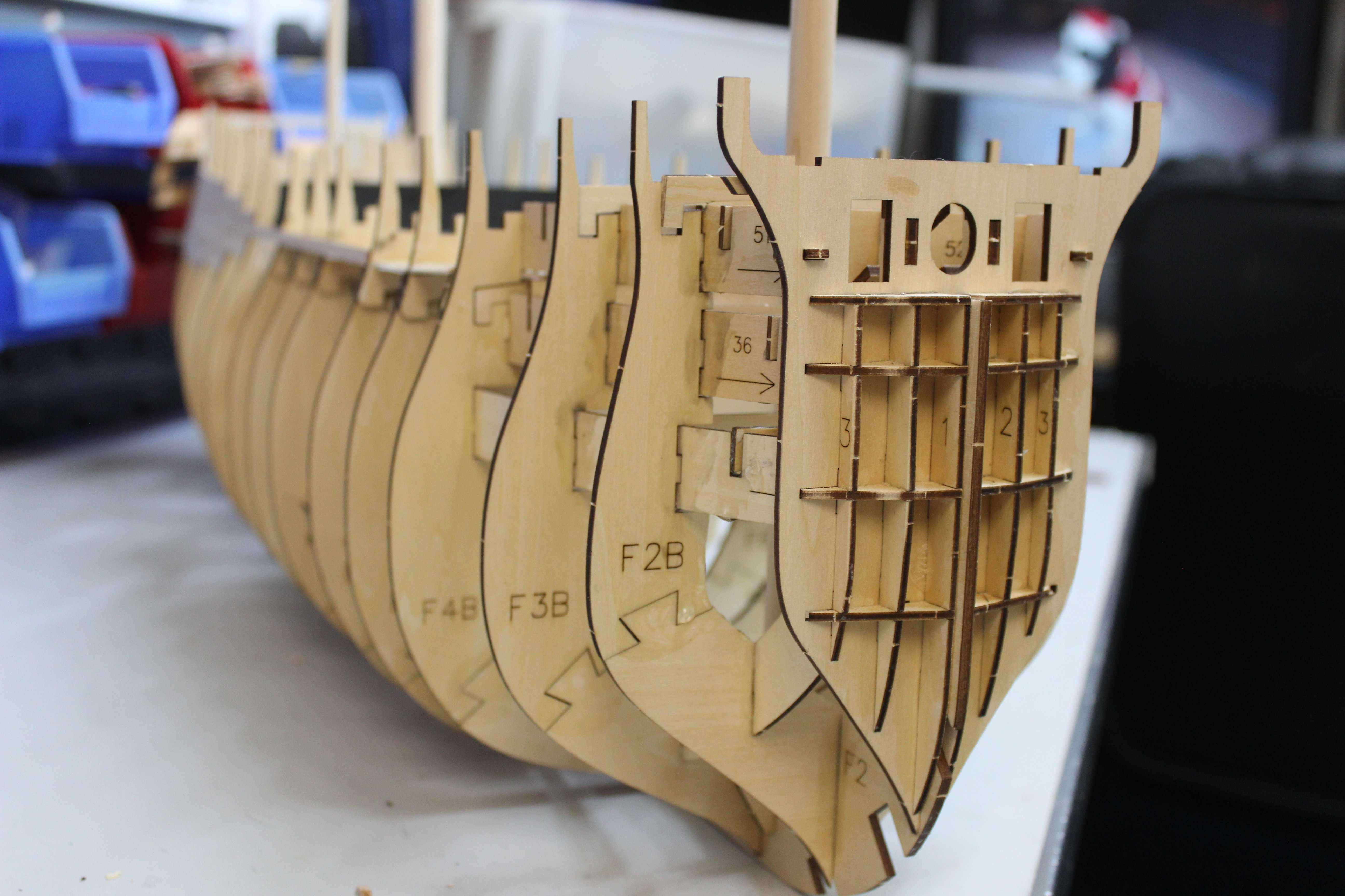

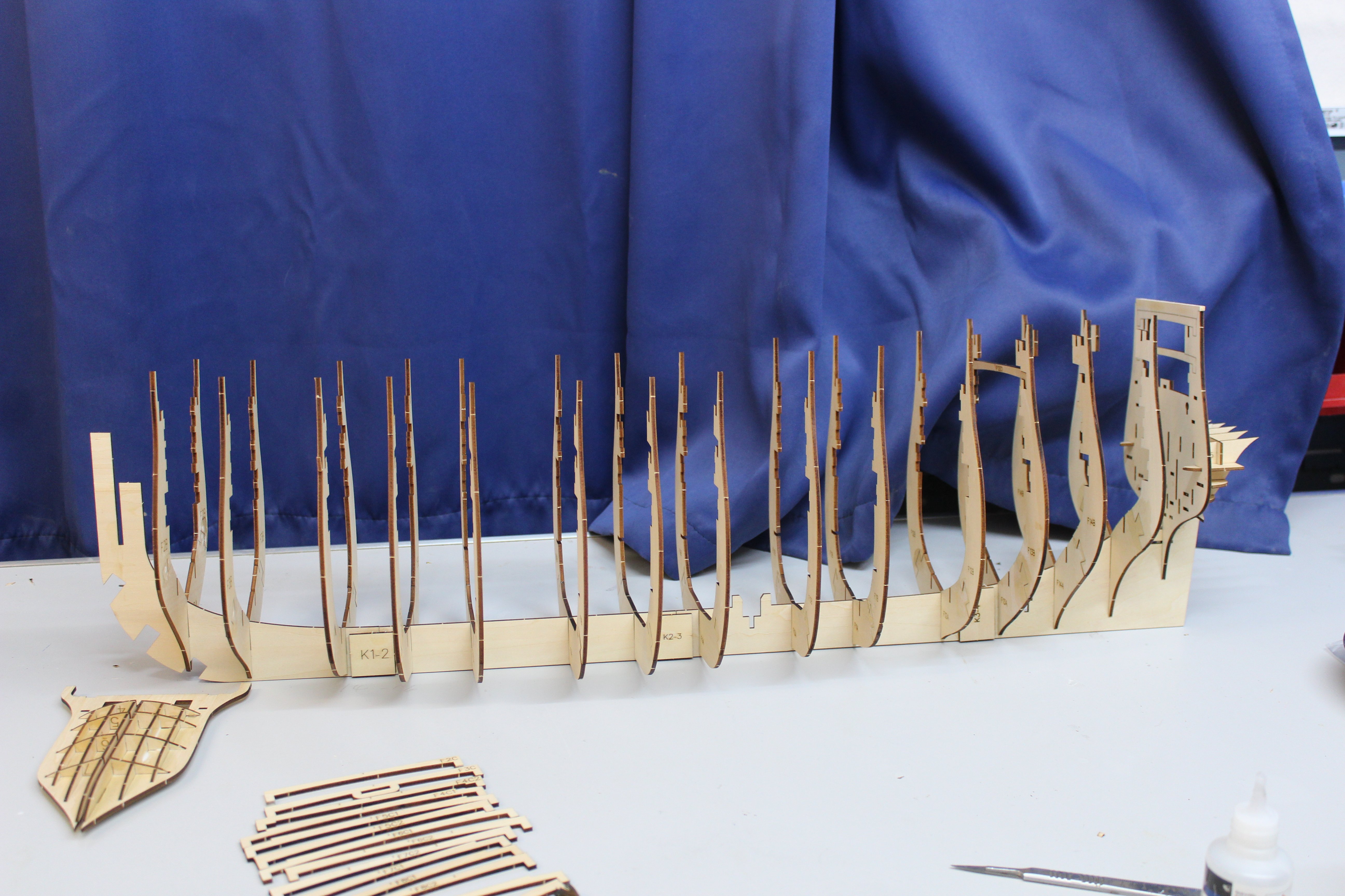

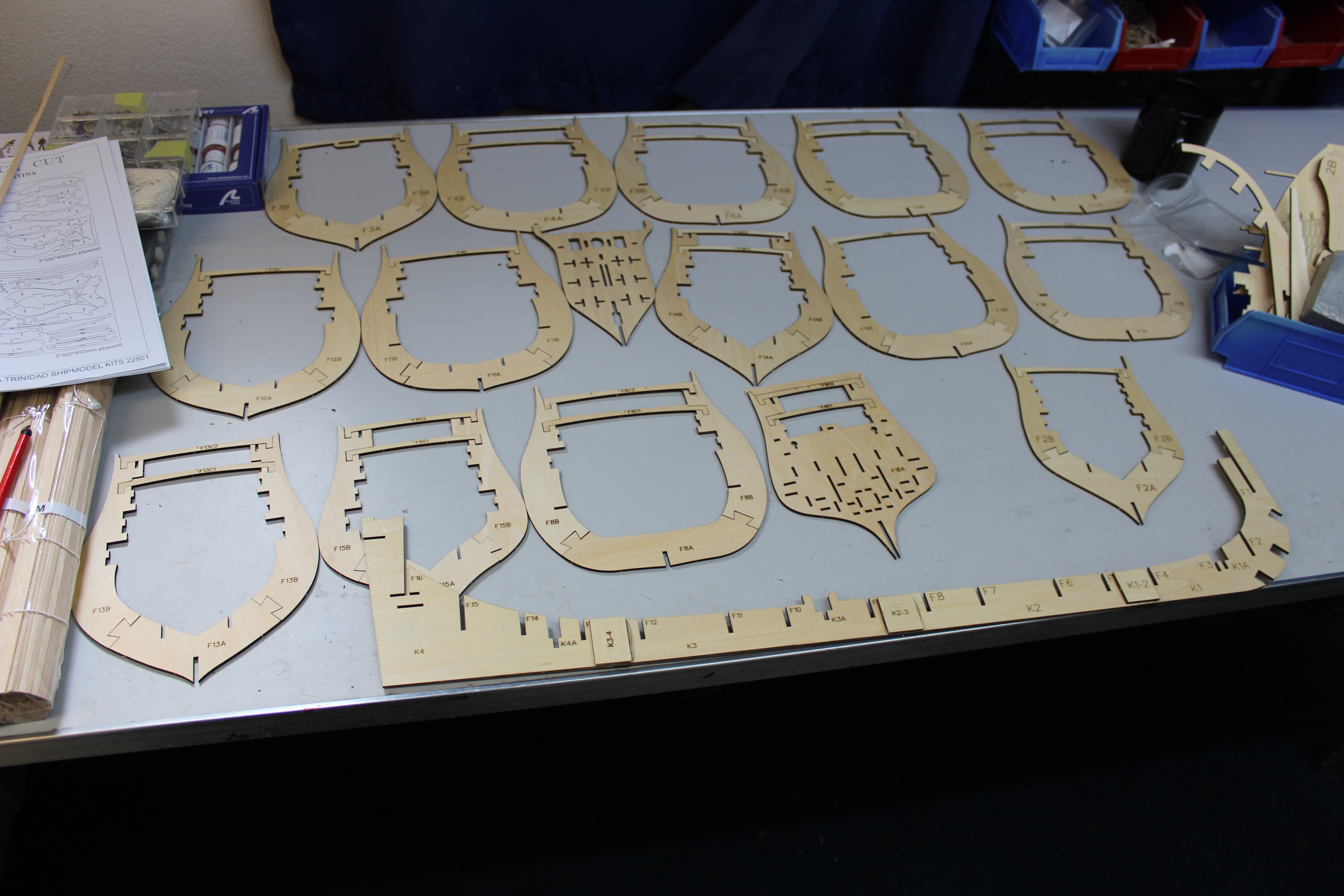

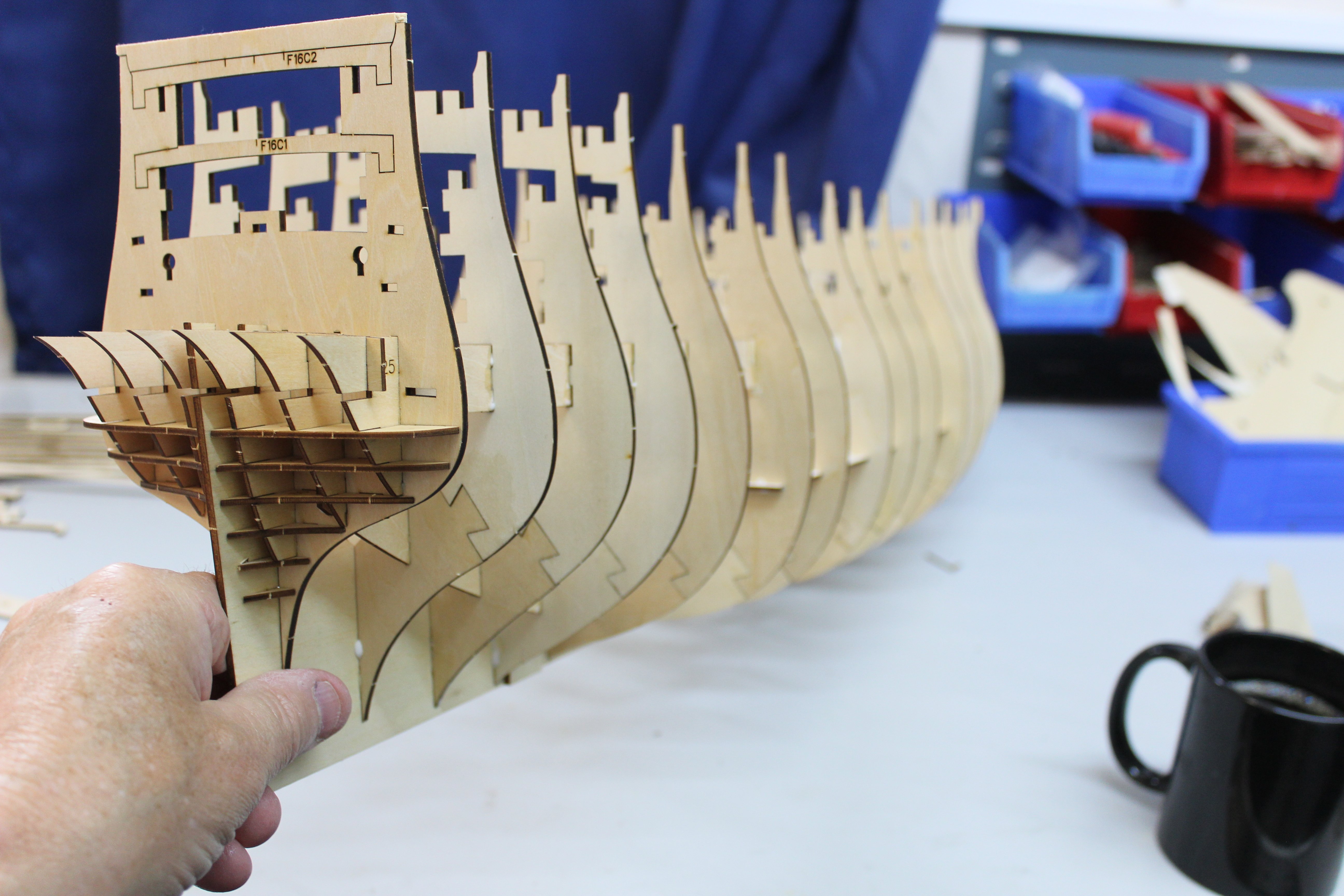

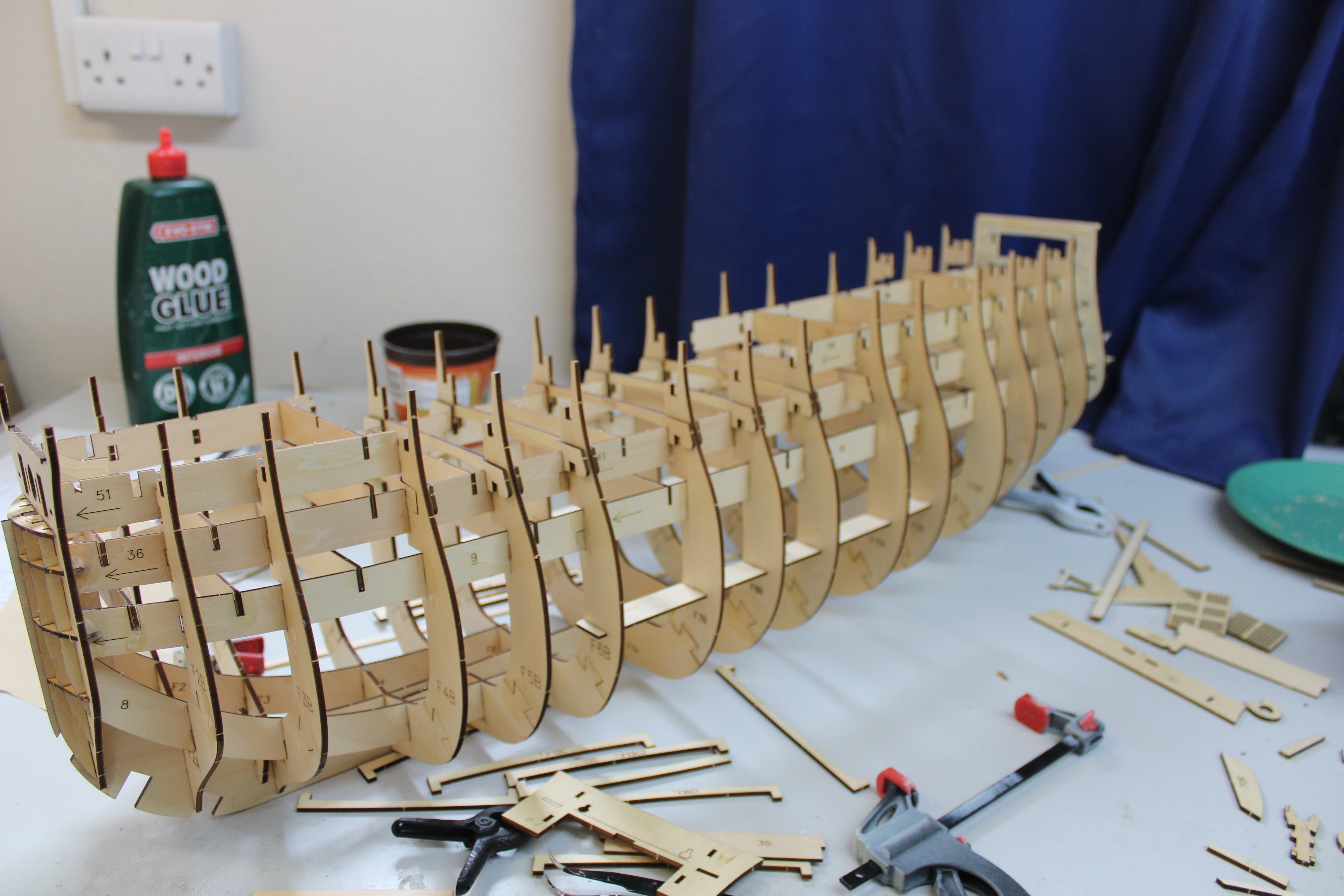

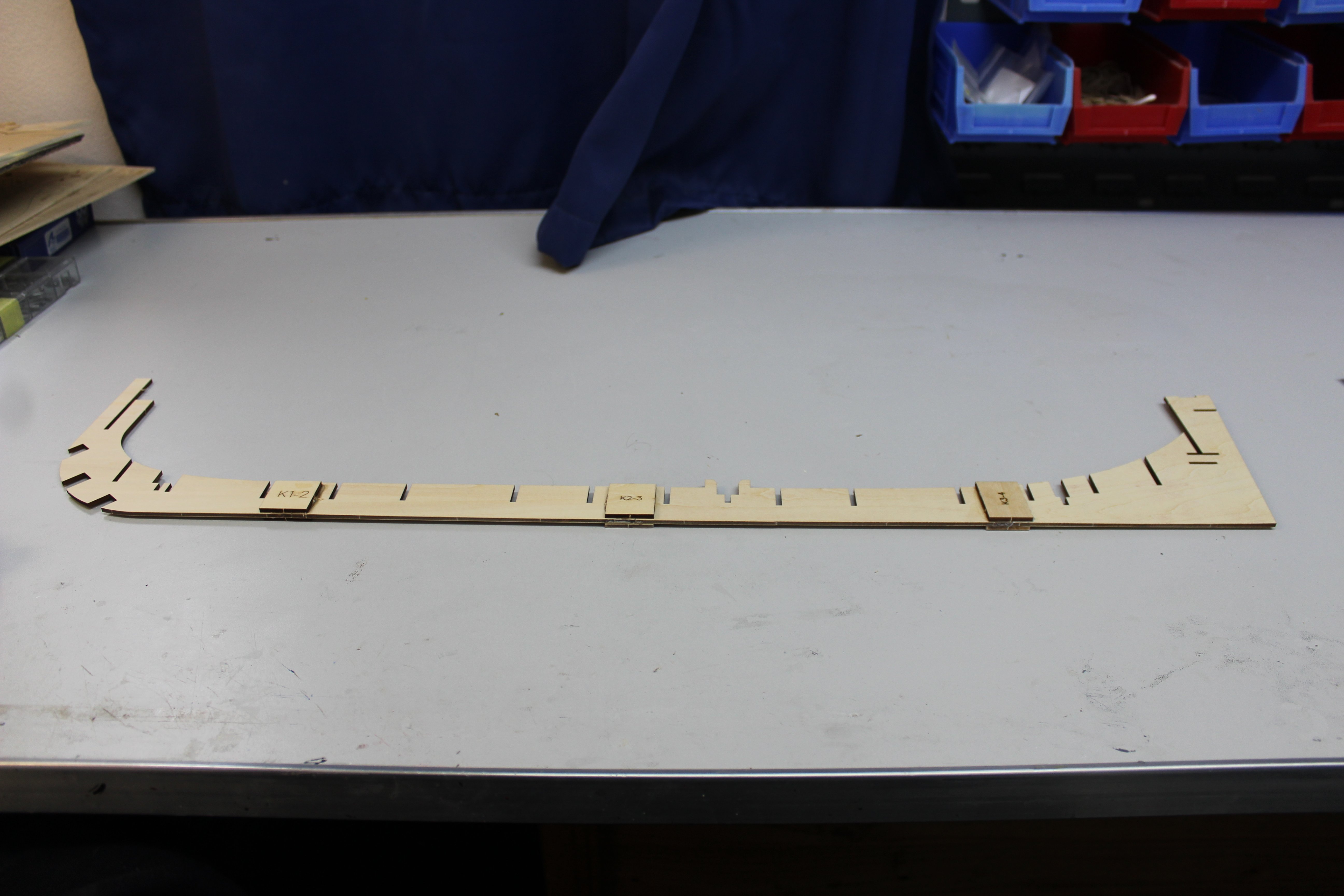

day 1 Frames
No written instructions for this, its all online, but lots of it

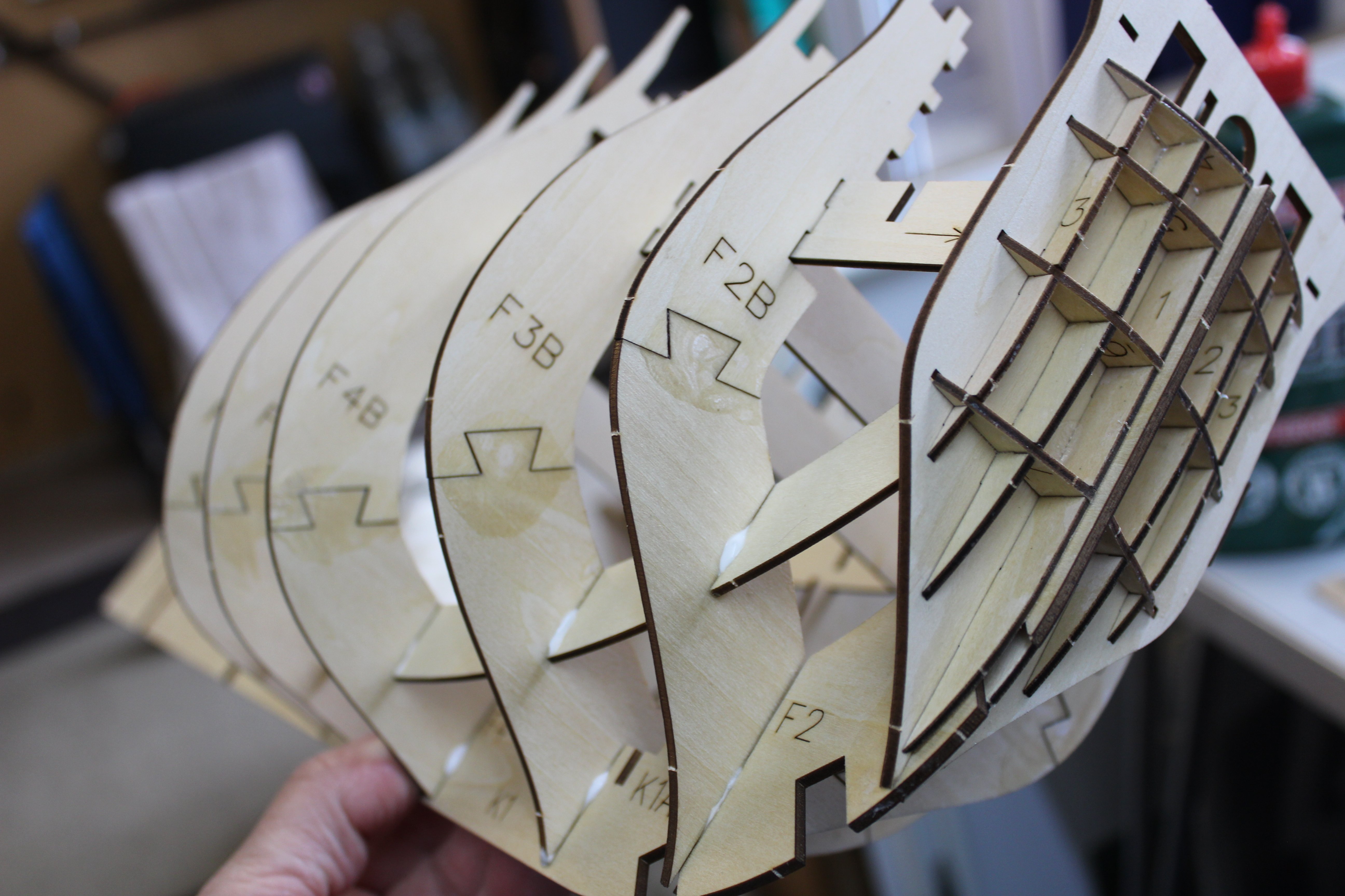

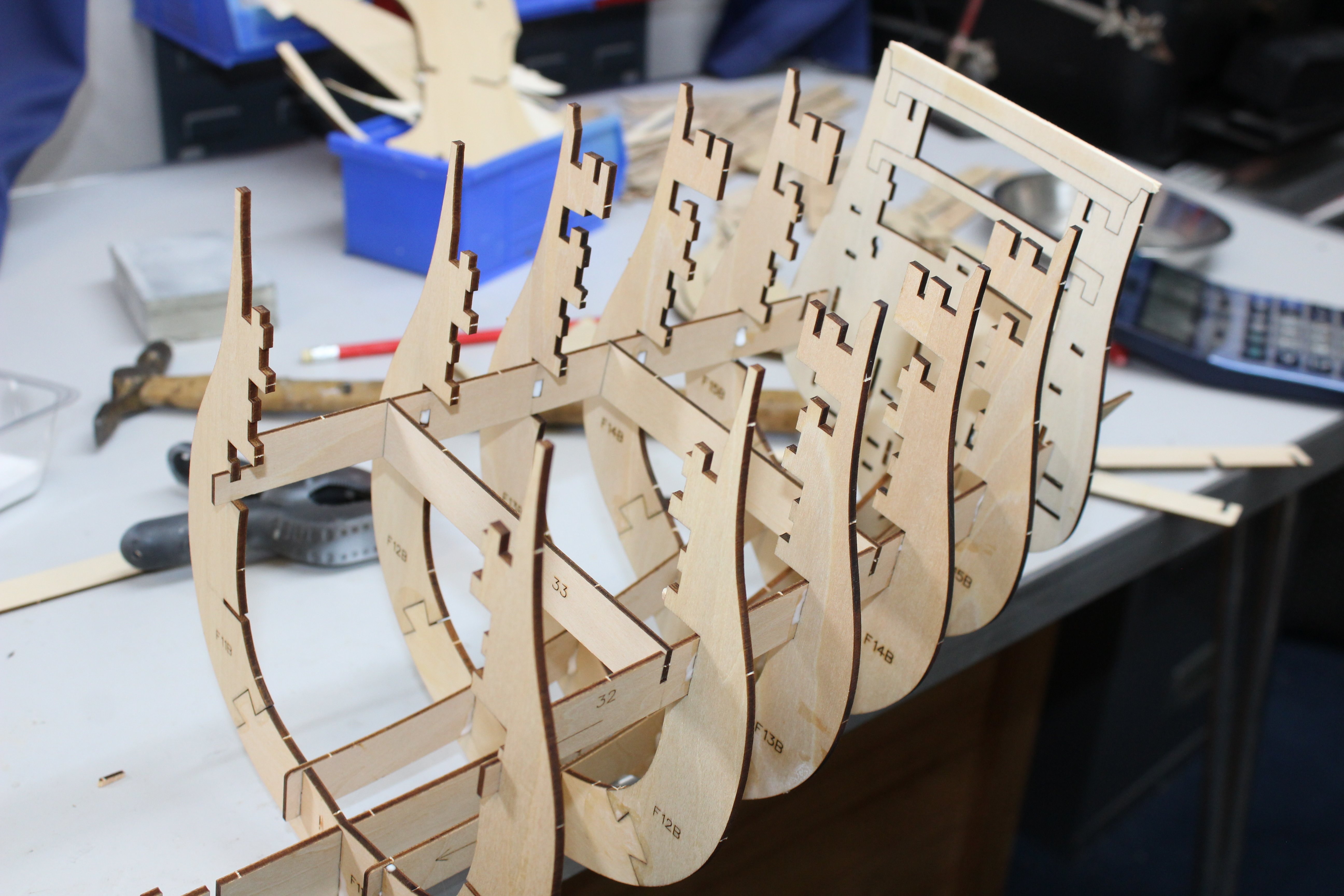

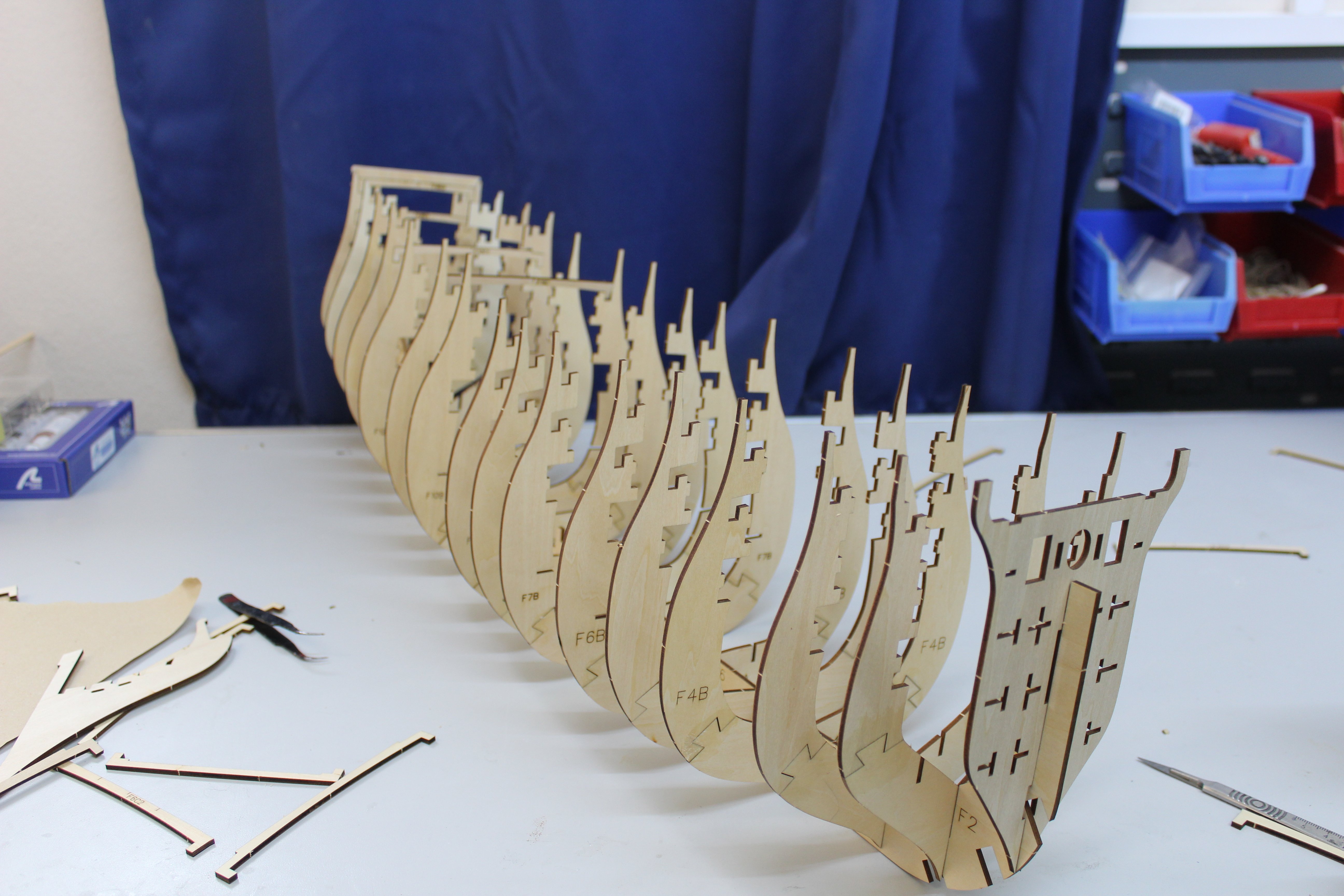

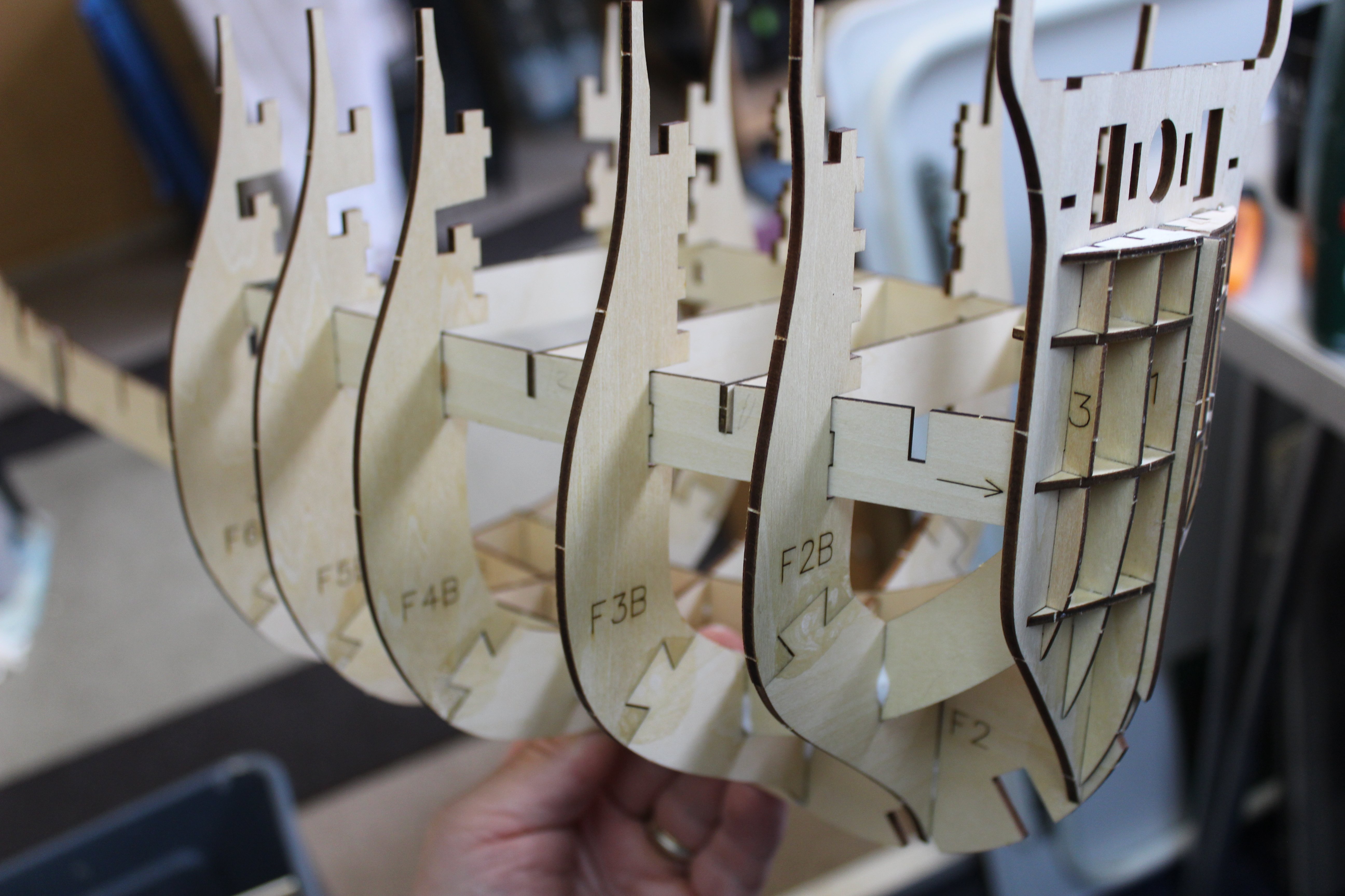

first impressions

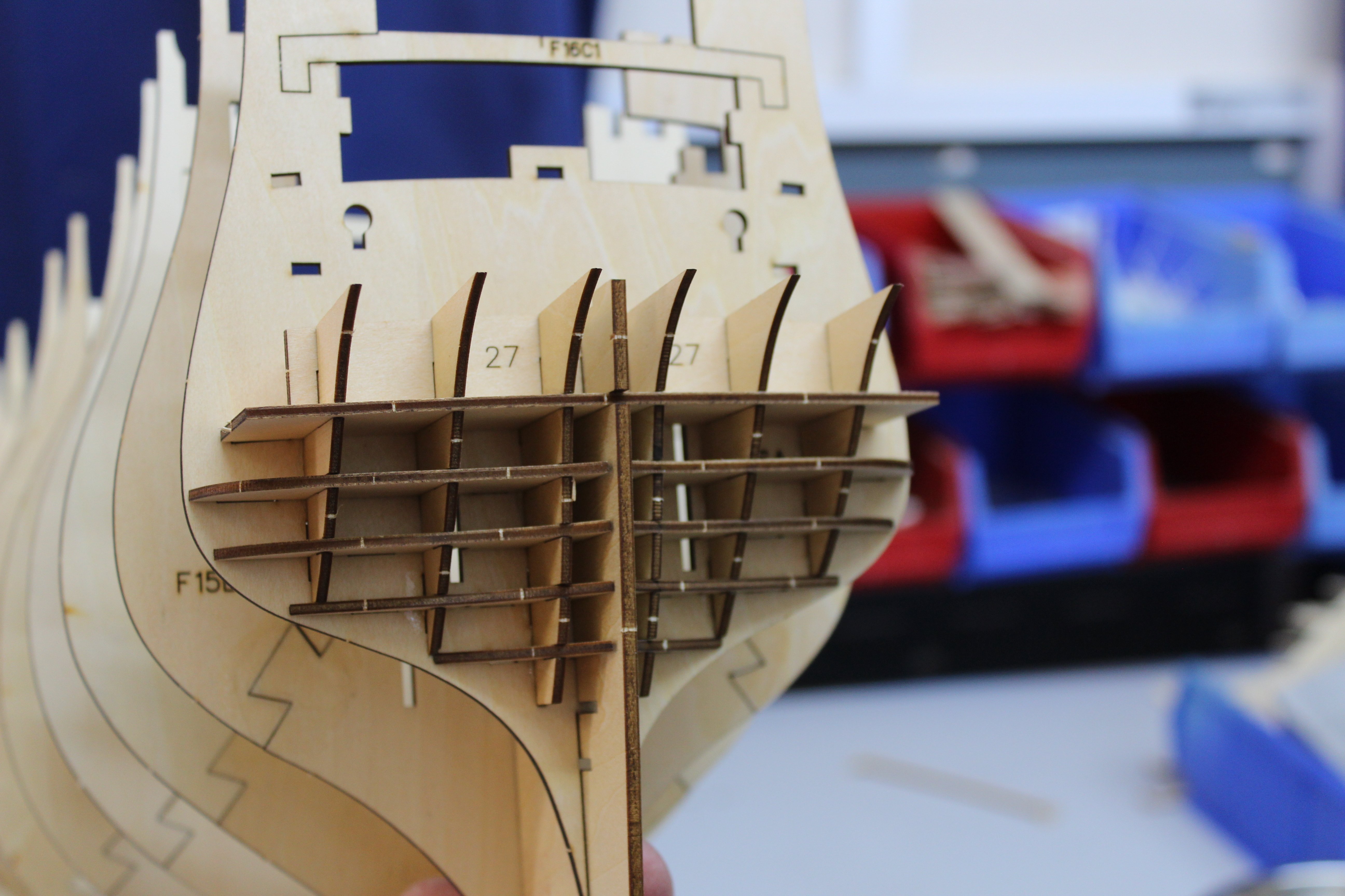

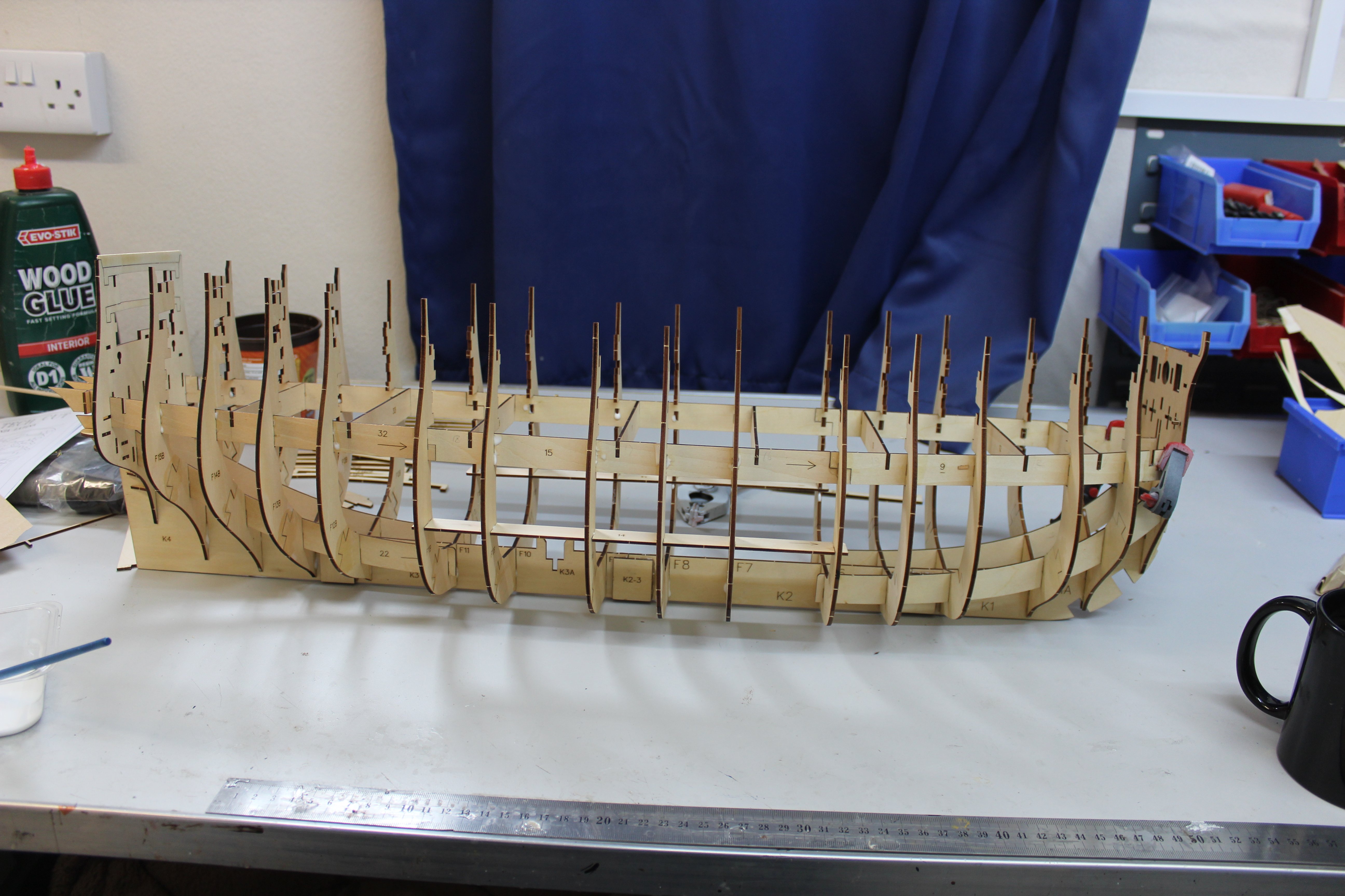

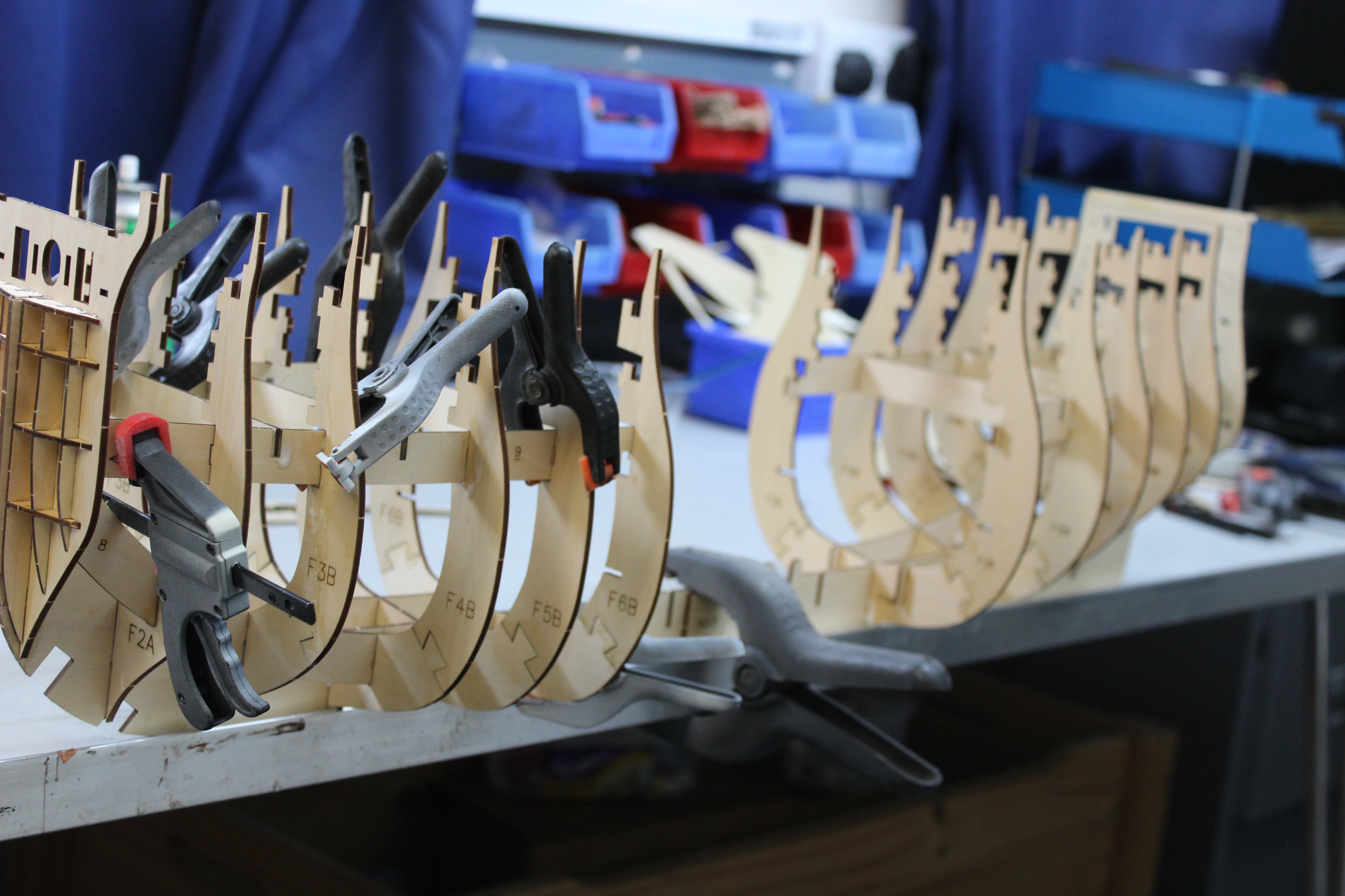

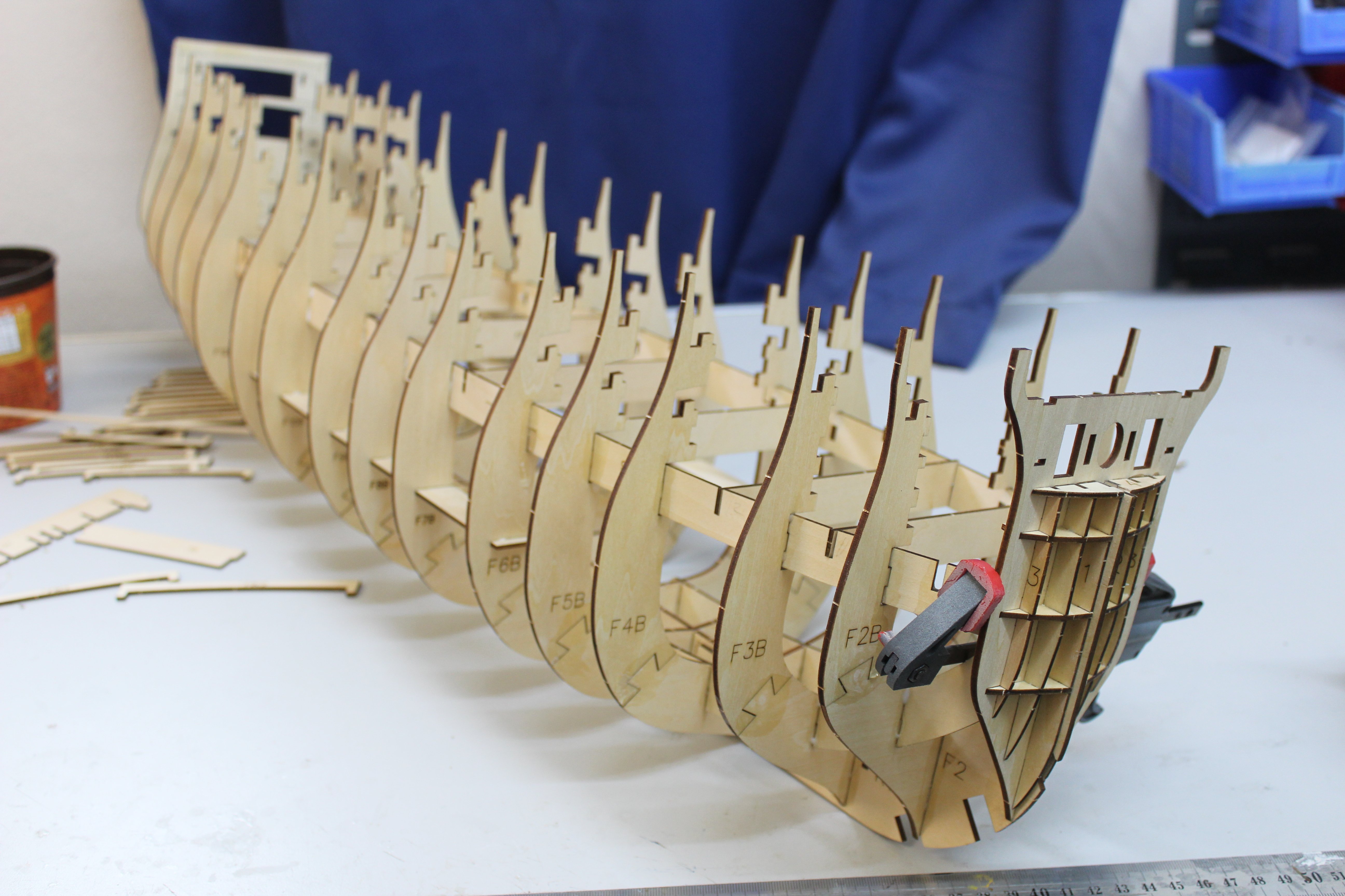

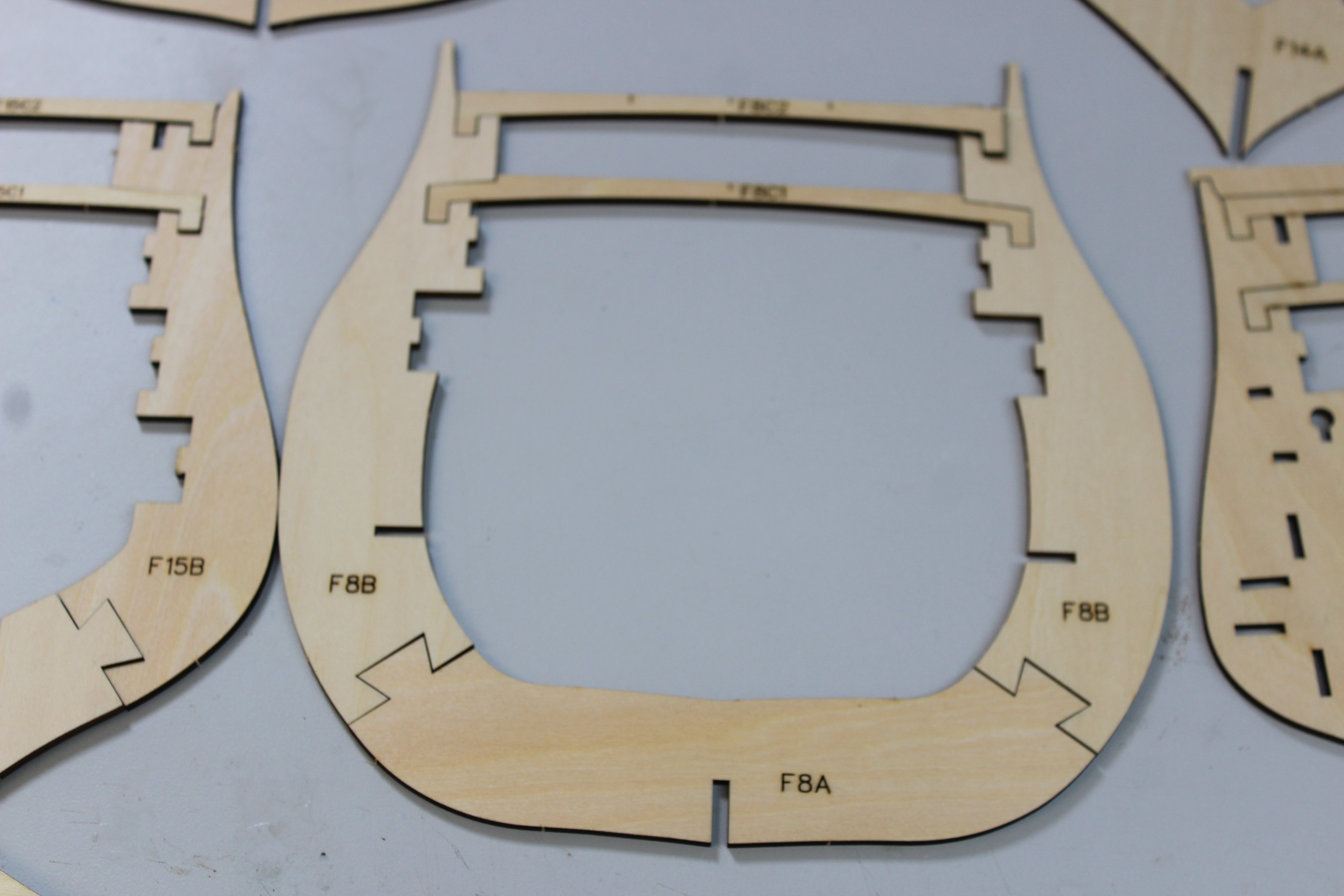

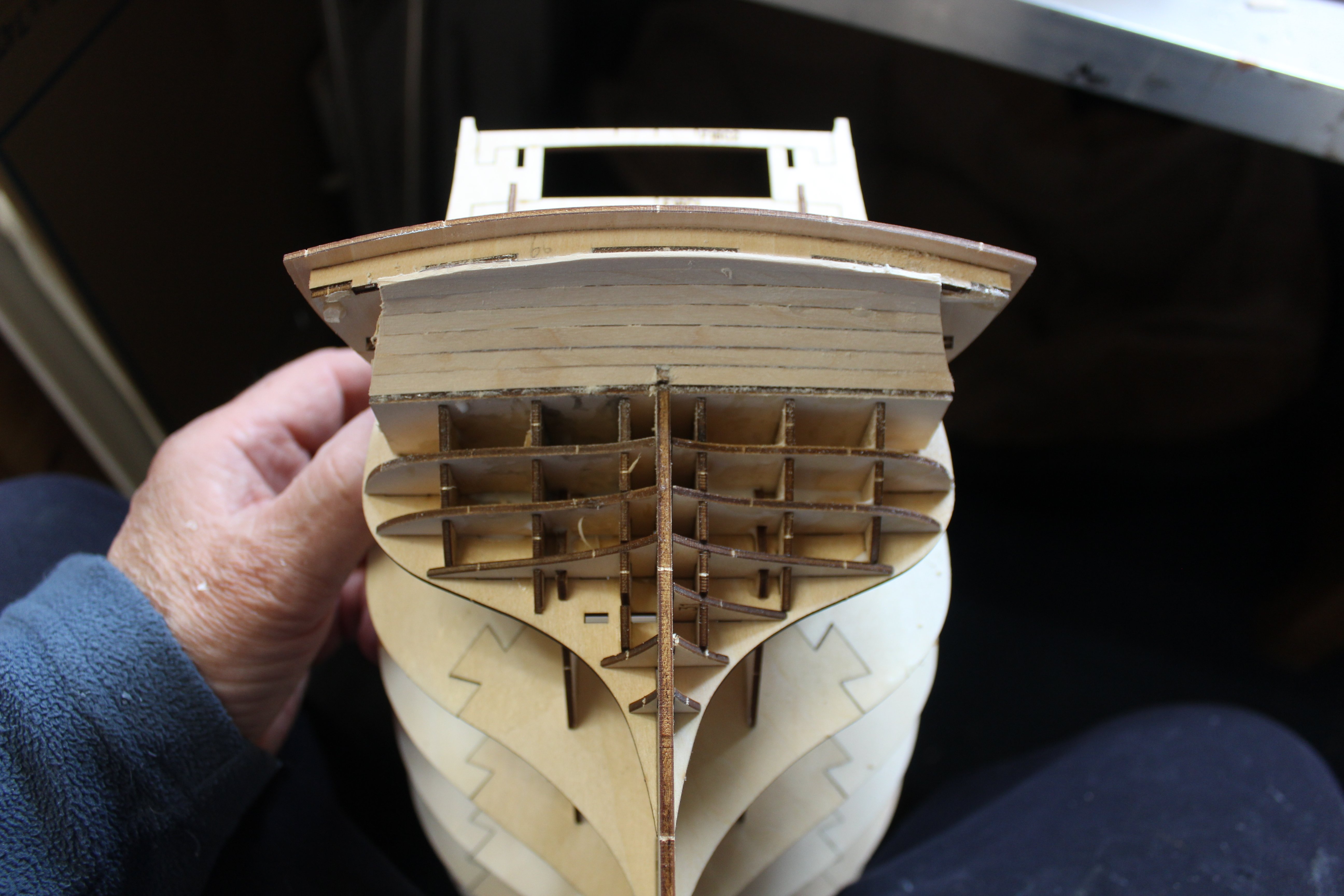

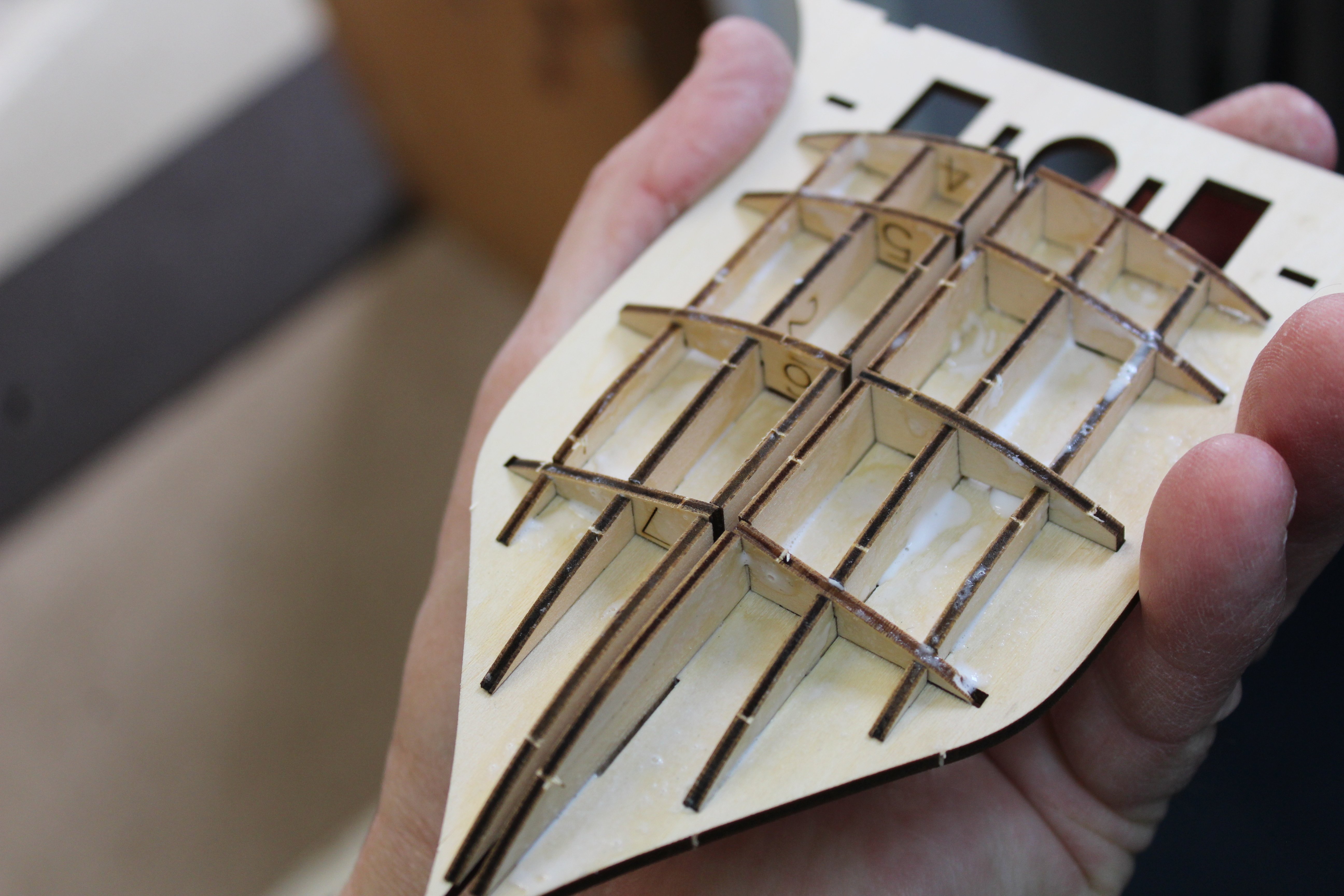

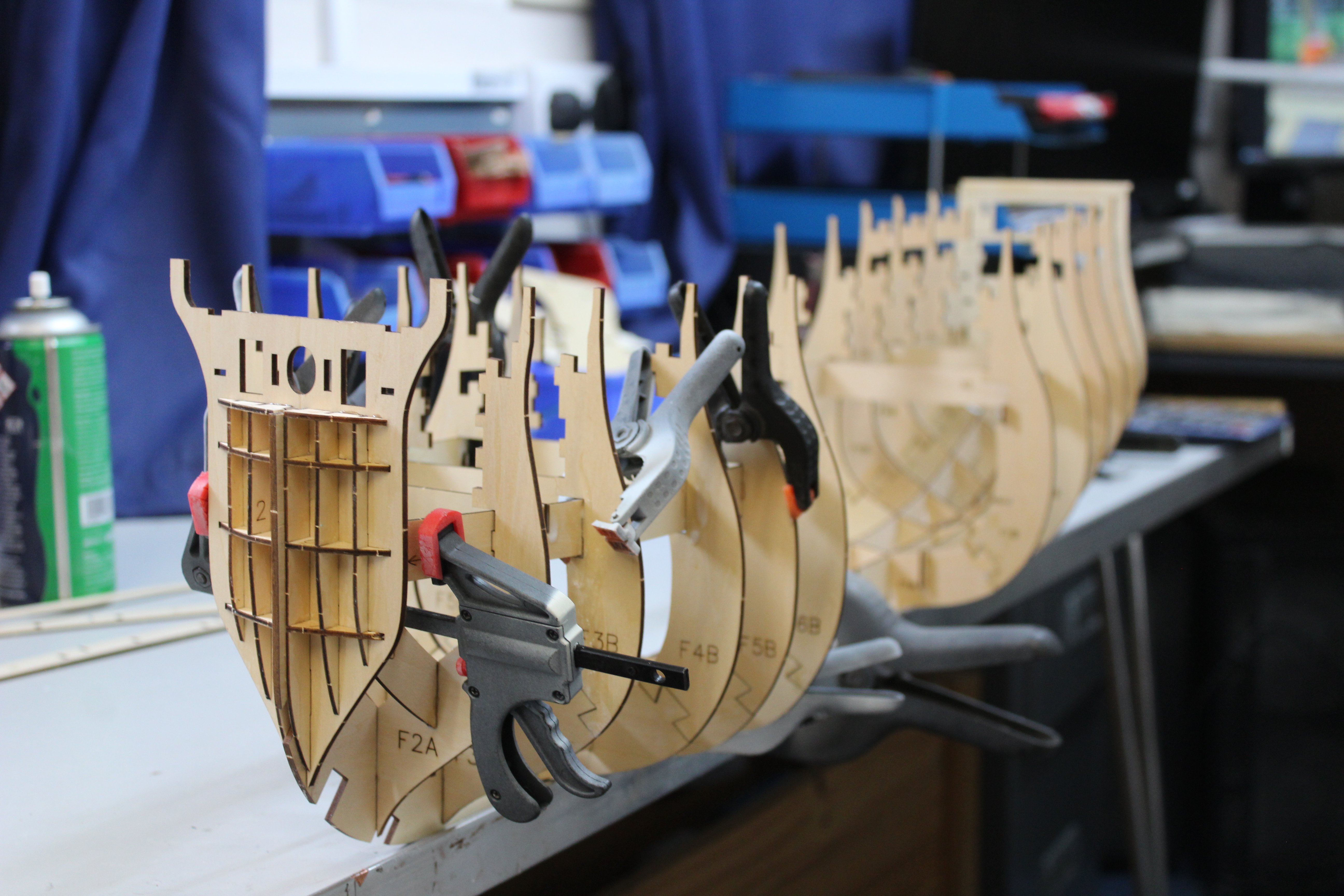

The frames are 2.5mm ply, and quite good quality, the laser cuts are clean, and the pieces can be pushed out quite easily, but on test fitting, all the joints are quite sloppy, and care is needed to ensure, each frame is kept as tight as possible, they are  made up of at least 4 pieces, some are five
Centre line why have one piece when you can have four. i quess it saves warping, but its a bit daft, considering as above all the joints are quite sloppy, side plates are added to add strength to the join

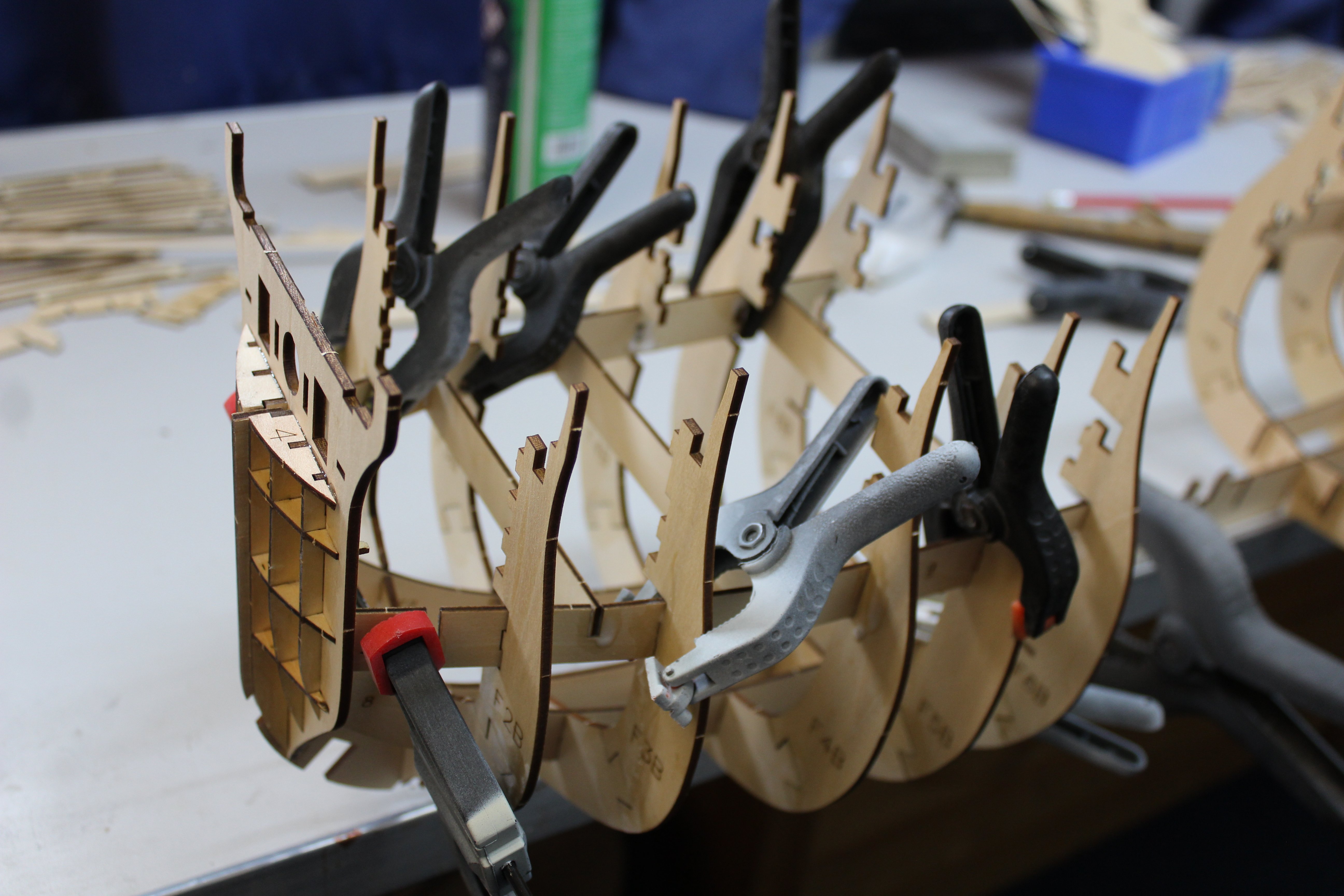

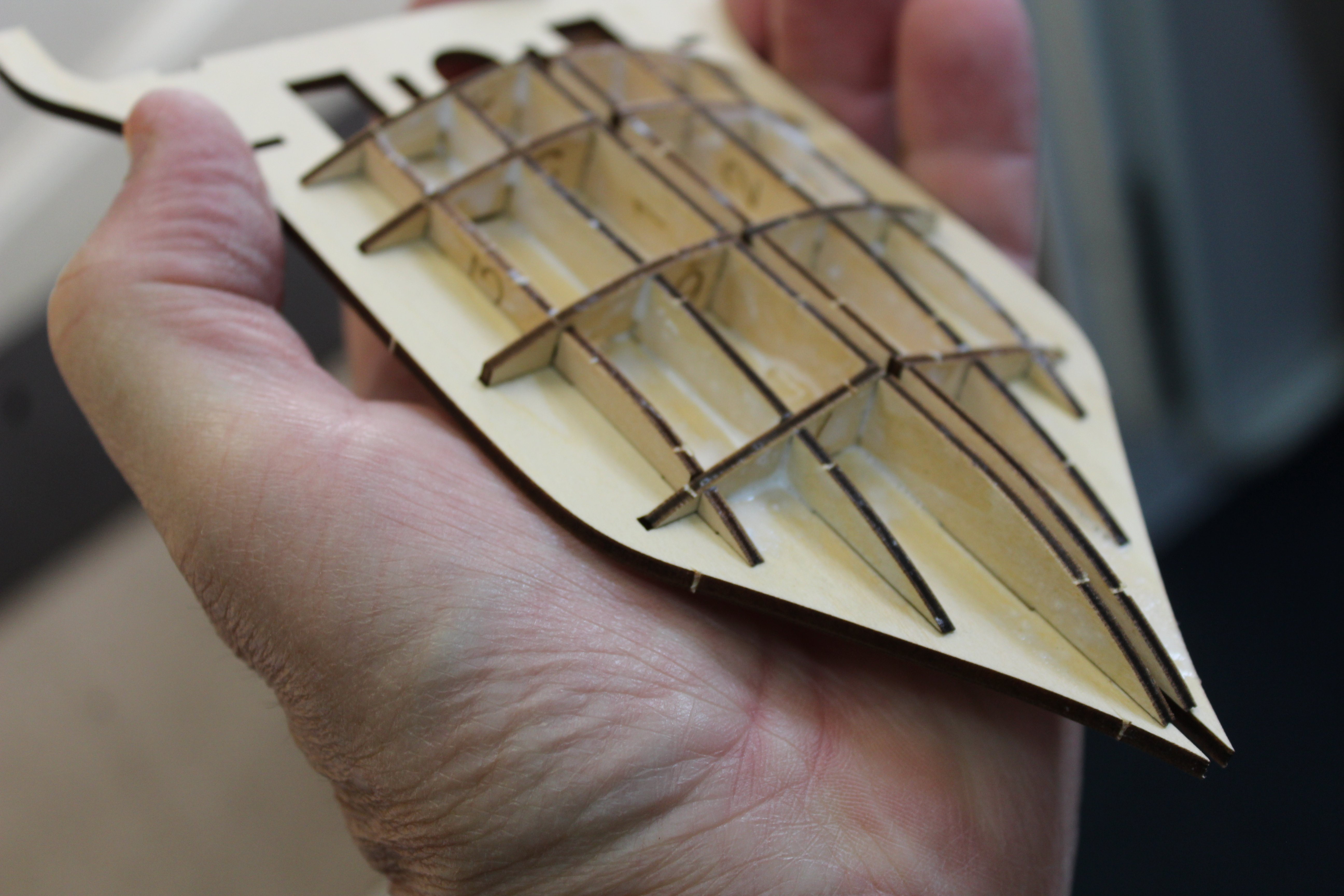

bow and stern sections have been made up as well, again, well glued, because as soon as they are raised vertical to the centre line the bits fall off

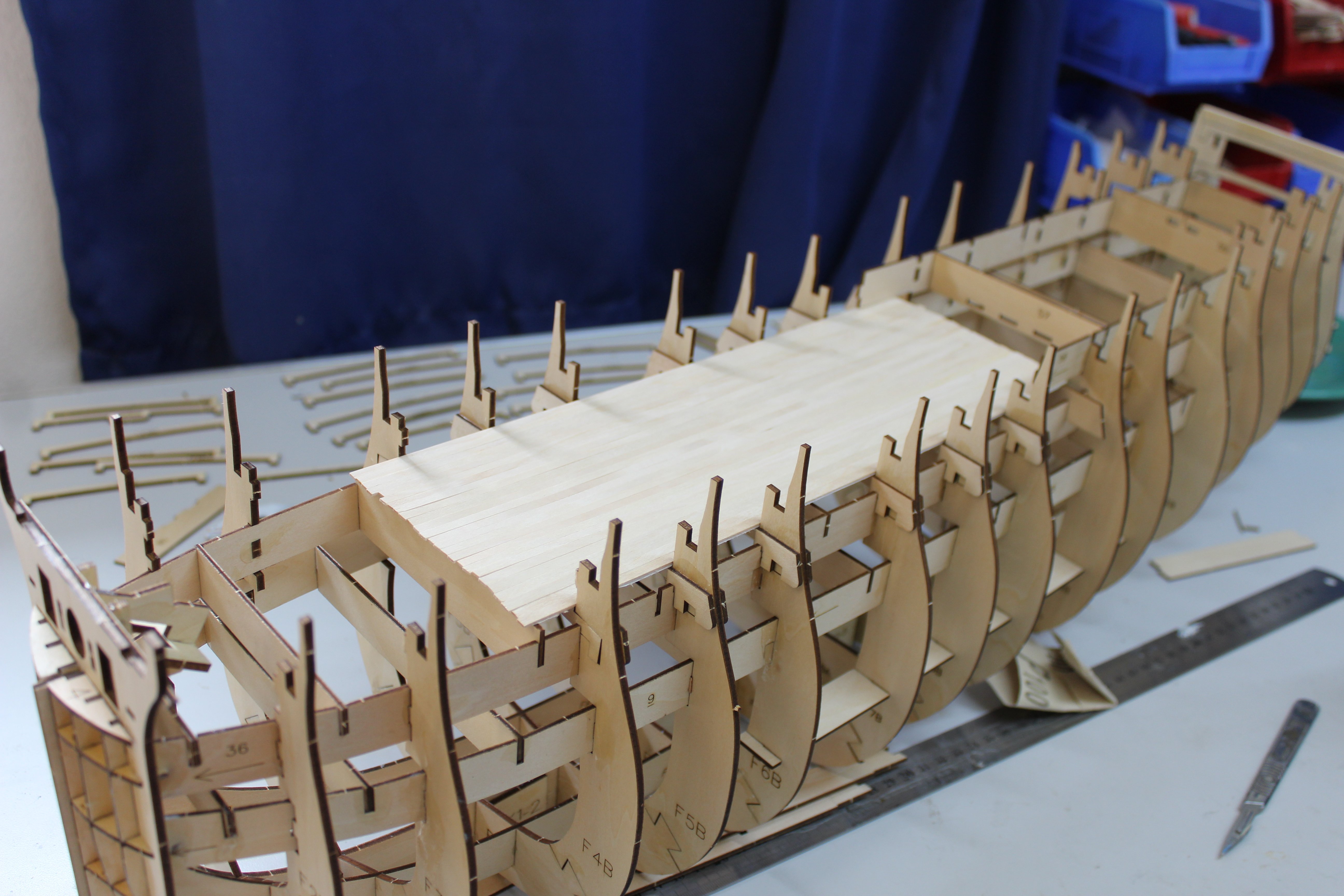

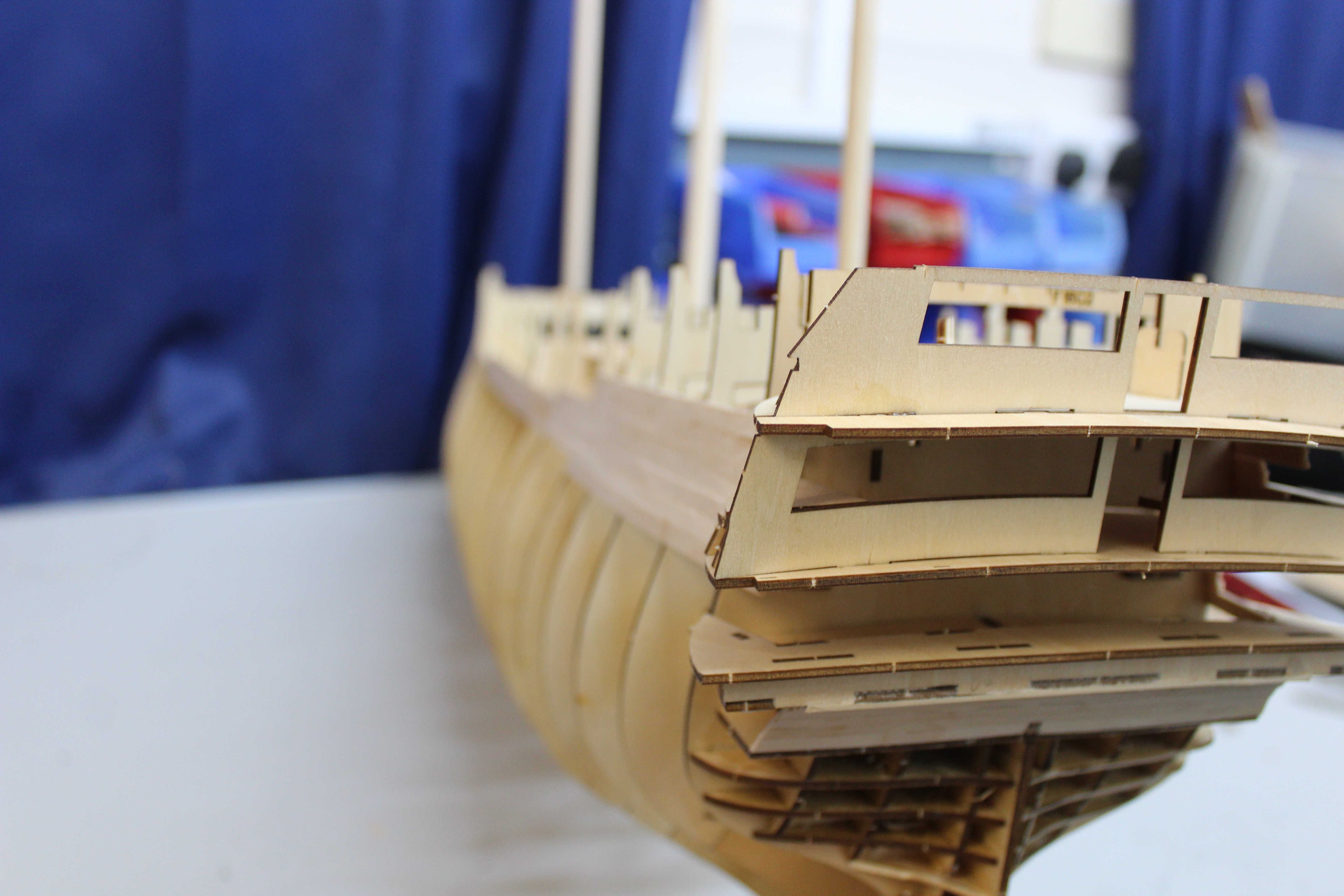

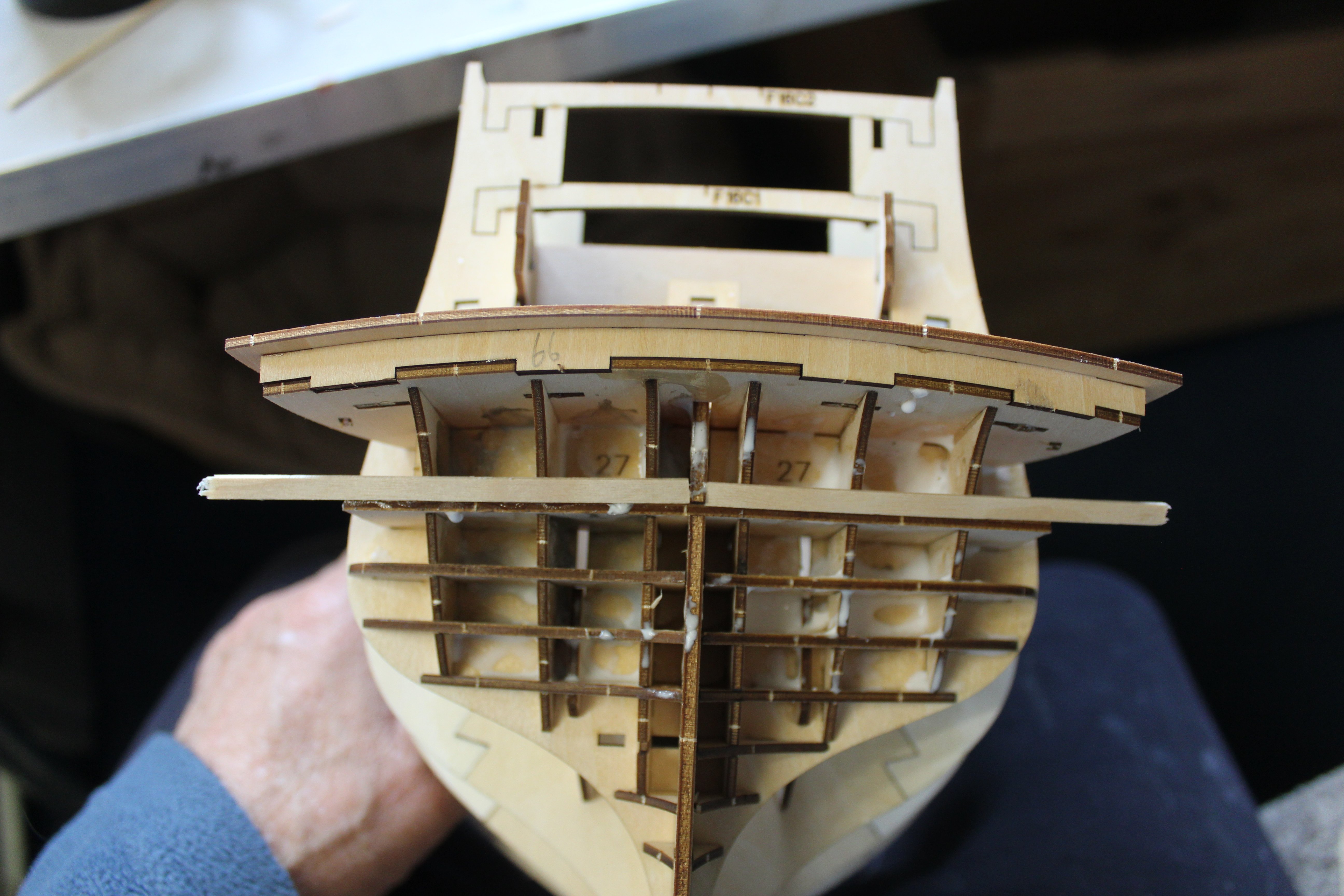

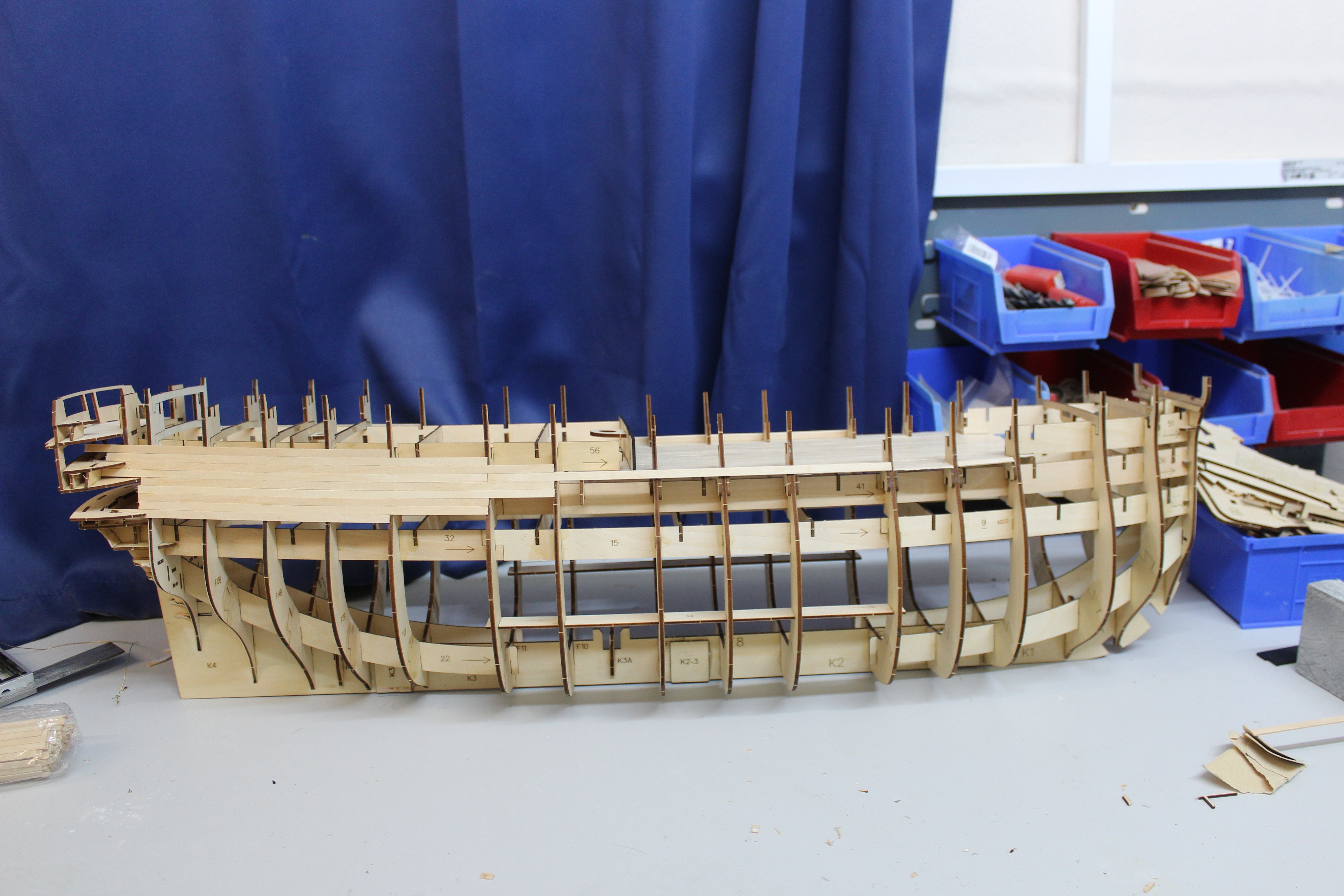

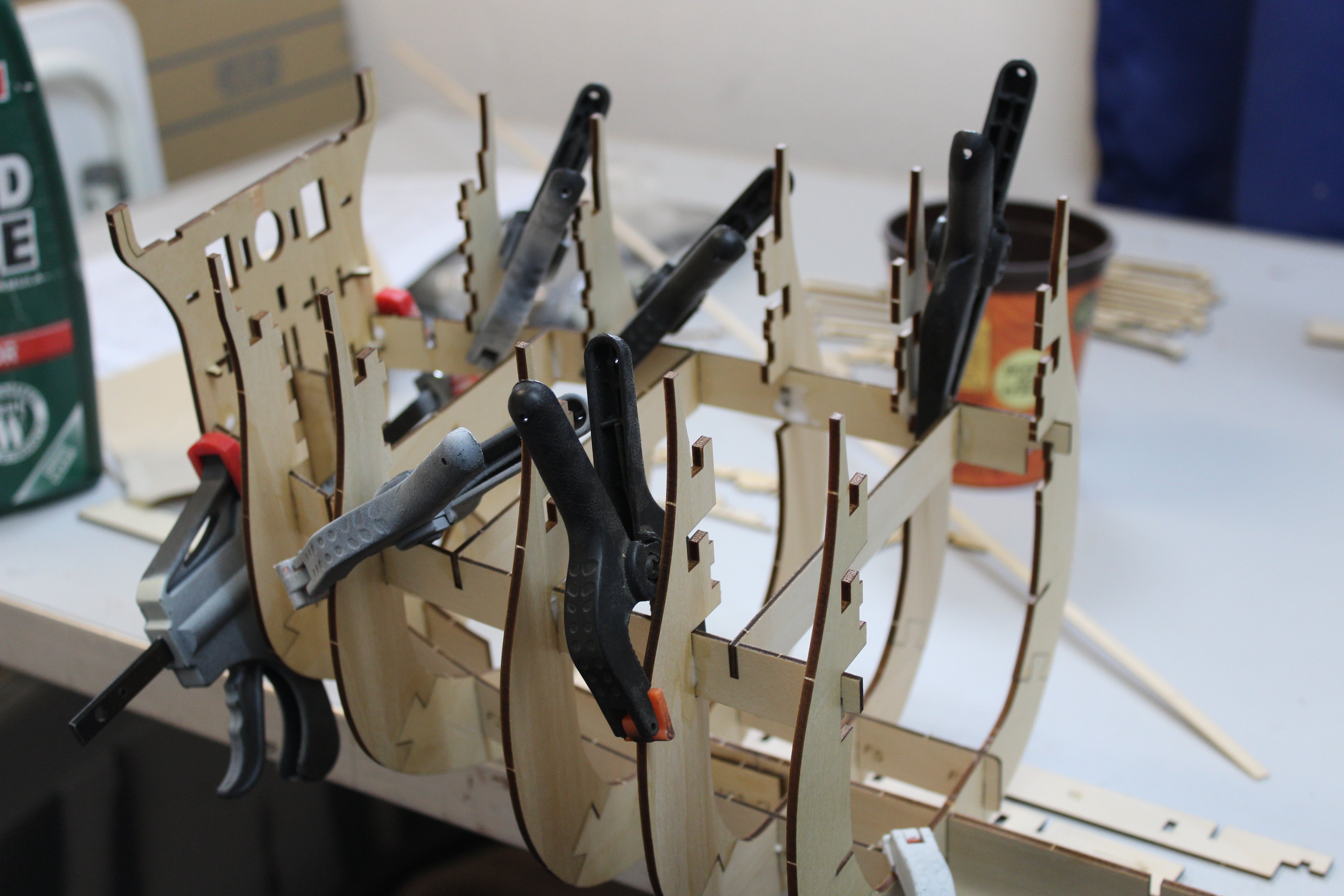

day 2 hull build up
Good evening everyone

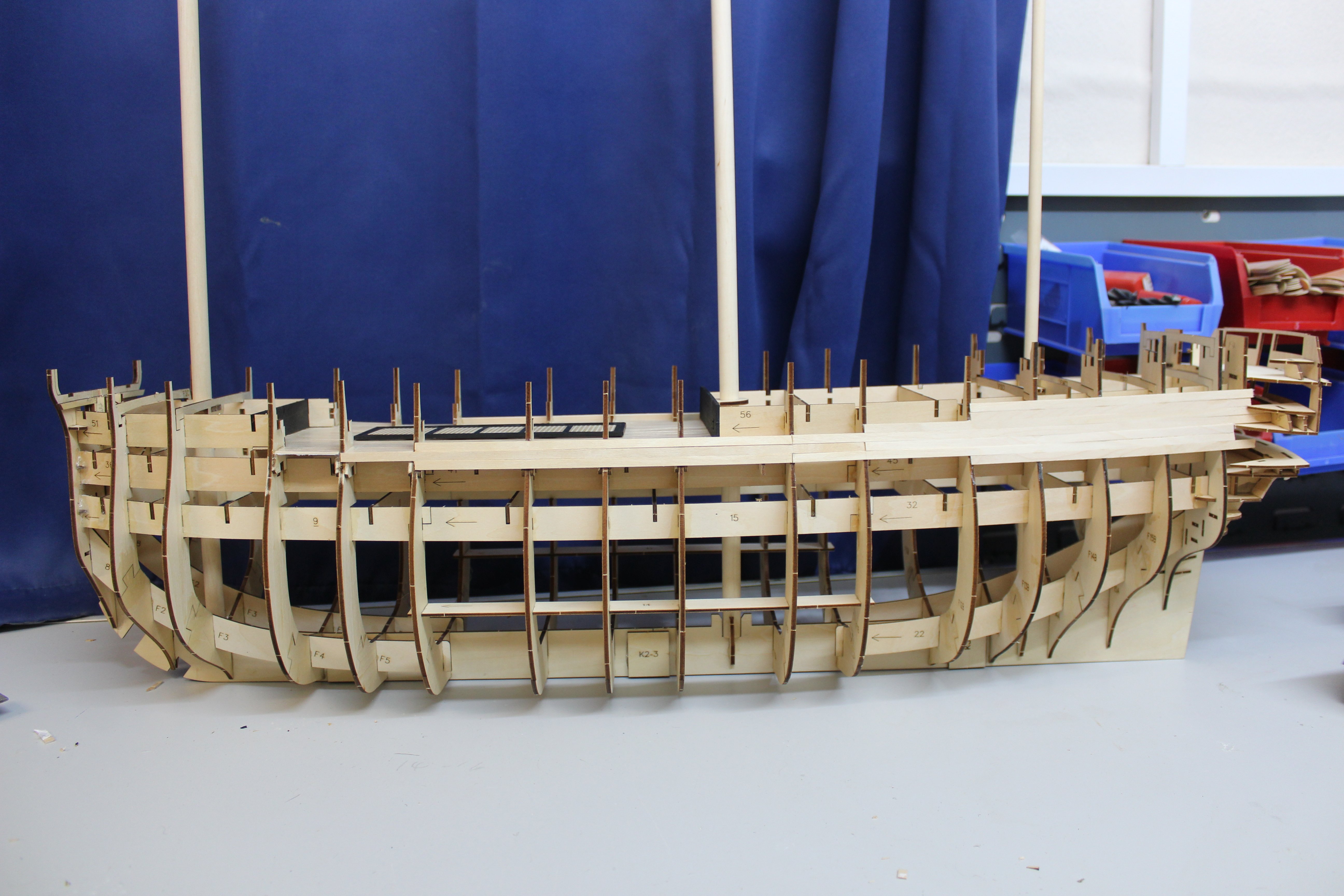

My concerns for a sloppy loose joint build have gone away, i did a test fit of everything, and wasn't impressed, but once all the locking tabs are inserted and the glue allowed to dry the hull is quite sturdy. but still feels very light weight and looks fragile, i am already onto planking the middle gun deck, this needs to be done now before the rest of the upper hull is fitted
looking ahead and seeing the lack of frames, i am going to convert her to a double planled hull and order some 1X4mm lime strips. she will then have a decent base for coppering, i also do not intend to have her with all guns showing, hoping to do the same as my Vic and have them in vent or shut

3 hours ago, yvesvidal said:
It is interesting to see how they implemented the building of the bow and stern, which is always difficult on this type of hull.
Great poisoned gift that James gave you.... 🙂
Yves

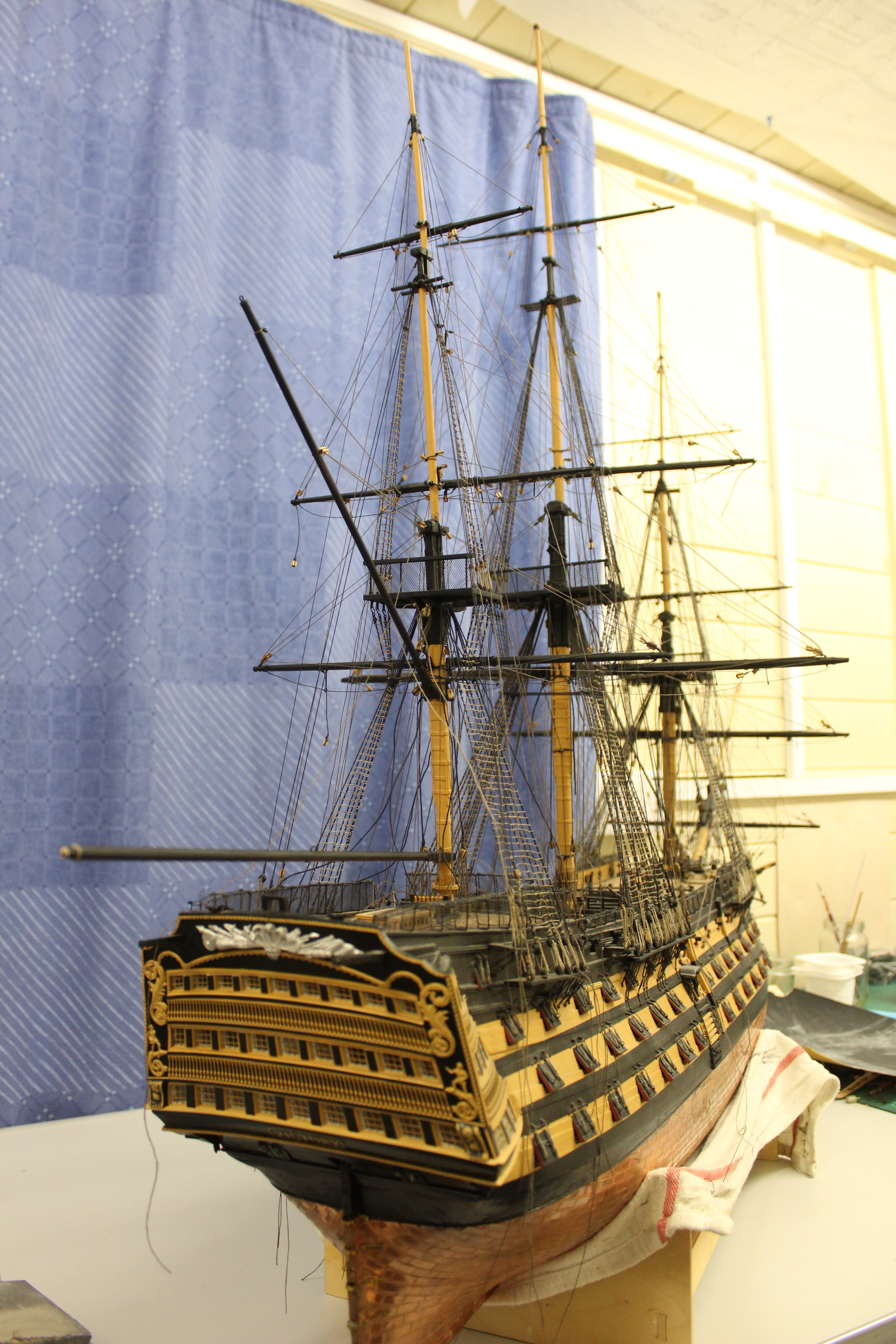

Absolutely stunning work on the Victory with only one criticism: Why have such a magnificent ship as the Victory with all those 100 plus cannon and not have them all showing loud and proud?  To me, that is the best part of building the victory.
i had planned for her to be with a full sail set, then changed my mind, also i had not seen one in that configuration, and my latest build will be the same,

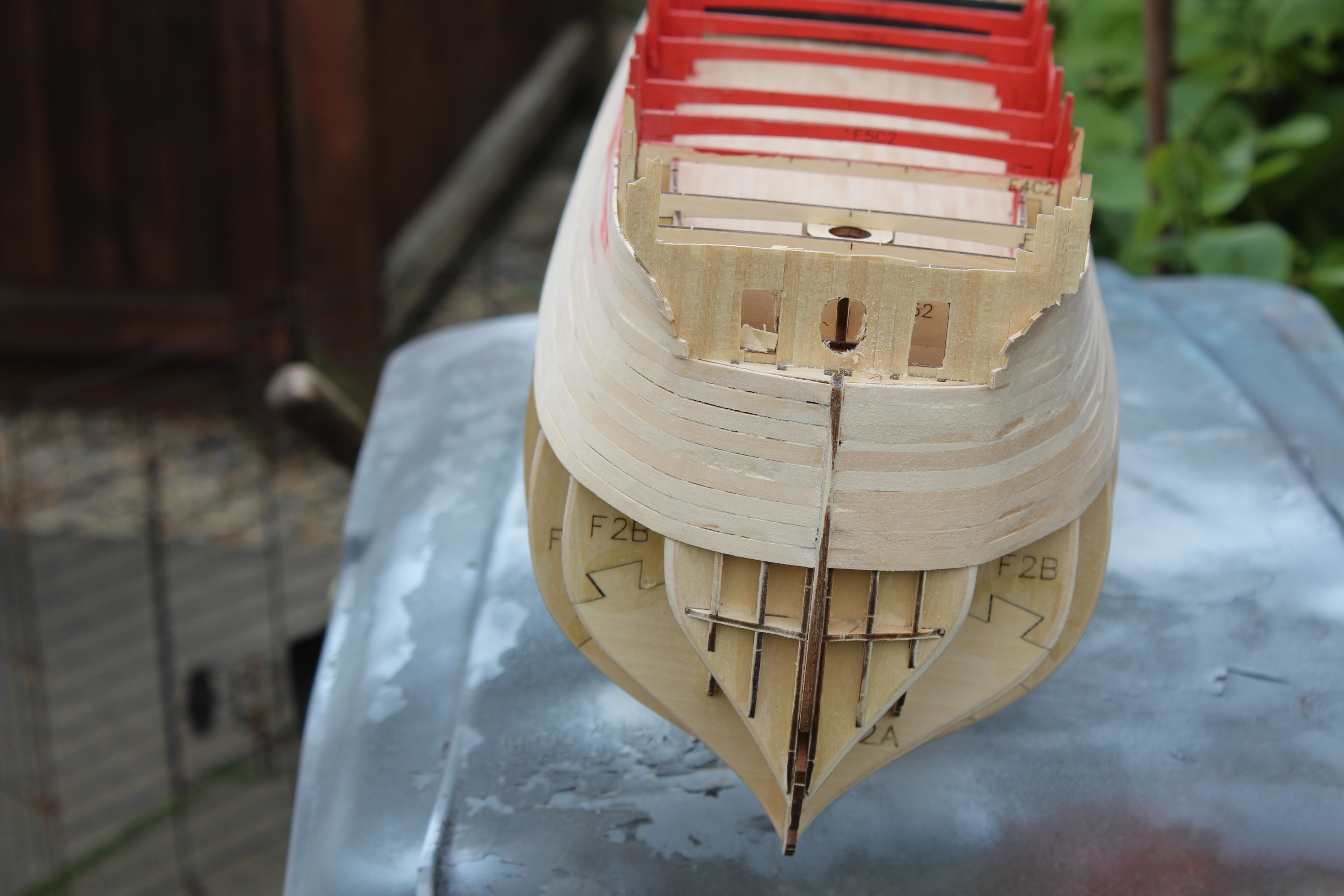

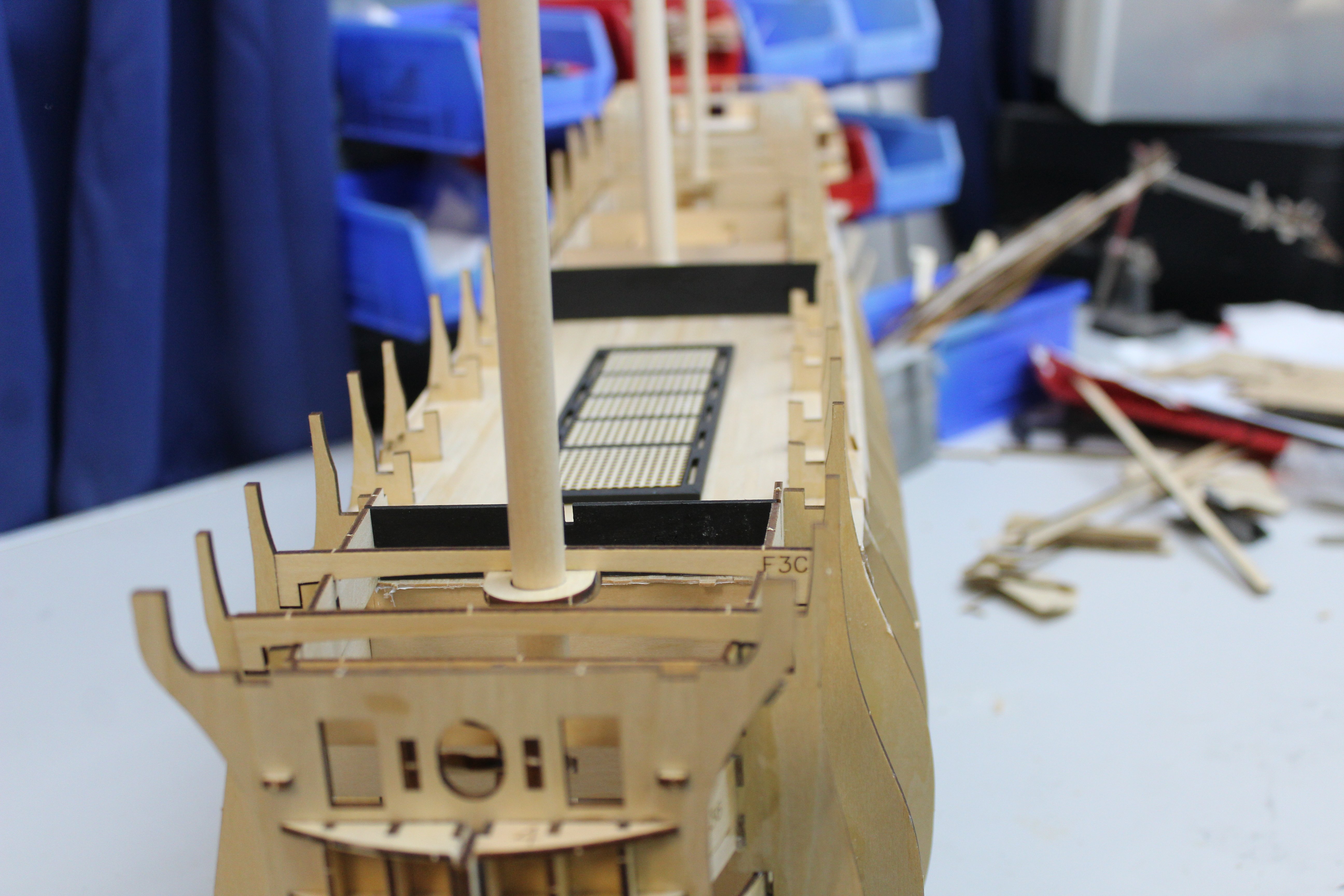

good evening everyone
day 4, hull build up, and galleries, with some 1st planking
pleased with myself on how this id going so far,

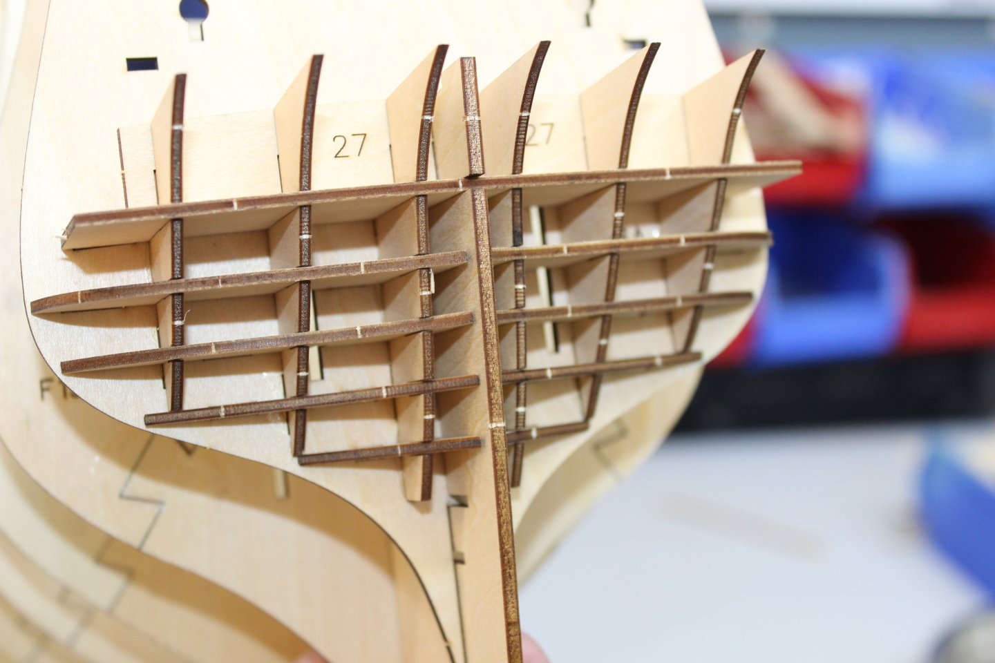

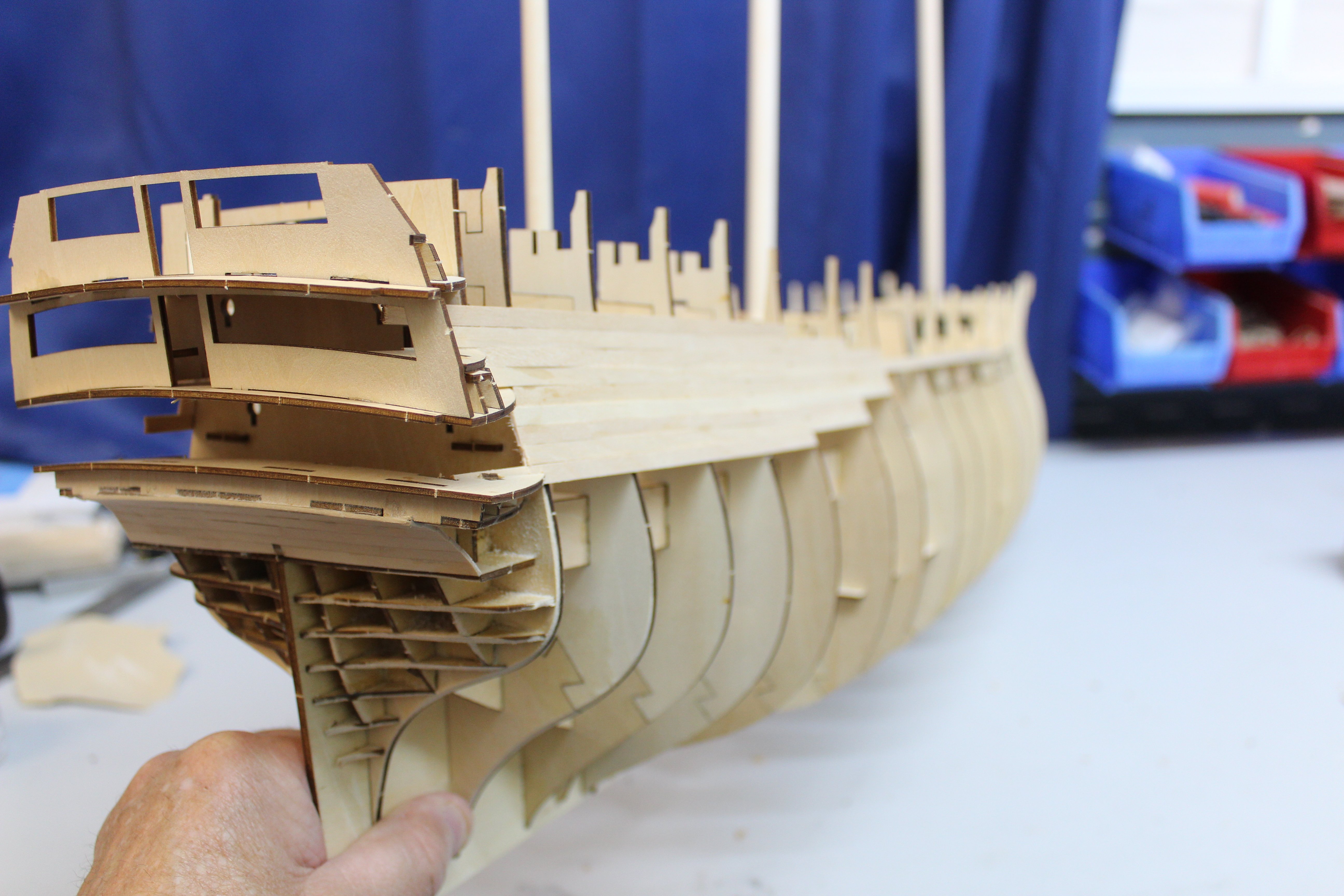

90% of the frame is complete,
stern galleries have been made up
i have changed the kits requirement from singe planking to double, therefore using the kits 1x5mm in the wrong places until my ordered stock arrives.by planking the galleries now, i can protect them better, by going to double planking i think i will be in a better position to display the gunports shut, without having to do the lid linings
the light kit arrived today, Thank you @chris watton and i will be possibly sorting that out in a couple of days
that pretty well sums it up for today

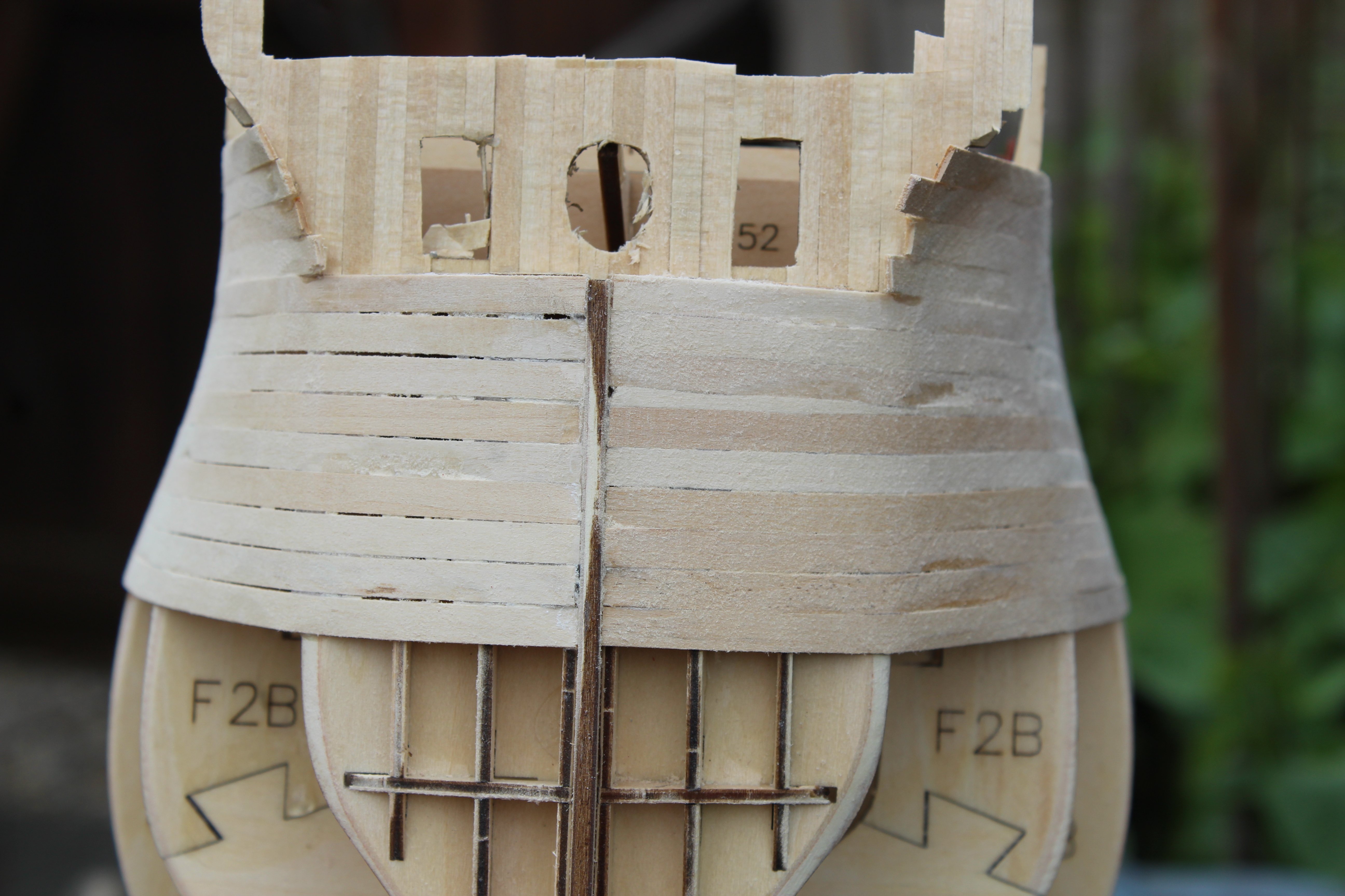

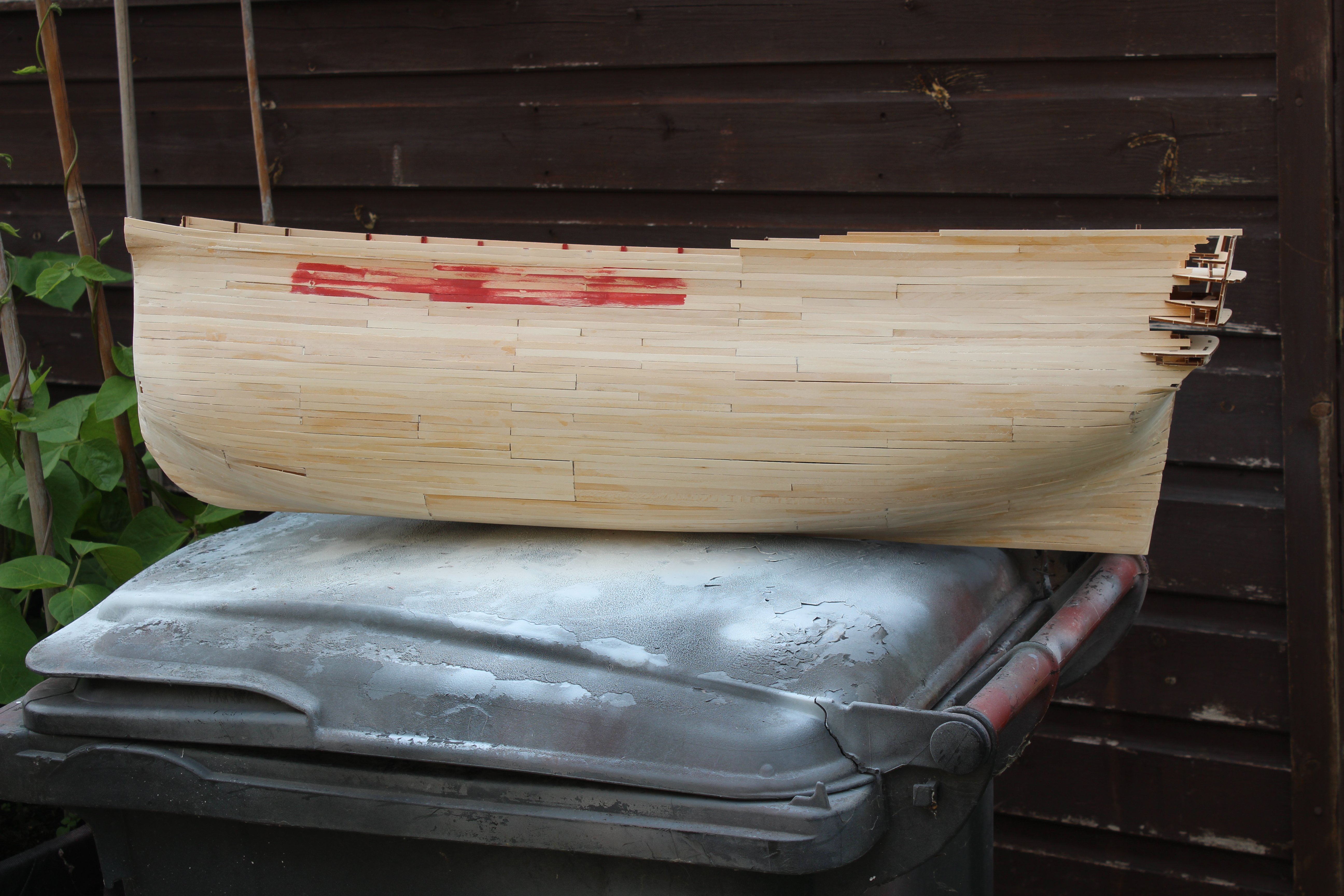

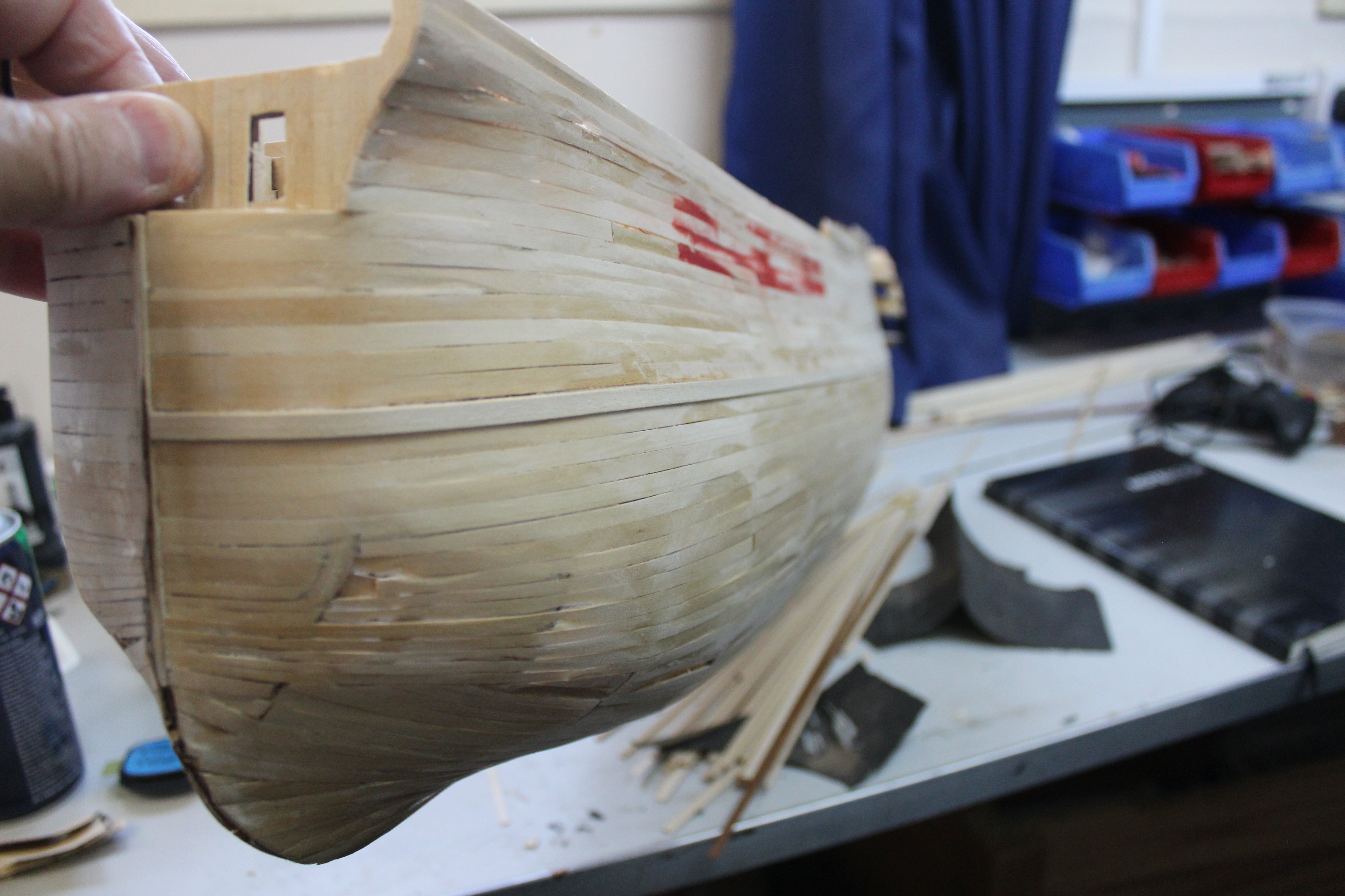

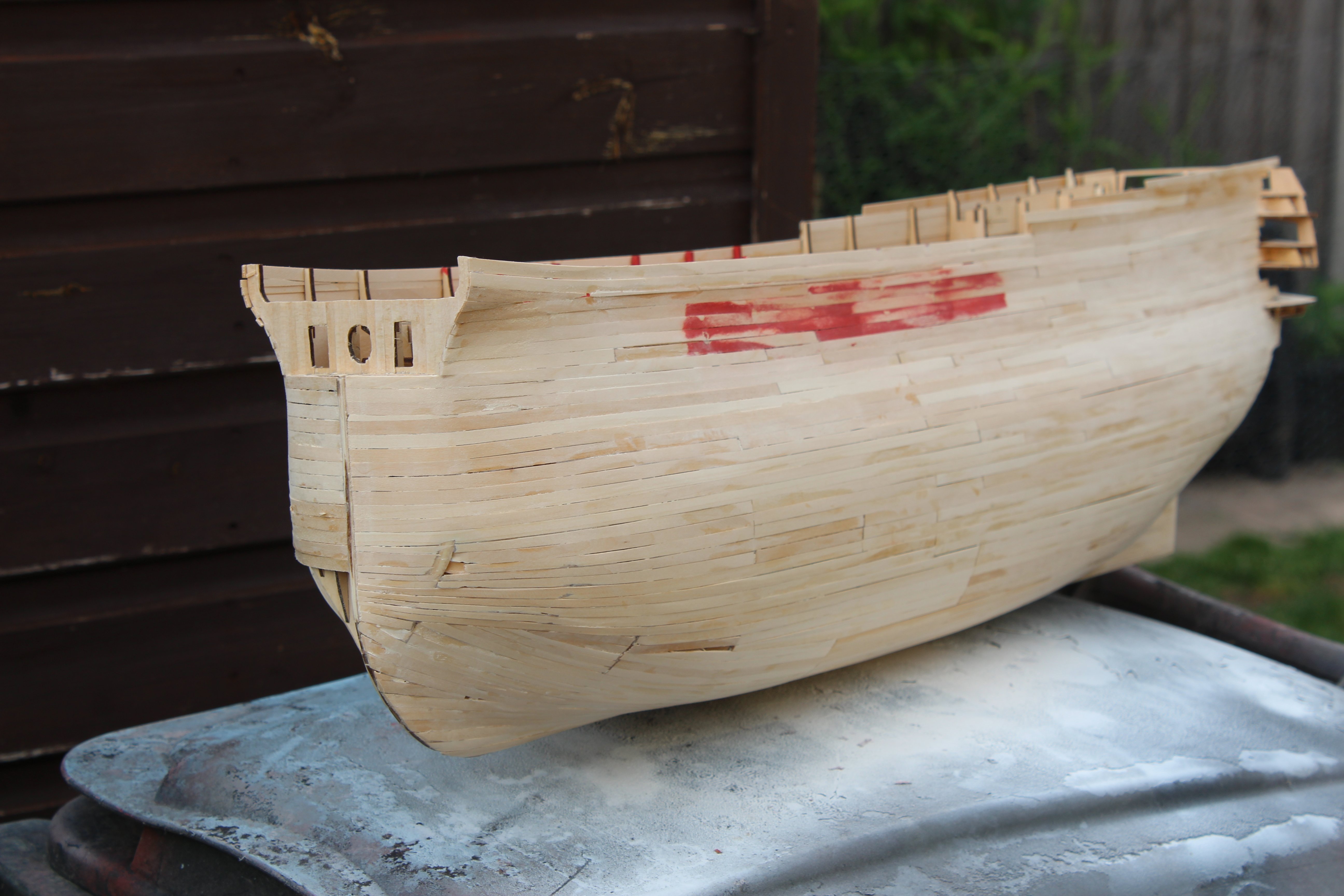

day 6 1st planking

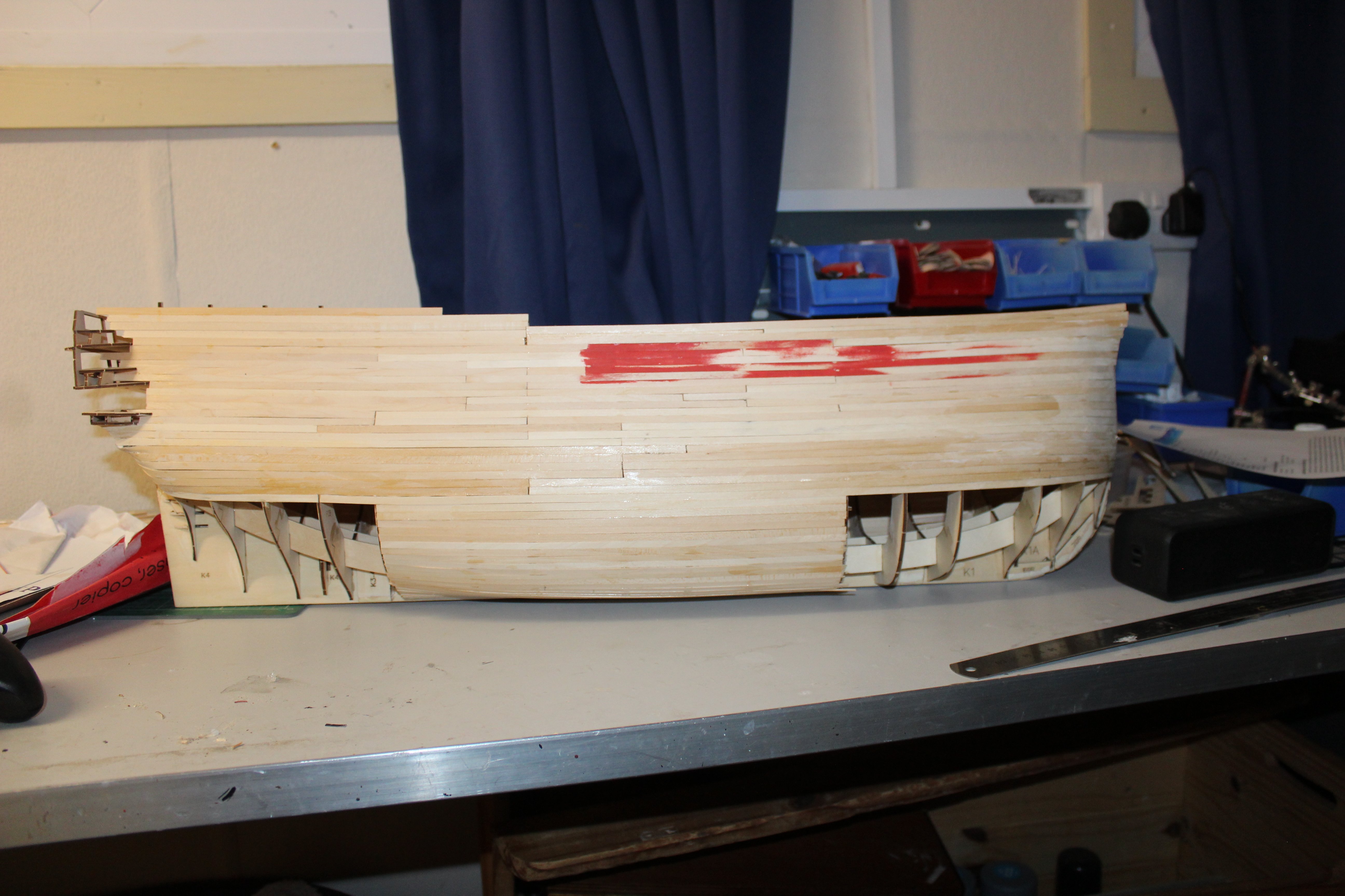

no regrets at all on changing the planking from single to double, i have 100m of 1x5mm lime strip on its way, might need some more, at present im using anything left from previous builds
gave her a bit of a sanding, starting to look like the instructions now, working on the gundeck before it more of less gets covered over

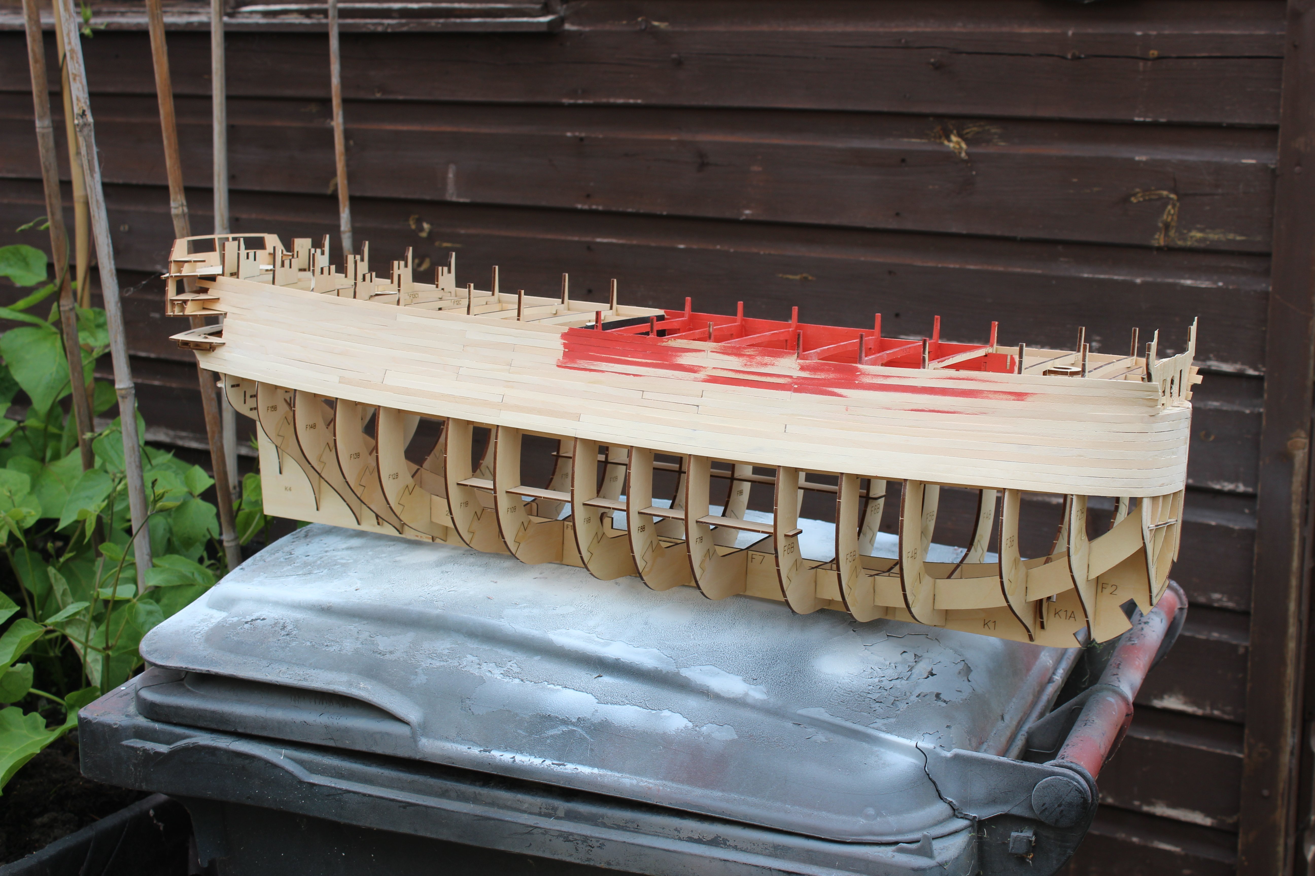

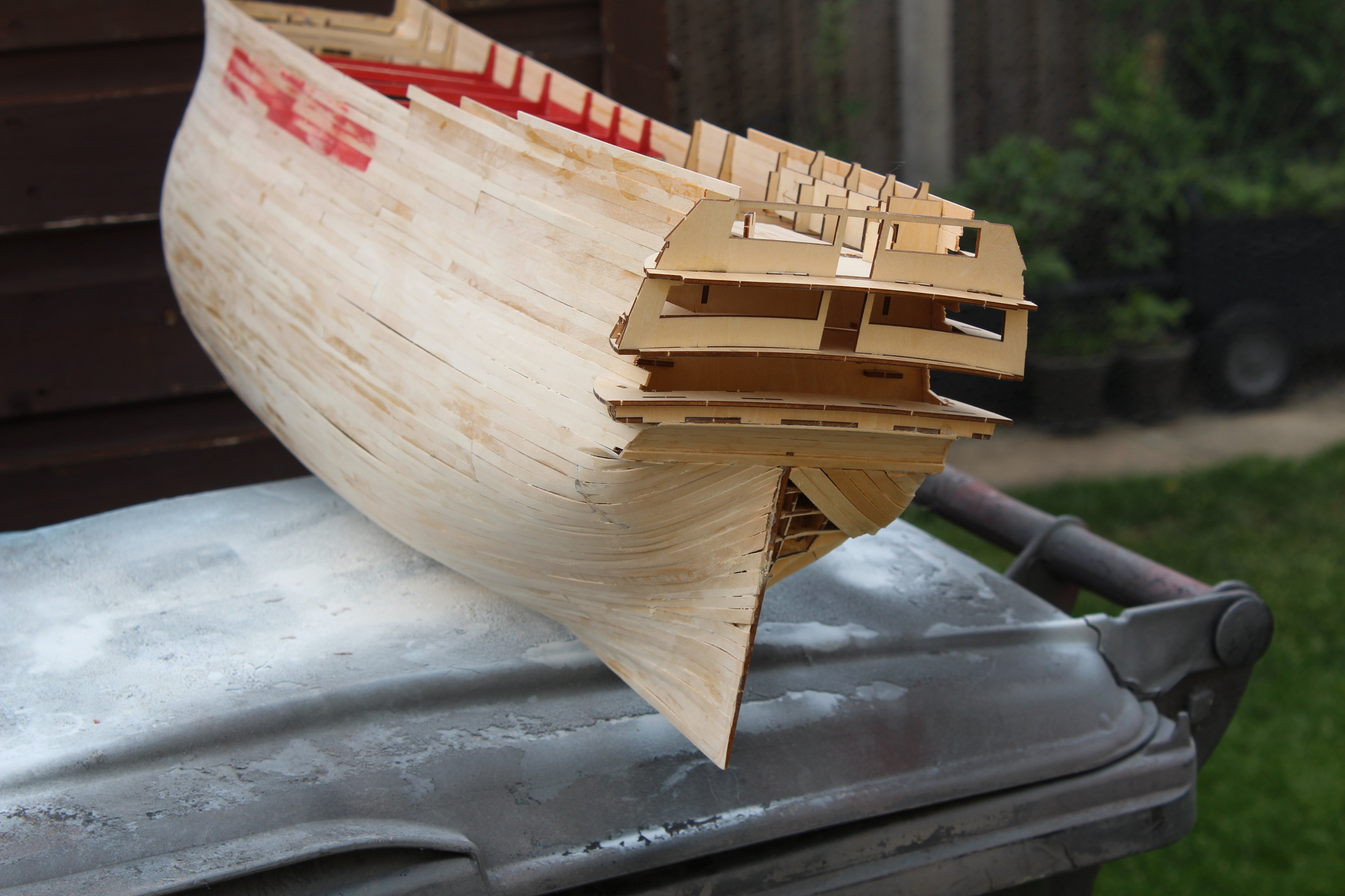

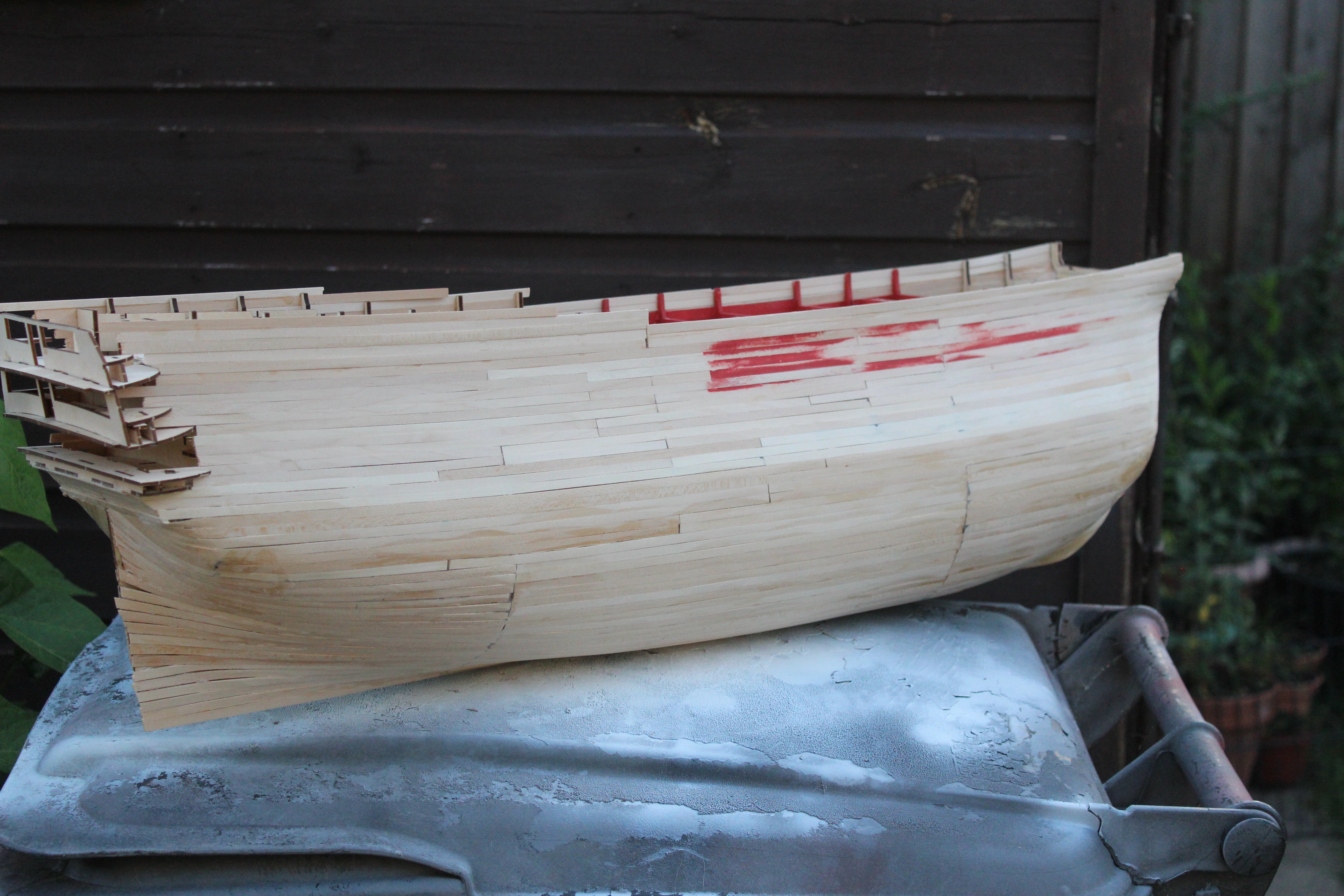

Day 10 1st planking port side complete
thank you for comments and likes

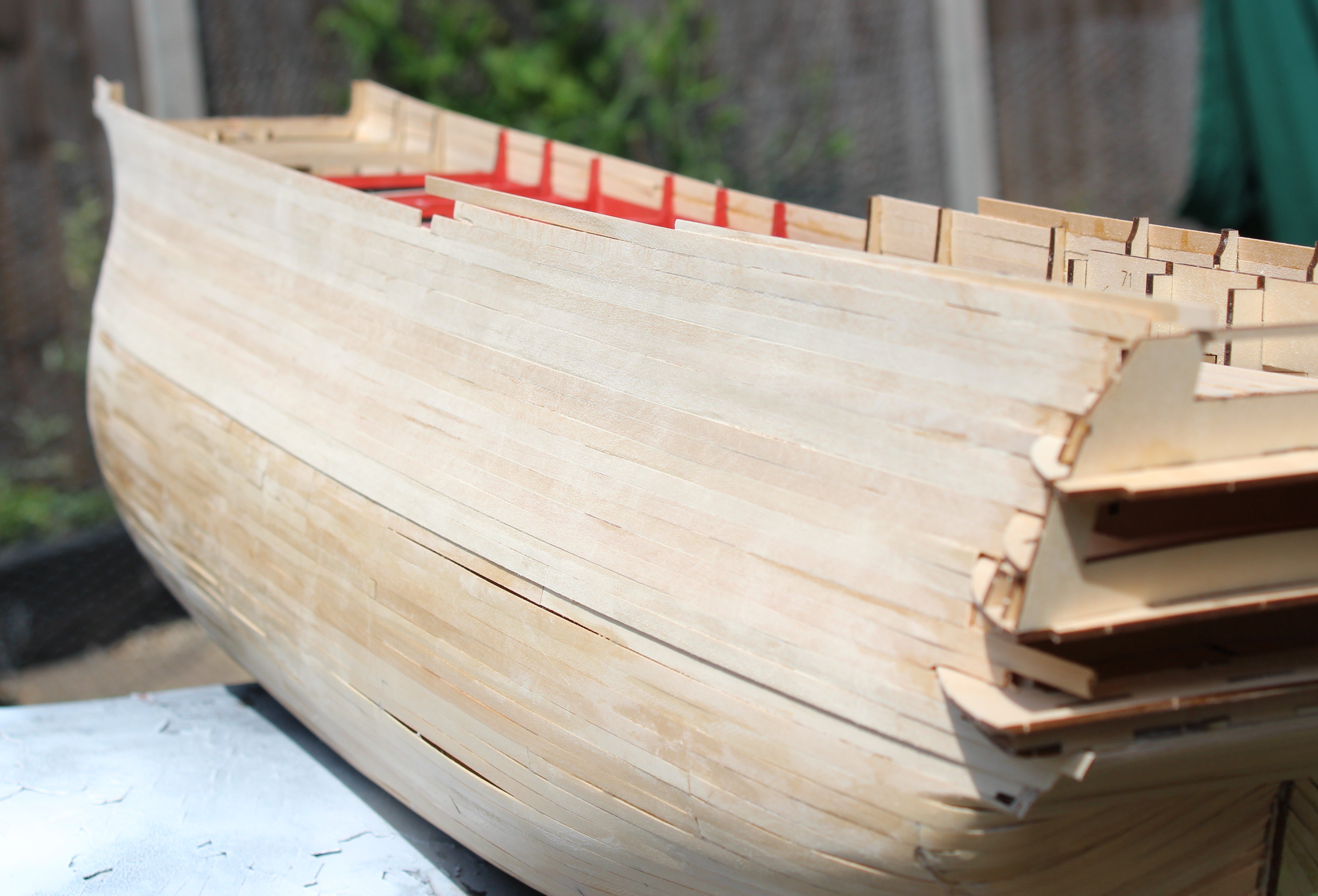

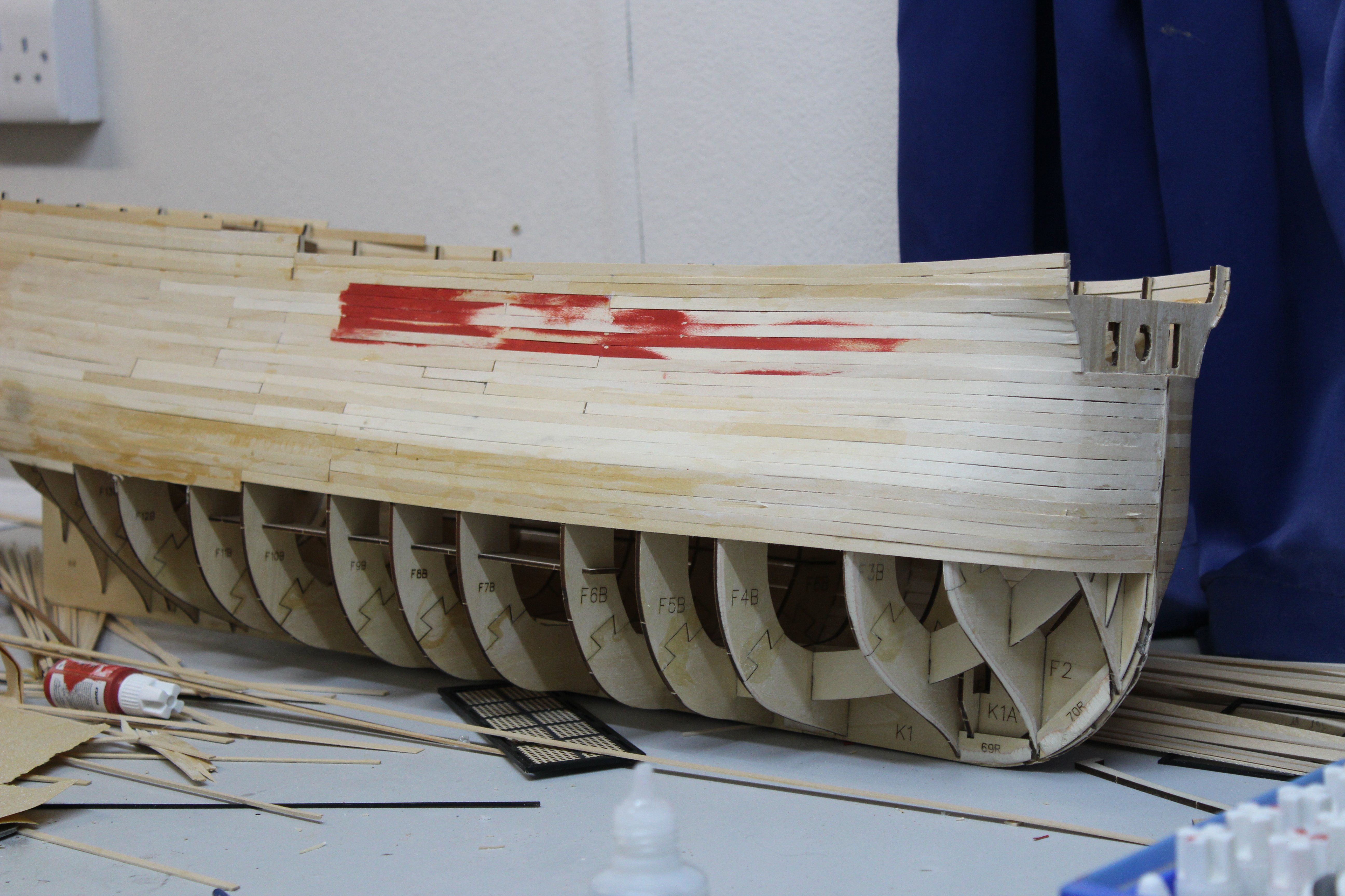

this build is quite the monster, i have just finished 1st planking the port side and she has taken 50 lengths of 1x5mm lime strip, the other side is progressing.
Although a slightly smaller scale than the 1/72 Victory she looks a far bigger hull. (i need to check that fact out), will certainly dominate the display area when completed
The planking is not pretty at all but gives me a lovely base for the next layer once the planking is complete i need to mark out the gunports over 4 deck levels

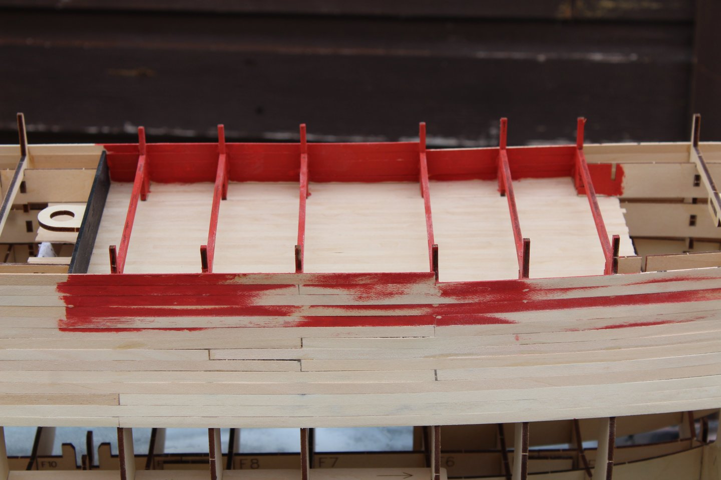

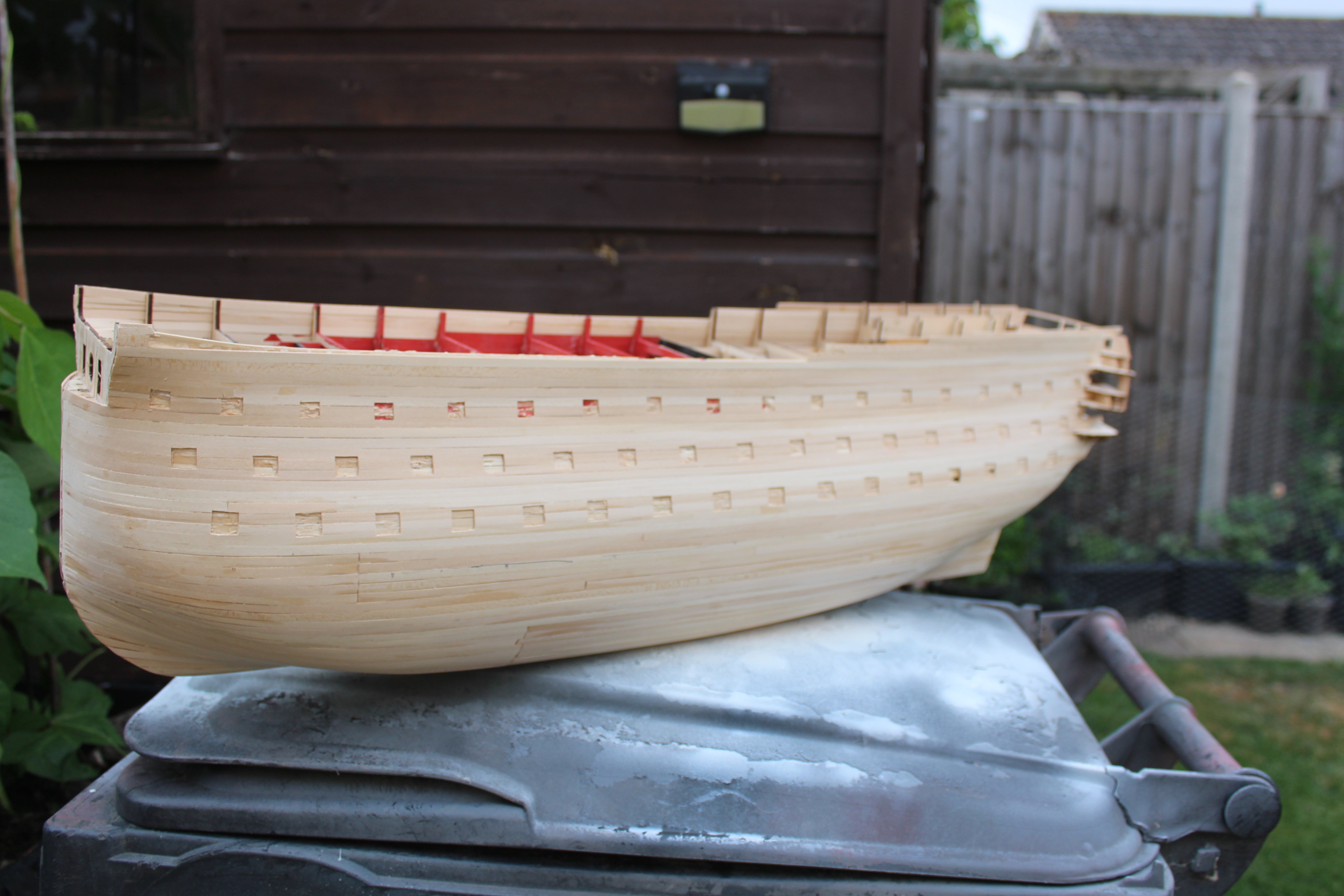

Good evening everyone, thank you for comments and likes
day 14 started 2nd planking
Well the 1st planking was very messy, but it was so very well worth the trouble to do it, im not a lover of planking in the first place, but with 16 frames using 2mm stripwood in 300mm lengths would have done me in
i have thought quite a bit how i would like to present this build and have decided - wait for it......................
A all gunport lids will be shut
B i will attempt to do sails on her, whether to use the kit supplied ones or do my own, still to be decided
C_ put some lights on her

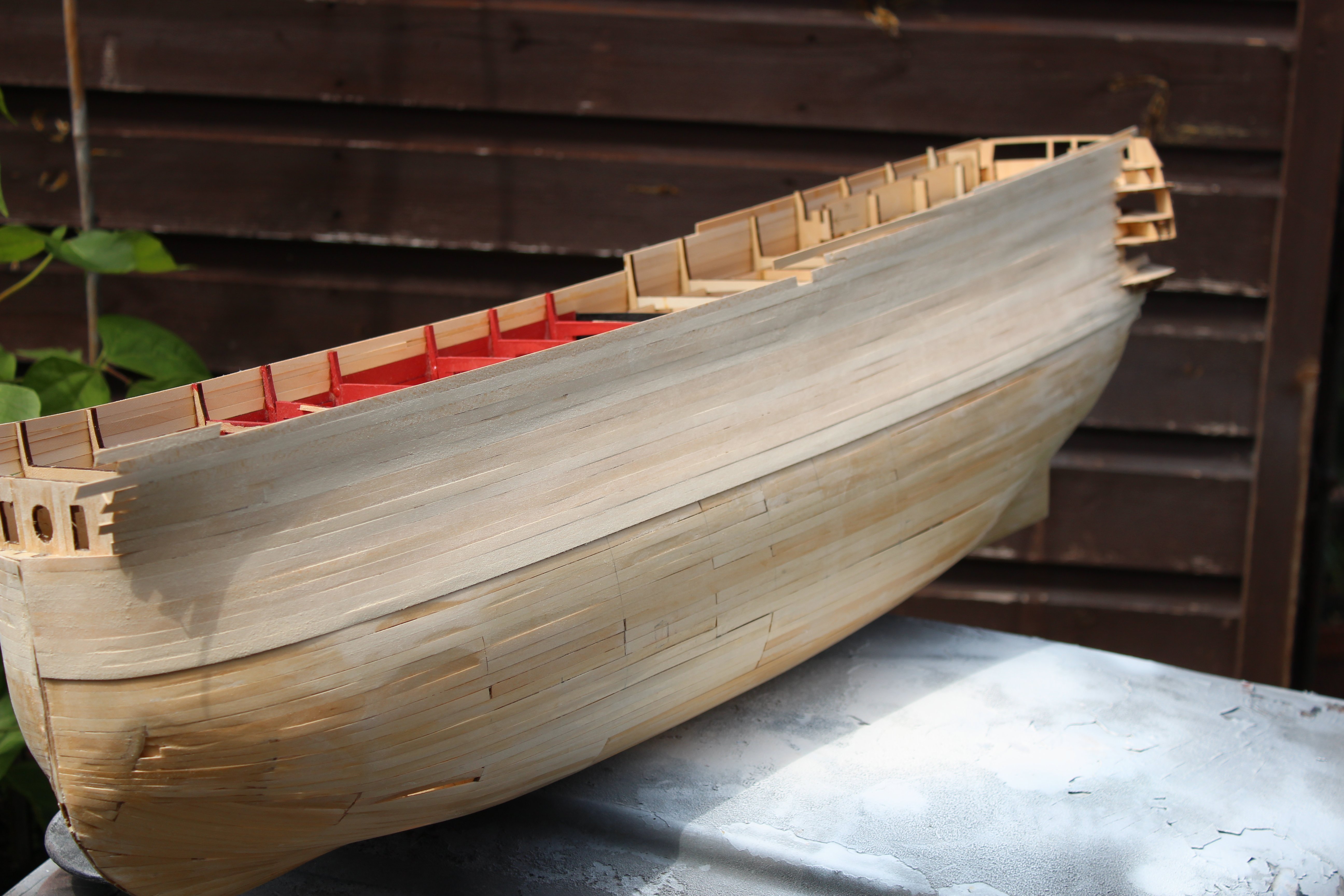

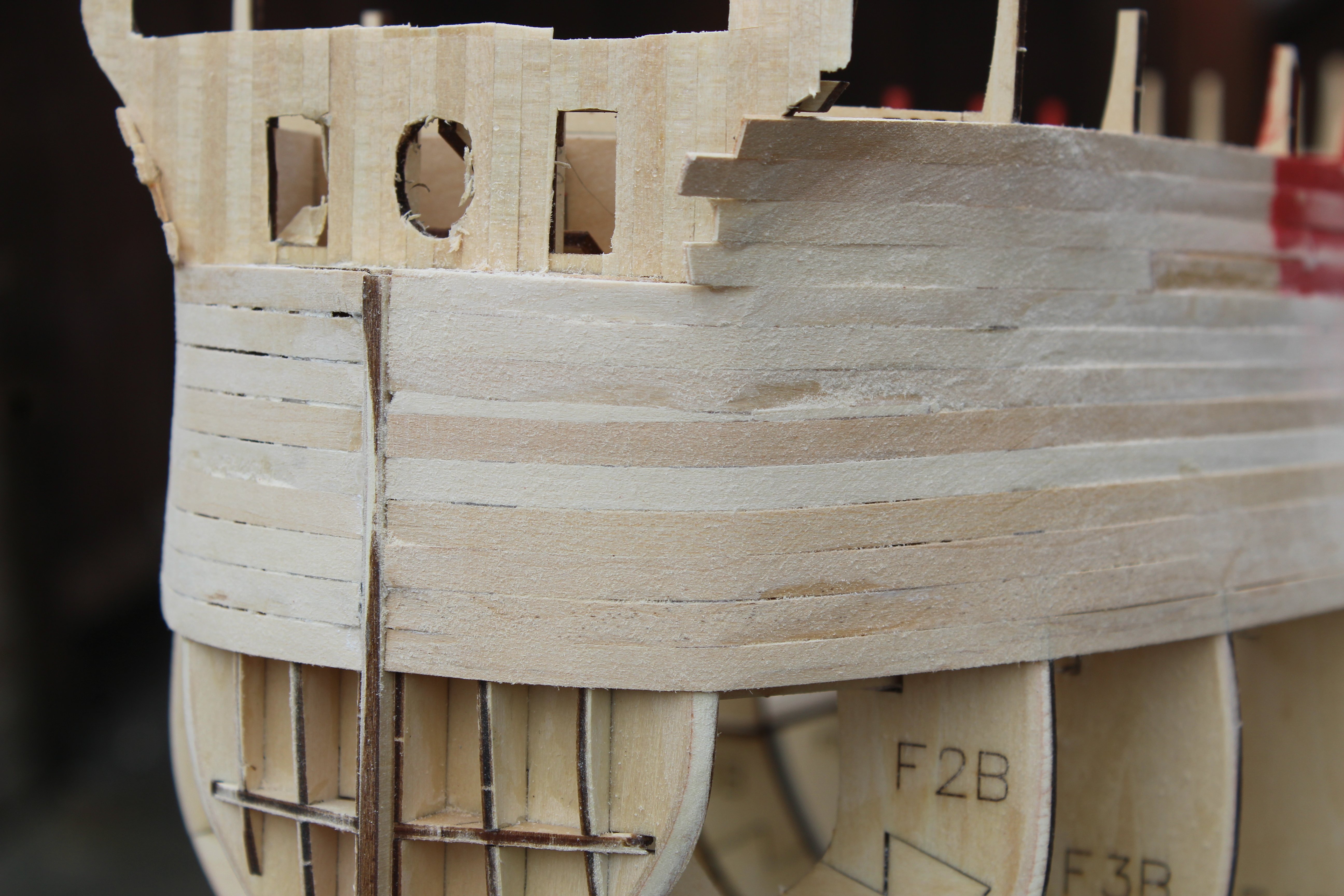

Day 18 completed 2nd planking
not in a hurry to do that again, double planking using 1mm x 5mm used appx 150 meters
sanded using 240 grit, will do again later with a finer grade after touching up a few places, like the stern where the rudder post will eventually go, worse to come soon (gunports)

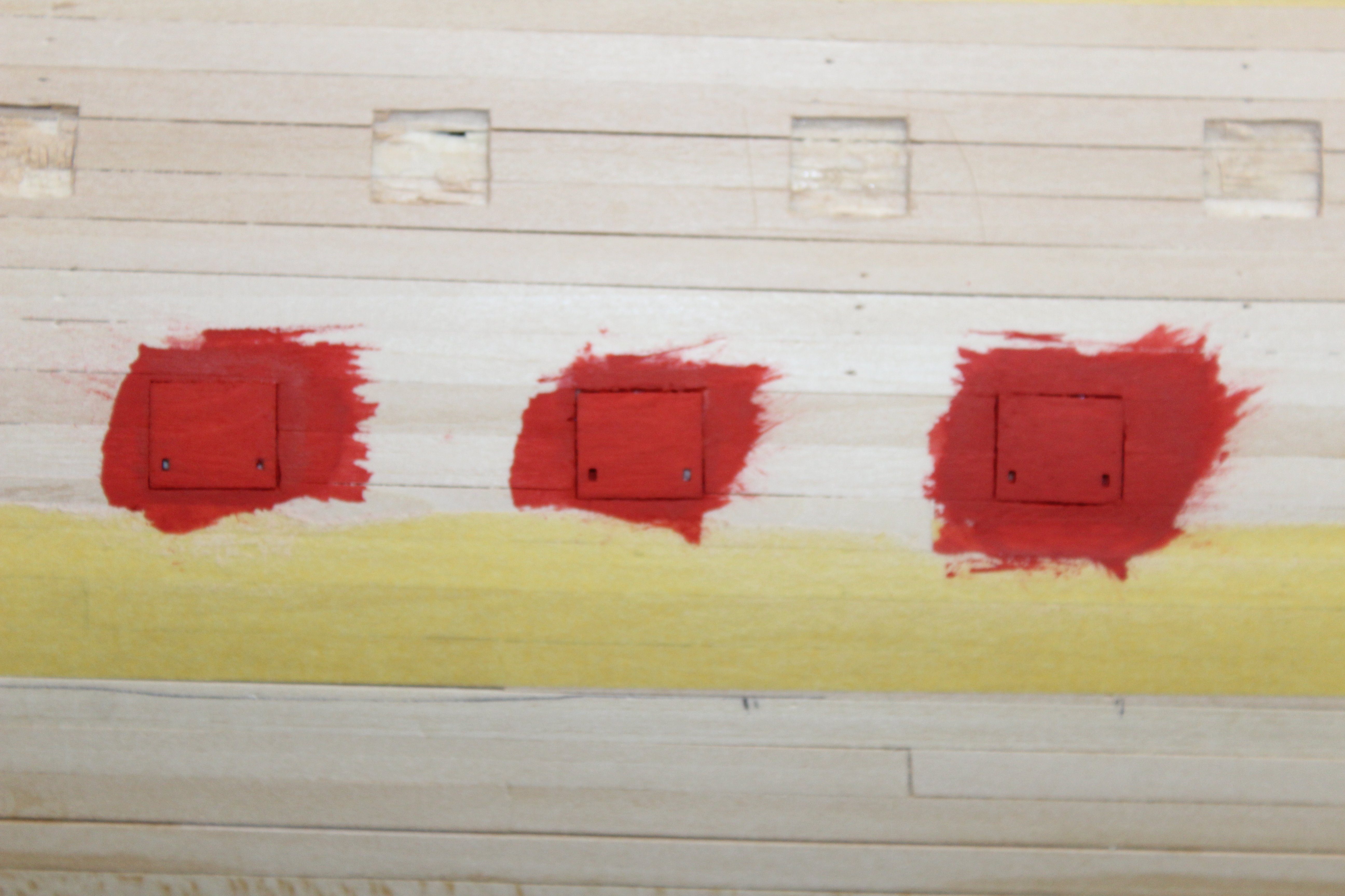

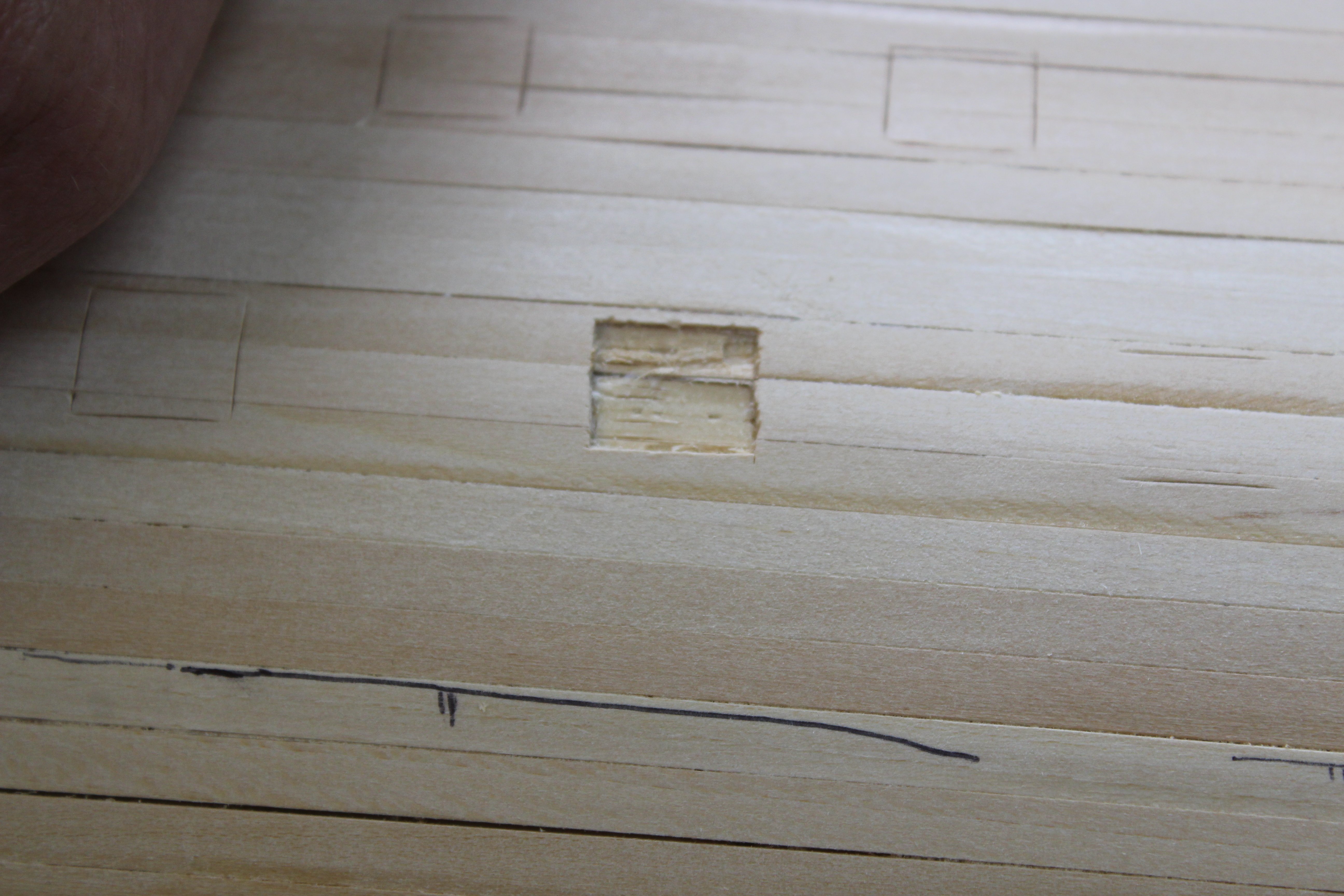

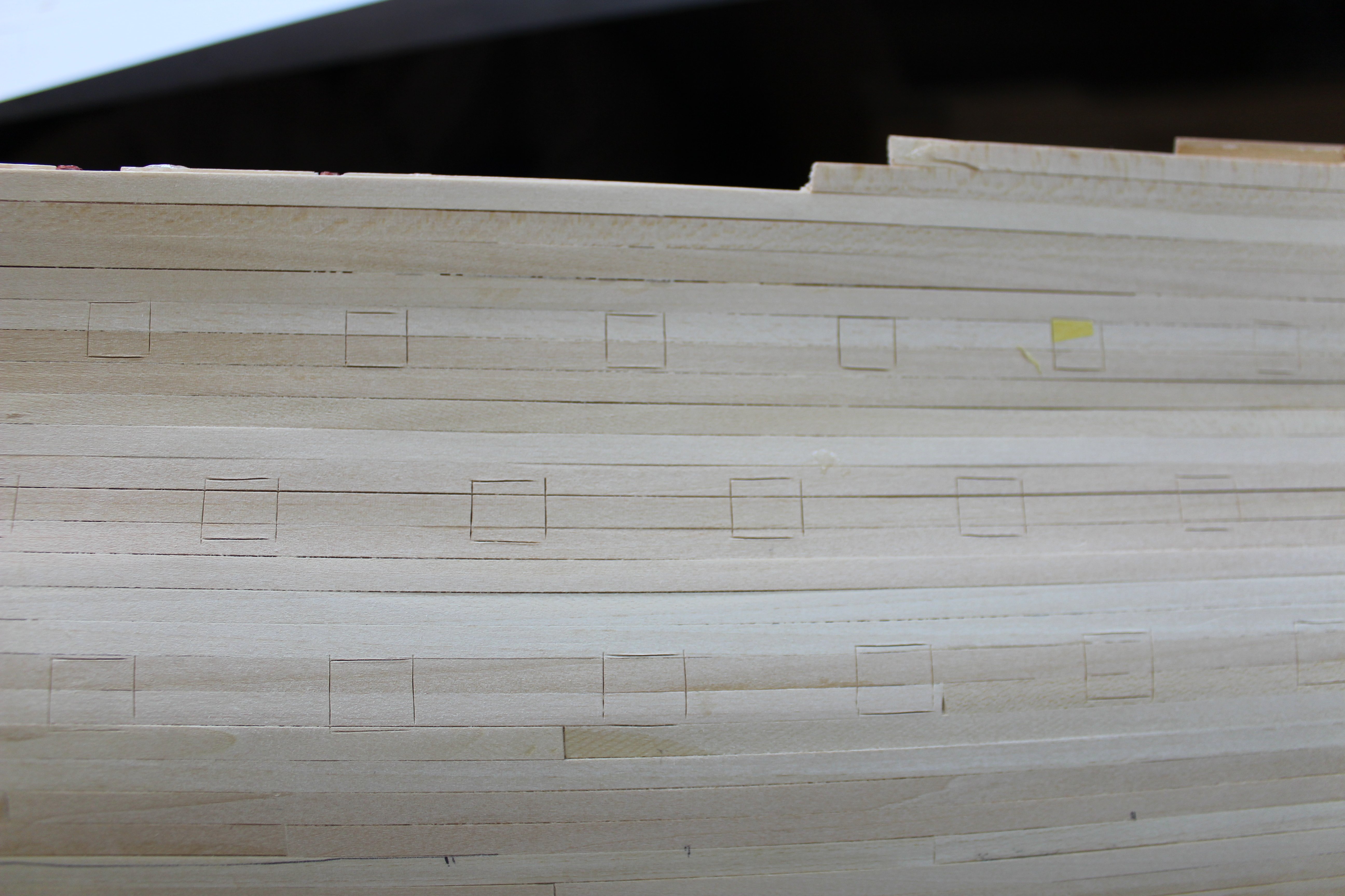

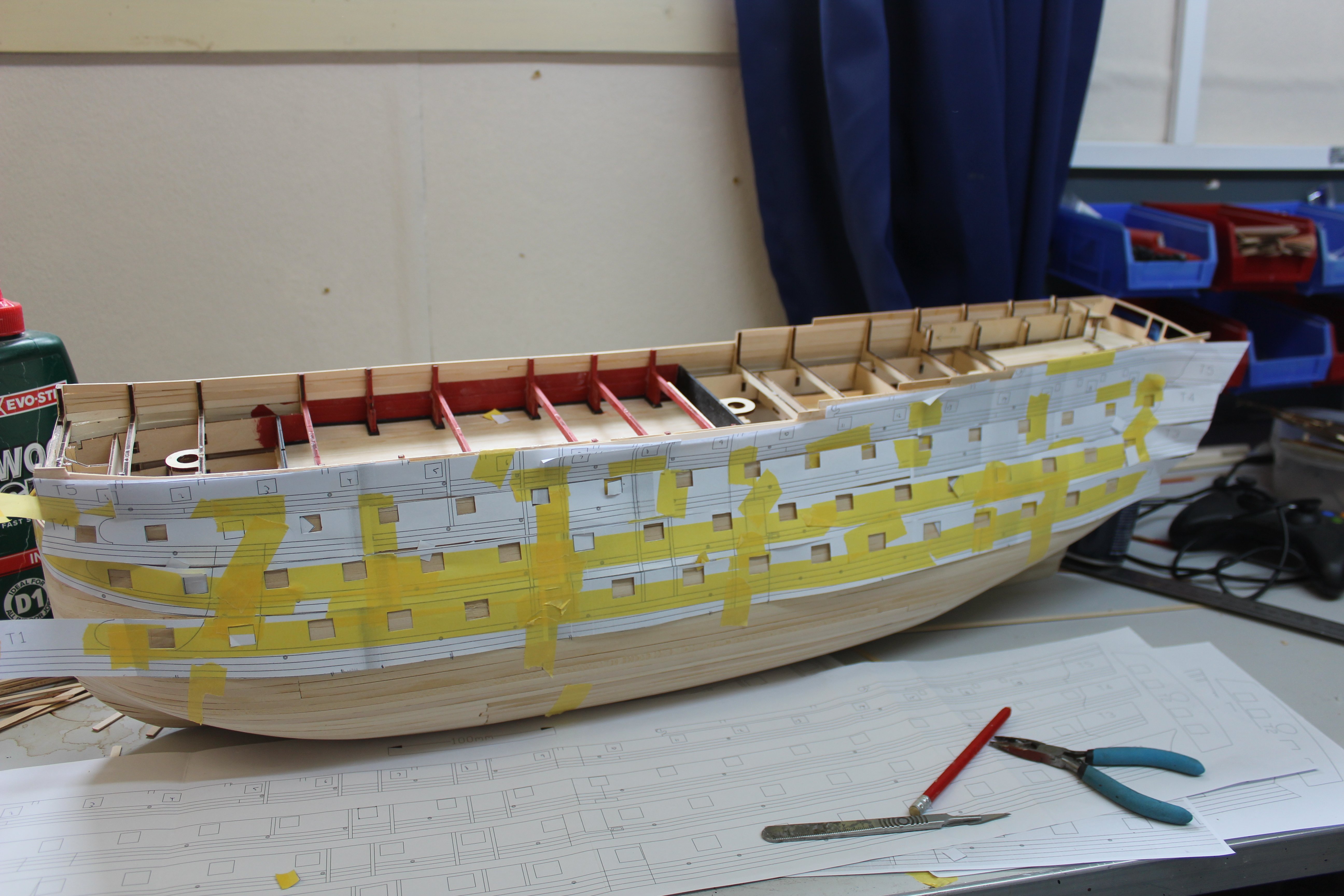

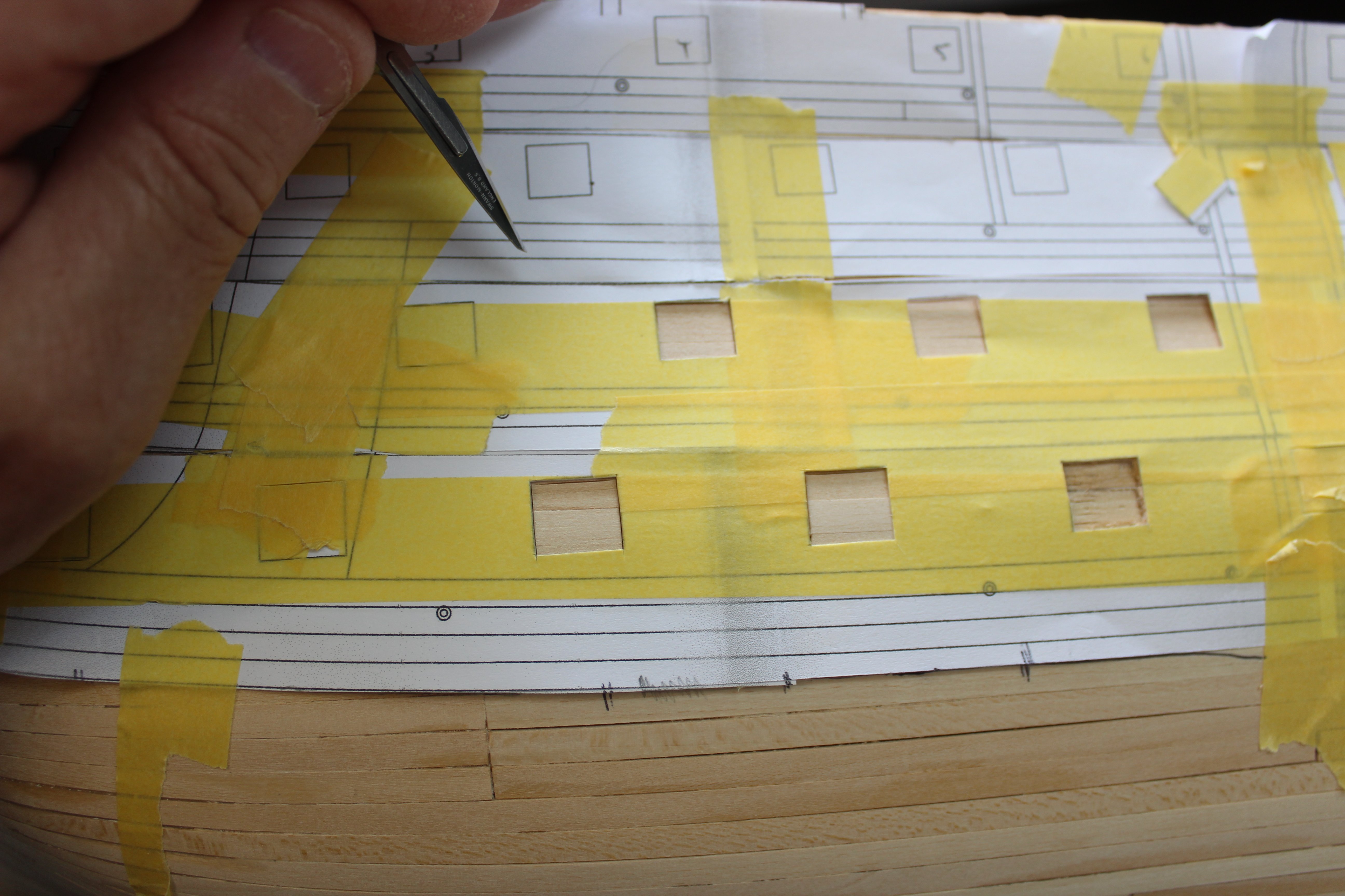

day 19- a recipe for disaster
but so far avoided- hinged gunports
Come on AL there has to be a better way for a gunport template

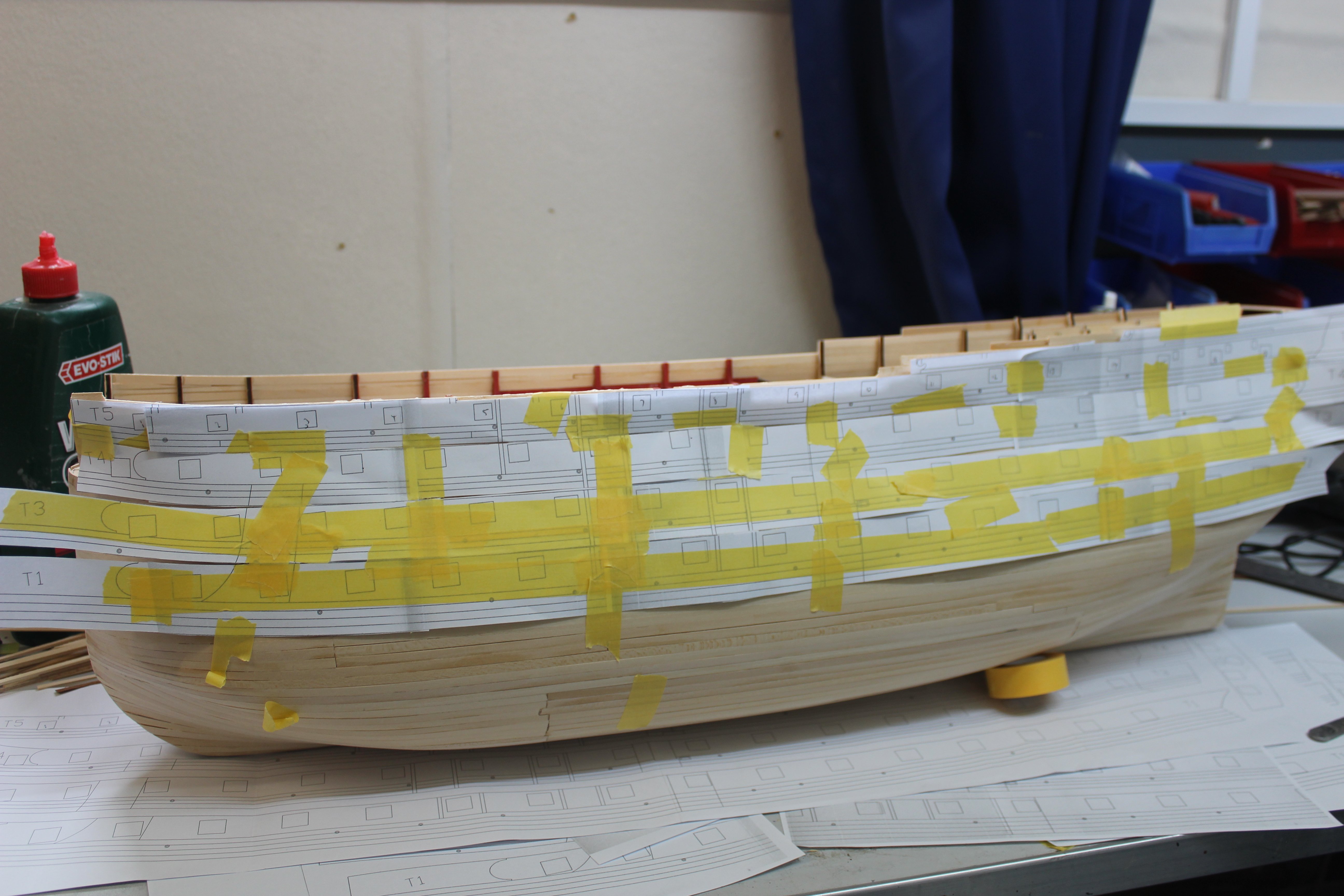

I copied the template onto printer paper, cut them out and built them up on the original template,
took a lot of messing around to hopefully have them in the right place
as non of these are going to be open, i just had to remove the top planking, this side has now been roughly removed, and require some tidying up to get the lids to fit
free flood ports still to be marked outIMG_3762-Copy.thumb.JPG.b87d93cf719e91c33568eb85092e2d16.JPGIMG_3763-Copy.thumb.JPG.b23efc6444b3741c4a3a57b911585d06.JPGIMG_3765-Copy.thumb.JPG.62b0acdfd9ec3b5e9067904ef1647997.JPGIMG_3766-Copy.thumb.JPG.c551acf1cc27953d995a86ad899c7794.JPGIMG_3767-Copy.thumb.JPG.2e74a0284b28280110ad814a60f43538.JPGIMG_3776-Copy.thumb.JPG.e038039e00e51a0a2f31e1fd6be9824e.JPGIMG_3778-Copy.thumb.JPG.2ab19cdf2d7ecea99934c91b516a2353.JPG

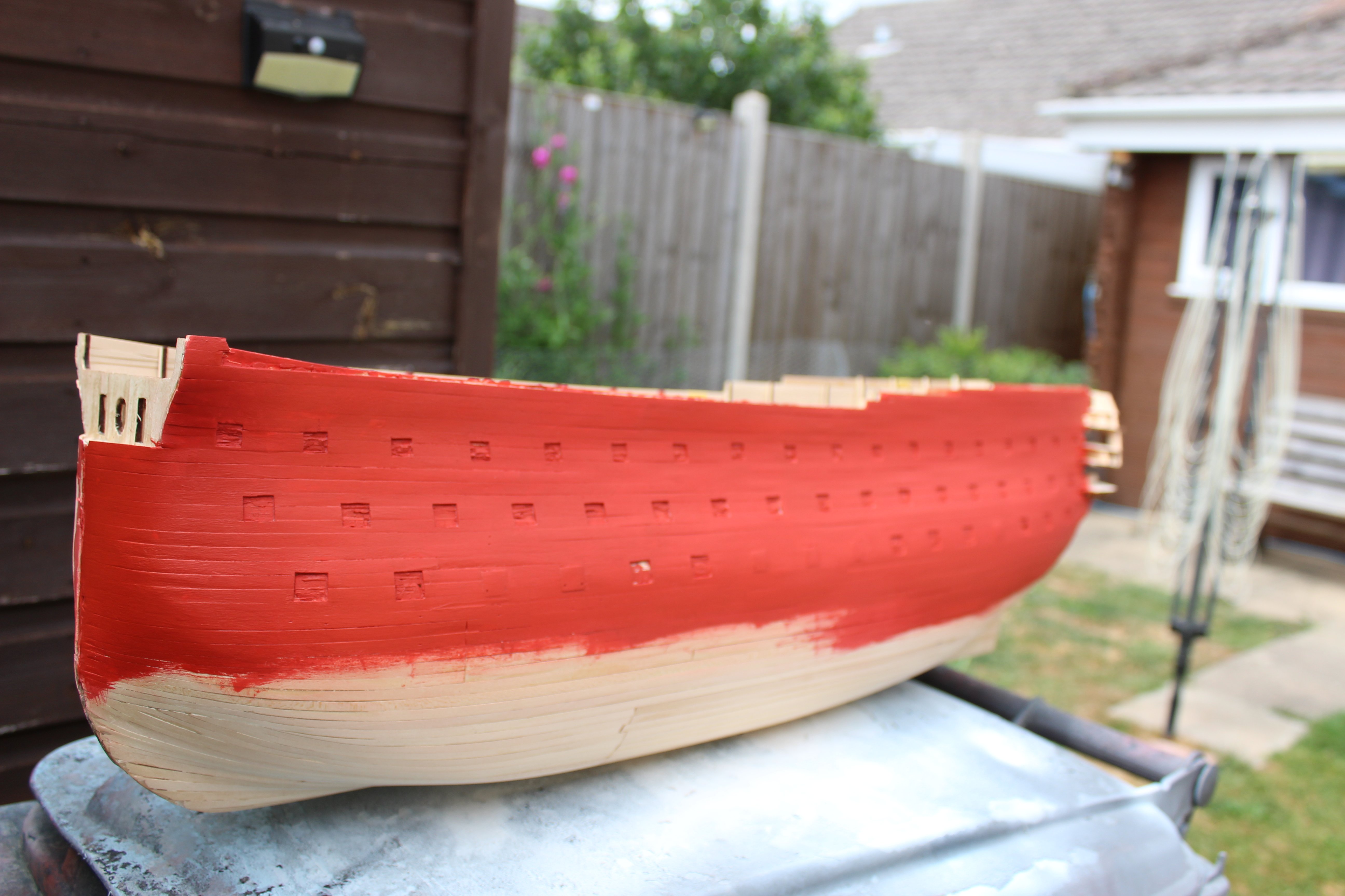

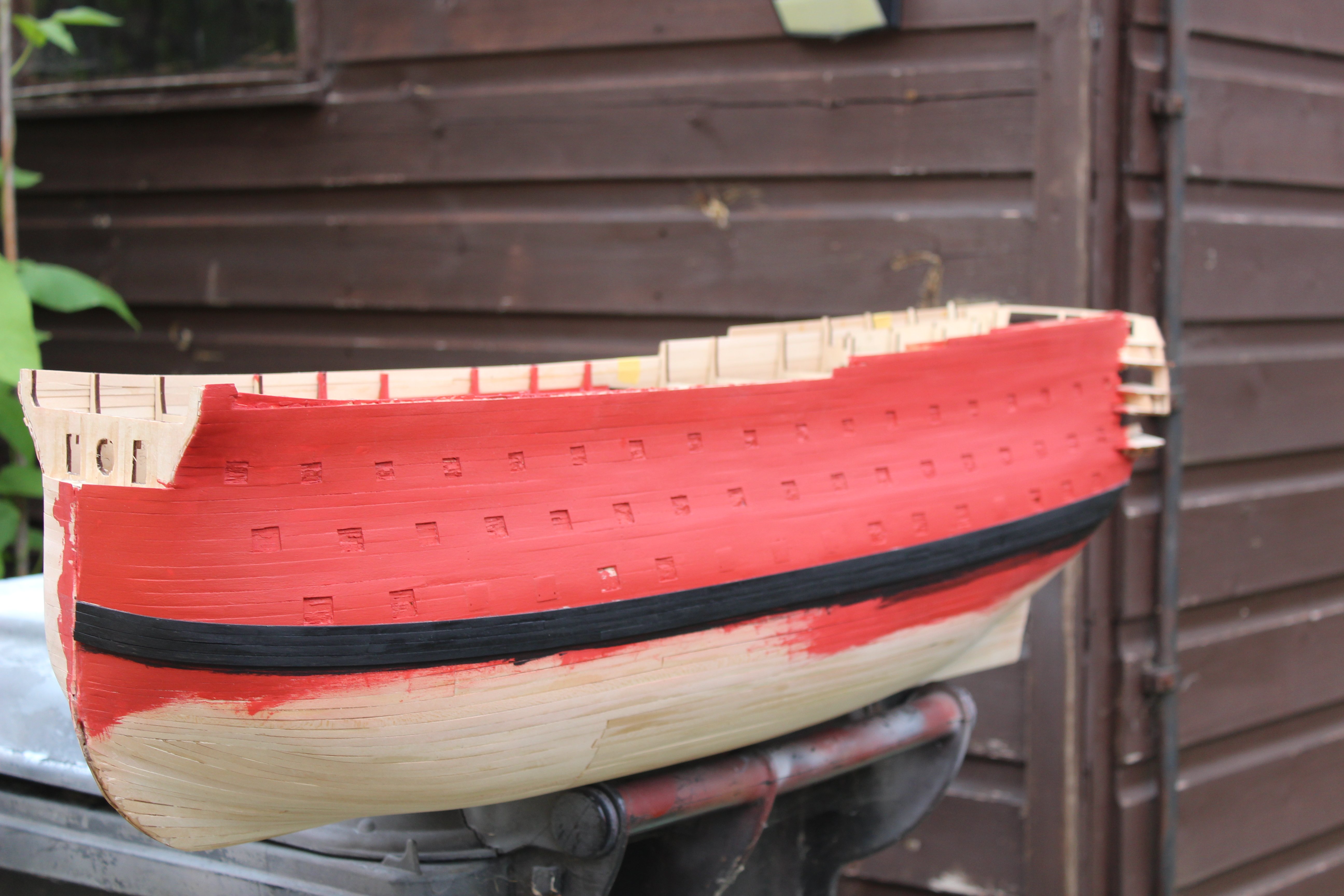

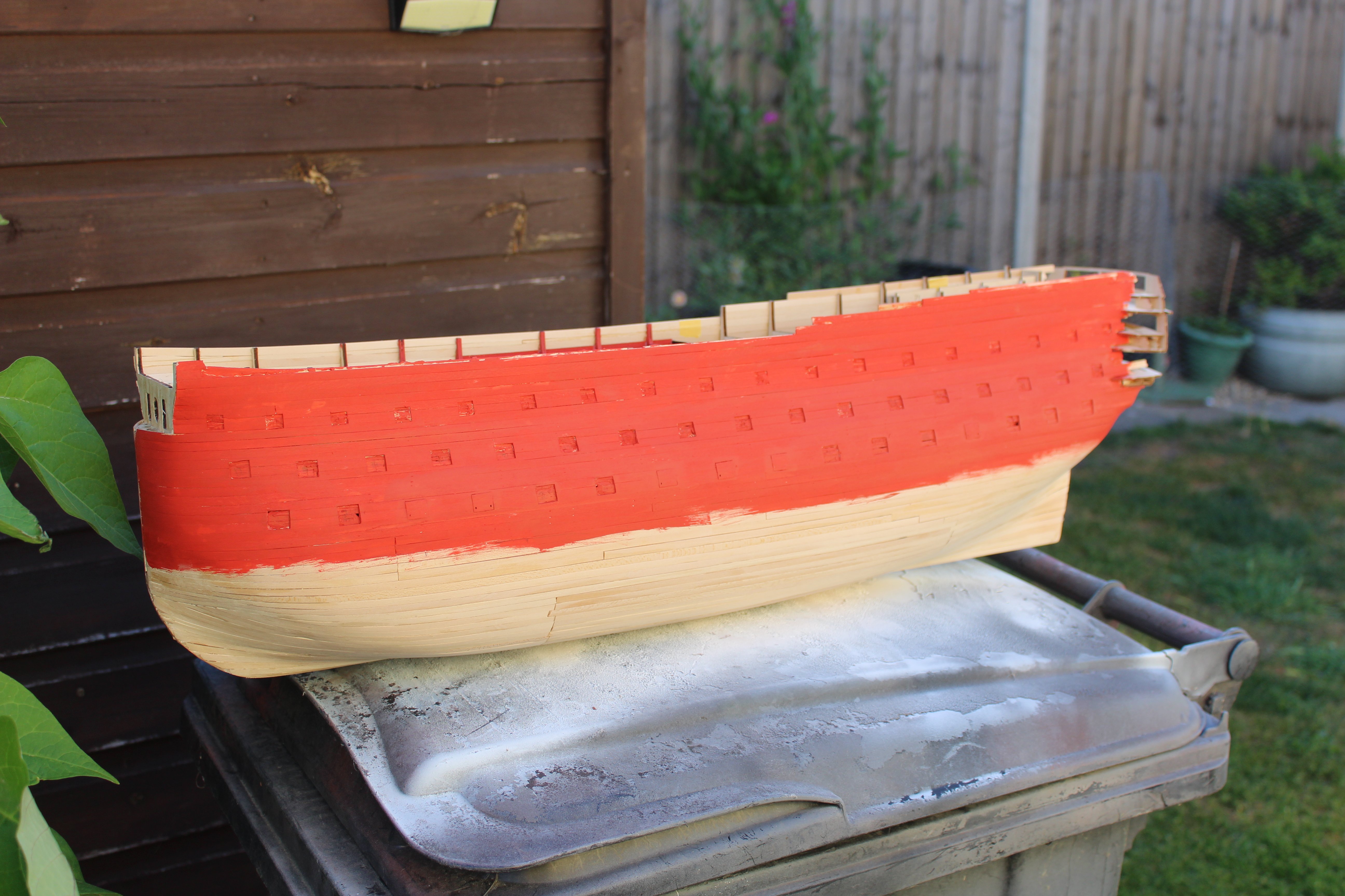

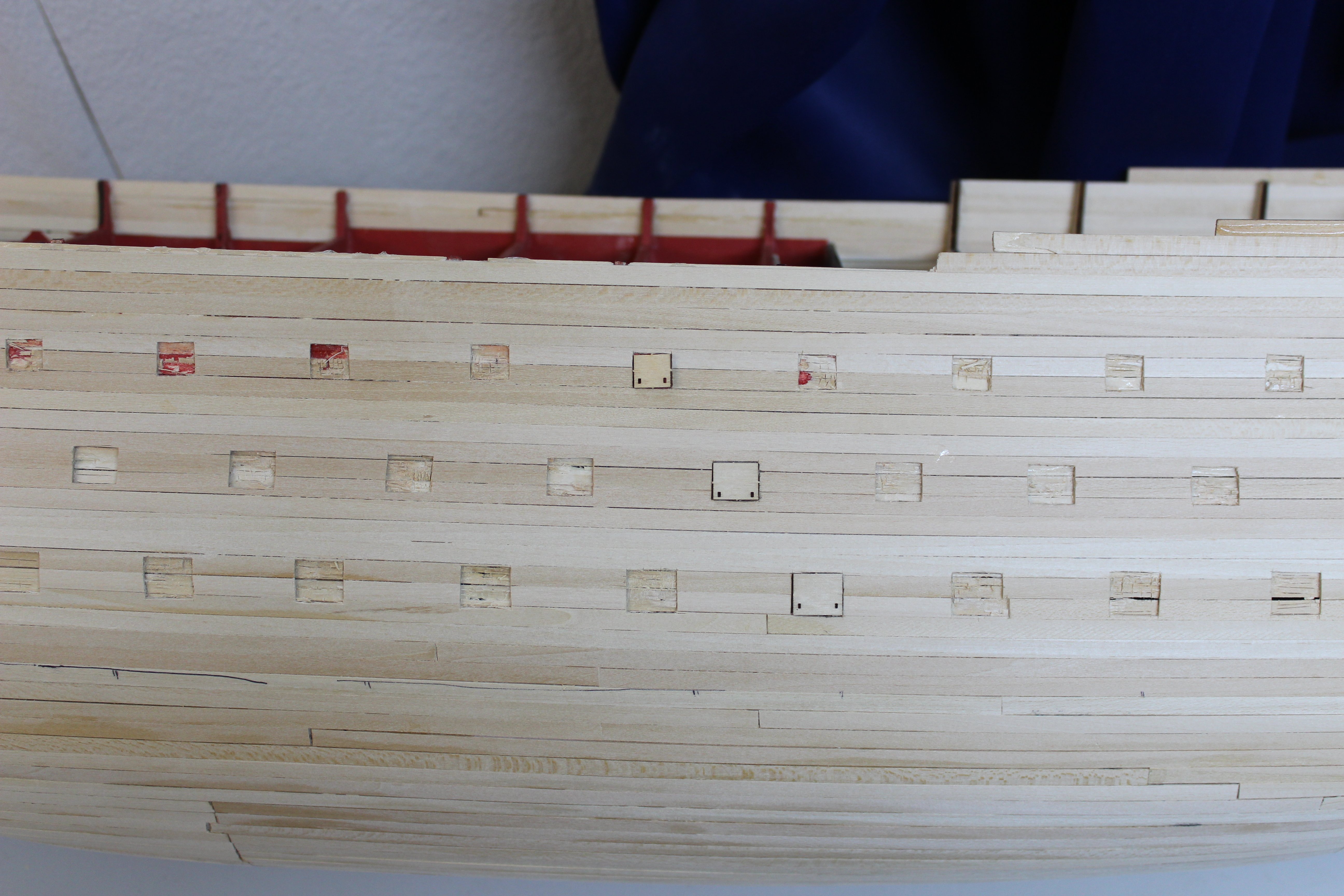

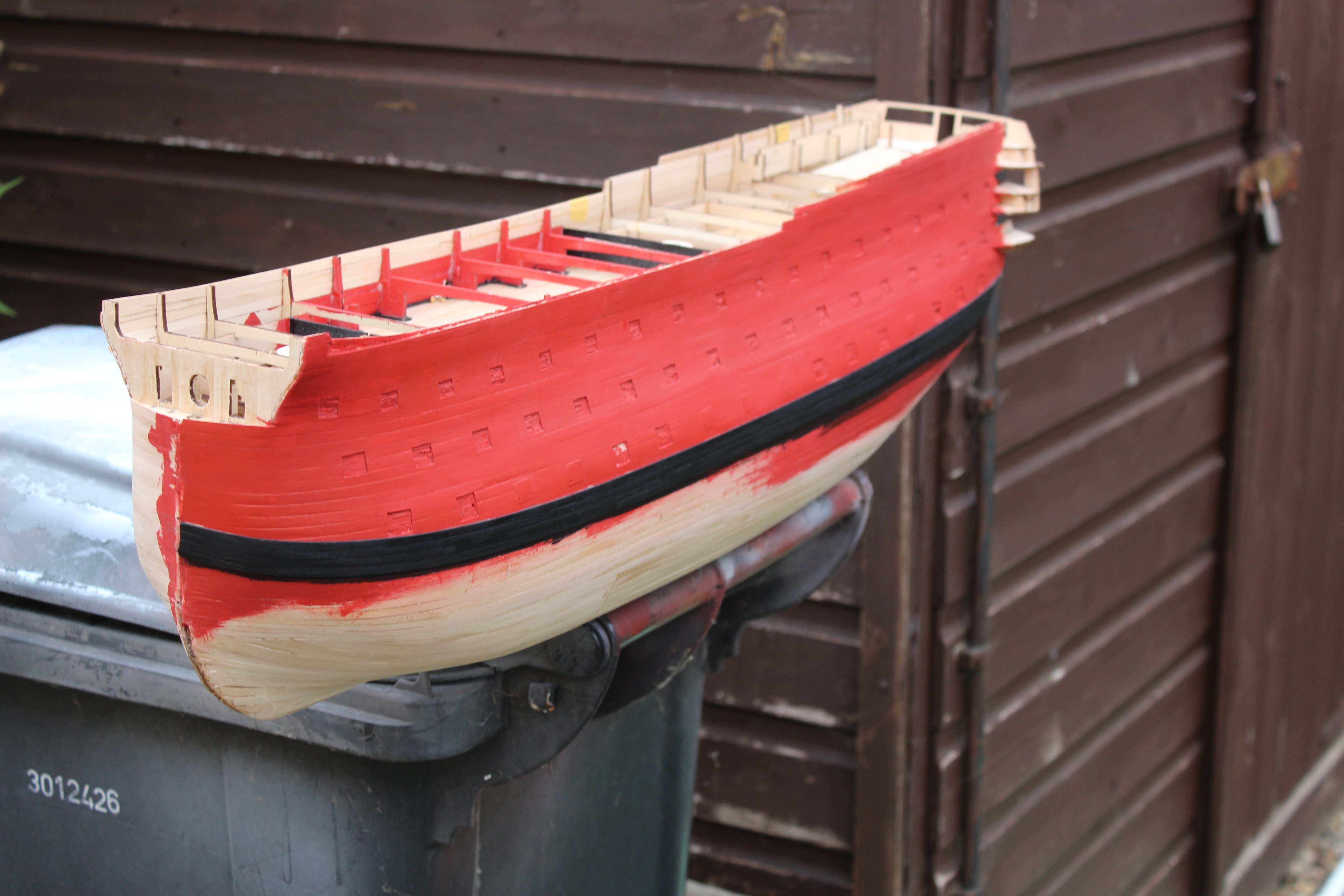

good morning everyone

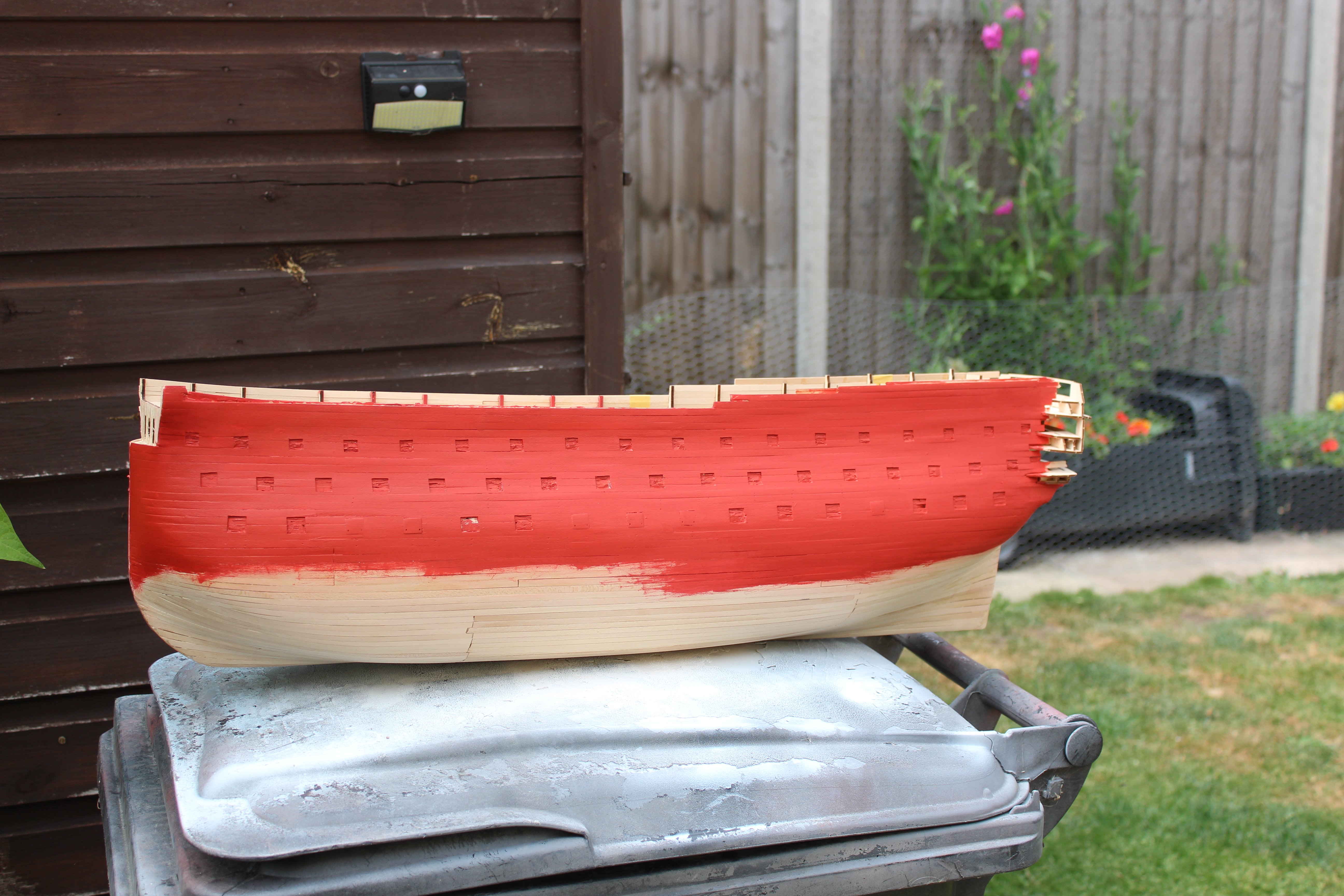

Wednesday day 22

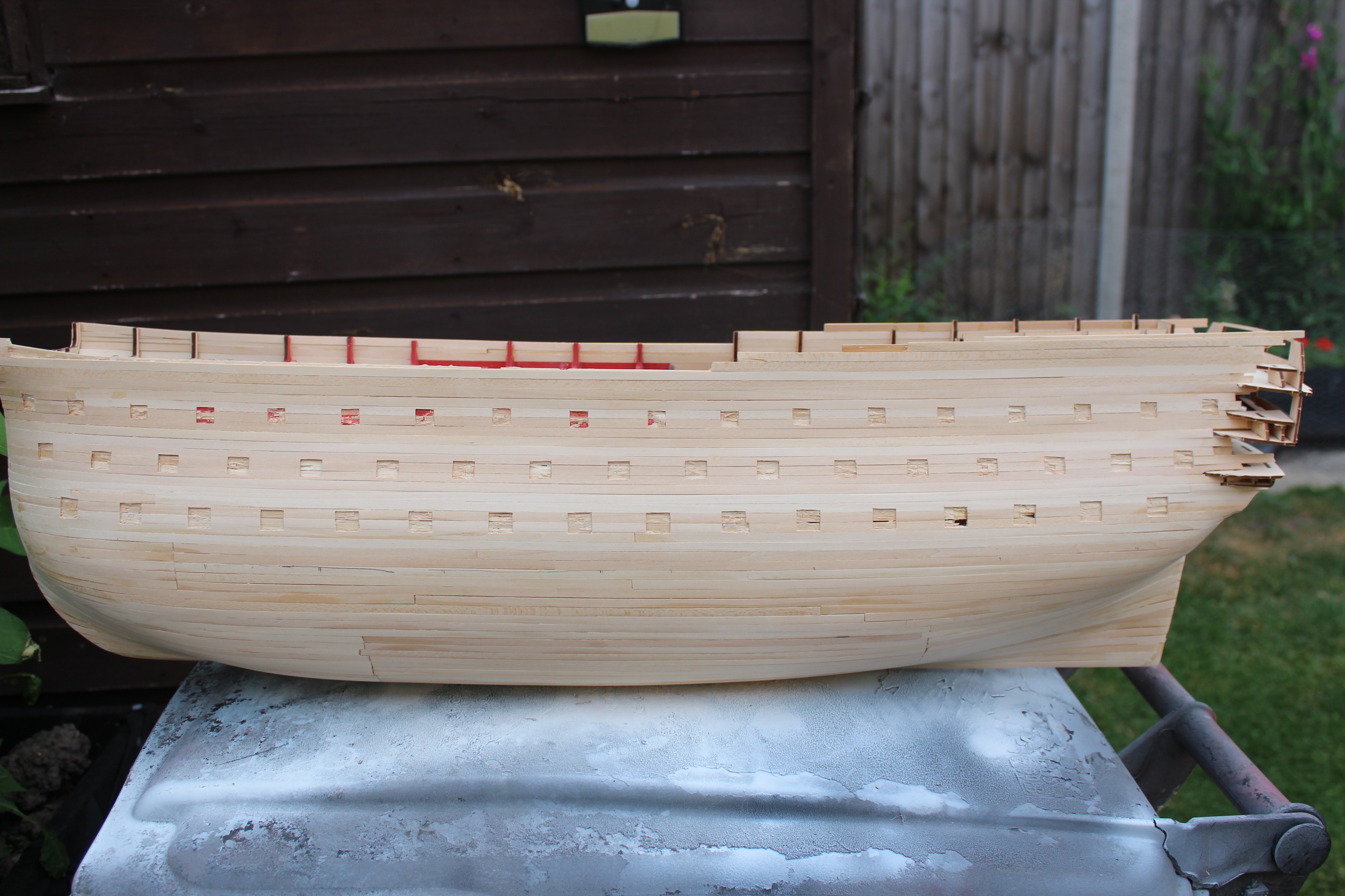

having  marked out where the gunports go, a lot of them have been rebated to accept the lids in the shut/closed position, i quickly realised these lids are going to have to be put on at a later date, because i was finding that the sanding of the hull was hiding them. Not regretting doing them like this, but i can understand people questioning my logic behind it, (lol i dont want all guns run out, when under full sail).
lots of paint added, and i am still sanding areas that refuse to look good, lower wale added to just give me the warm fuzzy feeling that i have most things in the right place
this idea does not work for me, putting the lids on and then finishing the hull, as the gaps fill up and they become invisibleIMG_3794-Copy.thumb.JPG.a612f0e893abf130924f52e91368f957.JPG
