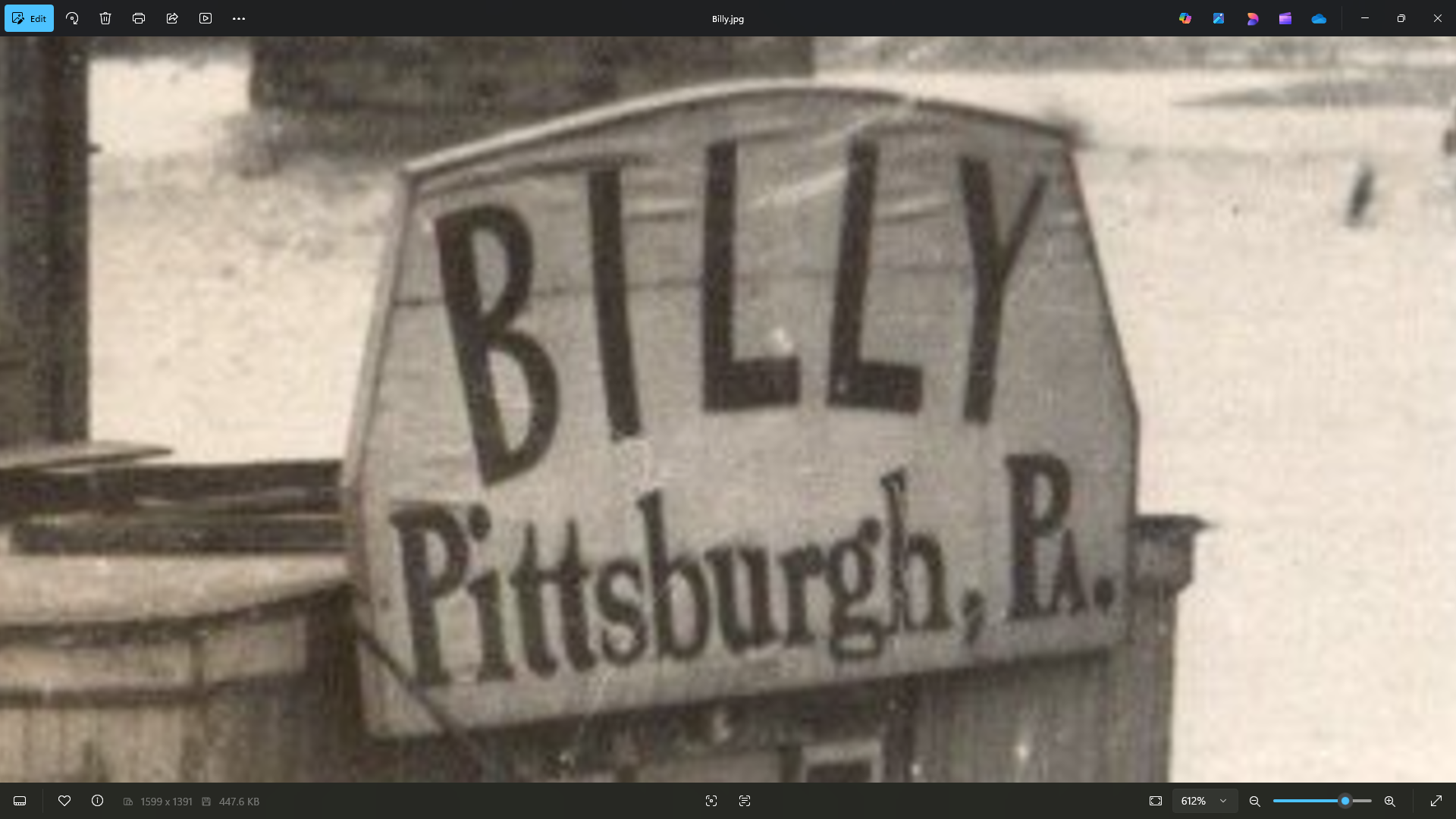

You've got 2 different fonts to deal with and the lettering on the original has sharp lines which will be hard to duplicate freehand at this small scale, especially the serif font of the "Pittsburgh, PA".
 I went to a serif font generator and Pittsburgh, Pa. is different than the lettering on Billy's name board. The ending "a" in the abbreviation Pa. is a lower case "a" not a small capital "A"
https://www.namecheap.com/visual/font-generator/sans-serif/
4 hours ago, Glen McGuire said:
I'm also wondering what causes those wrinkles near the top.  It almost looks like a stretched canvas that's not quite tight enough - like how my bed looks after I put the sheets on it!  That's the cool thing about these projects of yours - trying to figure out what's going on by just studying these old photos.
 Yes, the lettering was painted on canvas and badly stretched over horizontally run boards.

As to the wrinkles at the top of the aft sign, I think they might be paint blisters almost ready to flake off.  Can't be a fabric - the line through the name is a separation gap between two boards - in my opinion.
 Glad to see you've pulled up a chair, Kurt. Your vast experience and input is very much appreciated.
 After viewing countless times under heavy magnification I'm certain that the lettering was done on canvas, you can see the tack strips on the edges of the name board.
Scale 'canvas' = silk span! Scale lettering = "Hmm... you're on your own with 'that' one!" LOL
Pretty sure those are in the photo itself. You can see the wrinkles extending up from the sign, over the bridge pier and bridge.
EDIT: I posted on Page 6 without noting that discussion continued on to Page 7. I agreed with Kurt that it really looks like it's painted over boards, but I haven't done the exhaustive close-up looks Keith has. Are you certain that the tacks you see aren't nailed attaching the boards to inner framing? It would look much the same.
 Eric, I think it's painted canvas stretched over board but I could be wrong. I've been wrong so many times lately I've lost count.

1 hour ago, tmj said:
Sign looks as though it has a proud wooden border / frame surrounding it...
 Nicely magnified image. That proud wooden border is what I think are tack strips, Tom.

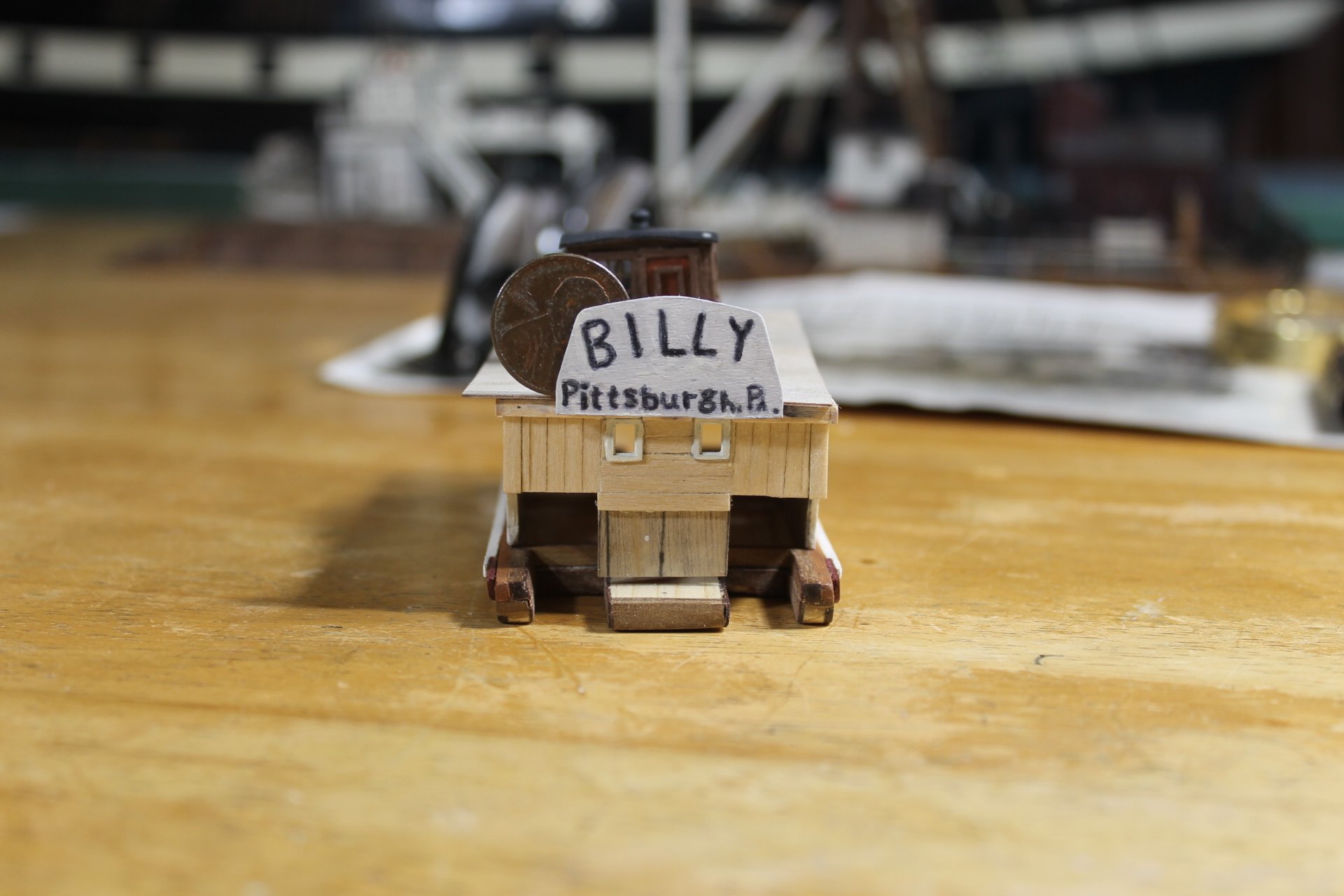

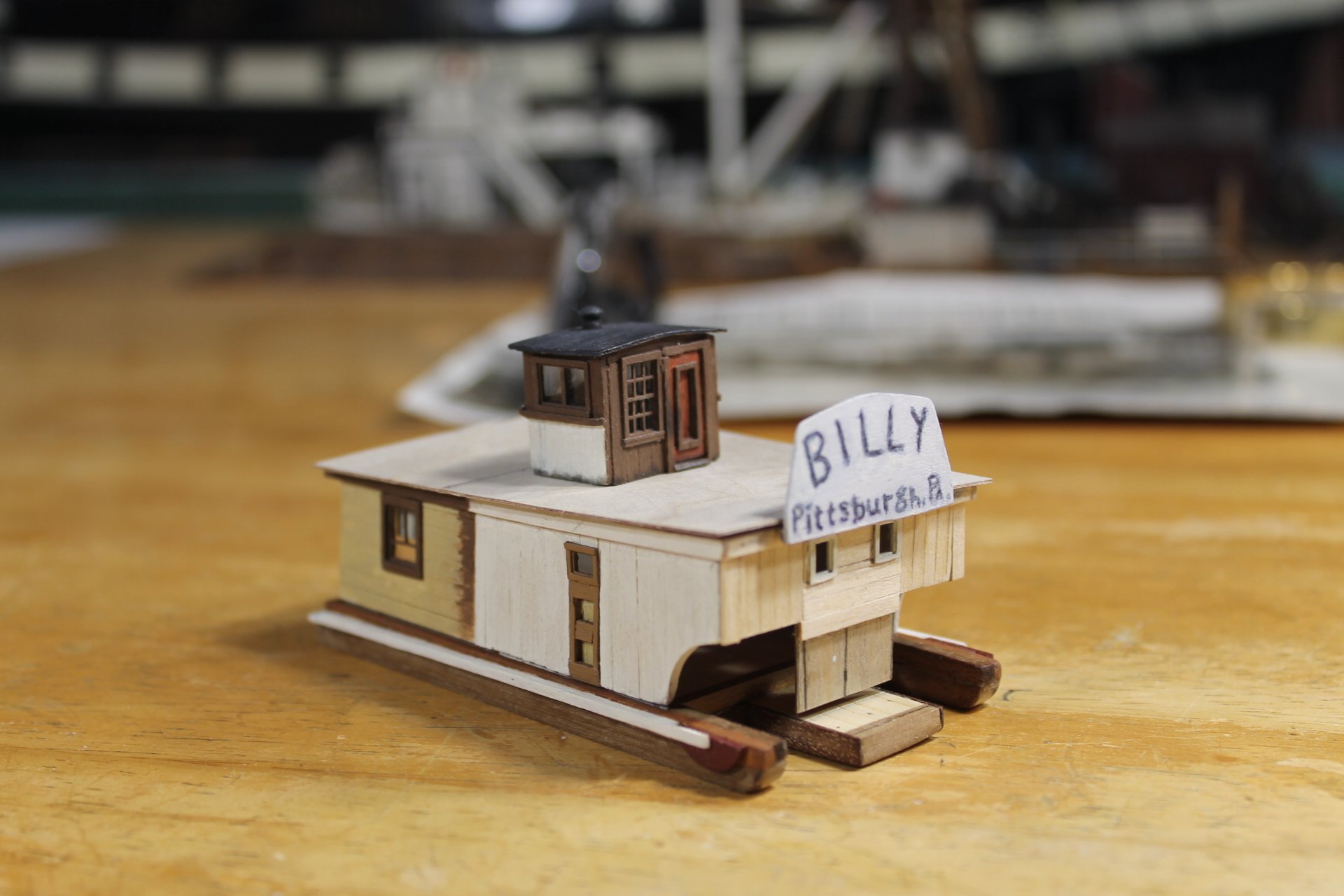

 Name board 1.0D75E9391-D3C9-4A30-970E-5C89F28AAD4A.thumb.jpeg.d8cbc8ed08aff8086d4fc8787eda7932.jpeg

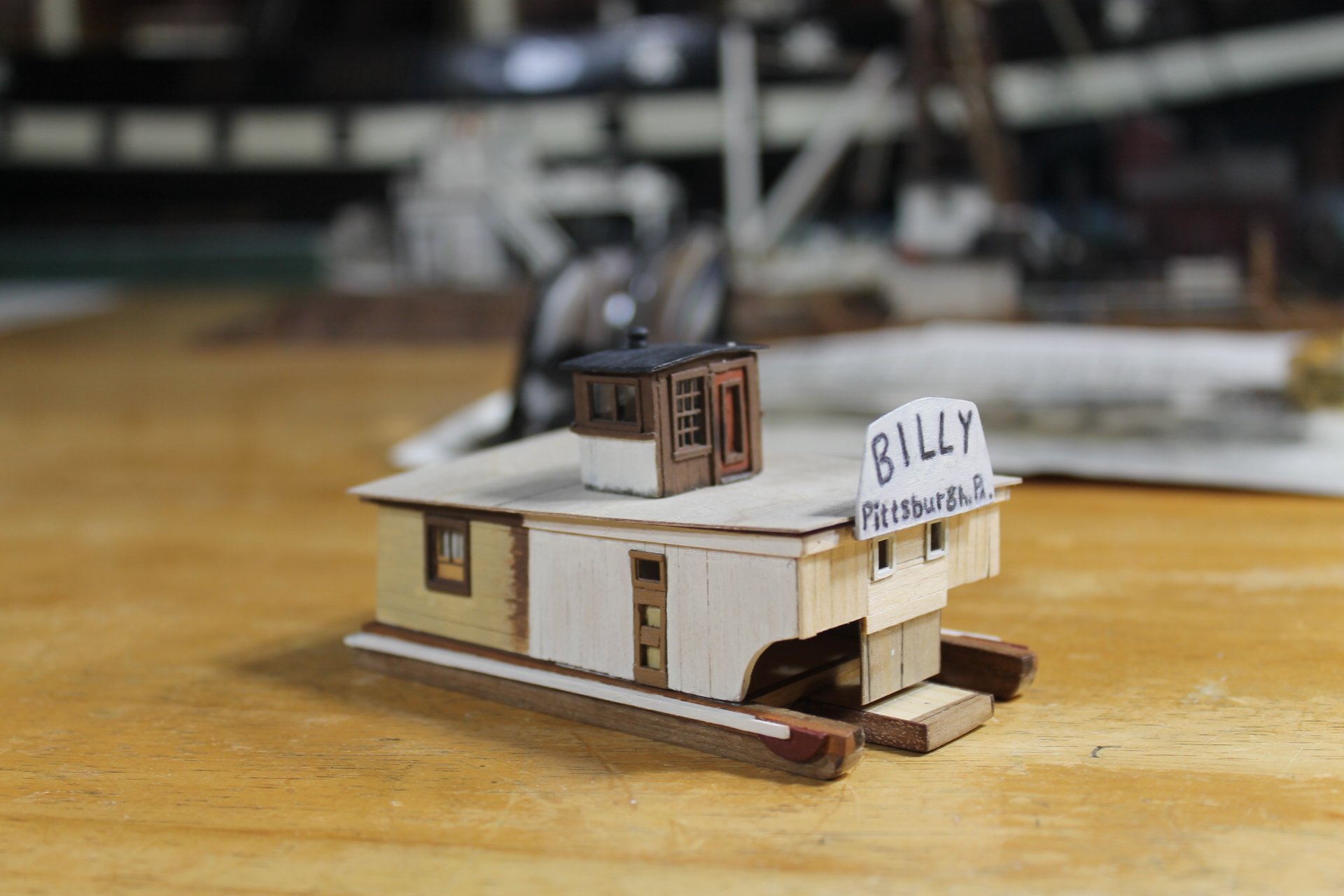

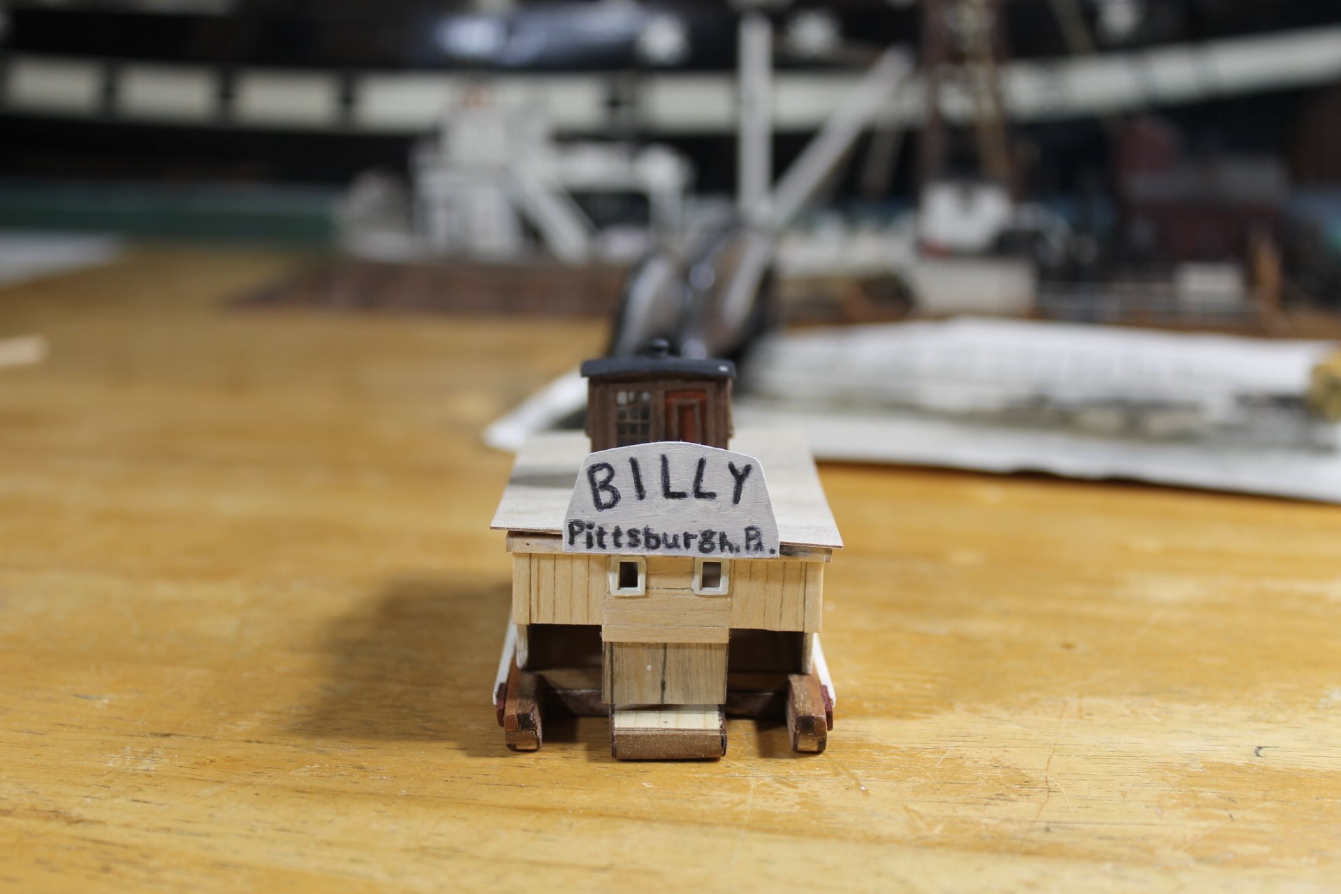

 Name board 2.0. Lettering was washed with heavy watered down white paint.
 And finally name board 3.0. The letters are hand painted with acrylic craft paint. I know there are thousands upon thousands upon thousands of folks that can do ten times better than I on this lettering on the name board but this is the best I can do. I'm done trying to do any better, I'm calling it done with 3.0, no mas.
 Please believe me when I say this looks a lot better at normal viewing distance than in a close up photo.
 The penny for size comparison. Most of the lower case letters are 0.10" high, some a bit smaller.

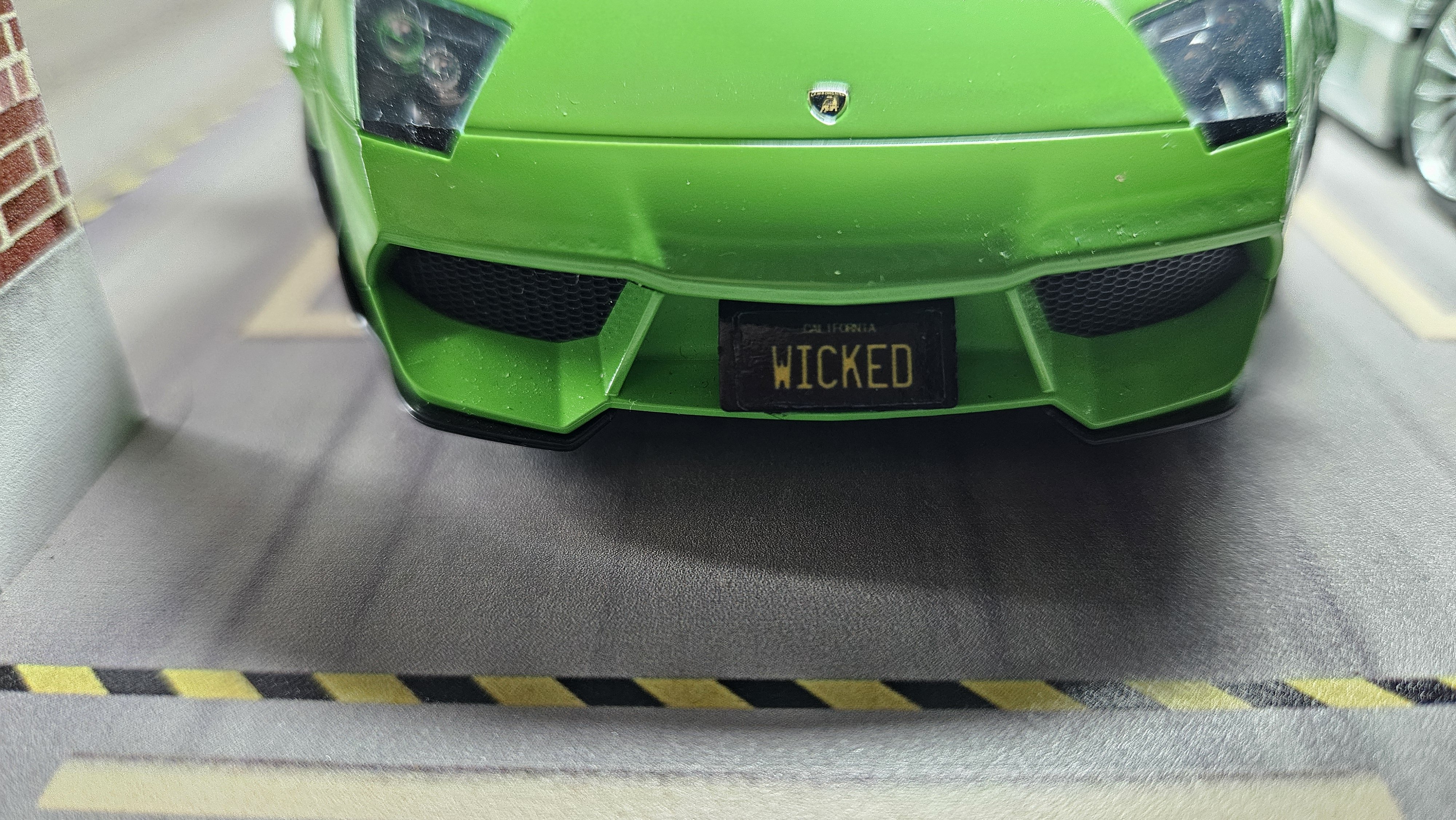

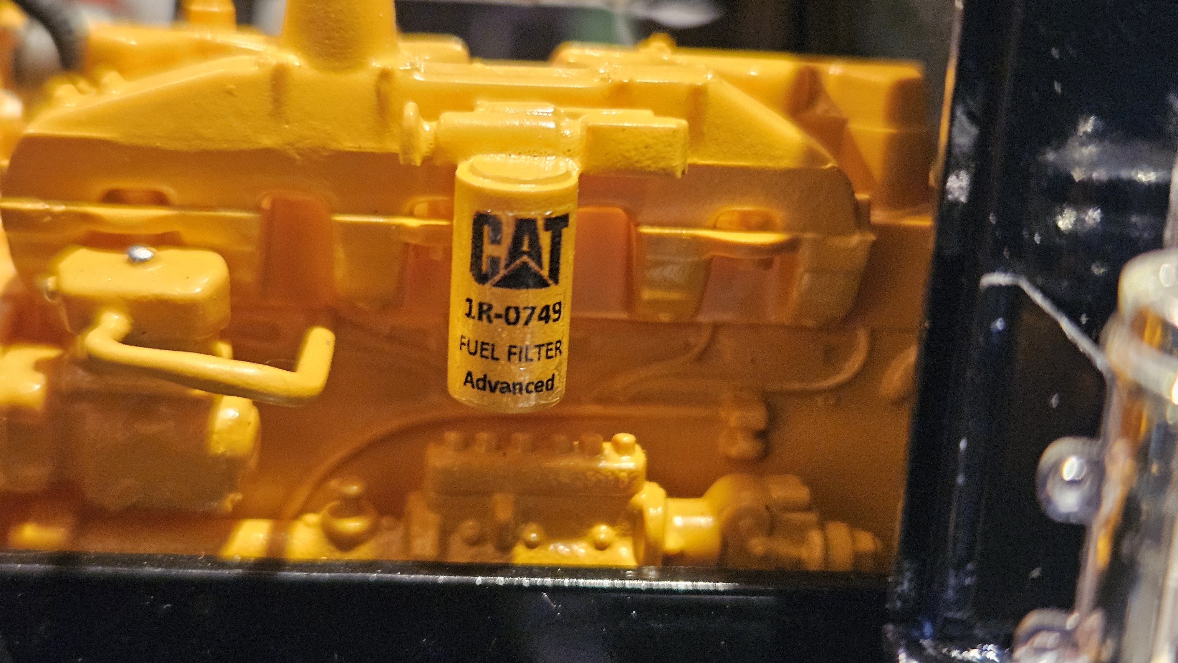

I have done the home made water slides on cars to nice effect.  Definitely worth a try if you haven't done them before!
Fuel filter decal...
Seat cover decal...
Custom license plates...
You need decal paper, acrylic clear coat and decal setting solution but it is sure fun!

That followup zoomed in photo means I could go either way on the fabric vs board debate. Either is believable as a method used on the real thing. There's definitely distortion in the photo itself but other aspects of that view do imply fabric. Whatever Keith decides on this one will make sense and look right.
 The finished name board on my model of Billy is 1/64" birch ply so it really doesn't matter how Billy's original name board was constructed as I won't be trying to replicate the wrinkles/bubbles. It's purely the opinion of each individual viewer and each opinion is as good as the other.
