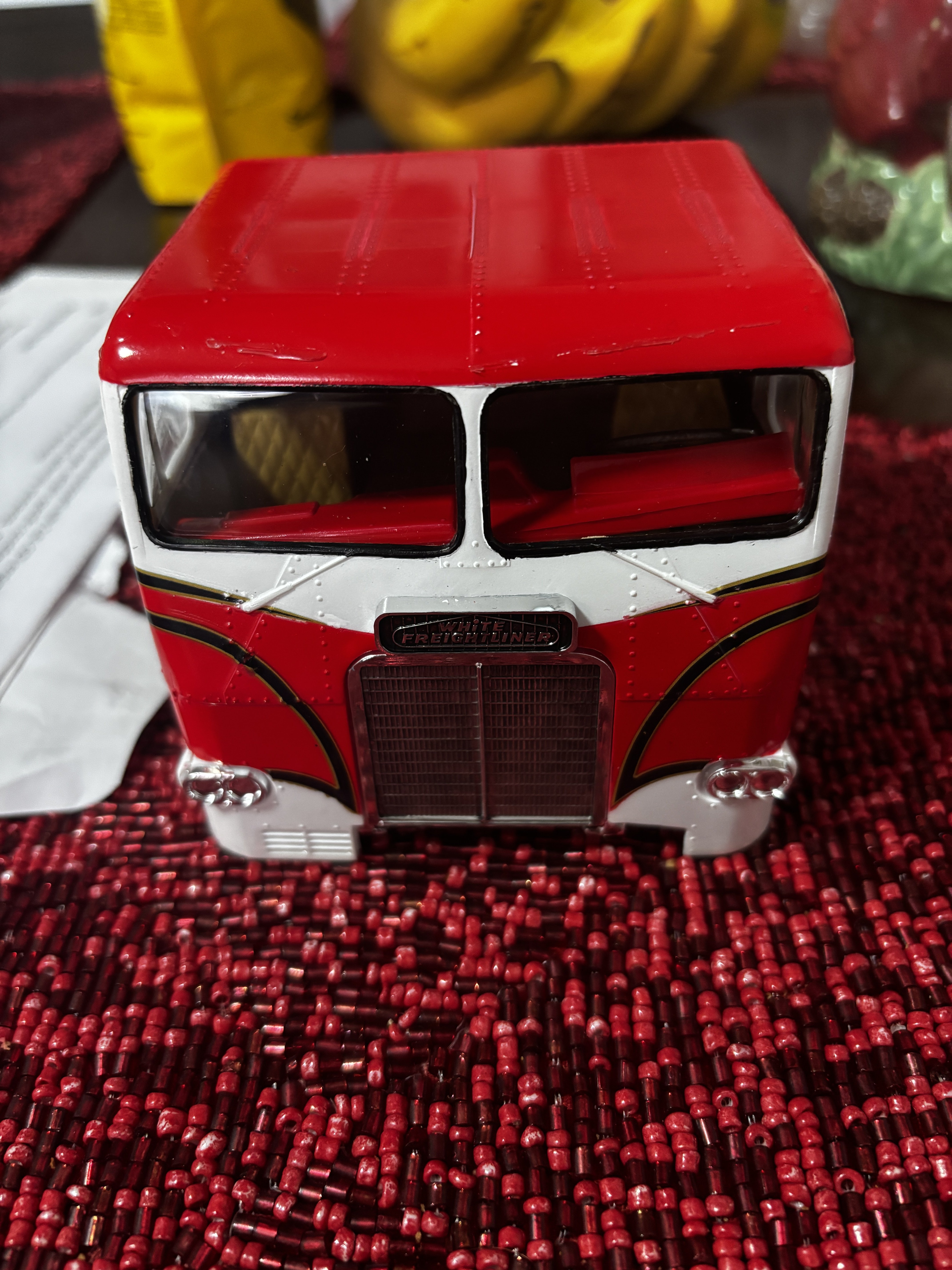

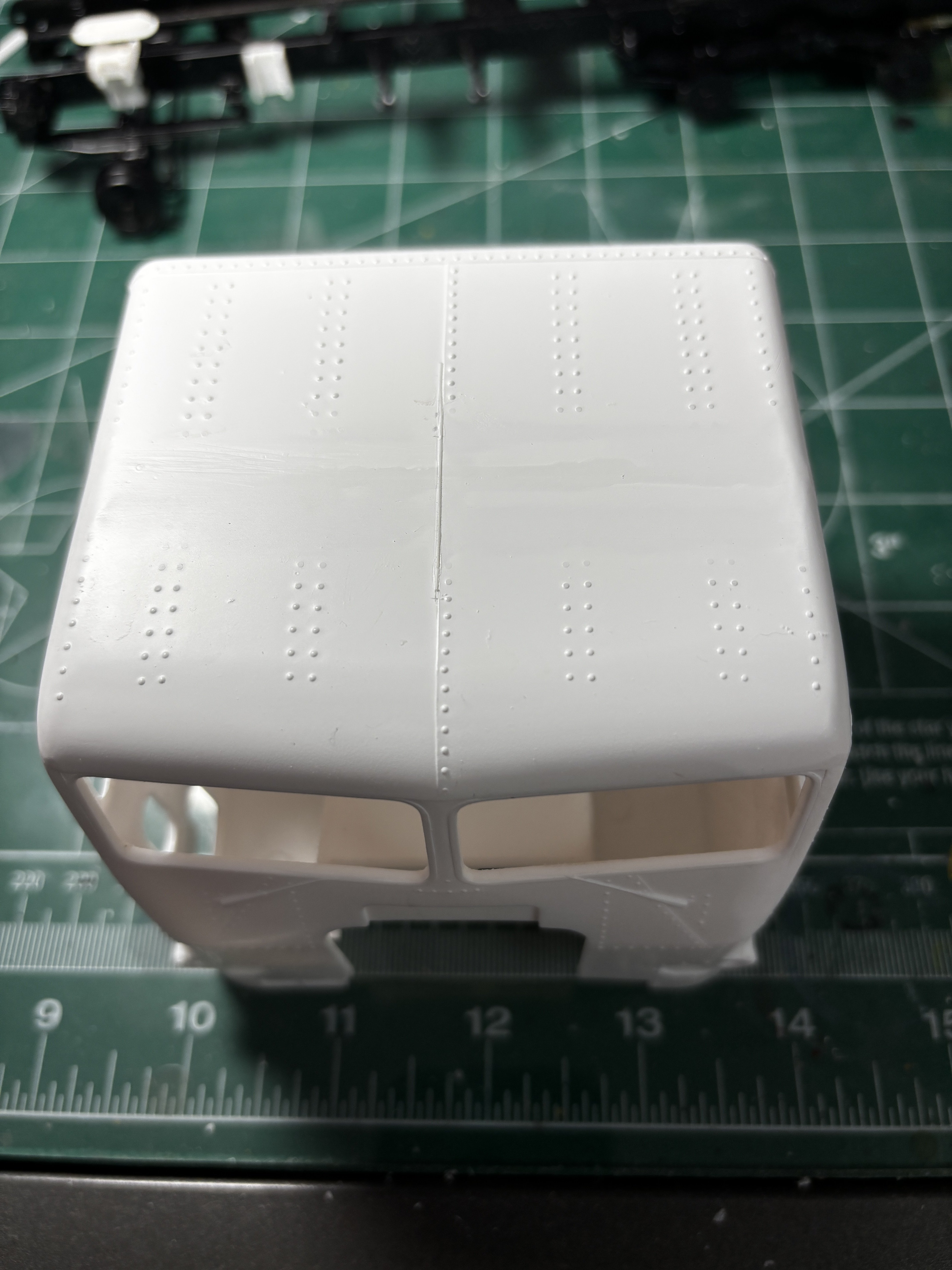

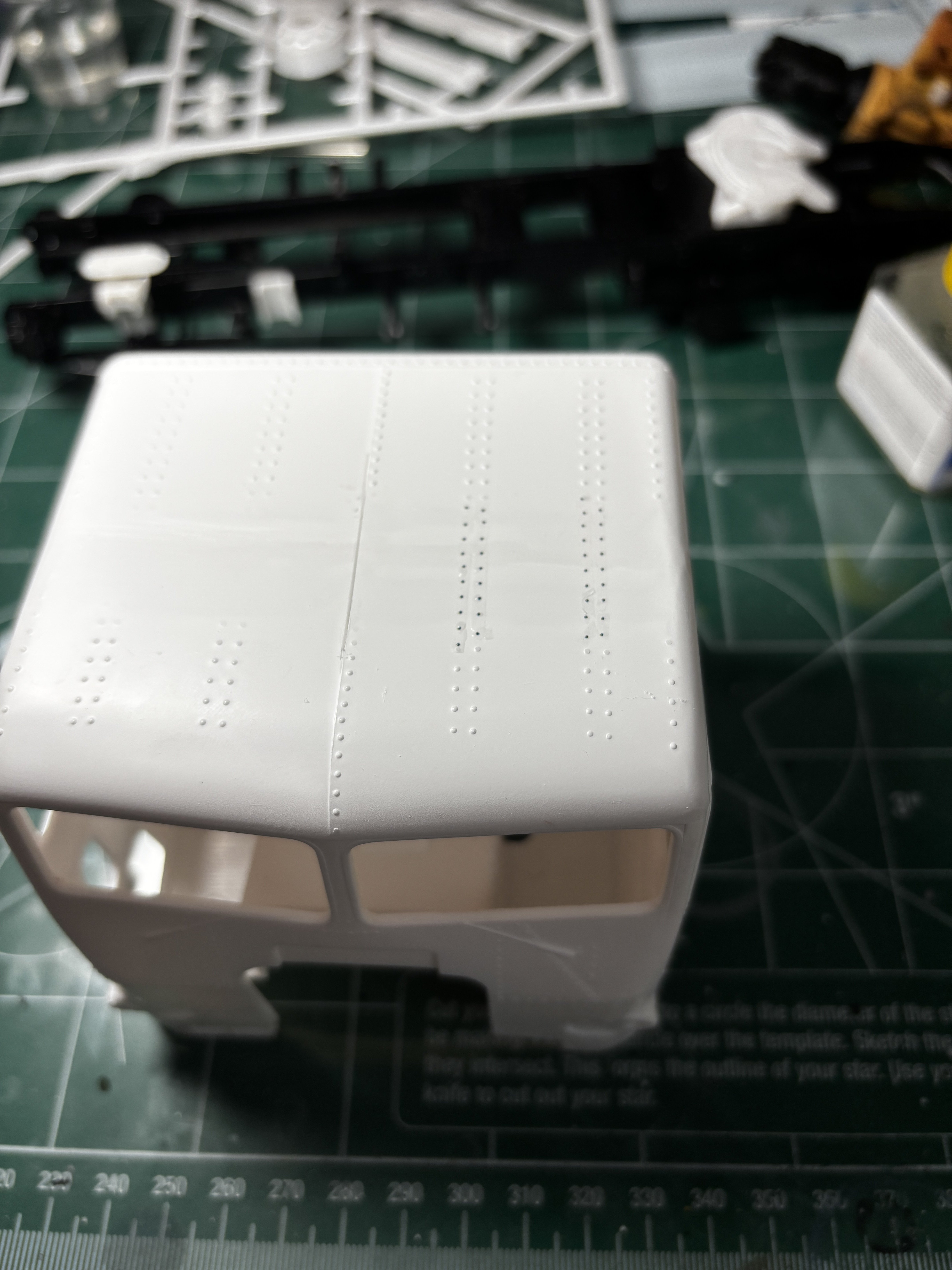

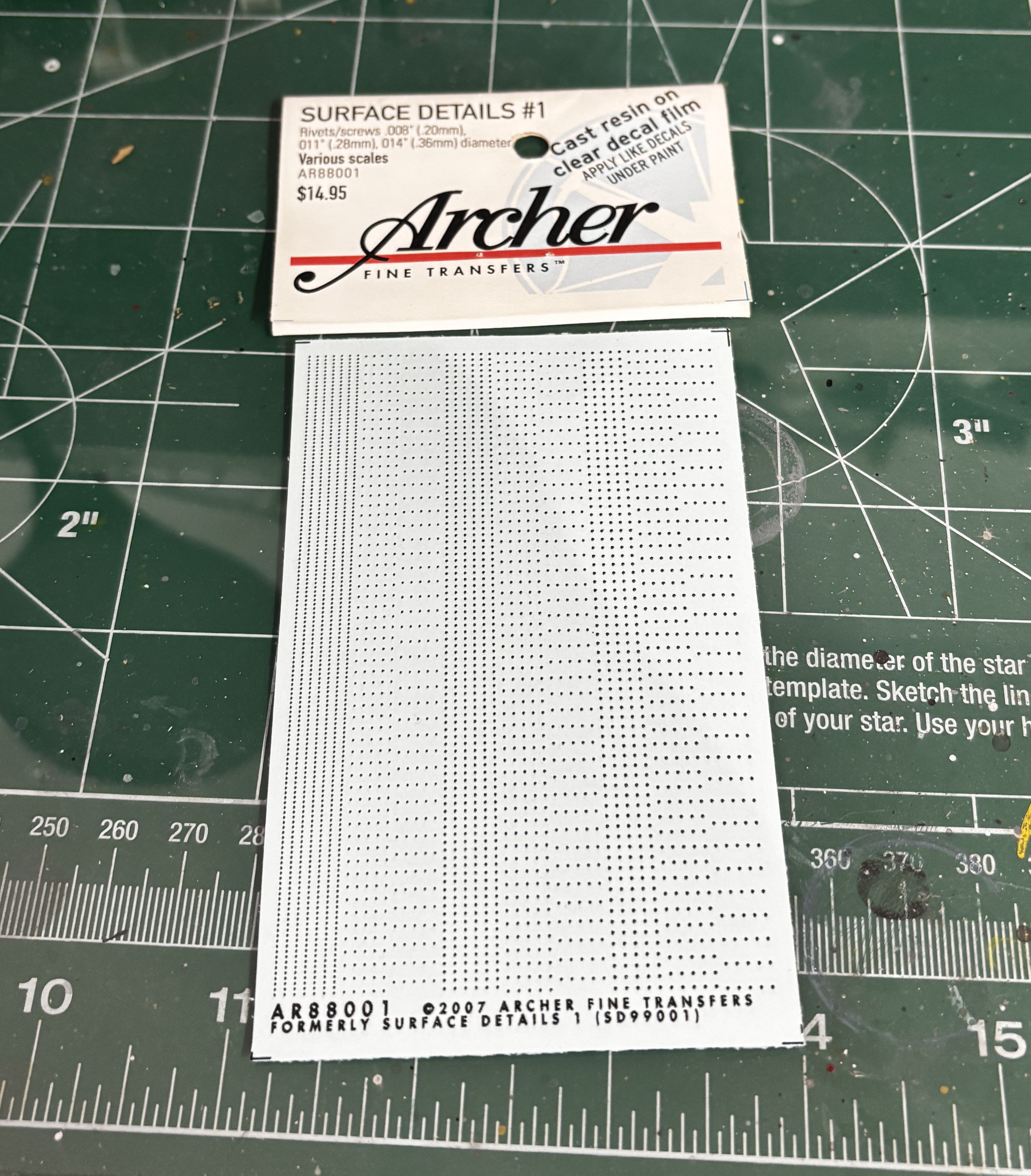

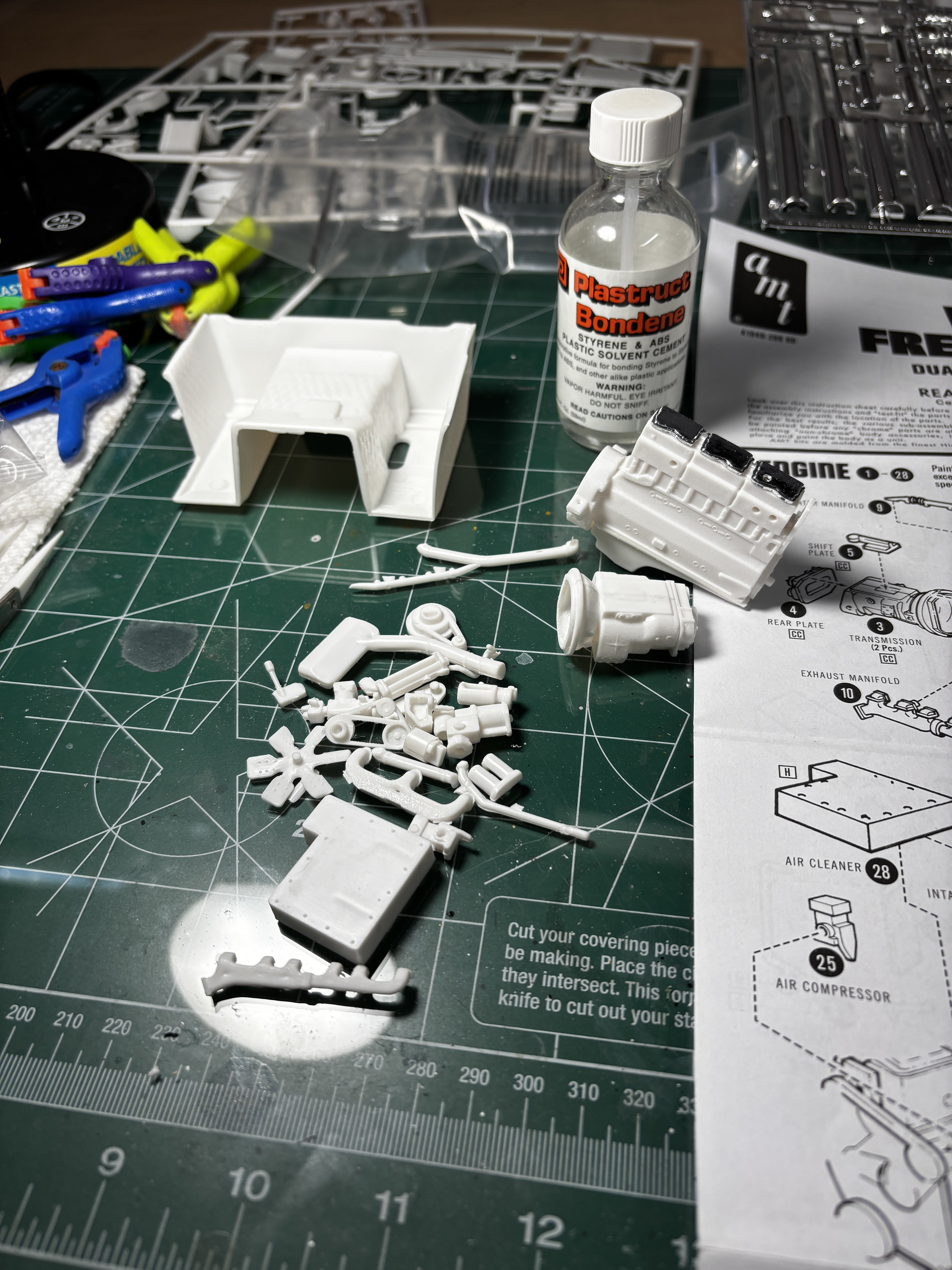

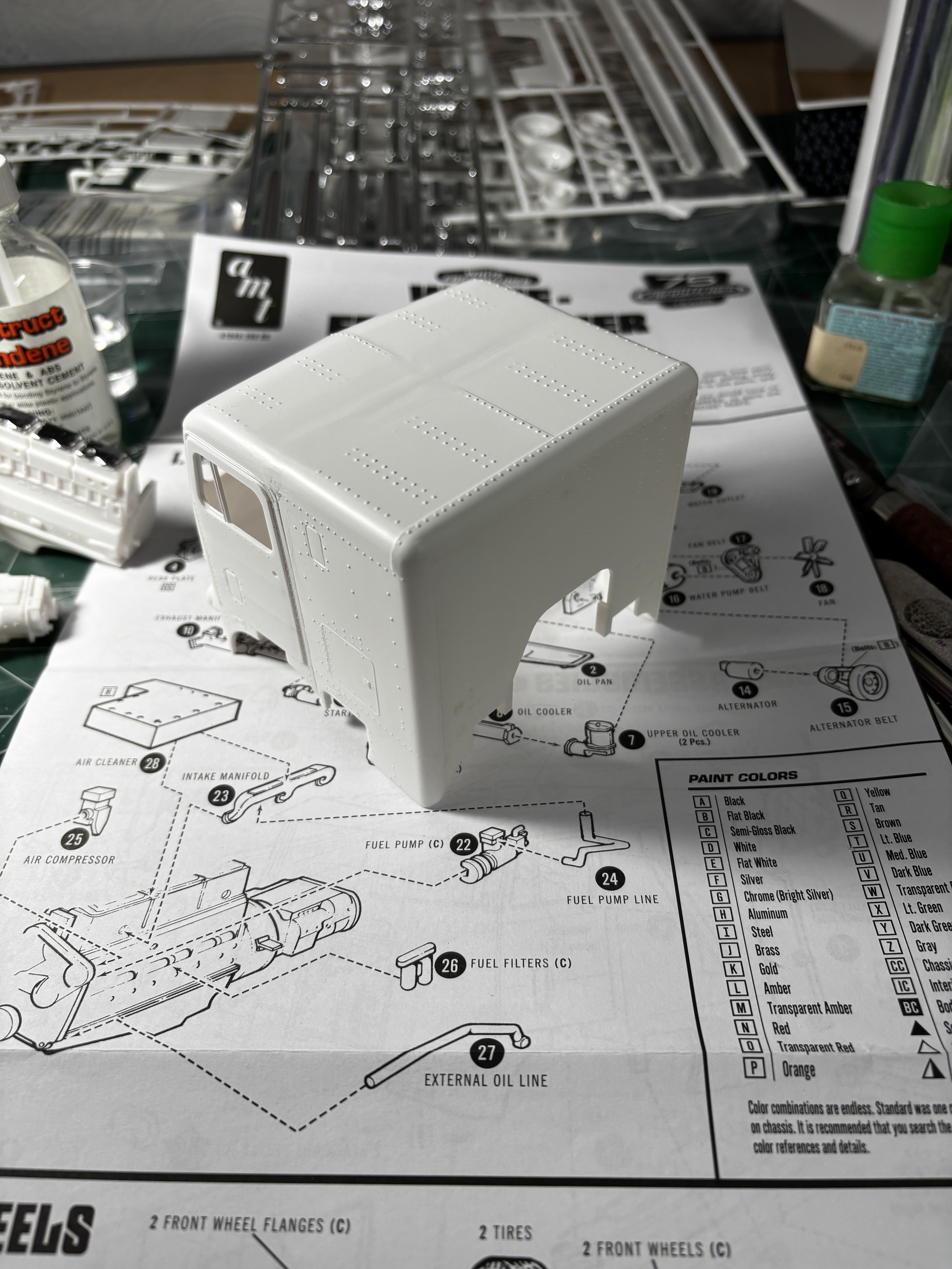

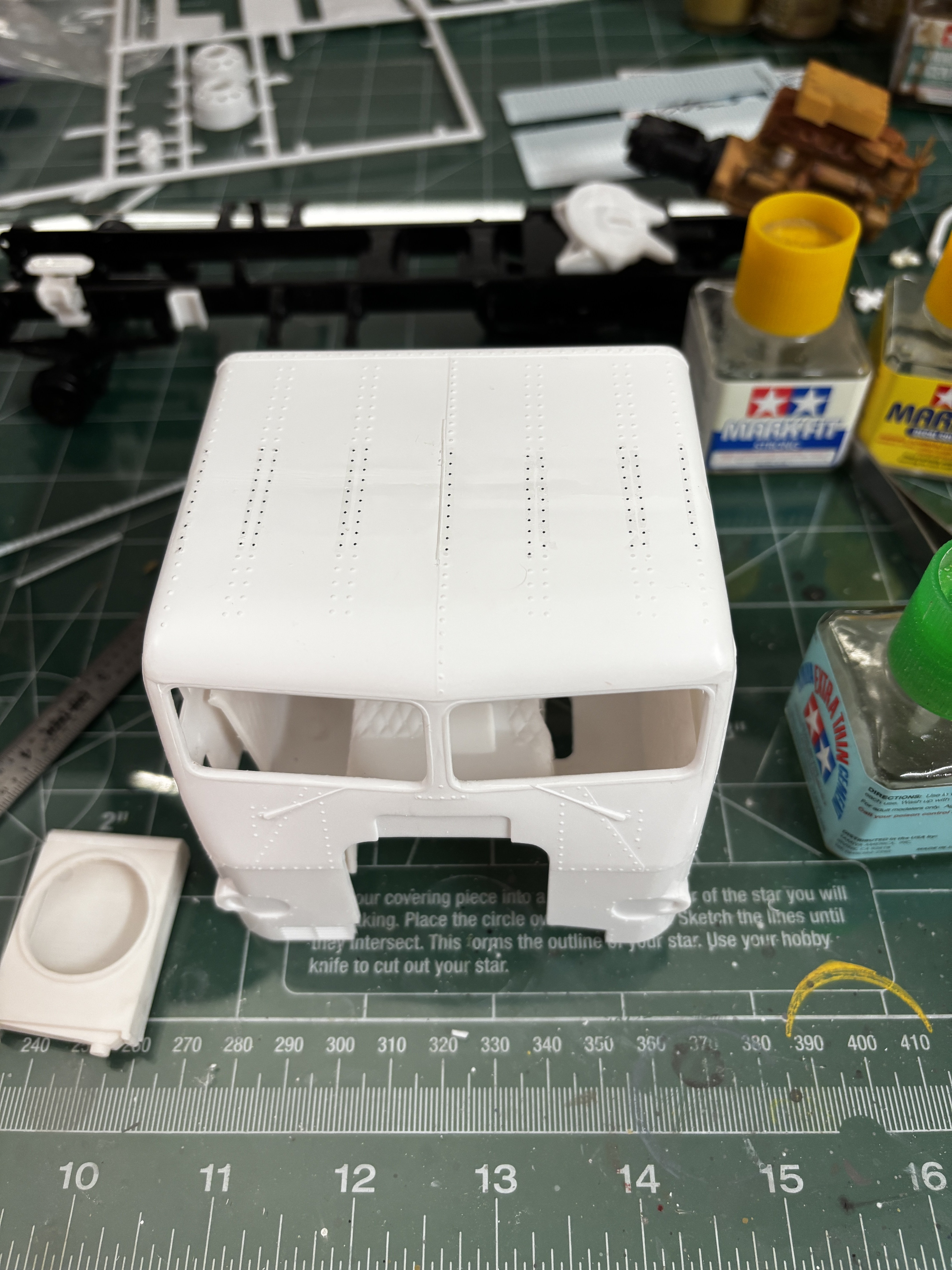

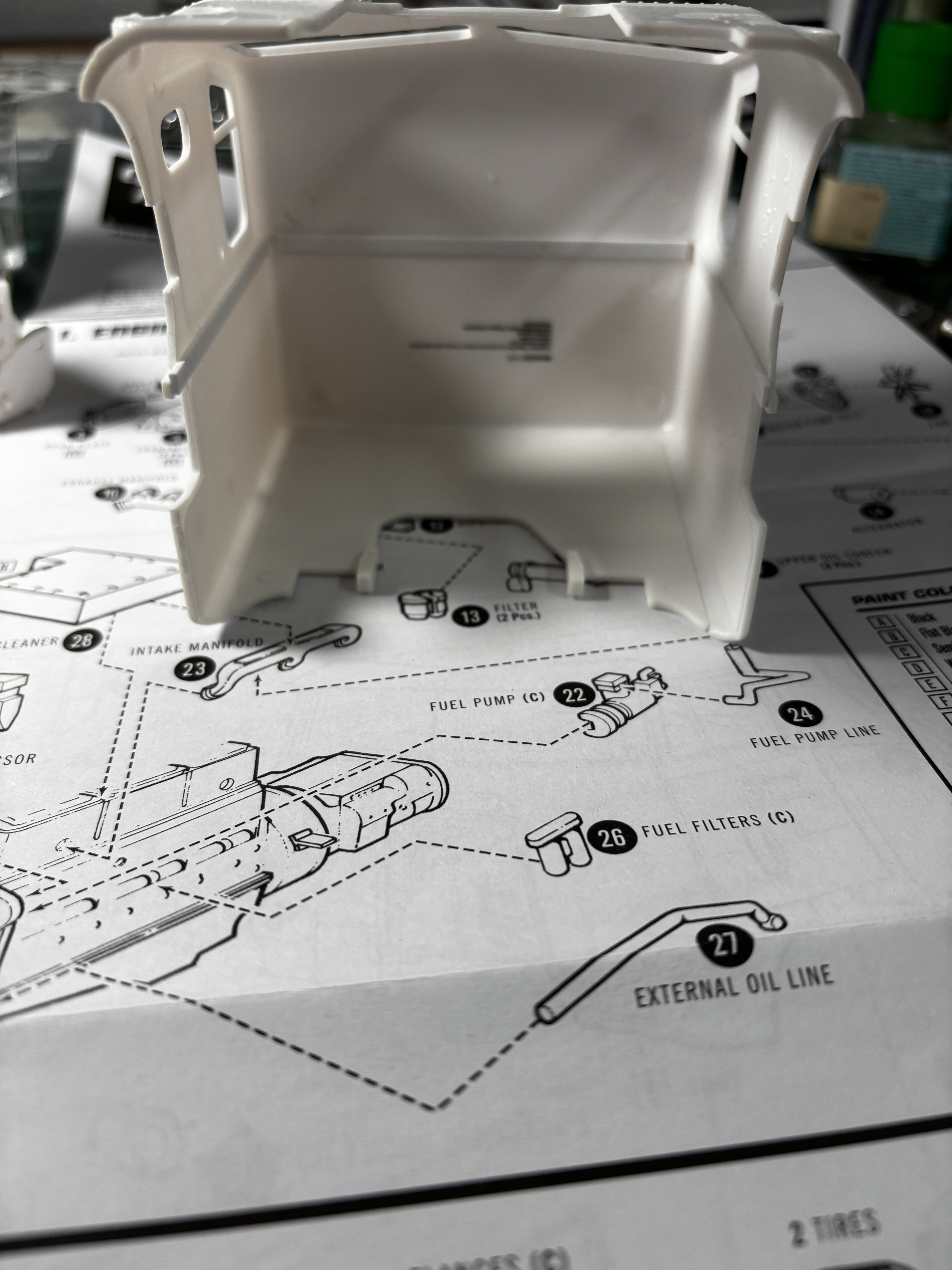

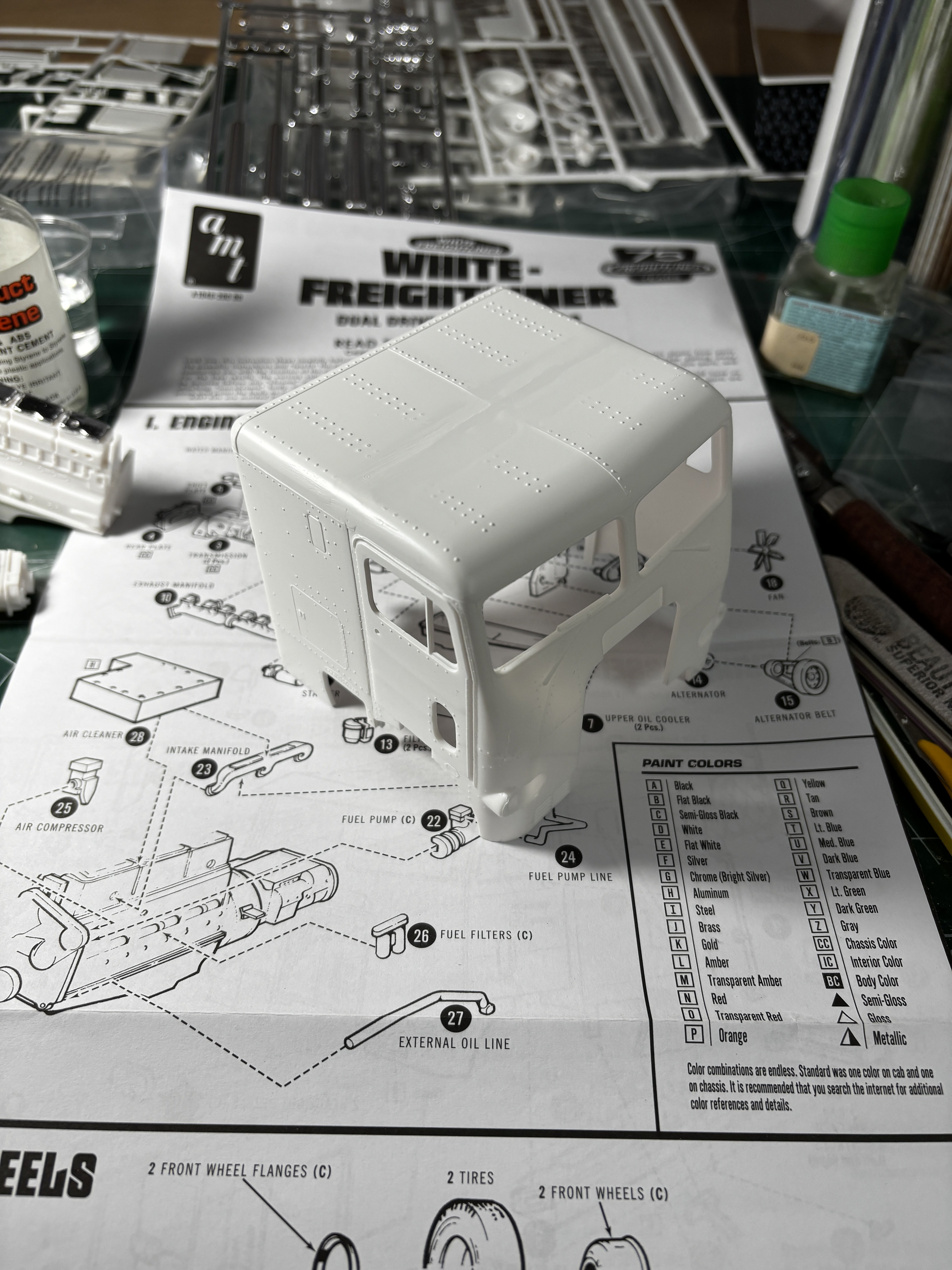

After all these years, this is the very first time I have ever attempted to build a semi tractor model. This one is a re-released, very old mold of the White-Freightliner. It can be built as an SD model (short cab) or as the DD model (extended cab with sleeper). Mine will be built as the extended cab DD model. The first thing I noticed was the troublesome seam created by attaching the sleeper to the cab. Because there is raised rivet detail, it's going to take some work to smooth out the join area, particularly the top. Will probably need to sand off all the rivet detail then replace it with some Archer decal rivets. I didn't have any of those on hand but placed an order for some that should arrive later this week. I used styrene strip stock to reinforce the joint and help keep it in alignment. The strip stock will create some issues when later fitting the interior tub inside the cab, but that can be overcome with a little work. For the time being, I will work on the engine, transmission and frame assemblies. I plan to follow the box art as my painting guide. This re-release does include a nice decal sheet to recreate the graphics as seen on the box.

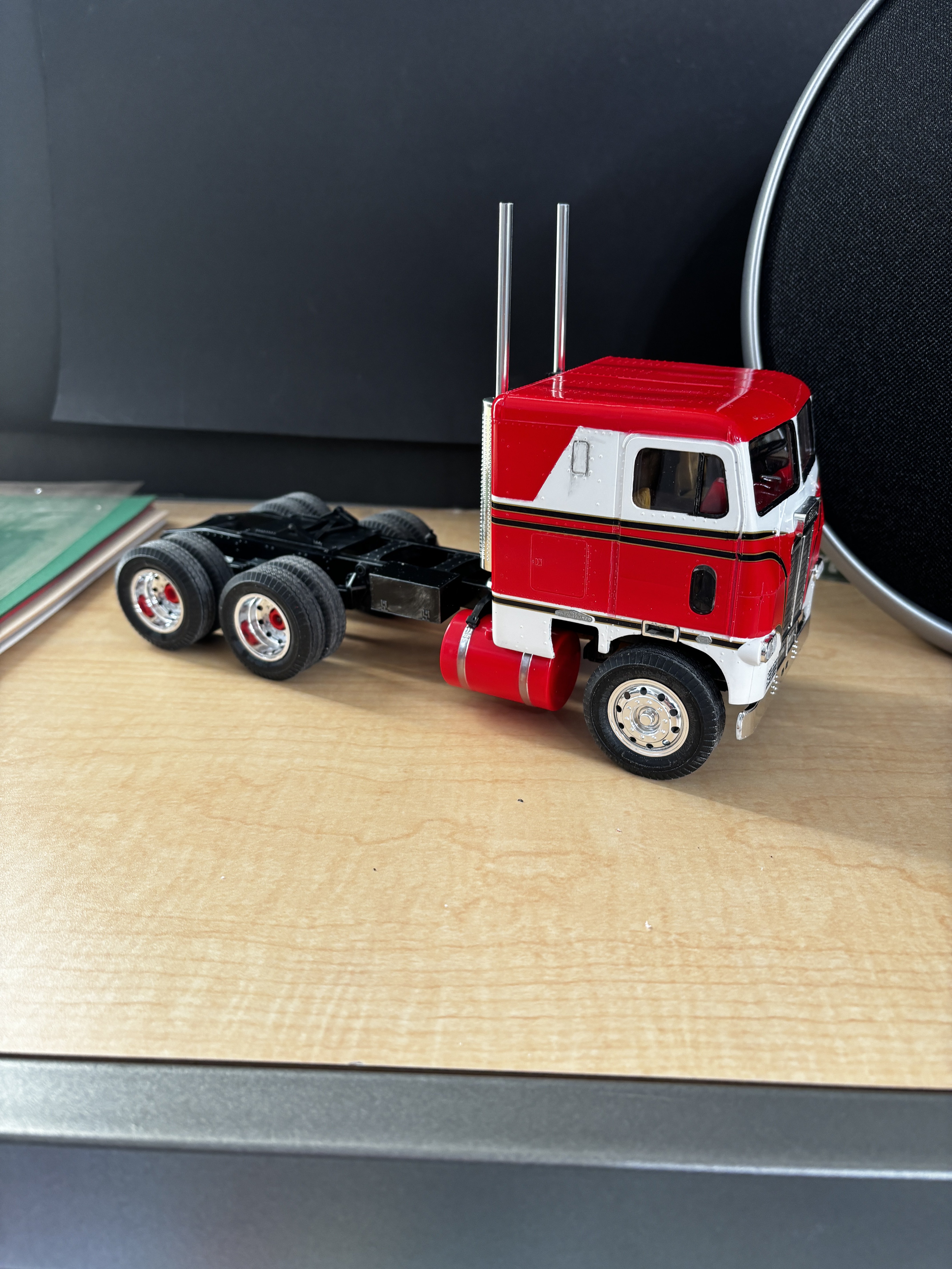

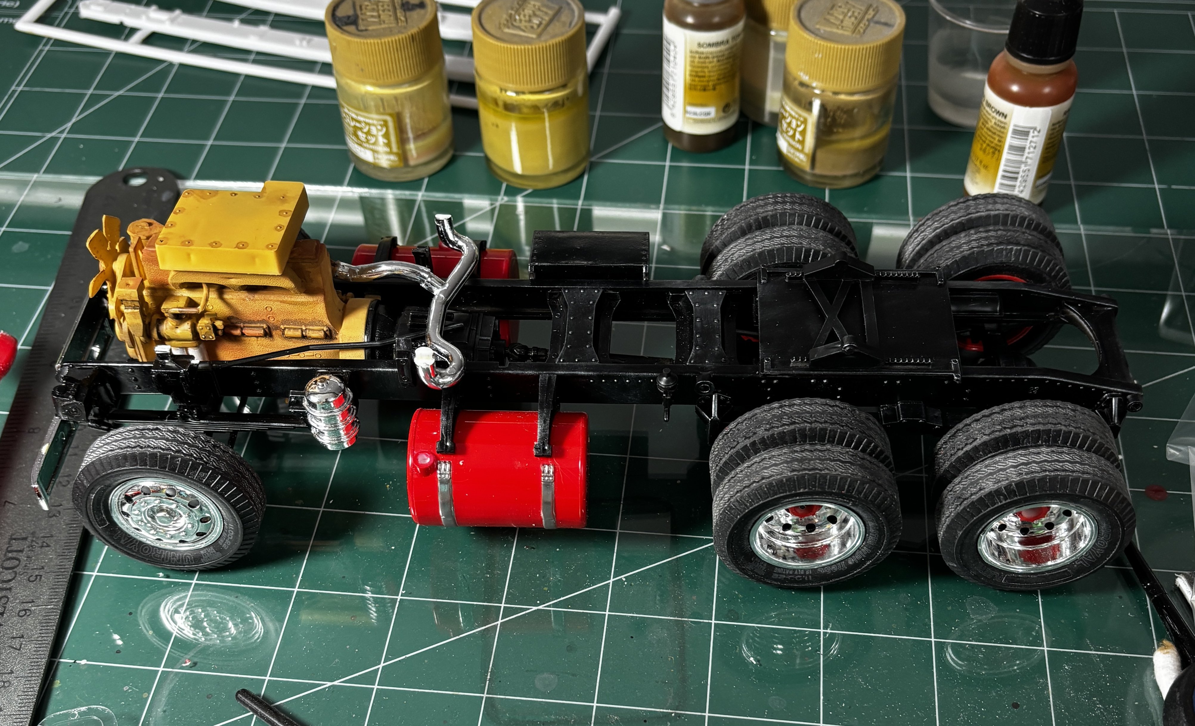

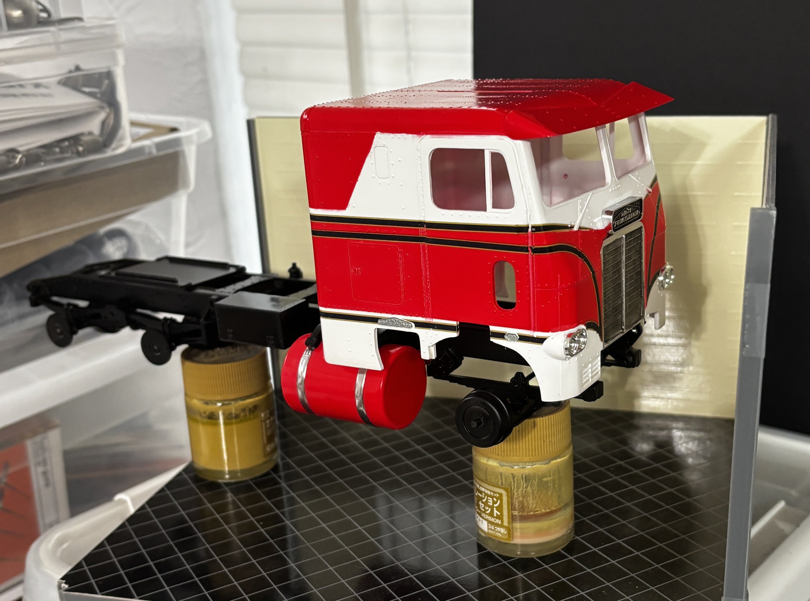

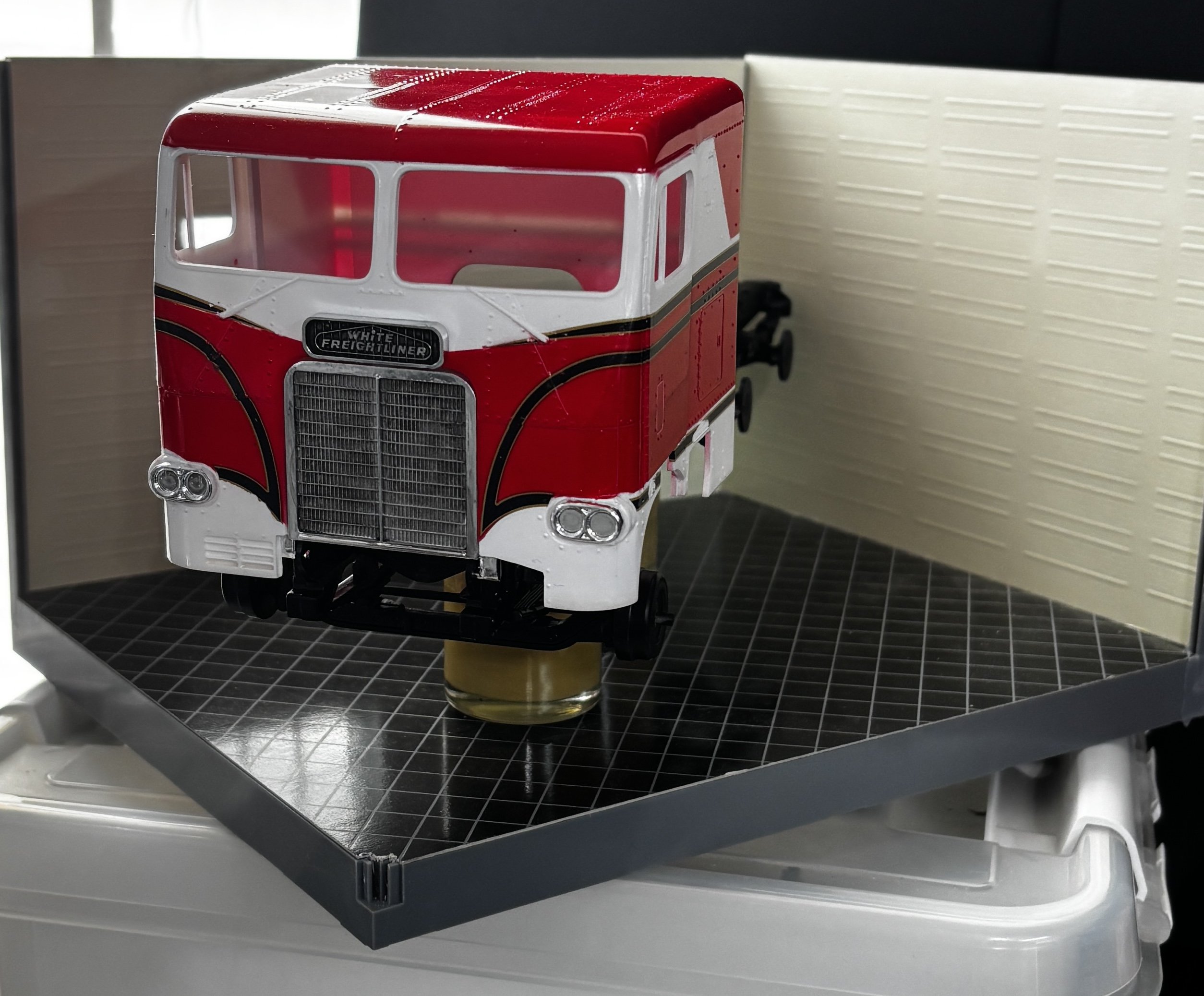

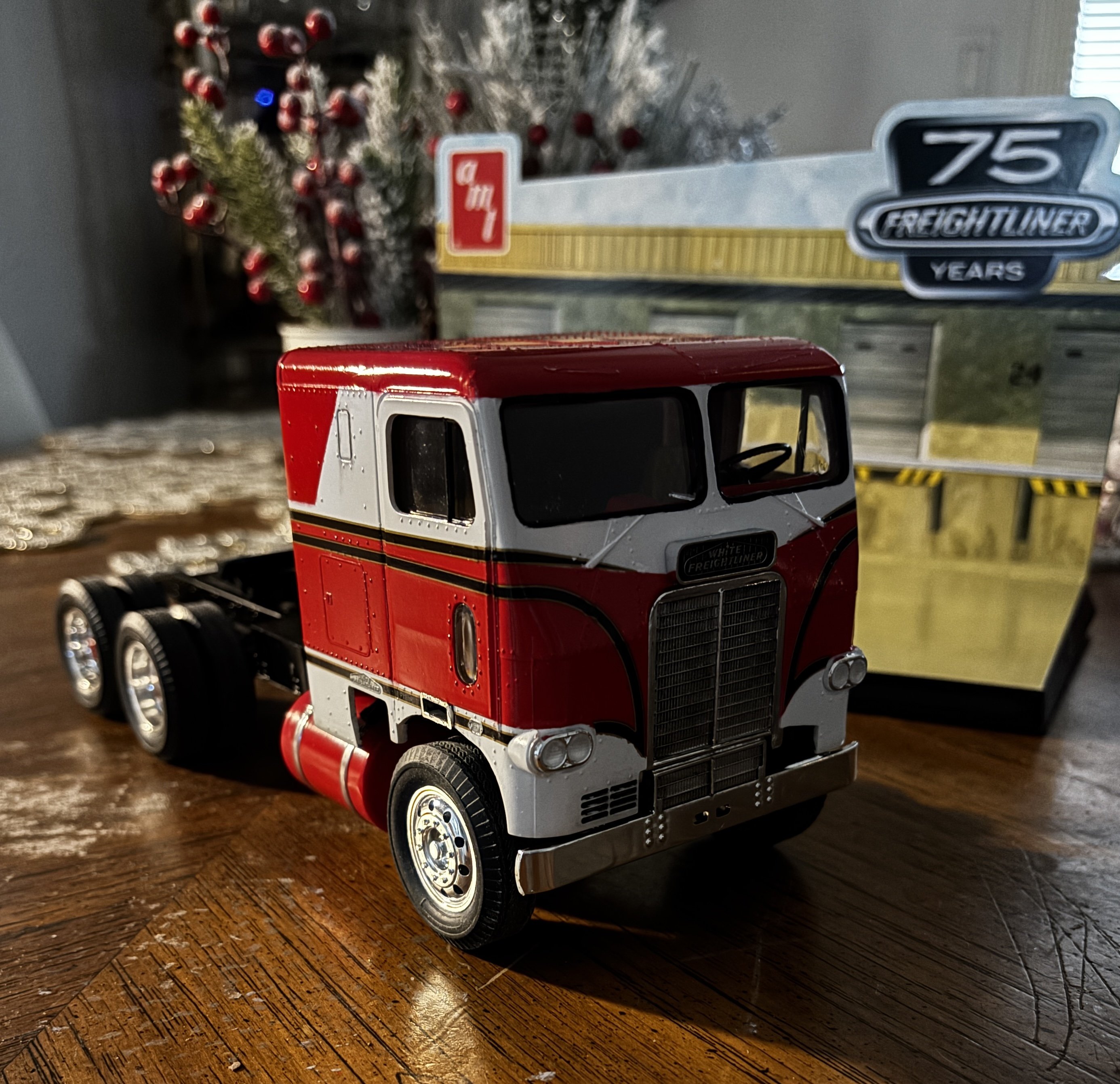

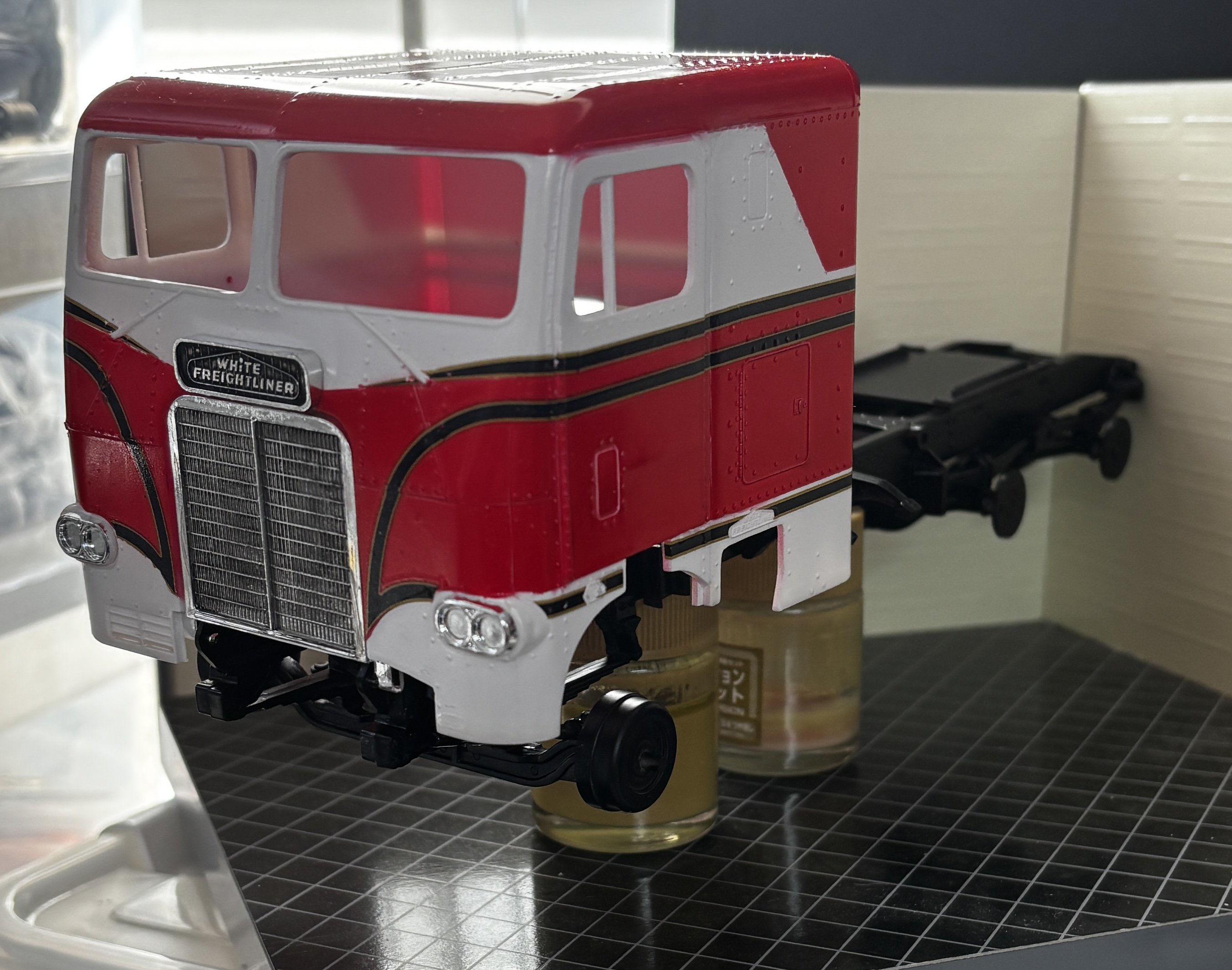

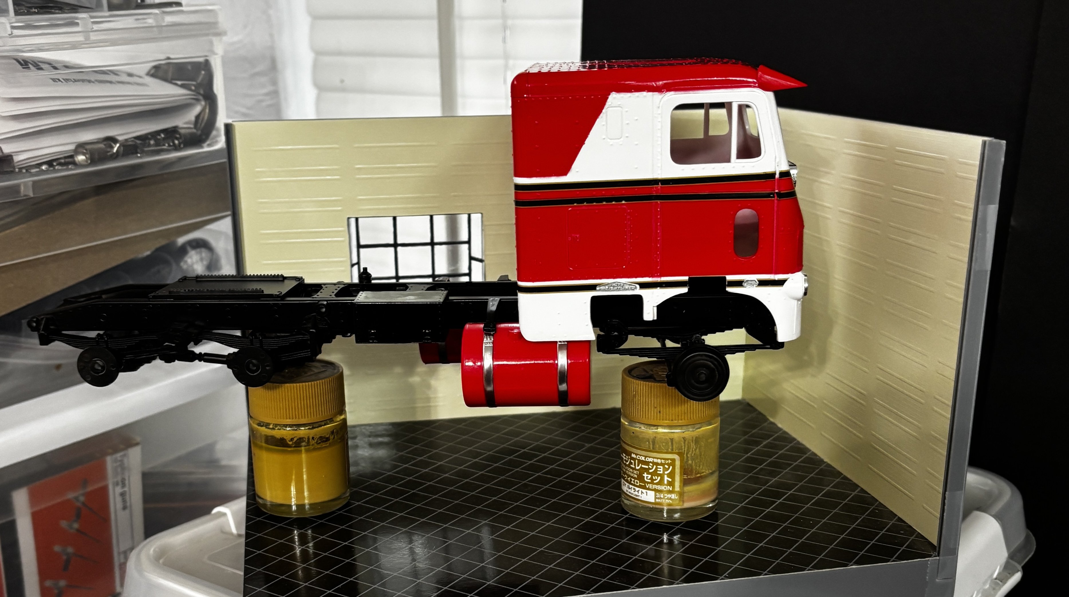

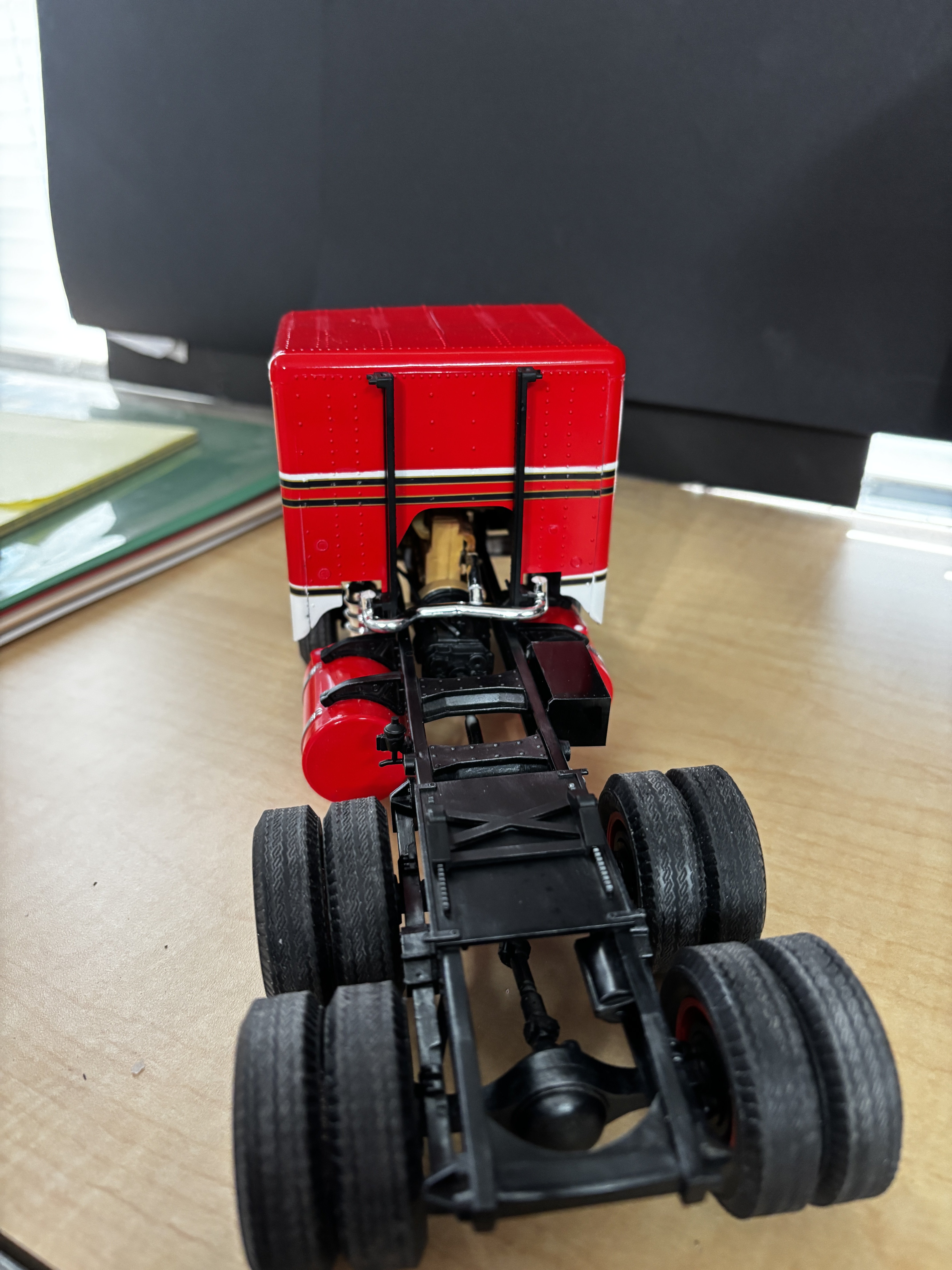

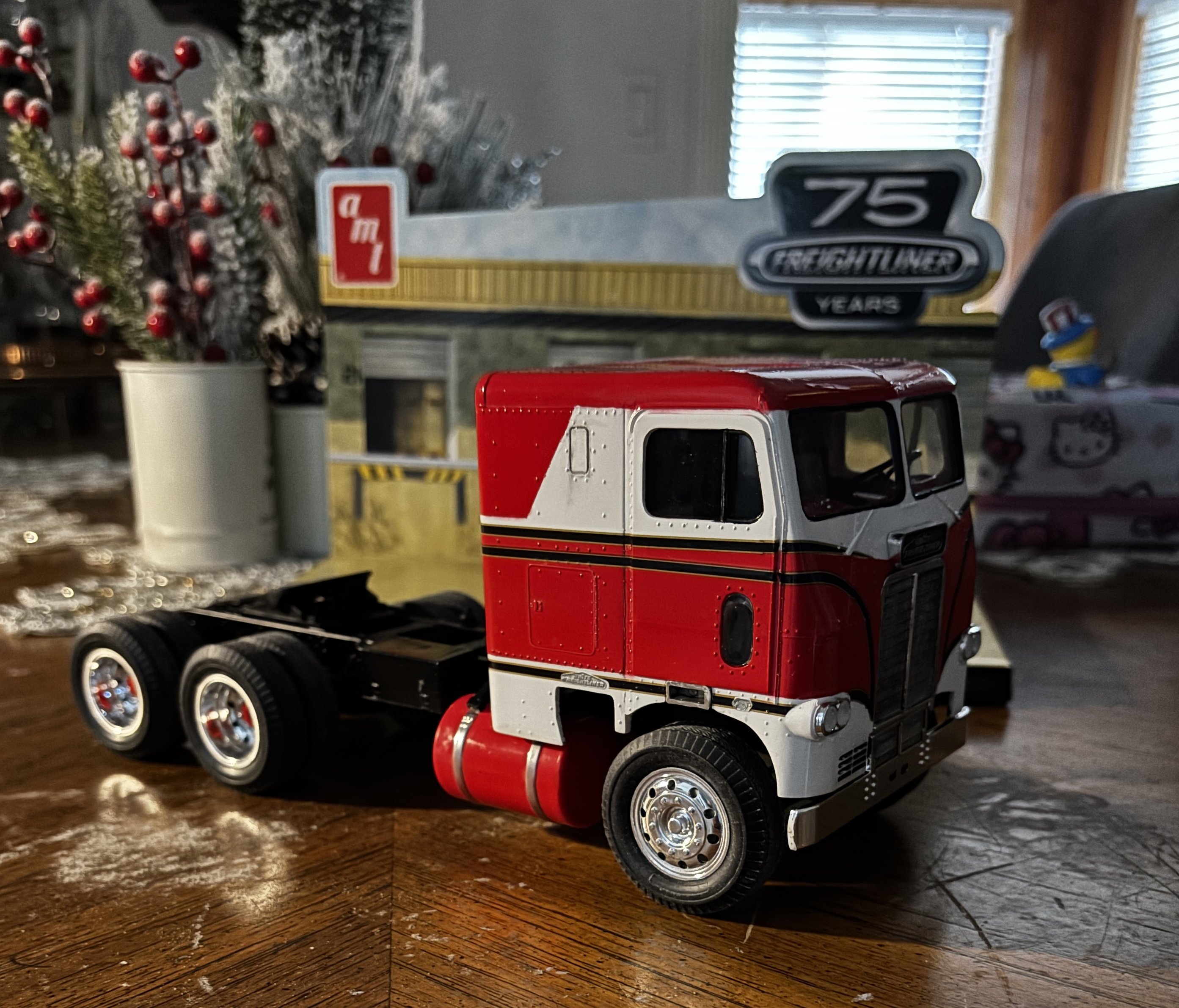

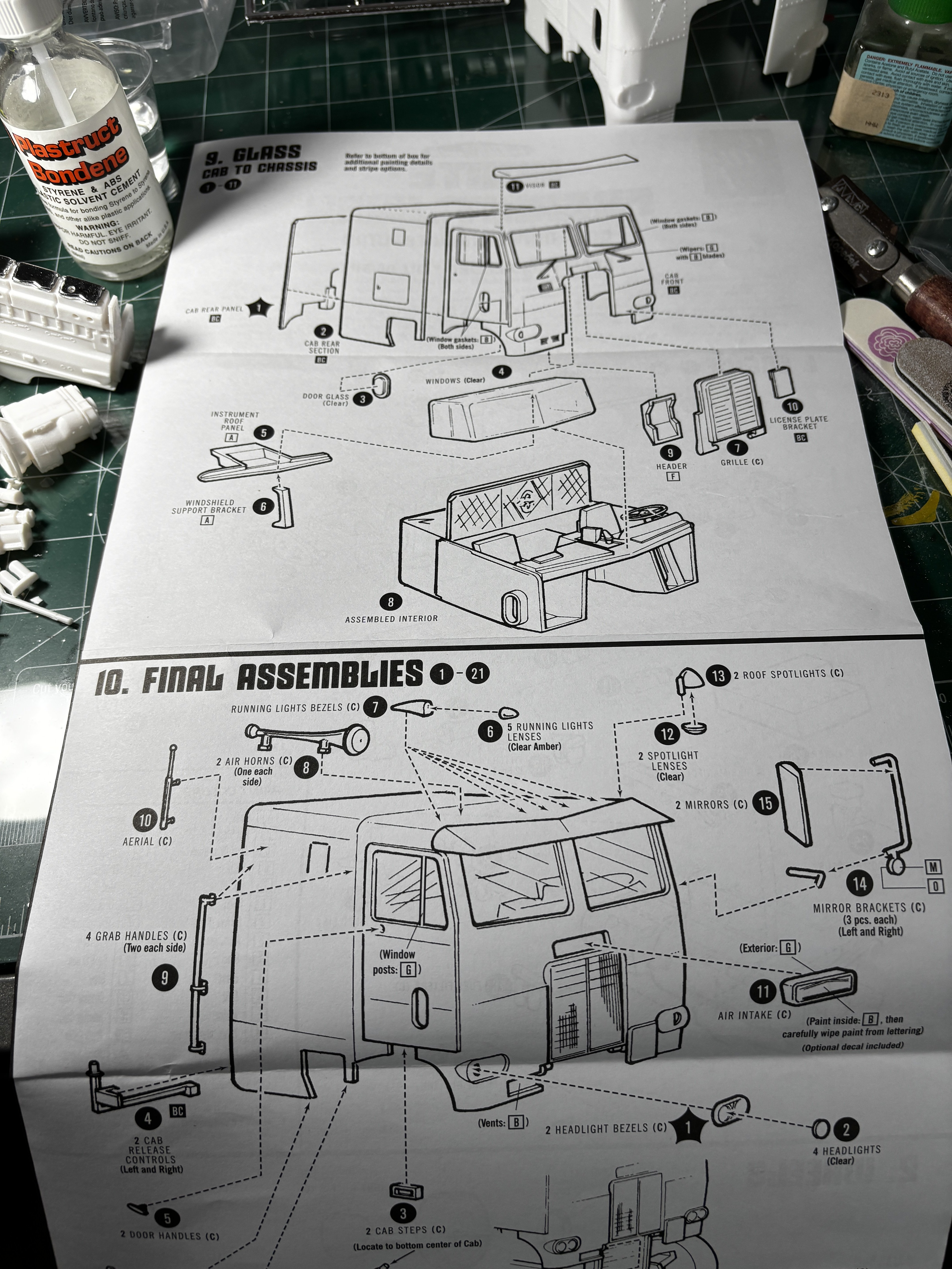

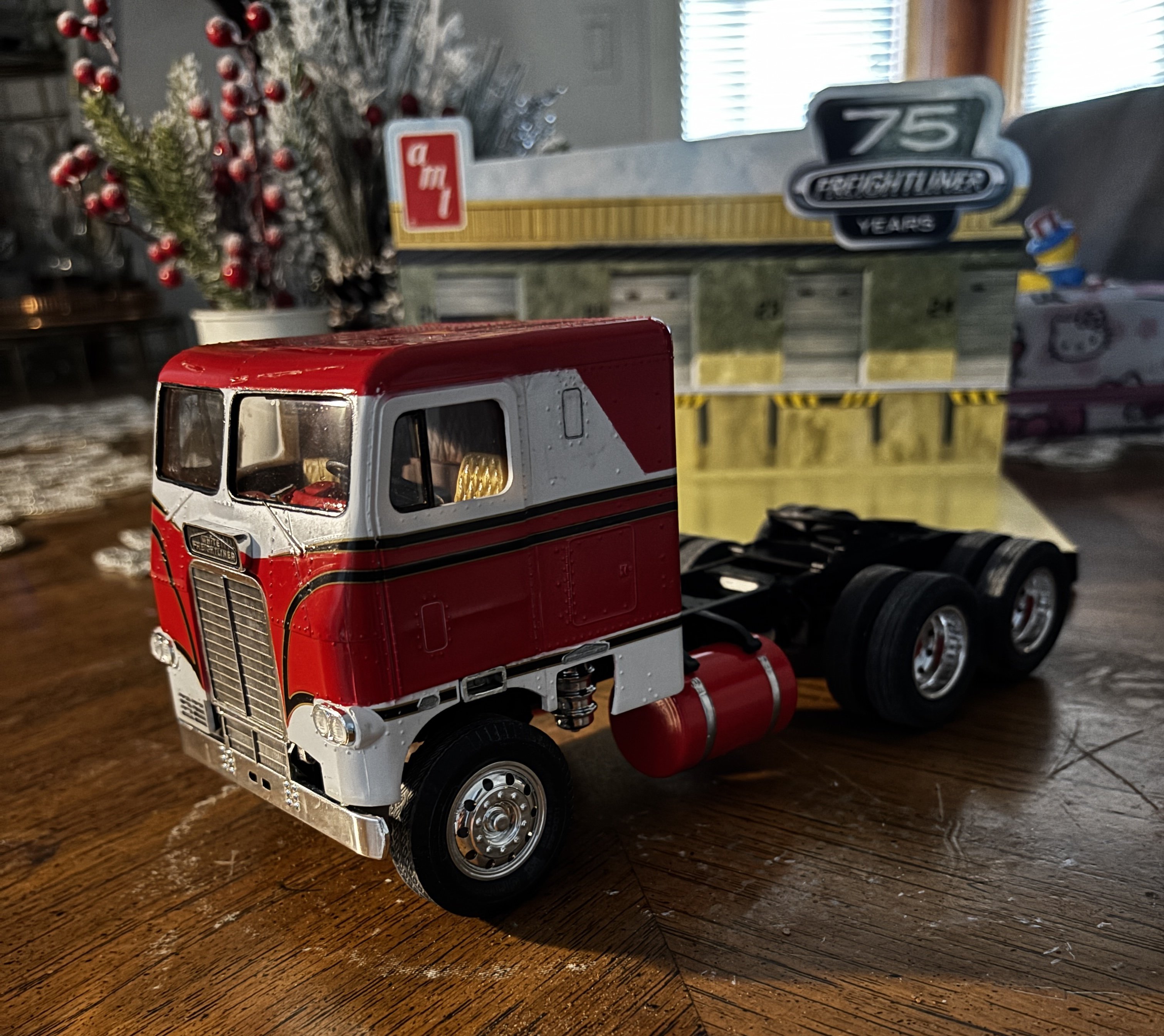

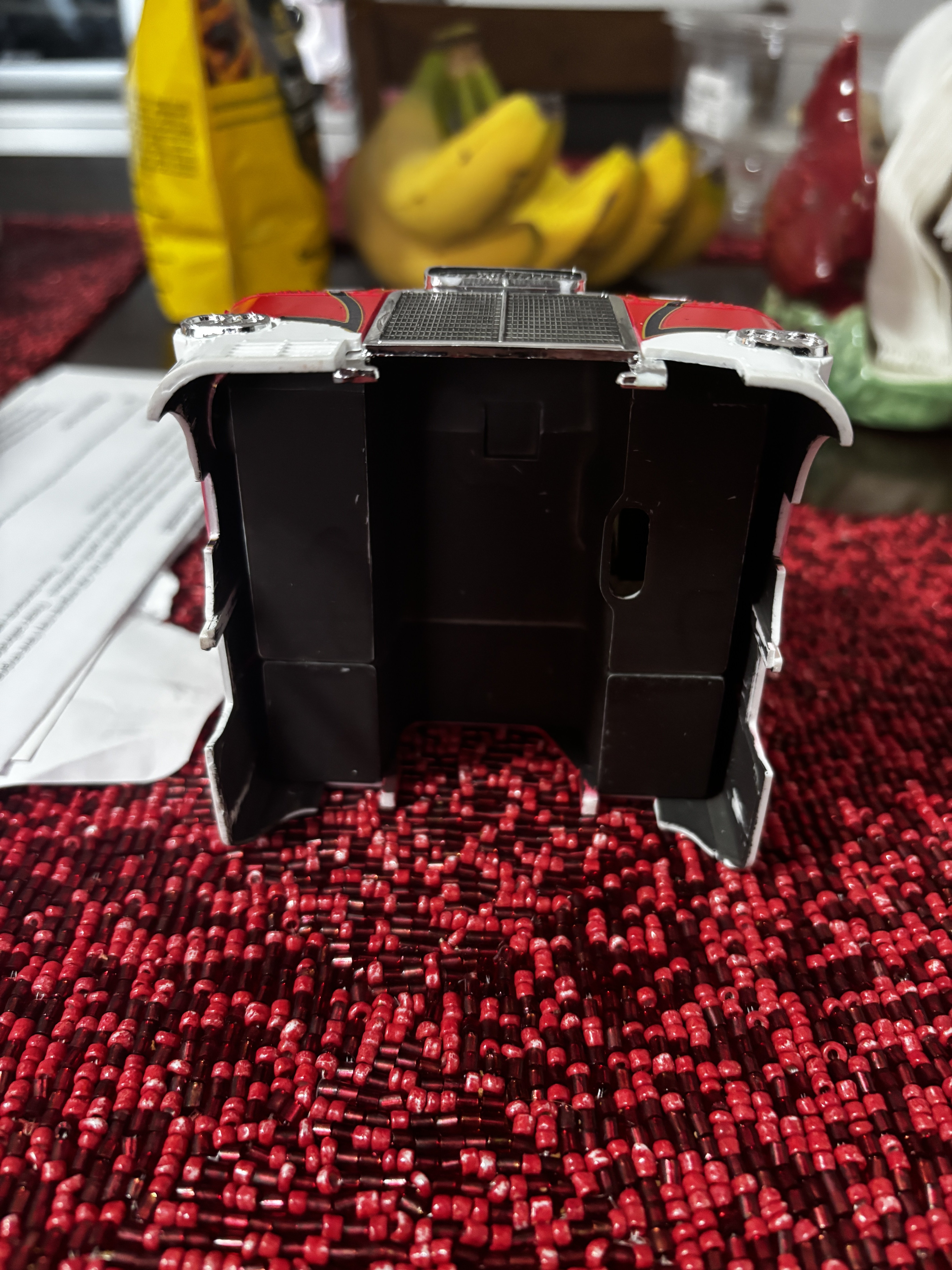

The Freightliner is a very old kit. As such, there are multiple well documented fit issues that I didn’t read about soon enough. One of those issues is the fit of the interior tub inside the cab. It’s one of many but one that seems most difficult to correct without building a new interior from scratch. I’m going to make it work but as such it will be a 10-footer. One of those models that will look okay sitting on the shelf 10 feet away. Nevertheless, I am having fun with it. Some progress photos.
Looking Really nice Craig.
OC.

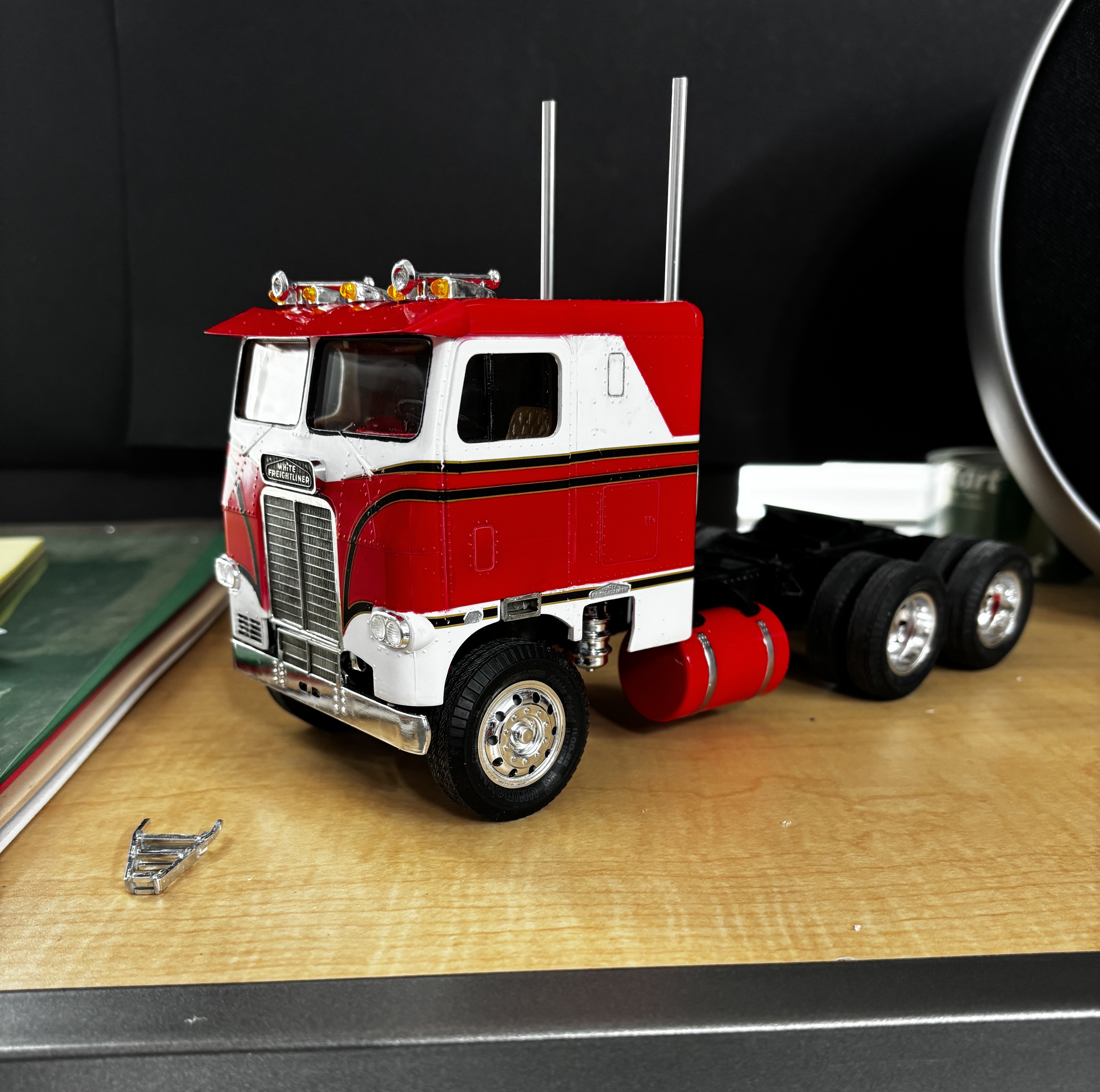

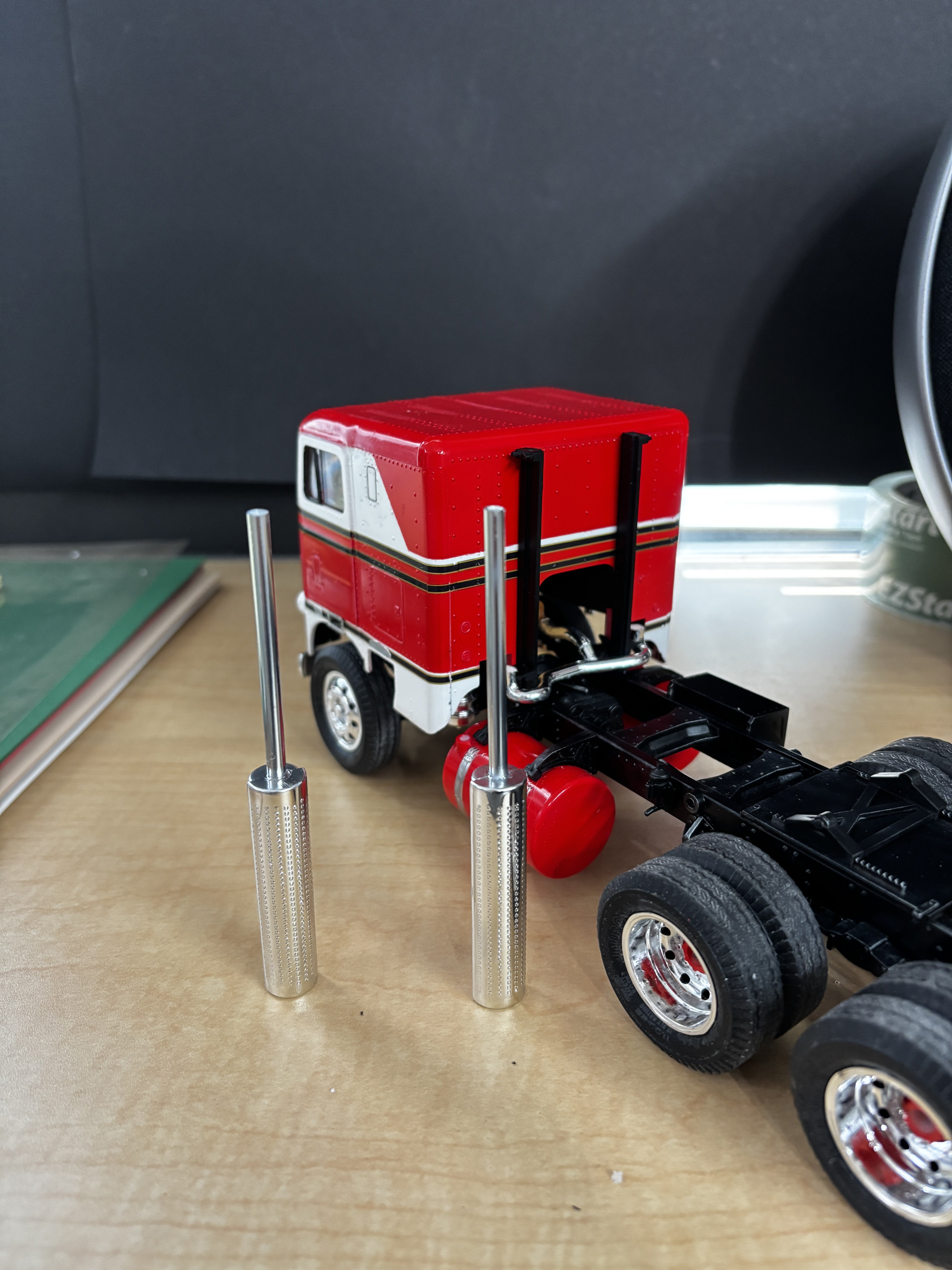

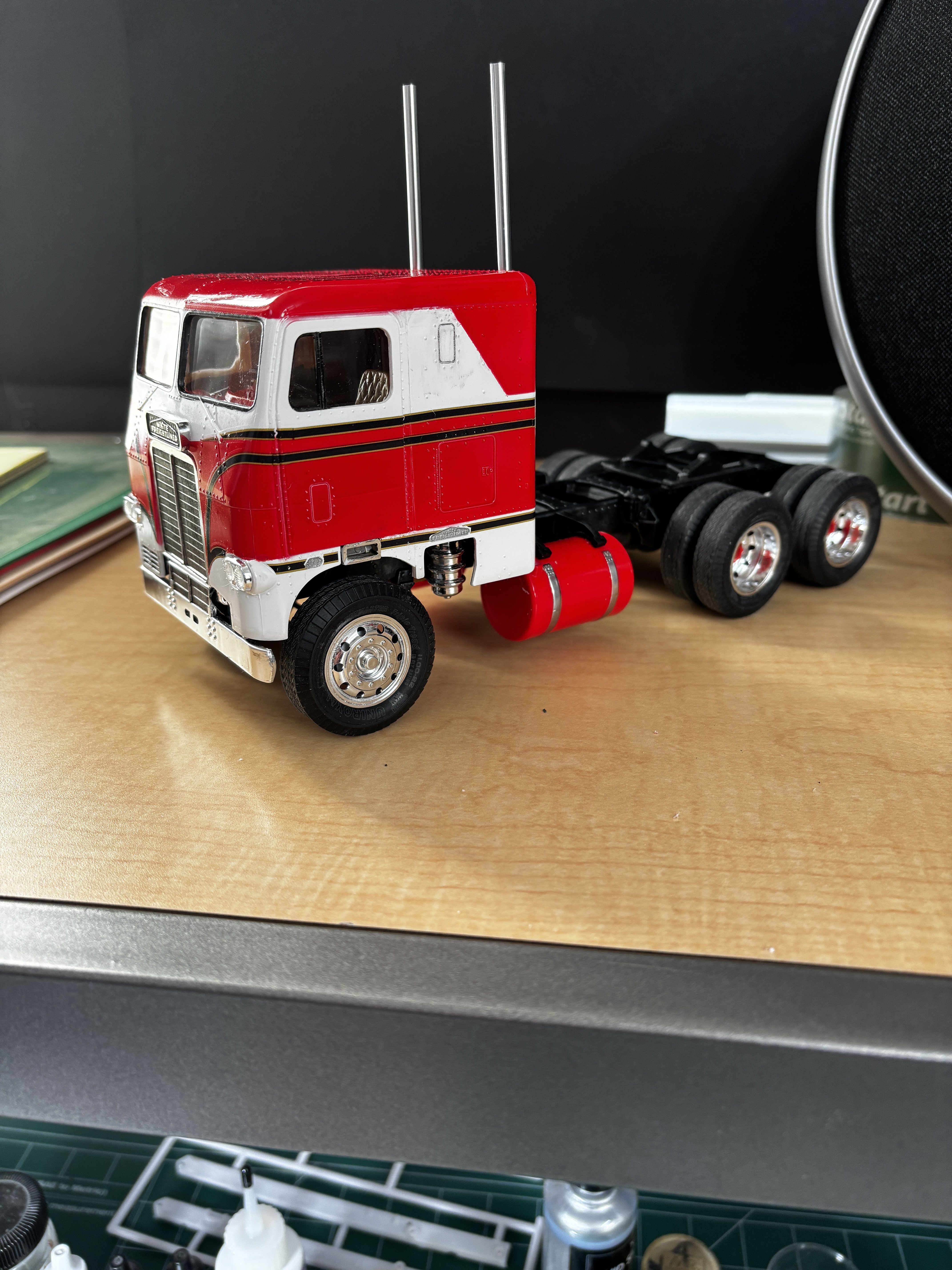

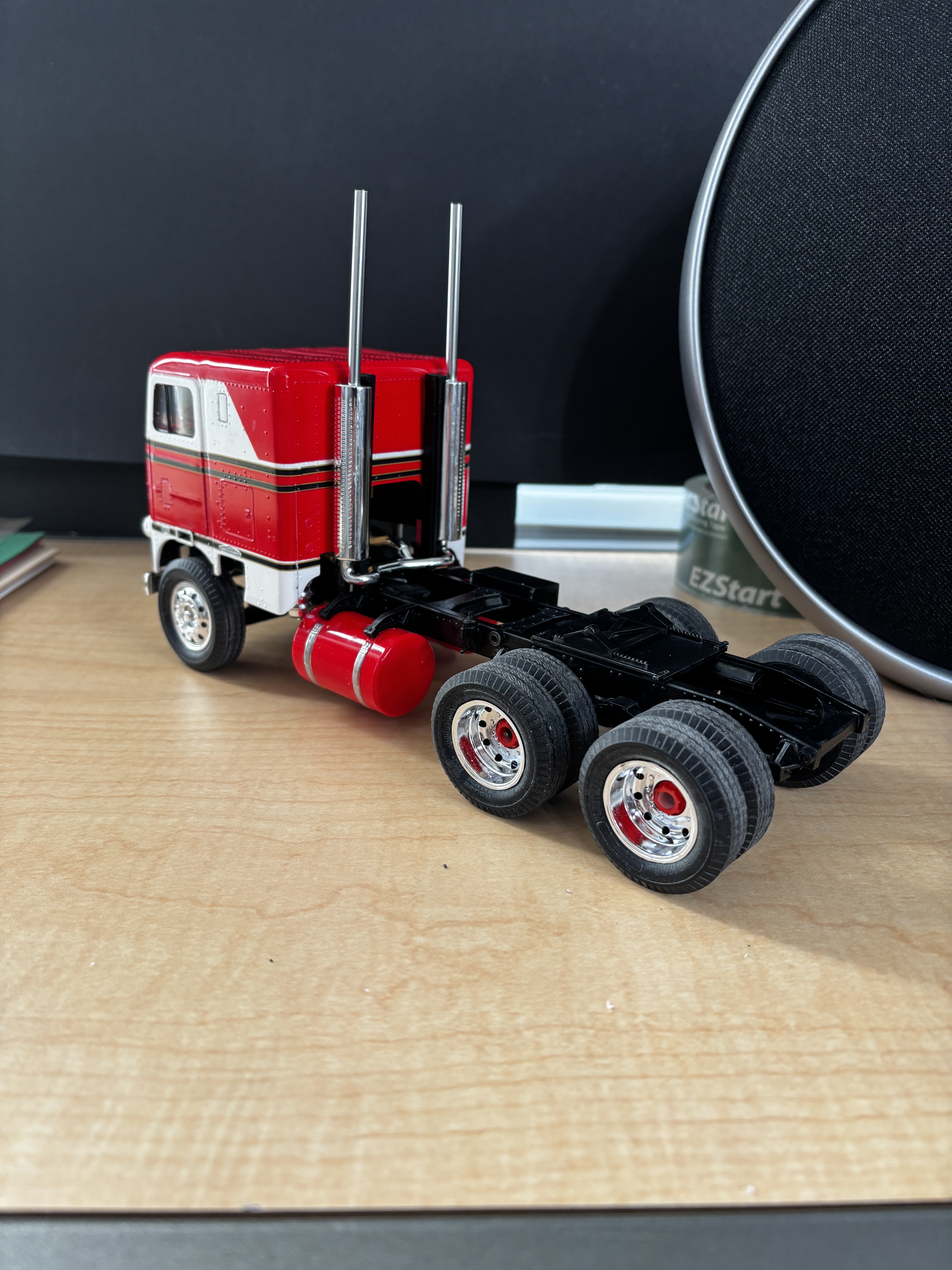

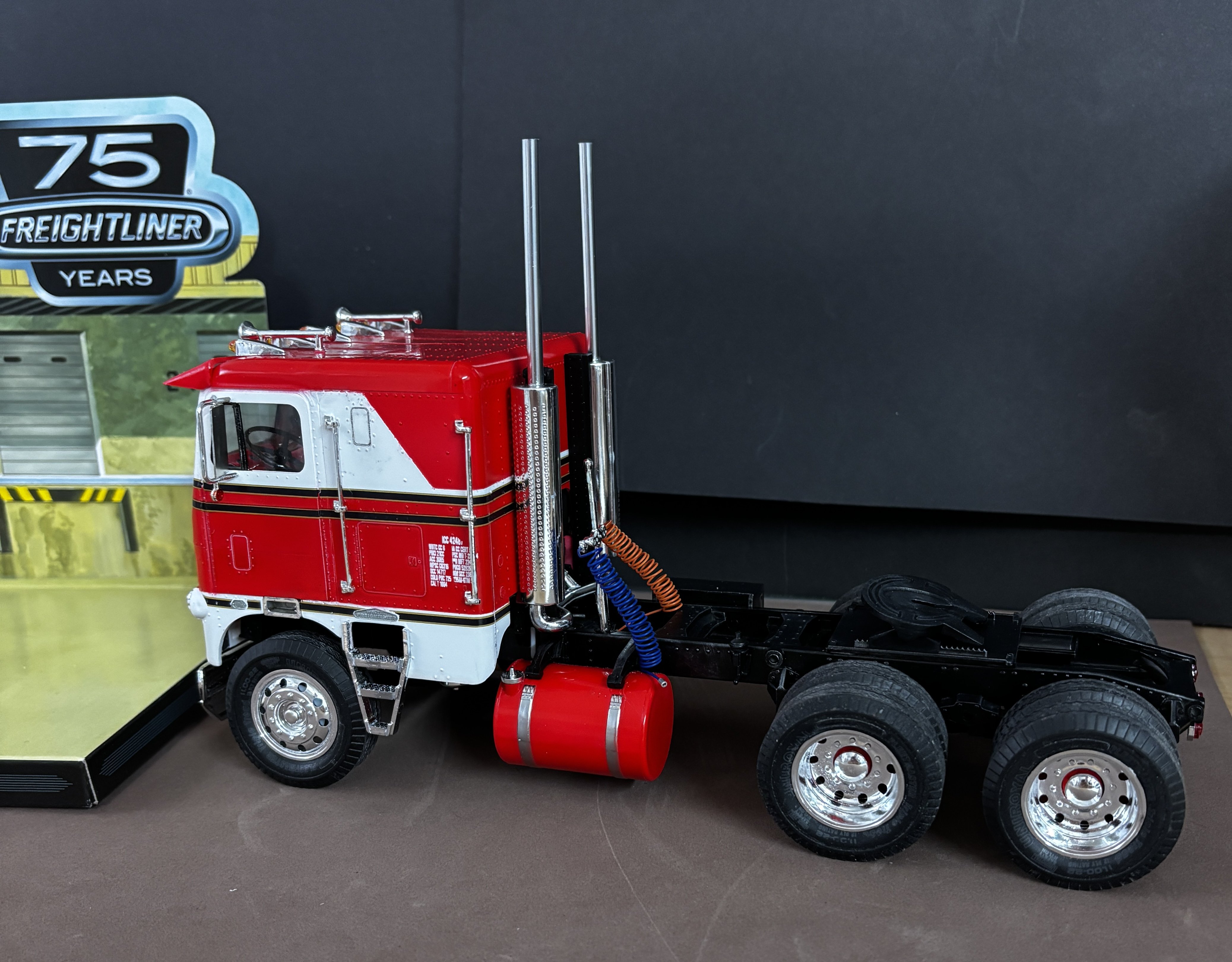

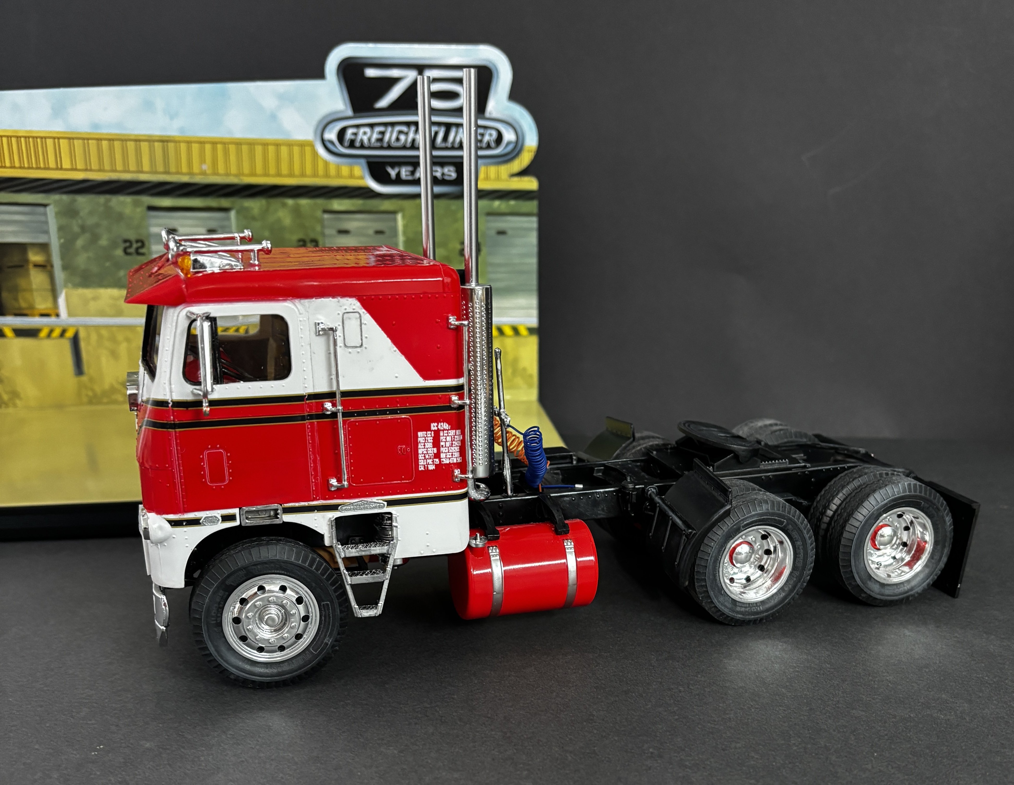

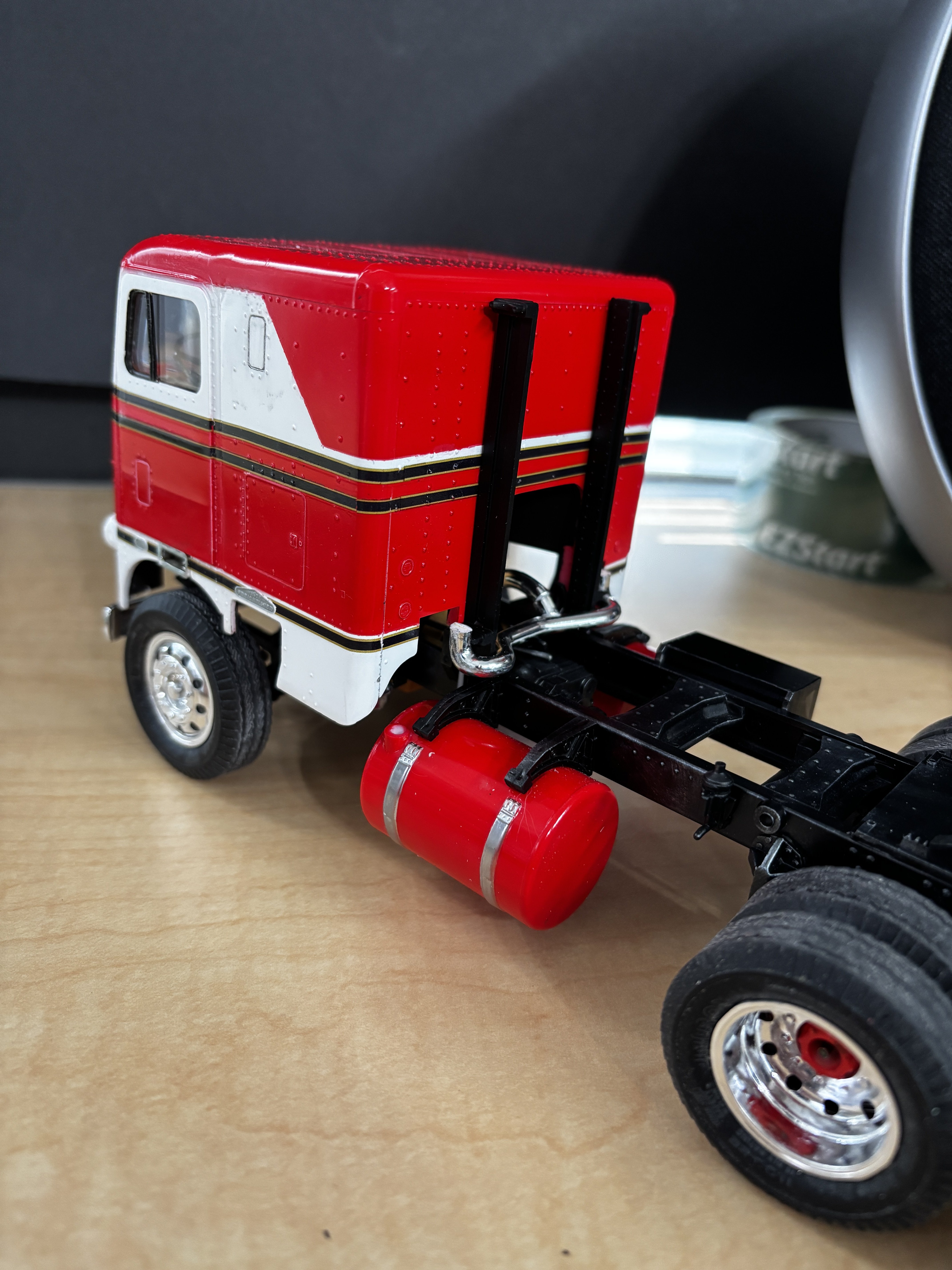

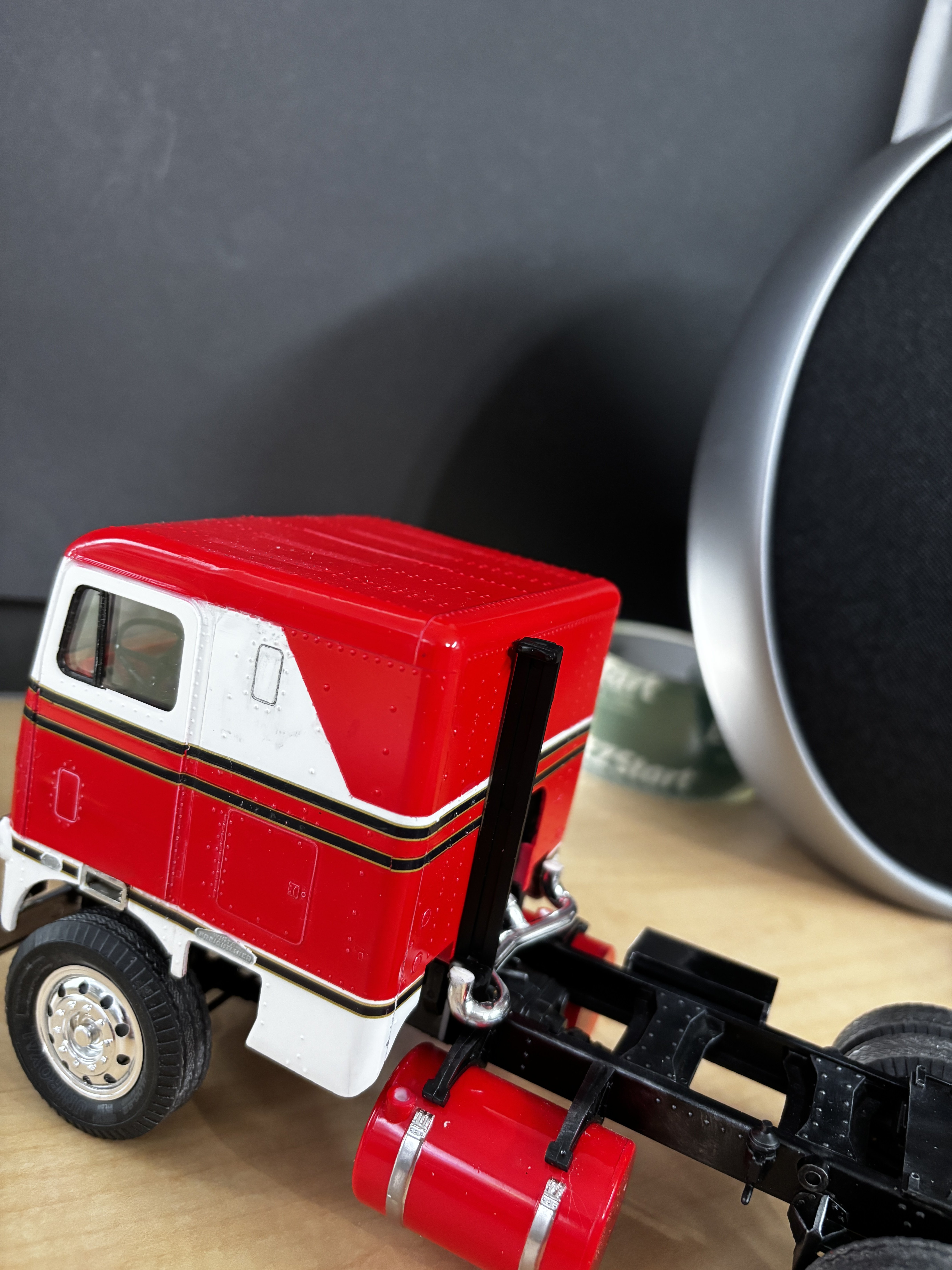

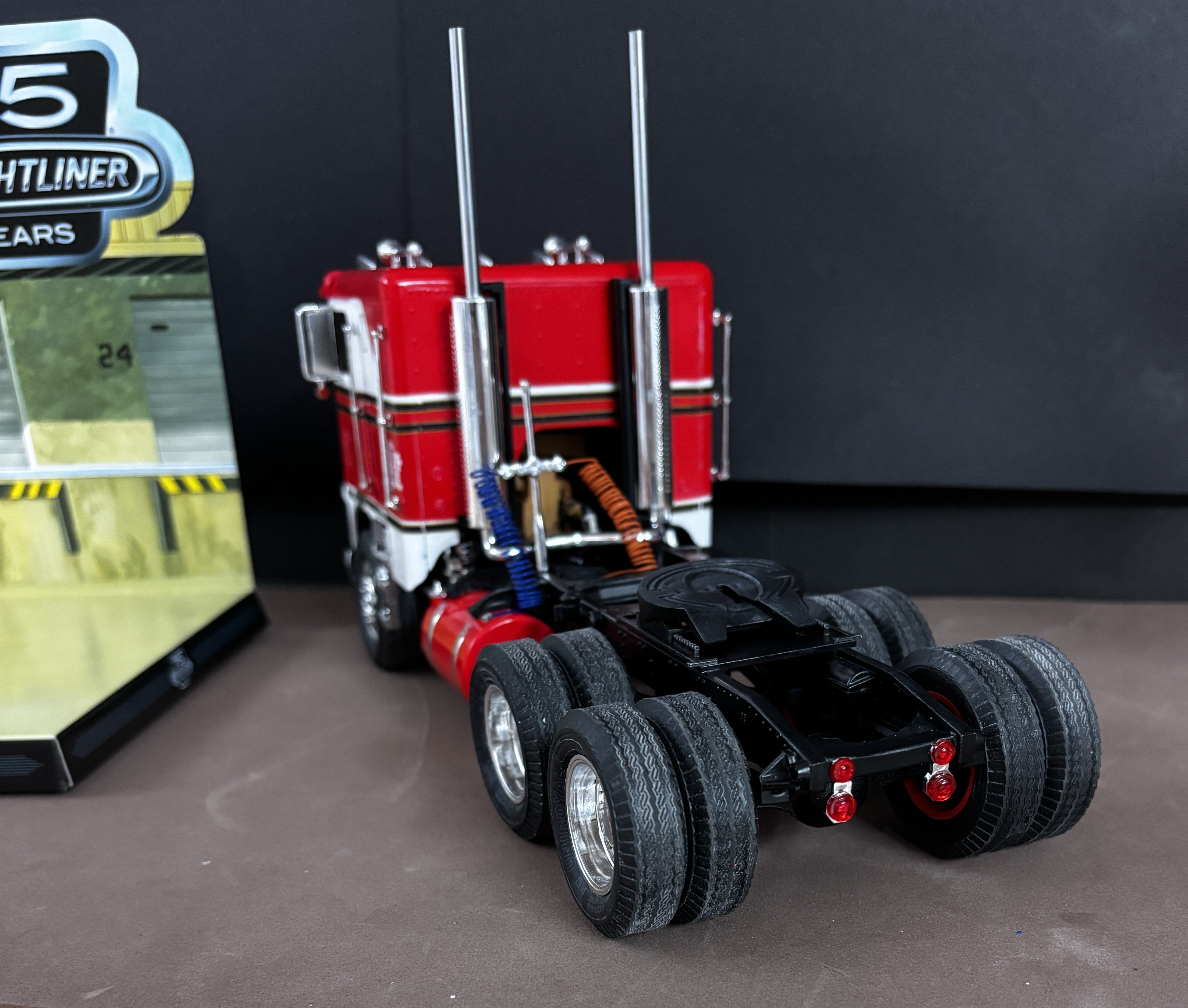

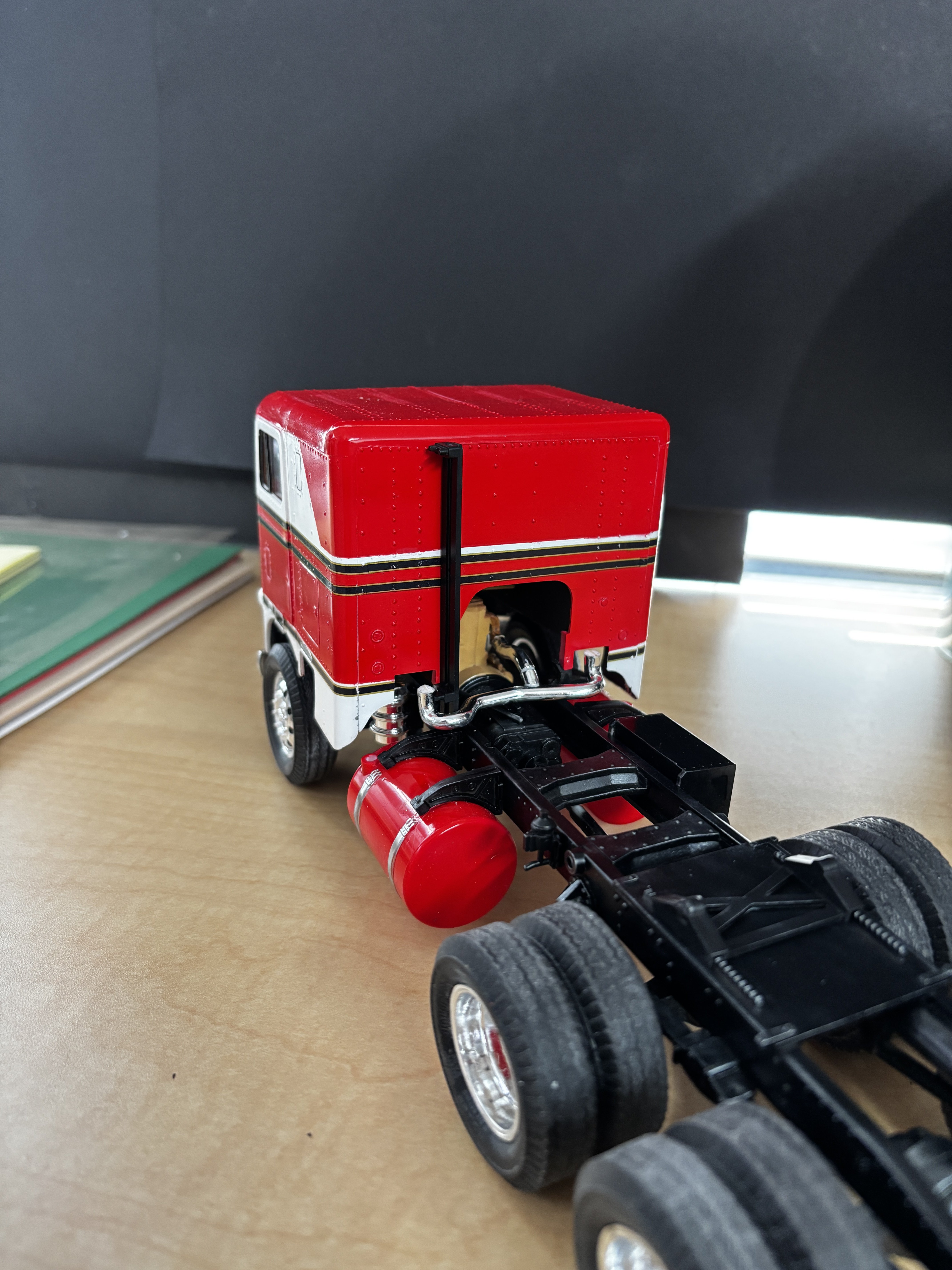

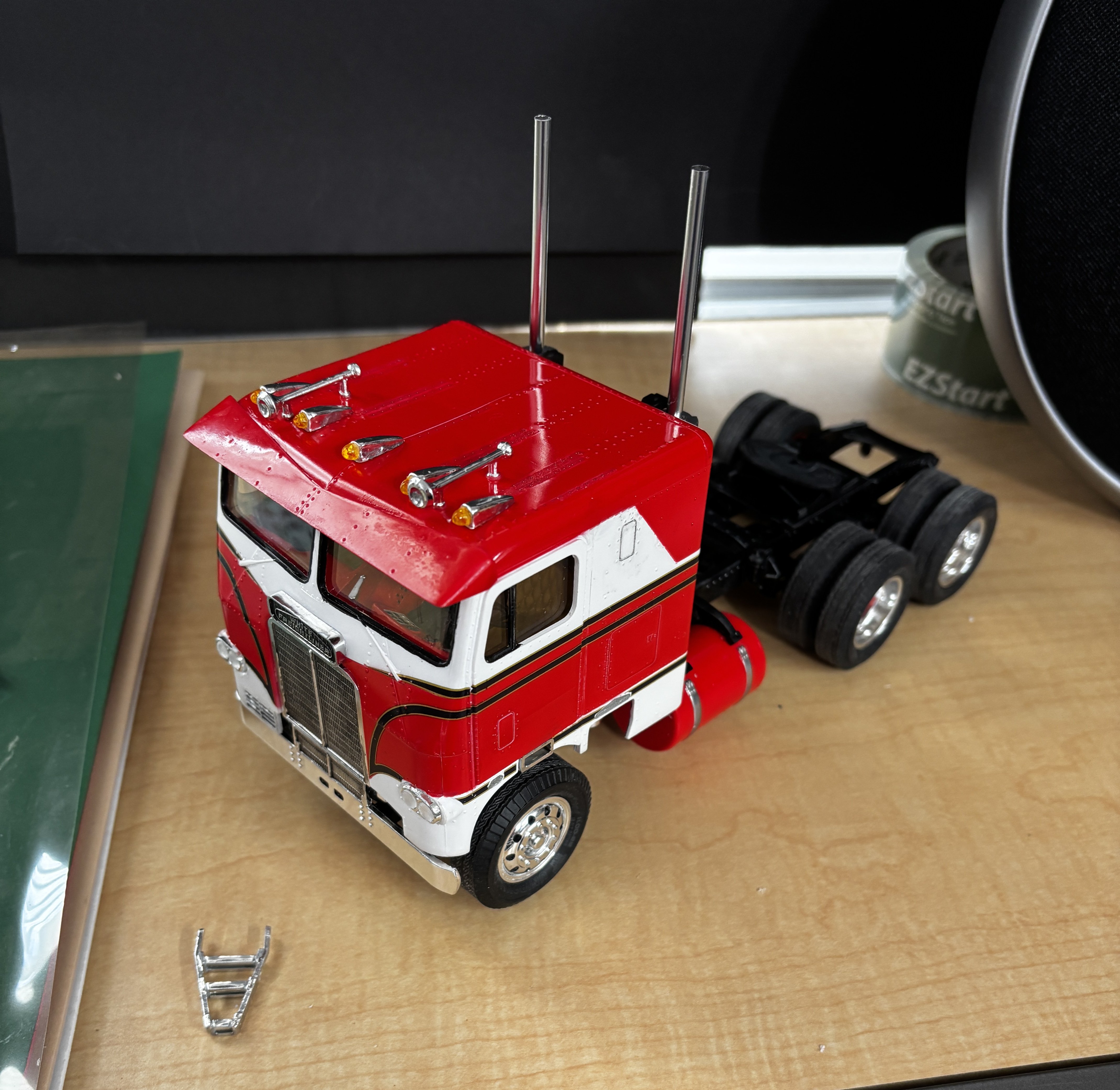

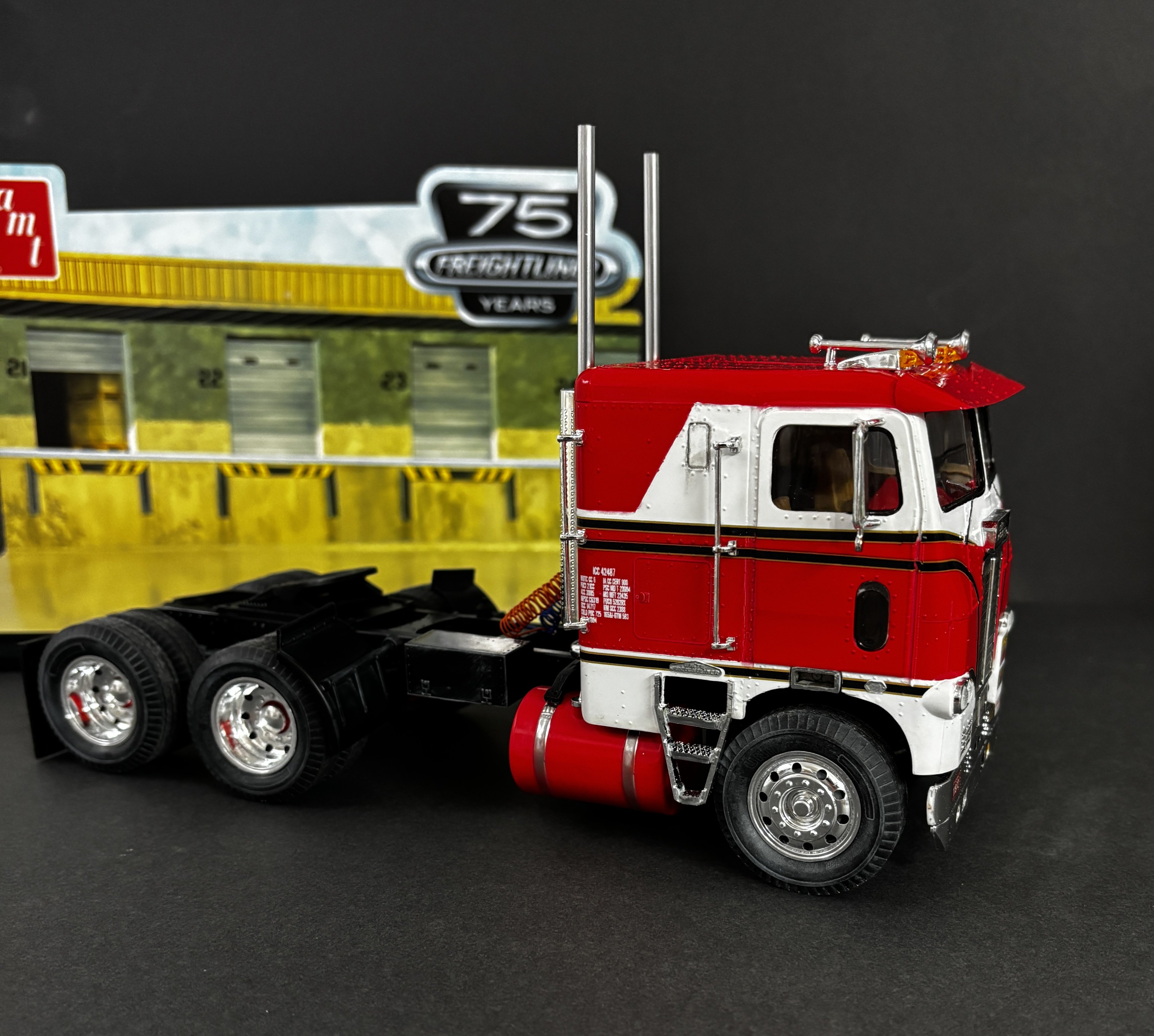

turning attention to the exhaust stacks. Remember, this is an old tool kit. As such, many parts need TLC to make them fit. The exhaust stack supports are no exception. Careful fitting to make sure they line up properly with the cab and the exhaust pipe is required. My exhaust stacks had big, ugly dink marks in the pipes rising above the heat shields, plus they were solid plastic, not hollow as they should be. I just cut them off and replaced with plastruct tubing, then painted the tubing with AK Super Chrome. The stacks will get attached later after the glue on the supports sets up well.

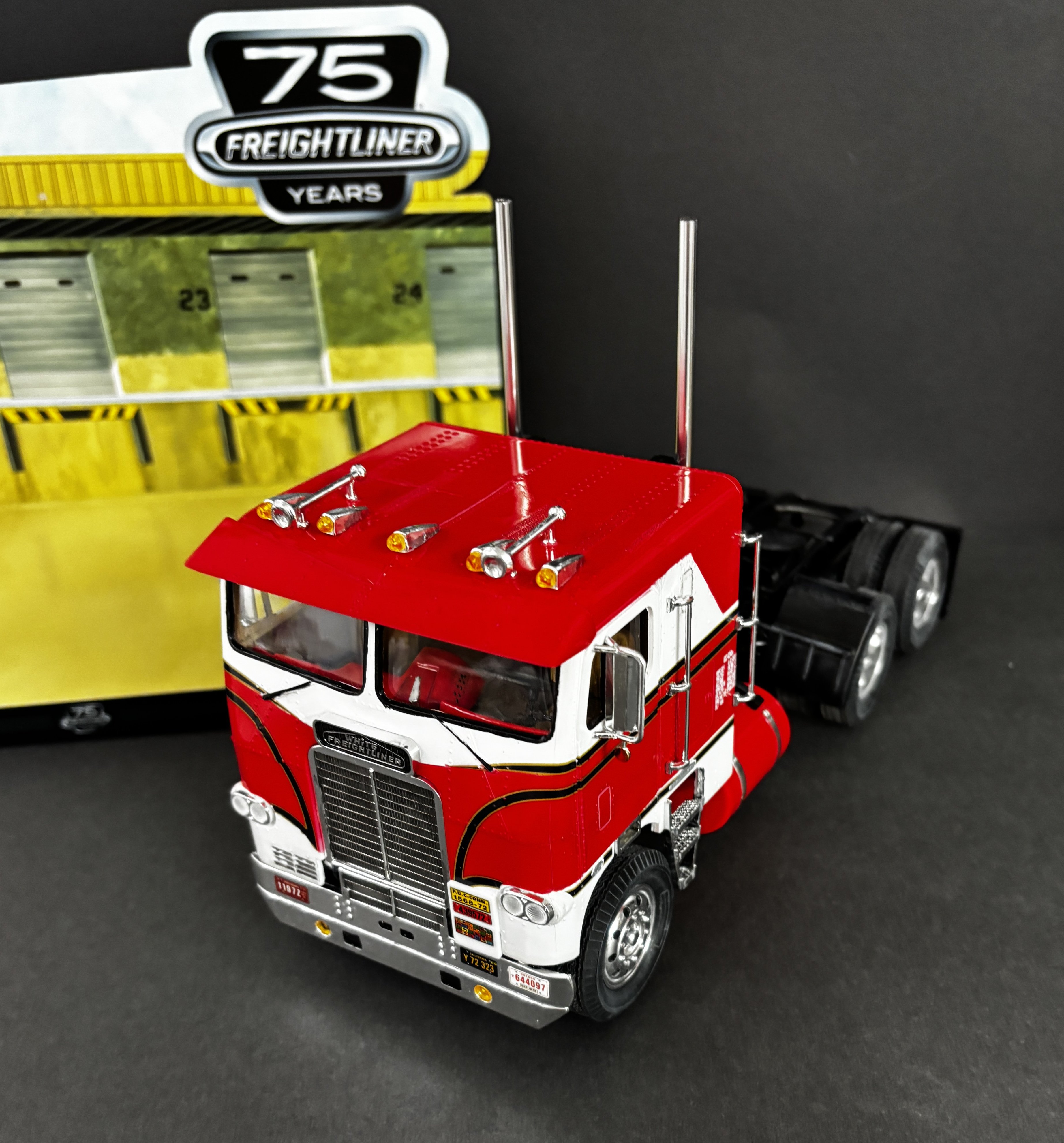

Looking good.  A few posts ago you said it was "slowly shaping up" but from my vantage point it is moving along pretty quickly.
1 hour ago, yvesvidal said:

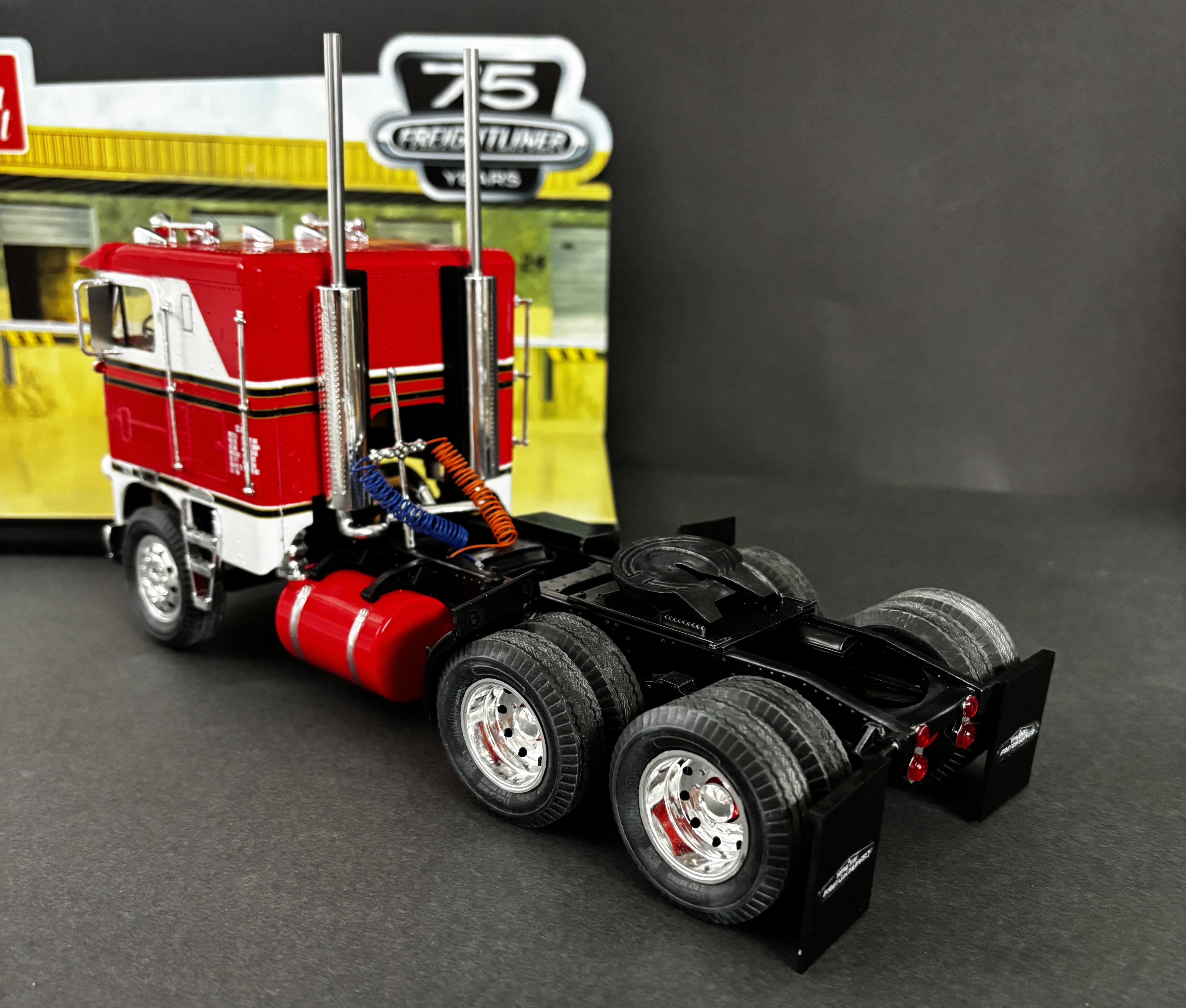

The "super" chrome painting is impressive.
You should do something about the tires, they look too new.
Yves
I’ll do something with tire weathering at the end when I’m sure handling of the model is almost finished.

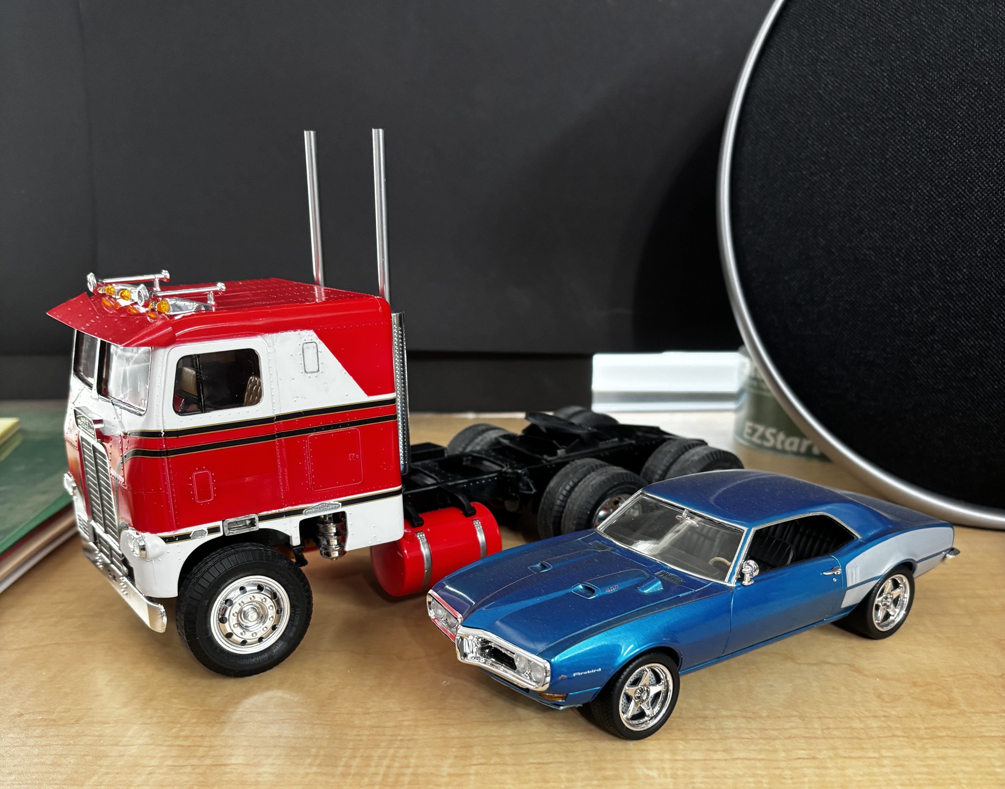

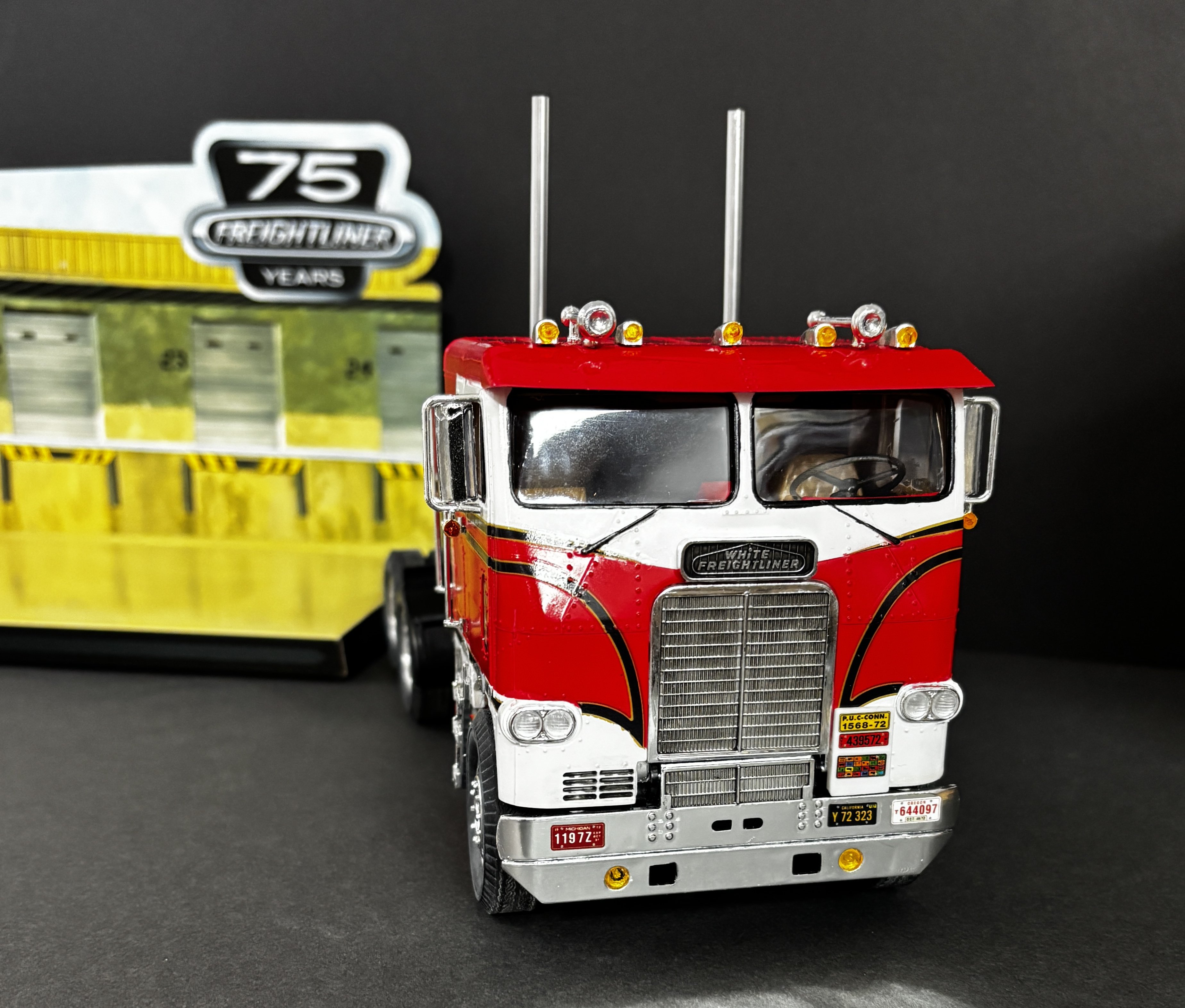

i still need to drill location holes in the cab to install all the bits. That will take some time. More wreathing in general as well.

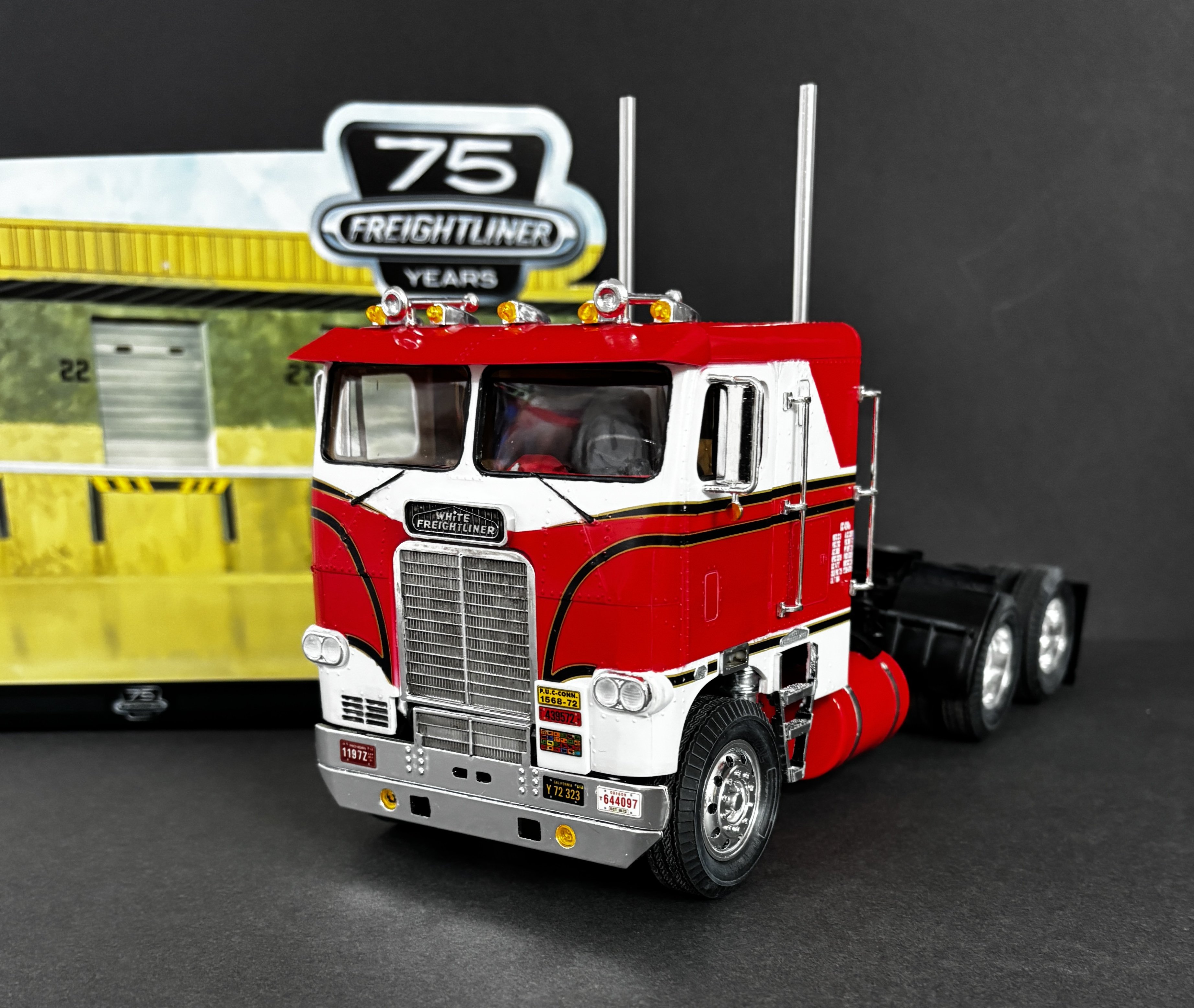

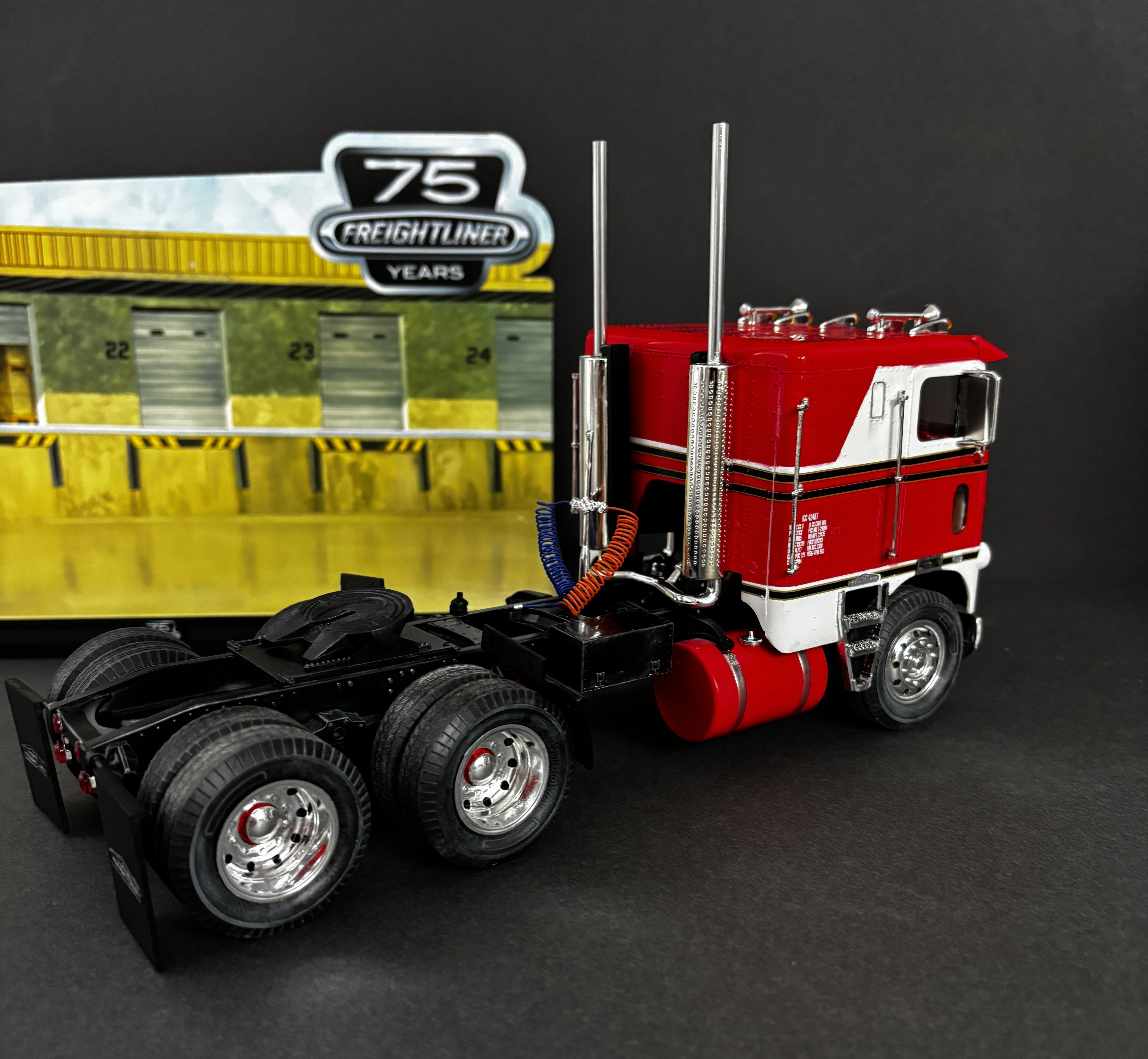

Impressive!  Like the backdrop too !

Nice work with that dinosaur of a kit. I build this or a similar truck, when I was very young. I considered building a Peterbilt 378 Long Hauler some time ago. There is a resin engine and nice PE parts available for this one, but I always shy away, when I see the Italeri label, as well as AMT.
