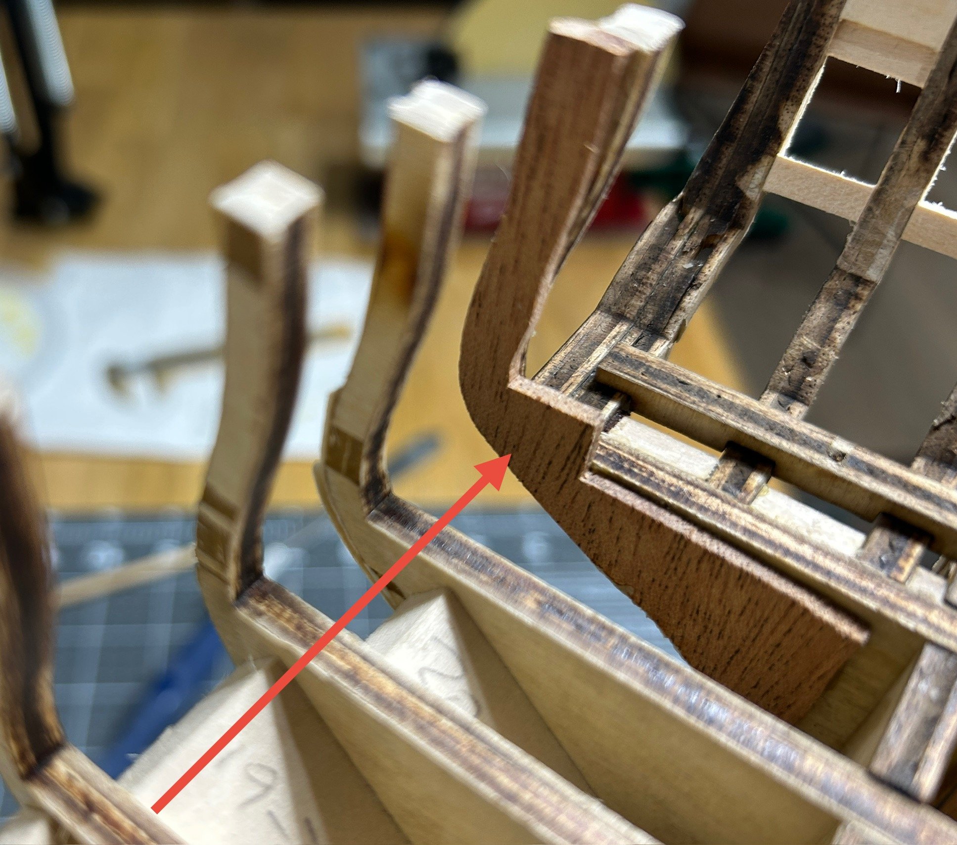

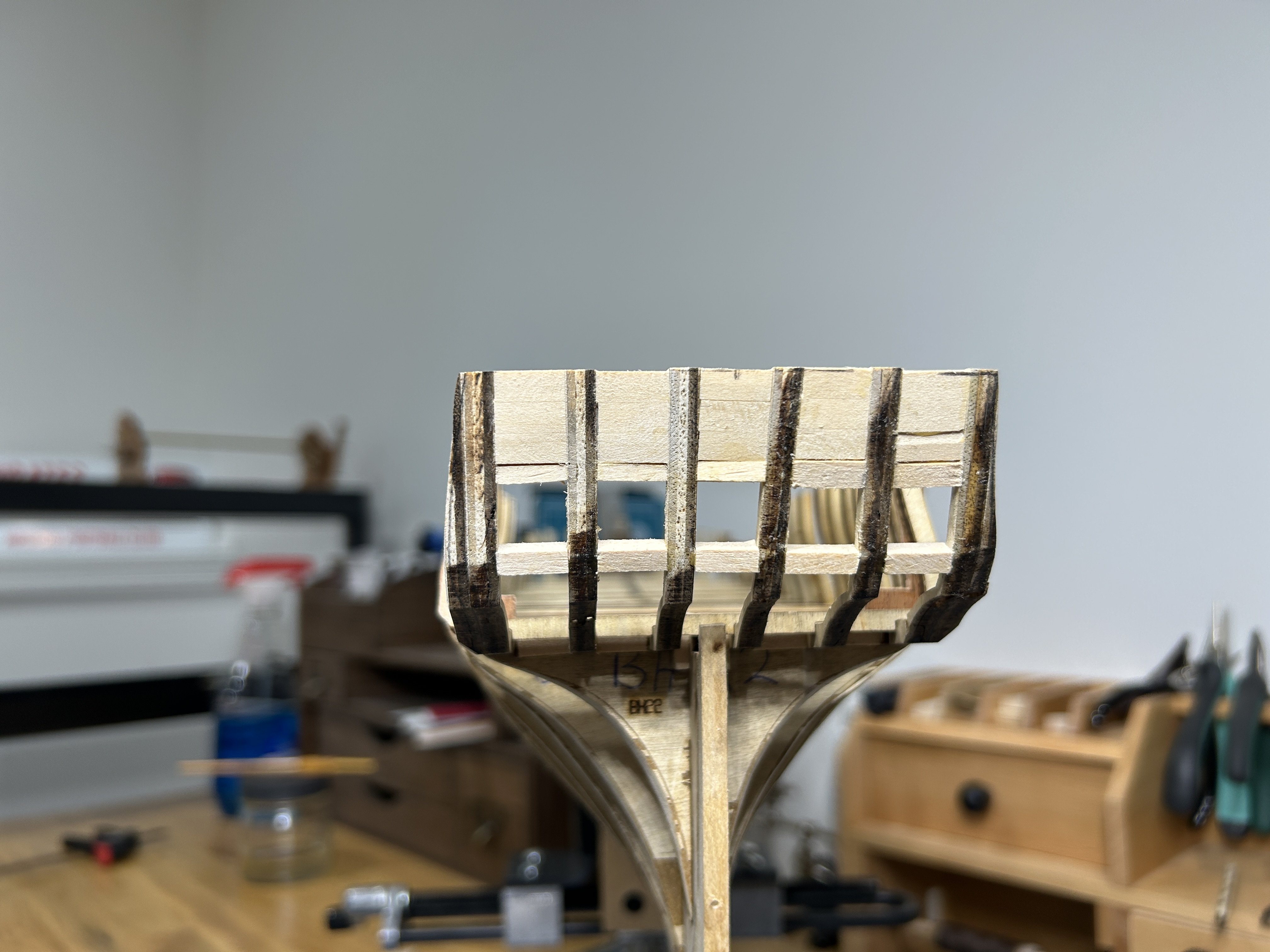

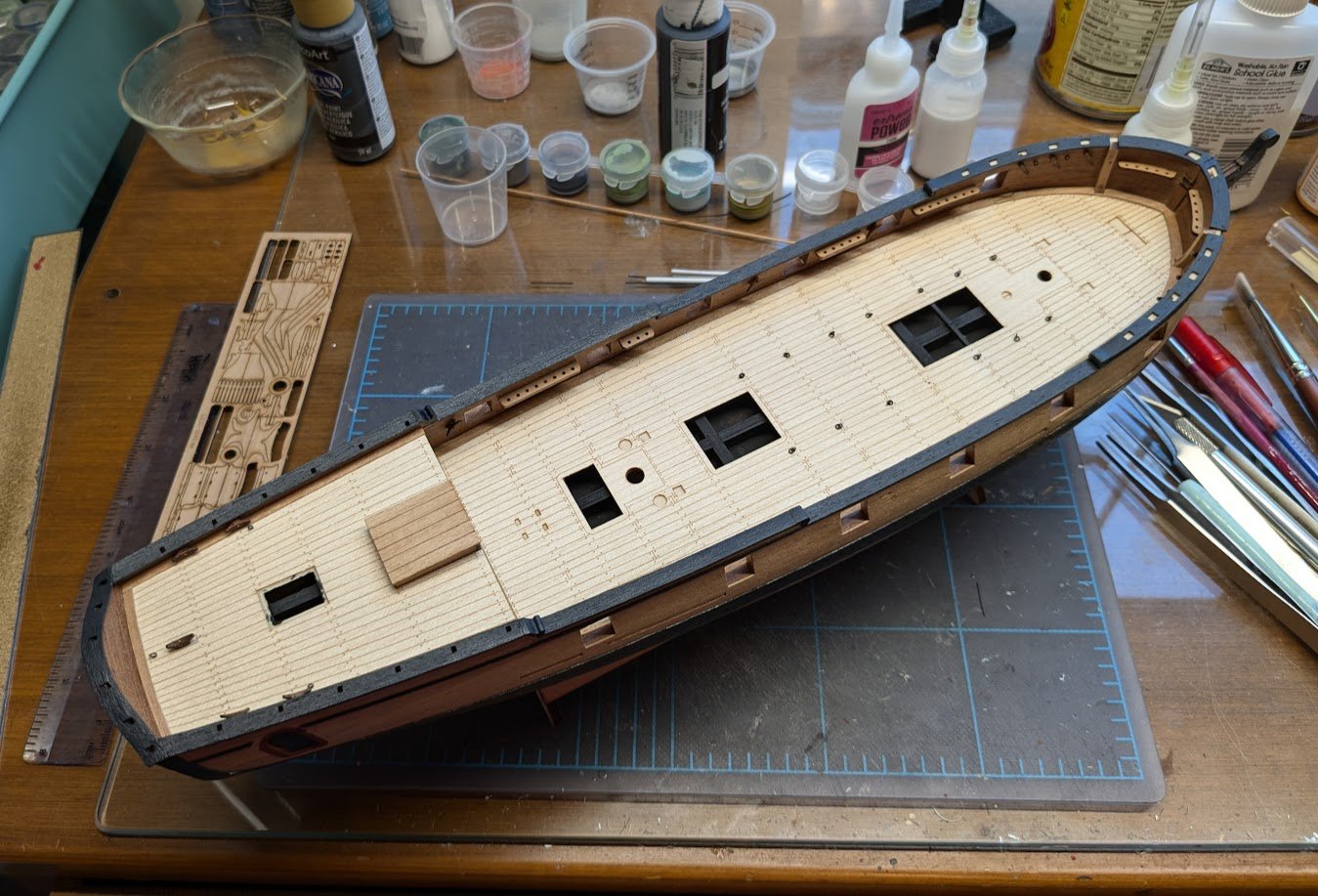

I have made some progress on the stern. I have managed to repair and reattach the frame pieces that broke. I also figured out that the problem I was anticipating with the arched frame for the windows on the stern. As I described in a previous post it appeared that the top of the arch would end up above the cap rail which would not be correct. It turns out that I misunderstood where the the sills were to be placed on the stern. I used alcohol to free the sills and then place them correctly. I also created some parts that will help re-enforce the bulkheads above the deck on the last bulkhead. I left some extra material at the deck level to help add some strength until the outer planking is complete. I will need to remove that material before the decking in installed. I use some 3/16 inch thick walnut. I am hoping the walnut is a little stronger than basswood. This part will also create the side of one of the gun ports. the 3/16 thickness was what I needed to have the side of the gunport in the right position. I still need to do a little more sanding and on the stern, but I have started to work on the placement of the gun port sills also. I will post an update on the sills soon.

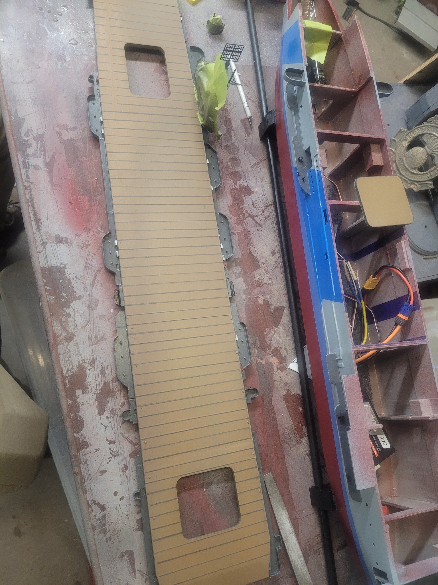

Finished installing the eyebolts, cleats, and pin rails along the inner bulwarks. I'm skipping around a bit compared to the construction sequence provided in the instructions. The rudder was supposed to be the next assembly, but I have no intention of hanging that until I'm ready to mount the hull to its pedestal (which I don't have yet). Rudders just beg to be knocked loose if they're hung too early.

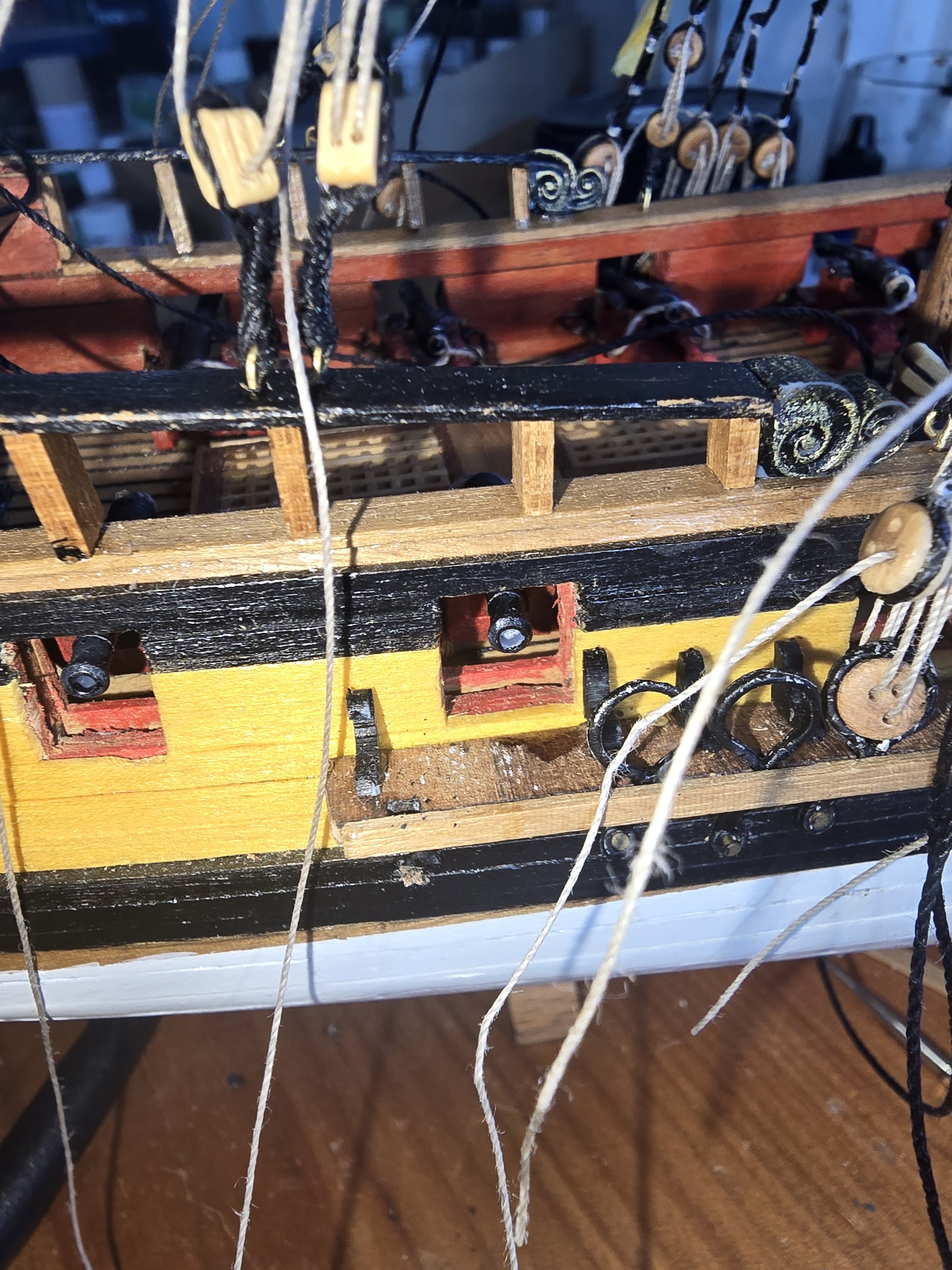

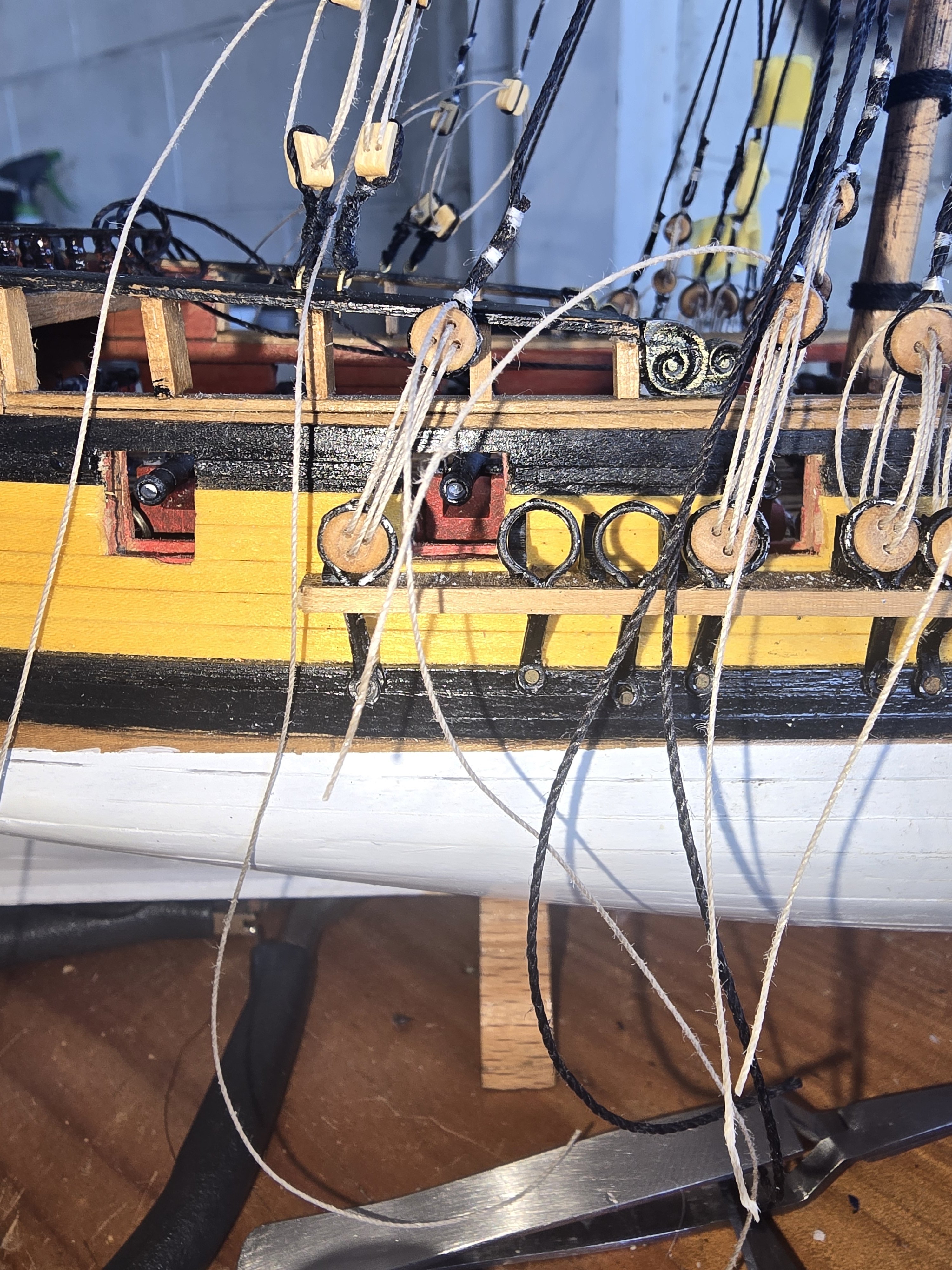

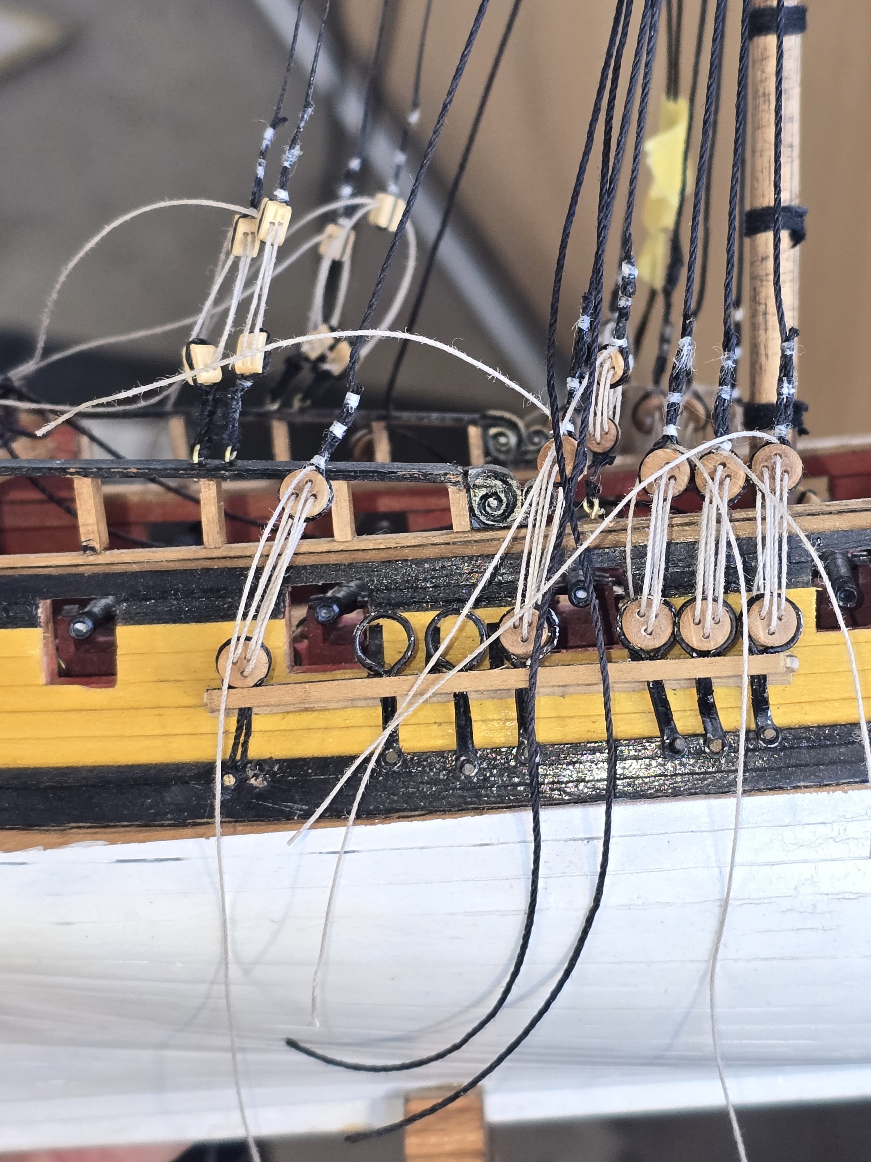

As ive gone along with build ive realised something about building model ships. If you dont like something there isnt anything on this ship that i cant take off redo and put back on. Case in point was the kit supplied chain plates.. which are metal for a start and not in keeping with 1720 but anyway it was the angle of the chain plate with the stay and so i decided to change it this morning... 15 minutes work and its much better than it was! Dont be afraid to change things with the kit... it will be ok!

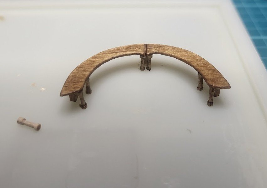

Thanks George and Snug Harbor Johnny! The arch on the stern is pretty crude, but I didn’t have a better idea. No way I could carve it out of wood and no good design for a decal . Rick
