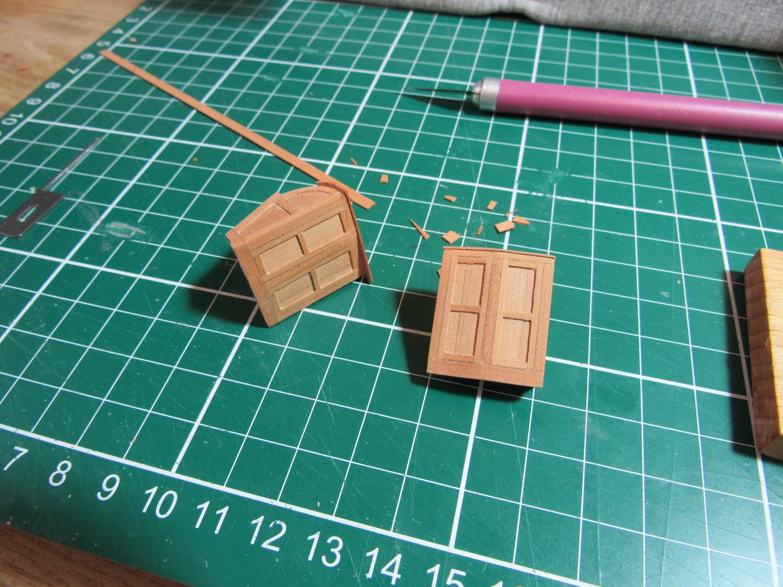

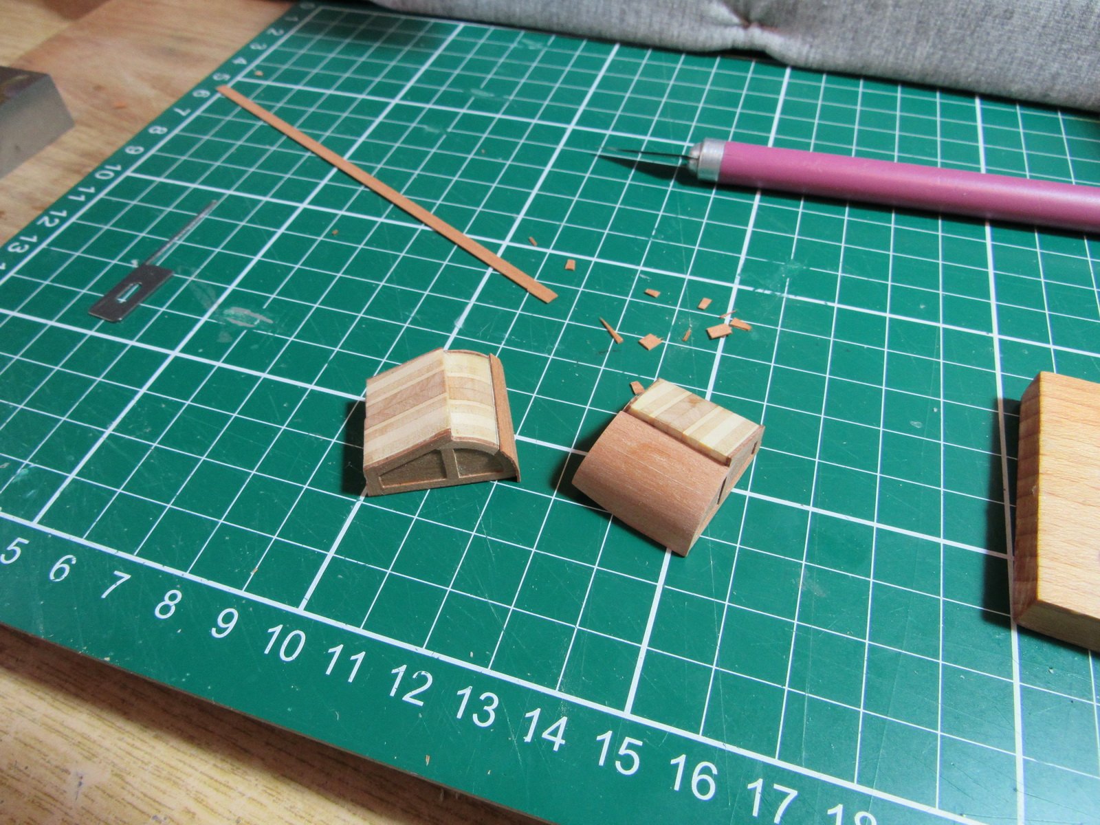

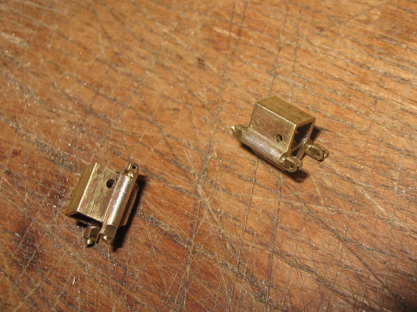

Skylight and companion at the back. Again acrylic, pear and brass.
Edited by Ilhan Gokcay

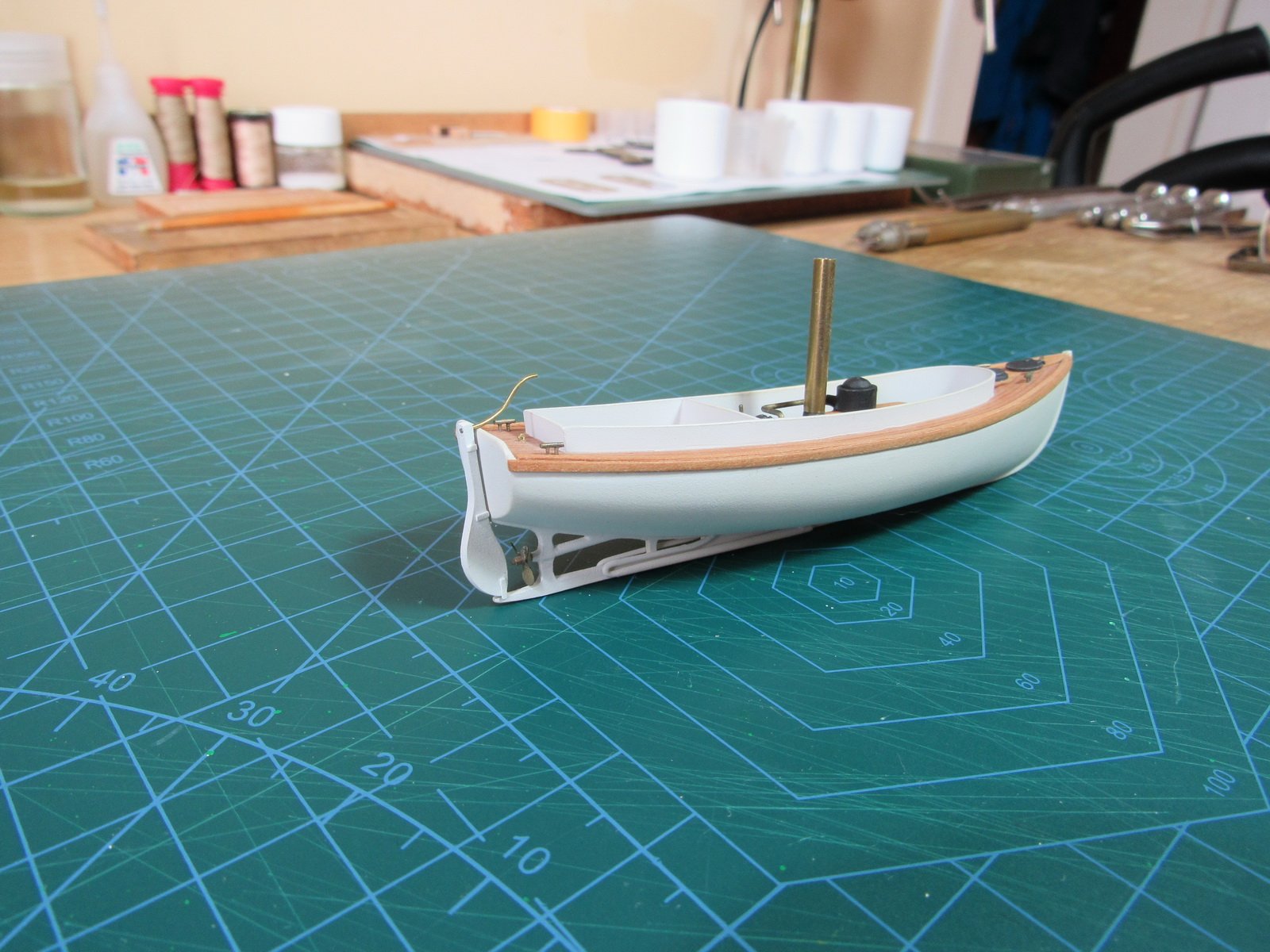

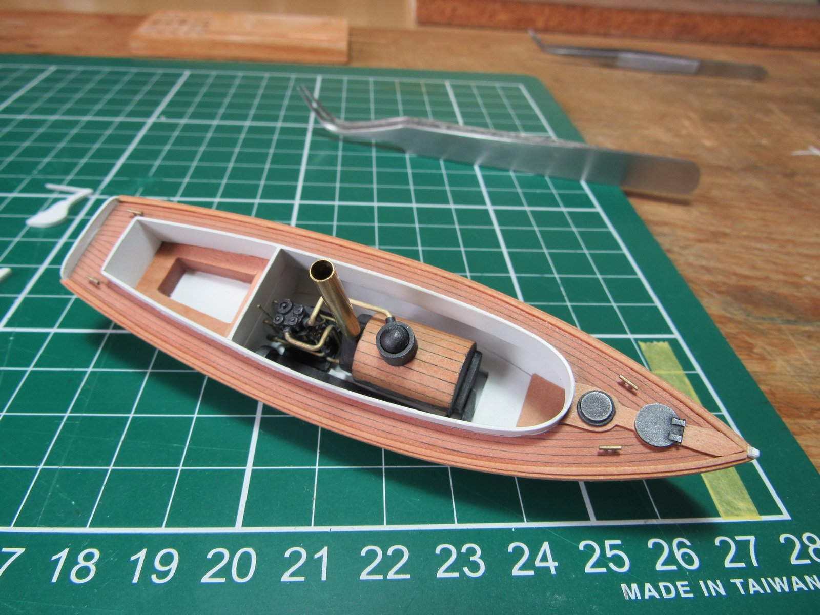

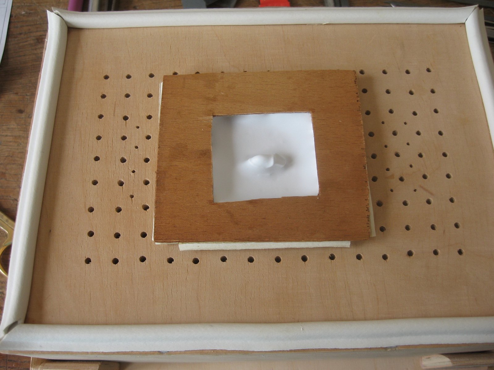

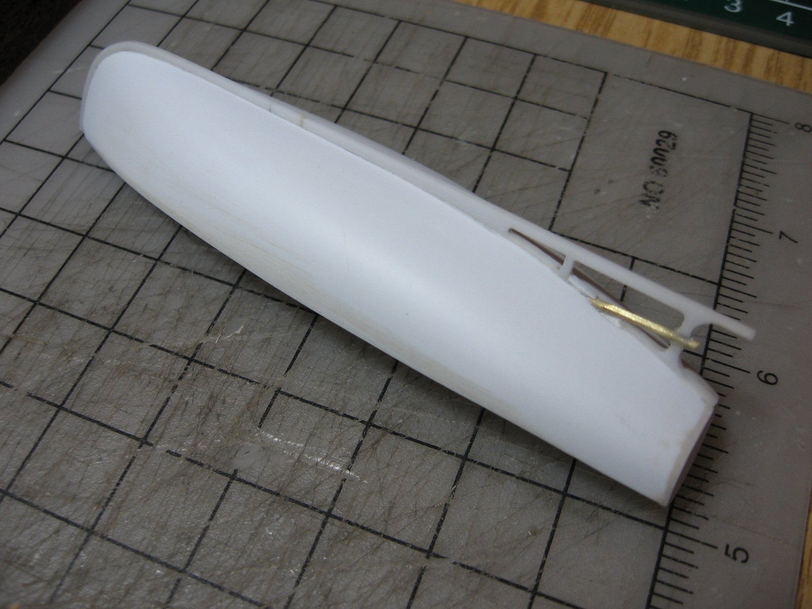

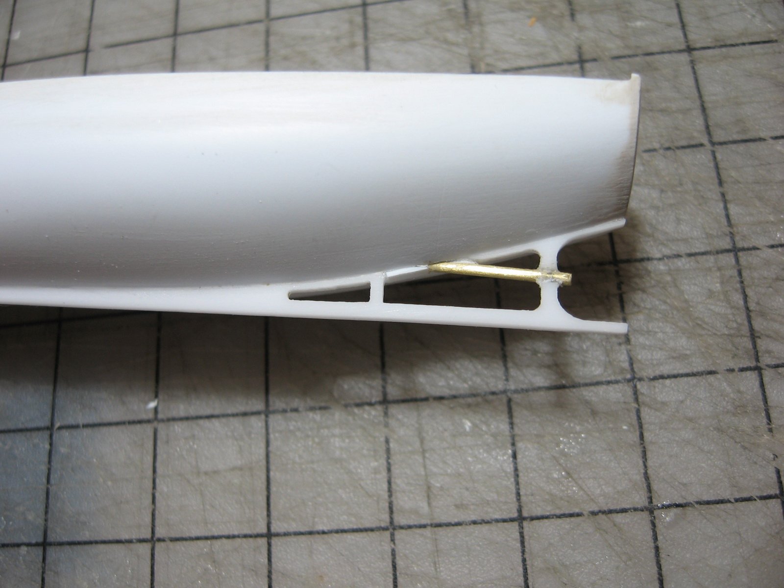

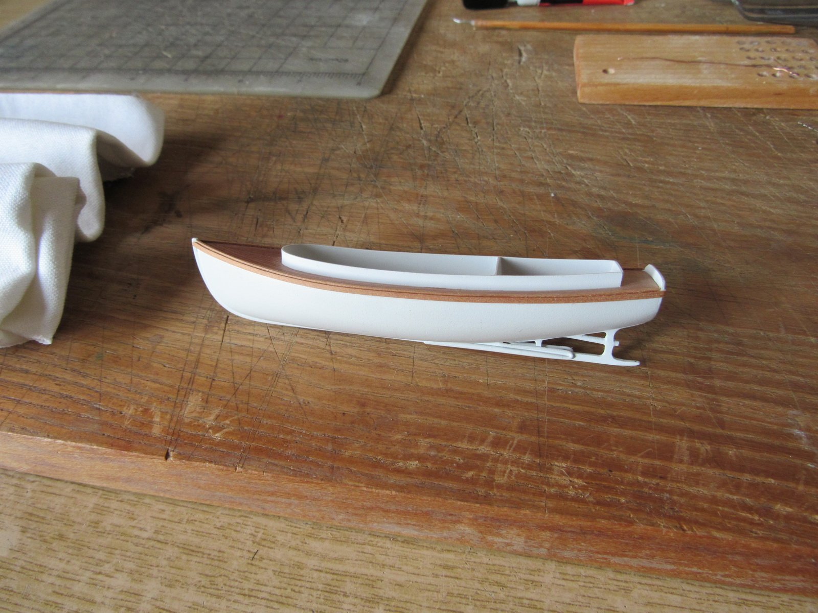

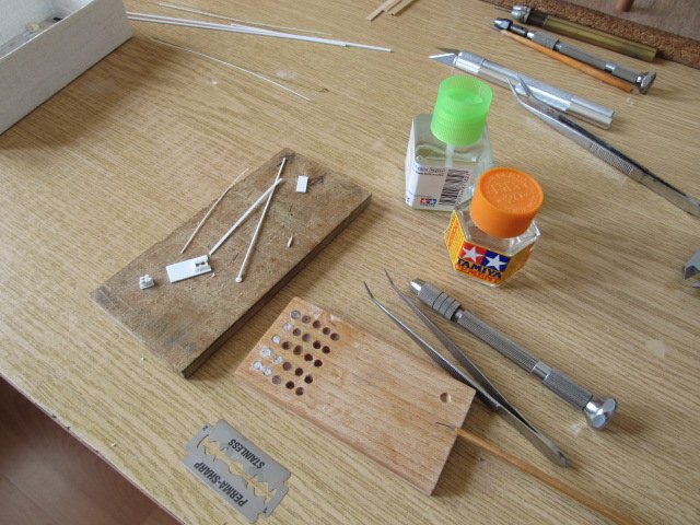

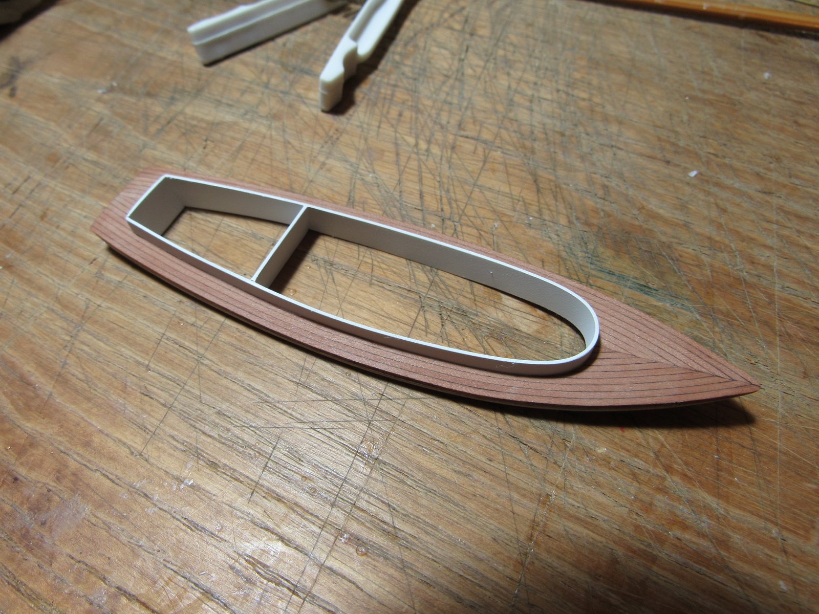

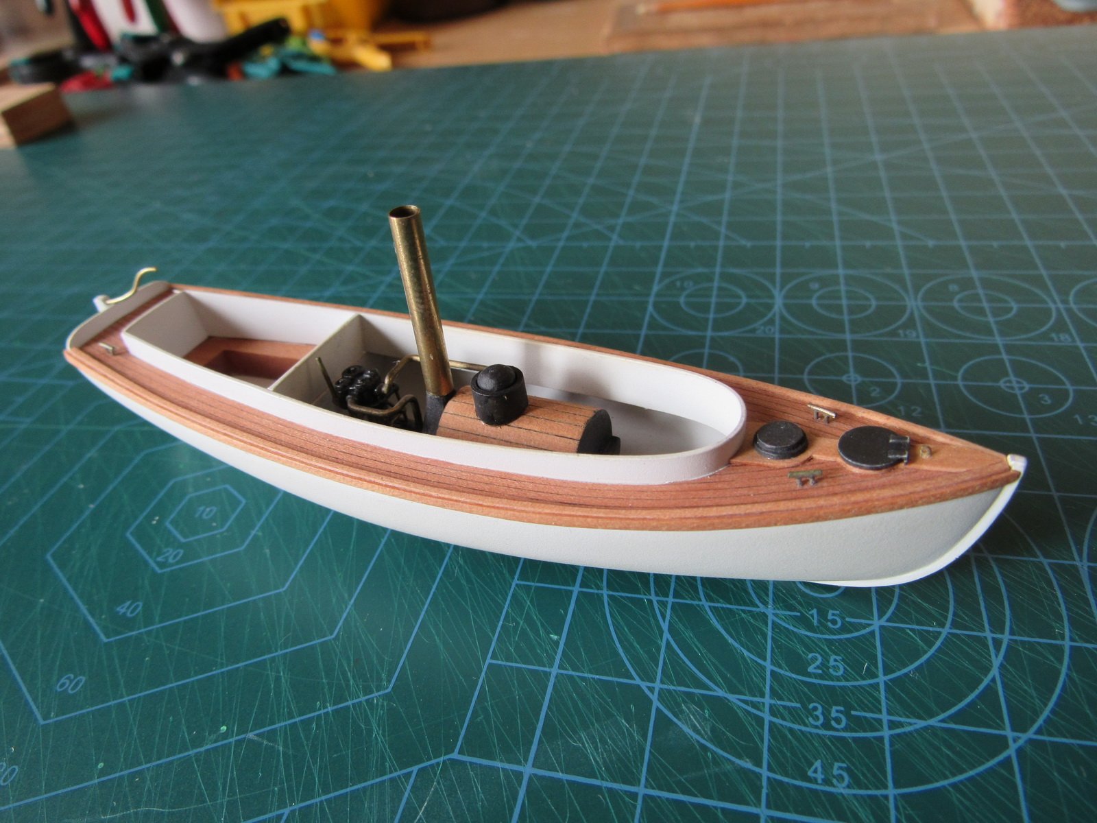

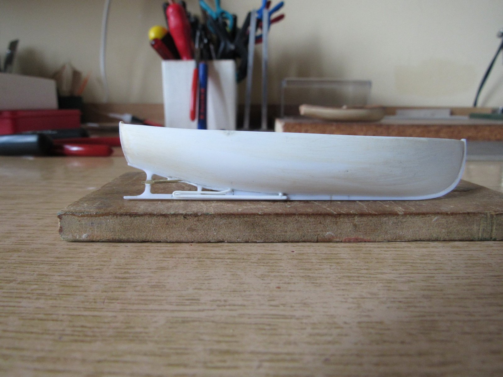

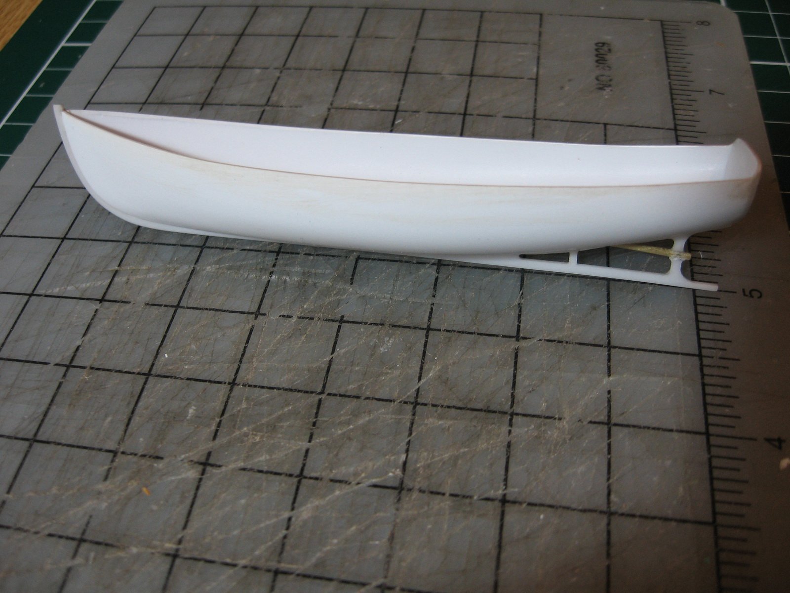

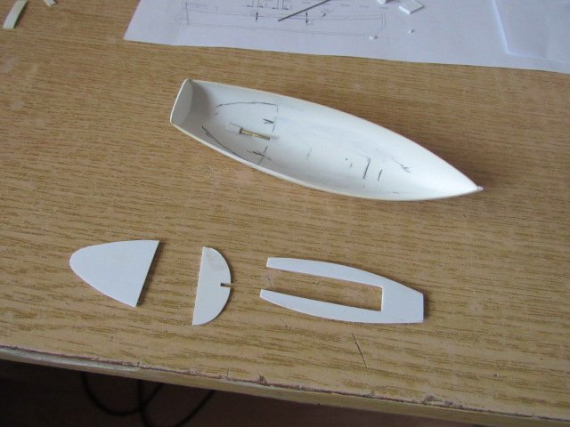

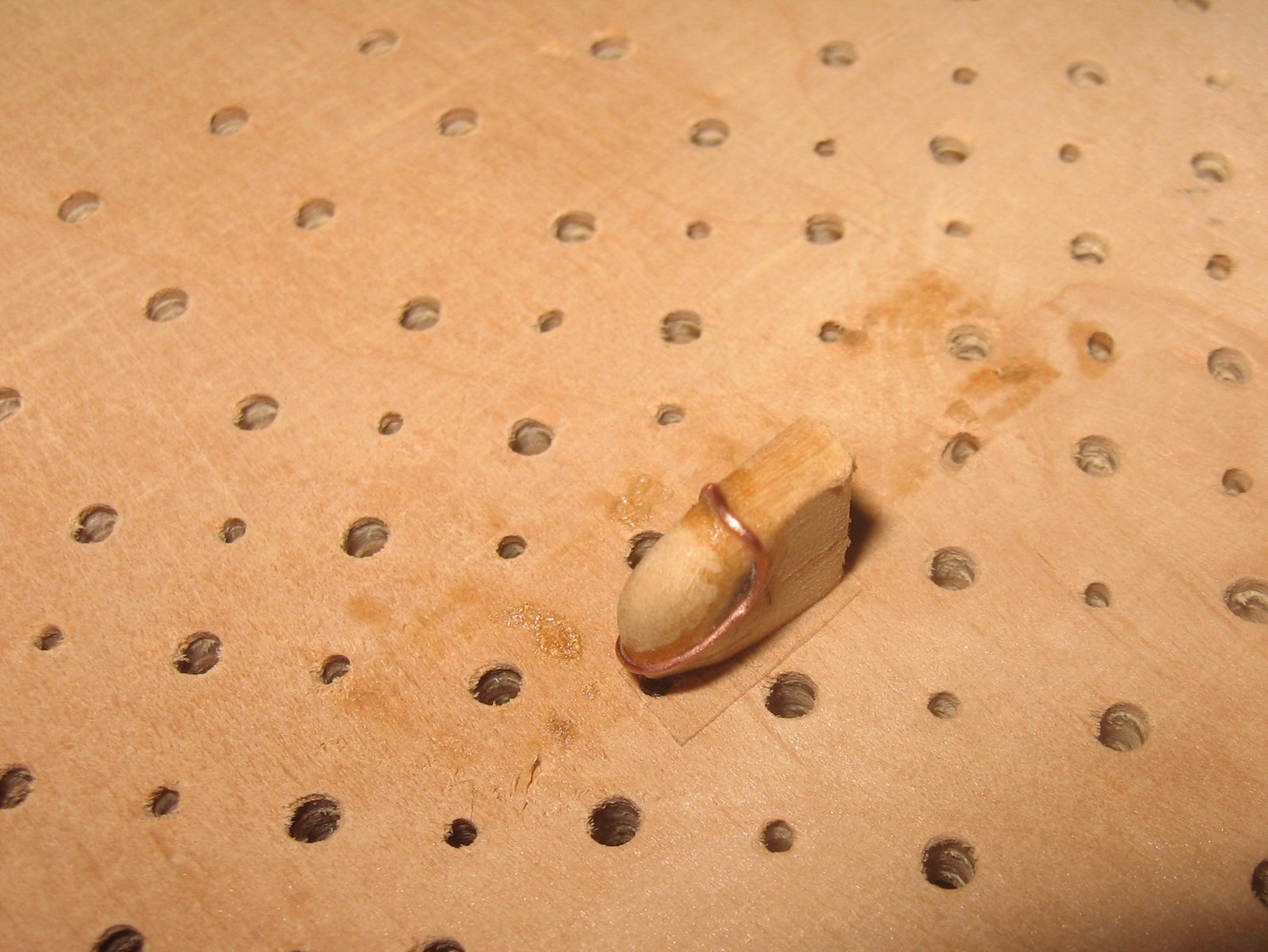

I've started to build the boats. There are 6 boats and they are all made of polystyren sheets with vacuum thermoforming.

Amazing work, Ilhan. Thank for showing us how you made the ship's boats.
Iilhan, thank you for your excellent, clear (boat) tutorial..... a project I've been toying with for some time.

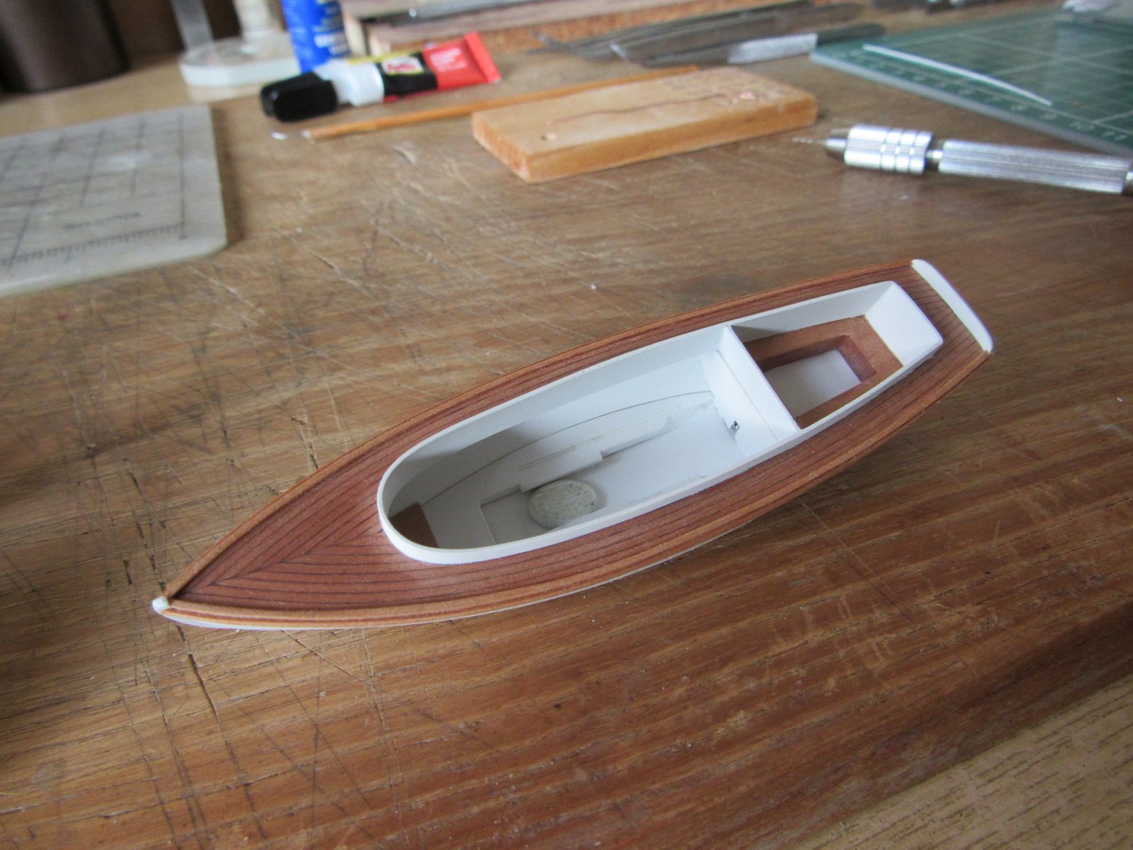

What was the sheet plastic thickness you used?
Apart from the internal architecture, I will be interested to see how you represent the keel on each boat.

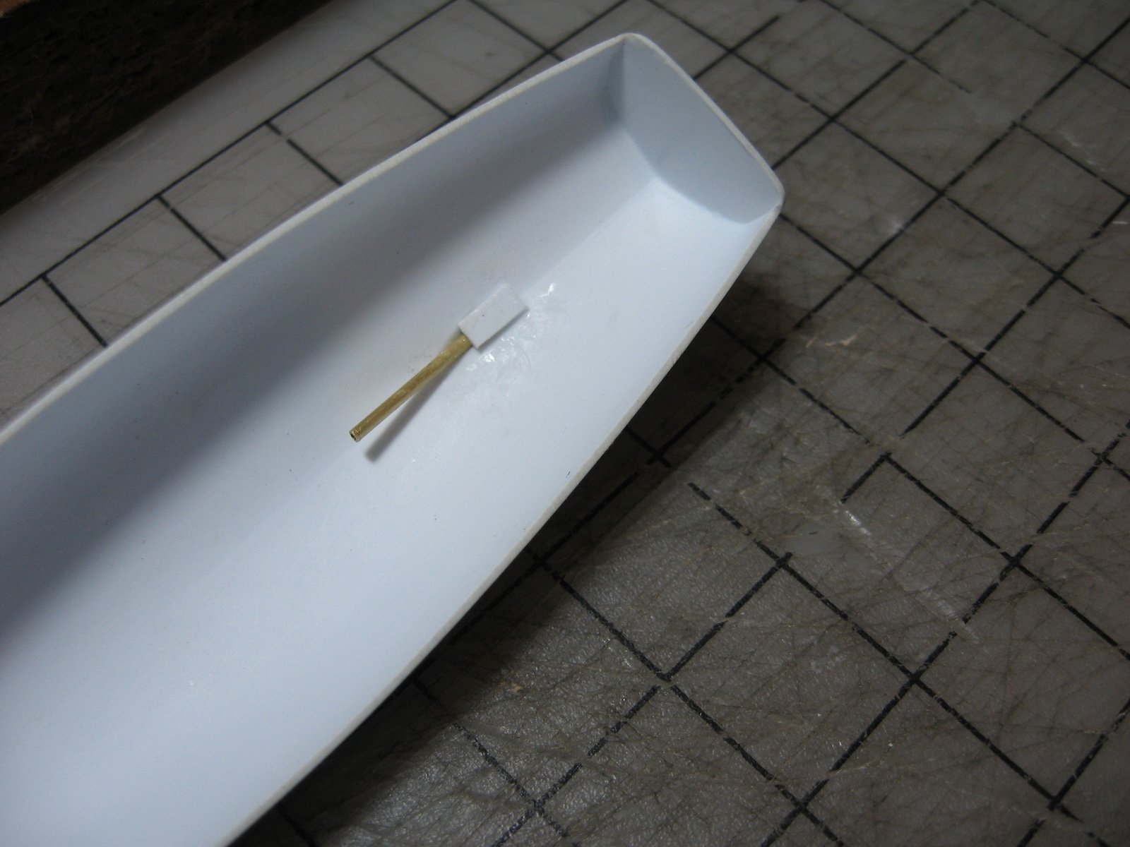

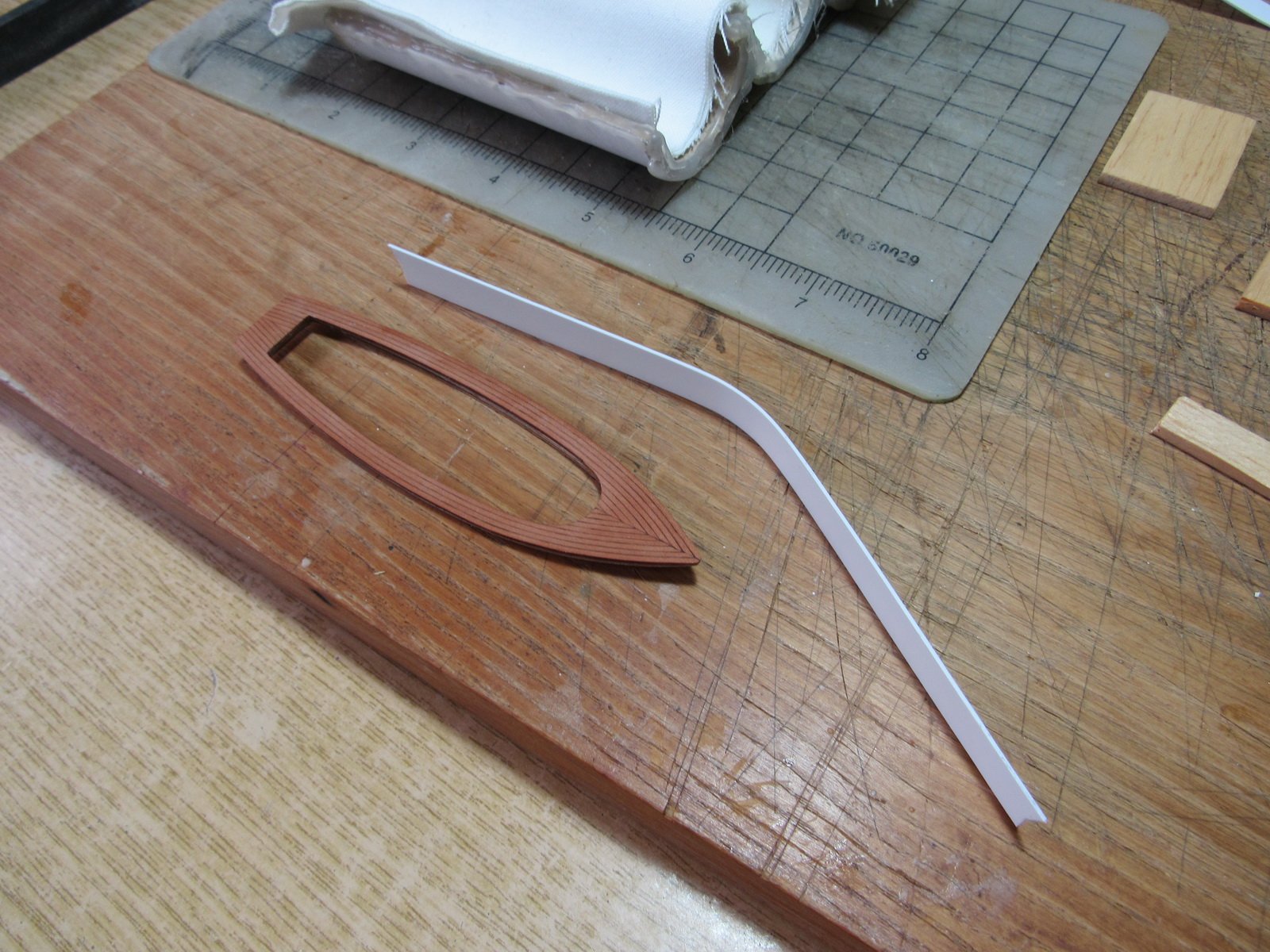

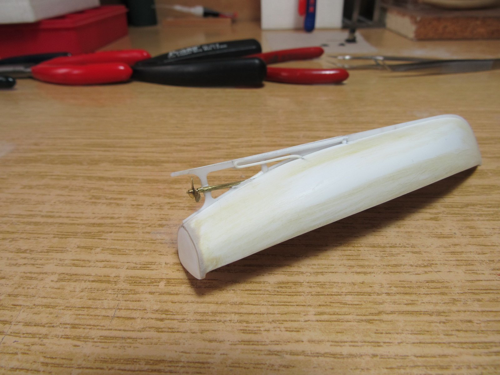

Thanks  shipman.
It's polystyren sheet initially 0,75 mm thick. After forming it reduces appr. to 0,5 mm's.
To get the keel (0,75x0,75mm plastic strip) straight I made a straight edge and glued the strip with polistyren glue.
I have most problems with the frames and getting them aligned.
After several failed attempts I made a plug/core of the boot and cut it at the intervals of the frames. So using these mould parts as a template I managed to fix the frames exactly aligned and square to the keel. I press the plastic strip (0.25x0.75mm) to the mould and let tiny drops of CA to penetrate at the side. One by one and step by step.

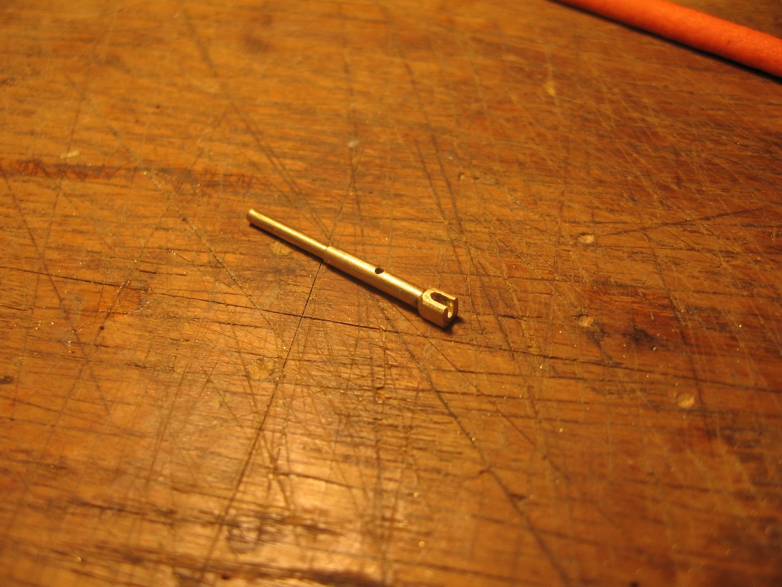

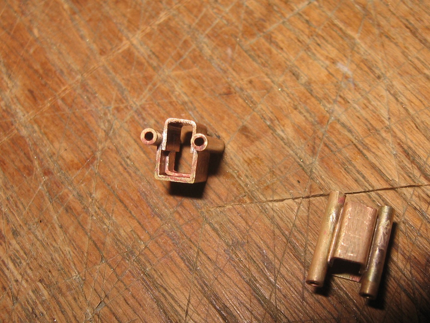

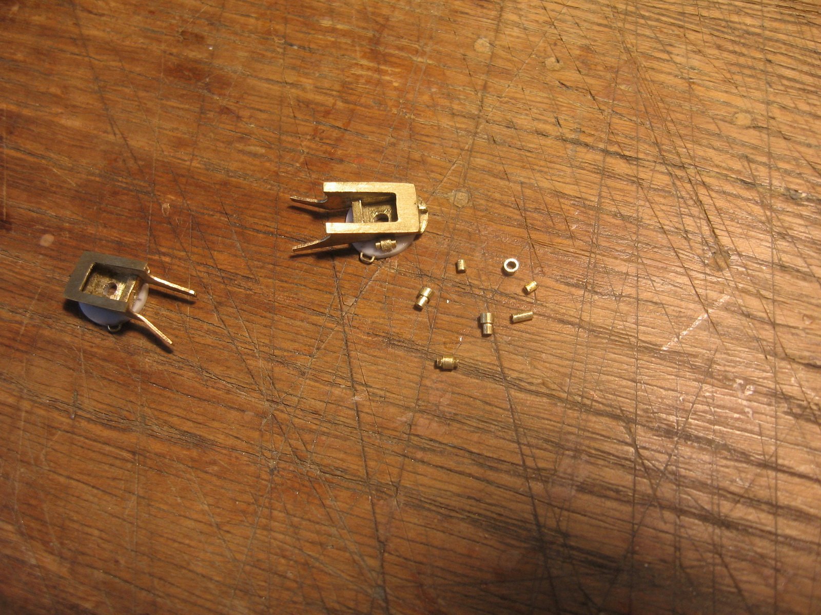

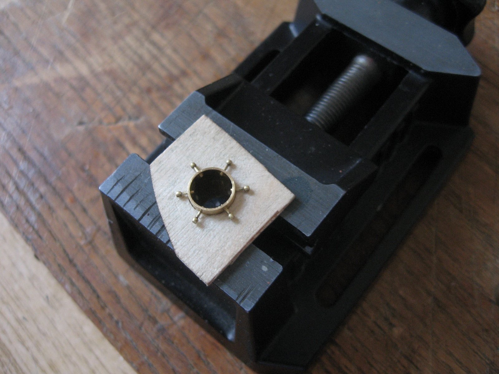

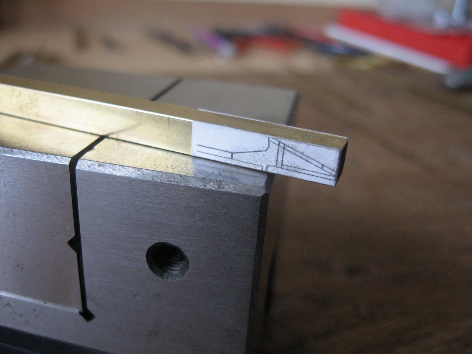

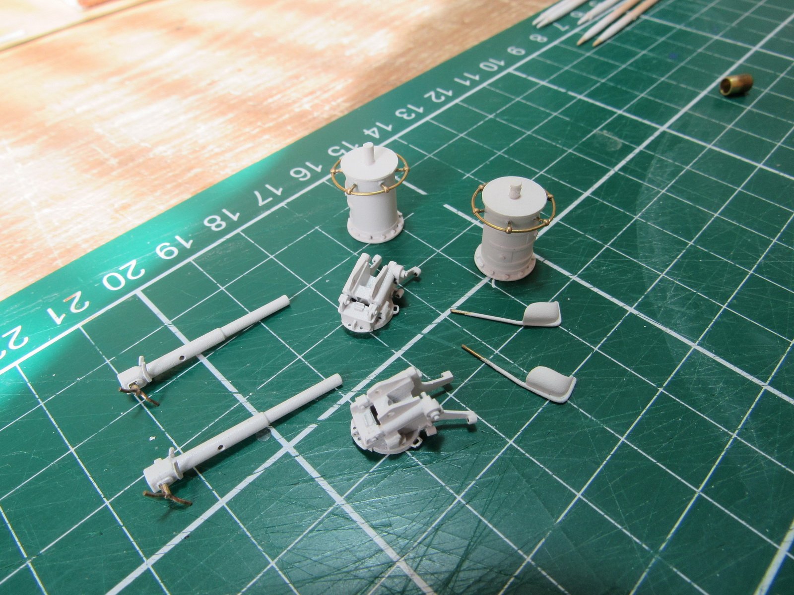

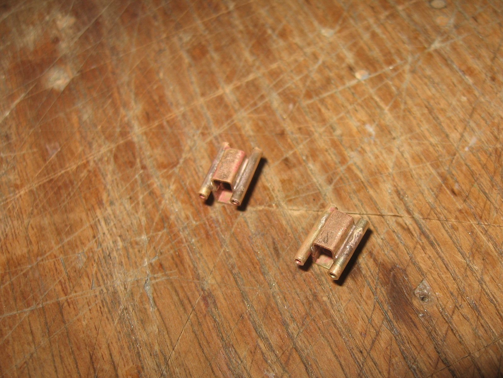

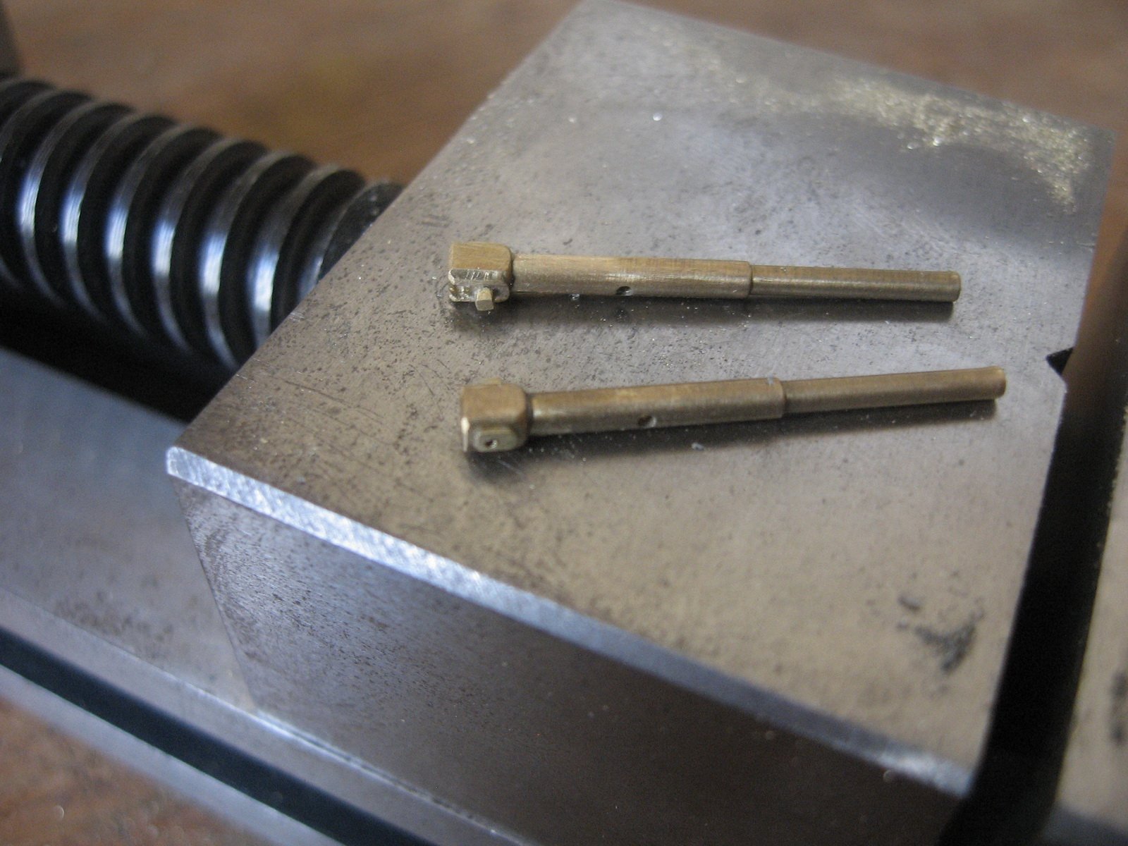

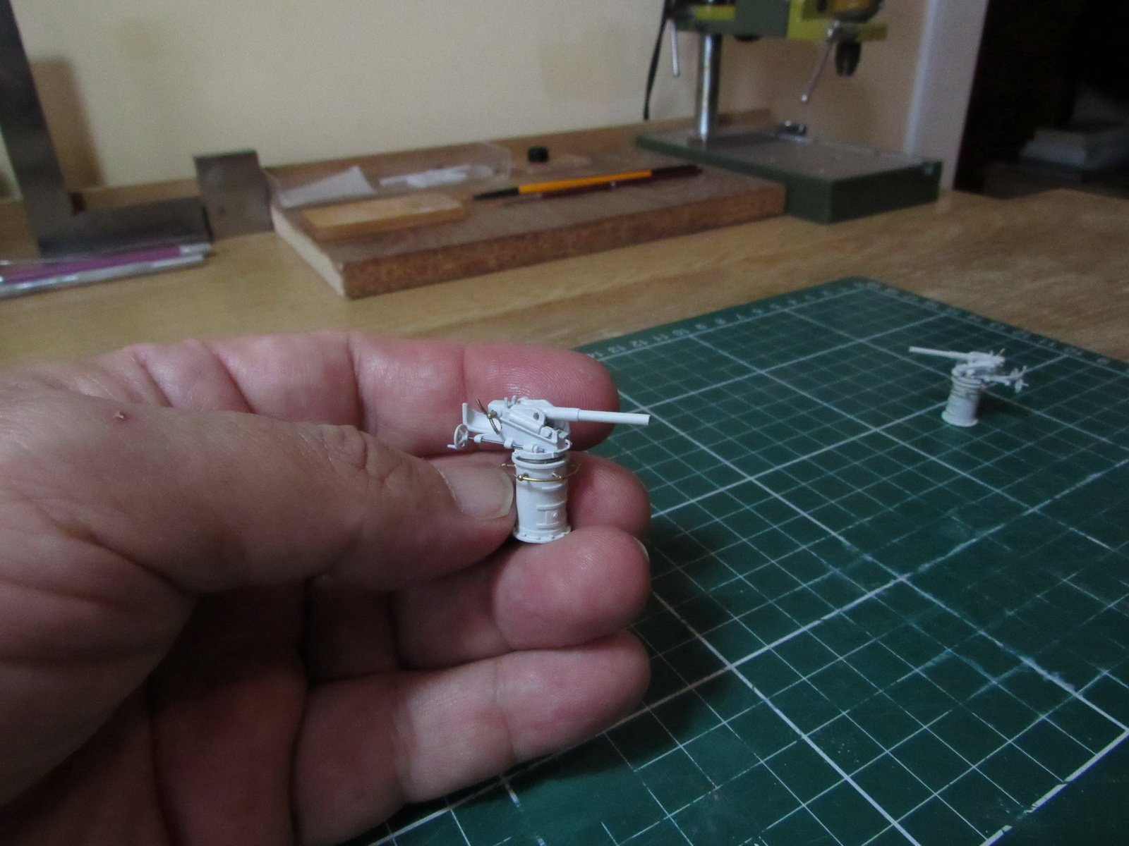

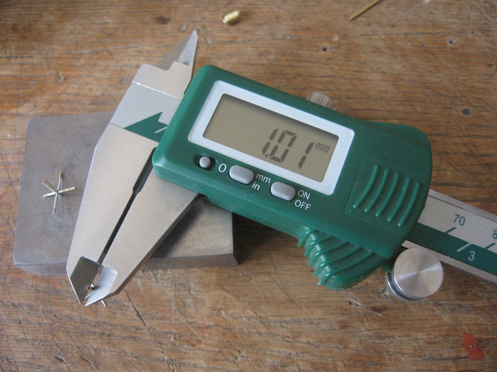

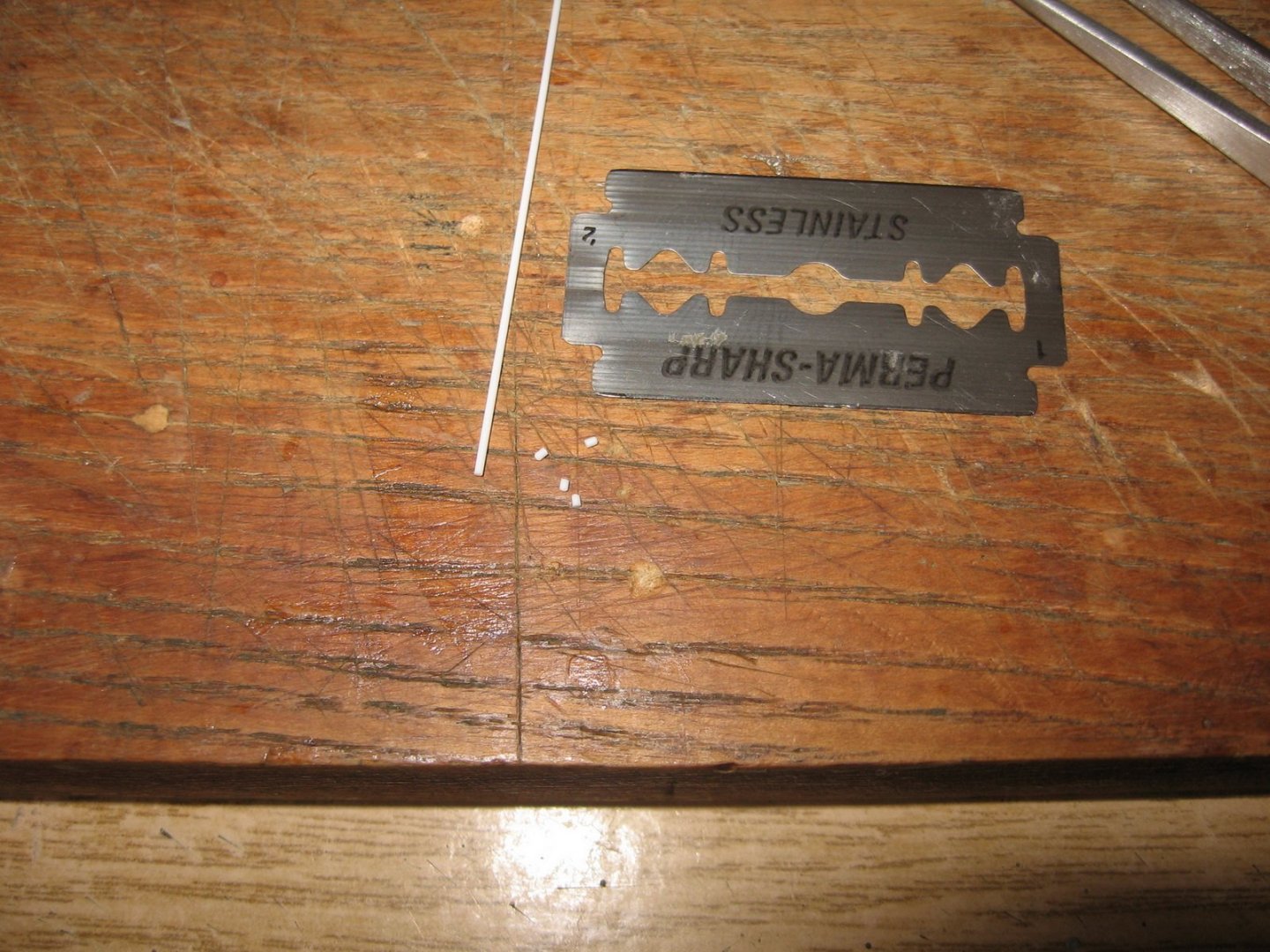

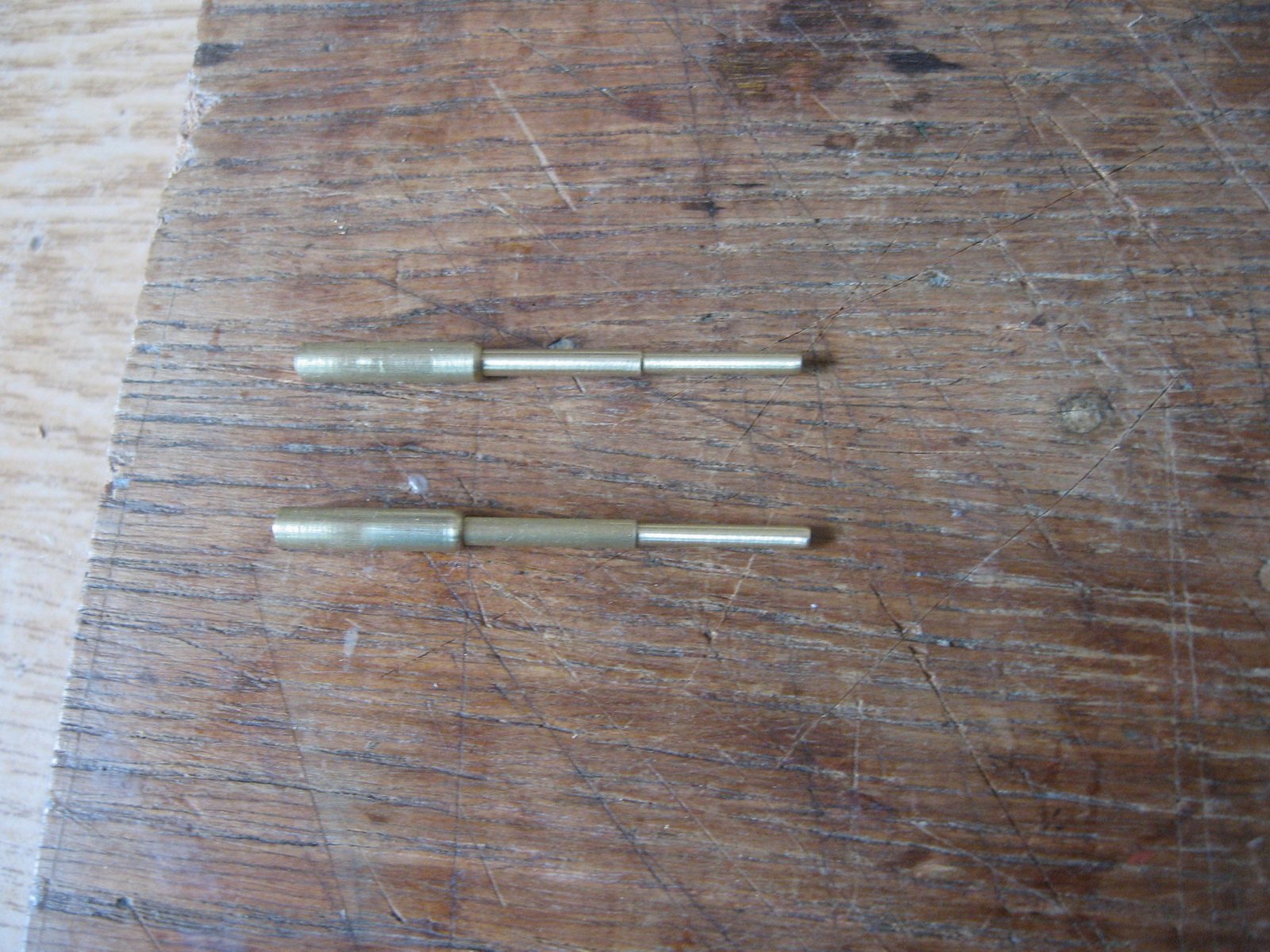

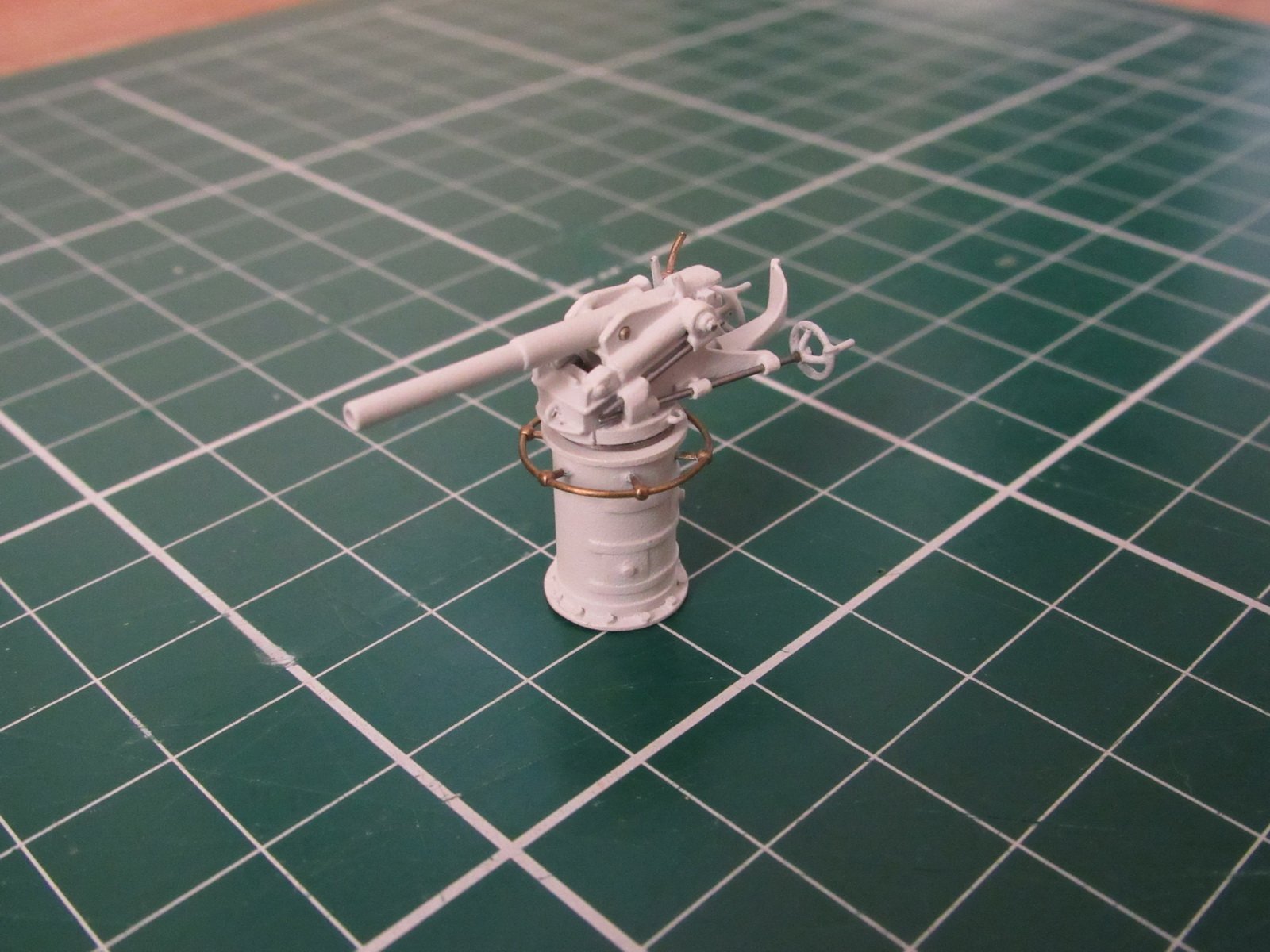

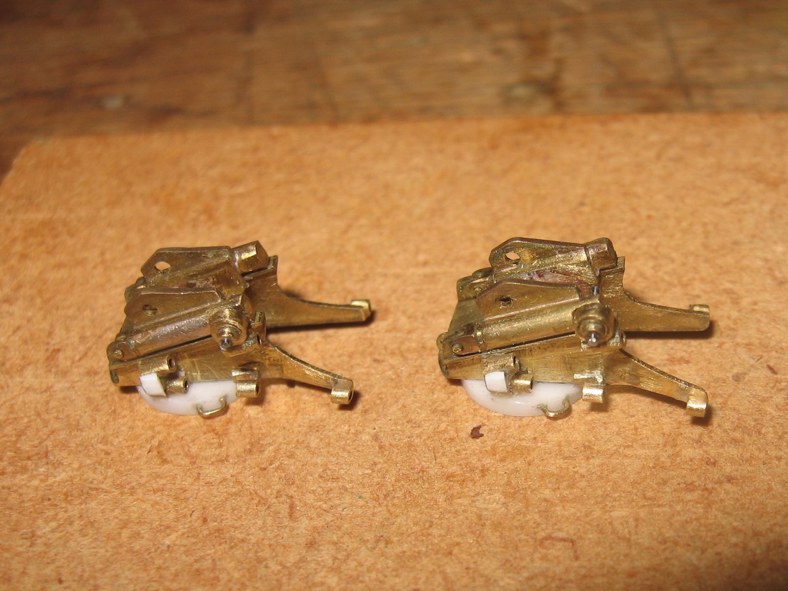

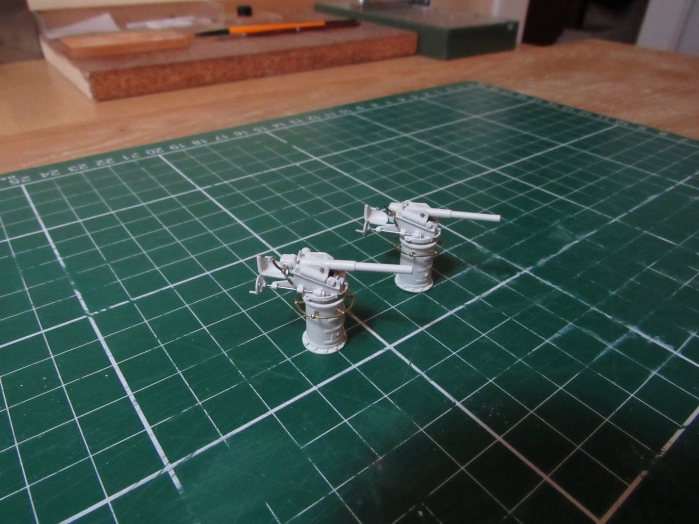

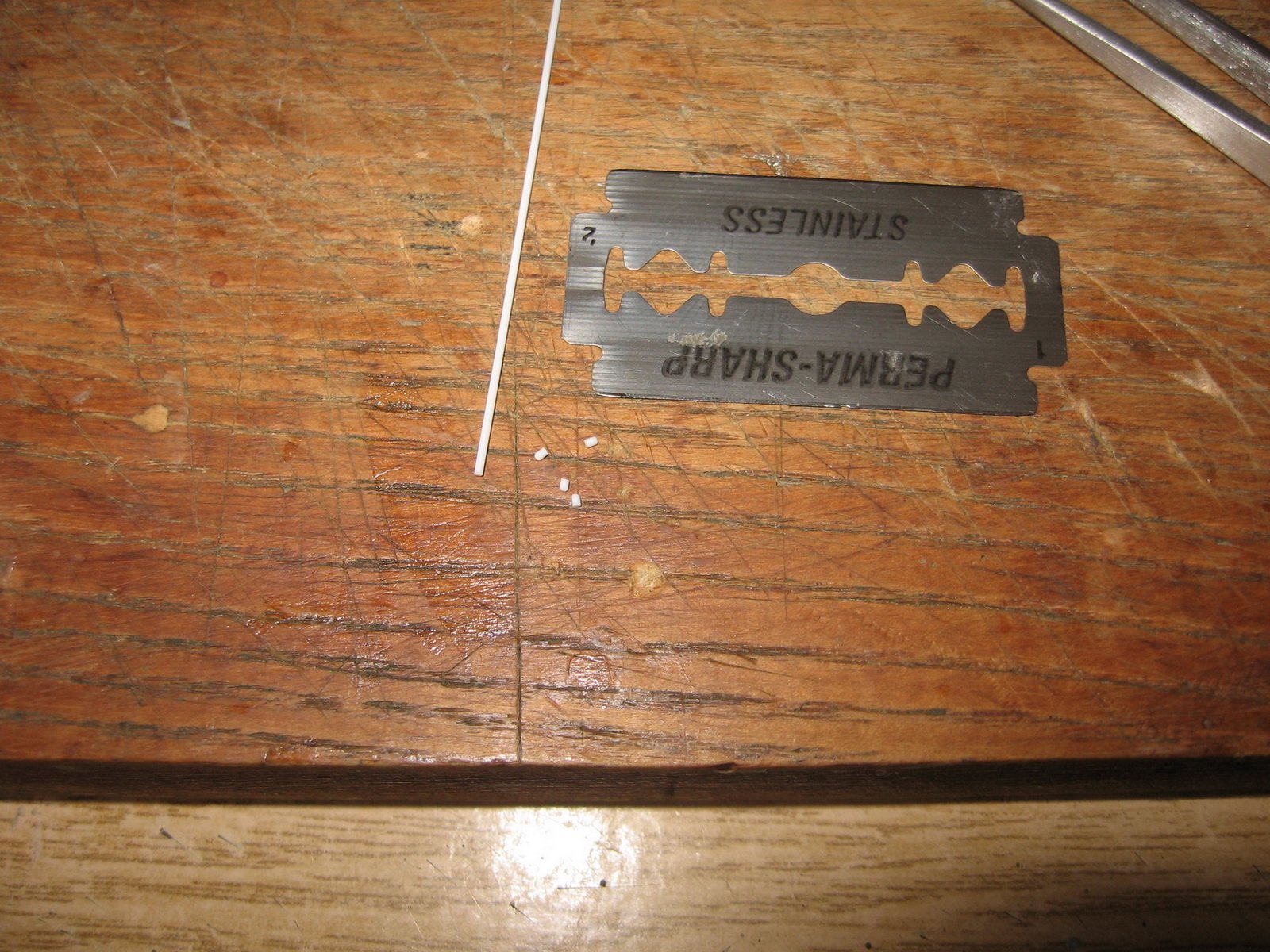

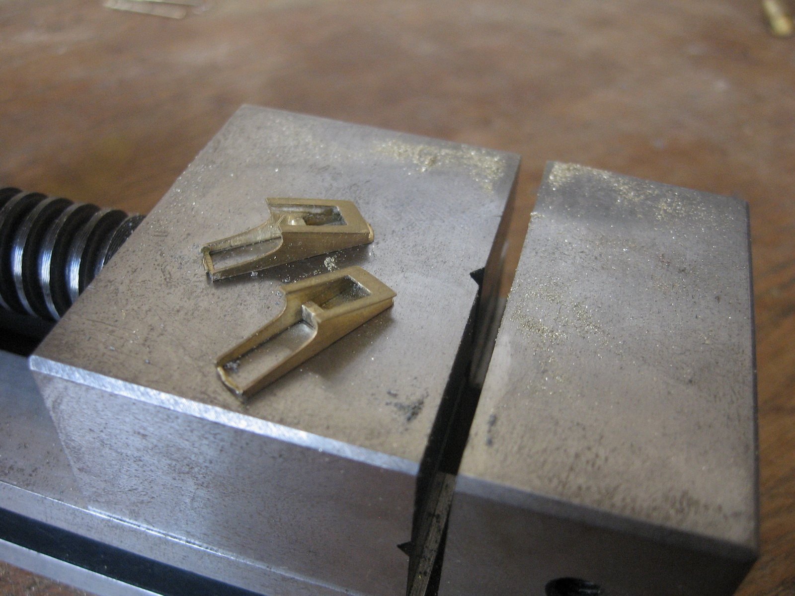

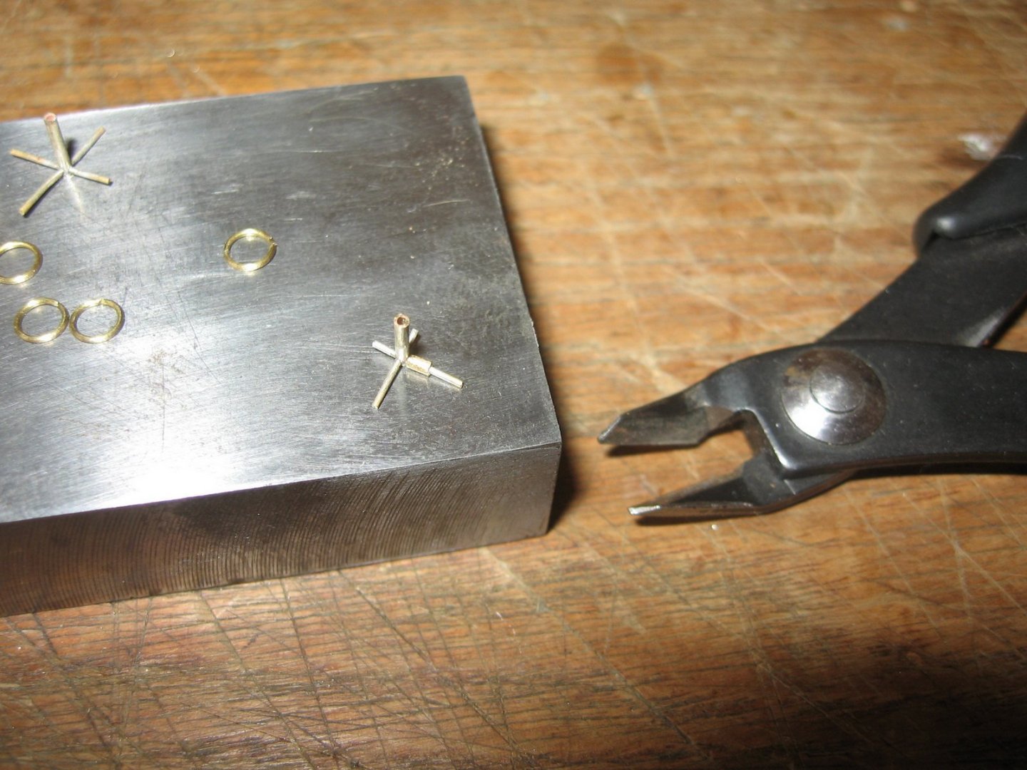

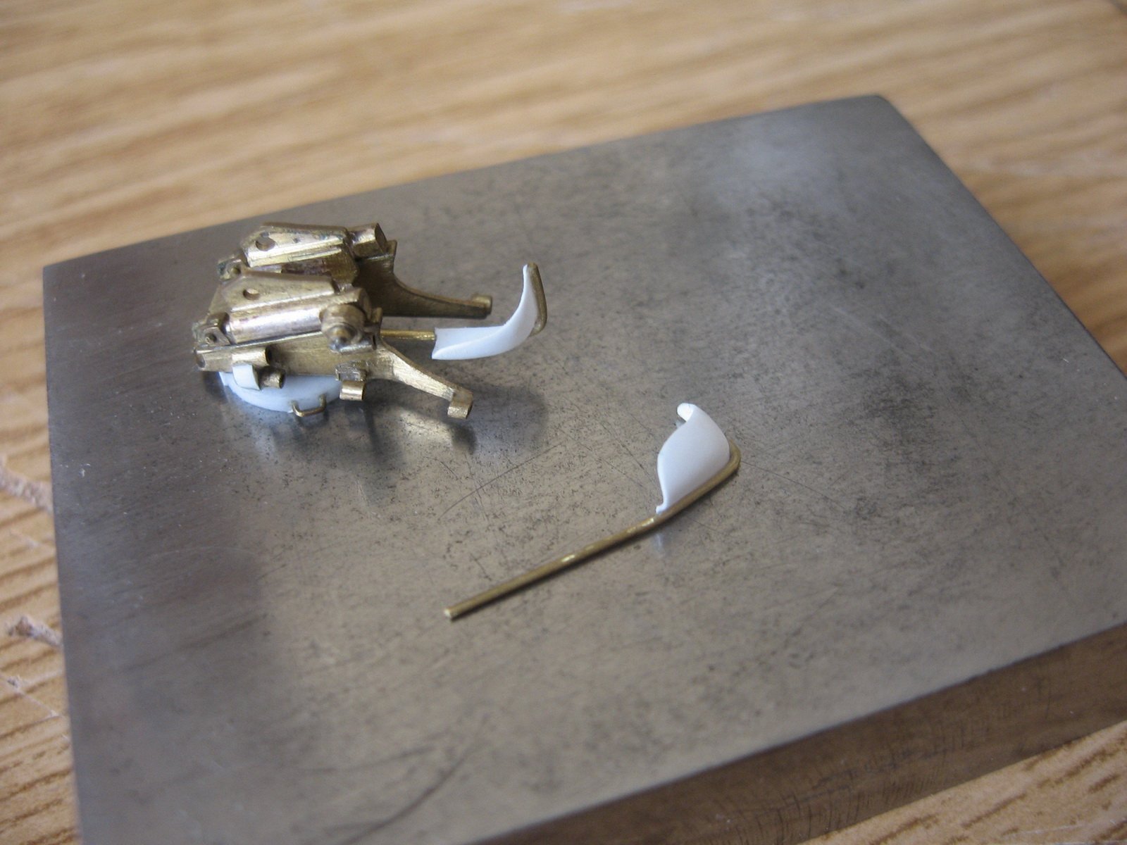

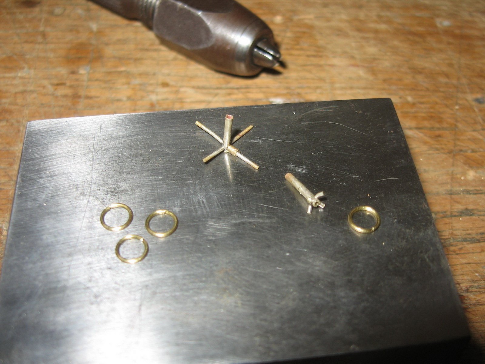

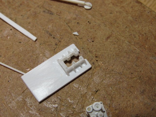

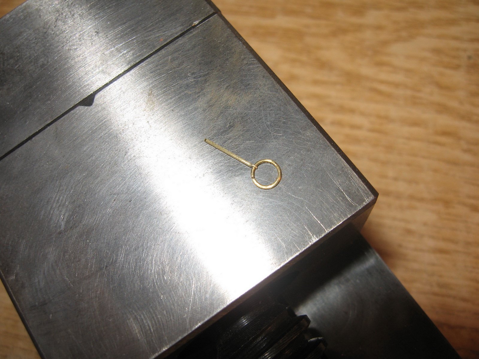

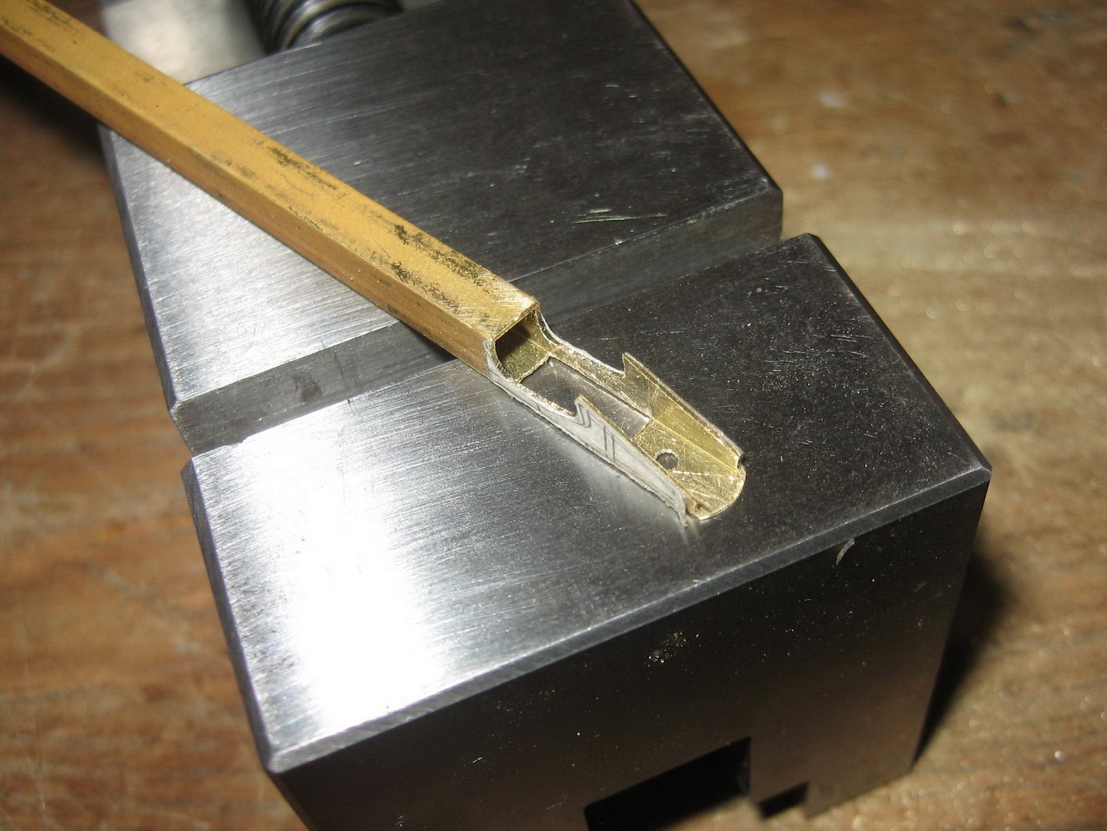

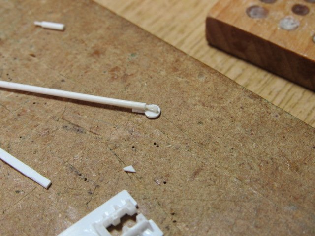

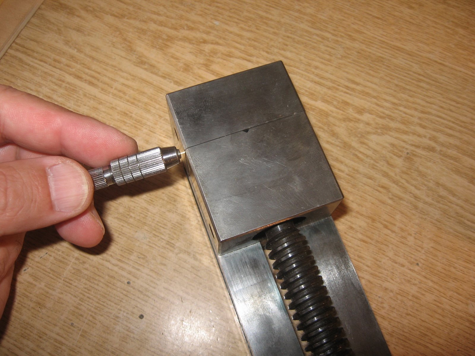

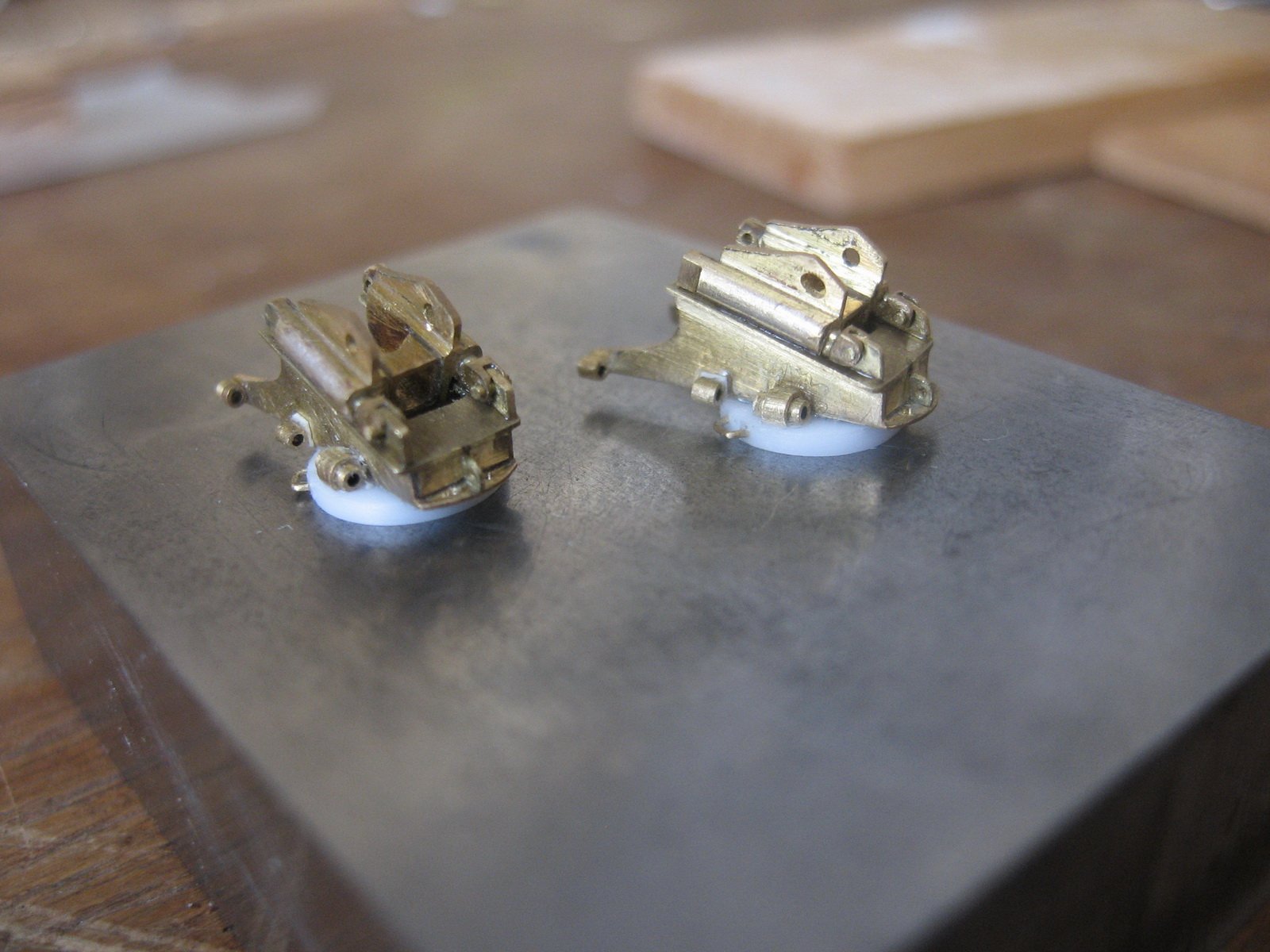

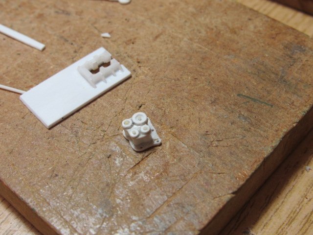

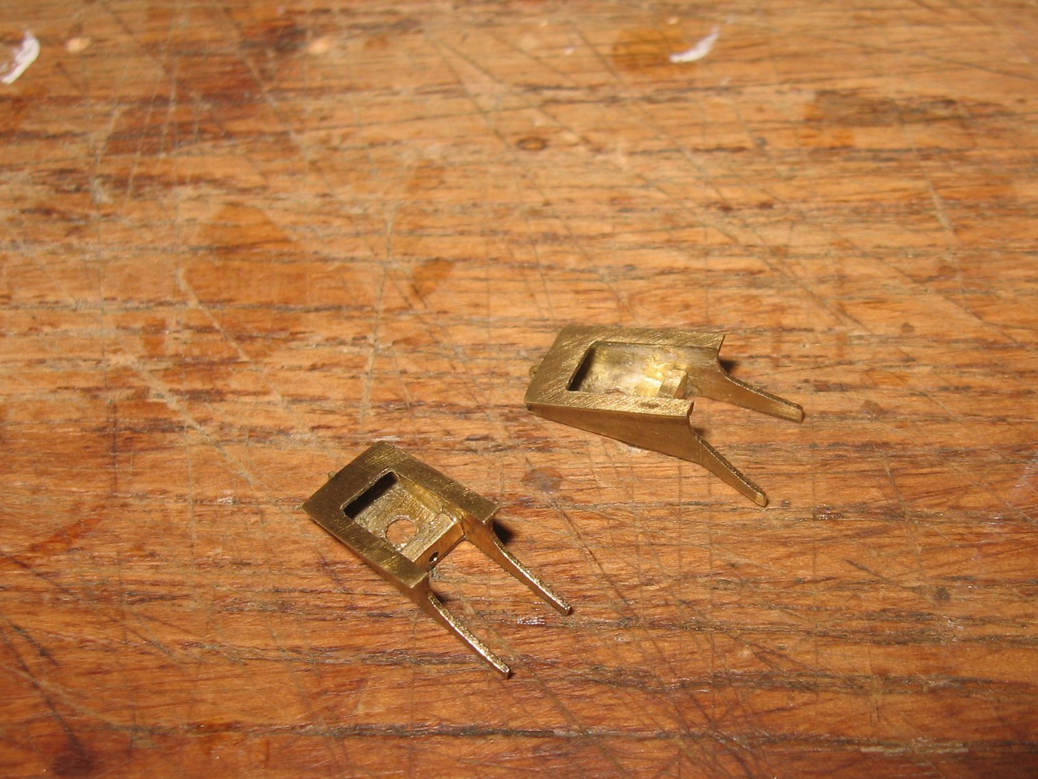

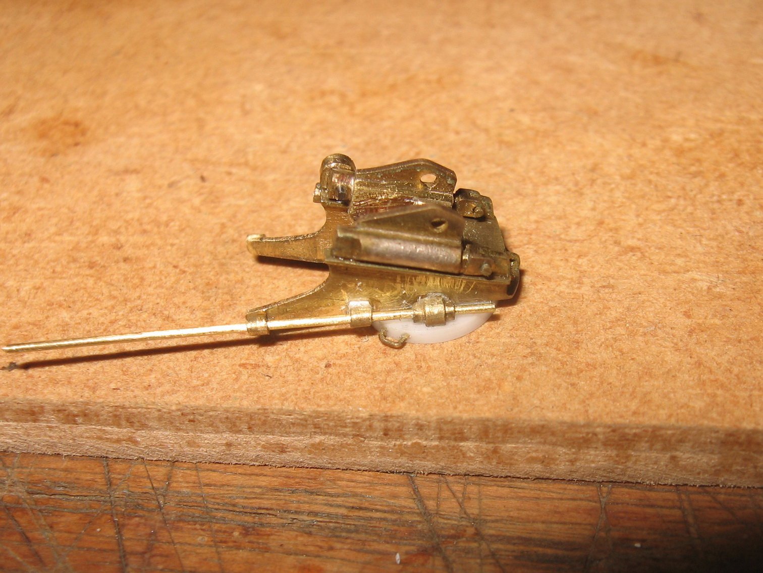

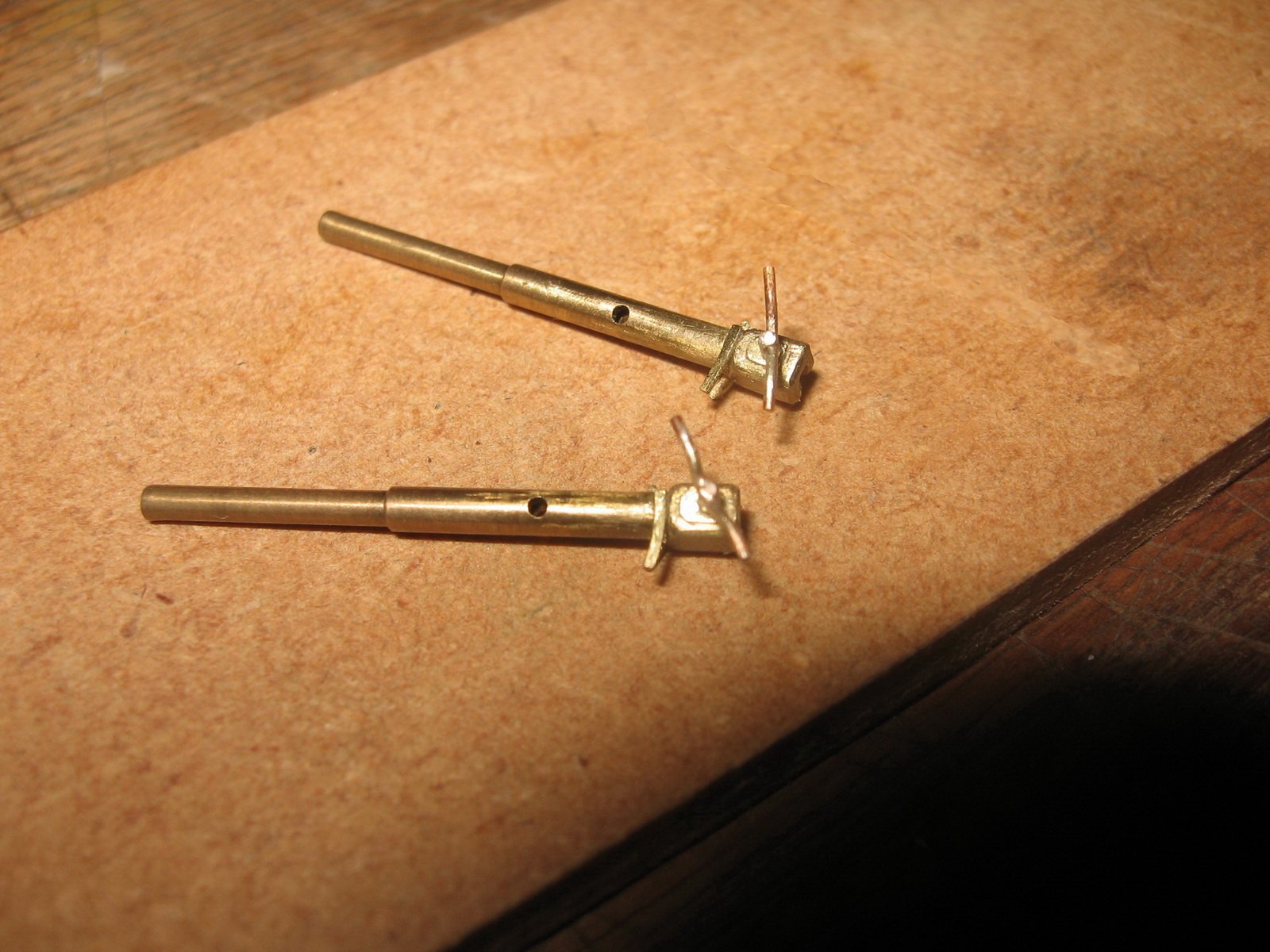

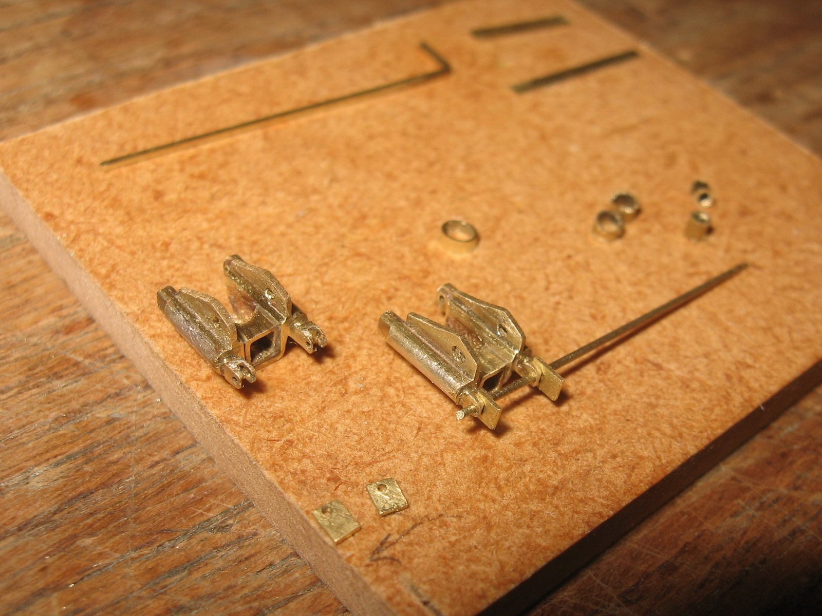

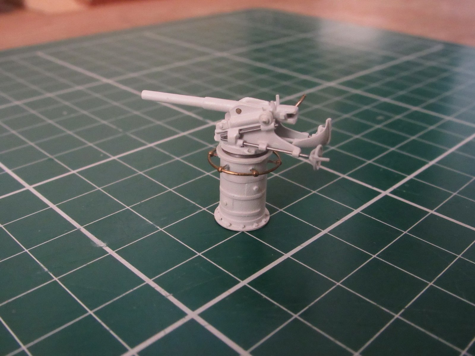

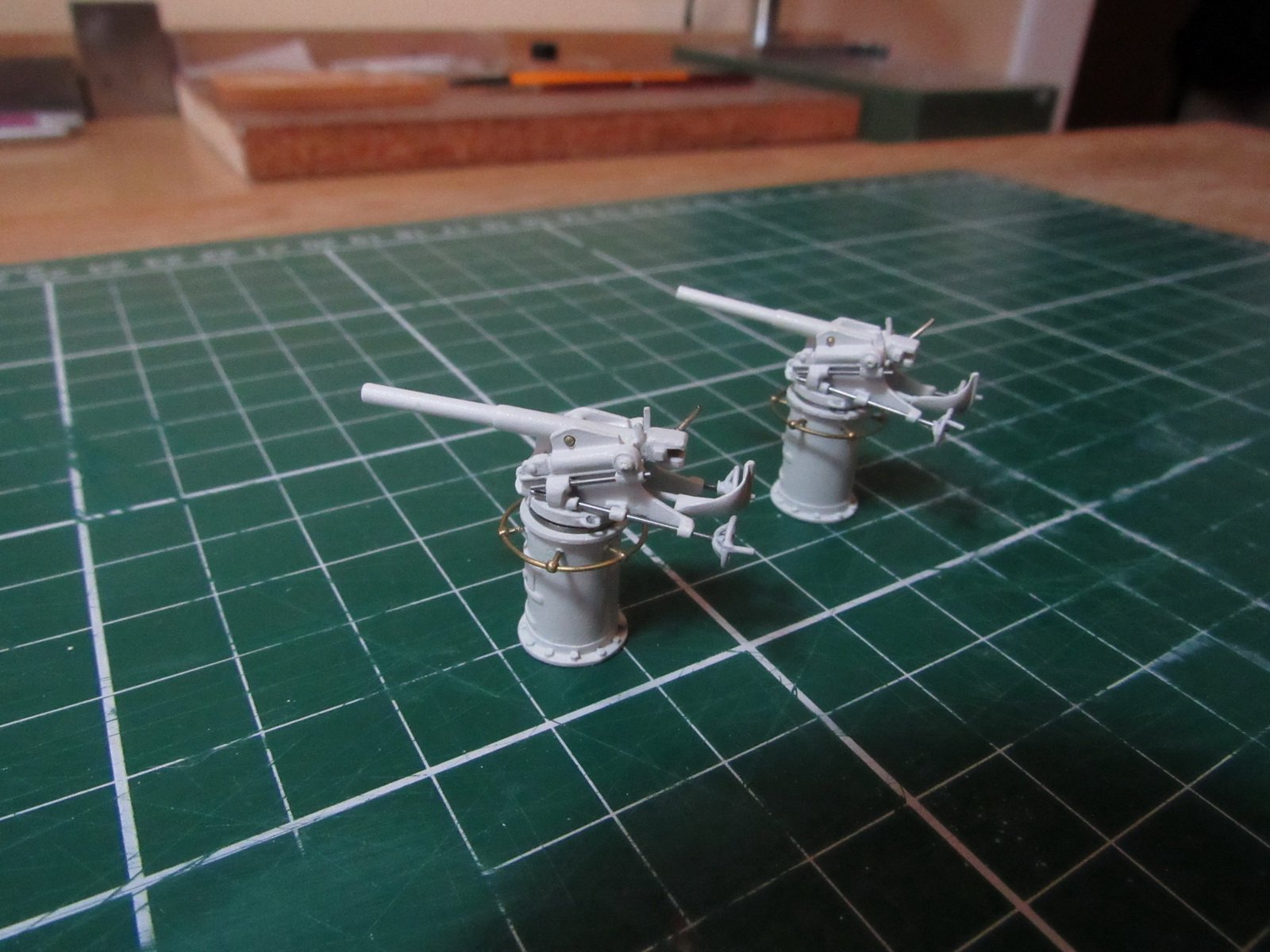

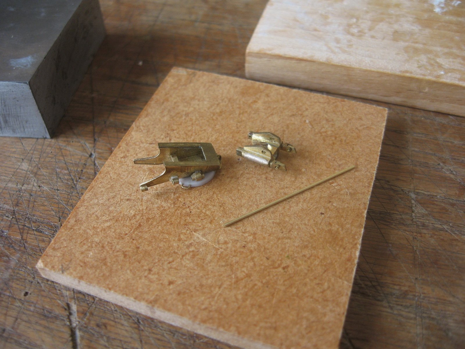

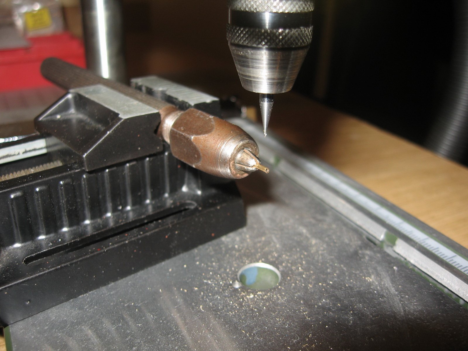

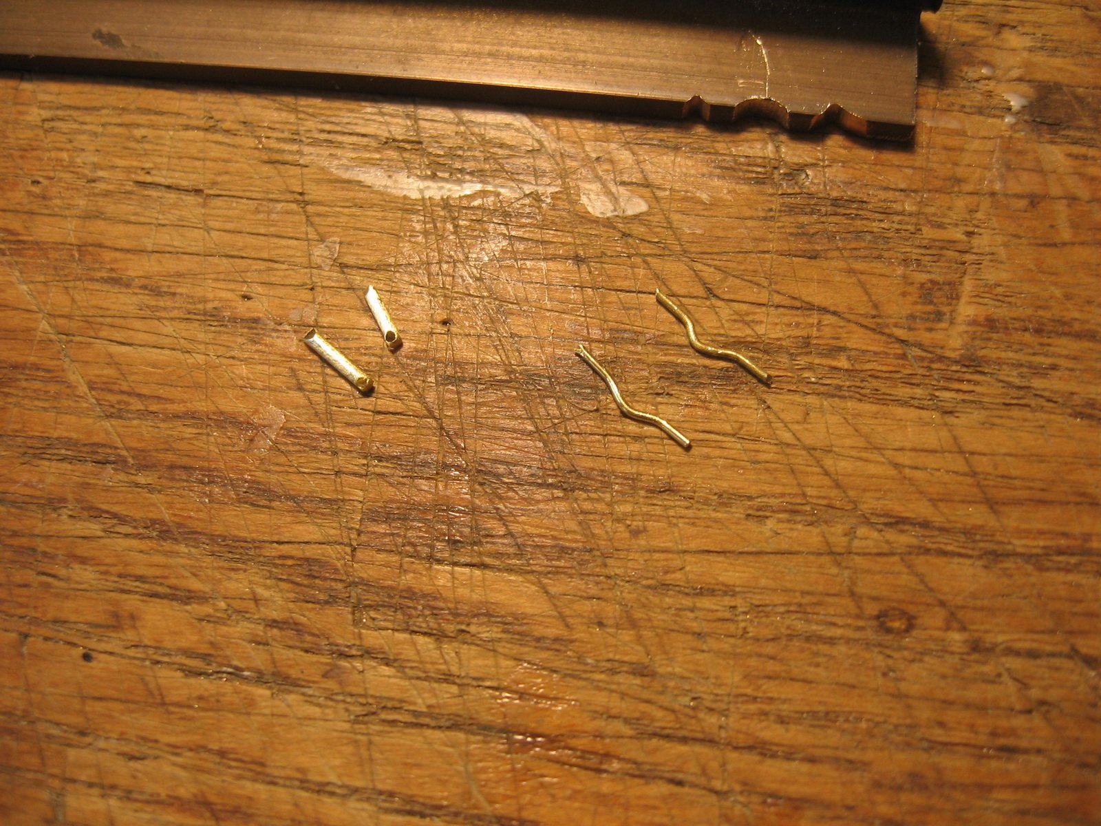

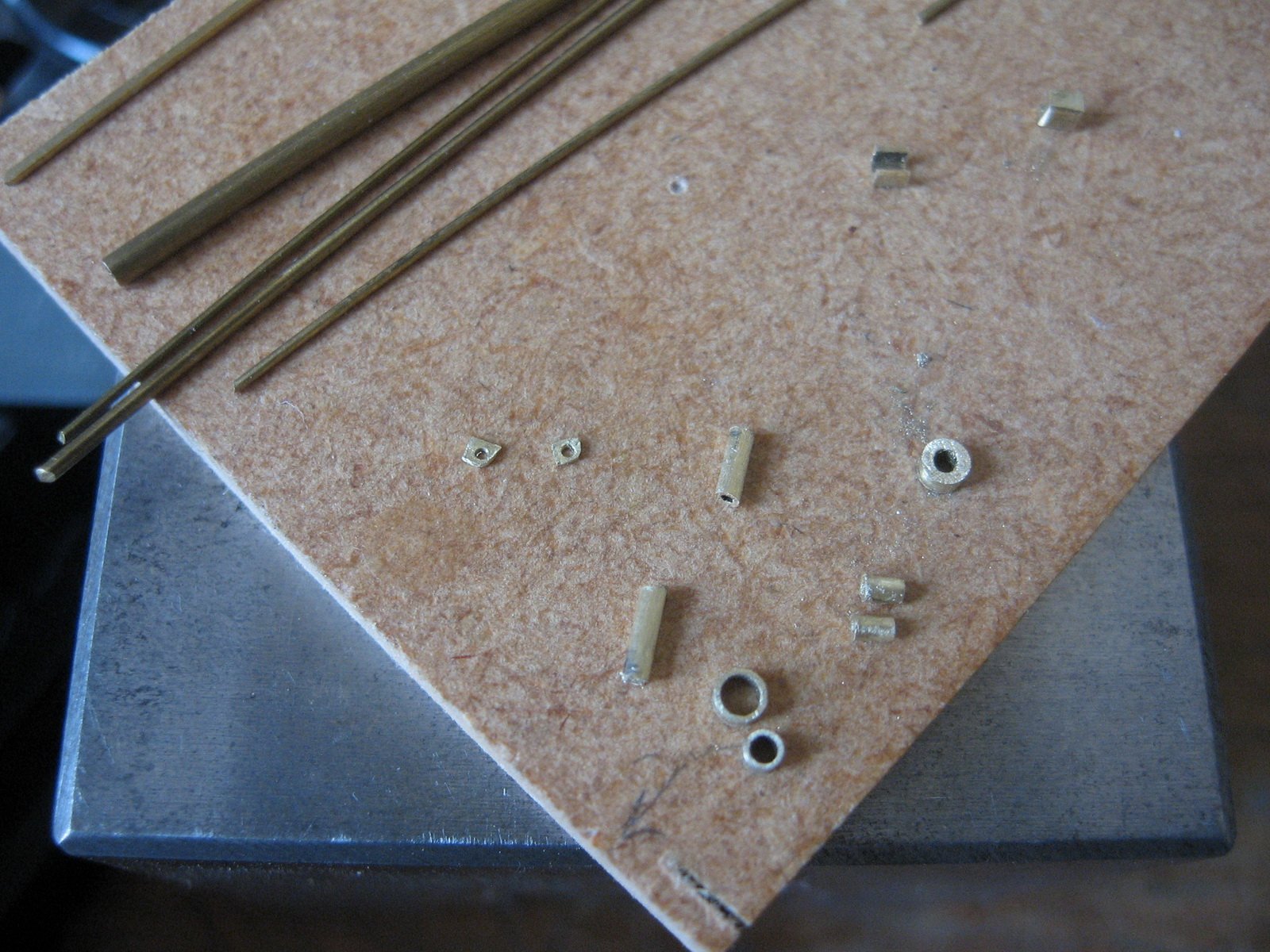

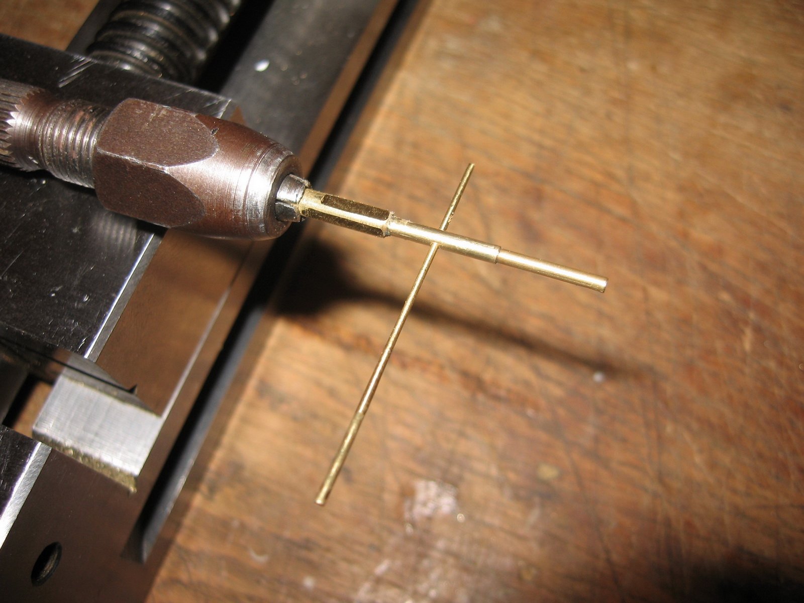

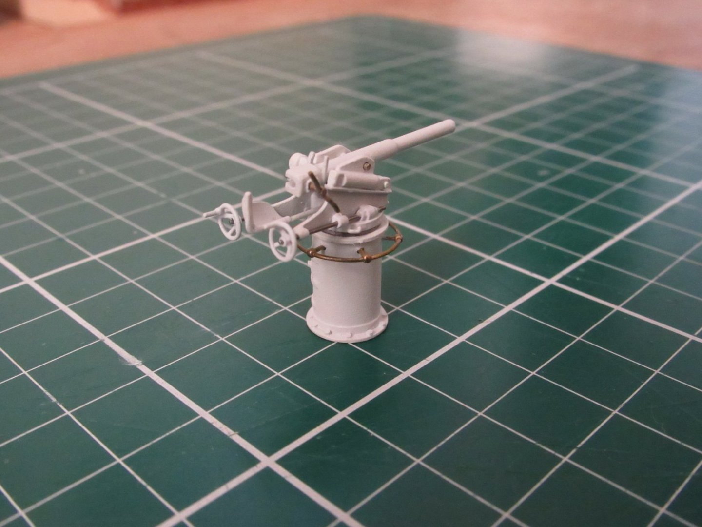

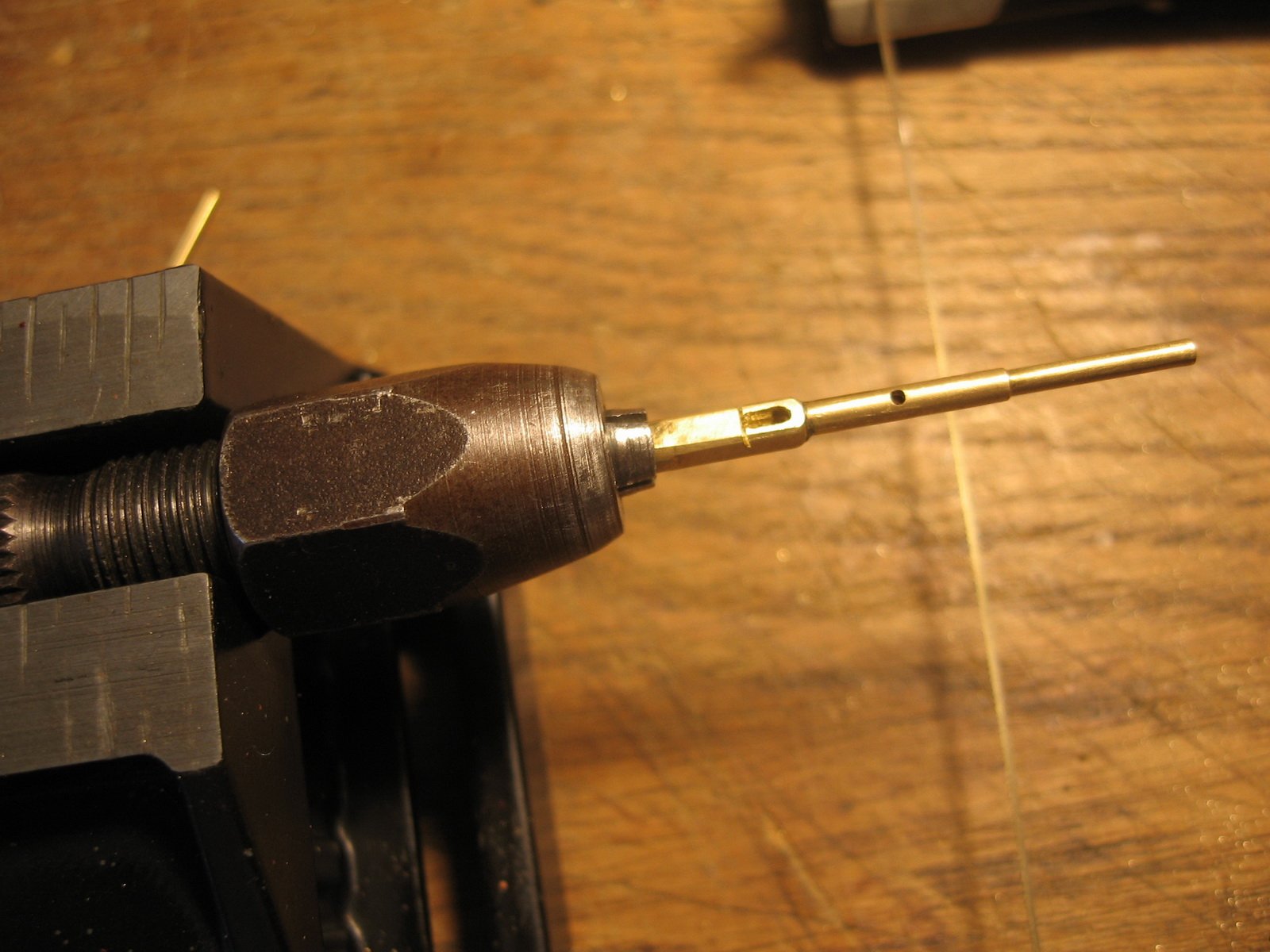

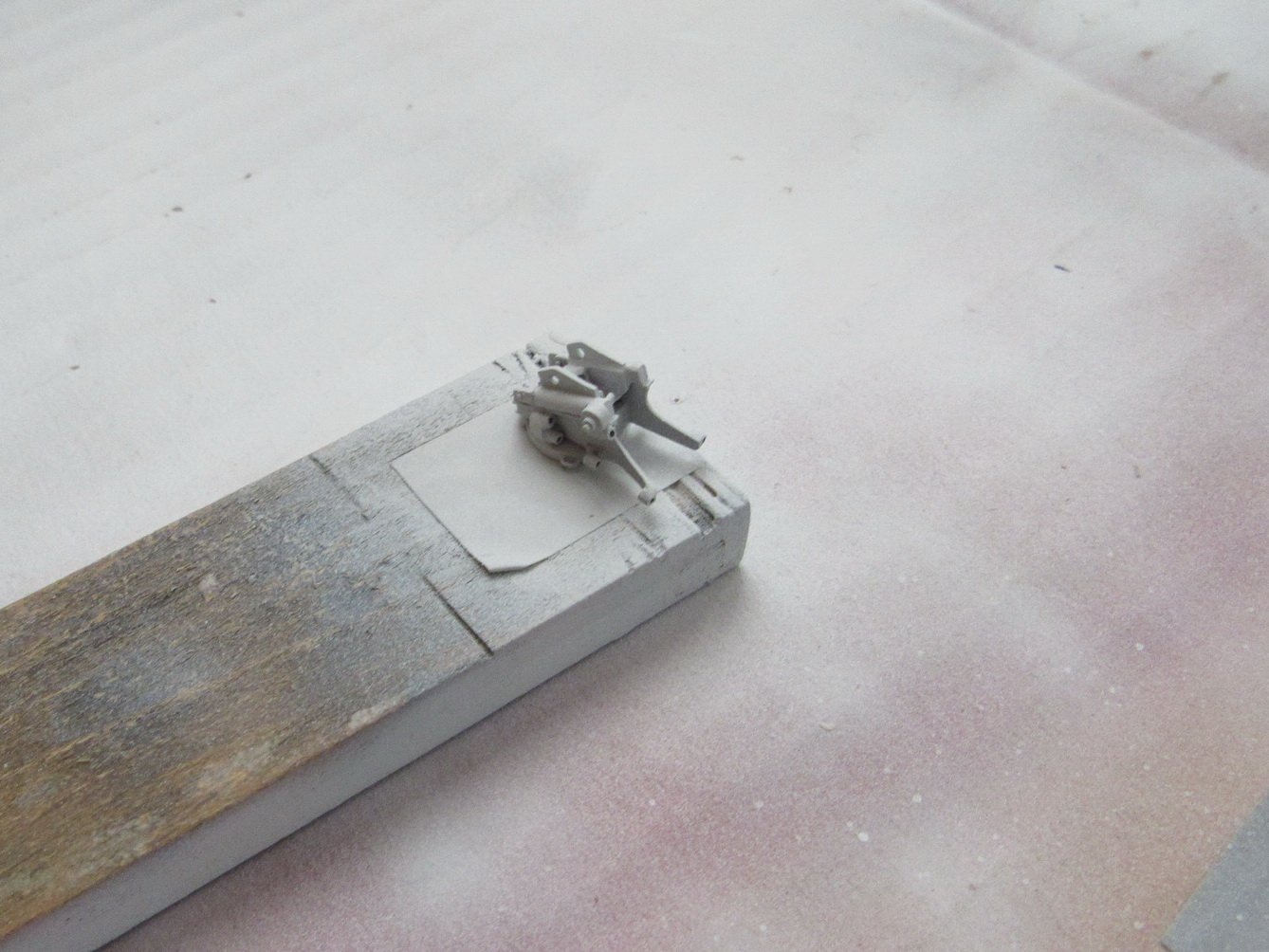

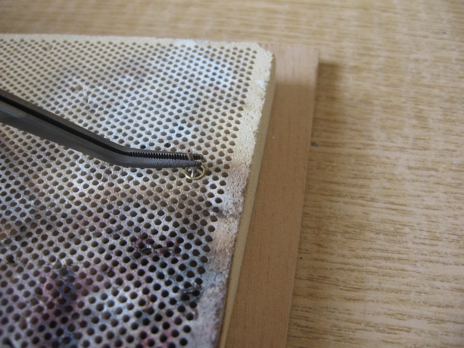

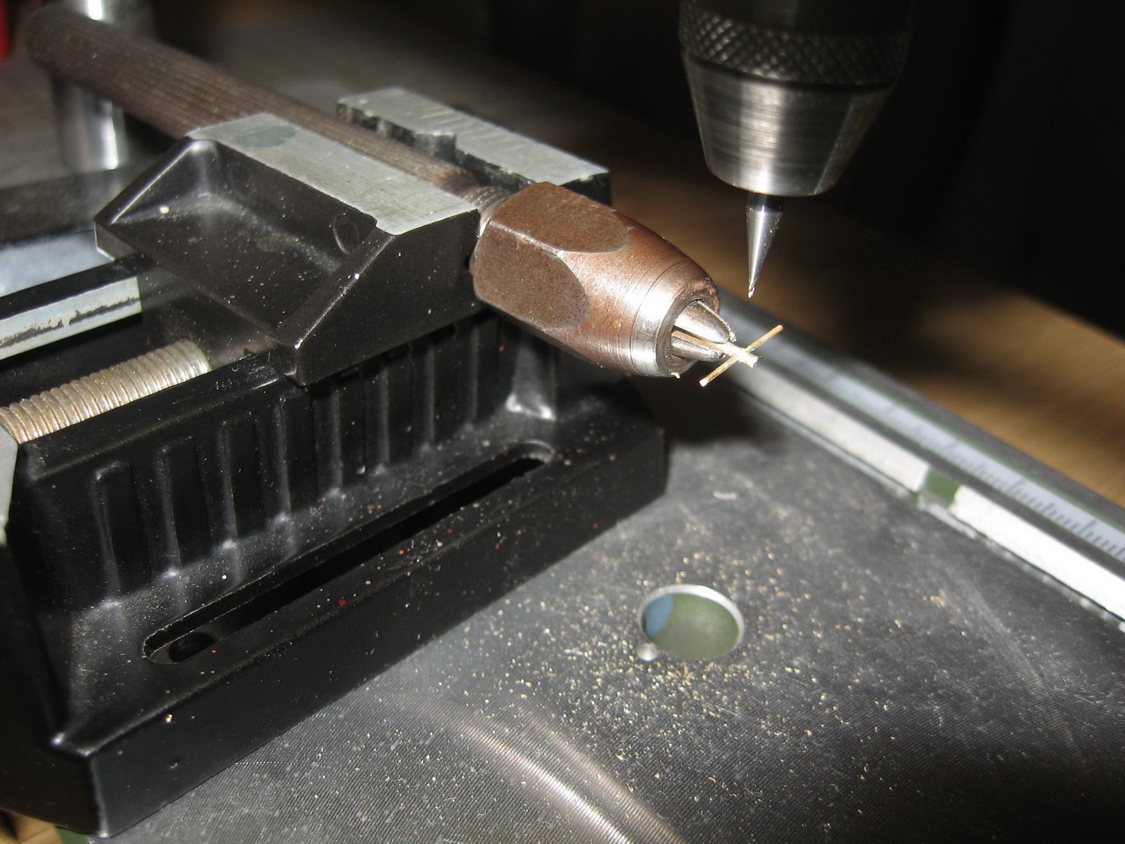

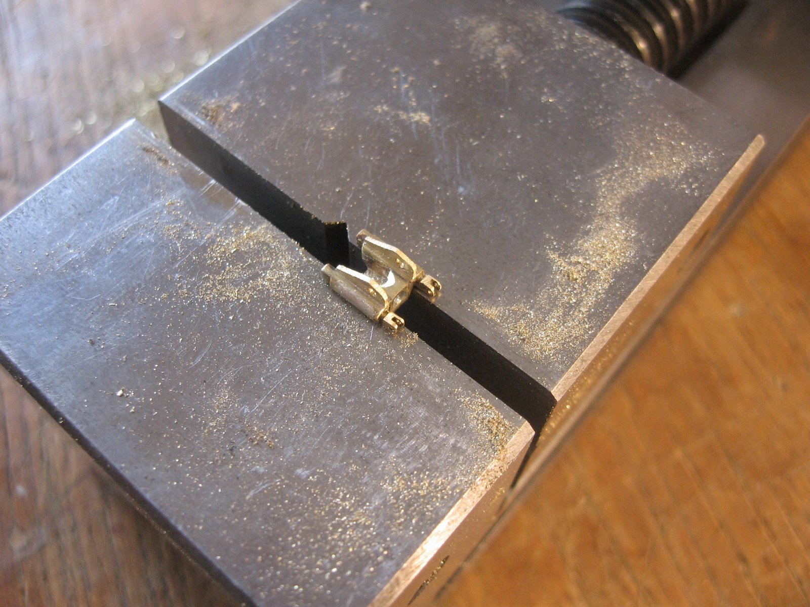

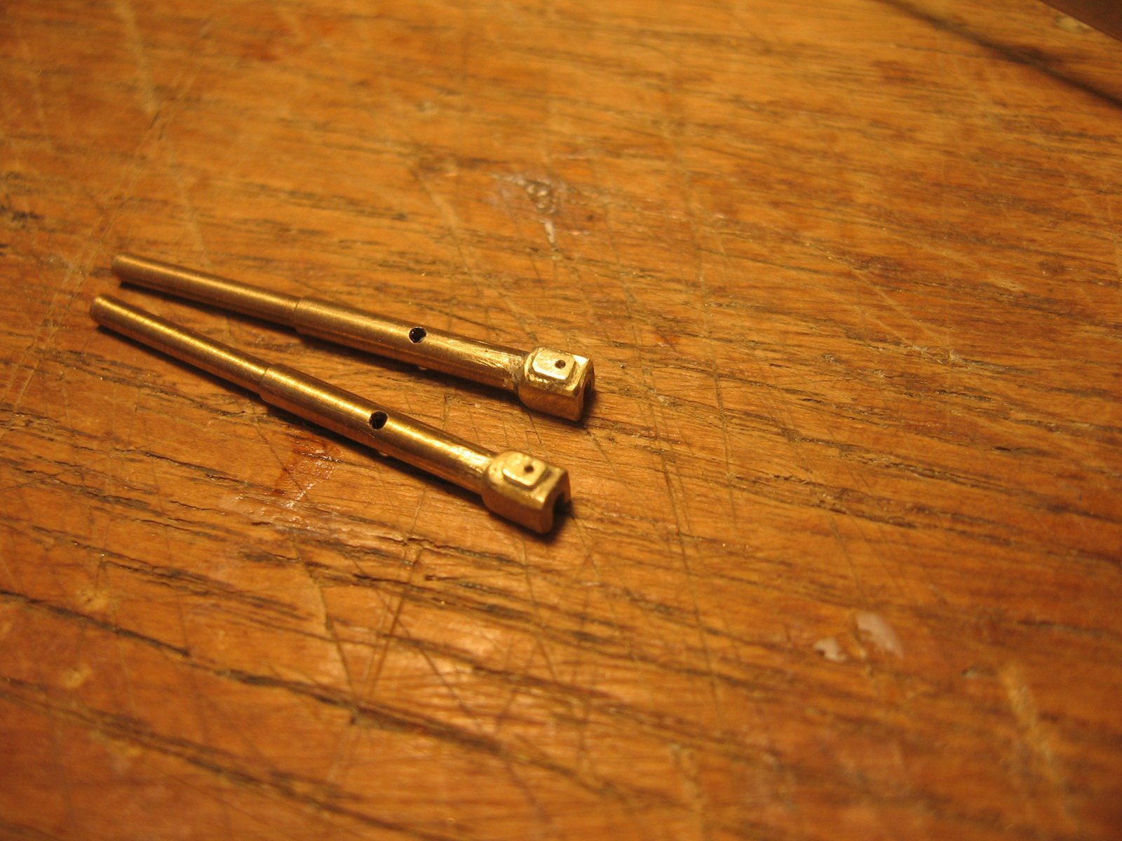

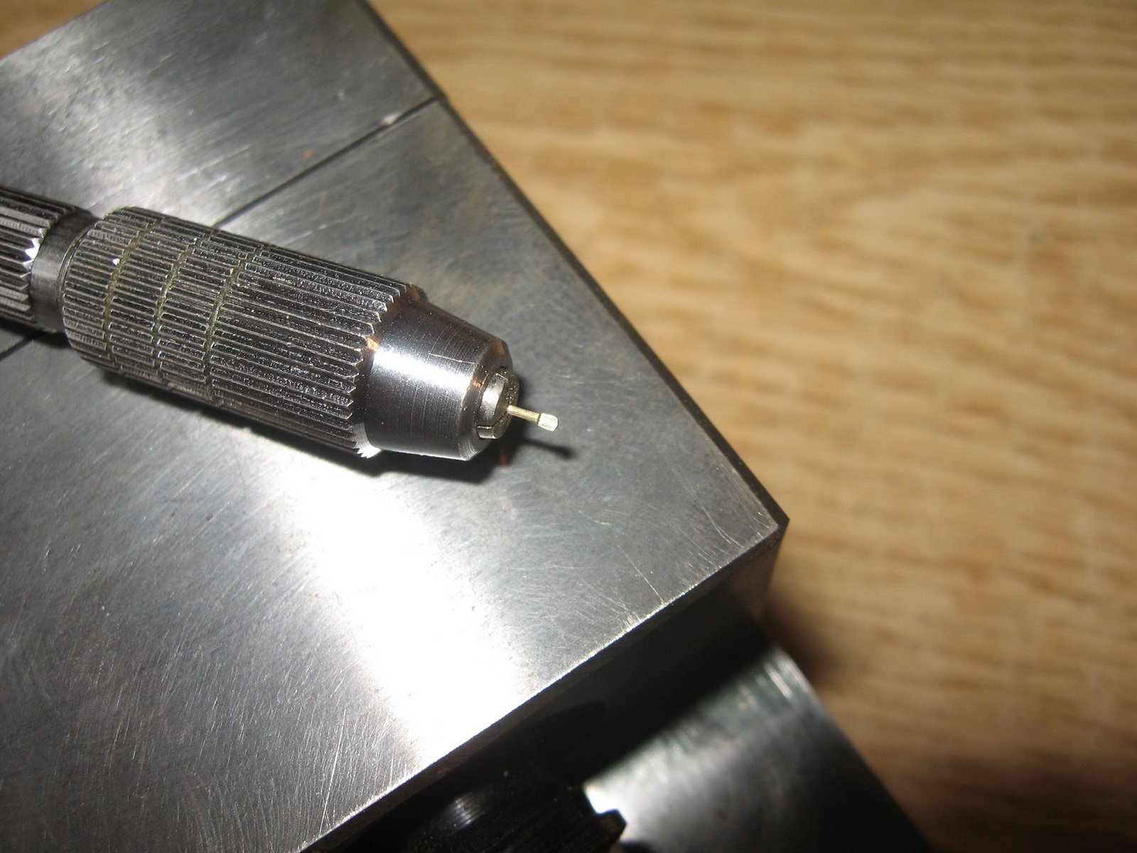

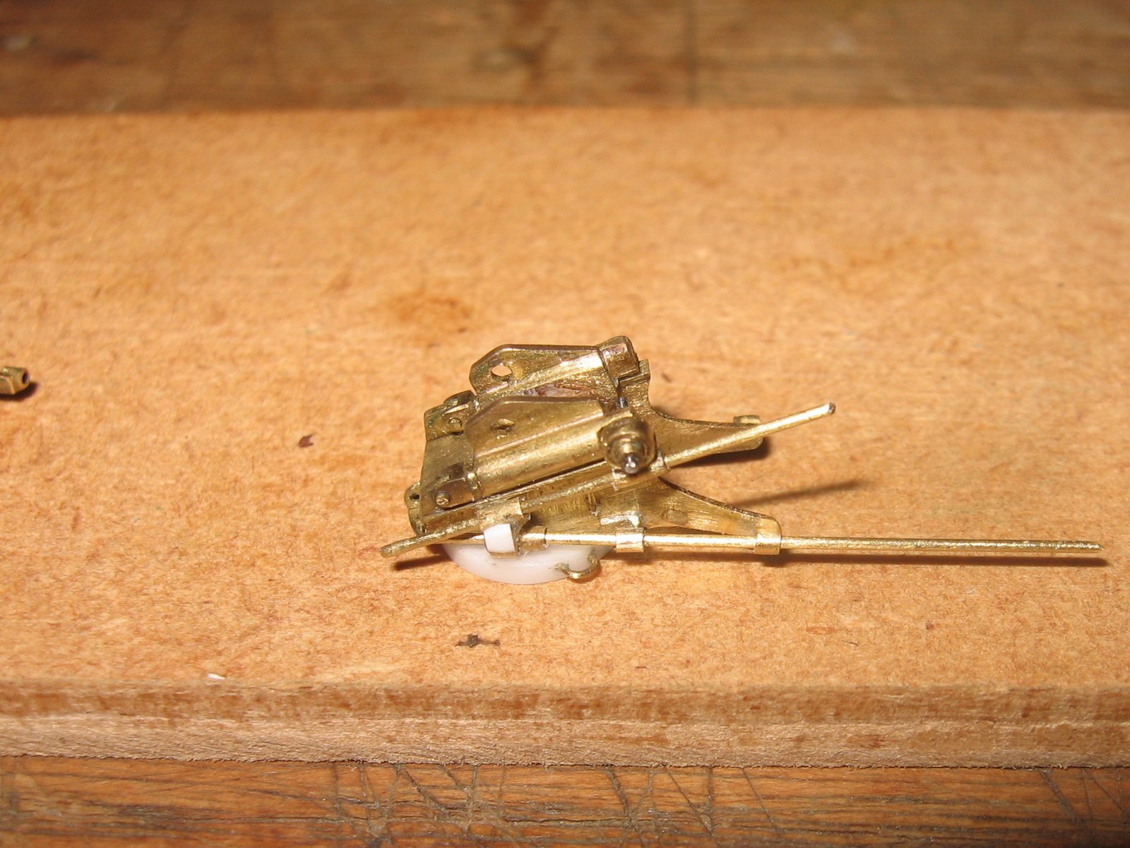

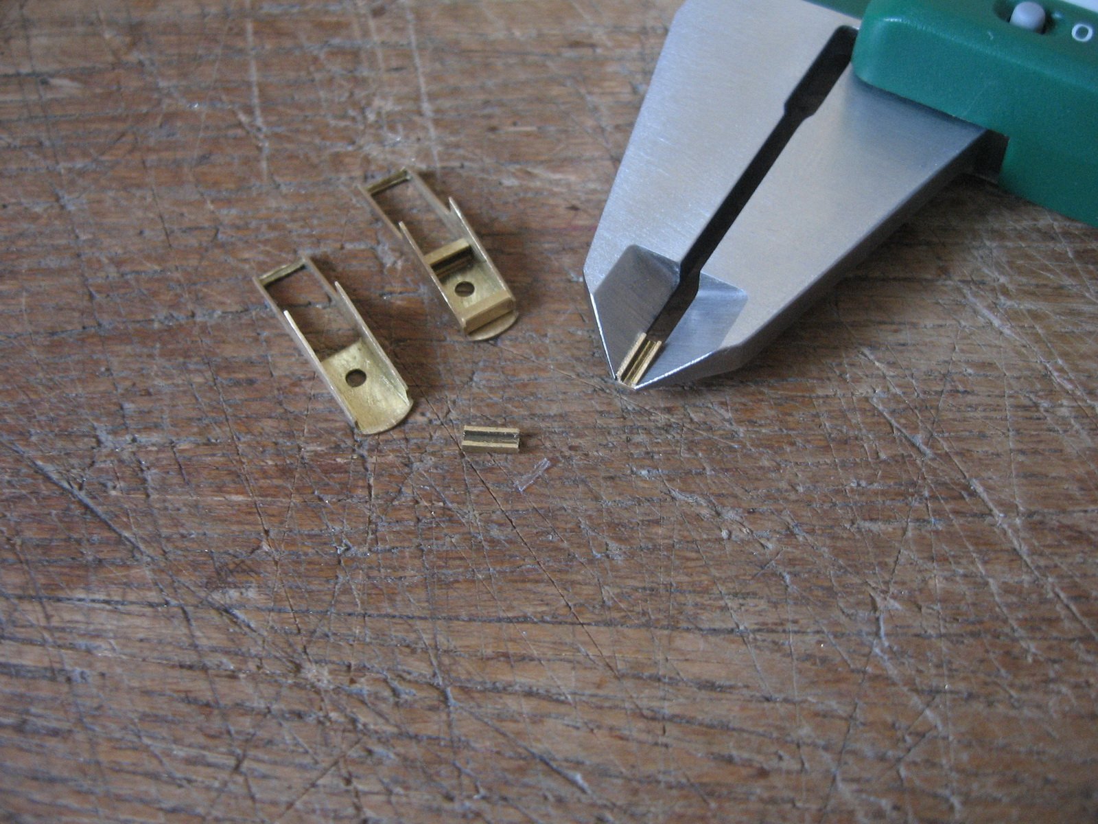

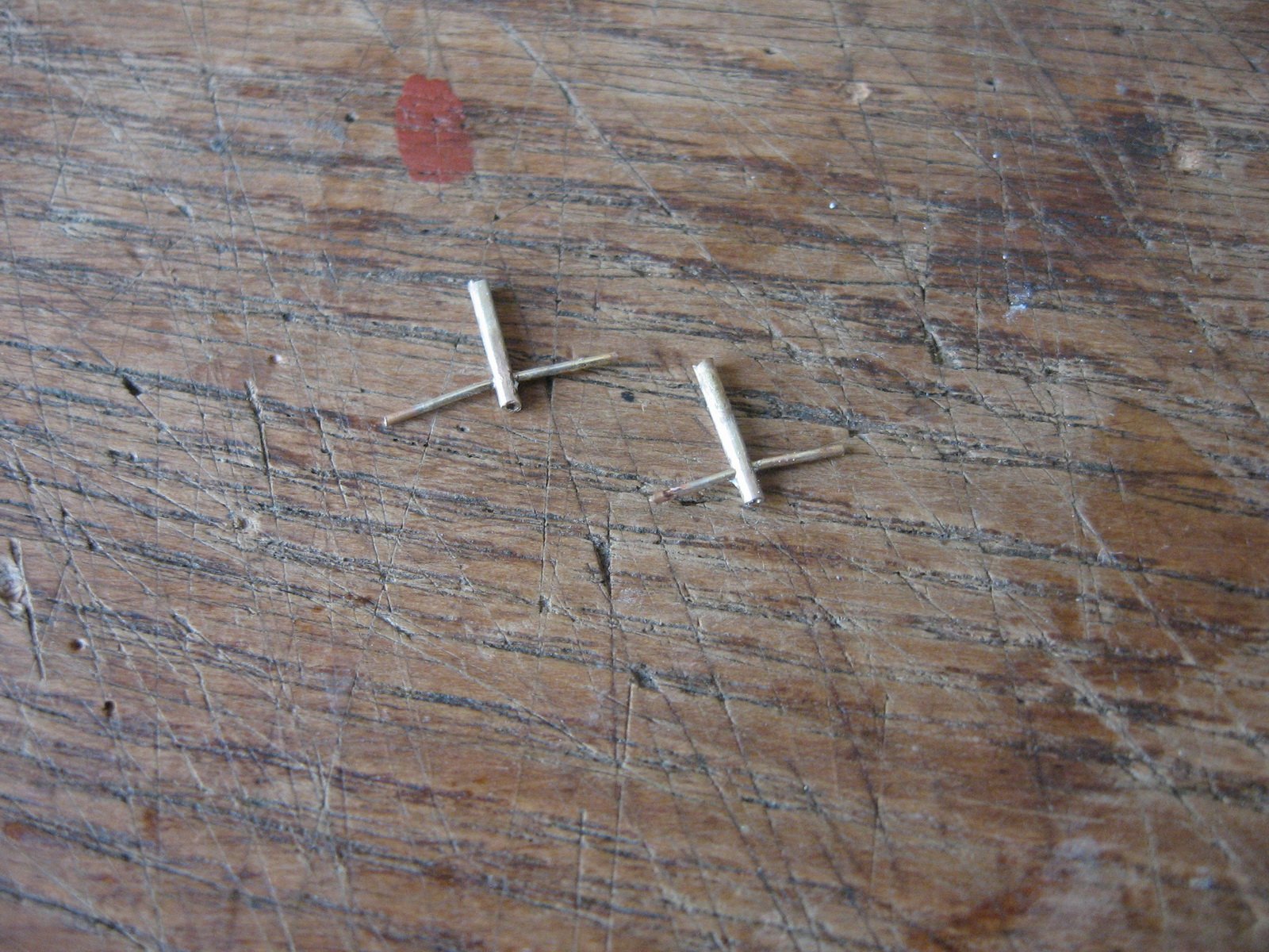

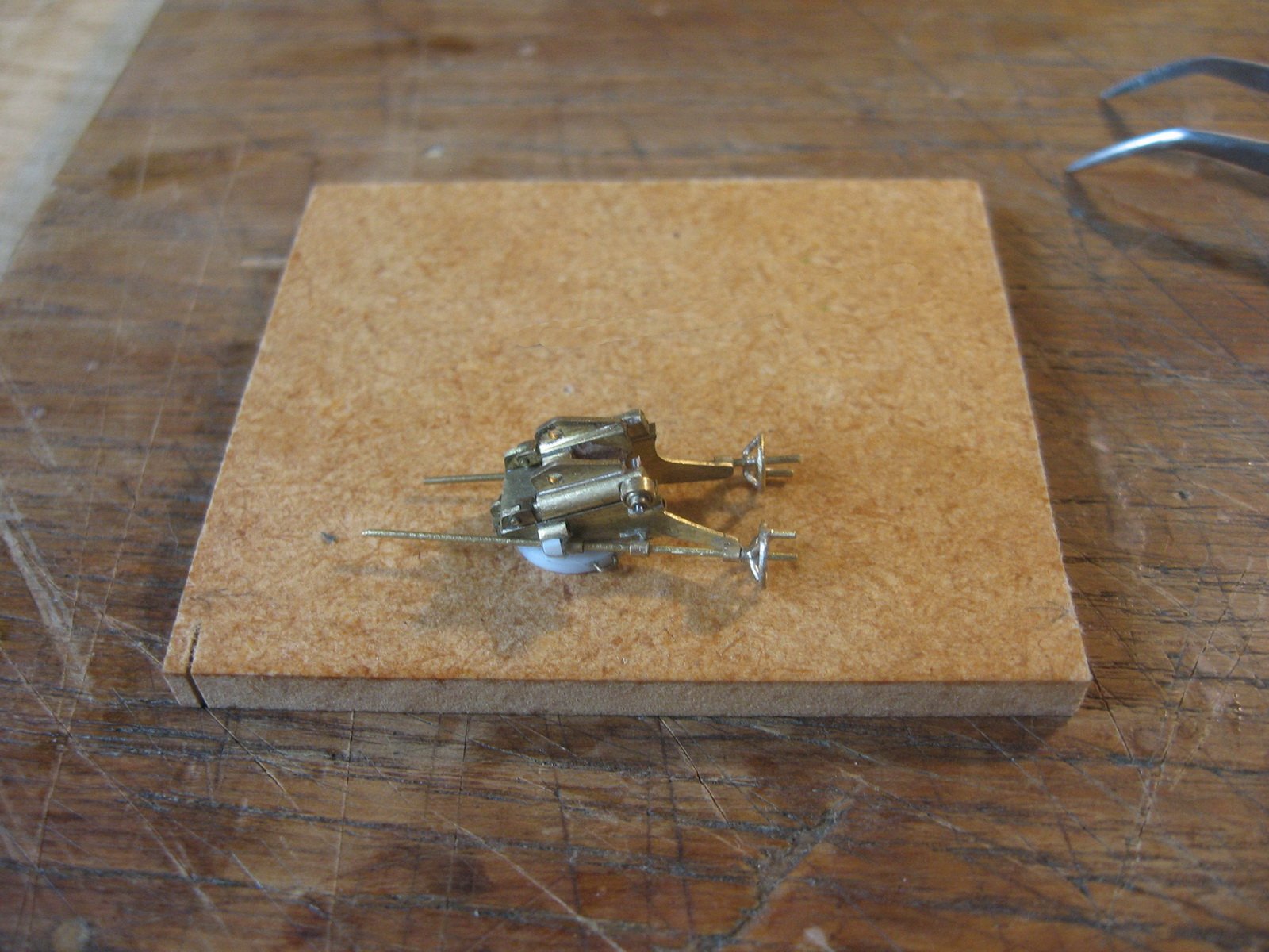

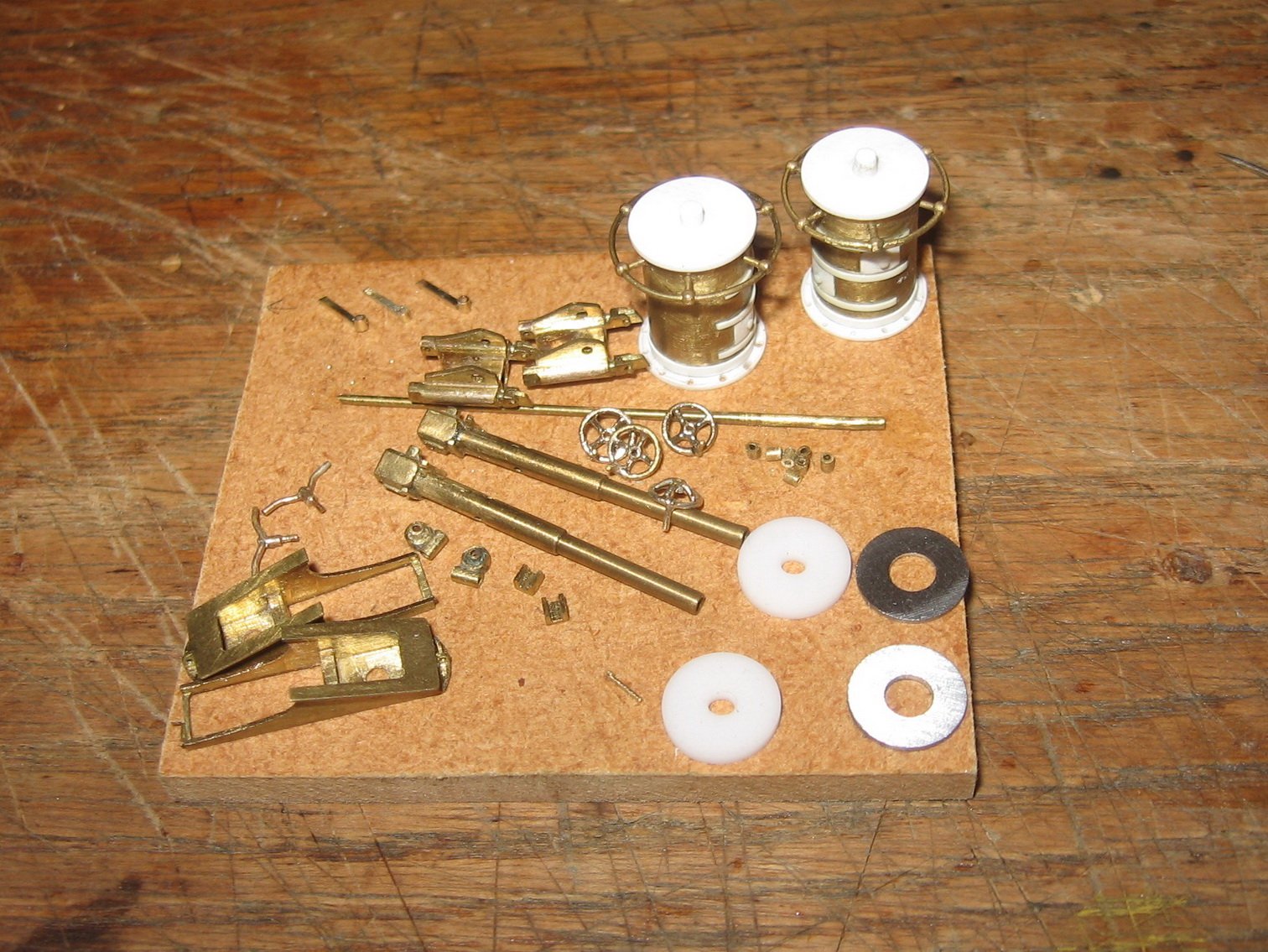

Guns are made of brass rod, tube, profile and scrap polystyren.
95 photos of the building process.
 Unbelievable, absolutely amazing.

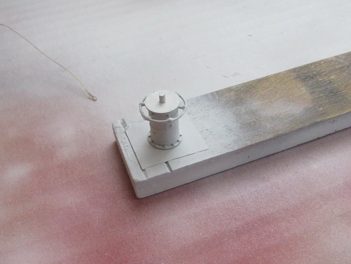

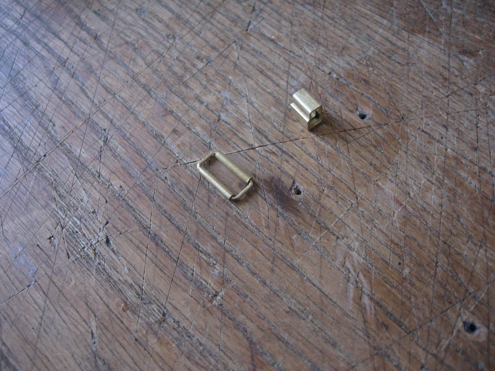

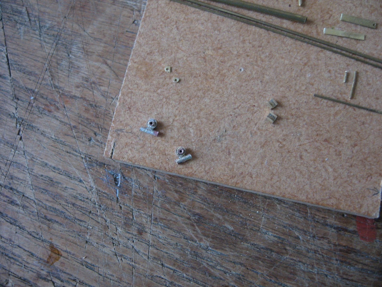

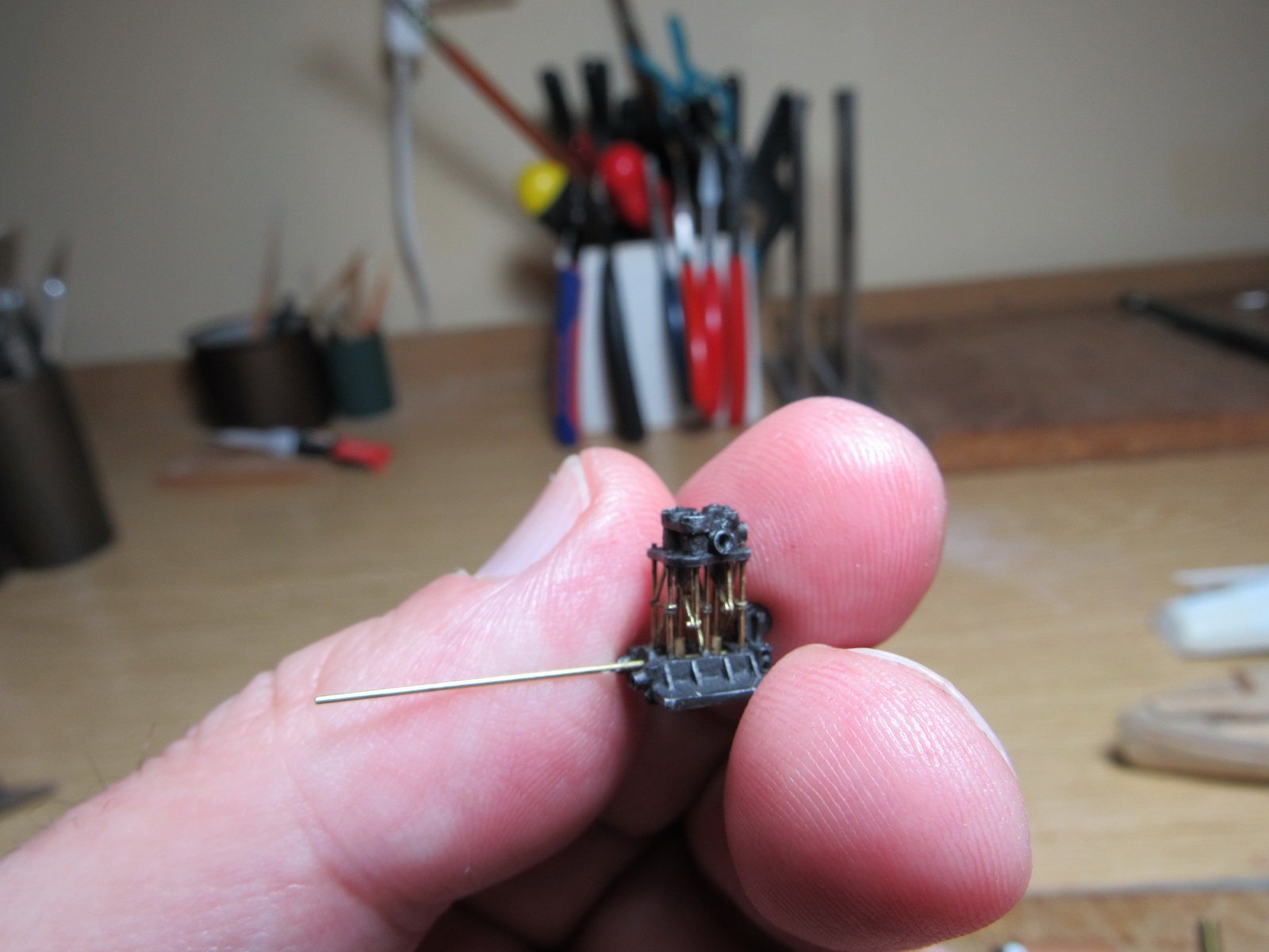

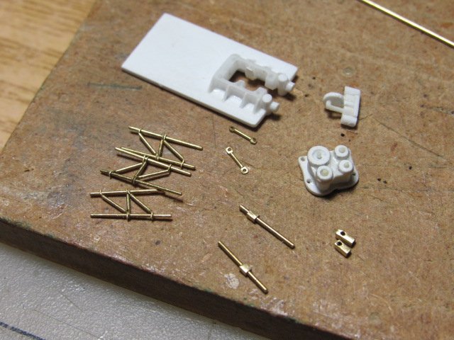

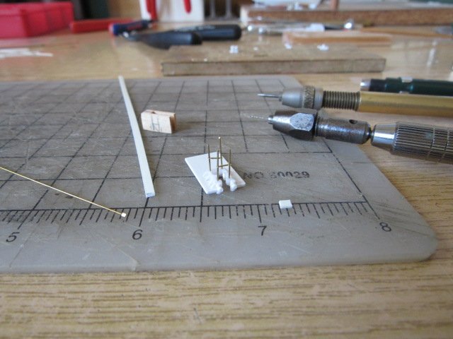

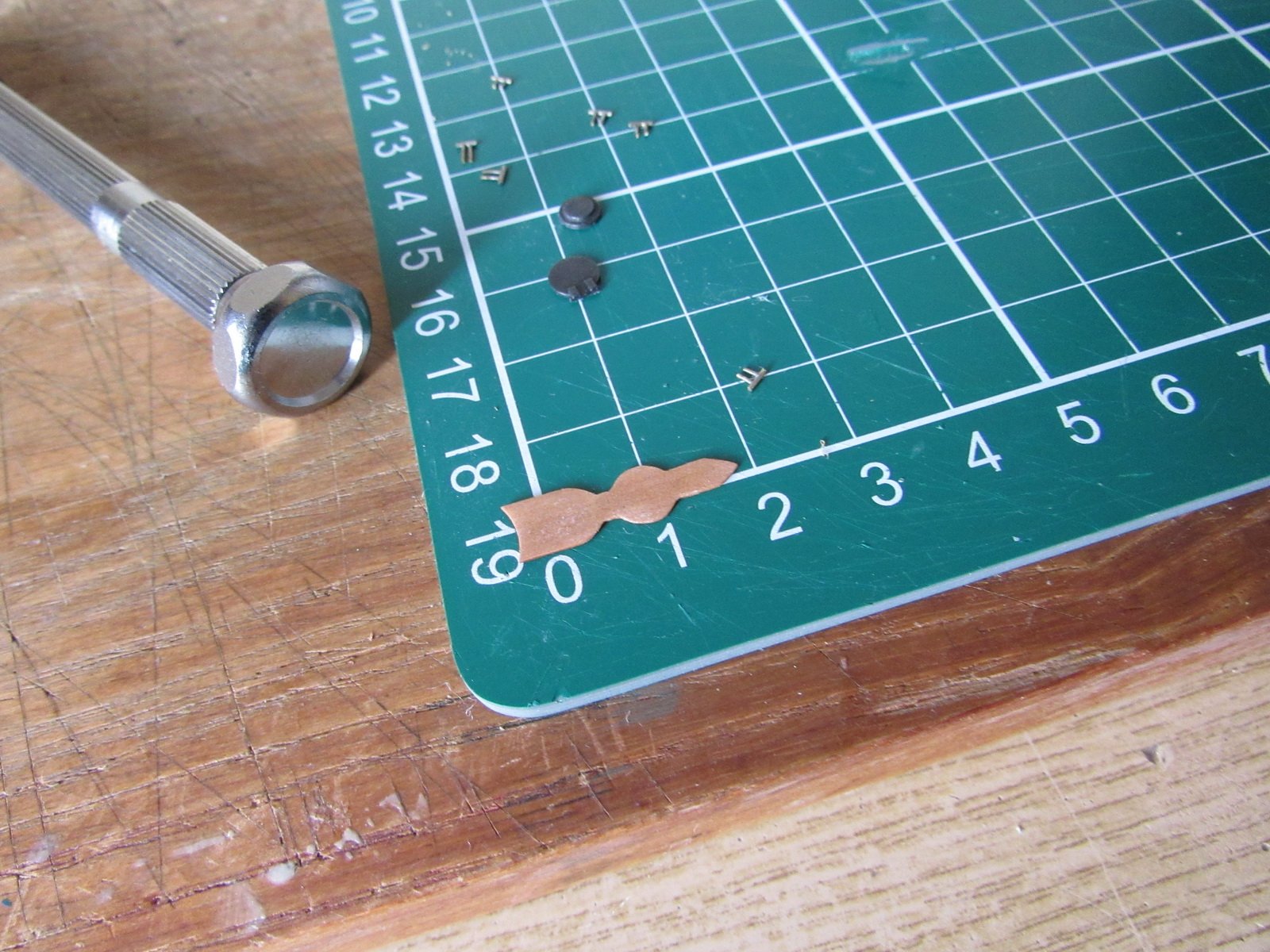

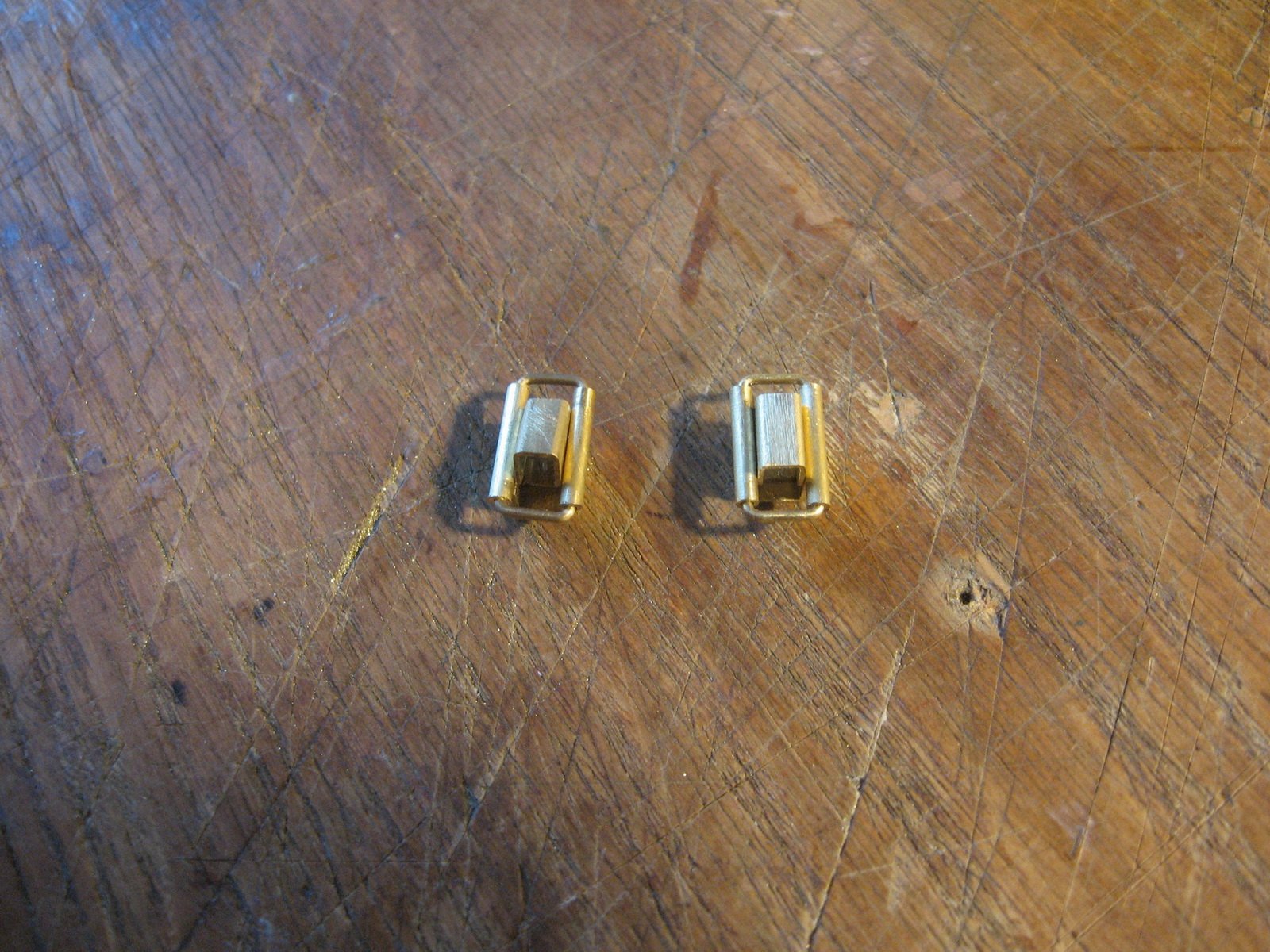

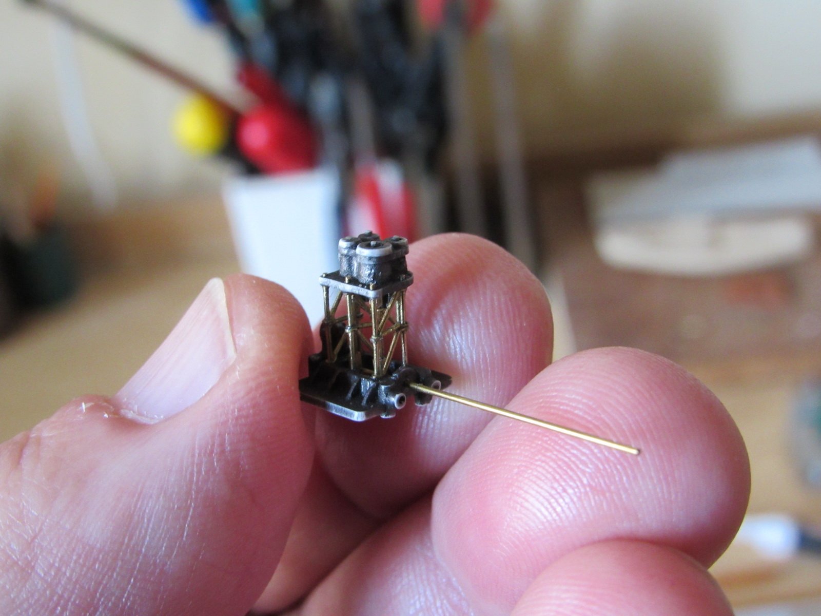

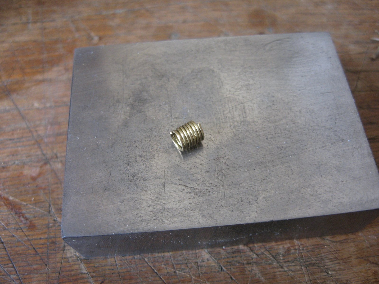

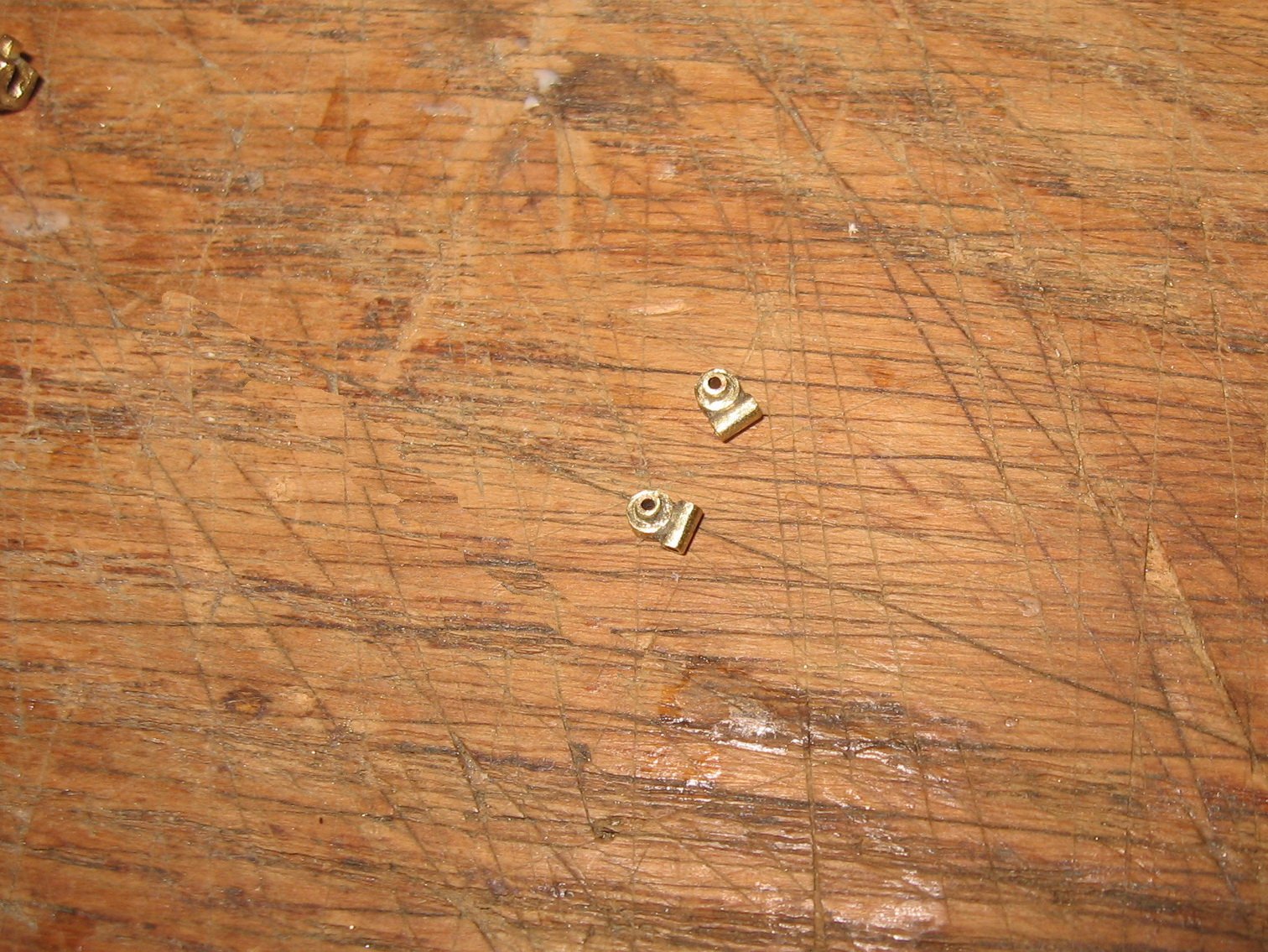

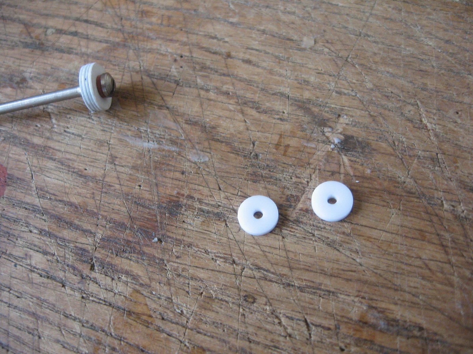

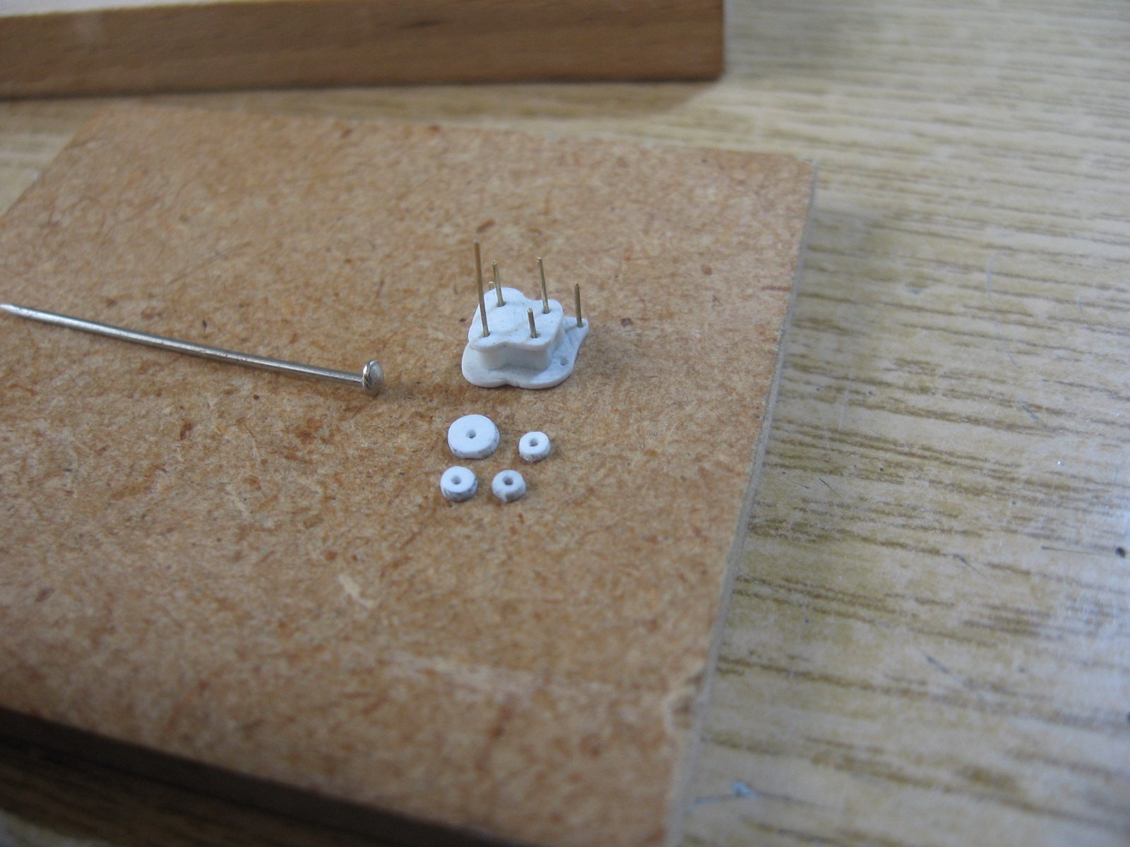

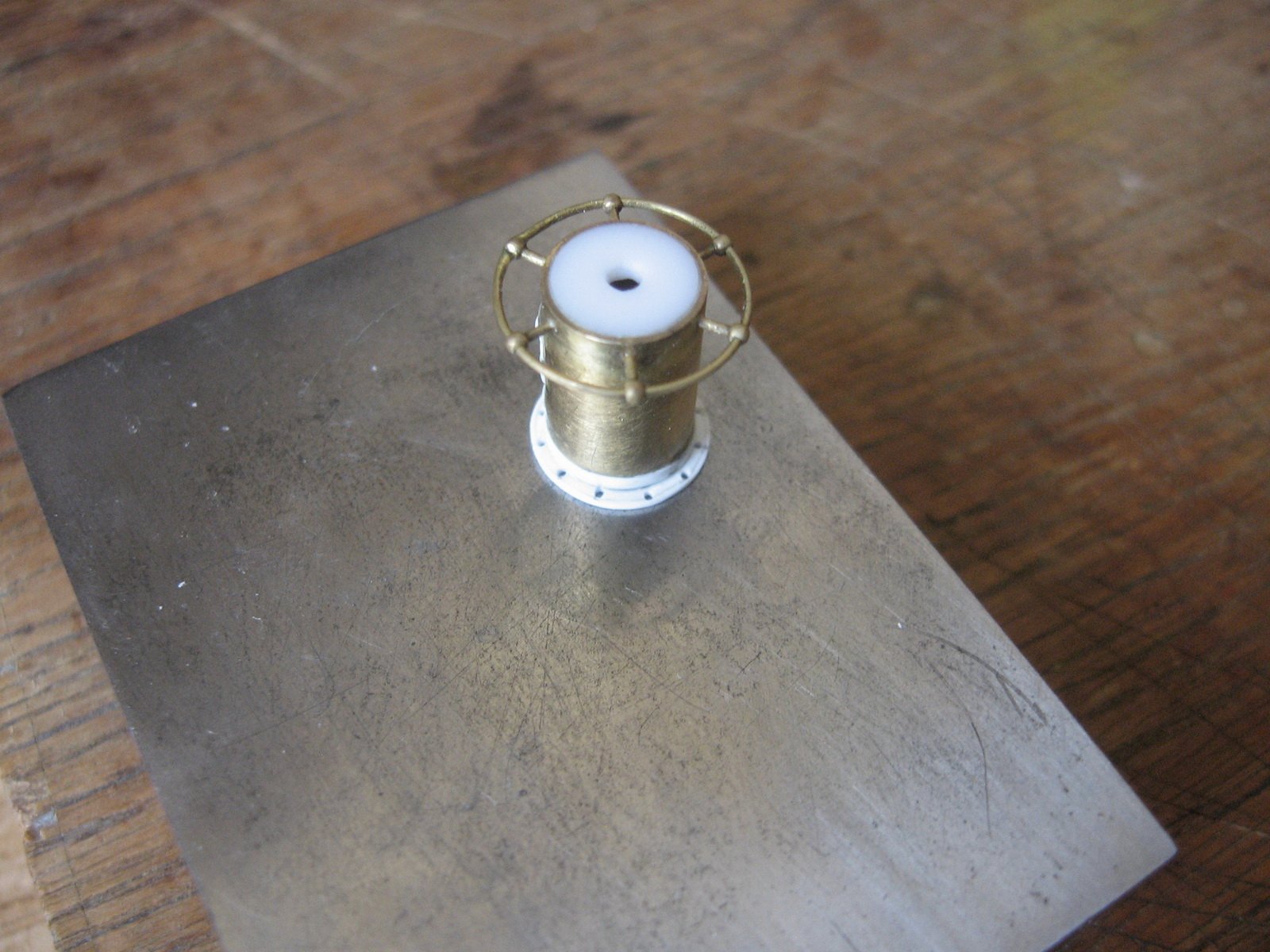

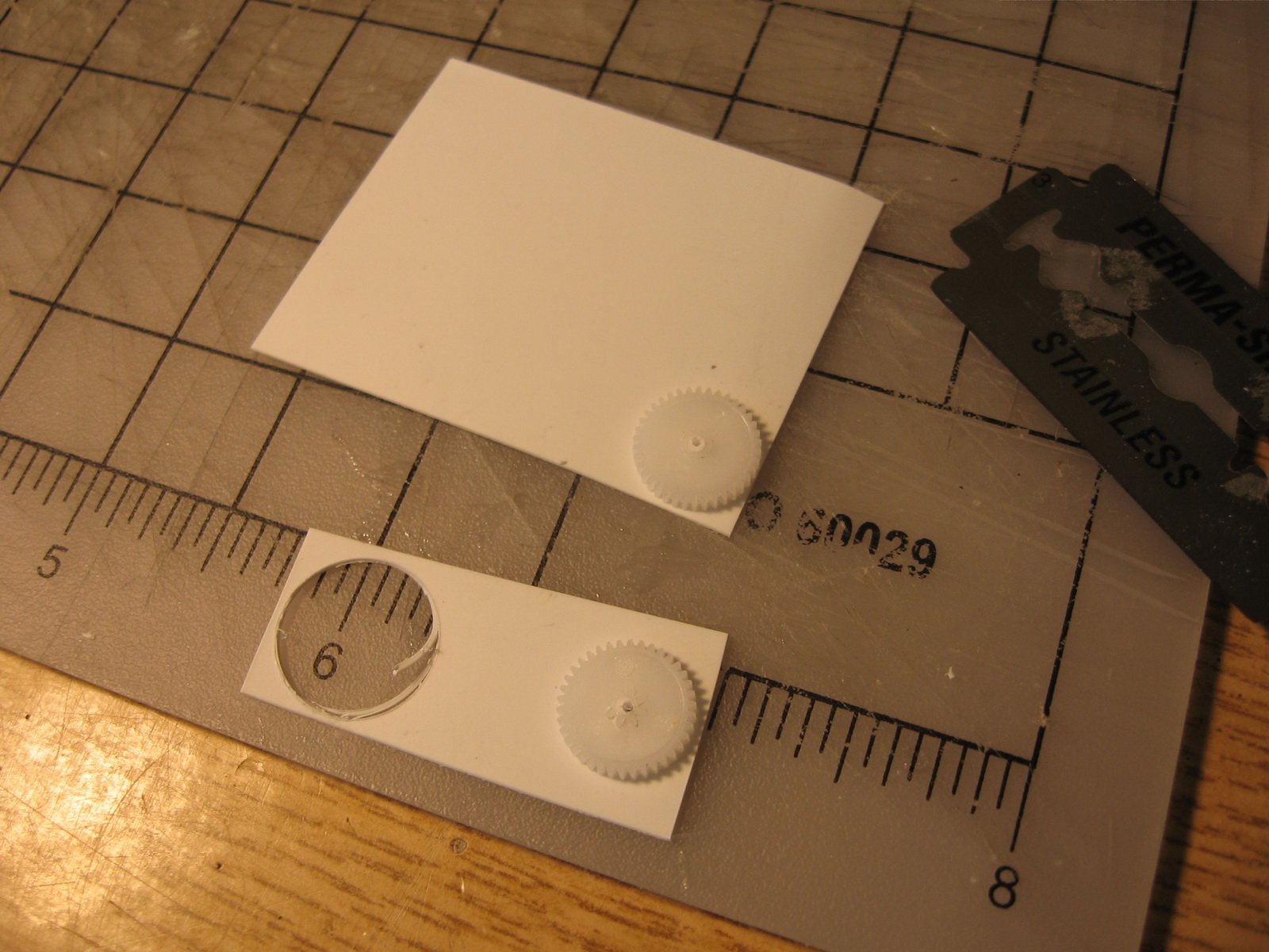

Finished the windlass. Gears are from a micro servo. Most are plastic.
 Beautiful micro work, Ilhan.
