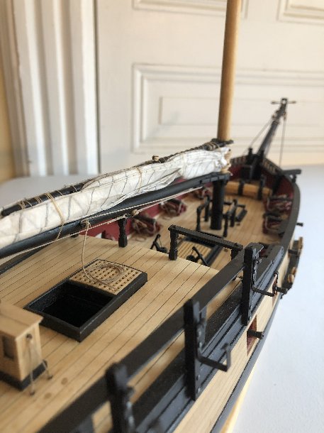

The main sail is furled. I was worried about this, but it came out alright. It doesn’t look too much different than a photo I have of the replica’s furled sail.  I also rigged the mainsail outhaul and the main sheet.  I used the rigging plan shown in the Petersson book mentioned above; even though I know that rigging practices changed in around 1800 and all of Petersson’s examples are of ships after 1805.  But, nothing is glued in place yet.

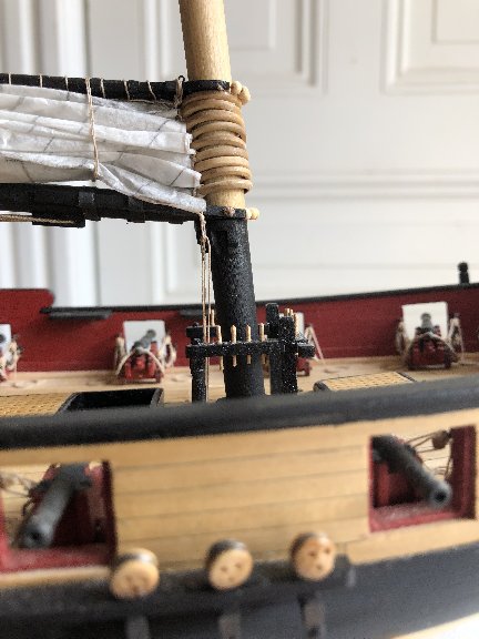

I spent a great deal of the summer in the country without my model.  But I survived and am happy to get back to work on the Providence.  The first thing I noticed is that the main sail is a bit too short.

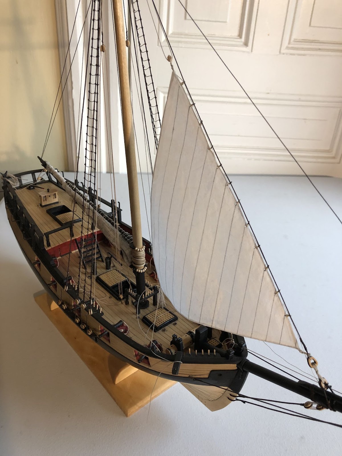

So I took the sail down and made a new one.  I like the longer sail and I think the furling produced a better look this time.

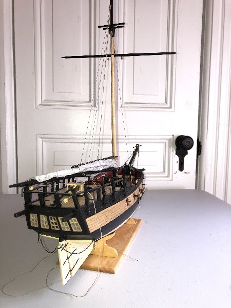

After redoing the rigging, I added a tack line which is described in Lee’s and Antscherl.

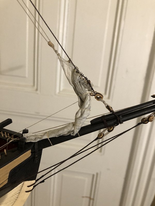

Next up is the foremast staysail.  I’m going to attempt to use hanks rather than just a metal ring.  The hanks will be of metal, however, made to look like a wooden hank.  I’m using 28 gauge black wire.  First, I made the hanks and tied them with a very thin thread using a clove hitch.  The hanks were placed over the fore stay, and each hank was tied using a hole made using a drill where the “cloths” joined.  Add a little diluted white glue, trim the thread once the glue dries and cut off the exposed metal ends.
-whho2uqL1xg4GK0Gyv6nqhh_0ShBCYta-Pi3e5PQAKDTEHjedQj2hGWmmp_Ij1HY37H0cUcgvMuQHZB-Ng9m57CavtyCrSzP4gwINMMRDTr8TYJ-YDFEc6QKXofuA_JpC-ZMPN_     qHpZCXp5KCr0F_1N-ZA-6Hy0VWTK9wbTncEA_ivT8rfpG-fQOxhVgZvUbqONGwqmcRrzTx8T_92EgzBBO4vhsInMYVdnTSmVzaHrm6GdxpzLcz9huZKUaez0JtxtwPfmO6qrjmtY
Once all the hanks are done the sail looks ready to be furled.  However, that will have to wait until after after I make another Medway stove.

The ‘fore’ staysail has been furled.  I had to try three different positions before I found one that I liked.  Again the lines - halyard, downlauler, and sheets - are not belayed to their final location in the forecastle.
