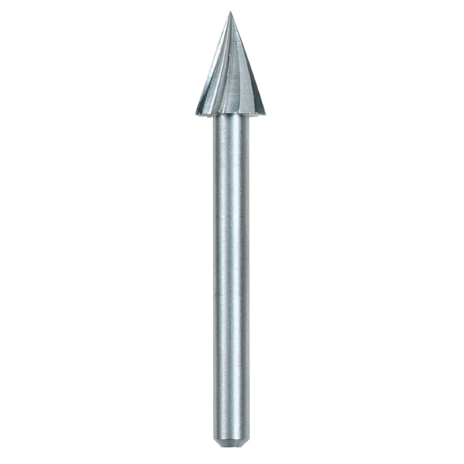

Hello Greg:
Best tools for doing this, including the bulkwards: battery operated Dremel at low speed with a cone cutter (the base cuts fast but the tip cuts slowly), and a Japanese cut file (iwasaki 150 medium cut) to finish it up (cuts fast and leaves a smooth surface).
Hope this helps,
G
Iwasaki File 150mm Flat Medium Cut for sale online | eBay
Dremel 125 High Speed 1/4-inch Rotary Tool Pointed Cone Cutter, 1/8-Shank  80596001254 | eBay
Thanks so much Guillermo.  I have a cone cutter for the Dremel and didn't even think about using that.  I used the drum sander on BF-3 a short while ago and it worked well, but I wouldn't trust it on BF-2 when I flip the ship and and have to get close to the stem and keel.  The cone cutter will work much better.
