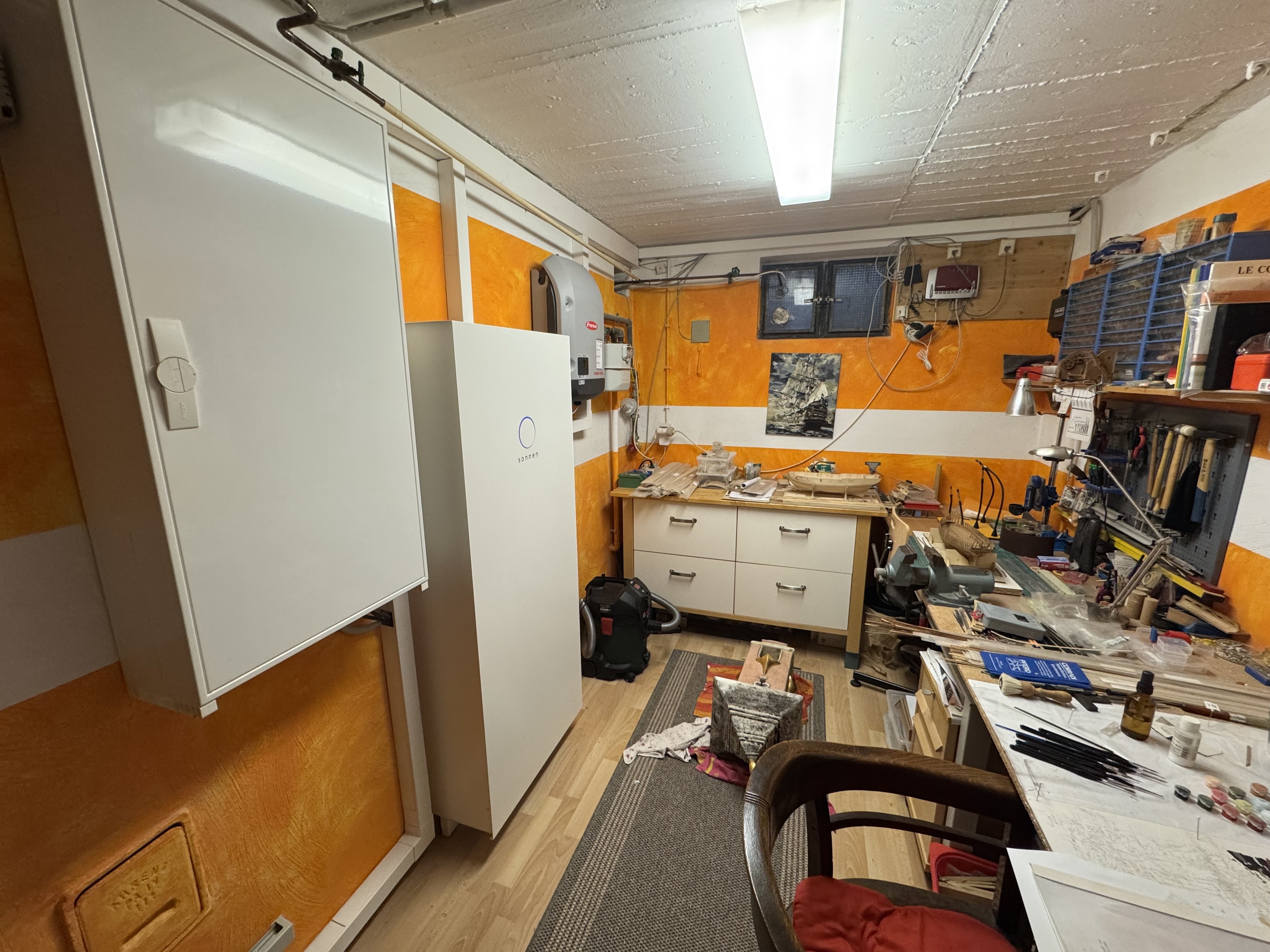

Hello and thank you for your interest in my building log. Two years ago we installed a photovoltaic system in our house and I had to completely clear out my building room because the battery was being installed there. It was such a mess that it took me quite a long time to rearrange the room. There were also changes to my self-employment and I'll be moving into a different building soon. These things have distracted me from model building, and once I'm too far out, I can't get back in.
Because of the long break, I've forgotten many details about ship modeling I’ve learned before and now I feel like I'm back to the start. To get back into it, I'm going to pause building the Coureur for now and look for an easier project, perhaps the Alert from Vanguard Models or something similar to start with in the next months …
