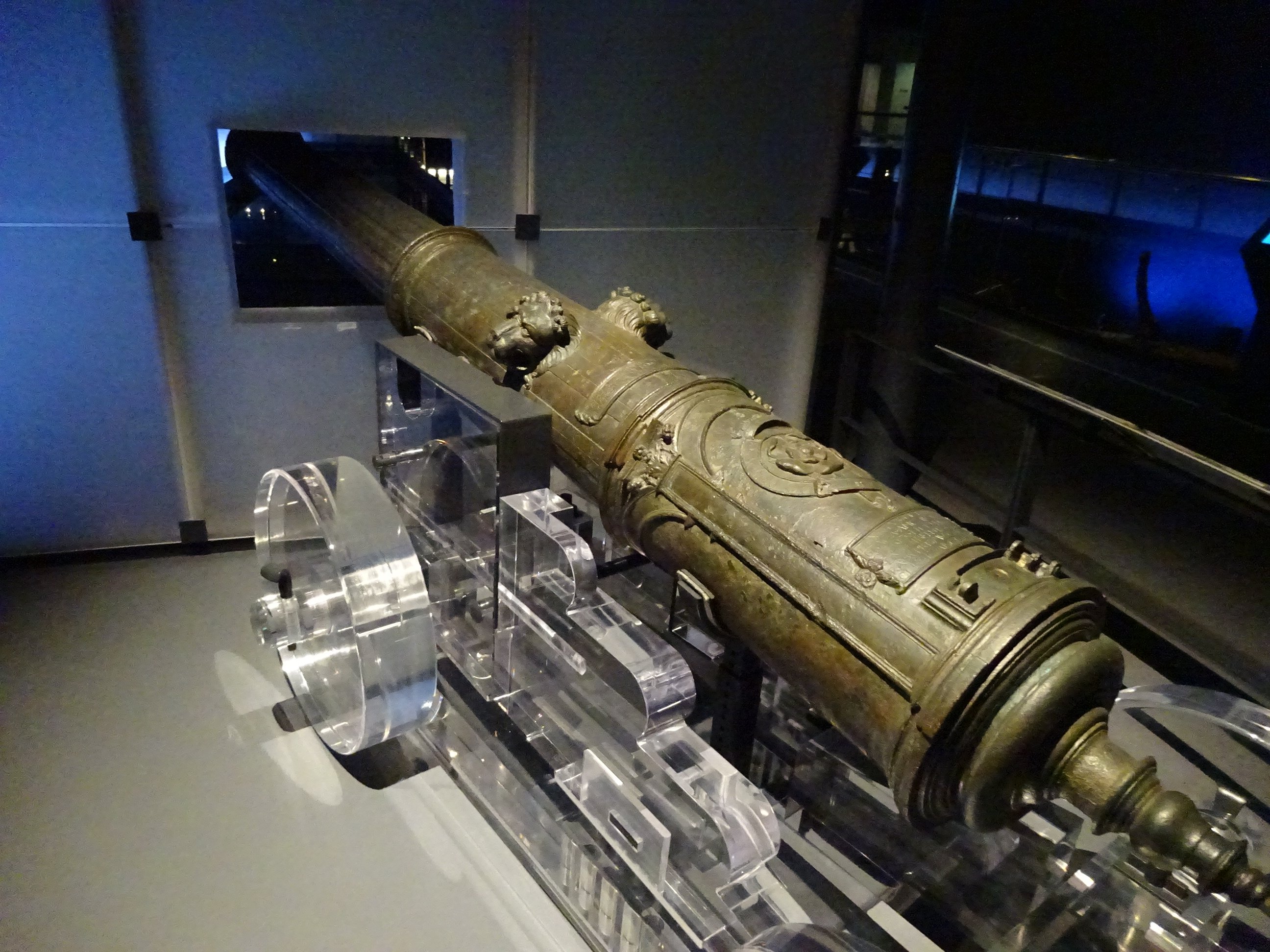

On 4/24/2025 at 8:37 AM, Baker said:
The idea is to place four "larger" swivel cannons here.
Why swivels? Because on the Anthony drawings the cannons on the back of the fore castels usually point upwards. And it is therefore suspected that these are swivels
Why only four, Matches the drawing.
"false openings" Make yourself appear stronger than you actually are?

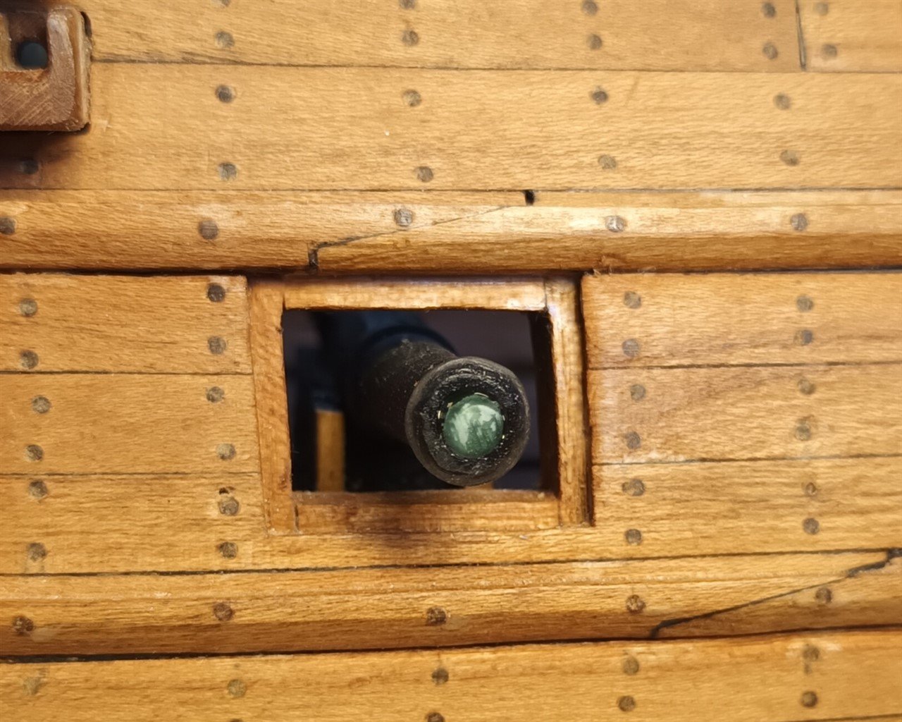

Maybe that is helpfull for you. I was this year in Portsmouth and visited the Mary Rose Museum. Here a foto from a canon from the aftercastle include description.
Regards
Helmut
Regards
Helmut
Thank you, very helpful 👍

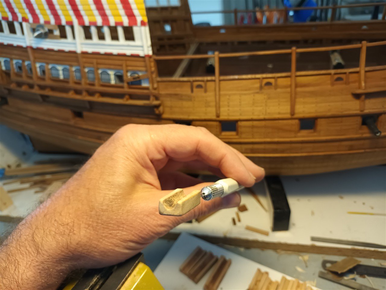

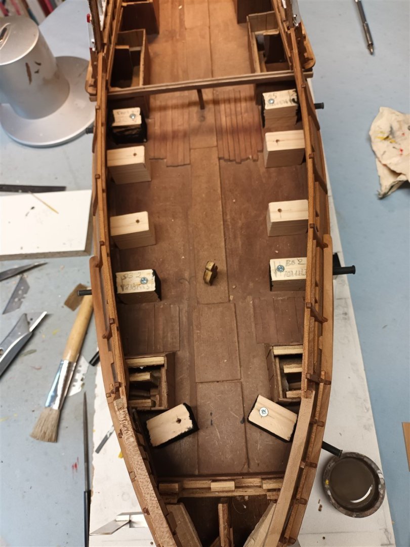

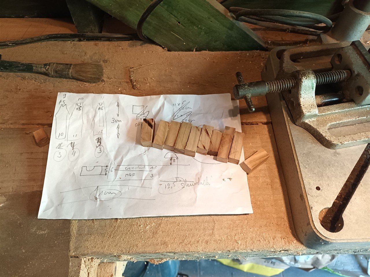

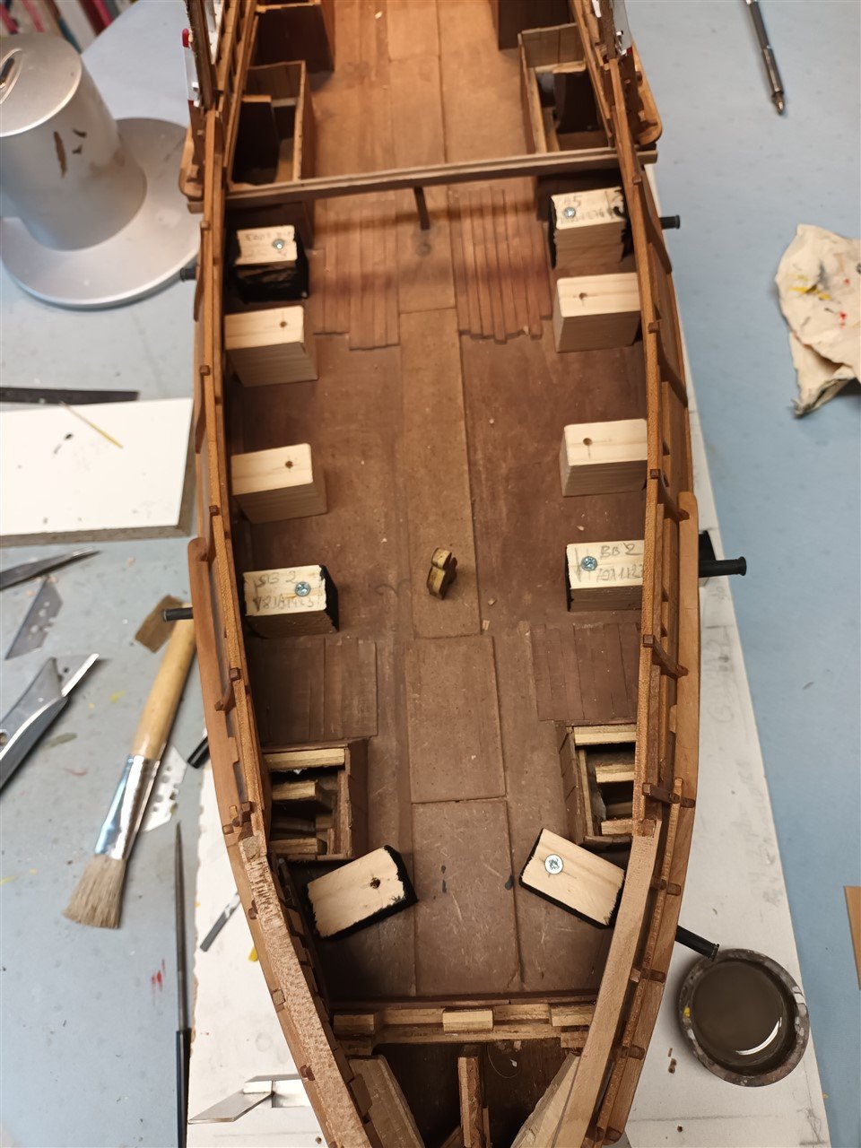

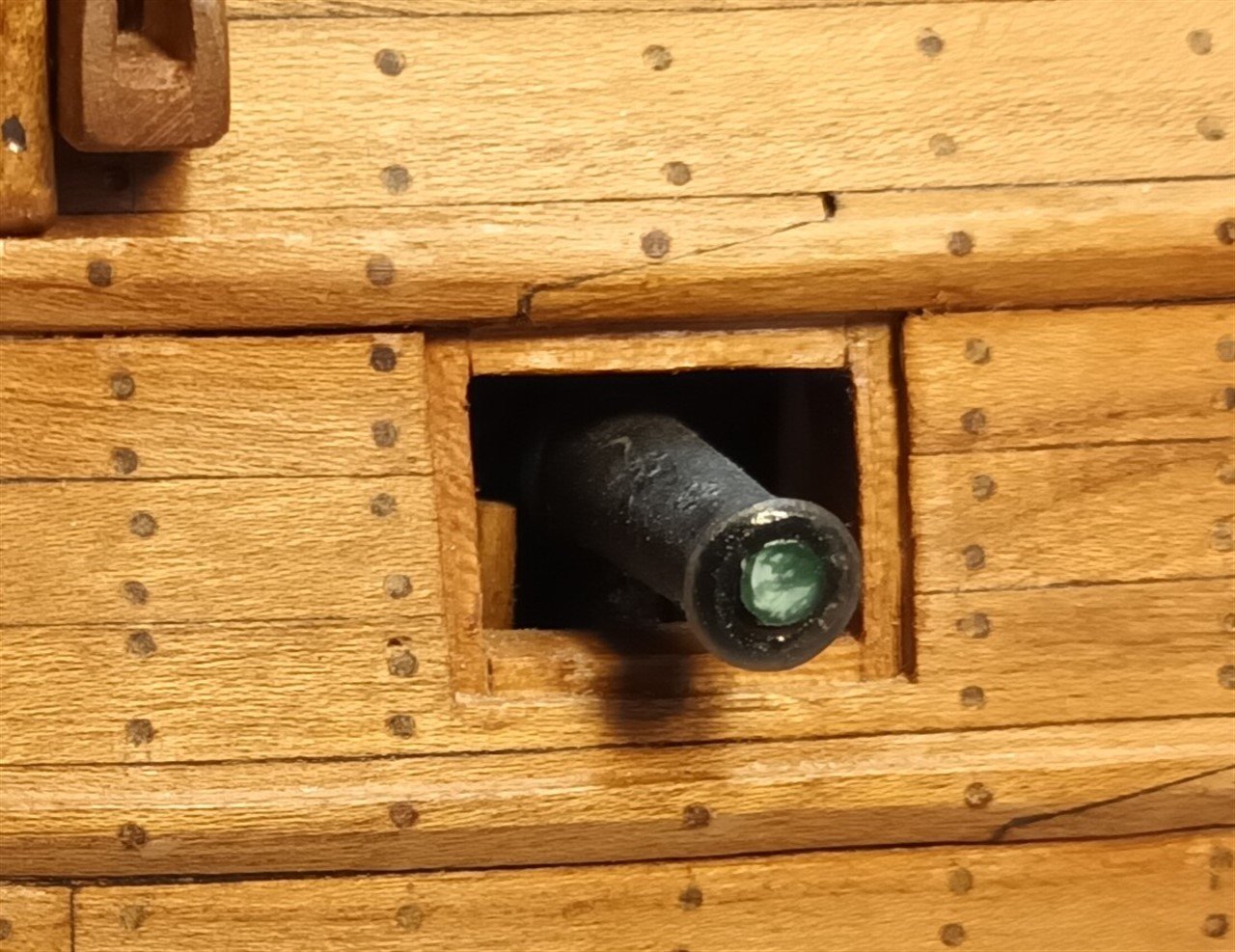

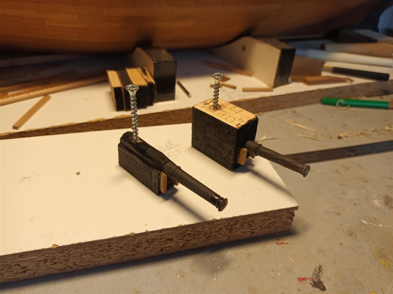

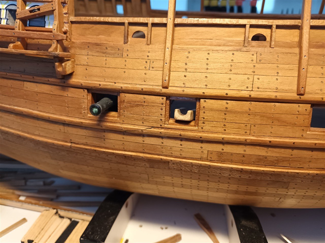

Preparation of the cannon deck.
Since there is no grating in the deck above, there is little or no visible interior of this deck. The intention is to make the carriages of the cannons as simple as possible. And only add the (half) cannon barrels later.
The first attempt failed, fortunately no photos.
The second attempt was with wooden blocks. Reasonably good, but too visible when the sunlight shines on them.
20250424_153554_1280.jpg.5769d3ea7fd9935754e09e3f4d0bc6b4.jpg20250425_200609_1280.thumb.jpg.8993b63b1071d0291ea33d7c71ce71e0.jpg
The third attempt has now reduced the size of these blocks and painted them completely black. This will be the method used for the bronze cannons.
20250430_170232_1280.jpg.0e9b8a4c59206403cbae8bafcf8311e9.jpg20250504_094713_1280.jpg.7bb60ac13c5c626488c94196fb7a33f5.jpg
Wit wooden block
adjusted wooden block an final methode

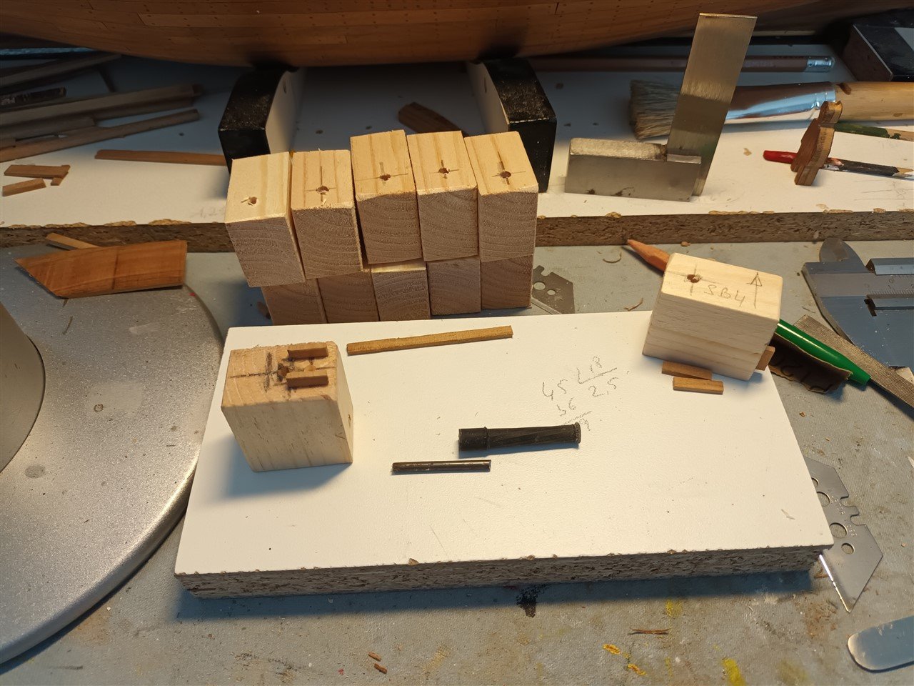

Smal update.

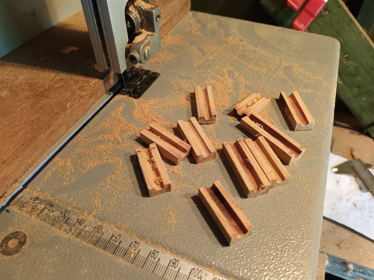

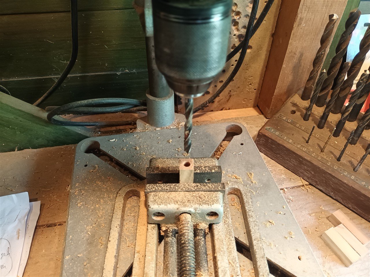

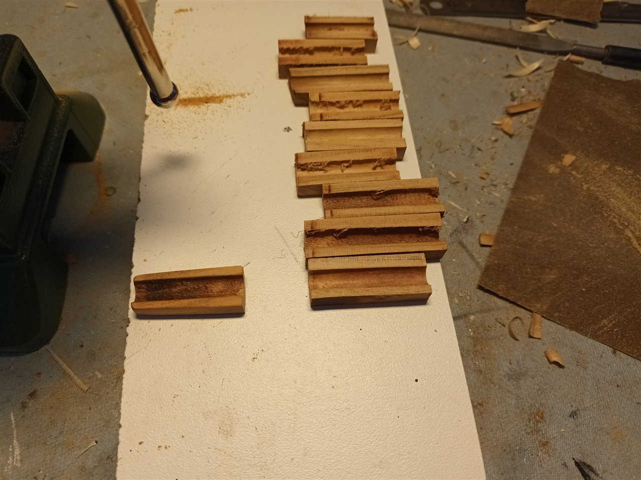

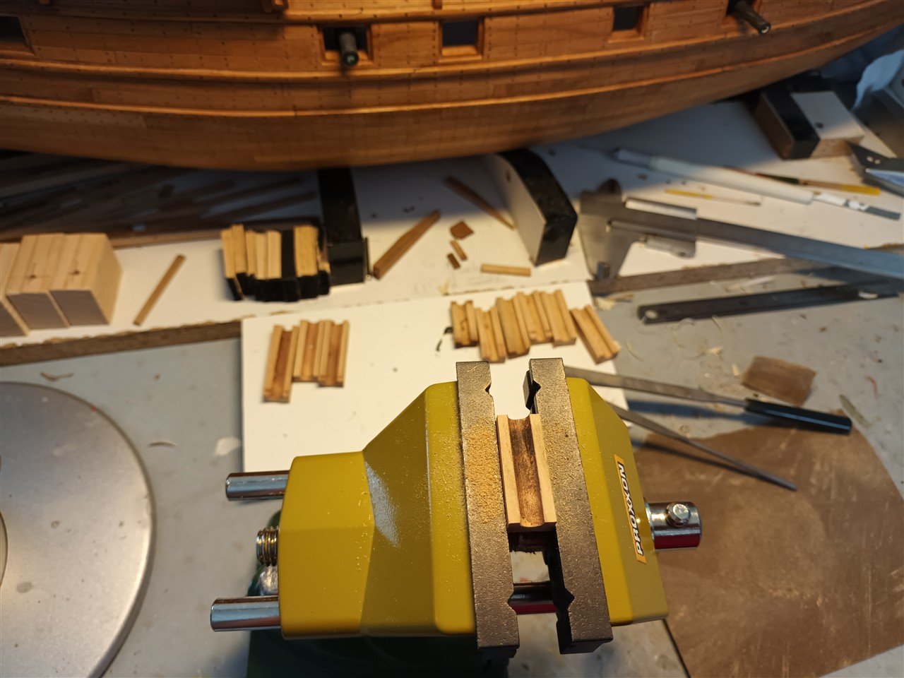

Started with the wooden parts of the wrought iron cannons
Base wooden blocks
Then drill holes
Saw through
The further finishing
20250506_140047_1280.jpg.770486fa2173e18f664939498c0749c9.jpg20250506_141923_1280.jpg.ec698727f9bc61ea09c7e6f044bac726.jpg20250506_142014_1280.jpg.9bfe4c5584952f838f837f219e1ed479.jpg
Currently there are 10 made

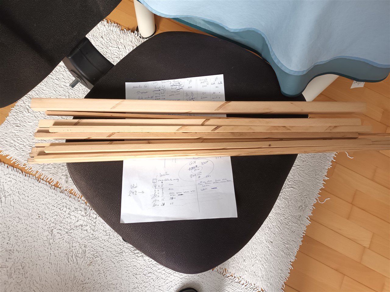

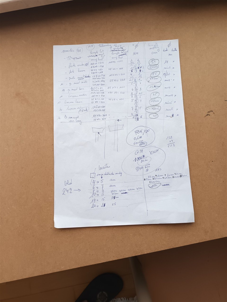

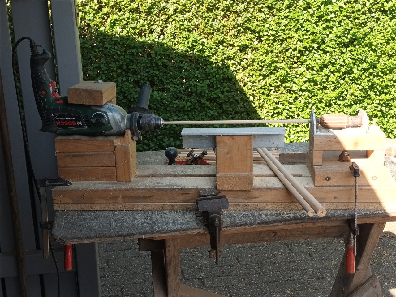

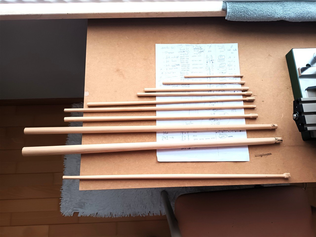

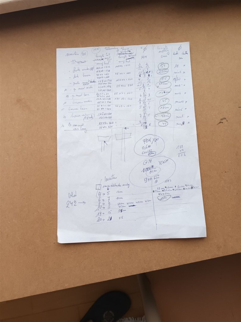

Masts and yards.
During the last vacation, the possible dimensions were drawn up. (All this is largely guesswork).
A few months ago, wood was sawn. pine wood with thin grain. Age?? But the tree was sawn at least 25 years ago.
20250402_111153_1280.jpg.9d3a4fb0c3fda3570def84eab7556315.jpg Nice weather to work outside, So the "lathe" was set up. Own construction, not a pretty thing. But it works.
All masts parts are"semi" ready. Together with the main yard.

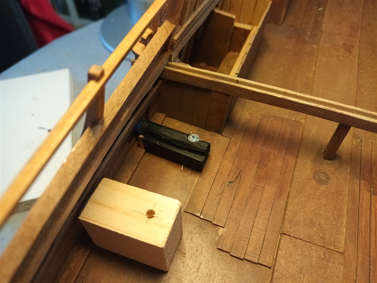

Continuing with the cannons and preparations for the main deck.
The forged iron cannons are constructed from polystyrene tubes, the inner and outer diameters of which differ by 1 mm.
These are then glued to the wooden part (carriage) and provided with an iron pin. They will be finished later.

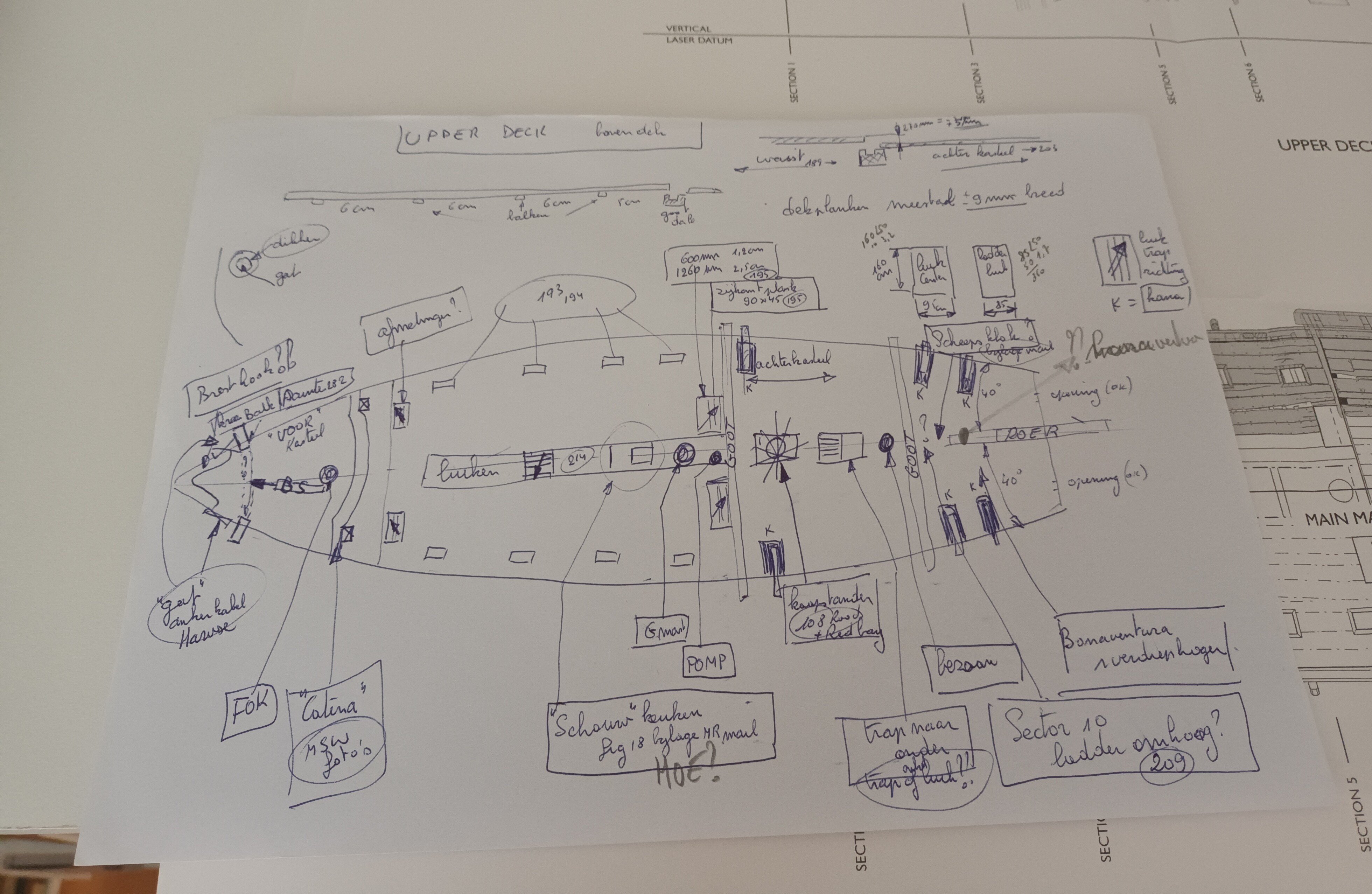

Small update on the upper deck layout.

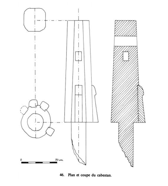

During a week of vacation I asked and received information from the Mary Rose museum. Was there a capstan, and if so where?
Answer.
There is no real evidence that there was one, but also no evidence that there wasn't one. And the most logical place is behind the main mast.
Also received a pdf "Cabels and Cablets of the Mary Rose" which contains a lot of information about the layout of the upper deck and the anchor cables.
This results in the following setup (not a technical masterpiece as it is sketched on a beach chair, but reasonably clear).
Start upper deck.
The Lomellina (Genoese, sank 1516) had a capstan a little aft of the mainmast, with a knight between the two.
As the May Rose's mast appears to have been directly forward of the aftercastle, it would perhaps be a little differently arranged. But Generally I'd expect it to be similar. On my Great Harry, I put the knight and capstan on the upper deck of the aftercastle - see post #308 at
but that's not to say my interpretation is correct. By the way, note that unlike later capstans, the holes for the bars pass right through the capstan and are at two different levels. So there are only two bars, each of which extends out from both sides of the capstan, so there are only four positions for the crew to push at the capstan.
I hope that helps.
Steven

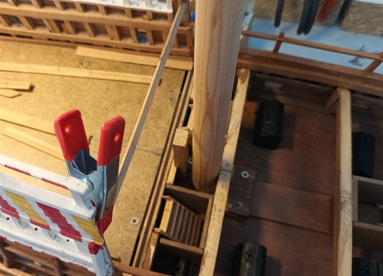

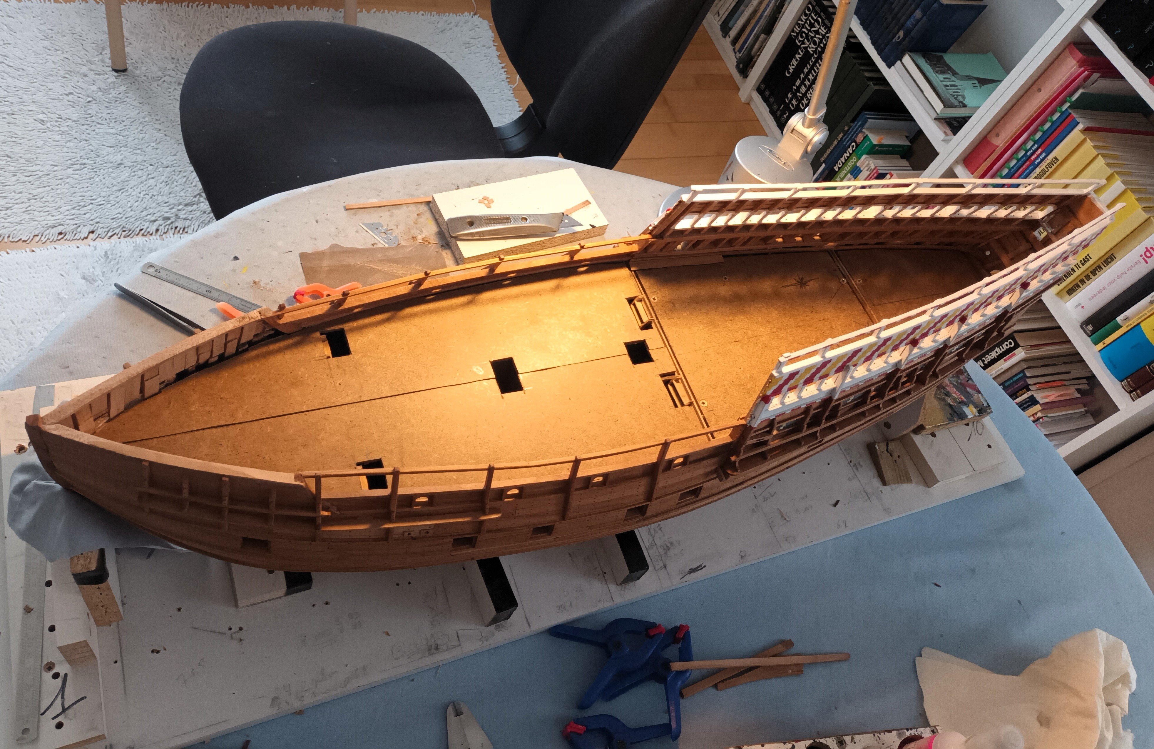

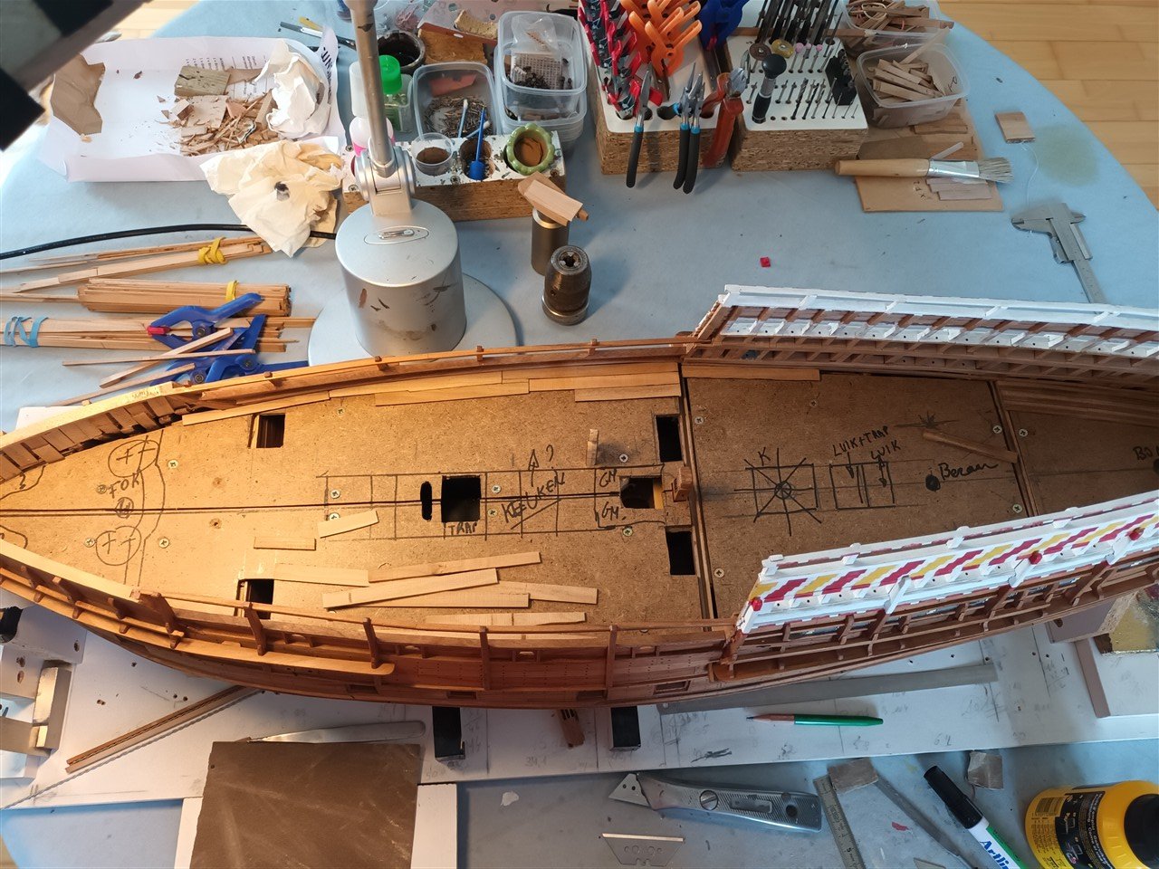

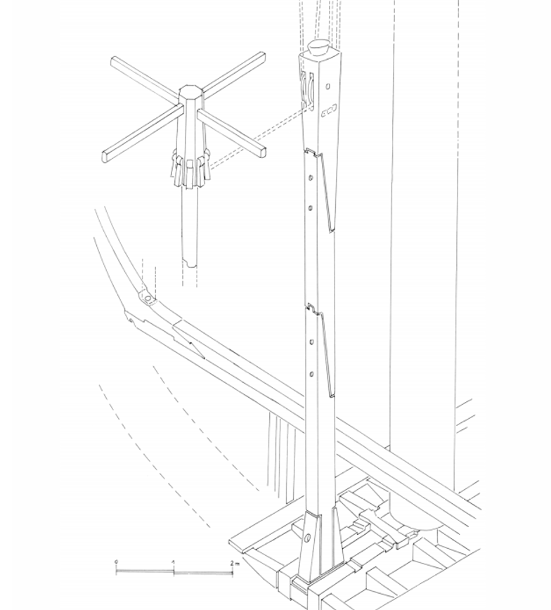

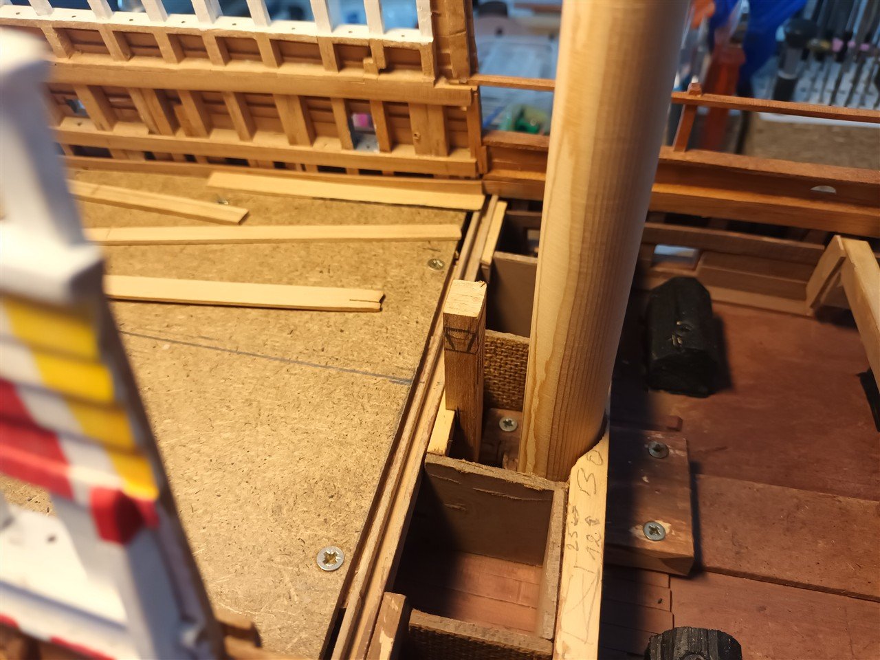

Construction of the knight for the main yard.
It appears that i placed the main mast too far back.
Corrected position.

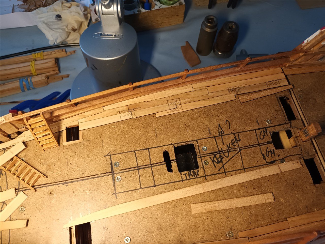

Knigt and the base plates for the upper deck placed. With the layout roughly sketched.

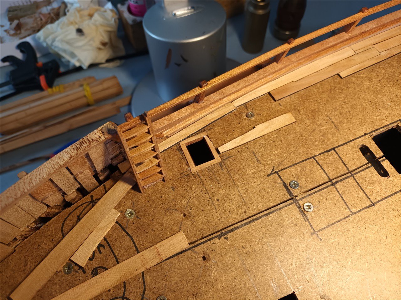

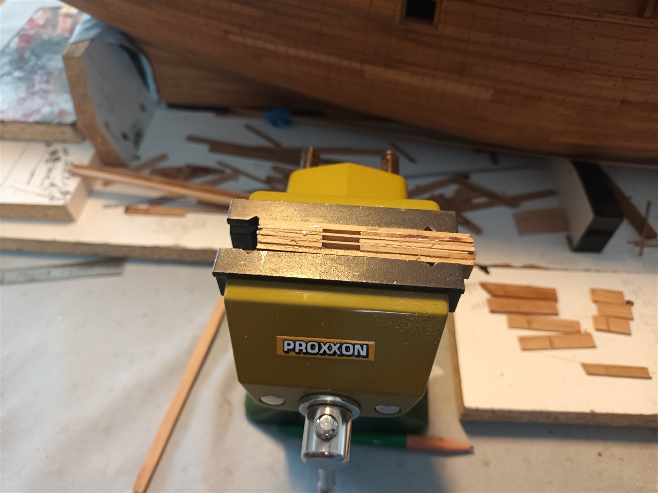

And start planking.
First the piece that is still left, then the remaining part (a puzzle...)
20250613_201009_1280.jpg.b41a0902aa5d43b098154dc974945ecd.jpg20250614_141600_1280.jpg.1653ef5bdd1f6832435990a6fe765d6d.jpg
