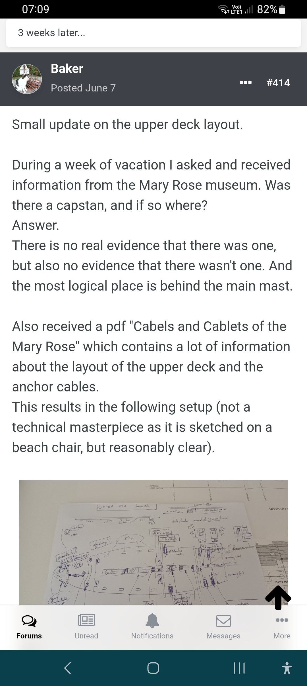

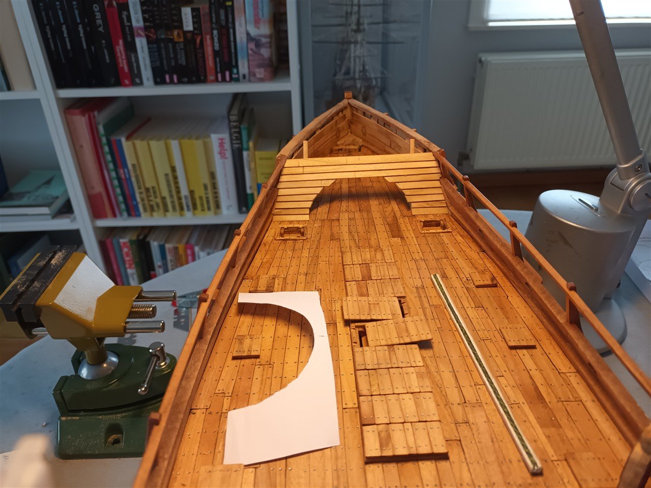

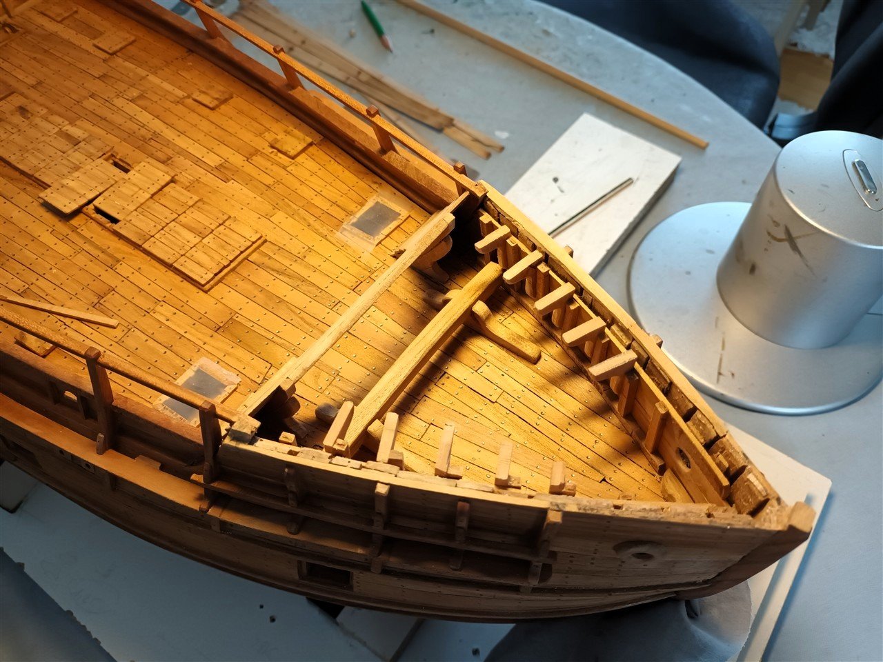

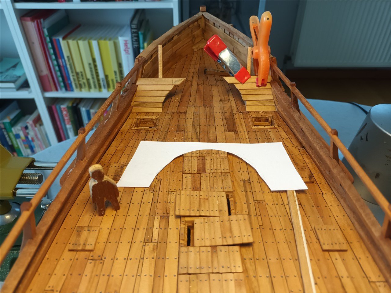

I wouldn't place the capstan exactly in the middle. If, for example, the anchor also has to be raised with it, it is useful if the rope runs along the mast foot without touching it.

And the Anchor cable wil not toutch the main mast
btw,
There are anchors on starboard and port side.
if I place the capstan off center then i can only operate the anchors on one side
Edited by Baker

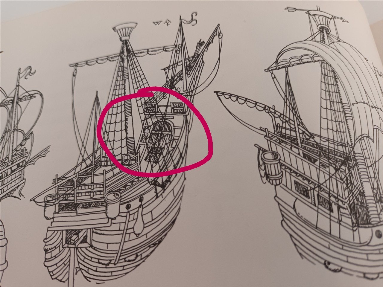

Usually the capstan  (spil) was set up in front of the mainmast and then in that case  it could be set up on the axis of the ship. In this way he could hoist the lower beam of the mainmast (the line then went along the foot of the mainmast via a bitt placed diagonally behind the mast). The lower beam of the jib mast could also be lifted from the capstan (also via a bitt, but behind the foot of the jib mast). And the anchors could also be retrieved by the capstan. A capstan was the only very strong power source on a ship and was used for everything (hoisting cannons, sloops, cargo) and was on large ships indispensable. Small ships used a windlass.

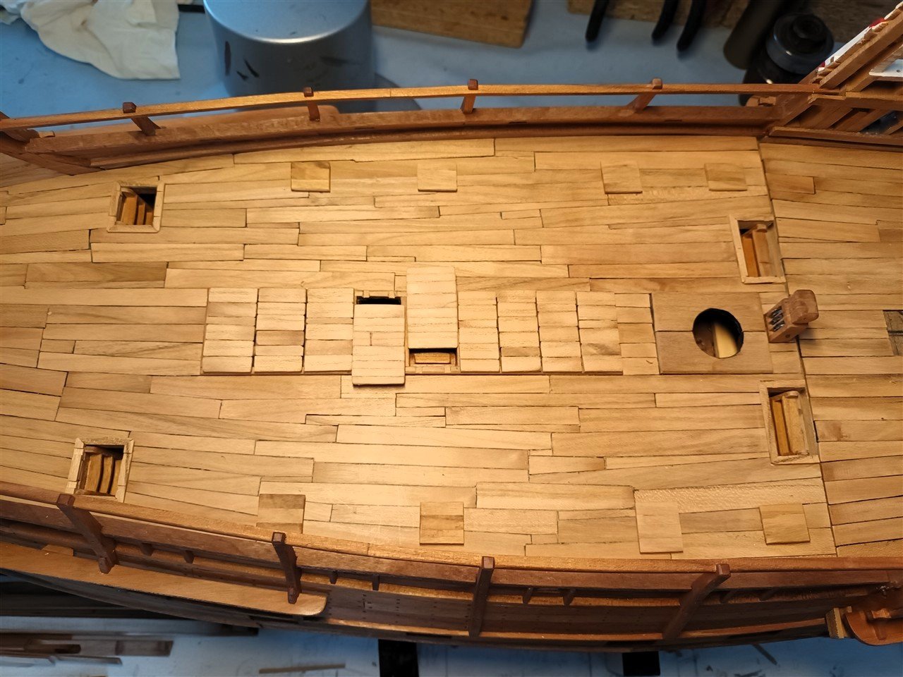

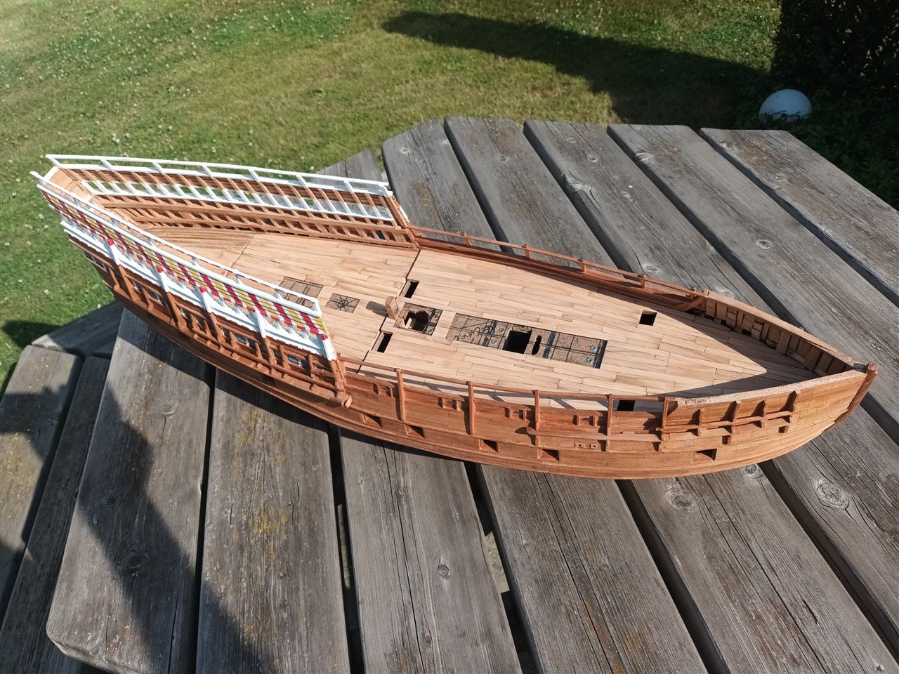

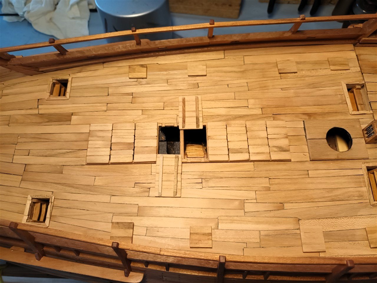

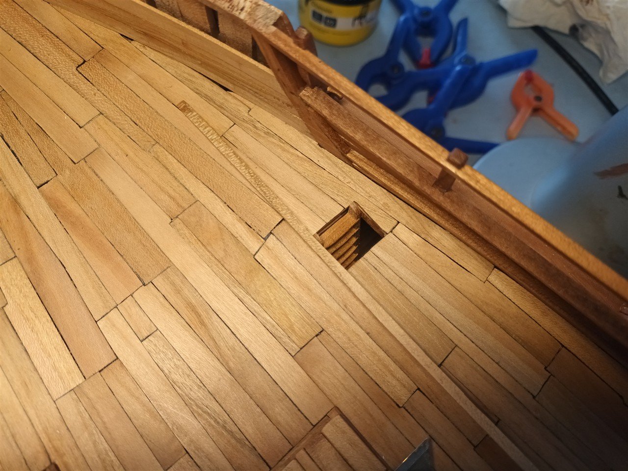

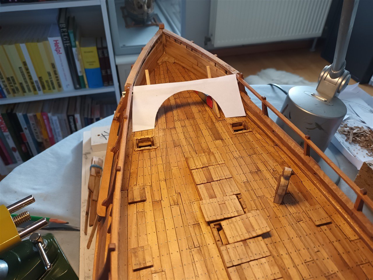

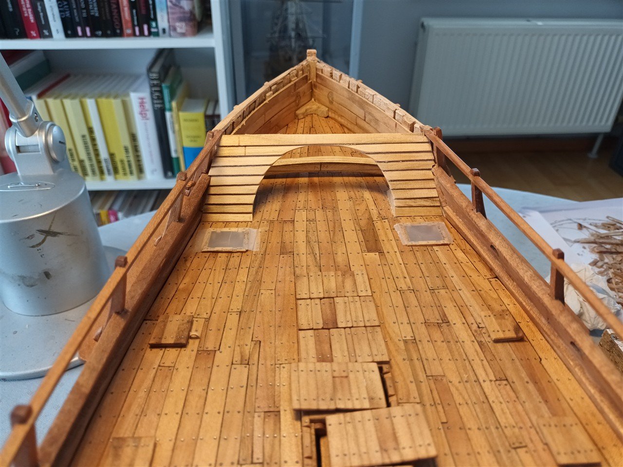

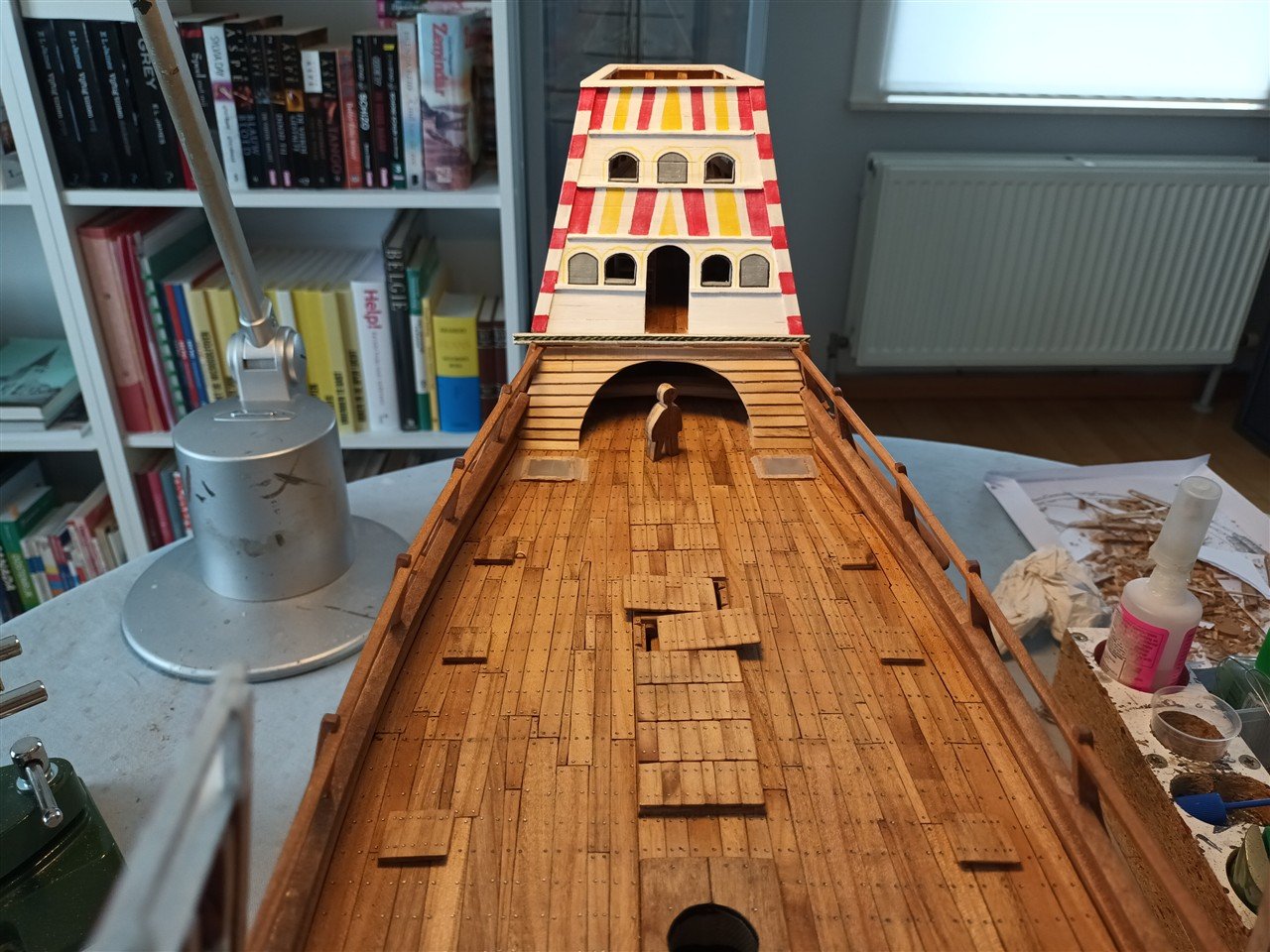

With the deck planking finished, the deck (outside in the garden) is sanded and dusted.
The planking at the back is virtually invisible later, so most attention has been paid to the parts that remain visible.

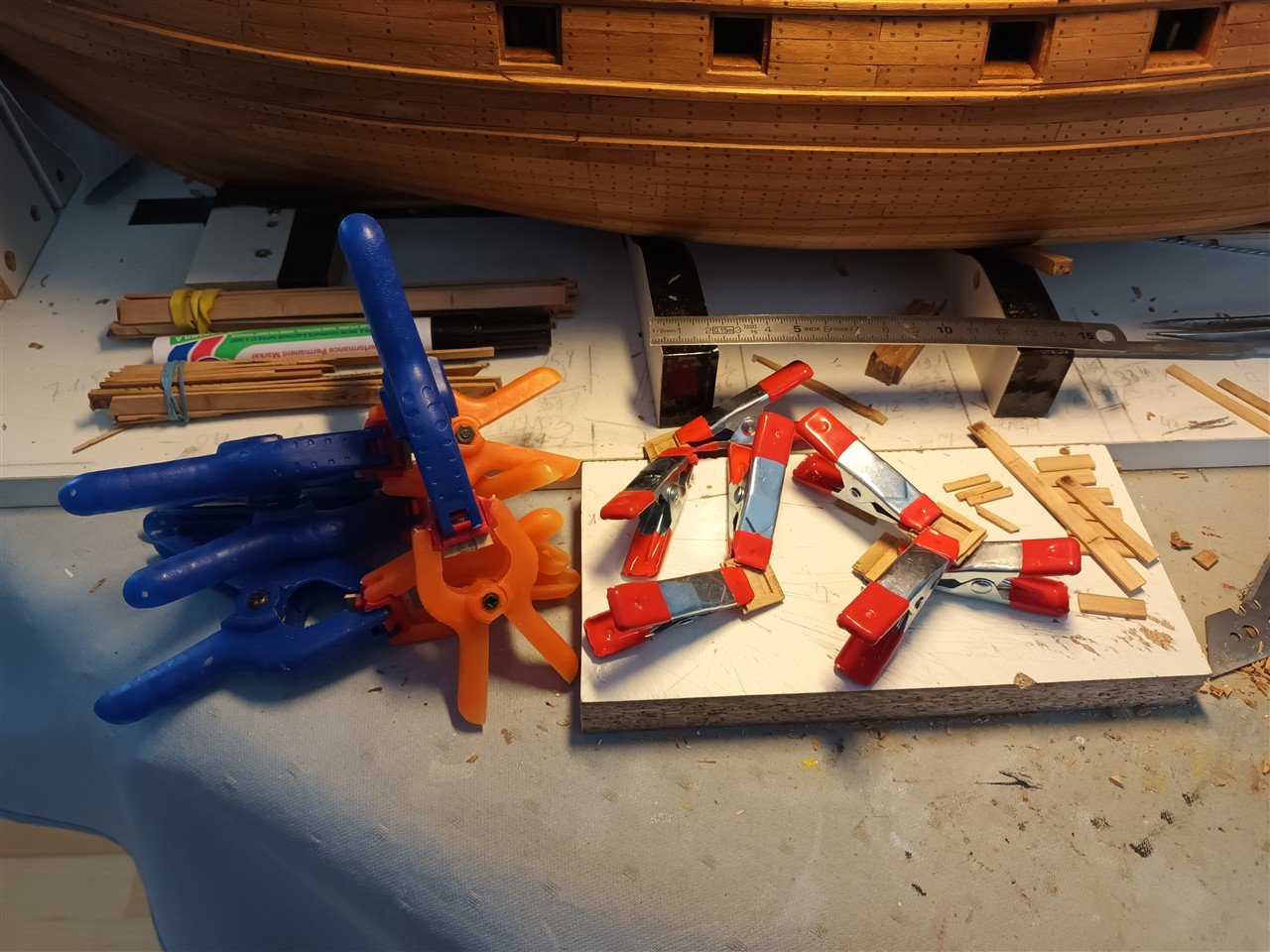

Ladders glued
20250703_200433_1280.jpg.418fa73b5ebe234d3c64b88ef57fc6a4.jpg20250703_200459_1280.jpg.5e184968b6881d28dea70e1ef0561ff6.jpg

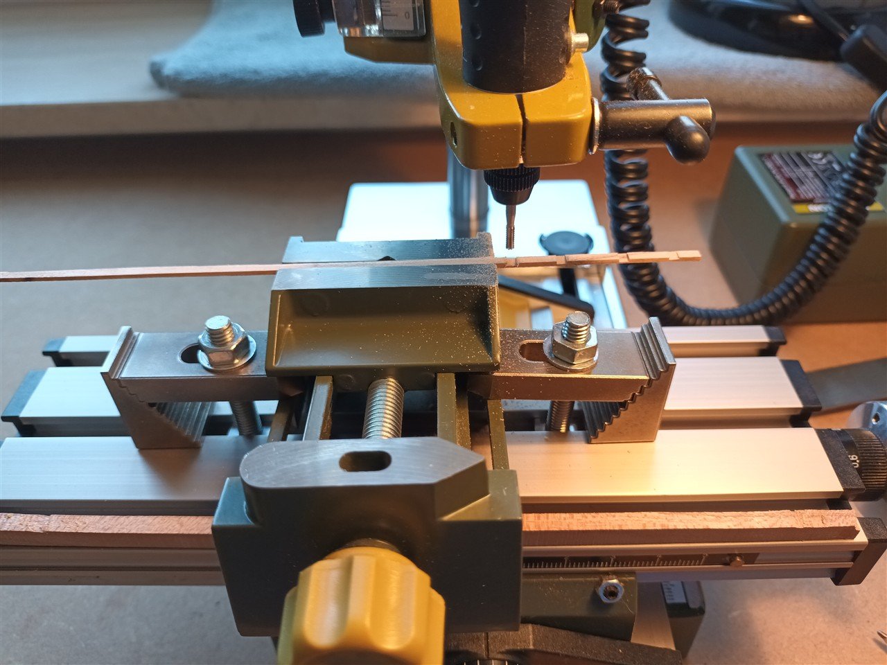

The openings around ladders and other openings are finished with planks with grooves milled into them. The cross beams of the hatches fit here.
(Most of the hatches in the middle will be closed)

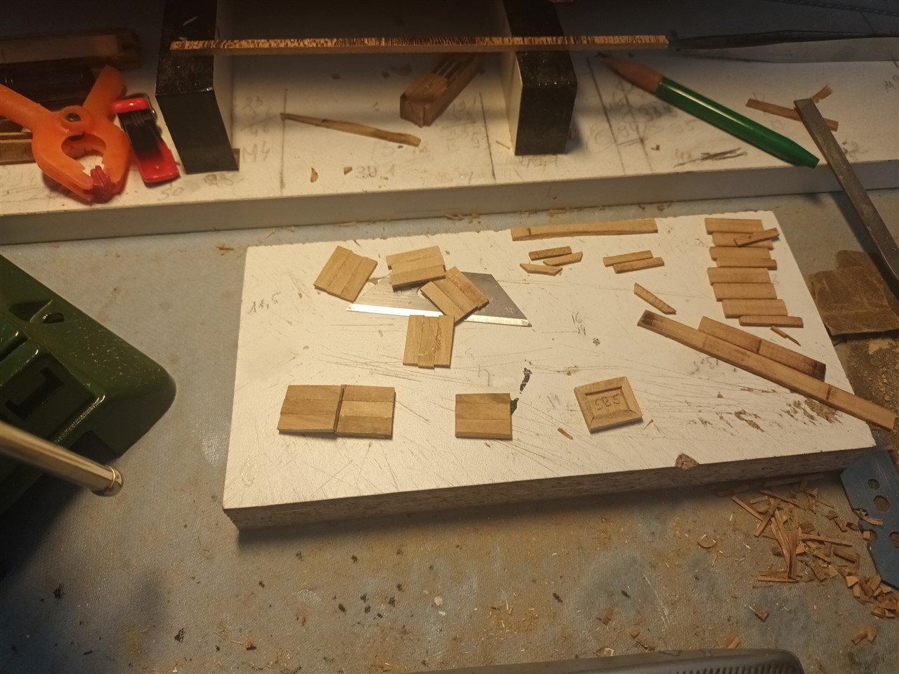

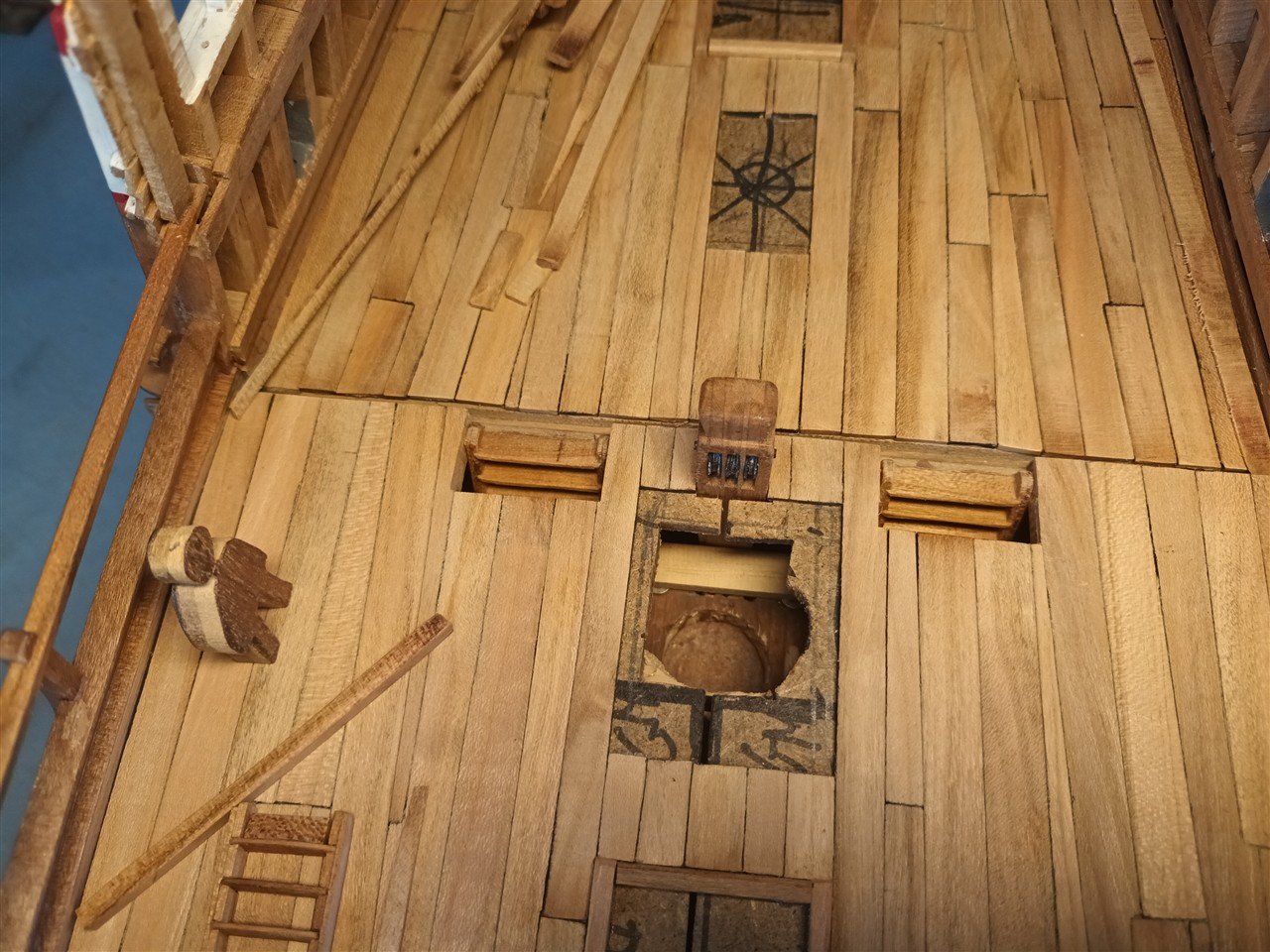

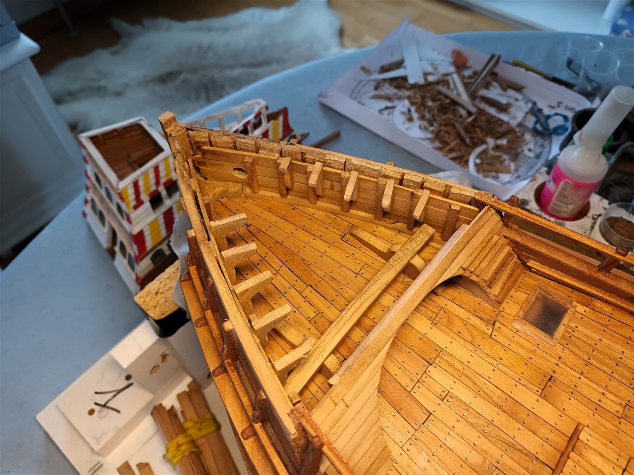

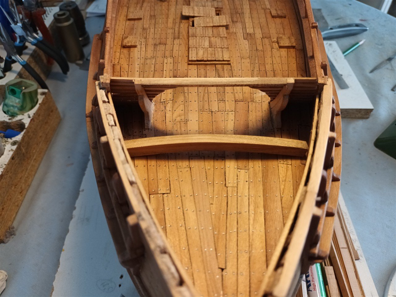

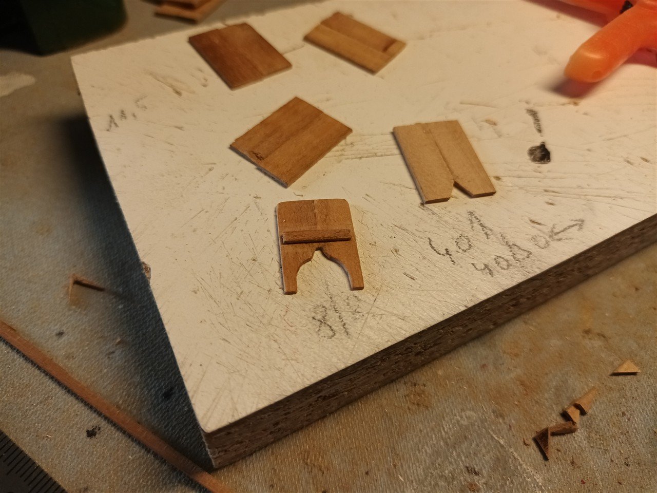

Construction of the various hatches on this deck.
20250708_105249_1280.jpg.e82ffce8a38d074c581fb351dfe02fd9.jpg20250708_123103_1280.jpg.03c7881a40375dbdb8962c18c6d9b1f5.jpg
Eight small hatches, above each gun on the deck below. None are identical. It looks sloppy, but so be it...
Larger hatches are provided in the middle.

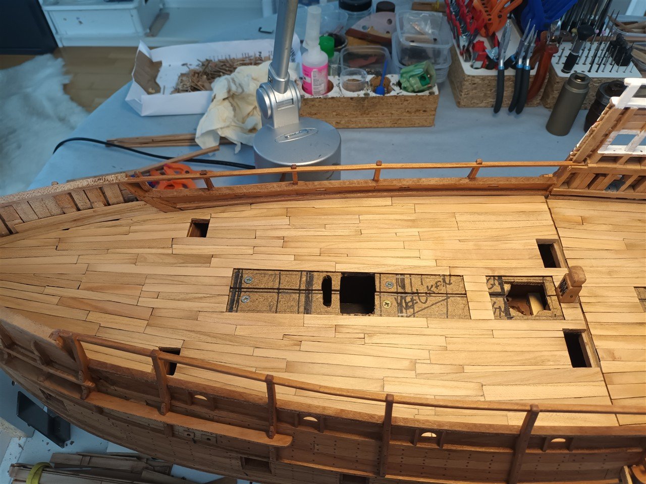

An anchor cable will later "disappear" under one.
A ladder will remain partially visible under another.

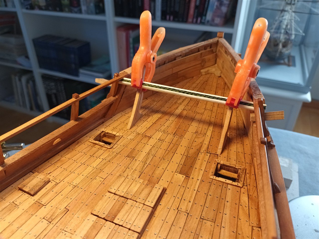

20250715_135441_1280.jpg.51ff52a5a5b8010fda1850e6d6548e67.jpg20250715_135412_1280.jpg.7daadf51c13f6ff978fc11008f531ce6.jpg

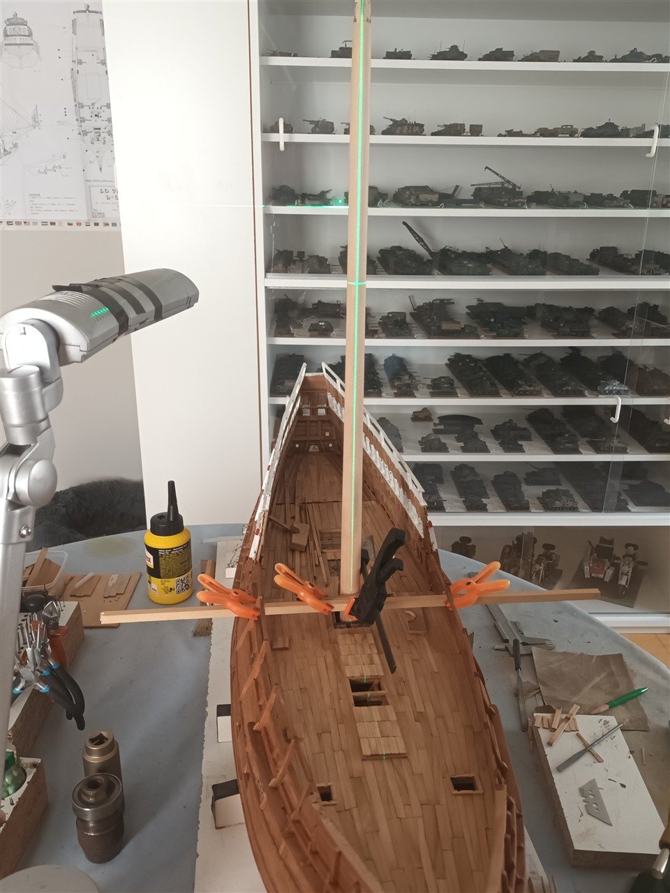

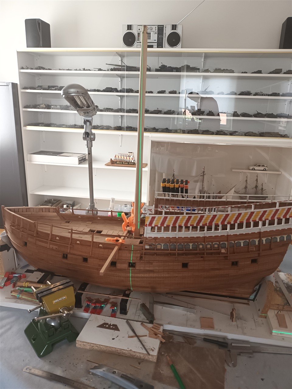

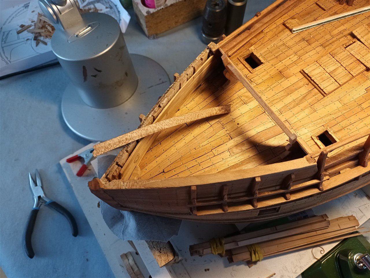

The mast is aligned, straight across the width and leaning slightly backwards along the length.
20250708_181323_1280.thumb.jpg.af2a62a5c37fa4057f43c46882ce752e.jpg20250708_180841_1280.thumb.jpg.4913cd73710f015cec118612e986611f.jpg

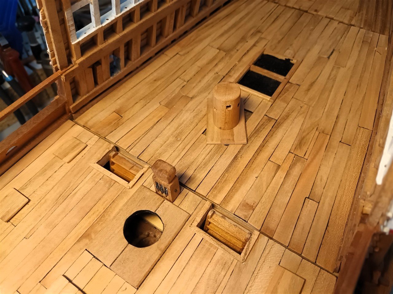

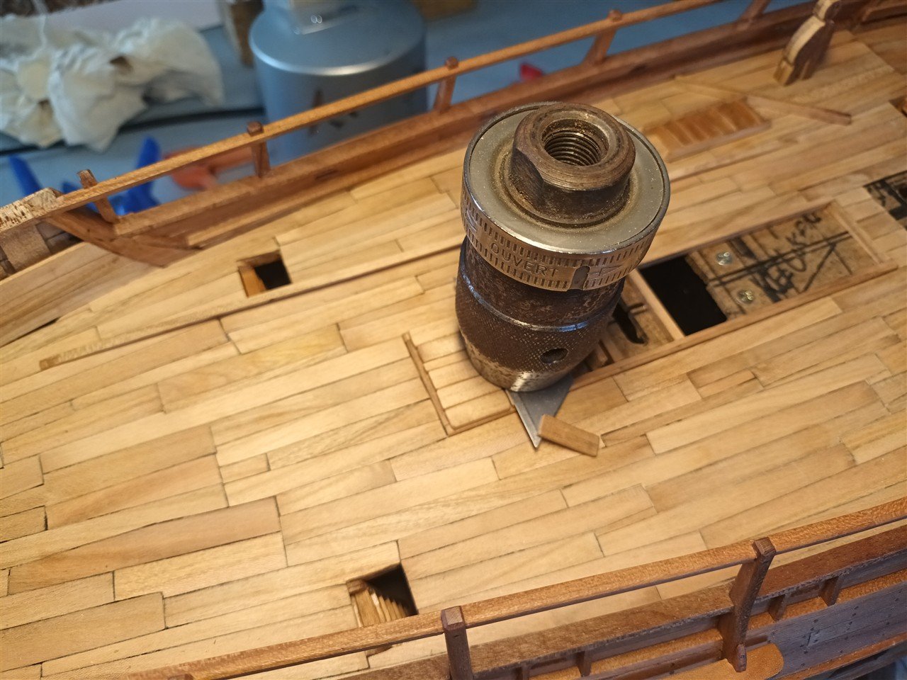

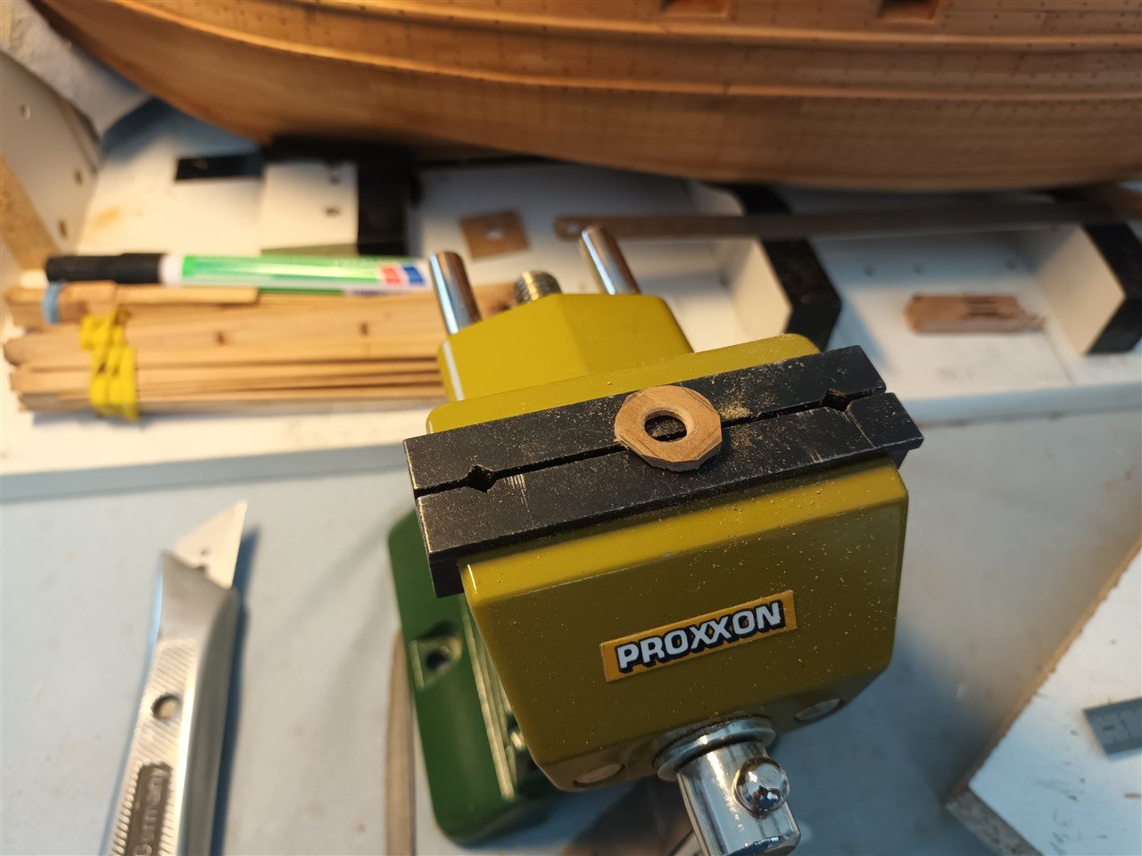

Capstan under construction
Thanks for following and likes
