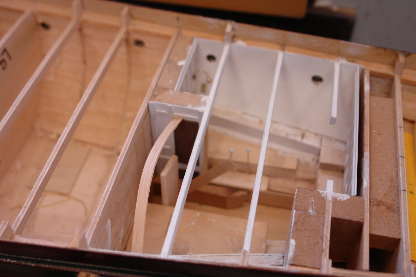

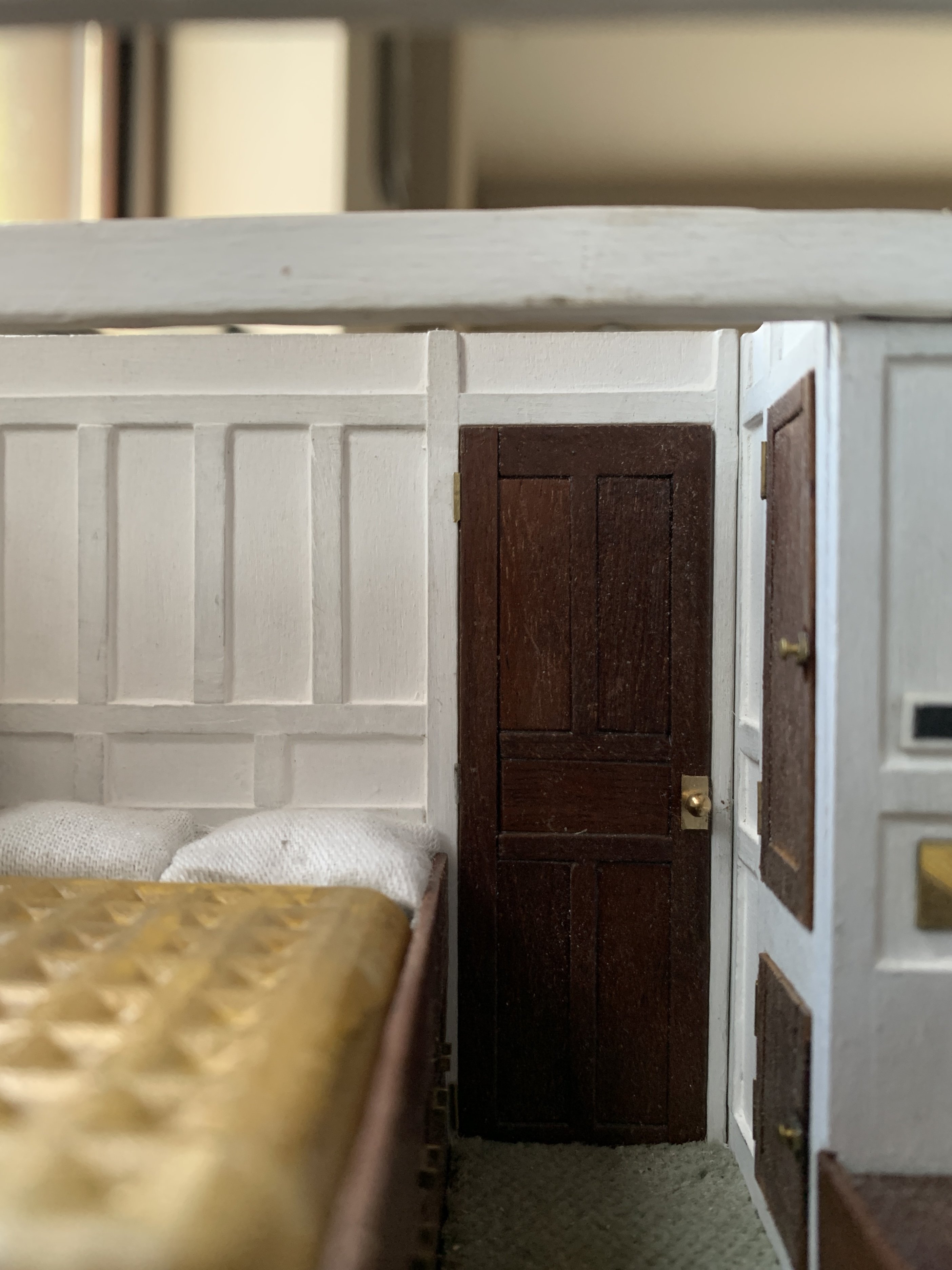

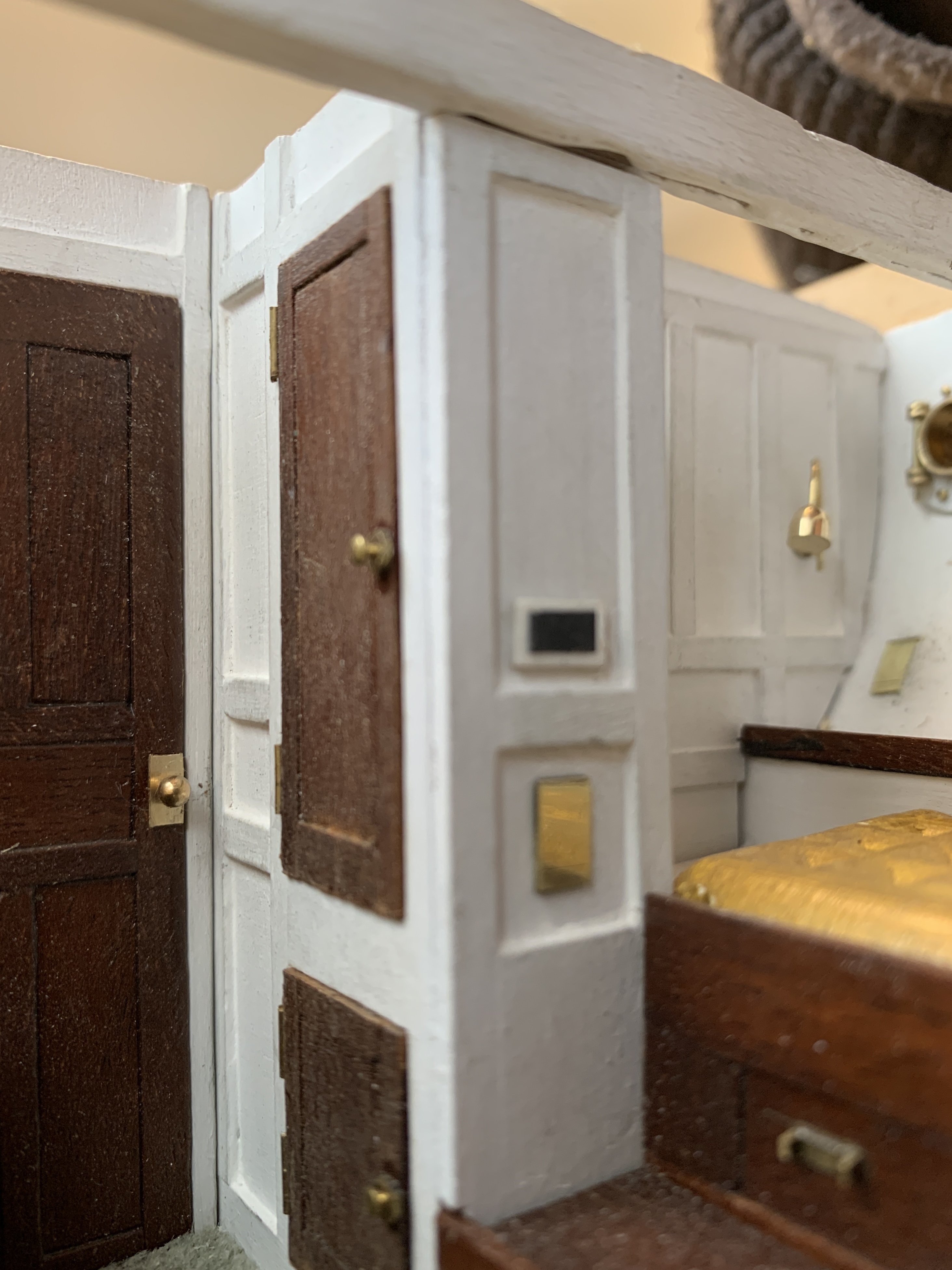

Well the grandchildren are gone and the weather has turned very wintery. The workshop is currently at 5 deg C - 41 deg F so my time working is somewhat limited. I have however been progressing the aft guest cabin.

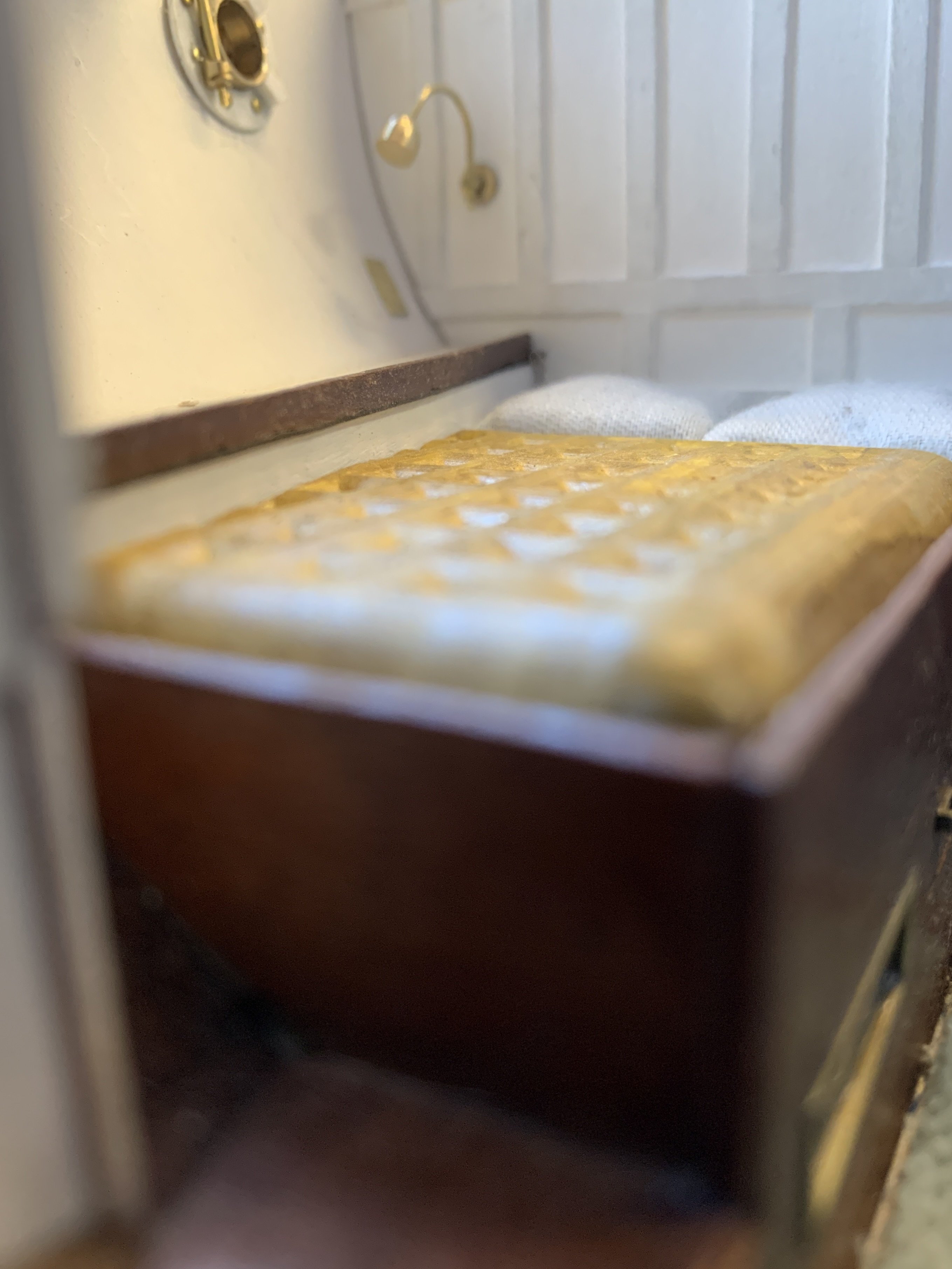

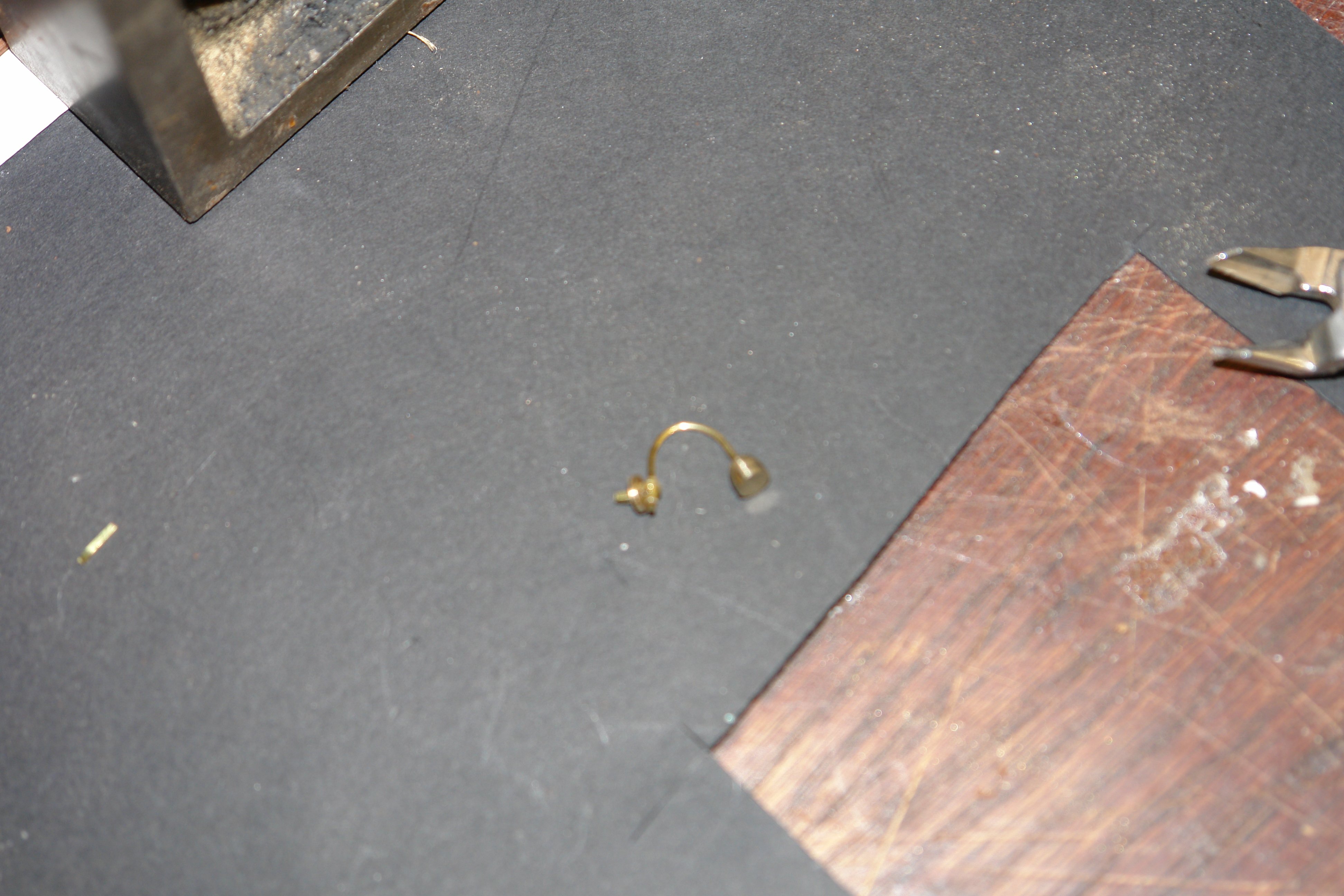

I needed a couple more bedside lights.

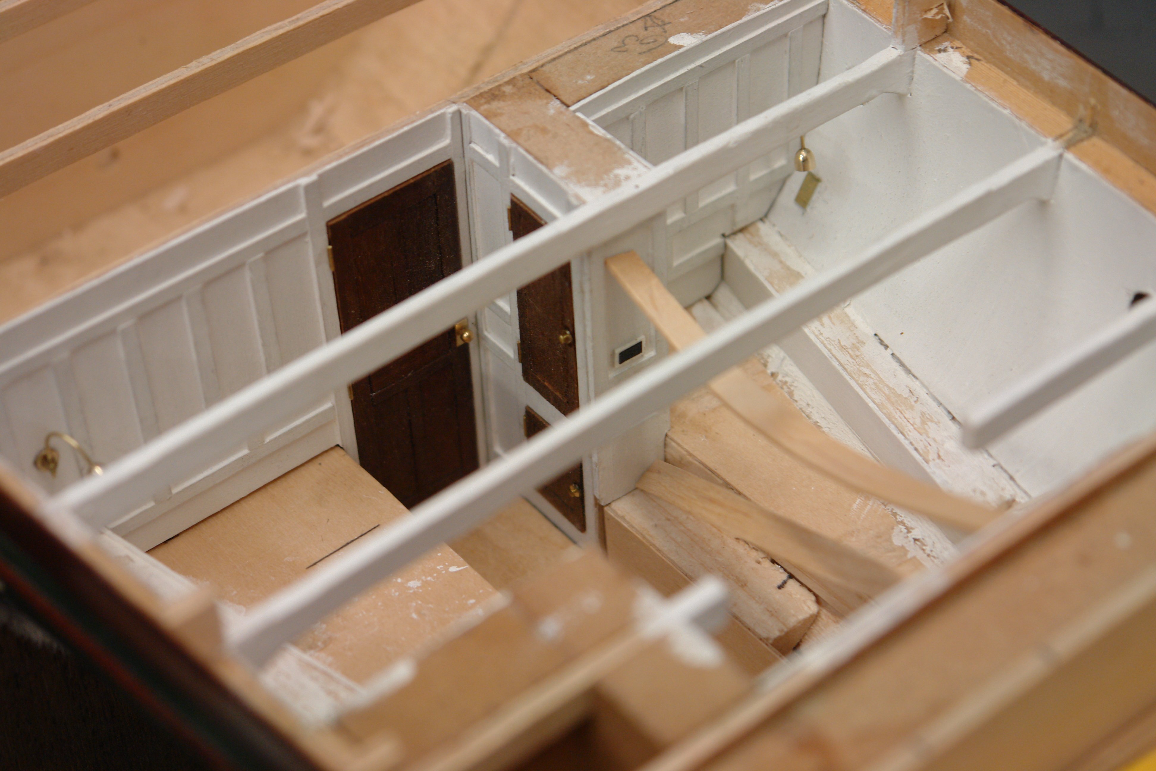

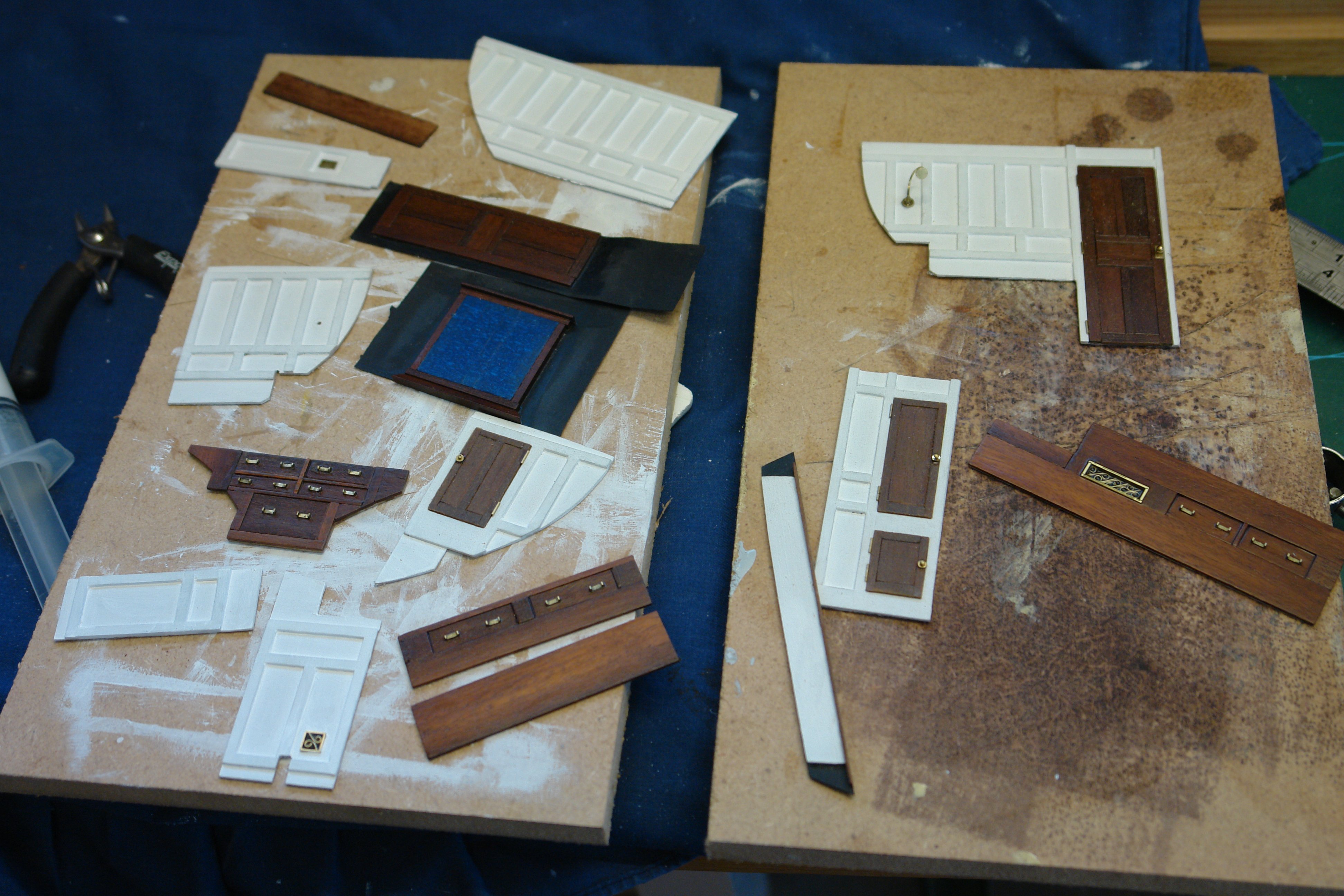

I also started gluing the mahogany doors to the various panelled walls, followed by door knobs, handles, lamps etc. I also made the large mirror ( currently protected by blue masking tape).

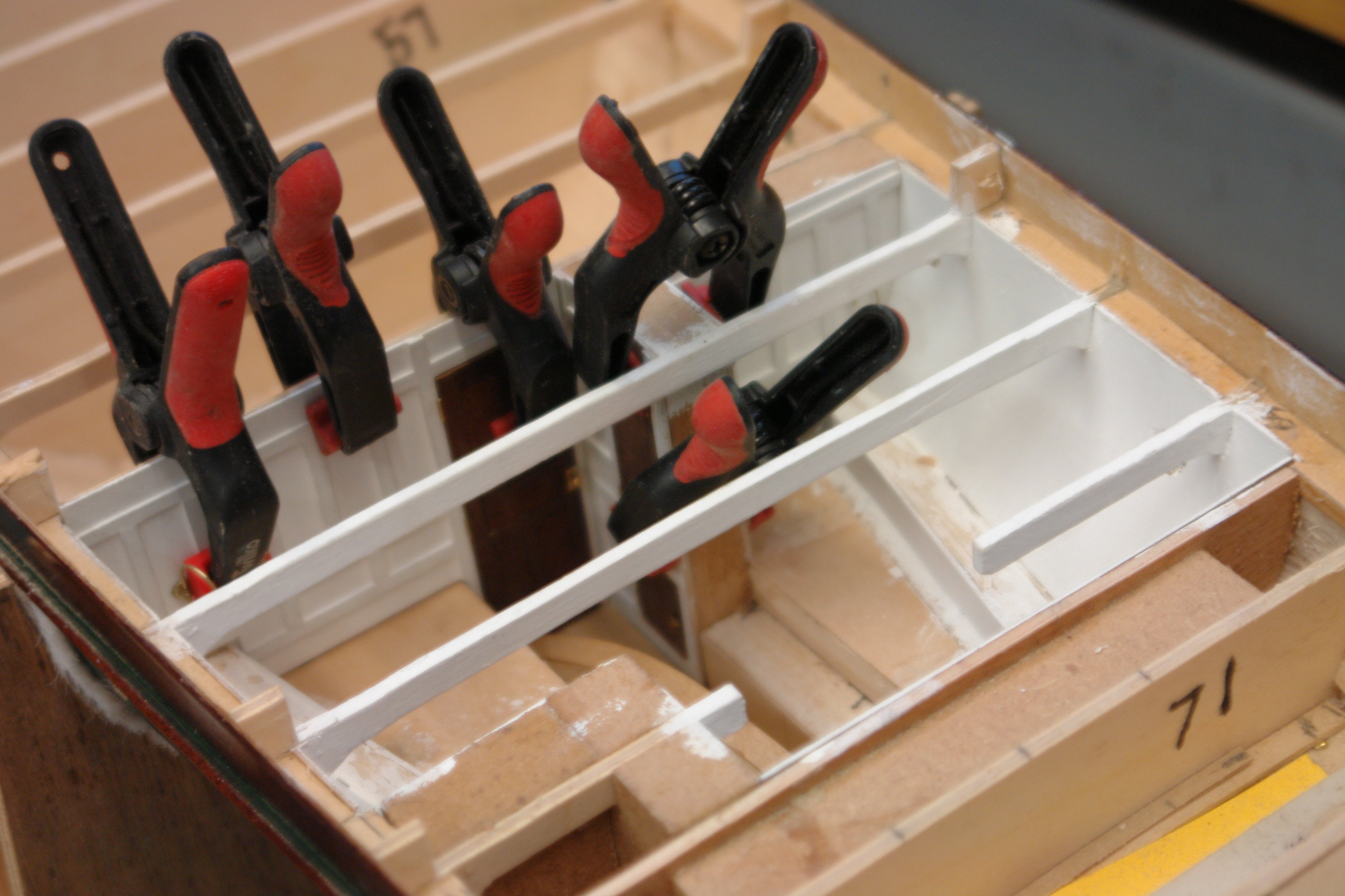

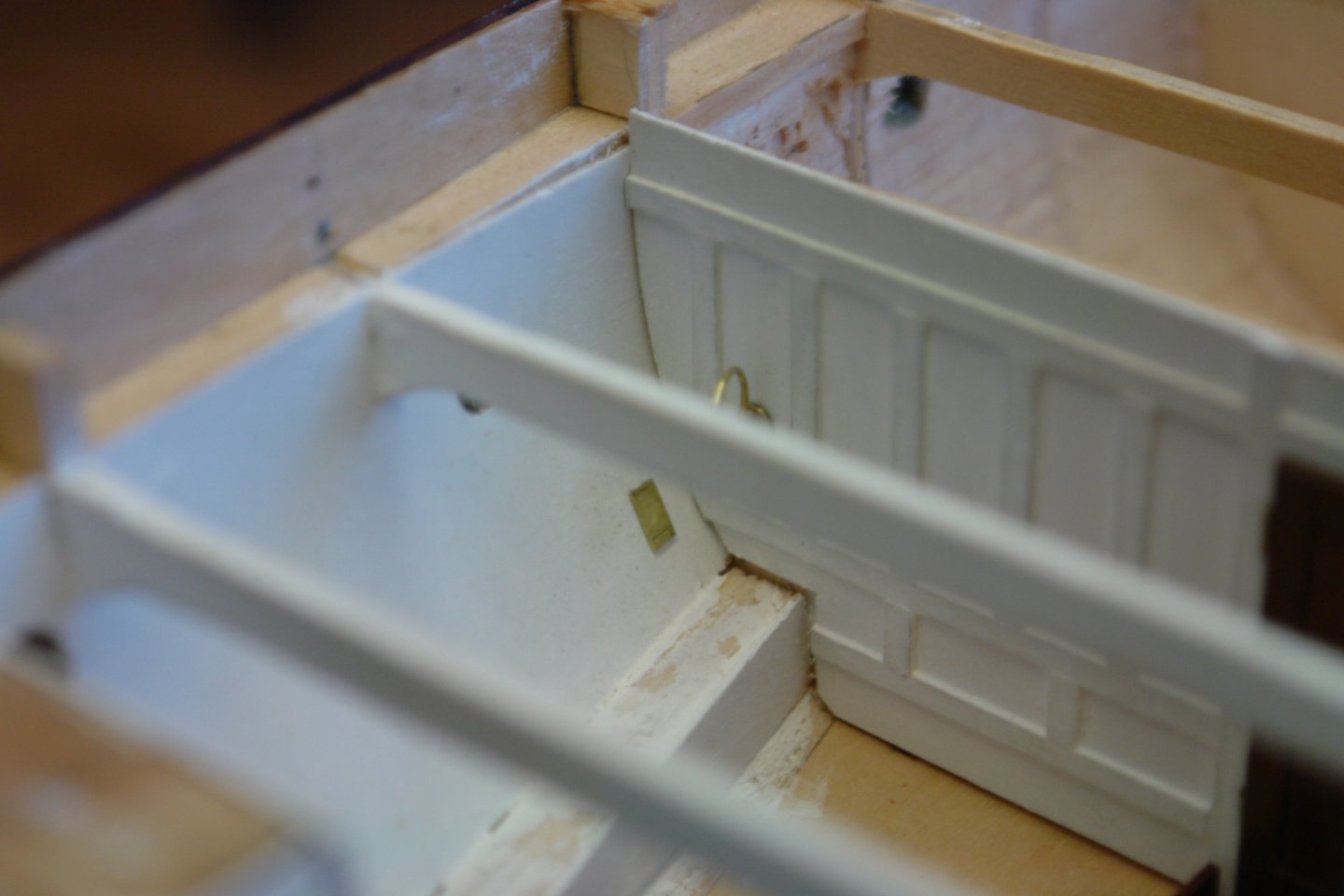

With the panels completed I was able to glue them in place with PVA - using more Starbuck sticks and various clamps to hold them.

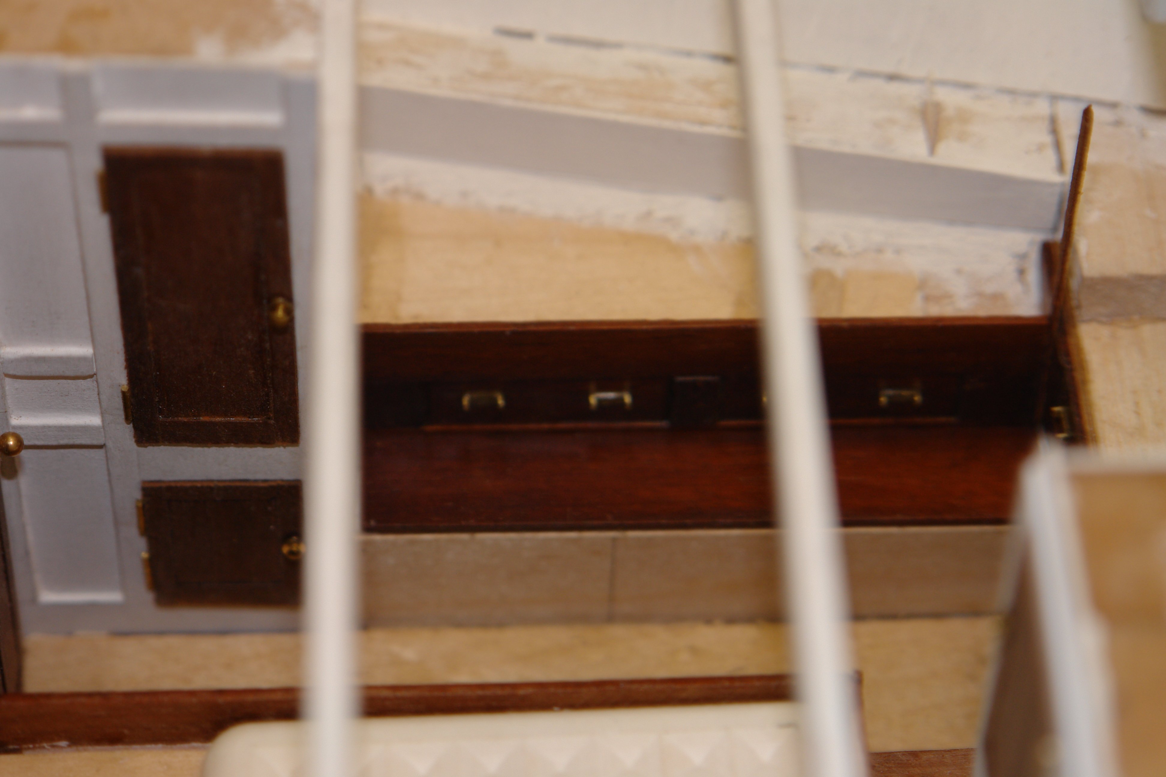

The side panels for the bunks and the various door fronts, shelves etc, went in next. The step (bottom left in the next photo is my best guess at what this area looks like. As explained earlier I don't have any photo's of this location.
Next a bit more carpeting. The floor has a slight step in it, presumably to accommodate the curvature of the hull or to trip up the mother in law. (see later comment).

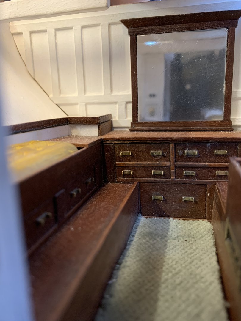

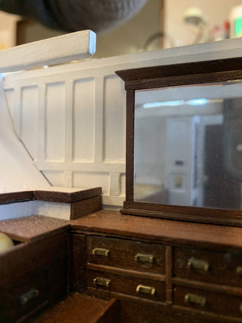

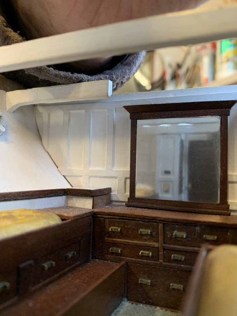

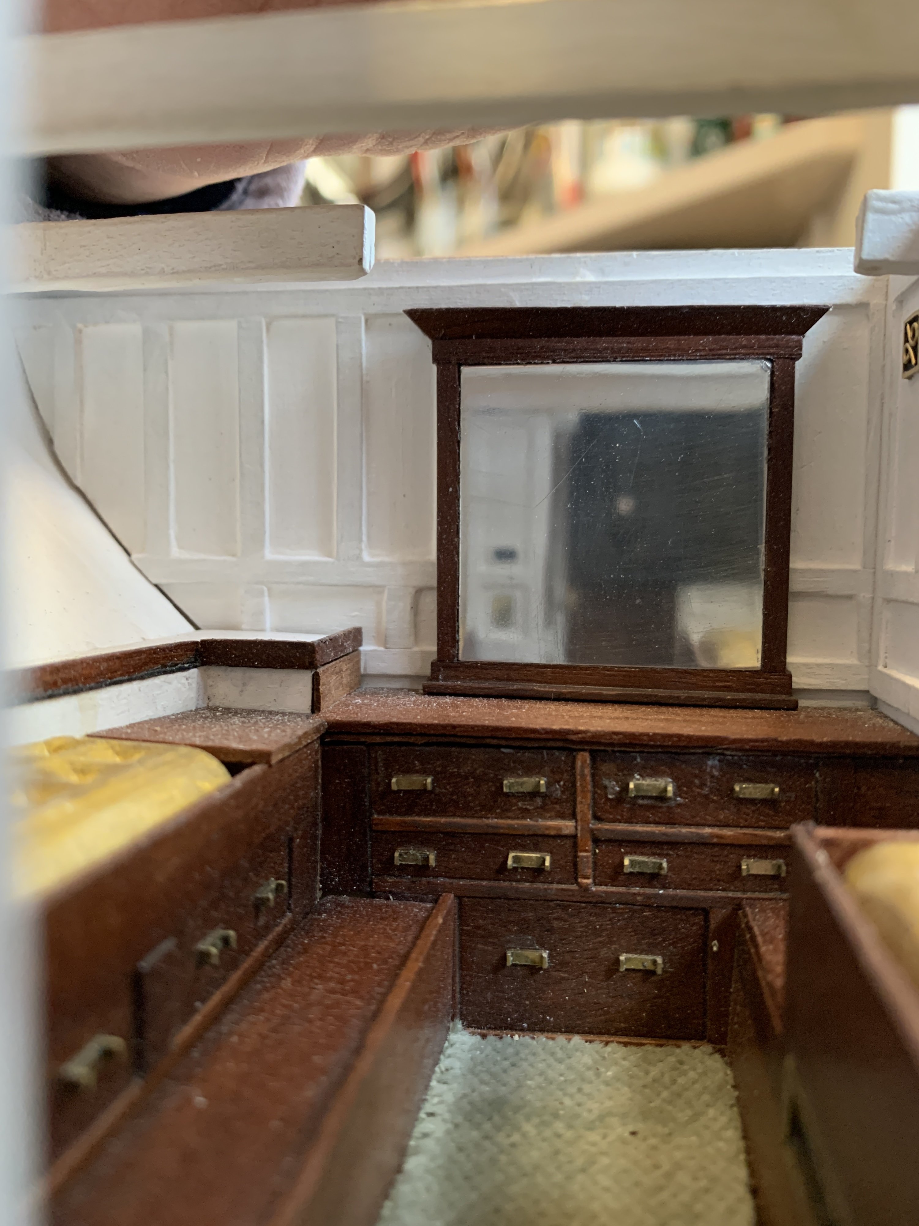

With everything in place I did a few shots with the phone camera (restricted by quite limited access).
Once again I forgot to clean out the dust.

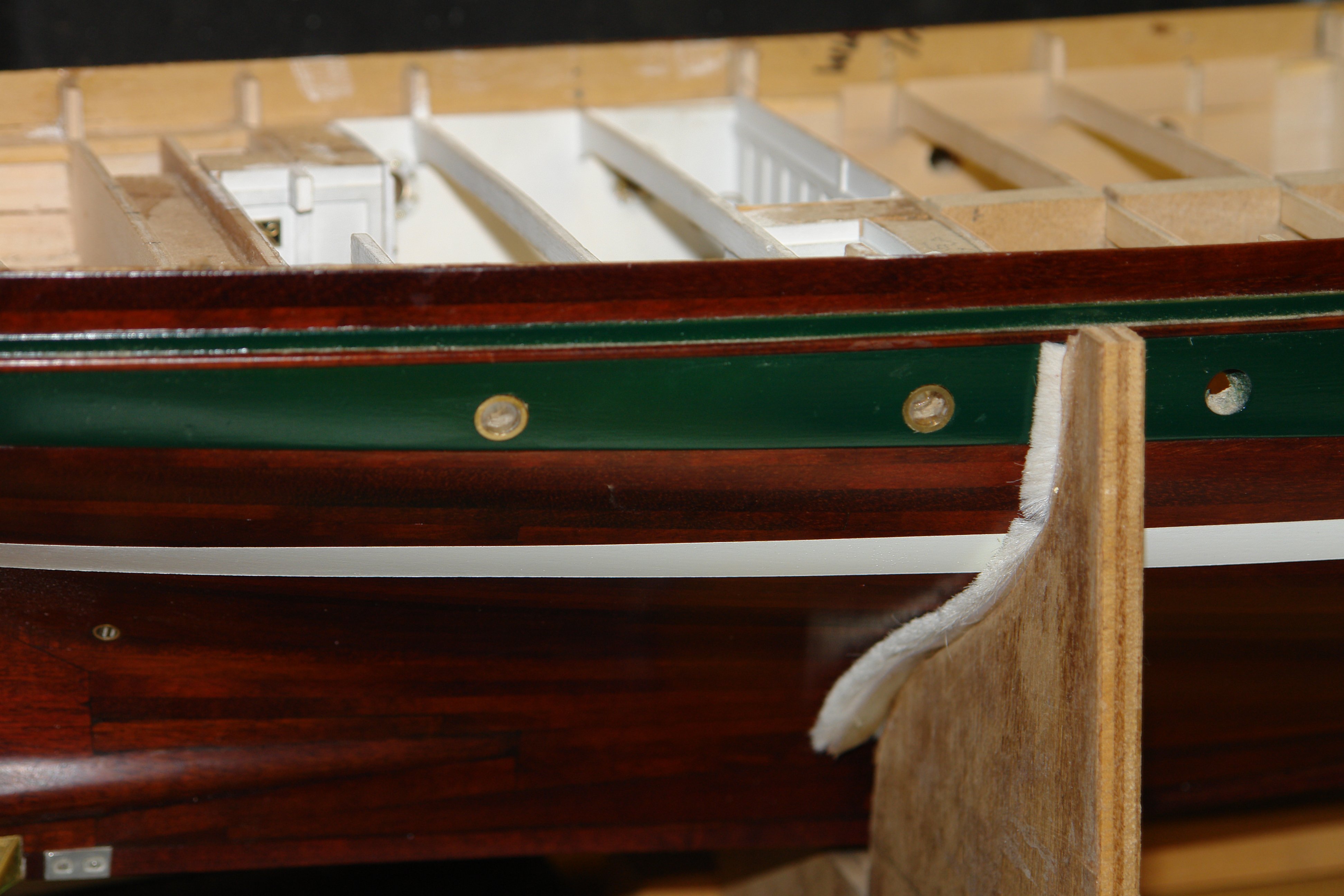

The following it the best shot I could get of the portholes.
I then glued in the external port holes (made earlier).

 Marvelous work as always, Keith. Those bedside lights are a treat.
Keith, I know you receive a lot of plaudits and you have earned every one of them.  However, I must add to them.  Some of those shots, especially showing the door and side panelling, bed etc, are so life like, if you posted them in a magazine without explanation, I believe most people would think them the real deal.  Exceptional quality and building. As Druxey says, perhaps you are having too much fun with this (even if 5 deg.)?
