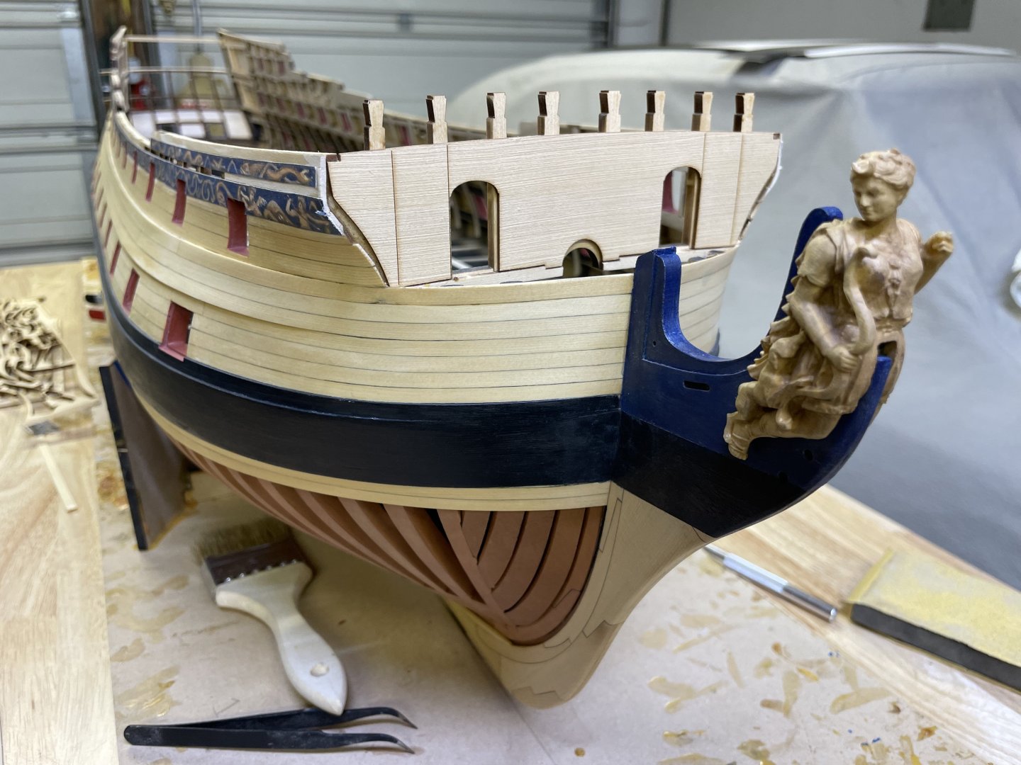

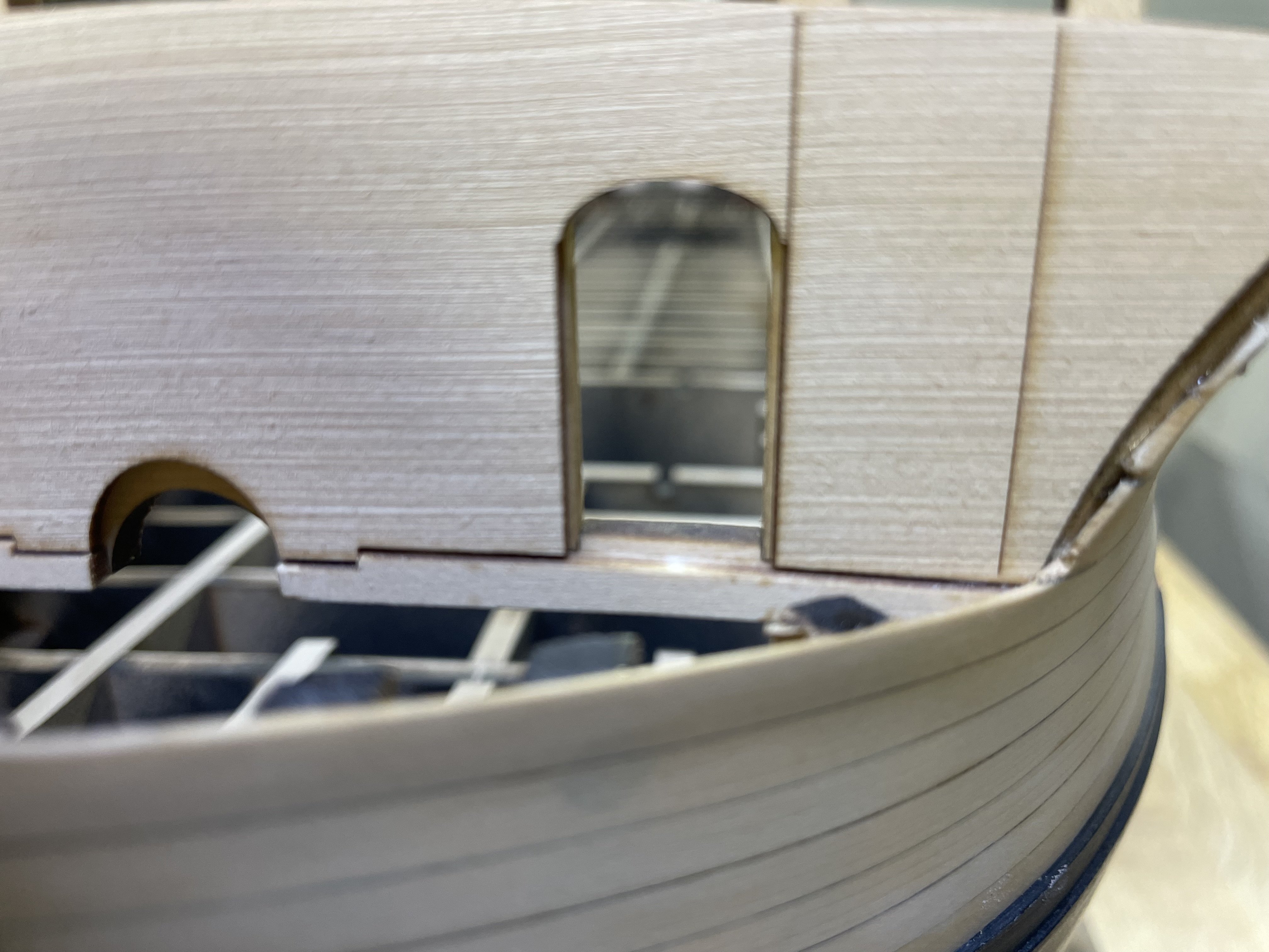

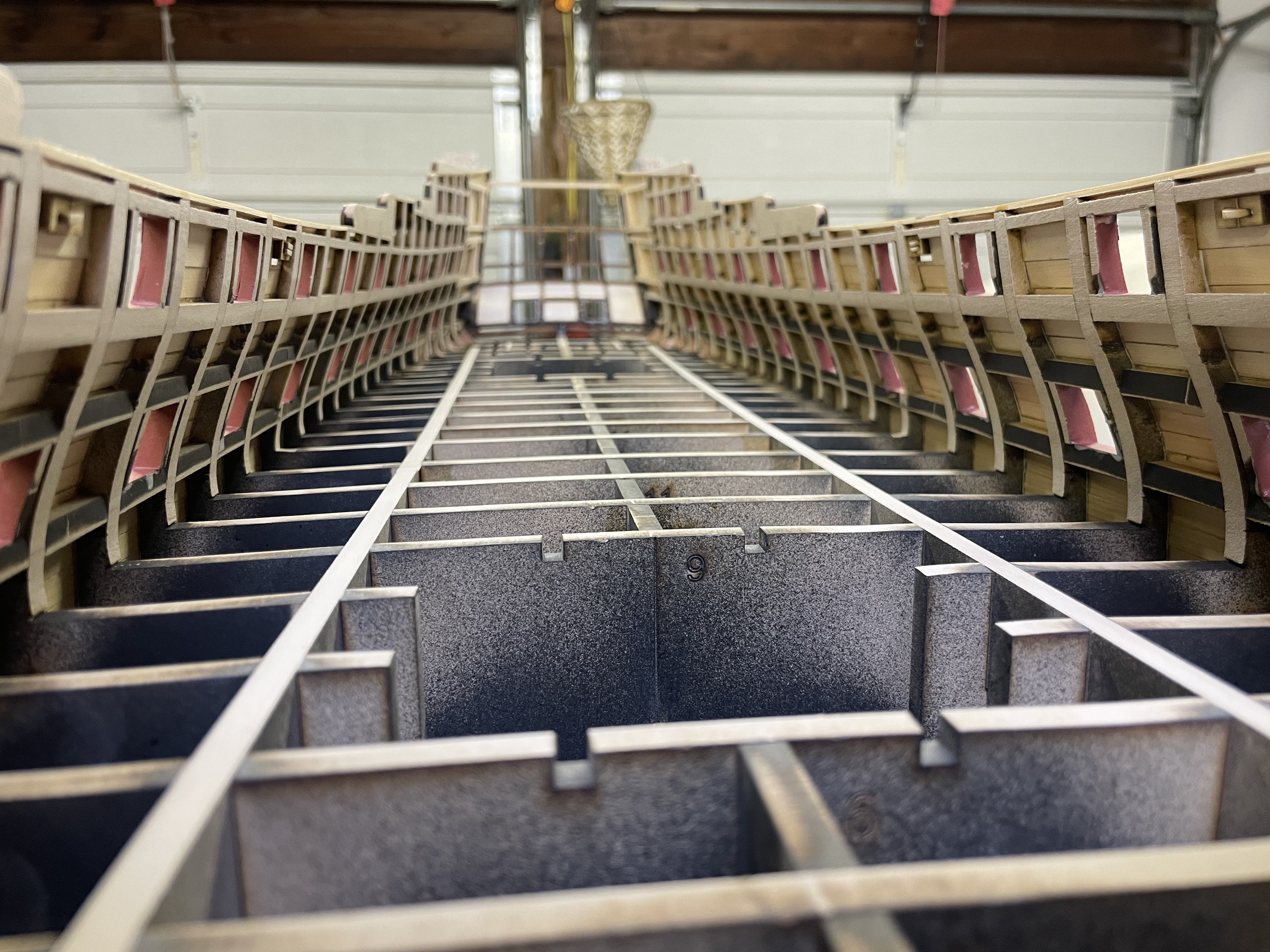

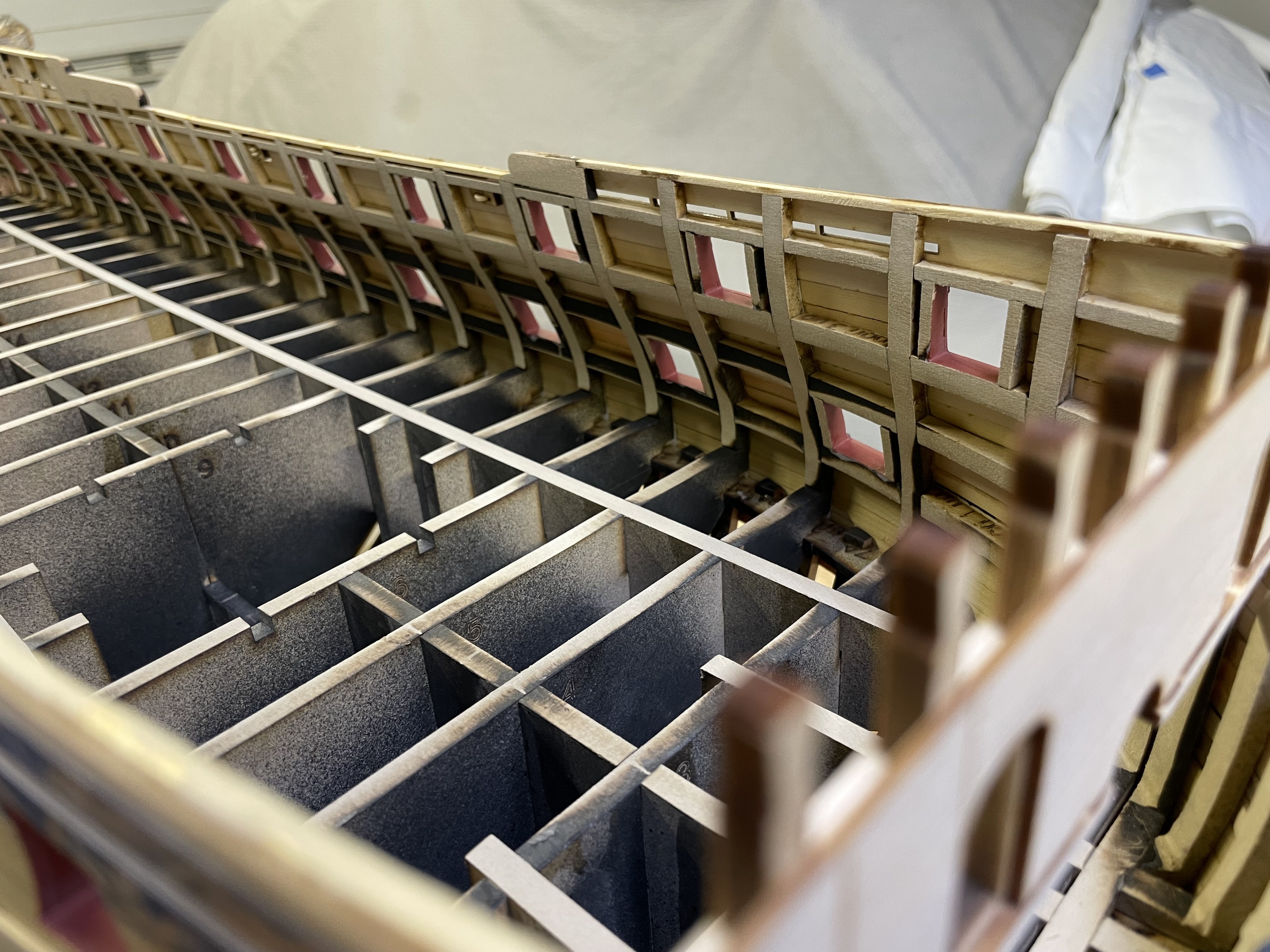

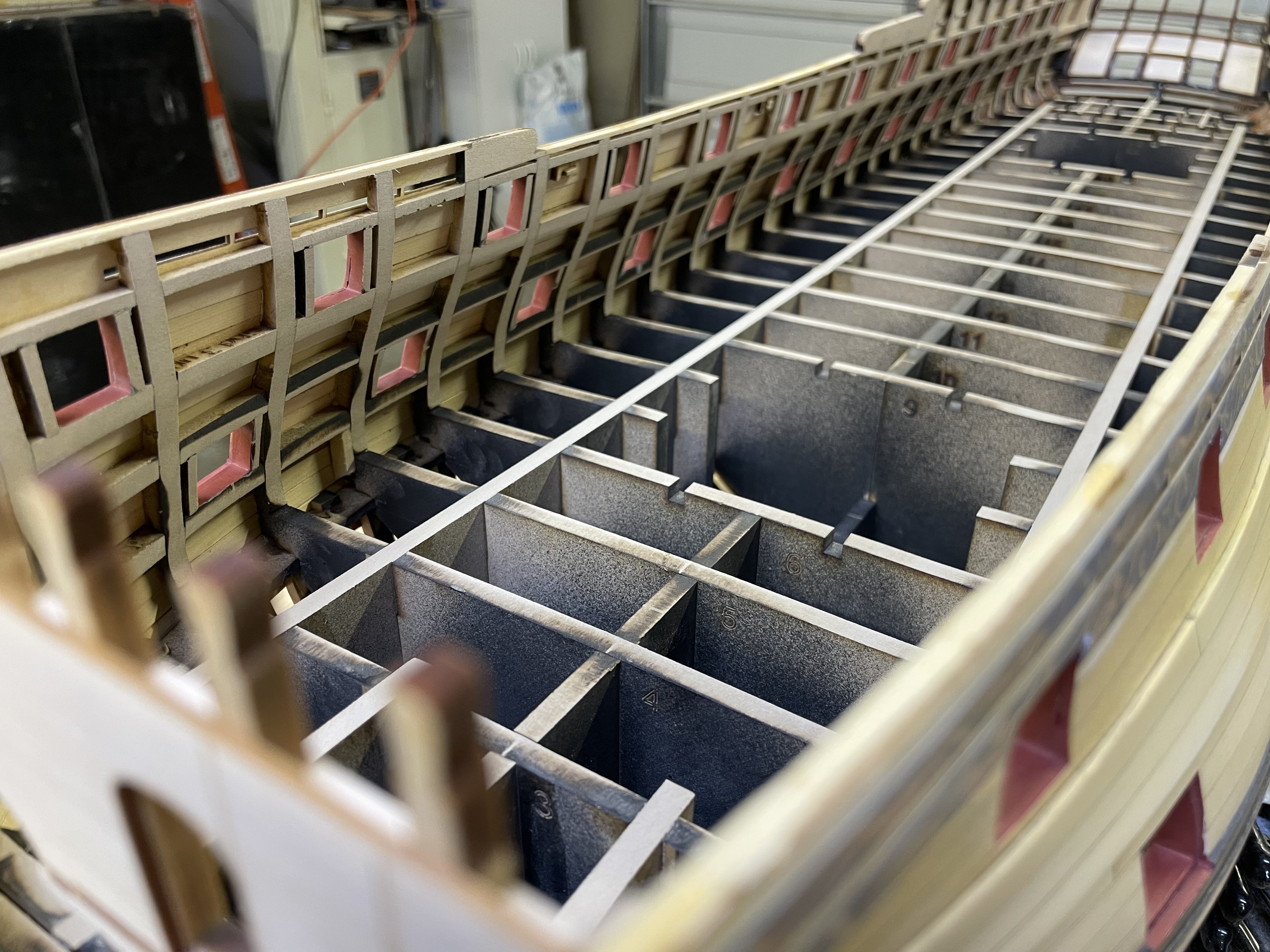

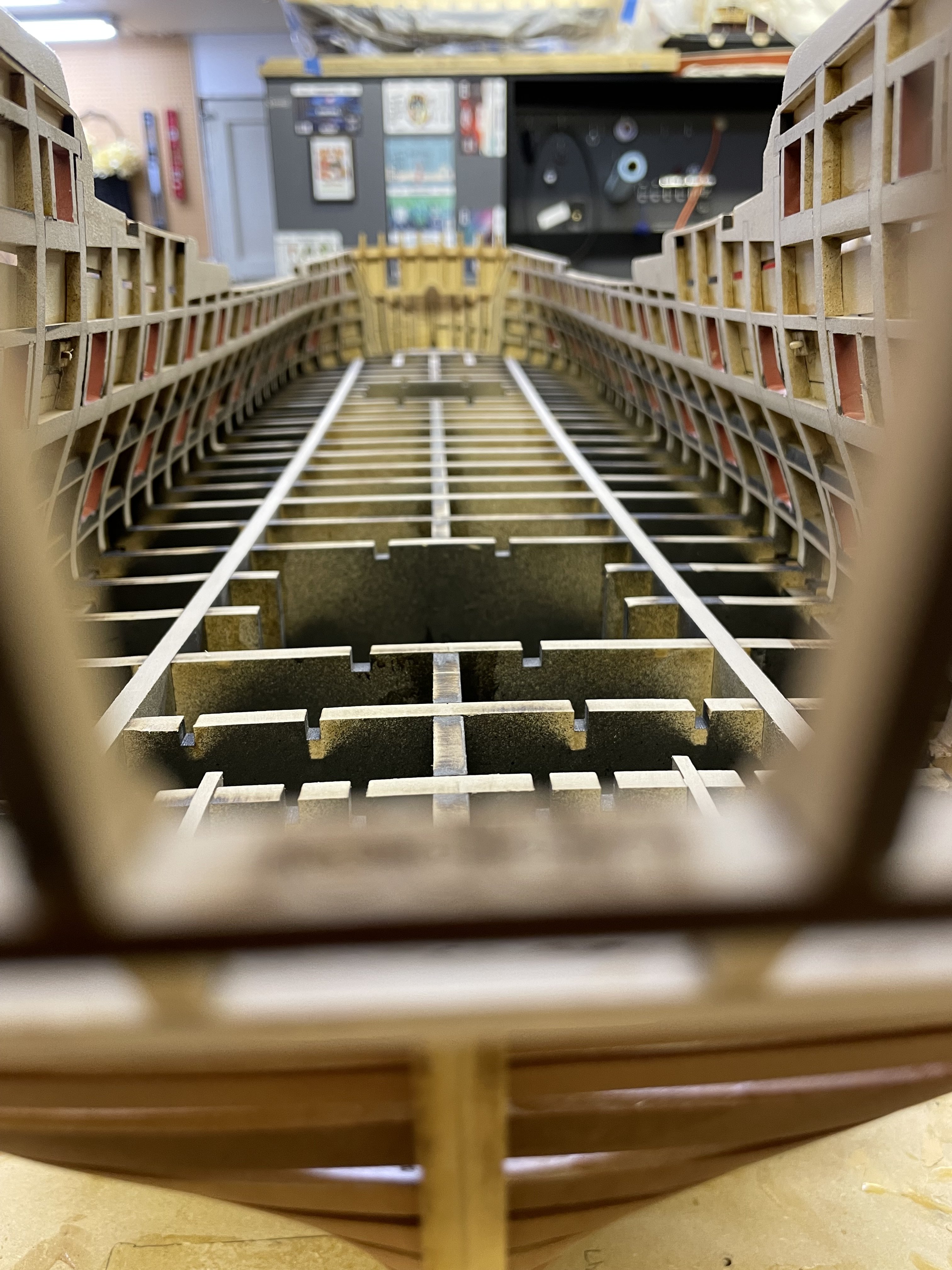

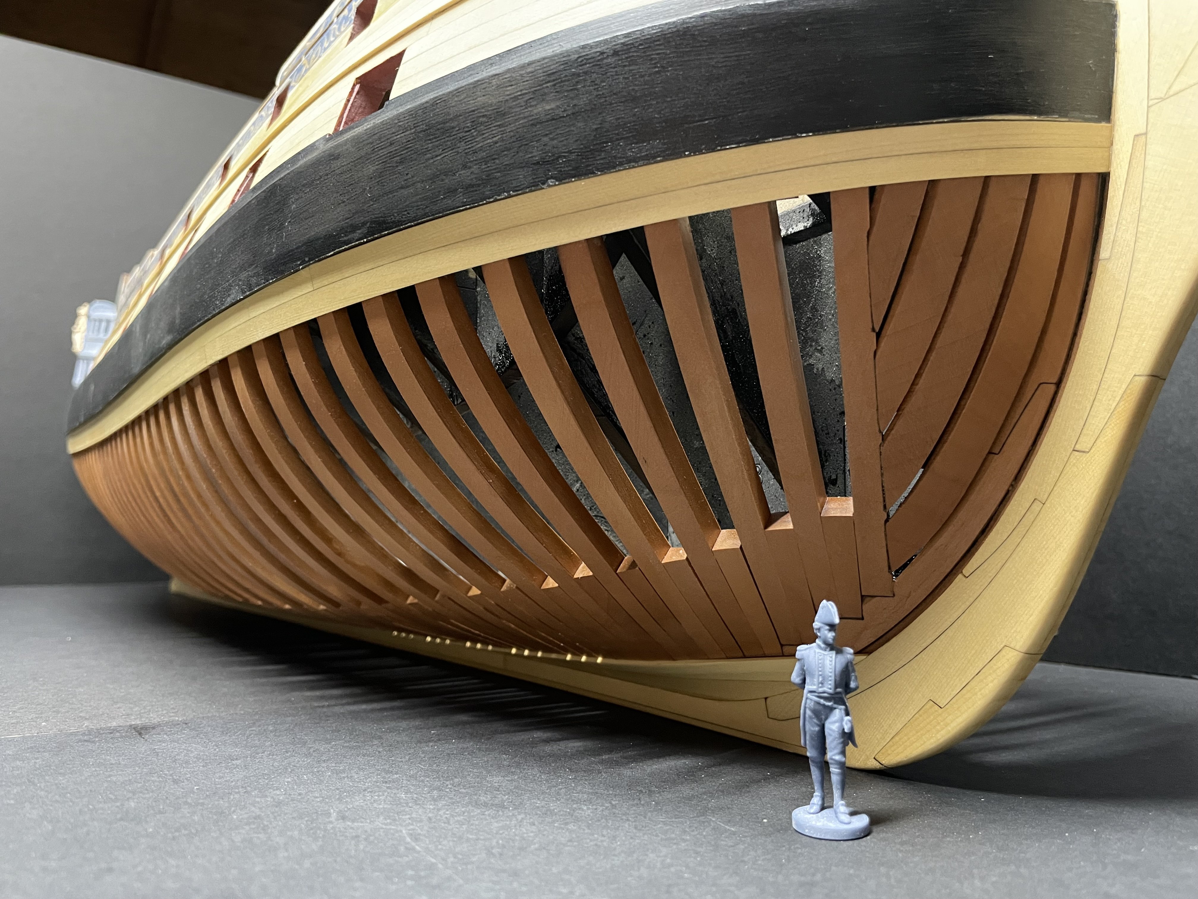

 I began fairing the inner hull, as mentioned earlier, the bow needs to be done first in order to install the beak head beam and finish the channel wales.
I began by cutting all the extension reenforcement hoops out with a small excel saw blade. MDF cuts like butter so this goes quick
from here I faired all the bulkheads down to the first hance piece. I faired enough of the bow aft of the beak head bulkhead beam that I won’t have to worry about coming close to that area then I finish fairing the inside.
Now I can complete the channel wale. But before I finish that I moved onto finishing the lower garboard strake plus an additional one. With this complete I could finally add some WOP to the remaining portside hull and frames. Moving on to finish the portside gunports now and finally the last strake at the channel wale.

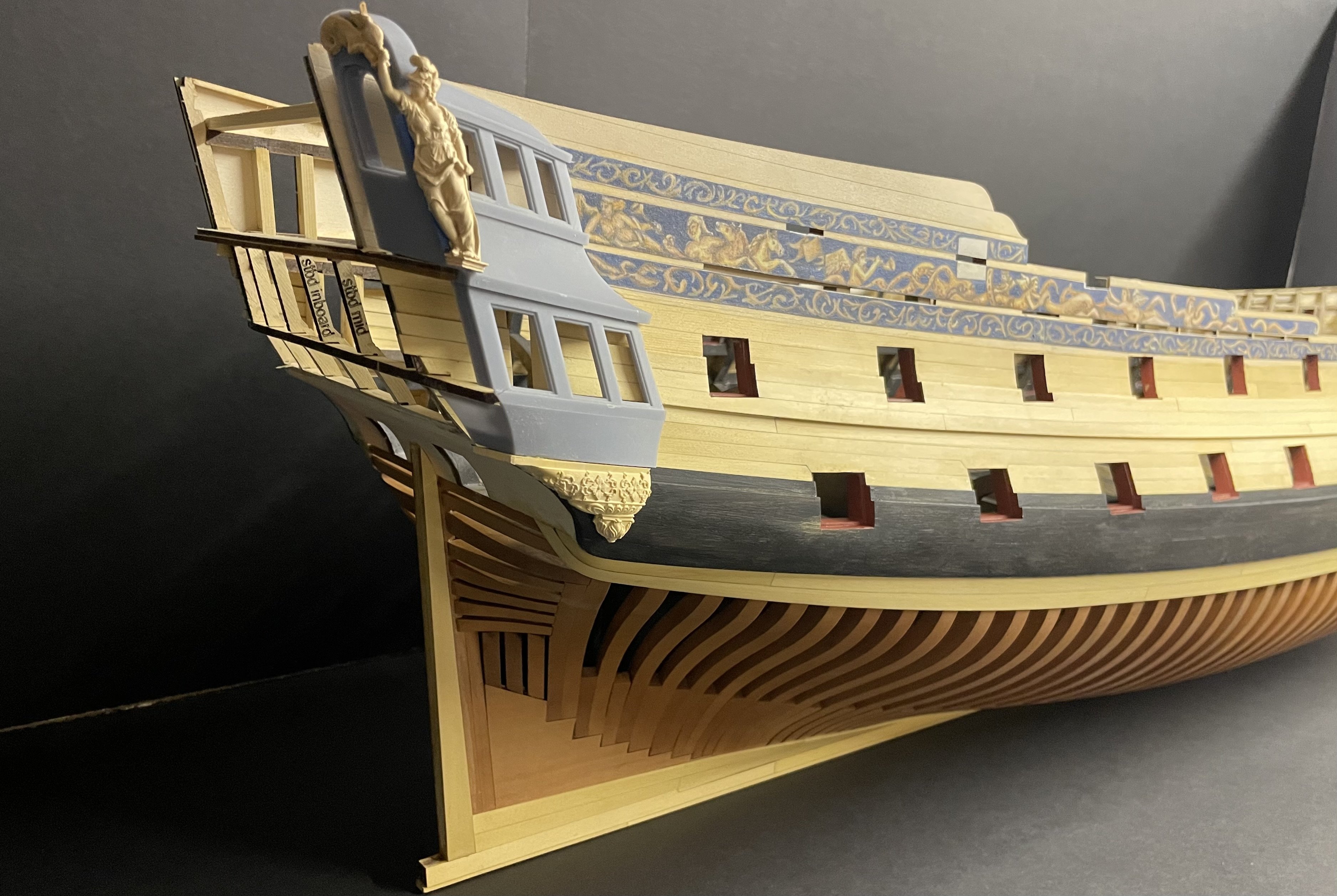

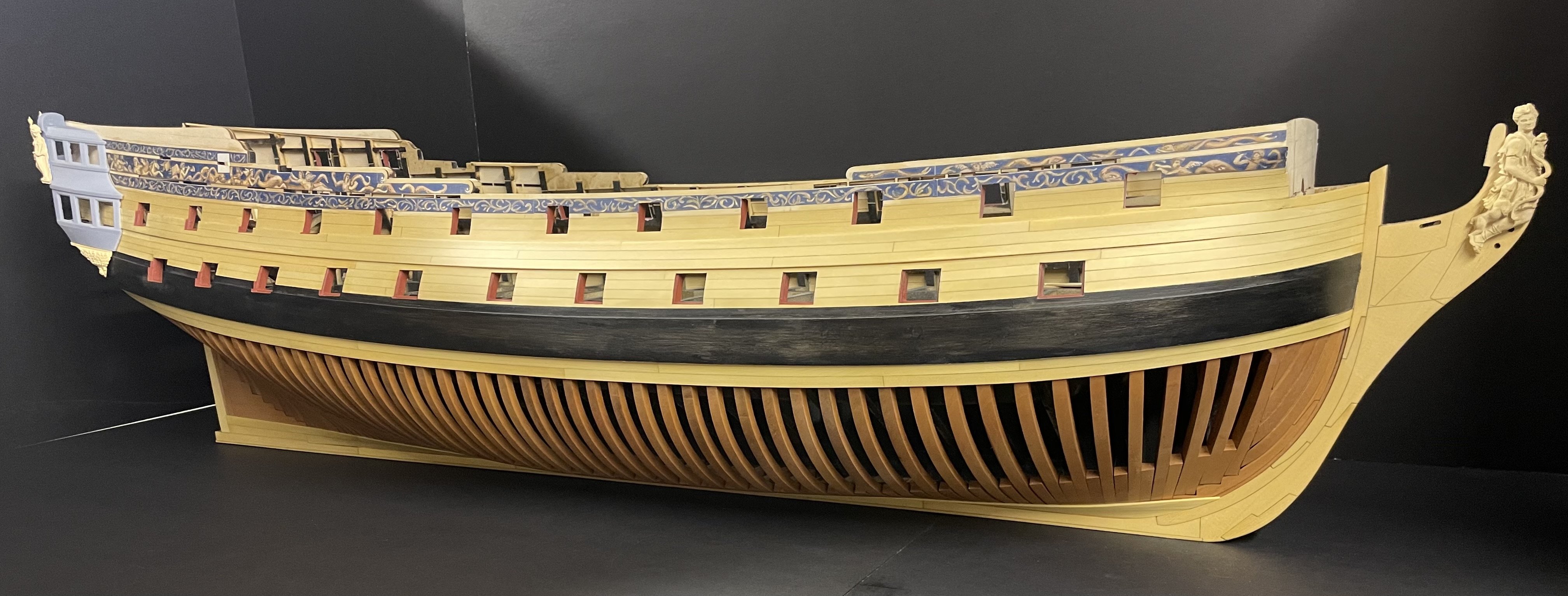

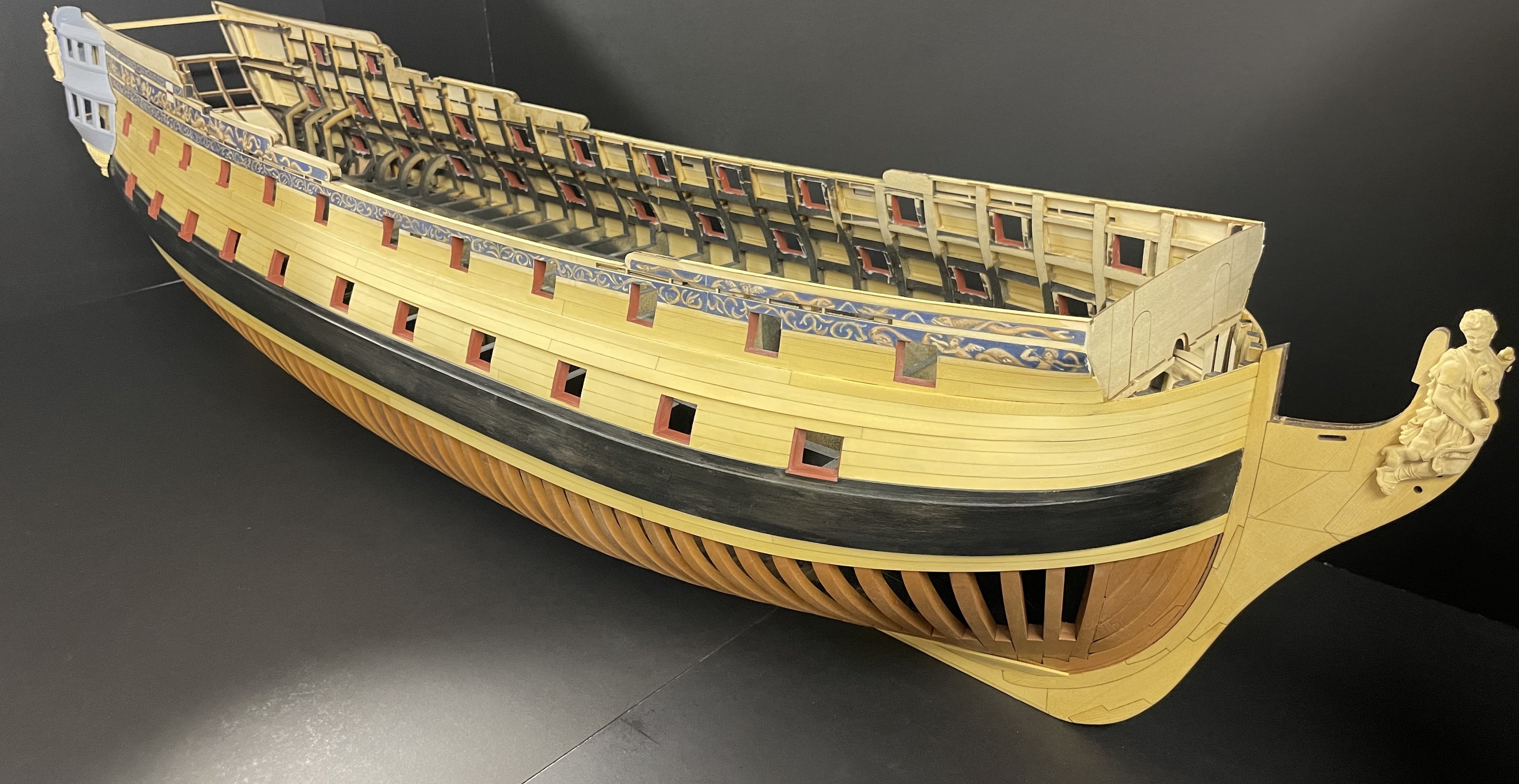

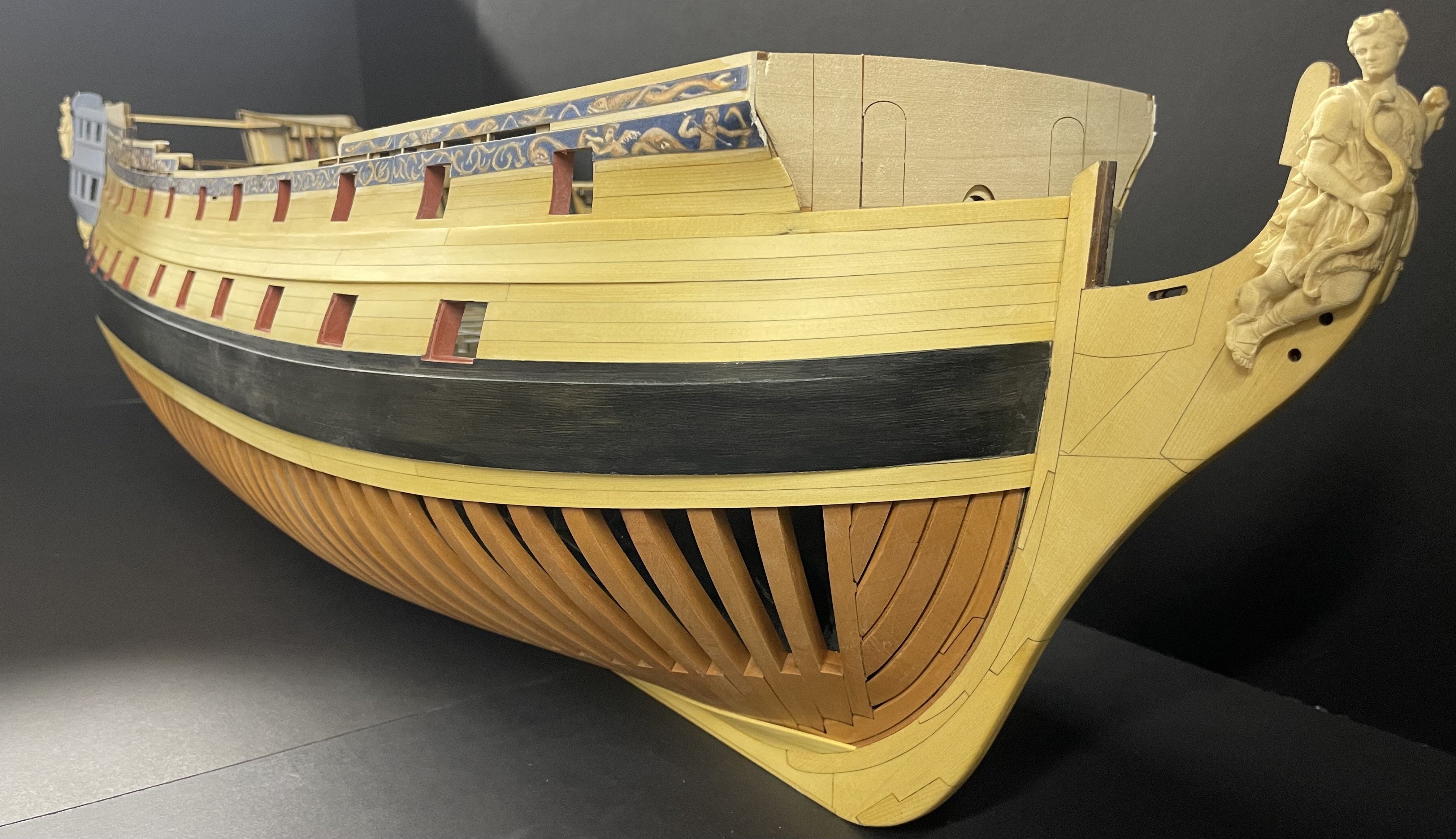

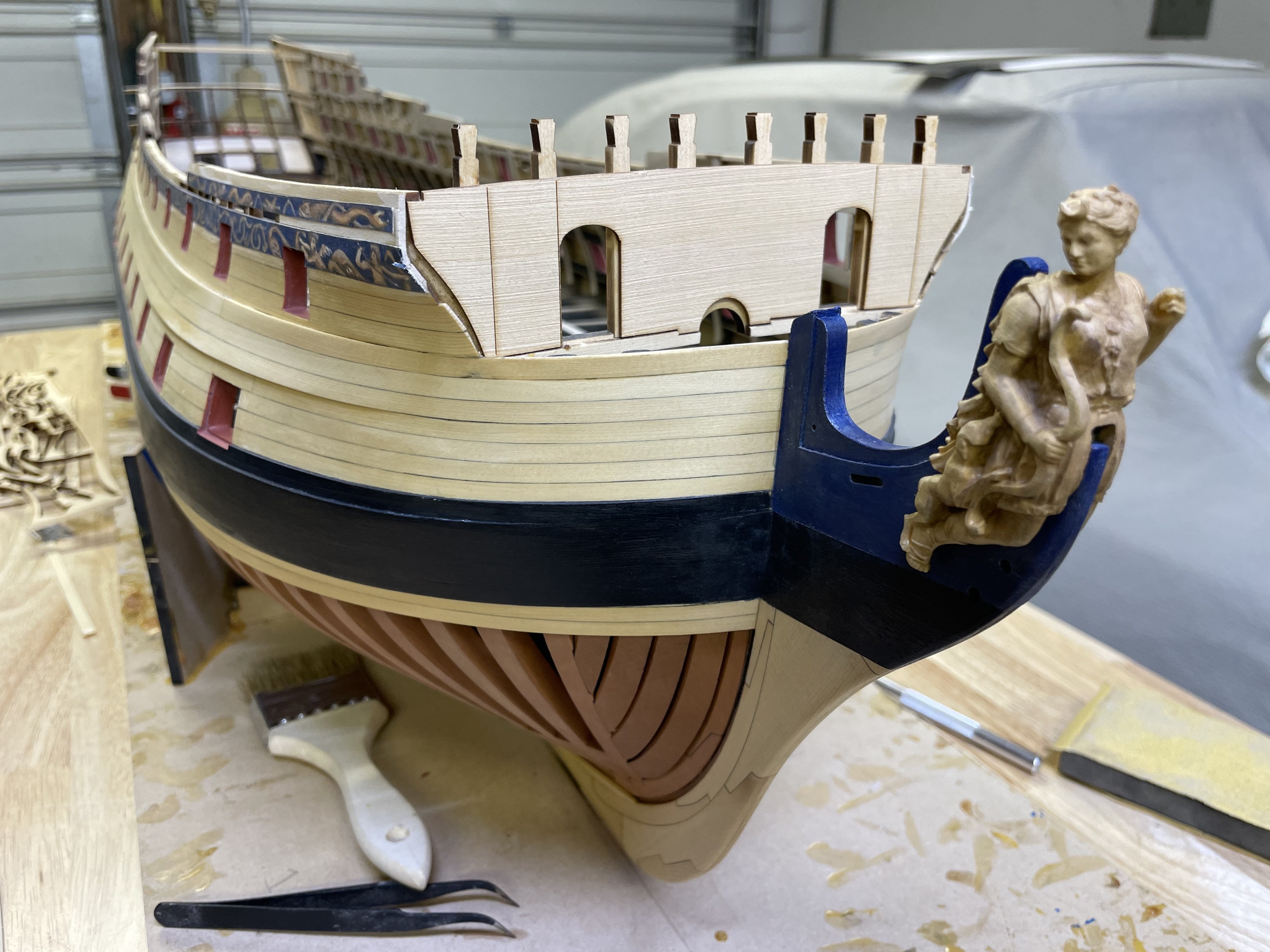

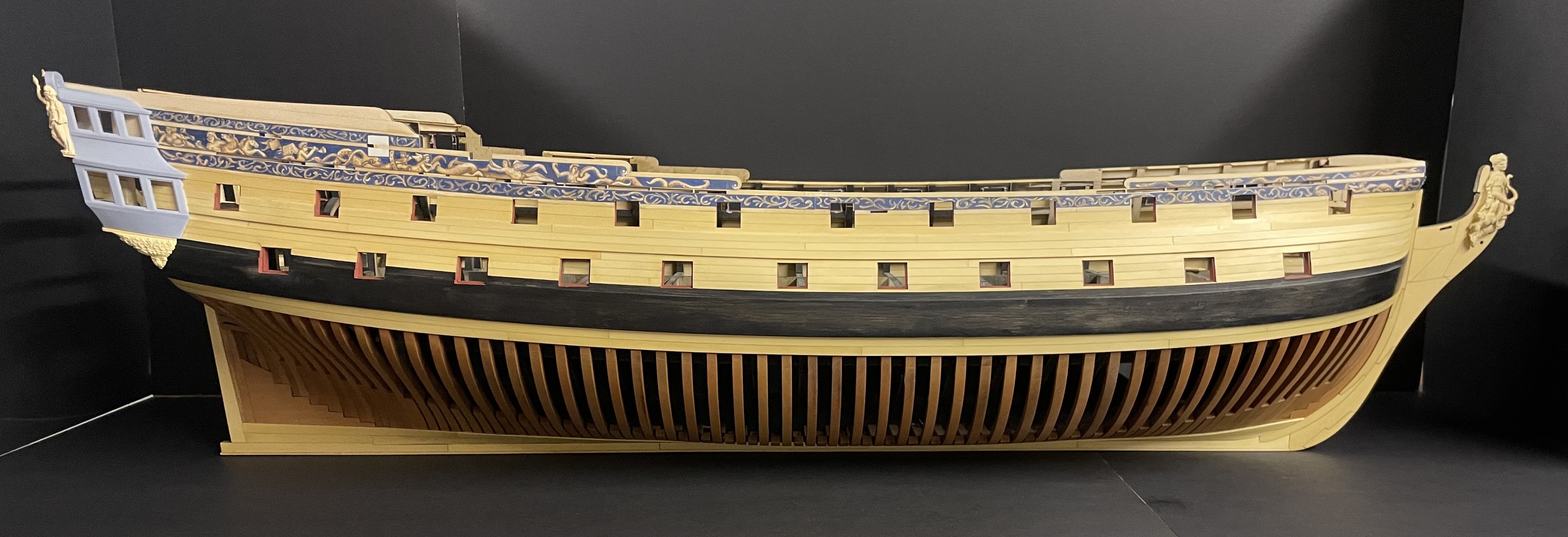

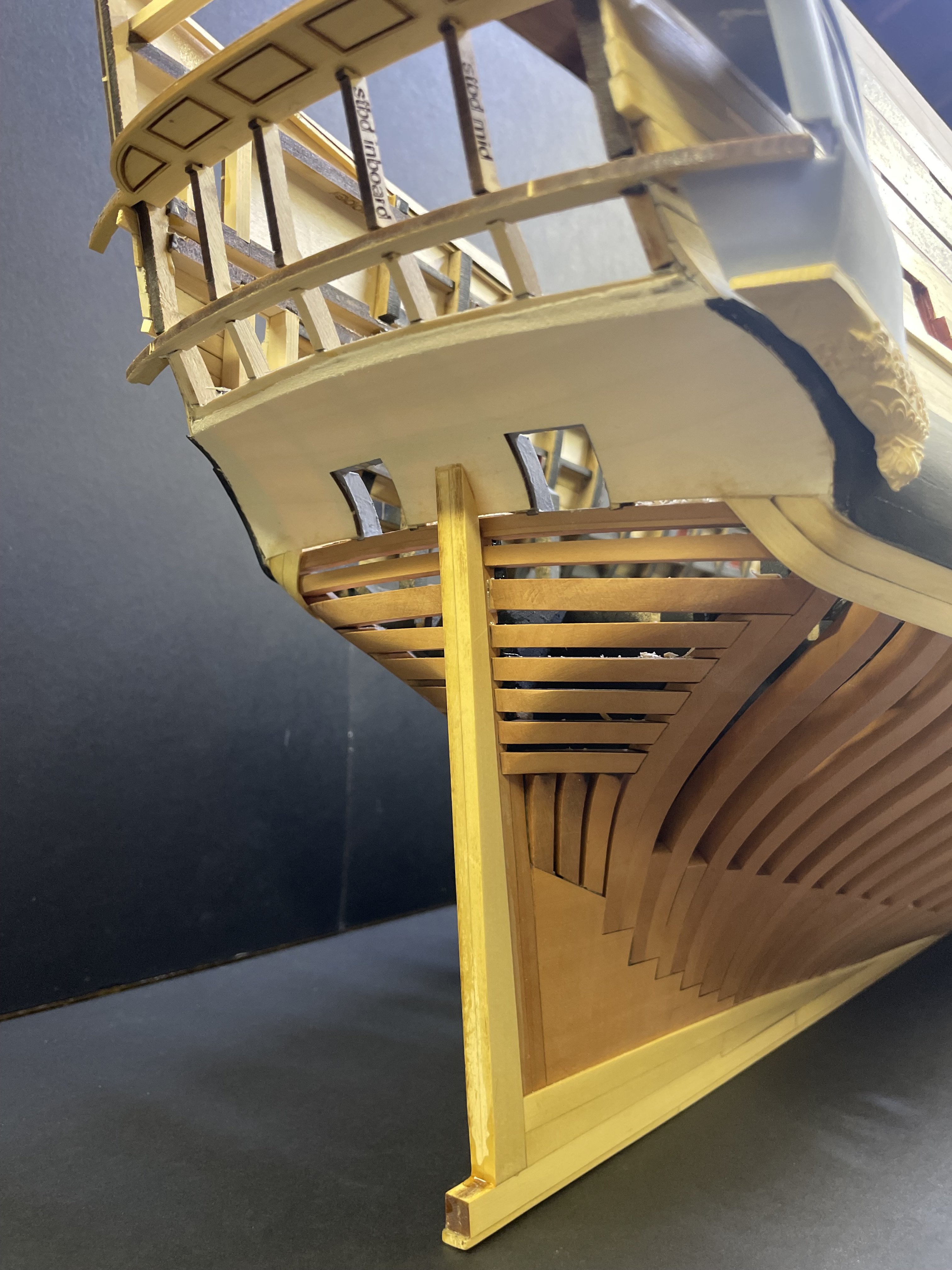

Almost done with Chapter 2, here’s where the model is at this point, warts and all!. A few more things to wrap up and I will begin fairing the inside and getting ready for chapter 3.
Edited by scrubbyj427
She's a beaut, JJ!  Very impressive model; can't wait to see what chapter 3 has in store.
Kenny

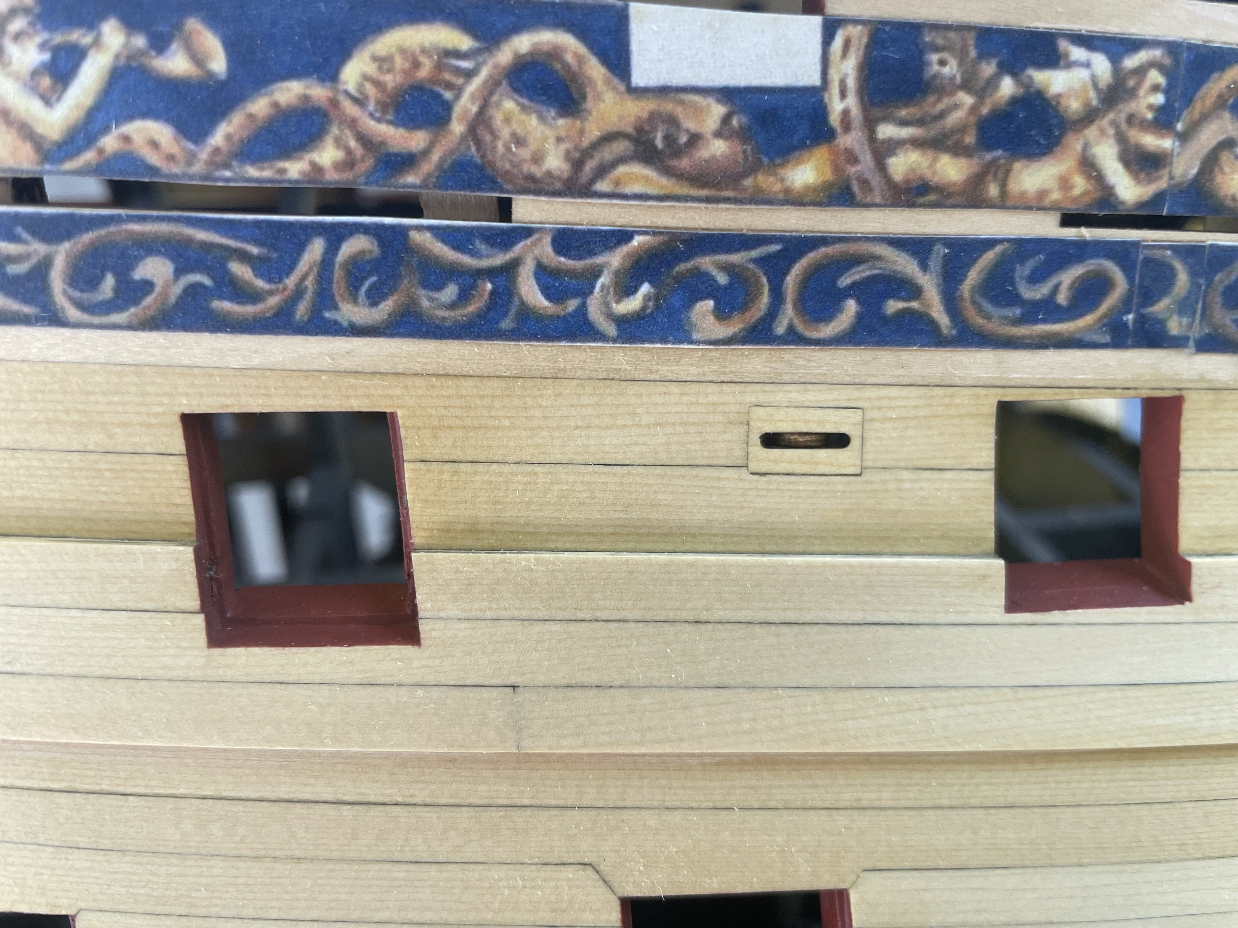

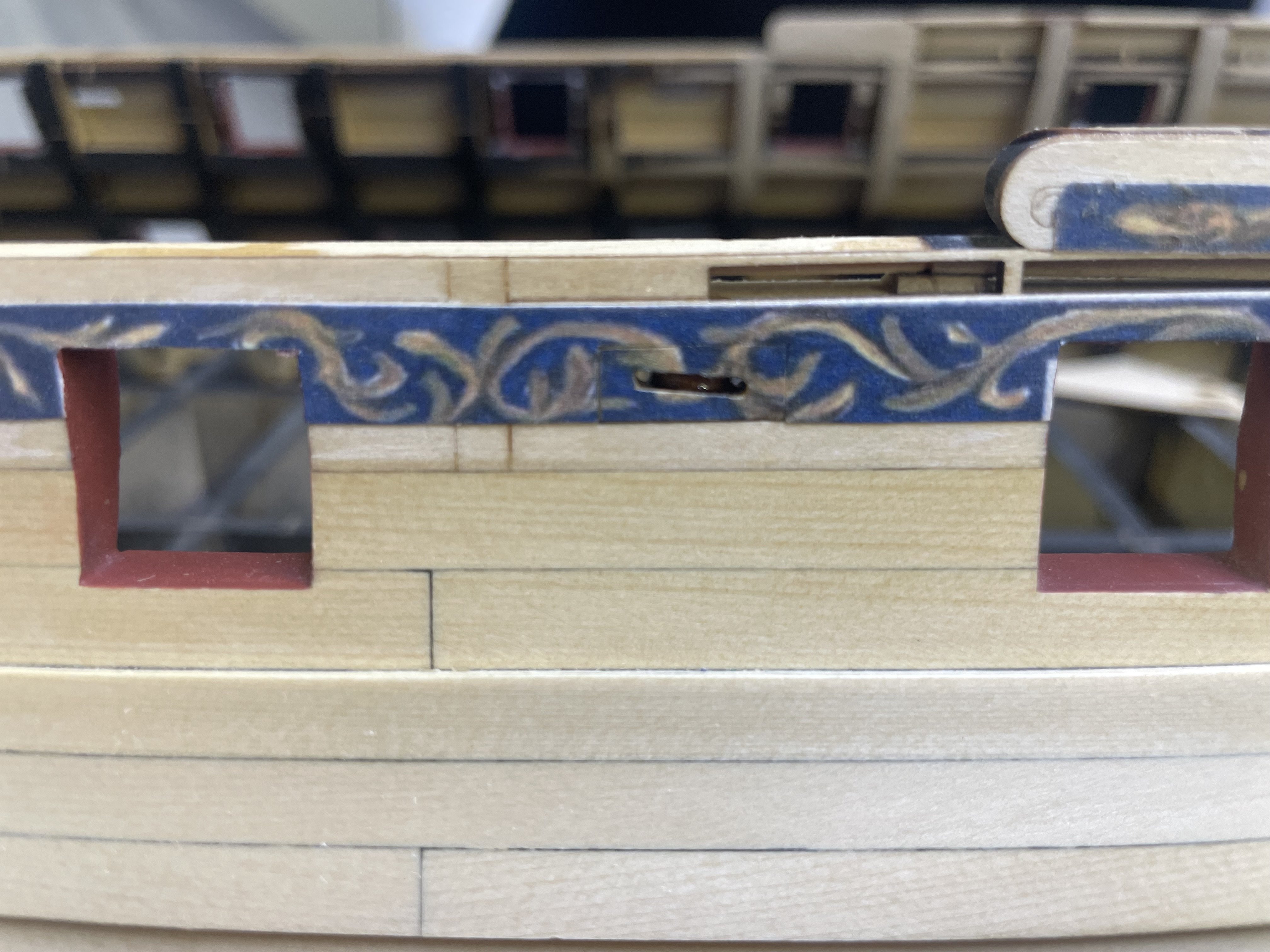

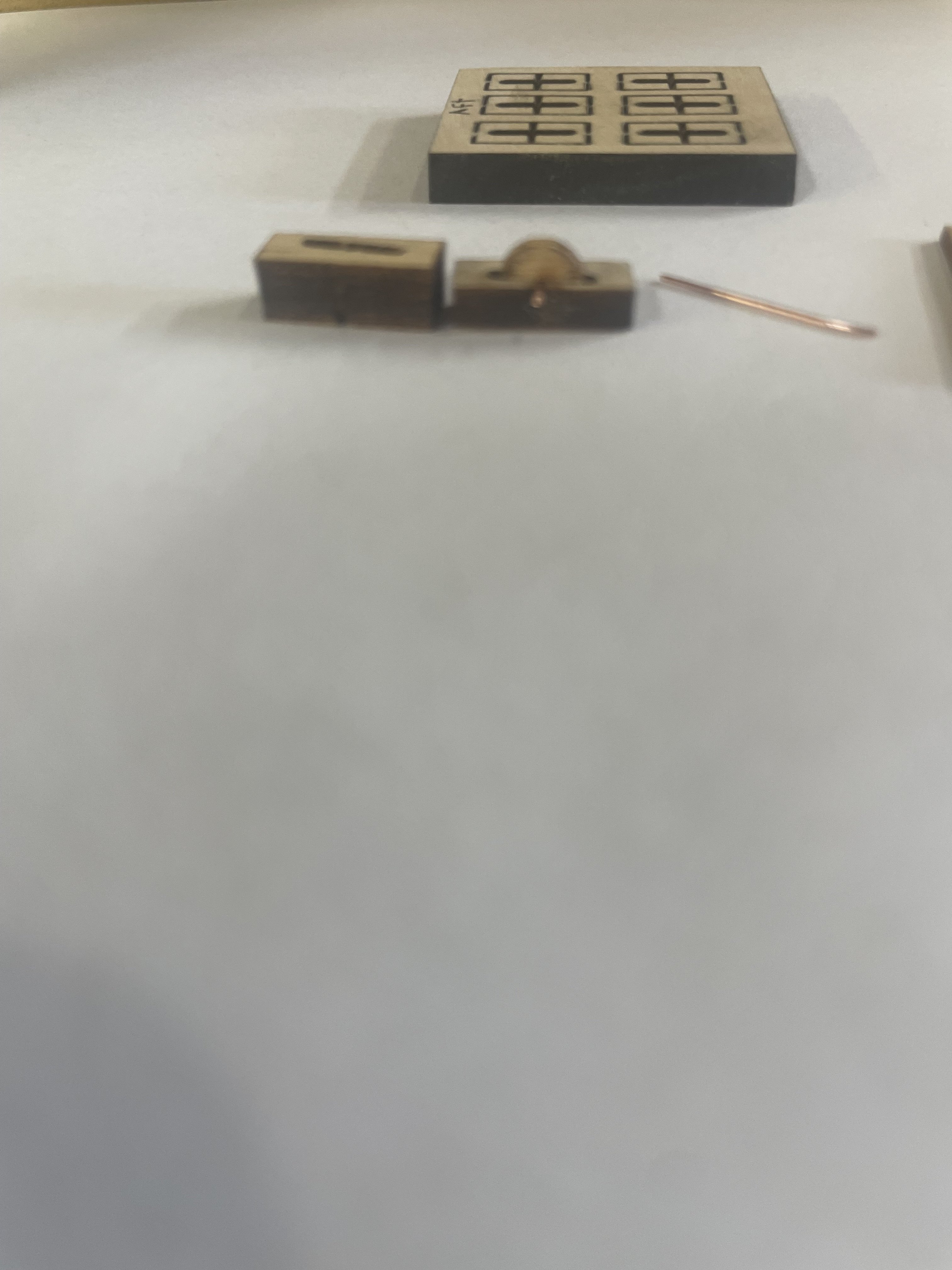

Adding the fixed blocks today, it’s pretty simple actually except for the aft one, there’s no covering up boo boo’s with a frieze on this one.

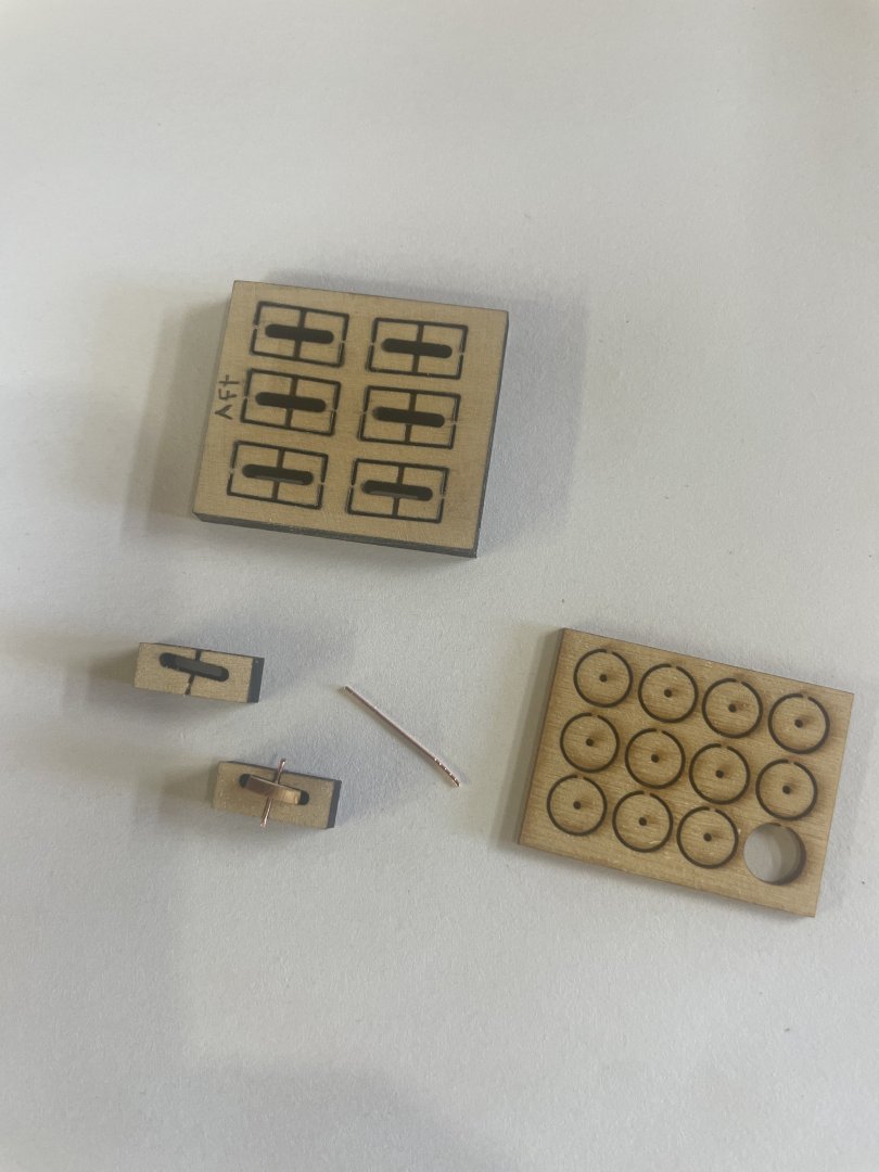

lets start with assembling the fixed blocks.

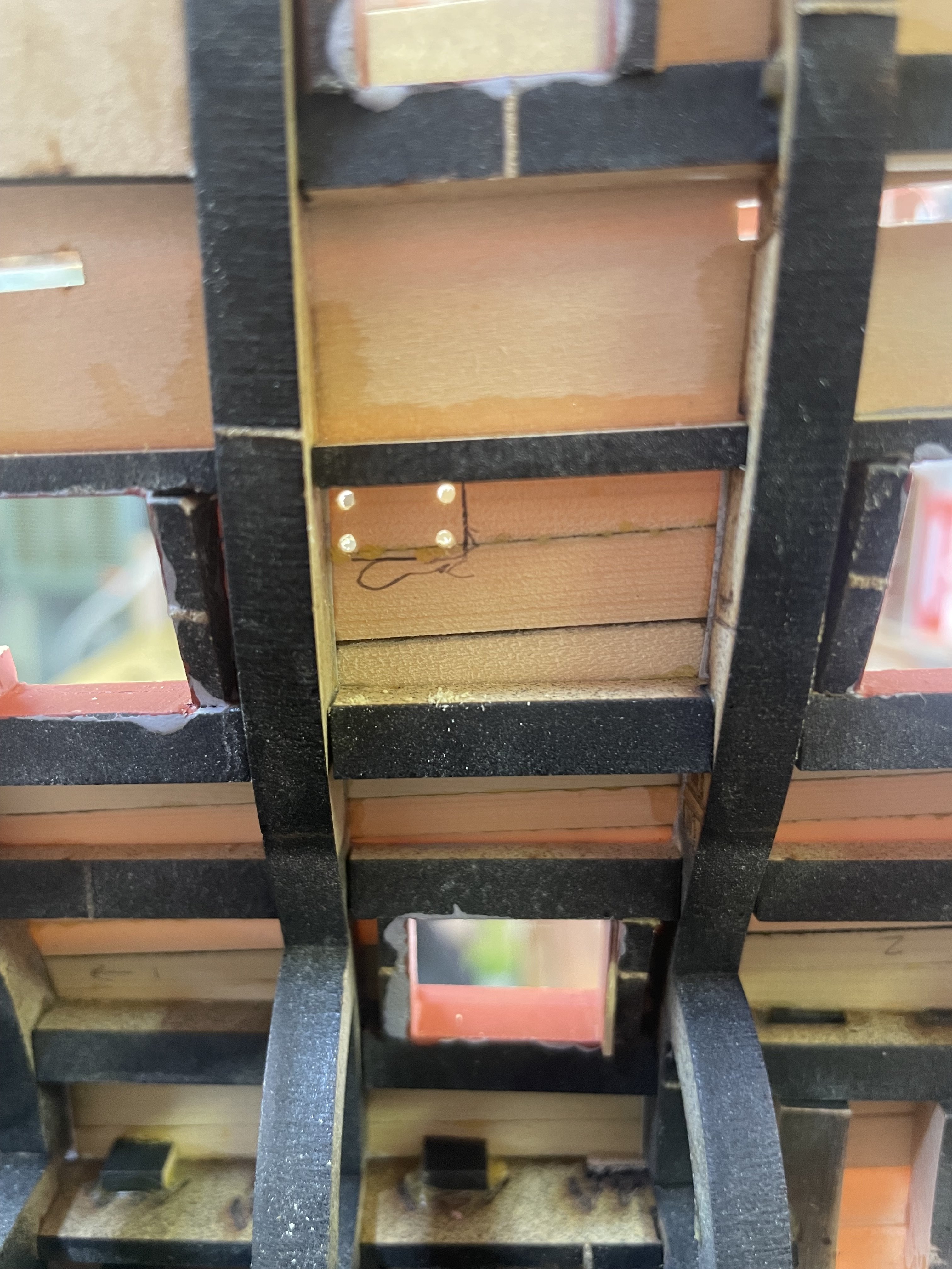

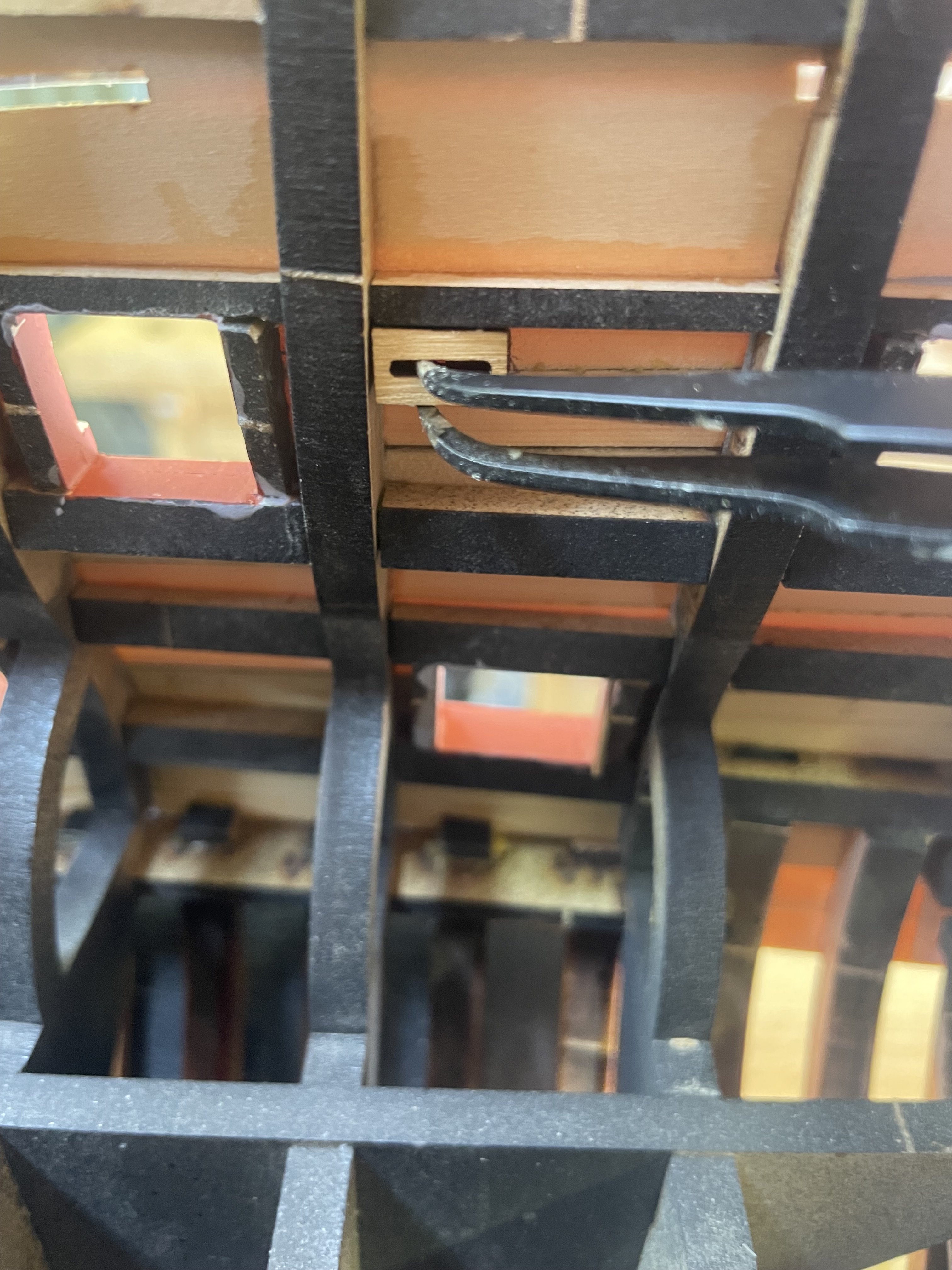

The fixed blocks come in two halves, you just need to select the one that faces out and assemble the roller and the axle to that half. From  there I sanded the out side down until it almost hits the roller
The idea here is that once we fair the inside of the hull and add the spirketting panels then we can install the other half of the block and fair it down to the spirketting. When faired properly we should be able to see the roller from  the inside as well. I’ll cover this more when we get to this stage.

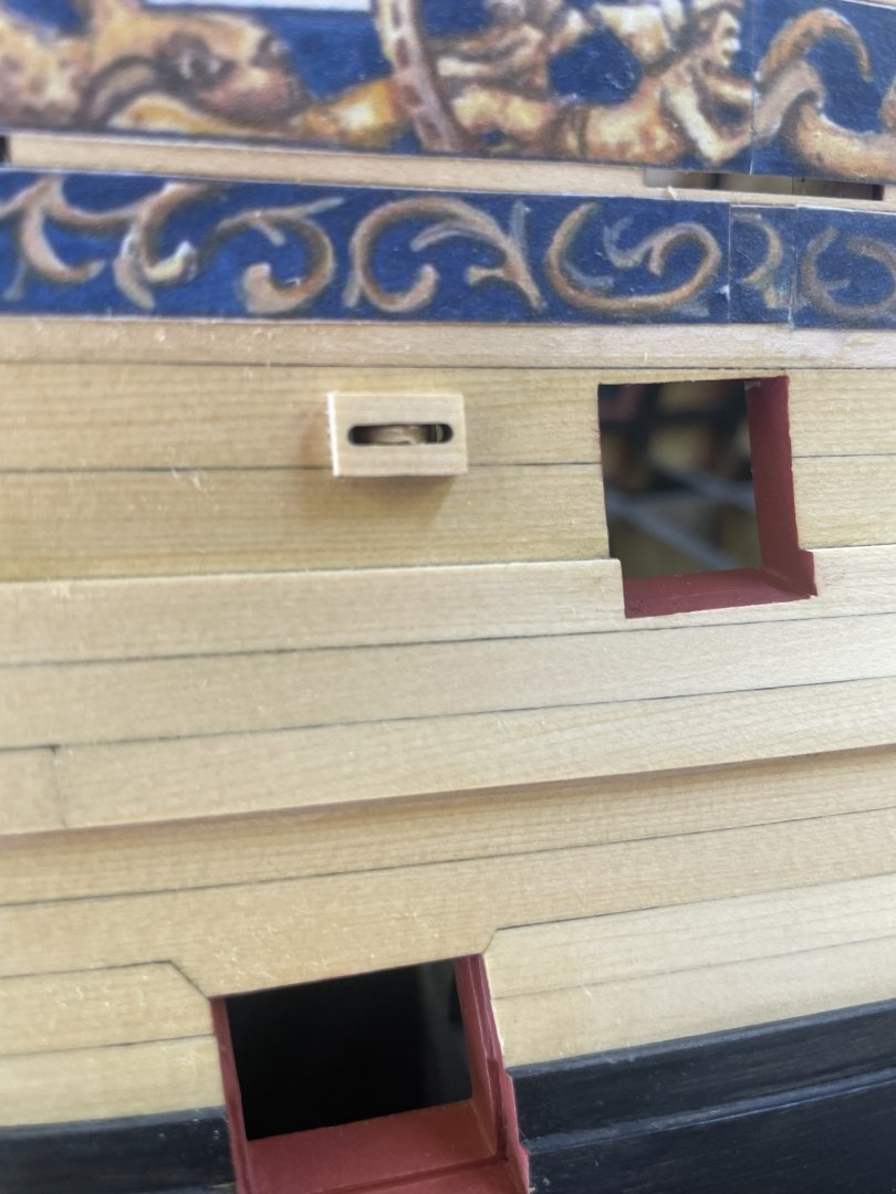

Now onto installing the fixed block half, I started by marking where it goes, it’s important that we place it in the corner of all the structure, it will help in the future when the laser cut panels go in on the inside IMG_9961.thumb.jpeg.a05611eabe1030ba81369a6ca9c5d7c2.jpeg
I then traced it with a pencil so I could see where to make Some small holes
from there I just opened up the hole very slowly and tested the block over
and over again until it had a tight fit.
here you can see it from the inside with the roller in place, this will also help you when fairing the inside, once you get close to the roller you’ll know you’re done sanding!IMG_9964.thumb.jpeg.9cbfe4fc8b91ad4b791888d2b3a74edc.jpeg
once it fit well I glued it in place and then carefully flush sanded it to match the hull then covered it up in some wop so it matches the rest of the planking.

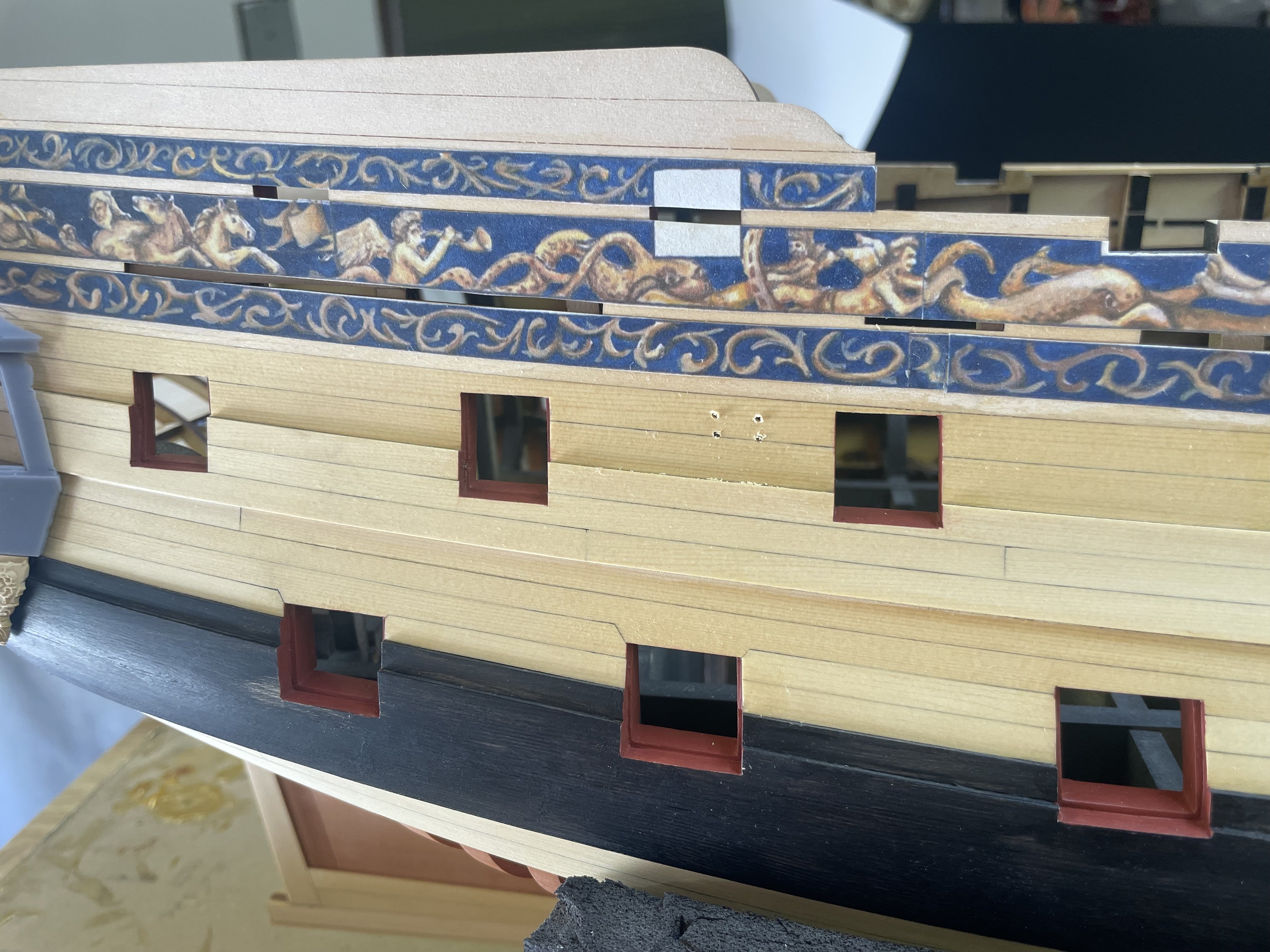

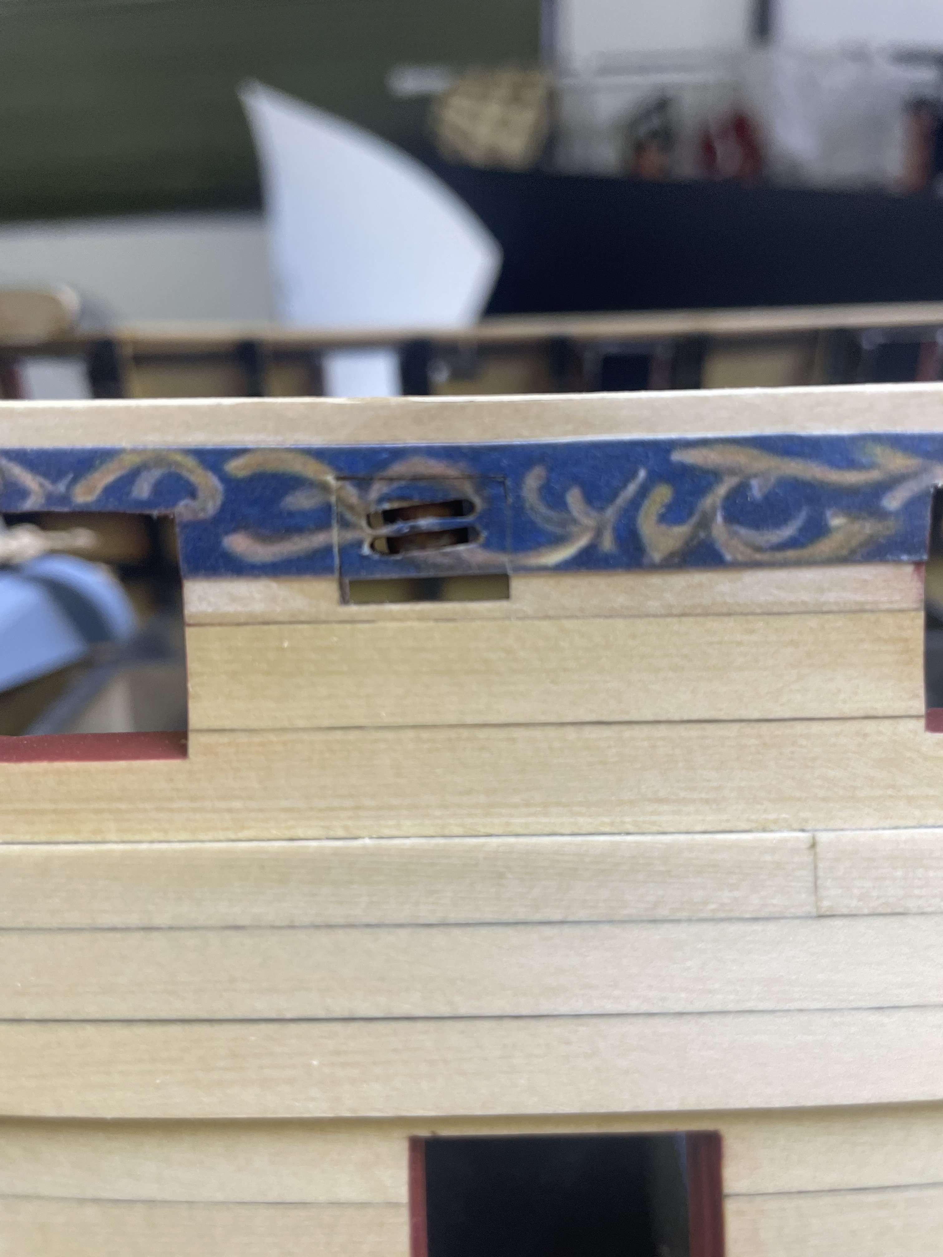

the rest of the fixed blocks are pretty easy, they just need to be fitted into laser cut holes in the frieze panels.
i carefully cut the frieze piece free from the hole and glued it down to the top of the fixed block and then opened it up with a #11

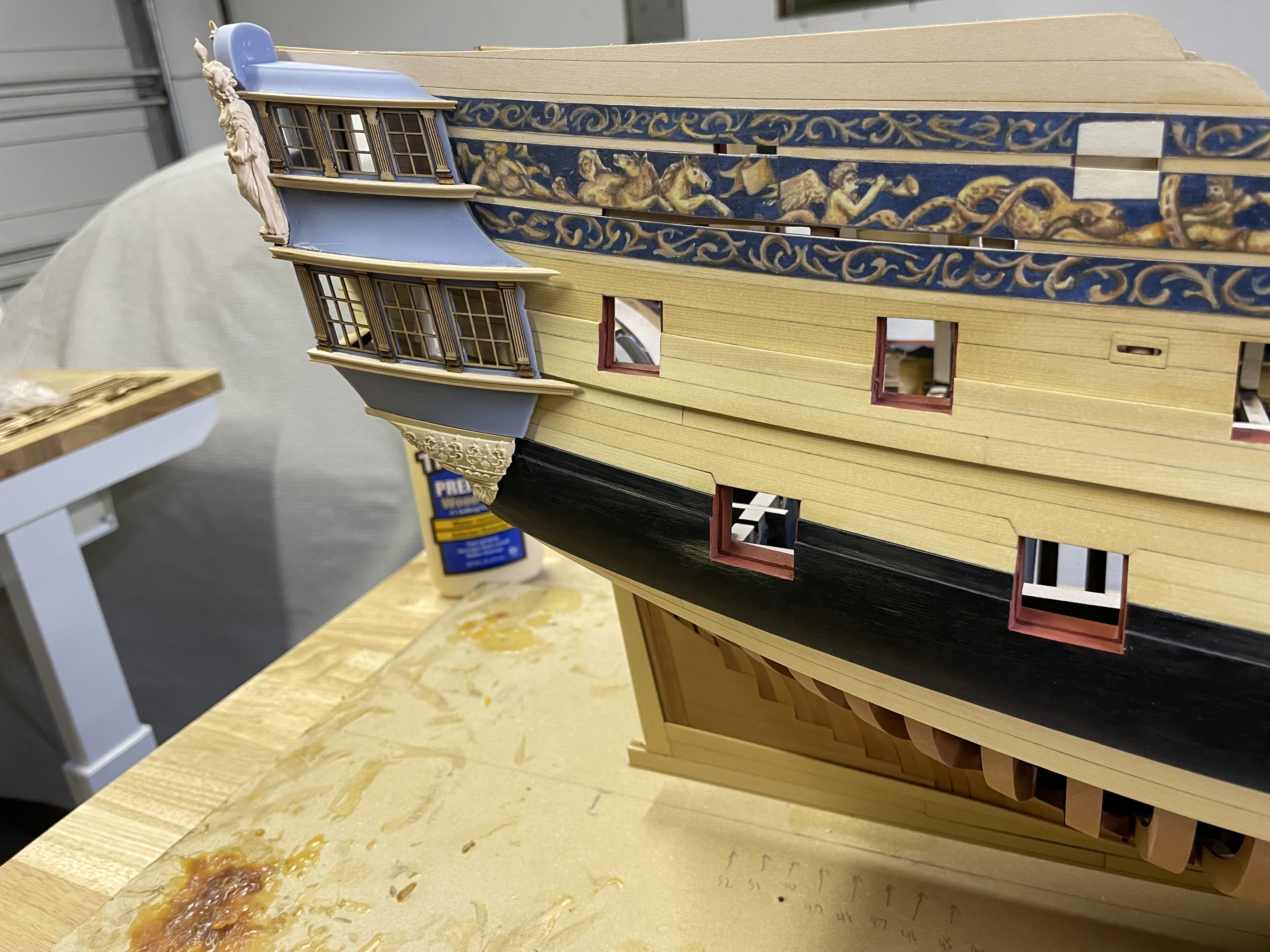

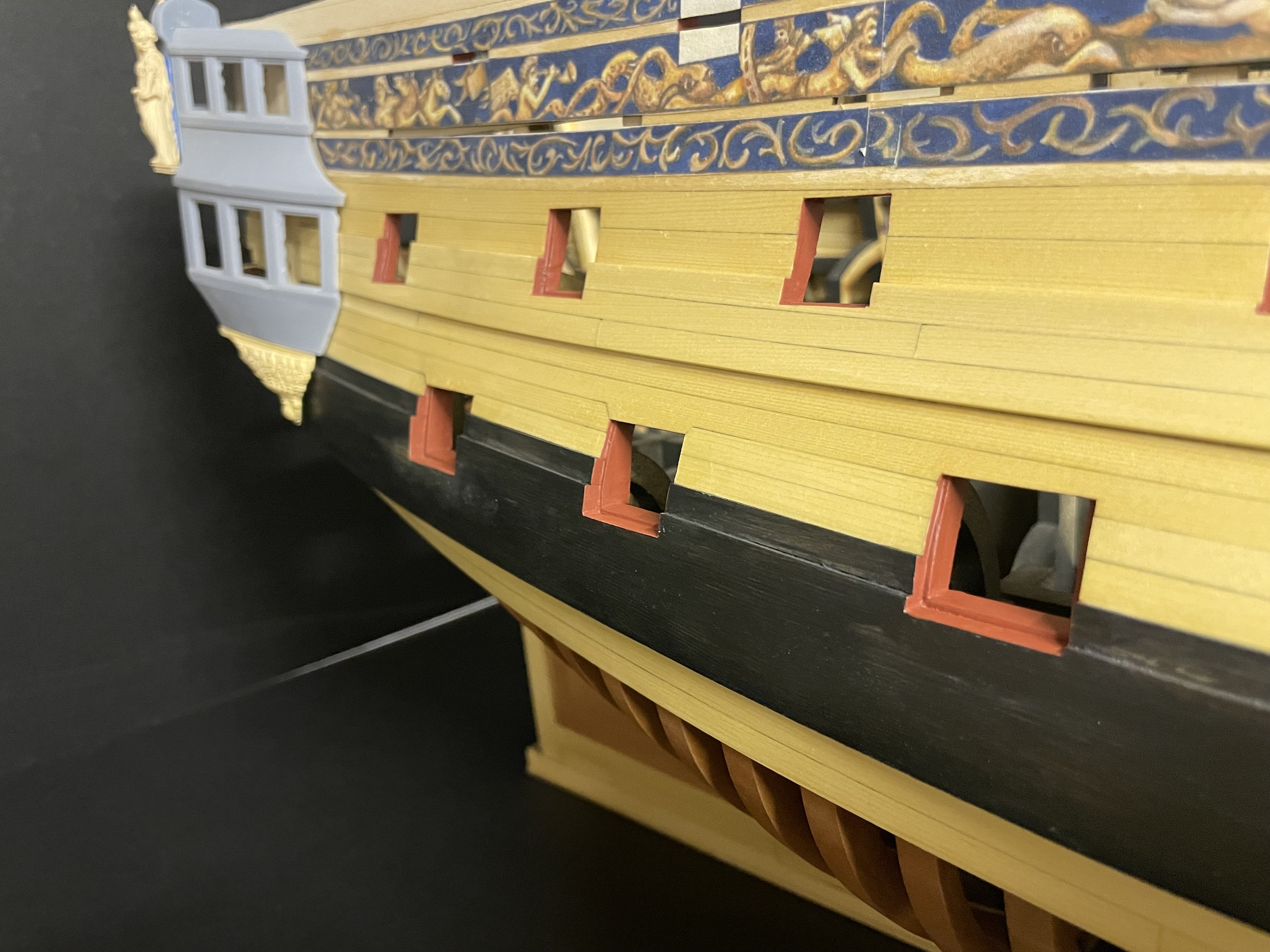

The end of chapter 2 or the beginning of chapter 3, however you want to look at it…is just a bunch of sanding. So that’s what I’ve been doing the last couple days. A little paintwork at the bow and some playing around with the beak head parts.
In the meantime I’m printing a revised QG prototype and hope to have a set of them  bolted on later this week, installing and outfitting the QG’s will
be the bulk of chapter 3, along with some other exterior details. More to come soon.

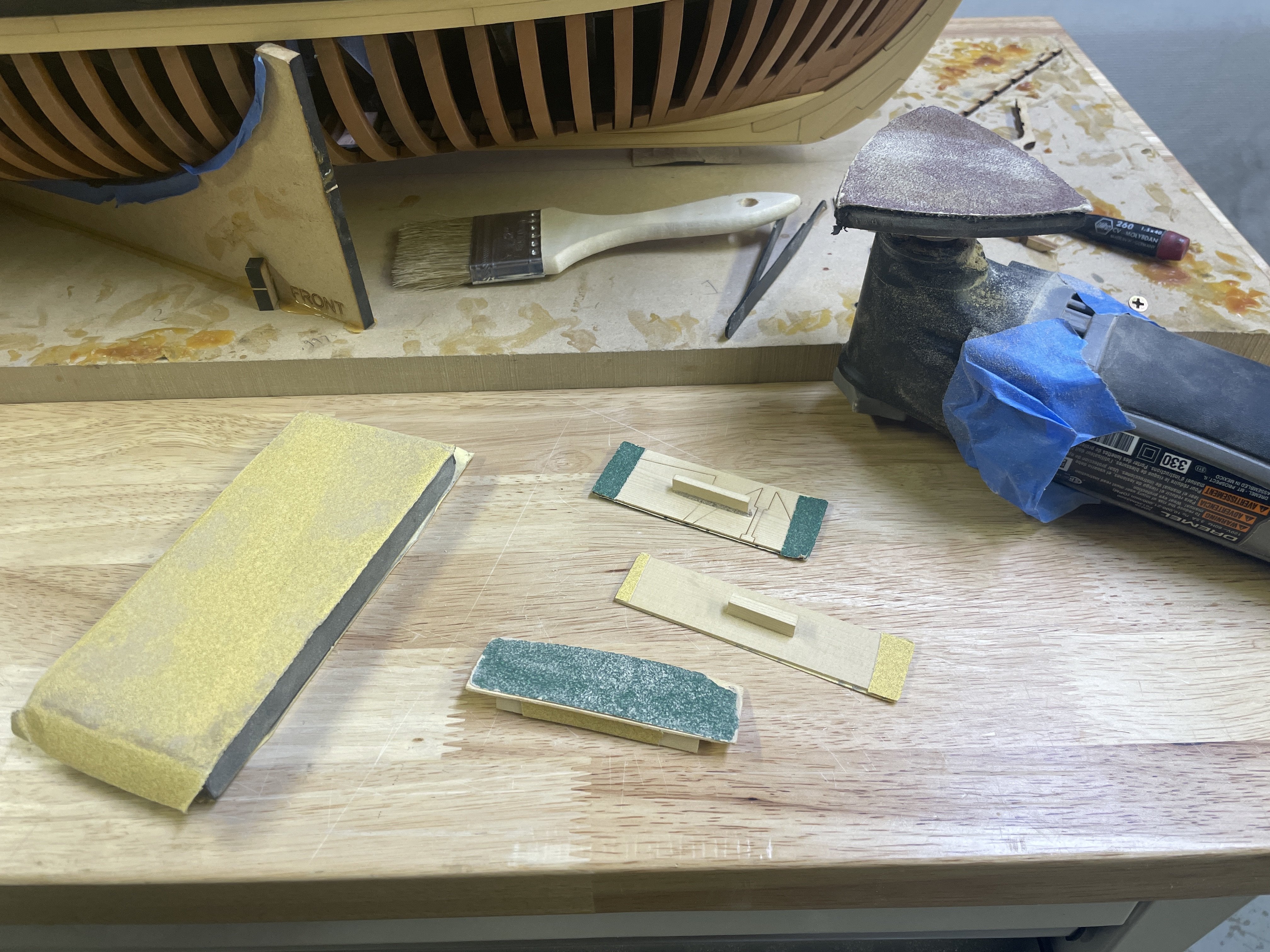

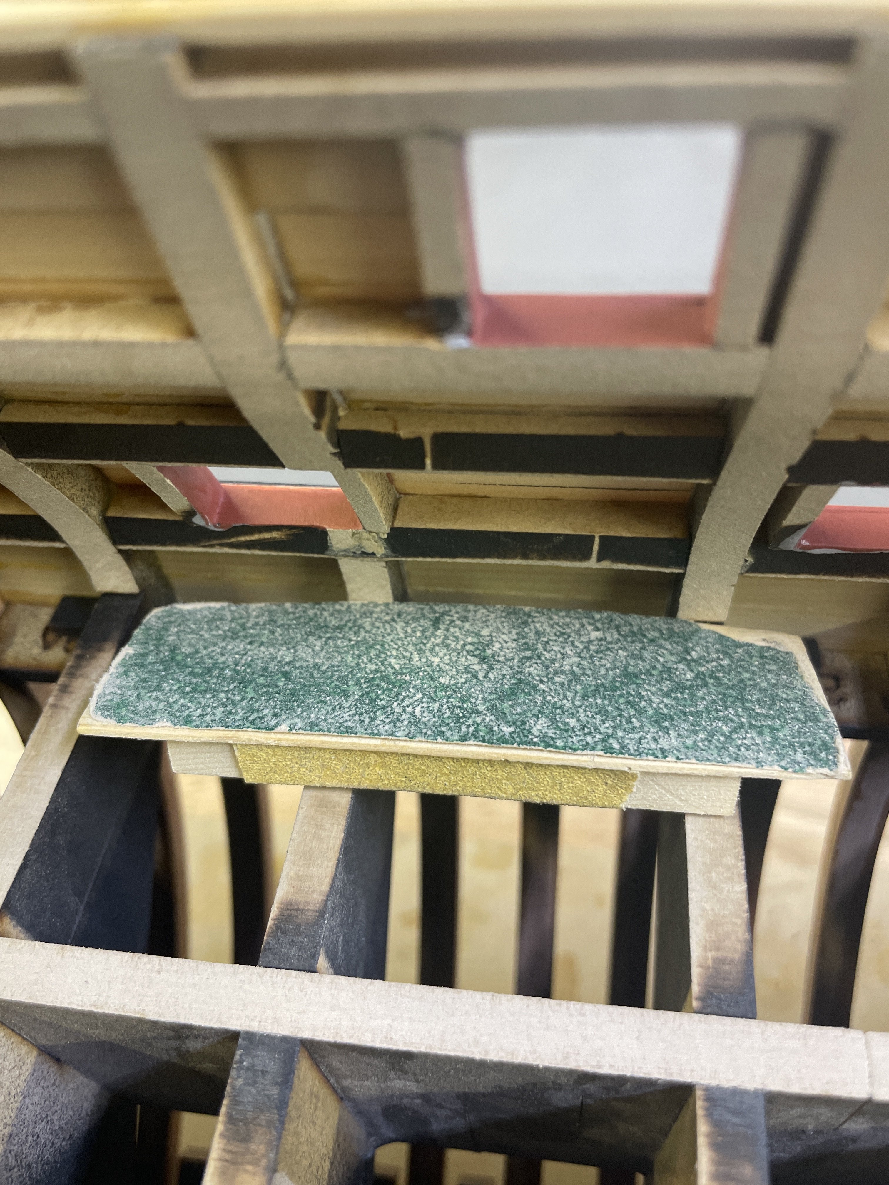

5 hours ago, woodartist said:

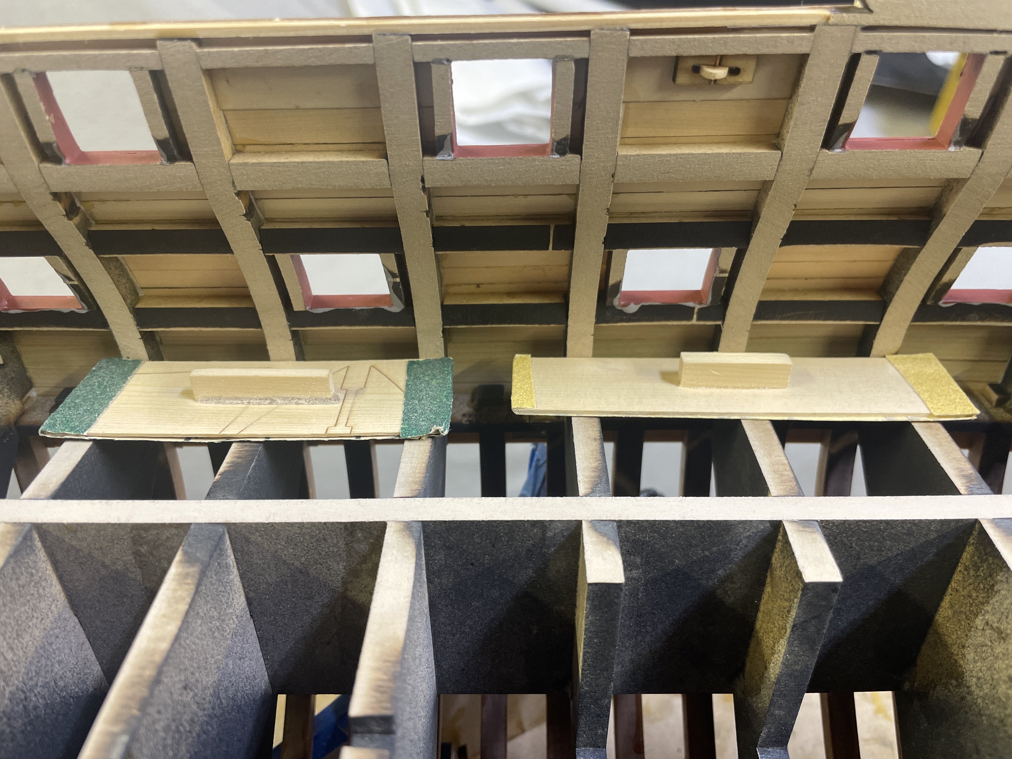

that is a lot of sanding, what did you use to get it so even?
I start with one of these wonderful dremel tools (everyone should have one) and then move on to a series of thin little block s that I make. And I finish out the gun deck level with this wide foam block that I used on the hull. The little thin sheet blocks are wide enough to span three bulkheads so they keep things even but they are flexible enough to not dig holes.  The curved one helps with getting down to the bottom of the extensions, the little pad with lighter sandpaper helps you keep a grip on it.

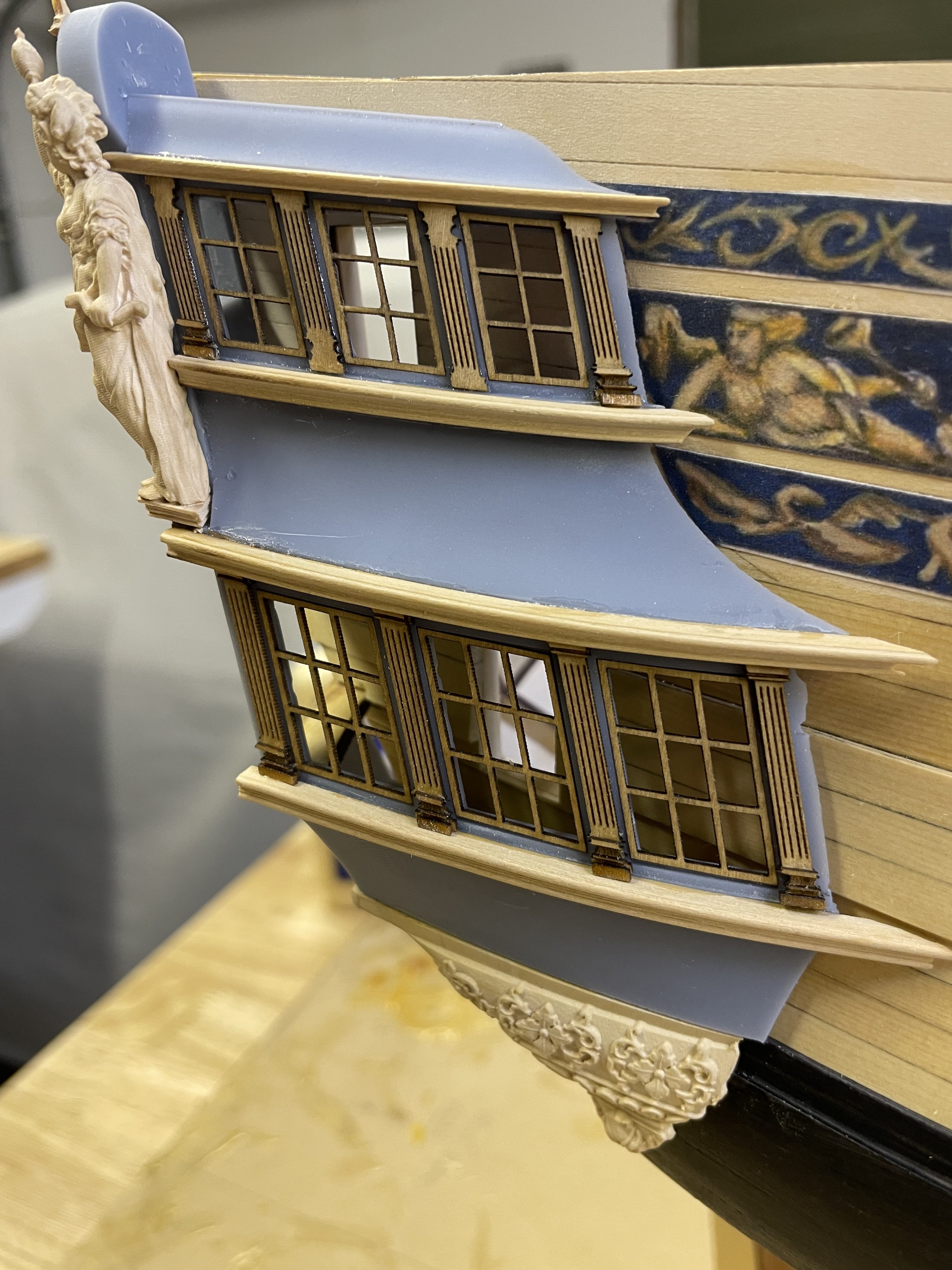

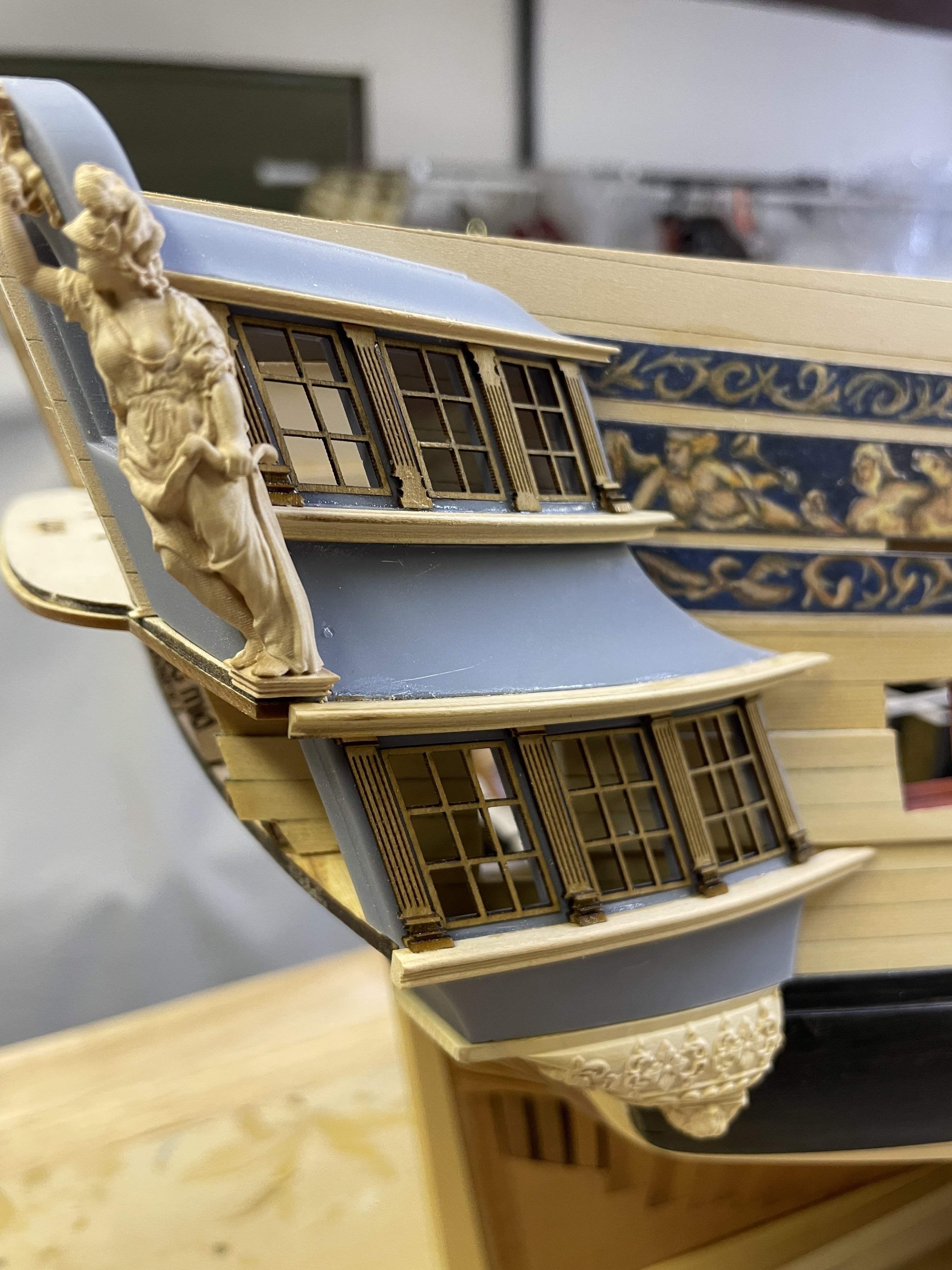

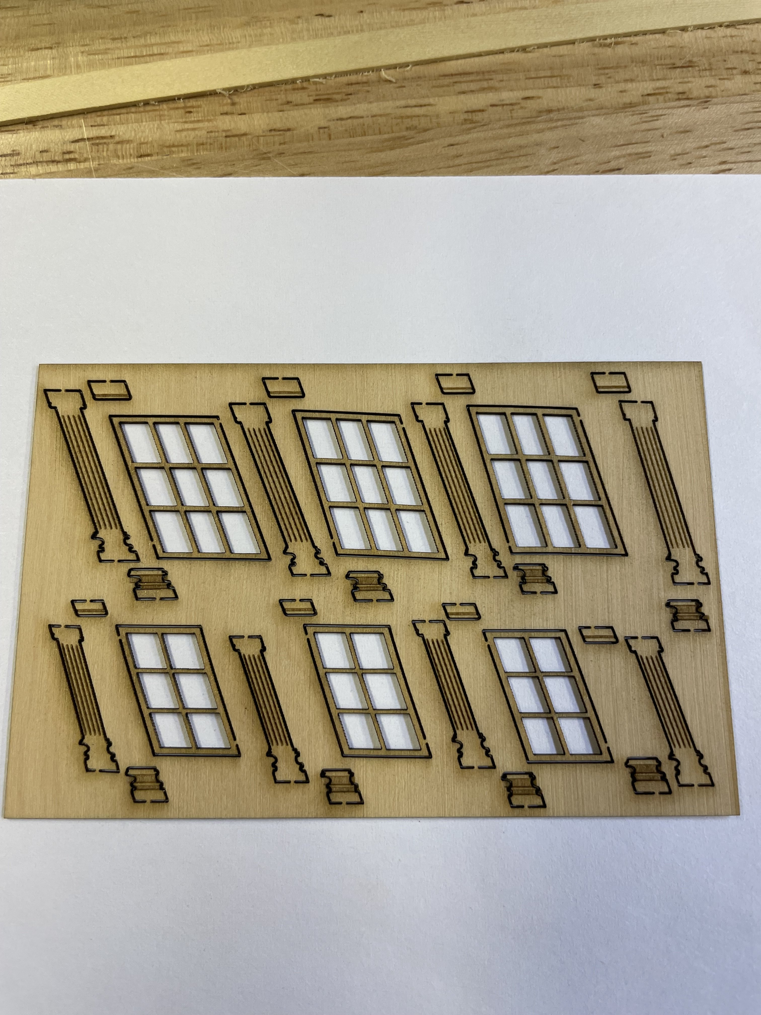

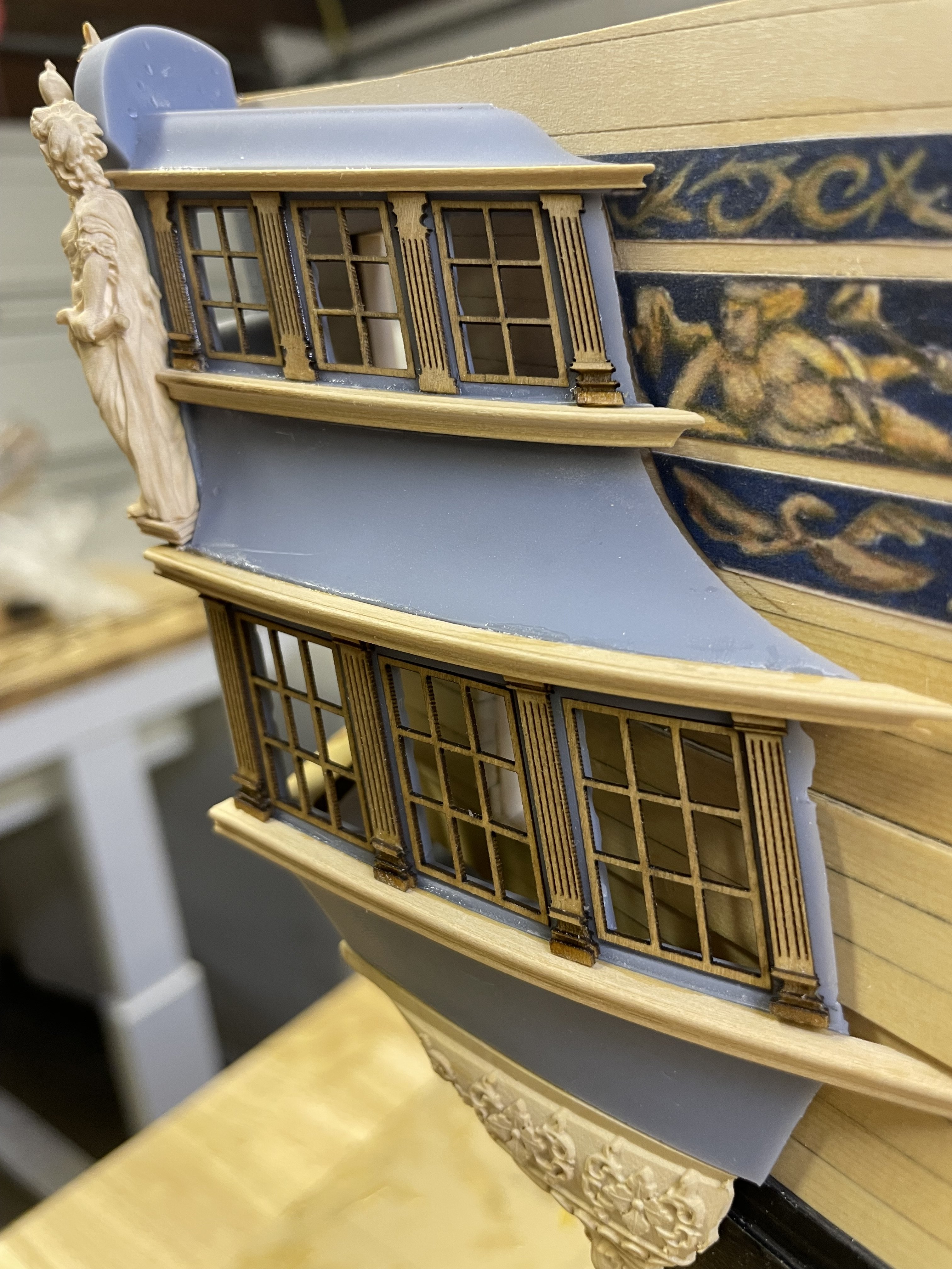

Some very preliminary QG work done tonight. Lots of boxwood had to die for this to happen. New revised windows on an old prototype QG, some messed up columns and oversized moldings. But you get the idea. There’s still much more to these things but this is the basic idea.
Those QG look great!
Kenny
Thanks guys. Still a ways to go. Will be making some more revisions to the 3D model today and hopefully print another one this evening. I’m hoping to have the QG design and laser cut parts sorted by early next week.
