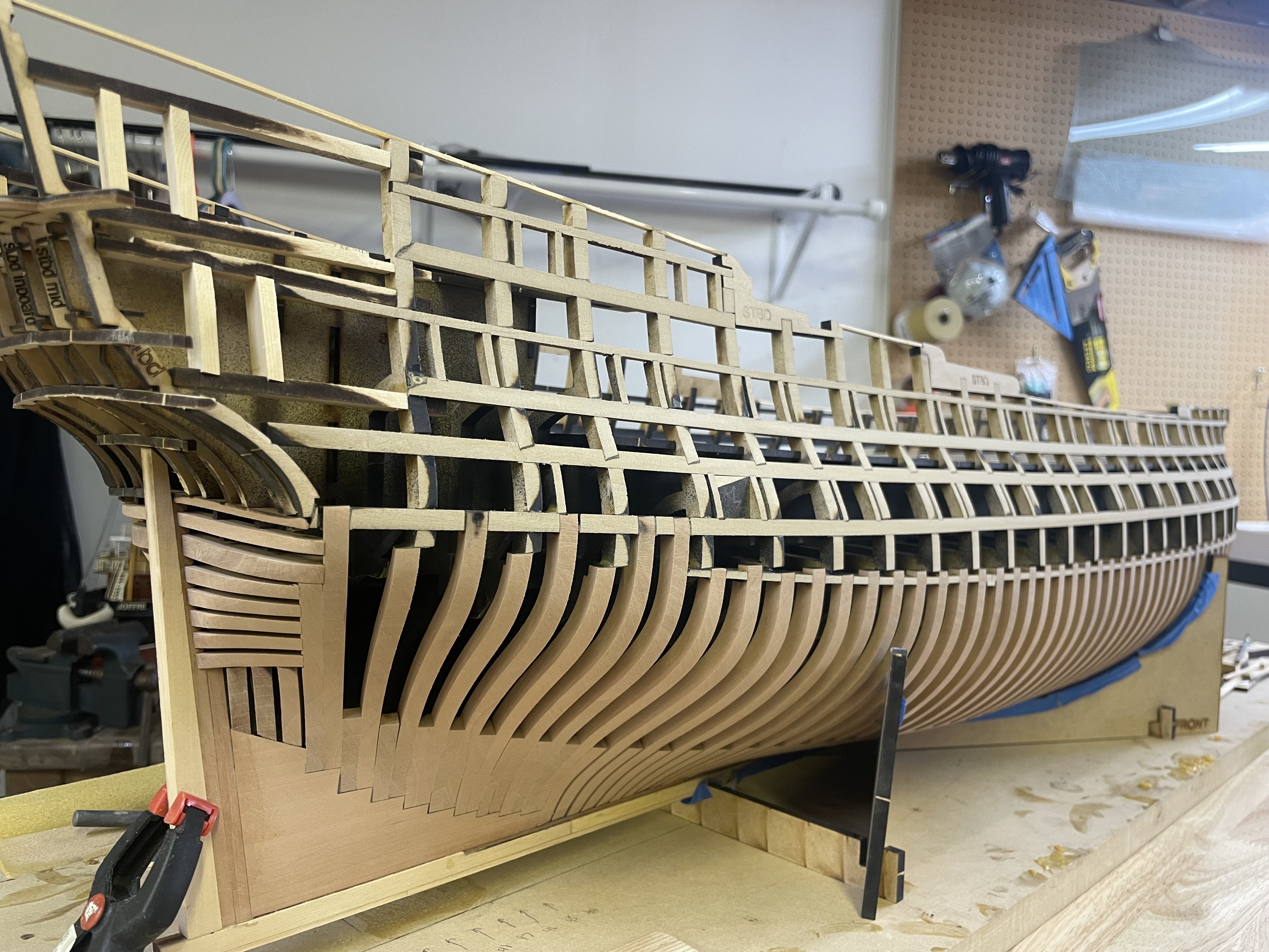

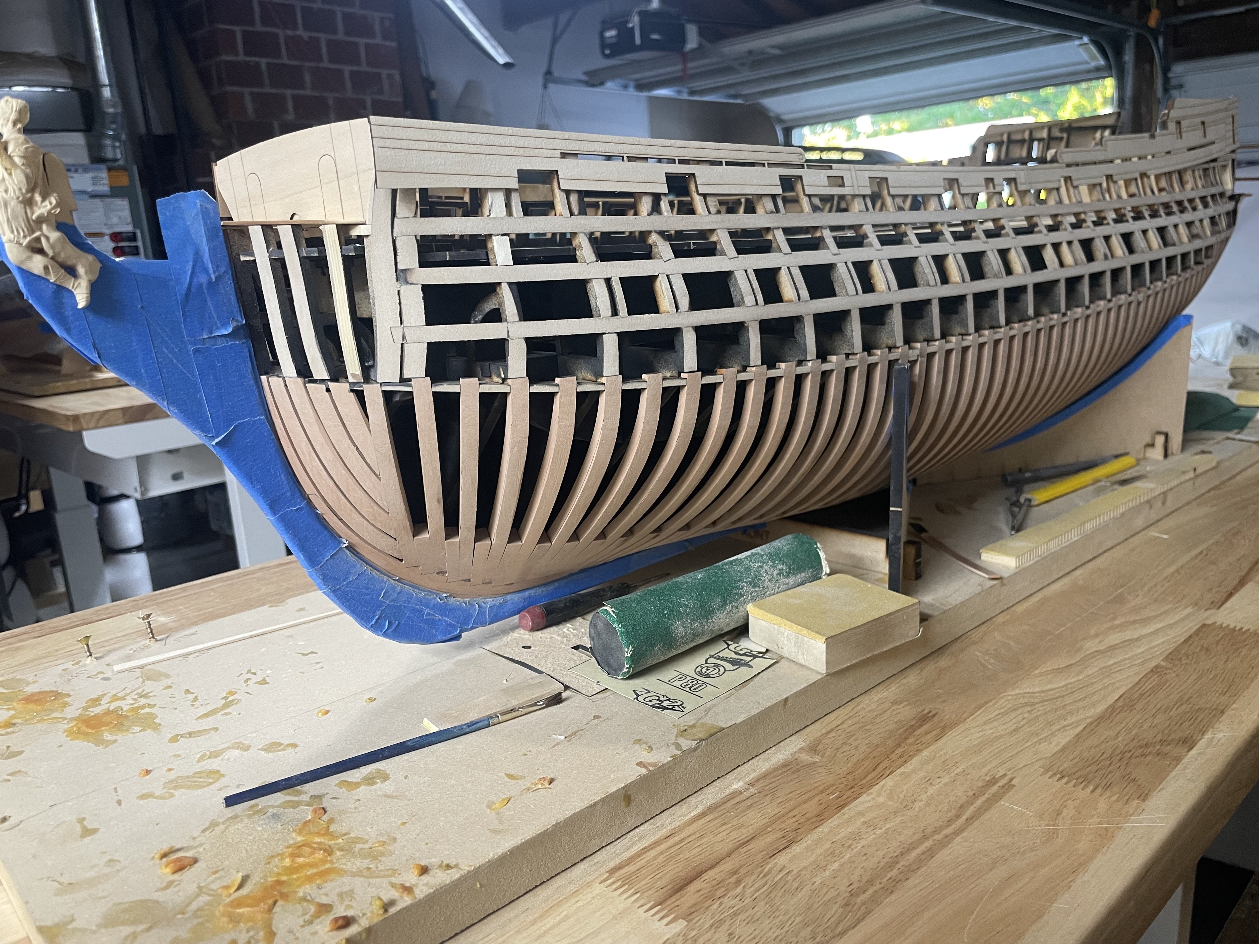

I’ve started fairing the hull, still a long way to go and Pear sands like cement but slow and steady wins the race. Hoping to have it completed within a week or so.

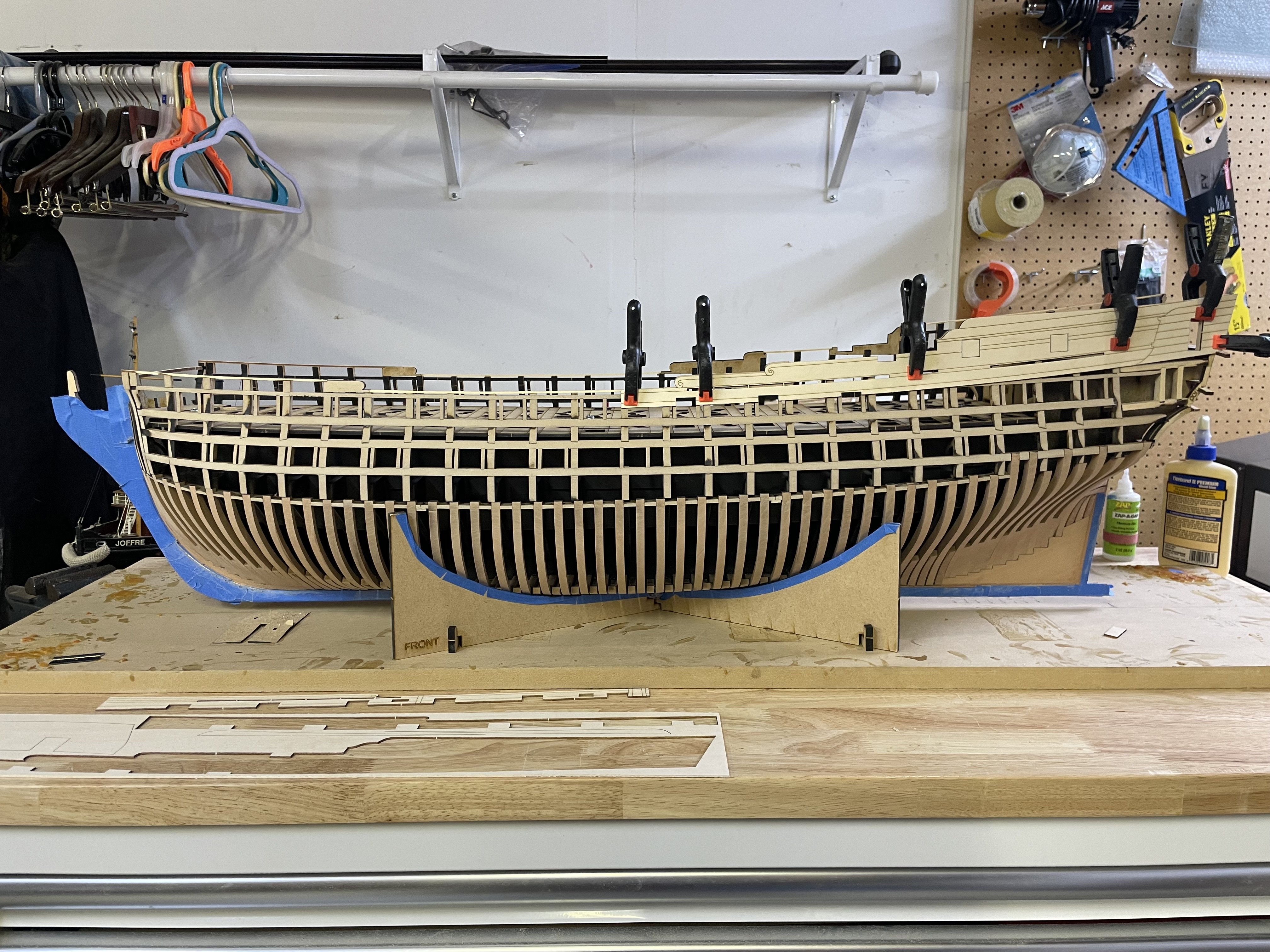

Today I got back to work on Portland, I faired up the lower counter and added some high build primer on all the gunport frames.
I used a solvent based high build primer to seal up the MDF, it soaked it up like a sponge. I’ve always been a little concerned about swelling when adding water based products to MDF, the primer also makes sanding and finishing the ports nice, it fills small gaps or joints in the port framing.
Ive also been working on planking guides that will attach to each bulkhead and assist with spilling, more on that soon.
IMG_9356.thumb.jpeg.0234c4097127208d2f8b60dbfea71f7b.jpegIMG_9355.thumb.jpeg.c5ec66117cebe7ad3ea7b7138b80f059.jpeg
Officially underway on chapter 2 now, I have all the Gunports primed, block sanded and painted. Tomorrow I will start milling wood and begin planking from the main wale up.

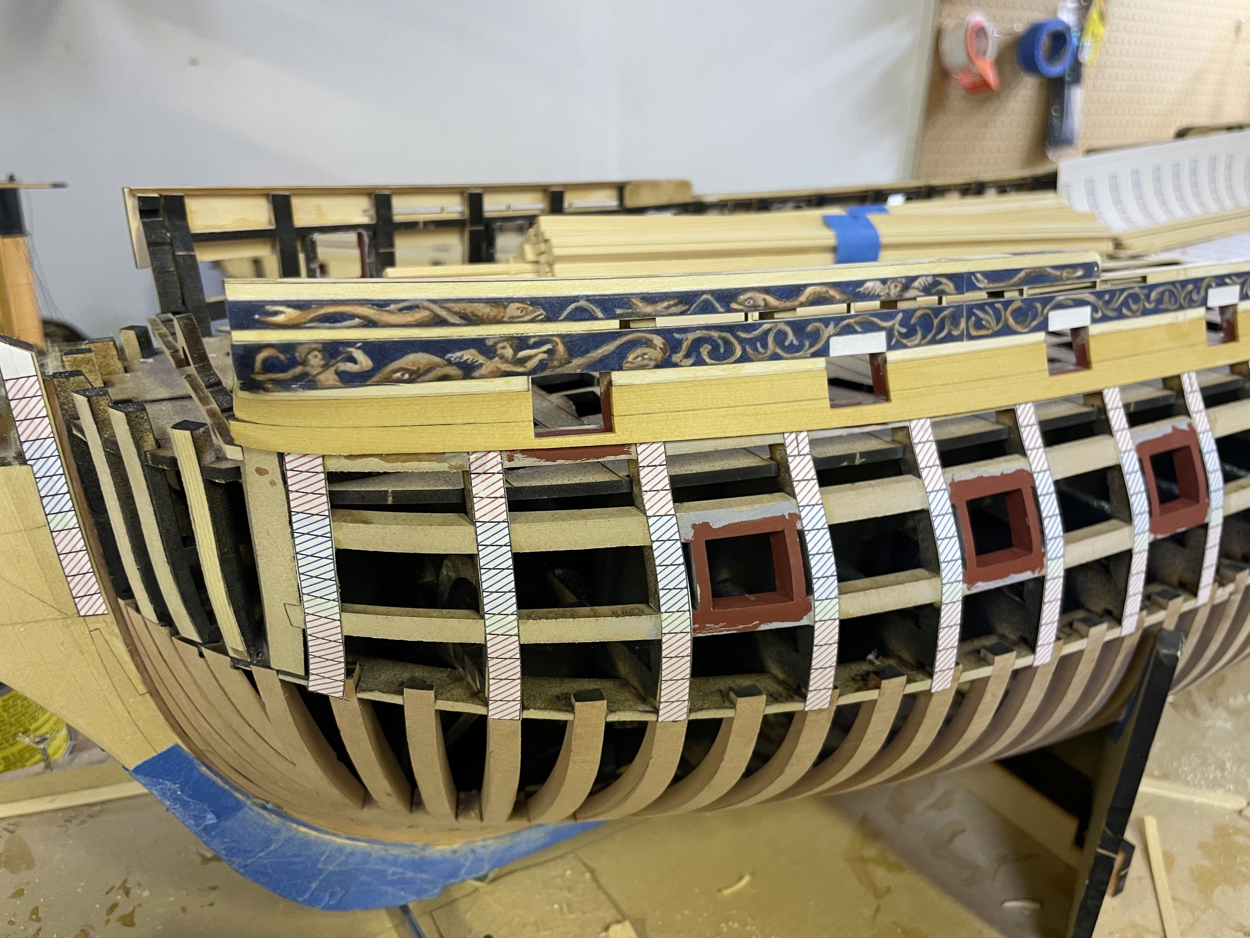

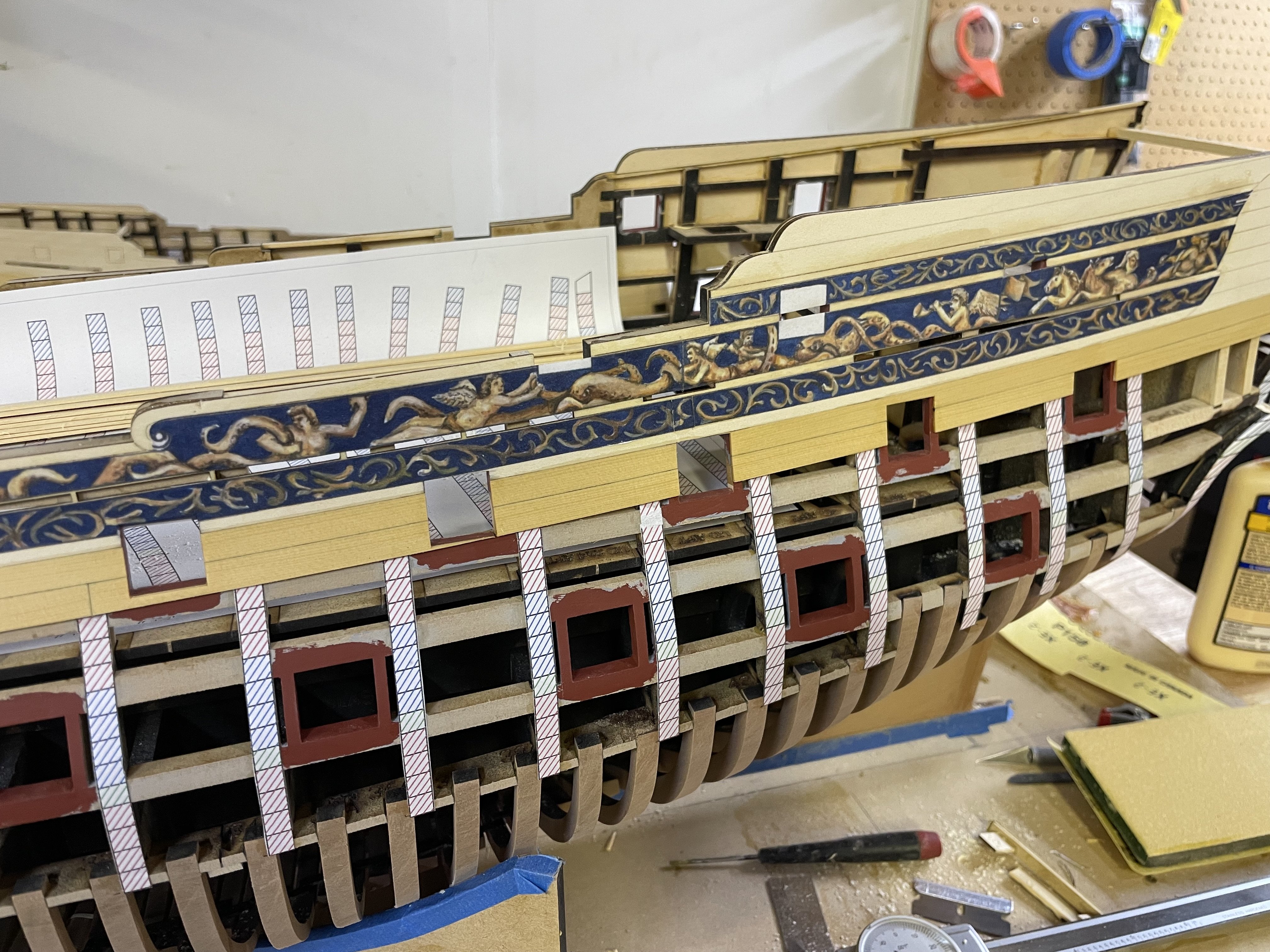

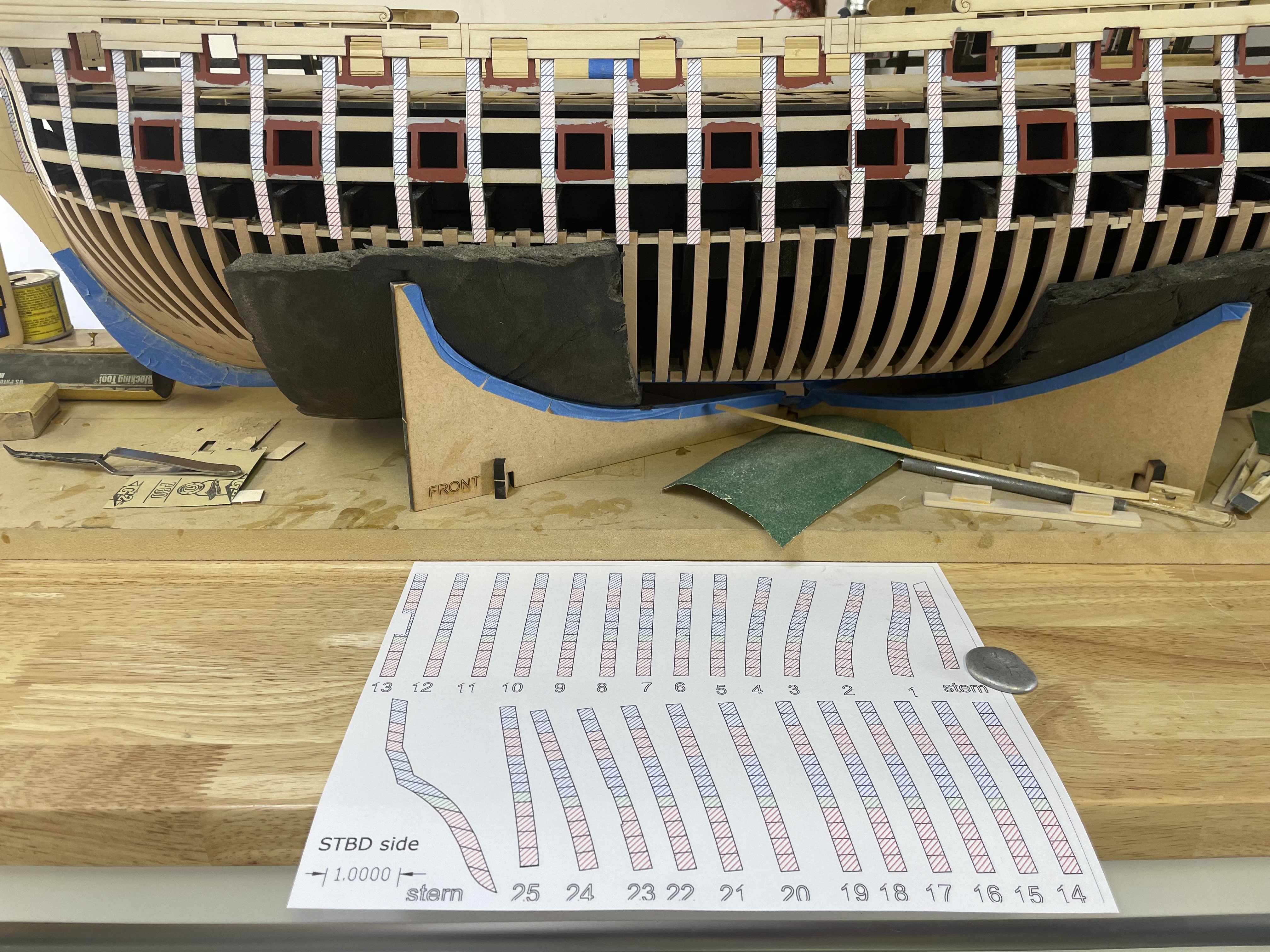

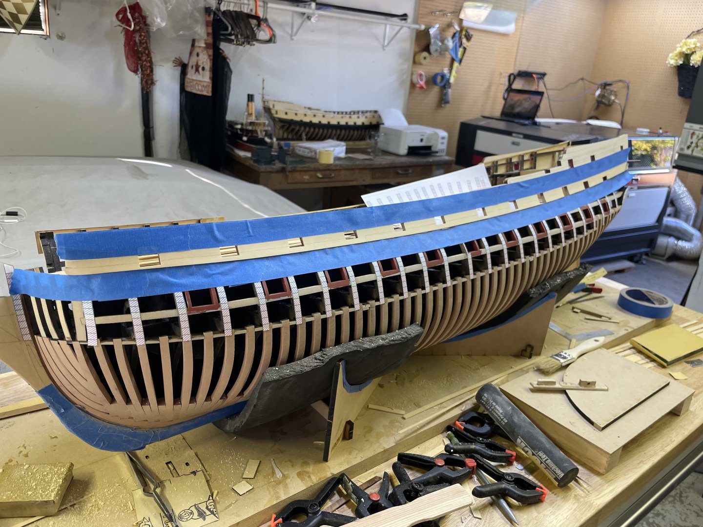

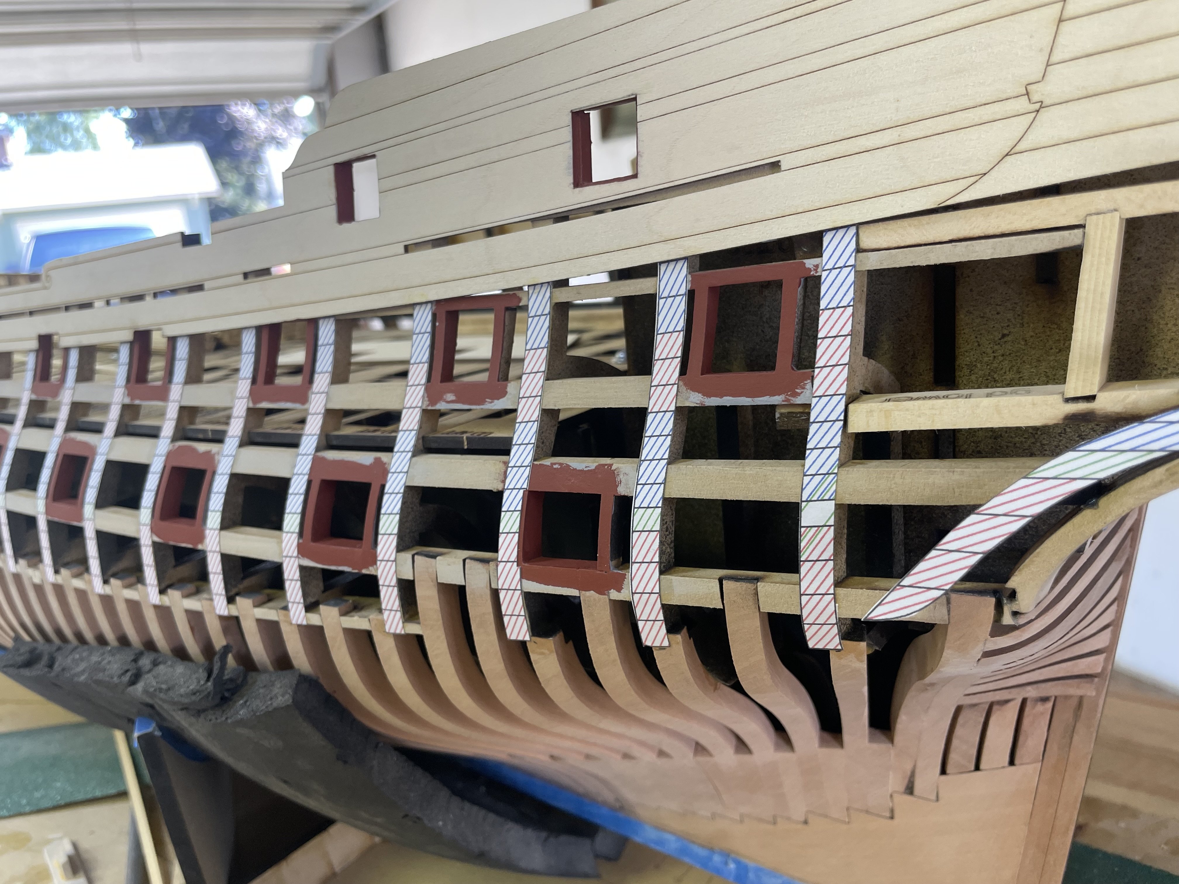

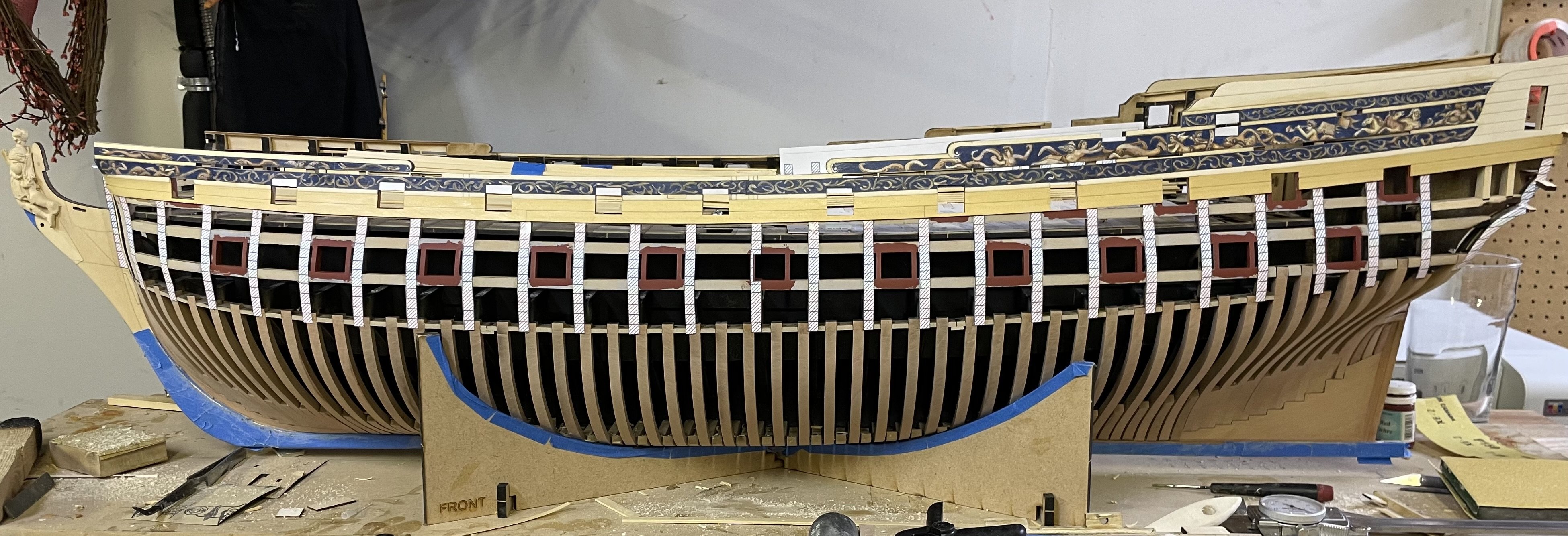

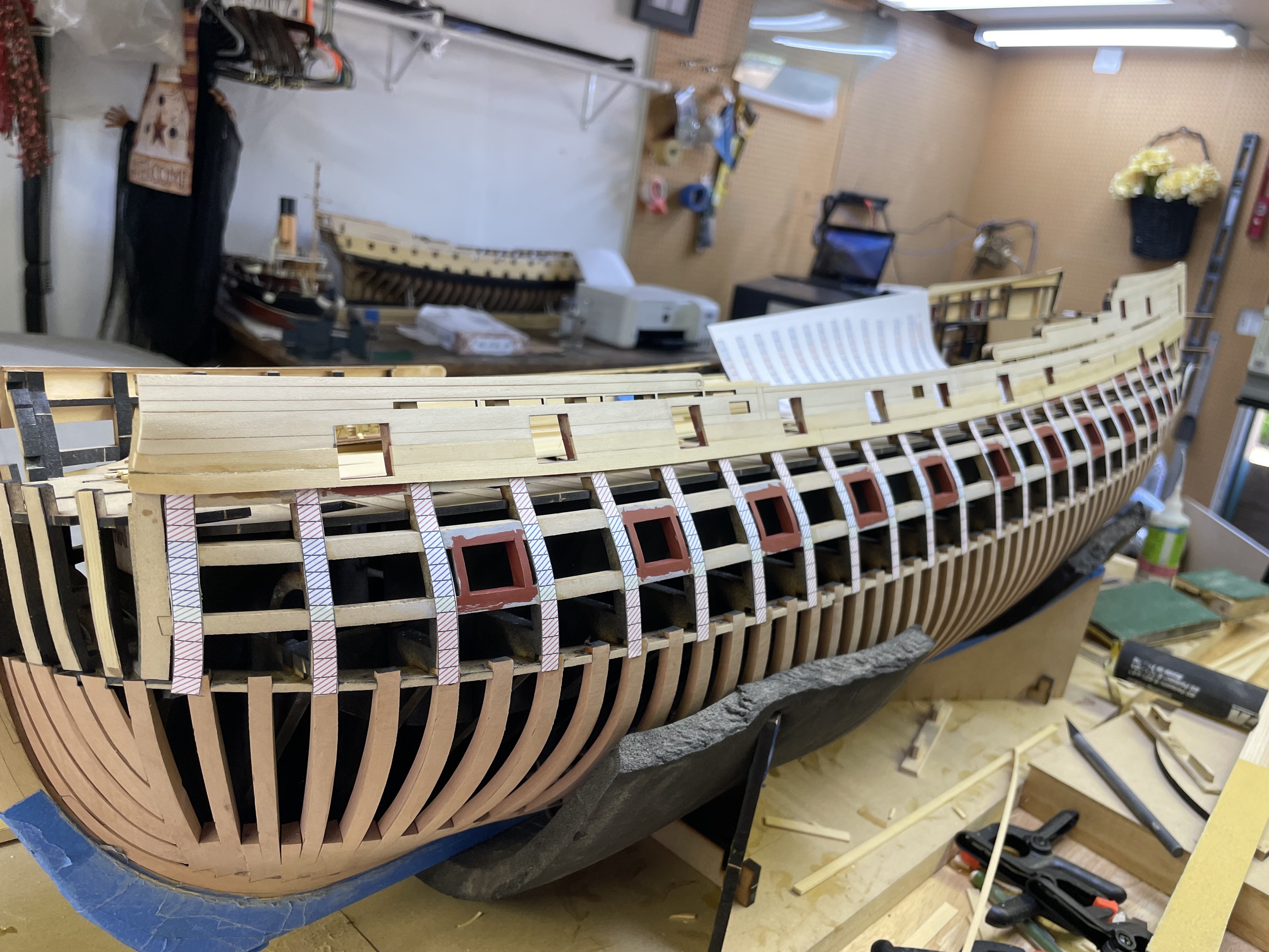

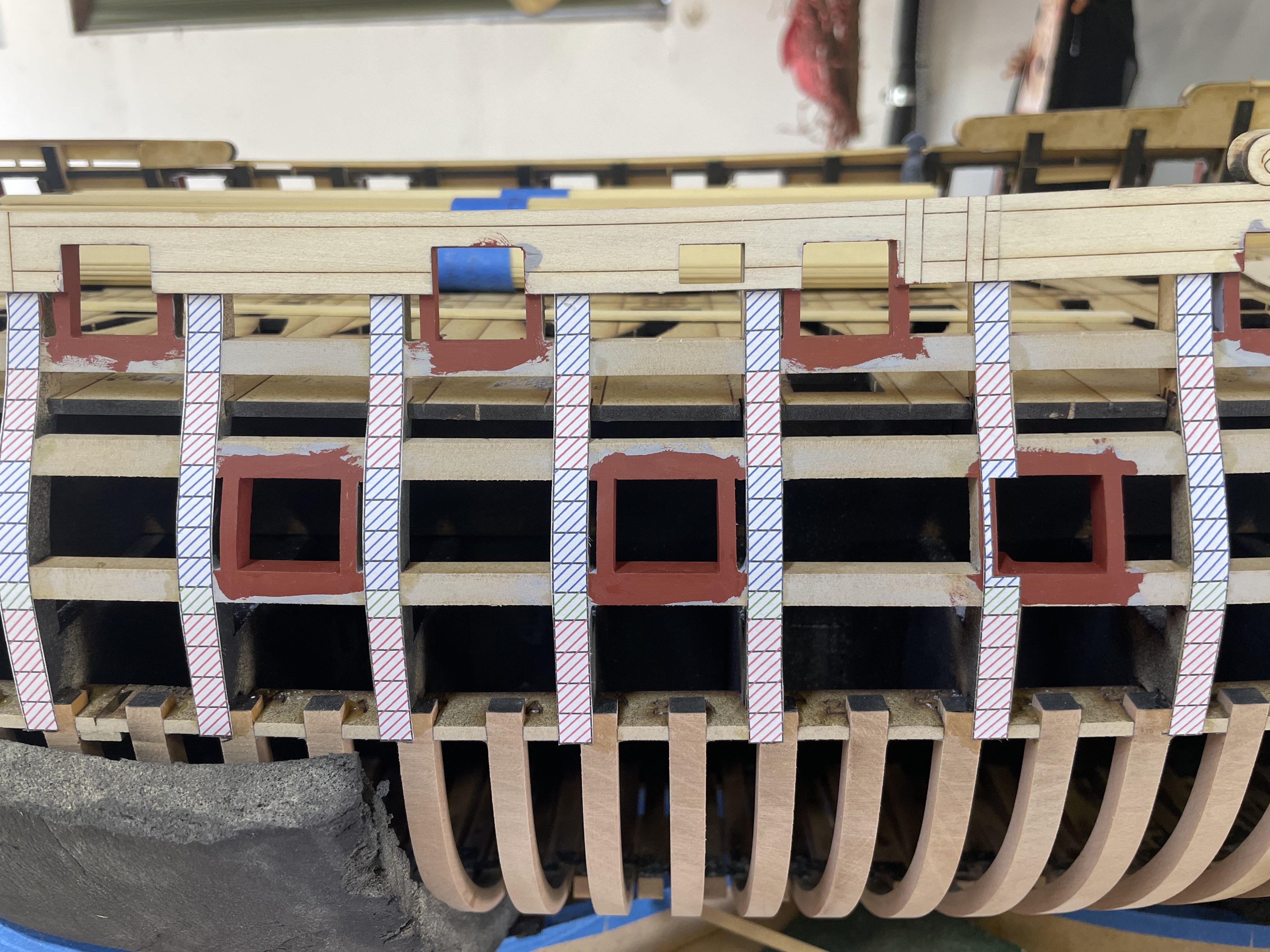

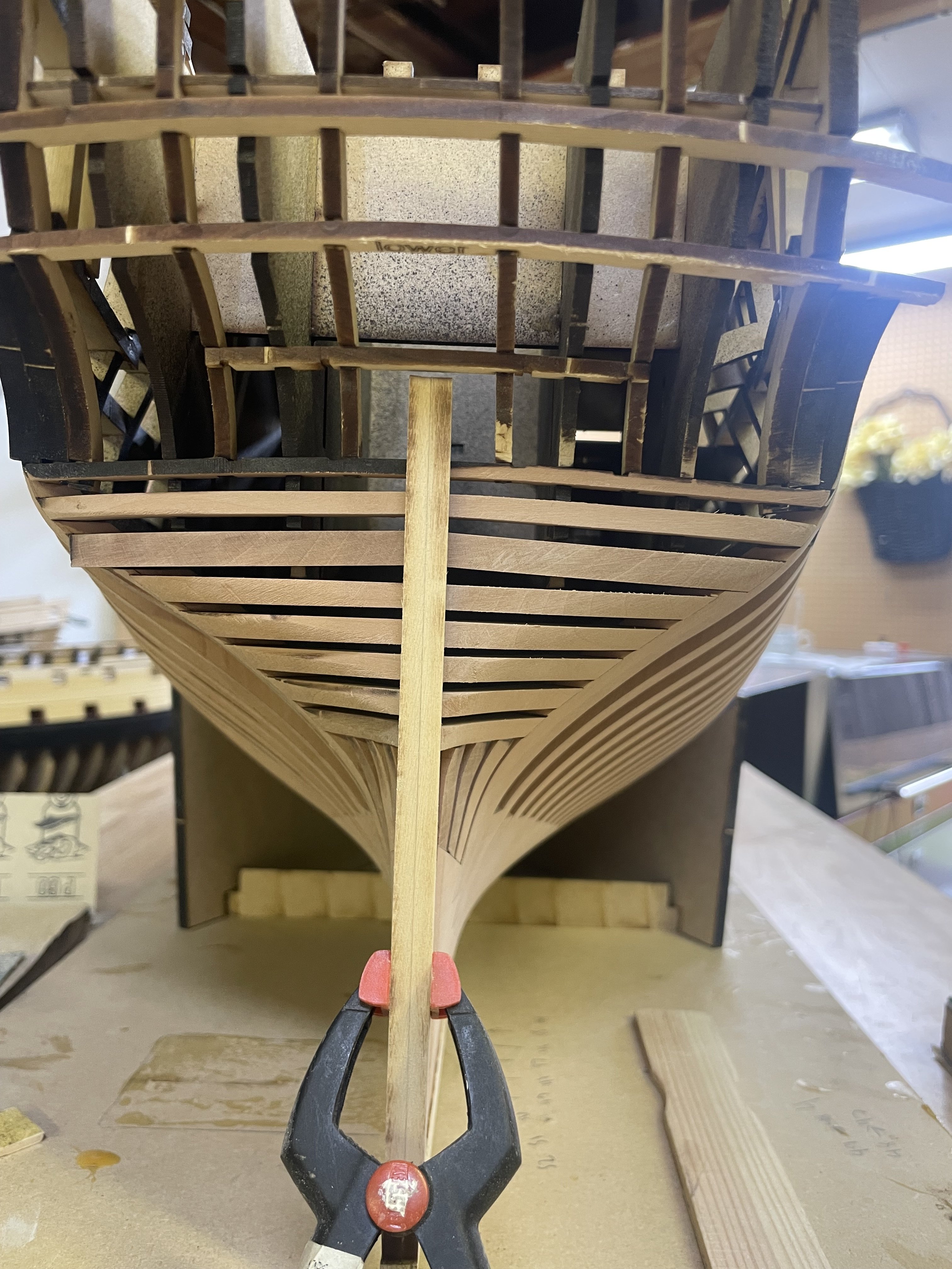

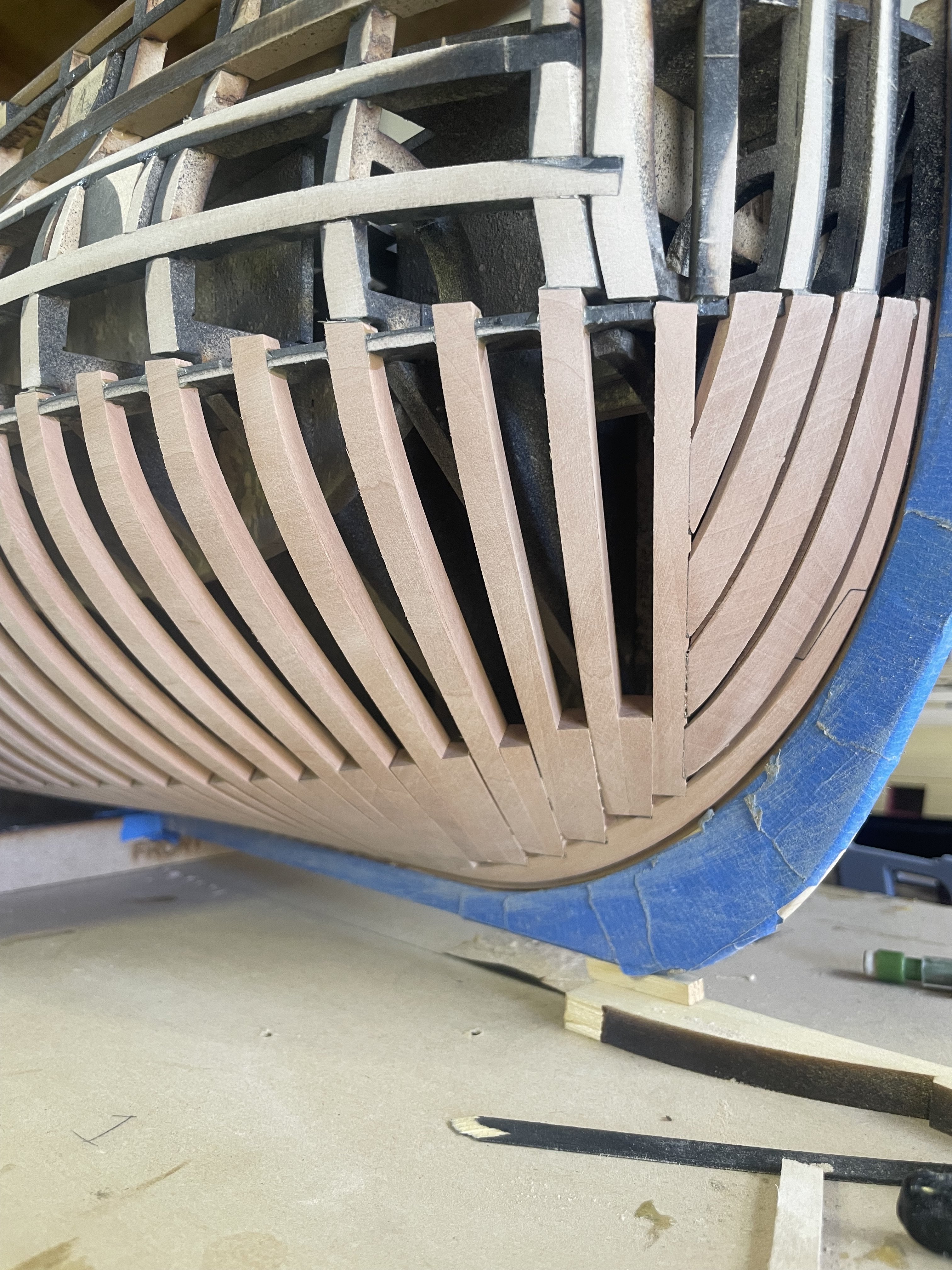

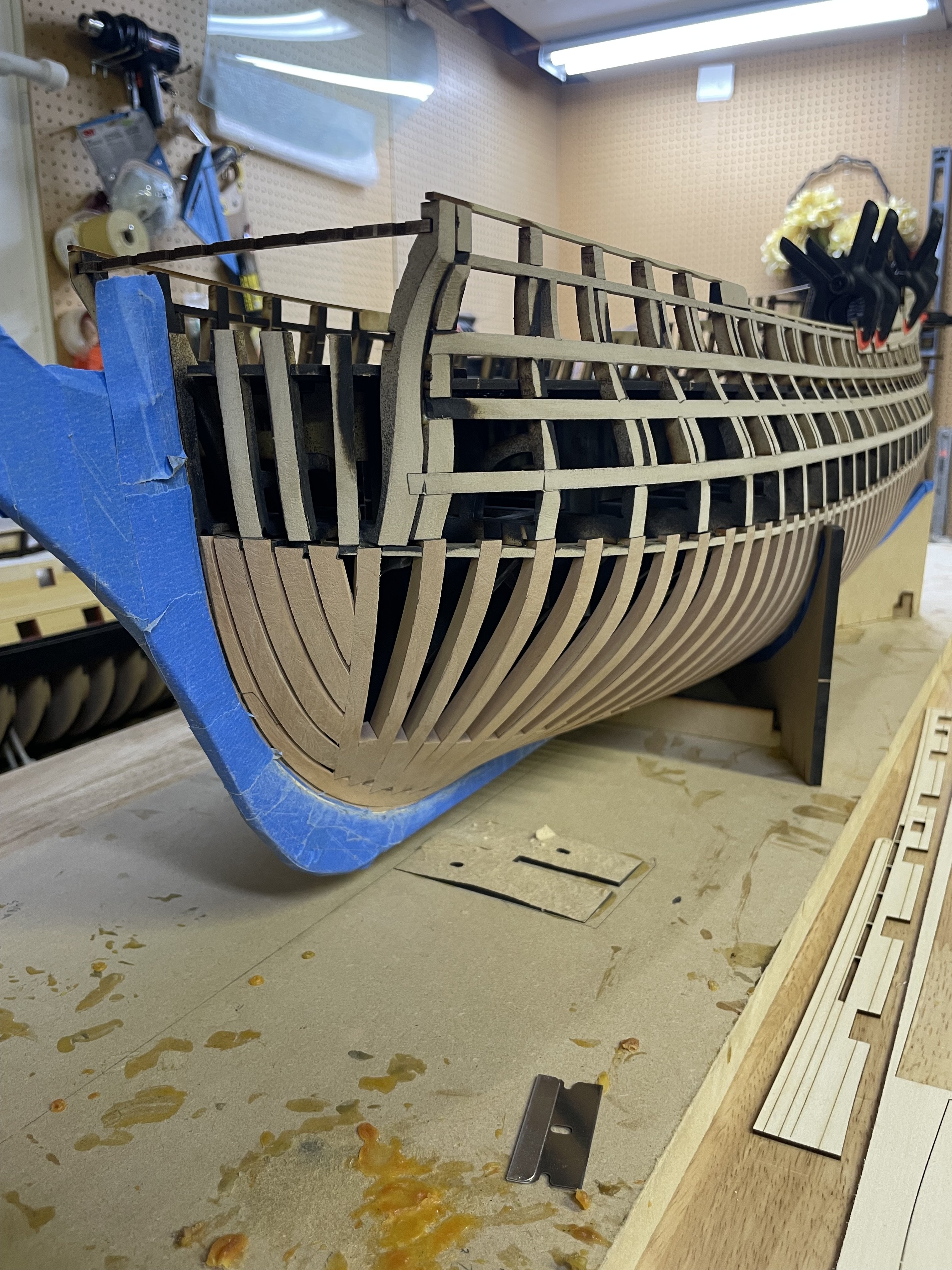

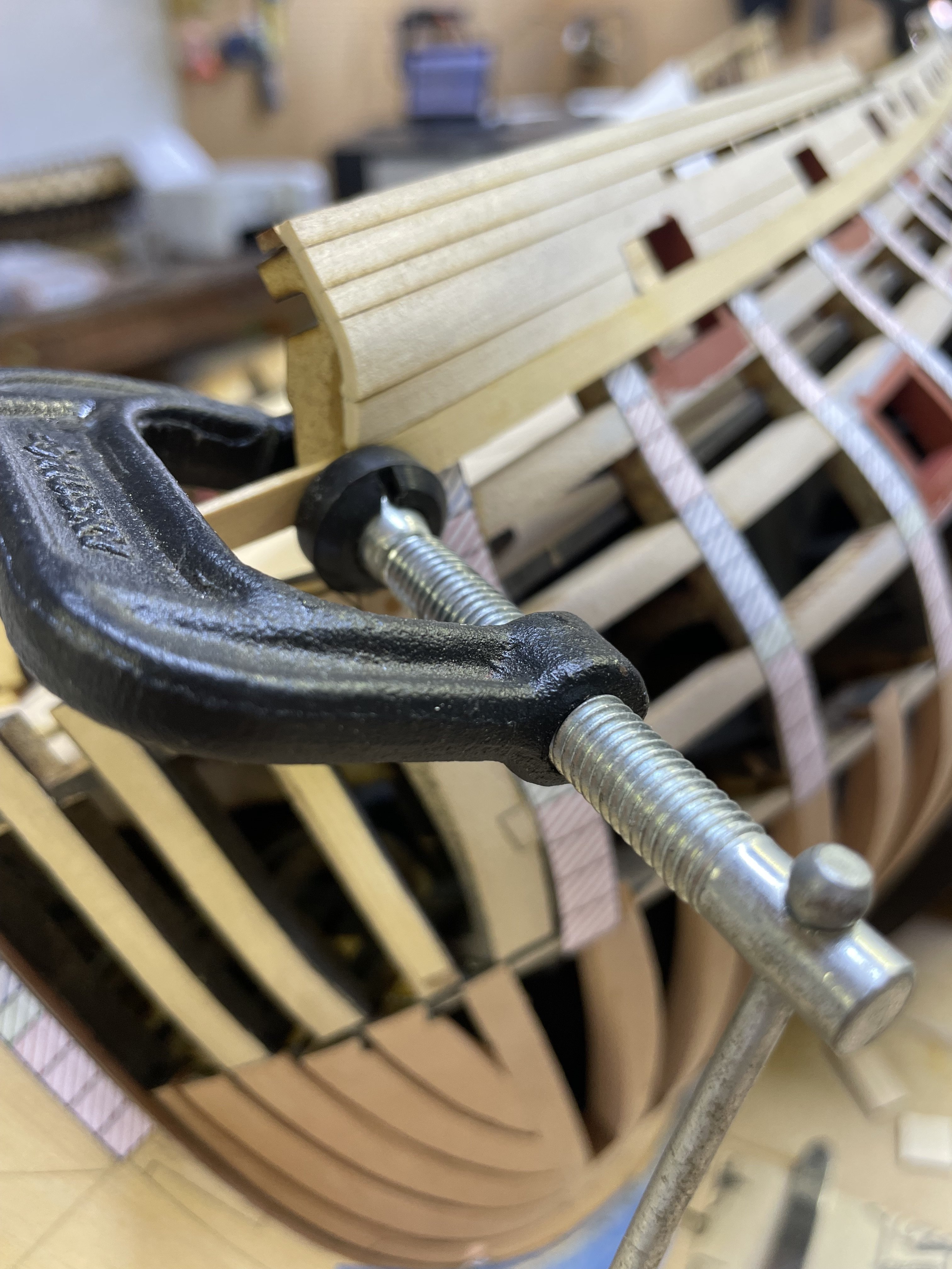

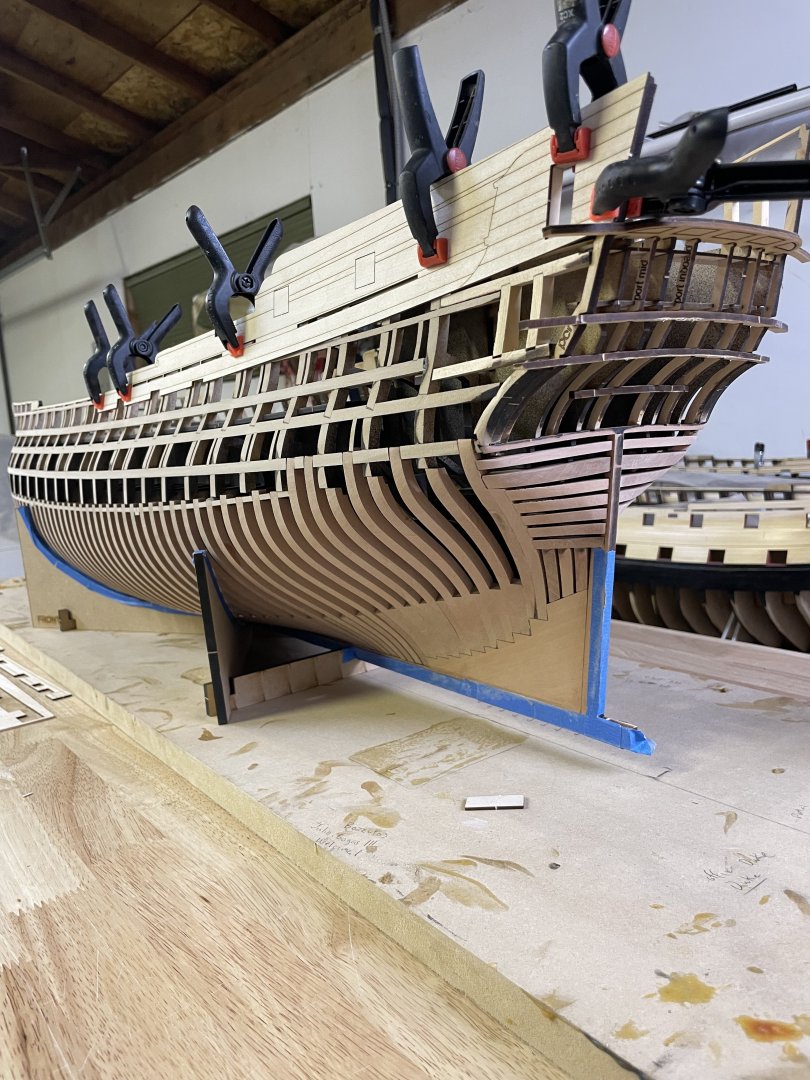

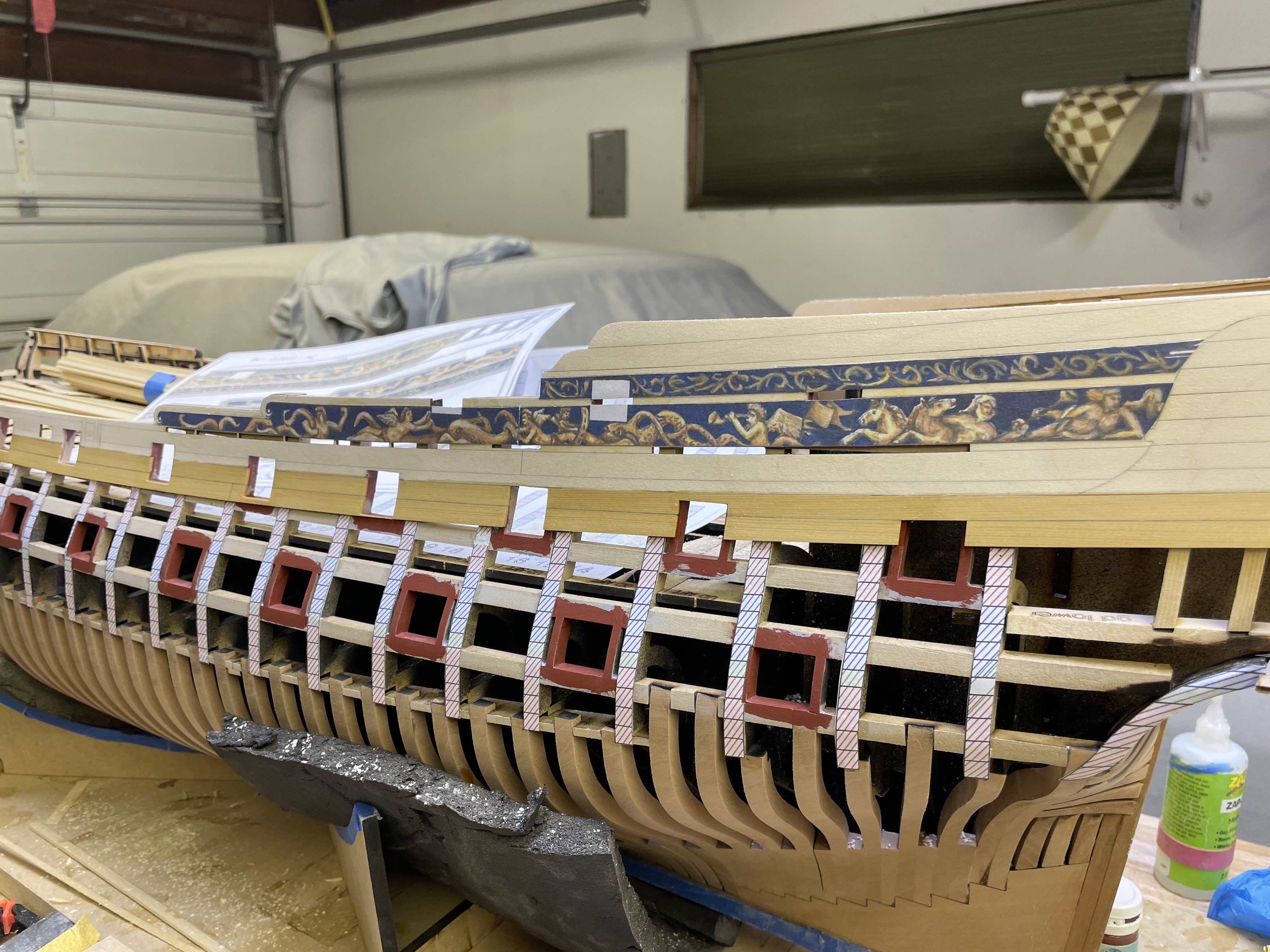

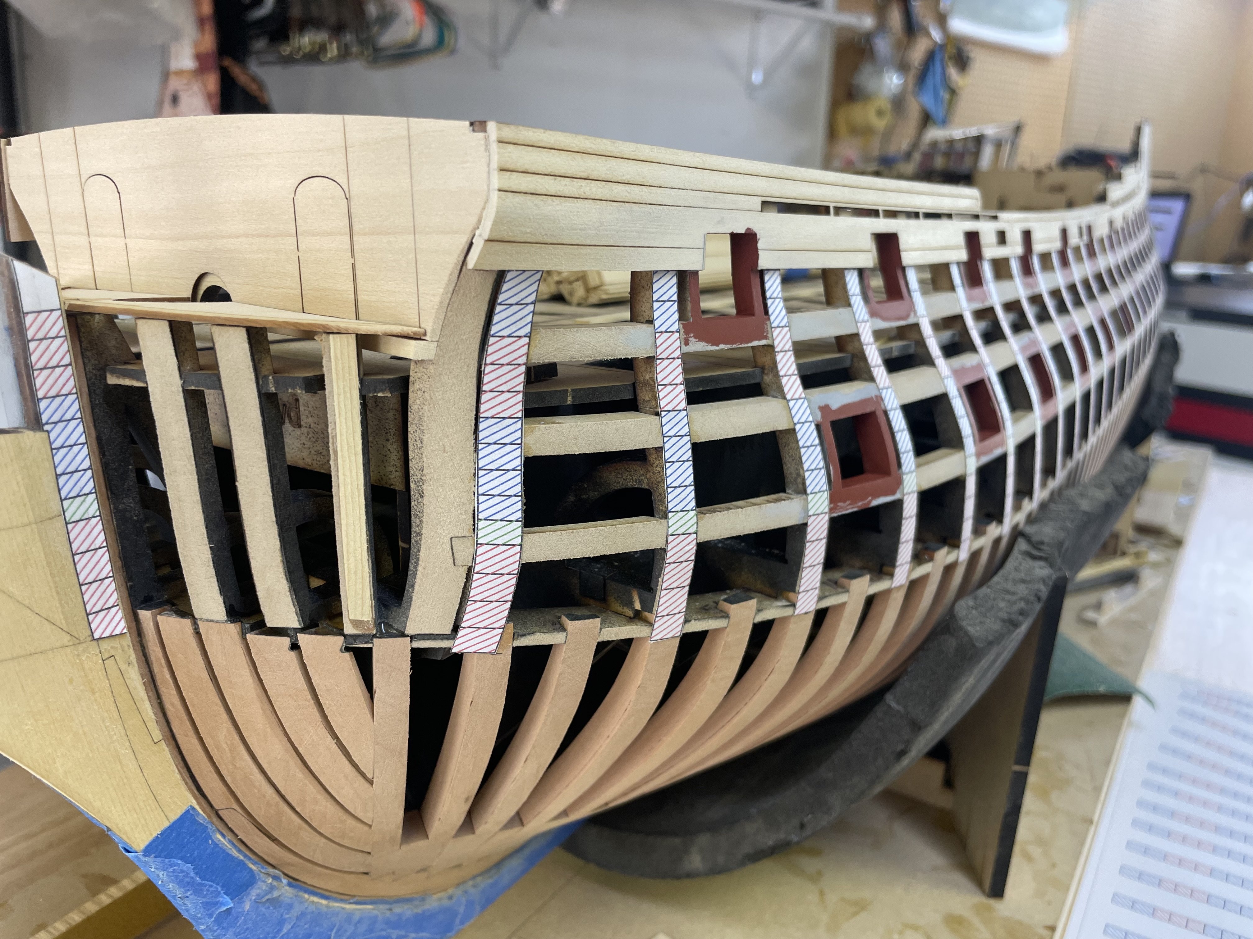

Been working on Portland all day. I started by gluing on the planking strips that I took off the 3D model, these were derived off of the 2D planking being projected onto the 3D hull and then flattening the surfaces and turning them into a printable 2D document. So far they are working as planned.

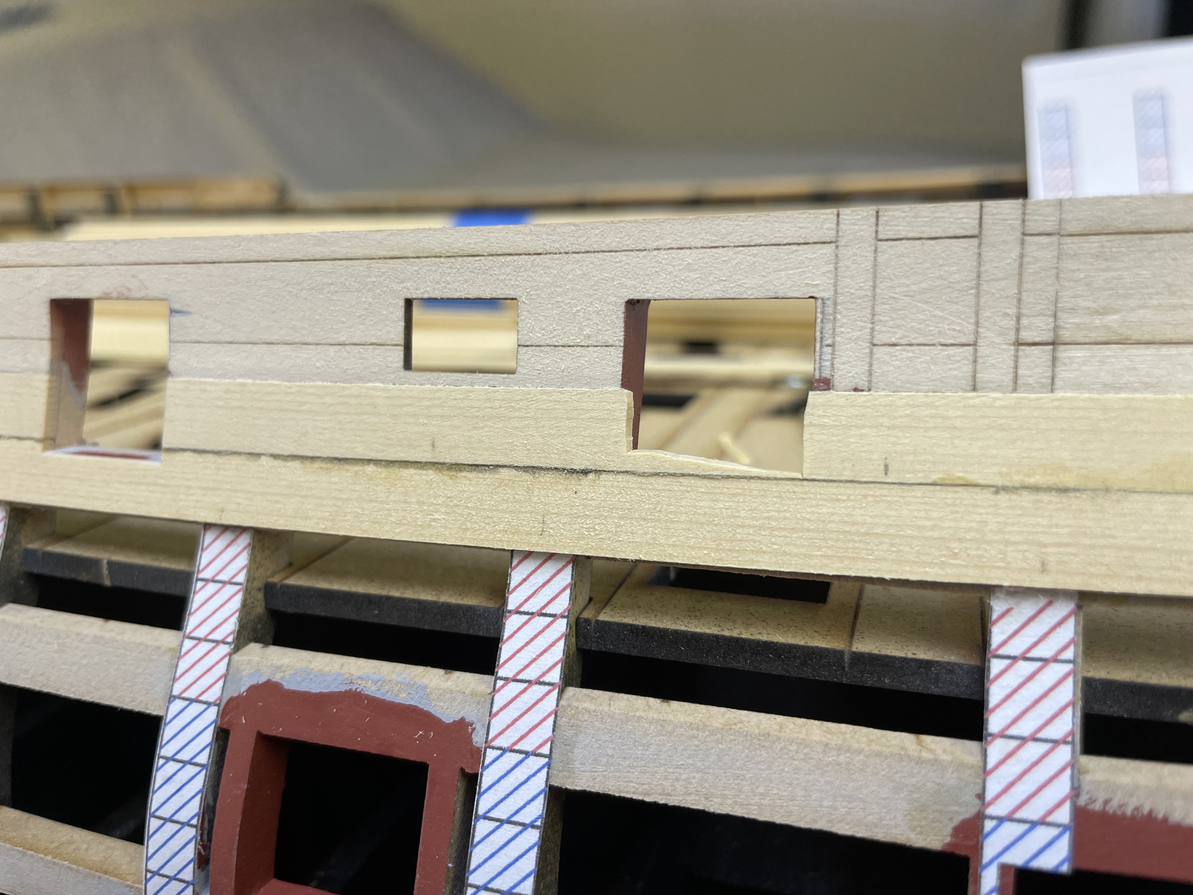

I stated planking the first belt from the frieze panel down, this consists of two planks and took most of the day.
I decided to run the planks right over the gunports as they won’t have doors over them, I can just sand the planks flush right to the frame. This really makes it easy to get a smooth running strake.
I can simply carve out the port rough and file them down carefully.

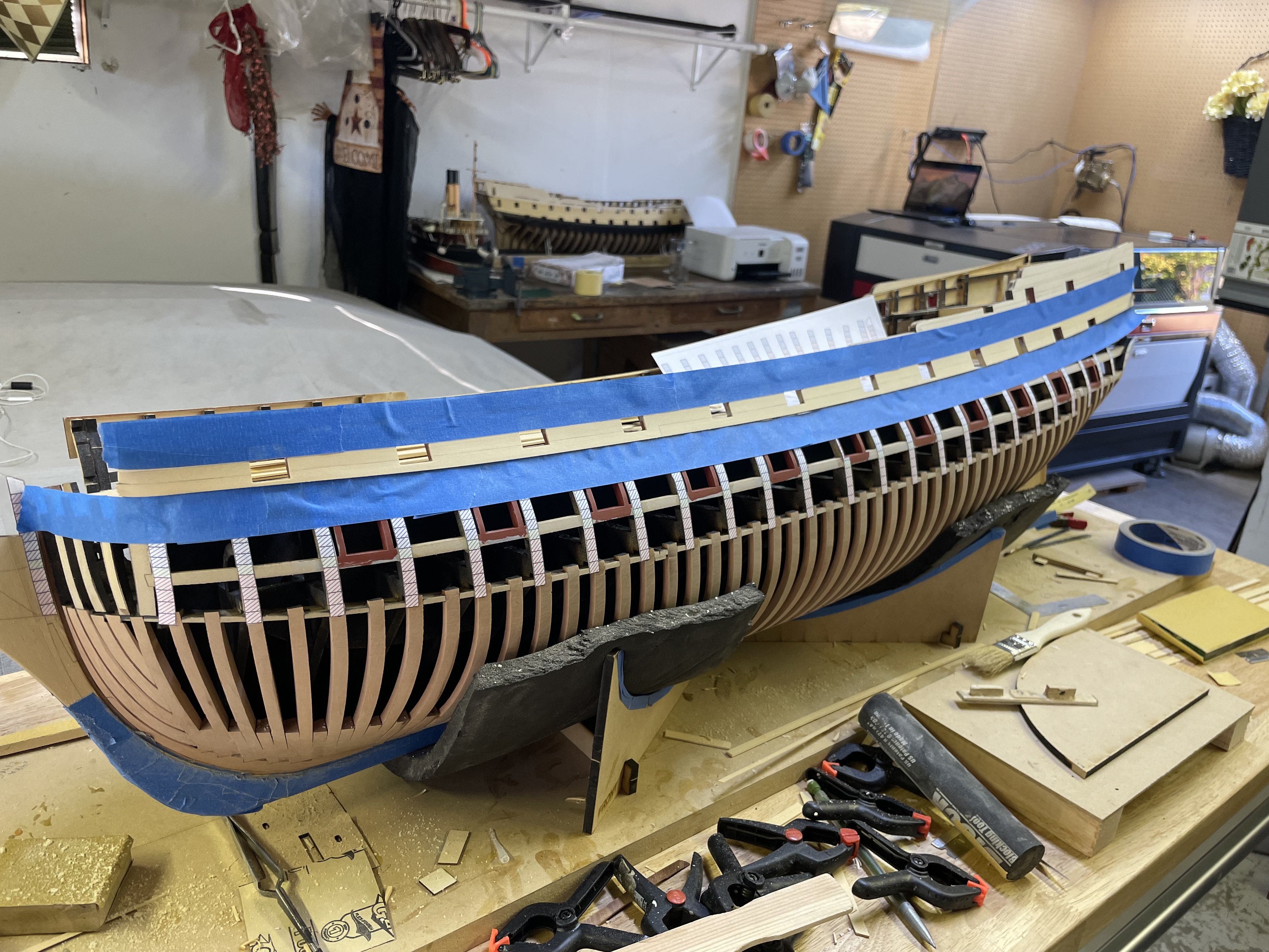

Once all the ports were opened up I block sanded the whole side down with 150/220 and then taped off that belt and sealed it with WOP to protect it, this will also allow me to paint the ports again with ease as any paint on the planks won’t soak in and will just wipe off with some alcohol leaving a perfect sharp paint edge around the port.

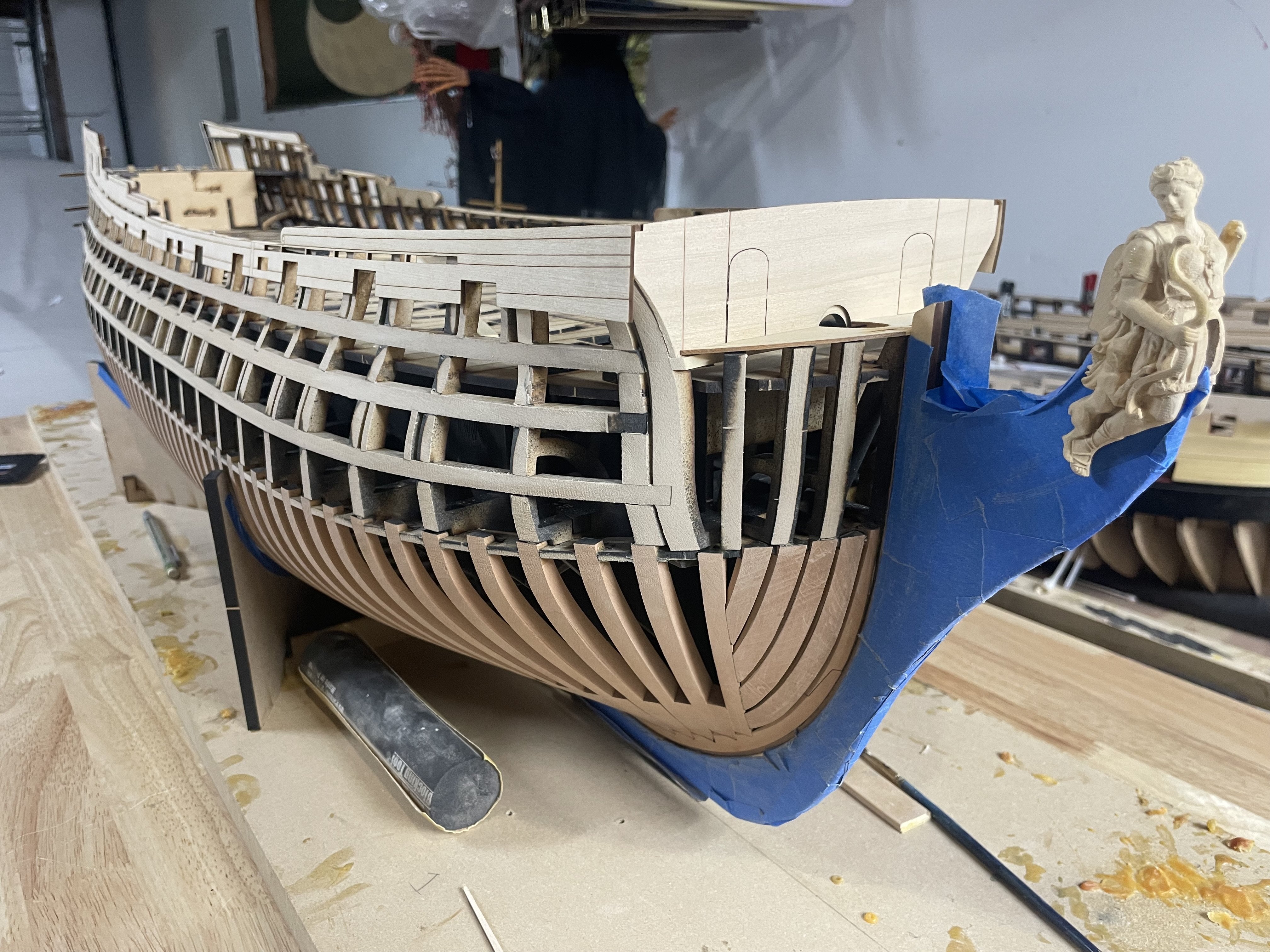

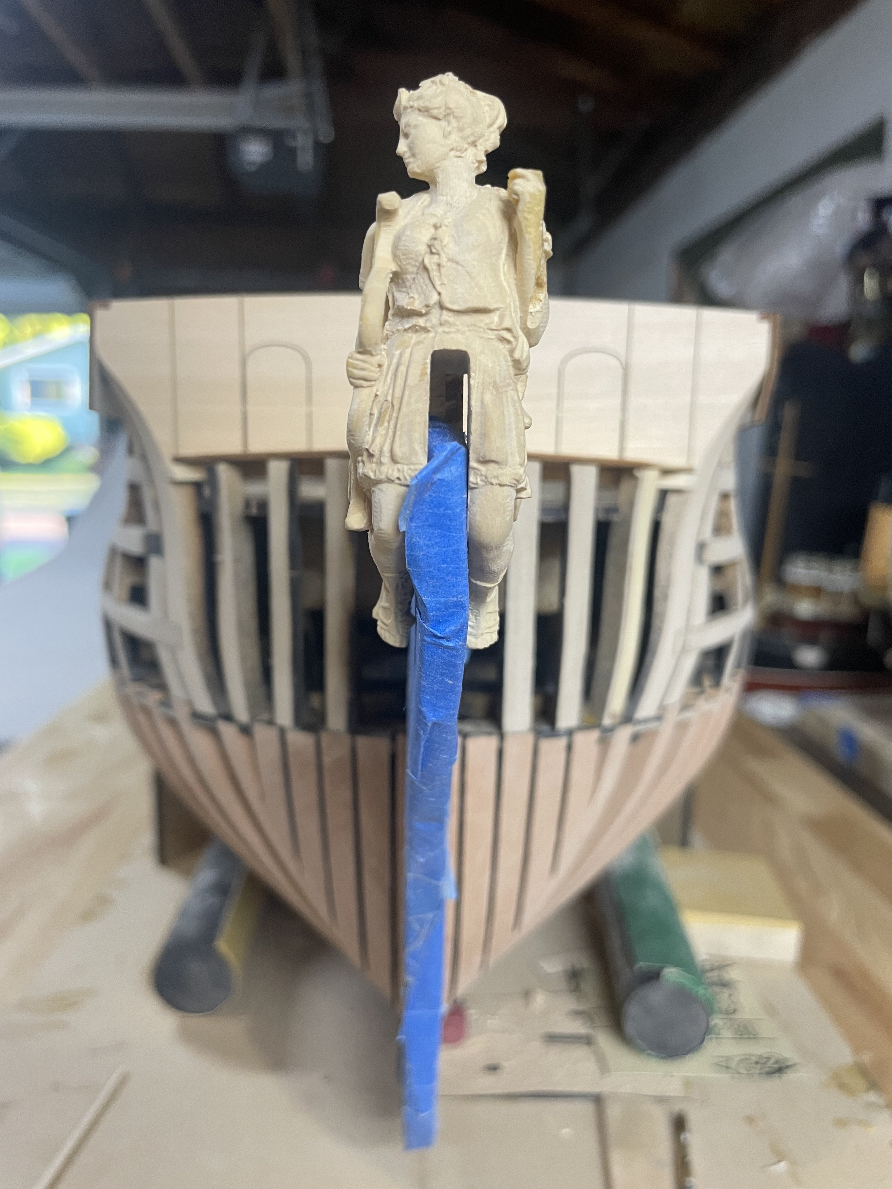

I couldn’t resist any longer so I glued the friezes on, the fit was pretty good and I only have to make a few adjustments to the document. Overall I’m satisfied with how they turned out. I should have molding scrapers coming soon that are specifically designed to match Portlands molding profiles taken from the drawings and painting, it will be nice to tie up the blank spaces with some nice boxwood molding.IMG_9386.thumb.jpeg.707e53a0d33cc894e75c99dcadaed2e0.jpeg

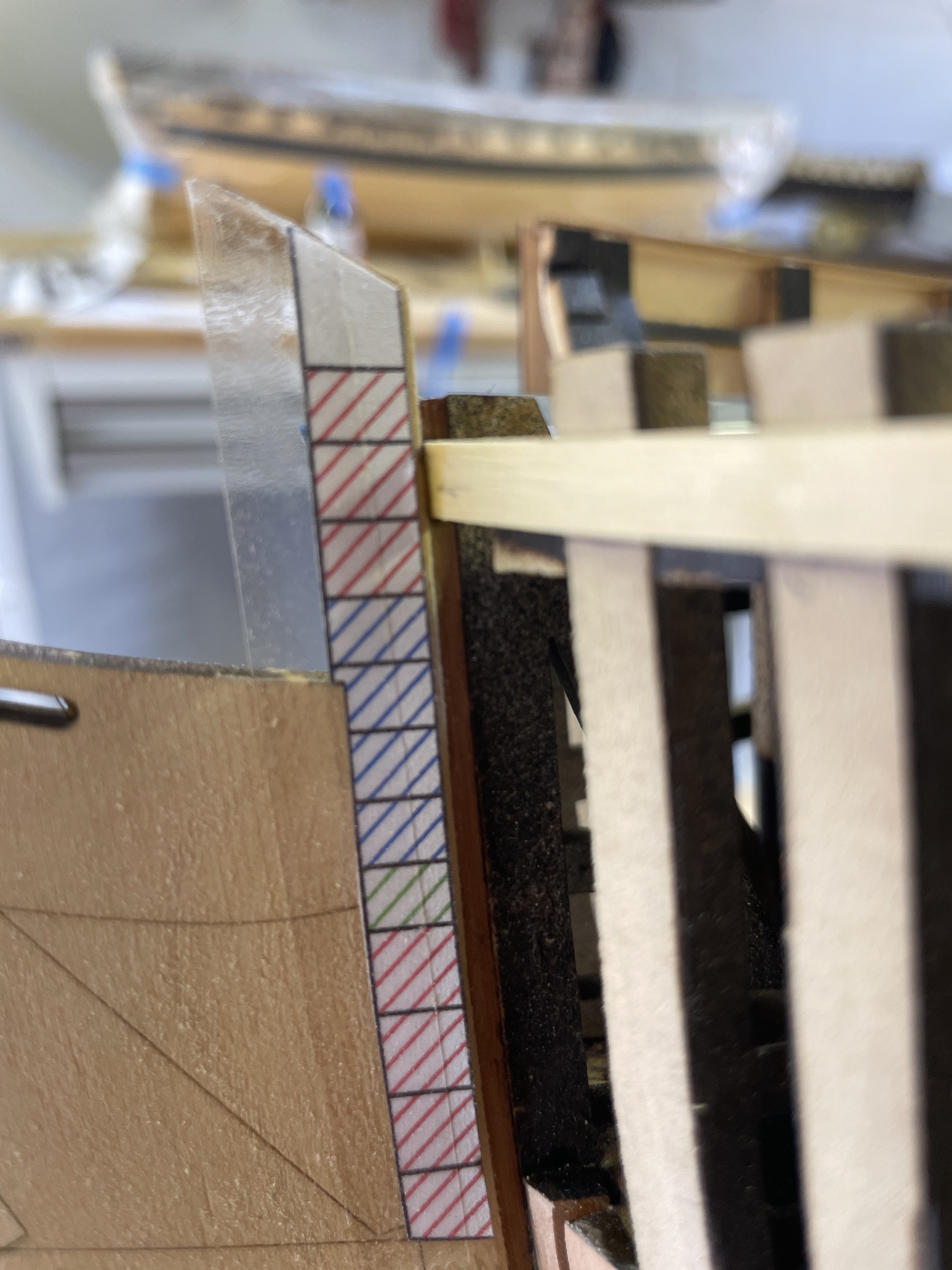

What do the color changes on the strips signify? Why do the lines on the strips run in different directions?
I can not tell from the picture if there is a rabbit on the bow and stern where the planks meet the keel.
Those colors represent their respective planking belt. I will do a midship section diagram for the instructions. basically blue is regular planking .050” and red are the wales at .120-.140” with green representing the black strake. The lines are just hatching from CAD so I didn’t have to fill the whole thing with color.
There is, it’s pearwood/cherry
